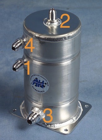

Fuel System:
Please remember I don't have a clue about a lot of this stuff so looking for some help please :)
While re-doing the loom I am going to be sorting another thing on the car which is the fuel supply system as it the high pressure pump will need power I guess.
I currently have a solid fuel rail from AT Power but into it runs the standard renault fuel pipe and I worry about the connection a little so going to run the whole system in braided hose. I am going to mount the Swirl pot in the bulkhead but I believe the swirl pot has to have a return from the other end of the fuel rail which is currently blanked off. So do I need to:
Run -6 hose from In tank pump through car, into scuttle panel and then into (1) on the swirl pot
Run -6 hose from (2) on the swirl pot back into the return on the standard fuel tank (I don't think the 182 has one of these does it? Do I need a ph1 setup?)
Run -8 hose from (3) on the swirl pot to Sytec fuel pump
Run -6 hose from High pressure fuel pump to -6 fitting on fuel rail
Run -6 hose from other end of fuel rail back into (4) on the swirl pot
Does the above sound correct and do I need to run another fuel filter?
Will -6 fuel line fit onto the pipe take off on the standard renault tank fittings?
I am planning on using Aeroquip fittings as they are the most reasonable by quite a way has anyone had issues with them?
The fuel pump is rated to 9 bar fuel pressure is this enough? Do I need to add a regulated to reduce this back to renault pressure? (Sorry I really am clueless with this stuff)
Thanks for any help you can give :)
James
  182/RS2/ Turbo/Mk1
On that swirl pot I would do:
Phase 1 cradle output goes to number 1;
phase 1 cradle return goes to number 4;
High pressure pump is fed by 3; which then feeds the fuel rail
Fuel pressure reg fed by the rail return goes to number 2;
Then you want a high flow low pressure pump fuel pump in the phase 1 cradle.
You would run a 3 bar reg on the rail, a 9 bar pump is more than enough, but you need to make sure it flows enough as well, 255L an hour is the normal one people go for on a setup like this. Likewise the lift pump needs to flow similar amounts.
And also add a filter between the swirl pot and the high pressure pump.
Ohh quite differently to what I thought then lol! Right so I need to get a PH1 pickup then, also a different pump for it you mean? Also a regulator?
Do you know if the fuel pipe connectors on the PH1 pick up will take the -6 pipe mate? I would go measure but the car is dangling on axel stands and I don't fancy getting in the car to measure lol

Was just looking to see if anyone knows the size of outlet where the fuel tank goes into the fuel hose? A pic would be awesome if you can but no worries if not Mike :) Thanks
  182/RS2/ Turbo/Mk1
I take it you do know that the fittings on the pump cradle wont be screw fittings like on that swirl pot by the way? Ie they will be either push on rubber pipes or something similar to the fuel line.
The outlet of the pump you mean? If so, ill take one later..
Yes that's the one thanks :)
Yes they are unfortunately push and jubilee clip jobs aren't they! I was just wanting to make sure the -6 hose will fit onto it and then jubilee clip it to the cradle as I've seen other do before
Oooo the hose i'm going with has an I.D of 8.7mm I wonder if I will get away with it?!
