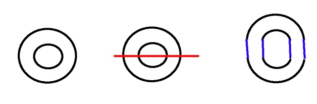

Sorry I meant to retain the top mounts and the strut brace I will get on paint and draw what I mean :) It should work it's just a PITA to fab up

This is what I was thinking of! Hopefully someone could fabricate it better than I can draw it on paint!
All it would be it plasma cutter through the middle of the dome, then cut around it, move it back 35mm build up the turret to the same height, weld it together and then cut out from underneath :)

For strut tops I would just cut an oblong piece and spin it 180 deg for easyness James, no need to cut up and re shape, hard to explain without a pic. Your not going to need caster adjustment at club level really, just get as much as you can.

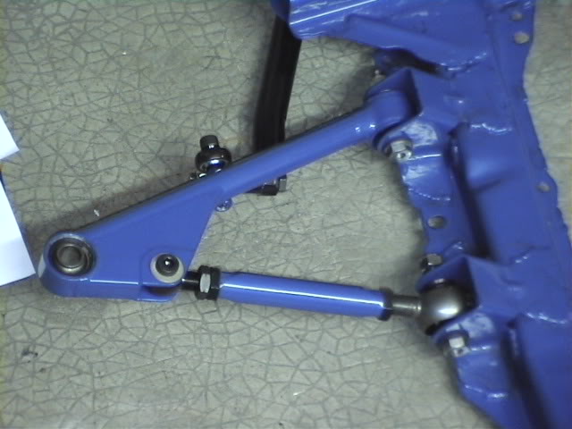

just a thought but wouldn't it be better to make adjustable low arms then piss about with strut tops but one thing for sure I'm with James on this one that well he's where he is now with the car striped he may aswell make it so everything is adjustable if he haded of striped the car then I'd be saying seat time and find the very best set up for as many tracks as possible but as the car striped may as well do everything he can to improve it.
  Golf GTD Mk7
Not really any other options apart from around the GB maybe if other bits are relocated. Would the small weight make much difference in front of the front axle? Lighter rad to counteract it, plus it might help with cooling.
rather than concetrating on the top, maybe investigate moving the wheel position at the bottom:
i`ve just got some adjustable wishbone for mine (106, not this clio tat haha) it retains std suspension pickups and still allows a bit of adjustment....
  182/RS2/ Turbo/Mk1
Problem with that is he hasn't got the room at the front currently to move it that far at the bottom.
I did point out to him that the advantage of doing the bottom is effectively moving the c of g backwards of the axle line too, and extending the wheelbase slightly would help with stability in faster corners too.
