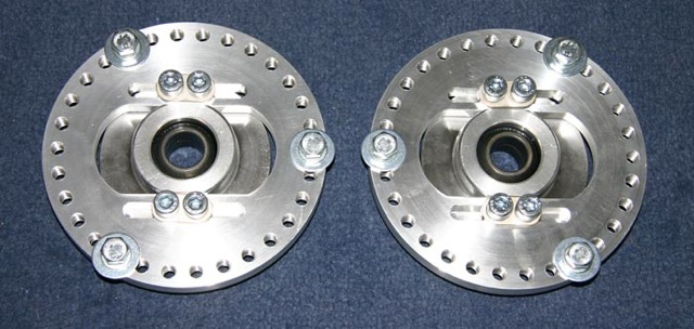

Tony, given that you are no doubt going to want the slider always to the max, you might be better off with ones like I have on my nova:
Although I chopped the edge of them down so I could move them ever further back, lol
  182cup & 172 racecar
Still think I like the ones James is showing, at least there is an option to adjust if needed, or file out more if needed.

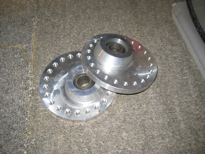

Yes exactly and then to get a top mounts with a decent PCD in you have to start chopping even more stuff out :( Kenny has done the right thing but I don't want to chop out the bulkhead/scuttle panel :(
James, where are these from please.
Those were from a company that seem to have now gone gone bust and the closest I can find are http://www.ebay.co.uk/itm/CAMBER-PL...589&pid=100015&prg=1006&rk=1&sd=181006349108&
I always hear about BMW top mounts for this on Clio's ? dont't know where that comes from though. Unless it's the AST BMW top mounts that you have to use.?
Yes the BMW E30/E36 top mounts are a good system to use if modding the top of the turret to a flat plate. Ideally the AST one's are the easiest to fit but offer limited adjustability. The clio 197/200 adjustable top mounts from AST would also work but again limited adjustment and expensive at around £360
These are for a BMW and are nice and cheap, My only concern is the quality of the spherical bearing and how easy it is to get replacements
http://www.ebay.co.uk/itm/BMW-E36-P...arts_SM&fits=Car+Make:BMW&hash=item1c29d787eb

If its just caster your wanting, plasma cut out a oblong piece from the strut top, spin it 180 and re-weld it, then you can still use PM top mounts and strut brace. You would have to be told it was done to notice it. Not suggesting you cheat or anything if regs don't allow, just bend them a little. Picturing the strut tops , you would get 20-30mm.
Interesting, but I'm not quite with you ?
  Cup In bits
Yeah you could still use PMS brace if you were to use the BMW style that you linked but with the rotational type you would have to drill a lot of holes if you wanted to keep them adjustable and changed your setup regularly.
