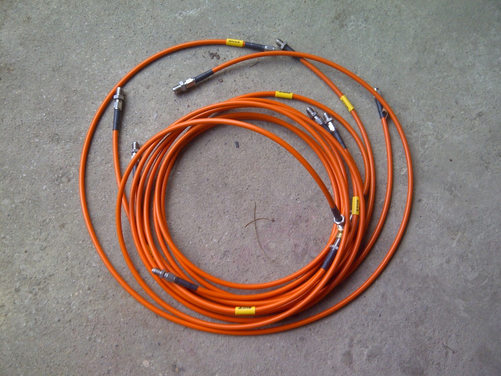

I think that is about it for now and i'm afraid I don't have too many pictures to show other than the brake lines
Earls hoses made them up and for the 6 hoses it was £170ish that is with stainless fittings which nearly doubled the cost so with normal fittings would of been around £100 for the full car! They have done a great job and their service has been spot on :)

So you're running full braided straight from the calipers to the master cylinder? Do you have any dimensions?

Yes braided throughout but I have changed the routing of the hoses to simplify the car so they now run in the car so they don't pass under the fuel tank. Before I would of had to remove the tank if my fuel pump goes and to this I would need to remove the brakes pipes so just thought to run them in the car out of the way. Mine is running through the scuttle and then through a proportioning valve until the back of the car where there is a T piece and then back to each calliper, If want the pipes to run the same way I have then Liam at Earls has got all the details :)

Thanks Ash. I'm removing the ABS over Christmas so thought I may as well run new lines.

So what braking system are you going to be using? Just a standard 172 Cup none ABS setup?
I originally wanted to but the costs involved were a no go, Managed to get a really good quote to do it and now the shell is fully bare it would be wise to do it now if i'm ever going to do it and unfortunately I have OCD so I think it will get done lol!
172 cup master and then the two M12's to the front's, blank one m10 port, single line to the back through proportioning valve and then tee off to each rear wheel :)

I predict heavy rear wheel locking up. Aftermarket bias valves don't restrict enough for a clio
Yes that is the problem as most don't but the Tillet one I have got works on pressure reduction so the more pressure that goes through it the more it reduces it, most of them are just a restriction in the line. It's the same type renault used to use on the Group N cars I just copied it from the renaultsport parts diagrams in the catalogue :) I'm not 100% sure it will work but I have designed the pipes so that I can easily refit the cup load valve if needed. I have been assured the valve I have gone with will work perfectly with the brake setup as on the min setting 200psi will go to each rear while the fronts will get 1200 psi couple that with the difference in pad size, piston bore and pad friction should hopefully be okay and give some flexibility for adjustment too which was the aim of the game as I still struggled with the cup valve :(

Risky, but clearly you've put a lot of thought into it so fingers crossed it works. I suppose if it doesnt then reverting back to the simple Cup set up wont be too difficult.

Yes I was a bit worried too so just got to hope Tillet and demon tweeks are right with what they say! Tillet said they will take it back if it doesn't work which gives me some confidence.

Cant you just used 2 bias valves if your idea doesn't work? Fully close one, then use the other for adjustment?
