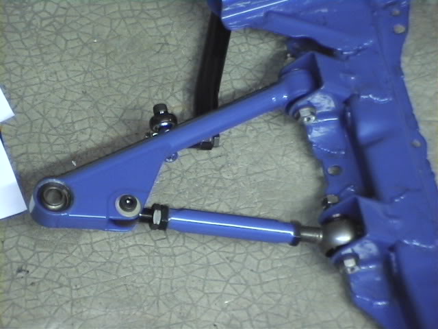

rather than concetrating on the top, maybe investigate moving the wheel position at the bottom:
i`ve just got some adjustable wishbone for mine (106, not this clio tat haha) it retains std suspension pickups and still allows a bit of adjustment....
Wow very nice Stu! Did you make them? That does look identical to a clio subframe obviously share the same tat :rasp:
Not mine... If i was doing them id run another adjustable rod end on the front subframe pick up so you can play about with caster and camber a bit more than that design allows...

Them wishbones are pn a clio 172 rally car in France and are actually from the the clio maxi,
my wishbones from pure Motorsport are nearly finished. As soon as they arrive ill stick some pics up, good thing about the pure wishbones is both arms are adjustable like chip suggested :)
Yes I think double adjustable would be ideal as then you can alter camber, caster and track width
Ahh they look very expensive lol! That would be great Andrew if you can :) I'm speaking with Nick tomorrow anyway so was going to ask how they were getting on!
