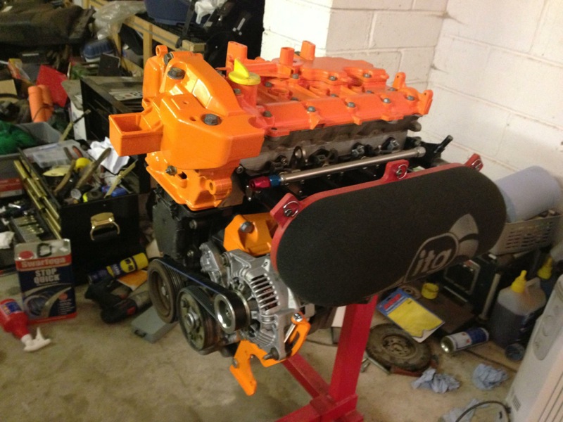

I then removed the rocker cover to paint, this was done by masking up all the bolt heads to stop the bolt seats from being painted. It got etch primered and then sprayed in FF-Racing orange
The block was painted black with VHT and I gave the head a clean up too.

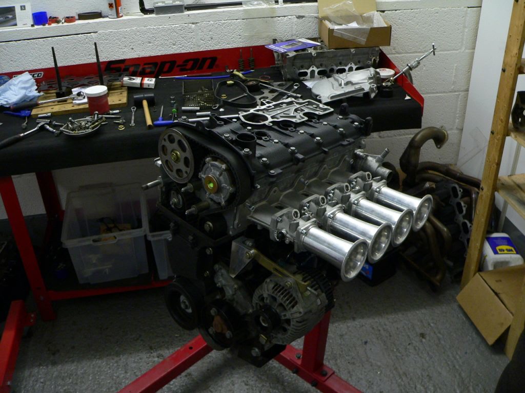

Next up was to assemble the bits together to make sure everything fit okay. The alternator brackets had come back from powder coating so they were fitted but the length of the aux belt meant that once tensioned the alternator touched the underside of the ITB's which it used to do from when it was originally built but as with everything else BTM fixed this by running a slightly shorter belt which dropped the alternator and gave clearance so I did the same with the new brackets.
I then fitted the oil cooler take off and oil pressure tee but unfortunately when the tee is tightened it leaves the sensor hole where the oil filter is so I need to work out a solution for this.
The following day when all the paint had dried it was time to fit the cams and build up the rest of the engine. One of my friends (NorthloopCup) was up near Leeds so very kindly he offered to come along with his Renault timing tools and help me out and also teach me how to fit the cam belt. This went smoothly and I think I would now be able to manage it all on my own in future so massive thanks to Mark for that and all the other help he gives me
Thanks also to Chip and Fred who both offered to come up and do the timing on the engine for me very kind of you to offer!
After this I refit the covers and then fit a new set of spark plugs along with a set of ARP rod bolts. Luckily I realised the torque figures on the rodbolts are in Ib/ft rather than nm as I was going to put them in at 42nm but then read it again and realised!
Then that was it really just a new sump gasket, fit the ITB's and then tension the Aux belt ready to pop it into the the car.
