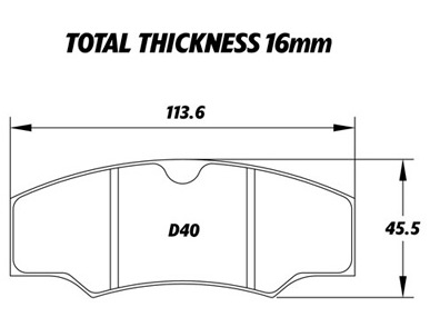

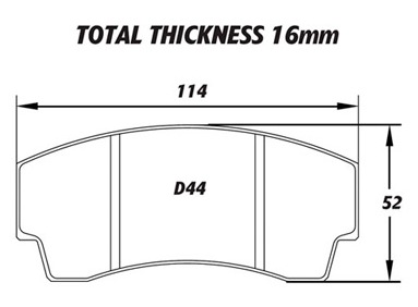

That was the problem for me, mine had the wrong size pads in to start with that were much smaller so I was just letting you know and hoping you didn’t have the same issue :)
This is what I originally had
And this is apparently the correct one
A-ha I see, my 'old' Pagids are the same dimensions as your correct pad diagram and my new 07's are exactly the same dimensions as the 01's so it looks like I wont be gaining any pad surface but the 07 compound will hopefully make a big difference!!
Have just come off the phone again with Matt at Alcon, he confirmed that there is definitely only the one pad shape & length that will fit our H-type callipers - there are small differences in pad depth but as I have found out from looking on the different manufacturer's sites only by a mm or so. He confirmed he was previously thinking of another style of their calliper where a larger pad can be fitted by replacing/adjusting (I cant remember which) the retaining pin. So possibly you were just 'unlucky' with the original pads that you found in your callipers, but the ones you have now are perfect size-wise as are the Pagids I'm taking out - but obviously I'm going for the PF 07's because of the different compound.
