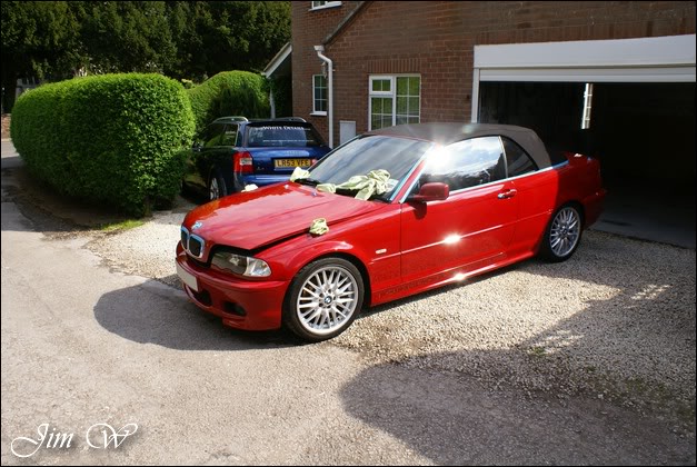

A few bits of tar picked up off of the lower quarters:
Once washed and dry:
Looks well already!

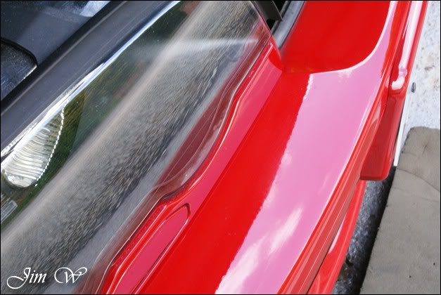

Repair work spotted on the lip of the front bumper..
Came up very well after a single hit of 203s.

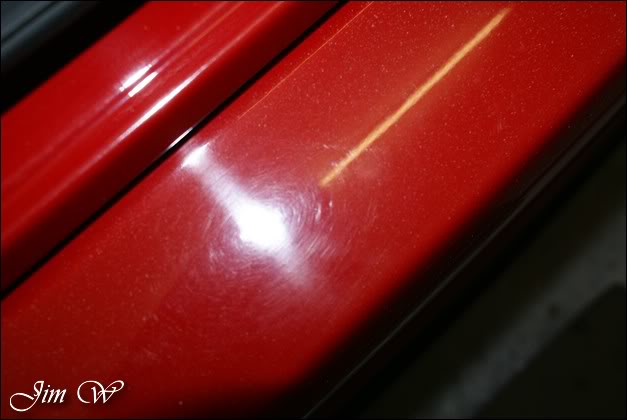

Scuff spotted lower down on the O/S front lip.
^no after photo unfortunately.. The worst of it was removed by Tardis – lots of surface paint as opposed to deep scratches.

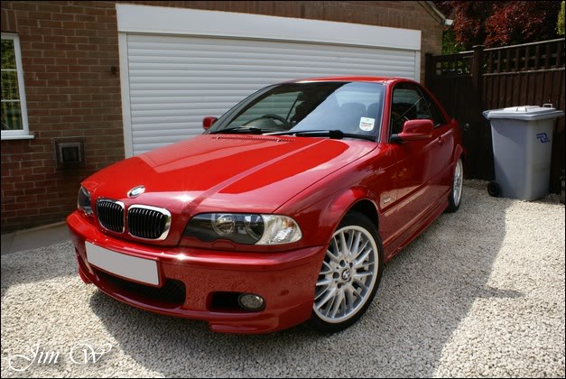

Nipped outside to check my work:

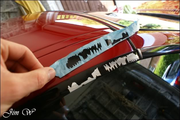

Once the whole car had been machined it was time to take the blue 3M tape off..
…I wasn’t however expecting this:
Rubbish! A serious ‘foot in mouth’ moment. You can see in the second photo that the edging of the roof had had some repair work done in the past; the trim had been painted black and there was little I could have done to avoid damaging it further.. The repairs are to be covered at my expense and if anything, it’s a lesson learnt (and one good reason to have insurance in place!)
The thing is, I had to tape it as I didn’t want the pad catching it; a bit of a double-edged sword in the end.
