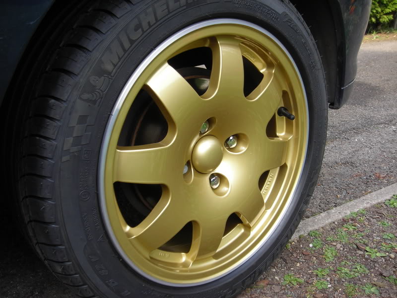

K...cheers for help lads. Definately think going back to OE Pads will help. Here the wheels anyway....after they were re-furbed...
  Williams 2
are the painted or powedercoated???
Power primed for durabilty, then I supplied the correct Akzo Nobel paint which I had mixed especially to meet the original colour match. The original wheels where electrostatically painted, so it's very thin and chips/corrodes easily. The process I had done should see them good for a few year!:cool:
