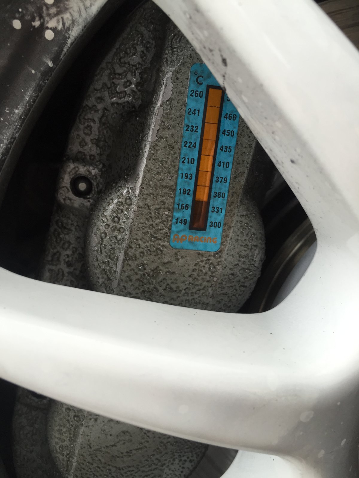

This is the caliper in question, this is after 2 15minute stints on track, going off the temperature strip would you say the caliper has Been binding the pads on?
Personally I'd say no, but I have nothing to compare it with. What speed are you hauling off? And which circuit? That'll help to give an idea of if that temperature is normal or not.
Top speed off about 105-110 on start finish and again at the end of tower at croft.
the caliper on the other side had another heat inductor and was positioned in the exact same place and it only read 1 mark up not 2, and the paint hadn't flaked off as like this 1
I thought that was some sort of strange finish that you'd opted for on your calipers mate, didn't realise until now that it's heat related!!! Deffo sticky pistons mate.
