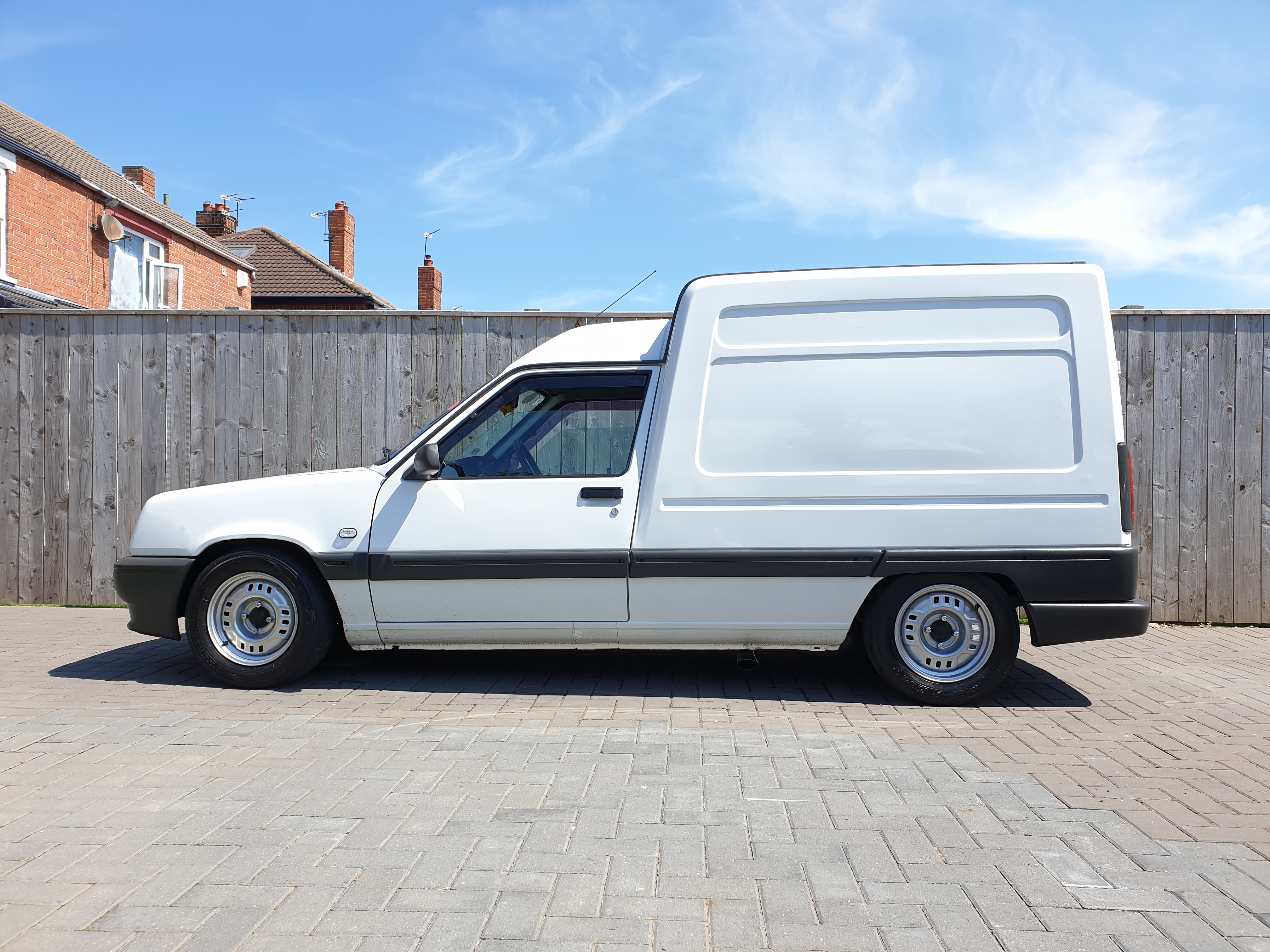

Van looks good and glad to see you getting some miles on it.
That thing in the last photo looks like a used condom though!
Cheers mate. It seems to be good to go for mapping, cant wait to hear it make some decent boost, this slow driving is doing my nut haha.
I have no idea what that thing actually is, its some modern art shite next to M/boro riverside stadium. Another waste of tax payers money:sneaky:

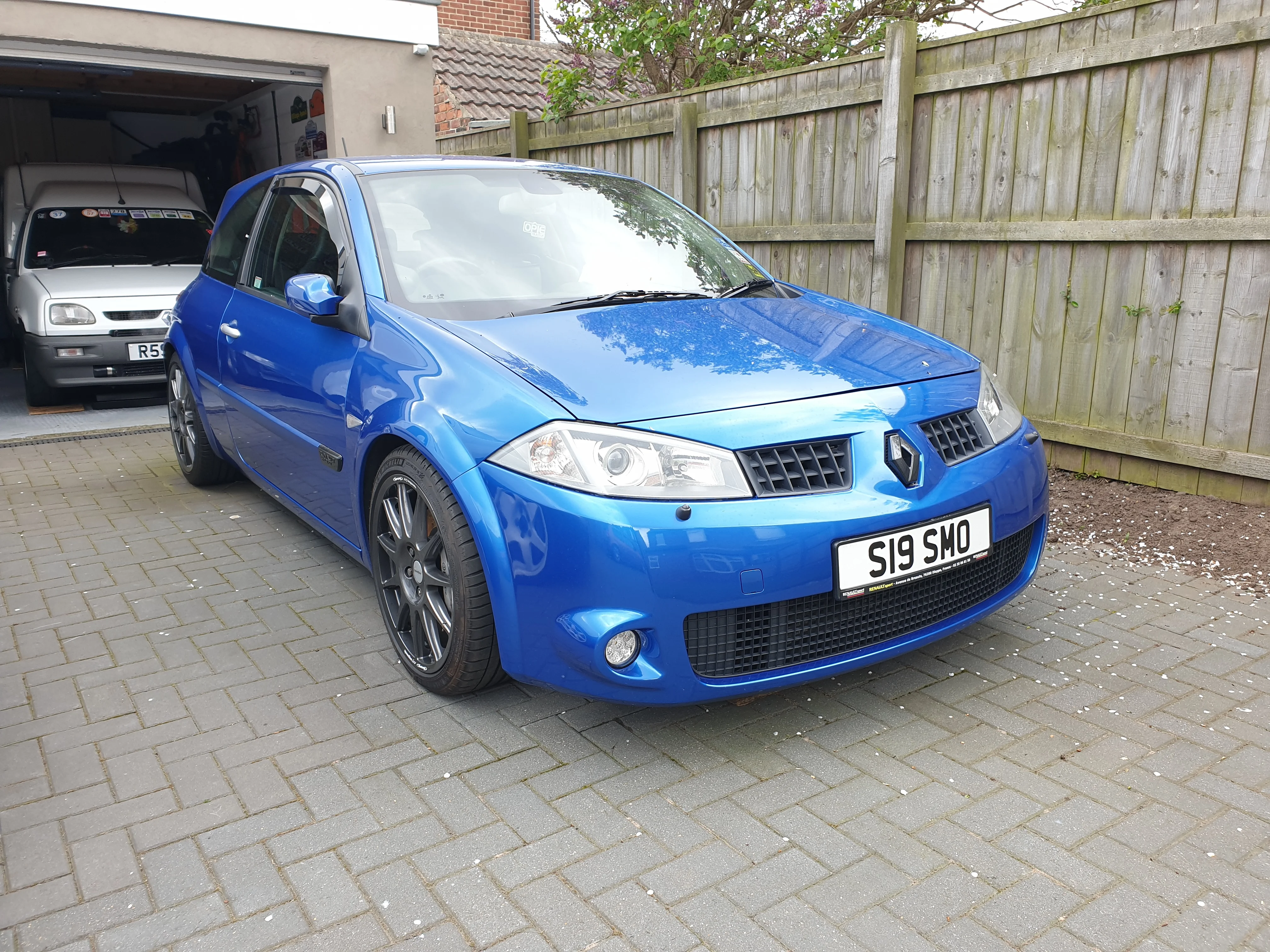

Updates.

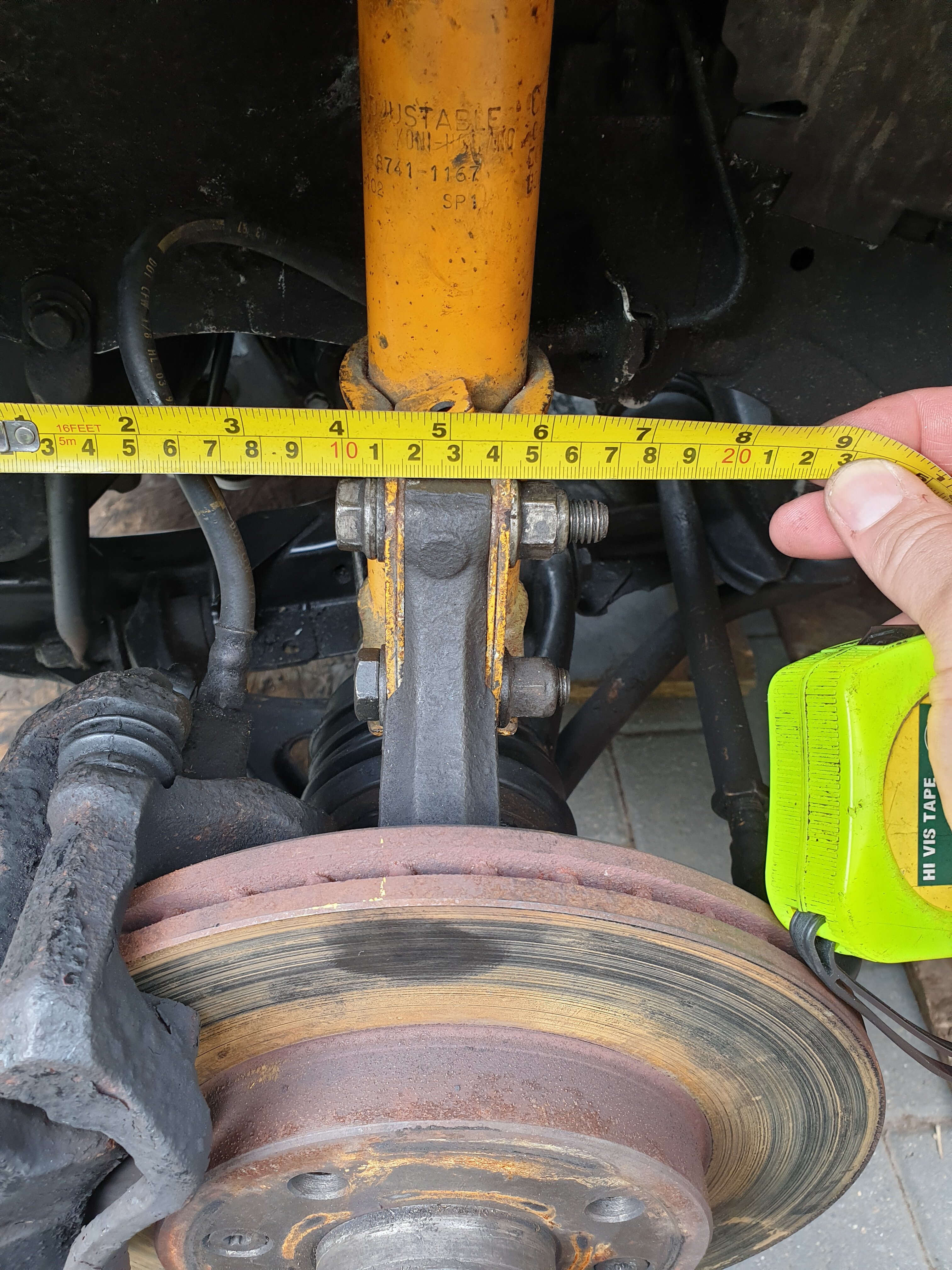

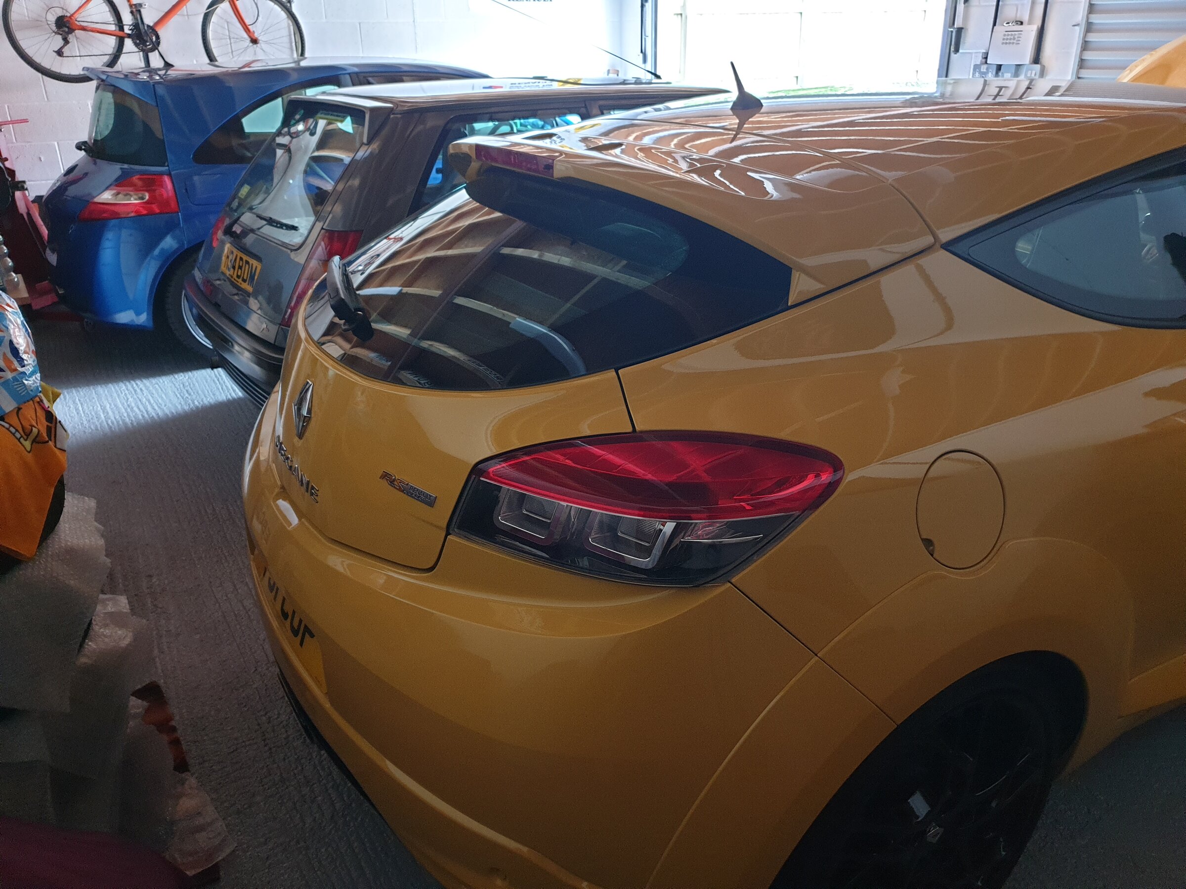

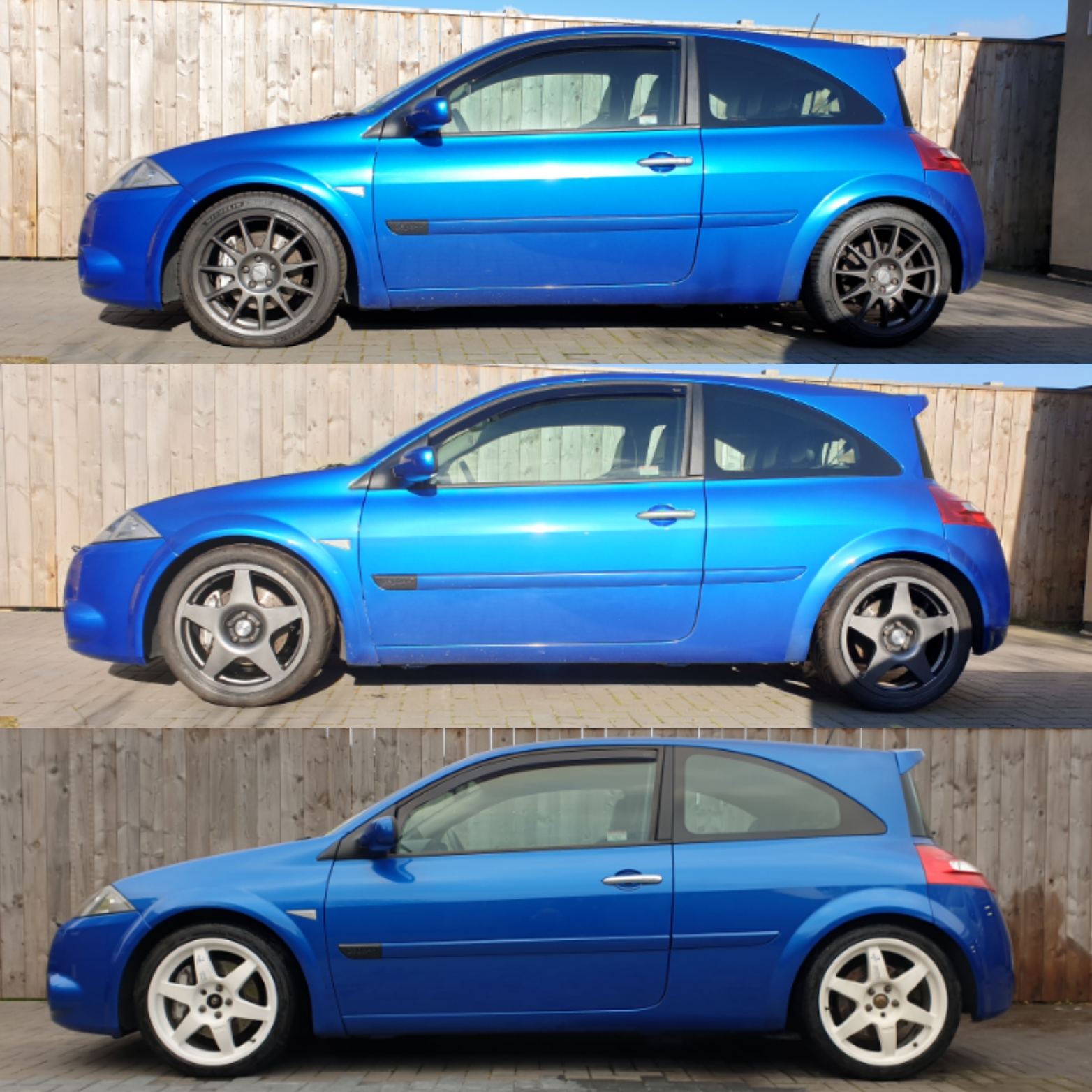

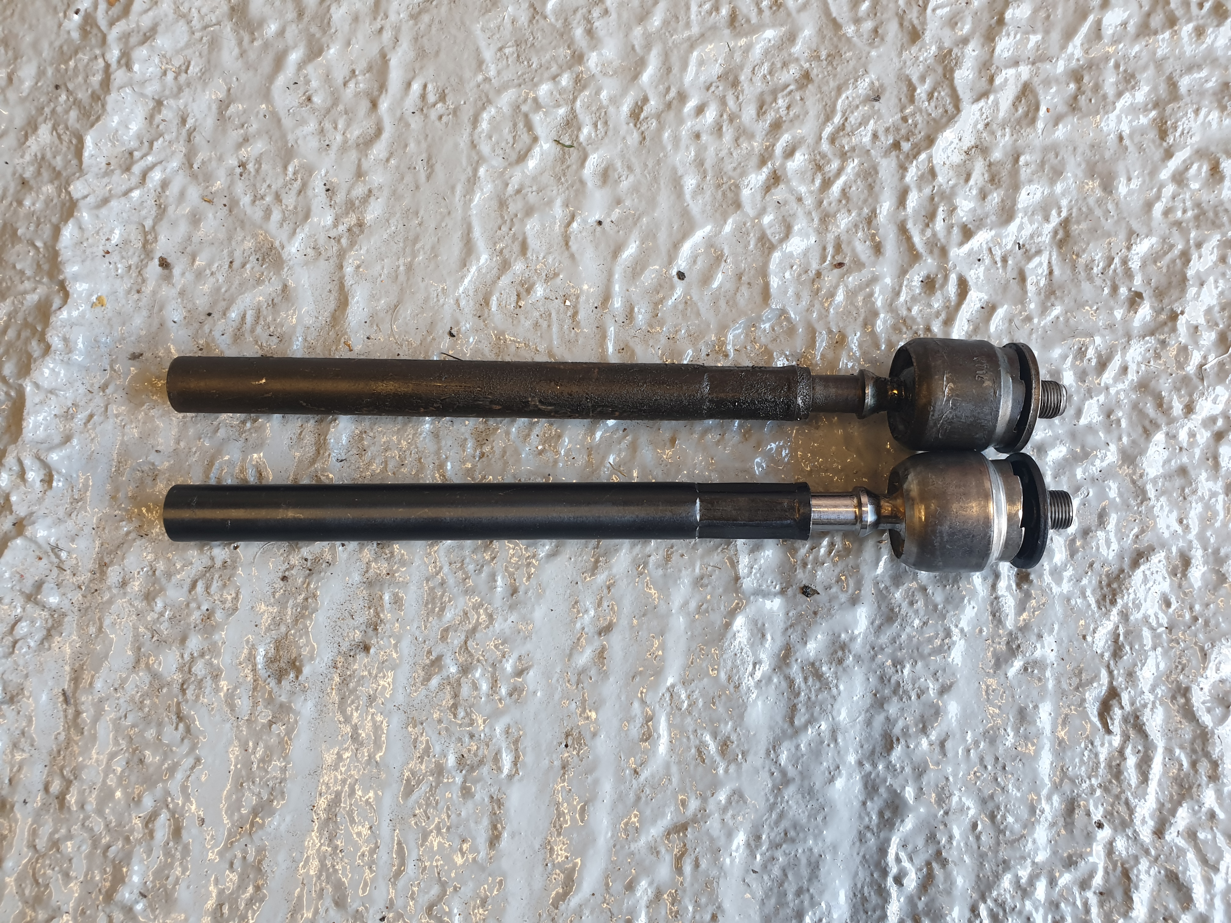

New o/s shaft in the 250 did not fix the wide open throttle vibration so had to do more diagnostics.

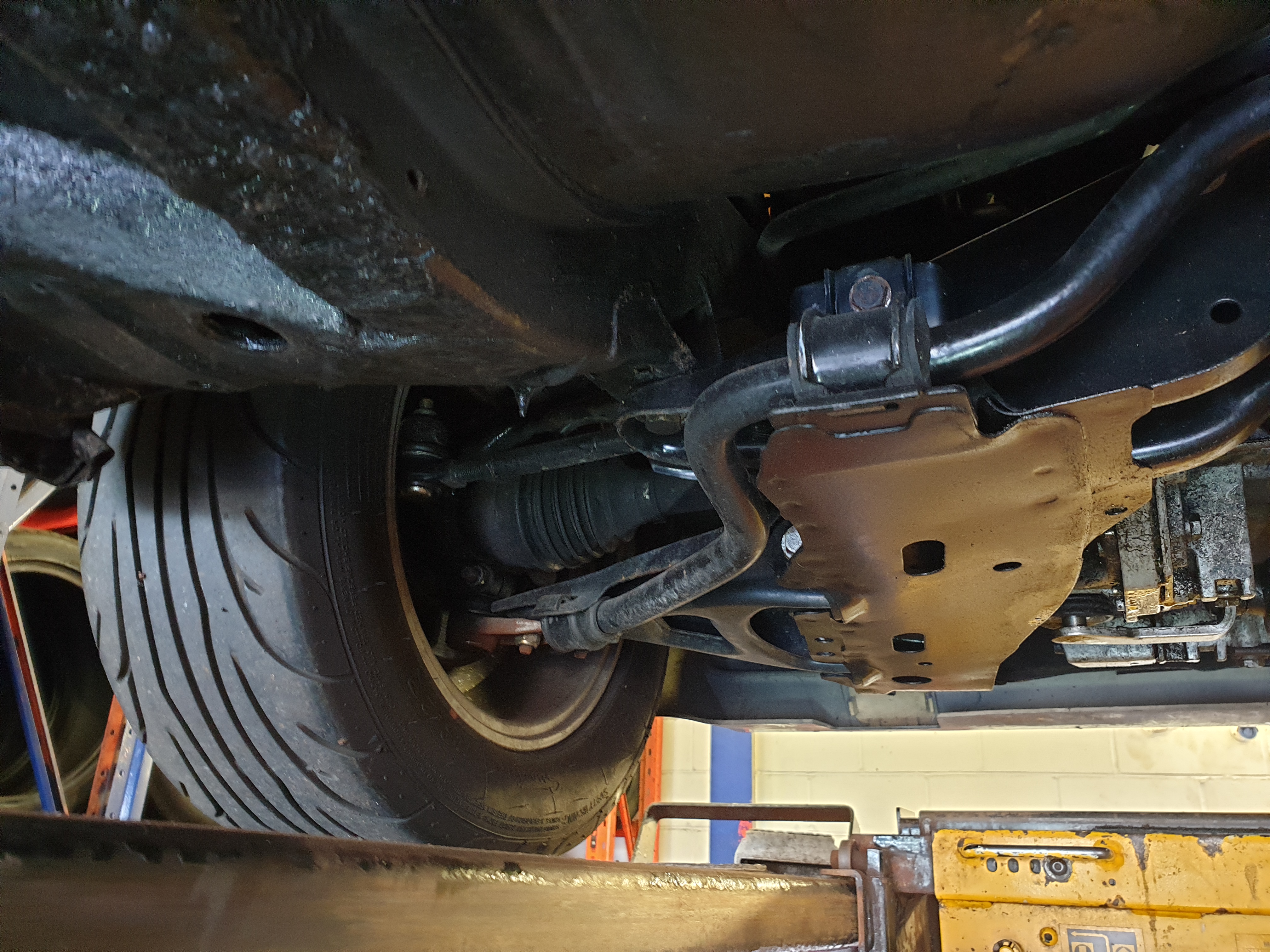

To recall the whole saga, car was perfect on stock suspension, low mileage 34k when lowered on bc's due to stock shocker failing. 2x new oem driveshafts fitted, spacer fitted to n/s and not fixed.
Checked a multitude of things, removed lower engine stabiliser to check condition, looked ok, checked the rest of the engine mounts all ok, buzzed the hub nuts off to check the shafts were not binding when the car was sat, both fine even with passenger side spacer.
Raised the rideheight 15mm all round and the issue is fixed, its smooth as silk on full throttle up to any speed. Its fair to say the driveshaft angle was past its happy spot causing the issue.
Height difference is not really noticeable either.
Handling is far better too on the plus side, it always felt a bit skitty on the back, the mk3 is lively on the rear but it did not feel right. I reckon the rear was riding the bumpstops previously when under compression.
Deep down i knew it was too low to make the most of the meganes good handling, should have raised it ages ago.
Took it for an extended test drive around my favourite moor roads, its the first time its felt "right" since fitting the bc's and i forgot how epic the chassis is, turn in, plant the throttle and hang on, never lift.
The end of the whole saga😆 can drive the car and enjoy the chassis. The power modifications can now start.

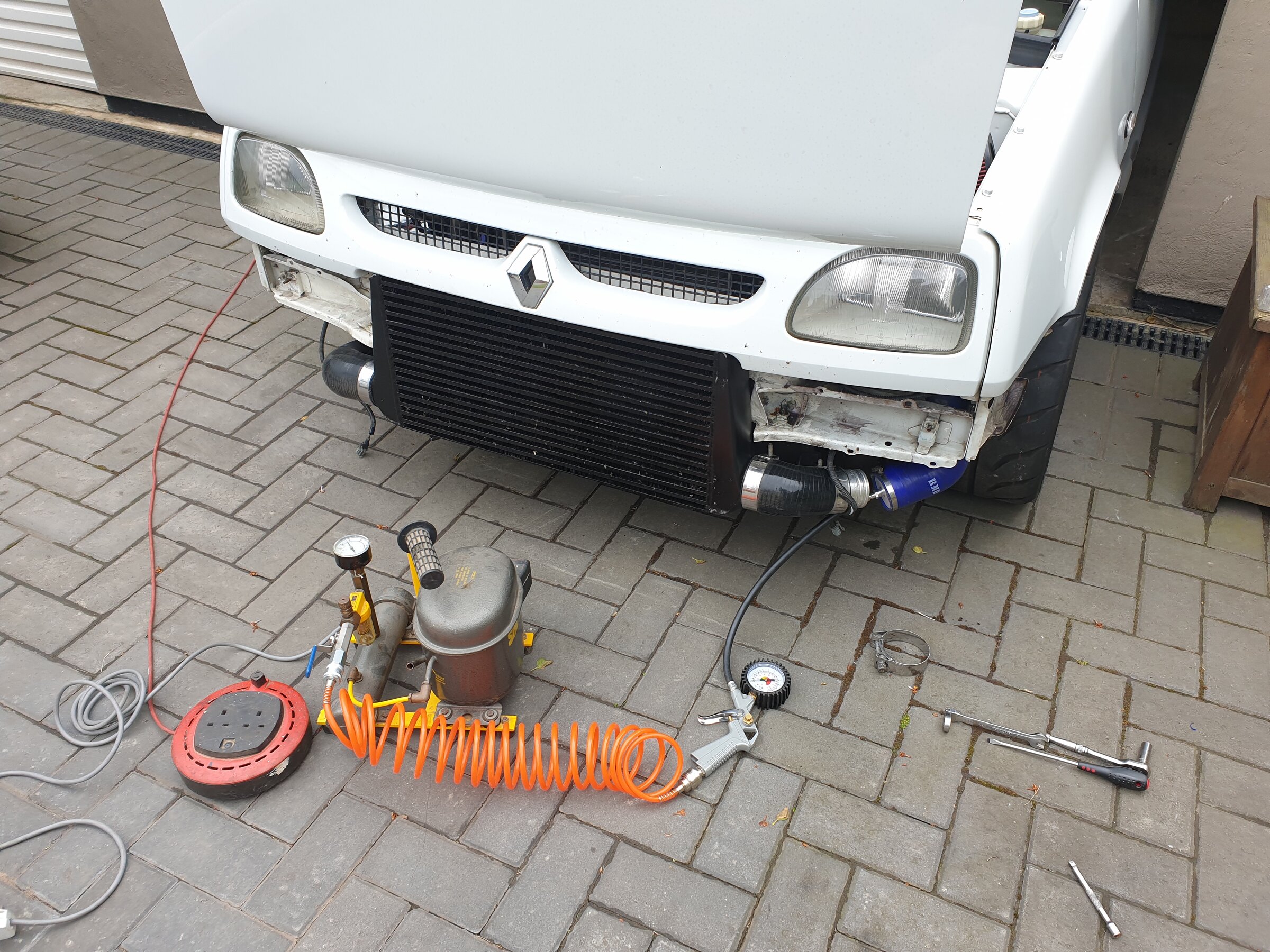

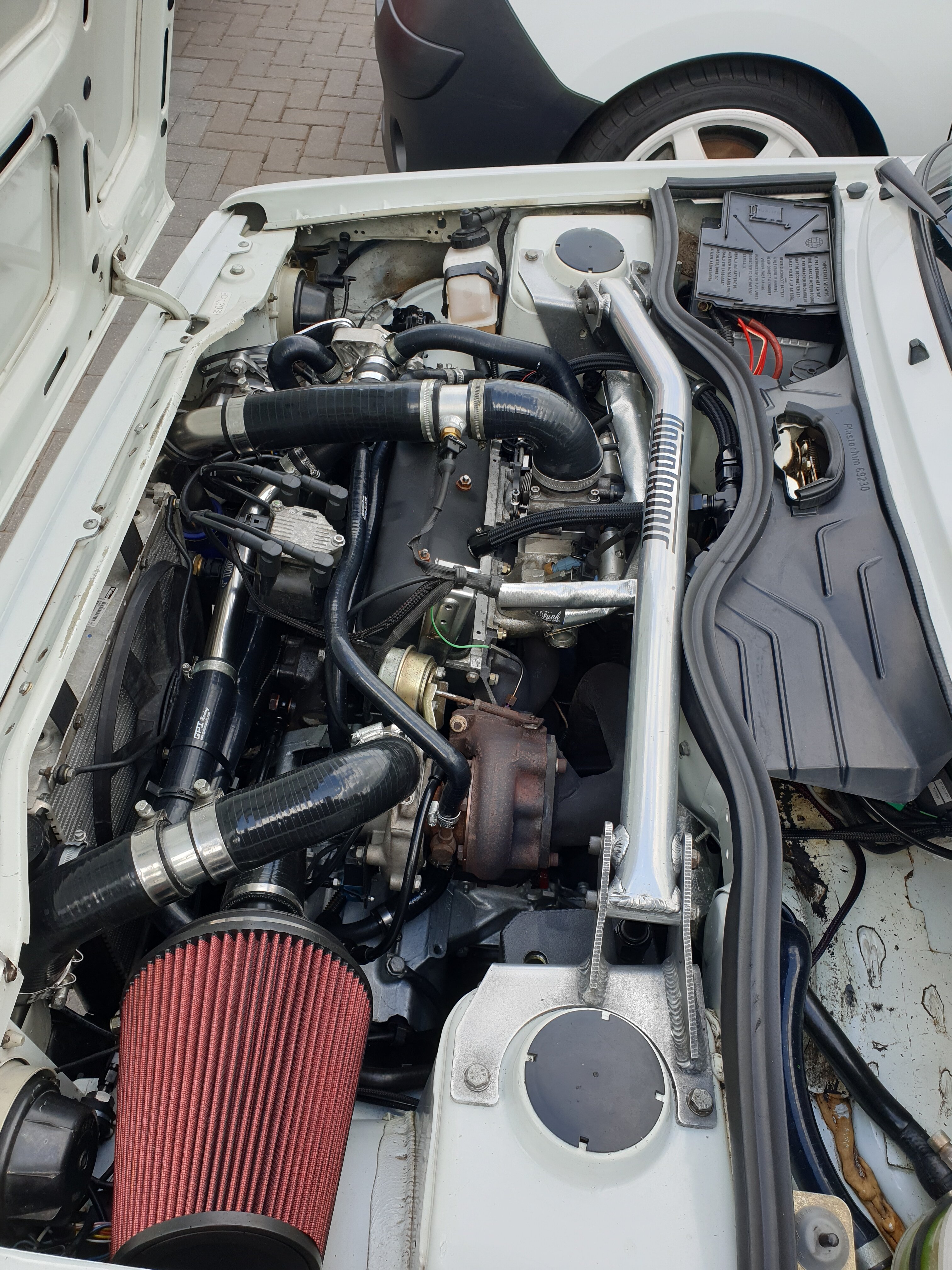

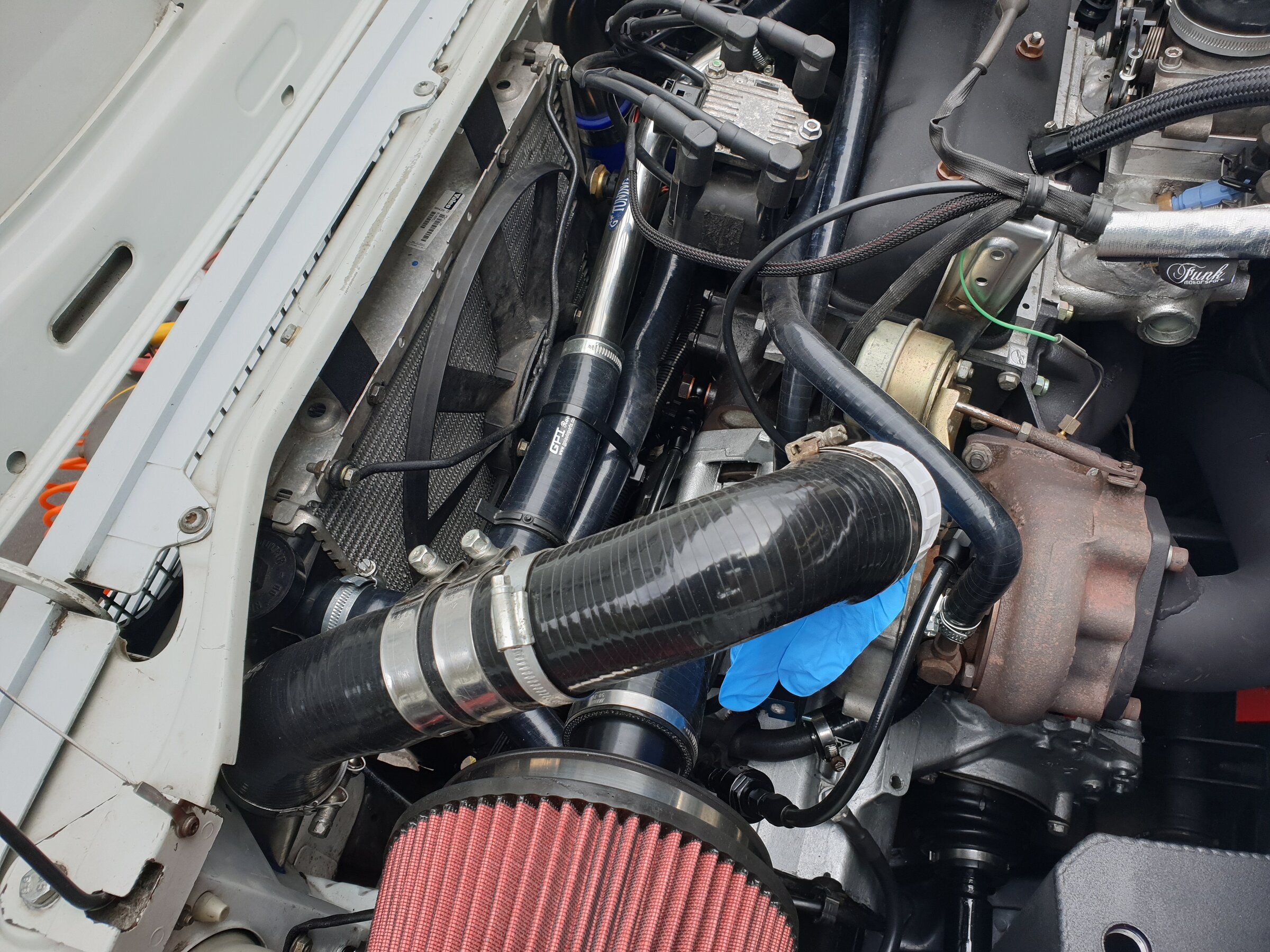

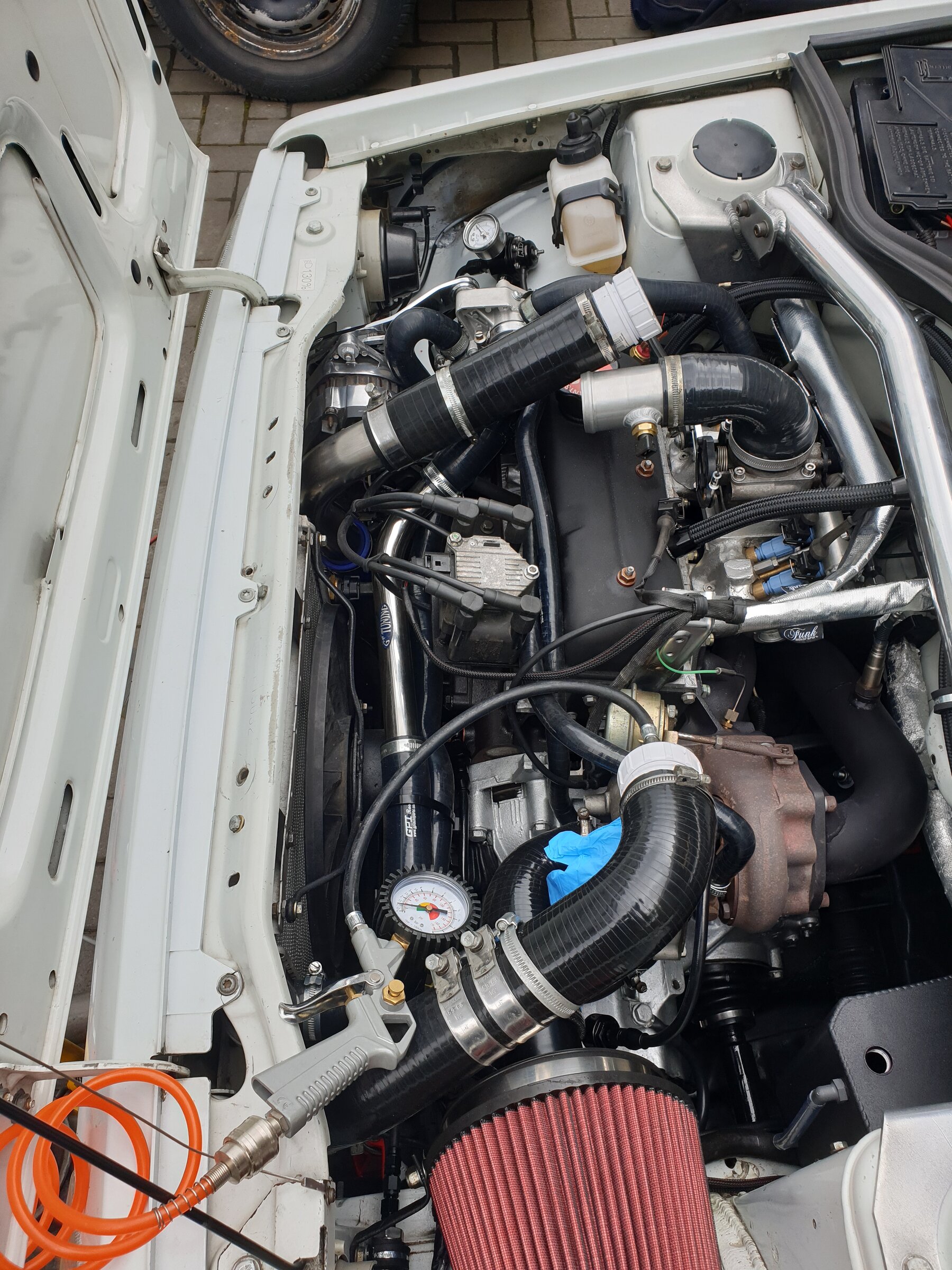

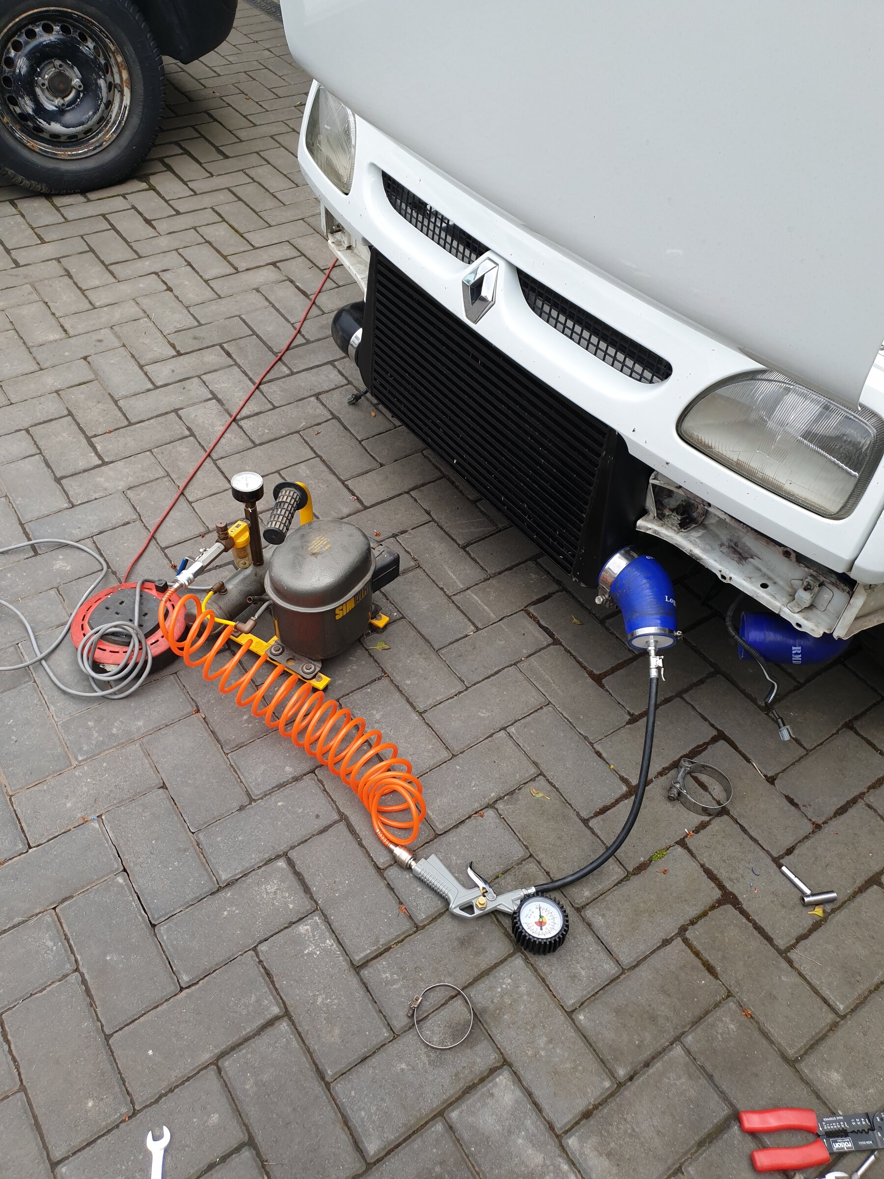

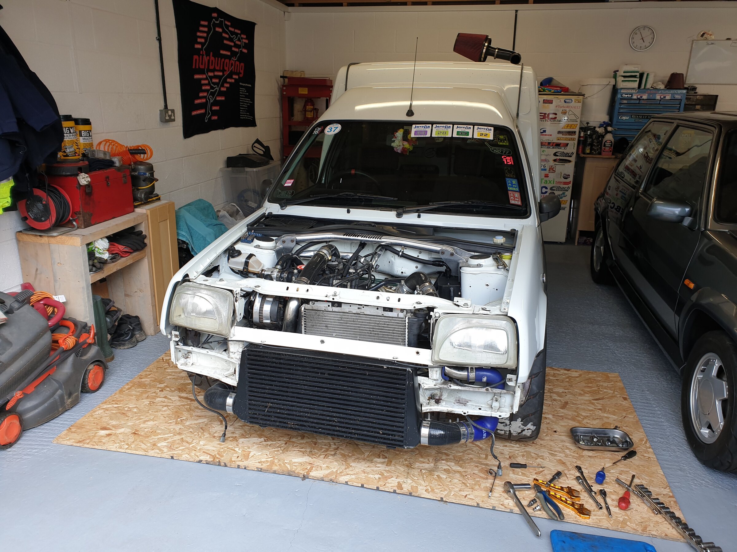

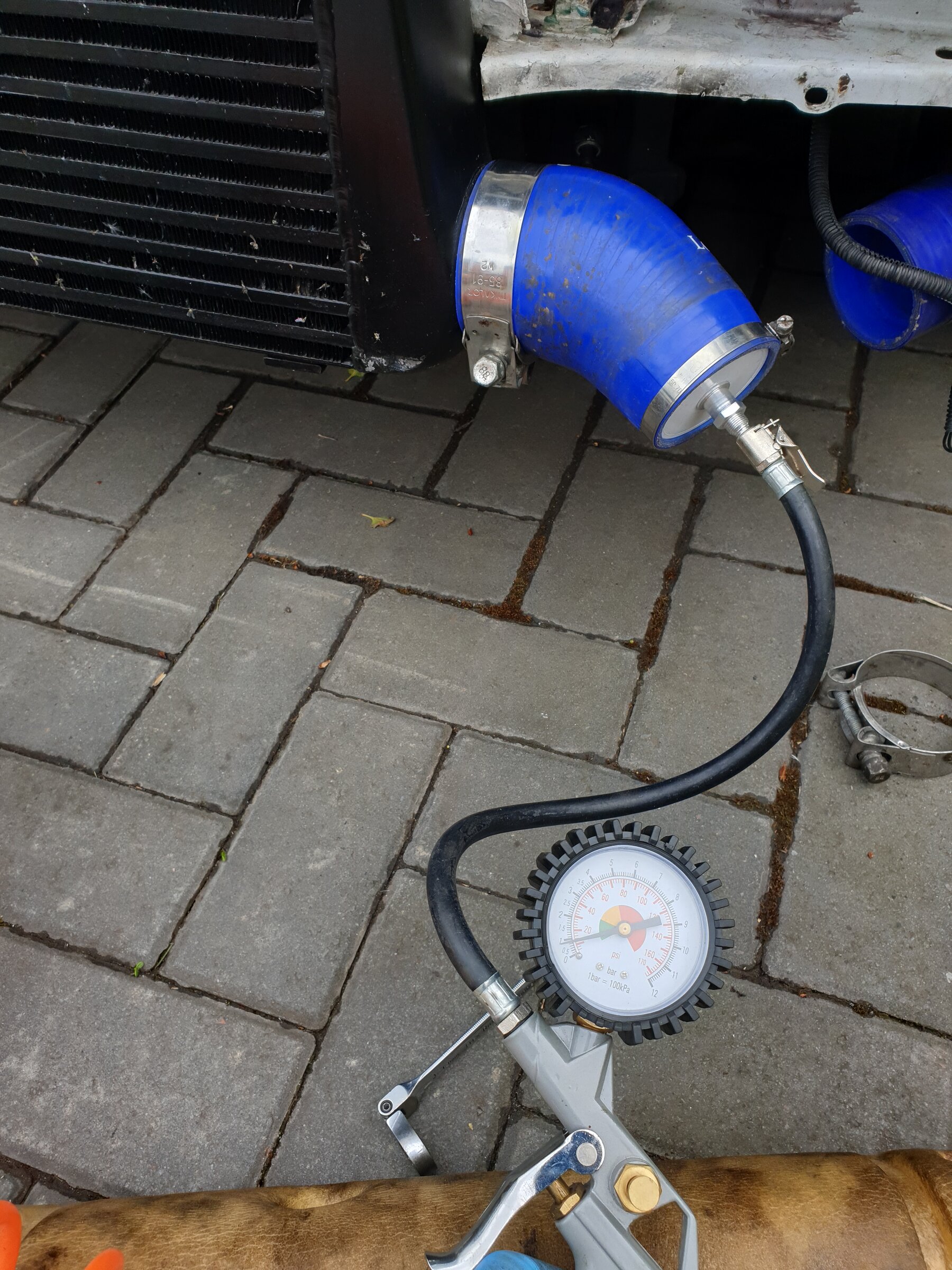

Checked the boost circuit for leaks this morning. Dug out my home made caps for the circuit and used a small compressor for an airbrush.
I would normally bung the airfilter and fill from the airfilter hose with a good compressor. However this compressor does not have much power so initially split it into smaller sections that the compressor could cope with.
Disconnected the hot side pipework from turbo to intercooler first which was OK held 18lbs of pressure.
Done the intercooler next on its own, held 18lbs pressure again without any issues.
Done the cold side pipework next, disconnected the pipework at the air temp sensor and bunged, and filled post intercooler.
This side had quite a leak at one of the hose joints and would not fill and hold any pressure initially. Easy fix, just needed the hose clip and hose adjusting/tightening furthur at a joint and held 18lbs.
With this sorted i reconnected the intercooler on the cold side, and filled from the hot side, which was ok and held 18lbs pressure.
Reconnected the hot side pipework and filled from the turbo end of the hot side pipework. Held 18lbs ok.
Apart from inlet and turbo, thats almost the whole boost circuit holding good pressure.
Well worth doing for an hours work, and to save any hassle on the rolling road when mapping, no leaks = more hp and faster spool so all good.

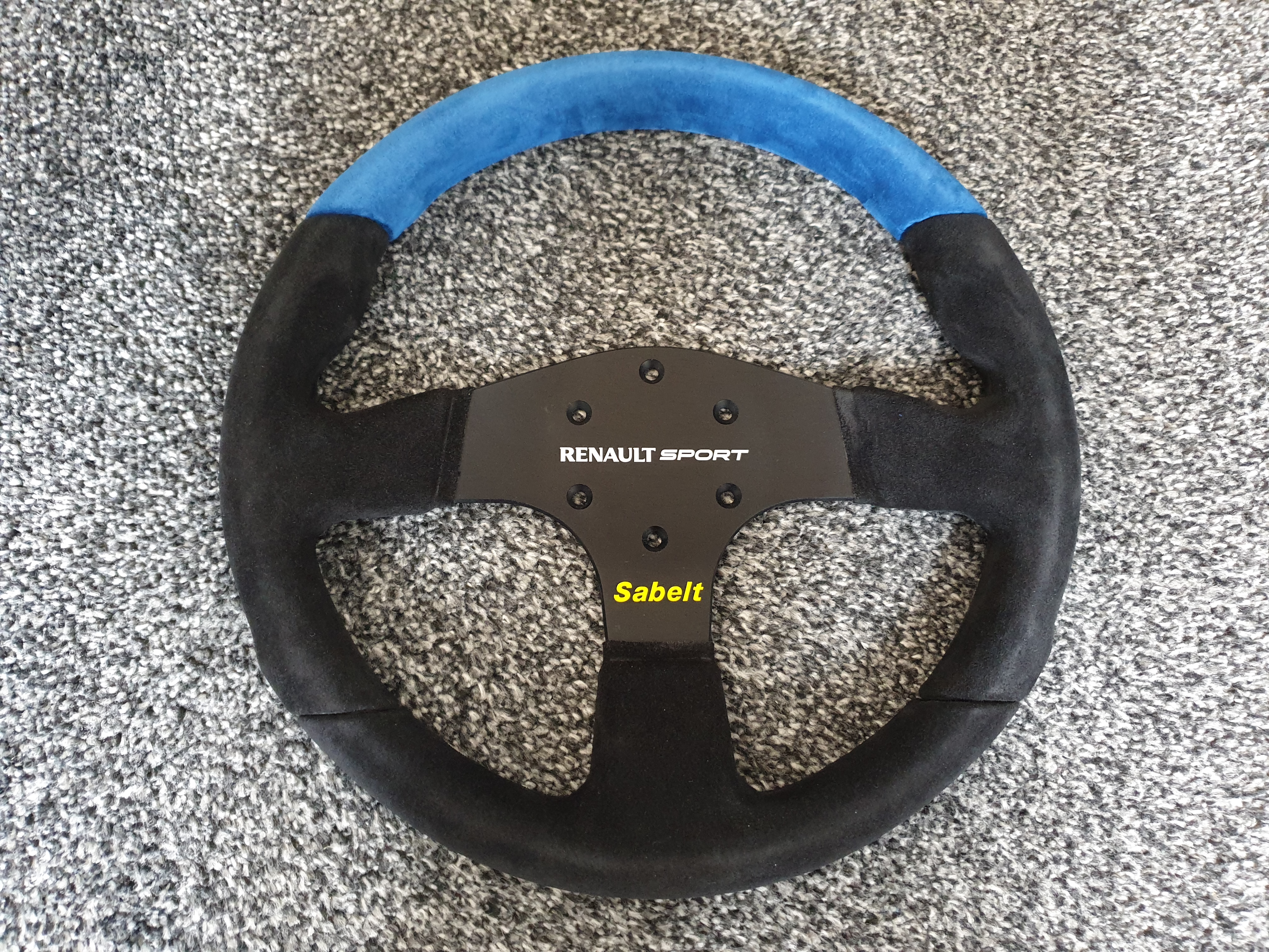

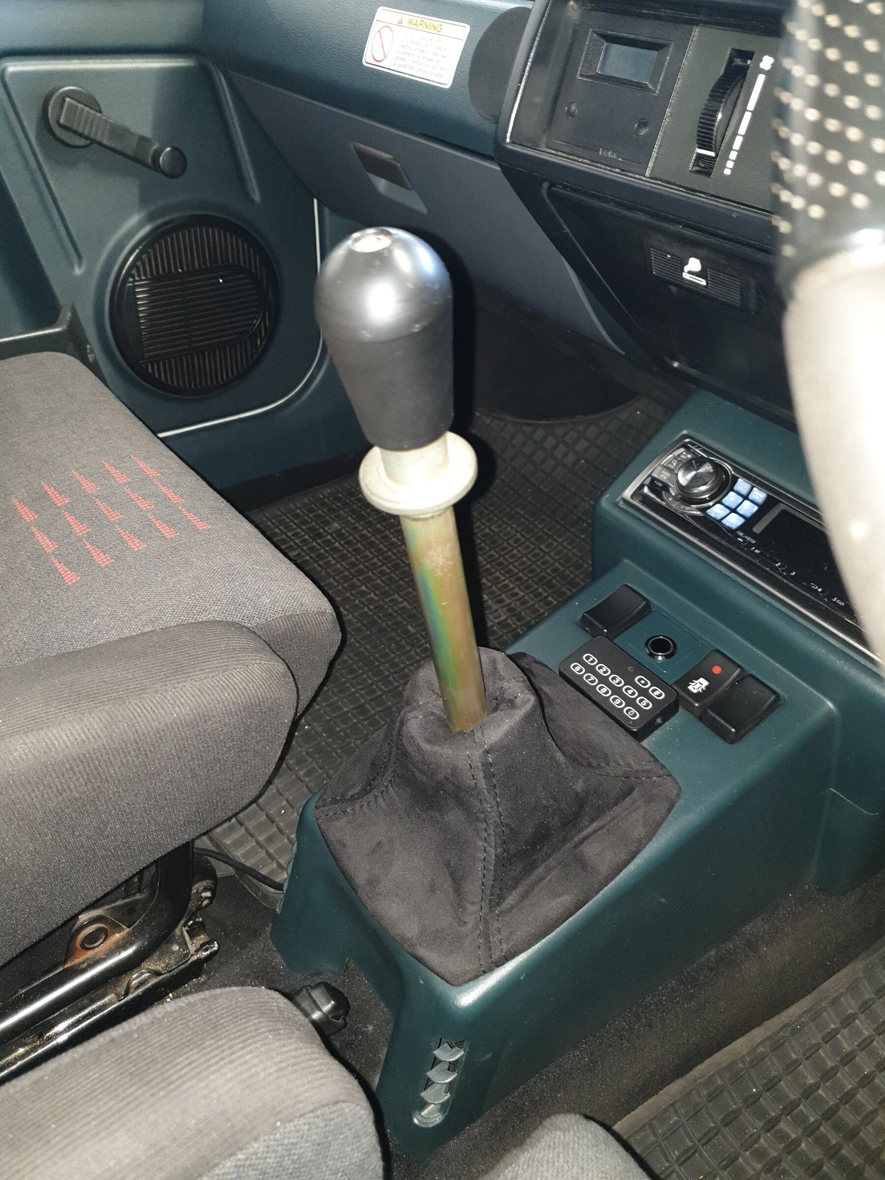

Custom lux suede gear gaitor fitted.

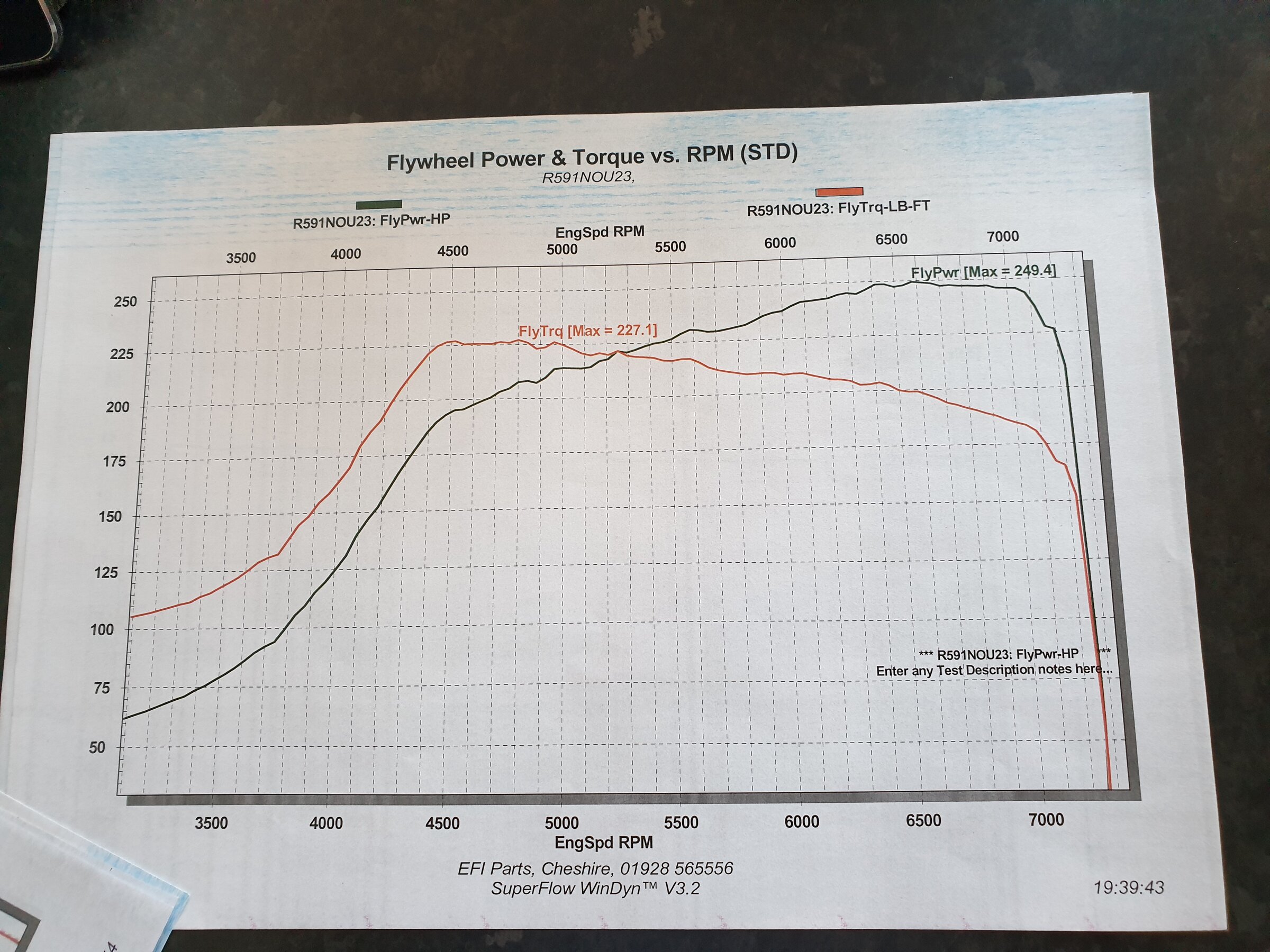

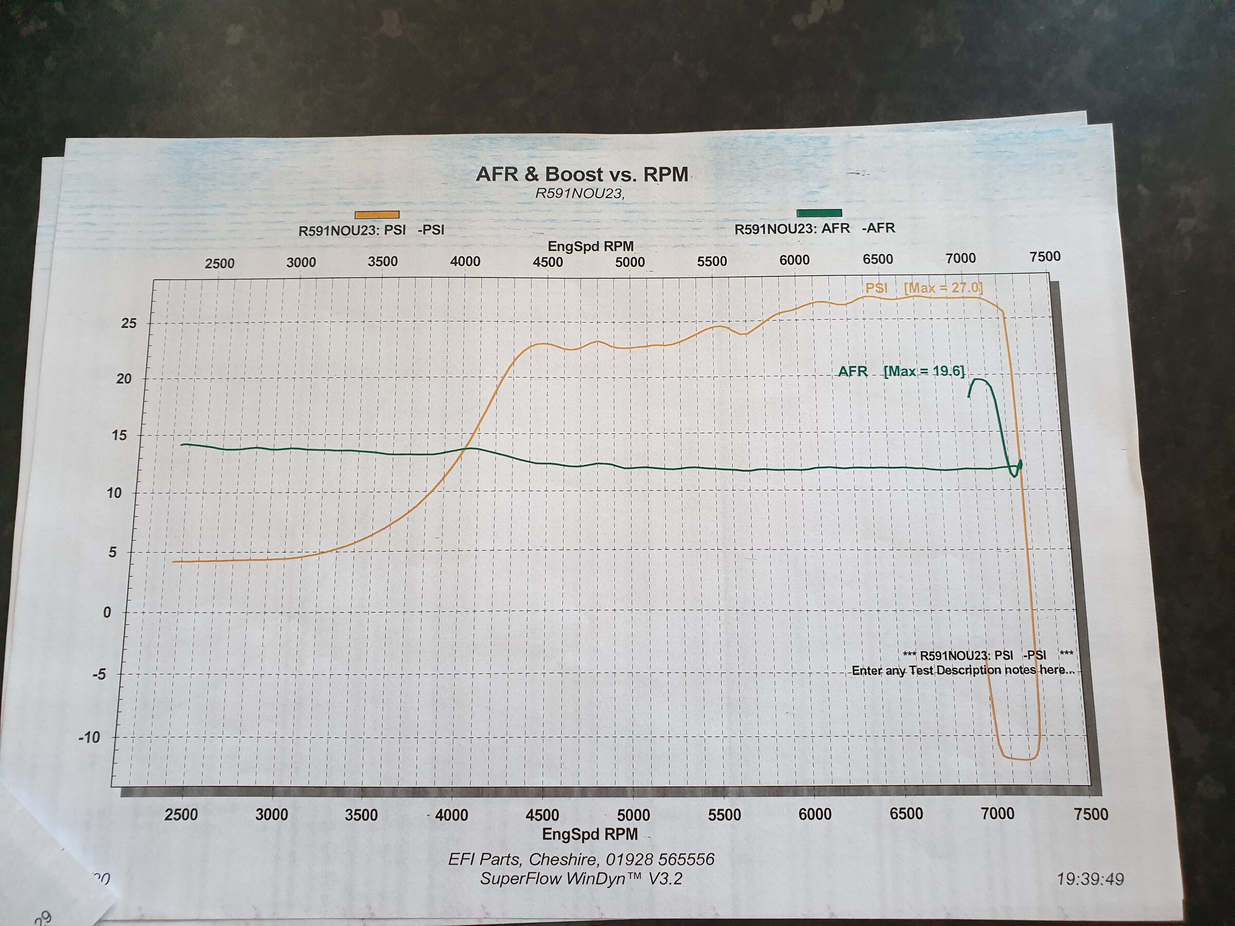

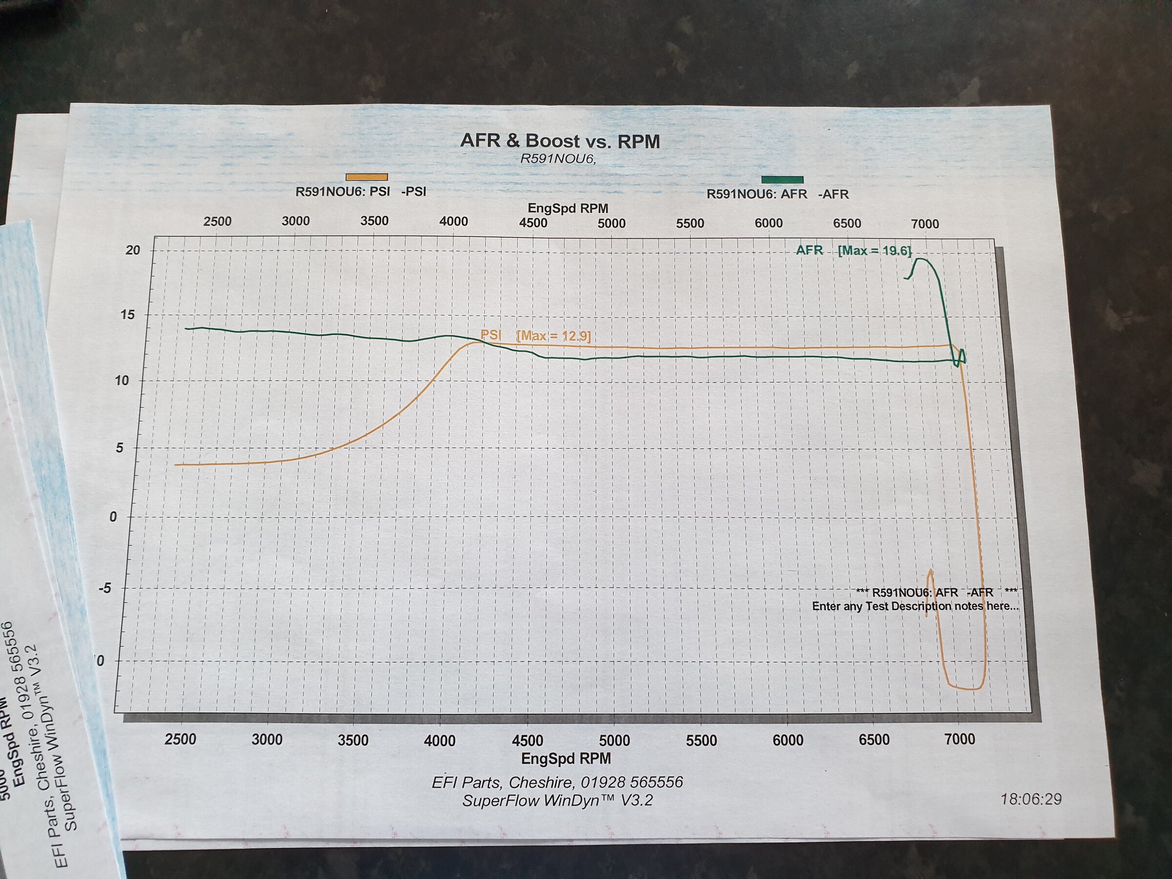

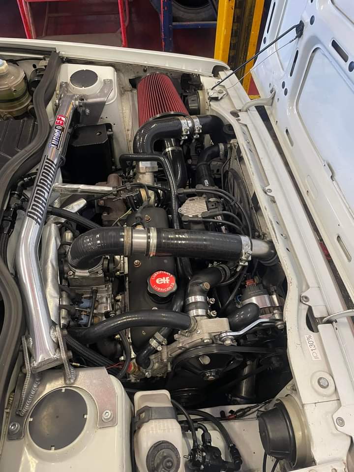

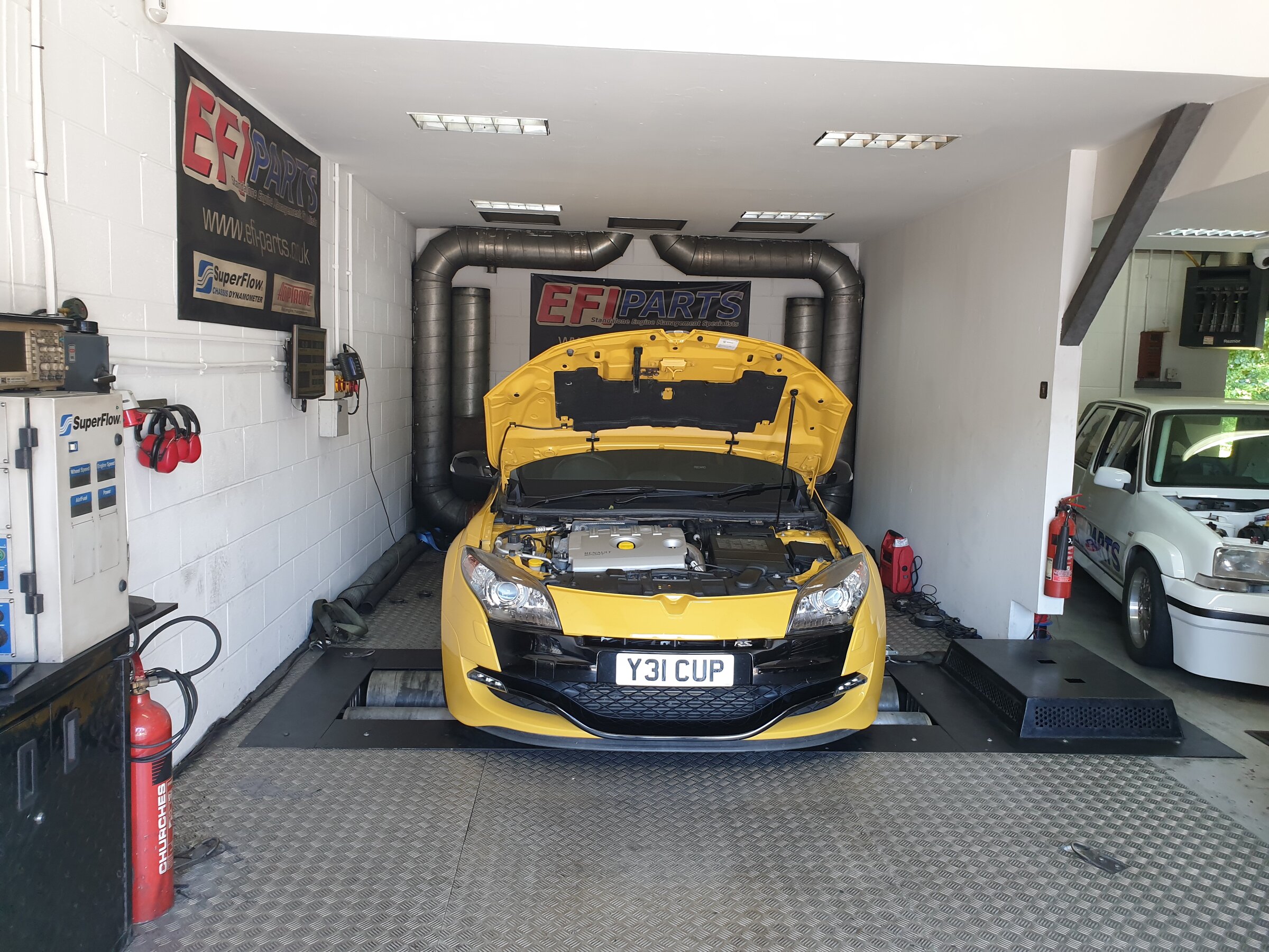

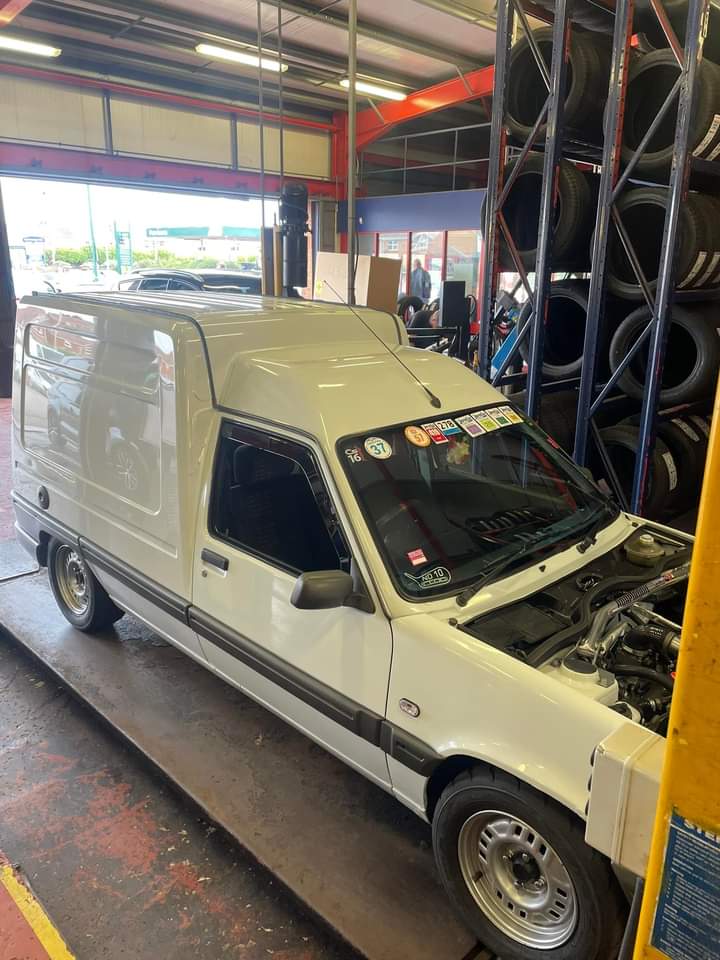

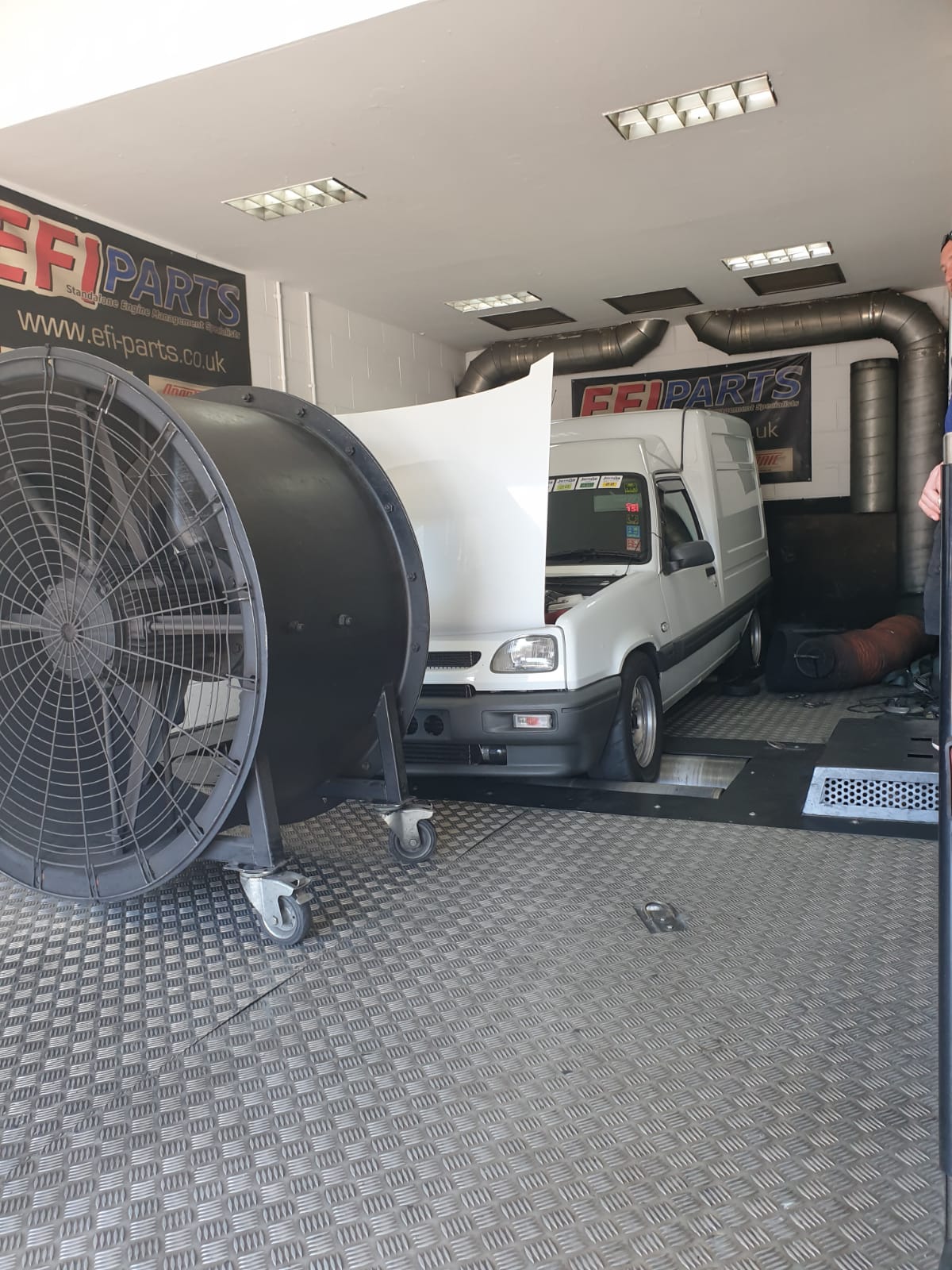

So the day came and it was time to get the Extra mapped.

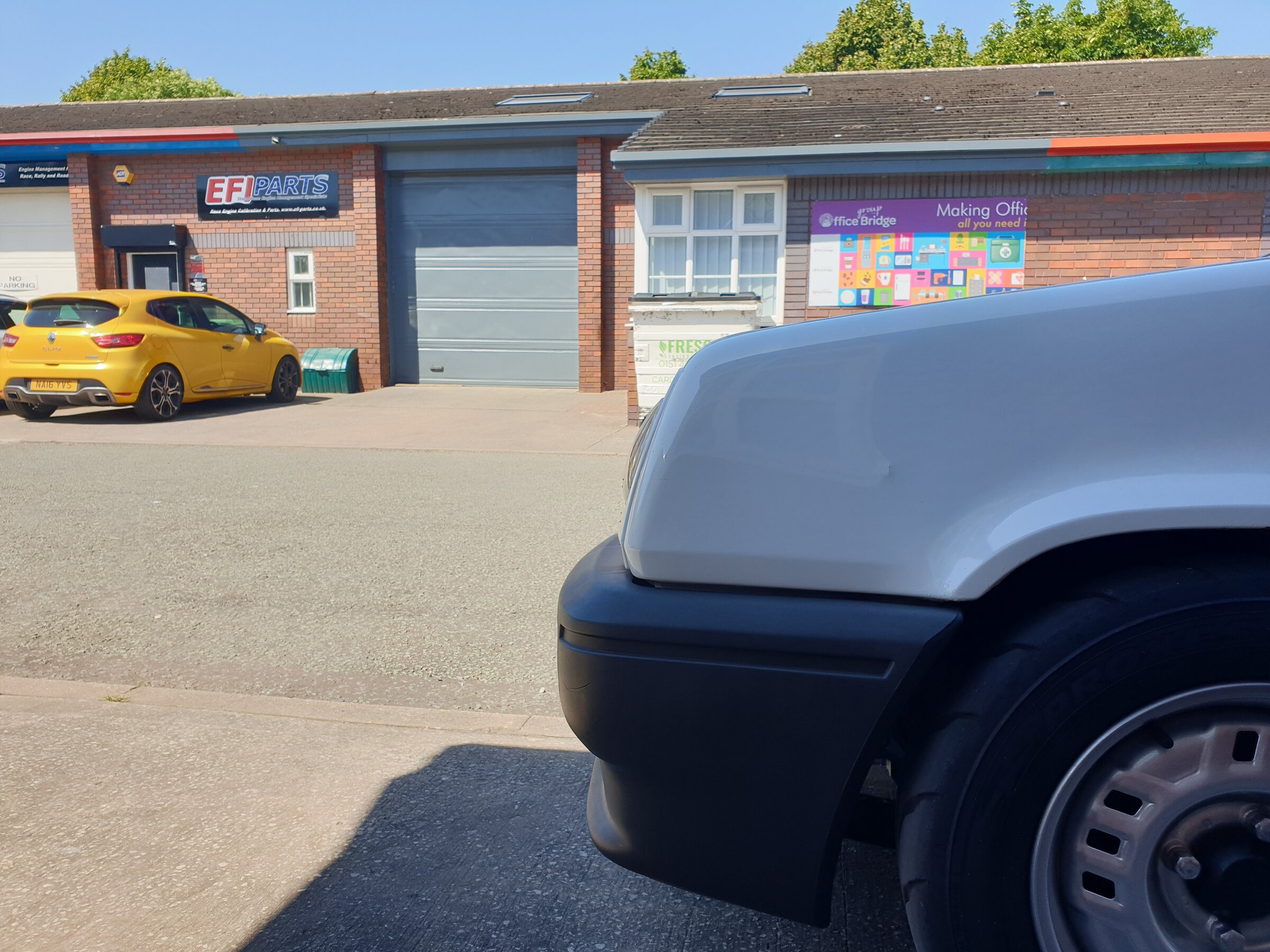

Filled the tank with tesco's finest 99 momentum and set off on the journey to Efiparts. Had a steady drive on the way down as the base map was ok but not great, sat at around 50-60mph. The weather was exceptionally hot around 25 degrees, but did not cause no cooling issues and the engine was quite happily cruised along at 75deg.
Stopped off at Warrington as needed to go and brim the tank with tesco 99. Hit mid day traffic and ended up crawling along for a while, rad fan singing away keeping the temp around 80degrees and paddle clutch was awful in traffic.
Filled up and set off on the short journey, got there early and a megane was just finishing off on the dyno so took a seat outside in the sun.

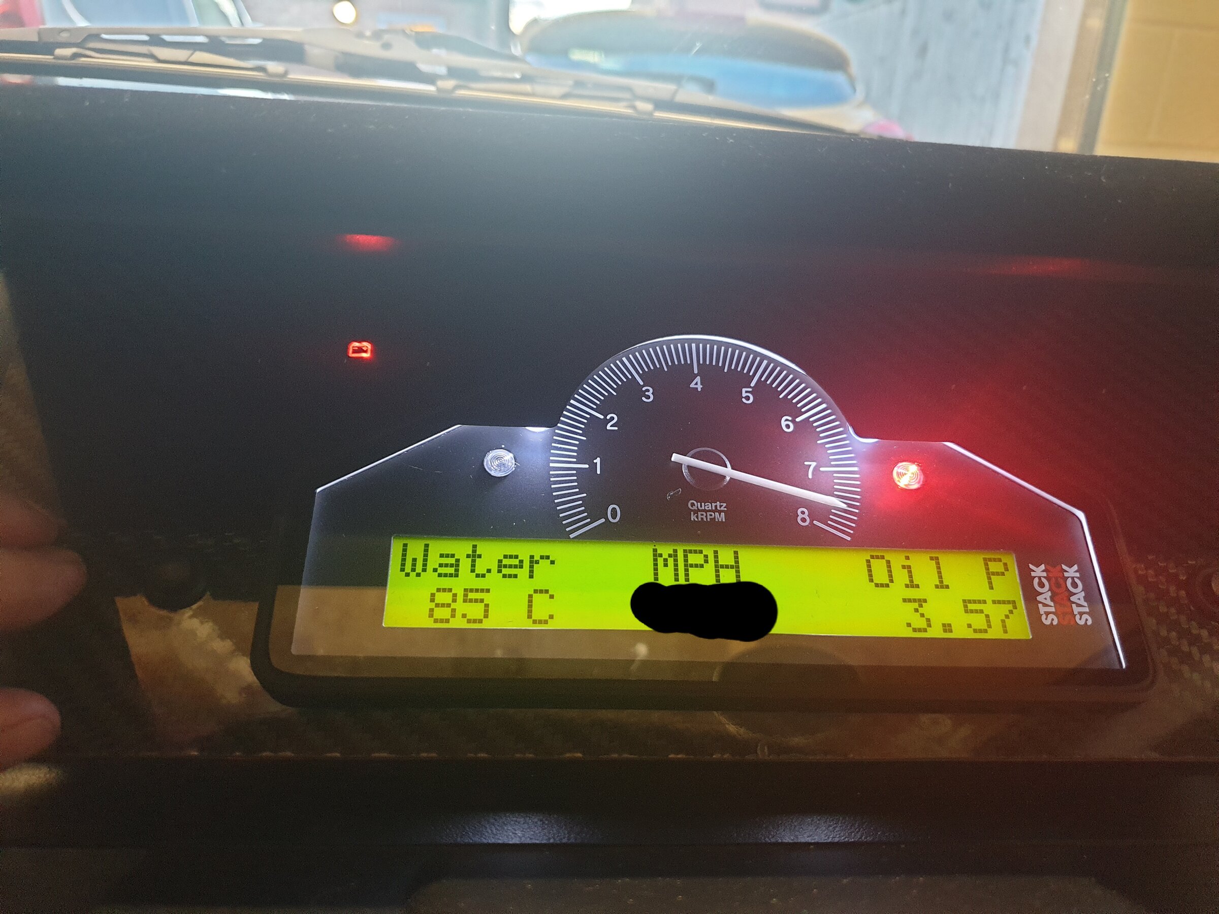

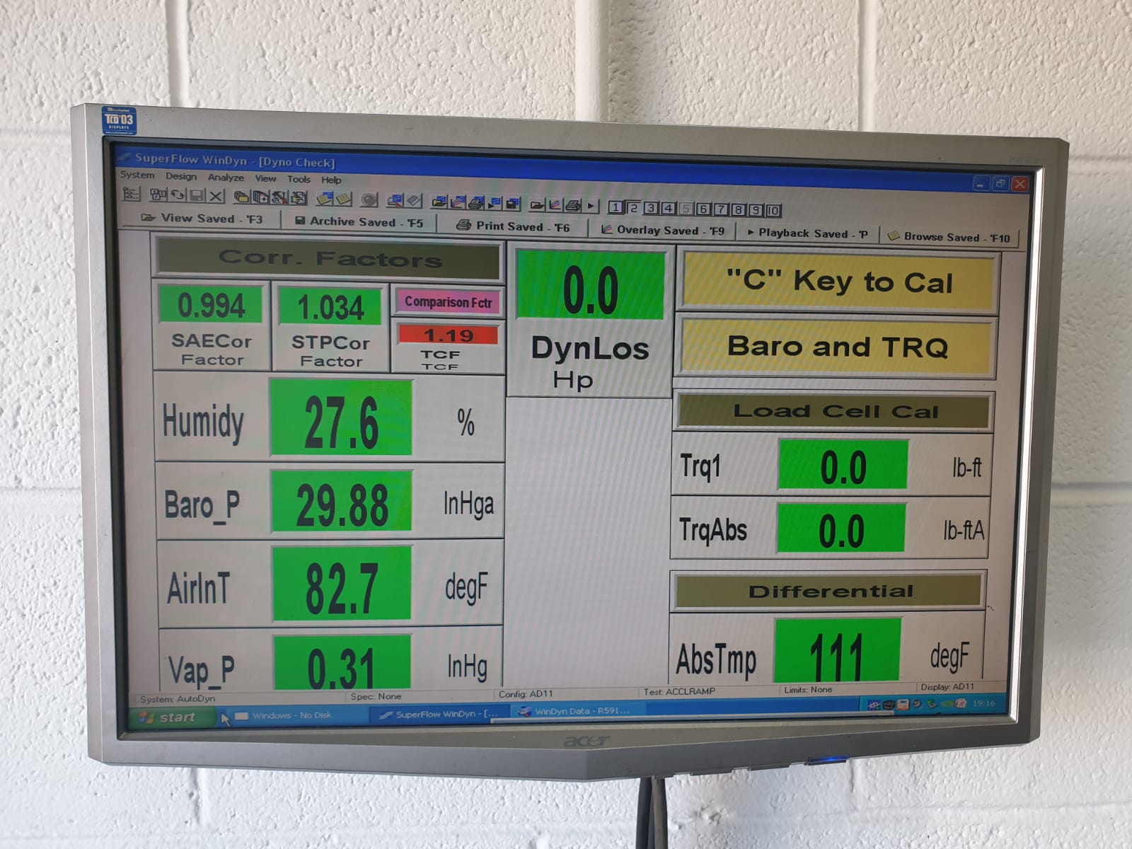

Time comes and its strapped onto the dyno. Fan looking rather large compared to the van!

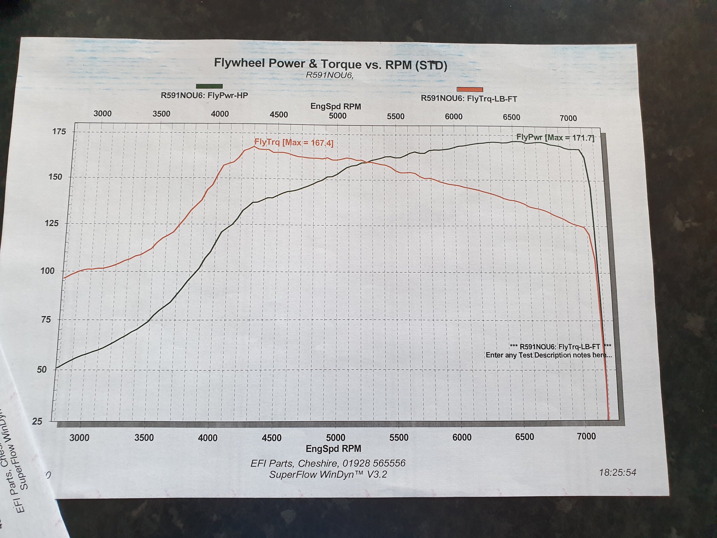

Chris done some initial checks, first was to check the base ignition timing was set correctly with a strobe light. It needed adjusting as i had set it slightly out and was 4deg retarded.
He then started doing some low speed mapping on part throttle. I was keeping my fingers crossed that the fuel system and ignition would be ok as largely untested under load. I had only seen around 4k rpm on the road and no real load on the engine.
I explained the mac valve was on a switch so with the switch off it would run gate pressure, and high boost with switch on.
After a few runs we were up to a respectable 171hp/167ftlb @13psi gate pressure. Listening to the engine sing round to 7500rpm for the first time was awesome. The setup was working well and responding well to boost.
So the next question off Chris was "How far do you want to push it" and my answer as usual was "all the boost";) push the engine a bit and see what its capable of, within reason as its pretty much stock bottom end and 200mm ap paddle clutch.

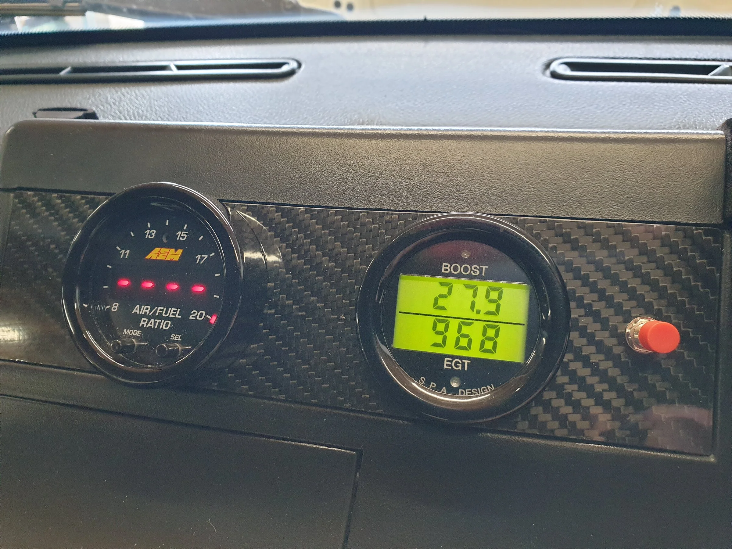

Started ramping some boost in and the power came up fast, seen 200hp, 220hp, 230hp without flogging it too much. I was happy at this point as it had met what i had wanted hp wise.
Started really leaning on it and boost up to 29psi to see what it was capable of on some runs, with the power still coming up. Great buzz hearing the engine picking up power and sounding stronger each run.
Dyno cell temps of 27 degrees at this point which was not helping things!
So after exploring the limits and pushing the engine, the power came up a bit more than i was expecting.
The end result is 249hp/227ftlb.
The boost had to held back a little under 6krpm as close to knock, then ramped up to 27psi over 6k. Torque is limited to keep the stock rods and drivetrain happy.
First test drive, took it down the road on wastegate pressure of 13psi and was quite suprised when it was scrabbling for traction in 2nd gear, felt quite fit. I then tried high boost, its pretty lairy as expected, feels quick and makes all the right noises. Its a drag strip tune, so good for short blasts on high boost but will need knocking back a few pegs for hard track use, which is what i expected and ill be happy with 200-220hp for track use at lower boost.
To put it into perspective, its as quick as my mrs meg 250 cup on wastegate pressure, and long gone on high boost.
Worked out its around 270hp per ton on high boost, so no slouch.
Overall it drives great, starts up hot and cold like an oem car, cruises along at 14afr nicely at 70mph. Very happy with the whole setup, engine is a lot more responsive low down with raised compression, turbo spools up faster and on boost around 1k rpm faster than the previous setup. Done 30+ runs up to 7500rpm on the dyno no issues, no misfiring, did not need to lay a spanner on it. Mapped and drove home:)
Chris done a great job mapping it so big thanks for showing the full potential of the setup, went above and beyond to get the best out of it. He is the best in the business in my opinion, cant recommend him enough.
The plan is to drive it a bit this summer, then invest in some stronger bottom end components and get this Gtx 2860r bolted on and see what happens;)
Thanks for reading!!

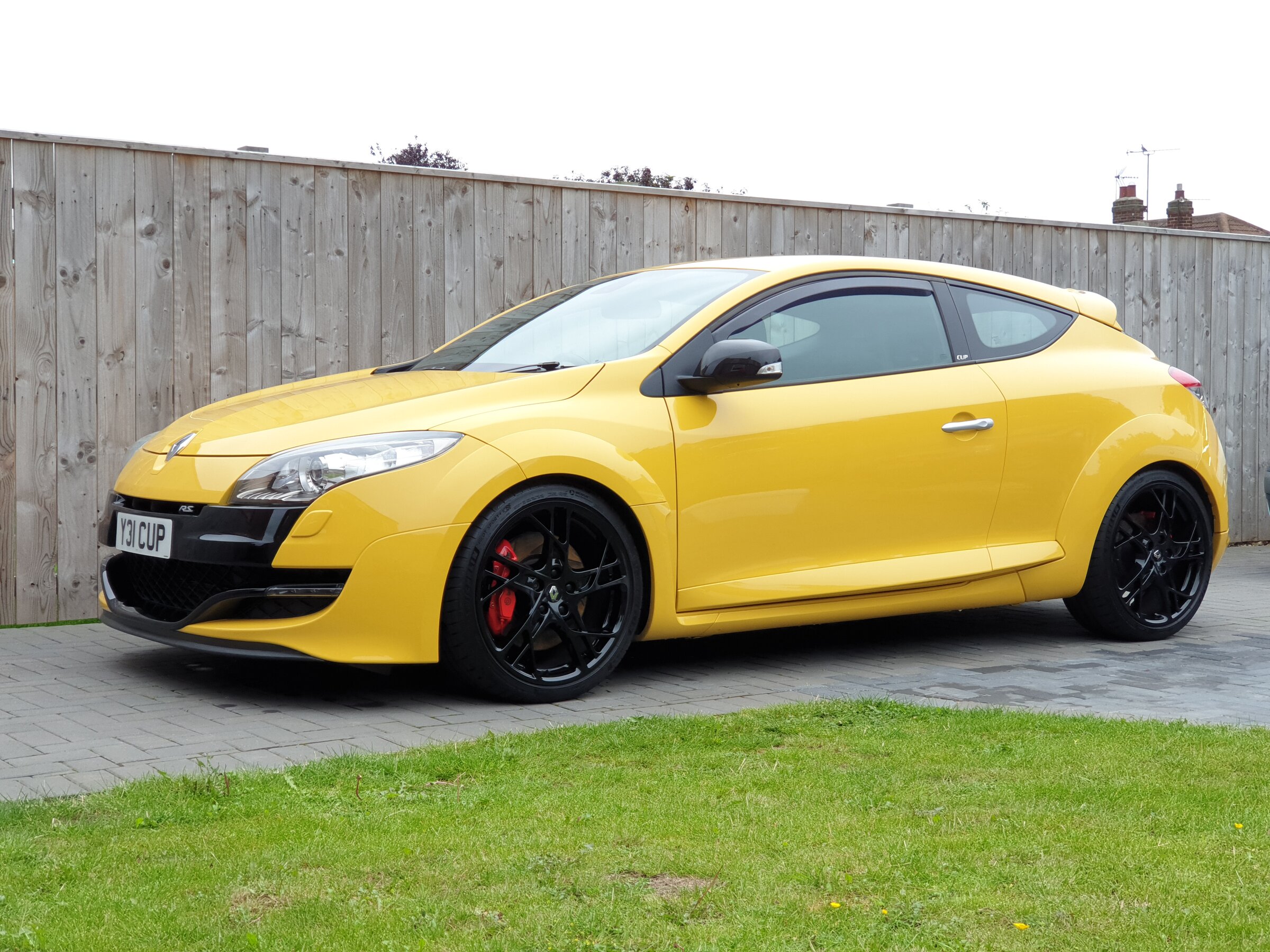

250 cup and the battery saga.
Had an oldish Bosch battery on it which went flat over winter, had been hanging on for ages without regular use.
Feeling generous and like a reliable car so stuck a new Yuasa batt on from Halfords with trade discount so was quite cheap. Stuck it on and it started up yet slow ish which did not seem good. Anyway was planning on taking it out for a run so went to start it a few days later and flat as a fart.
Charged it up with my ctek charger on restore, seemed fine so stuck it back on and flat within a week and struggling to start on weekends when used. At this point i started doing some basic checks for parasitic draw with my multimeter. Basically found nothing out of the ordinary, so planned on taking it back on warranty as assuming knackered cell on batt then lockdown hit so left it.
Lockdown eases so return it for a new one.
Day 1
Lad on the counter tests battery and says its flat (no s**t sherlock) i explain the above then he says he will need to charge and check as per Yuasa instructions.
Charges up and says its saying ok on tester (no s**t fully charged) told him not happy and a cell is knacked. Its not showing 620cca only around 570cca at this point. As im arguing the toss he says he will leave it off charge and test again and he cant replace as not a manager bla bla.
Day 2 he tests it, its dropped down to 12v and about 420cca with no load and agrees its knacked. I cant make it down but will replace with new. Hes not in the next day so will leave a note for the manager.
Day 3 i go to collect new batt. Snotty manager says i dont know why he said you can have a new batt bla bla. I start losing my s**t at this point and tell him what i think of his s**t battery and refund or battery.
Walk out with new battery. Moral of the story is never buy a battery from Halfords ever.
Fit new battery and the meg fires up great. No sign of going flat at all, so was right all the long.
Cleaned up and looking good as usual.
Even had a shot in the garage whilst we got some more block paving done.
Drive after another few sqm of block. Bricklayers are having bets on us getting them back to get the rest done :LOL:

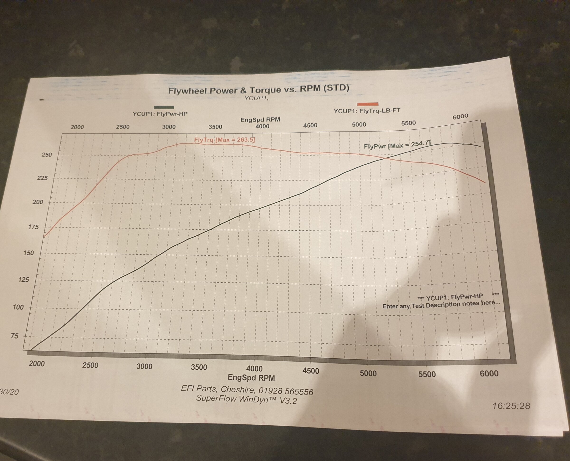

Also give the 250 a power run at Efiparts to see what its like before any mods. Made 254hp stock, its only on 37k and not had much abuse, Chris said its healthy enough and what he would expect power wise.

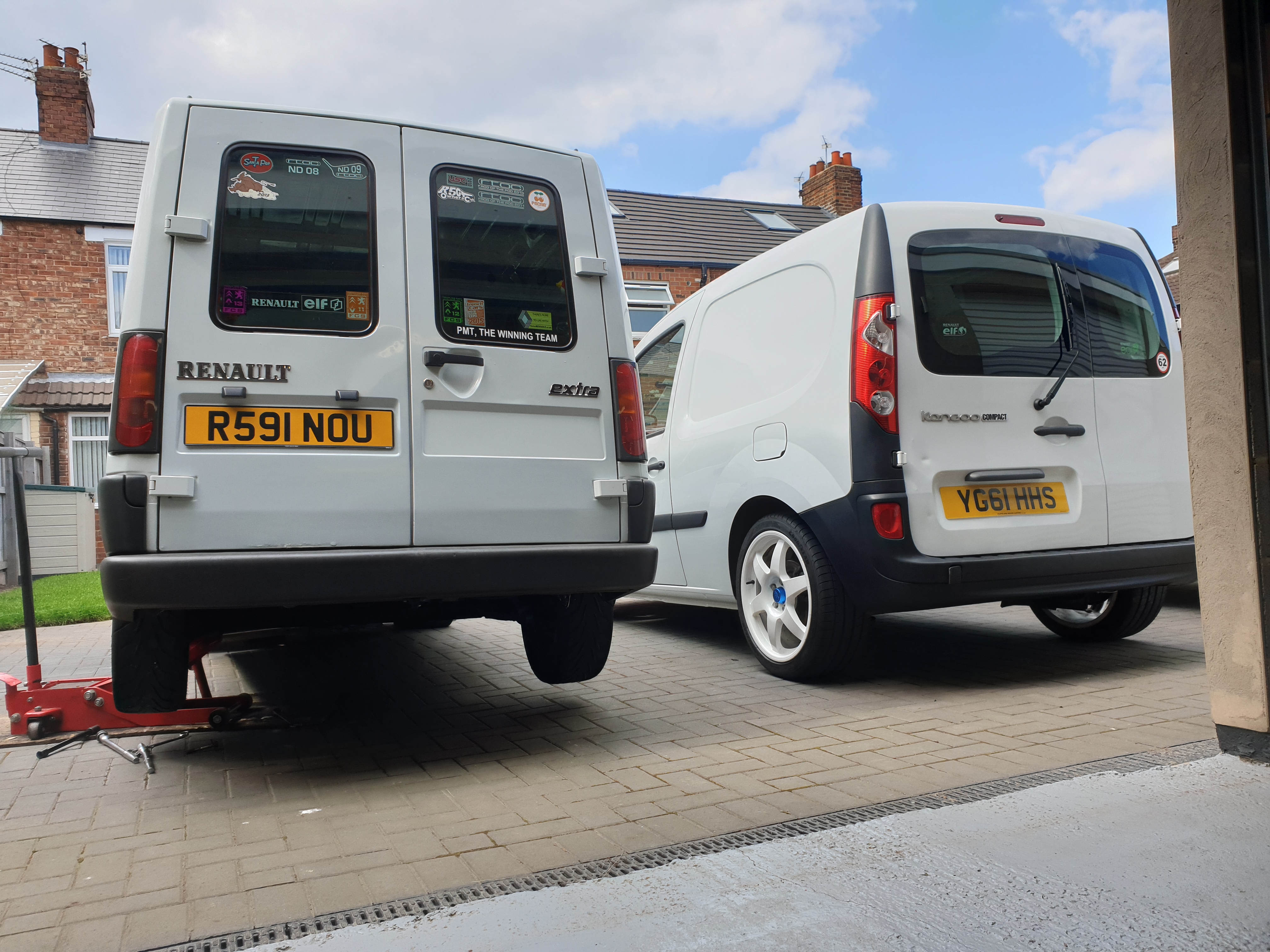

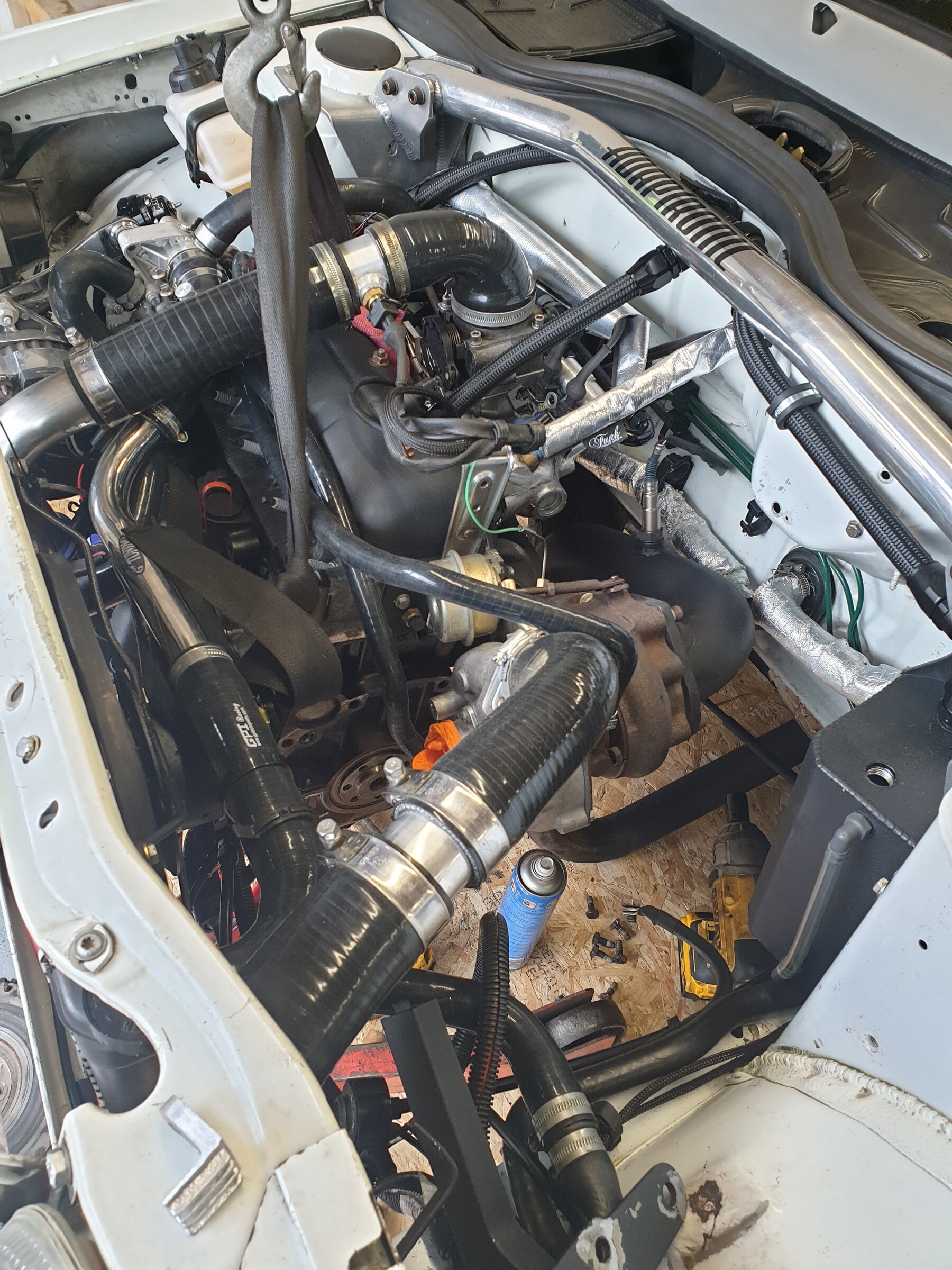

Renault Extra oil leak saga.

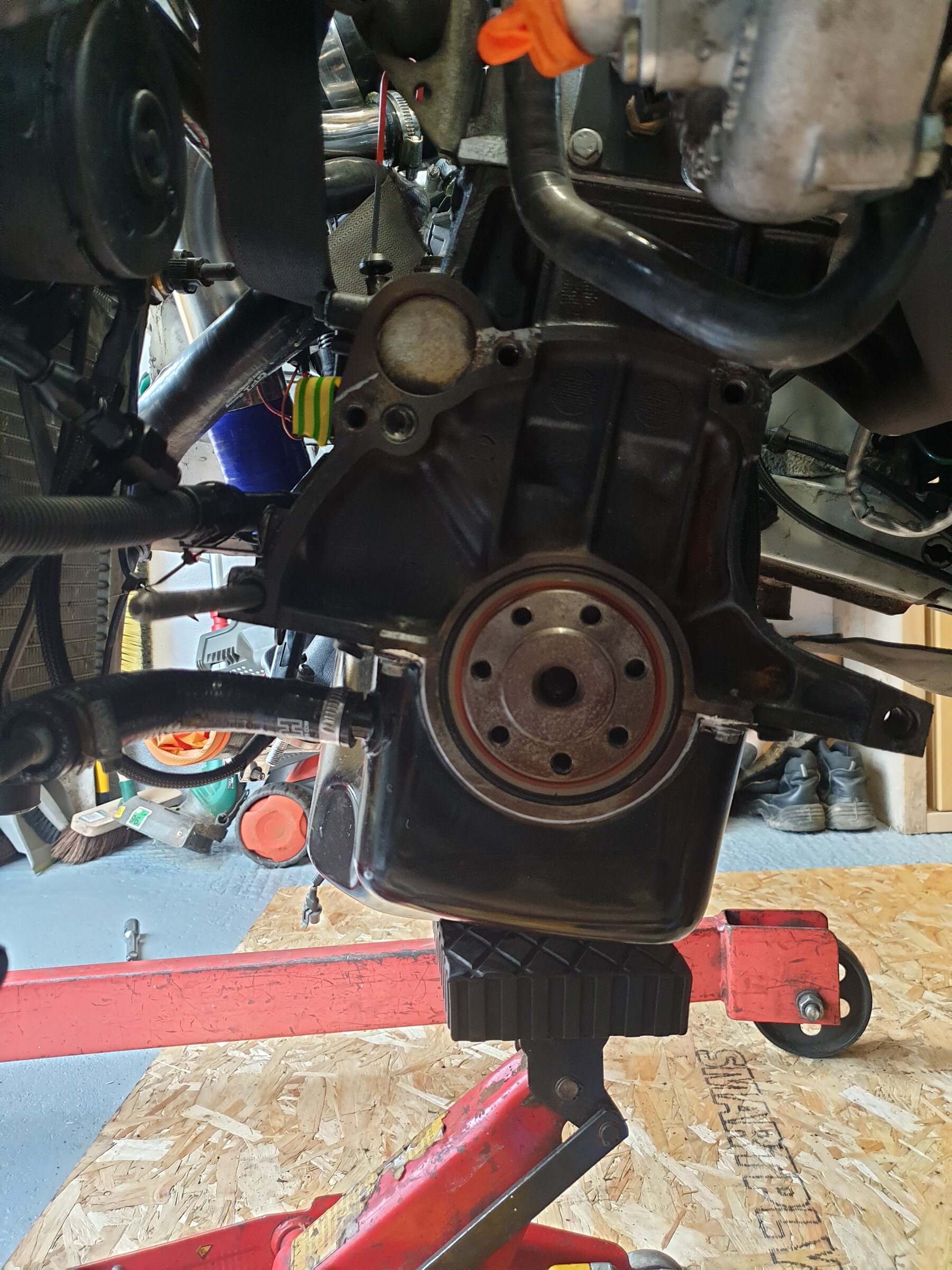

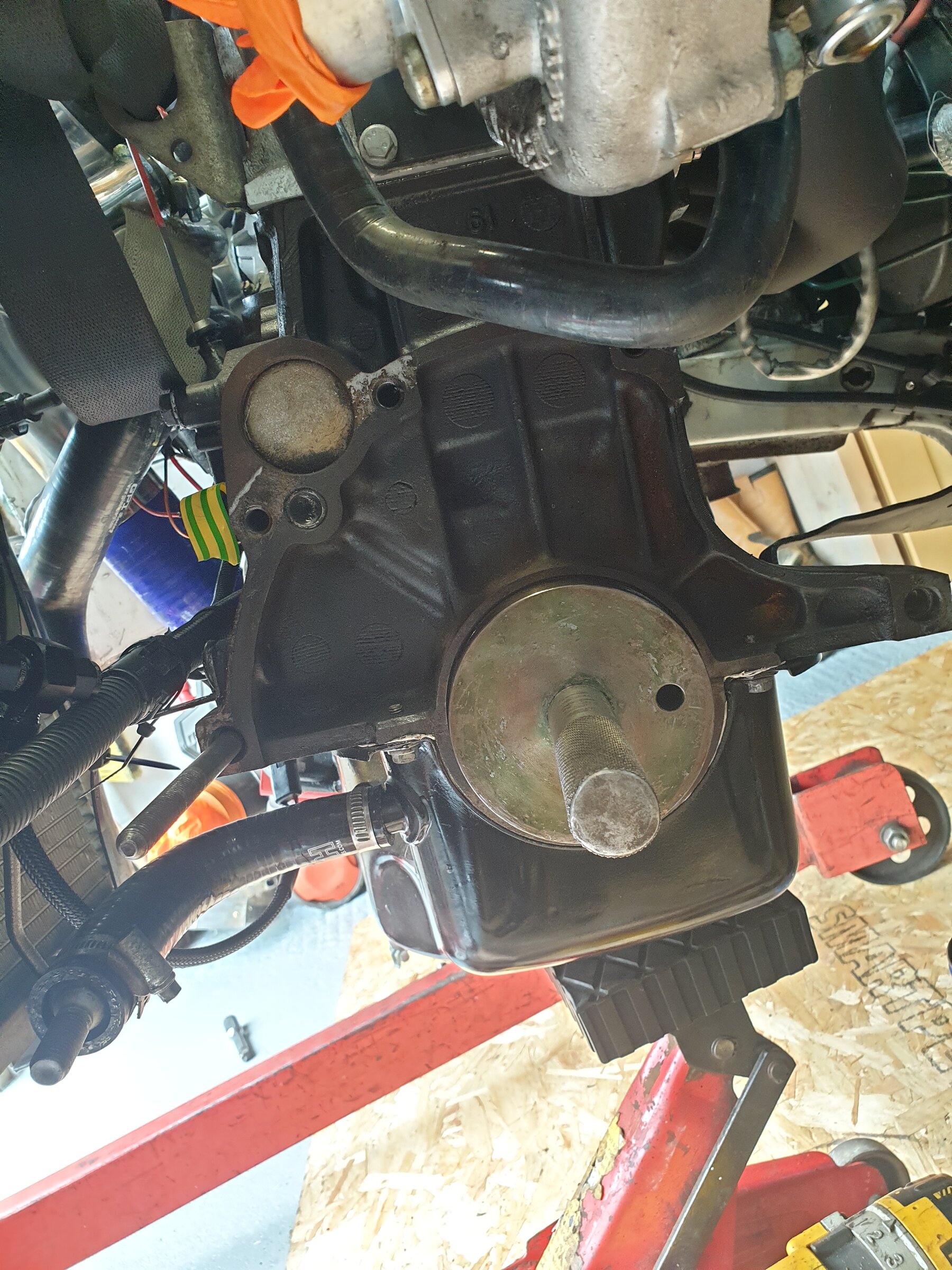

After mapping i noticed a leak on the crankshaft side of the sump. Jacked it up and could see oil running from crank area. So stuck it in the garage and left it for a few weeks.
Had a weeks leave from work booked in so proceeded to drop subframe and take gearbox off, leaving engine in situ to save disturbing too much.
Familiar view in the garage, Extra van in bits
Engine hoist and jack on the job to hold it in place
Whipped flywheel off and noticed the crank seal is pretty much dry. As its impossible to accurately trace the leak without removing everything to see it was a chance i had to take.
Tilted the engine and could see the oil seeping out of the half moon sump seal on the crank side of engine. F**k, did not have the parts to fix it at that point and not in the ideal position to be pulling the sump off with the engine on the hoist, decided to stick it back together. I used a combination of black and orange timing seals when building the engine and the orange one is bone dry on timing side.
So with this set back, i levelled the engine to stop oil seeping, brake cleanered the oil up and resealed it. Whilst i was there i fitted a new o.e renault crank seal as it looked like it had a very slight weep.

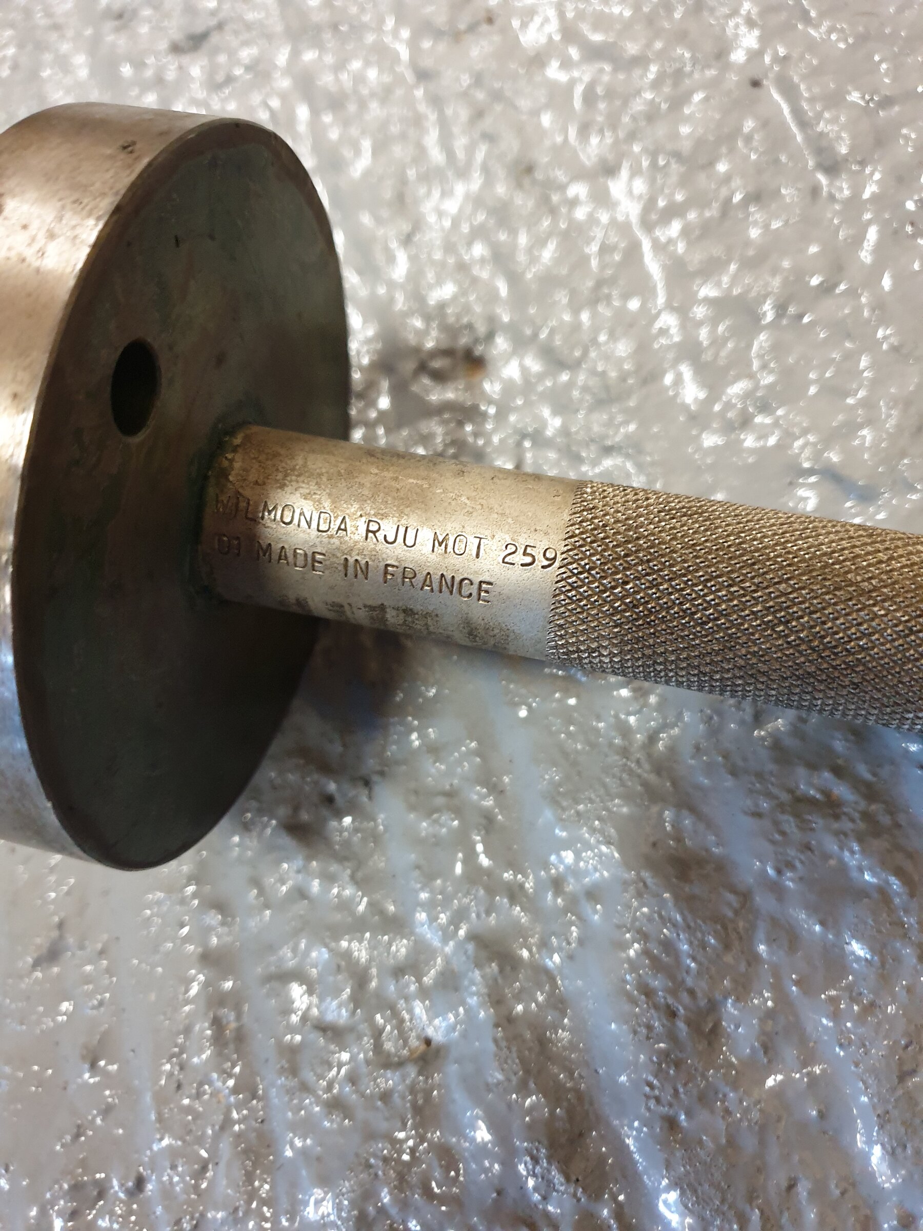

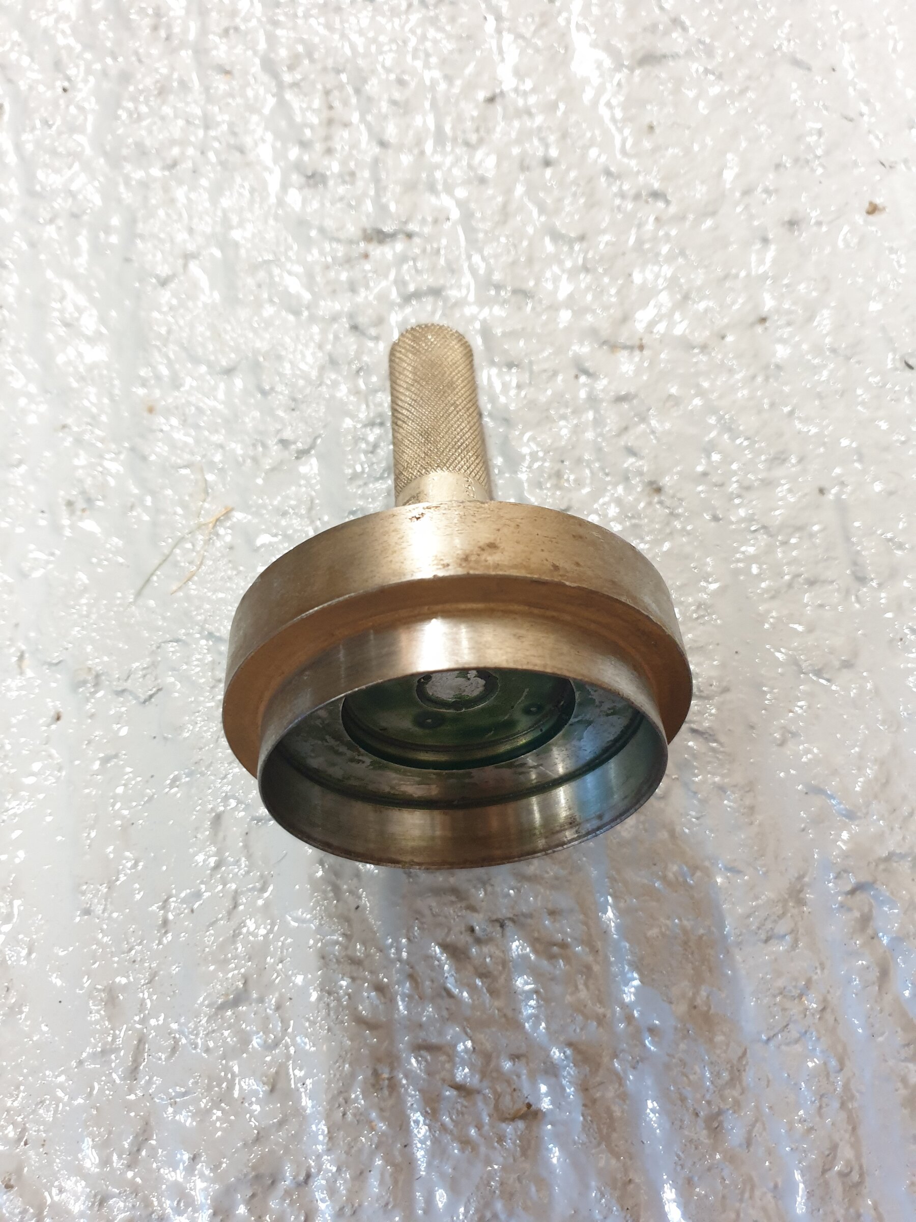

Found a genuine renault crank seal driver MOT259 on ebay usa so used that to fit the crank seal.
Turned out to be an epic bit of kit, i hate fitting crank seals as easy to knock them in off square or kink. The tool slides over the end of the crank nose, just lubed it up, knocked it home with the dead blow hammer, super easy.
Note the grey tgreebond sealant applied in a band aid fashion.

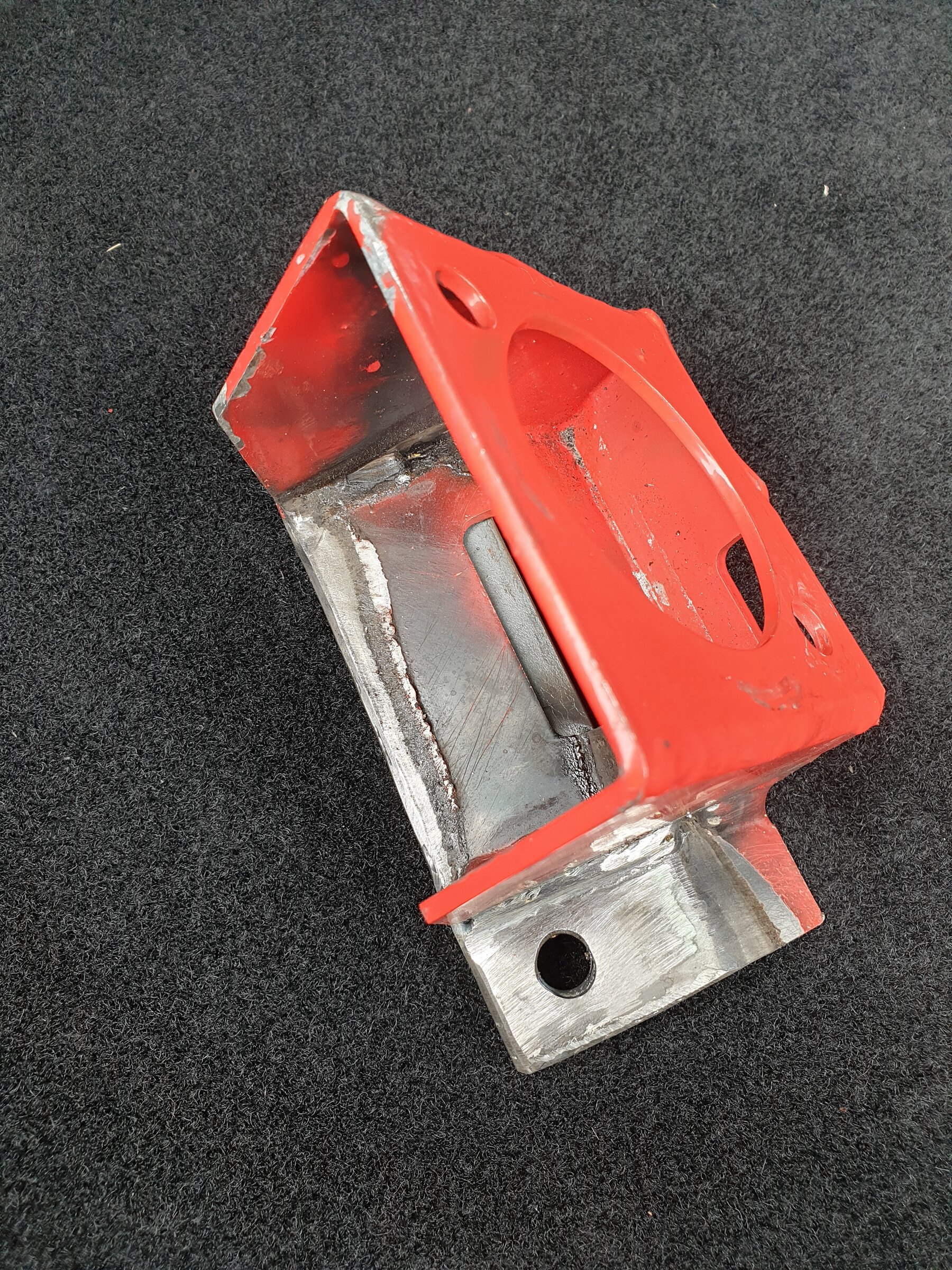

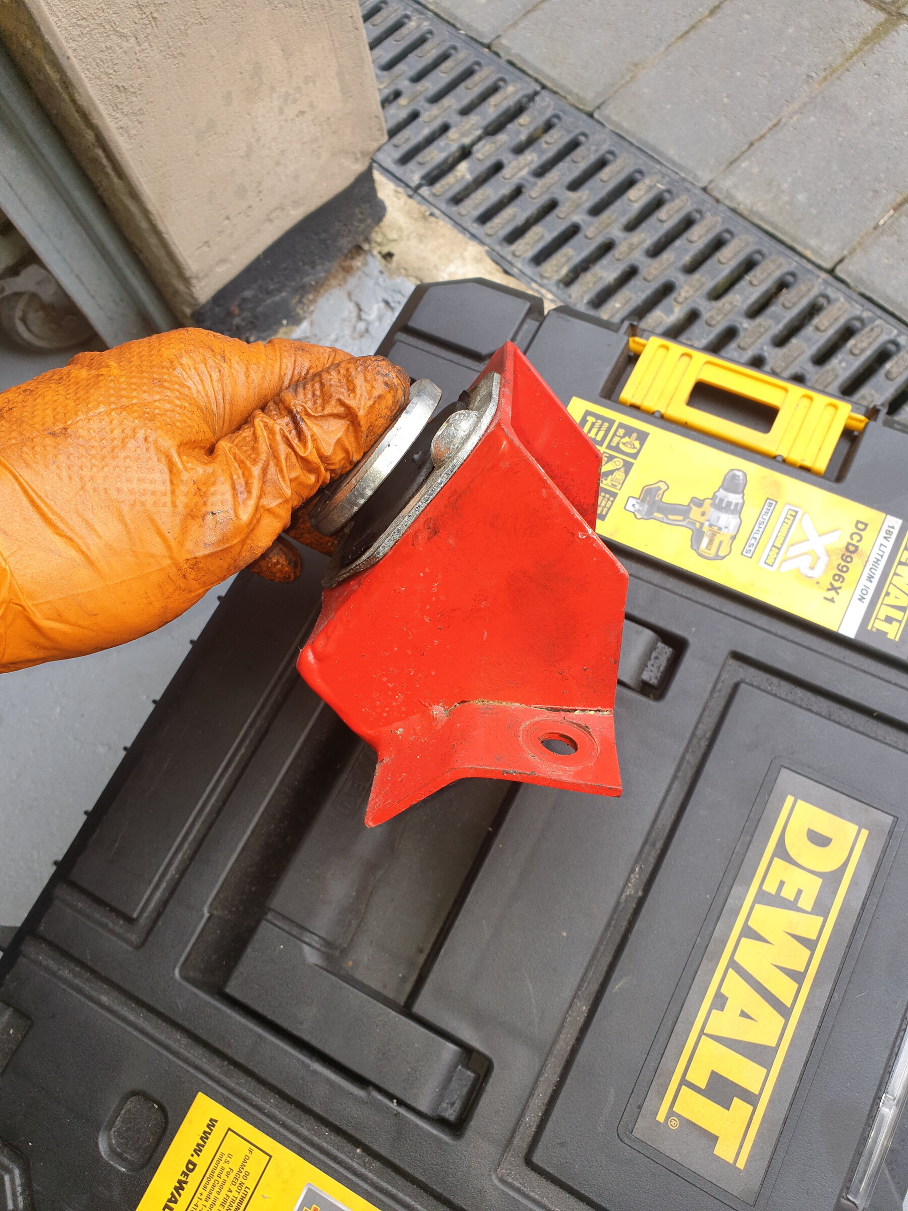

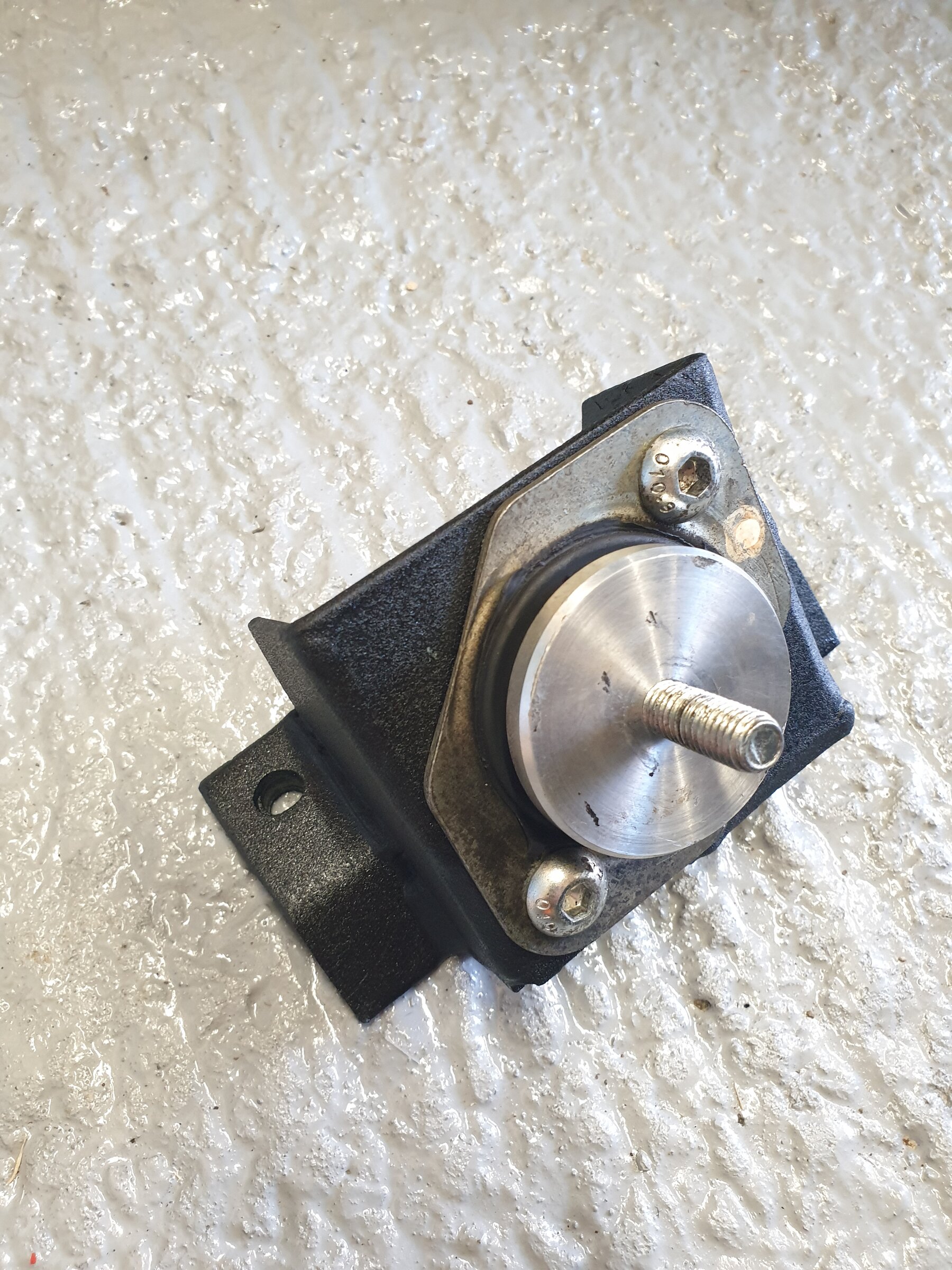

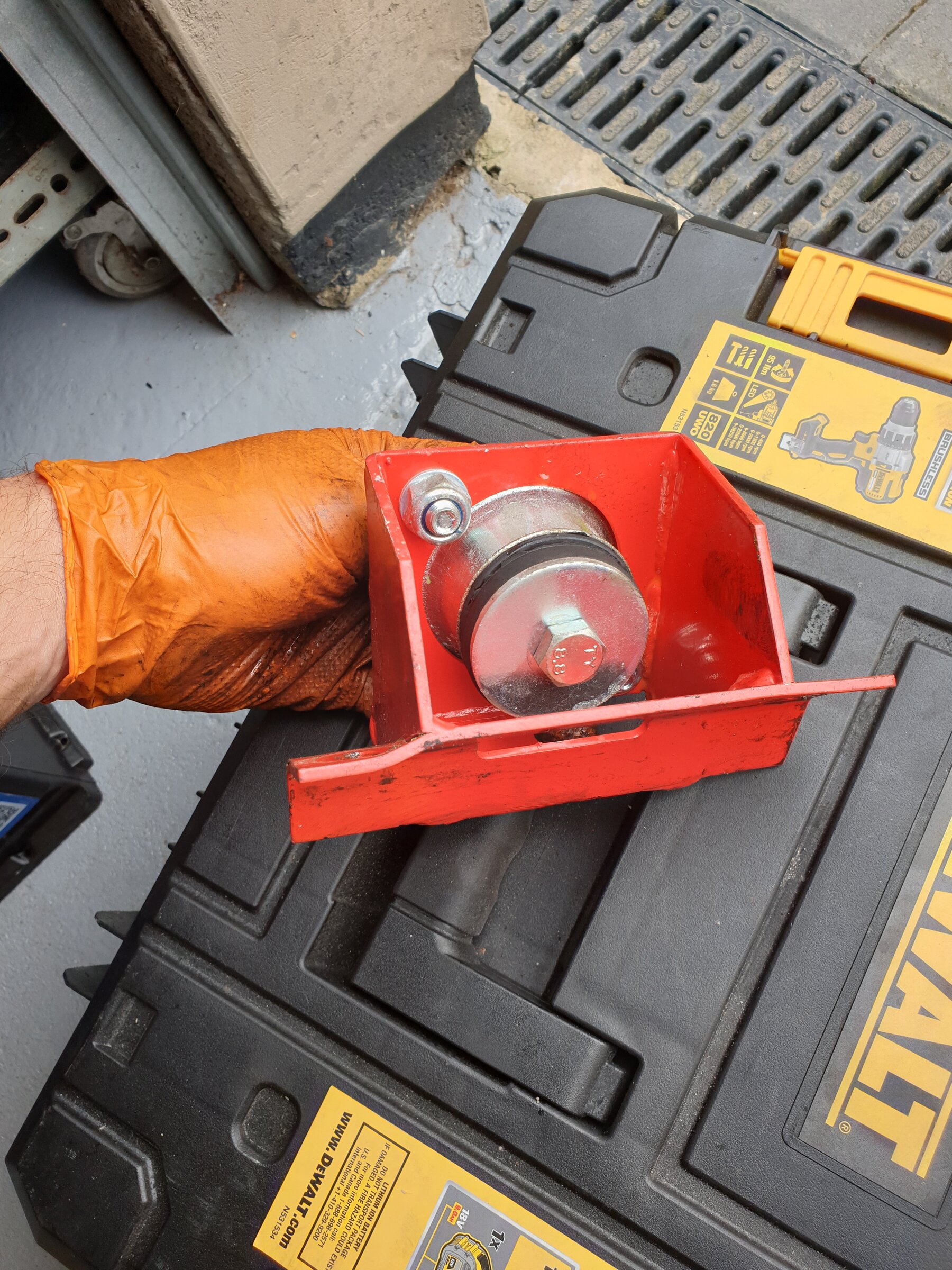

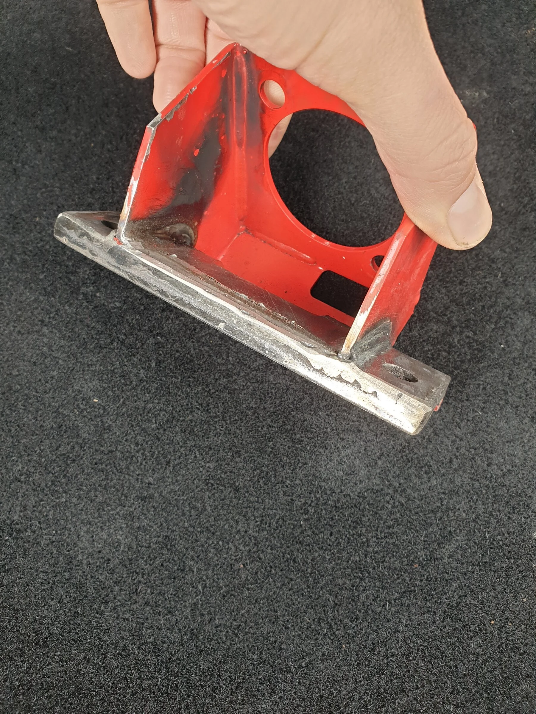

Whilst apart i noticed the rear engine mount had split around the welds. Its done 800 miles running in mileage and mapping, hardly used.
Mount is a vibratechnics one. Proper flimsy piece of s**t really, only welded on one side, not cheap and not fit for purpose
I was highly annoyed over this and feel vibratechnics should have replaced this, however no time to mess about as i needed it back together sharpish.
Popped down my local fabricators and he beefed it up with some 5mm plate and fully welded. He agreed with me, the mount is poorly made.
Painted up. Glad i discovered it now before it broke and the exhaust falls onto the heater hoses or a shaft snaps.
With that fixed, stuck it all back together.
Initially the oil leak was fixed, give it a bit of boost and the leak has reappeared, but not as bad as last time. Its passable for now and can wait until winter, will pull engine out and drop in some steel rods, forged pistons and ductile liners, reseal the sump on the engine stand whilst apart.
Took it for a test drive as not really used it since mapping. Hooks up great with the quaife lsd, its been transformed from a wheelspinning/understeer oldskool turbo setup to point and turn and accelerate.
The engine revs well, really strong up top. Ive been avoiding the rev limiter but accidently clipped the hard cut in 2nd 7600rpm. Shotgun bang lol! Best avoid it as i dont fancy dropping a valve.
Peak recall on the gauges.

440 mile round trip, 044 fuel pump whine and pms shifter rattling but apart from that no issues, and reasonable mpg at cruising speeds.

Can't say I'm surprised by the mount. They did one for the Escort years ago and it just used to disintegrate, was nowhere near up to the job. The Clio ones seem ok, but I would be cautious with others.
Van looks great otherwise 👍
Brigsy
  T.Turbo
Cheers mate. So dissapointed with the mounts, will never buy anything from them again. Im looking at motorsport style mounts to replace them.
massiveCoRbyn
  Several
Yeah definitely hit and miss. The standard Escort mount isn't the best design, but the Vibratechnics one was shocking. Made of welded aluminium sheet, which had just cracked. Later versions were steel, but it was pretty obvious that ali would never have done the job.

Meg 250 has been sold, its gone to a great home though. Little bit sad to see it go as had very light use off us in 2.5 years we had it. Already got eyes on another car to replace it, which will be epic ;)
A few pics of it all cleaned up, great looking car.

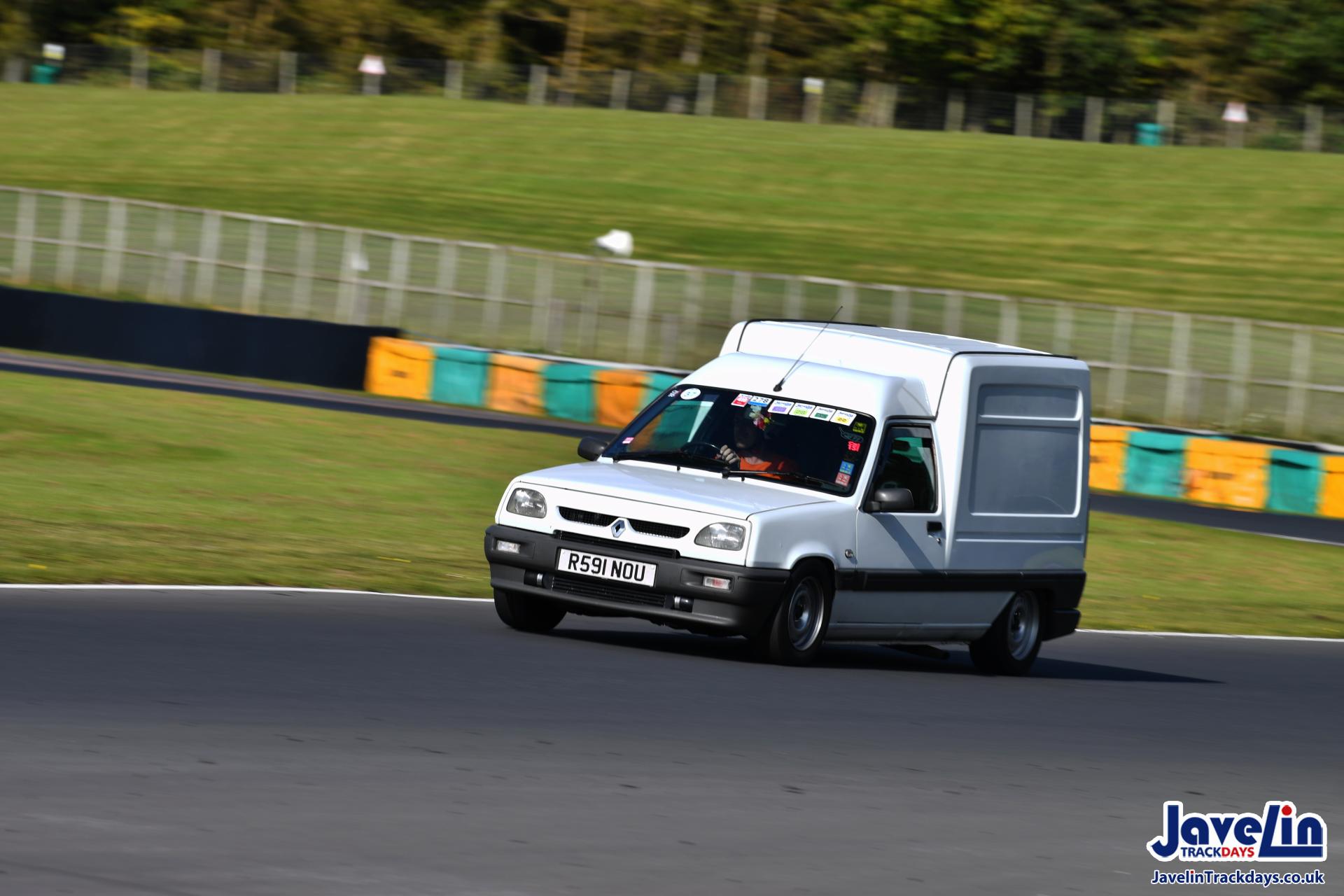

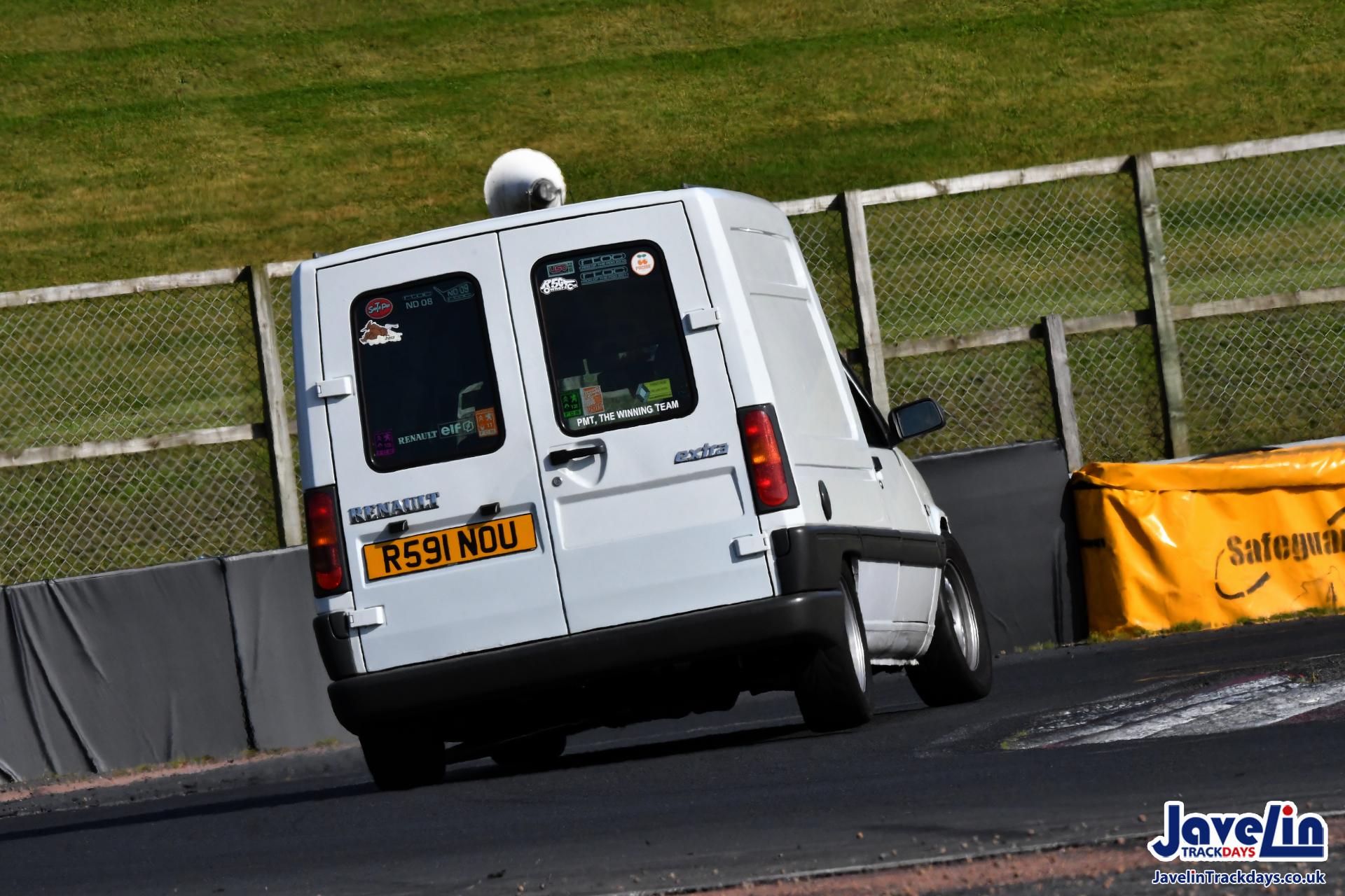

One of my mates was at Croft in his meg on bank hol Monday. He needed a 24mm spanner taking over so dropped it off as only 30 mins away from the house. Chucked my lid in and next thing ive paid for the last hour on track for a quick shakedown.
Went really well on low boost of 12psi 171hp, no issues, oil temps of 89deg max and coolant temps around high 70s. Happy with that as not used it in anger on new setup.
Brigsy
  T.Turbo
Fast forward a couple of weeks later and go over to Croft to help fit a set of rear pads. Stuck my lid in again and paid for all afternoon as the weather was great.
Handling is great with the quaife lsd and can really get on the power on low boost as no drama and really smooth. Its hard work to drive but so much fun.

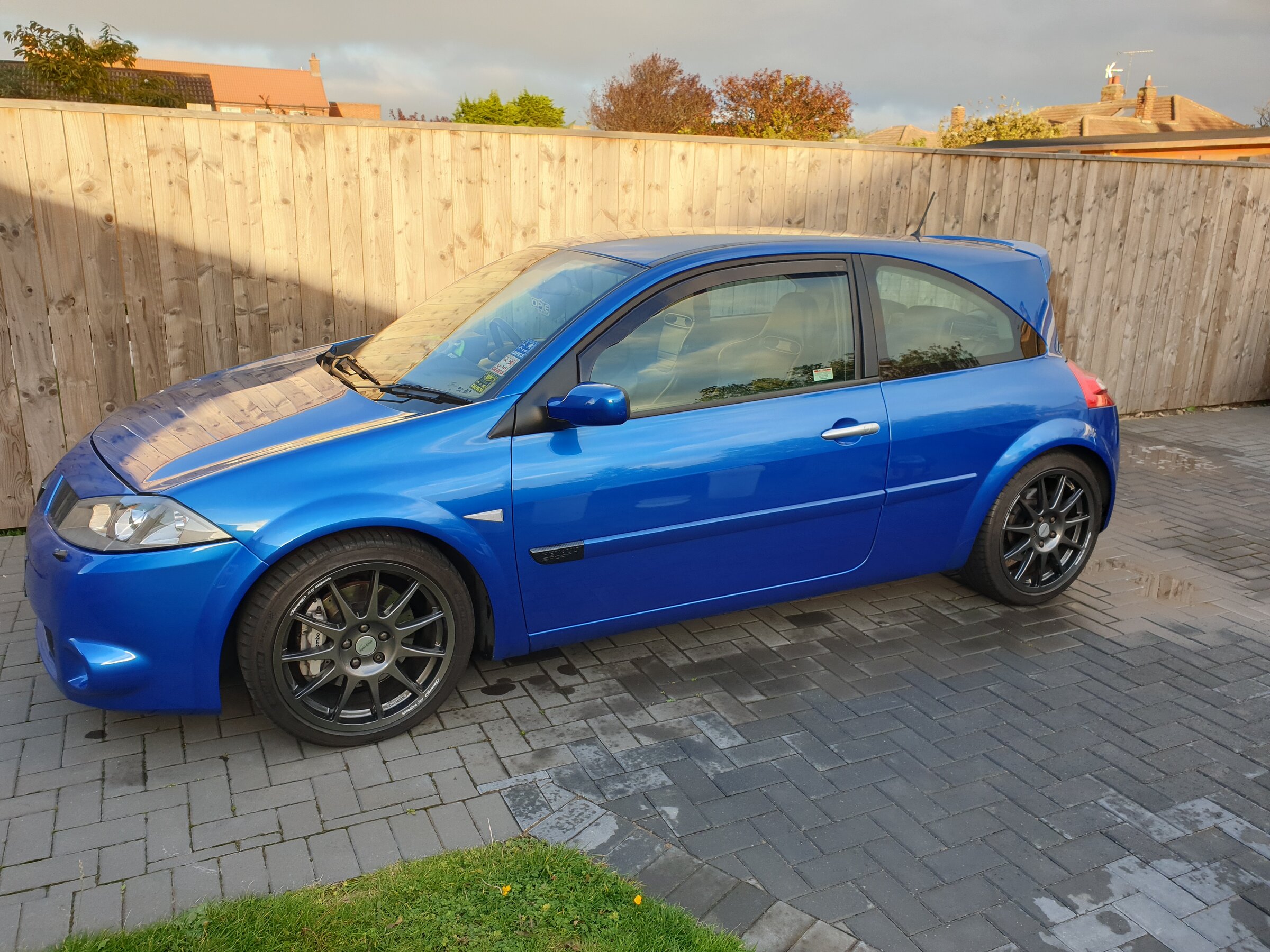

Blue meg has been used a bit too. Had to pop down to Ipswich for an ebay purchase last weekend and give it a ride out. Drives so good, nice comfy recaros. Sat on cruise most of the journey 34mpg, 520 miles.
Give it a good clean up when we got back
Sorn until next year now weather has turned.

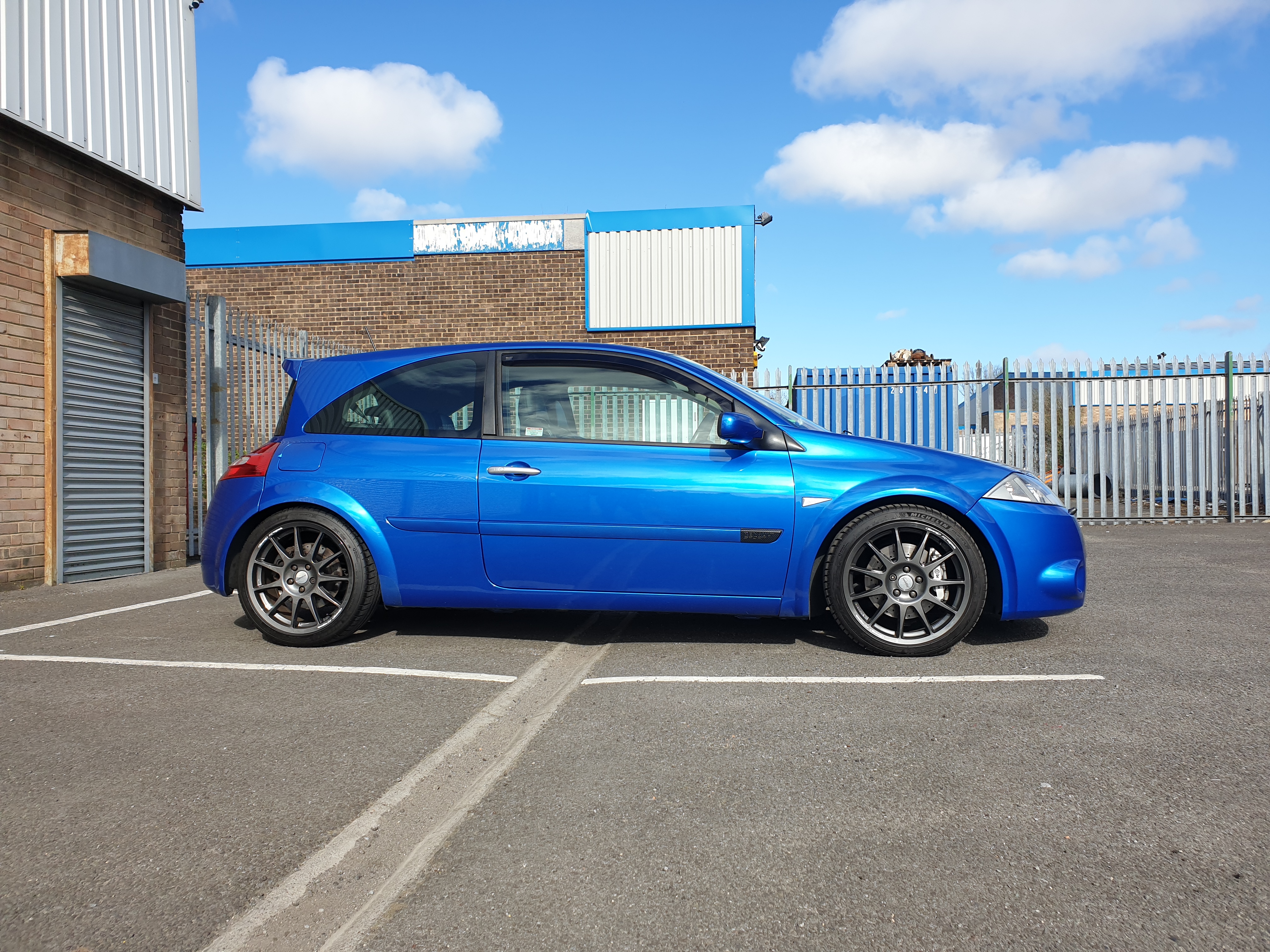

Had the blue meg out to try on the comps at the weekend, so done a collage of all 3 sets of wheels. Cannot decide which set i like the most as i like them all. Garage is full of sets of wheels!
Brigsy
  T.Turbo
MO5's would suit my car more, should sell them... 👀
The old style mo6 in 5x108 and right offset are made of unobtanium for the meg, so much graft to get this set I even asked compomotive to make me a set and they fucked me off:LOL:
Still fancy a set of r26r wheels to add to the collection
Klumpy Dumpy
Not all gingers stink of piss. But I do.
Bloke in Scotland had some for sale the other week, said he didn't want any time wasters but didn't include a price in his post. Spastic c**t 😂
Tbh I've got enough wheels, need to offload some. I'll still never say no if @DaveL485 decided to sell me his Bola B12's 😂

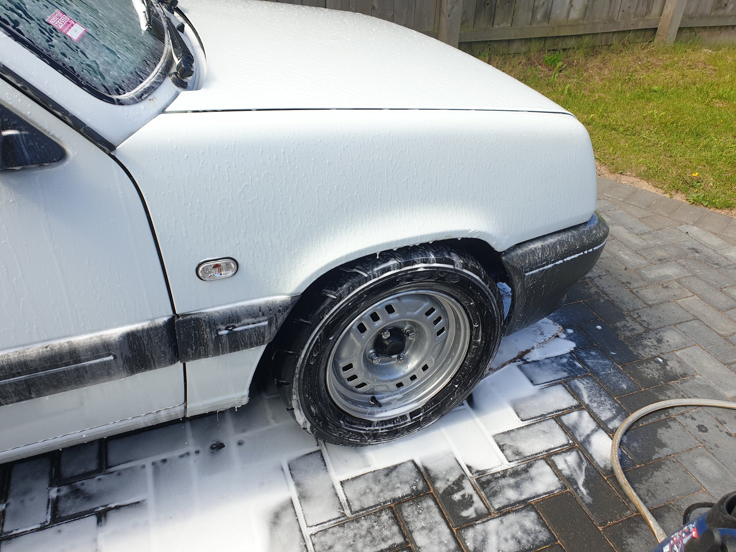

Quick snowfoam to get dust off, checked tyre pressures, steady drive upto M/boro to get some heat in everything then over the North Yorkshire moors to enjoy some b road action. Still love this car, the progress you can make on b roads is epic. 17 year old car now!

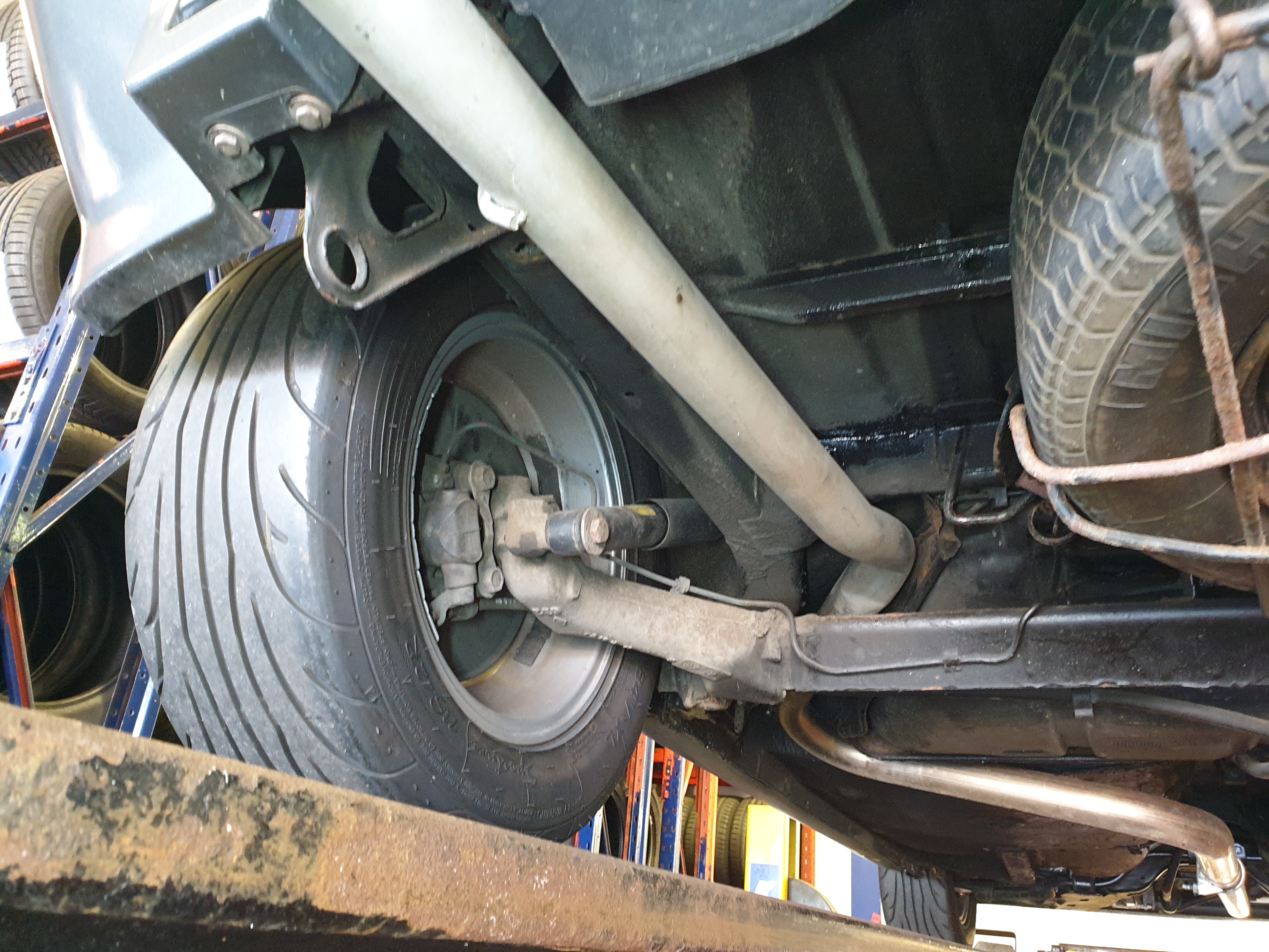

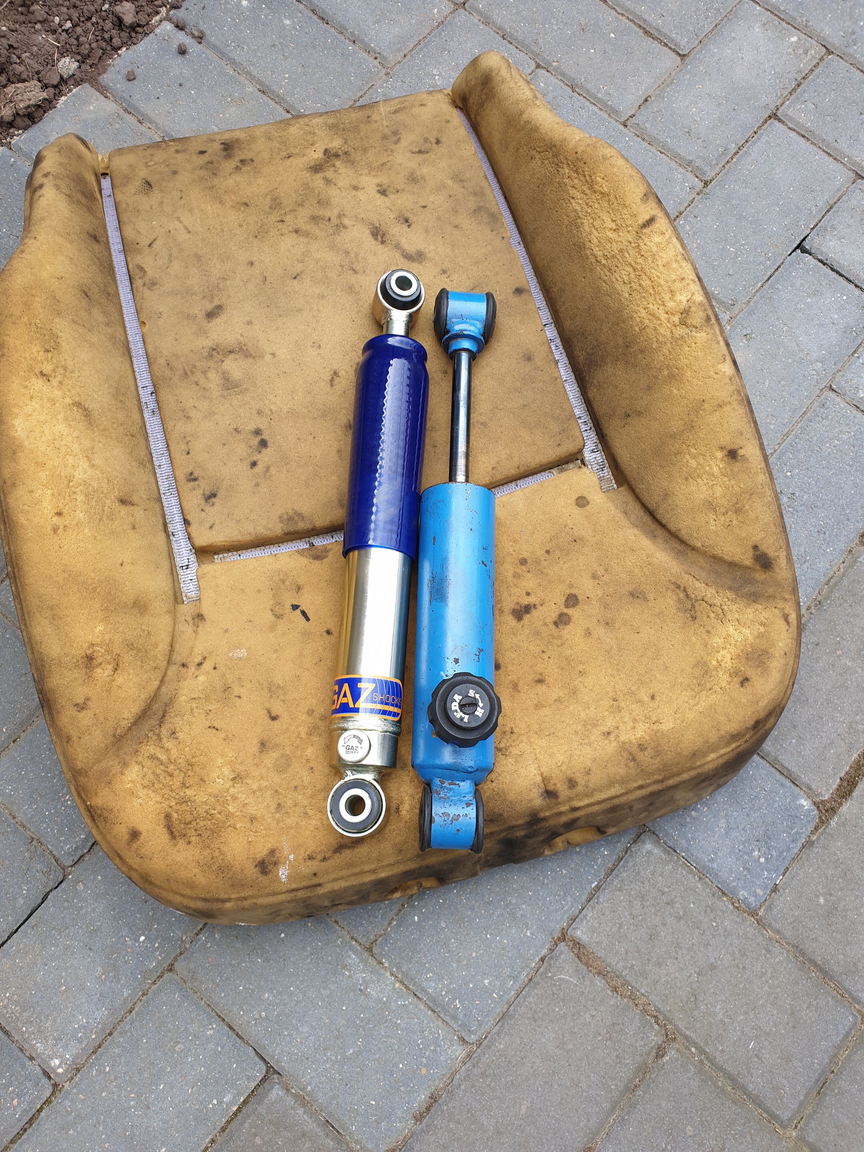

Jacked up and new gaz rear shocks fitted as i had robbed the previous set for the Kangoo
Gaz vs Leda rear shocks. I had intended fitting the Leda, but there is an issue with the shock body catching the beam as its larger diameter than the gaz/oem. Something to look at another day.
Jack up one side on the rear and it lifts 3 wheels off the floor. Its crazy how light/stiff it is.

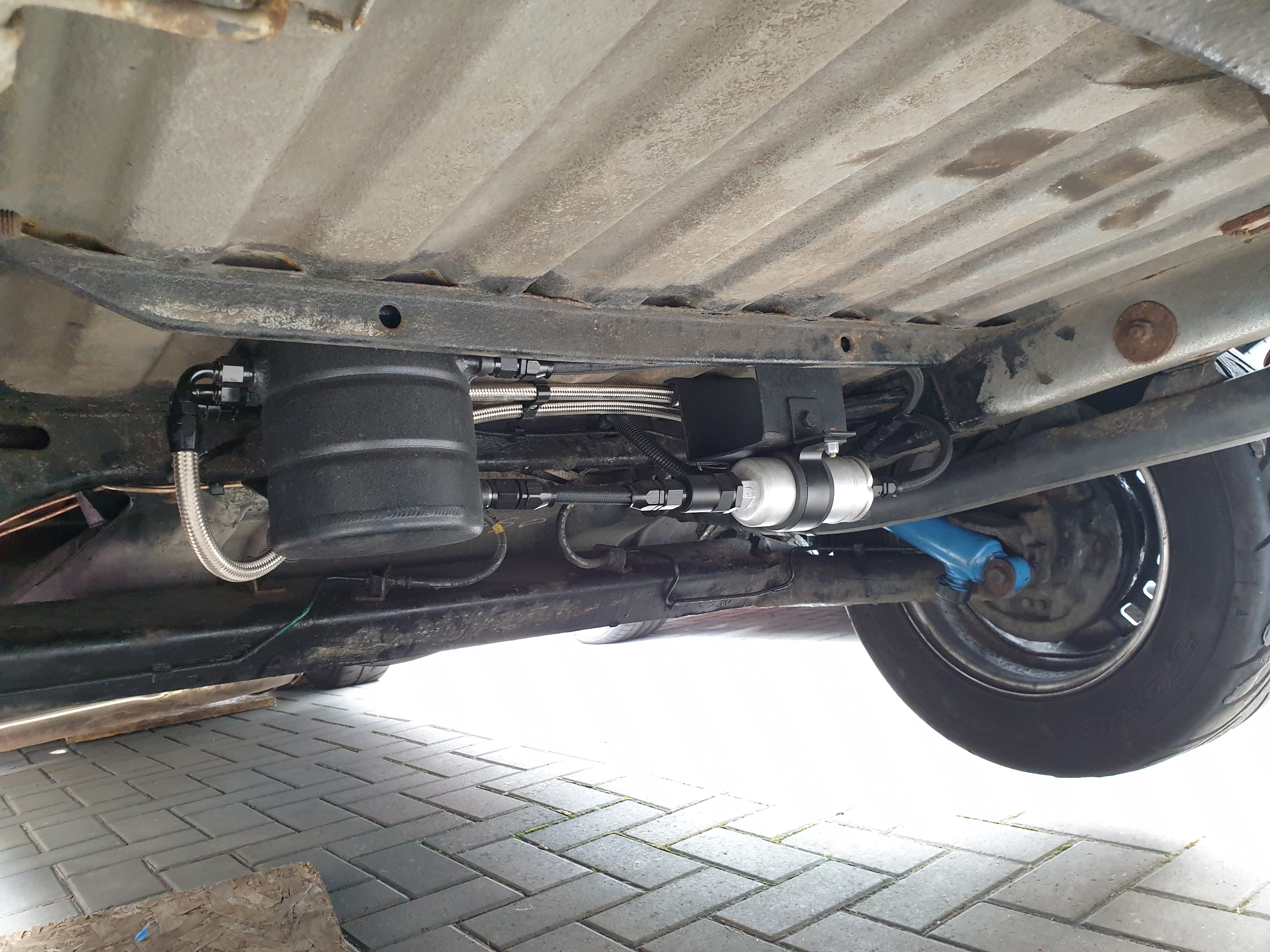

Fuel system on show.
I then moved to the front to find out what the issue was with the funny right hand turn in..basically i hit the rh apex at tower corner at Croft and the handling went a bit on the piss and i thought id damaged the outer cv.
Turns out i had blown the seals out of the avo coilover on the o/s and the shock shaft is moving all over the place and oil all over. Track rod end and inner tie rod had play, passenger shock was leaking.
Inner tie rods and outers replaced for trw. Cant argue still on the original van tie rods.

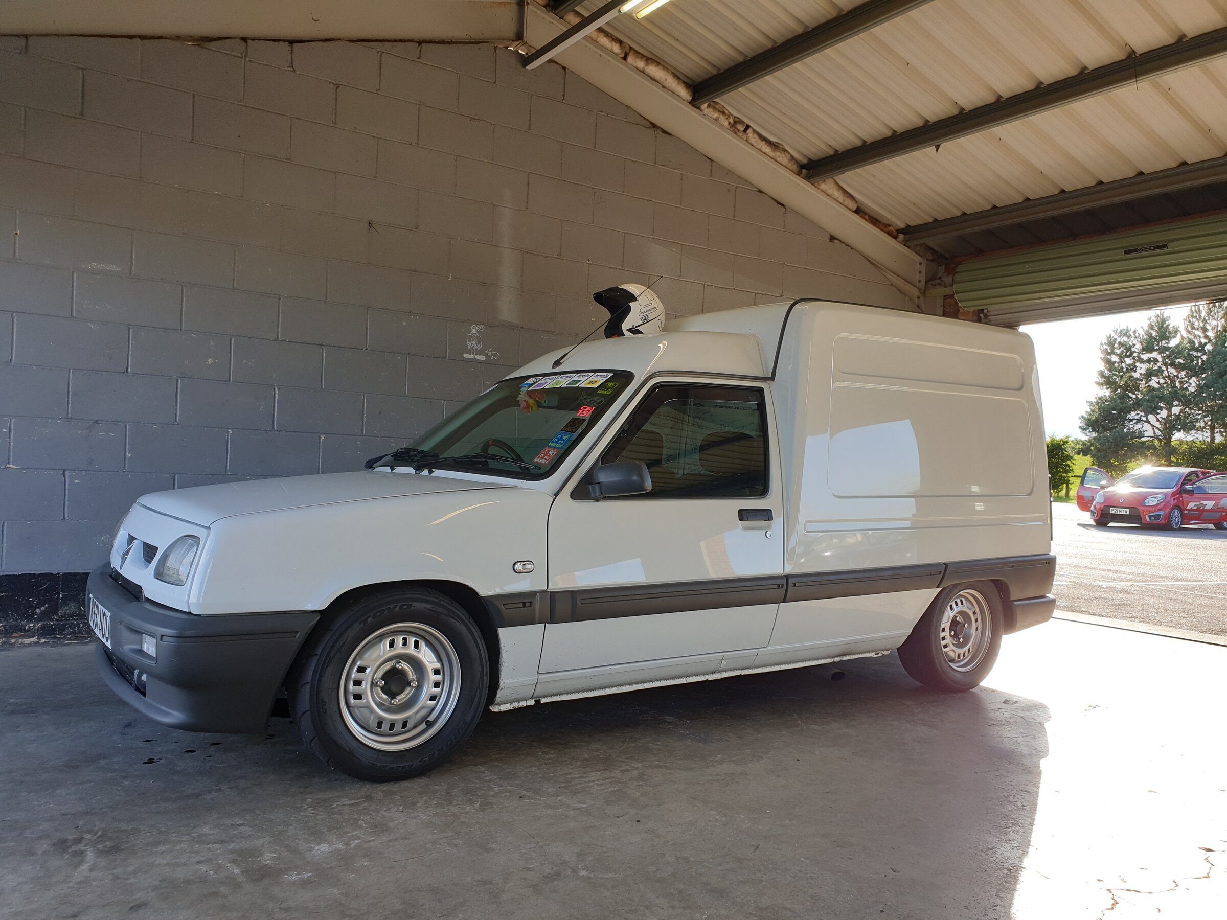

Santa pod and back done! No issues journey was pretty uneventful apart from the drone of the side exit exhaust/ 044 fuel pump whining away and showing up a golf gti who thought he was clever putting his foot down when i went to overtake 😆
Cleaned up before
Pissed down all morning at Santa Pod typically but was nice to have a run out.

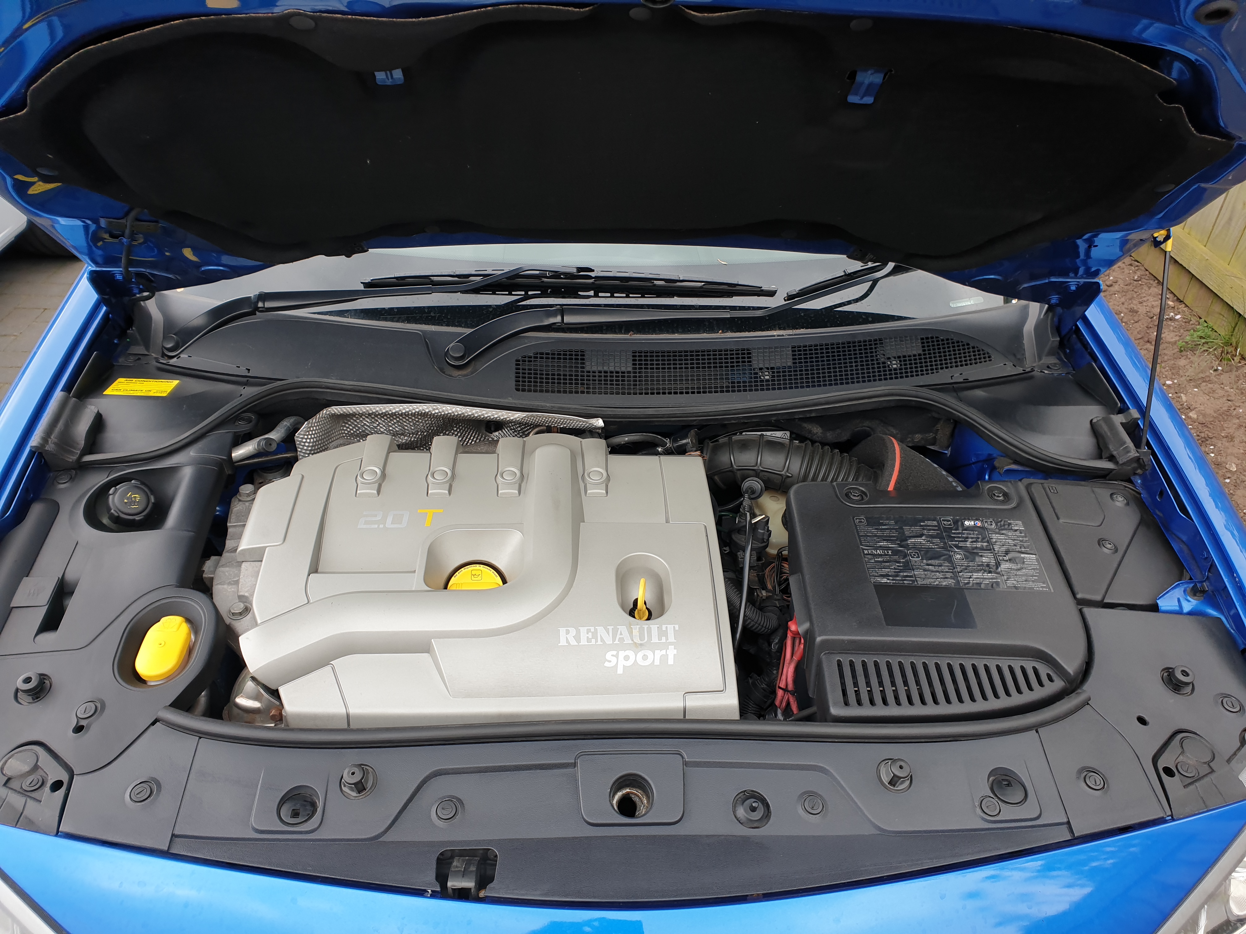

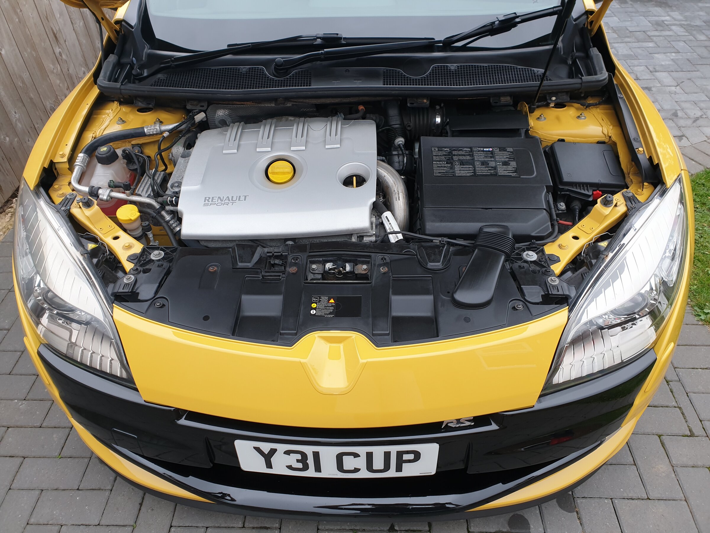

Serviced the megane, fresh 5/40 synthetic oil and changed the gear oil
Give the engine bay a wipe down, still nice and clean.
Current mileage of 70k, low for 18 years old.
Took it for a good blast out around the local b roads, the chassis is awesome feels so planted. Still one of my all time favourite hot hatches.

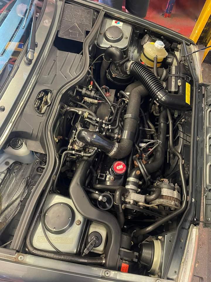

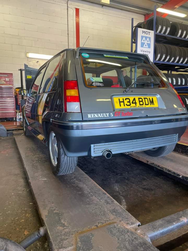

Finally pulled my finger out and got it mot'd. Cleaned up as was looking rather barn find covered in dust. Fresh fuel, primed oil system and it fired up easy enough. Mot'd and 10 mile test run, no issues to report, cruised along with the old tape player on and happy hardcore tape packs playing to relive my youth!!
Still very clean underneath, garage has kept it right.
Grp n silencer replacement pipe for all the bangs and turbo whistle with no silencers.
Extra van updates
Winter layup lasted a bit longer than anticipated due to the Trophy eating into all my spare time. Had tons of plans for mods to this but basically got nothing done. It needs nothing apart from a simple service, and oil is still super clean so not urgent.

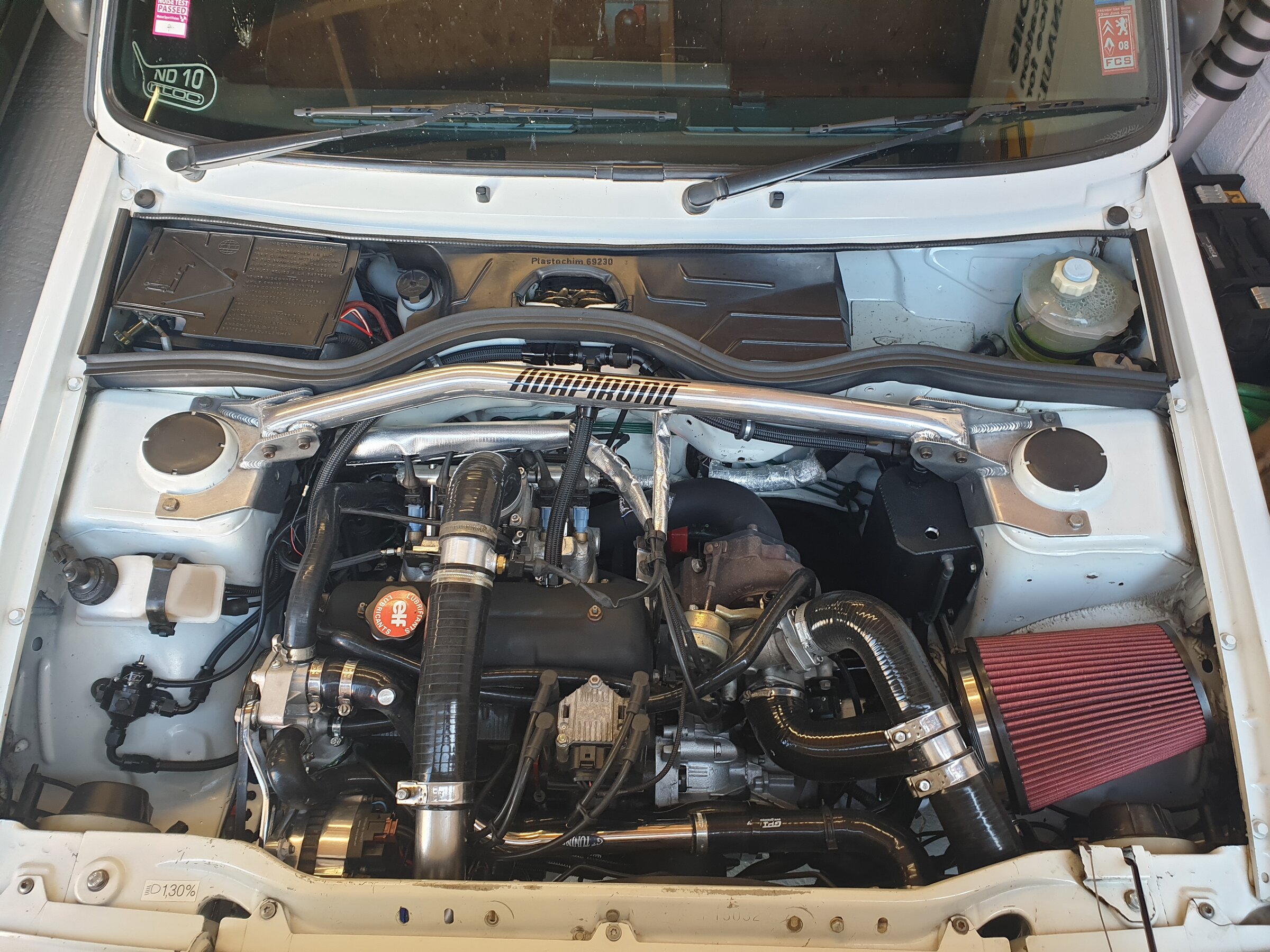

Primed up oil and fuel system, topped up with fresh fuel and it fired first crank, fuel injection ftw! Mot'd and took it for a quick ten mile blast. The noise, hot turbo and oil/exhaust fumes is pure oldskool. Hooks up great with the quaife atb and leda suspension. No refinement whatsoever with paddle clutch, soild engine mounts, pms shifter rattle, drone off the side exit exhaust and toyo r888r whine. Love it!! Different animal compared to the gtt.
Got a couple of small mods to do soon then take it to RRG if all goes well.

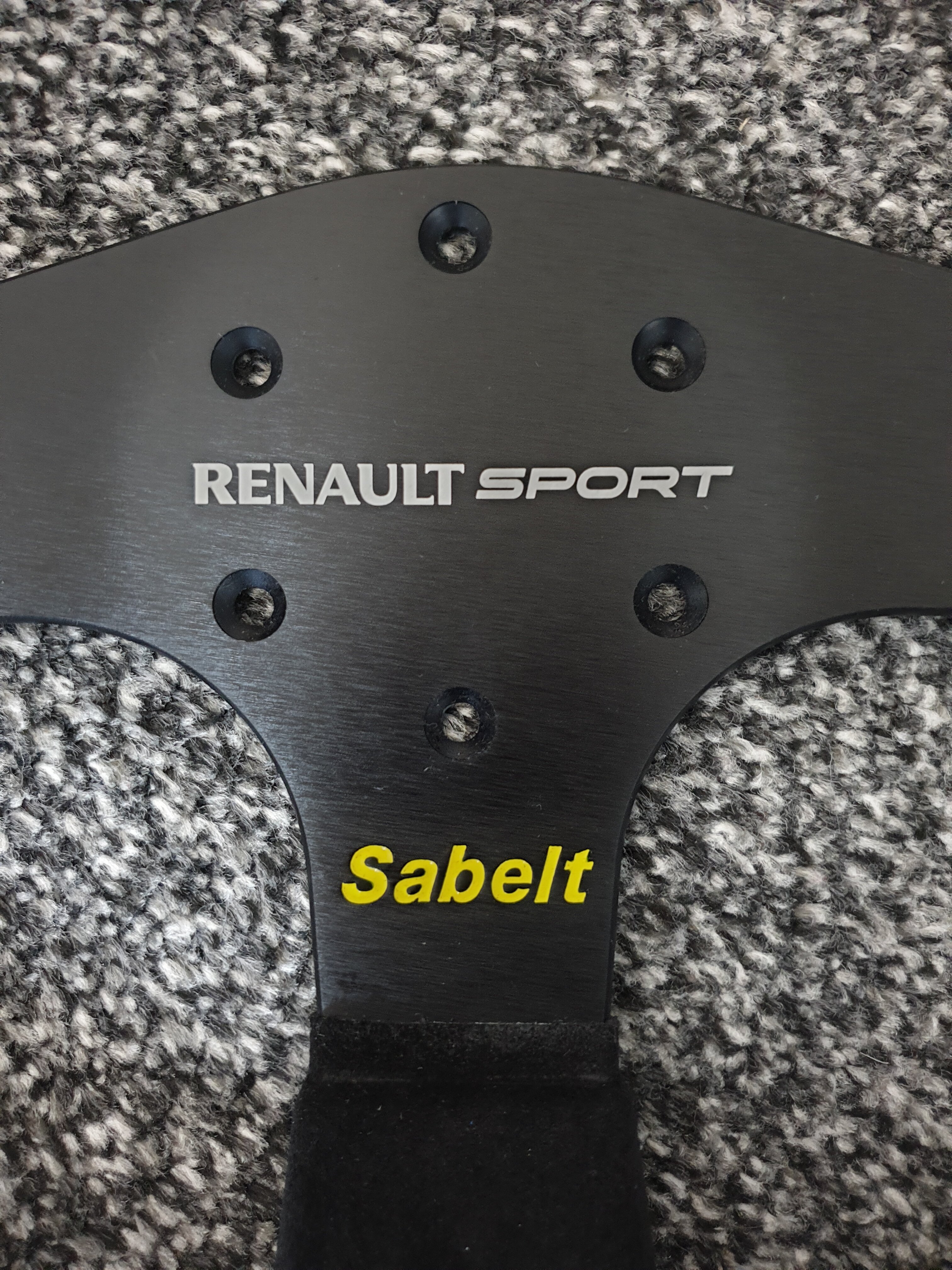

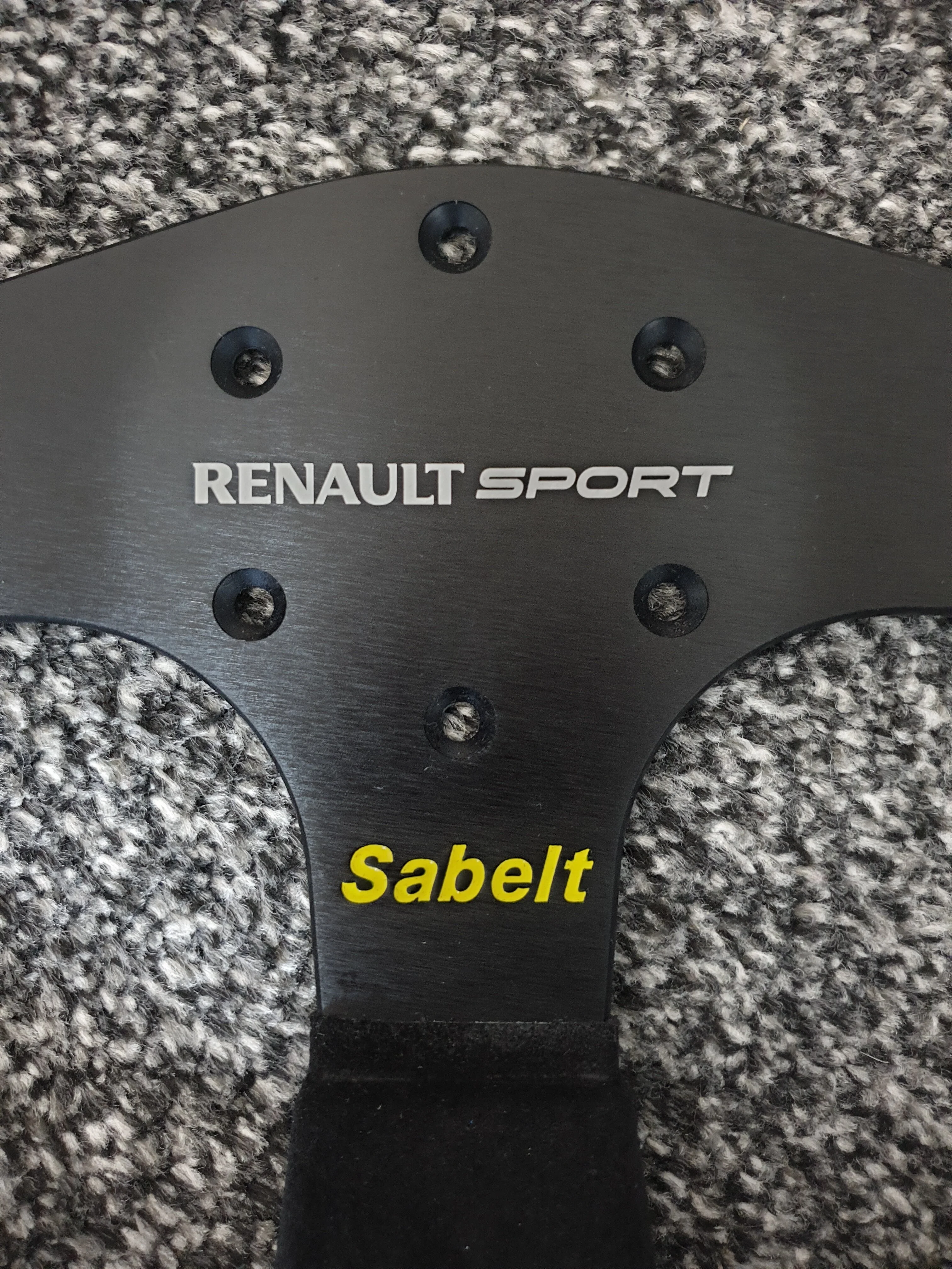

Bought a genuine RenaultSport Sabelt X85 clio cup racer steering wheel from R.S performance official store recently. Original type, engraved Renaultsport lettering not the later stickered up type. Wanted one of these for years but thought id missed the boat as hard to find in the uk, but seem to be easy to get overseas.
Boss arrived yesterday so fitted it to the Extra van. Loving the look with the stack dash.
Also bought a cover and omp suede cart gloves to keep it nice.
Took it for a quick drive and the grip on the wheel with the gloves on is epic and it feels a bit more go kart with the smaller wheel on. Loving it!!
