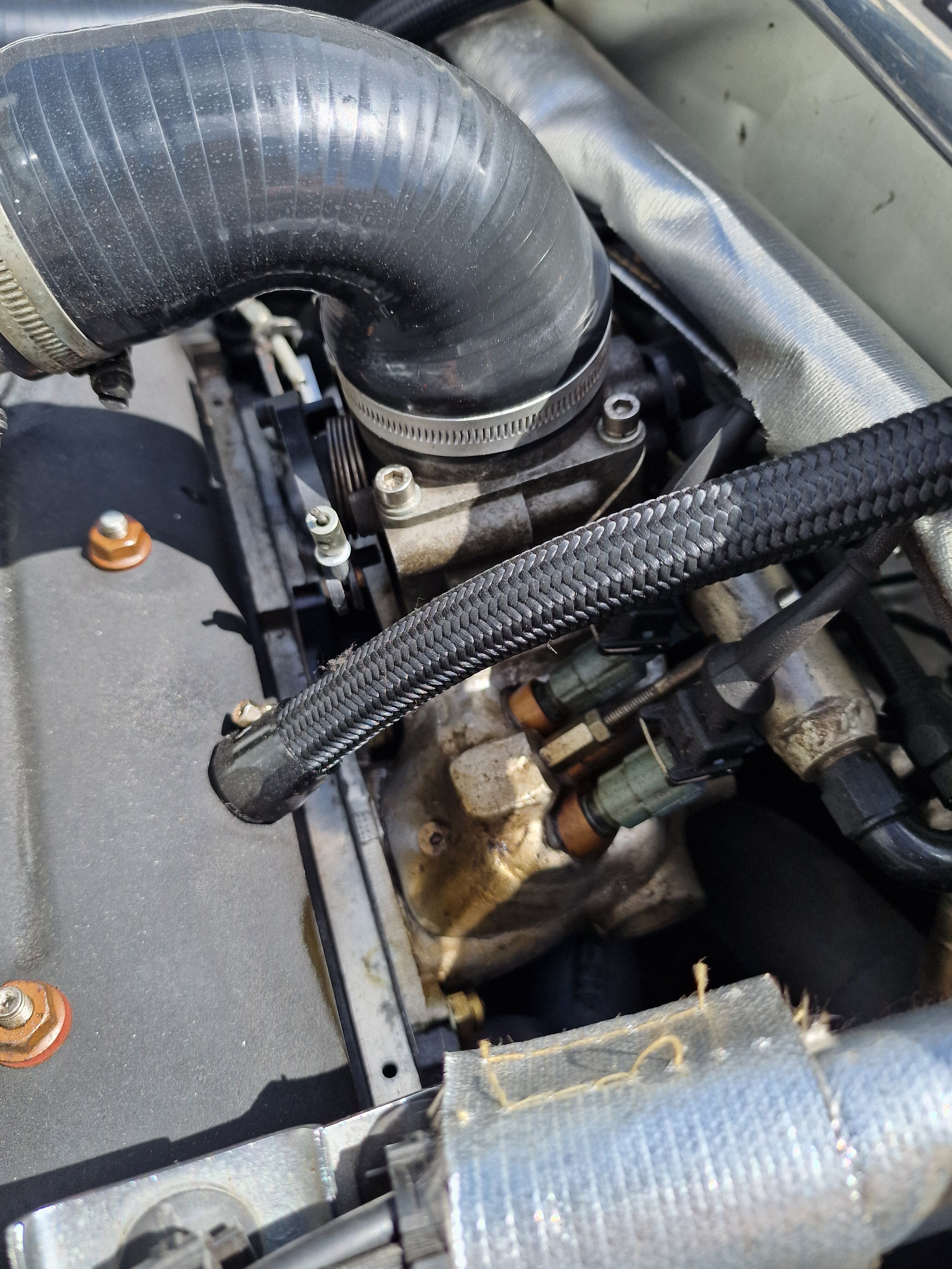

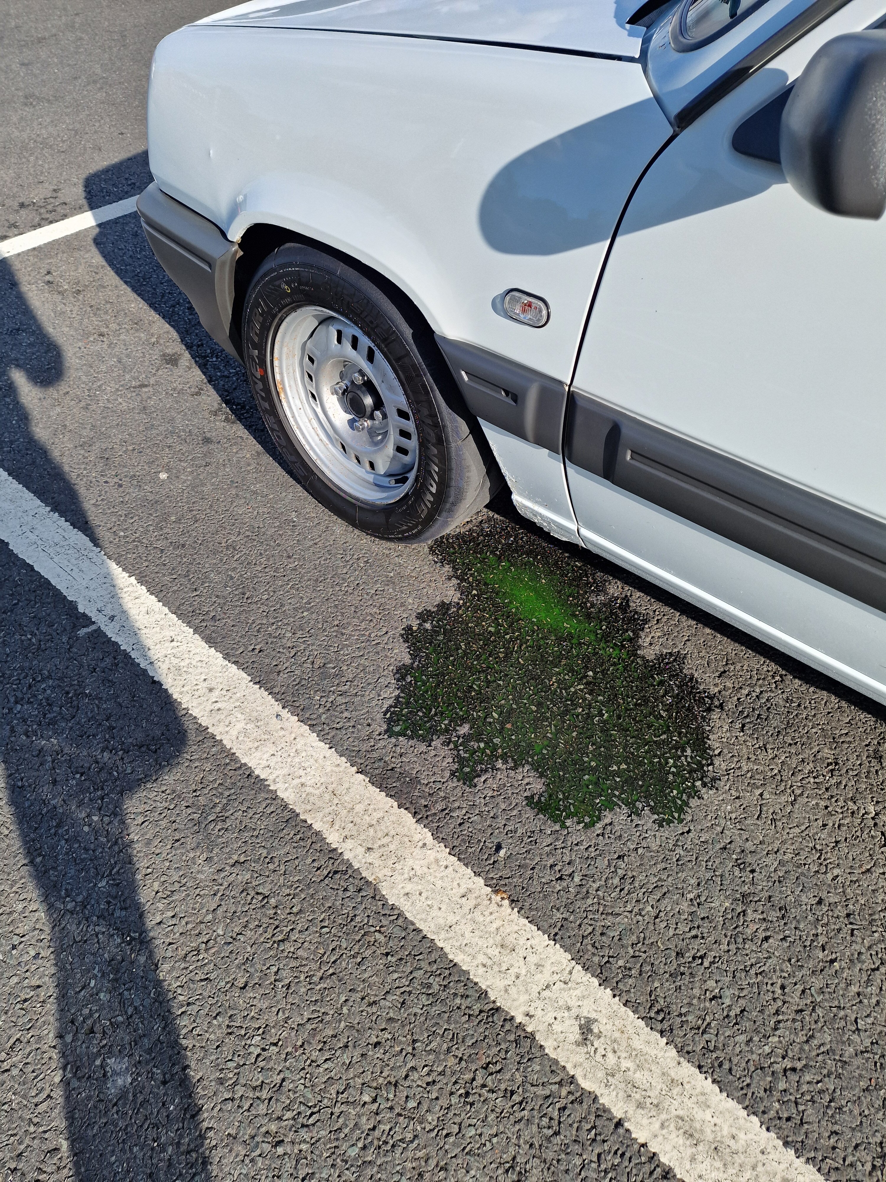

Mrs points out that its pissing out coolant.
Luckily this was an easy fix. Basically when id topped up coolant pre journey the seal on the header tank cap had decided to not seal and fold itself inside the cap. As the engine runs really cool on normal driving it didnt cause an issue but system was not holding pressure and it caused the coolant to raise/come out with the lack of seal when engine is switched off hot and coolant not circulating.
Ive had this issue before and have bought a few new caps including oem and they have all been shite quality, some not sealing from new. I had a spare cap with me in the flight box in the back and swapped seal over. New seal fixes the issue and header tank is sealed. Coolant was still on the max too as it was hot, looked like loads but hardly any lost, just needed a small top up the next day when cooled down.

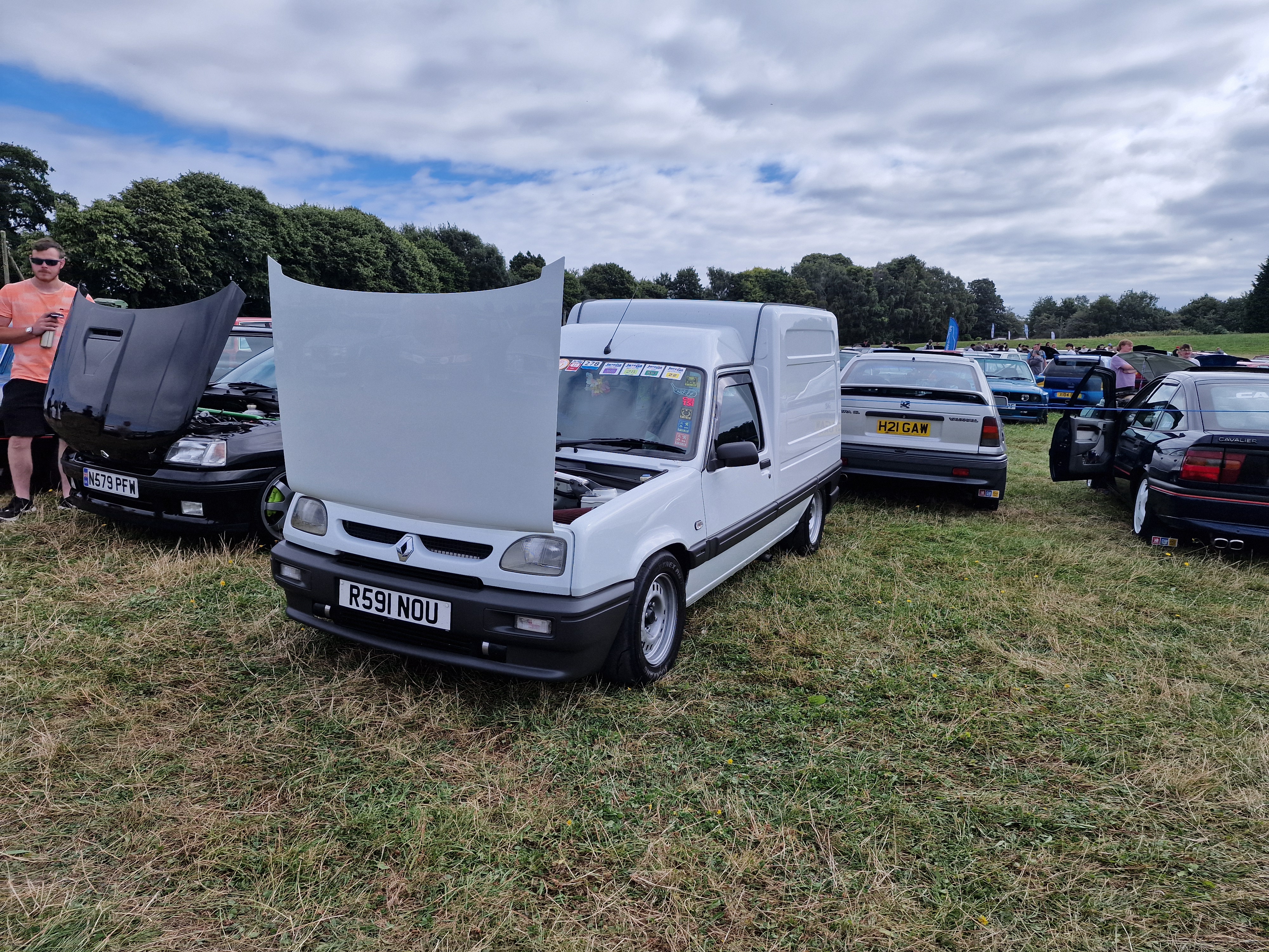

Surrounded by retro motors.
On the TurboRenault stand.

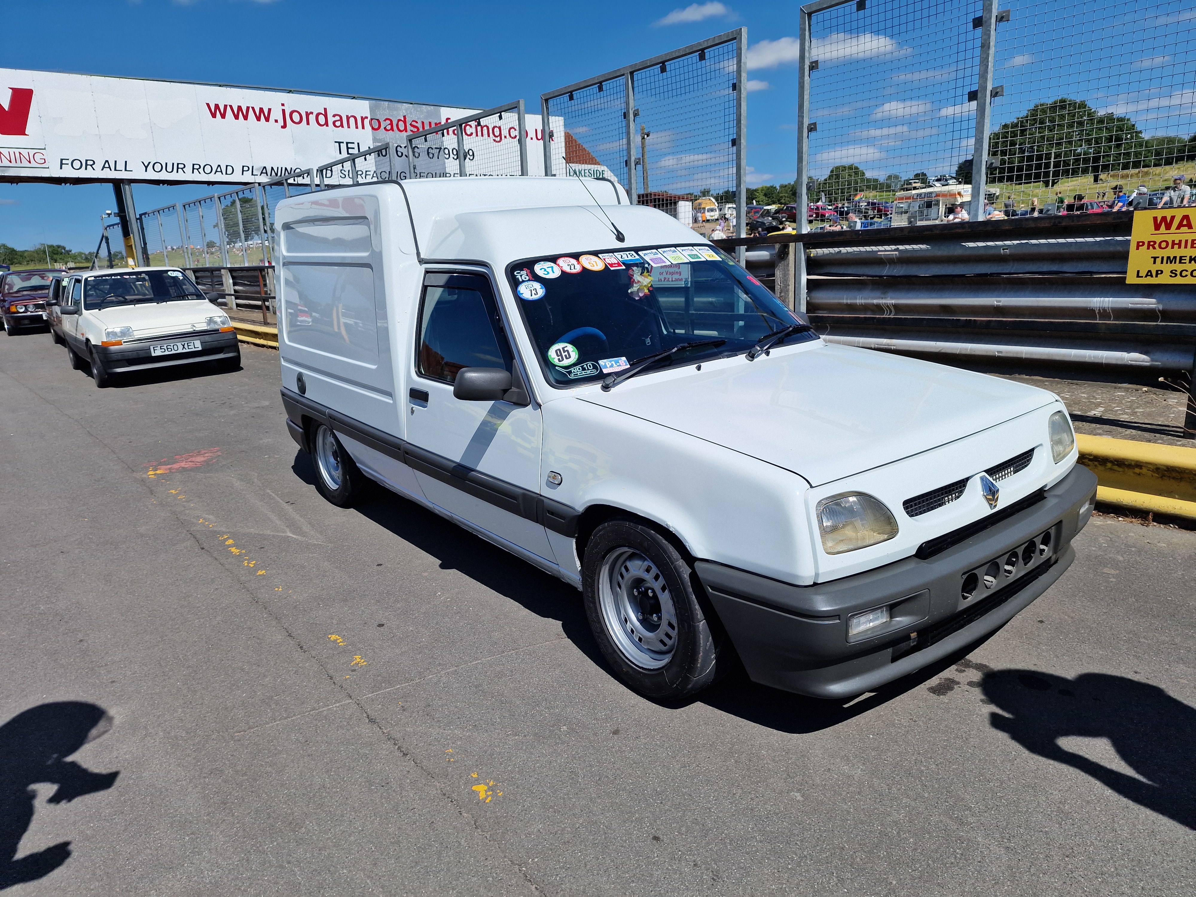

Afternoon comes and get over for the sprint. Its absolutely scorchio 25-28degrees so take numberplate off for max airflow as it will need all of it.

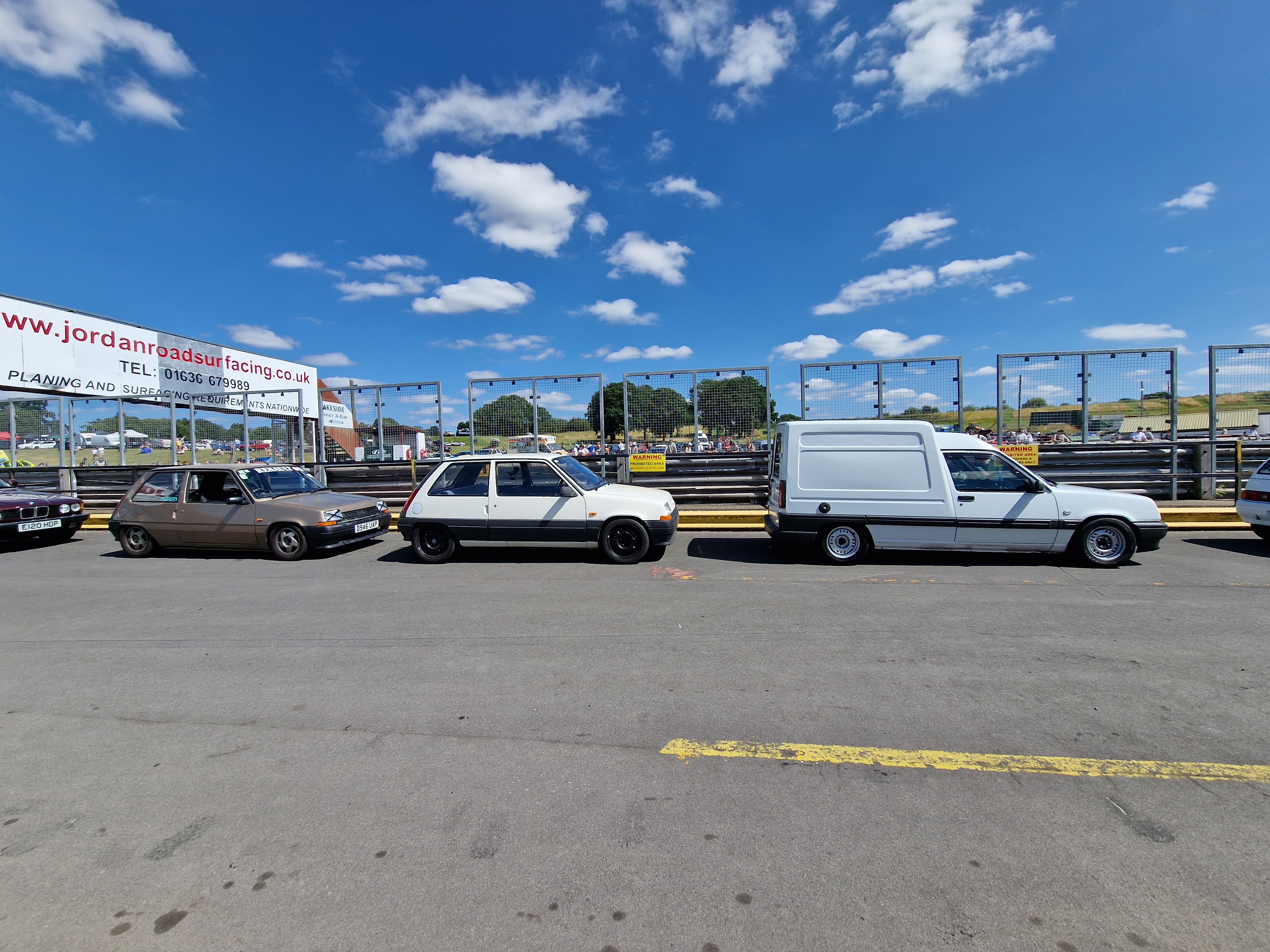

Queing up in the pitlane with @Renny 5
Mega banter with @Renny 5 as usual and we have managed to group up for the sprint runs. Mine c1j, Marks 5 172 powered with throttle bodies, lad behind (forget his name apologies!) Has a f7p engine on carbs from memory.
Anyway its usual comments of full send as its a sprint run so no tyre and brake warmup just get on it. My tyres still have a s**t load of pickup from Anglesey so not the best but full send it is!
Im first out in our group and straight out round gerrards from the pits.
Trying to warm up tyres on the job its fat out on exit of Gerrards late braking into Edwinas. Turn into Edwinas which is a sharp left and absolutely sideways on cold rear tyres which was not expected but manage to get it back fast without spinning.

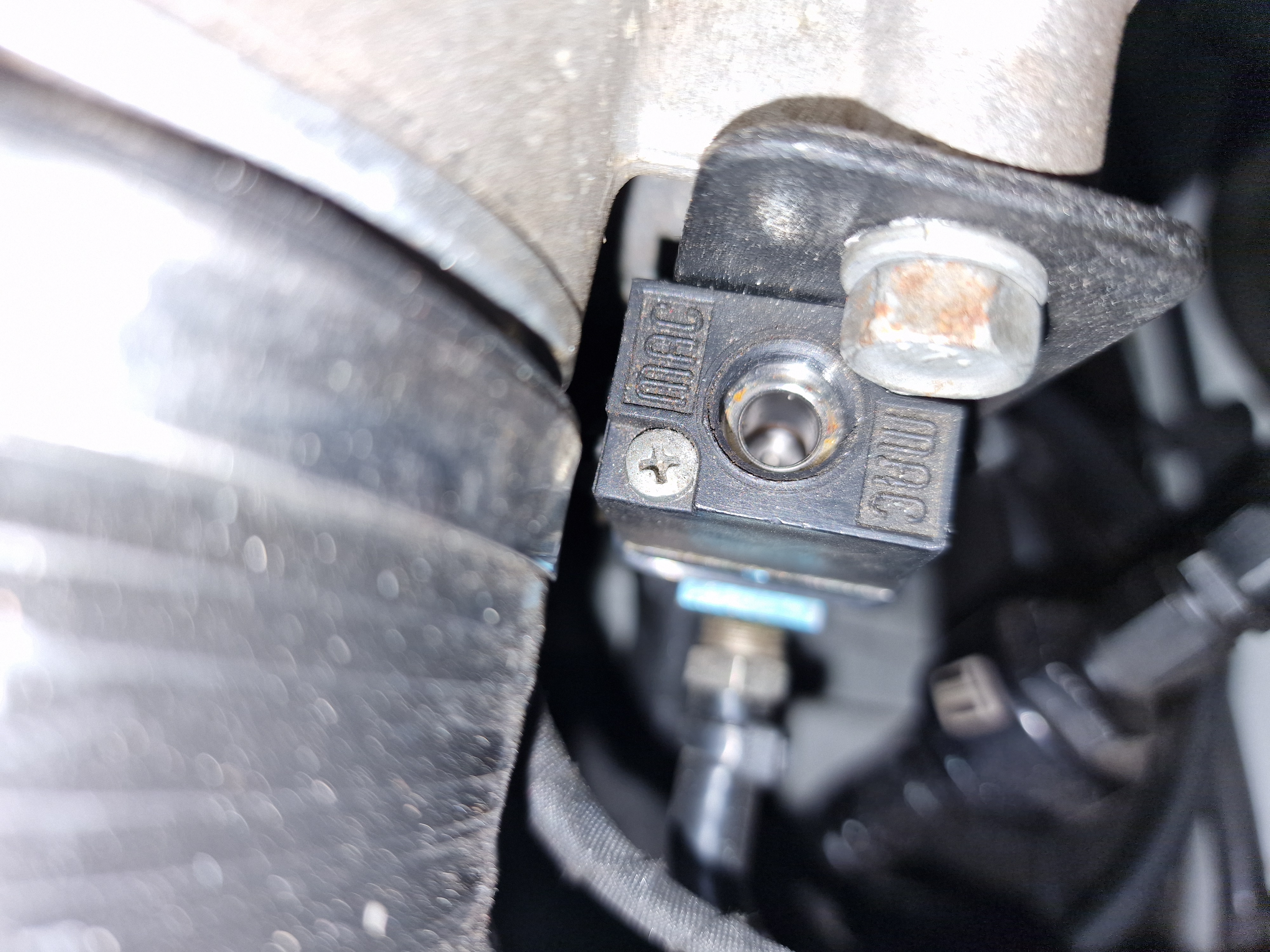

Complete the lap and fast as poss round Gerrards as tyres seem to be on grip wise. Flat out on the exit of gerrards in 3rd gear, the engine is feeling super lively and i hear a massive bang out of the exhaust. I assume ive hit the hard cut rev limiter although rpm seemed lower than usual, bang it into 4th gear and it just feels a bit flat. Look at boost gauge just before devils elbow and boost pressure is right down to wastegate 12psi and fluctuating all over the place and my high boost switch is doing nothing its low boost or low boost.
Flat out exiting Gerrards and shot gun bang.

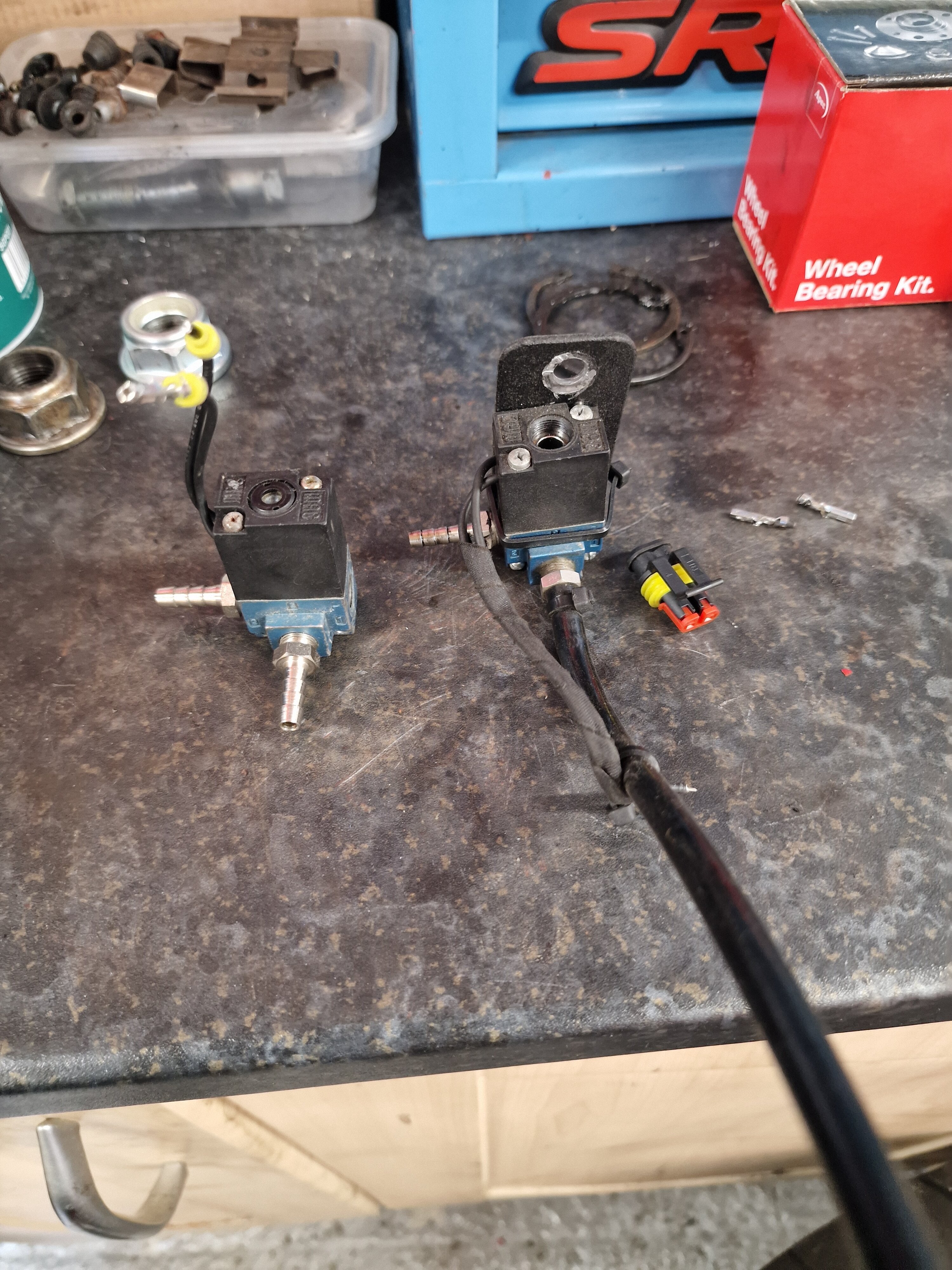

As its a sprint the 2nd lap is up and i get it back into the pits. Open bonnet, its about ten thousand degrees under there but i notice the Mac valve for boost control has self destructed and the centre is gone!
I assume the bang exiting gerrards was actually boost cut and it was bleeding off more boost than it should have been, but luckily the engine is mapped for 27psi and boost cut is 300kpa (29ish psi) so nothing was hurt.

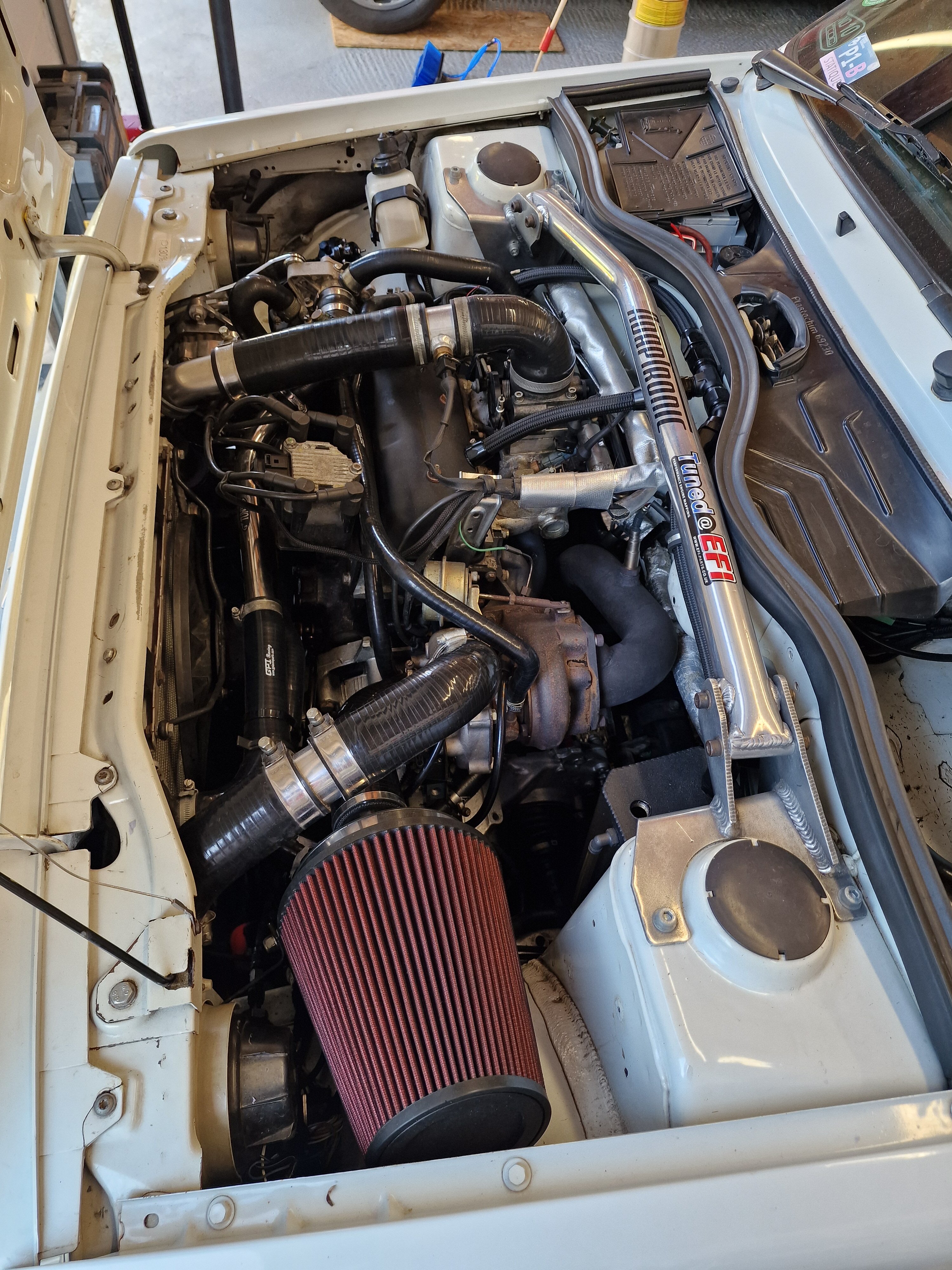

A few days after Mallory i dug my spare mac valve out to fit. Was originally on the trophy briefly..test it and works OK so wire it up.
New one on the left.

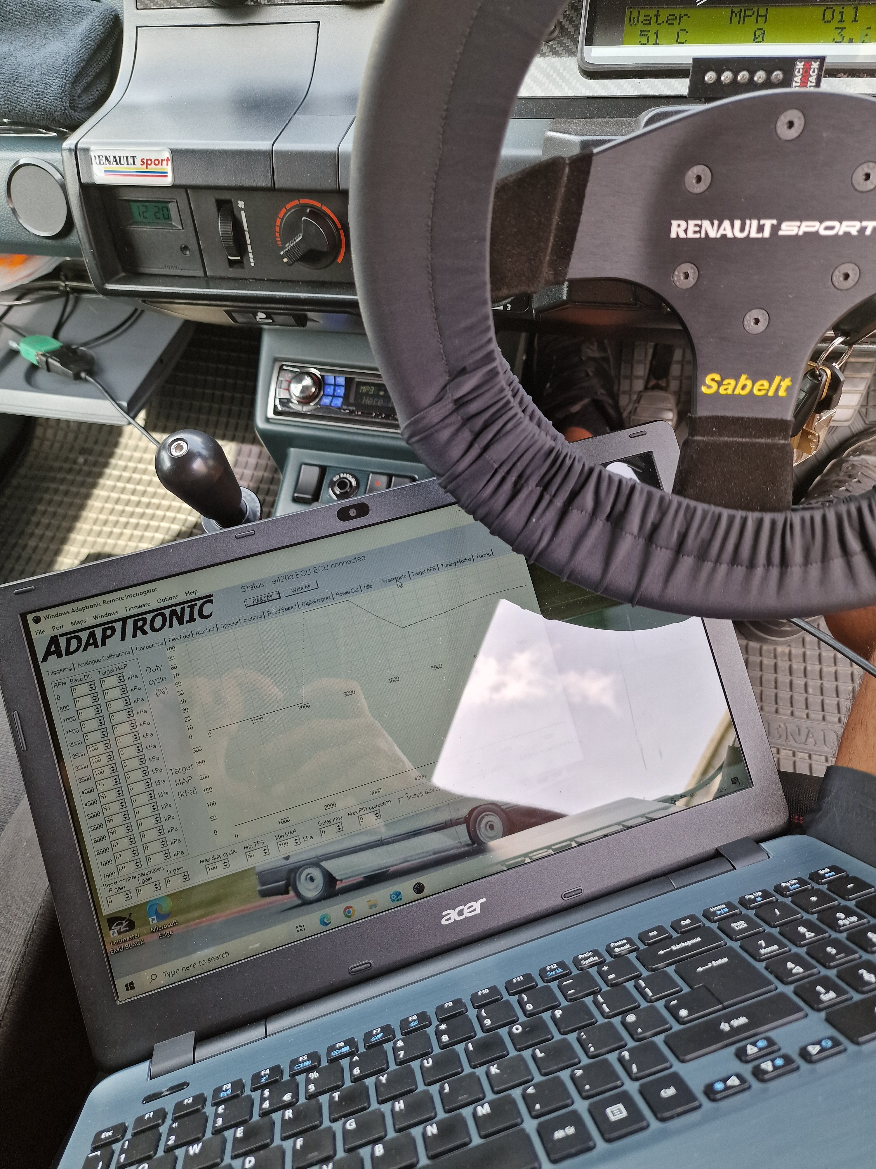

Fitted and static test that its working ok. Hook up laptop in prep for some datalogging in the future.
Wari software.
Quick test on the street and wastegate pressure is back to solid 12psi and a quick tickle of high boost it goes straight up to 21/22psi in the mid range. Need to take it out on an evening and do some datalogging in 4th gear and tweak if necessary.

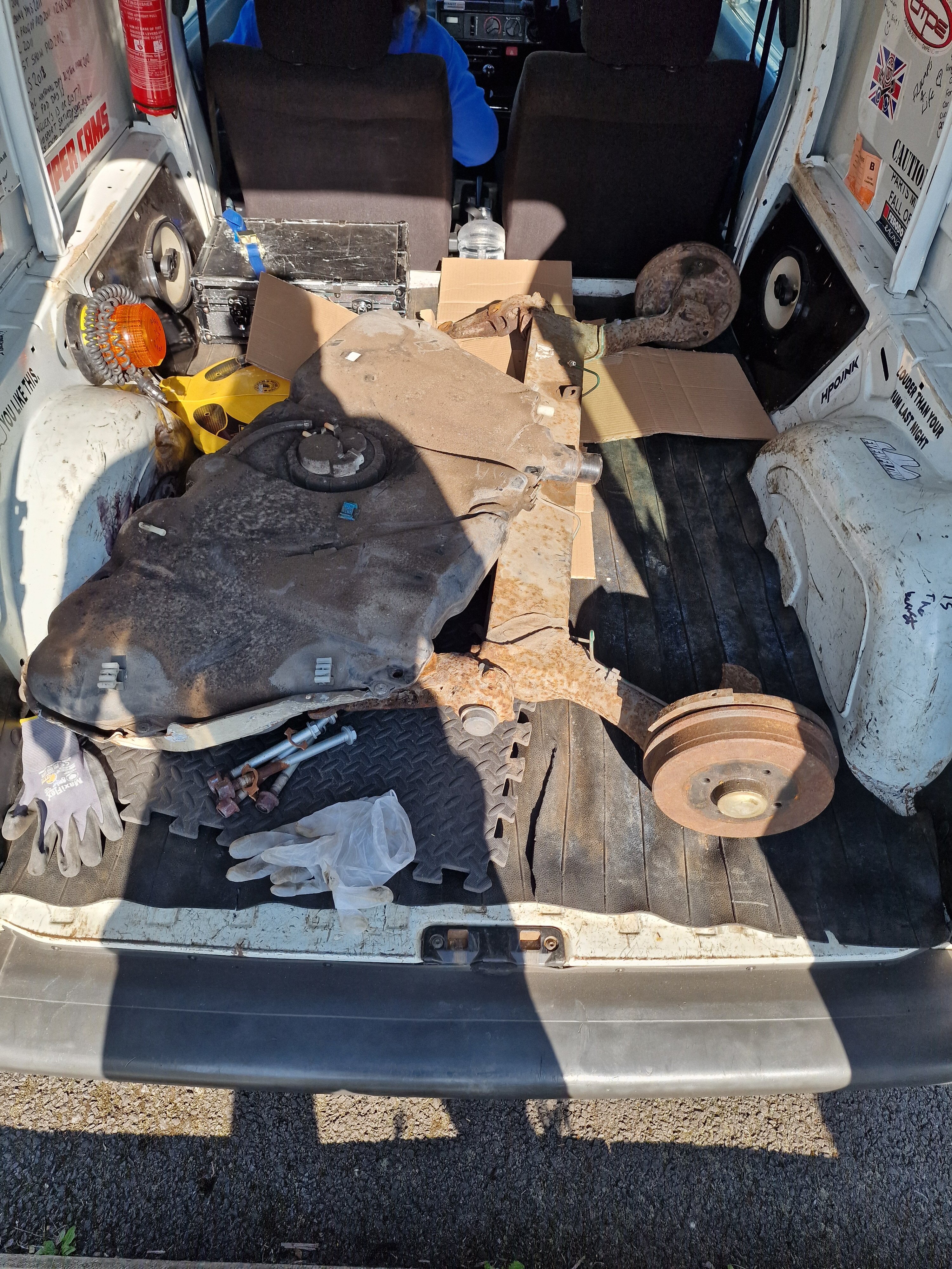

Had a job for it today. I had located a spare rear beam off a breaker Extra van and needed to collect it, and it aint fitting in my blue clio or kangoo compact so this was the vehicle for the job.
Short trip to Doncaster.
Used as an actual van!
The extra van beams are quite hard to come by now as they are about extinct. Plan is to refurb the rear beam and upgrade the bushes to a bearing kit thats available and can fit it straight on. The current rear beam bushes on the van itself are well worn and sloppy due to age/mileage and well overdue replacement.
Im going to see if i can sniff out either a whiteline rear arb for clio 1 williams/16v or something similar and fab up brackets to suit.

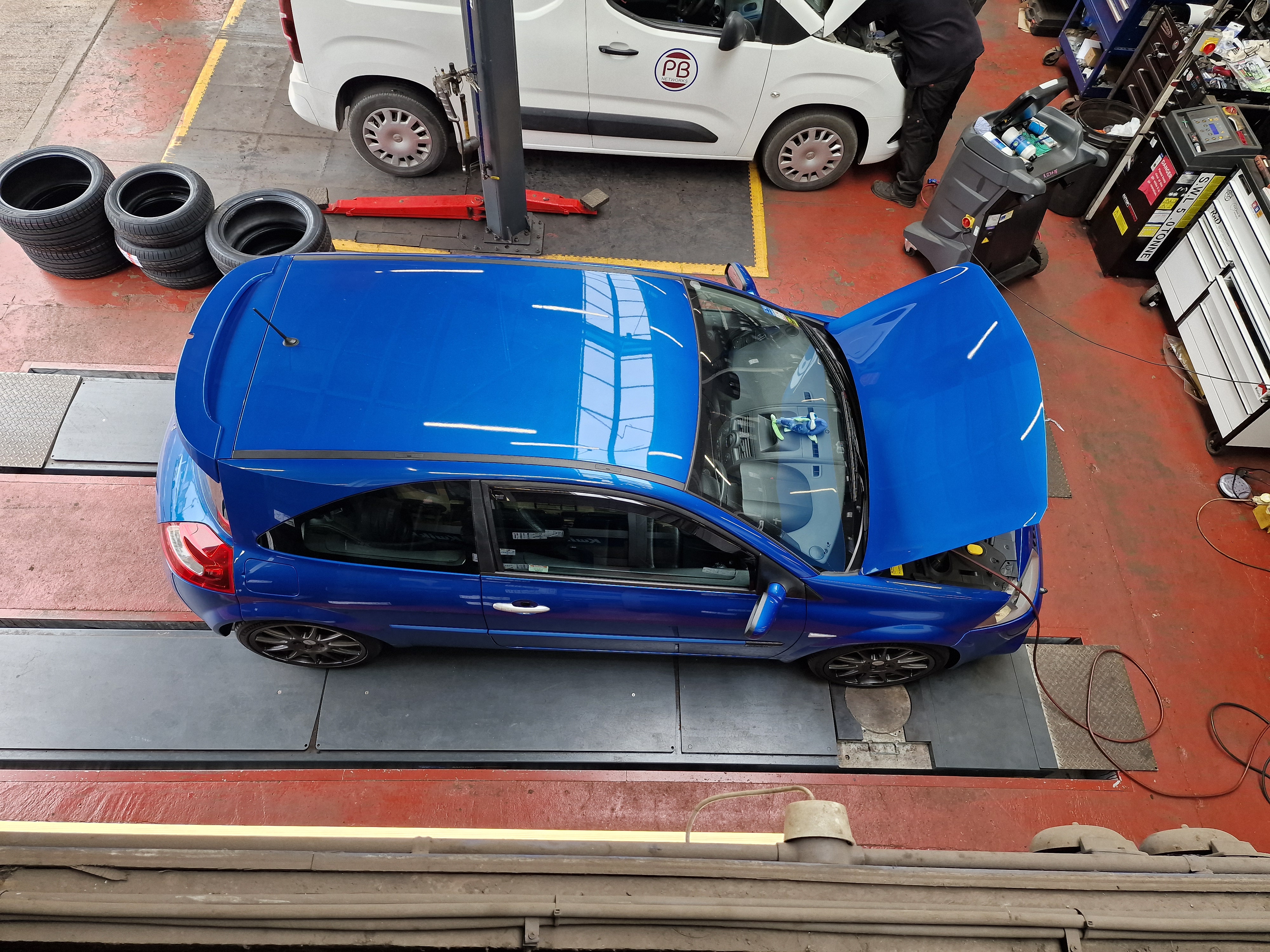

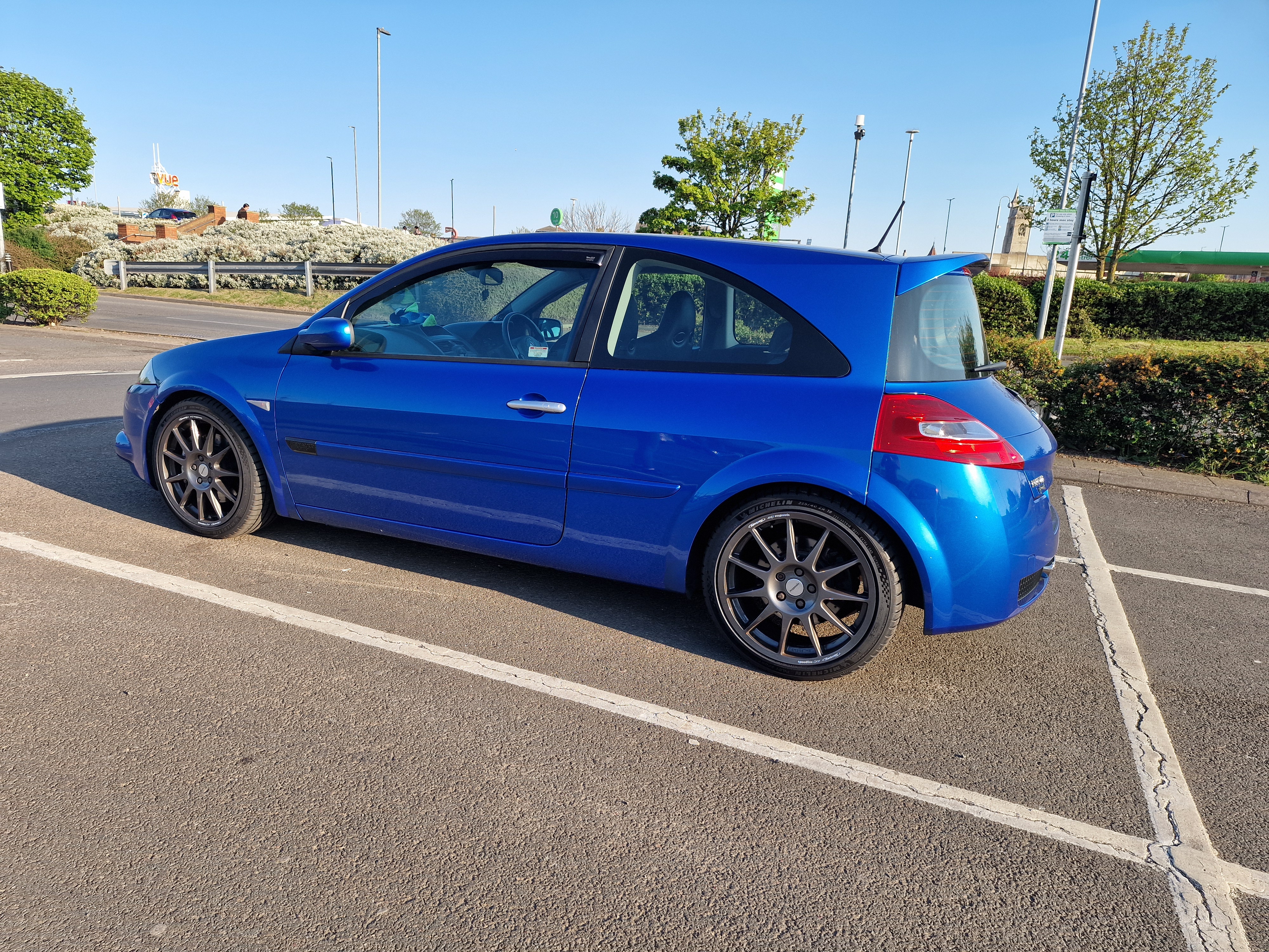

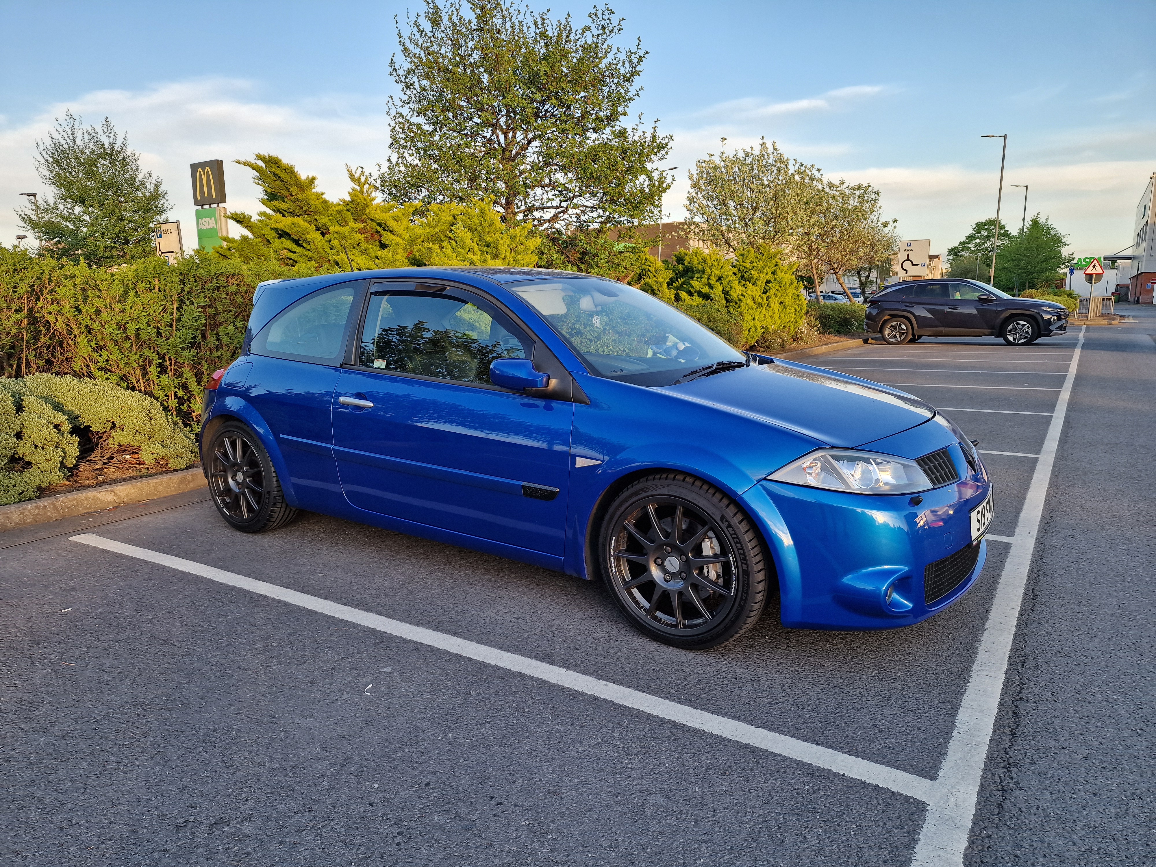

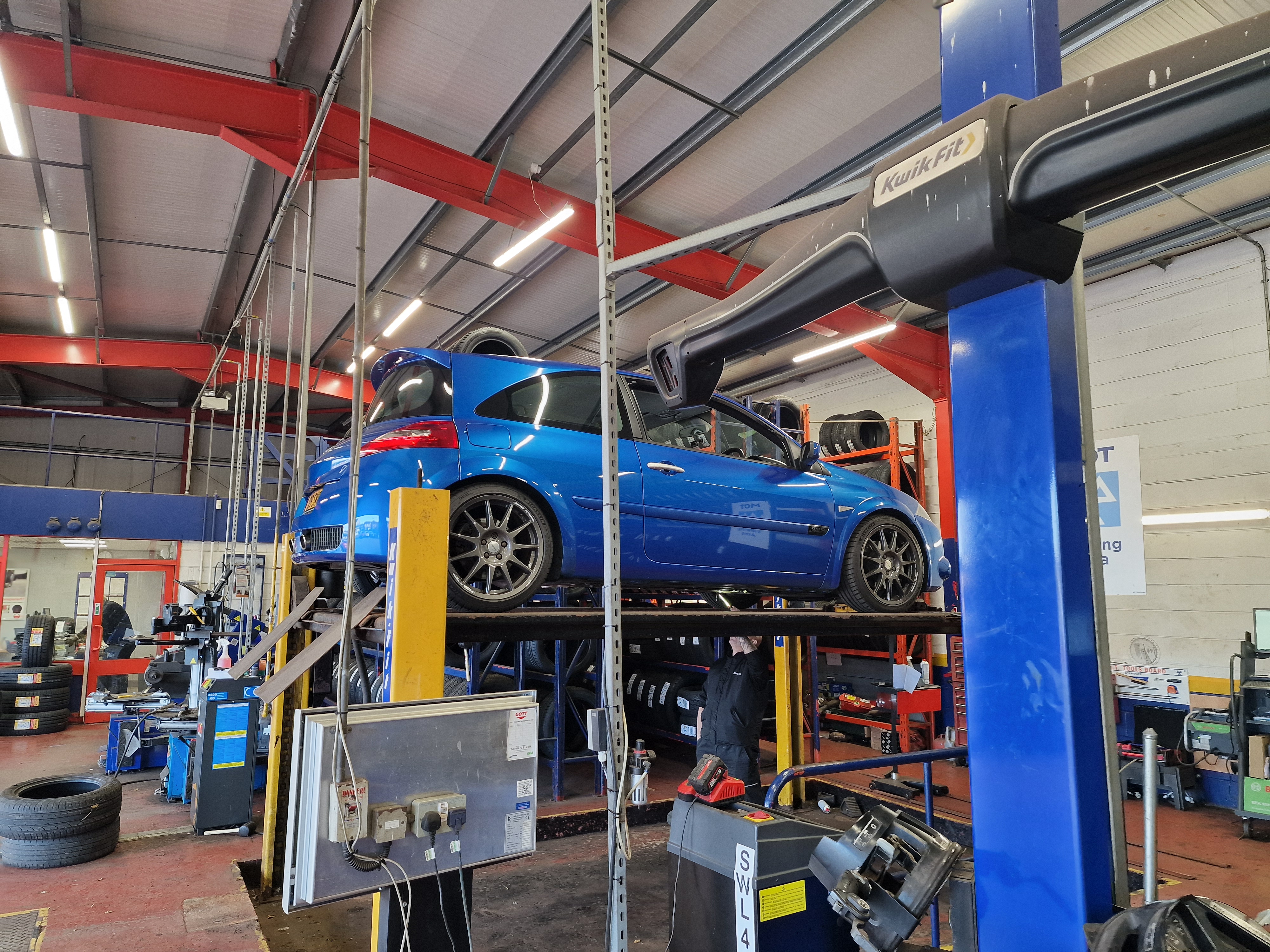

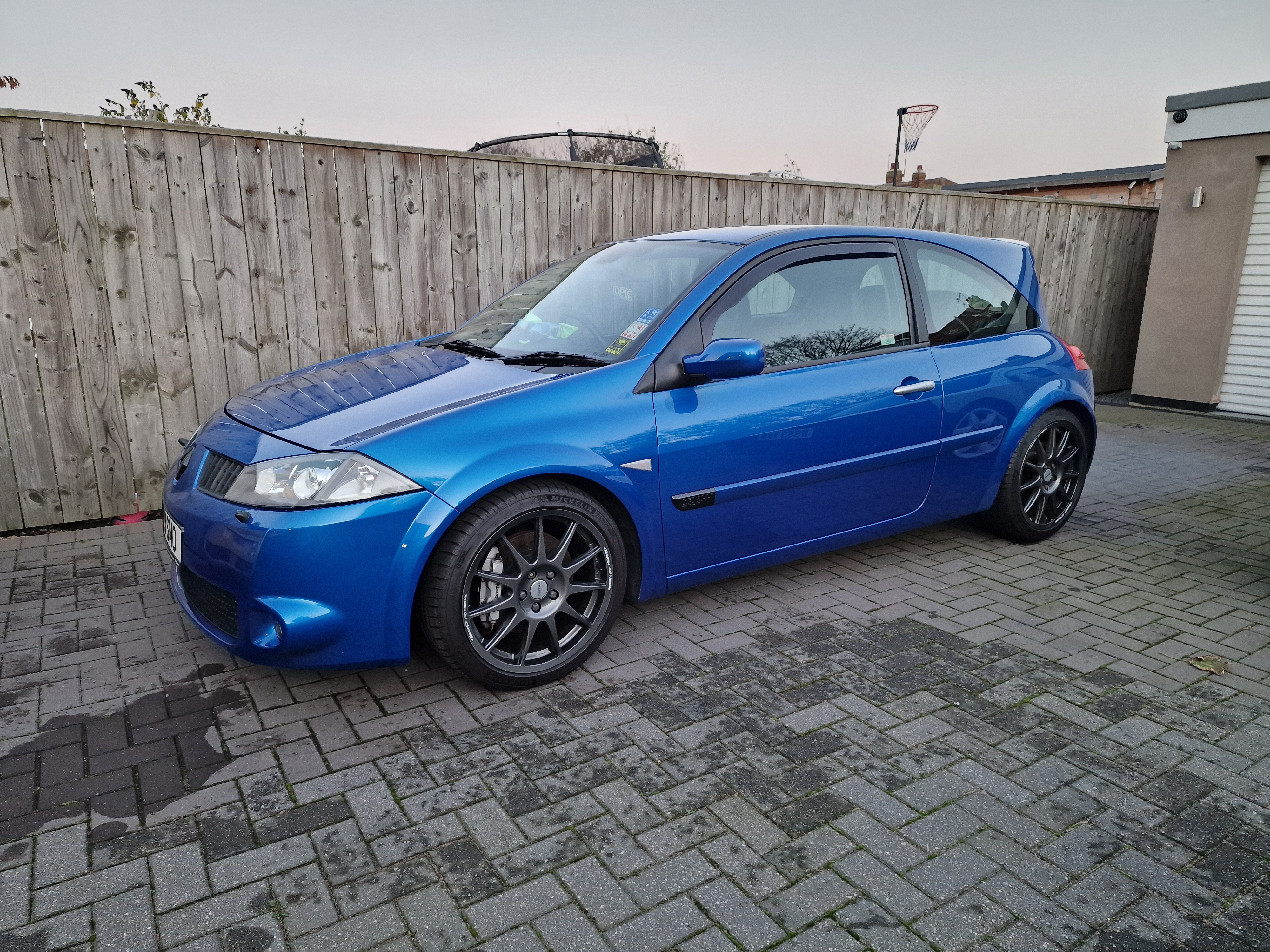

Blue 225 mot had expired and its not moved this year. Its been shuffled in and out the garage a couple of times thats about it.

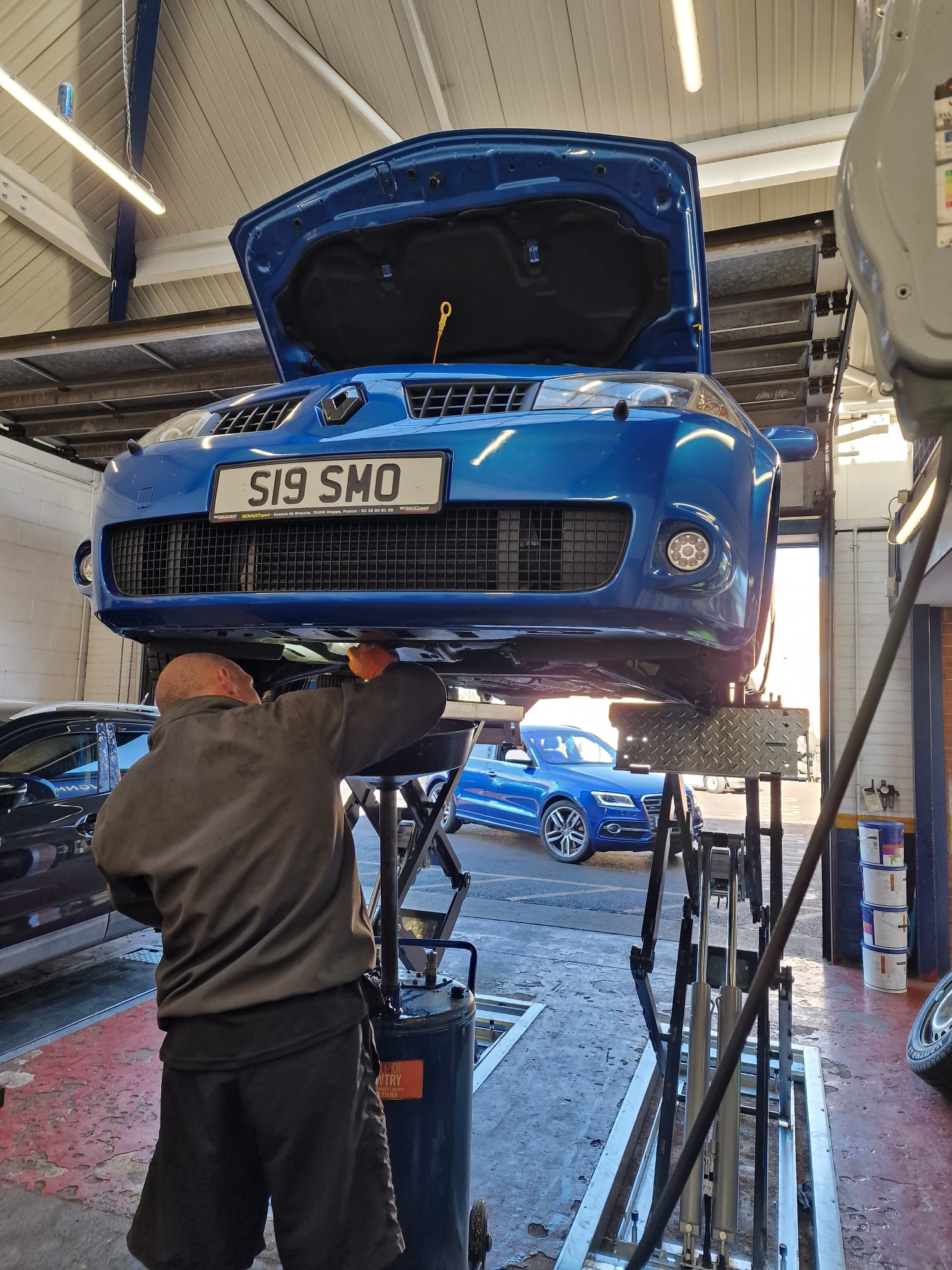

Booked it in for mot so got it out over the weekend for a clean and a quick run round the block. Its been on trickle charge so battery is good, checked fluids and it fired up pretty much instantly on 12+ month old fuel and sounded great as usual. Didnt take much effort to get the dust off and was clean in 20 mins.
Clean.
Rare pic of both megs together.
Quick run round the block and all seemed fine. Kept it off boost due to old fuel.

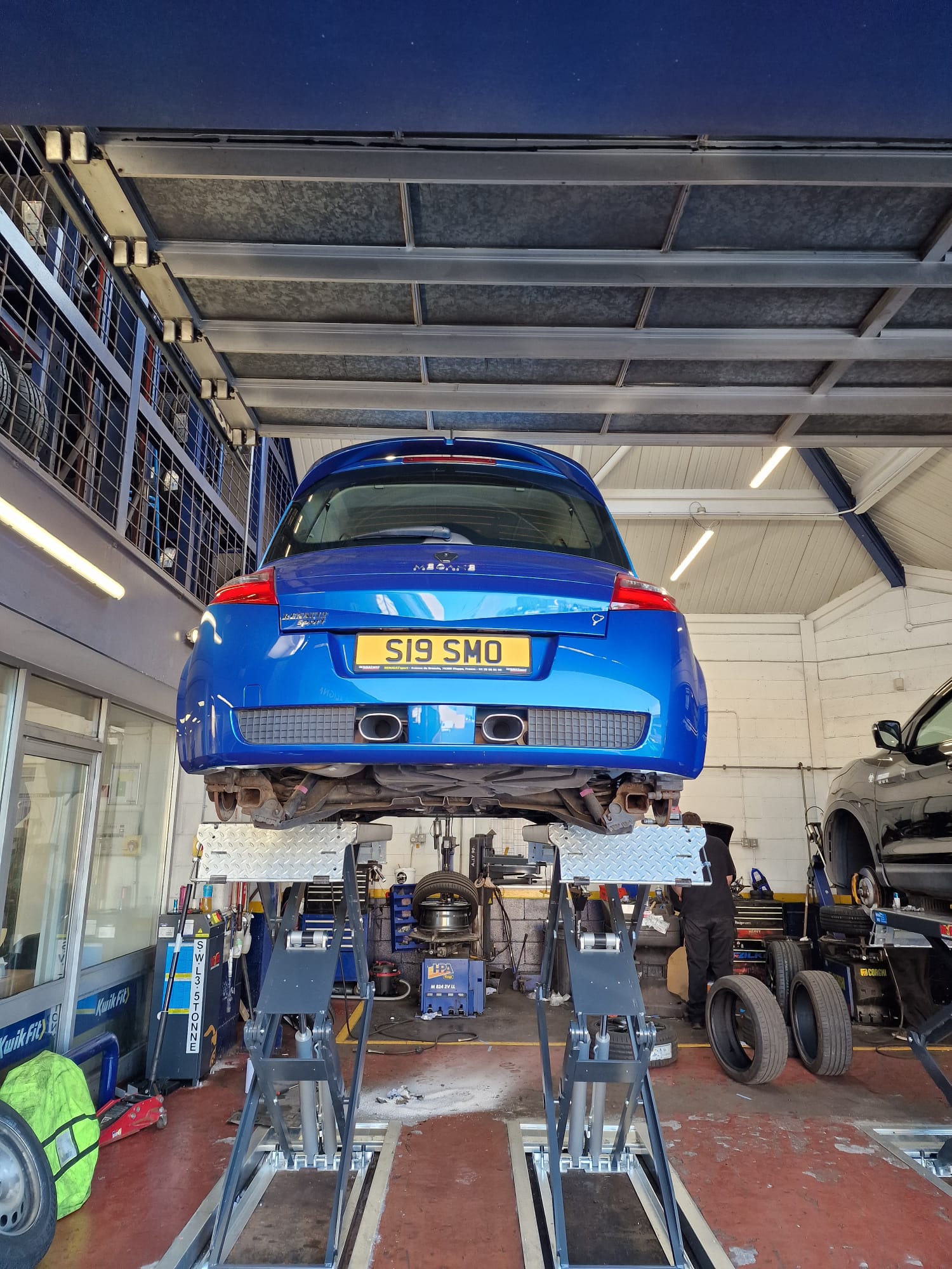

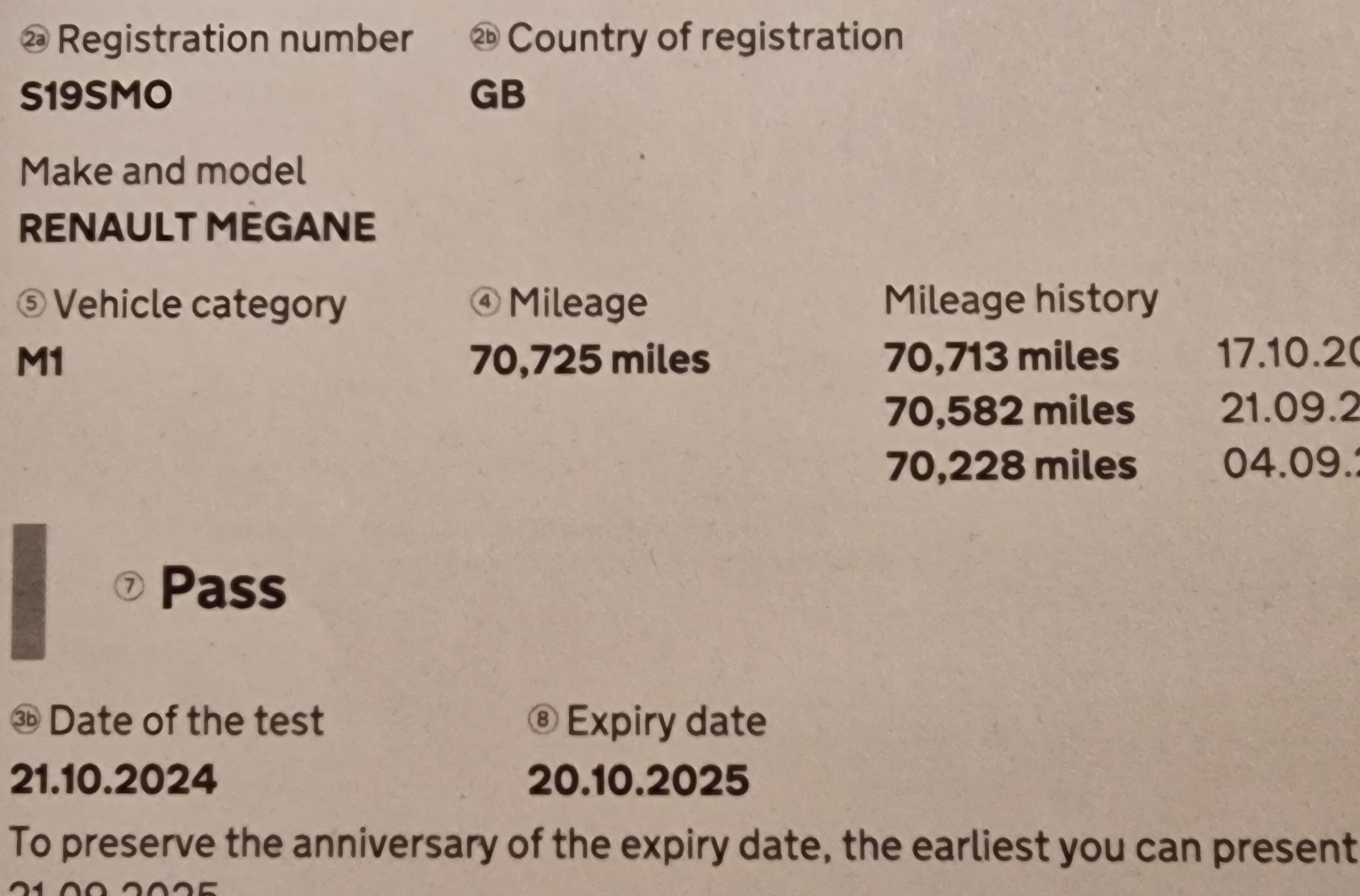

Took it for mot today and passed. A whole 12 miles since its last mot!
Nothing changed since last mot.
It was showing 1/4 of a tank on gauge, so stuck another ten ltrs of fresh fuel in for return trip of 4 miles. Took it the long way back home and as soon as i give it a bit of throttle/0.5 bar of boost it instantly misfired its tits off and i backed straight out of it.
Its never done this before so its either stale as f**k fuel, or fuel pump has decided not happy and pressure is down a bit. Pump was changed 5 years ago and has not done many miles but never say never i guess.
Its had the 630cc siemens deka injectors in for at least ten years so ill prob get them cleaned, new pump in again, rest of the service bits and maybe a run on the dyno in the new year to make sure all is good.
Until then back in the garage and on trickle again.
