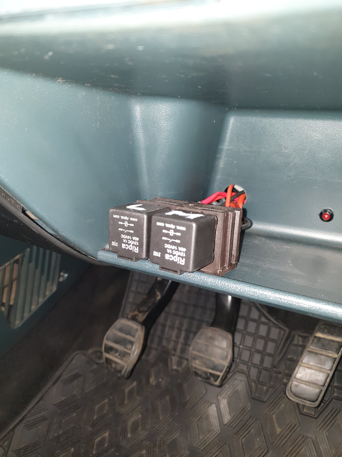

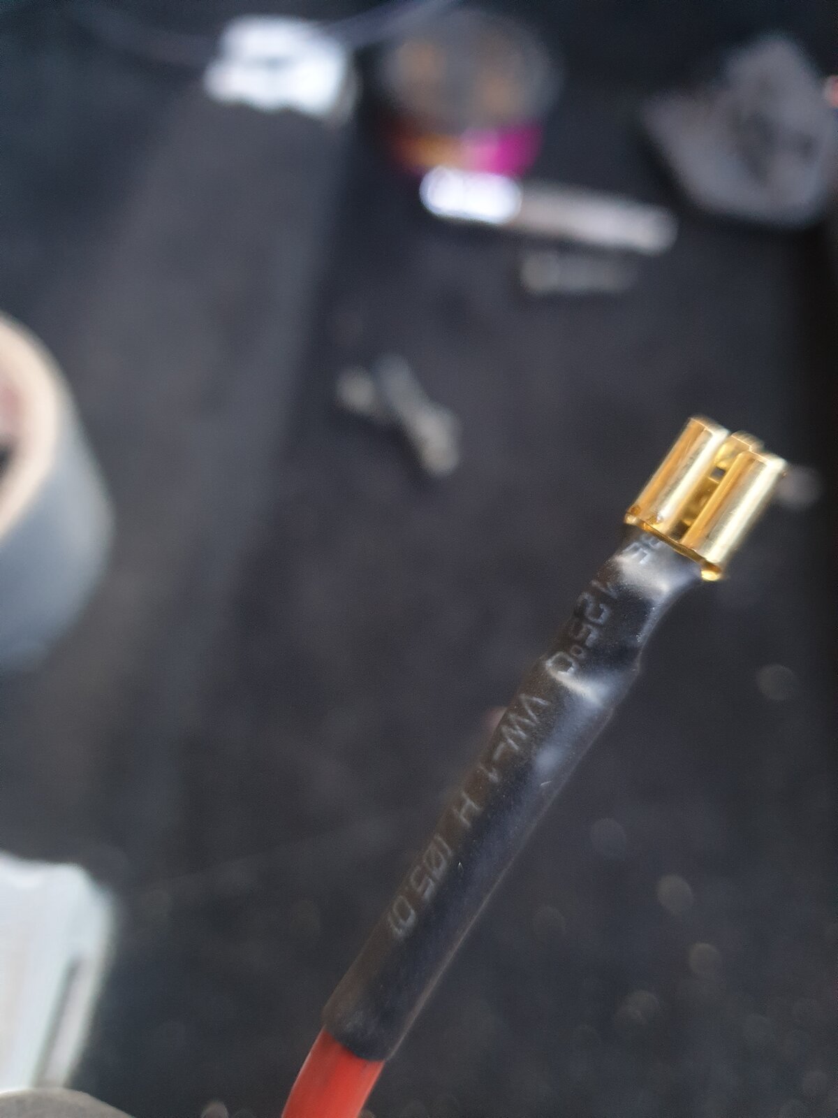

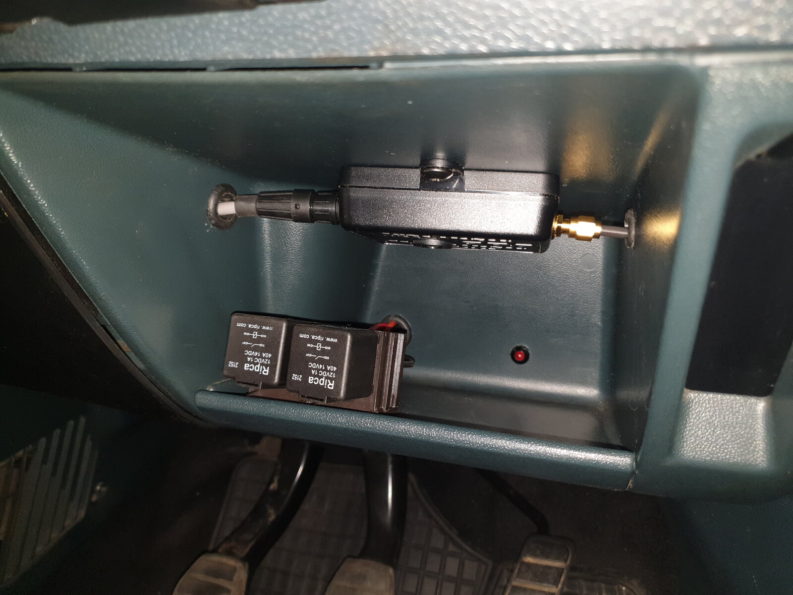

Lift and main pump wired up, went a bit overkill with the wiring possibly, 2x 40amp relays and 6mm wiring for main pump, but should be more than adequate. Also wired up stack fuel gauge and pikey temporary calibrated the dash with an old sender.
Relays fitted in cubby hole on drivers side.
Crimp and solder/heatshrink

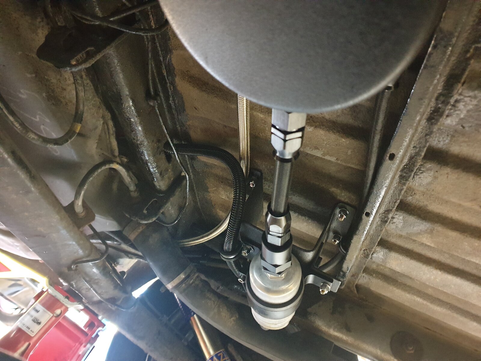

Wiring fed over tank and ran in plastic conduit

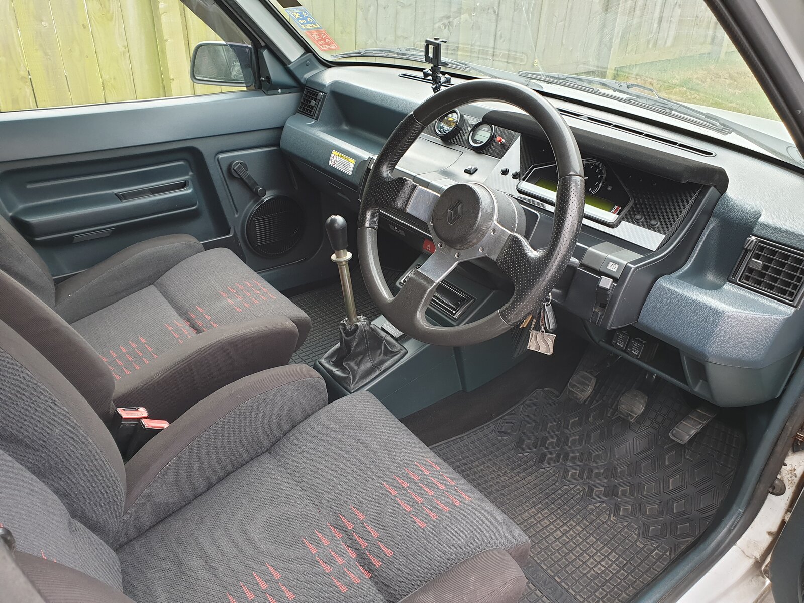

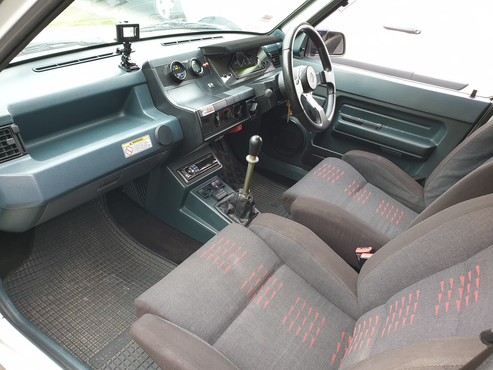

Interior finally back together.

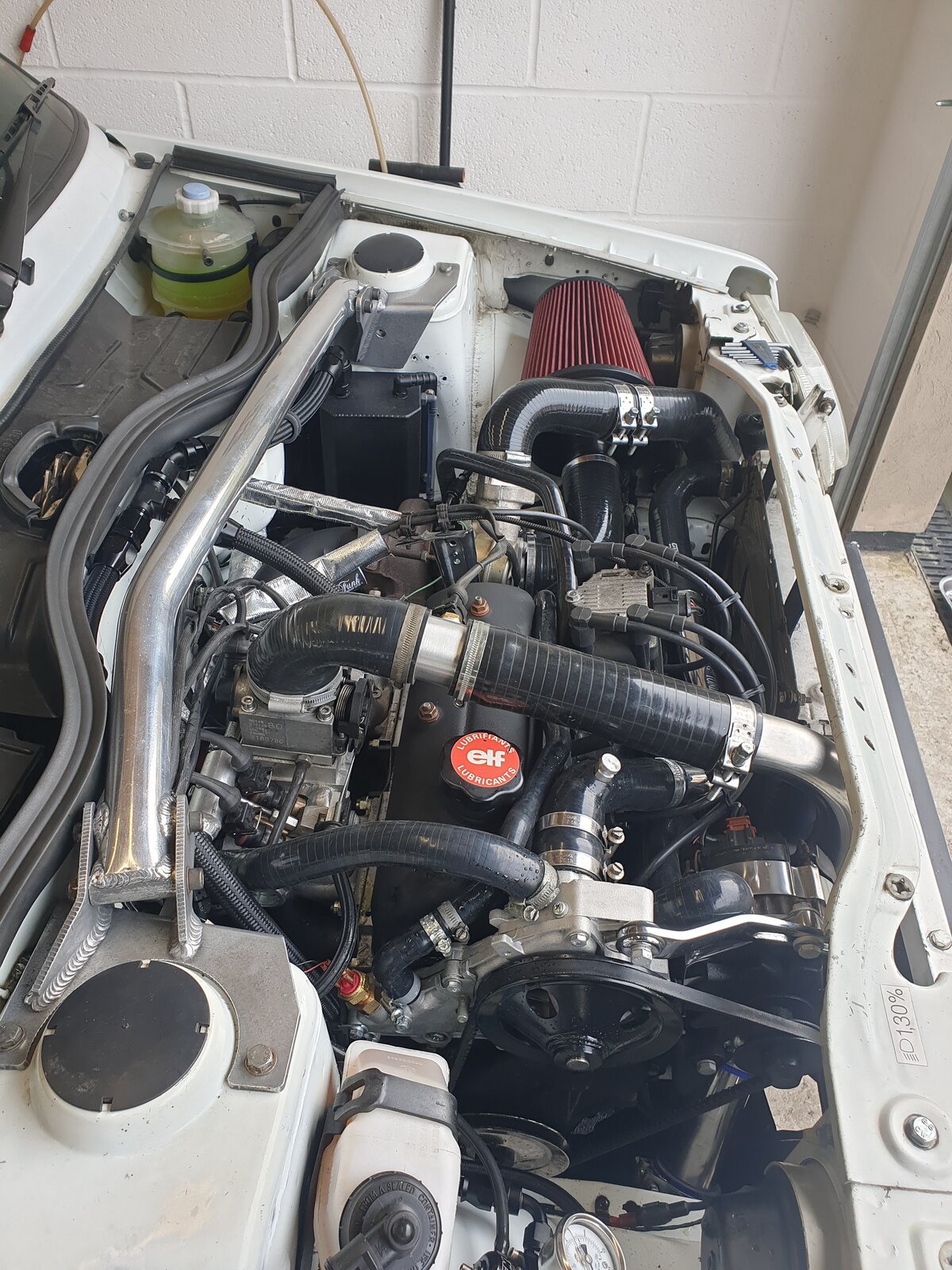

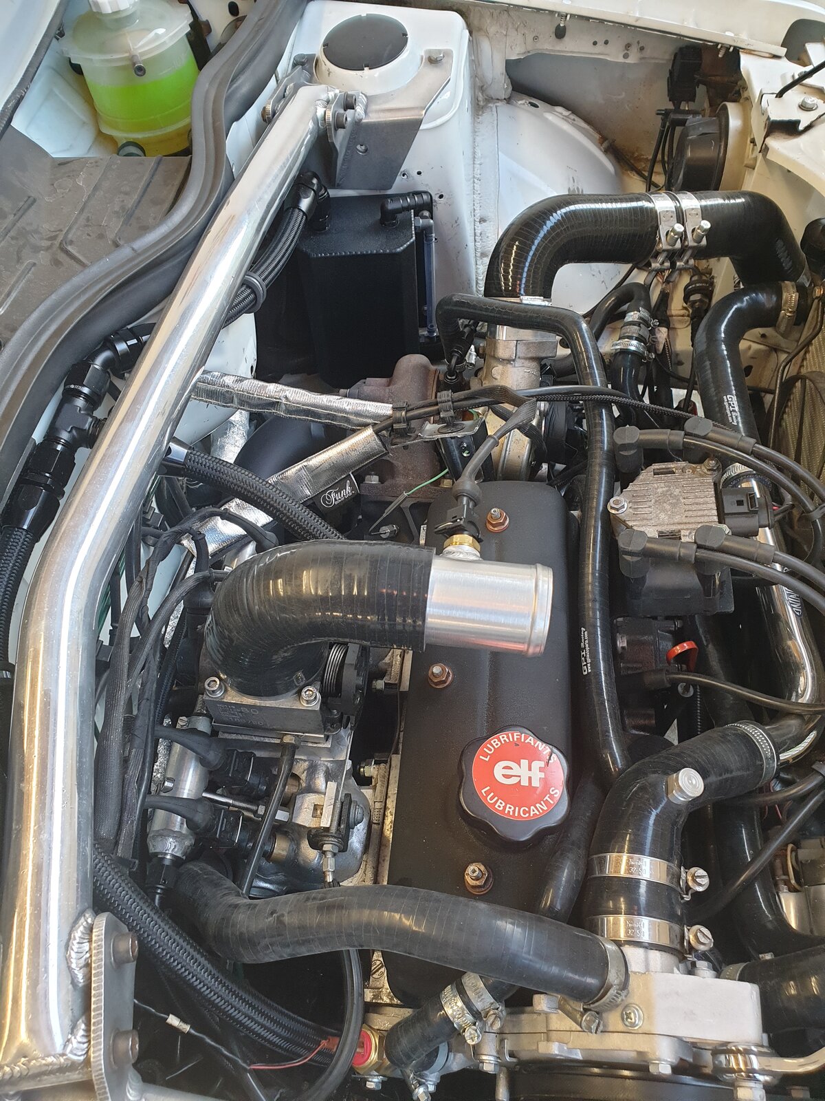

An10 breather system completed now the good fittings have arrived from Torques.
Refitted the plastic scuttle and battery cover and seals.

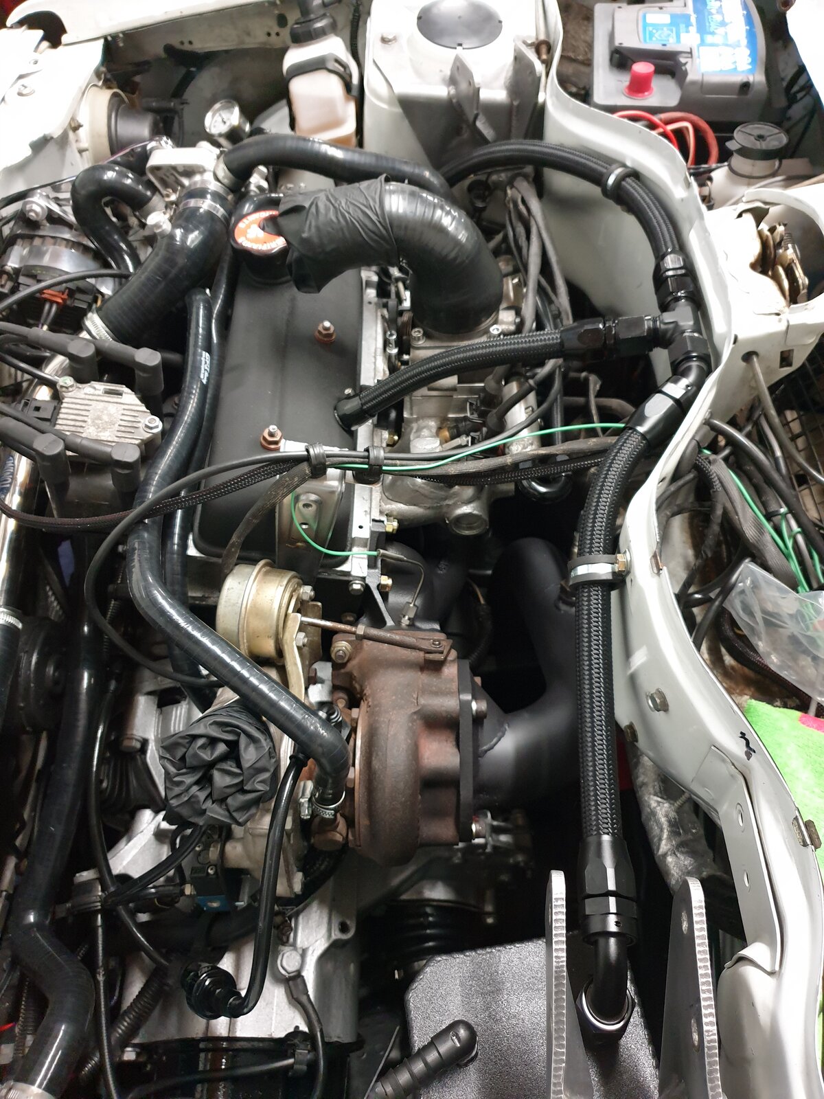

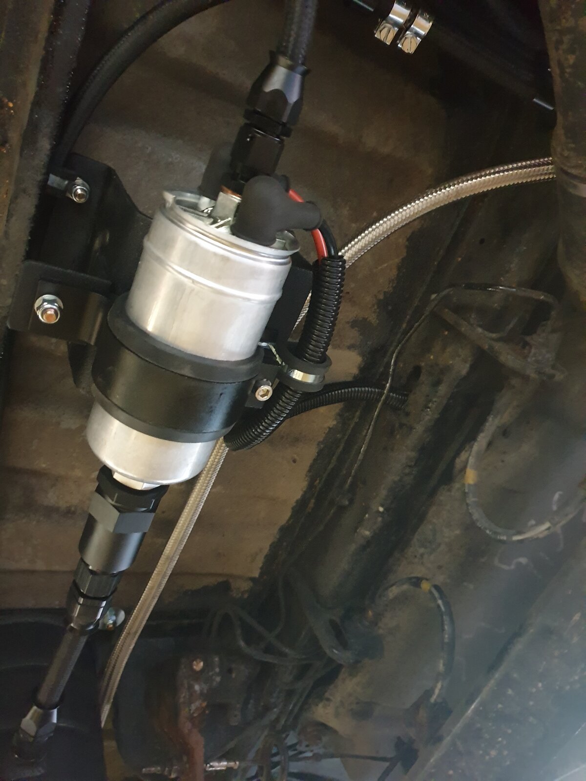

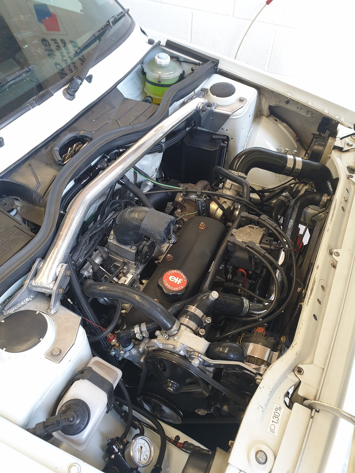

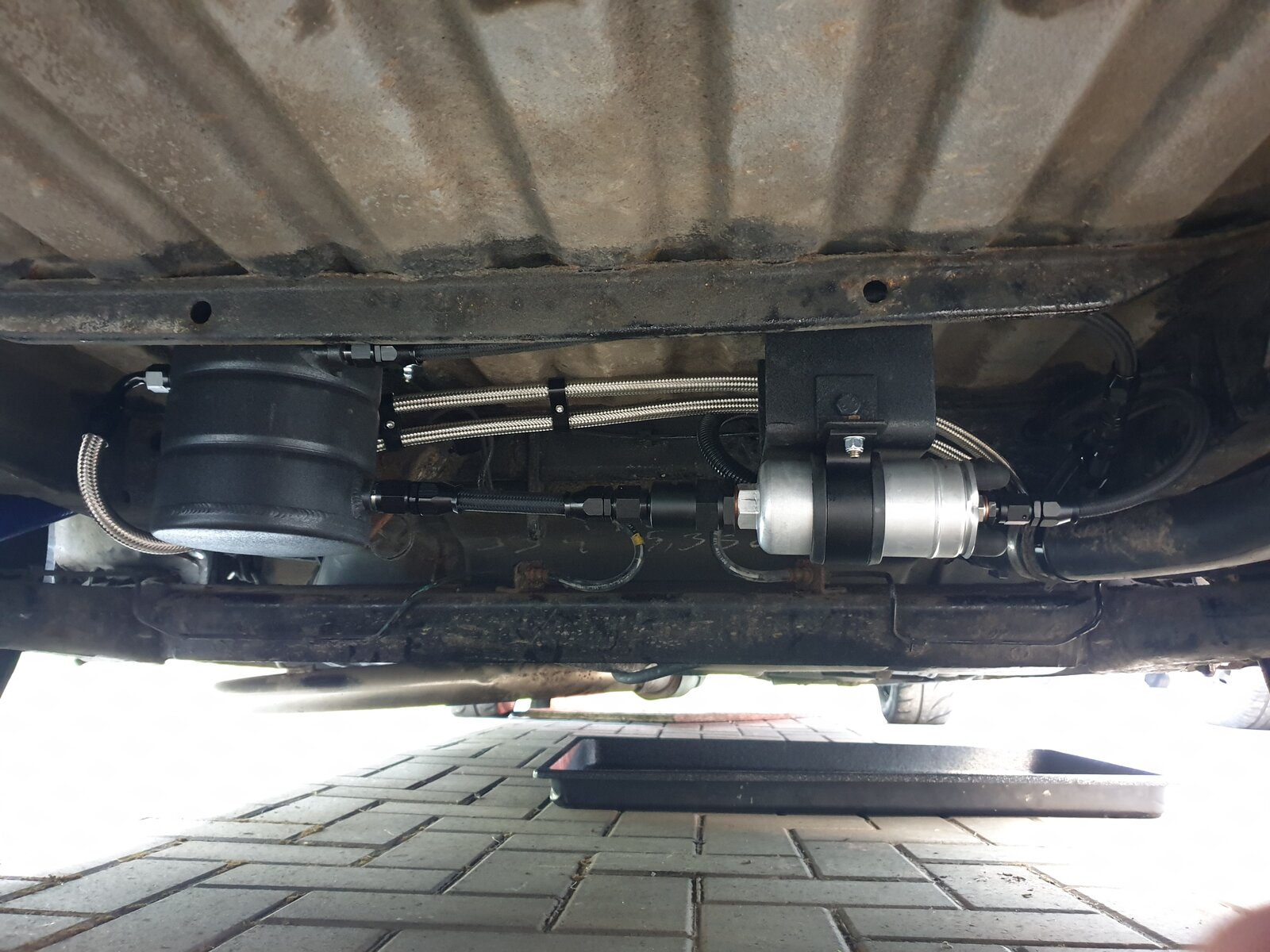

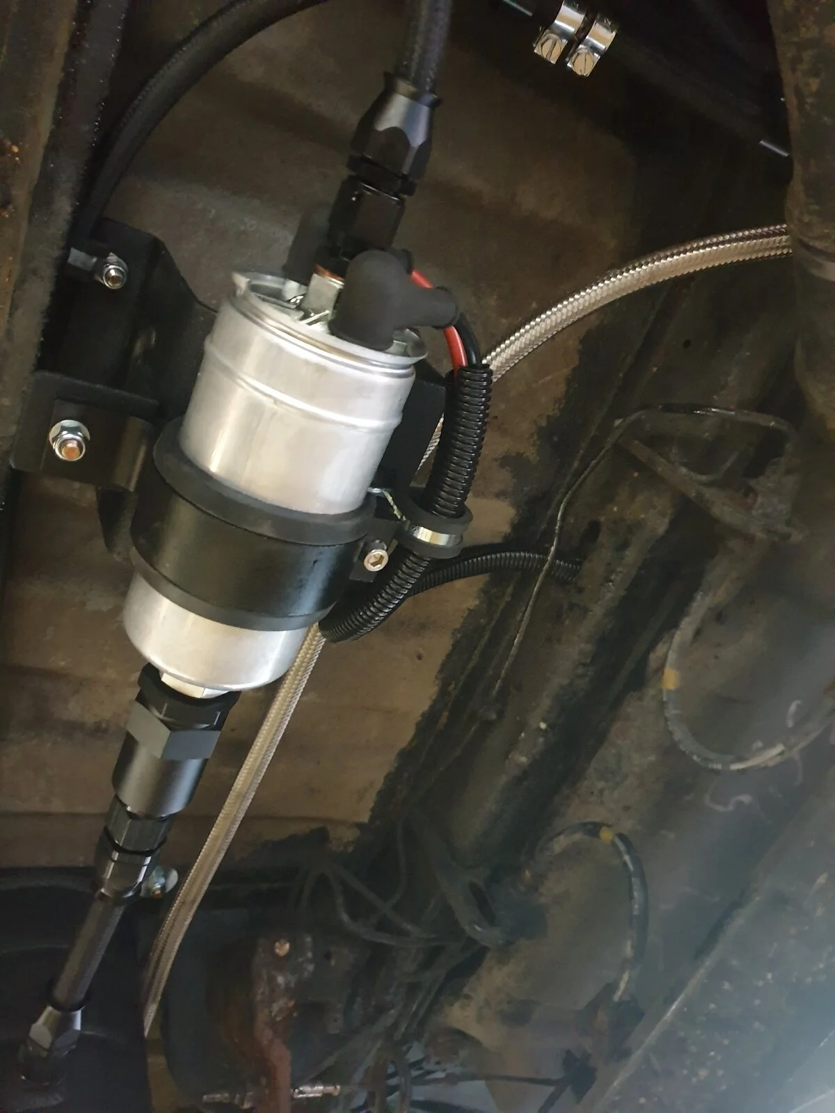

Finished plumbing in the fuel system, officially hate braided hose and routing fuel lines, worst job ever :cautious:
Bridged the fuel pump relay wiring to run the lift pump to fill swirl pot and leak check, only one minor leak and needed to nip a hose clip up. Fired main pump up, and its super loud as expected, but no leaks on any an fittings, ramped the pressure up on the reg to 4.5bar all good static.
Filled it up with mineral oil and primed the oil system up with my home made tool and drill
Oil pressure went up straight away to over 4bar on the stack dash which is decent enough for one of these engines.
Tickled the starter and seen rpm on the laptop so plugged the fuel pump relays in and went for it. Was a nice moment to hear it wanting to fire straight away as i had changed quite a few parts and had to configure the trigger pattern myself for the new flywheel which is ironically same 60- as 172 clio.
Stack dash fired up

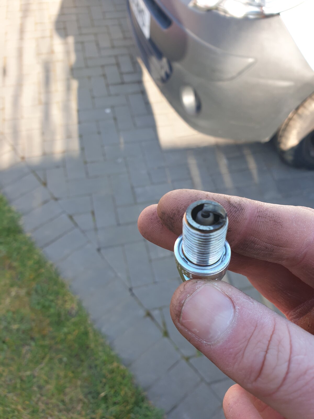

Pulled a plug to see what was going on, looked ok, as expected fairly clean.

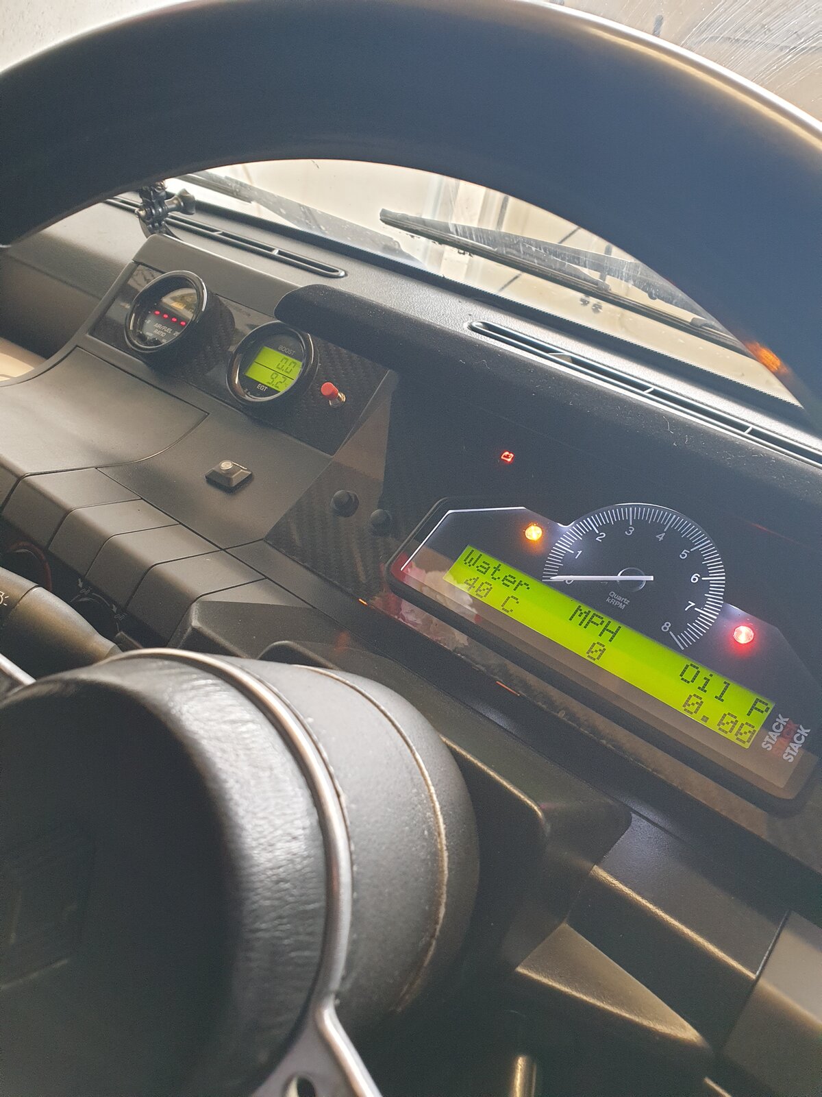

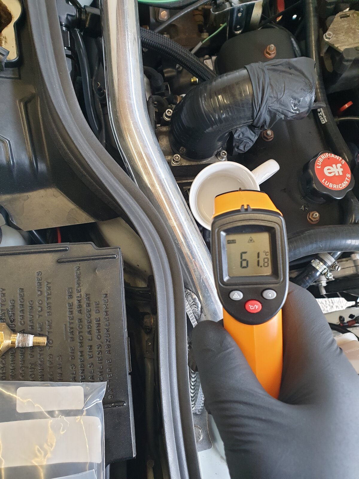

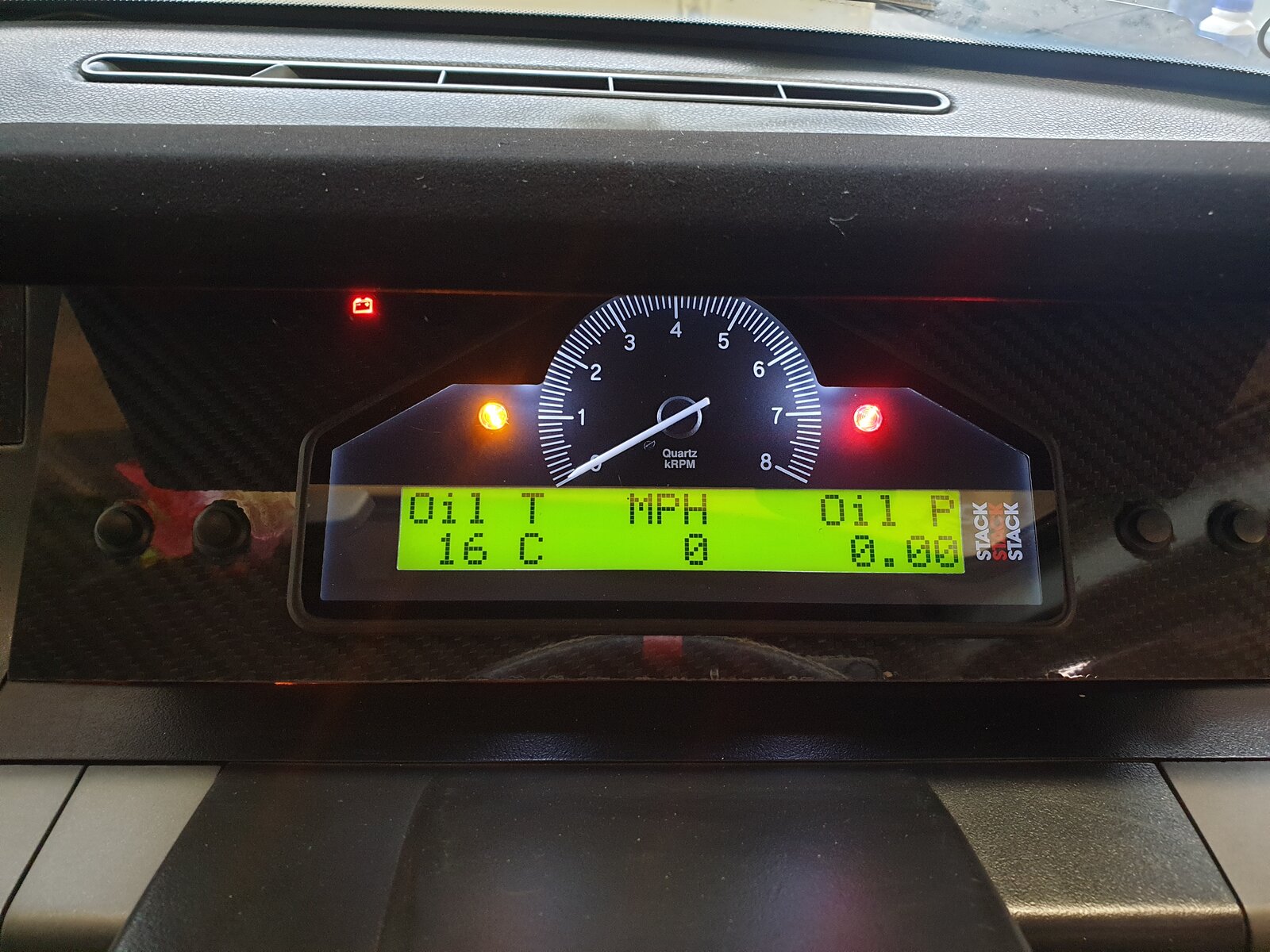

Stack temp sensor turned up today
Done a back to back test with the old sensor and ir temp probe
Old sensor said 40deg
New genuine stack sensor reported 18deg difference
Repeated the test with hot water and same result, original sensor seems to max out at 50deg. Stack sensor responds far faster too.
The aftermarket sensor was supposed to be fine on the stack dash, but as usual should take anything you read on the internet with a pinch of salt :cautious: looks like i will have to get my money out and replace the oil temp sensor too. Buy cheap, buy twice!

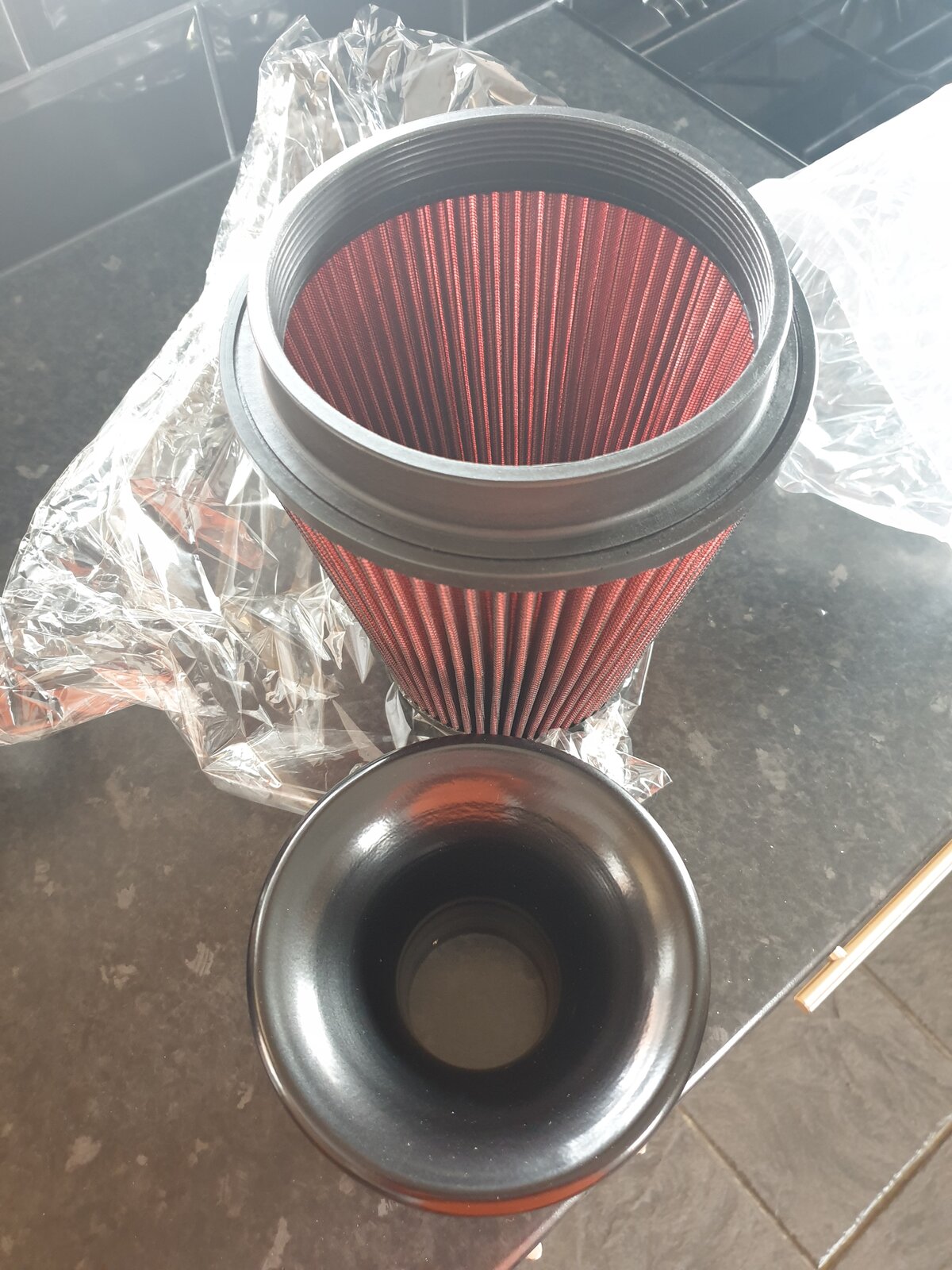

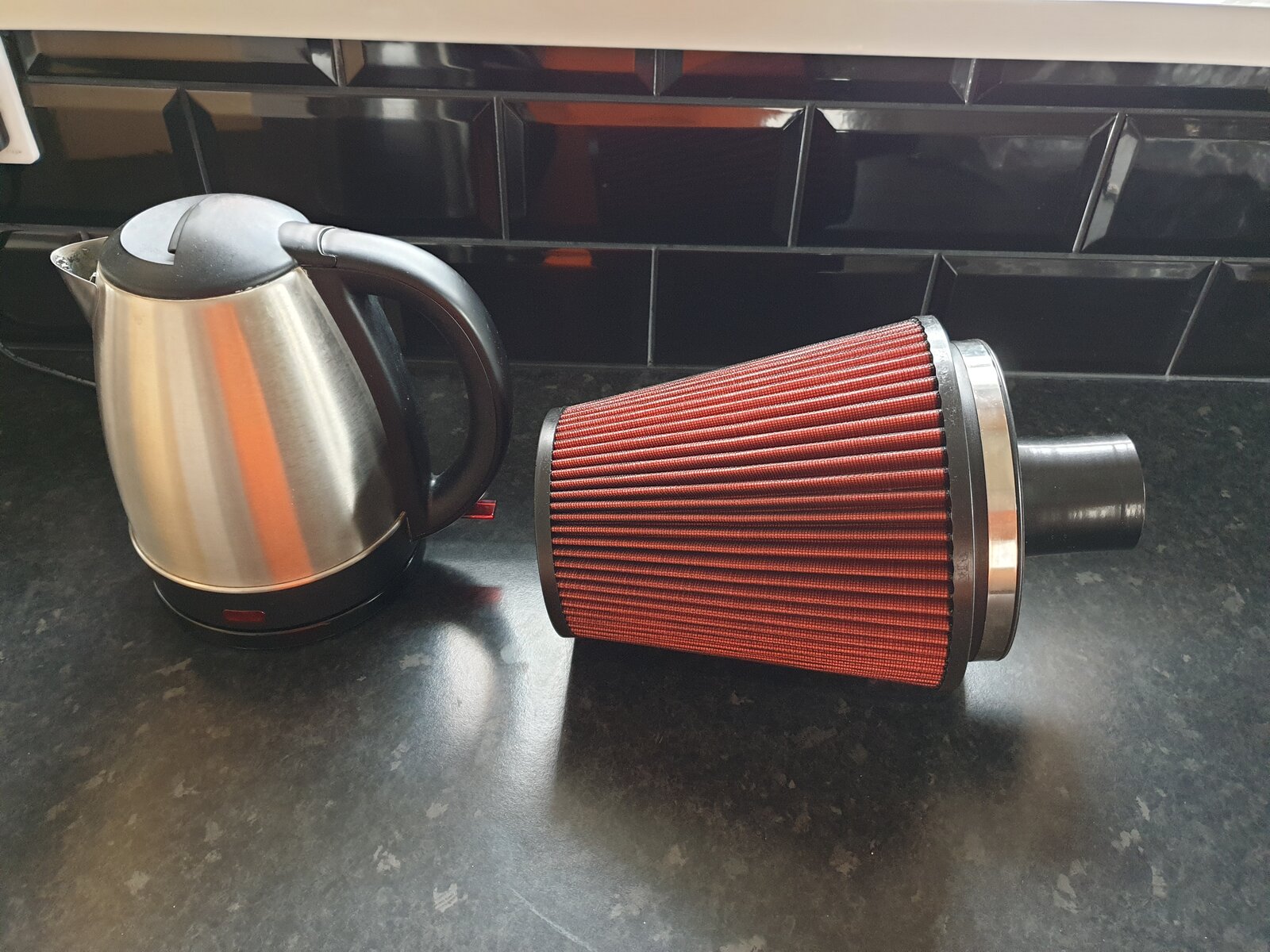

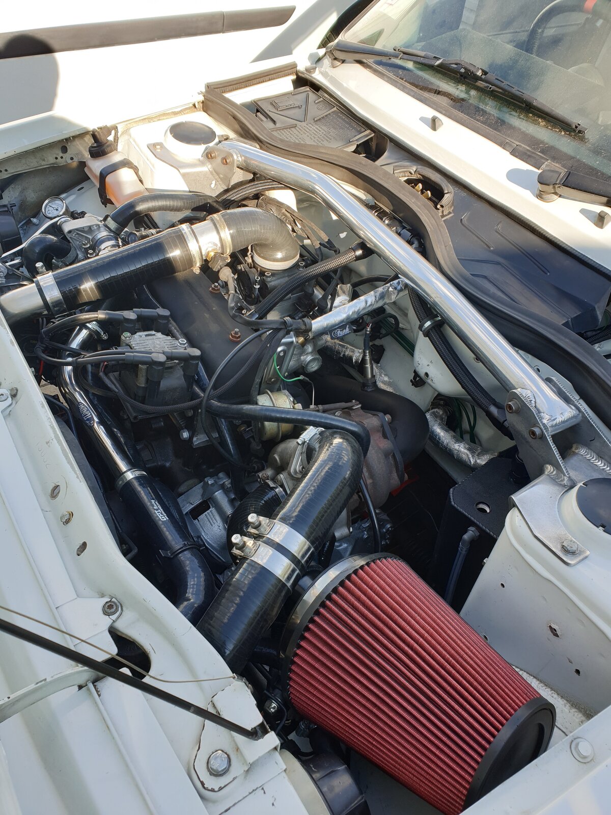

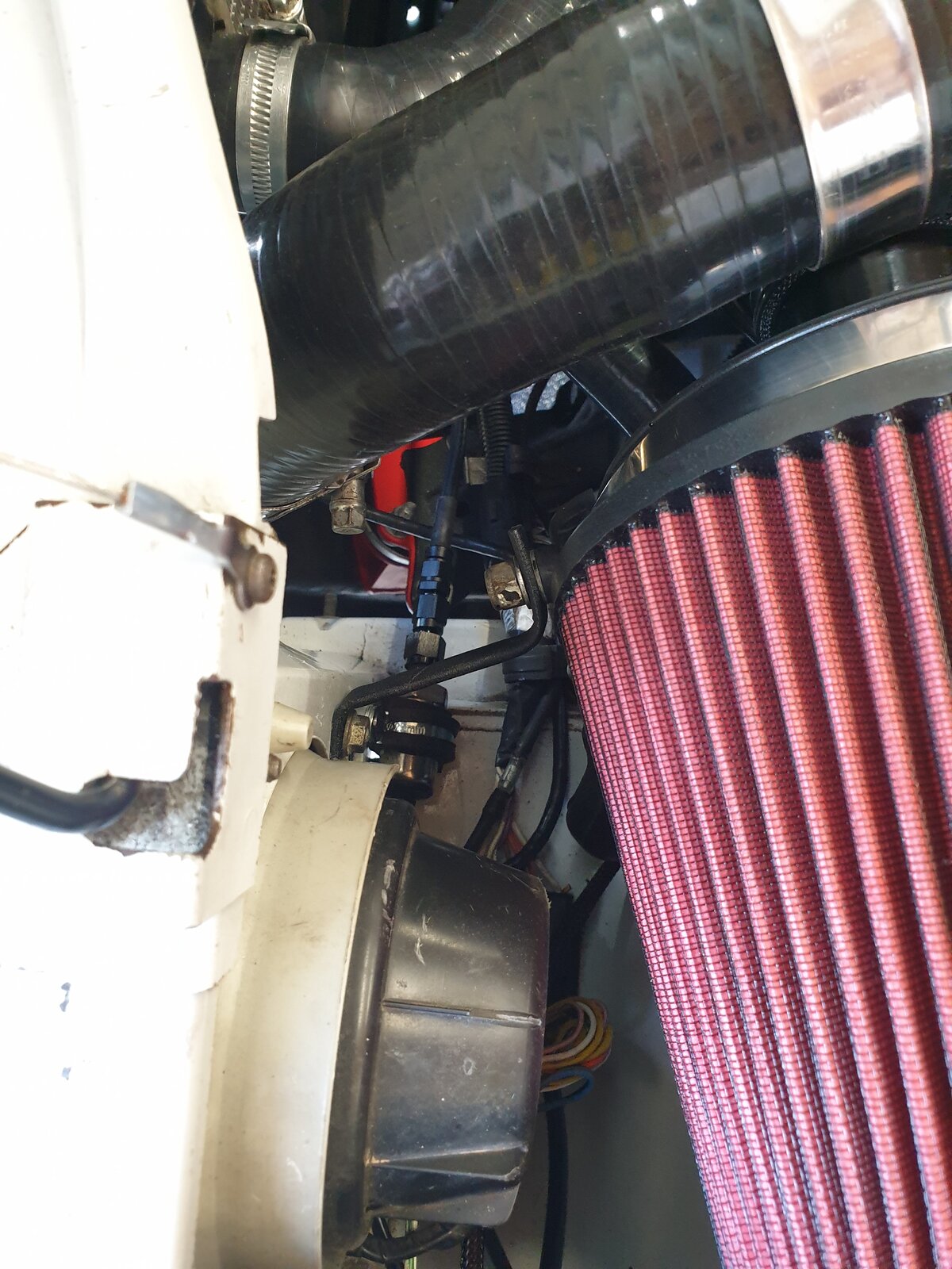

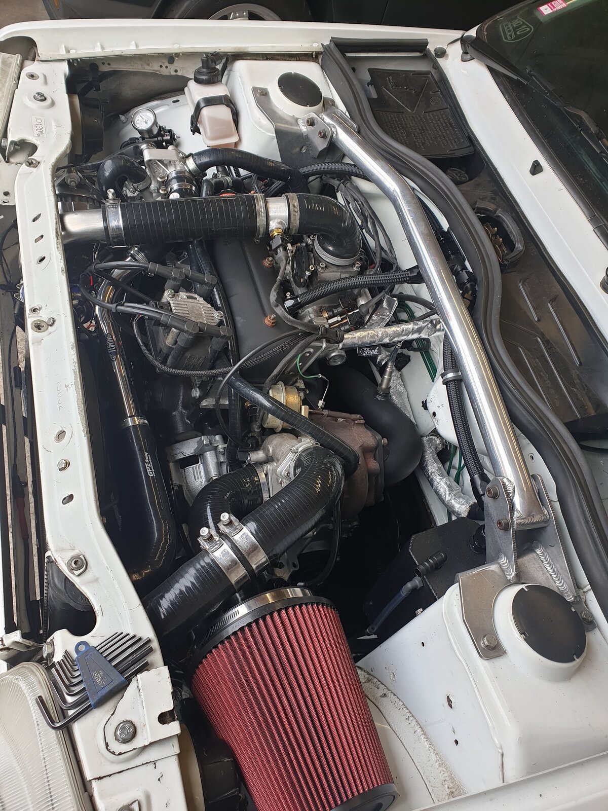

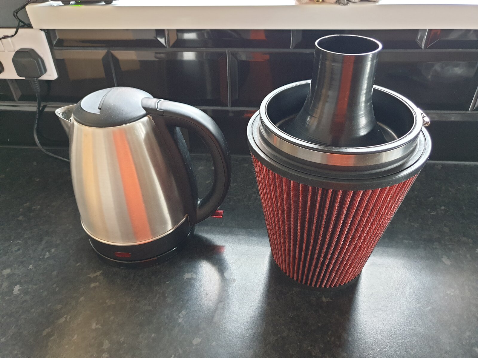

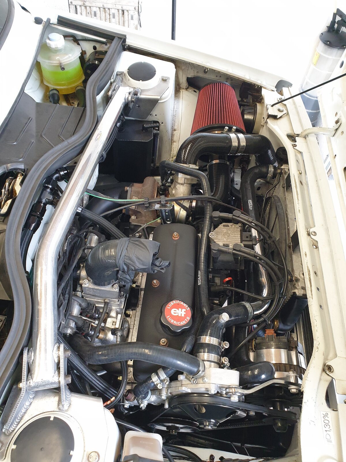

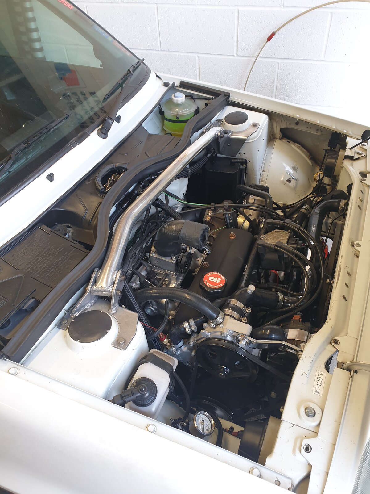

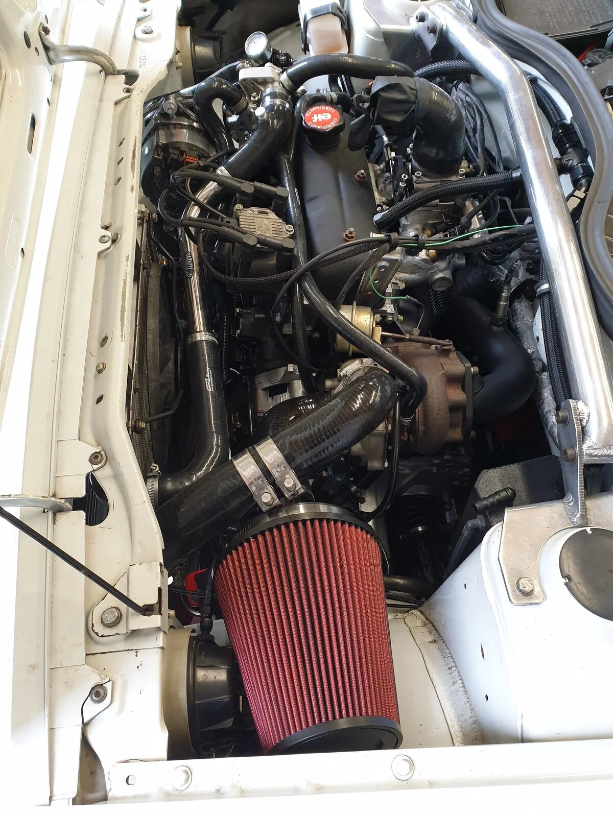

Ordered an Airtec cosworth grp a filter as the old JR cone filter i had was blue, did not really fit in with the new look. Forgot how big they are when unwrapping!
Fitted, i planned on boxing it in but too big so can stay as is.

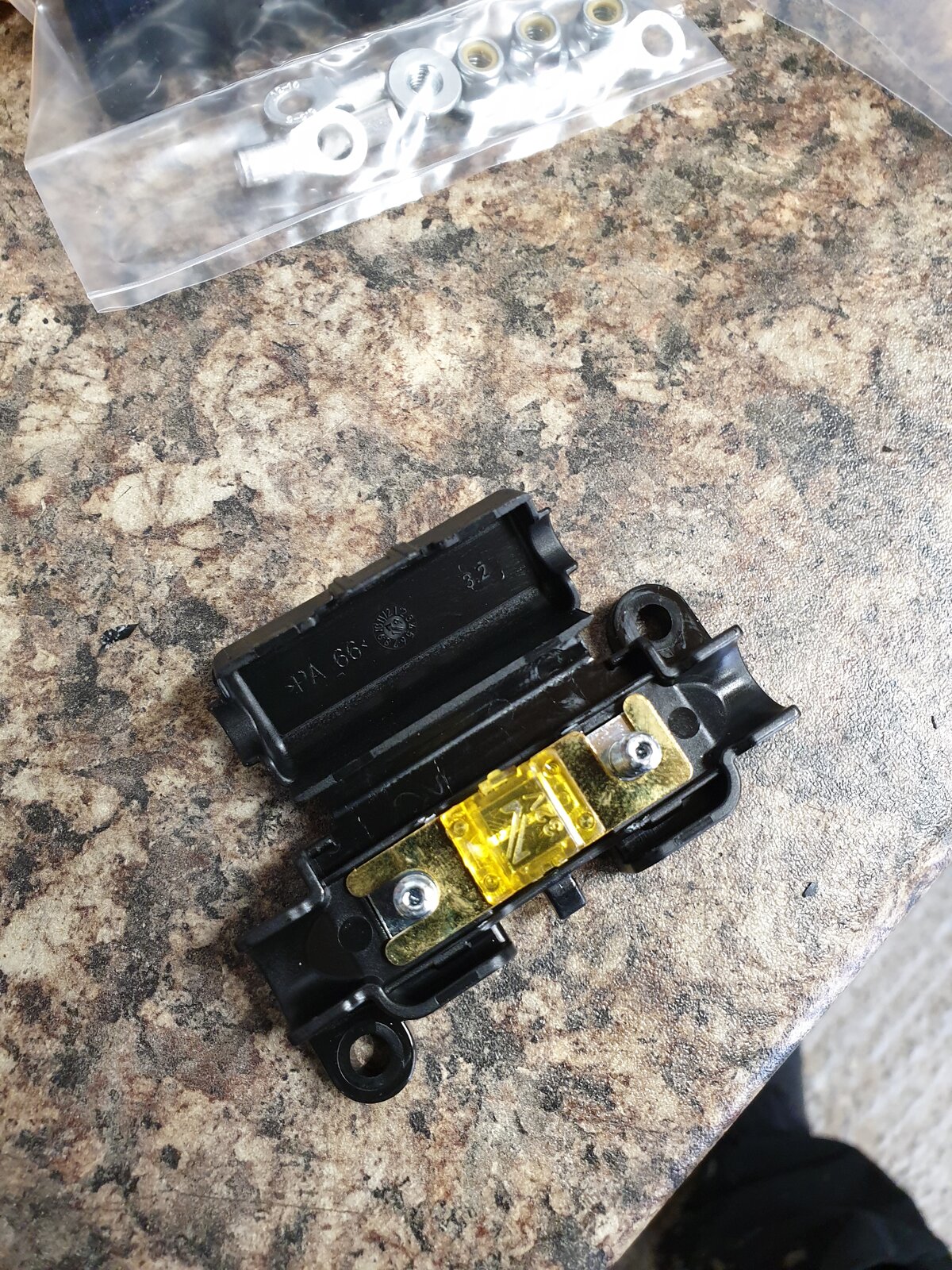

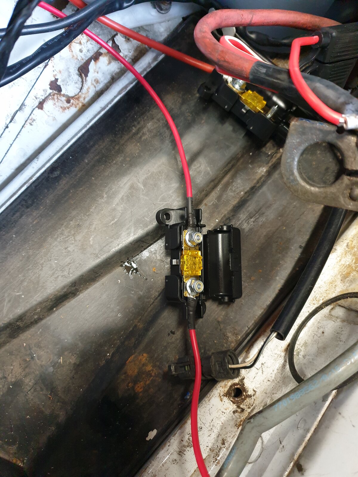

Added some fuses for both fuel pumps under the bonnet. @DaveL485 linked me up with these, good bit of kit.
Awaiting a few small parts and should be complete in the engine bay soon.

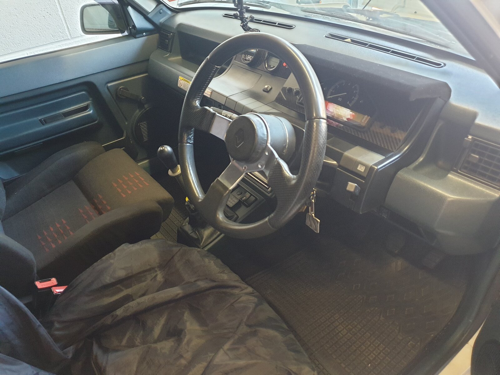

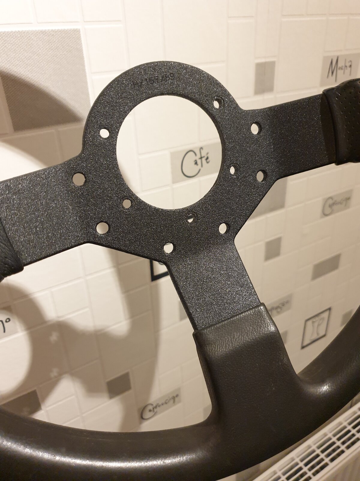

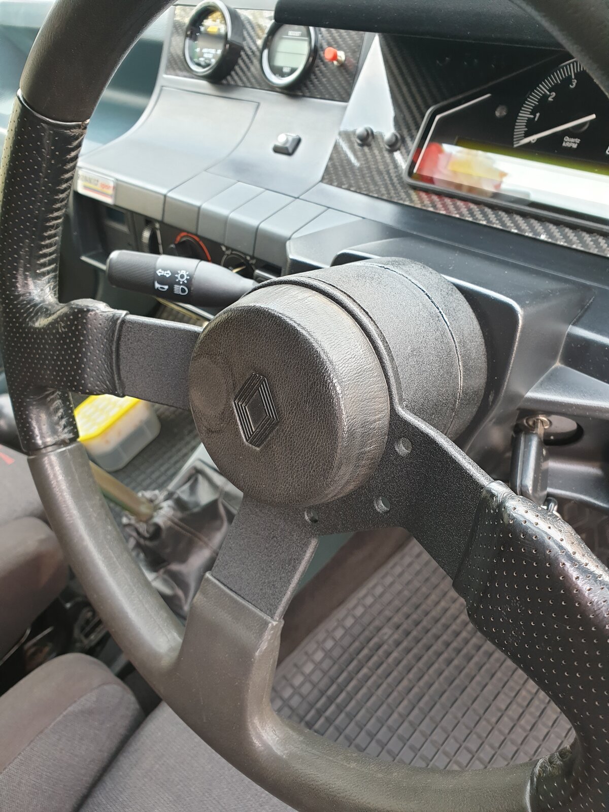

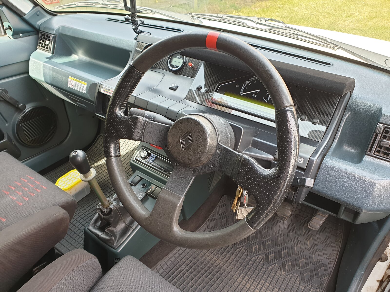

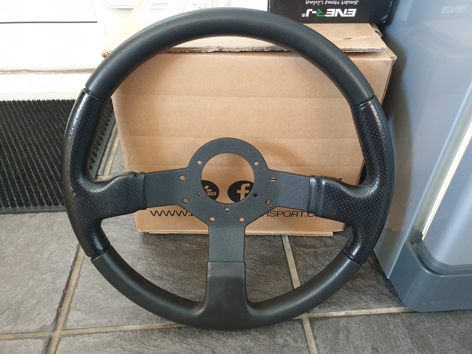

Not too keen on the polished steering wheel anymore and fancied a change, so dug out a spare steering wheel and give it a makeover with bedliner paint, as i love the textured hard wearing finish. The boss was looking tatty so give that a once over too.
Fitted, looks more oem+

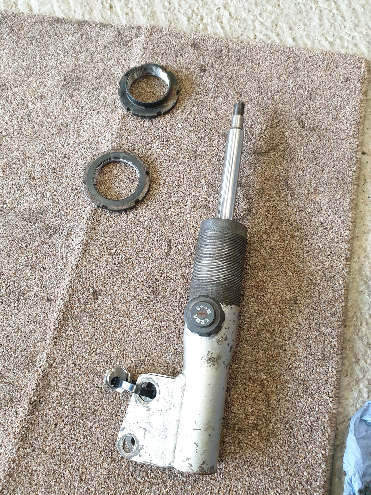

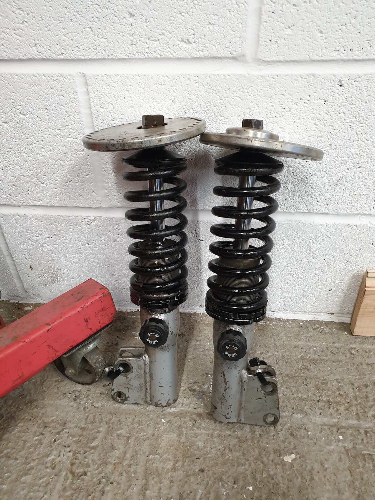

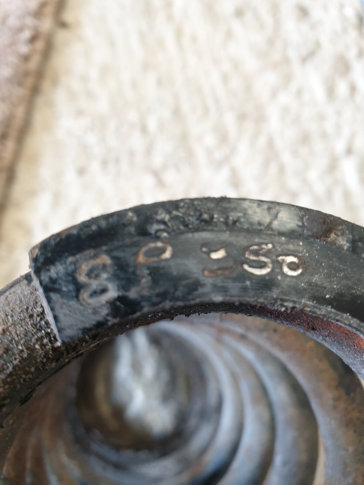

Pulled out the Leda front coilovers i bought a while back to clean up and check condition. The bloke who i bought them off reckoned he pushed them down once a month to keep the seals in good nick, i call bullshit to that as the springs are solid and i cannot move them whatsoever when built up.
I planned on doing this ages ago but did not have a socket the right size to remove the top nut, i took one of the legs down to my local garage and they did not have one either o_Oeventually we found out that it is a 26mm socket, queer size for whatever reason. Ebay to the rescue for a 26mm impact socket!
Gunned the nut off with my Dewalt no bother and stripped down, solid compbrake top mounts removed and springs off to reveal 350lb and 8" long. No way did the previous owner compress these by hand!
Stripped, threads cleaned, degreased. Checked both shafts for movement and work fine, damping works ok. I was not too worried if as the price to get them rebuilt from Leda is not too expensive. Stripped top mounts down and regreased the spherical bearings as dry, could probably do with renewing them soon but ok for now.
Rebuilt, threads greased with anti corrosion grease, and coated in acf50. I was very tempted to paint them black with bedliner paint but the tin is nearly empty. Just noticed i put one top mount on upside down, only loosely fitted though for now :LOL:

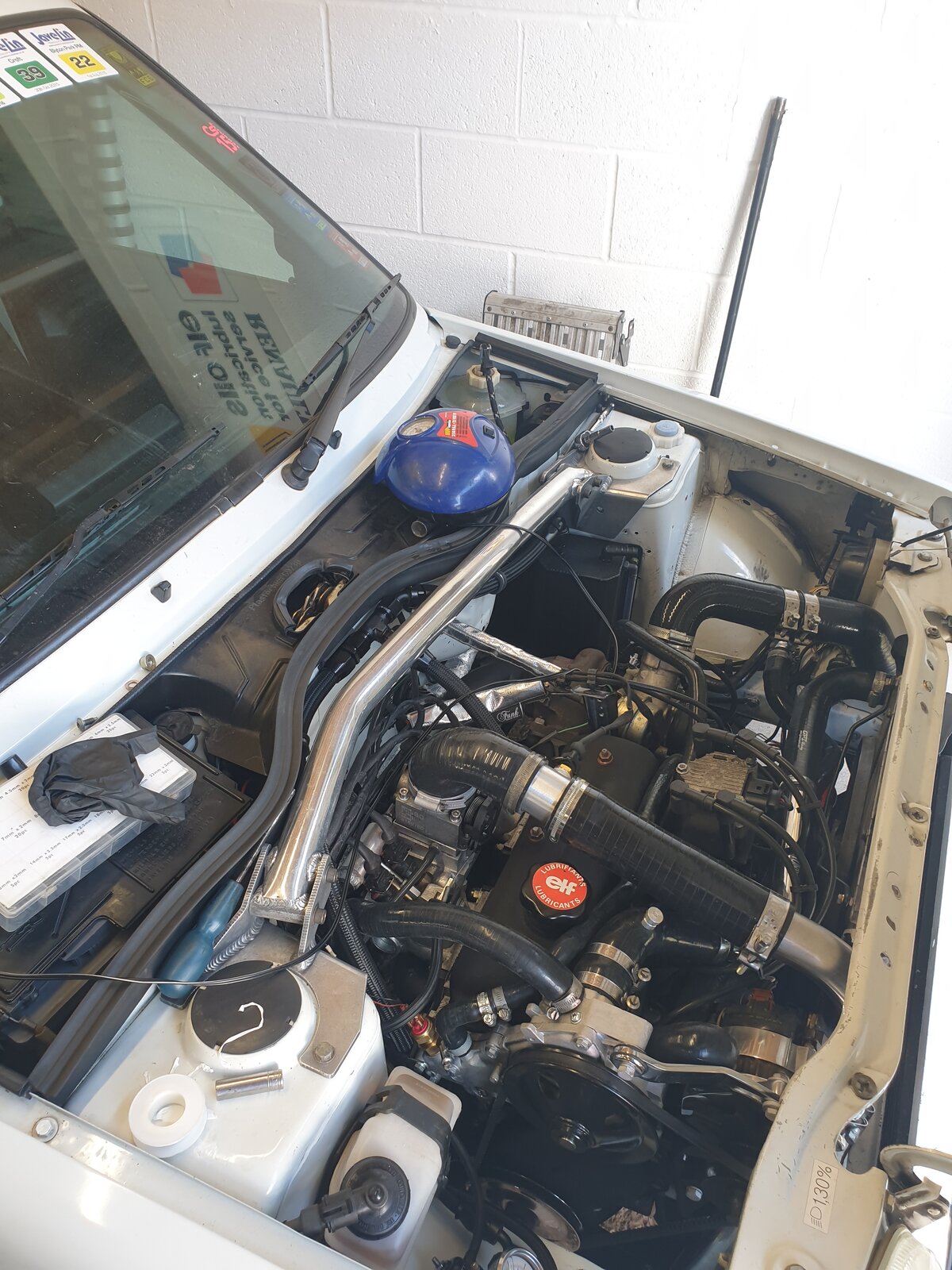

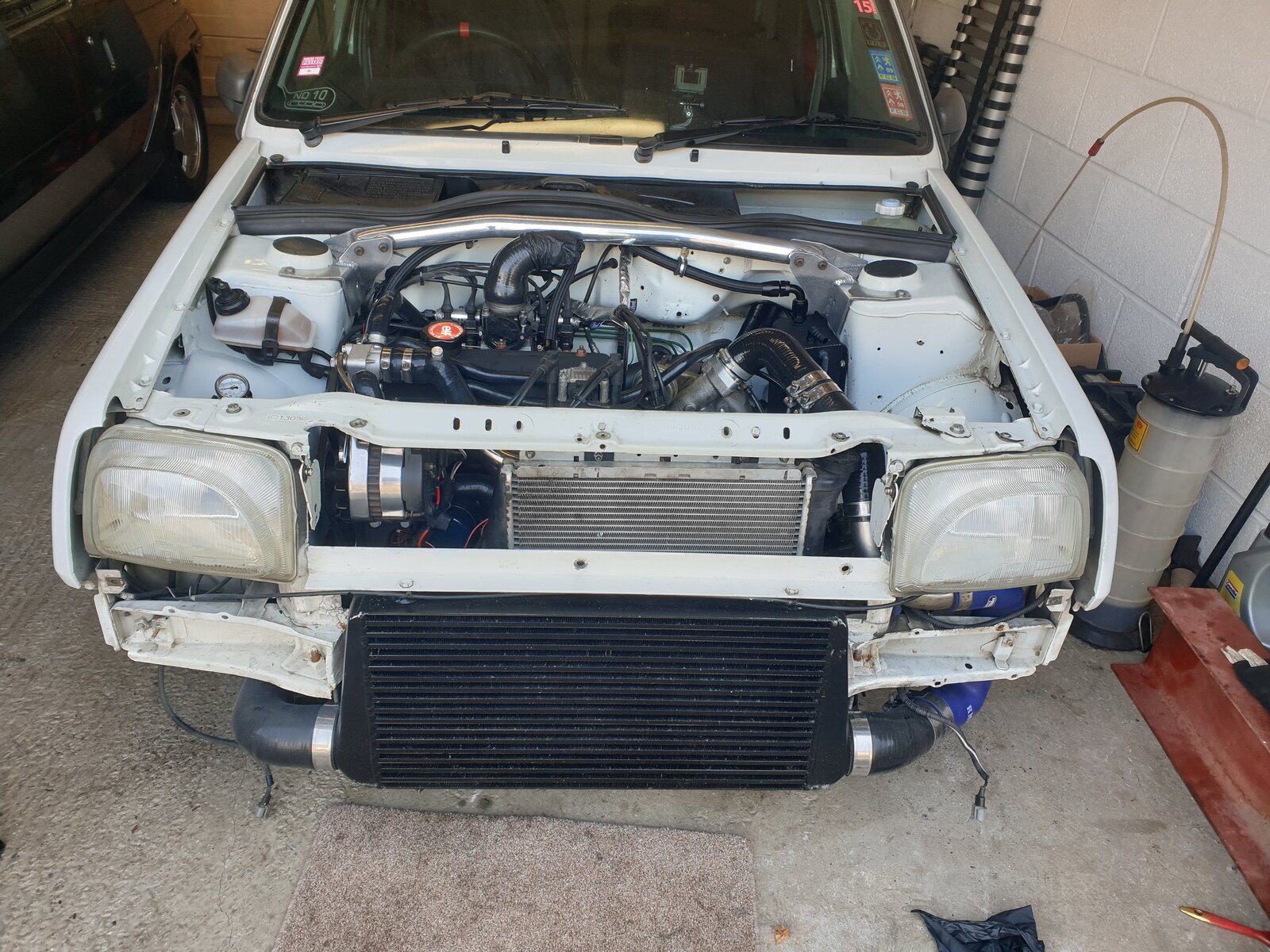

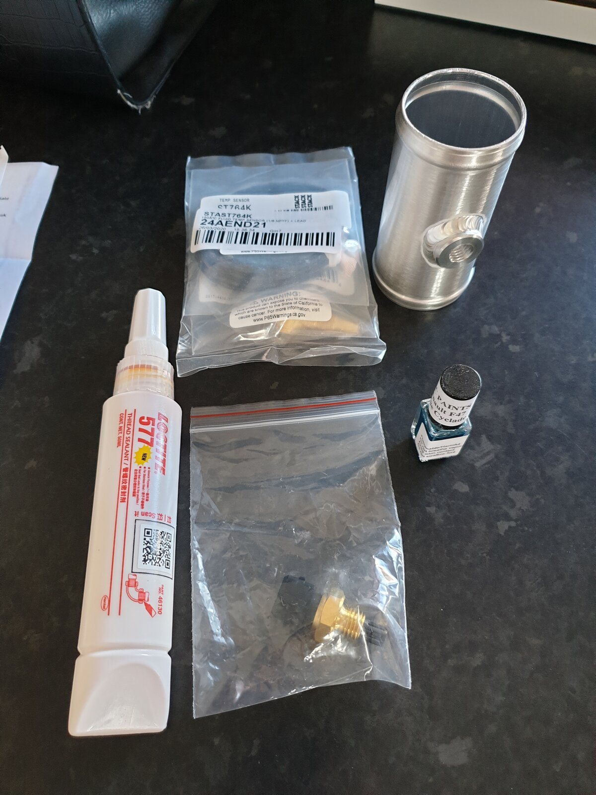

Been waiting for the postman to deliver some small parcels for ages so i could make progress on the Extra, ordered them all a fortnight ago and just arrived.

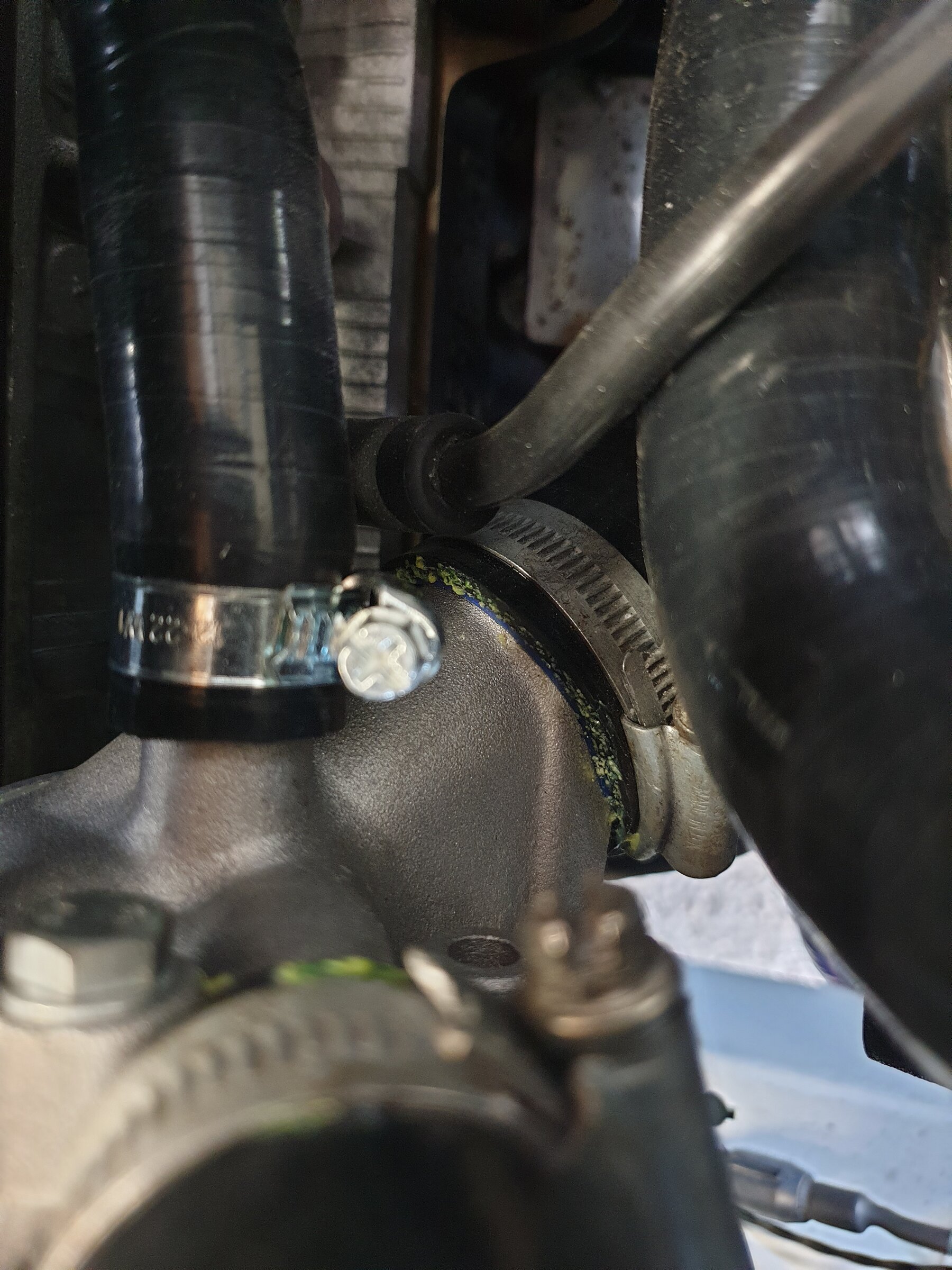

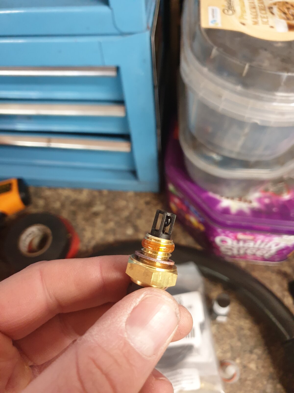

Had an issue with coolant temp sensor adaptor leaking from the threads even with a couple of wraps of ptfe, so ordered a tube of Loctite 577 to seal the threads. New air temp sensor and custom hose adaptor to suit, new stack oil temp sensor to replace the incorrectly reading old one.
Tried the 577 out on my air temp sensor, seems like good stuff.
Air temp sensor mocked up in place.

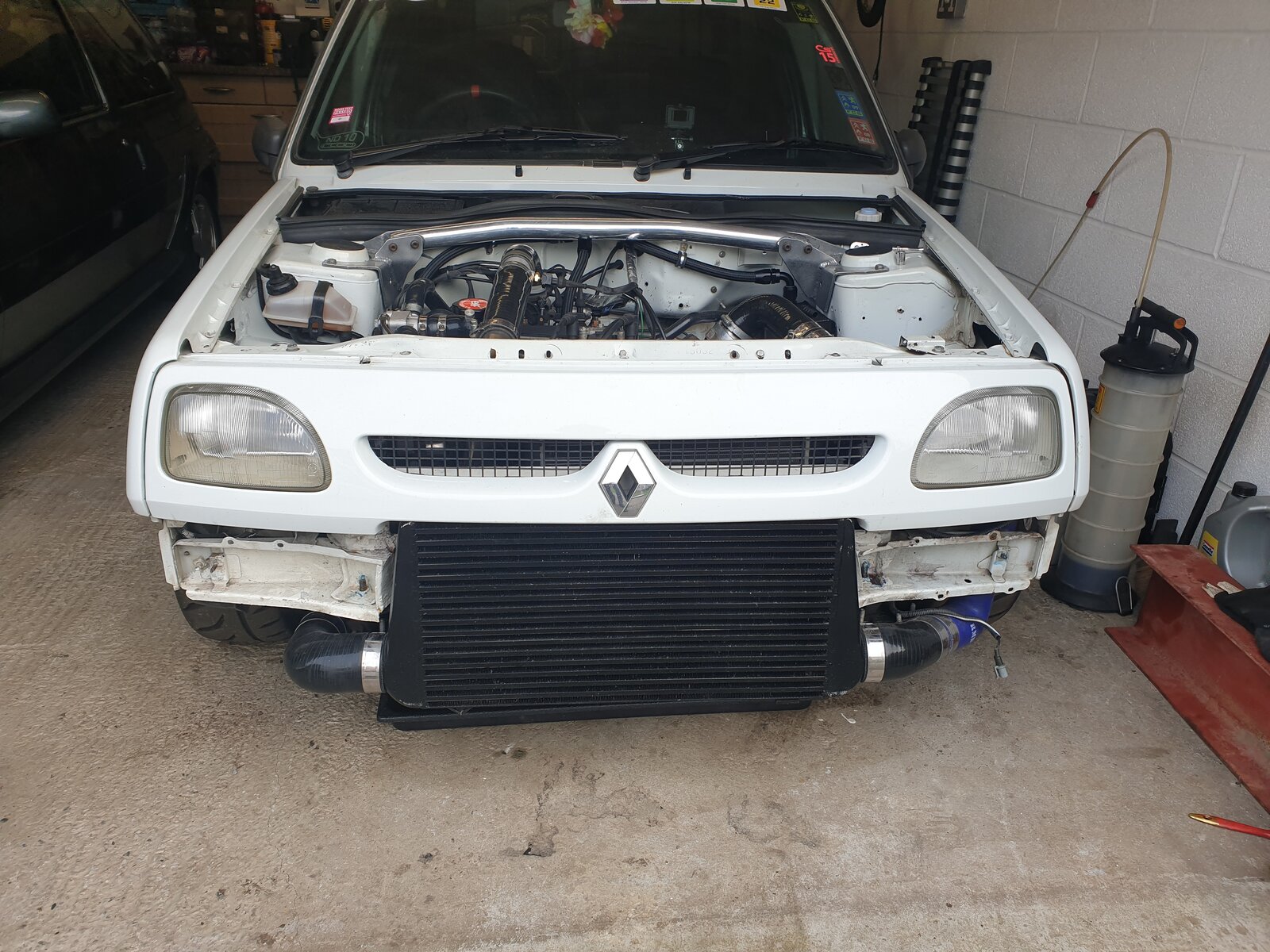

Had a day on the Extra today.

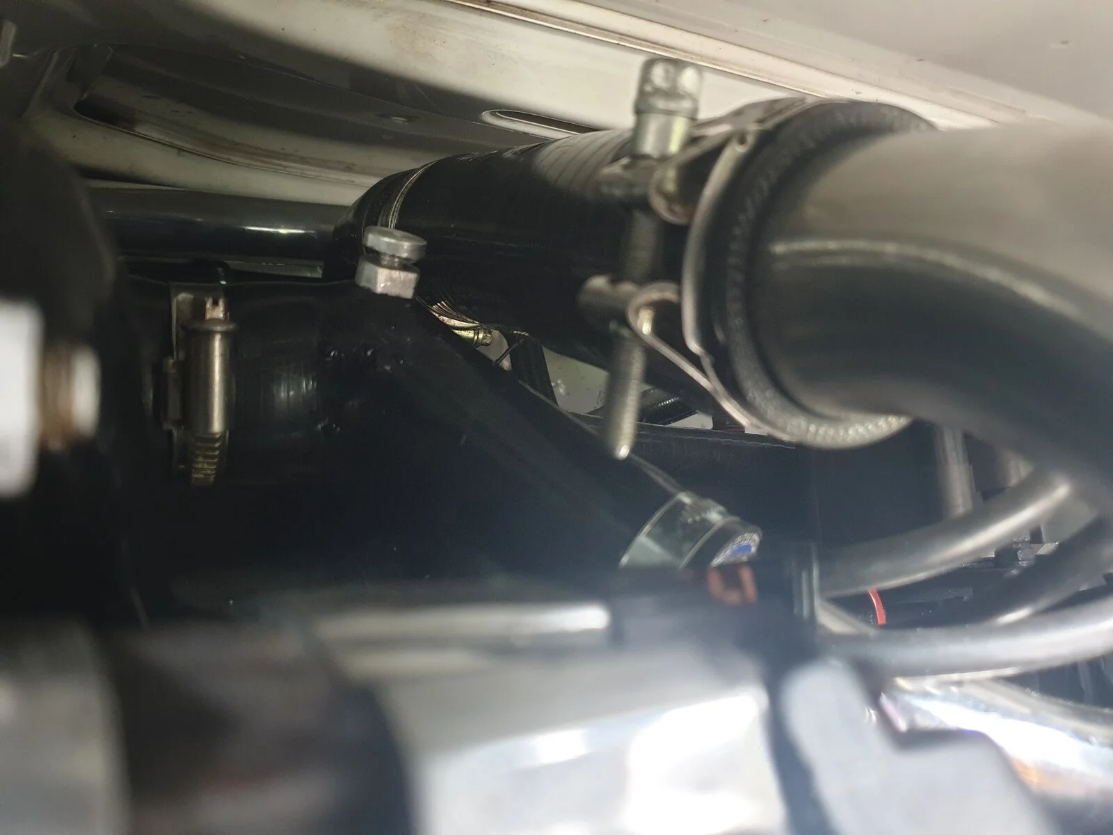

Had to change the stack oil temp sender. Its buried under a load of pipes at the fronf of the block. Whipped front end and intercooler off for access, easy job as its all been off many times over the years
Intercooler off giving easy access
New sensor fitted, added a bit of Loctite 577 thread sealant, also done the gauge fitting on turbo oil feed as was weeping slightly.

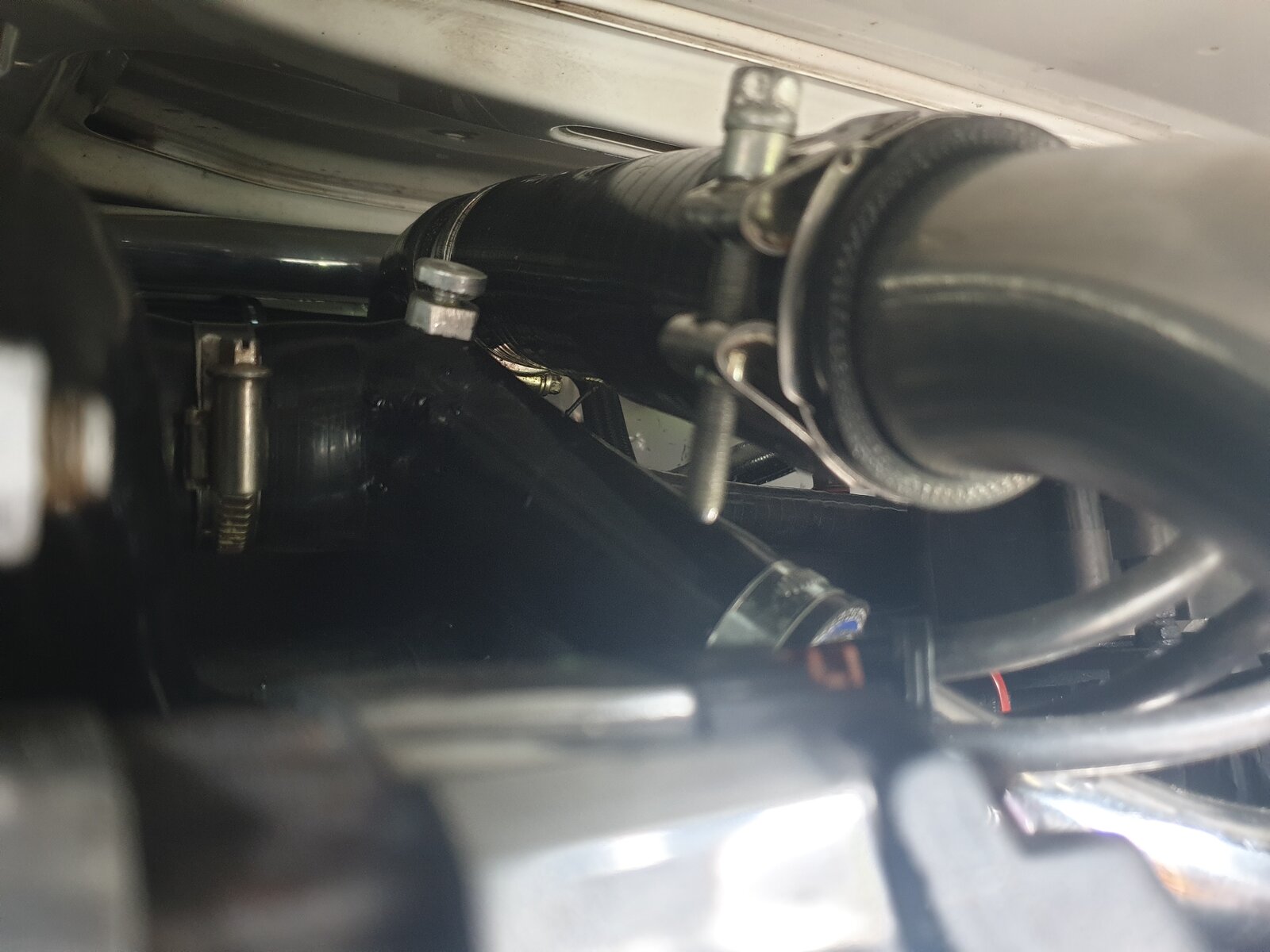

Fitted cold side boost hoses whilst apart as access was much better. AIT sensor fitted in boost hose instead of inlet to avoid loads of heat soak.
Started refitting the parts, looks badass with grill and no bumper
Checked boost hose clearance against bonnet when shut and all good, its tight but the same as the old carb setup was.

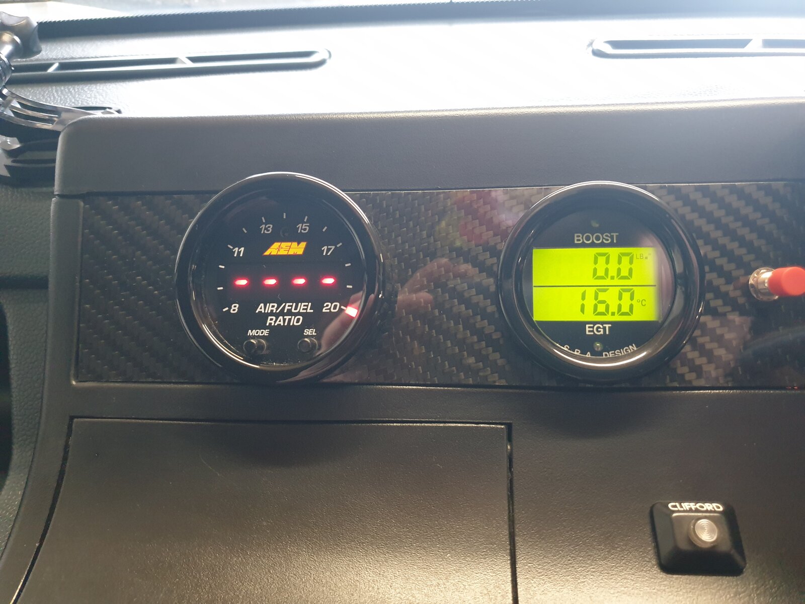

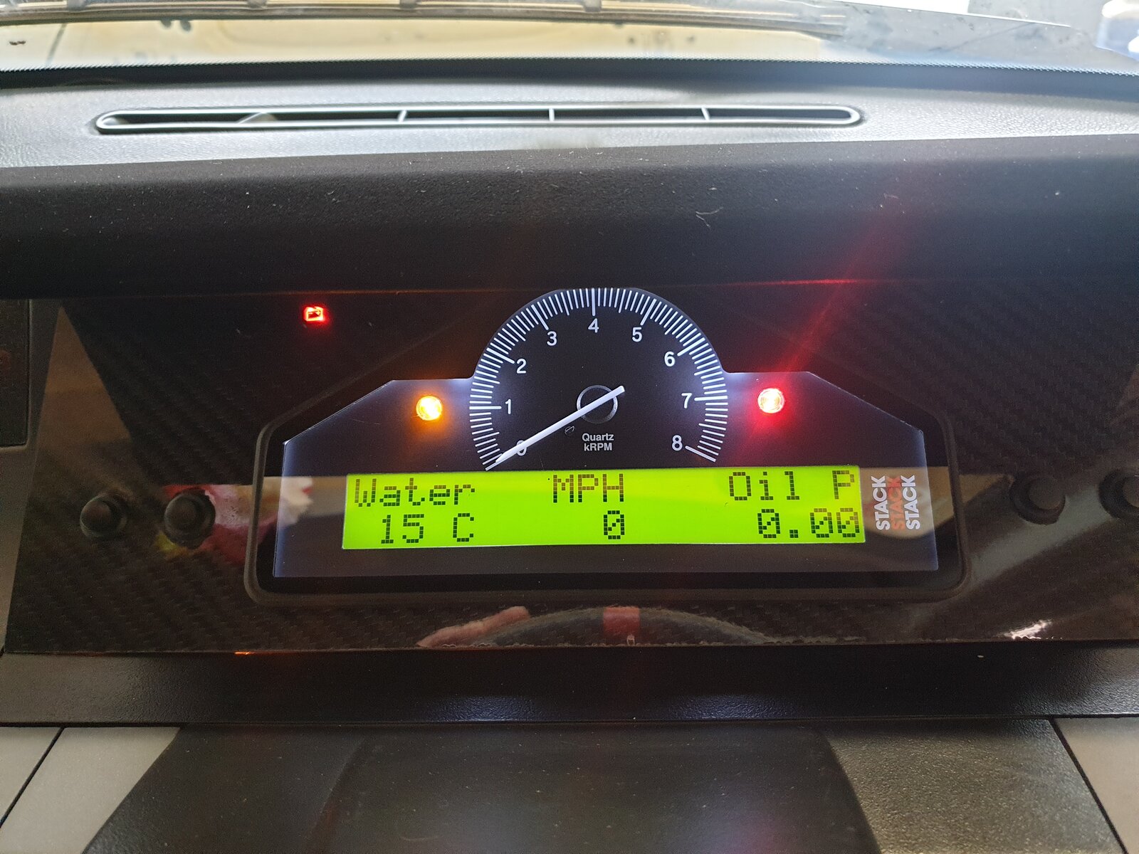

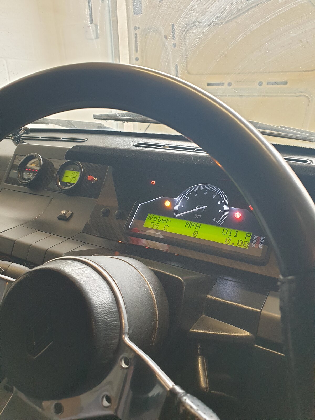

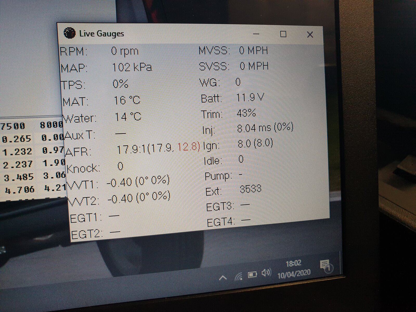

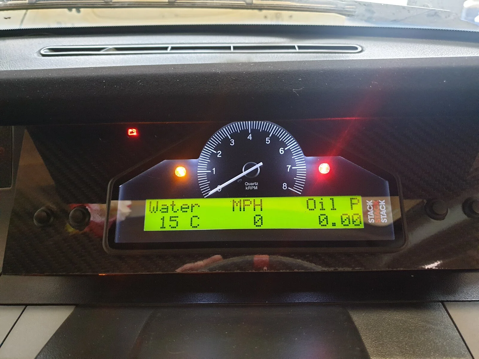

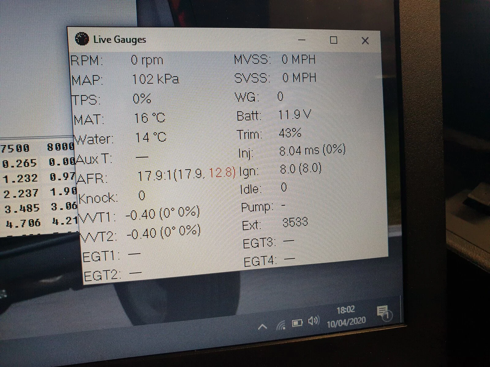

Fired the laptop up and checked everything was reading ok.
Ambient temp high today, took egt as baseline saying 16deg
Ecu IAT 16deg, water 14deg
Stack dash water temp 15deg
Oil temp 16deg
All close enough so should be ok on next fire up. A few small jobs to do now but its pretty much ready for road test. Roll on end of lockdown.
Thanks for reading!!

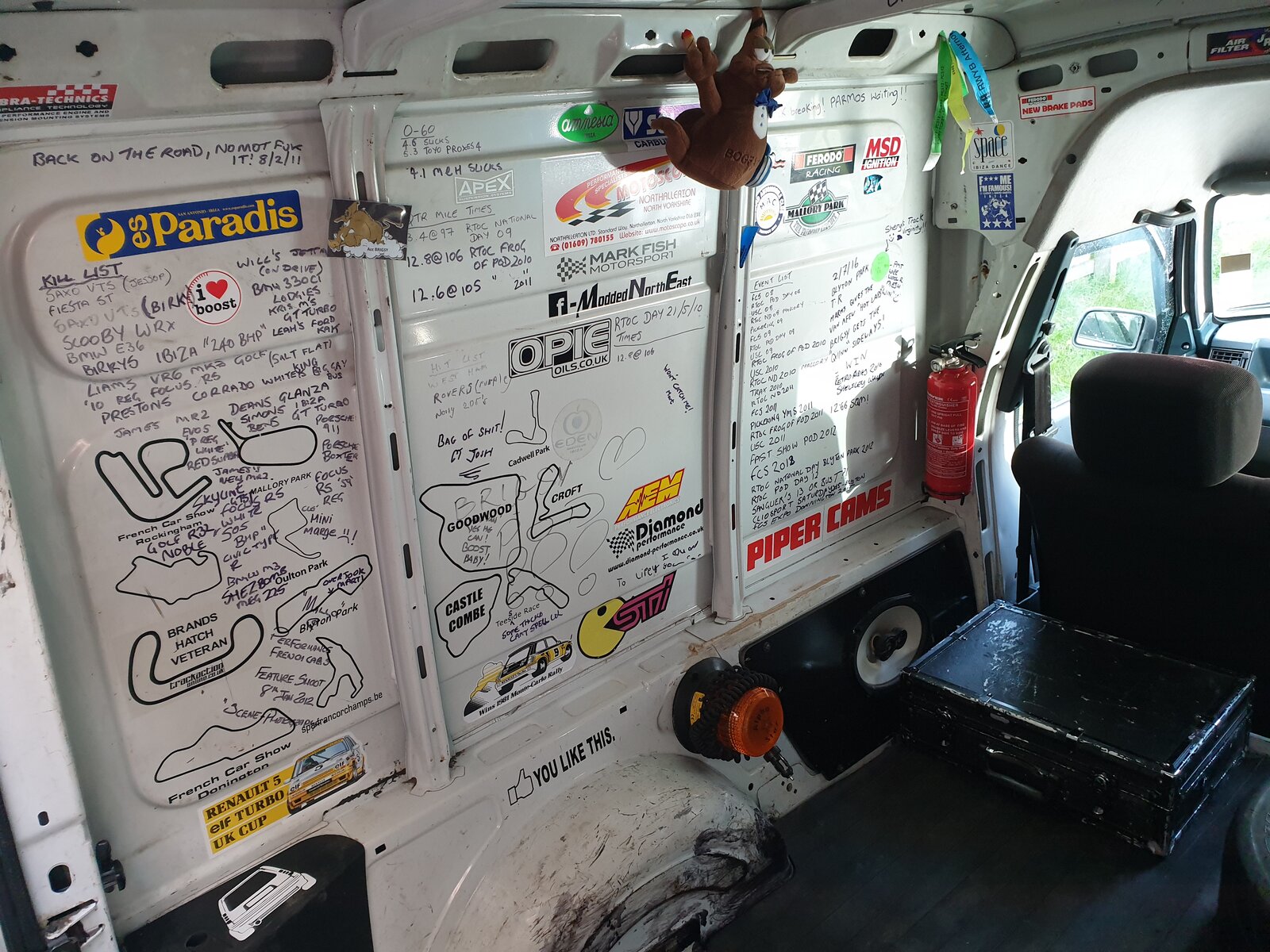

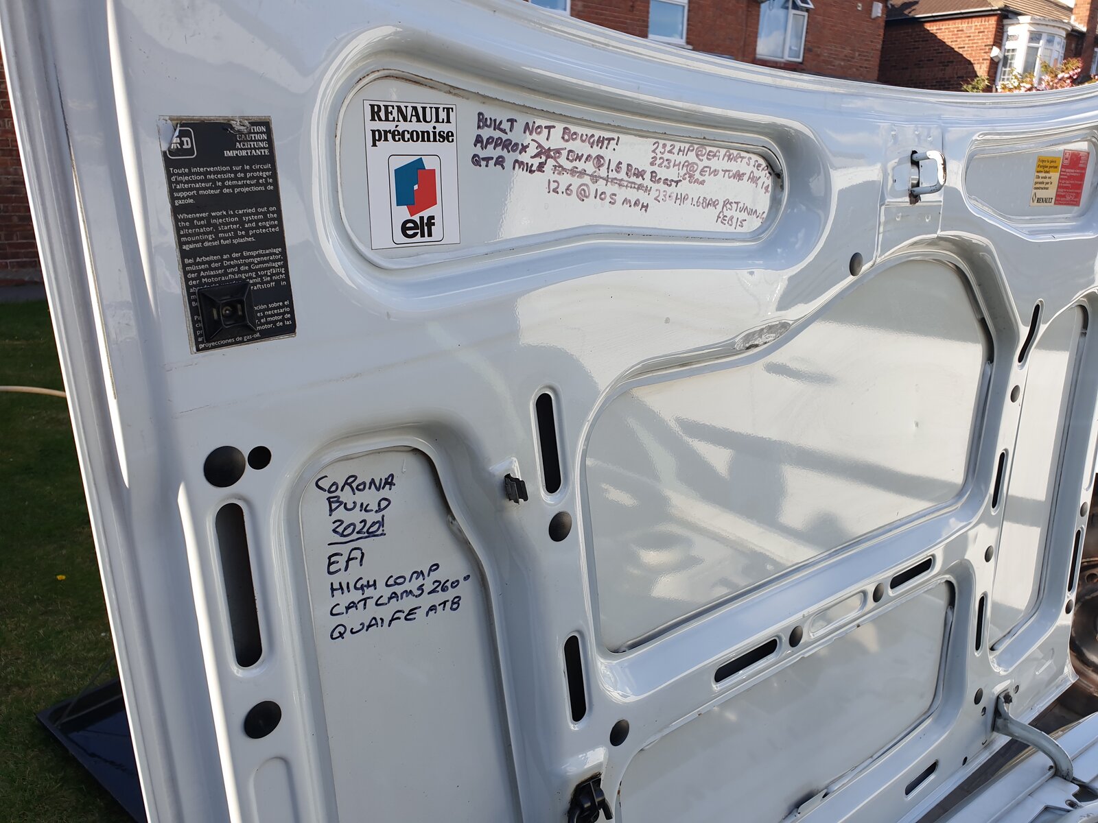

Writing on the bonnet is class 👌🏻😂
Should see the back, its chaos inside with graffiti, kill list and loads of track stickers. When i used to do a lot of drag racing, it usually ended up in a piss up on the night at Santa pod, and i used to leave the doors open and a permanent marker for people to do whatever they pleased ! Will get some pics of it.
This pic popped up today on facebook, i think it was 2010 at Santa Pod RTOC day. I had ran my first ever 12.88sec qtr mile on 22x8 M&H drag radials that day, still fitted in the pic. The pod nights were wild back then and anything seemed to go if it was doing no harm, Whilst bbq was warming up we had a toilet run, i think 13 of us got in. There was no room for me and my mate was driving, i had to stand on the back bumper good job it was crawling pace :LOL:

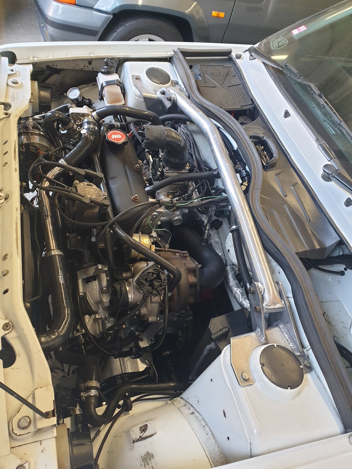

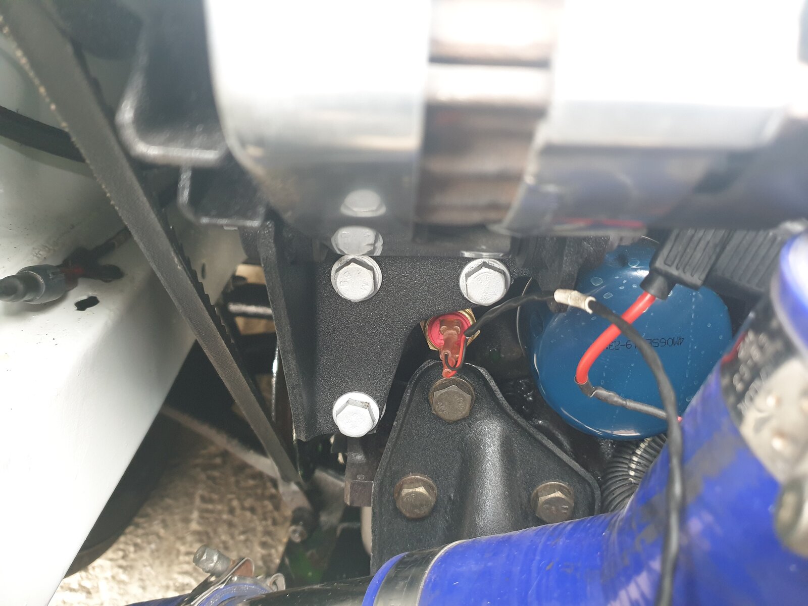

Needed to give it a start up to leak test the cooling system and a couple of oil fittings. Fired up willing and no issues, batt light was on so give the alternator connector a remove/refit as i had been in that area fitting the boost hoses which cured that issue. Give it a little rev and noticed the fuel pump noise really pick up the pace which seemed a little strange, so went through the menu on the stack dash to display voltage, 14.4v on idle, when revved to 2k rpm 16.5 volts o_O that will be the regulator shot and overcharging.

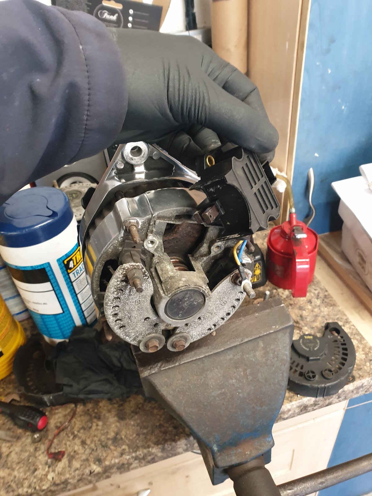

Turned engine off to save frying anything, tried to remove the alternator reg in situ as access was easy but fitted with the tightest slotted screws ever. Had to resort to taking it off, replaced with a new one off a recon volvo alternator i had in stock. Turned out to be a good move, as the bushes were worn right down on current regulator.
Refitted and fired up, and seen 13.8 volts whem revved, a lot safer than last time. Ran it to the rad fan kicked in, tweaked the idle cells on the map slightly to lean the idle off. Intetestingly with a stock thermostat and rad fan switch, it runs loads cooler on idle on EFI compared to carburettor. Highest recorded coolant temp i have seen is 80deg on the Stack dash, slightly less on ecu and the rad fan does not cut in very often, as any gtt owners know the fan usually cuts in every minute or so on idle.

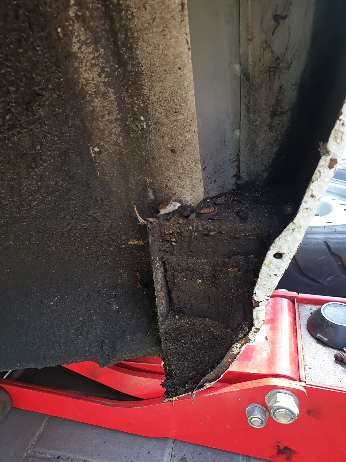

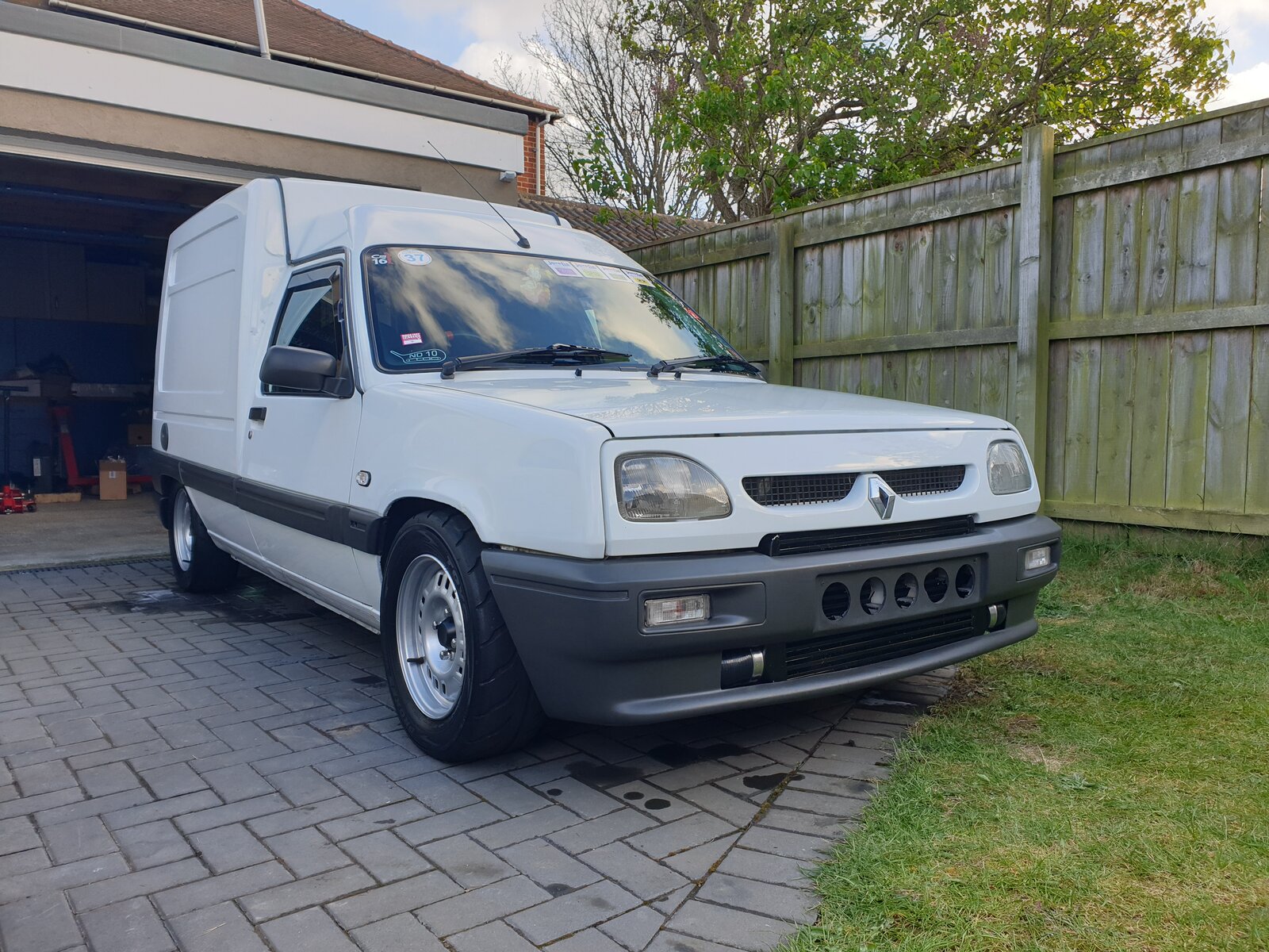

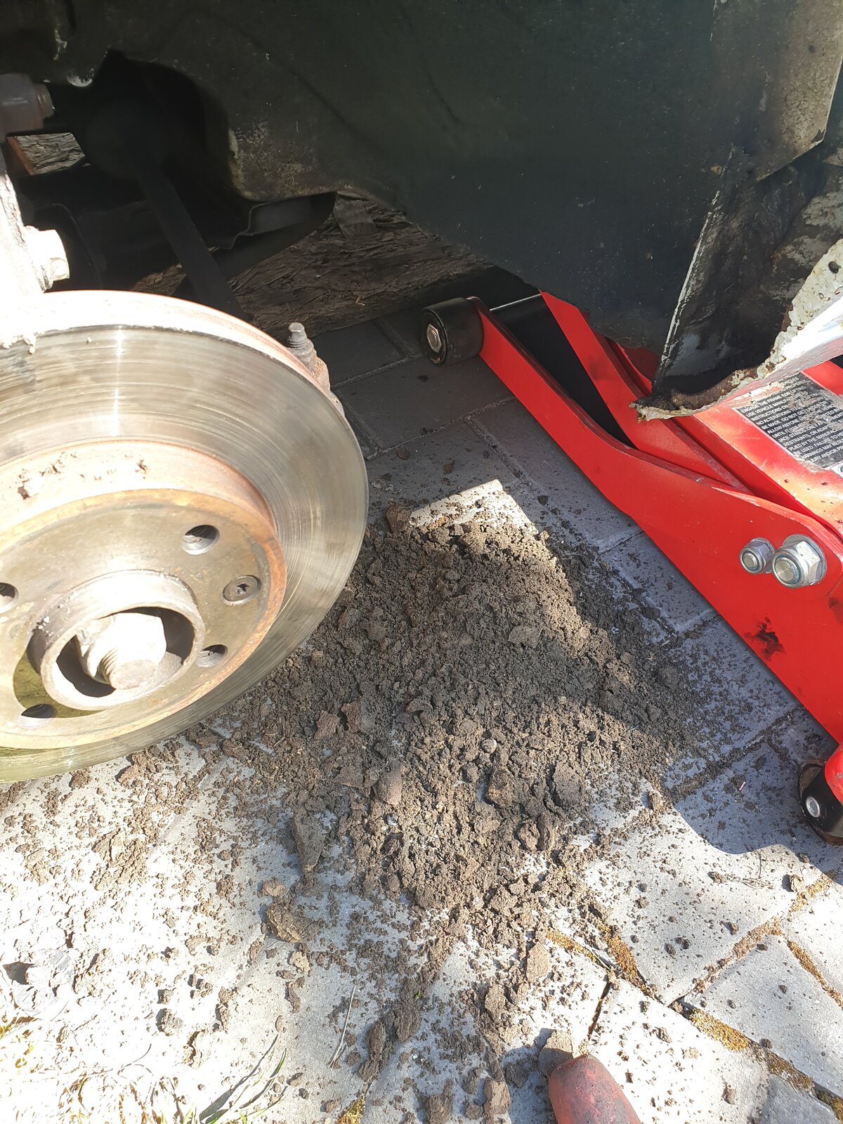

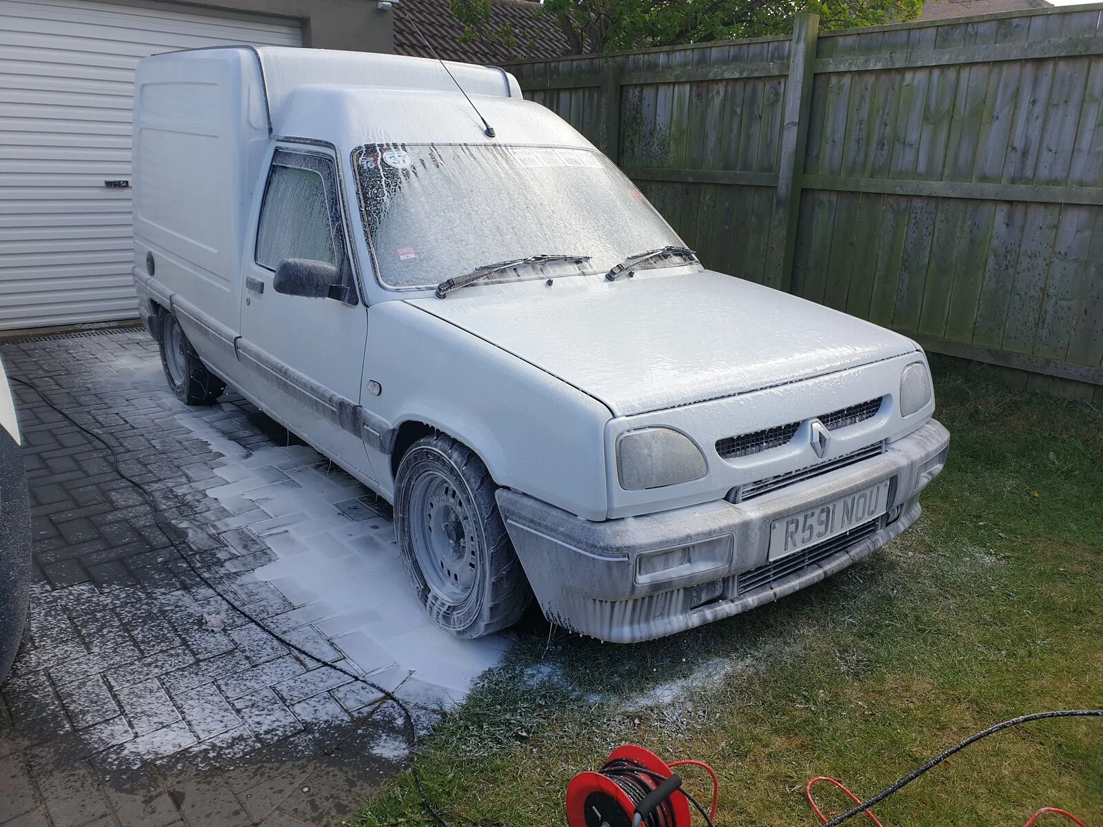

Cleaned up the Extra last week. Started by jacking the front up and cleaning out the arches. I had wondered why the lower wings had rotted quite a bit over the years considering its been garaged forever. Removed arch liners to reveal solid mud up the pillar, that would explain the rust.
Full shovels worth. Sill looks good and solid with only surface rust so cant moan.
Might have lasted a bit longer if i had cleaned it out ten years ago, but when i built this it was driven and not washed, and didnt even think about keeping it for a longer period.

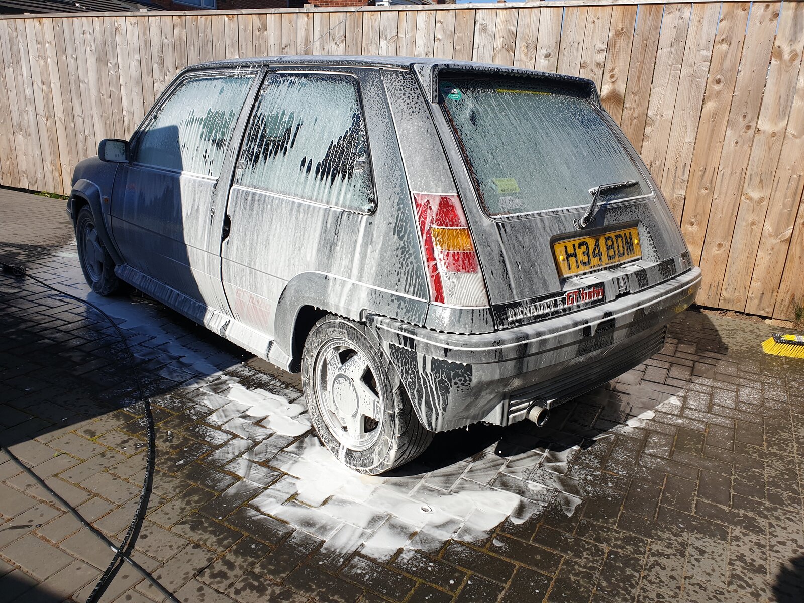

Anyway rust treated and put back together, BH autofoam and rinse, 2 bucket wash, a quick go over with Sonax BSD and Autoglym trim gel, tyre black and it looks half decent for an old van.
Plate off track look.

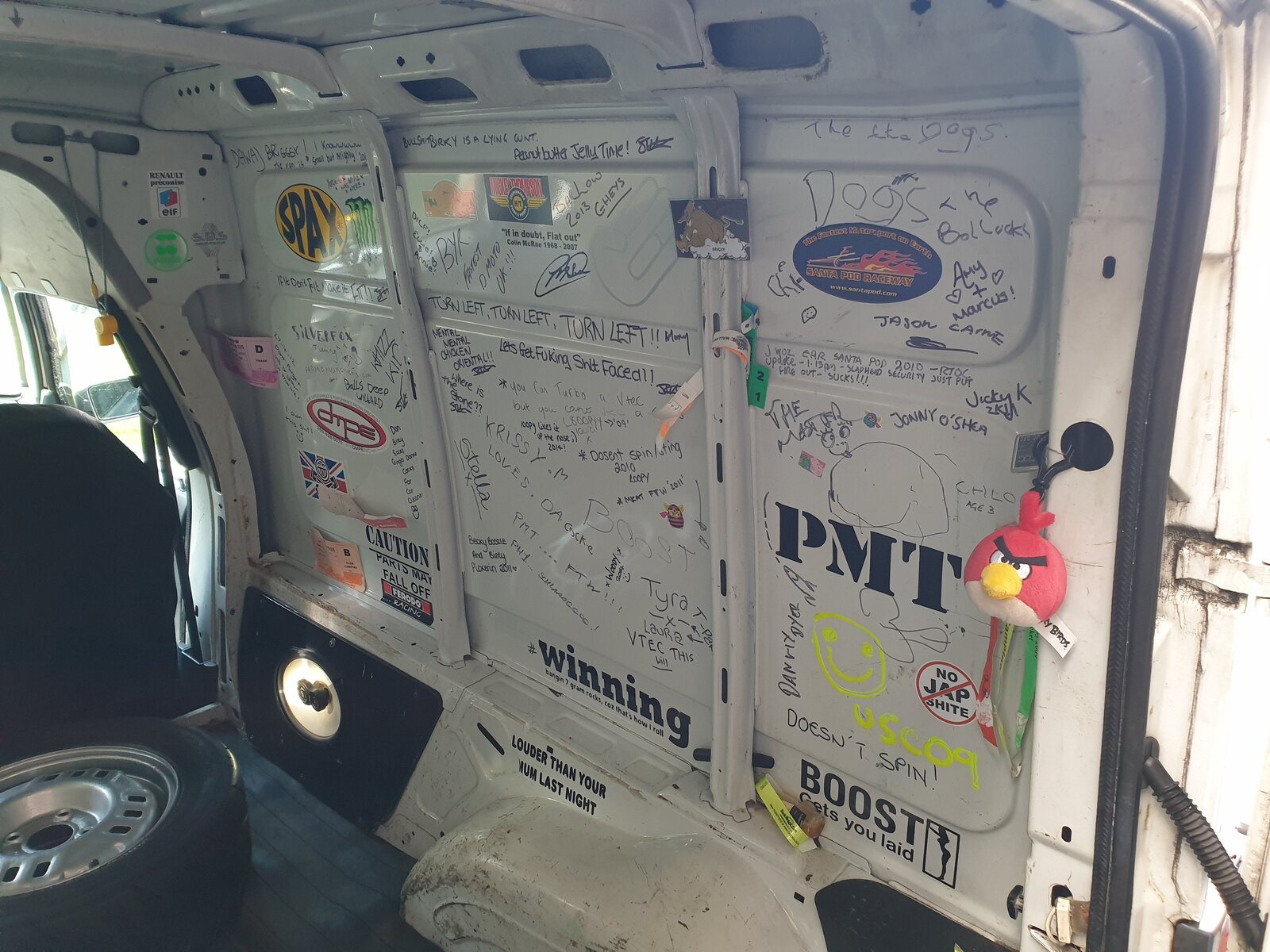

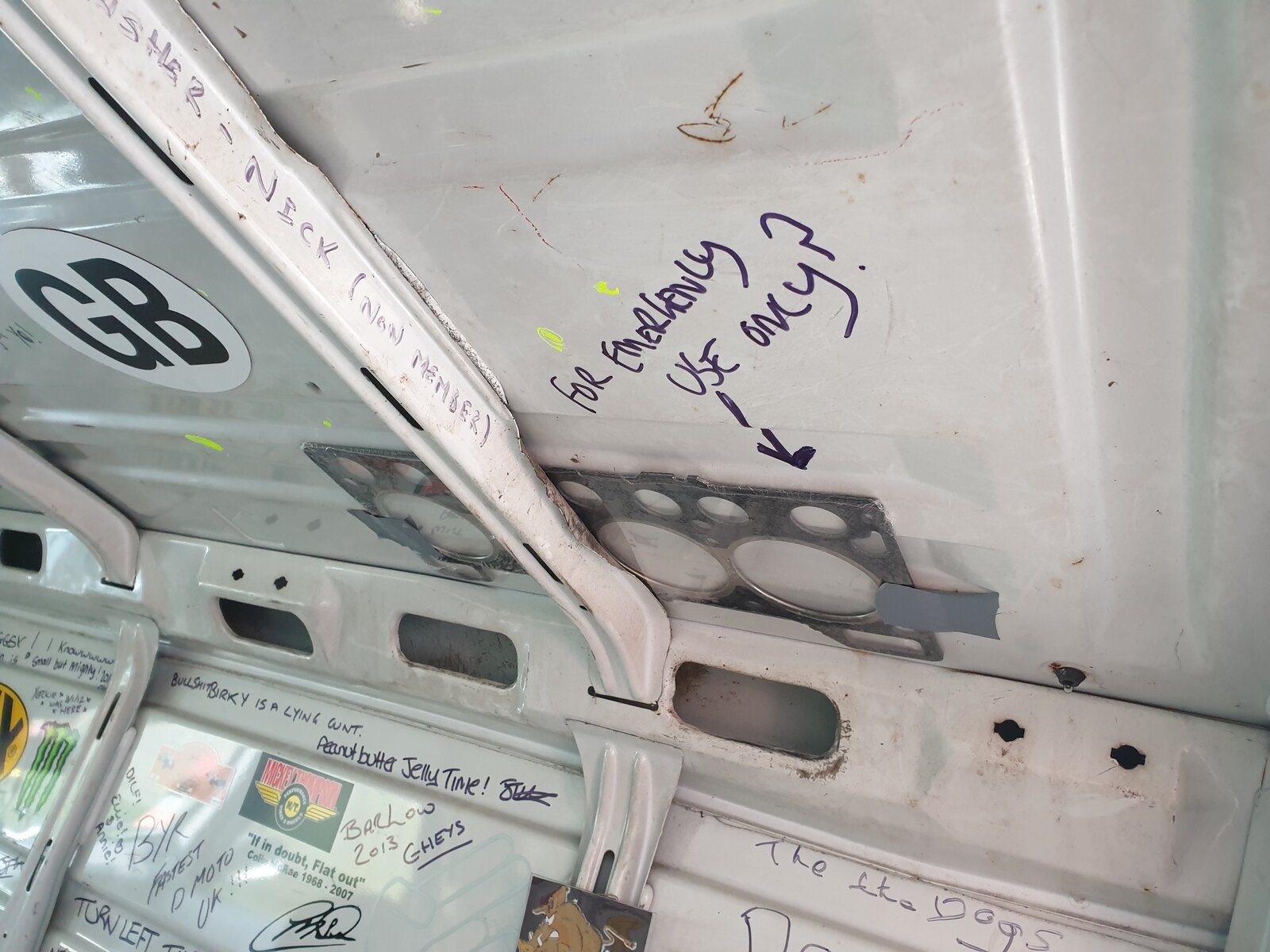

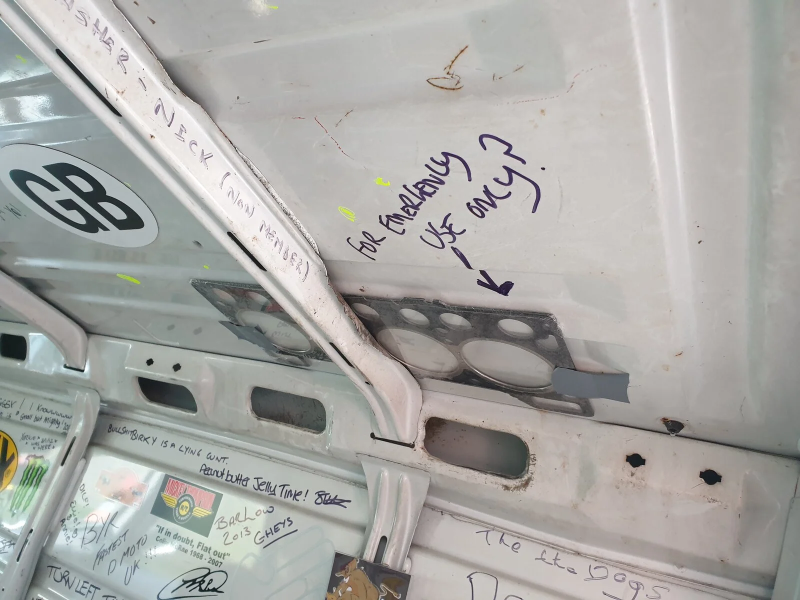

inside pics showing all the graffiti in the rear, some poss nsfw :LOL:

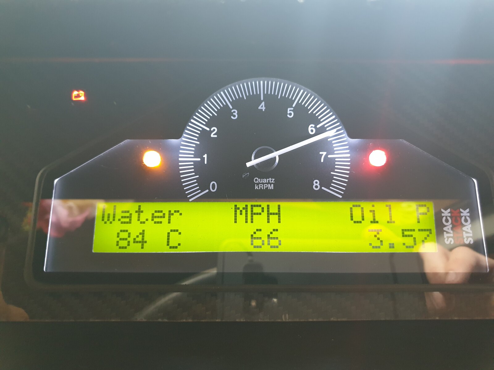

Inital thoughts on efi, drives great on base map, engine feels very responsive but still makes all the right noises so has not lost the character. Ive only used low load/low boost and lots of engine braking to force the rings tight up against the cylinders. Fuelling seems good, ive set it up to run in closed loop at under 100KPA on the map so its generally around 14afr when cruising, but richens up straight away when on boost to 12.0 and dropping to mid 11's so safe as houses. I bottled it at 8lbs as no knock detection and ign map might be way off, but it felt willing and wanted to go.
Also noticed that the coolant temp lingers around 76deg on the move, quite a bit lower than carb, i assume the engine is very happy with an injector per cylinder.

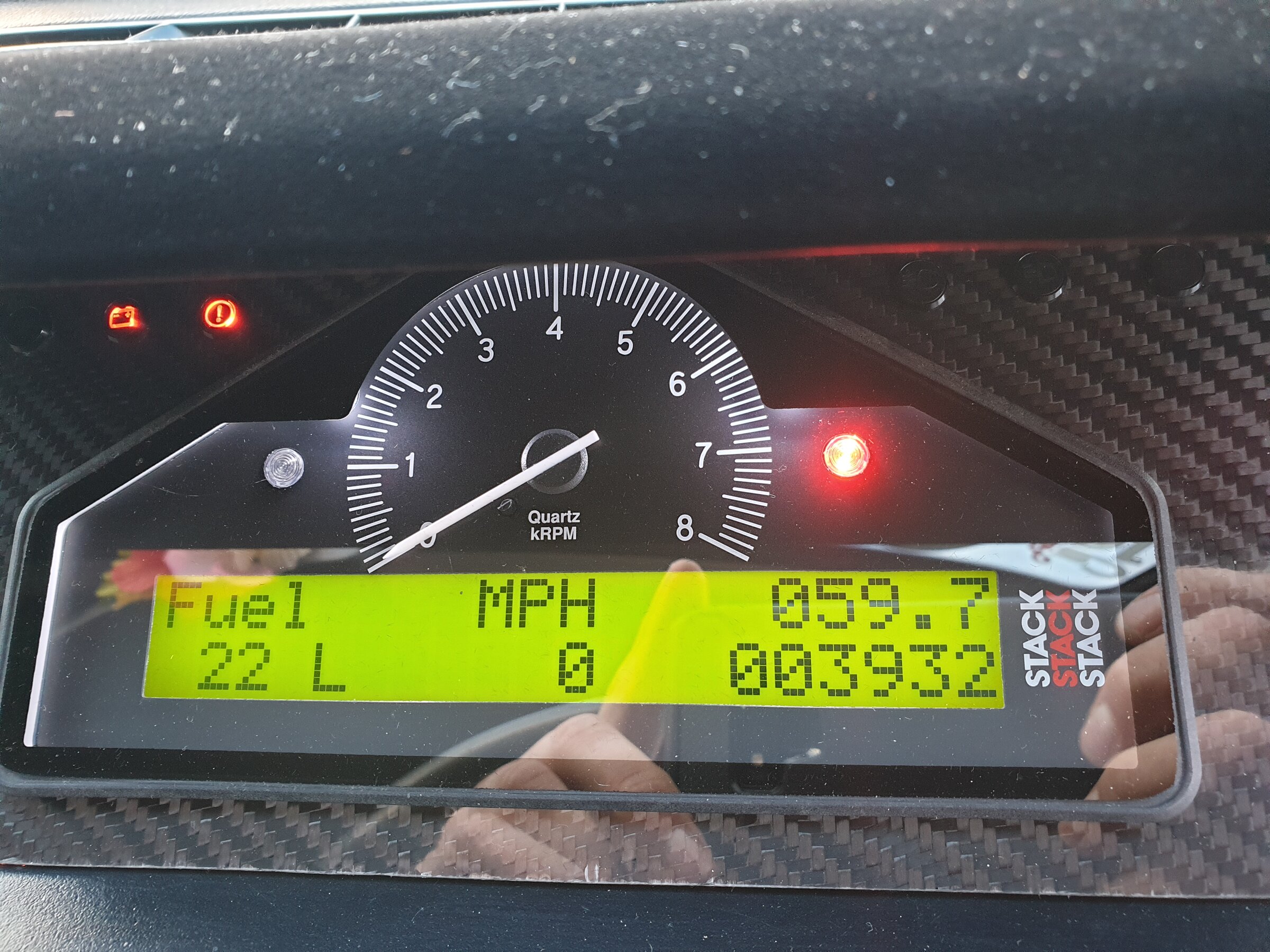

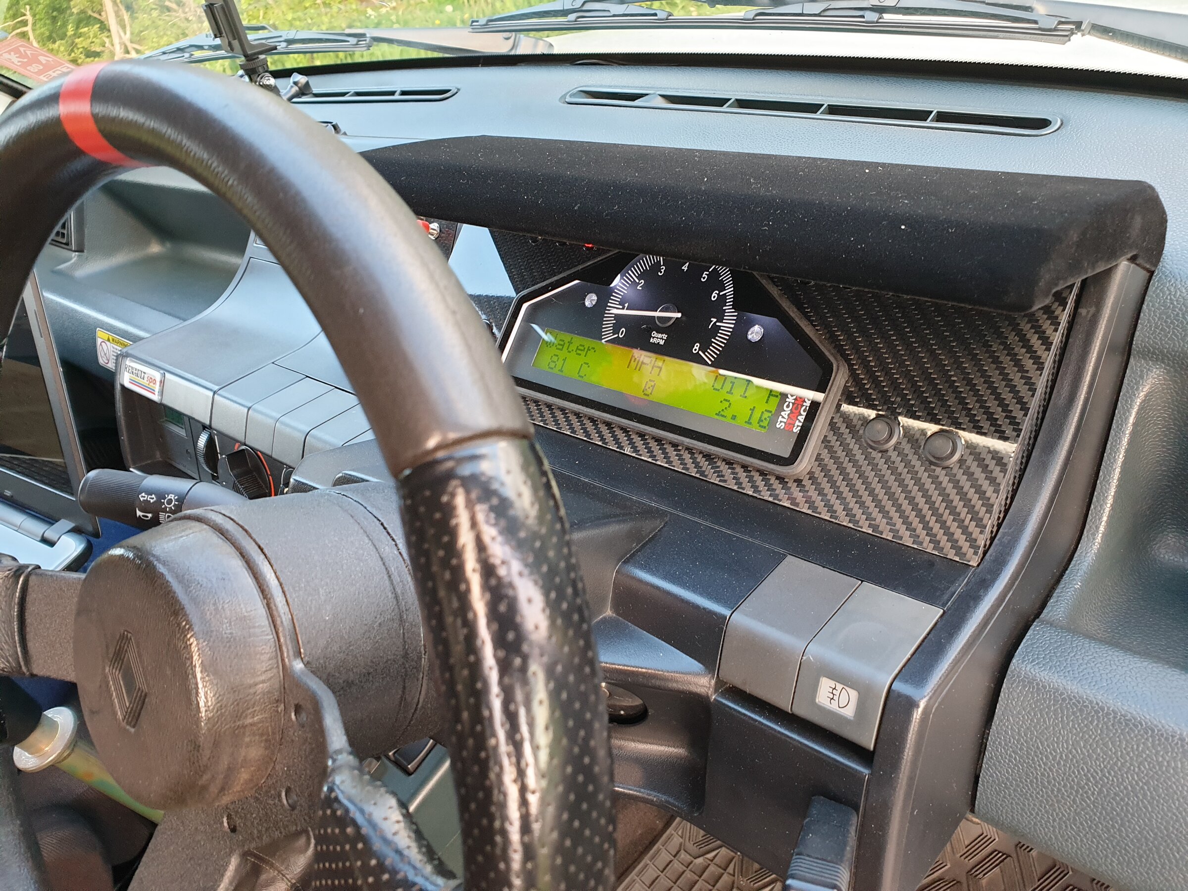

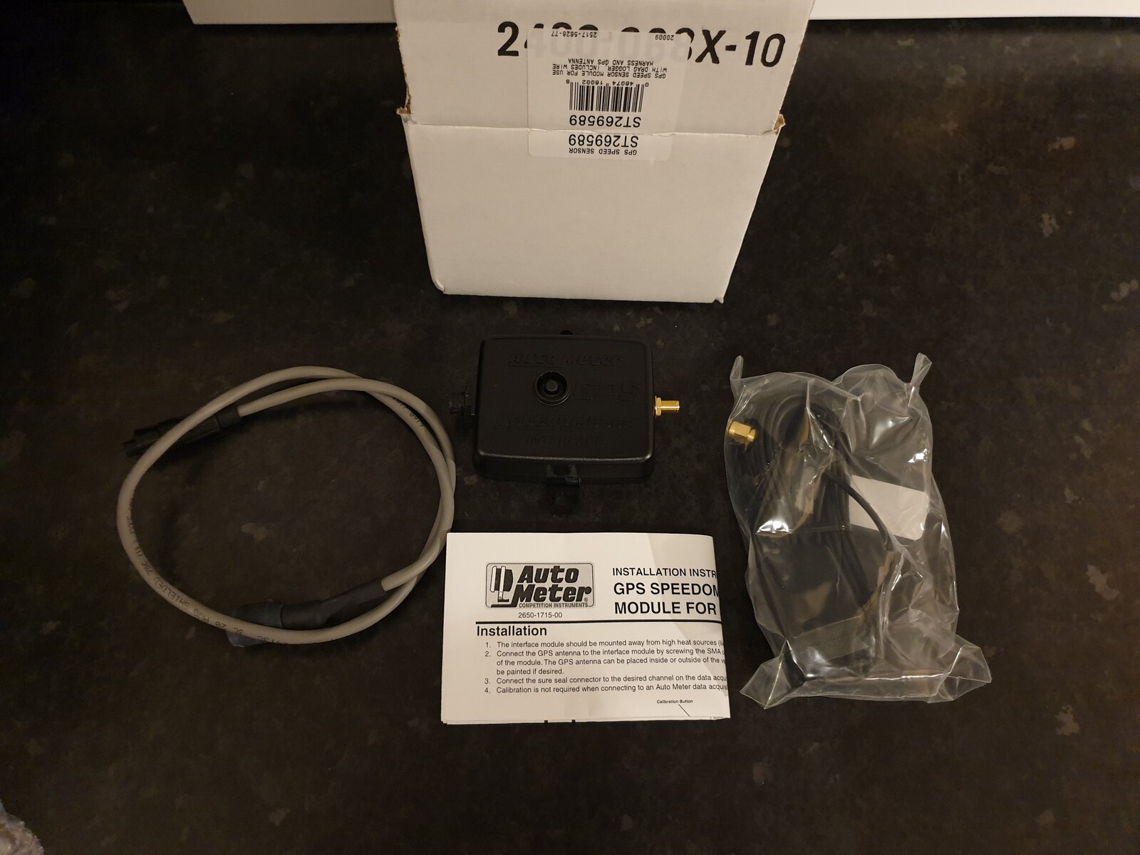

Have got my money out and bought the expensive gps speedo module for the stack dash.
Such a buzz to drive it again after all these years. Roll on mapping when Efi parts open up again.

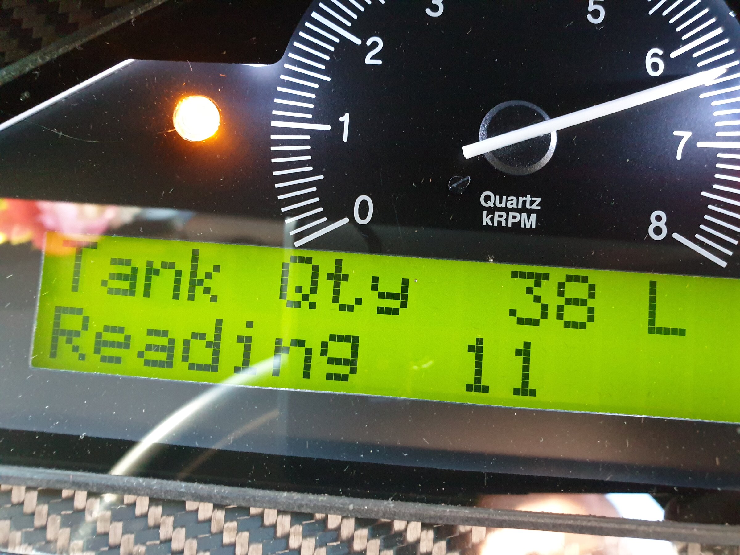

Fitted the Stack gps module yesterday, i could have rammed it behind the dash but stashed it in the cubby hole for easy access to the calibrate button. Dead easy to install, simple plug into the stack wiring and fit the antenna in the windscreen area, its a small discreet magnetic antenna so stuck it on the A pillar.
Pulled out for a short drive to the shops to test
Dash needed some settings changed as was massively overreading initially, but got that dialled in and seems to be very accurate, really fast to respond so quite pleased with the result. Recalled peak details on the stack dash.

Pulled the cars out for a clean yesterday.
225 done first, BH auto foam, 2 bucket wash, dried and a coat of Sonax bsd. Cant wait to use this once lockdown is over.

Cured the lazy start issue. Fitted the megane battery on, which improved things a bit. Fitted some beefy 35mm2 earths from engine block and it cranks over mega fast now, so a combination of both poor batt and poor earth:cautious:
Been chasing minor coolant leaks as a few joints are weeping when stood for a few days, no leaks when running and the system holds good pressure when tested. Cheap chinese silicone hoses for you, were ok years ago but the standards have dropped massively now.
Have nipped every joint and its OK for now, but the plan is to bin them eventually for sfs or samco matt black hoses.
Had the pleasure of calibrating the fuel gauge yesterday as had no idea how much fuel was in when low.
Drained the tank and gob full of fuel, fill 5ltr container, pour into tank, repeat, get covered in fuel etc. Worst job ever but done, been putting this off as i knew it was a s**t job. It said 5 ltrs left on last calibration and had about 3ltr in the tank so not the best. This time i stuck 5ltrs of fuel in and set that at 0 so it will always have a gallon if your really stuck. Stopped at 38ltrs as i ran out of fuel.
Its been out on the shopping run a few times recently and have clocked up 80 or so miles in total on the new setup and its running great. Just needs mapping now, have ordered Astra vxr blue 470cc injectors to replace the ancient saab reds in it and some fresh oil to change before.
Still love the retro stance

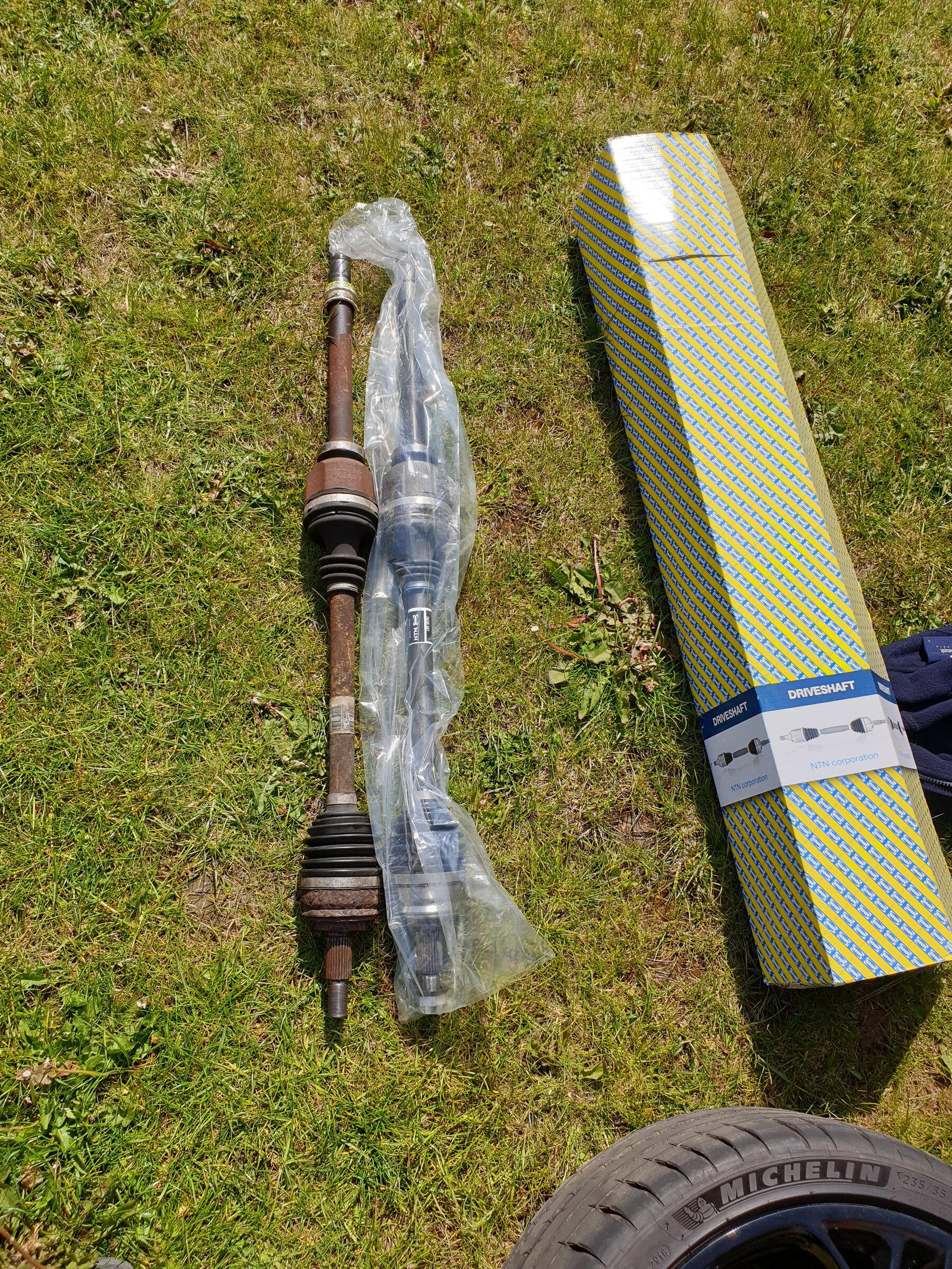

Yesterdays job, change the o/s driveshaft on the 250. Inner joint was worn/dry and causing some vibration when pressing on. Ordered the shaft from autodoc, £140 for SNR/NTN which looks to be oem without the price tag.
Hate working on the meg3 suspension, but all went smoothly and done in a steady hour and half. Cleaned the inner arches up, greased brake pipes, oil changed for Elf 5/40.
Shell is so stiff as stock, both wheels up off the floor and same height.
Not road tested yet but hopefully job jobbed. If its right, next step will be intercooler and exhaust upgrade, and map to suit. Prob leave the cat in this one to save the chew come mot time.

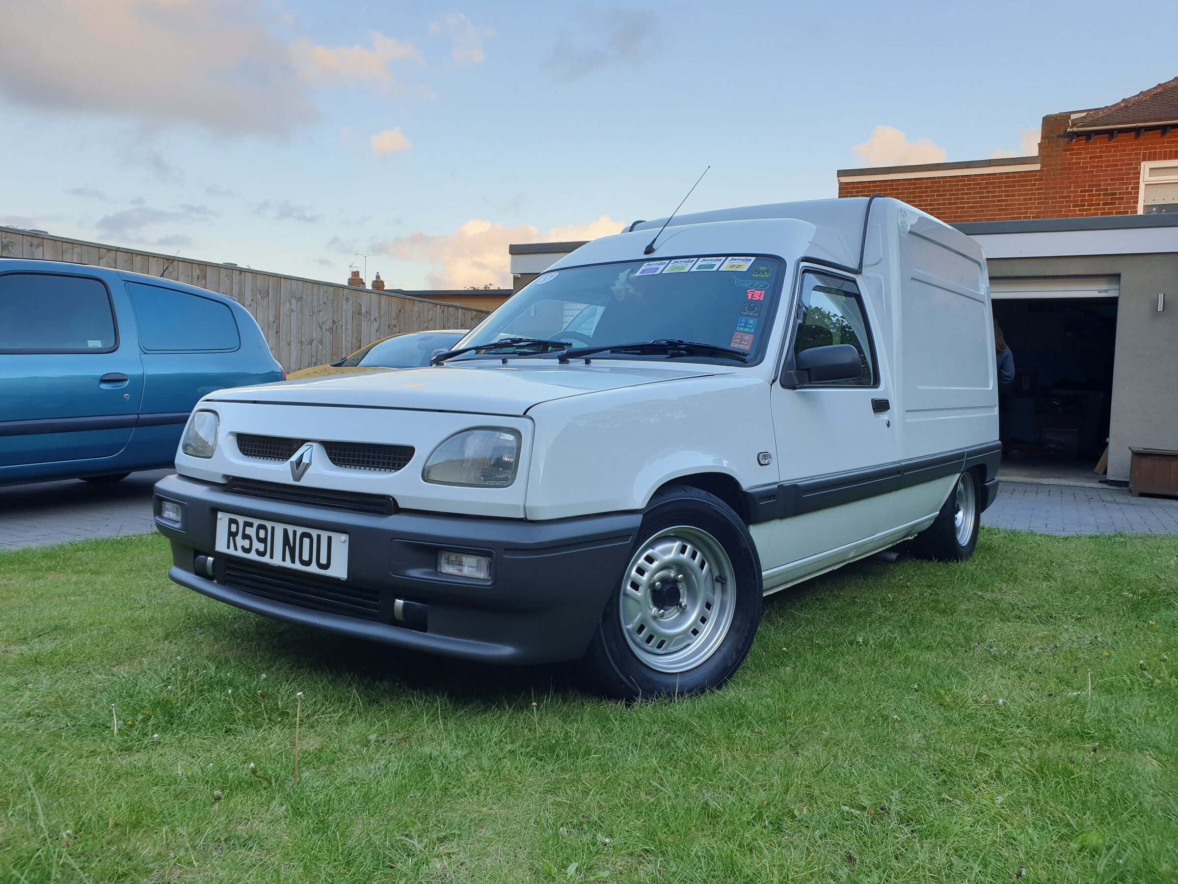

Not much to report, Extra van running in is going well though around 170miles done now.

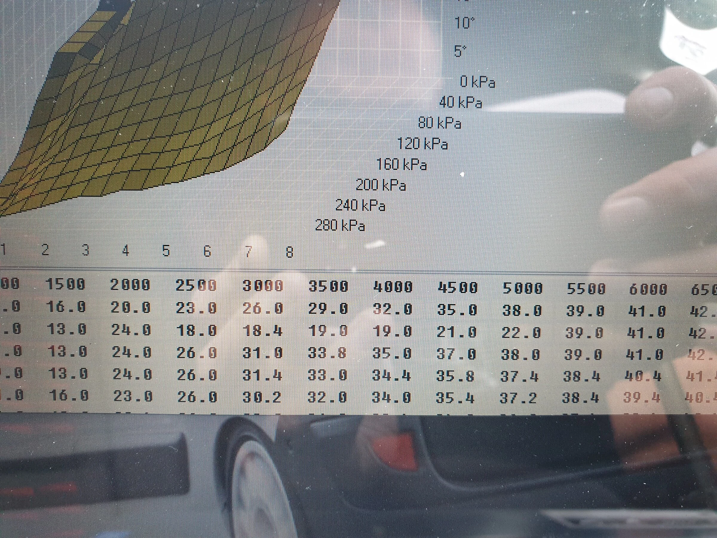

Done quite a few basic adjustments to the ecu map, ign and fuelling, drives really well considering. Still not boosted it properly yet, but some footage on the way to Lidl last week
Had to tame the pops and bangs on overrun a little, as it was savage with ign cells at 0kpa set to 0.0 between 2.5-5k. Upped it to more realistic levels of ign at 0kpa and its a lot less asbo.
Bottomed out the original to do list too

Running in miles going well, 280 or so miles covered now. Ive been to outstanding places of local beauty last 2 nights in the North Yorkshire moores for exercise ;) (y)

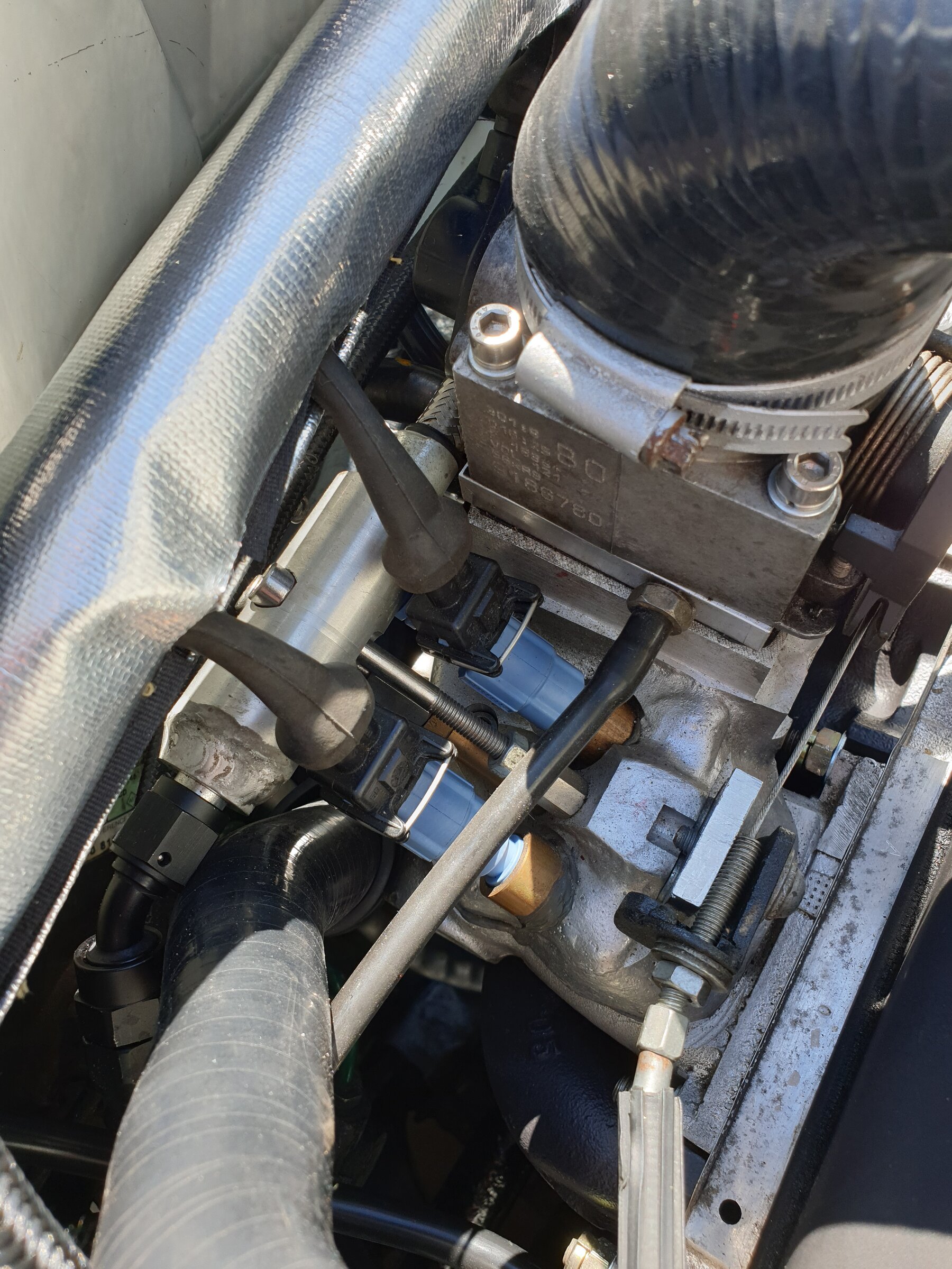

In preperation for mapping i fitted the vxr blue 470cc injectors, recalibrated fuel table to suit and changed the oil and filter.

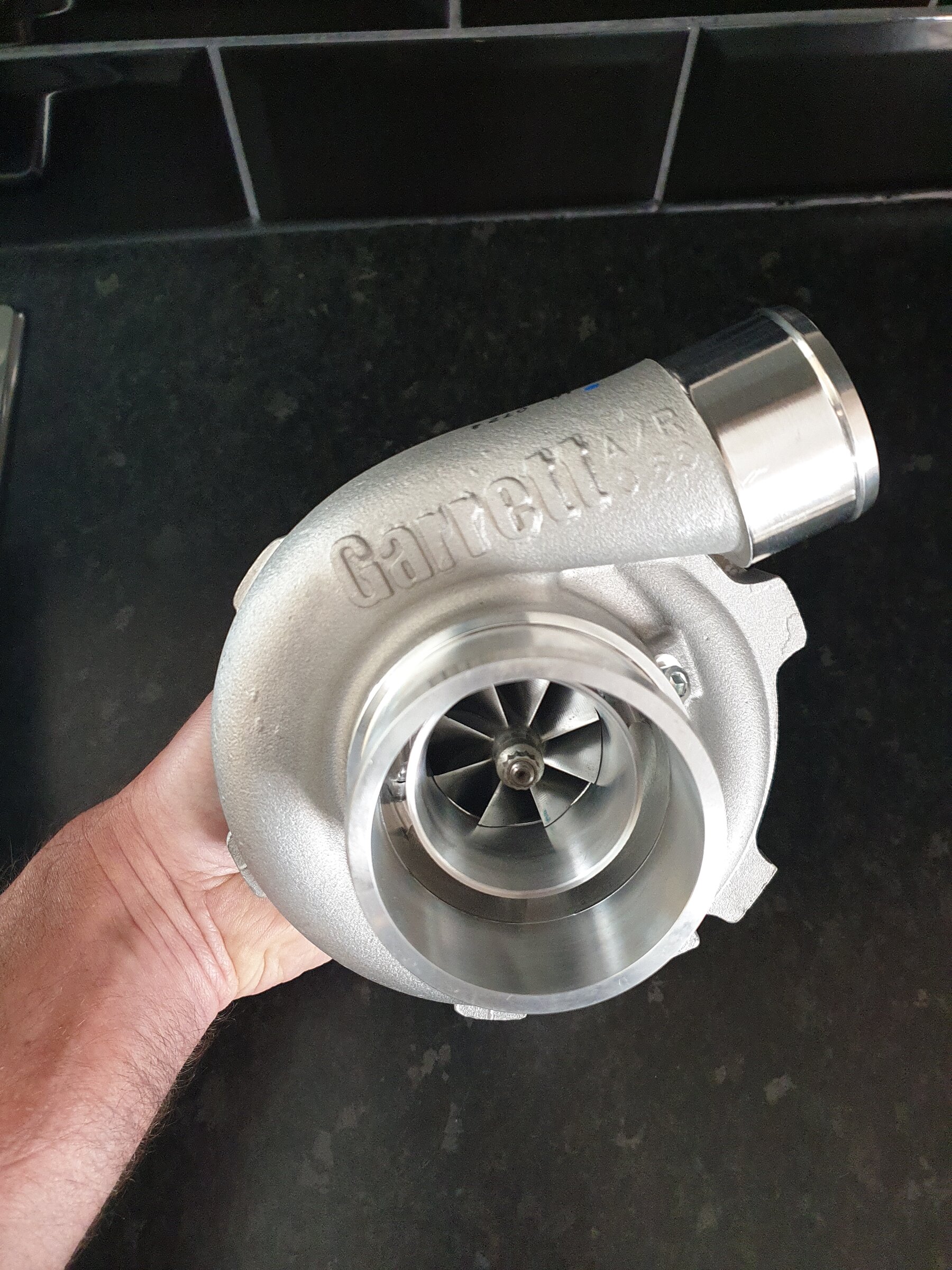

Today has been a good day, postman knocked at the door and my new turbo has arrived :love:
Will store it for a rainy day, as i need a 76trim exhaust housing, new 70mm trumpet for my airfilter and silicone bend, which all runs into a few quid. Tempted to fit a tial rear housing with external wastegate.
