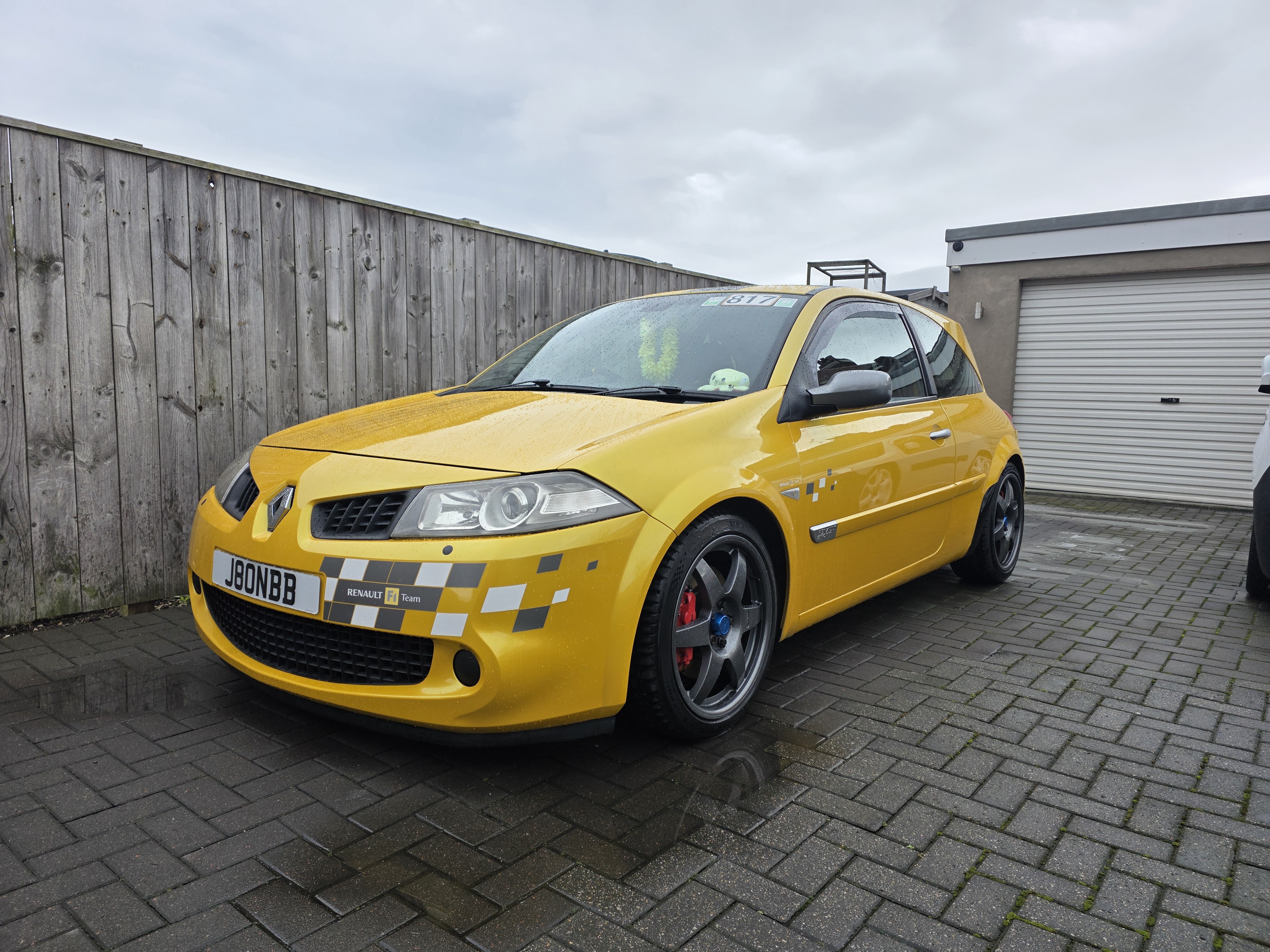

Bumblebee 2 featuring LY R26

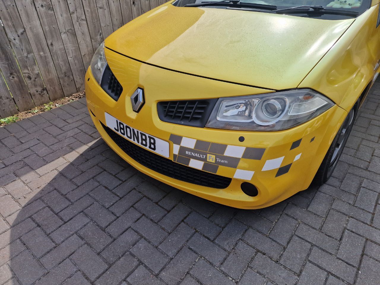

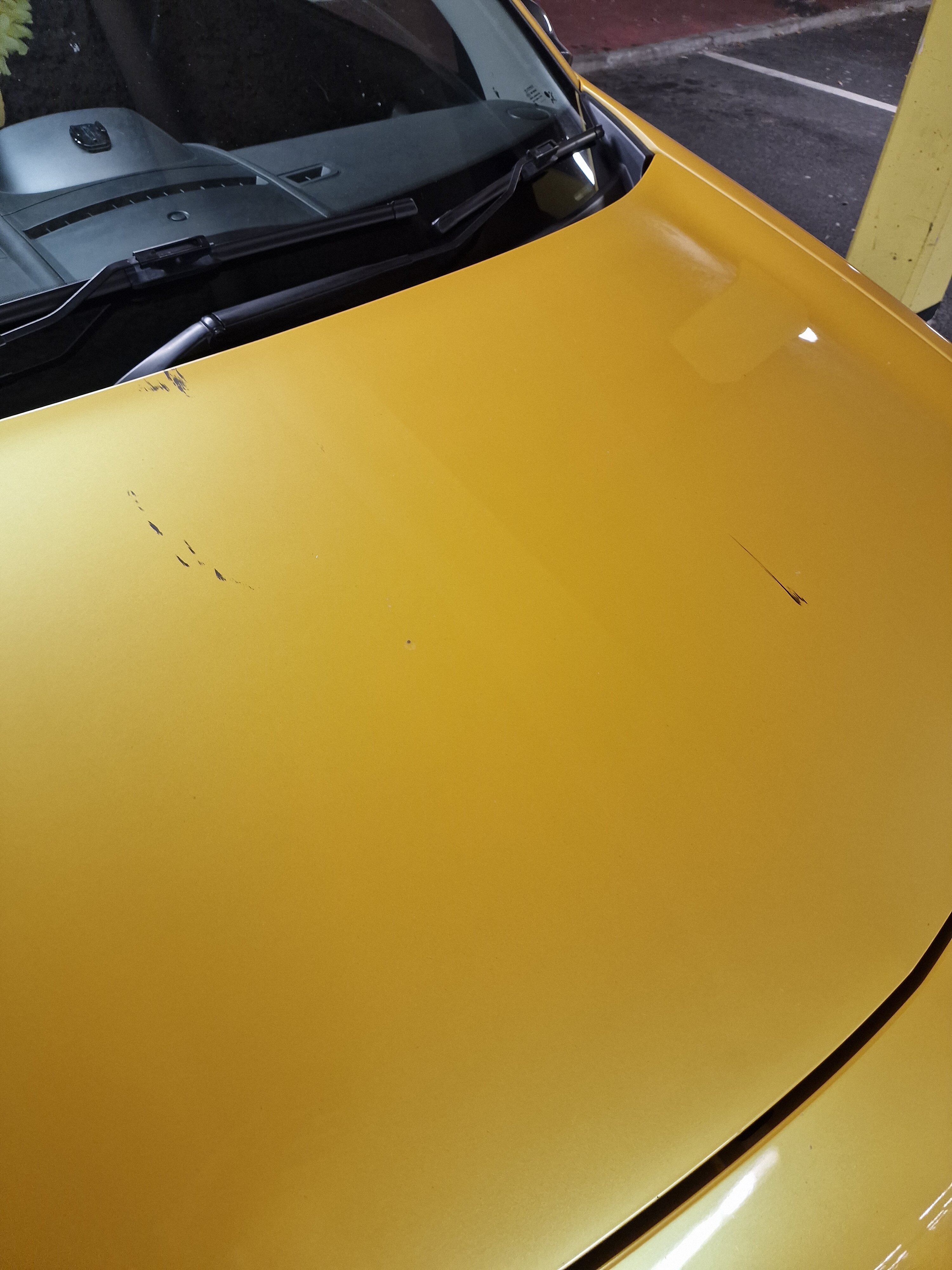

Quickly washed it on Friday whilst i had the gear out. Rubber marks all over it from Anglesey, i think every panel had a reminder on it :LOL:
With its intended use for track/fun/fast driving, i expect a few marks but everything came off quite easy. The coat of c2v3 i give it last week definitely helped.

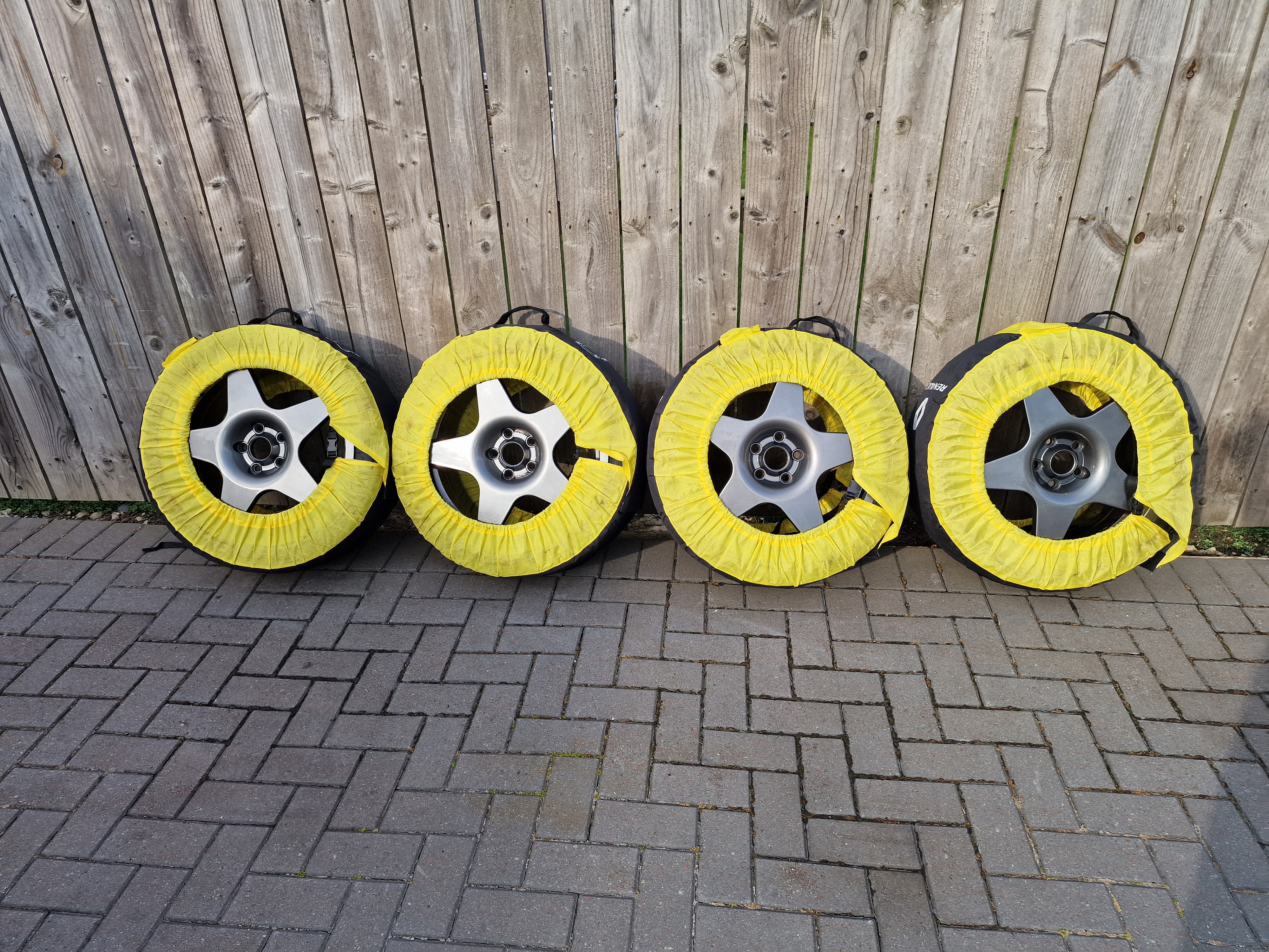

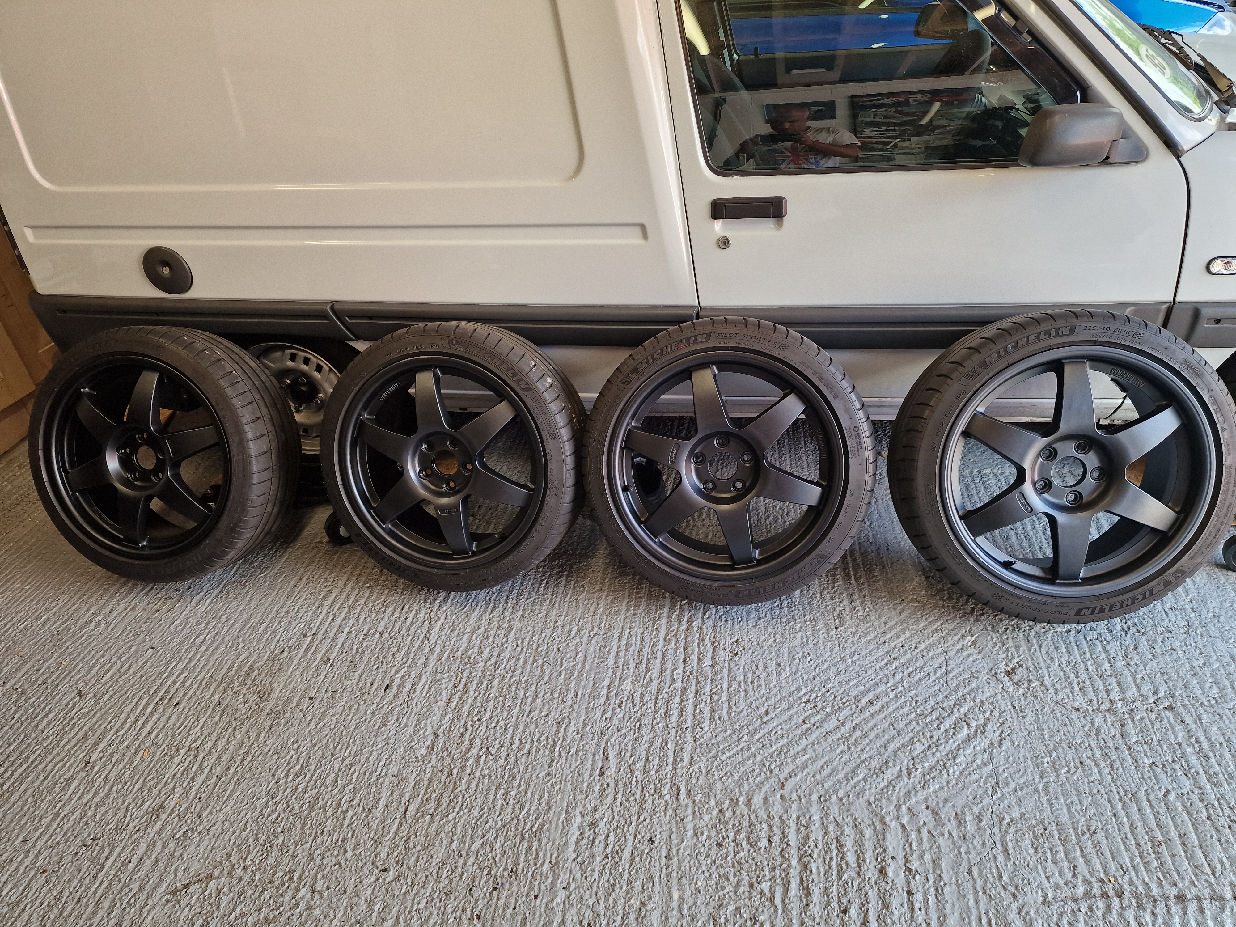

Also give the spare set of compomotives a clean to get the dust off and a coat of Gtechniq c5 wheel armour yesterday to help with maintenance.

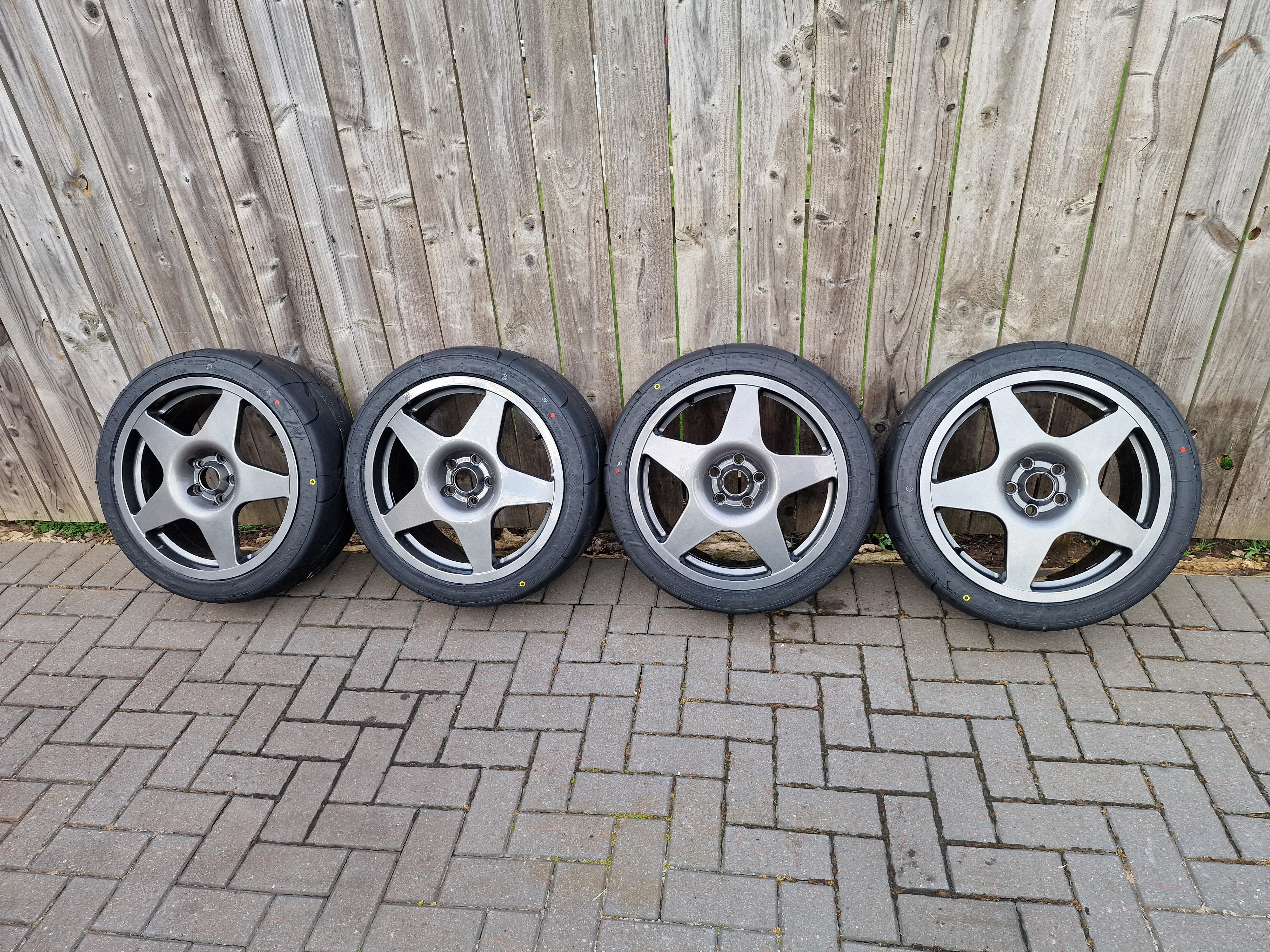

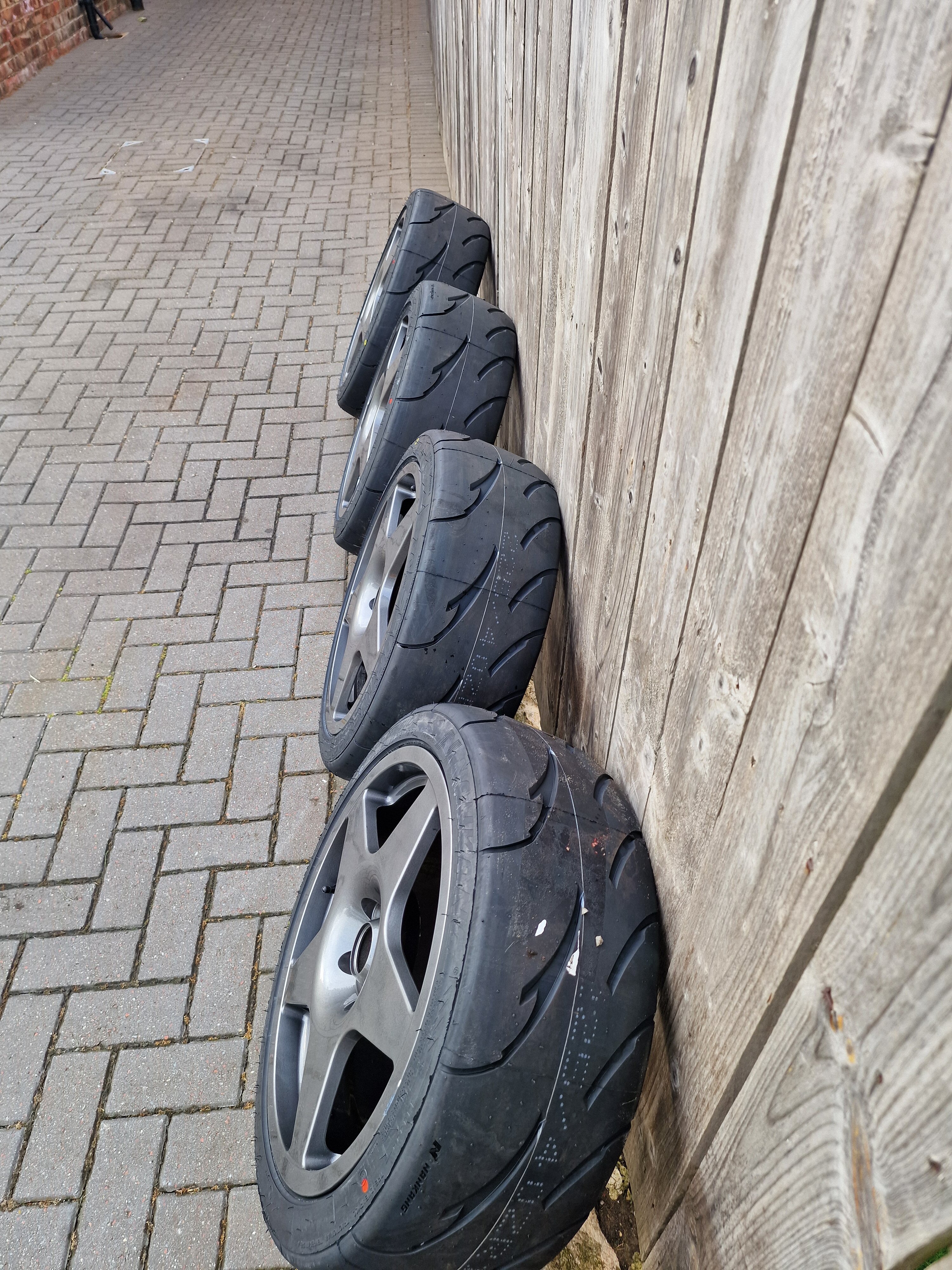

Had my new Ar1's fitted to the Technomagnesio alloys a couple of weeks ago. Give the wheels a mega clean as they absolutely needed it.
Cant beat fresh rubber.
Bagged up and on the wheelstand, ready for another day.

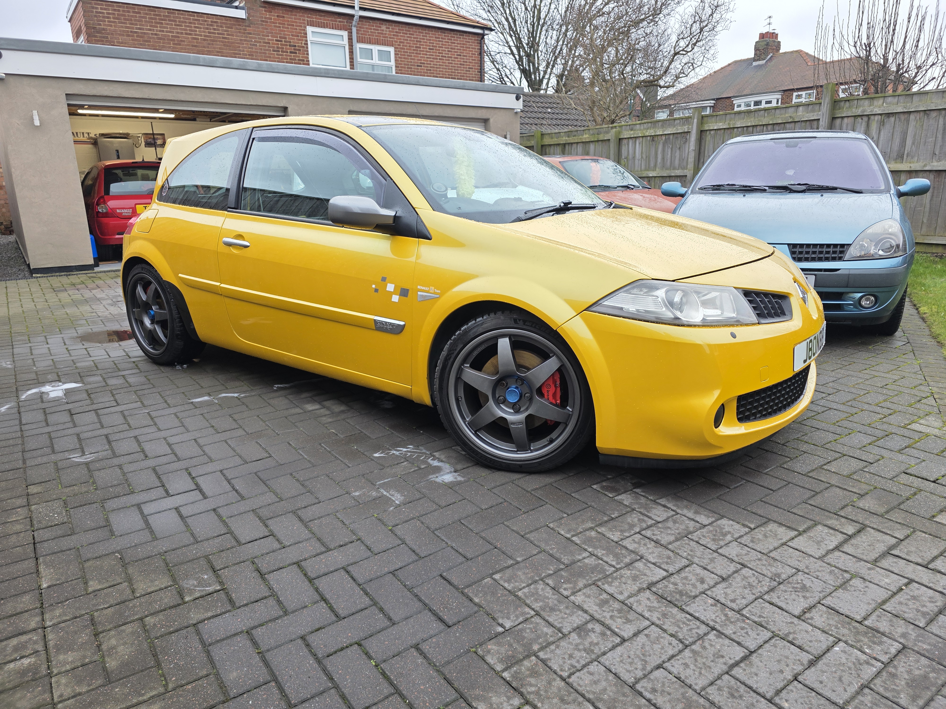

Done a few bits yesterday.
Polished the headlamps whilst i had the kit out doing the kangoo. They were starting to look tatty and light output on this aint great when they are faded. No pics before take my word for it, they werent looking the best.
Polished and protected with ceracote wipe.

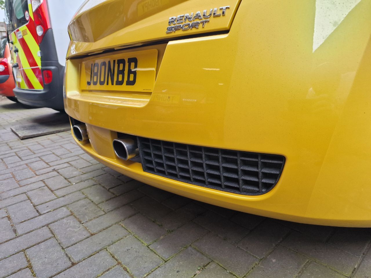

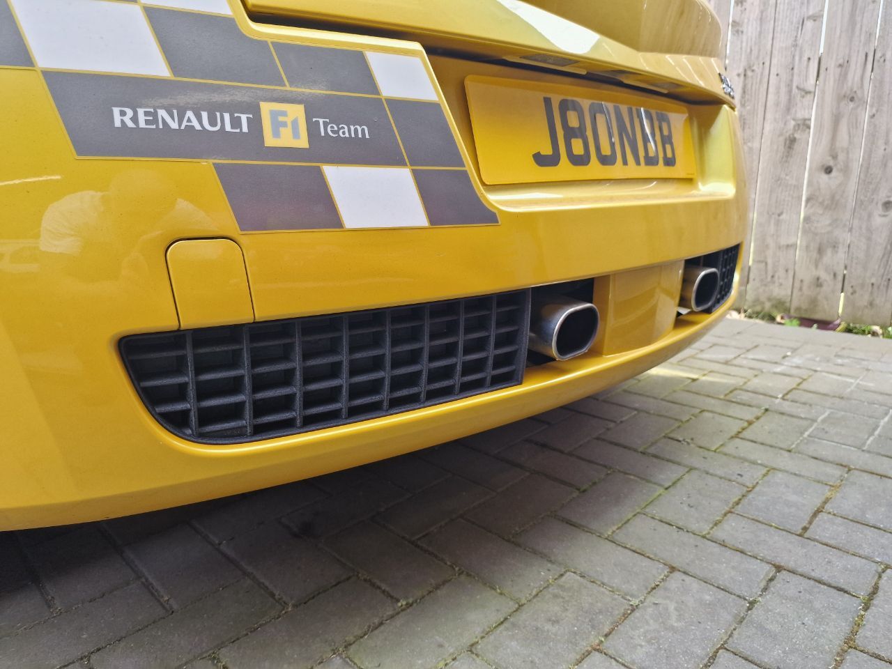

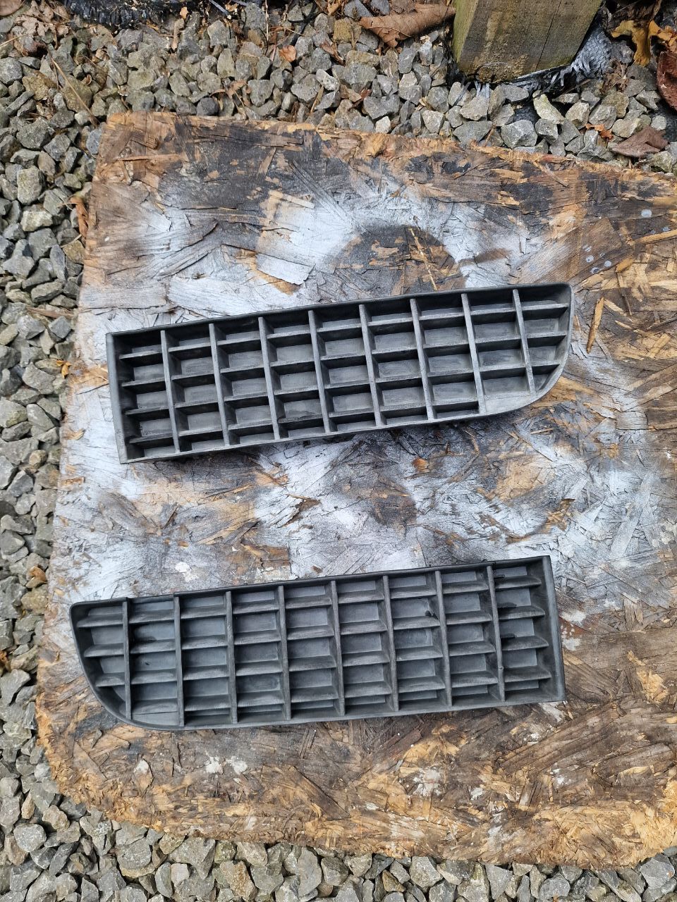

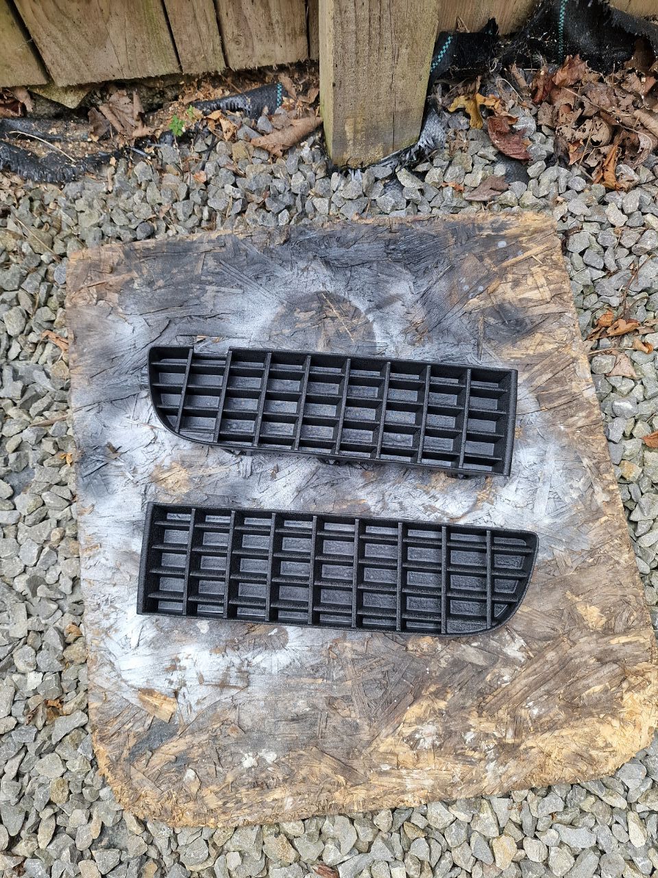

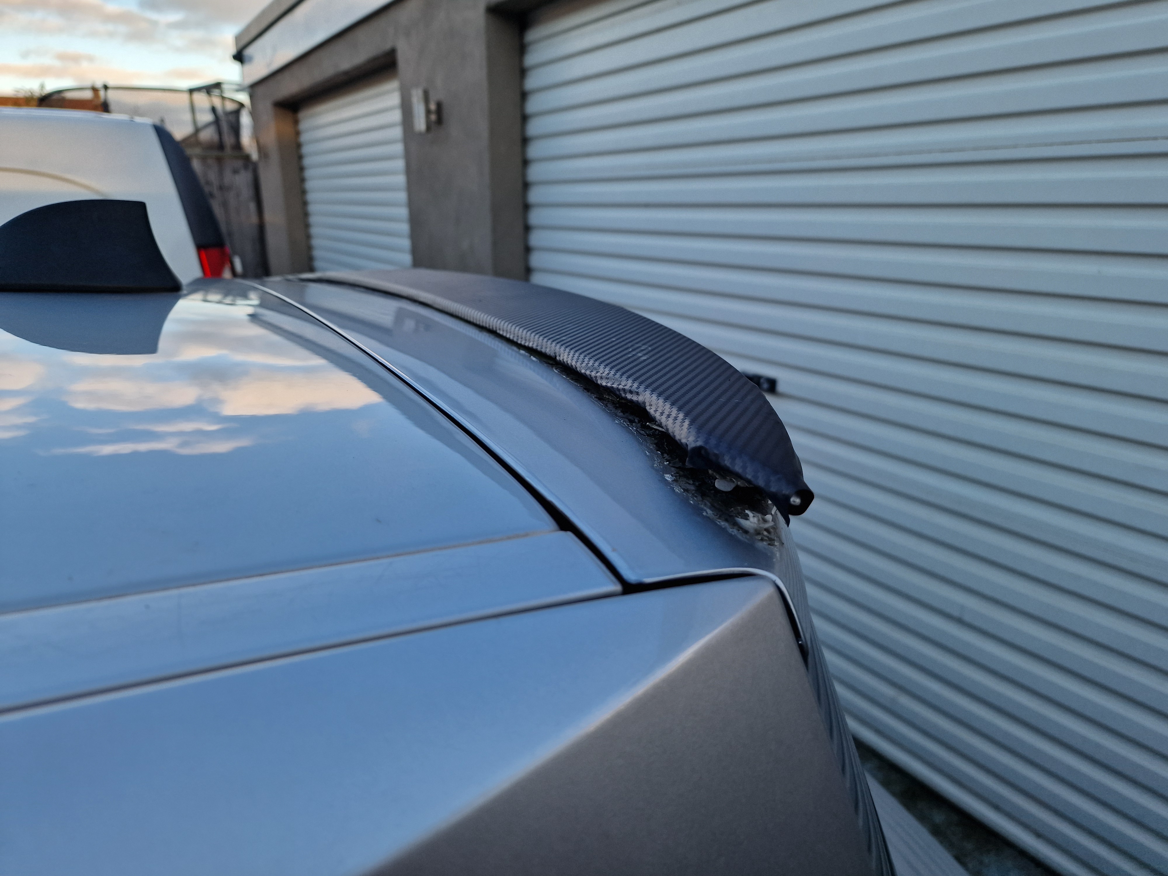

I had a quick look at the rear bumper trims which are faded to fcuk on this, with the aim to restore with a ceracote trim wipe. When looking closely they looked terrible, drivers side one looked like it had started to melt a little. (Could be due to hot lapping Spa last year or the sustained 150mph+ on the autobahns on the way back from the Nurburgring!?
Anyway beyond trim restorer. Note white bit looks melty.
Went on the spray paint shelf and was going to use bedliner paint, had ran out of that so it was vht black or vht wrinkle black. Vht wrinkle black was chosen as its darker.
Scotched the surface and blasted it on. Mid curing, heatgunned it to wrinkle.
Was unsure if the wrinkle finish would look ok but these were getting beyond saving so nothing to lose.
Fitted. Hard to get a good pic.
Looks ok, does not offend the eyes anymore. Not a bad result for an hour of work.

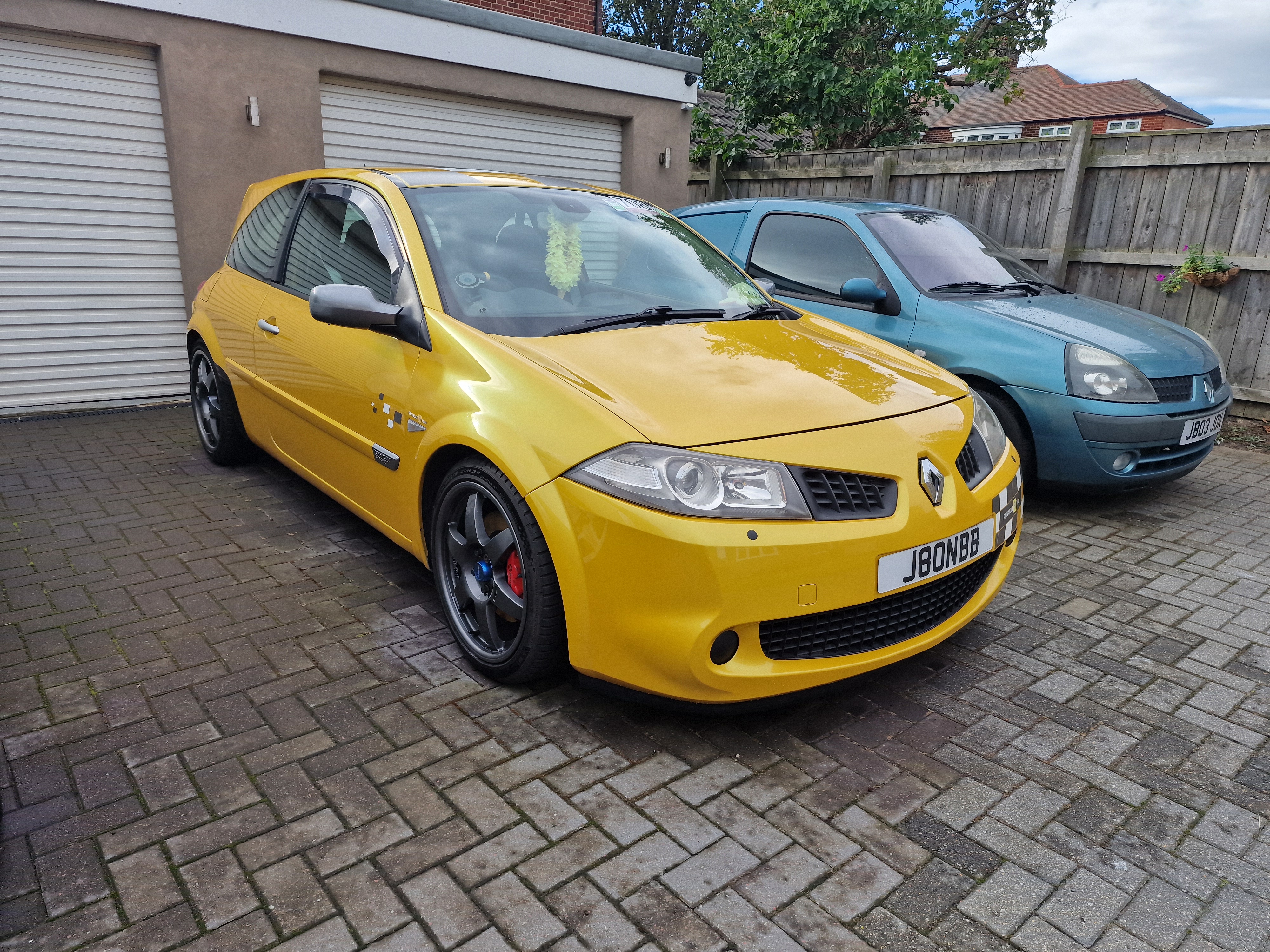

Basically done nothing to this since Anglesey apart from clean and drive, it all works so there was no real need to do much.
Renewed insurance for the year with Greenlight. Still cleans up decent and using the di vessel for rinse really makes the yellow pop.
With a Spa Francorchamps trackday coming up in the next few weeks i made an effort to get it jacked up and checked over yesterday.
Small list to do.

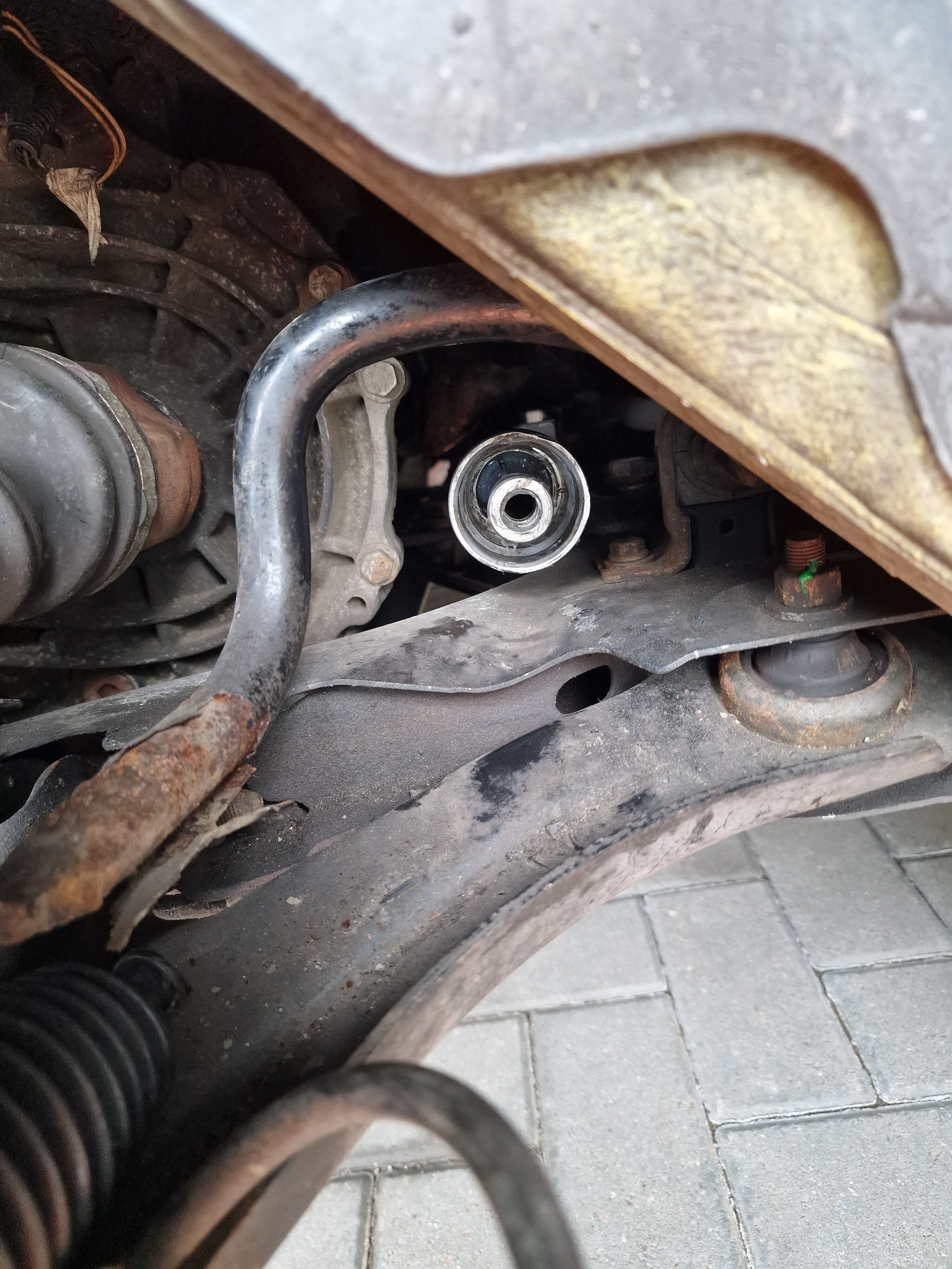

1. Steering rack bush on passenger side. To be fair this had developed a little bit of play before Anglesey, but time was not on my side to change it. Its pretty minor but will do it.
2. Both rear wheel bearings have developed minor play. This pains me as the discs and bearings were changed for quality snr before Anglesey and torqued to the correct spec of 220nm. It could be due to the semi slicks and extra load on the bearings, but this will be the 3rd passenger side and 2nd drivers side rear bearing swap its had in my ownership. Ive fitted tons of bearings with success so its not a technique issue, and stub axles look/measure fine.
I went a bit tighter on rear hub nut torque yesterday which took the play up to a degree but looks like ill be changing them.
Discussed this with people i trust and its apparant that the quality control on snr has slipped/bad batches. As bad as the usual chinese crap.
Apart from the above, everything else seems good. Half days work at worst for the minor jobs.

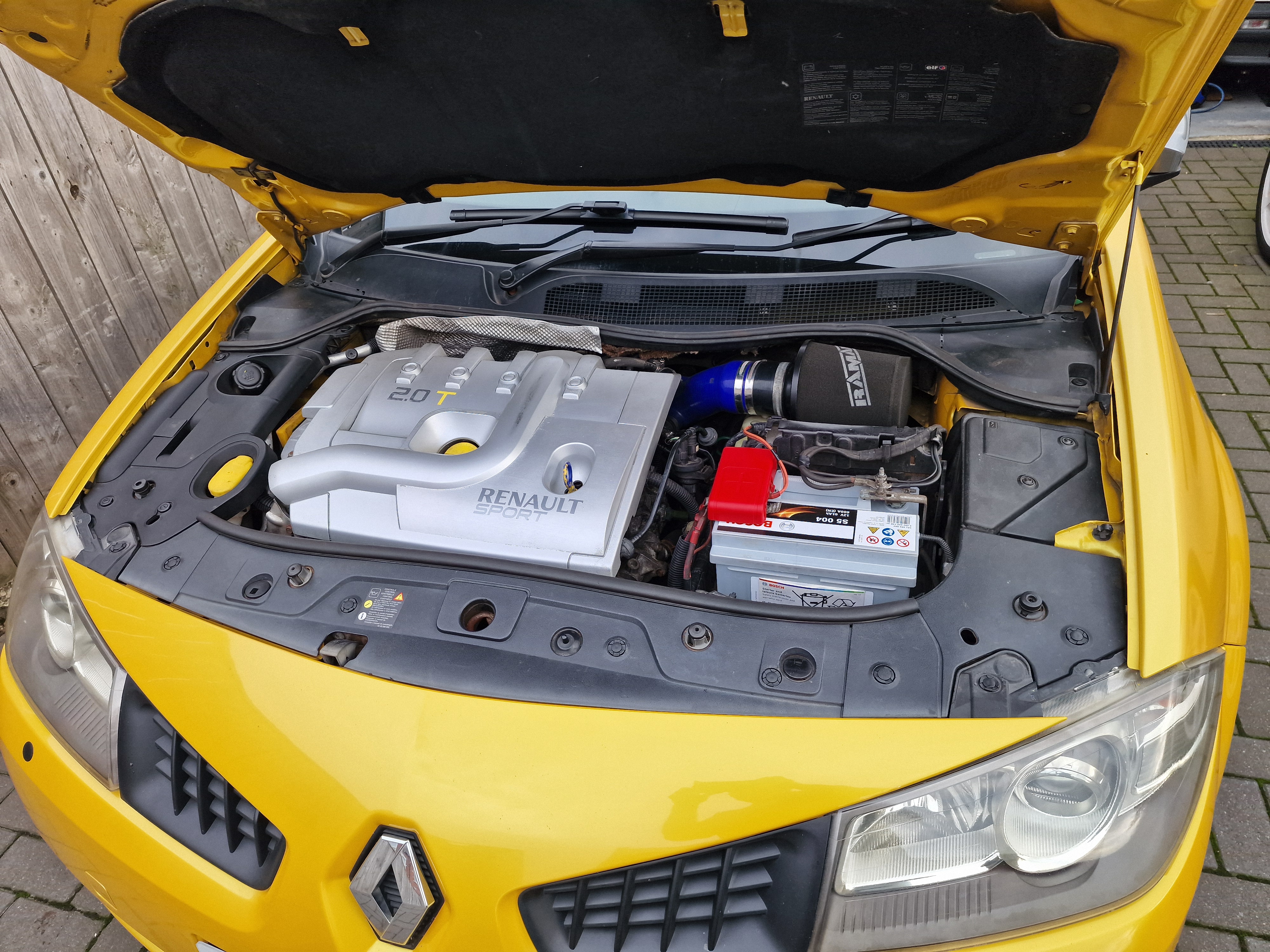

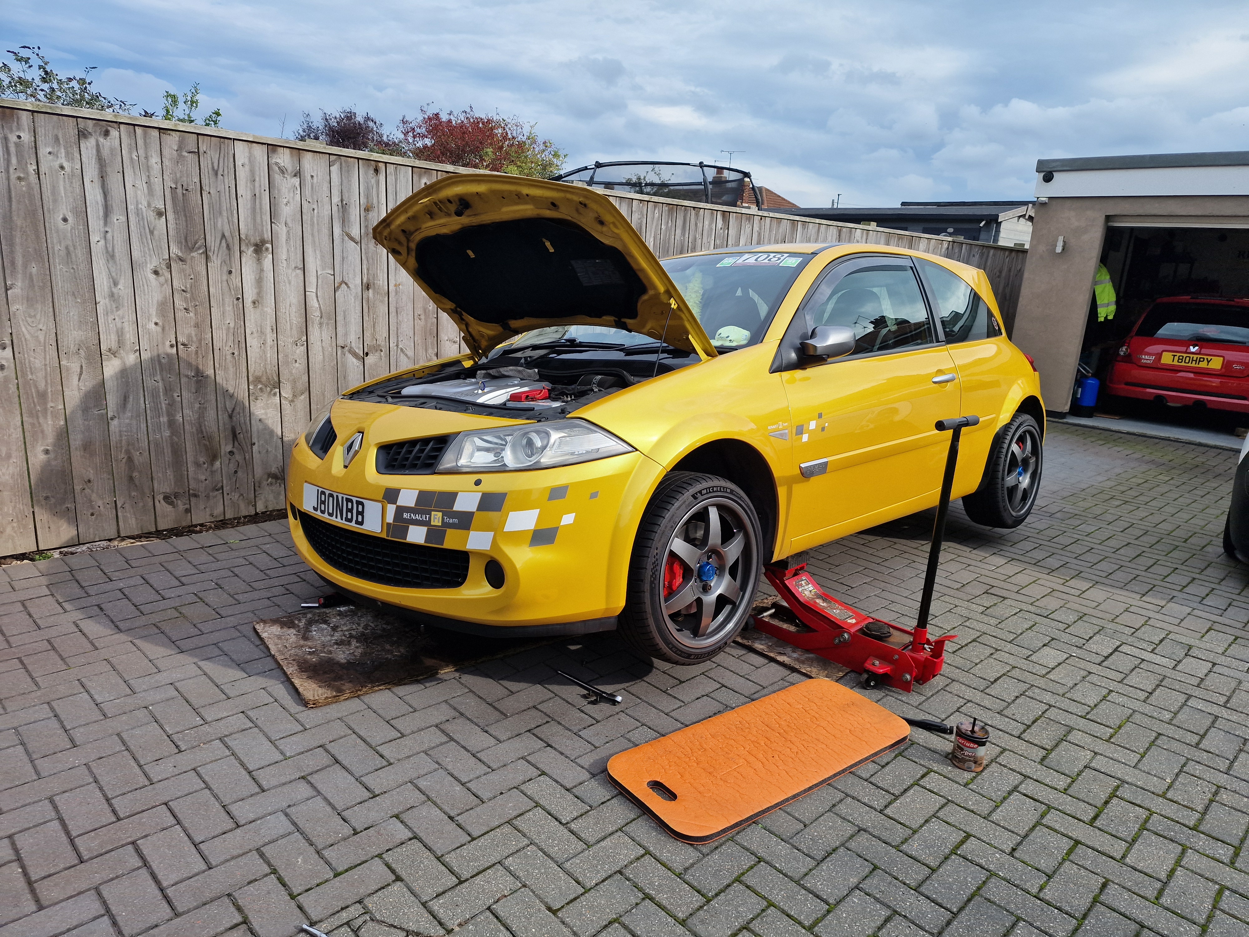

Whilst on the jack, i changed the oil for fresh valvoline synthpower 5/40 and purflux filter.
Engine bay wiped over.
Will get the above sorted in next couple of weeks.

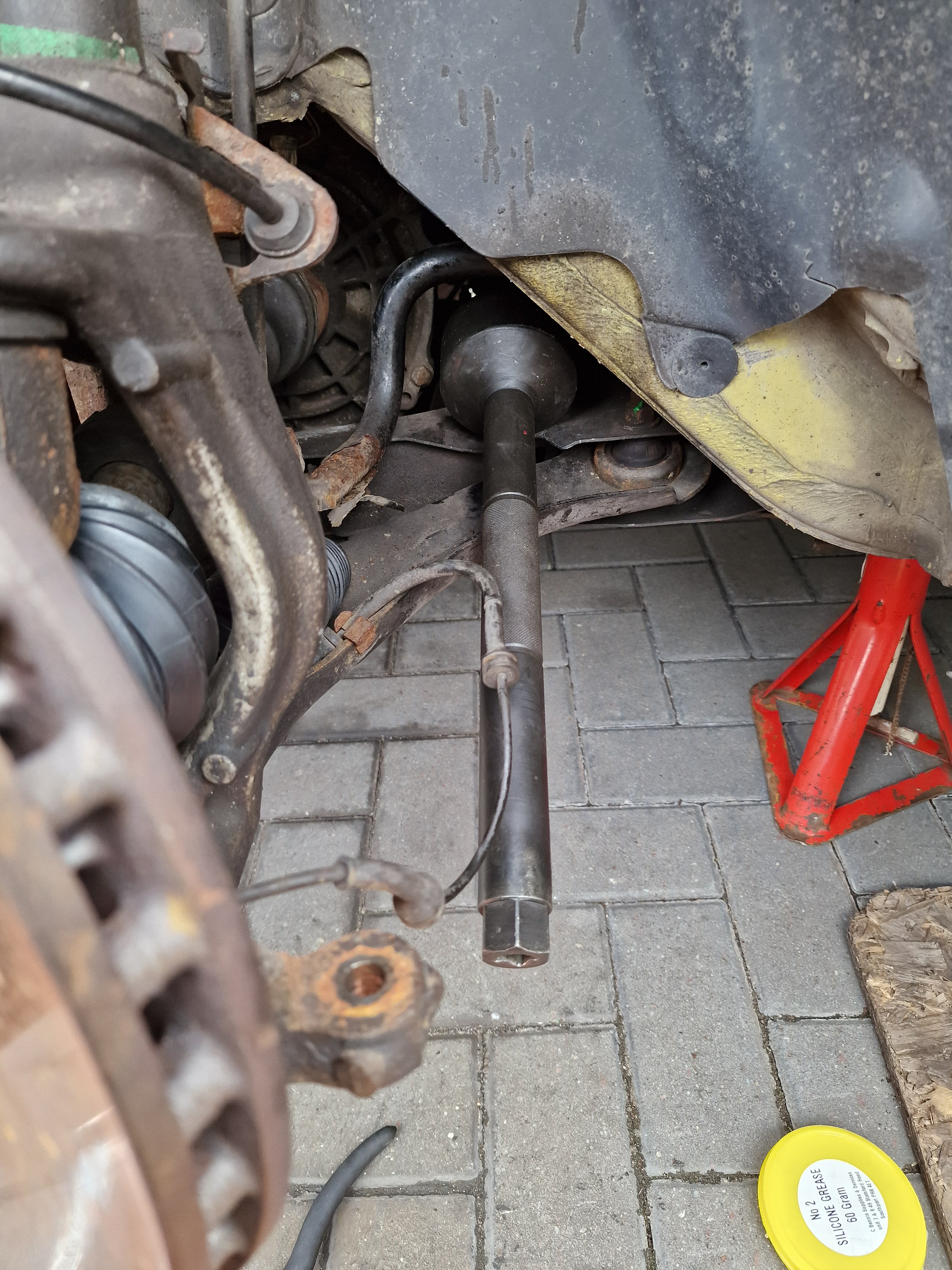

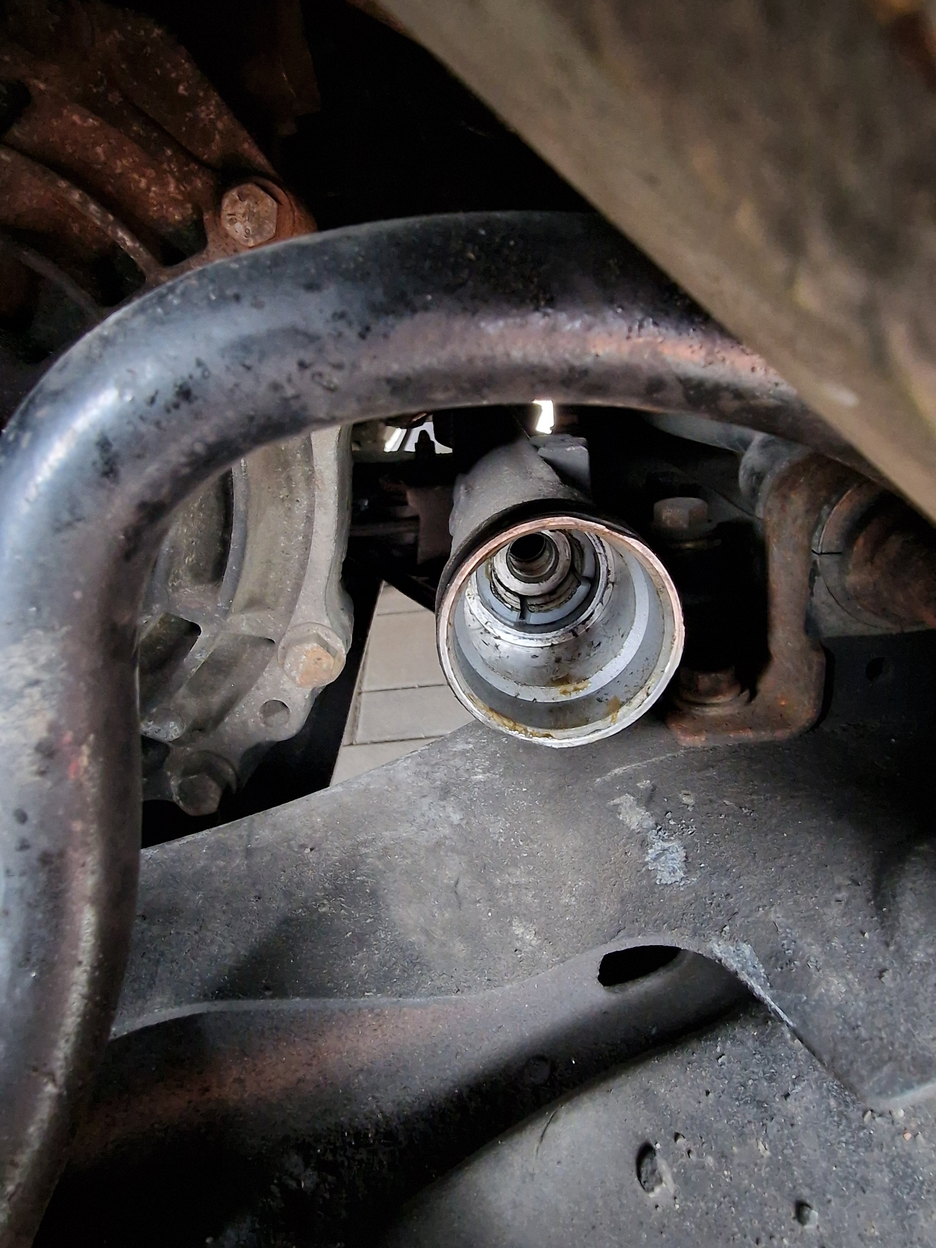

Changed the steering rack bush yesterday, easy yet fiddly to do. Its not my first go as done the one on the blue 225 several years ago.
All come apart easily. Tierod tool to remove inner.
Inner tie rod was still in great nick with no play, which is a good thing as its only done around 10 thousand miles and now £100 a side from Ren for new.
Old bush in situ.
New bush fitted. 2 person job as its a bit of a nightmare to get back in..needs a bit of persuasion. Loads of silicone grease to lube.
The bit of play in that area is now gone. Steering was a little stiff initially but a good run out lastnight sorted that out.

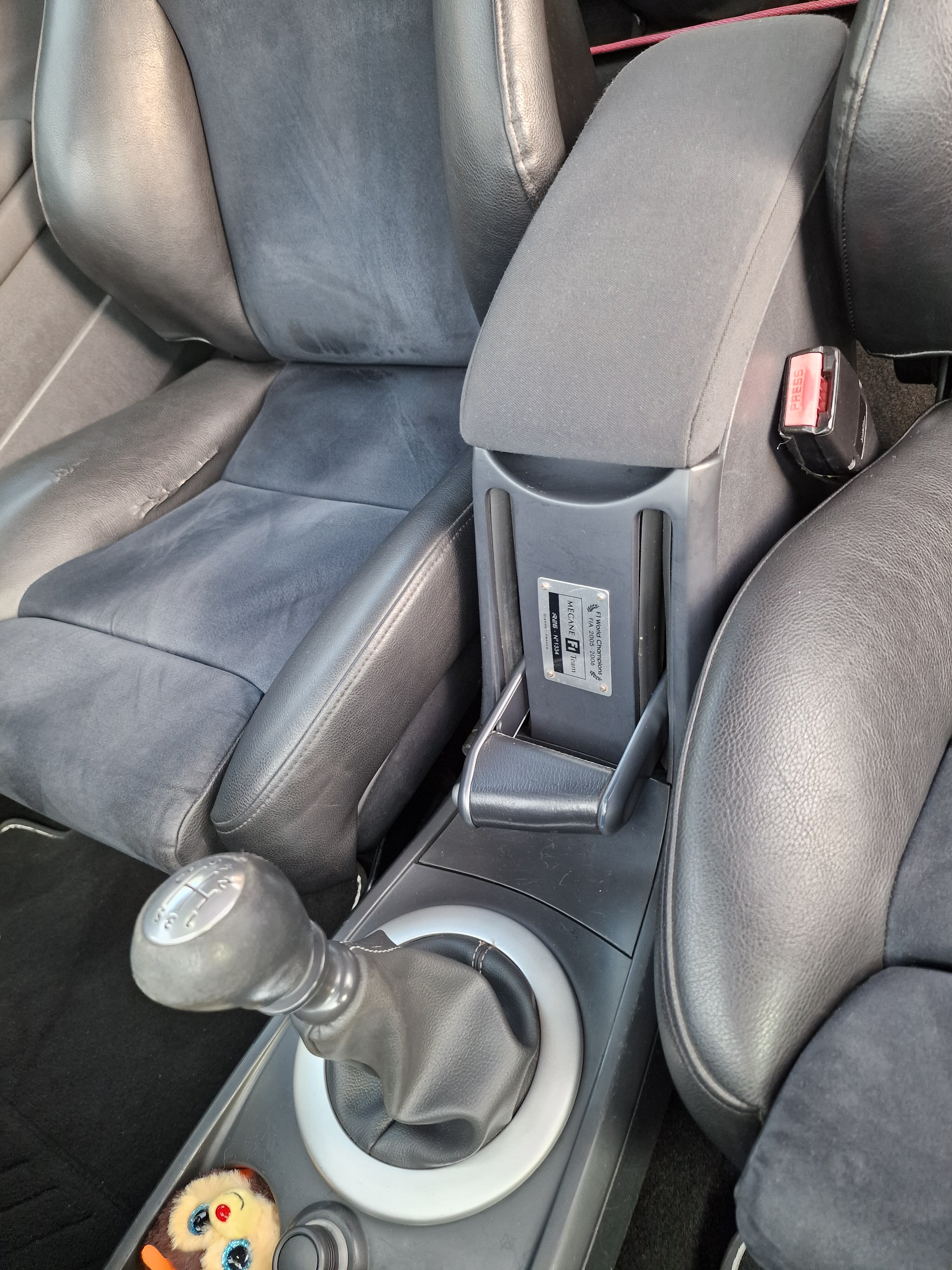

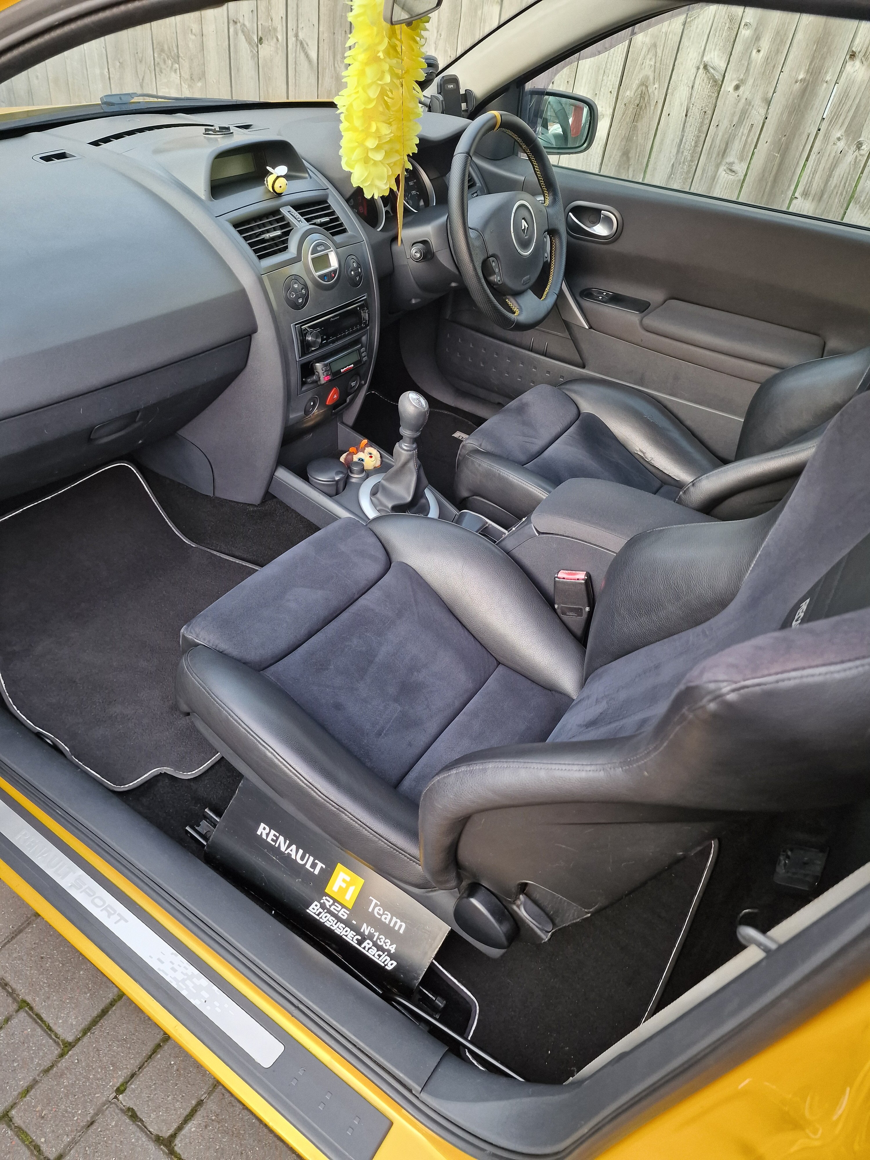

Bought a centre console with cloth armrest a while back to replace the povo r26 centre console.
Unfortunately it was not complete, and was missing the gearstick surround, obd cover etc. I thought the non armrest centre console parts would fit but totally different so put it to one side.
Found the right parts at u pull it a few weeks ago and finally got round to fitting today, and give it a quick hoover out.
Refitted the r26 plaque to the new centre console.
Small upgrade. Armrest is standard fit on our ph1 225, no idea why ren made the r26 so povo spec.

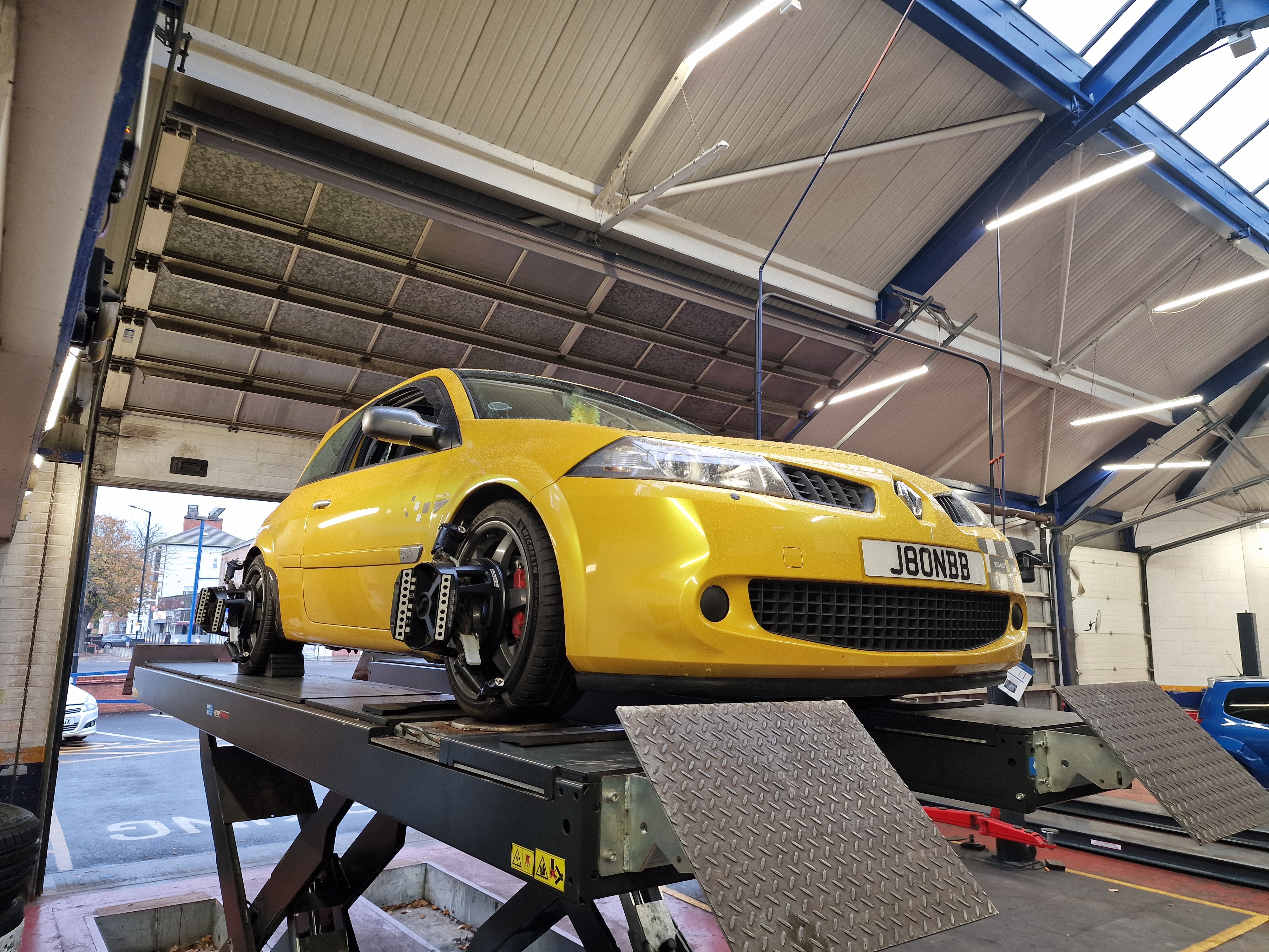

Took the r26 down my mates garage for geo on Sunday. They were super busy as short on staff but geo ramp was free. Asked my mate if it was ok to have a crack at it myself and he said crack on. So i did.
It was a nice easy job to do, i have seen my mate do it a million times before so knew the drill..only thing i struggled with initially was seeing the geo screen but that was fine when i put my glasses on :LOL:
Set toe only to ten mins toe out overall. I could lie and say i got it right 1st time, but steering wheel was a degree or so off to the right on first attempt as i think i knocked the steering clamp when getting out. 2nd attempt and i got the band perfectly straight. My mate give it a once over as a 2nd set of eyes and said all good. Asked when im starting working there now im time served 😅
Took for test run and it drives great. I thought this is ready for Spa.

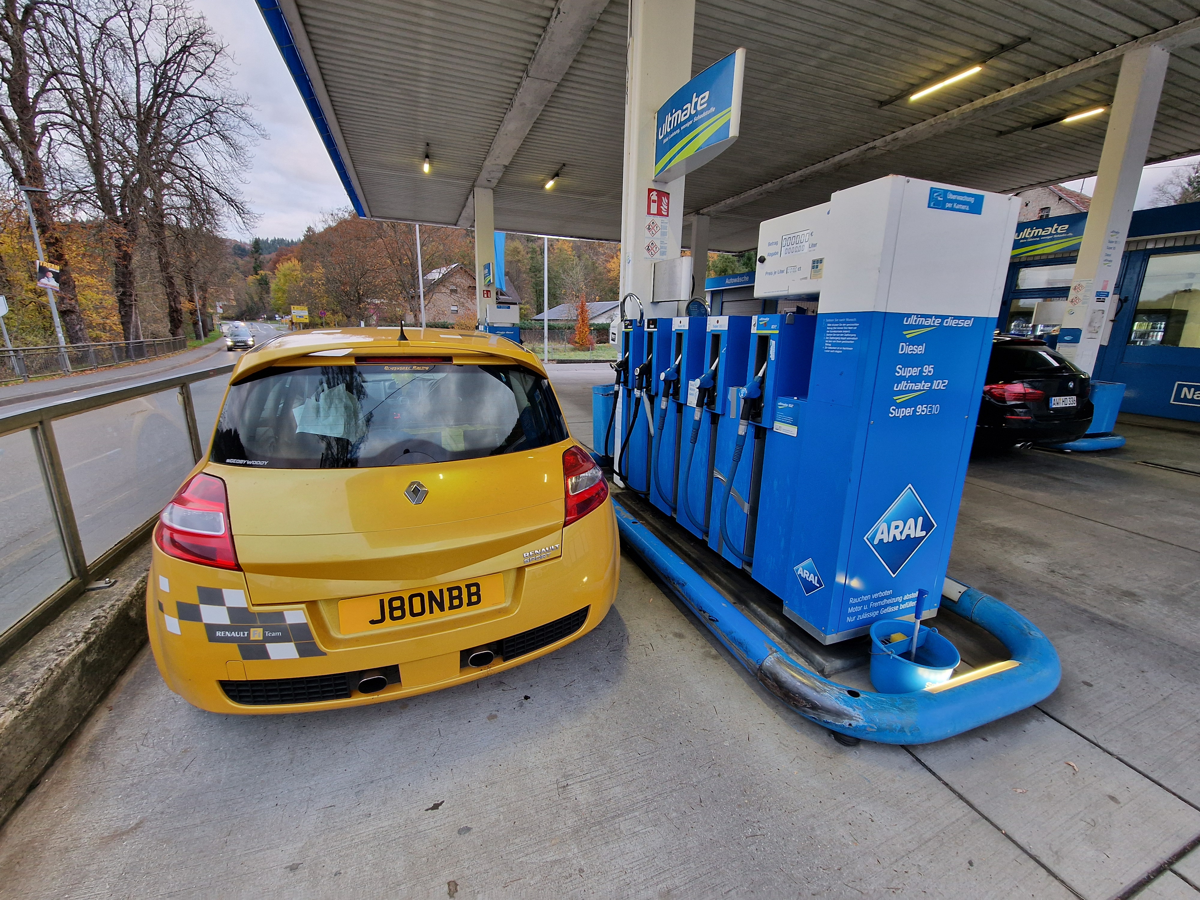

Next stop Adenau, fill up with Aral 102.

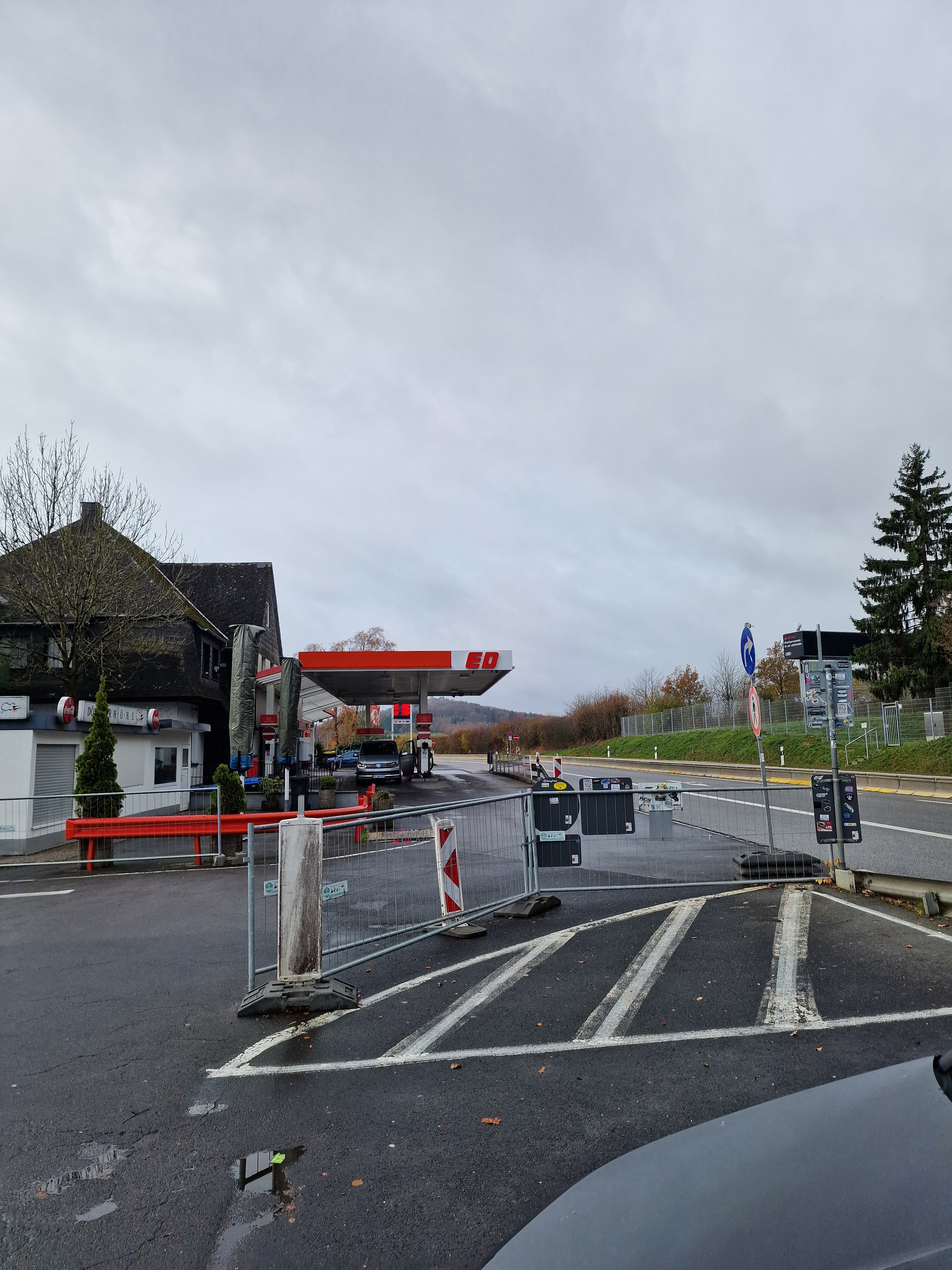

Anyway quick stop at ED tankstelle at Döttinger Höhe.
Interesting one. Pulled up and there is a few people parked up and stood about as usual. Mrs says "cars getting a bit of attention". A lad comes over and says hello and asks how Spa was. Get talking and he is from Brazil, his friend follows me on insta and sent the lad a pic over of my car from my story update. Small world eh!
Anyway buy more crap from ED and get rolling. Autobahns were wet so 130kmh speedlimit in force initially which was a bit dissapointing, but 80mph in wet conditions is better than uk 70mph. A few miles in and the conditions improve so the speed boards change to unrestricted, and can make a bit of progress.

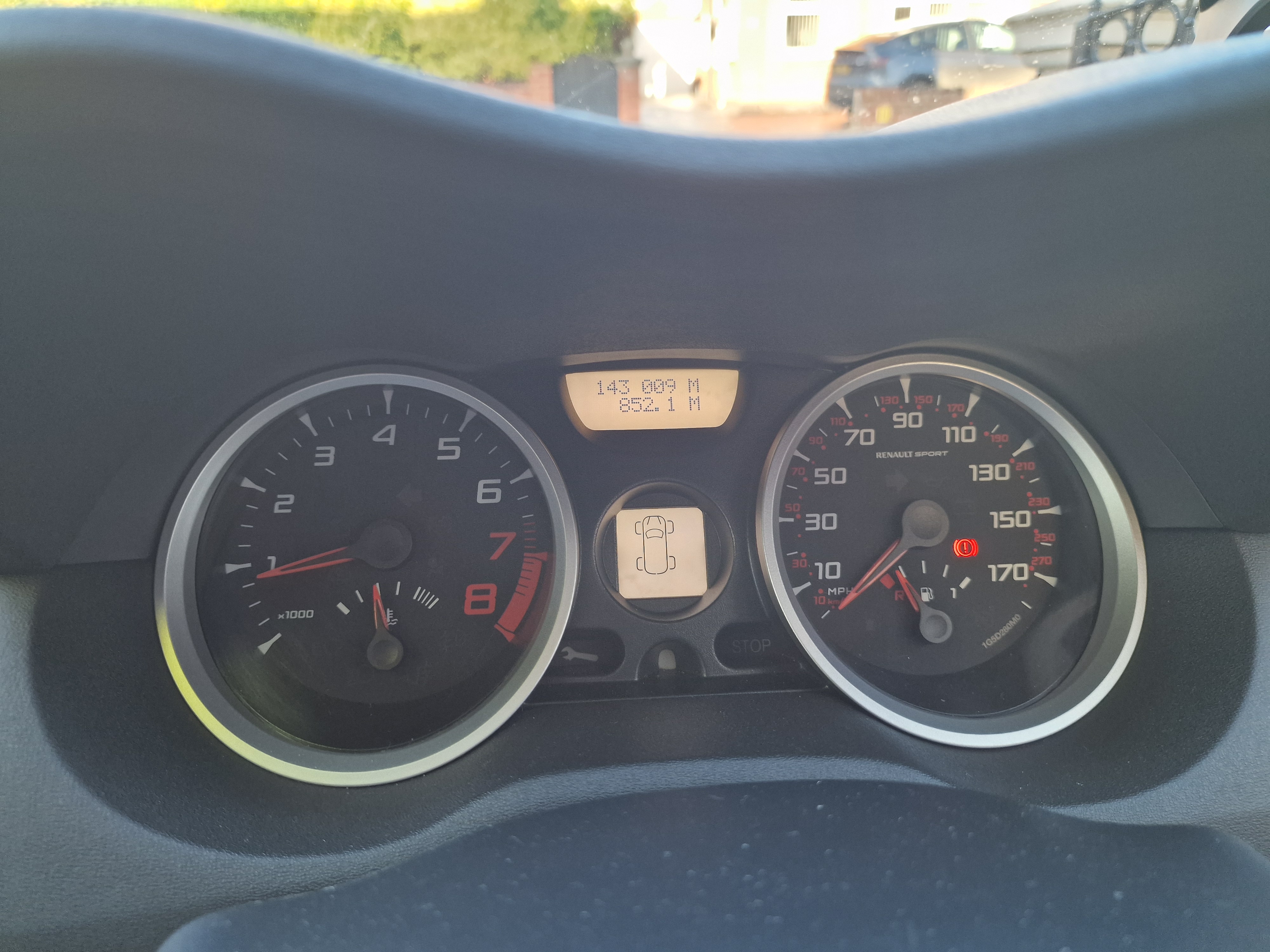

852 miles, done. Great trip.

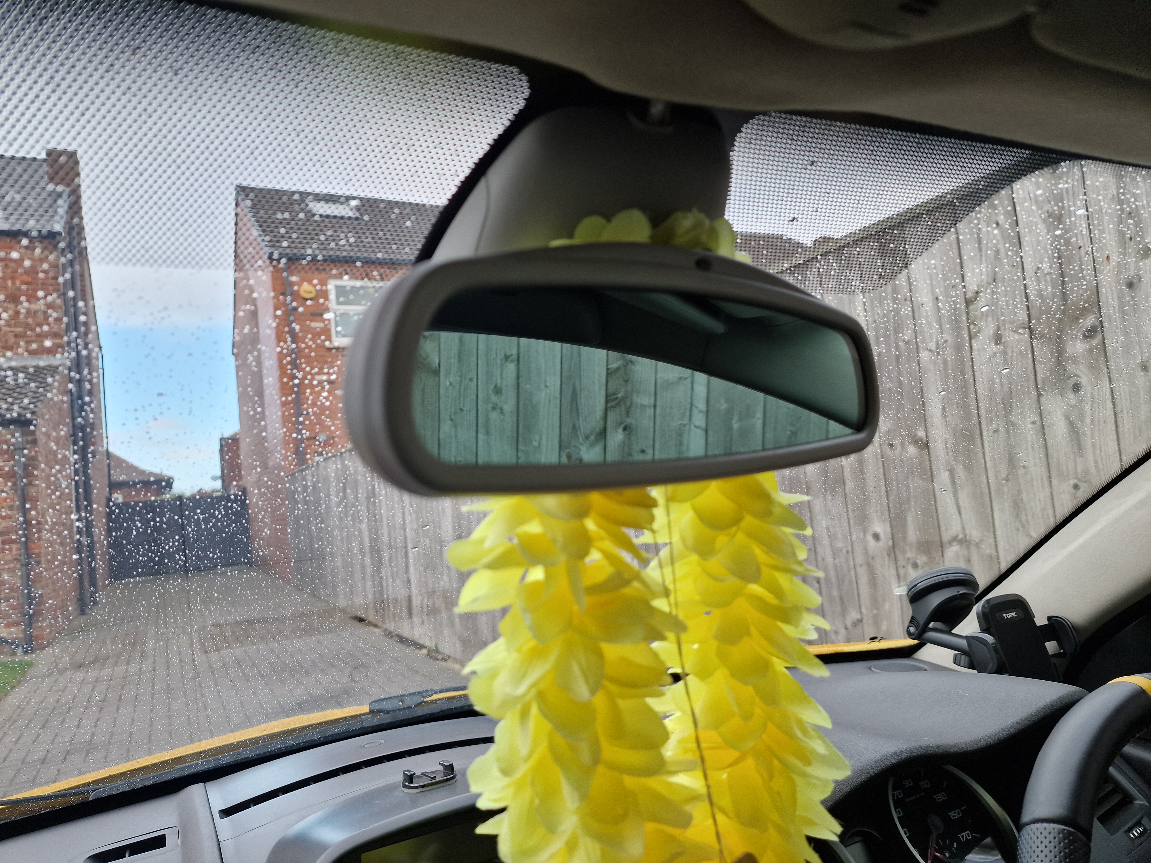

Fitted an autodimming interior mirror. This is a plug and play upgrade, well it should have been but the original mirror was tight as fcuk and i accidently pulled the bracket off the screen when removing. Luckily did not crack the screen, amazon to the rescue for loctite 319 window bond which has set rock solid.
On the plus side the auto dim is good and was worth the hassle.

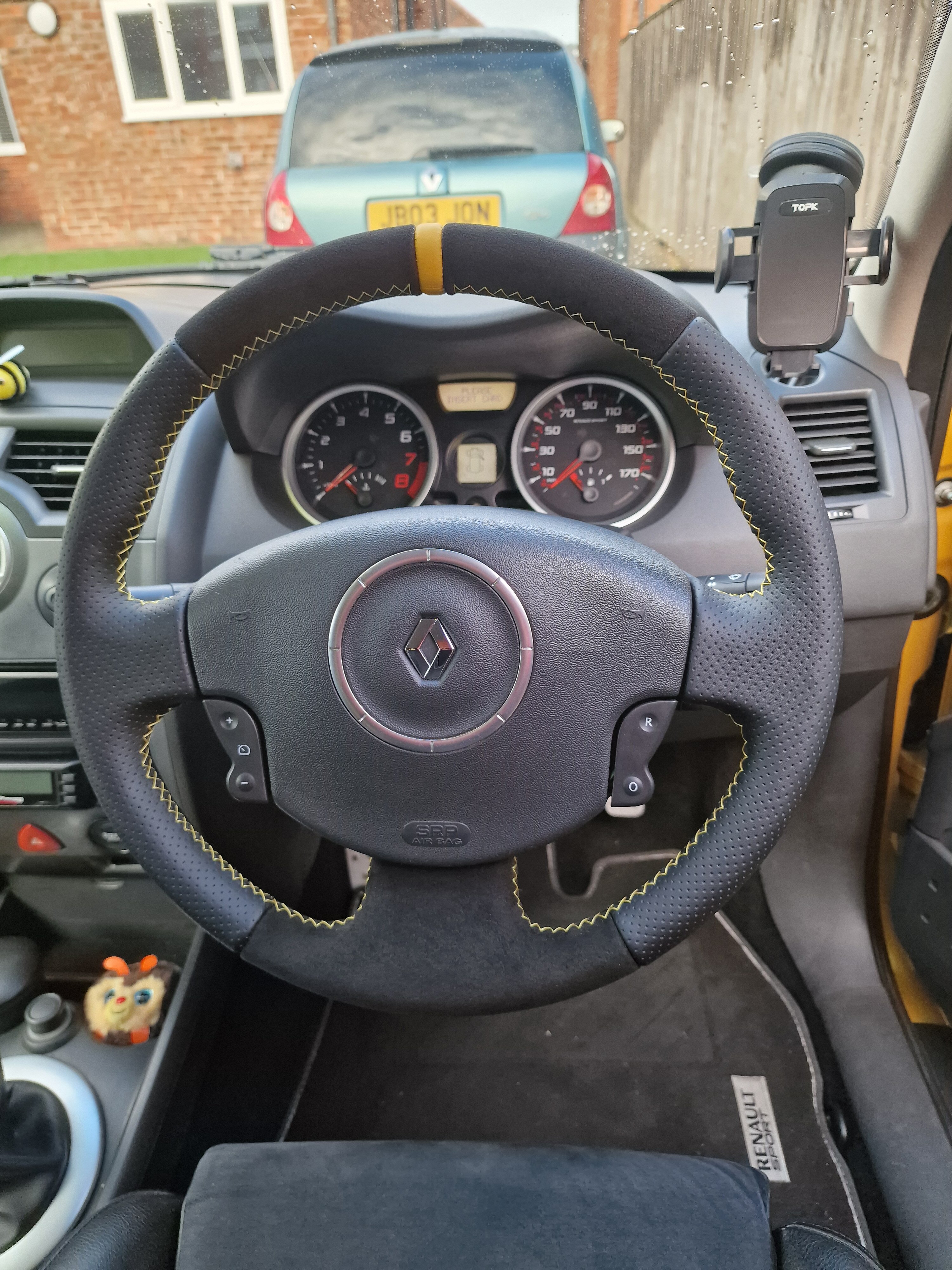

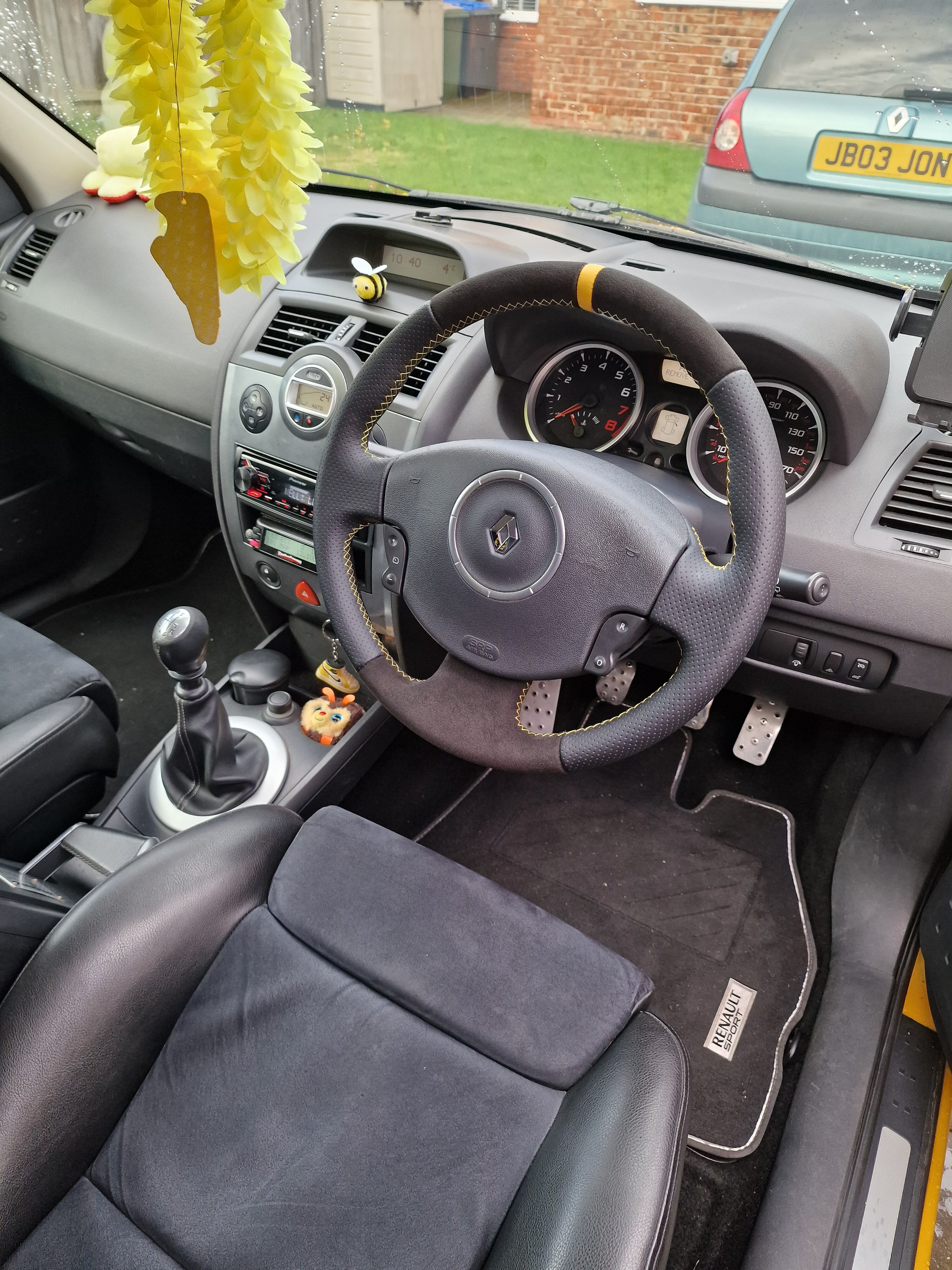

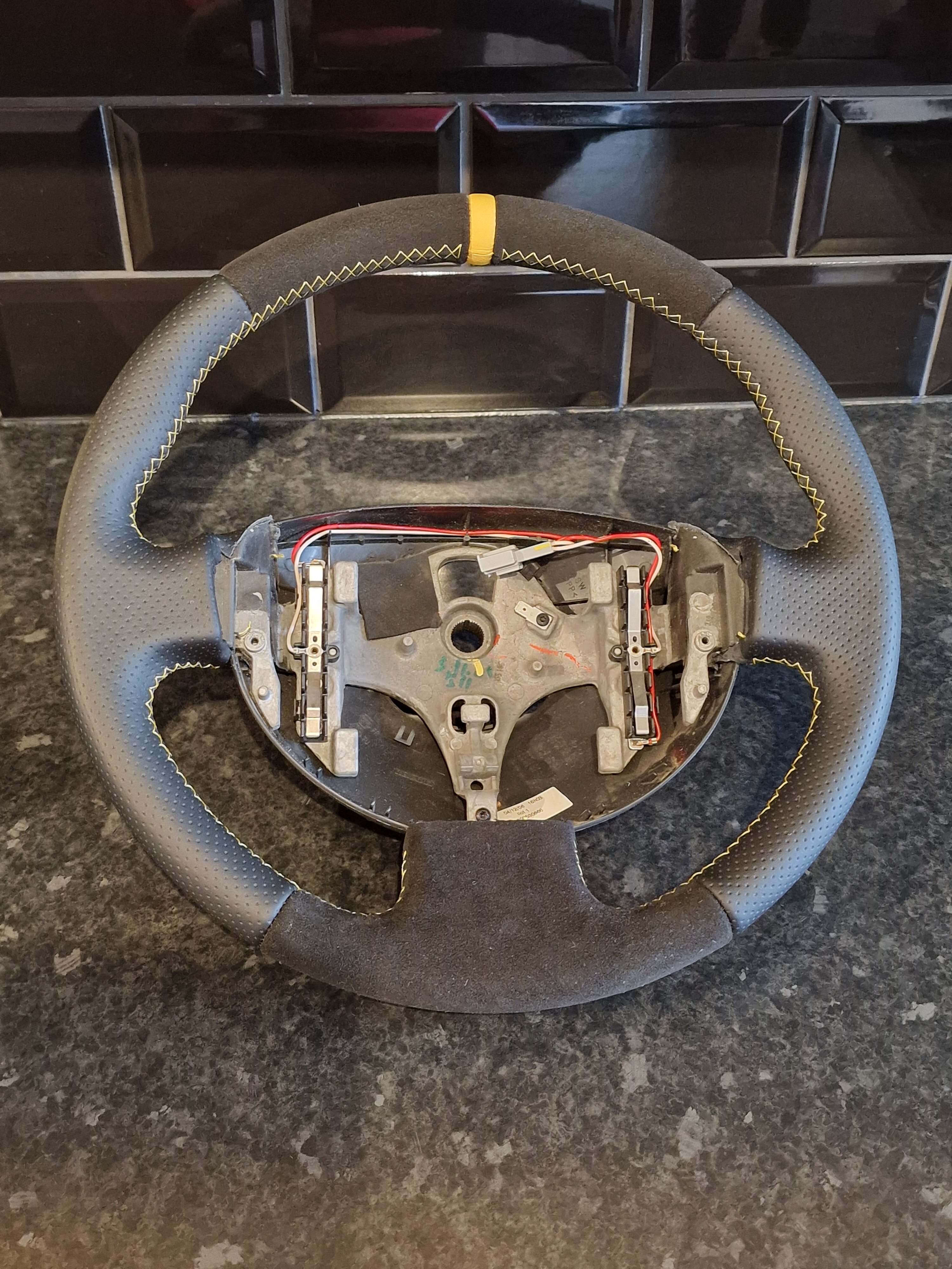

I have also fitted a freshly retrimmed sterring wheel from Otto Retrims. Ive had this one done in alcantara and perforated nappa with yellow stitching and band.
Quality is excellent as usual and nice change from the full leather one i had previously.

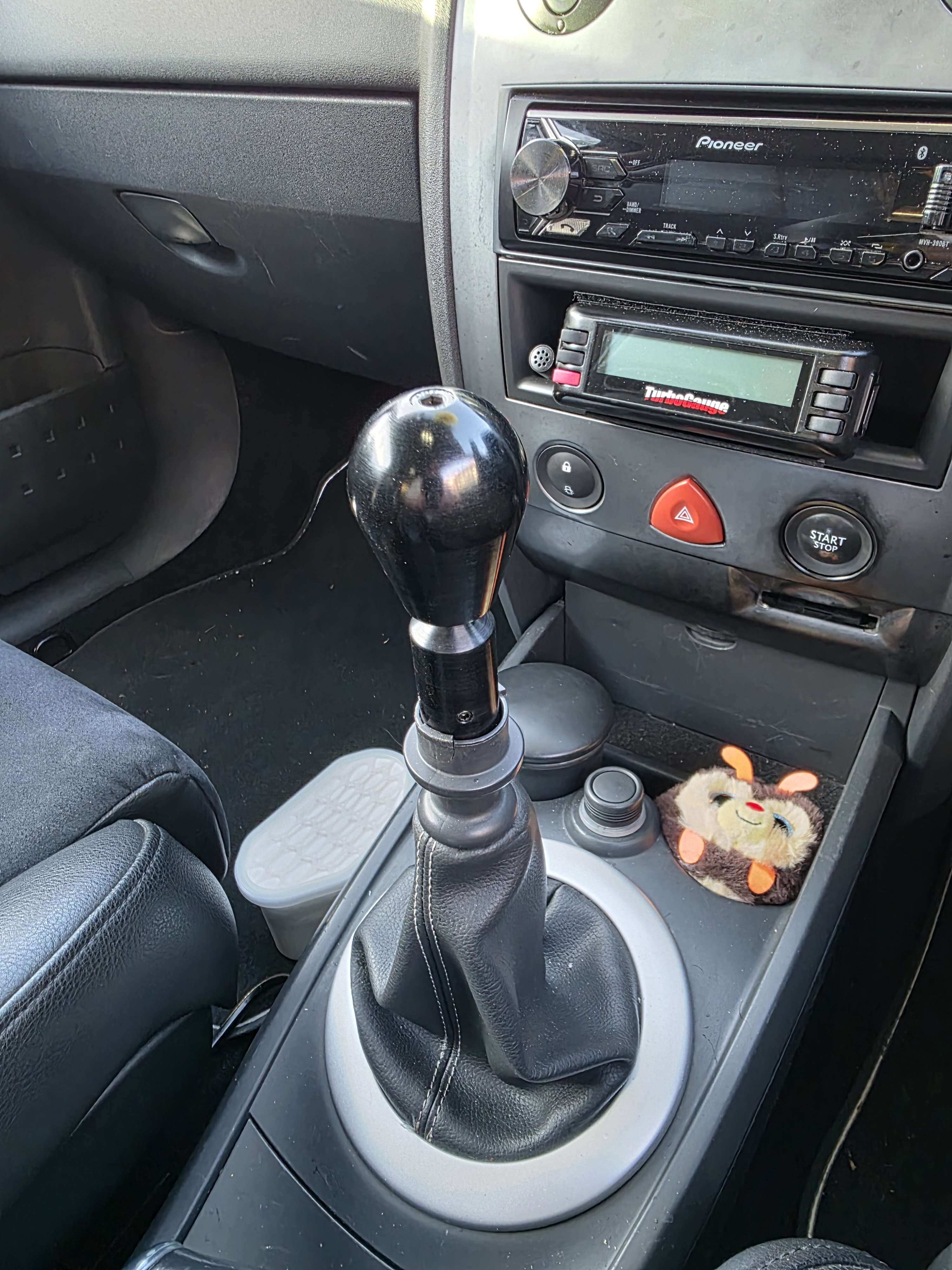

Have sent gearknob away for retrim in nappa with yellow stitching to match.

The steering wheel turned out great!

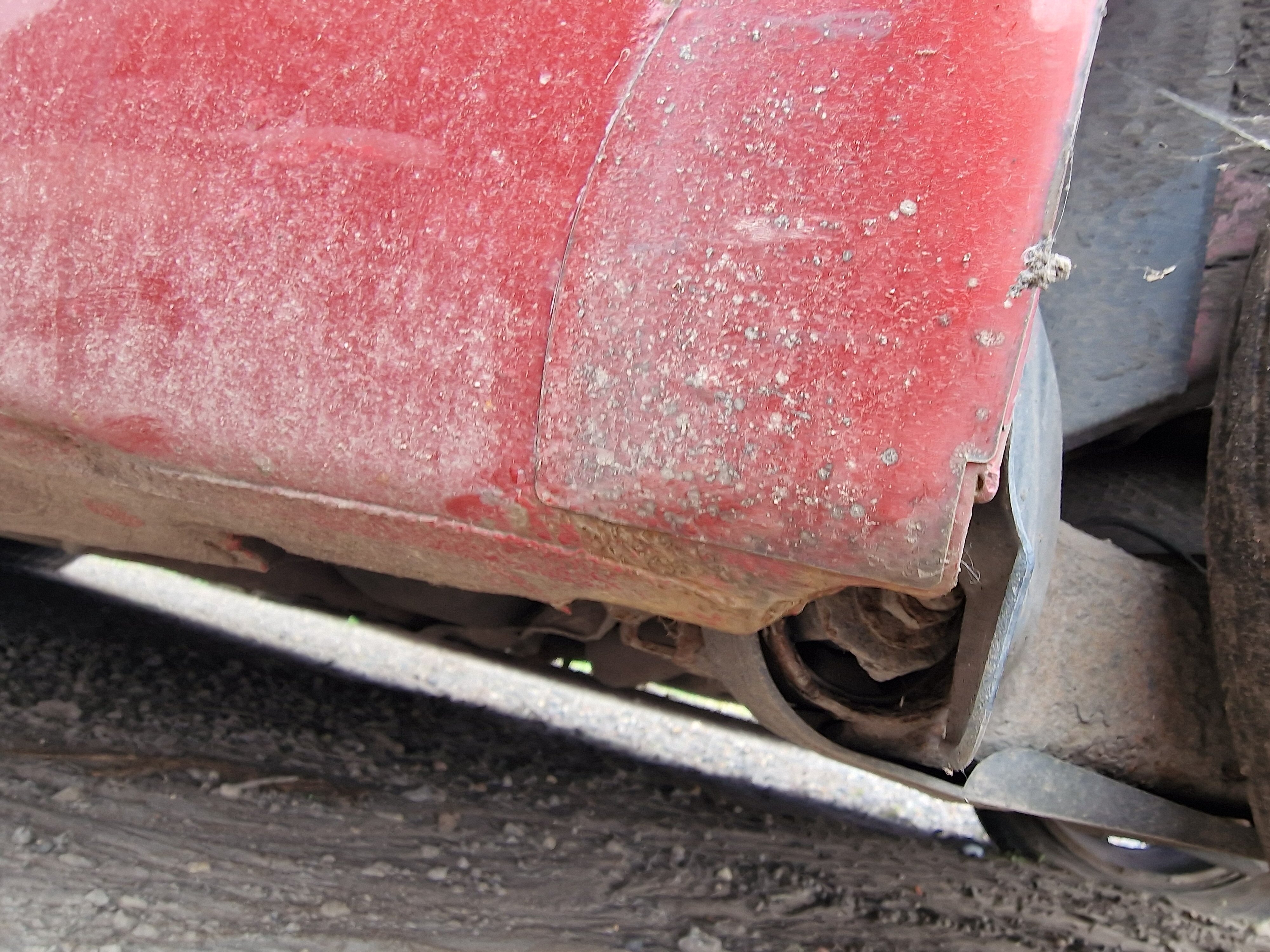

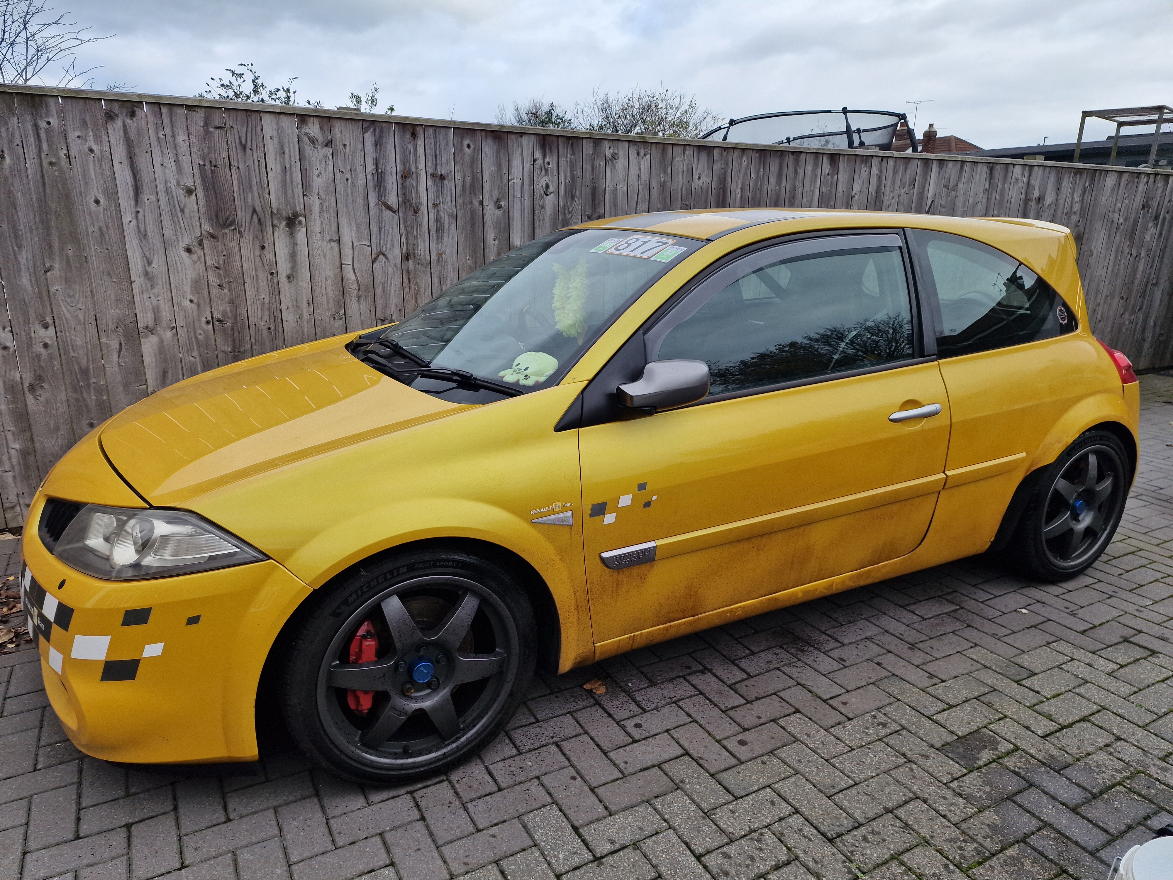

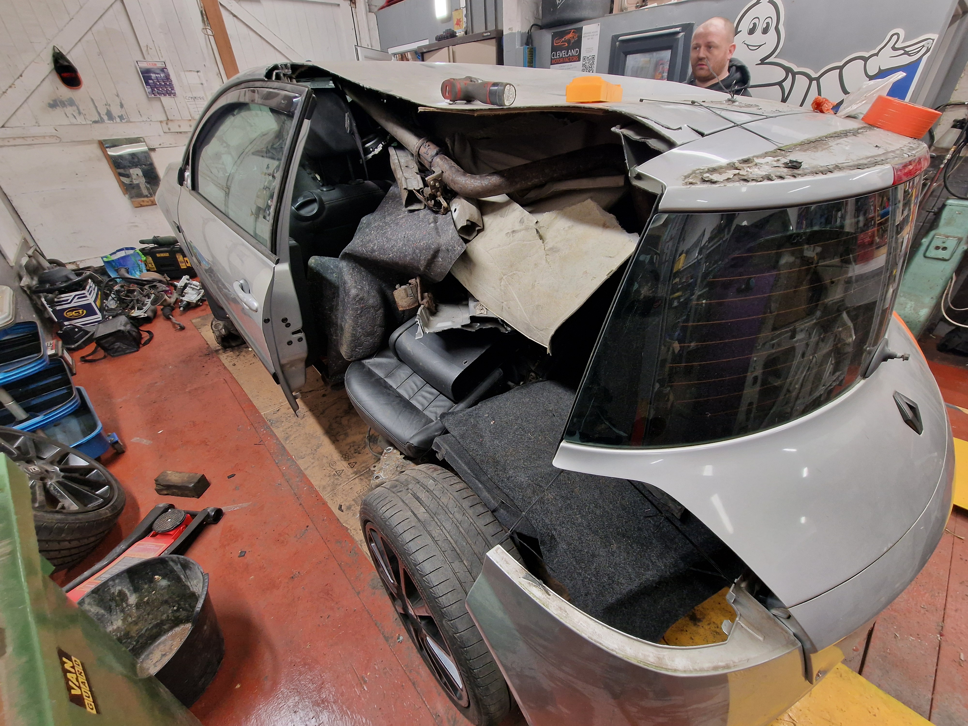

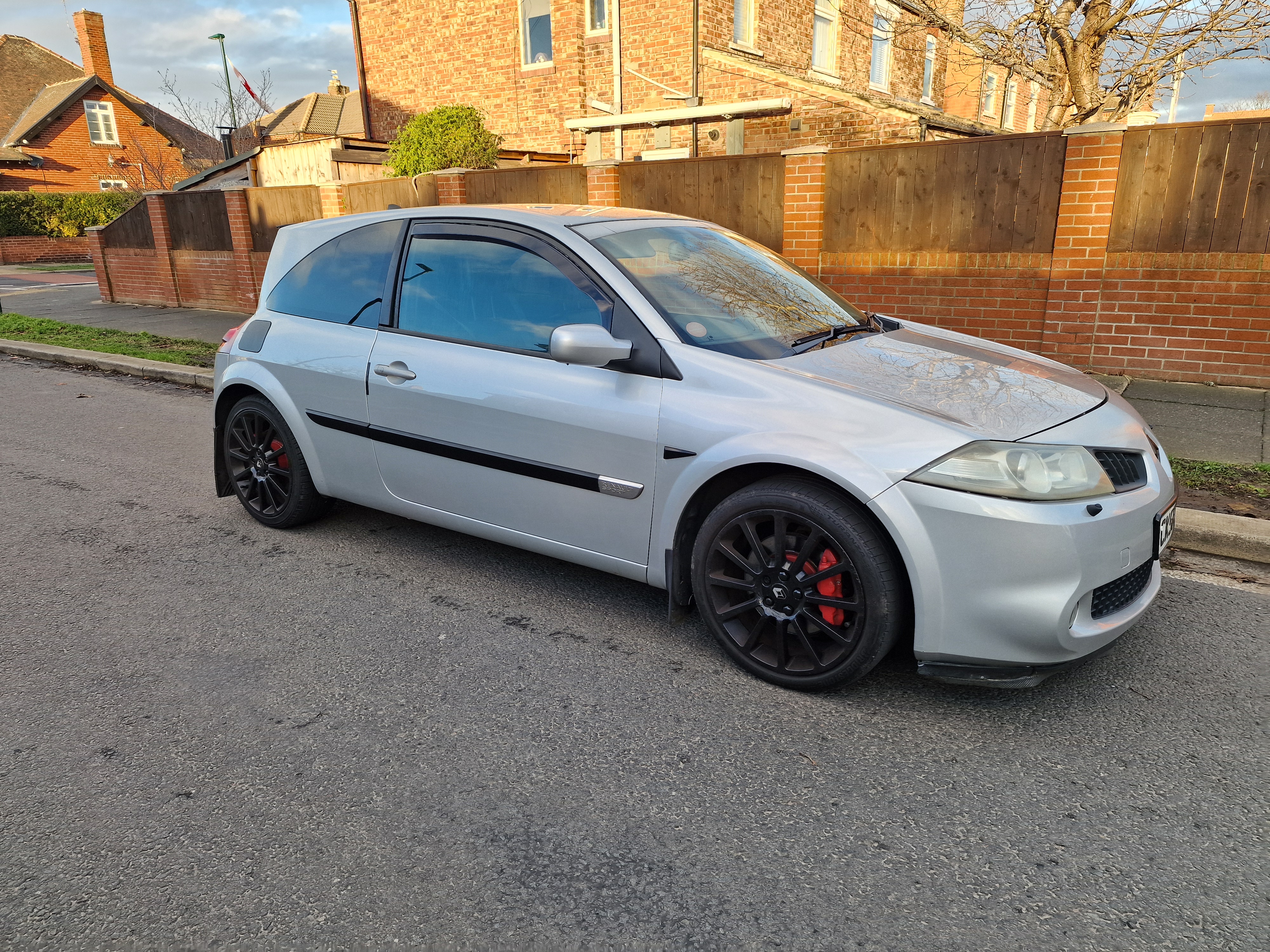

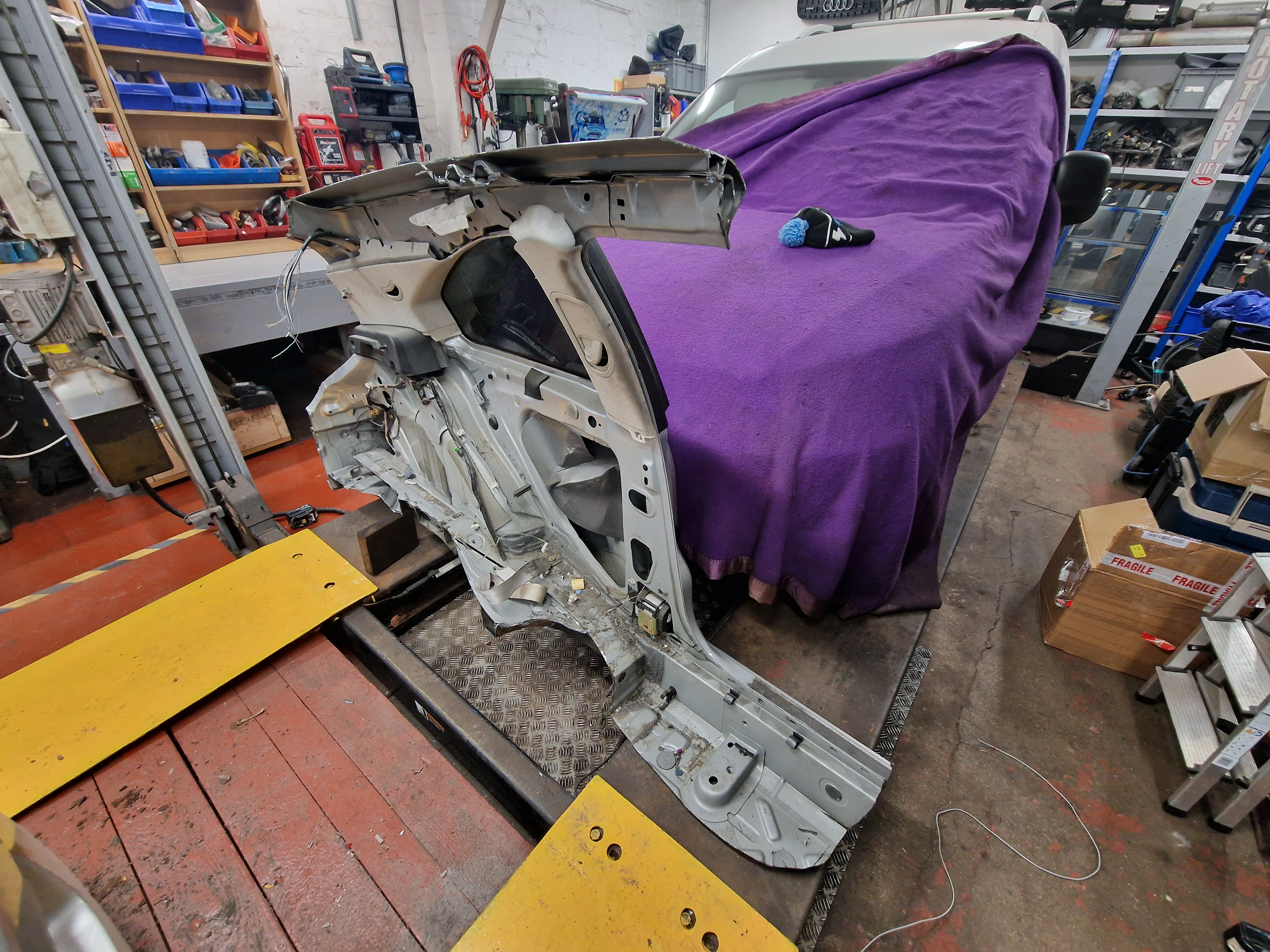

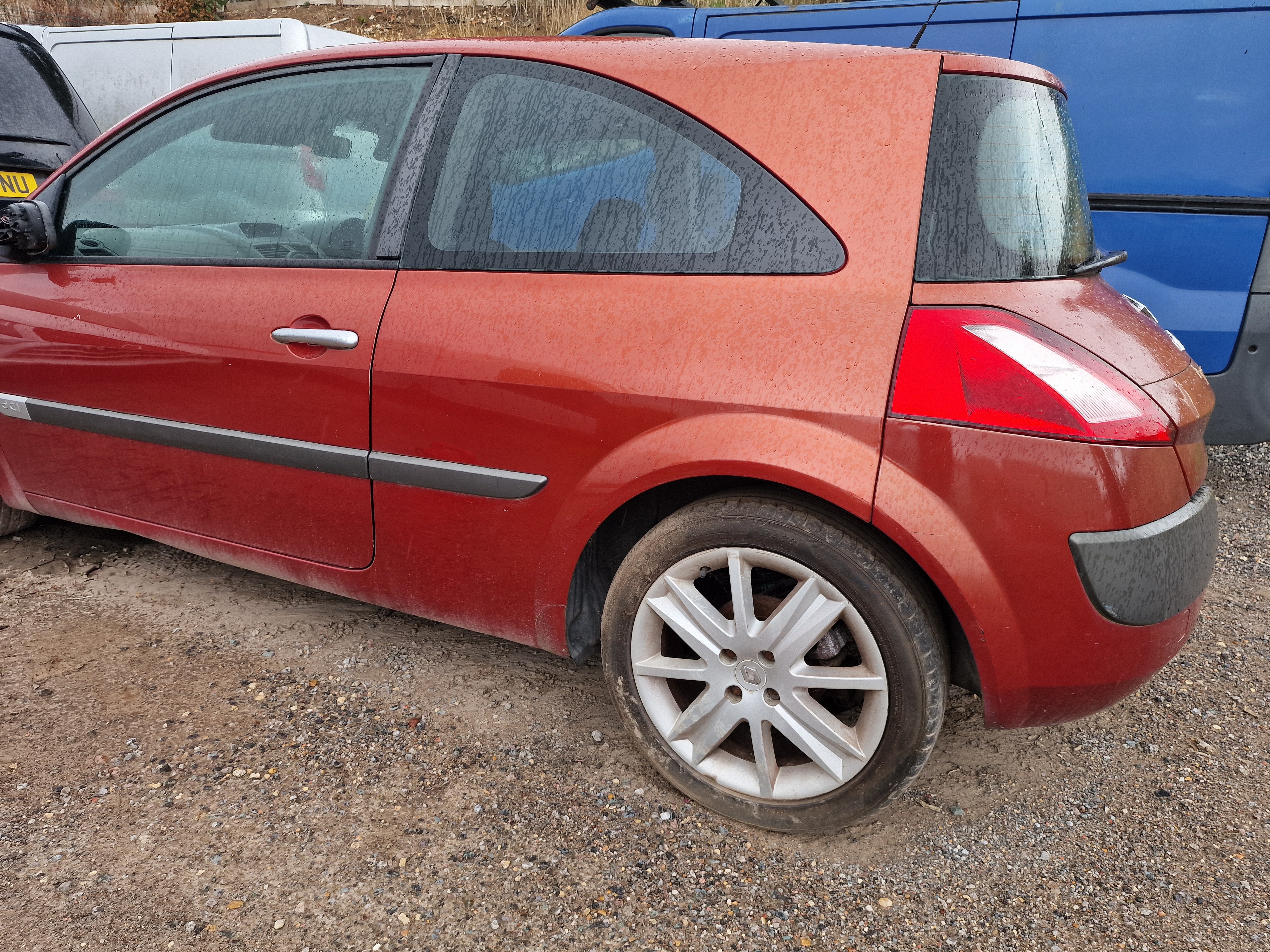

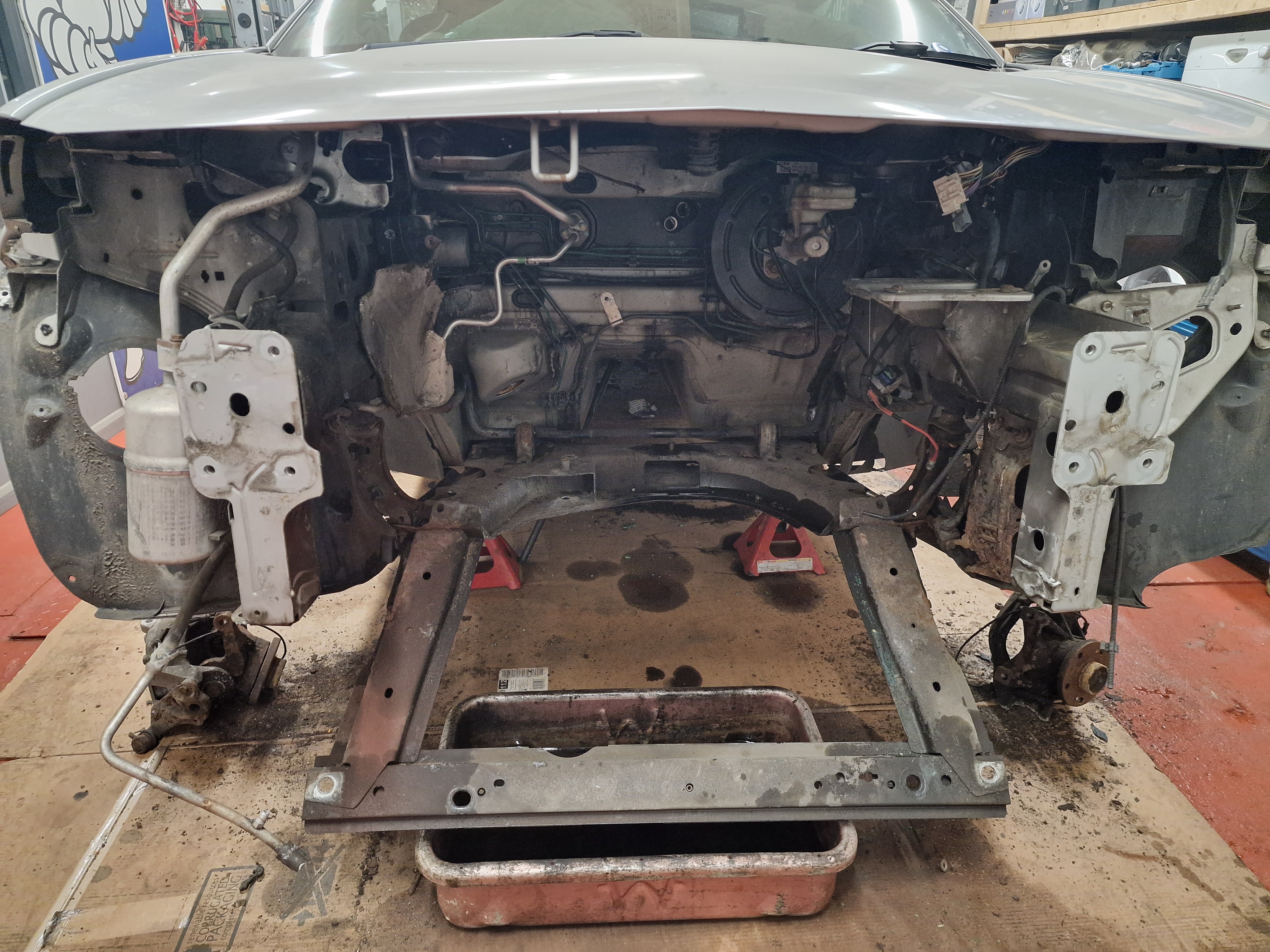

Some of you might have noticed that the passenger side arch on my yellow megane r26 is rusty. Mk2 meganes dont rust?! They do when they have had a new rear qtr fitted badly in the past and its full of bog.
Ive been looking for a solution for ages. I found a full rear qtr at not alot of money, but the problem is the inner arch panel is also rusty. This will require repair or replacement and its nla from renault as expected.
With the above in mind i thought the easy solution would be buying another bog standard spec megane mk2 3 door to cut a qtr panel off as i thought there was loads about and cheap, well a lot cheaper than the rs models. Ok'd the repair with a good local bodyshop who are willing to take it on before looking.

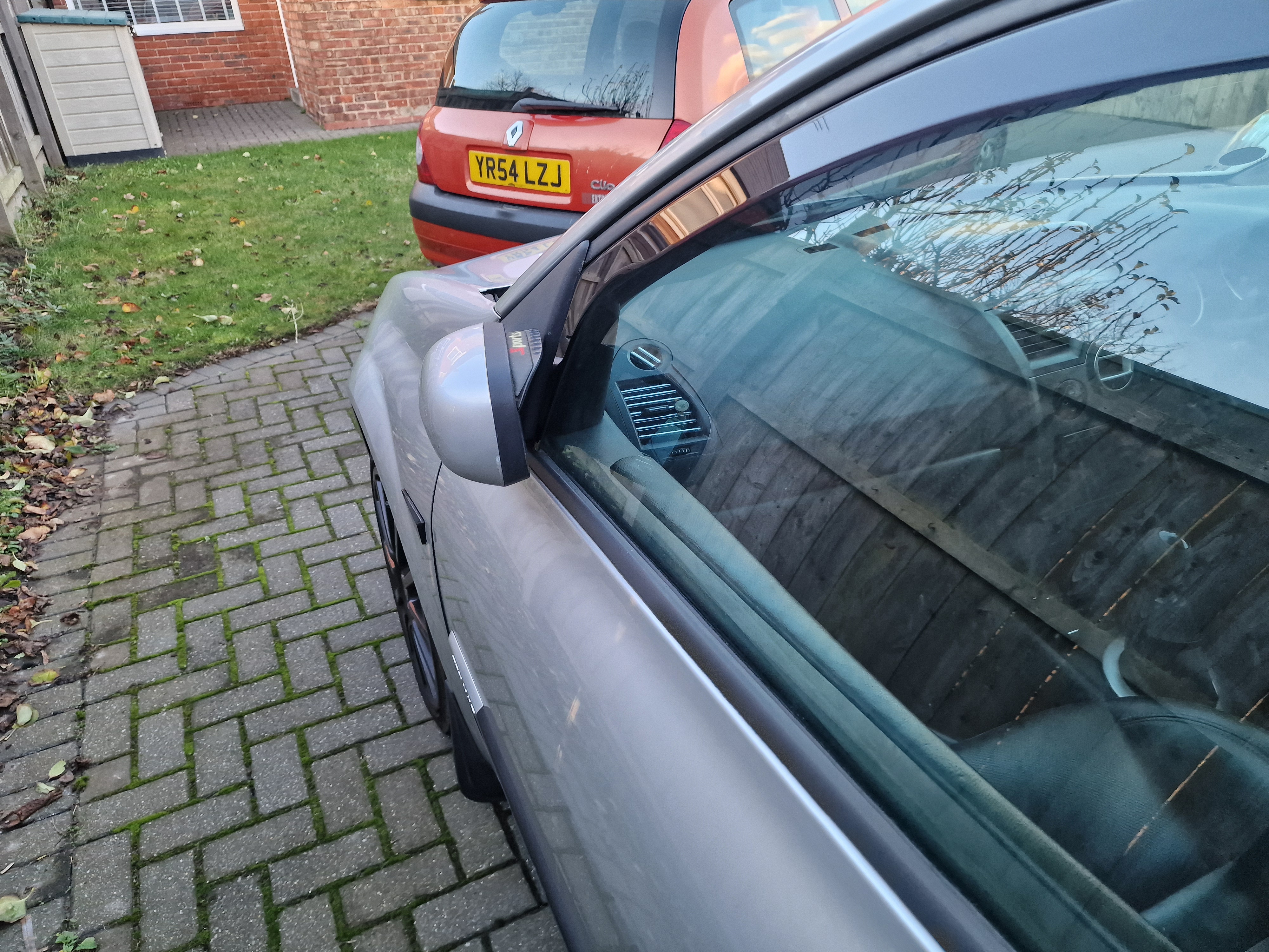

Started looking on FB, Gumtree etc for a full car to buy to cut up. Its apparant that 3door megane mk2 non sport are quite rare now and most for sale are 5 door, or convertable.
I looked at a silver 08 reg one locally and it had a dent/scrape across the arch but no rust, rest of the car was scrap. Being fussy i passed on it, regrets as would have been perfect with a bit of work.
Went to Lincoln to view one which looked good initially from pics, dci 350k on the clocks.
Got underneath the car and rust🫠car was a non runner so with recovery and sale price, i would have been around £600. Not good enough to use.
I then kept an eye on facebook market place for a while. Mostly overpriced bags of shite coming up for sale with dented to f**k rear qtrs or rusty. Ive come to the conclusion whatever mk2 megane 3 door base spec that are still on the road are mostly piles of shite, prob due to age.
Also tried breakers. Most are unwilling to let you cut the qtr or take the shell to cut or mess you about.

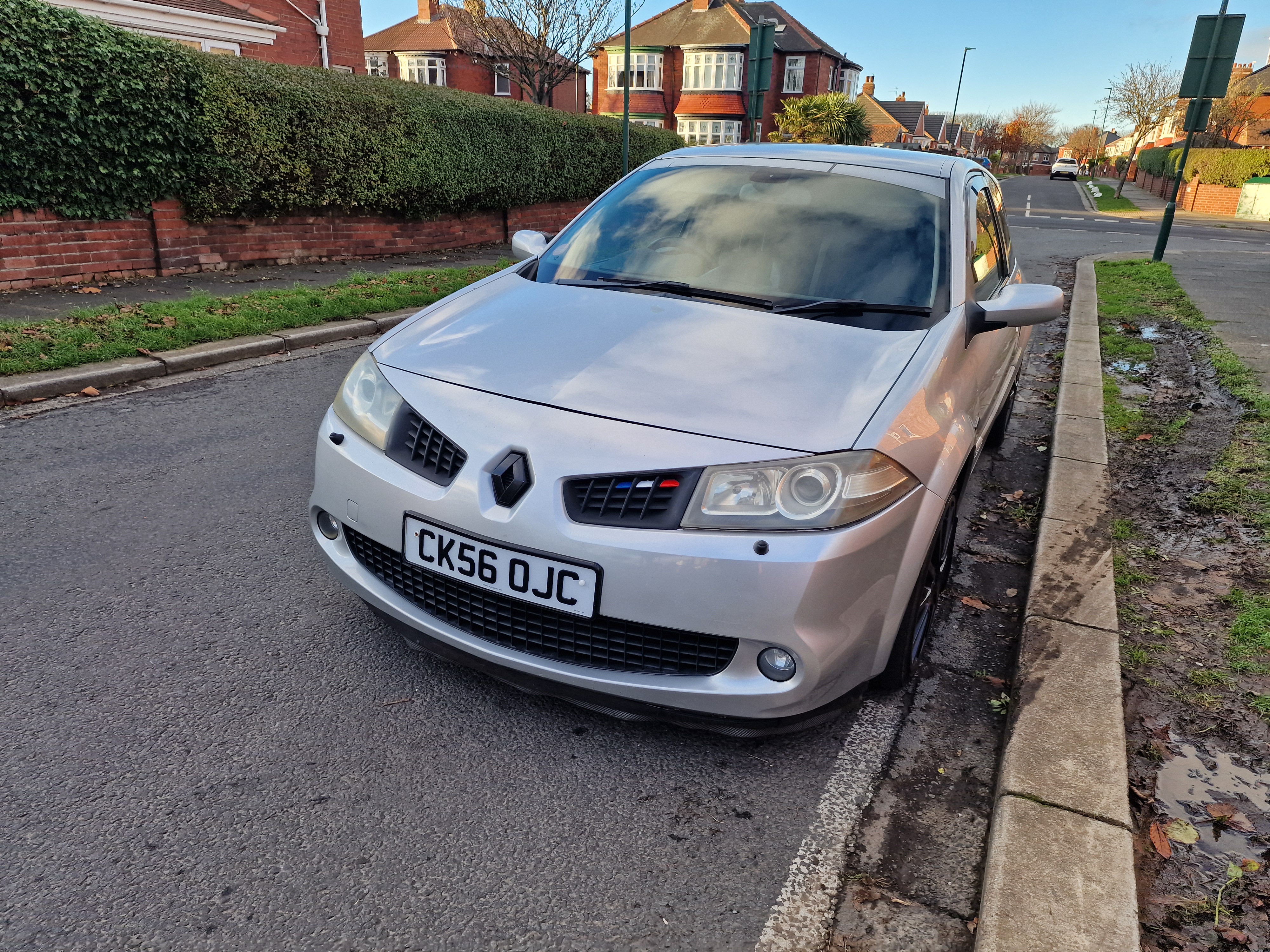

3 months worth of looking and nowt had come up which worked. Had the mrs looking for me and she spots a cheap 56reg silver megane 225 on Gumtree. Only down the road, fire the seller a message through the week asking if still up for sale and answer is yes. Price is a bit higher than i wanted to pay, so its got to have a good rear qtr and decent engine and gearbox to claw some money back from breaking it.
Arrange viewing for 12pm Sunday. Get up, bit of food, diagnose blue clio, quick poo and out the door. Its sunny and dry for a change so go in the yellow megane r26.
The car is in Hartlepool which is only 35mins or so away from me, and i know the area from working around there previously.

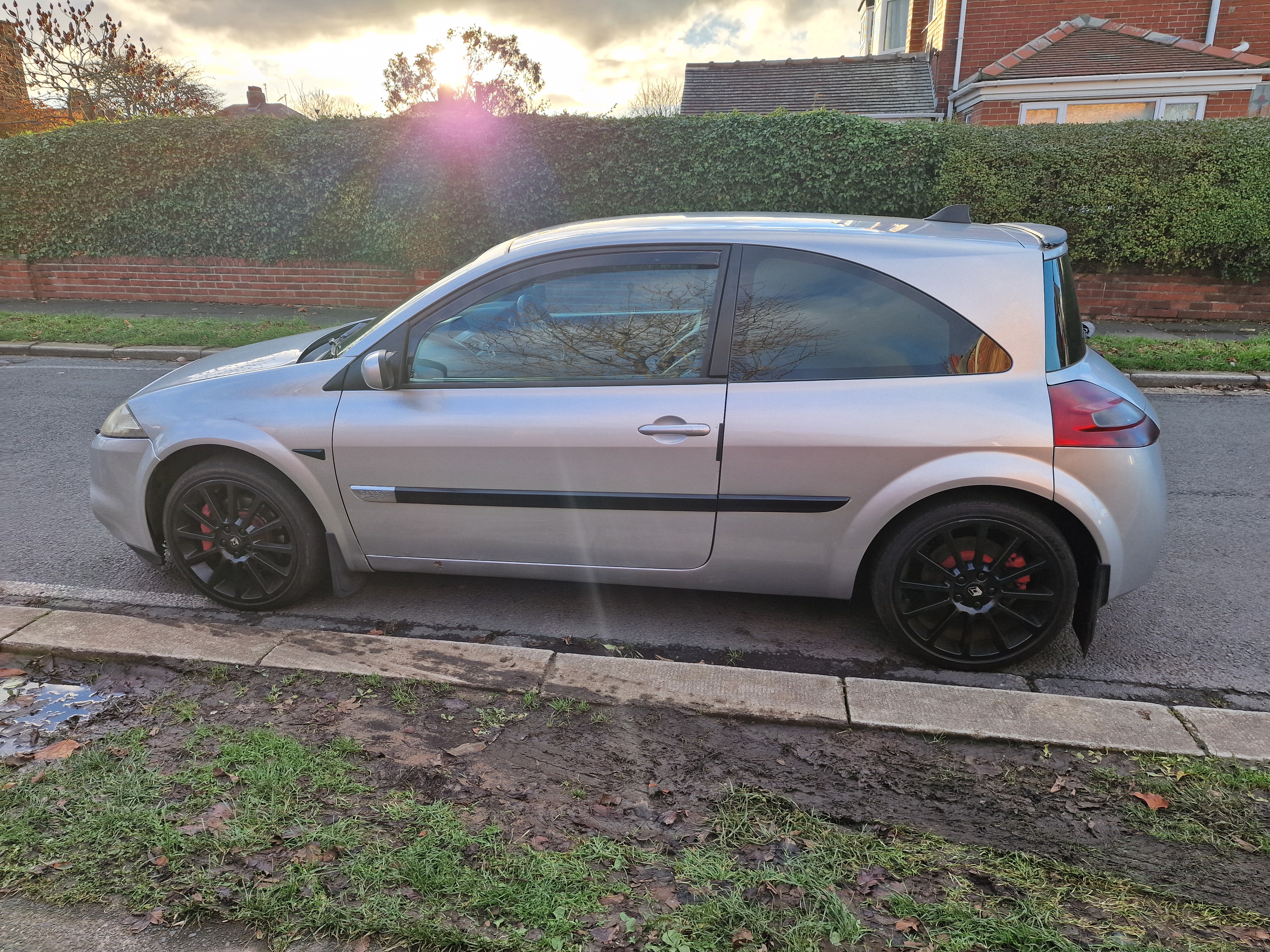

Arrive at the sellers house and the silver 225 is outside. Look at the rear qtr straight away ignoring the rest, looks spot on which im absolutely amazed at so im now interested.
Looked round the rest of the car having a laugh with the seller at a few bits. The advert was honest stating various issues including knackered front arm bushes etc, various electrics not working, handbrake fooked, clicky cv joints etc so i already know that its going to be a knacker. I accidently lock the drivers door on the keyless, and it wont open from outside.
Note it looks like the car has ran through temu with loads of stick on shite. Open and close boot and numberplate light falls to bits. Open bonnet, engine is typically oily megane rs and it has a forge blow off valve. Try to shut bonnet and bonnet catch bounces so me and the seller have to free it off manually so it will close.
Fire it up, and engine sounds sweet. No warnings on dash or nothing, was expecting check injection or airbag lights at minimum.
Take it for a quick test run round the block. Seller says its been mapped and do note it does go pretty well with one wheel peel on damp roads/s**t tyres and the essentials work ok, brakes, goes etc.
Go back and money changes hands, fire some temp insurance on it and set off on home journey. Didnt even need to put petrol in as had 1/4 of a tank of fuel.
Drive home was rather uneventful. I couldnt be arsed trying to work the chinese spec crap double din stereo so opted for turbo noises. Nothing falls off, temp gauge solid on 1/4 like they all are etc. Brakes derust fast, brake pedal feels fine.
My mrs was following me in the yellow megane r26, so we have a little race down the local dual carriageway near home, megane rs vs megane rs. My yellow meg is 270hp and the seller claimed this was stg 1 with exaggerated 300hp on stock turbo, stock intetcooler and still has the cat in, obviously not 300hp but can tell its been mapped as ive driven loads of megane rs over the years. The yellow meg pulled away from me, but not by a massive amount, taking a guess its probably around 250hp.
Overall the engine is pretty strong in it and pulls well.
Anyway your probably thinking less talking bollox and get some pics up..this is what you get for sub £1000 megane 225.
Doesnt look too bad from a distance eh!? Tat all over and loads of bodged bits.
Decent enough for the money, the engine seems pretty good and its rot free, in some respects it does seem a shame to chop it up. But realistically, it needs fckk loads of work to make it good. I reckon it would need £1-2k to put it 'right'.
Chop chop soon, engine and box out and a few bits off and the rest is going over the bridge.
Thanks for reading!!
Updates.
Stripped the breaker 225 in a day.
Big hole.
These meganes are absolutely solid and it took a fair bit of 9" grinder action to get that off!
