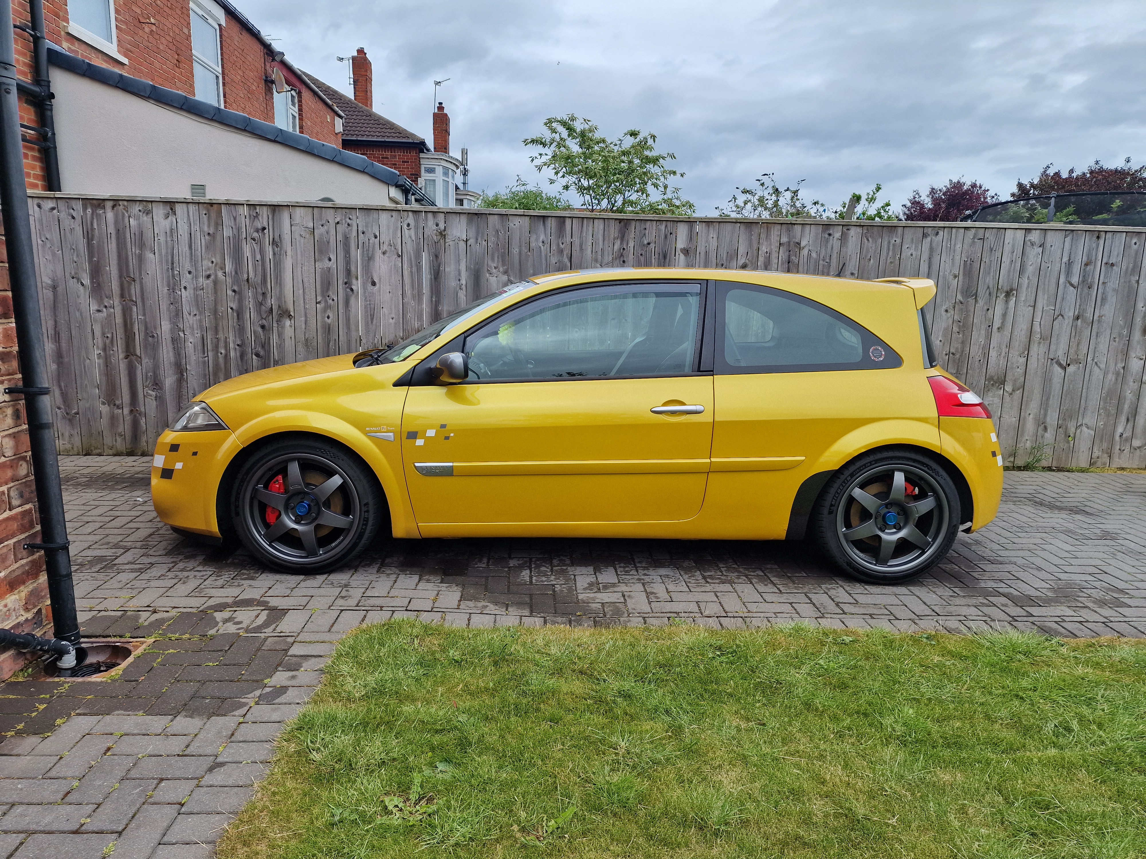

R26 not really moved apart from a couple of local runs out due to leaking water pump/cambelt job due imminently.
I have all the parts ready to go, just waiting for my snap on torque wrench to come back from repair. Hopefully be back mid Jan so can crack on and get that sorted.
Give it a clean up and coat of BH touch on last week.
Still rocking spa sticker
Also booked first trackday for 2025, Croft 18th April. Cant wait.
Thanks for reading!!

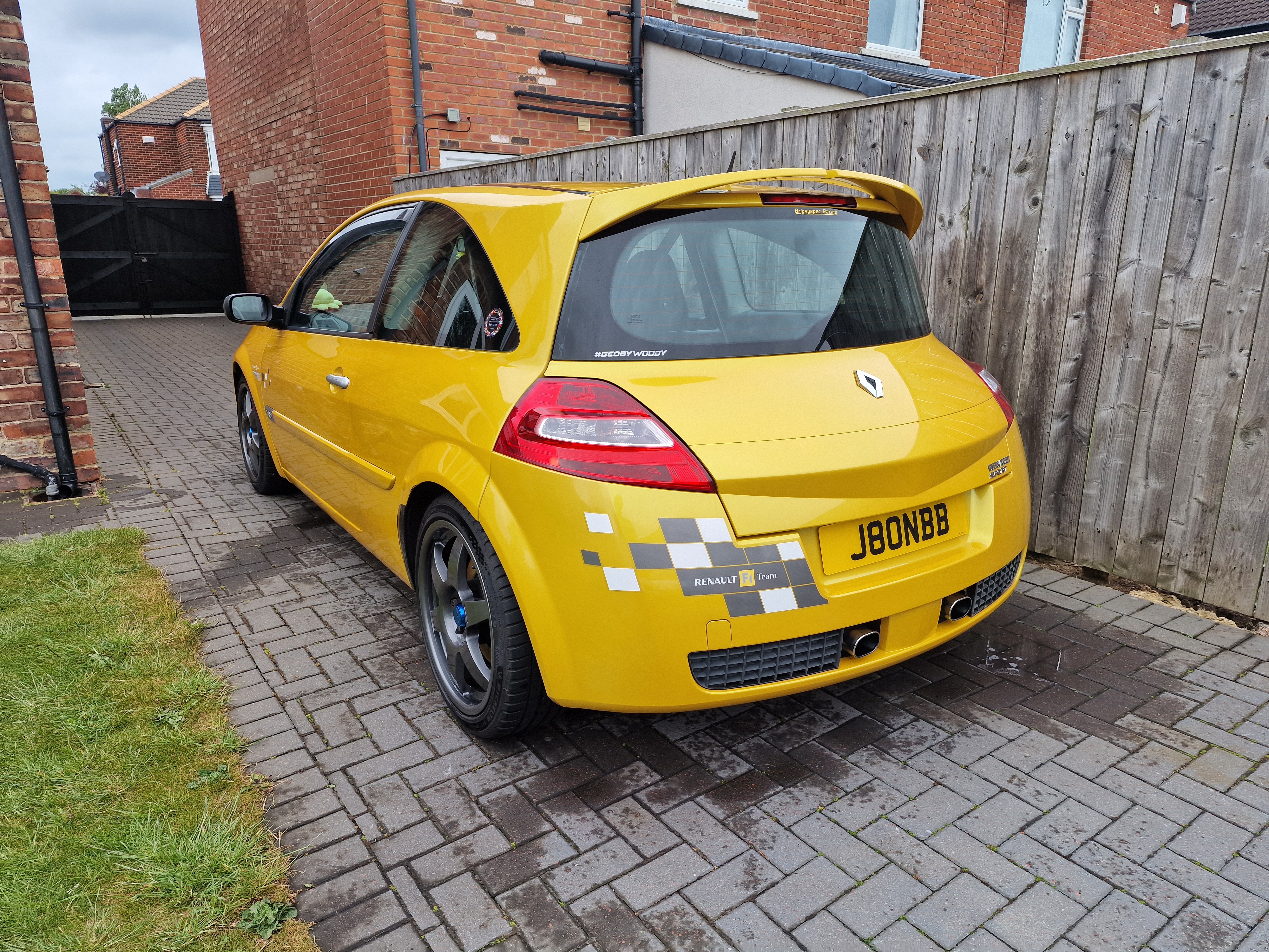

Clean, still comes up nice for an 18year old meg.
With the weather being pretty decent for a change took it for a run out. Done 50 miles or so, no issues.

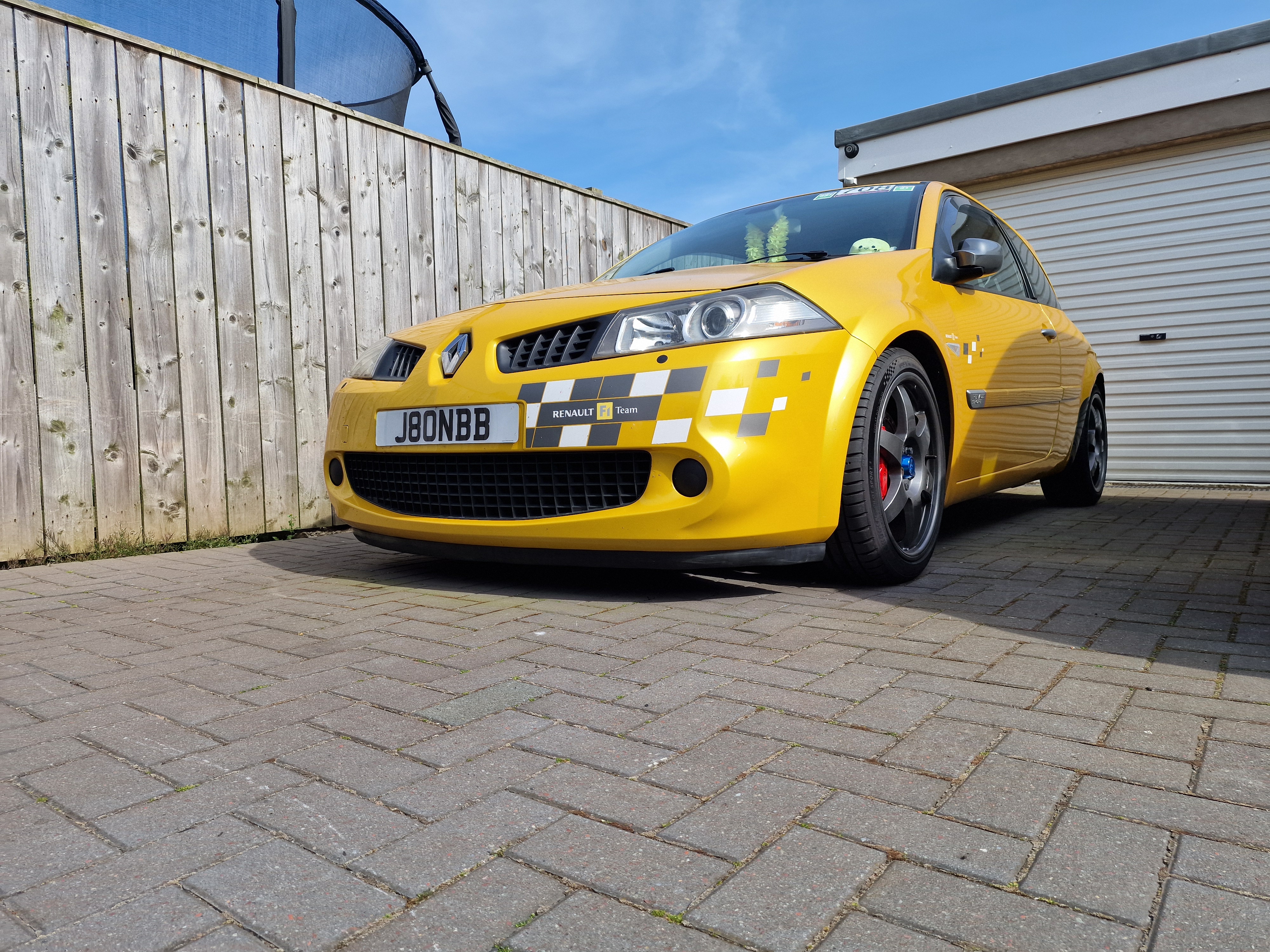

Been using it a fair bit this week. Nice to drive something reasonably quick on a daily.

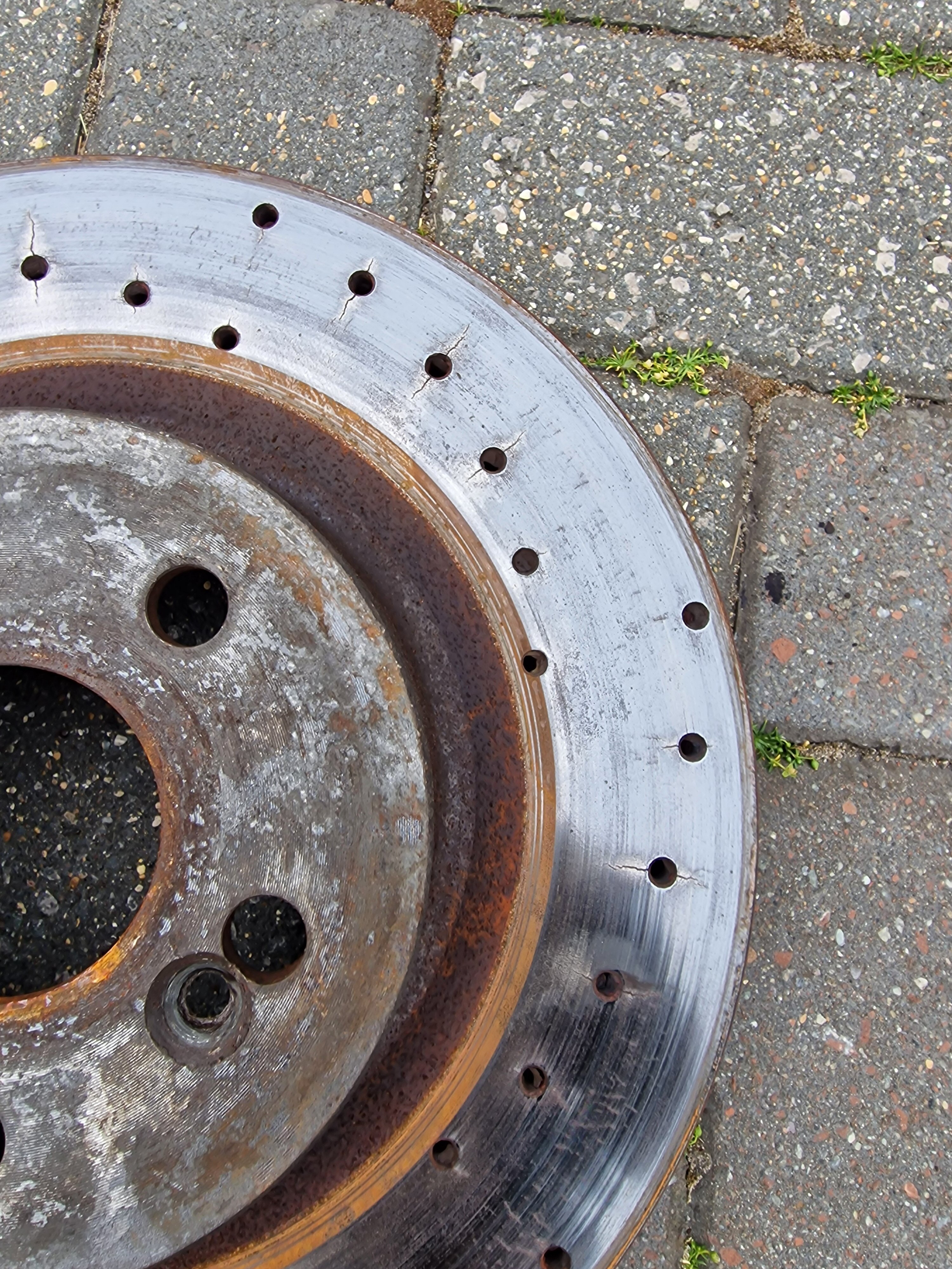

Give it a post trackday checkup on Sat. Everything ok apart from Brakes..fcuked. Front discs quite badly cracked, with some almost at the edge of the disc so in the bin. Front ds1.11 pads still have another send in them but low ish. Rear discs battle scarred due to metal on metal.
Ive put stock pads back in the front and checked rears over. Id took quite a bit off the 2nd set of pads on the afternoon, if it hadnt rained late on i think i would have also done that set in. Pistons move dead easy, and to mitigate any pad binding in carrier ive binned 1x anti rattle shim so around 1-2mm of clearance/expansion possible. Doesnt appear to make any extra noise when driving so all ok.
Ive got a set of snr rear discs on order and solid brembo hc for the front. Ds2500 rear pads also on order, ill send the ds1.11 fronts again and have another spare set in stock.

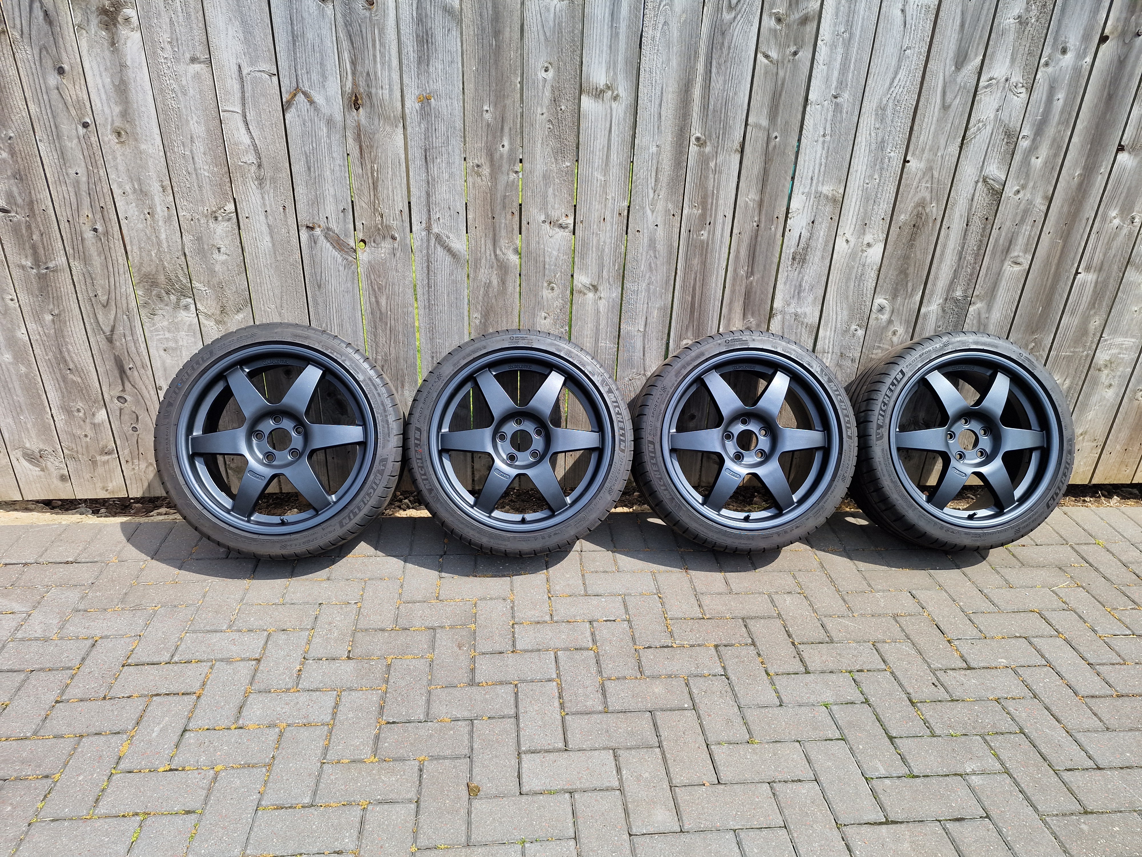

Also give the technomagnesio track wheels a good clean, they had not been done properly since before Spa and had metal all over. Came up pretty good without too much effort using Bh Autowheel.
Clean.

Drilled can get in the bin. Not a fan of drilled but was getting my moneys worth out of them, about the only part ive not had to replace on it :LOL:

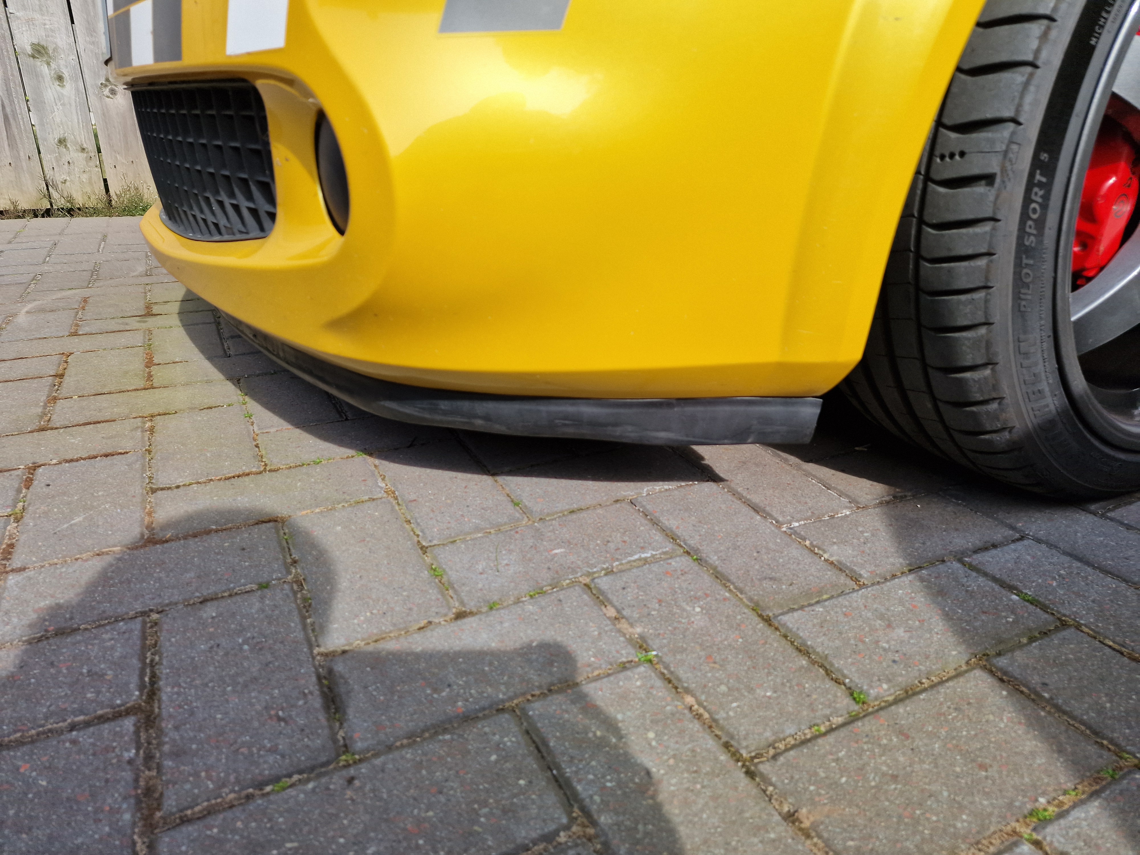

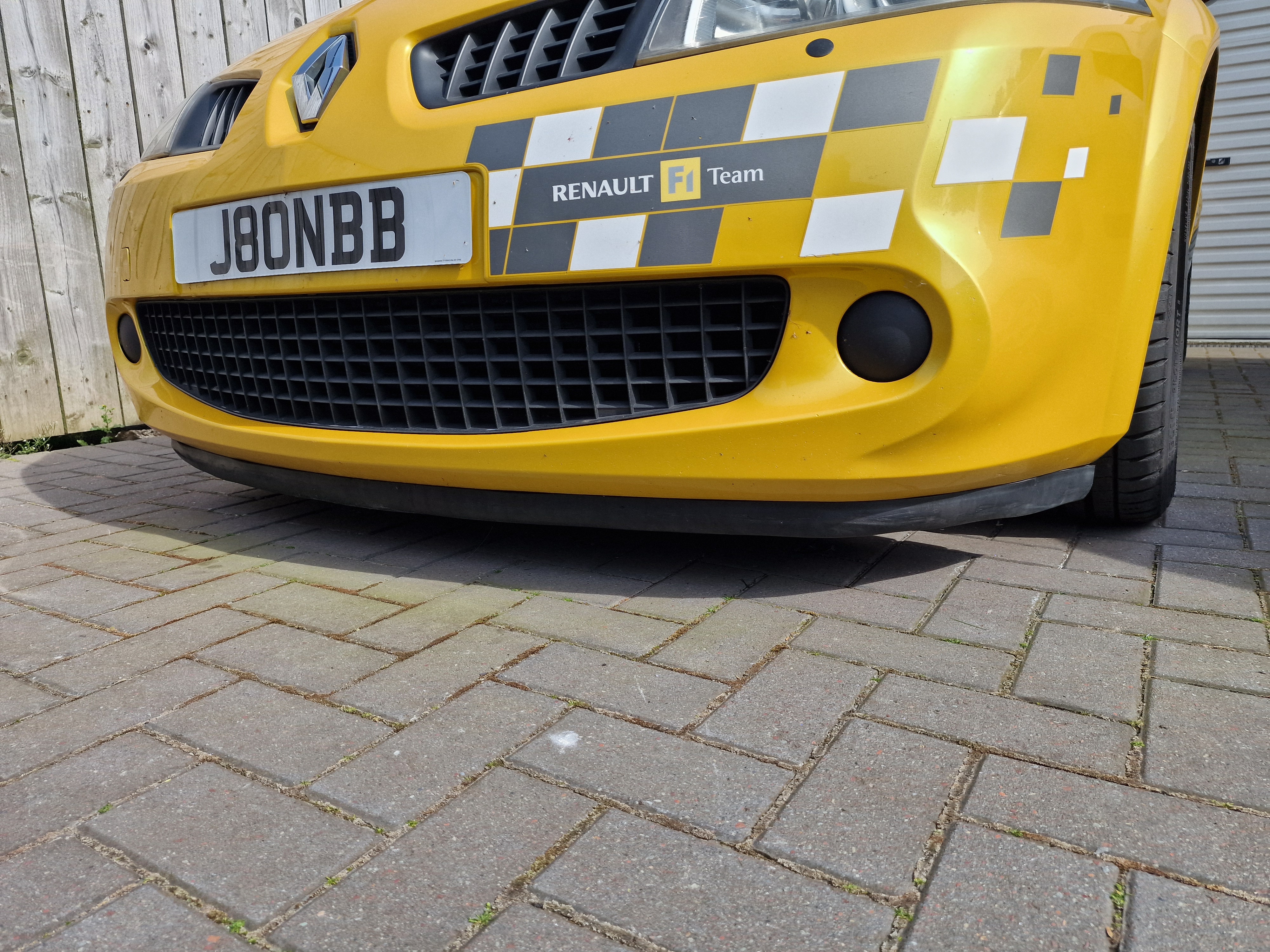

Anyway brake rant over. I had a coolant rad plastic shroud to fit so whipped bumper off the other day to install. Forgot to get any pics but promotes airflow through the rad pack which is never a bad thing, god knows why previous rough owners have binned them. I need drivers side one as the one i had was broken when offered up, awaiting a good used one to arrive.
Whilst bumper was off refixed the oem splitter. It was getting a bit wavy and looked like it was ready to depart as its seen a bit of kerb action with previous owners.
Its not perfect but 100x improved, also solid due to hidden small self tappers securing it.

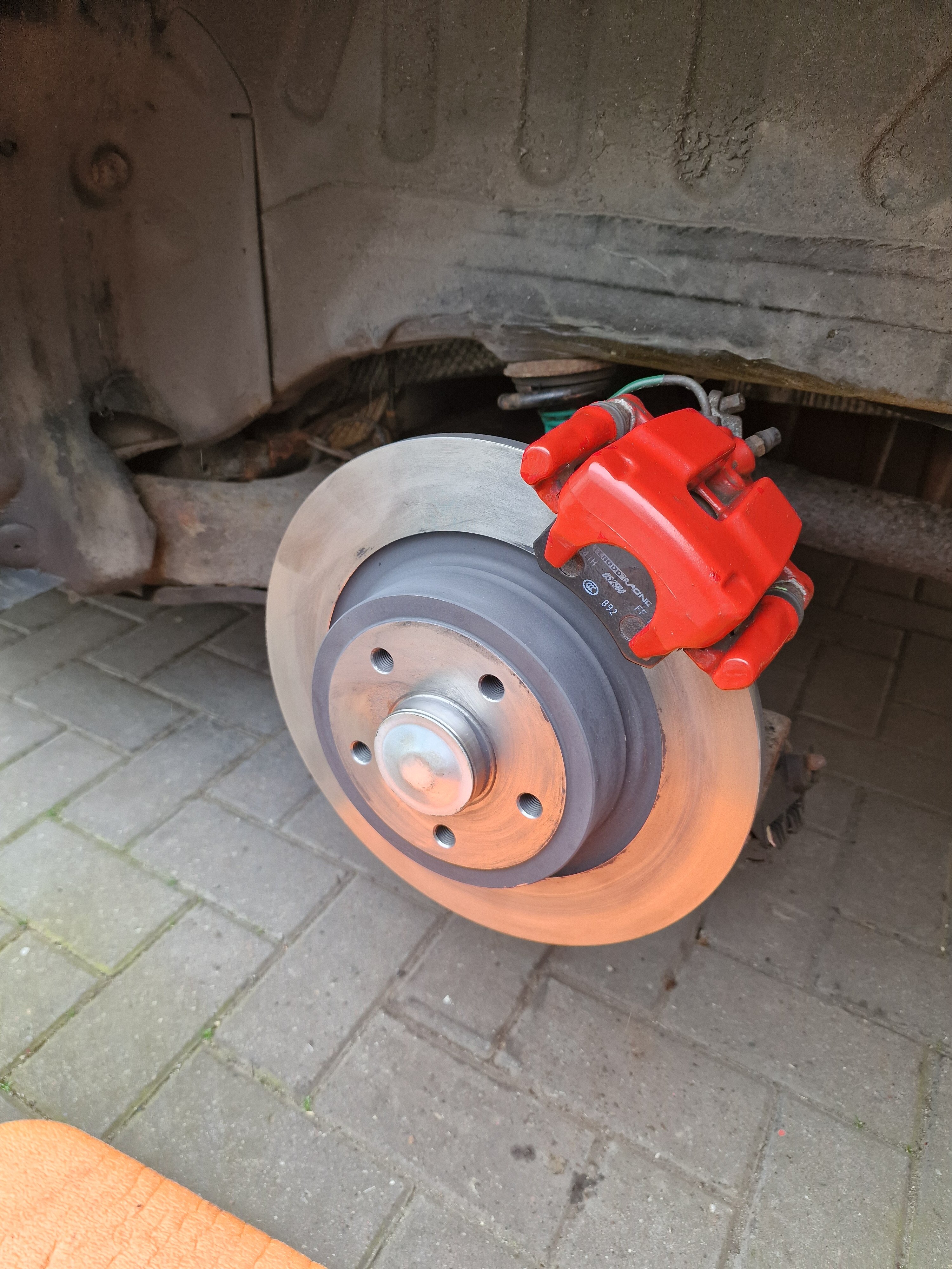

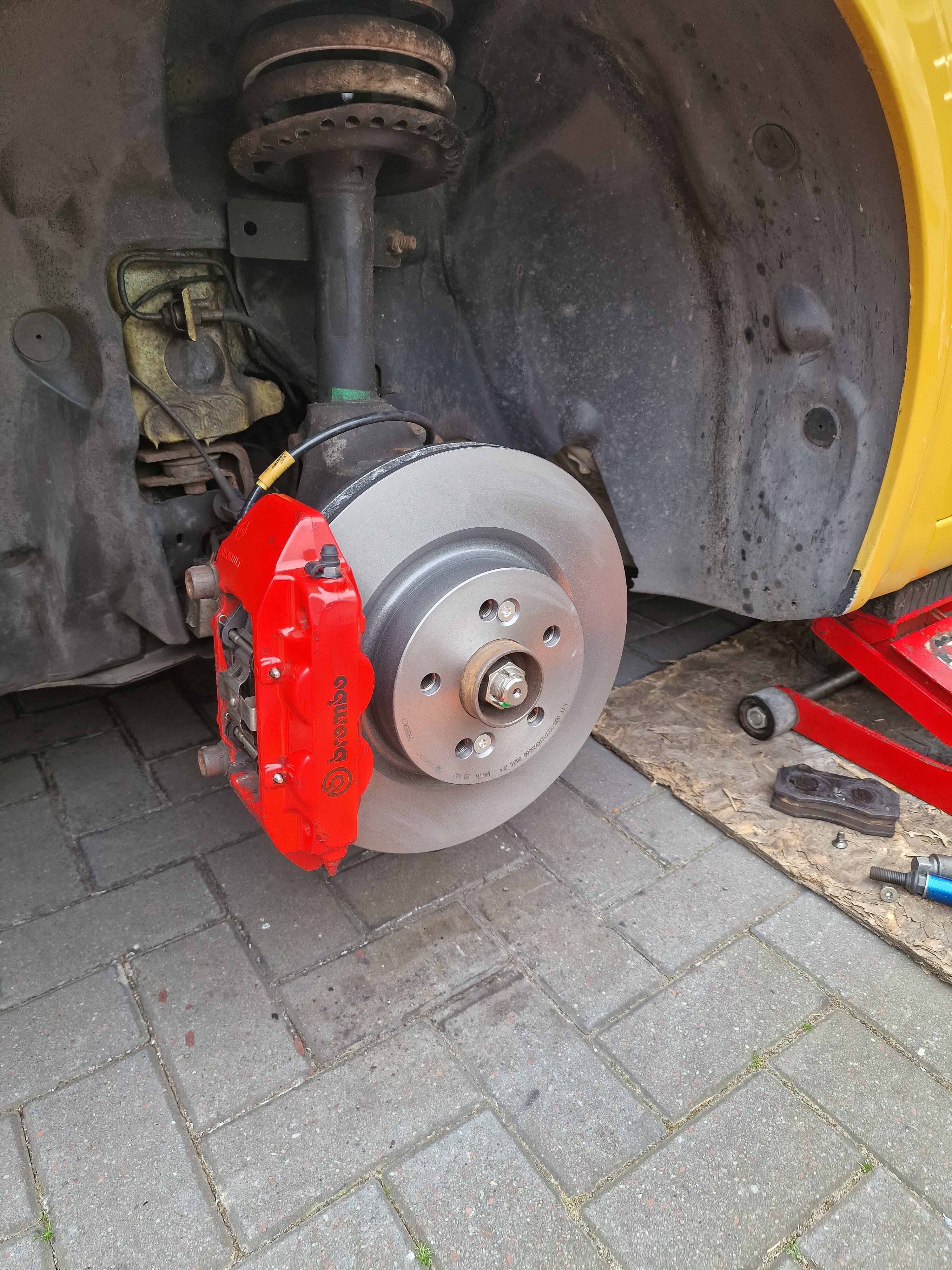

Had a couple of hours spare so fitted the new brakes front and rear yesterday.
Brembo HC plain discs/Ferodo Ds1.11 pads up front.
Snr plain rear discs and Ferodo Ds2500 on the rear. Rear discs not coated so splashed some vht paint on the centres to stop flash rust.
Interestingly i torqued the rear hub nut to 175nm which is always suggested and bearing still had a bit of play when wheel wiggled 12-6. I looked in the workshop manual to check this and 175nm is for povo spec models and sport lists 220nm. Once id done the nut up to 220nm all play was gone.
Eqt level sport correct torque settings.
Got my moneys worth out of the old discs.
Took it for a quick run out to bed the brakes in. In no time pad material was deposited on the disc and brakes were sharp again.
Anthracite wheels hide the dust

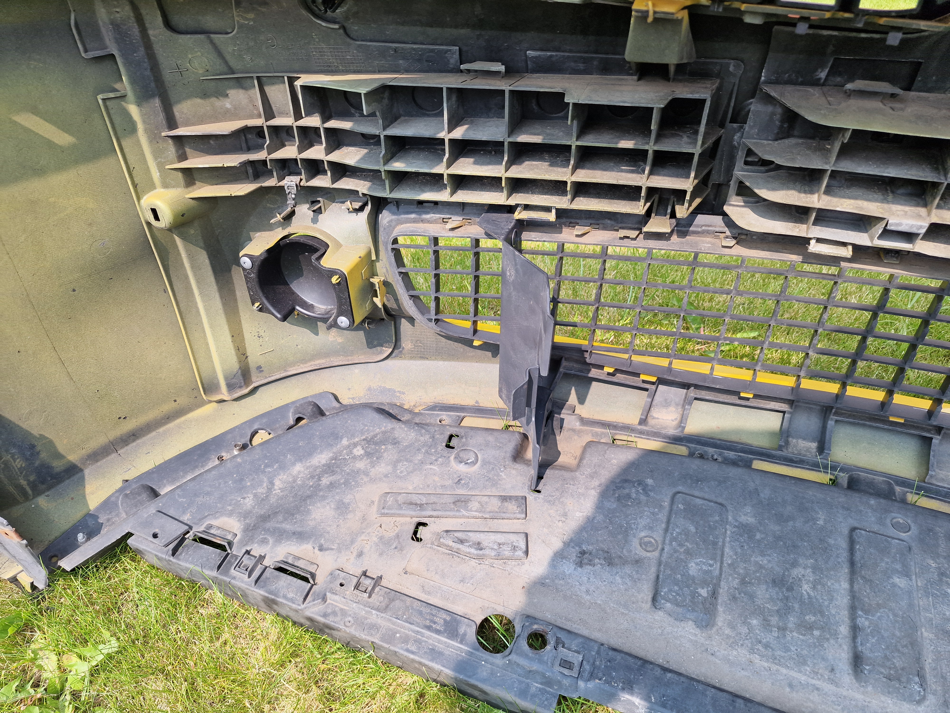

Daily driver this week, why not. Ive been having fun driving it and low mpg is the result. Apart from that its perfect, fast enough, easy to drive, ac ice cold etc what more do you need for a daily?!

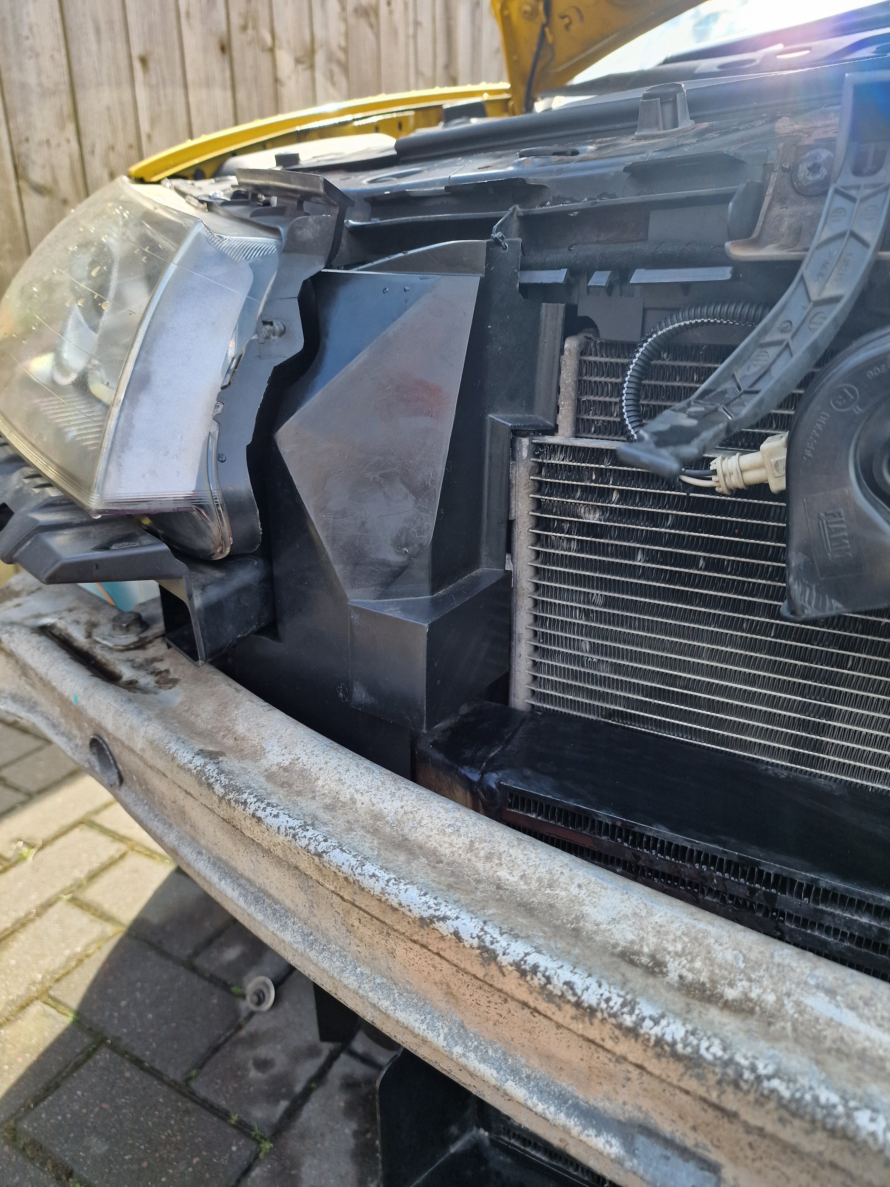

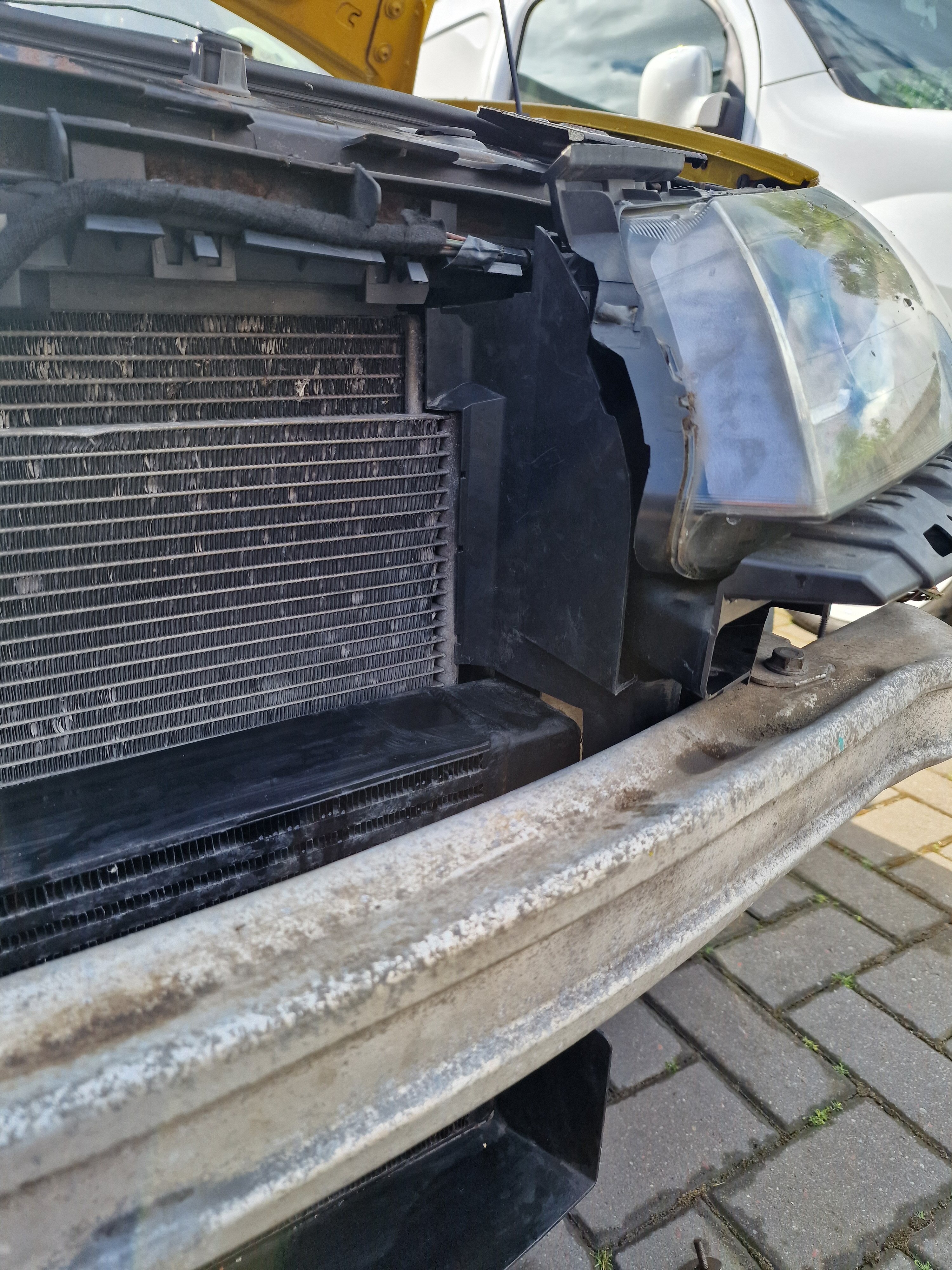

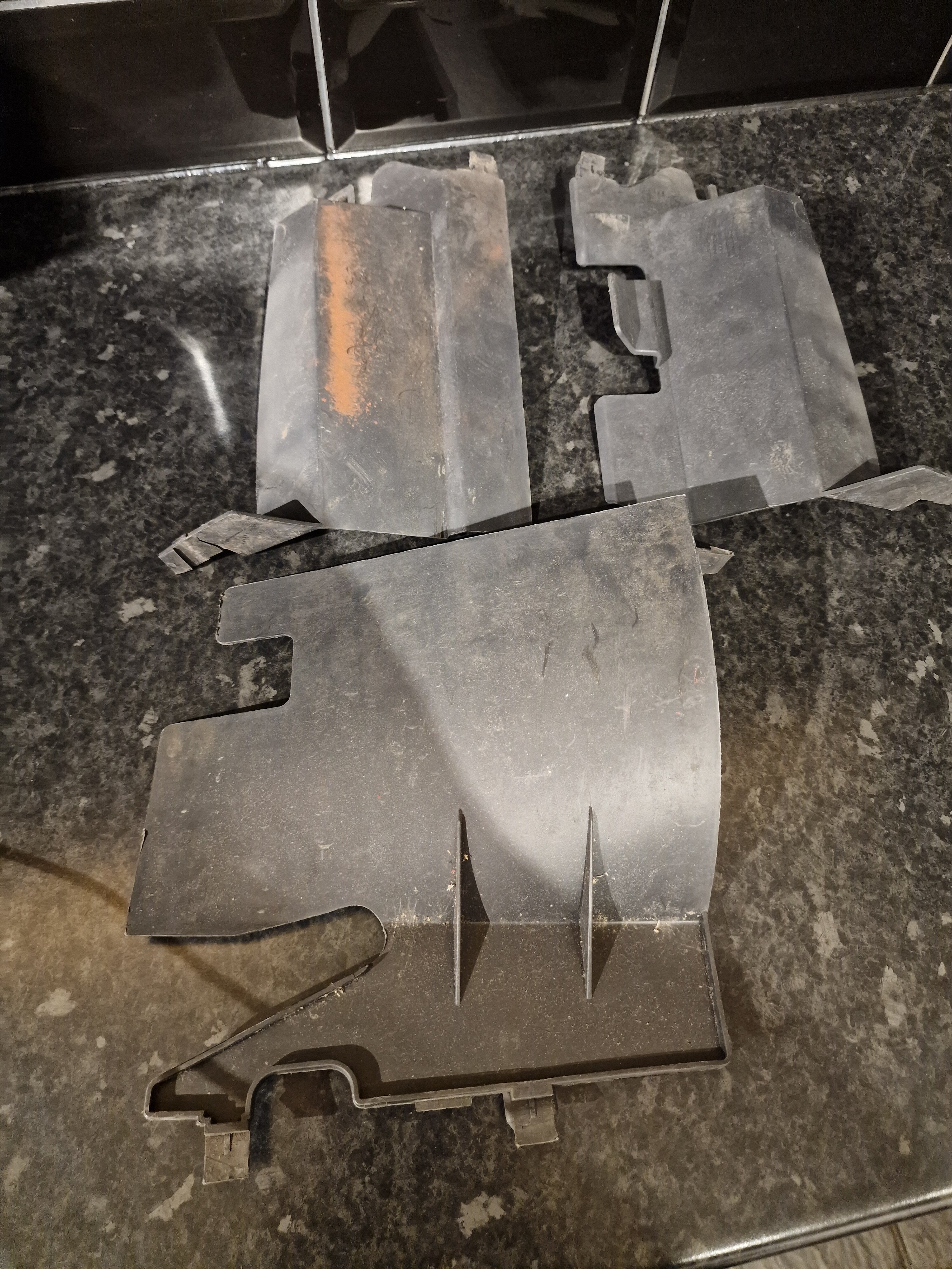

Anyway i snipered a set of radiator ducts from U pull it a few weeks ago as mine were obviously missing due to knobbers working on it previously. I thought it was worth refitting them to force the air route to be through the rad pack and not around it. When looking at the parts, the drivers side duct was bust so i googled the part number and found one on ebay, Same part as dci etc daft £20 delivered.
Whipped bumper off this morning and fitted, daft 15 min job. Had to trim the lower part so it fitted round the airtec intercooler which took 30 seconds to do.
Bumper off and ducting refitted.

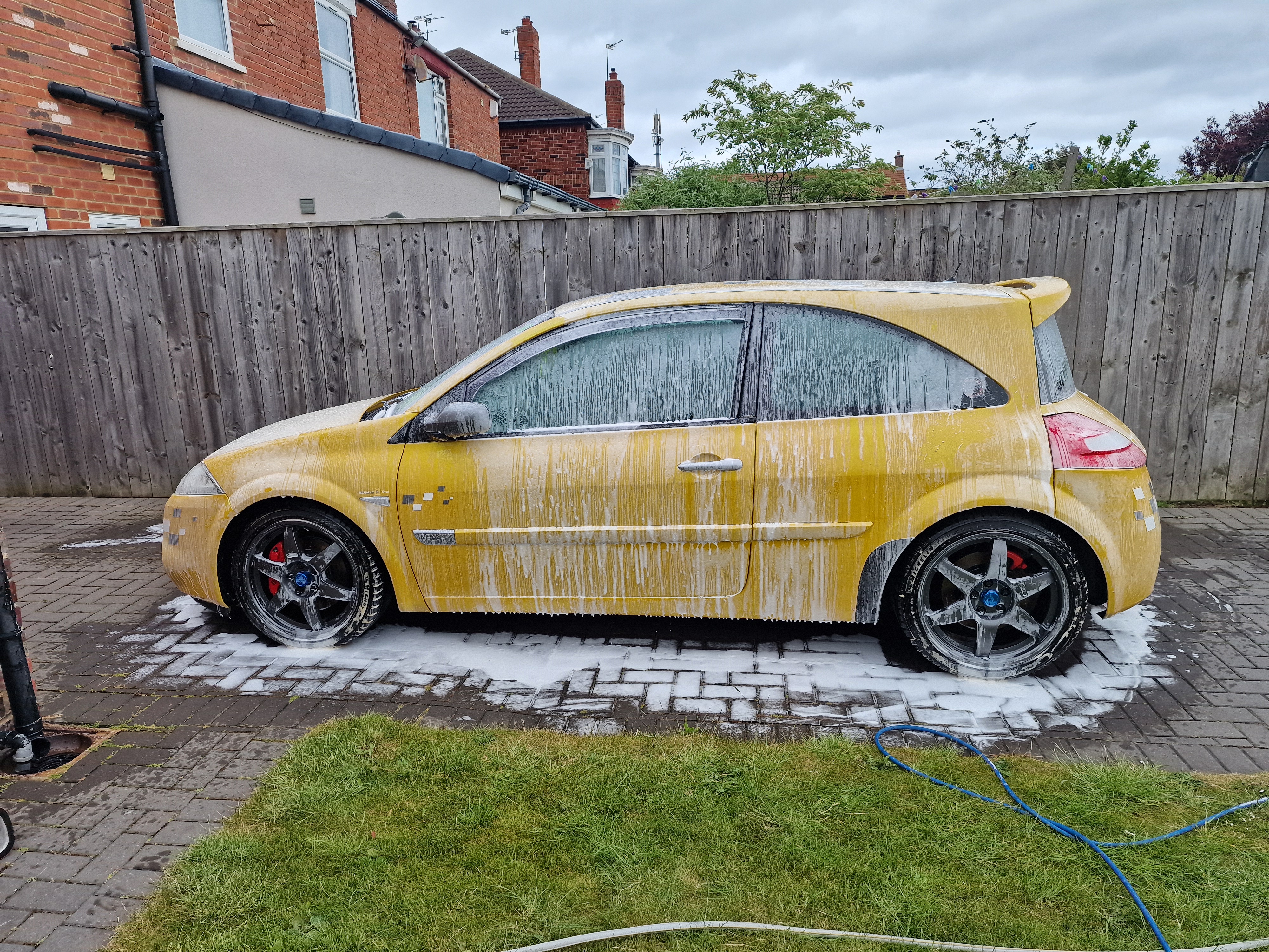

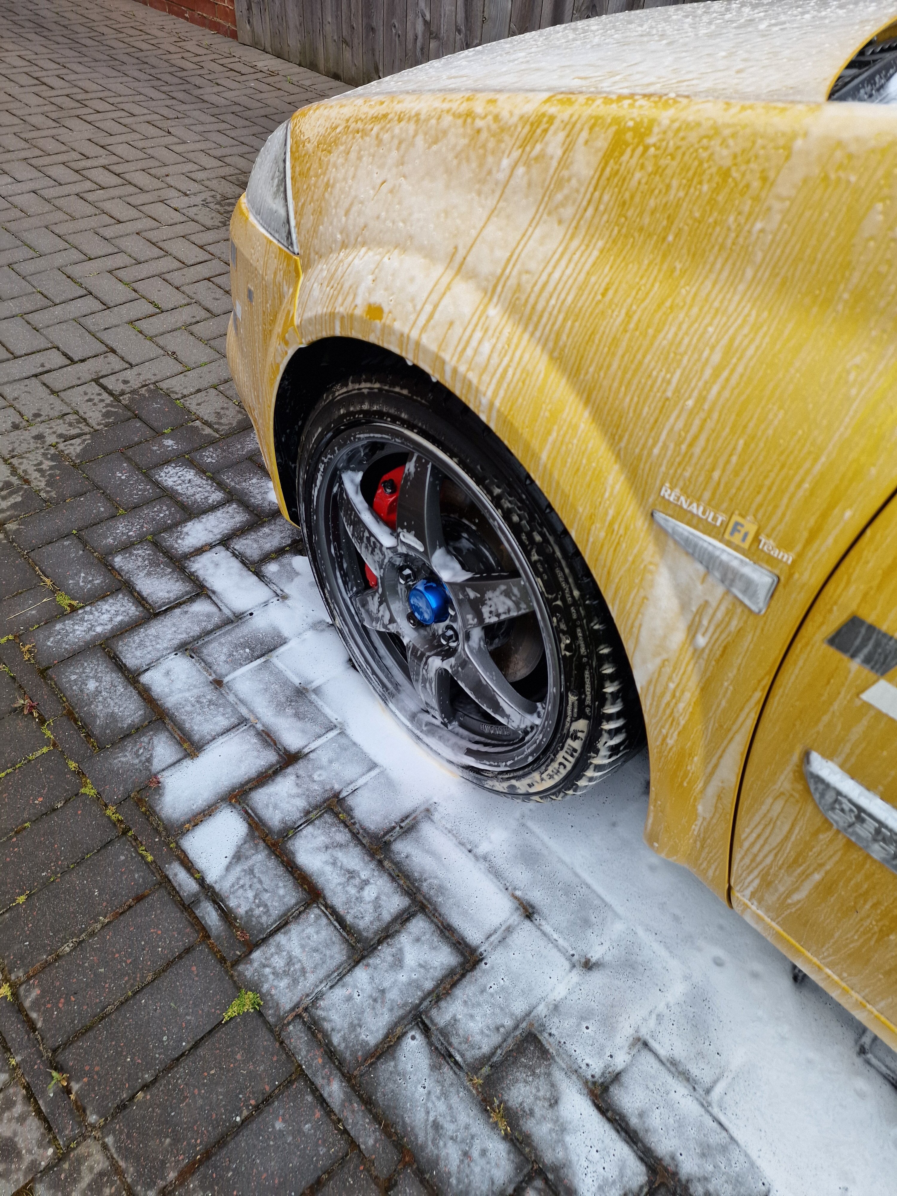

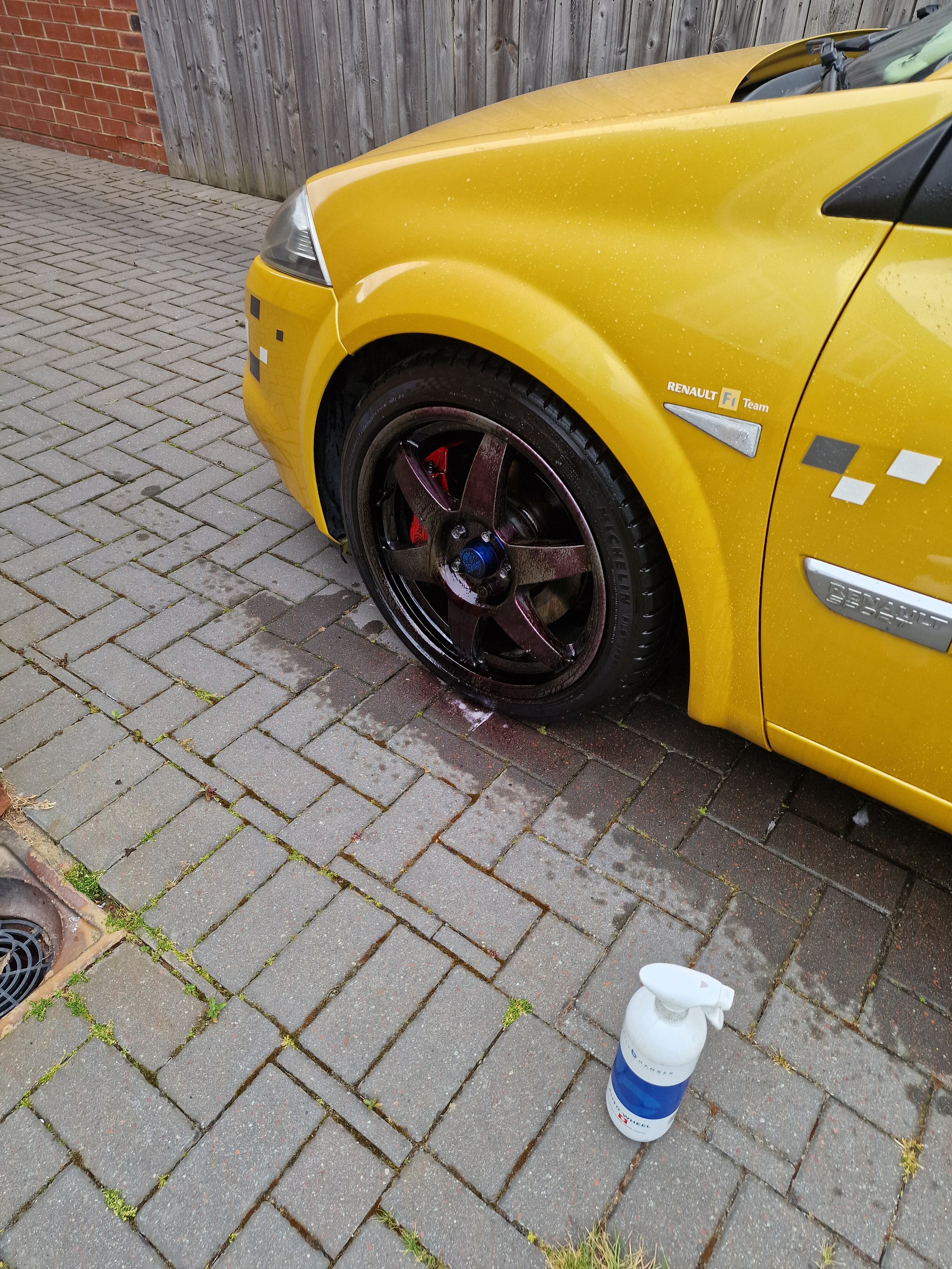

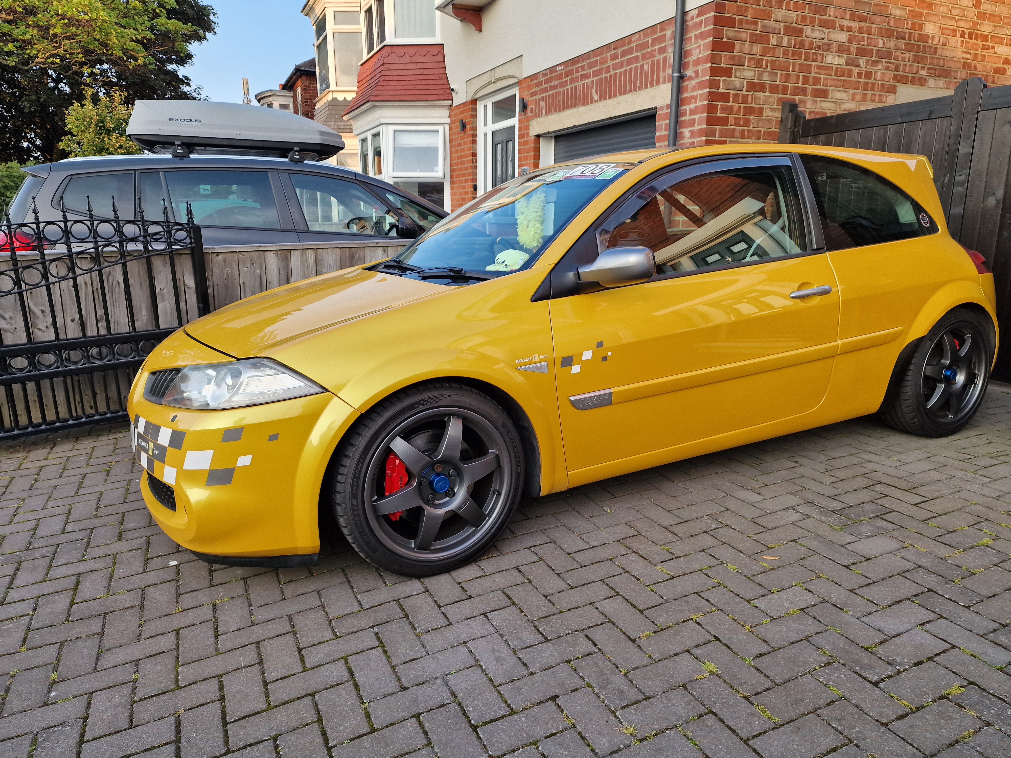

With this done i give it a clean up after id cleaned the Trophy. To be fair it was minging, the wheels were covered in fallout on all 4 corners from bedding in the pads. It rained overnignt and the wheels had turned a bit orange so best pull finger out.

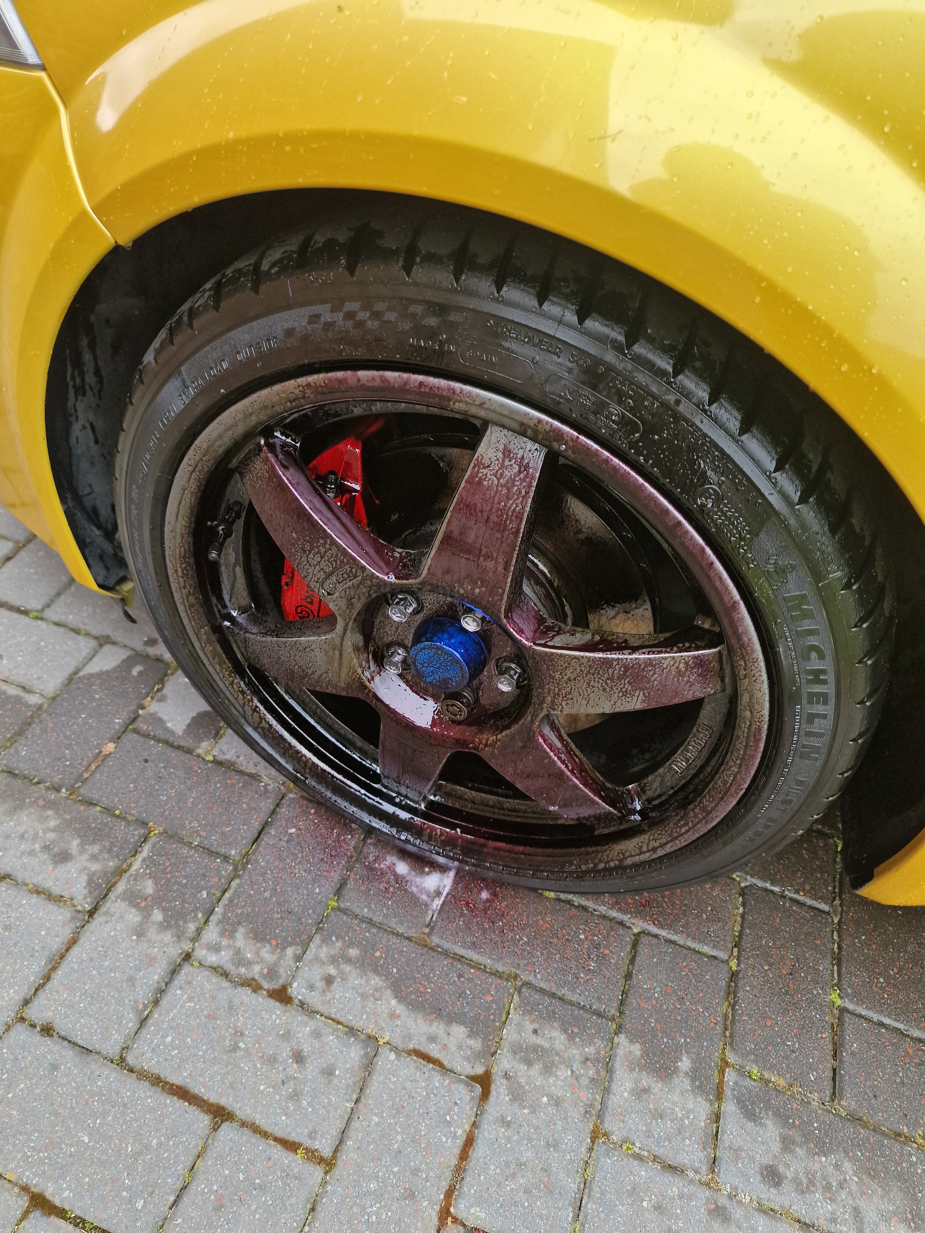

Bh Autowheel needed..all 4 corners were covered in metal filings.
Both sides needed fallout remover again to get the crap off. Followed by BH autofoam, Gwash and a coat of BH Touch on.
Wheels and bodywork looking much cleaner.
Still presents well for 140 thousand miles. Obviously it has pissed down all night since cleaning typicall, At least the wheels look clean again.

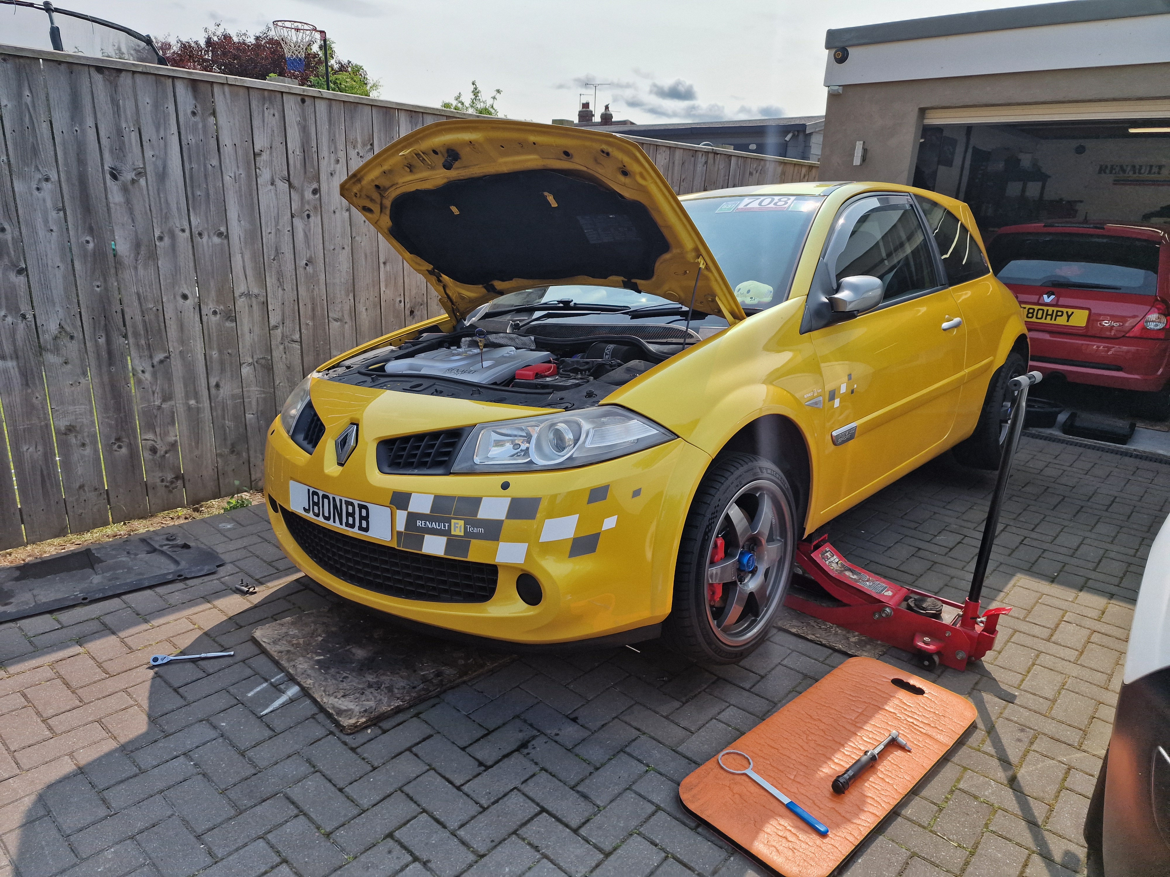

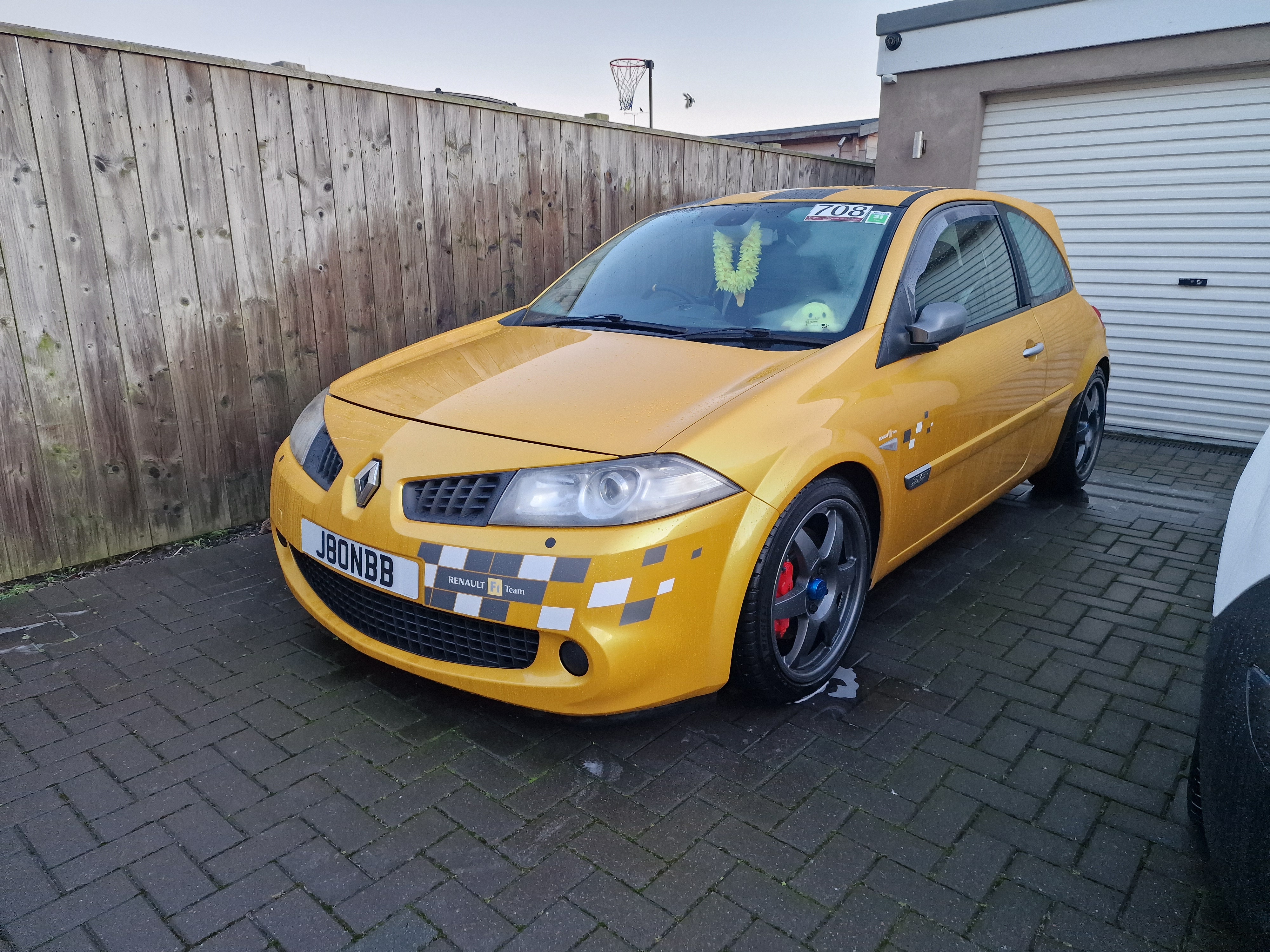

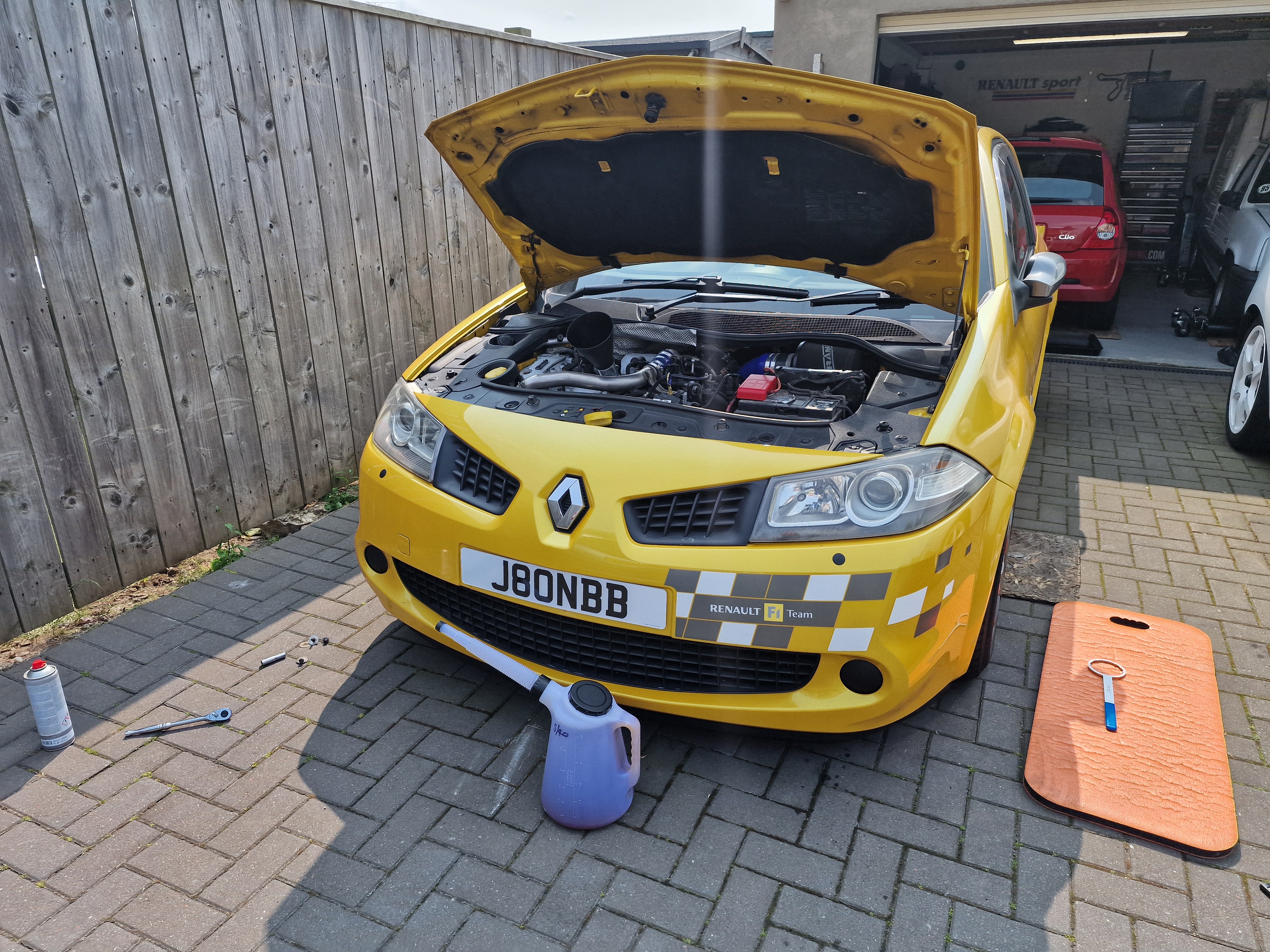

Spare hour this morning.
First job, oil and filter change.
Assume position.

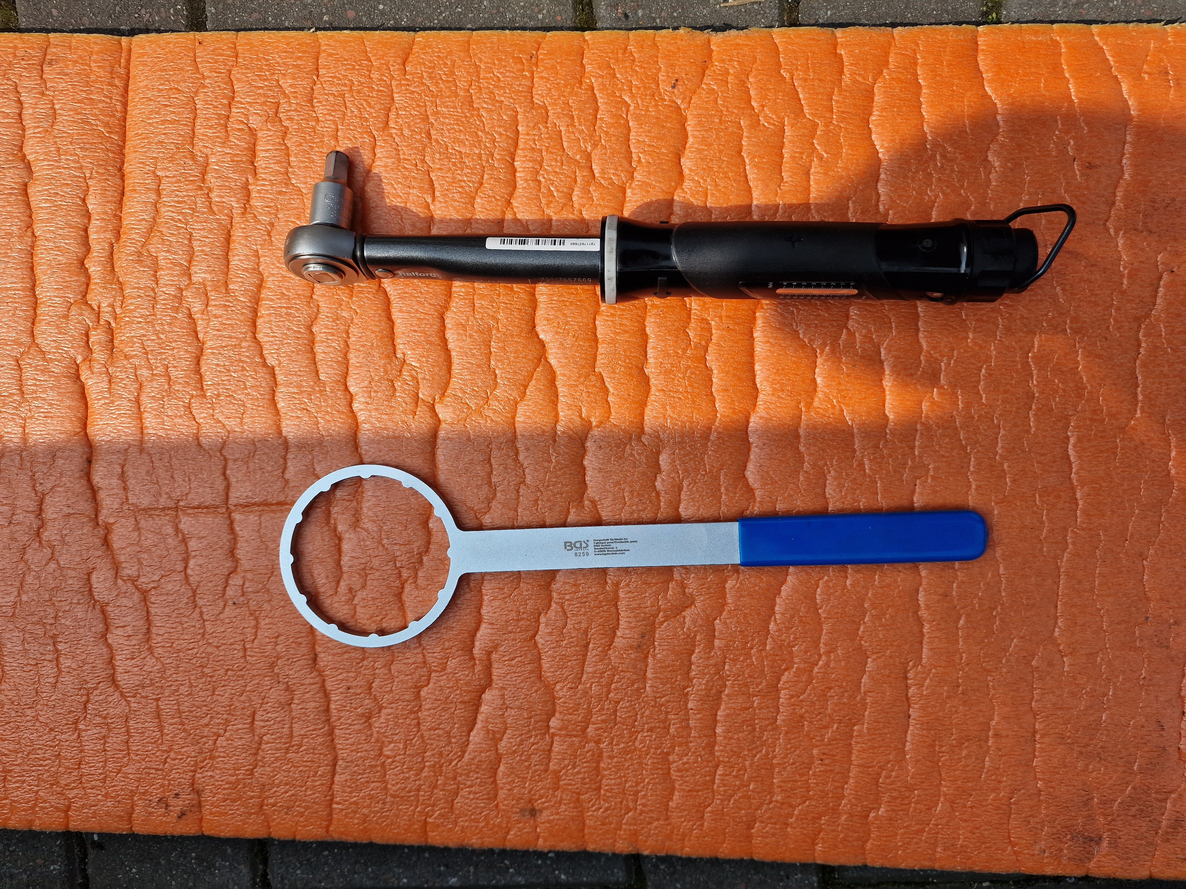

I seen a 12 point oil filter wrench designed for the renaults of this era a while back which was recommended for the meganes, and bought one (BGS Technic 8259).
BGS 8259
Tried it out this time and its amazing. Im used to wrestling filter loose with filter pliers and getting a few cuts on the way, but with this literally slide it over and undo from underneath, the thin profile fits straight in with ease where your limited with space for filter cups etc. These oil filters can go tight as fcuk with heat cycles and it turned it loose with minumum effort, and with the added bonus of hand away from filter, so can let the oil drain off without it going down your arm.
5.2ltrs of Valvoline Synthpower and Purflux LS932.

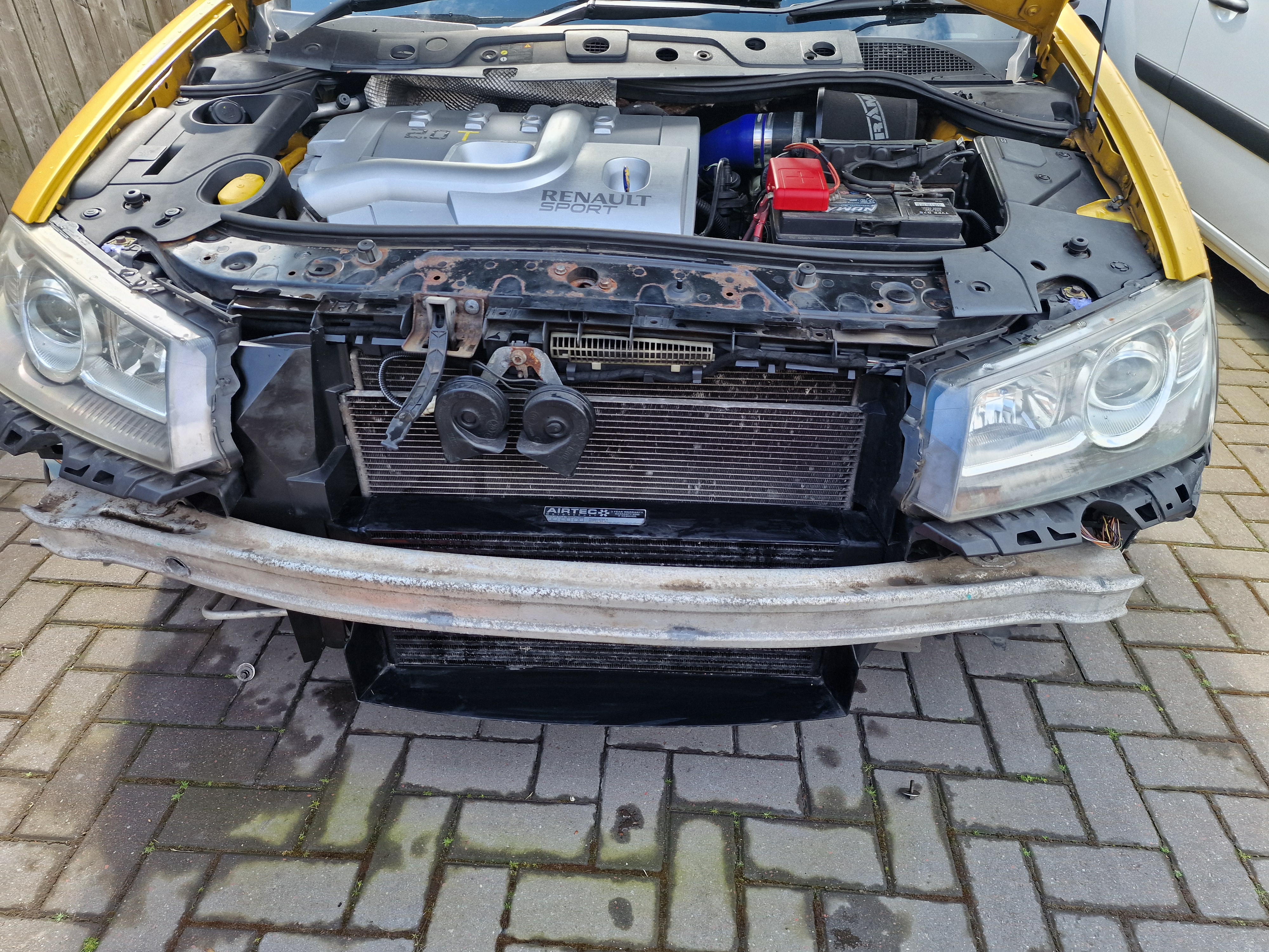

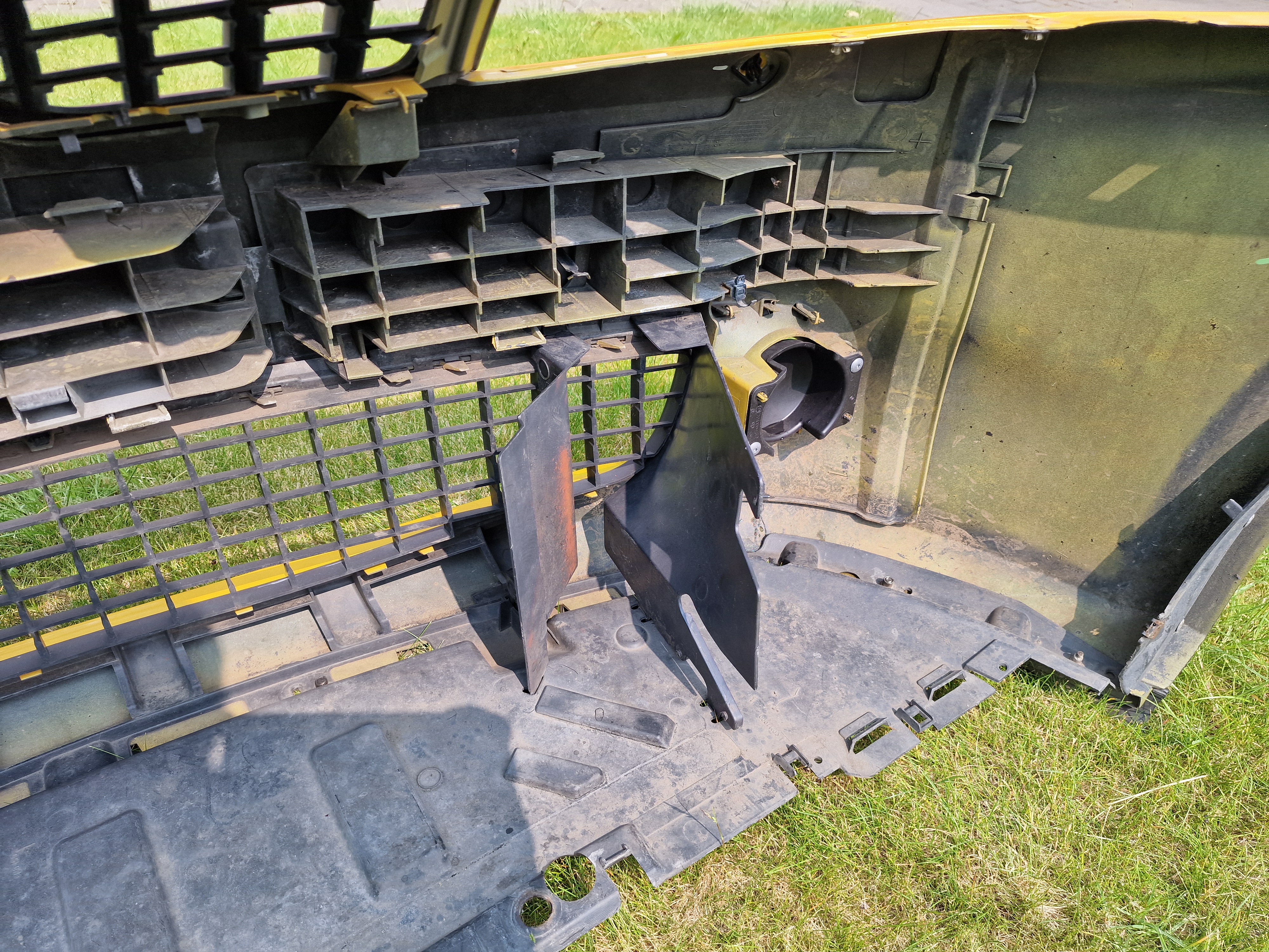

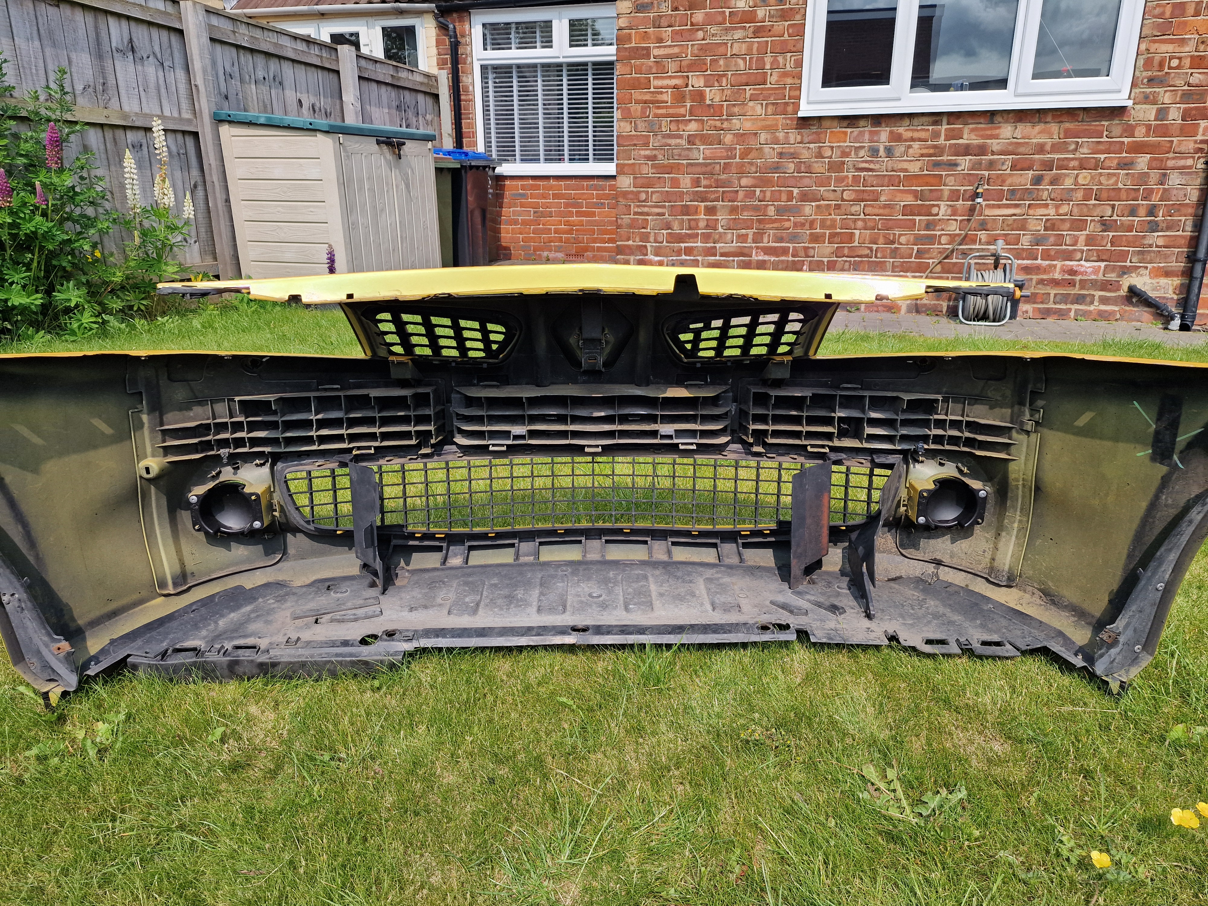

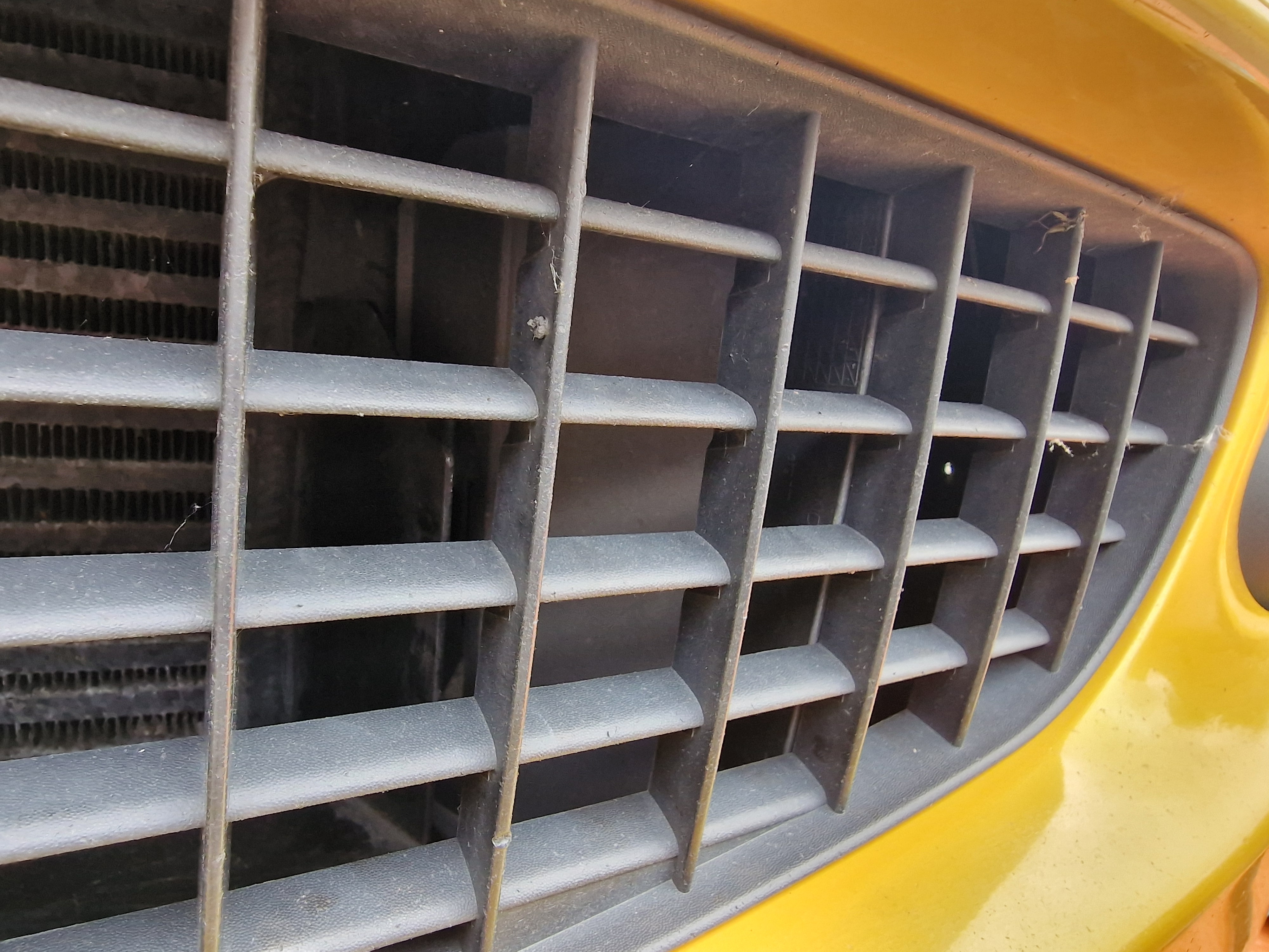

With that done in no time whipped bumper off to fit some more missing ducting that i had sourced off facebook marketplace. Seen an advert for a few random 225 parts which had bumper/intercooler ducts delivered to the door for a tenner. One was missing but better than nothing, seller was excellent and posted next day but typically they turned up just after fitting the upper ducts last week so its bumper off again.
Intercooler ducting.
Fitted.
Fits bang on with the Airtec intercooler. Ive no idea why people bin stuff like this as directing the air to the right location can make quite a difference to coolant and charge temps, and it fits with aftermarket intercoolers and the bumper fits the car better as more rigid.
As ive said loads of times charge temps are superb with the airtec cooler and coolant temps dont move much on this on track. Its mostly in the 90deg range for coolant but on power tracks on 25deg ambient or higher, on longer straights it goes up to around 100deg briefly on obd readings which you dont see on oem temp gauge, as it does not move from the hot running mark. It drops instantly when you roll off for a corner etc but any little improvement is a bonus to save ecu pulling ign etc.

Filter tool looks decent.
I've just ordered one of them filter drain things that clip on to stop oil going all over pipes and down front radiator support.
I need to order the drain clip on part for this, just keep forgetting.
Filter wrench well worth investing in for the meg.
Been out tonight and coolant/charge temps more stable with ducting too. Charge temps barely moving above ambient on the move.

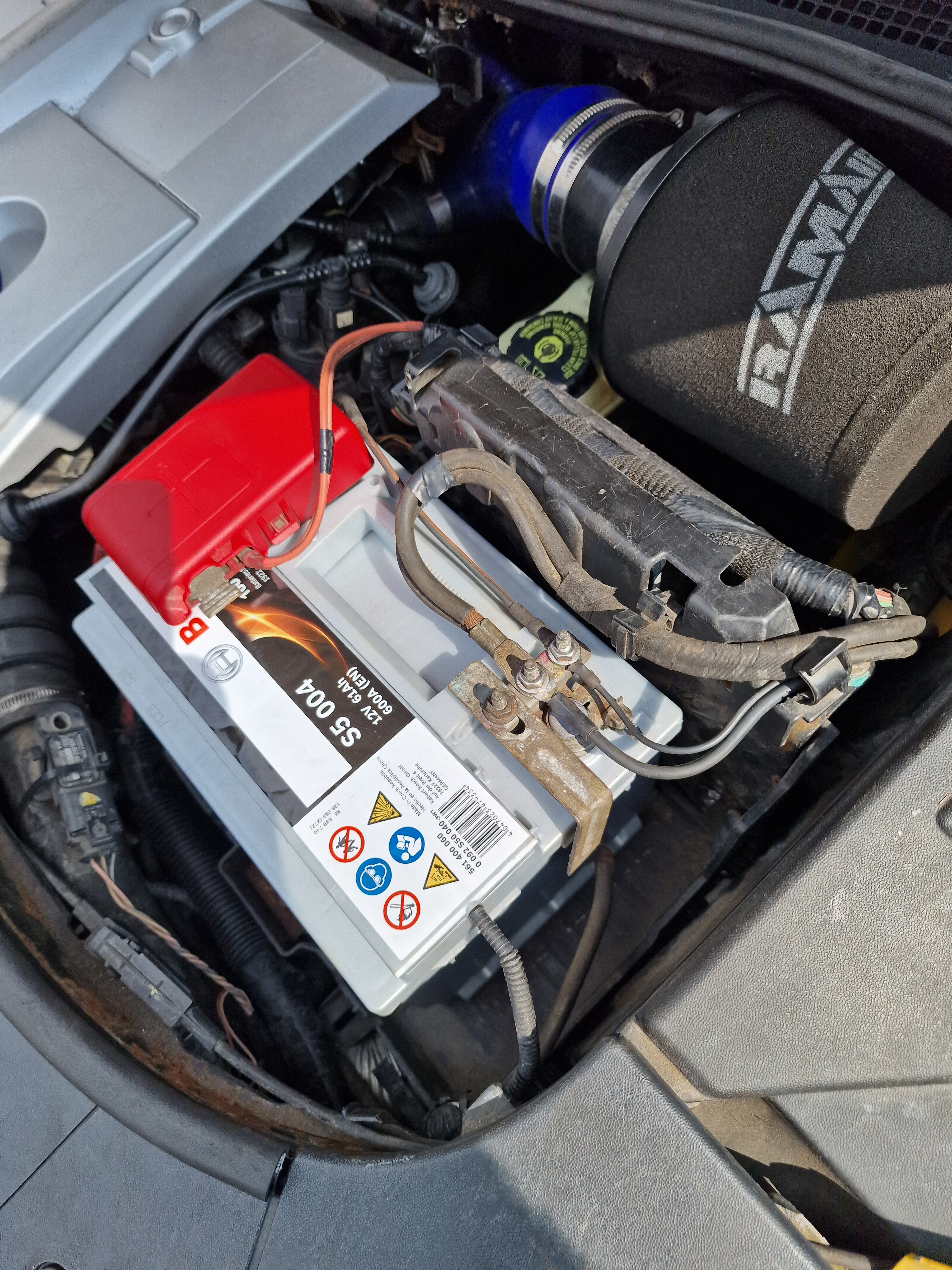

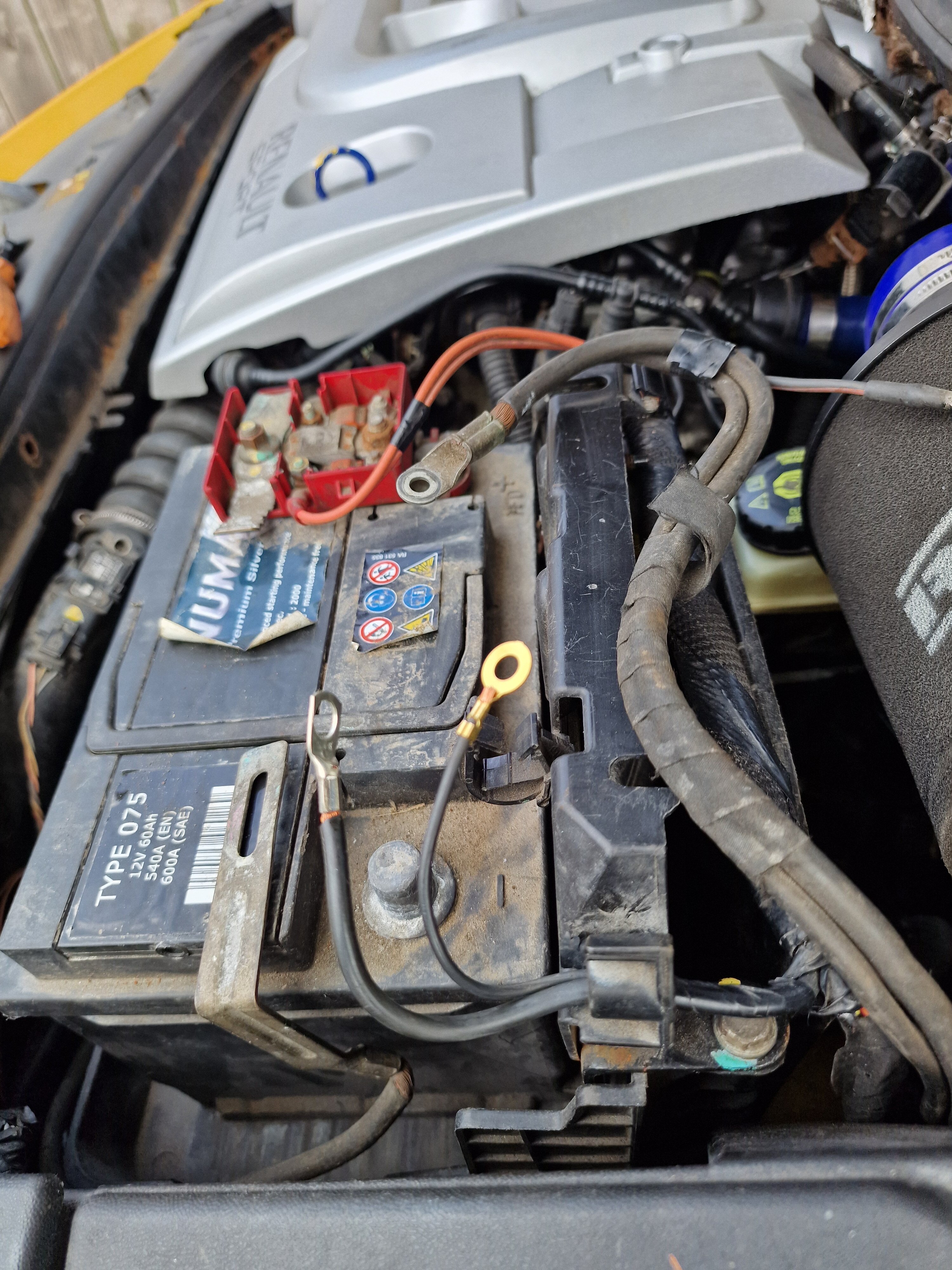

FTP (fail to proceed) on the meg on Sat. Went to start it up, ign on and starter click, battery flat as fcuk. It did sound lazy the week prior when starting but cant moan as the batt looks ancient.
9.5v not going to work
Ordered a new 075 bosch from Tanya, should be here at some point this week.

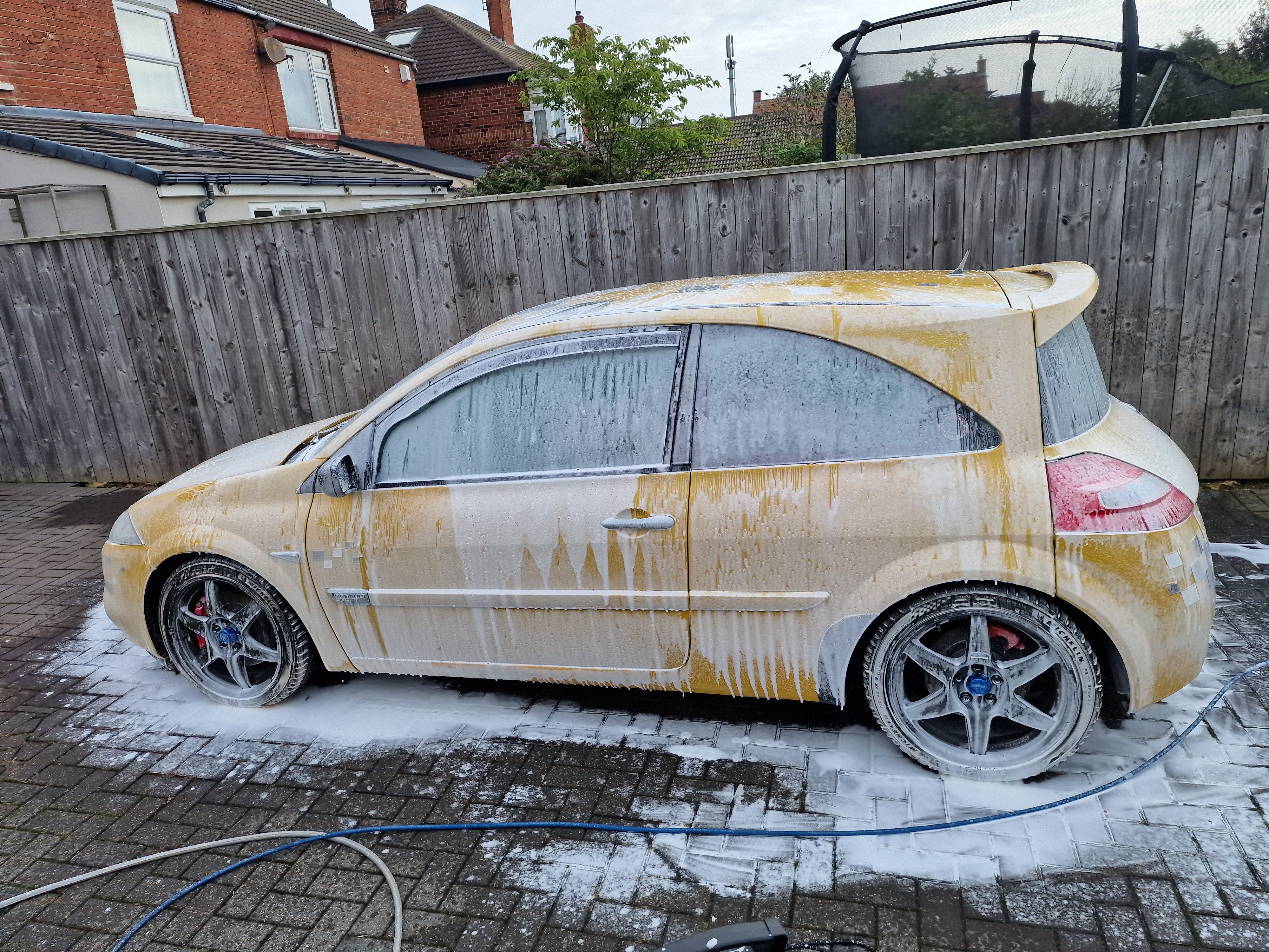

Also quick snowfoam off to get the birdshit off.
Shut the door on it and took kangoo out instead :LOL:

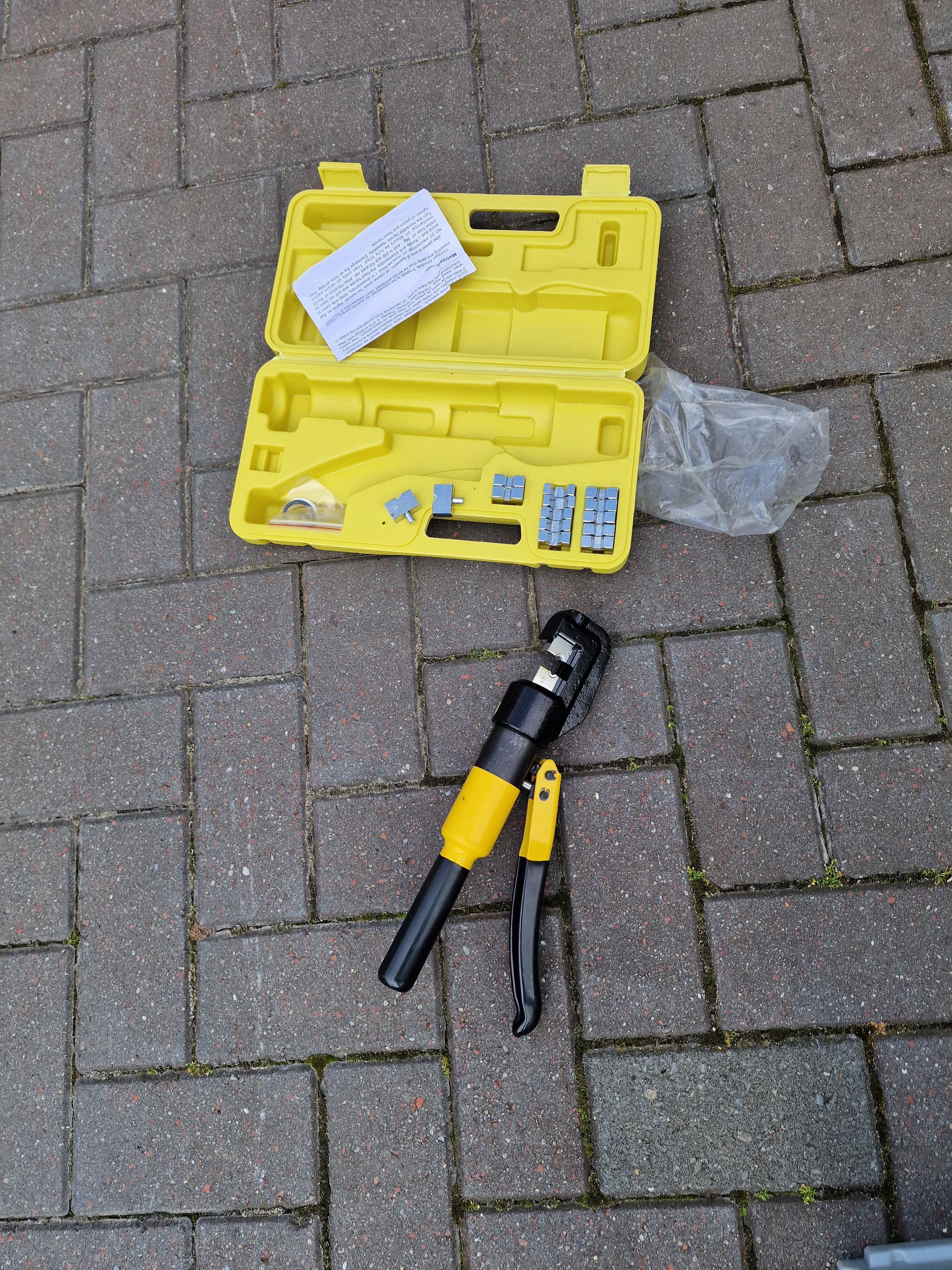

New battery arrived so fitted it this afternoon. Obviously nothing is straightforward and as soon as i touched the negative wire the ring terminal snapped due to corrosion. Luckily i have a stack of terminals left over from building the Trophy's wiring harness.
Hydraulic wire crimpers out
Fixed
Bosch s5 in.
Starts much faster and no dimming dash lights with accessories on. Unsure if that was the iffy ground terminal or not, i even checked old battery voltage to make sure it was the right diagnosis of non start and it was dead at 9.5v. Checked alternator output whilst test meter was out and its all good at 14.5v so same readings as the turbogauge in car.

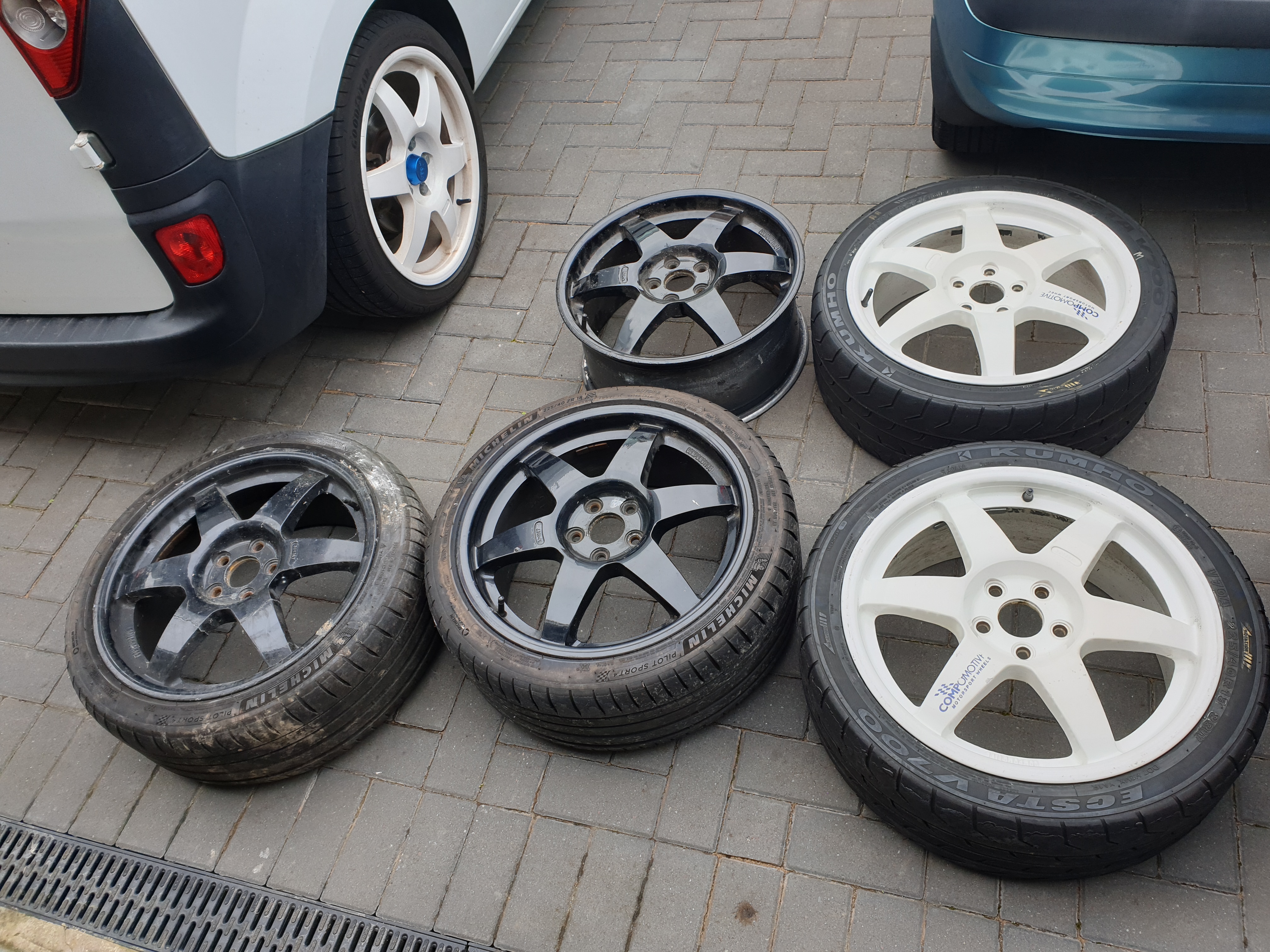

On another note, dropped my spare set of compomotive mo6 off to be refurbed by Temas Wheel Corrections last Friday,
Quite a tale behind these wheels.
Compomotive made a few custom sets of mo6 1880 for the pre production megane 225 for testing when a company called Ricardo developed the 225. The wheels were sold off after the 225's development was finished and renault used speedline wheels instead. I was told by compomotive they were made by them in 2001, unsure how many sets were made in total but not too many. Possibly 4 sets, i have 2x sets and another set are on a track megane. The last set if true is incomplete as i have a damaged rim here.
I had seen a set of them fitted to a megane r26 around 2014 ish at a meet and loved the look of them.
2020 - I was building the Kangoo compact and needed wheels, and wanted something decent, and seen the exact car with the comps on from all them years ago on a lads facebook profile. I pm'd him asking if he wanted to sell them..initially said no but a week later the gearbox blew and he broke the car and i got first offer.
It turned out that there was 6x wheels so bought all of them. I then started looking for another pair to make 2x sets. They are et66 18x8 5x108 so perfect fit, but odd offset makes them rocking horse s**t to find.
One came up on ebay at random (actually couldnt believe id found one). It was on bids and i paid around a ton for it delivered - somebody else was bidding but i snipered it in last ten seconds.
So with one needed to make a set, i put the feelers out on various places including the megane forums and got a pm offering one. Typically was located deep in Scotland, 6 mile away from John o Groats which is as far north as it gets really. It was also collection only and free, i was not turning that opportunity down. I drove 16hour round trip to collect it in the blue clio van doing nc500 in the process.
Turned out to be an epic road trip as weather was perfect and sun was out all weekend.
Tourist pic at John o Groat's
That was August 2021 and as im a bit of a wheel hoarder stuck them in the garage with a view to refurb soon.
Note 5 wheels. I actually got 2 from Scotland but one is damaged beyond repair with 3x cracked spokes!
A few years passed and last week finally pulled my finger out, got them out the lockup and took them for a refurb.
The ebay wheel was basically rough as old boots and had some metal filler on it for some unknown reason which flaked off (we think the casting was not great and was filled when produced. I actually was unsure if it could be made decent but has turned out real nice.
Got some pics through off Temas of them in the process of refurb.

Done. Went for stealth silver in a matt finish as i already have a set in anthracite, and a set in white.
Brigsy
  T.Turbo

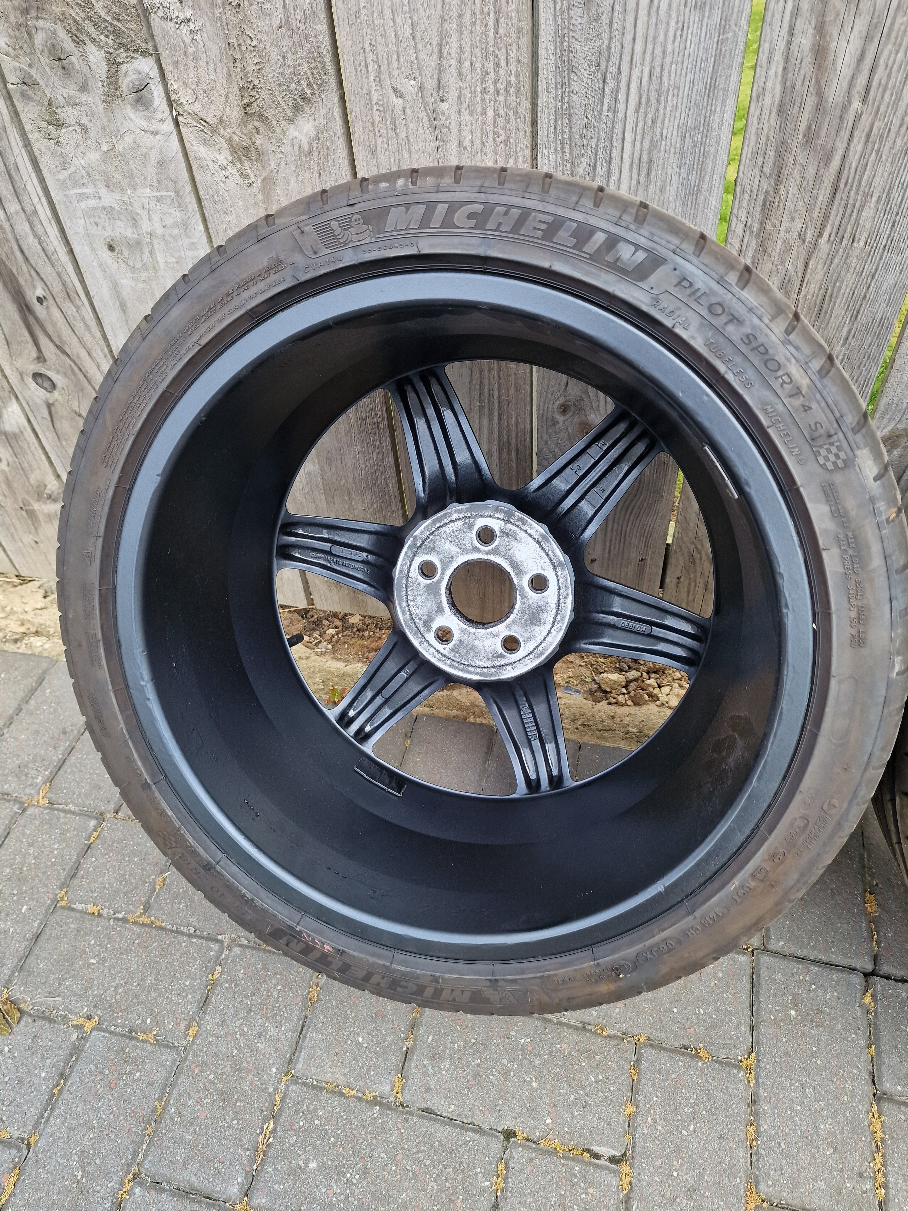

As im an absolute wheel hoarder i had a set of Michelin PS4S part worn in stock 2023 date stamp to fit so got them boshed on. Dropped off in blue clio
Checked out wheels before tyre fitting, all looking great and fresh.
Collected in the kangoo, always a struggle to get 4x 18s in 😅
2002 date stamp. Rears stamped with RS too which is a nice touch.
Cant believe how well they have turned out..i used to call these the s**t set but id say they are as good as the good set! Best refurb ive had done in years and £210 all in.
Ive got some Gtechniq c5 on order to coat them before fitting.

Give the r26 a once over the other day in prep for Anglesey. All seems ok, no urgent jobs required.
Washed it this morning for the first time in 2 months, it was looking quite shabby with tons of brake dust on the wheels. Bh snowfoam, bh auto wheel & quick coat of c2v3 and give the interior a quick once over.
Cleans up ok.
