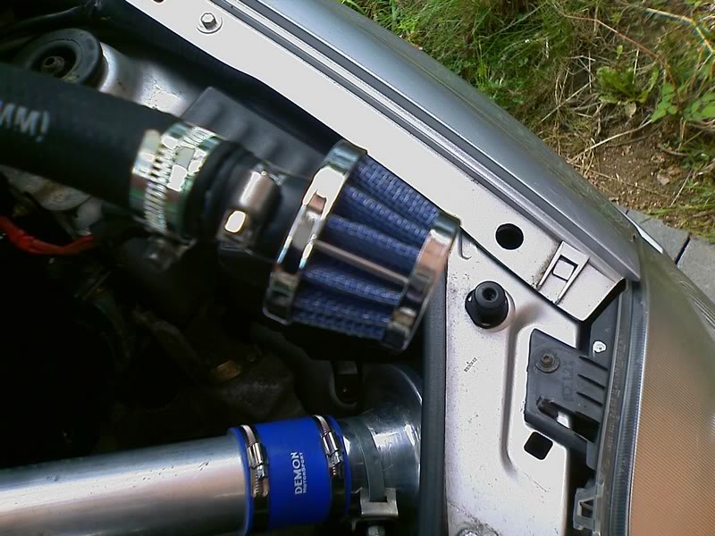

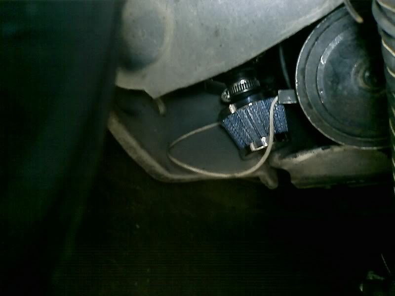

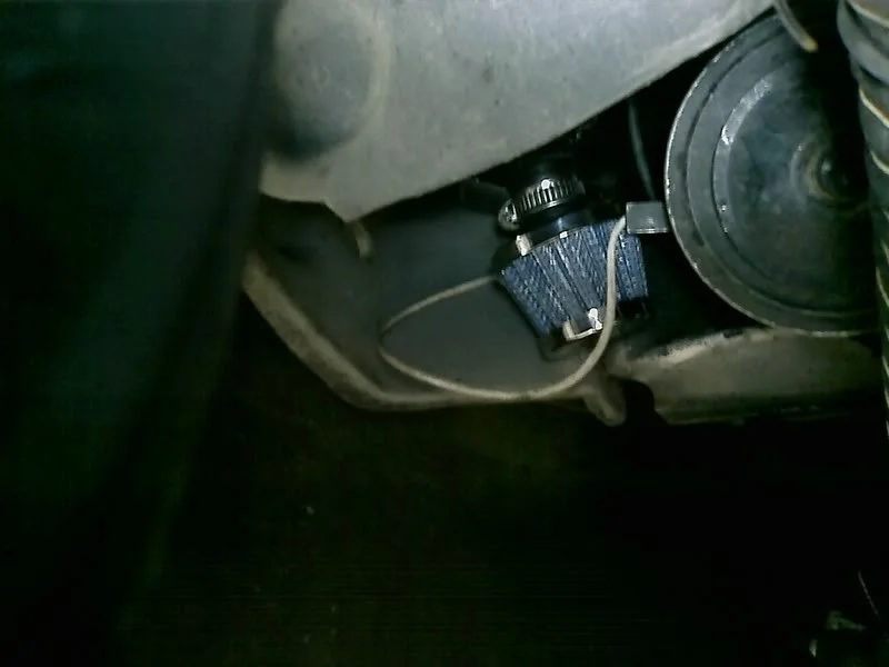

Finished off the induction setup. Fitted a pipe off the idle speed valve, long enough to tuck it out of the way and away from heat, into a small filter so it doesnt breathe from the main induction pipe.
Its been about 6 weeks since i last drove the car (holiday, family and work comitments) and ive not even strted it since fitting the induction set up. so today i took it out for a run into town.
The induction noise is amazing!

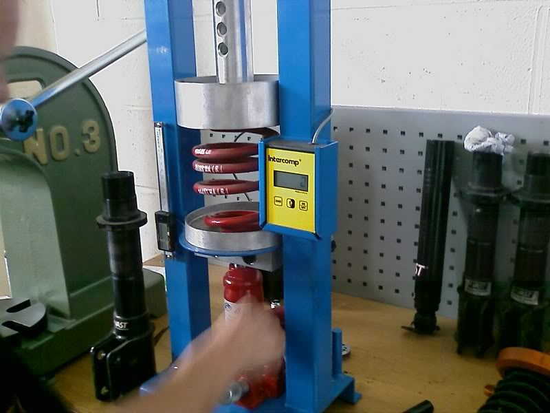

So today I went along to my mates place, did a few measurements (that Curtis would need to calculate clever suspension stuff) and whipped out a spring.
Curtis then tested it
The H&R's use a progressive spring and this made measuring it difficult.

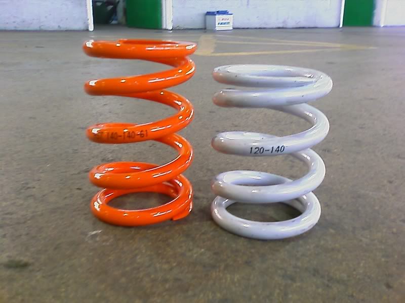

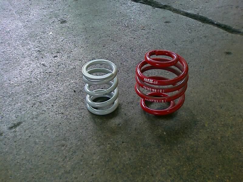

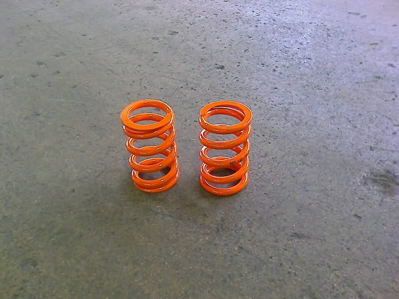

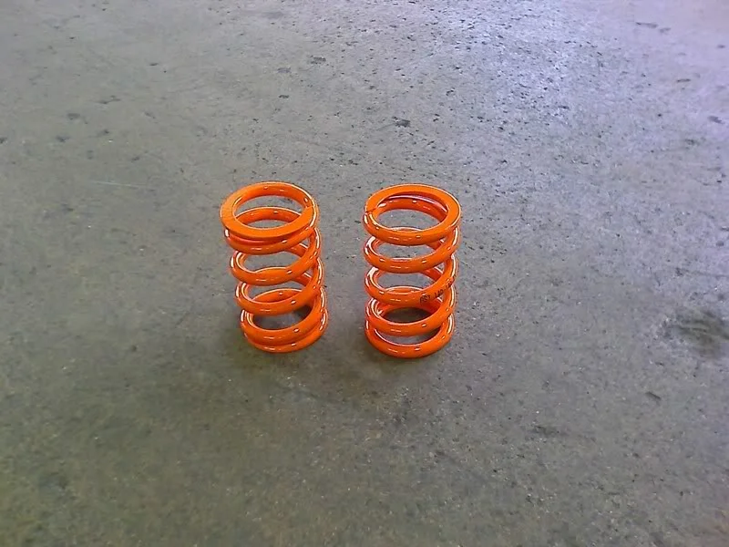

Then he had to find me some stiffer springs that were the right size as im already at the lowest setting on rear ride height and a stiffer spring could raise it. found some 120mm springs that looked good. They are twice the stiffness of the normal h&r rear springs!!
left = new............................. right = 'stock' h&r spring

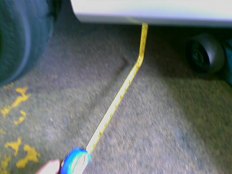

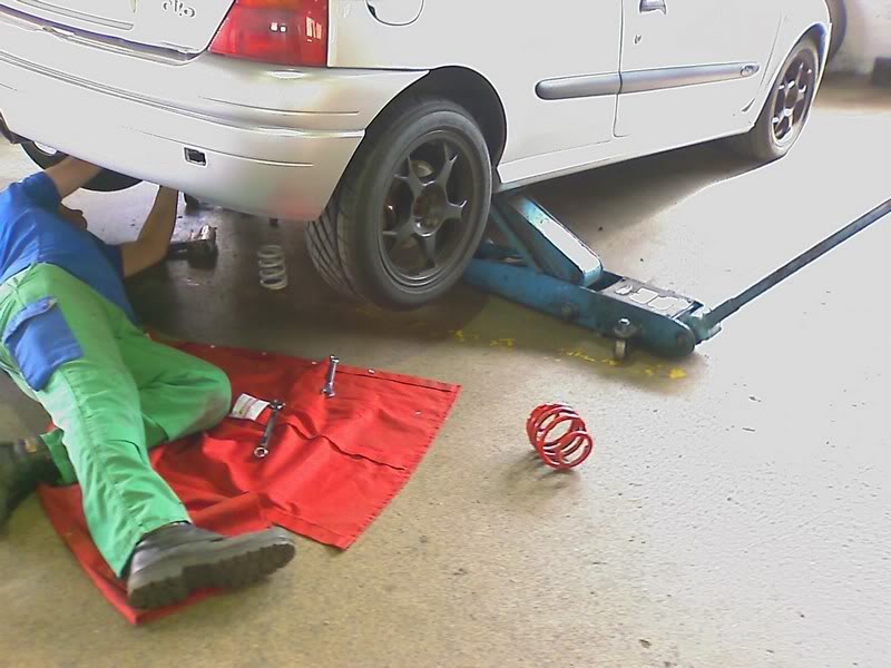

Trusting his judgemnt that i wouldnt end up backwards into a tree in the first corner, I went back to the car and my mate poped them in. (I didnt want to get dirty today;))
re-set the ride height
and took it for a jaunt.

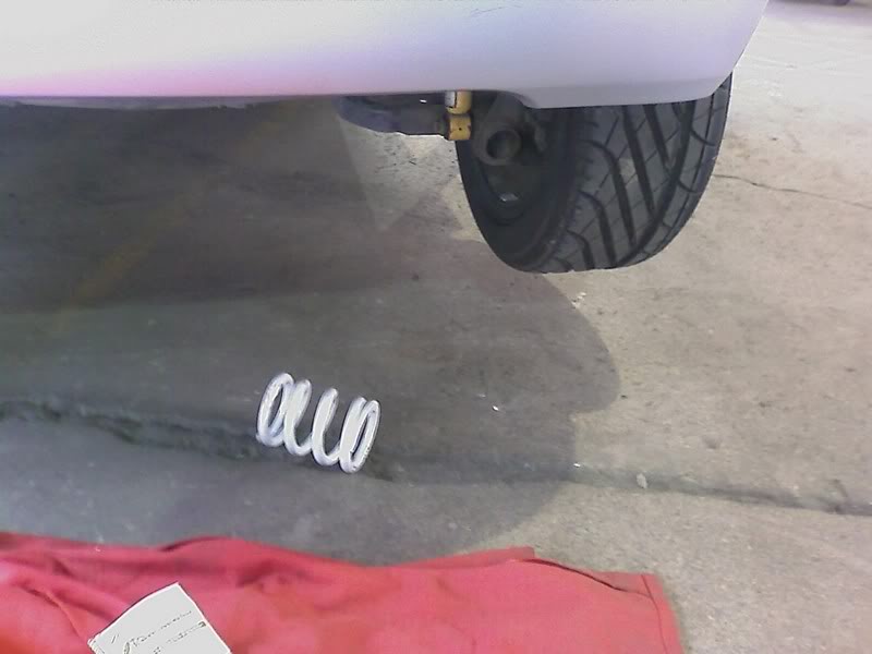

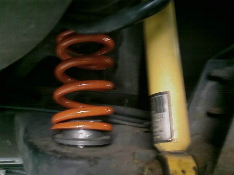

jacking the car up and this happened........
The 120mm springs were just way too short, so got some 140mm ones from Curtis and swapped them over.
PERFECT!
