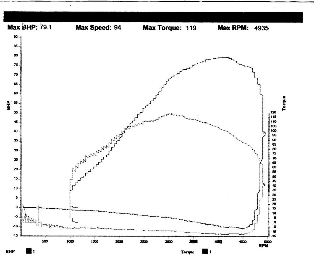

I took my little DCI to a company with a rolling road and they told me 79.1 bhp at the wheels & 119lbs per ft.

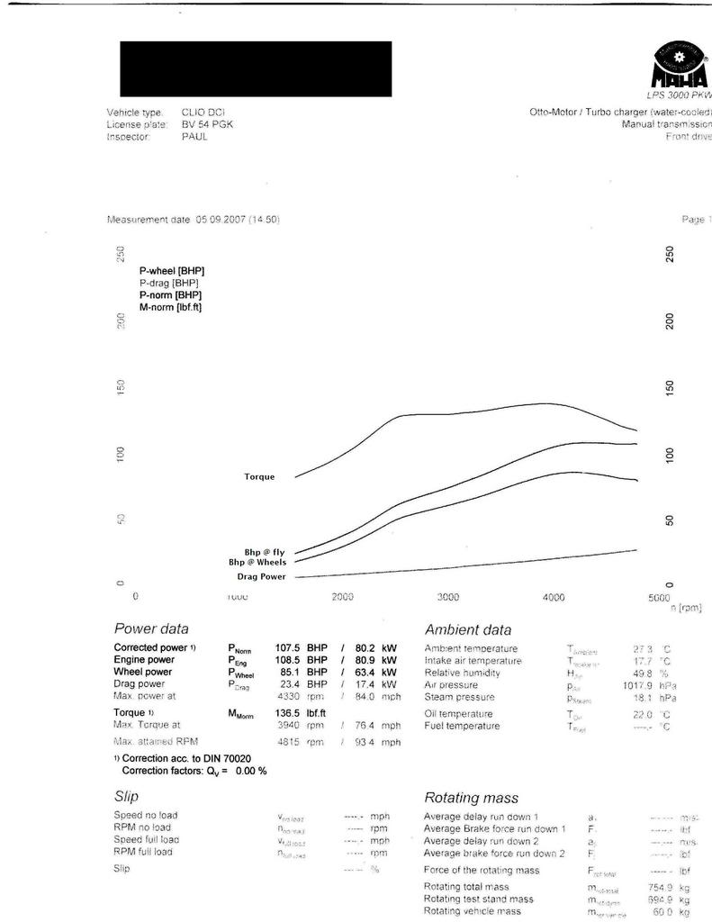

I got the map done another company and went back to the same guys rollers and he said it was only 85 bhp at the wheels!!! and 138lbs
Erm, clearly wots going on??? a full custom remap gettin me an extra wot 6HP?? lol gimme a break
My cars substantially faster since i had it mapped, but it seems to me that since i didn't do it at this guys company he told me lies about the figures! could that be tru??
If so wot can i do about it?
Also a little suspicious was that it quotes my peak torque (138lbs according to him) @ something like 4300 rpm!!!!
Surely thats wrong, don't diesels produce all their torque at around 2000?
Plse advise
Also come to mention it, it seems to hav a cut off line of some sort...
I'l hav to try and find the bit of paper, i don't i threw it away but may wel hav done cos was cross...
Wen he did it i watched the screen and the bhp soared and all of a sudden at 85bhp became a sraight line? like a heart monitor wen the guys dead lol
Shouldn't it tail off?? not go straight?

Ive found the before and after tests so i'l scan and post them tonite.
Can't find my best one which is annoyin but i'm sure its hoarded away somewhere lol, if you get a chance to compare both graphs please do, the torque curve looks very different

Can anyone help me compare these 2 graphs? I'm convinced the new one is waaaaay wrong...
Full custom Dci remap, only 6 bhp more at the wheels?
I know its wrong cos my acceleration times are much faster than they were & with all of 6hp u wouldn't really notice

Thats your best bet. Those two graphs cant really be compared, both are horrid to work out whats going on!
27deg aint to bad if it was a warm day. If they input it high (position sensor somewhere warmer) then the corrected figure will over read.
Edit; if you really want to see the difference you could replot them on excel ontop of each other!
Just glancing at the torque curves, its got a really good gain across 2500-4200rpm, 30lb/ft in places. You'd notice that as quick a bit quicker :)
that particular type of rolling road is well known to produce low numbers.
the most important thing in RR tuning is the operator and how well they set the car up - the road is just a tool.
