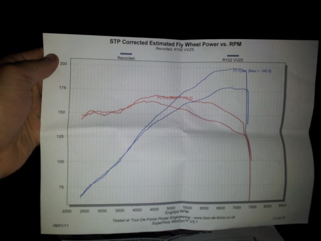

well knew i had problems so off to tdf i went! roaded the car and oh dear!

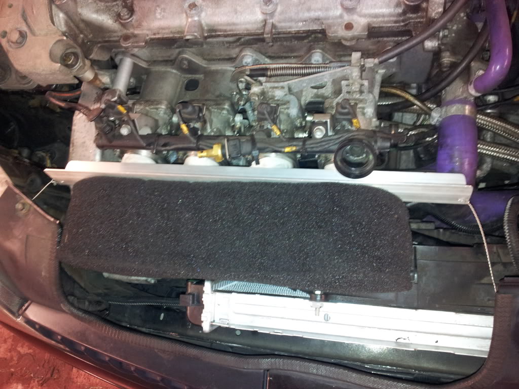

of course bottom one is the befor power and torque... so compression test was done.. that was fine 13.5 across all 4 cylinders! then we looked at the k-tech filter... it was basically pulling back onto the trumpets and killing the cars power! que me being a pikey!

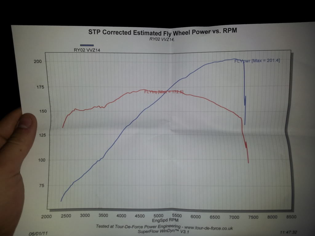

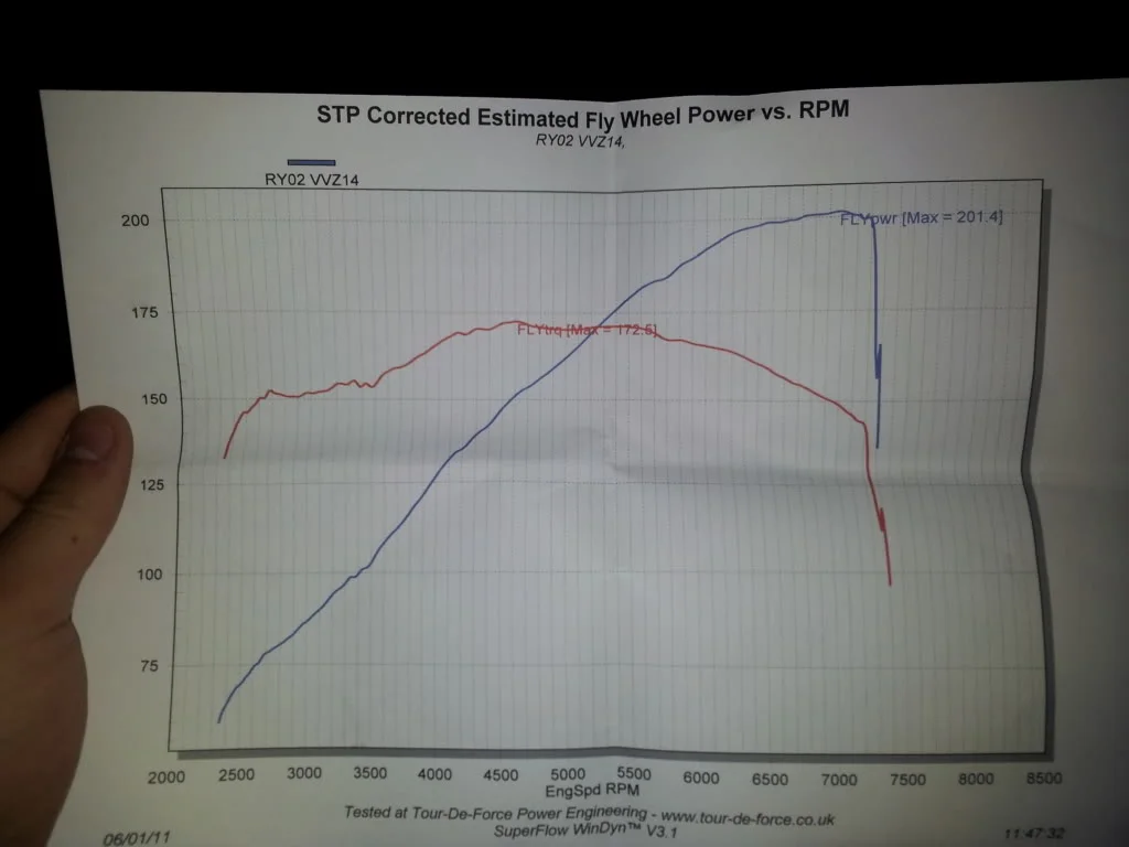

that little bit of L shapped ally made all the diffrence! :D and here are final power firures for you all!
quite happy with that torque! :D

Fact of the matter is k-tec sell it as a drive in drive out kit...
where as a matter of fact it's more of a drive in, drive out, then continually hassle them for quirks with the way the car drives until eventually you give up and take it to some-one qualified who has a clue what they're doing kit.
By the way kids that's not slander, that's called getting bent over.
You do need to come back and get a proper filter and air-con delete kit though.
this is a temporary bodge. not a TDF approved solution. lol
