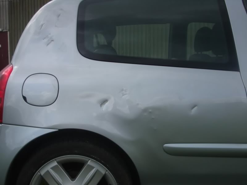

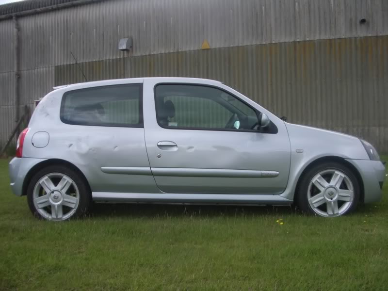

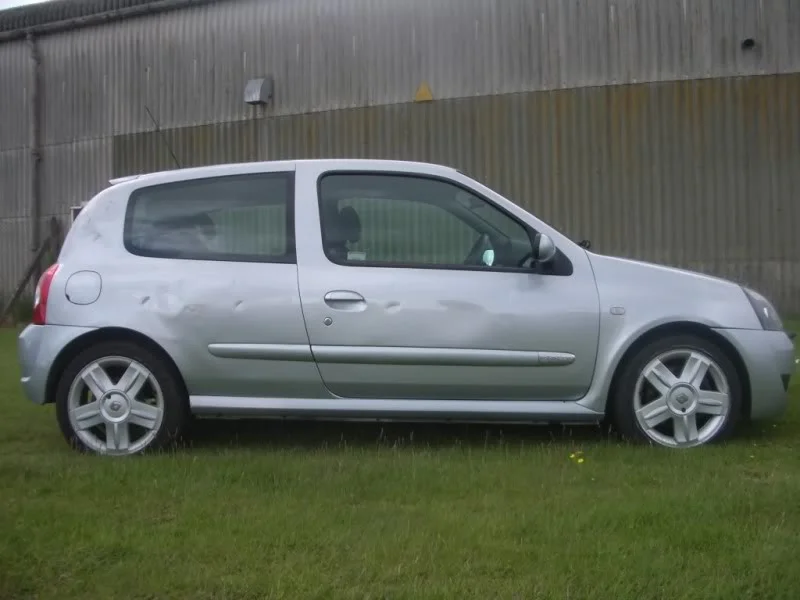

My Phase 2 was a cat 'd' write off with this damage,
We replaced the door asap as it wasn't worth the hours trying to get that straight when it was a bolt on panel.
For the rear quarter me and my dad (sheet metal worker/fabricator) straighted it out as much as possible with a dolly and hammer and the bodyshop did a final bit more panel beating and it only needed a minimal skim of filler to get it looking as good as new - no need for a new rear quarter at all.
