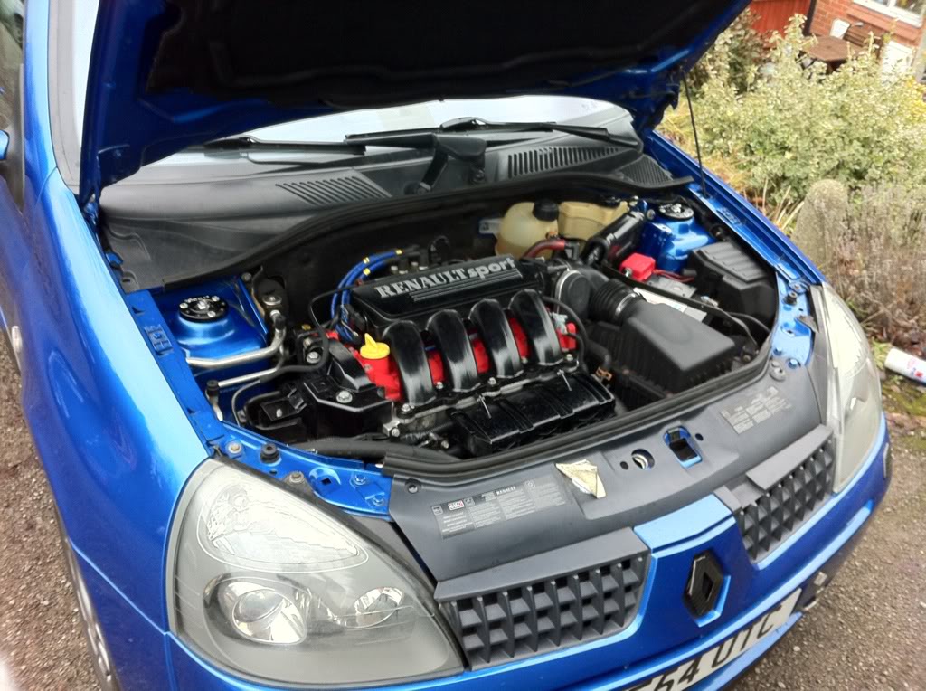

That's a very tidy engine bay that!

I run, engine dynamics cams, 286 at the intake and 280 for the exhaust, going by these values they are a bit wilder than 421's and yes, the idle is quite lumpy and below 2k car is very jerky, coming to a stop in gear is not nice either, but from there on... plenty of torque and power, I just recently added the 182 manifold and it gave me back some more torque as with the cams the lower range tends to weaken, but with the mani it has more torque than before cams, very pleased, it pulls very well and strong, and above 5K it just flies.
With that said, the profiles you have in mind should be very alike in real world life. Or wait for TDF cams as they are very reputable and their product should be perfect, also you can combine cams with JMS intake mani and you will end up with a very powerful clio, at least on paper.
