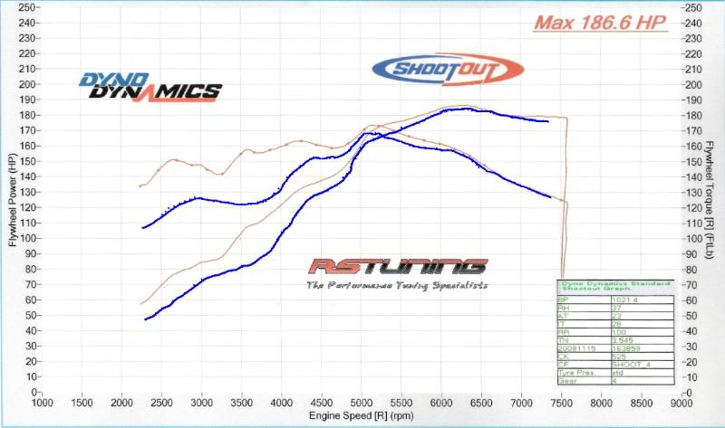

Heres a comparison. Blue lines are the cat cams which a marked onto the Piper graph to show the difference.
Top 2 lines are torque, bottom pair are BHP. Losses are massive up to 4.5 thou rpm especially the torque.
Torque directly affects your power output, the simple equation is rpm x ftlb's / 5252 = bhp
That's why a graph will always cross at 5252rpm, when they use the same scale for ftlb's and bhp
Your lack of Torque low down is the reason you're experiencing the kick, before you made good torque and now you not :dapprove:

Thats a bumpy looking power curve you've got there, A few factors to consider are ambient temperature and and / or map. Am i right in thinking you said there was 11months between tests? My old 106 track car use to vary by 5-7bhp throughout the year

Edited, you mean timing on the car lol - Everyone reckons it looks ok going by the graph on page 1 but its one of the things im going to have to check. Im not convinced like. Strange how it goes in for its belts doing, gets better cams (on paper) yet looses a barrow load of bottom end torque and overall the cars a hell of a lot slower.
