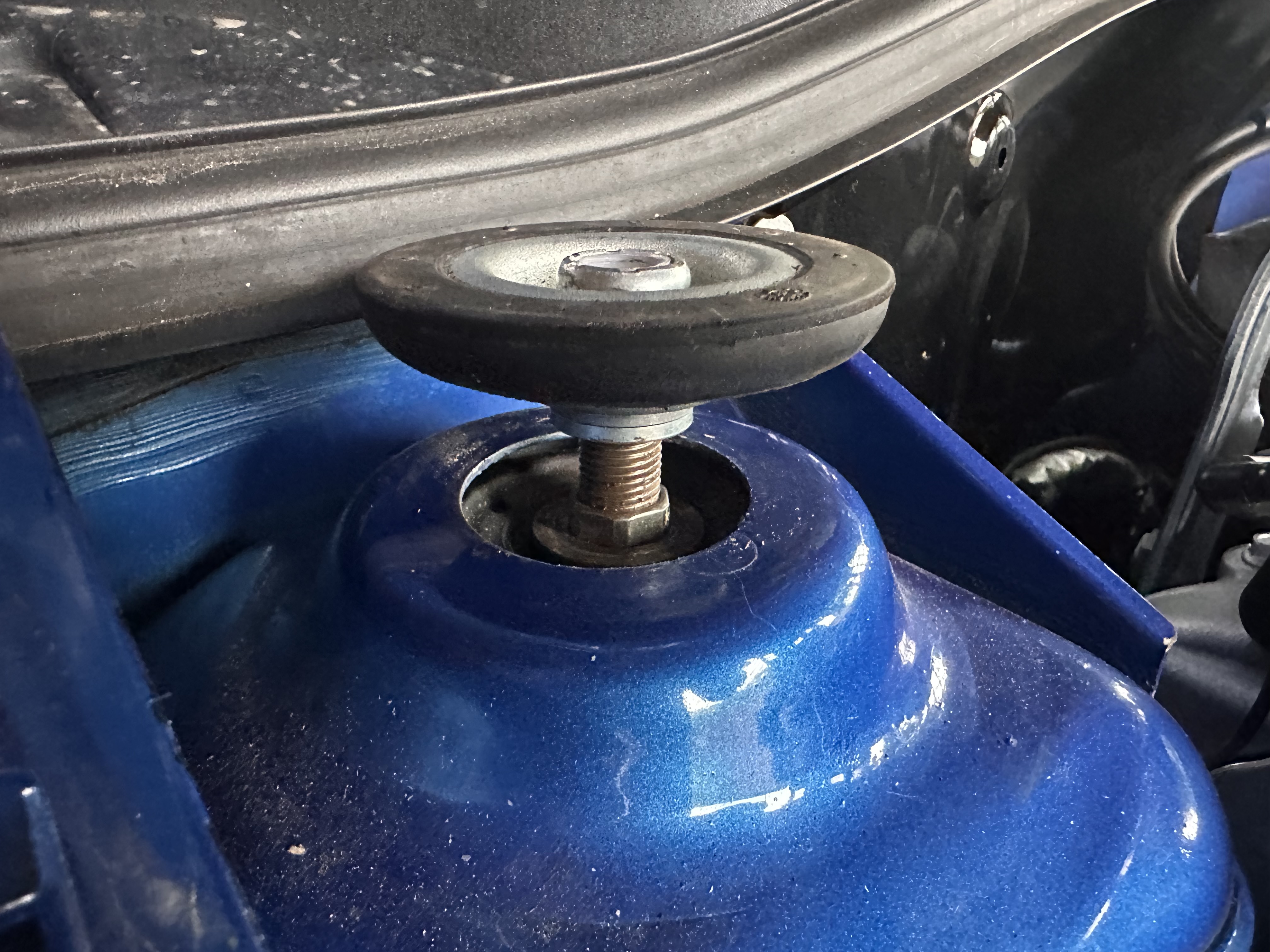

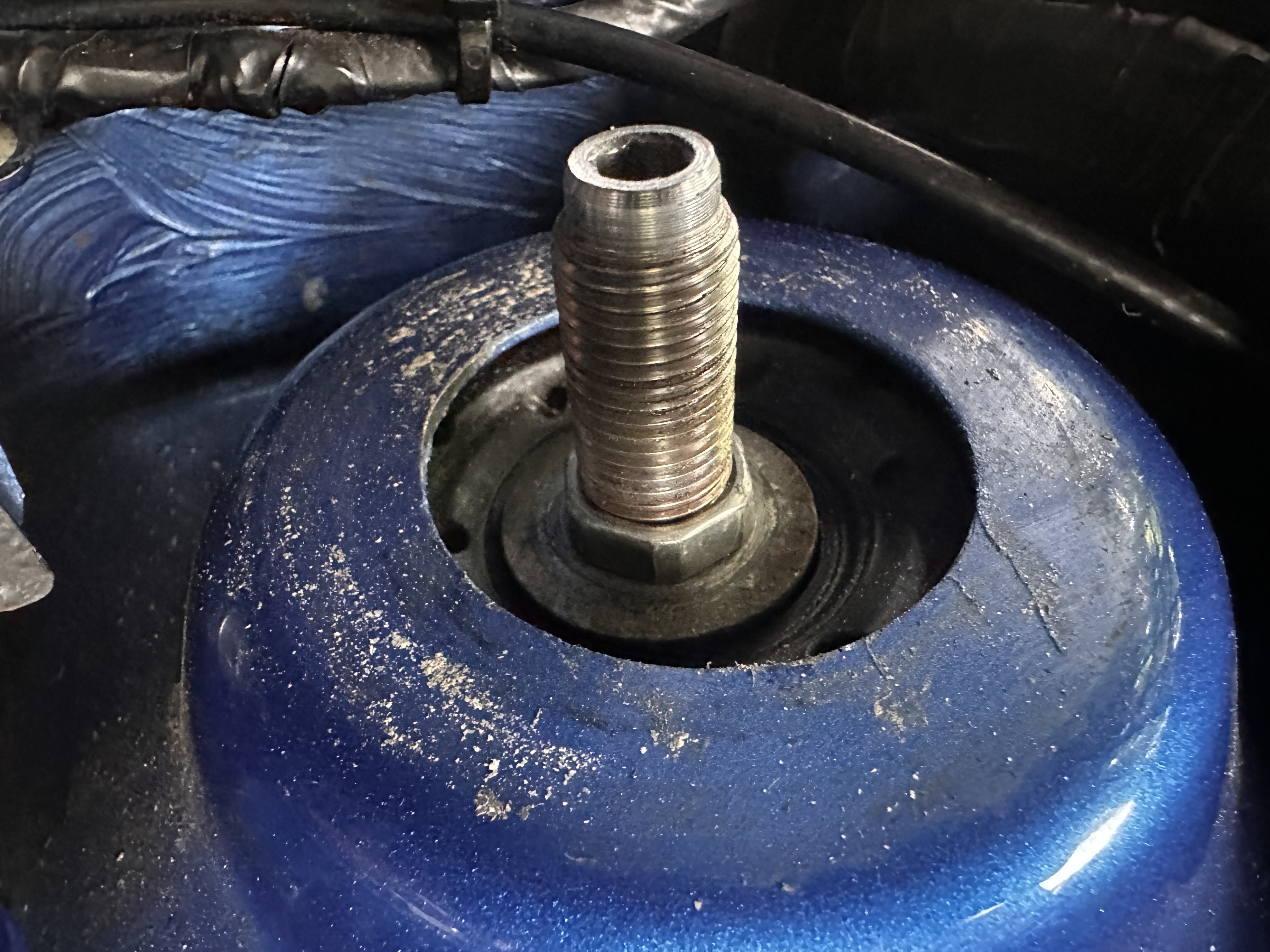

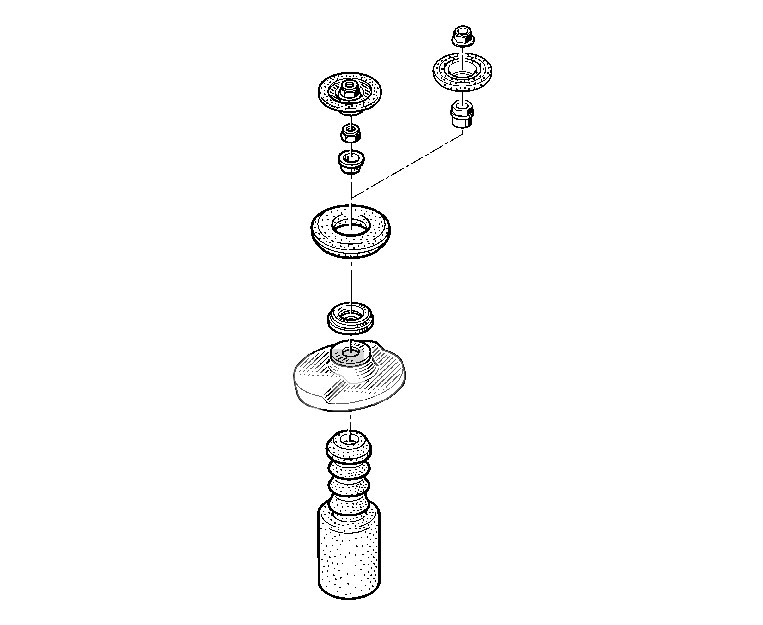

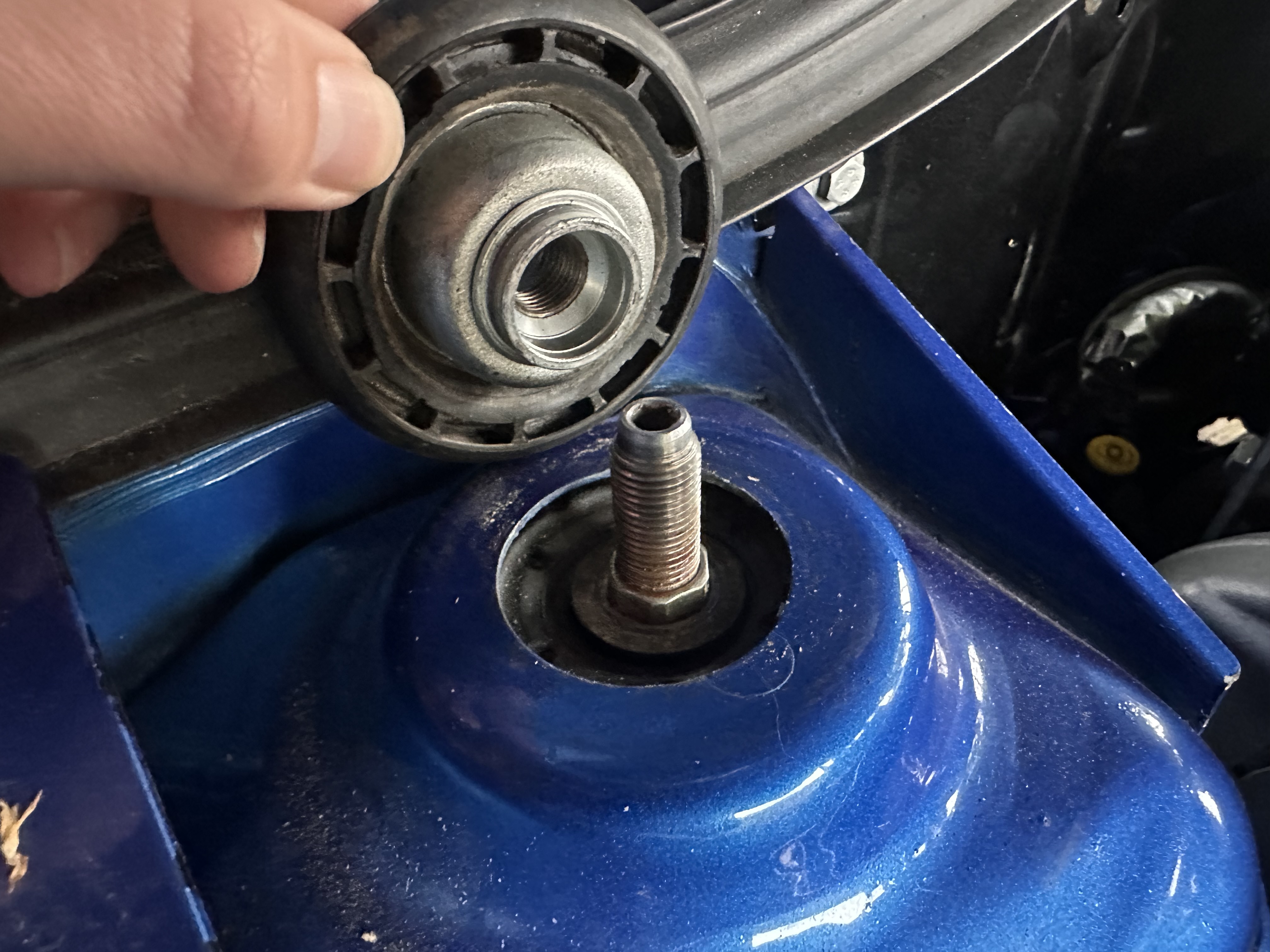

Also had a chance to photograph top mount setup. Does all look correct?
These are the top hats. The nut appears to spin on one of them but is fixed on the other. No idea if that’s correct.
I’m sure that it’s separate to the knock and hopefully the engine position is the culprit. Will try tomorrow when the weathers improved.

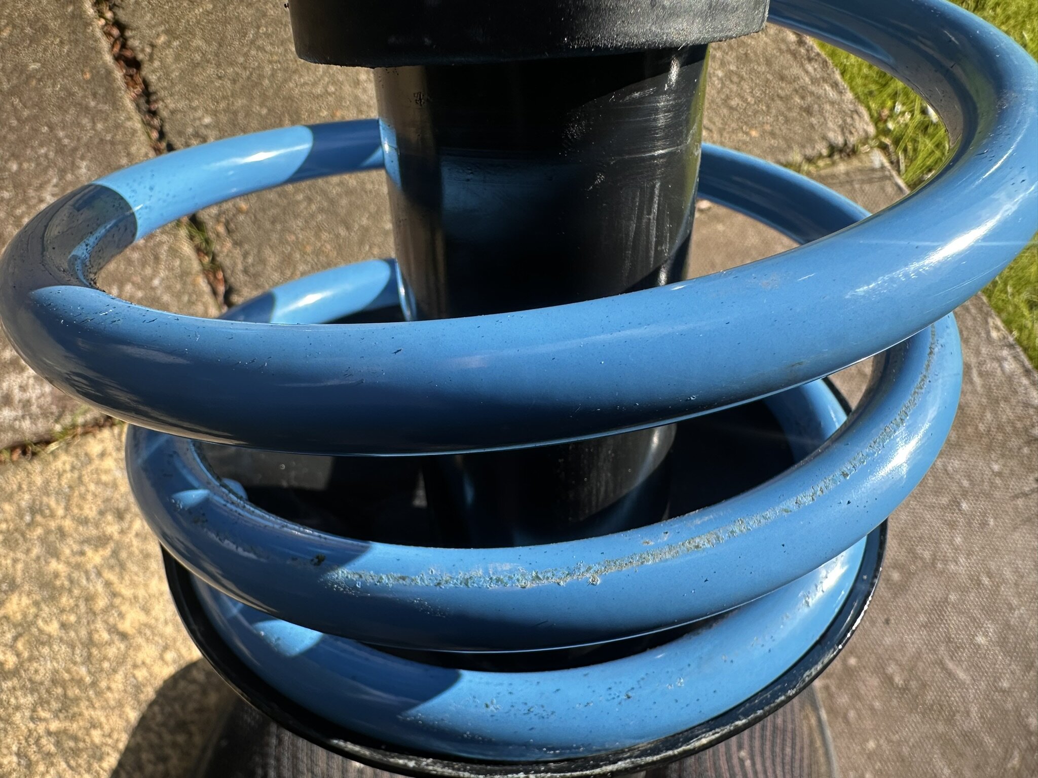

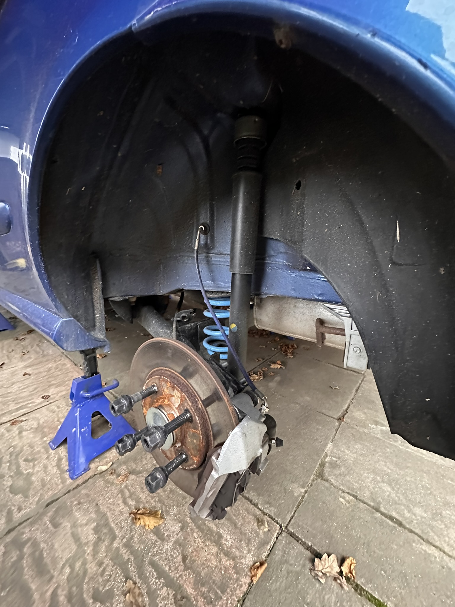

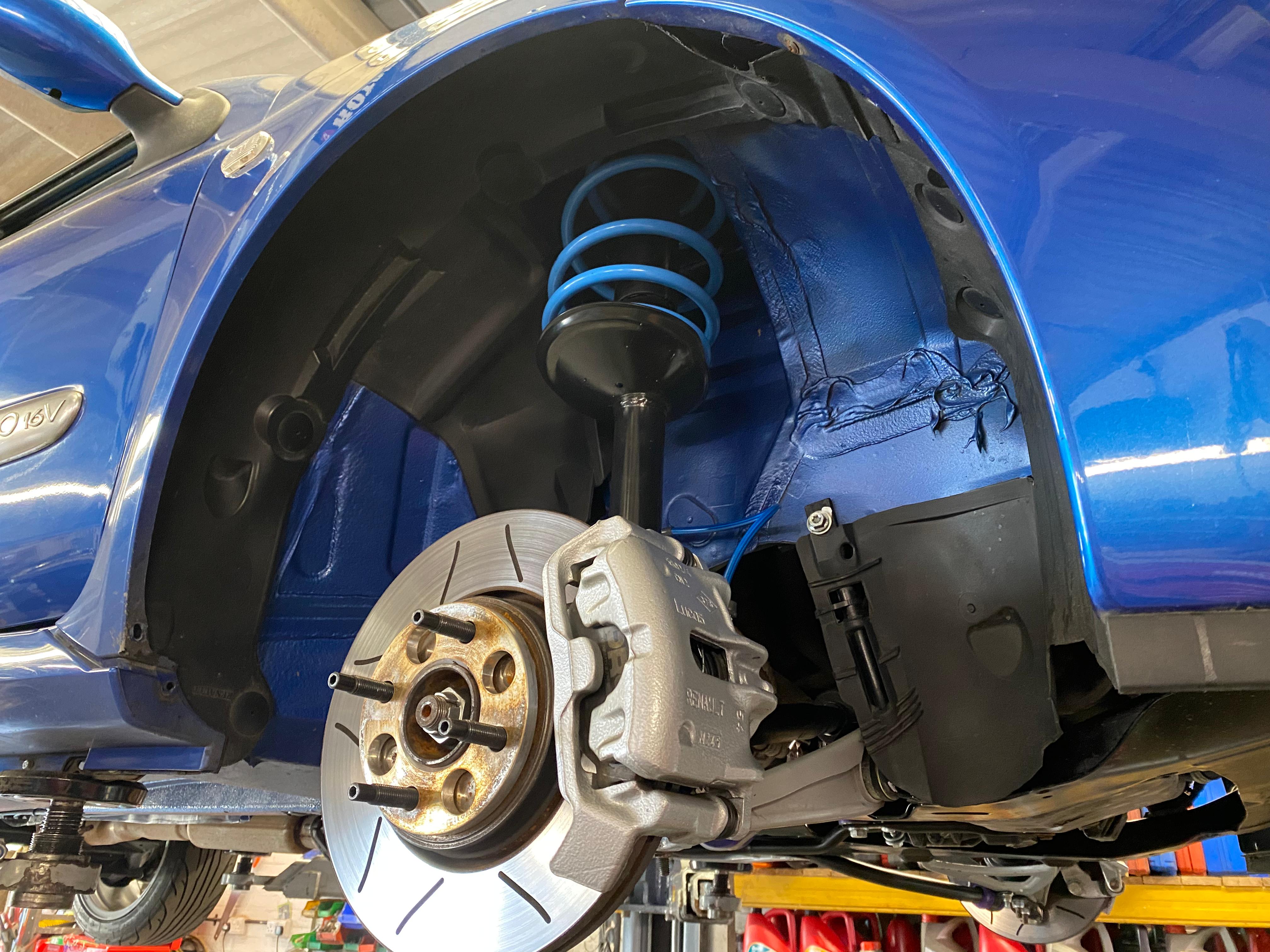

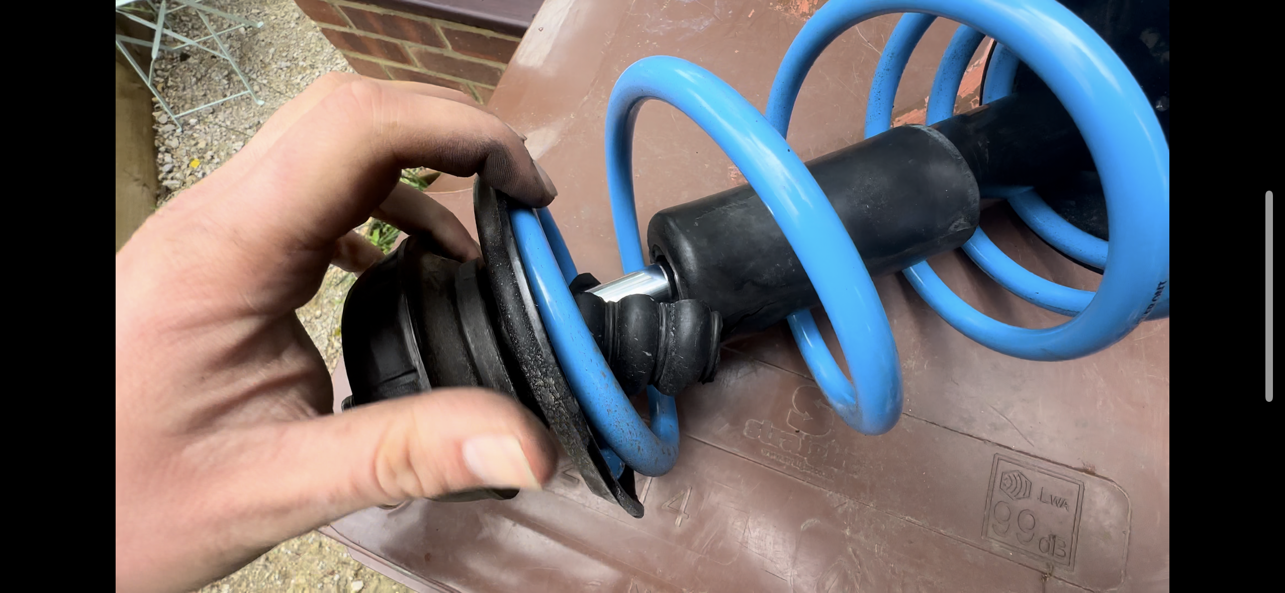

So, i've taken both shock absorbers out, and unassembled both. The passenger side spring looks like it had been compressed to the point that the bump stop had split in two. Should the spring be compressing to the point that the coils rub together? (pic below)
Measures taken so far to try and cure this issue:
- New top mount bearings
- New upper gearbox mount
- Polybushed dogbone
- Swapped to OEM dogbone
- Swapped back to Polybushed dogbone
- Triple-checked steering rack bolts are tight
- Moved engine forward and tightened down the engine mount
Knock is still there. I will be booking the car in to be looked at by a garage... although I am wondering if larger outter arb bushes would help? mine look almost loose. I ordered 23mm outter bushes for reference and the arb on the car when dismantling looked to be new/recently swapped.

Bumpstops always fall to bits on these, as they are used as secondary damping when lowered. I destroyed a bumpstop riding the kerbs at Blyton.
Id imagine the springs are progressively wound so will touch coils a bit.

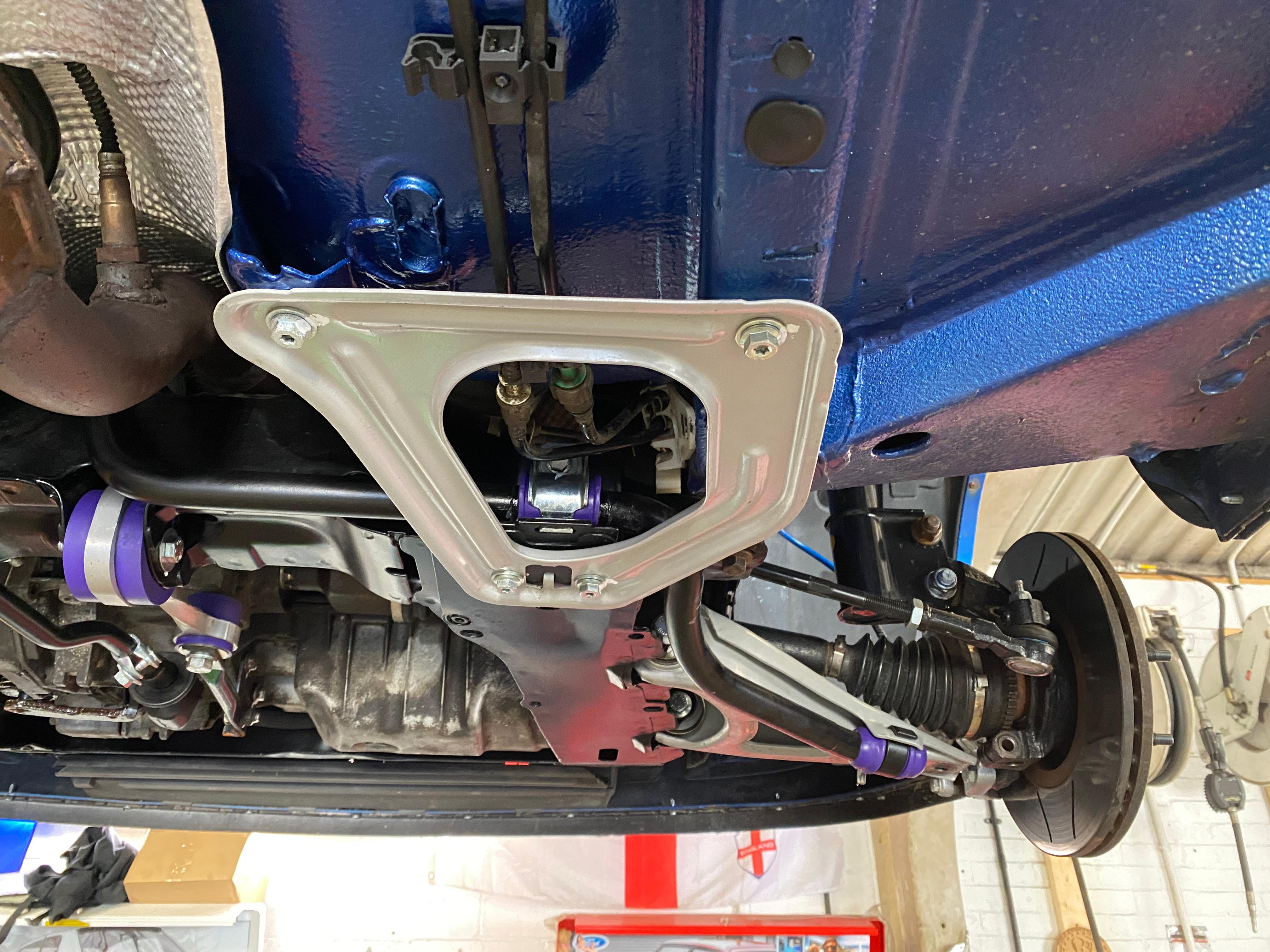

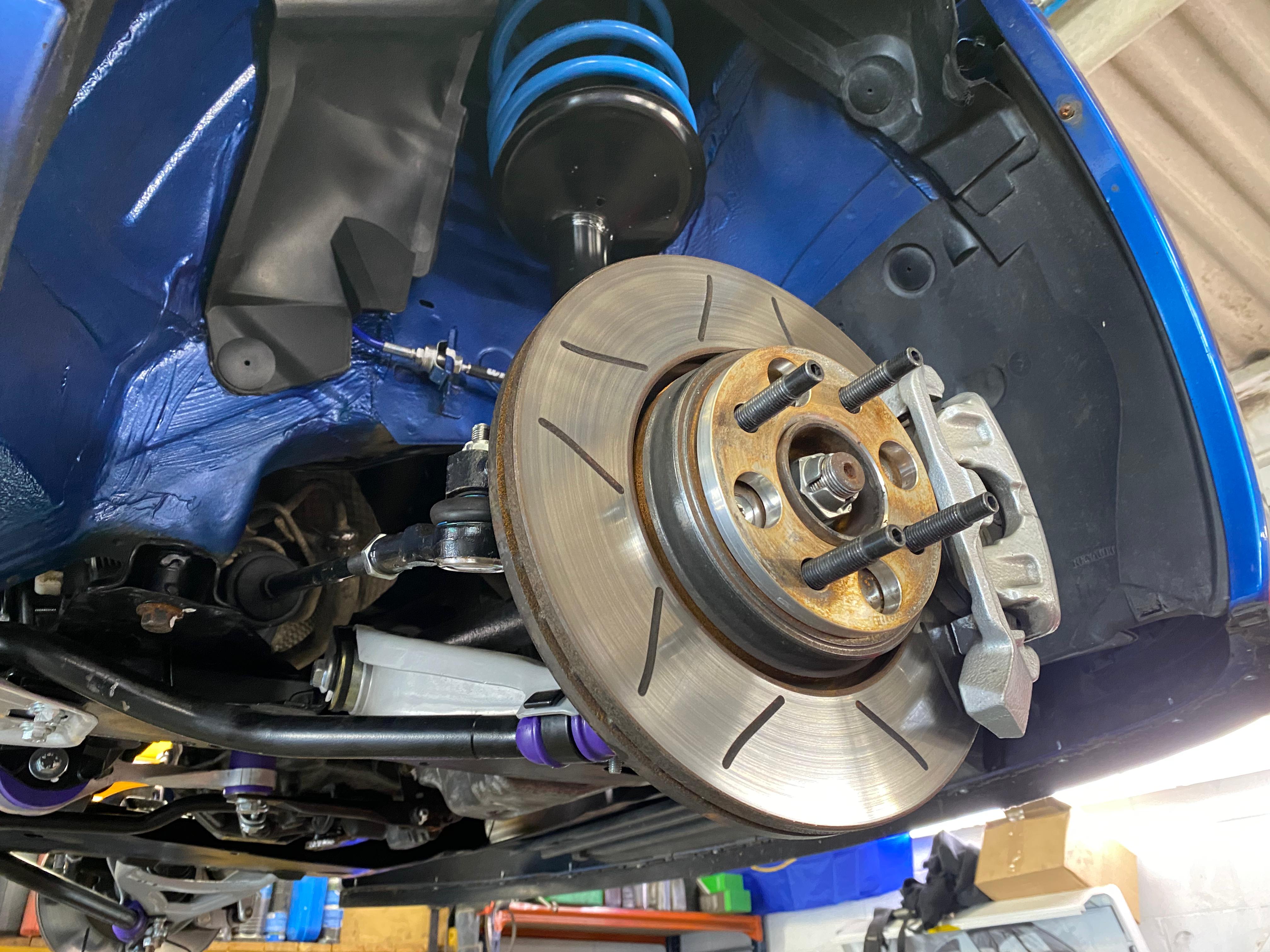

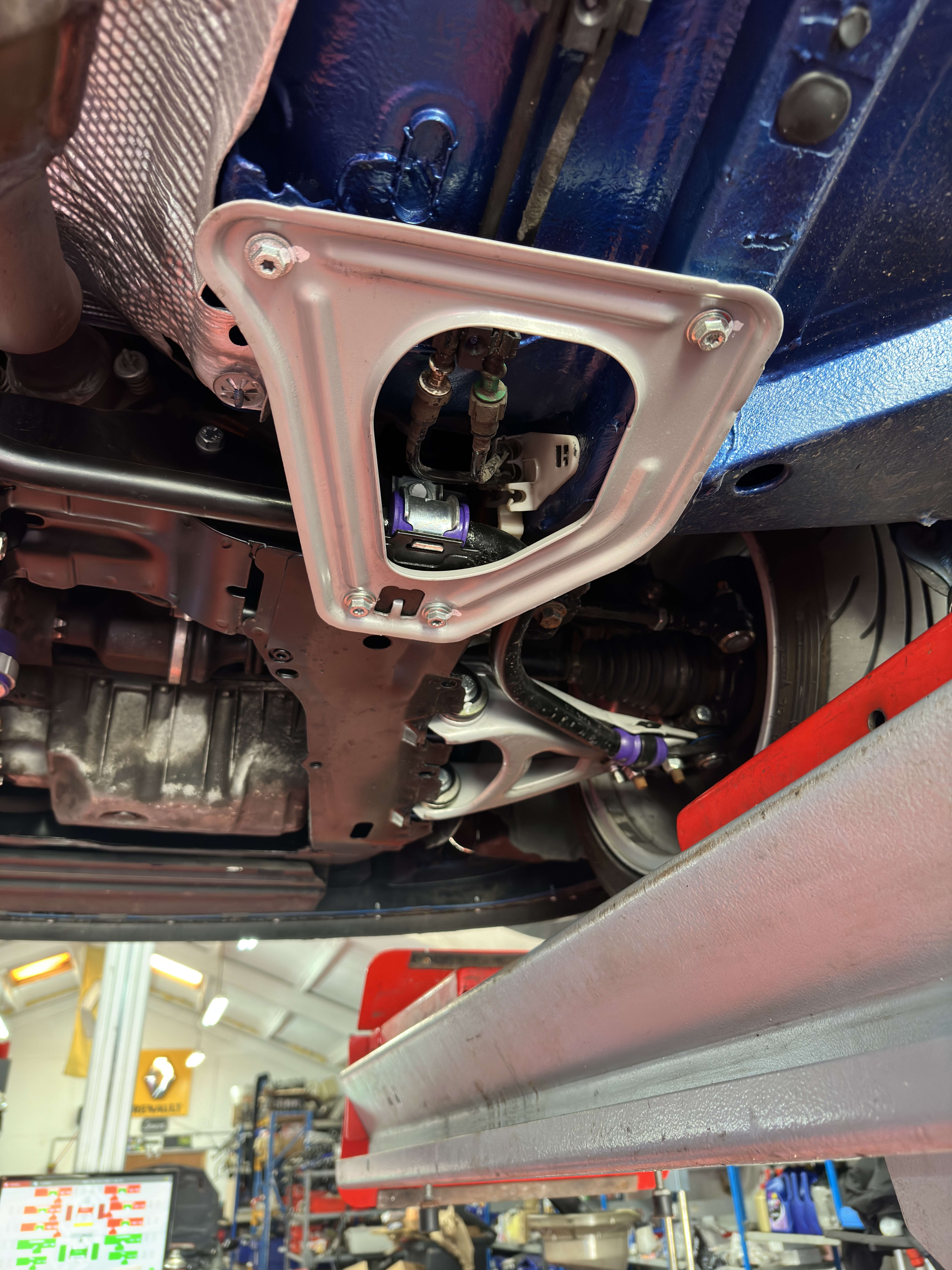

Turns out I was looking in the wrong place. Got my brother to take it to work. The ball joints where the incorrect type, and where moving separately from the arms. Not great!
It’s ok now, however, I’ll likely get some second hand Cup arms as spares just incase any wear occurs again.

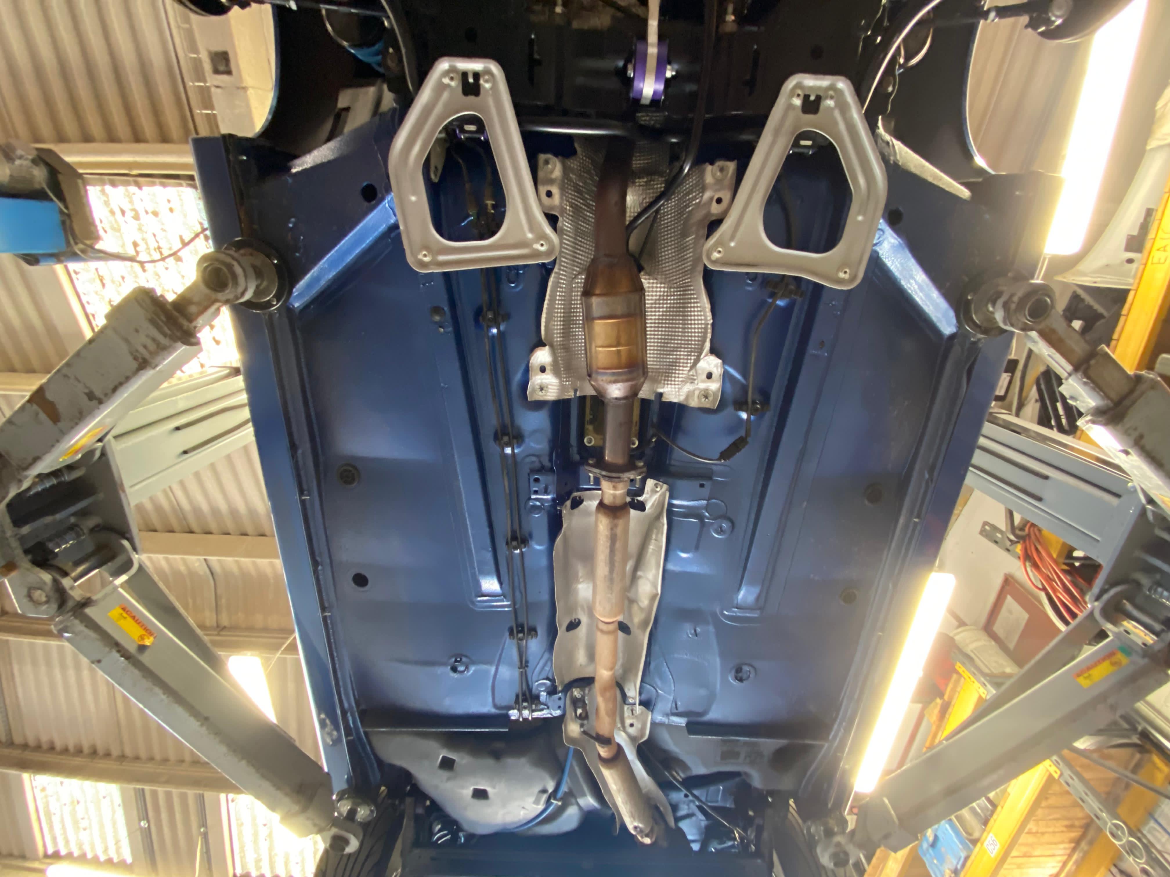

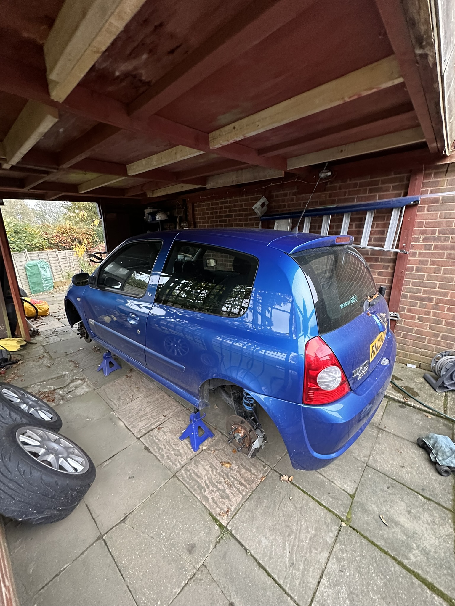

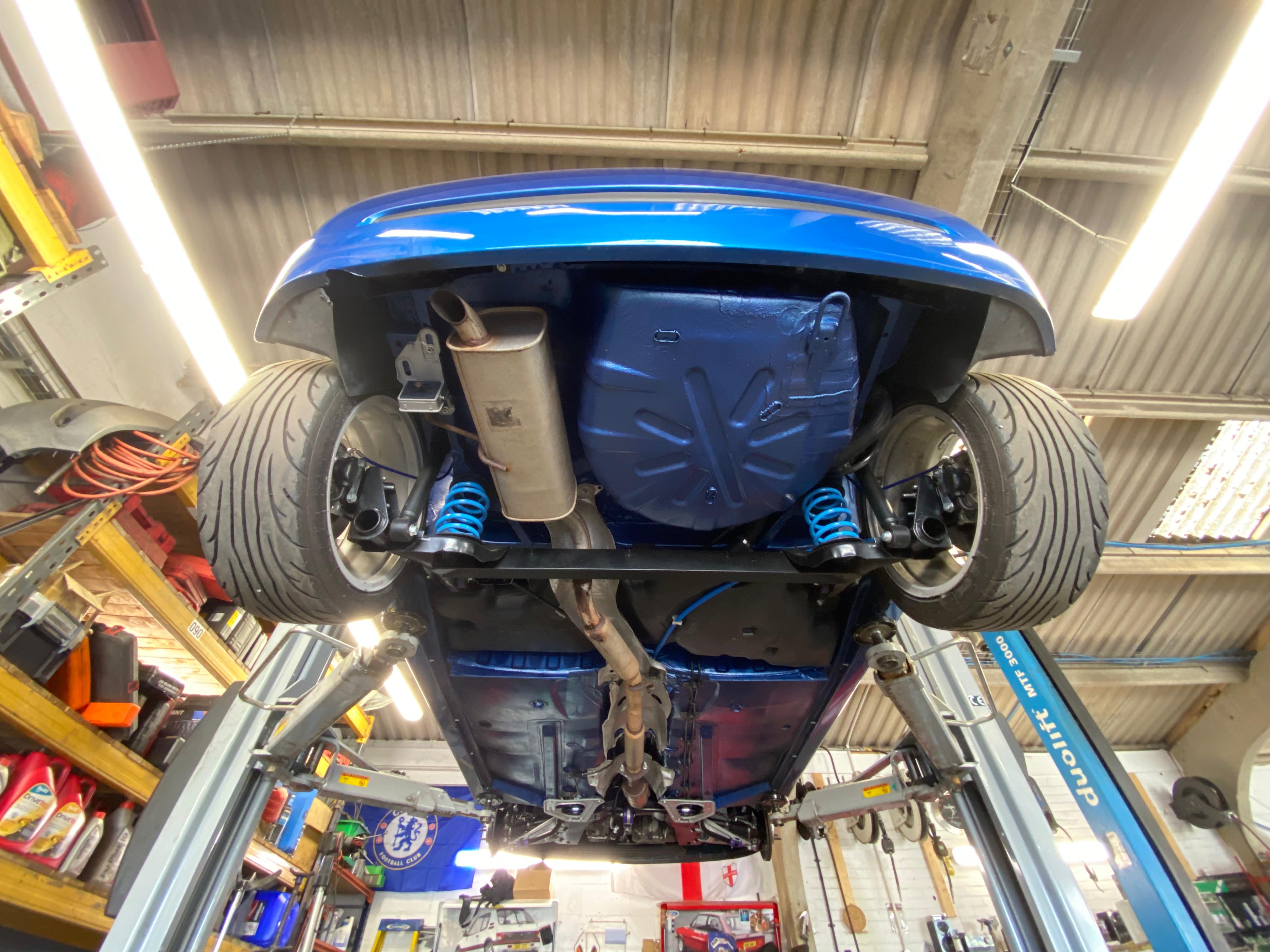

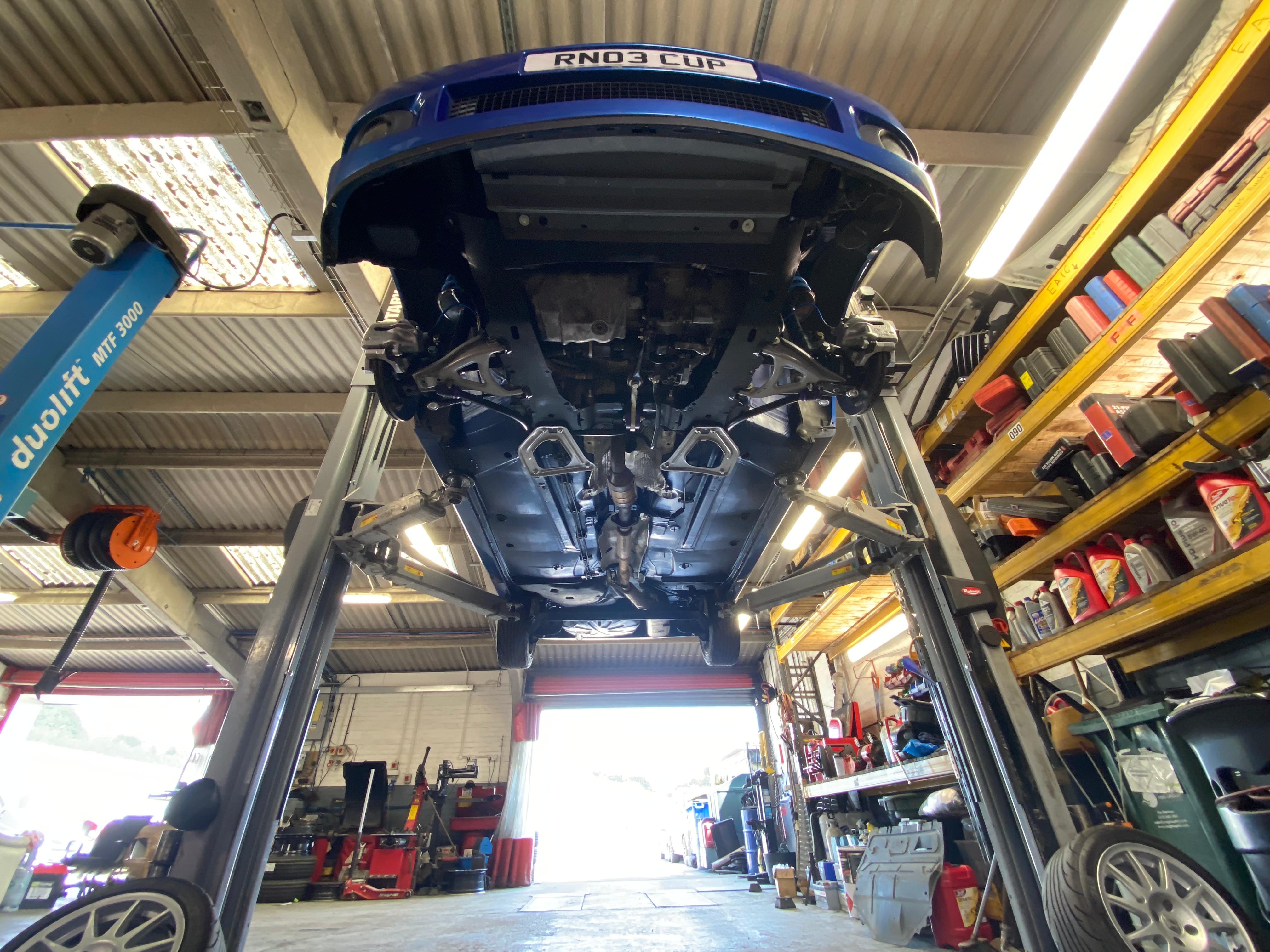

In the meantime, I finally got some ramp pictures. Nice to see it from afar, rather than on the floor 🤣
Still a few bits like heat shields and trim to put back yet. When I can be bothered

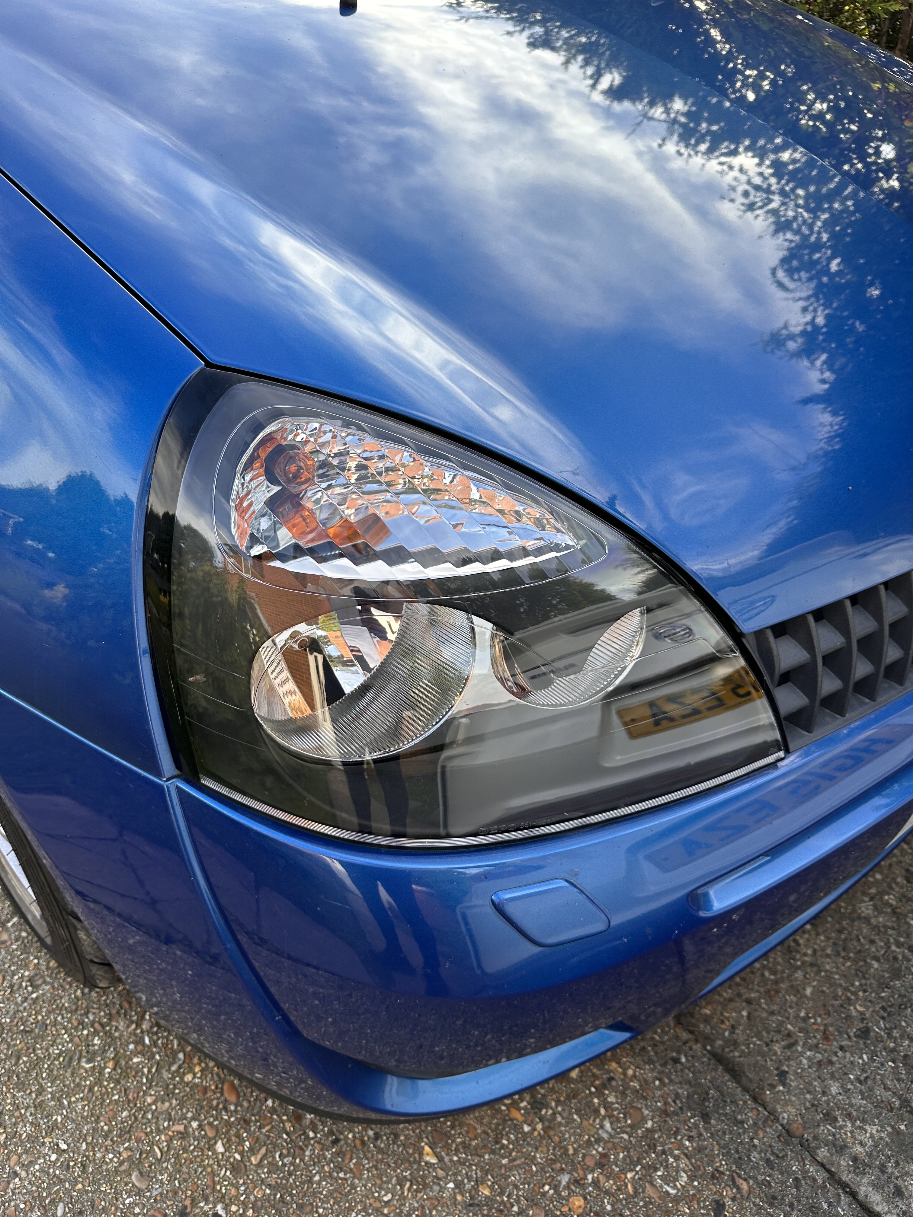

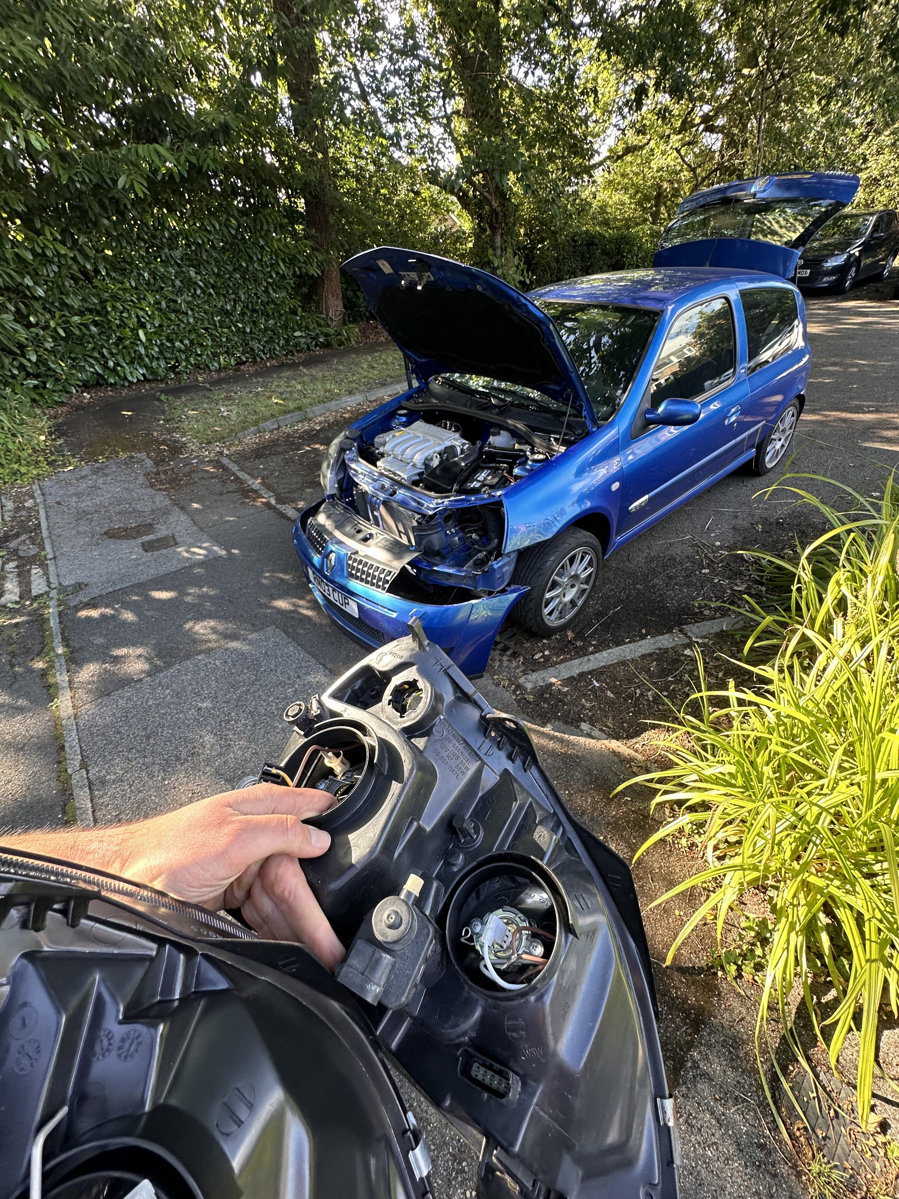

As it was the big day, I tried to get the car looking as good as possible. So fitted some new headlights. Definitely helps make it look a little more cared for.

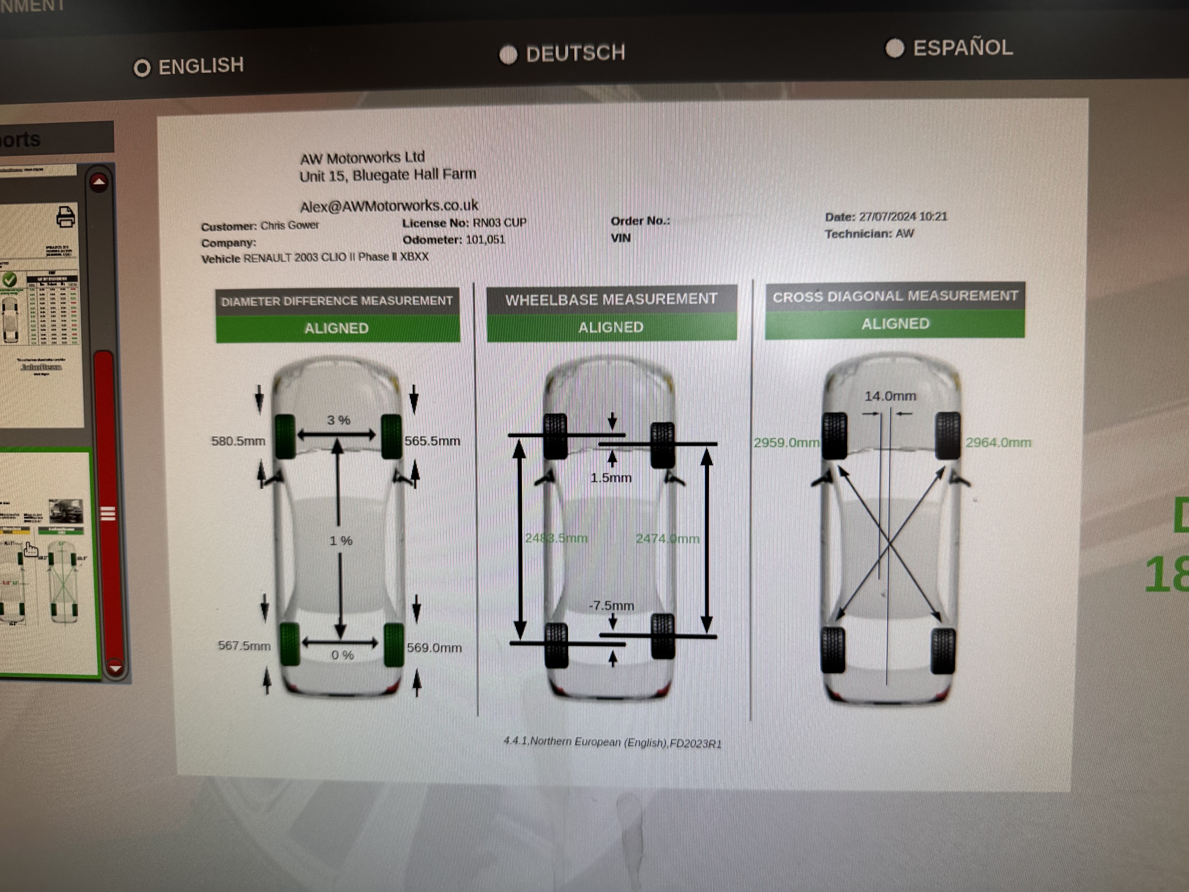

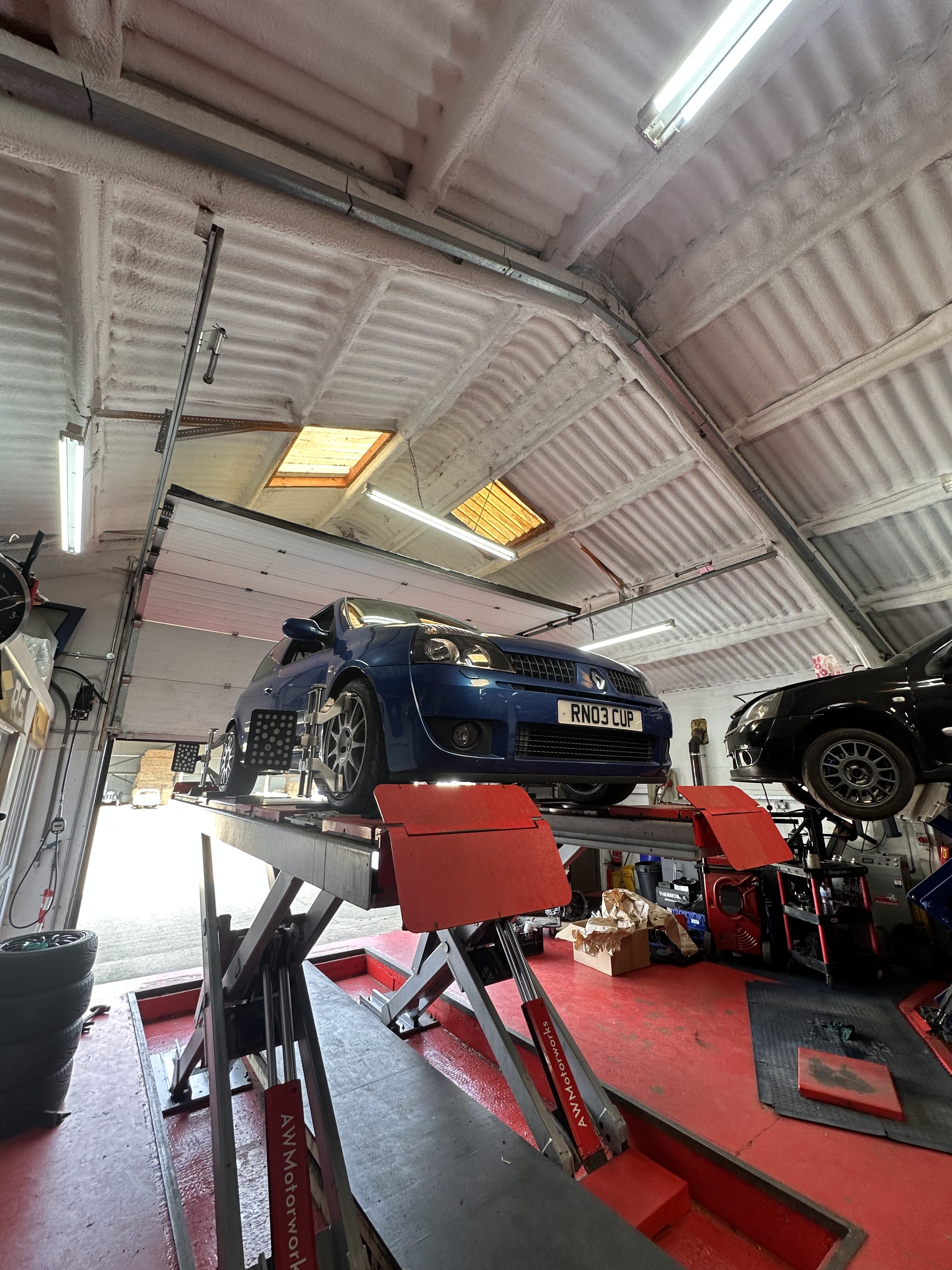

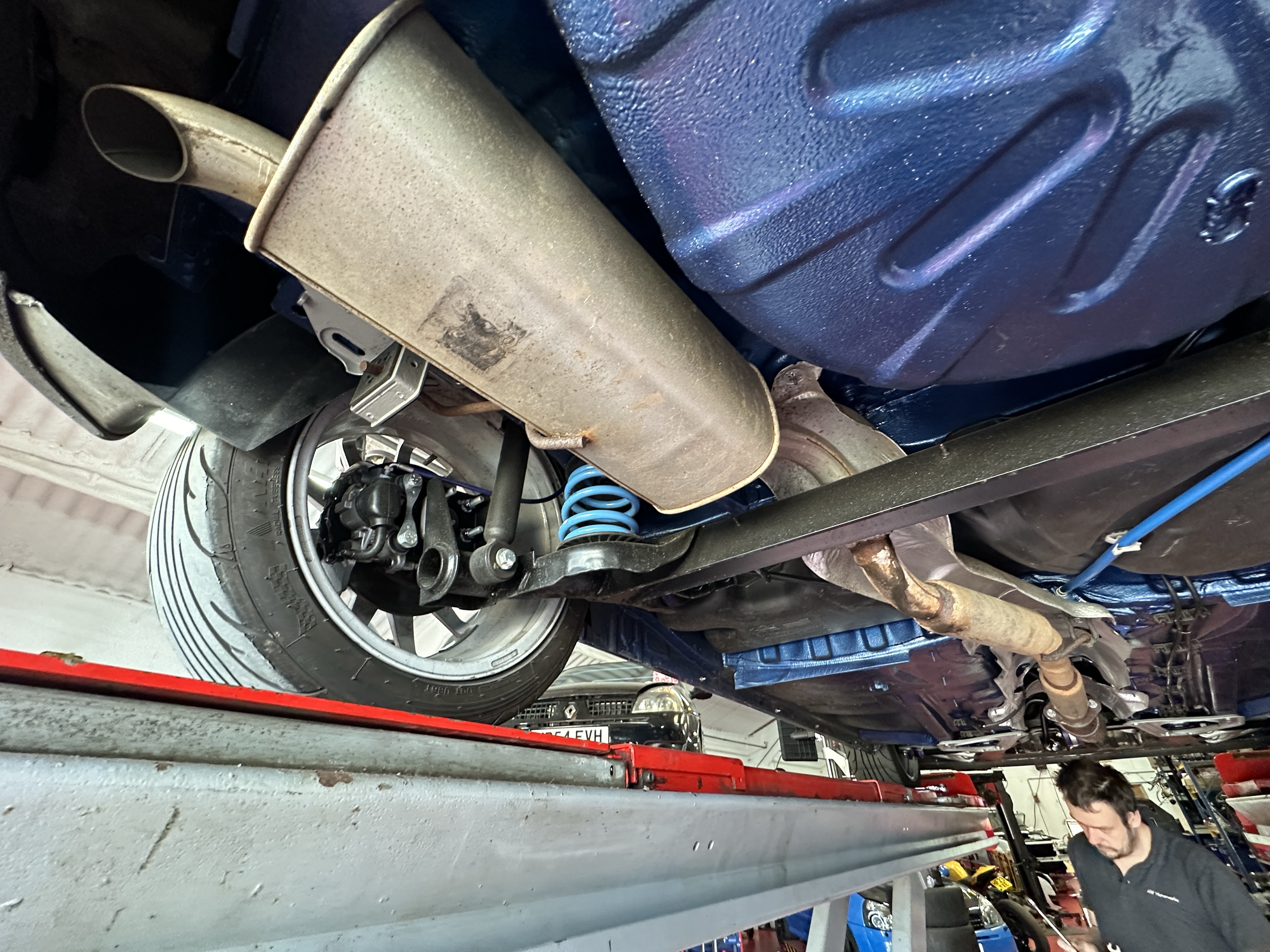

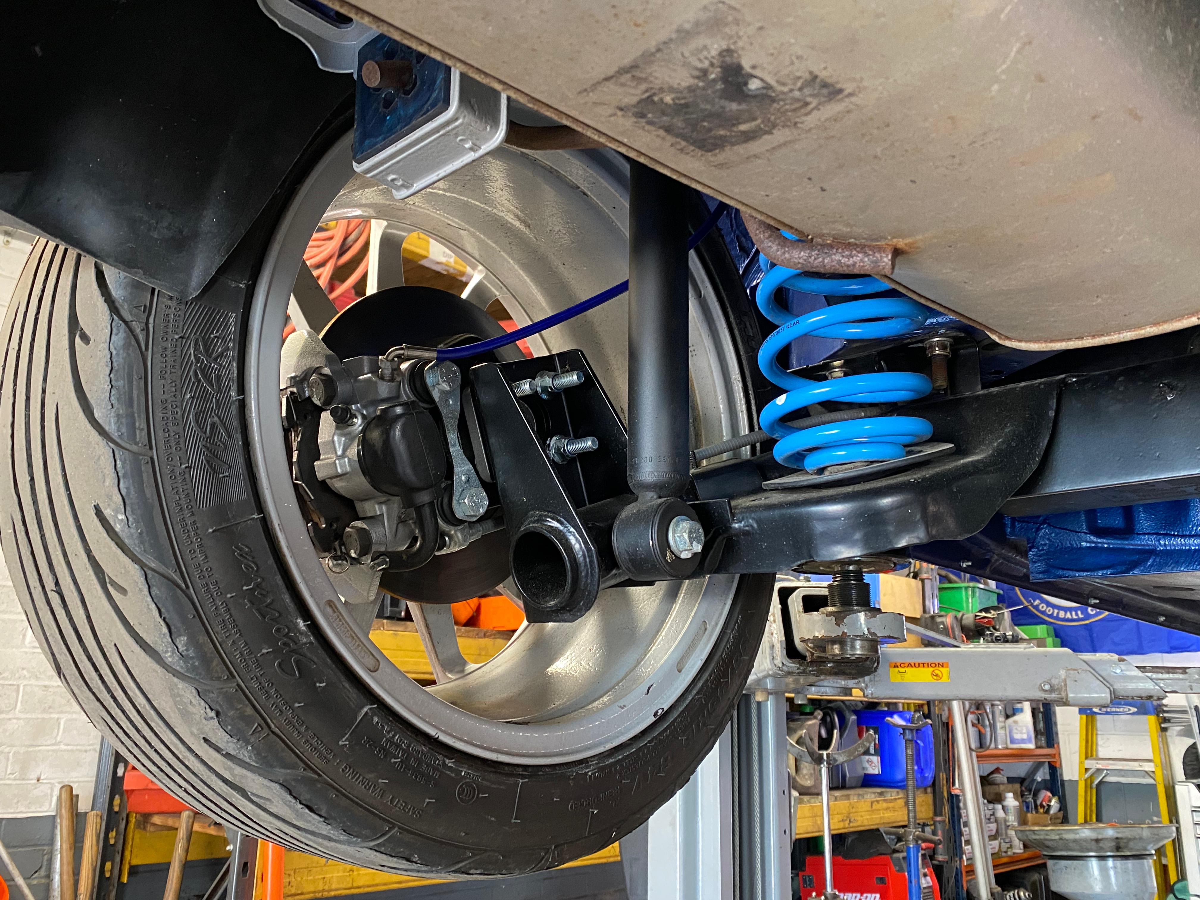

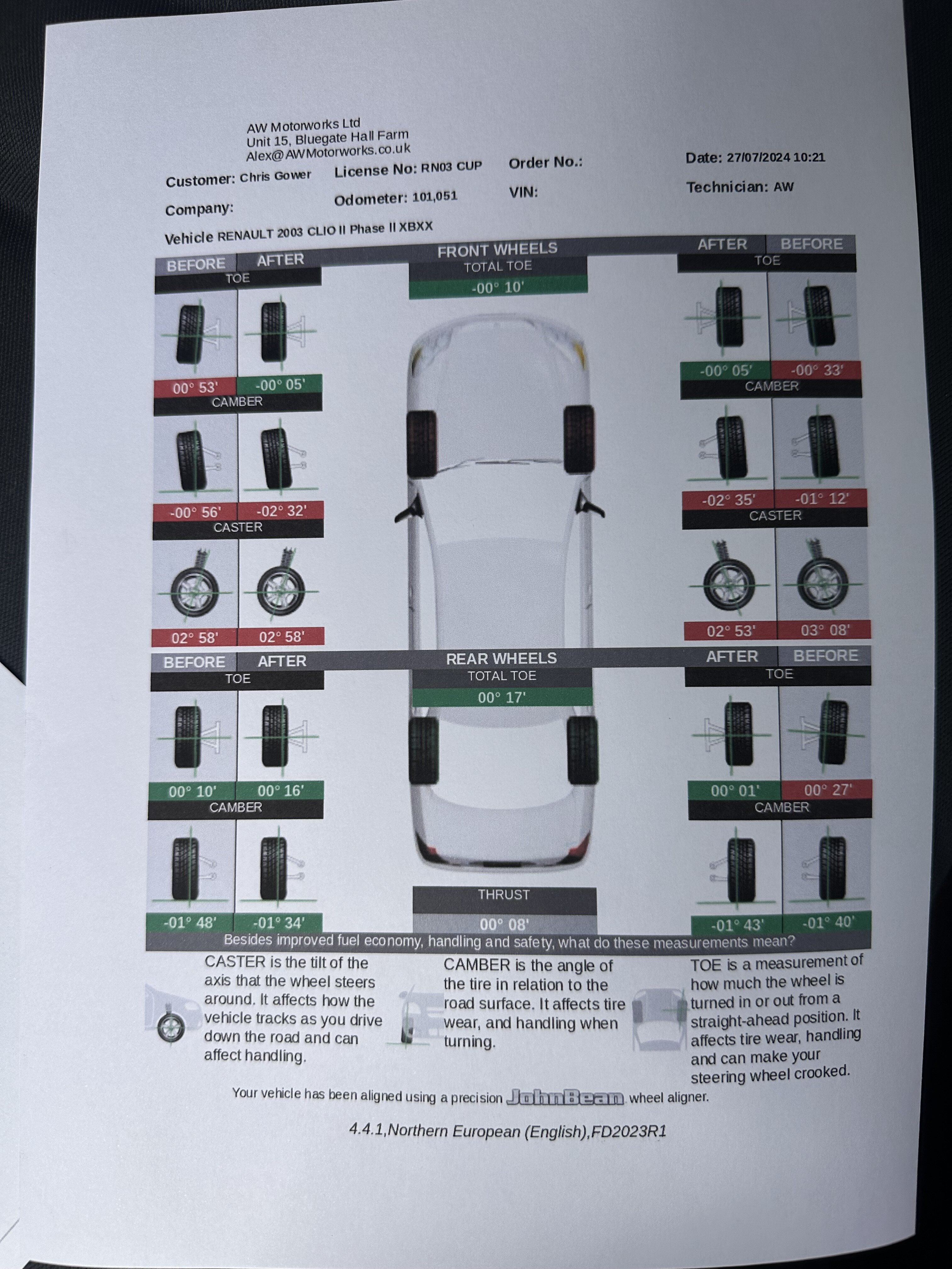

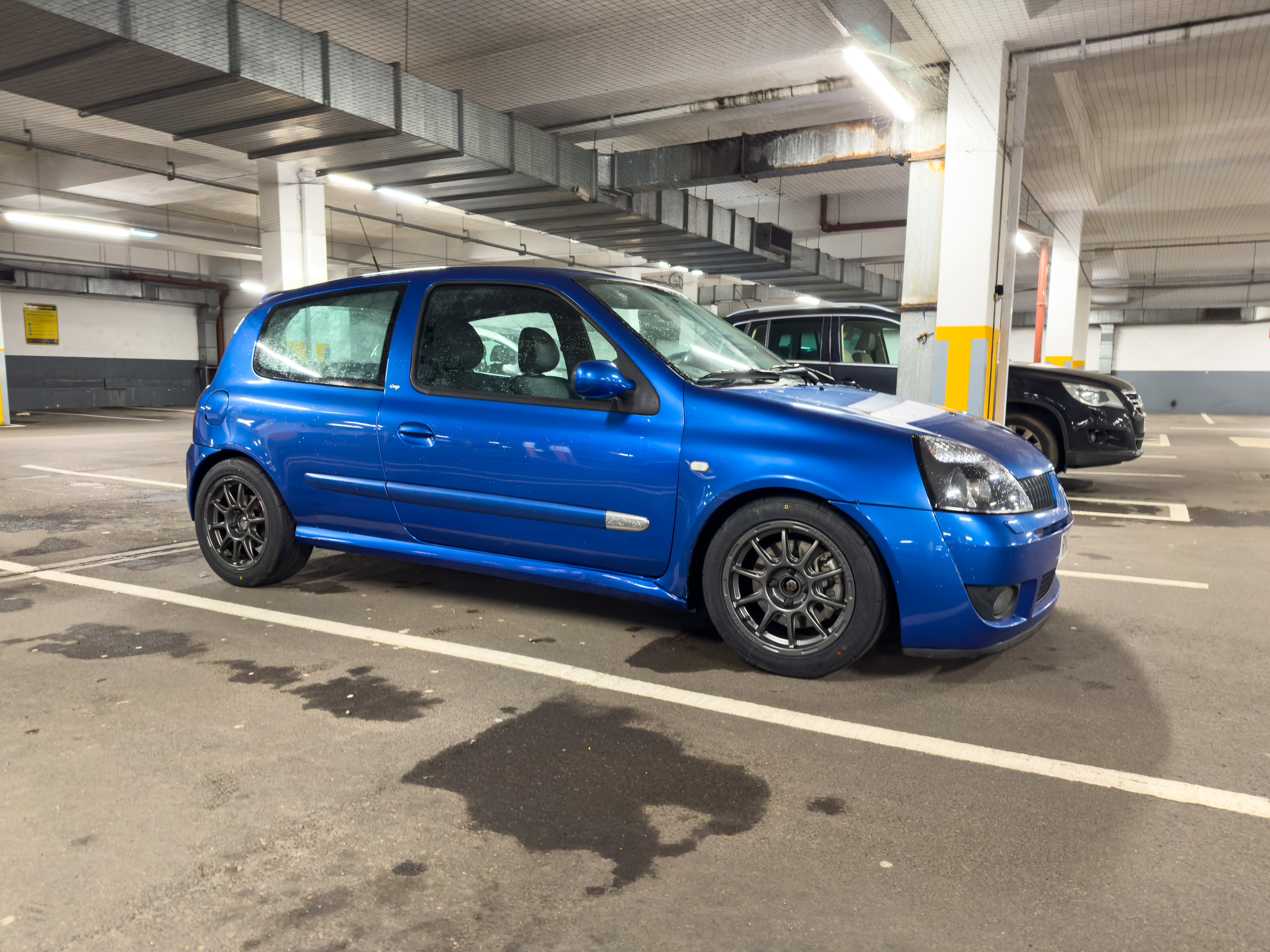

Took the car to see Alex at AW Saturday last week to get some camber dialed in and the alignment sorted - I'd been driving with the steering will pissed the entire time up till now.
He fitted some Eibach camber bolts and got it to roughly -2.5 degrees. Only 1 shim was needed at the rear drivers side to get it fairly square.
Oh my, what a difference it's made. For a relatively stock suspension setup, it's absolutely sublime on the road. No doubt it will be a little soft on track, but we'll see in a few weeks time!

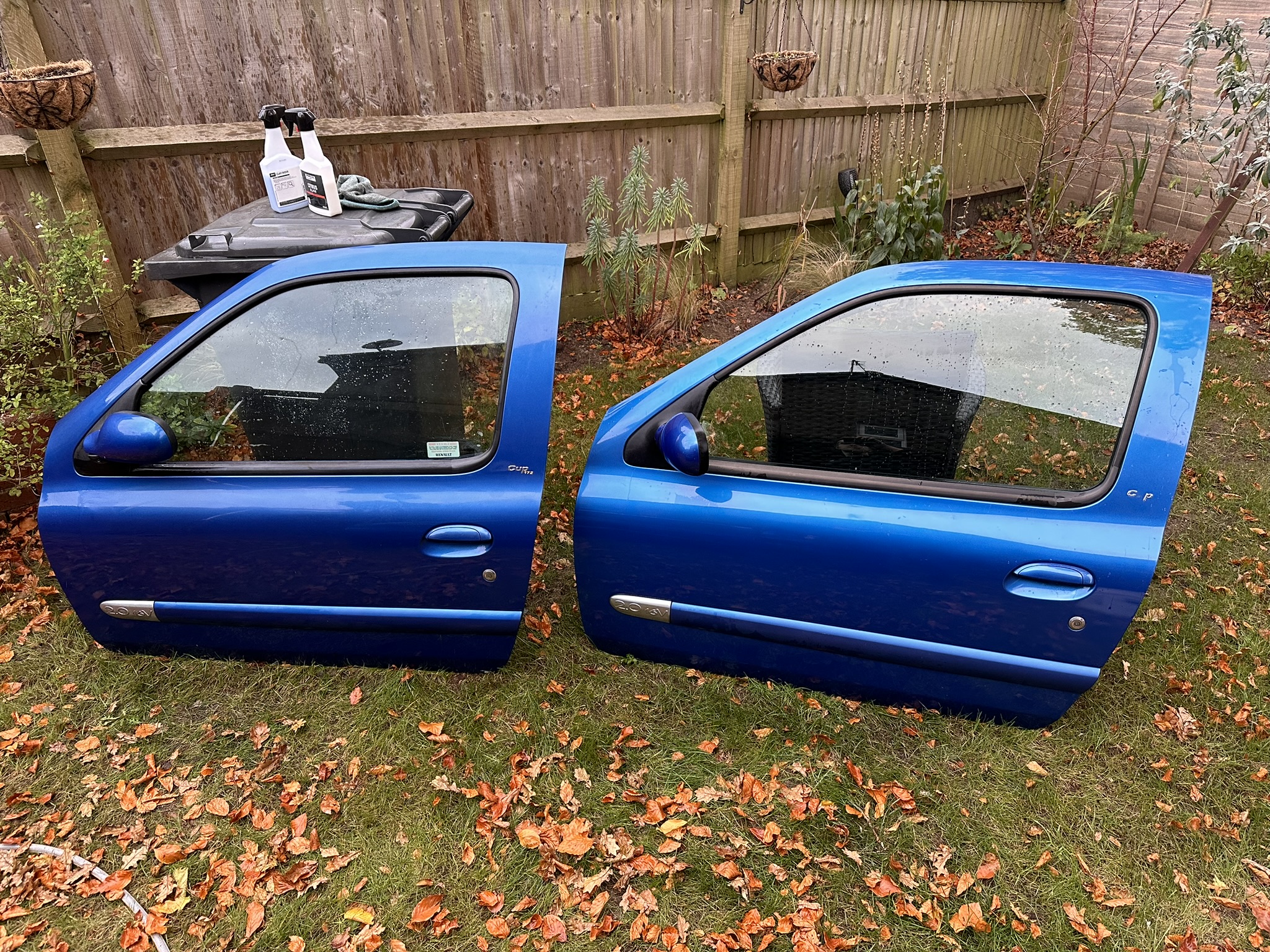

Changed a door
On the left is mondial blue - on the right, artic?

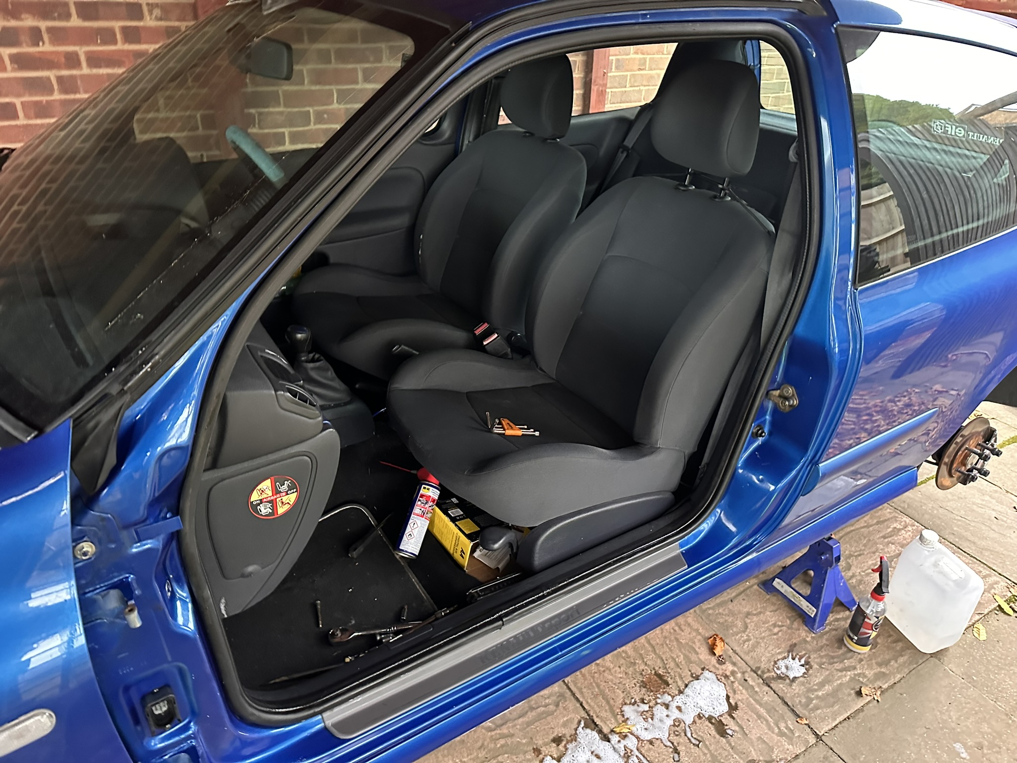

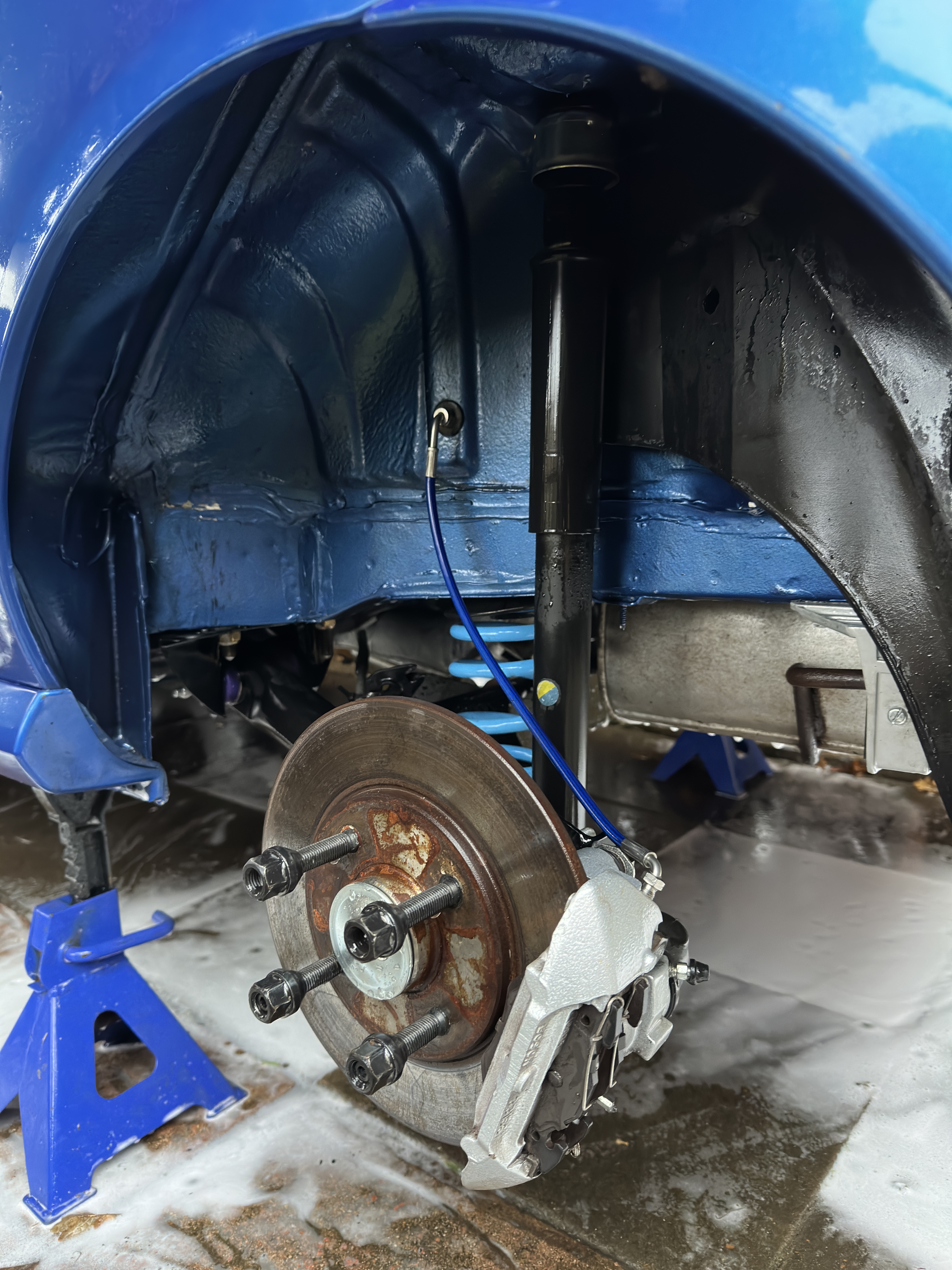

Put the car on stands to give it a deep clean.
Not too bad considering it had been a year - most of this was from when I annoyingly got caught out in the rain about a week prior.
Came up ok - seems durable enough. Will be doing this again. This was just the first pass with snow foam and a brush.
Finally, steering wheel and PH1 stalk fitted for the horn. No other plans on the interior unless I see a scenic shifter pop up for sale.

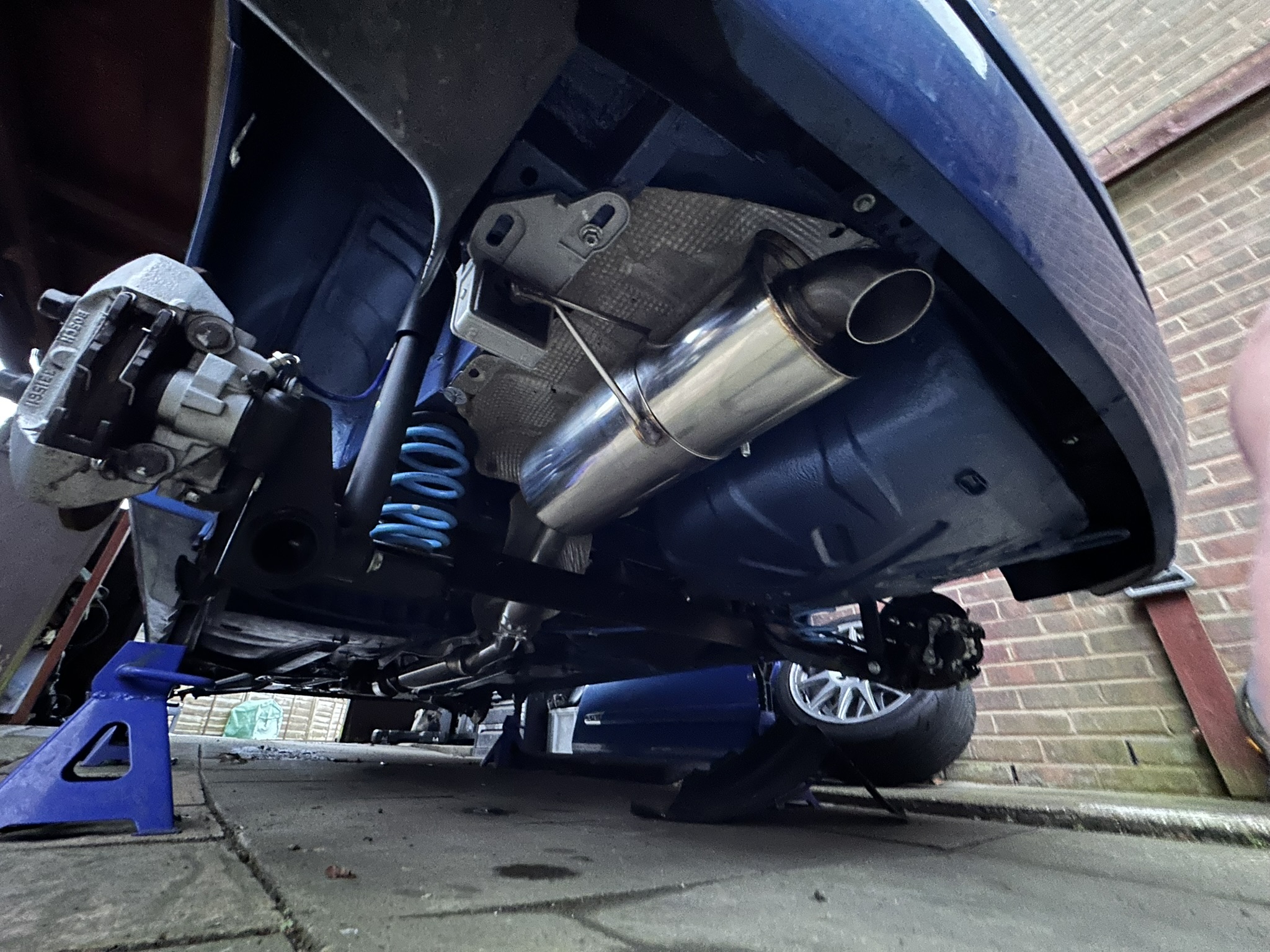

Fitted a Piper stealth exhaust system, got a remap, gave it a service, went around Spa. The car made 169.7bhp with ED. Not amazing, also not bad. The main thing is improved drivability and throttle response.
