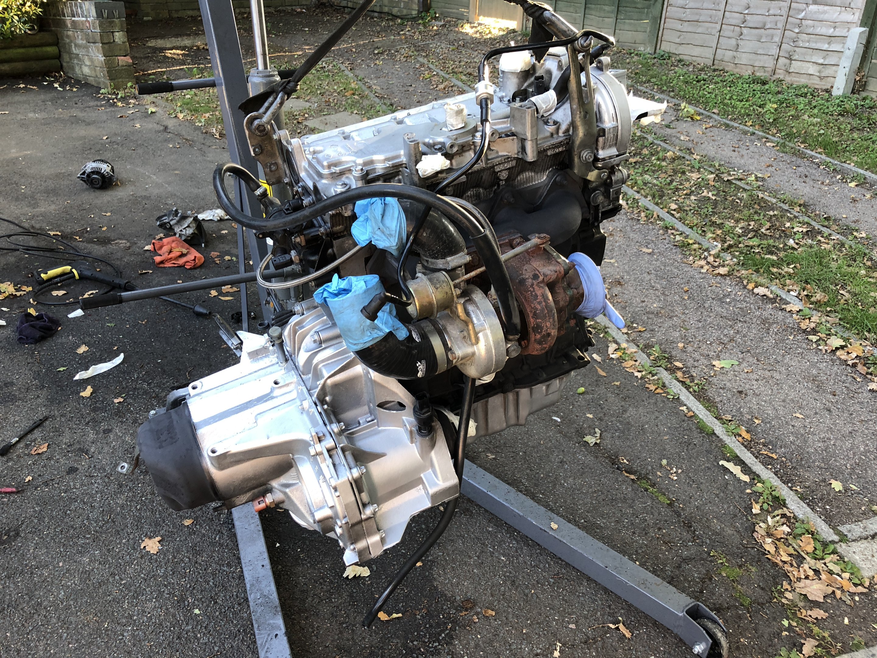

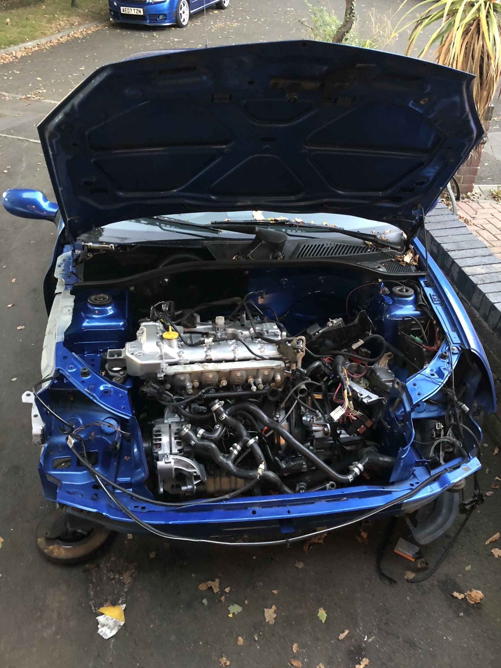

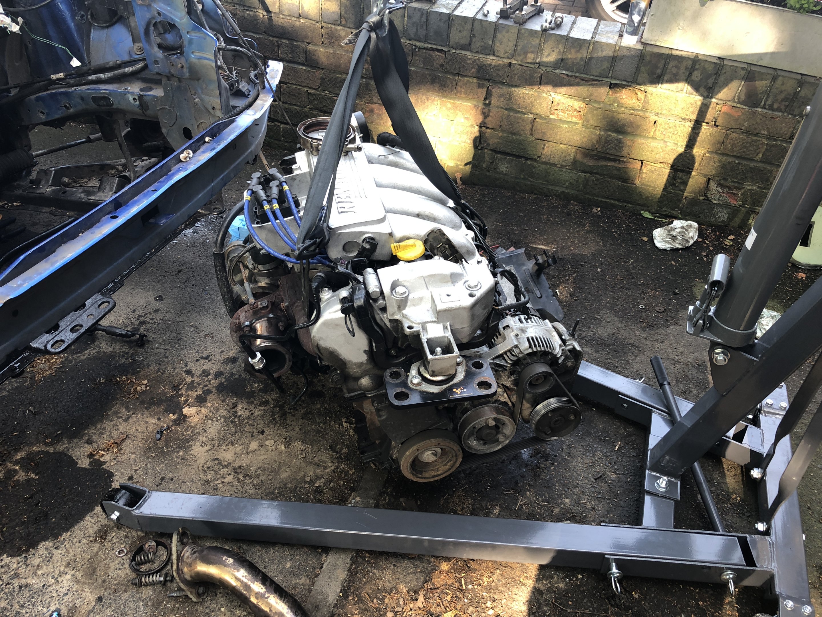

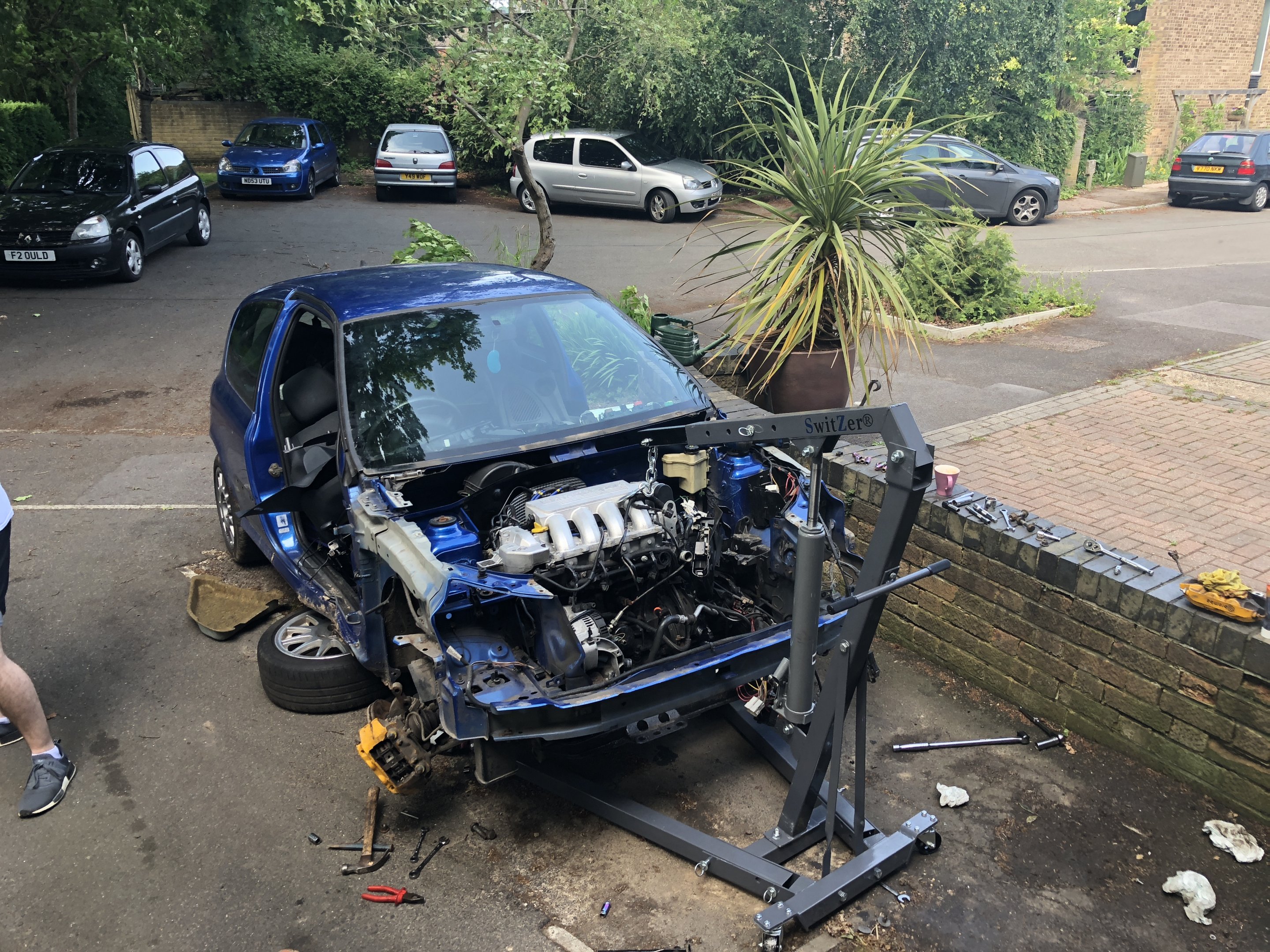

Engine out of old car. Was actually fair easy - most time consuming was labelling wires for injectors etc where they had been spliced into standard loom.
Engine out, ready for new genuine belts, oil change etc before going back in new shell.

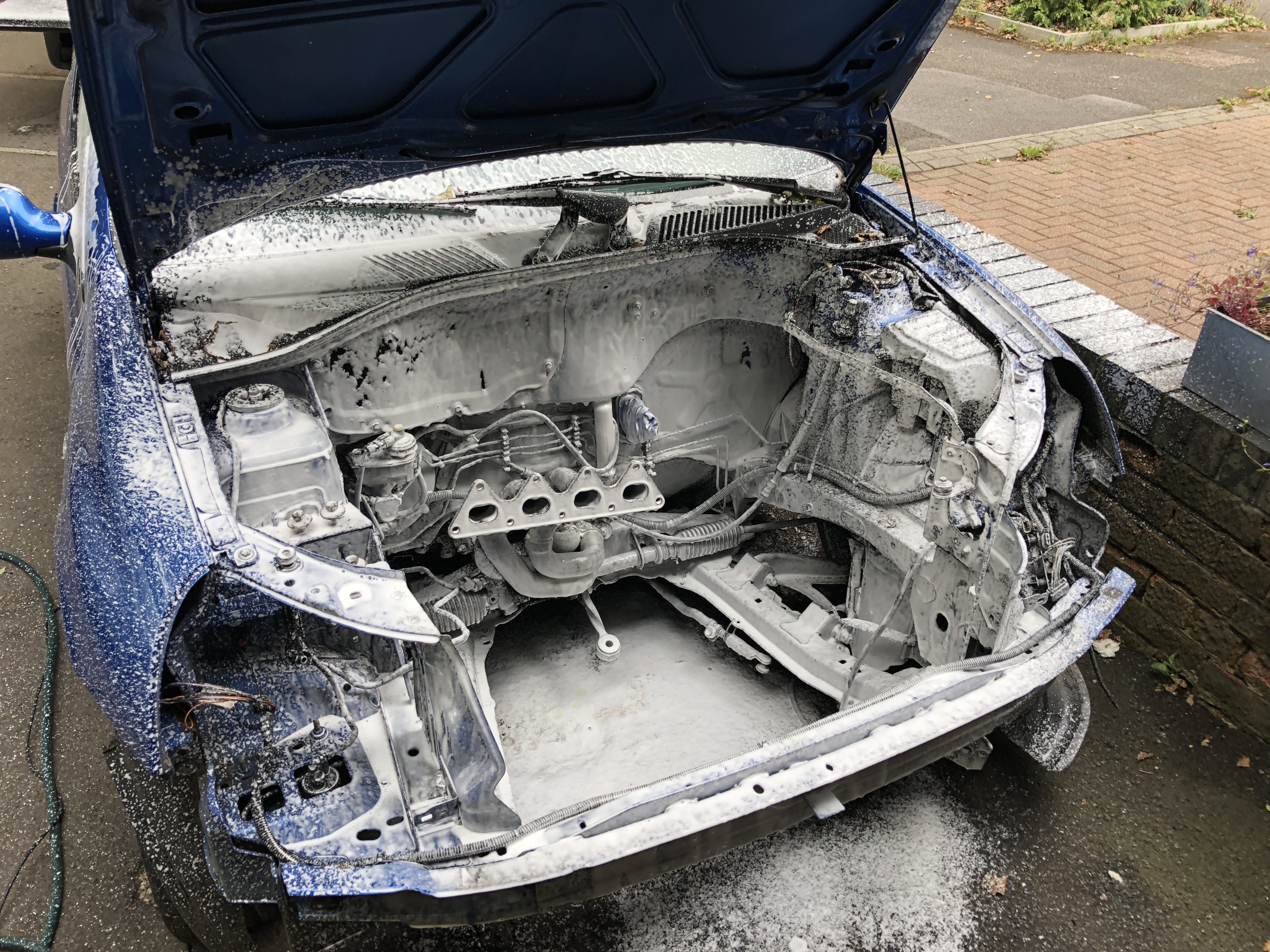

Engine removed from other car, the cleaning could commence! took ages doing this, cleaning it up, painting it with some left over paint from a spray shop to match colour of the car. Didn't grab so many of the before and after sorry!

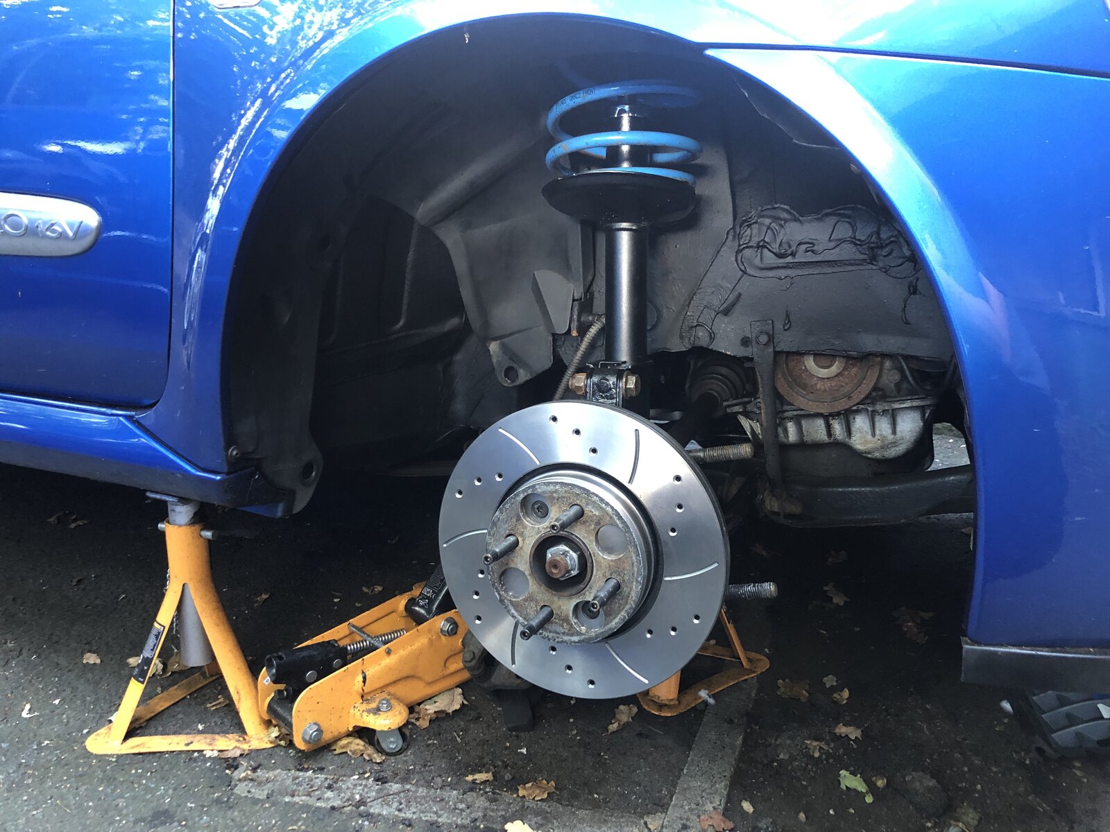

The 2118’s have gone to free up cash for some improvements, the first being fresh Cup shocks and a complete brake overhaul.
I’ve also started tidying up under the arches by cleaning and sealing with hammerite underseal in an effort to protect the car as much as possible.

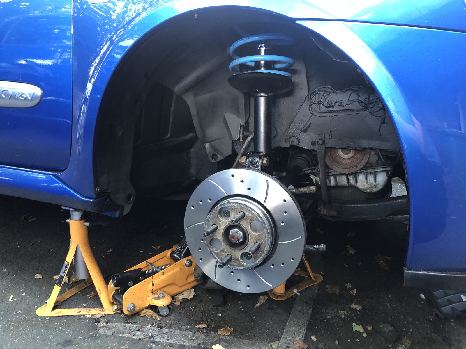

Fitted a fresh set of studs in preparation for the brembos to go back on, along with MTEC discs and new Brembo pads waiting to go on once the brakes have been refurbed. They will be silver this time around as opposed to yellow. The aim is to make the car as OEM as possible moving forward, aesthetically at least.
I’ll make sure to get some better before and afters of the other side.

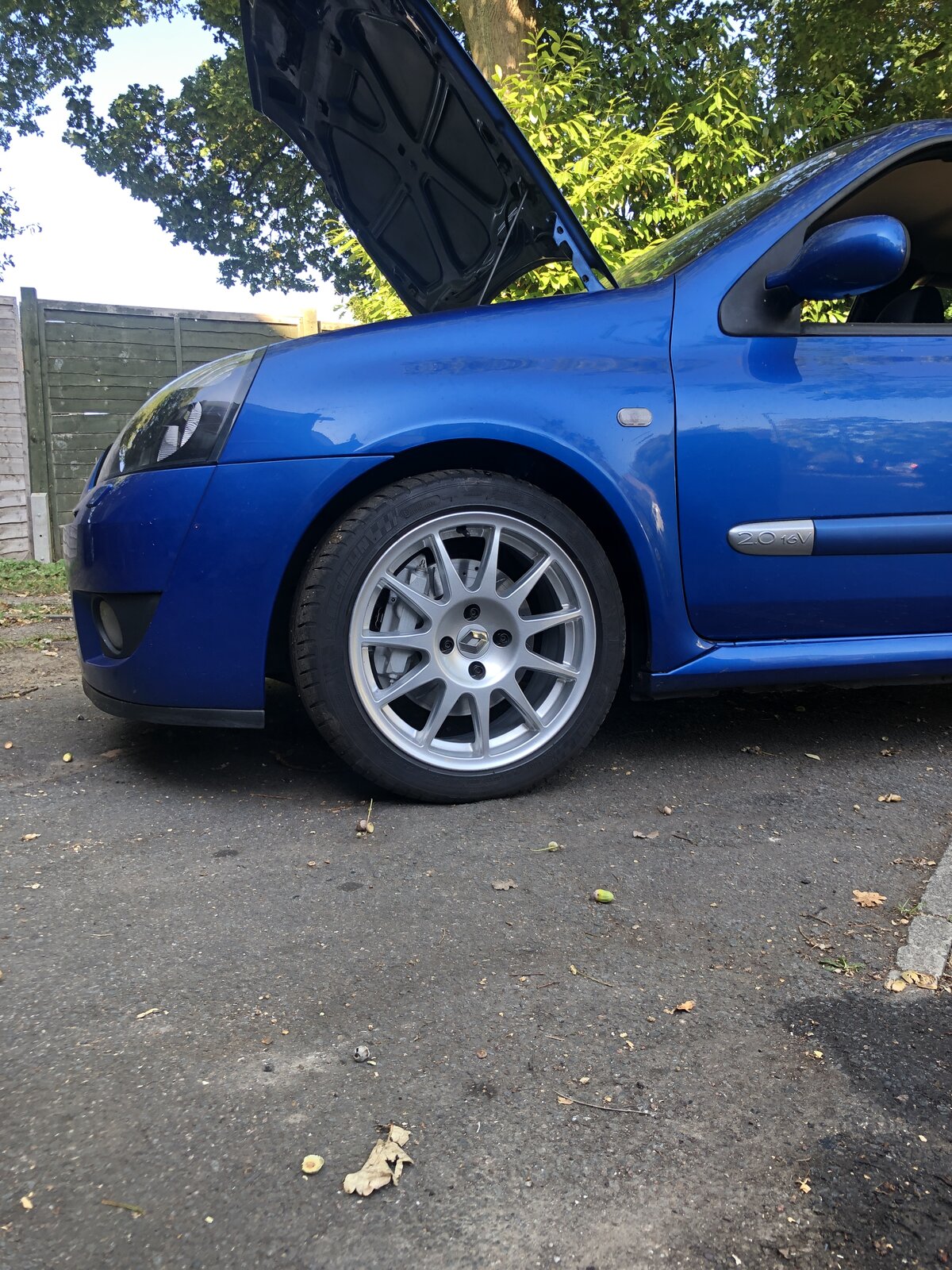

September has been a good month for the Cup.
- Complete Cup Suspension refresh
- Brembo’s refurbished and back on car
- MTEC drilled and grooved discs + Brembo pads
- Stud conversion with 10mm PMS spacers

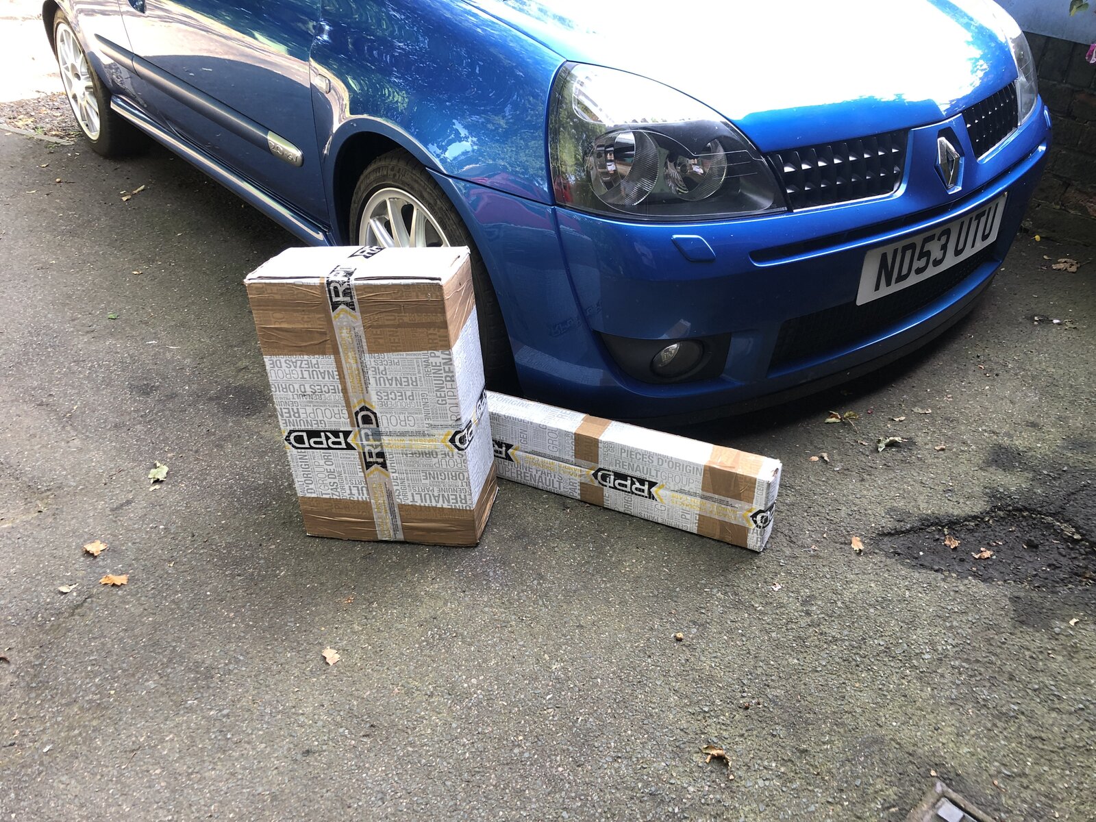

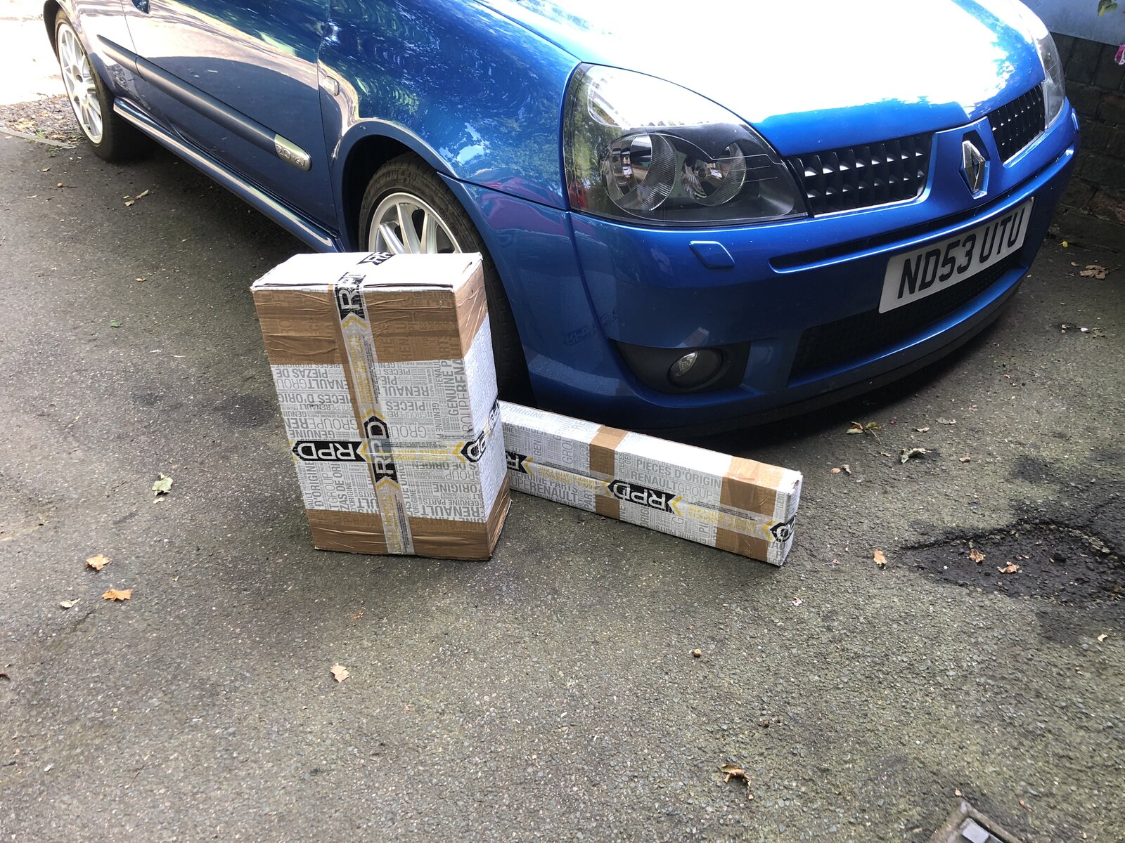

- New Cup alternator from RPD

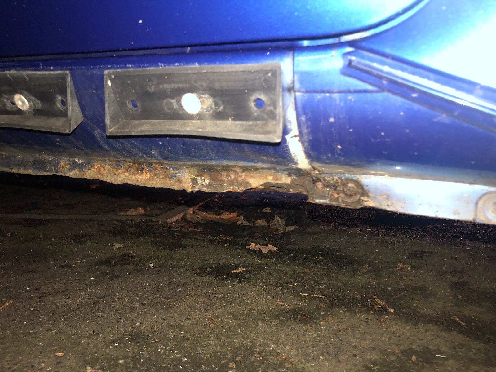

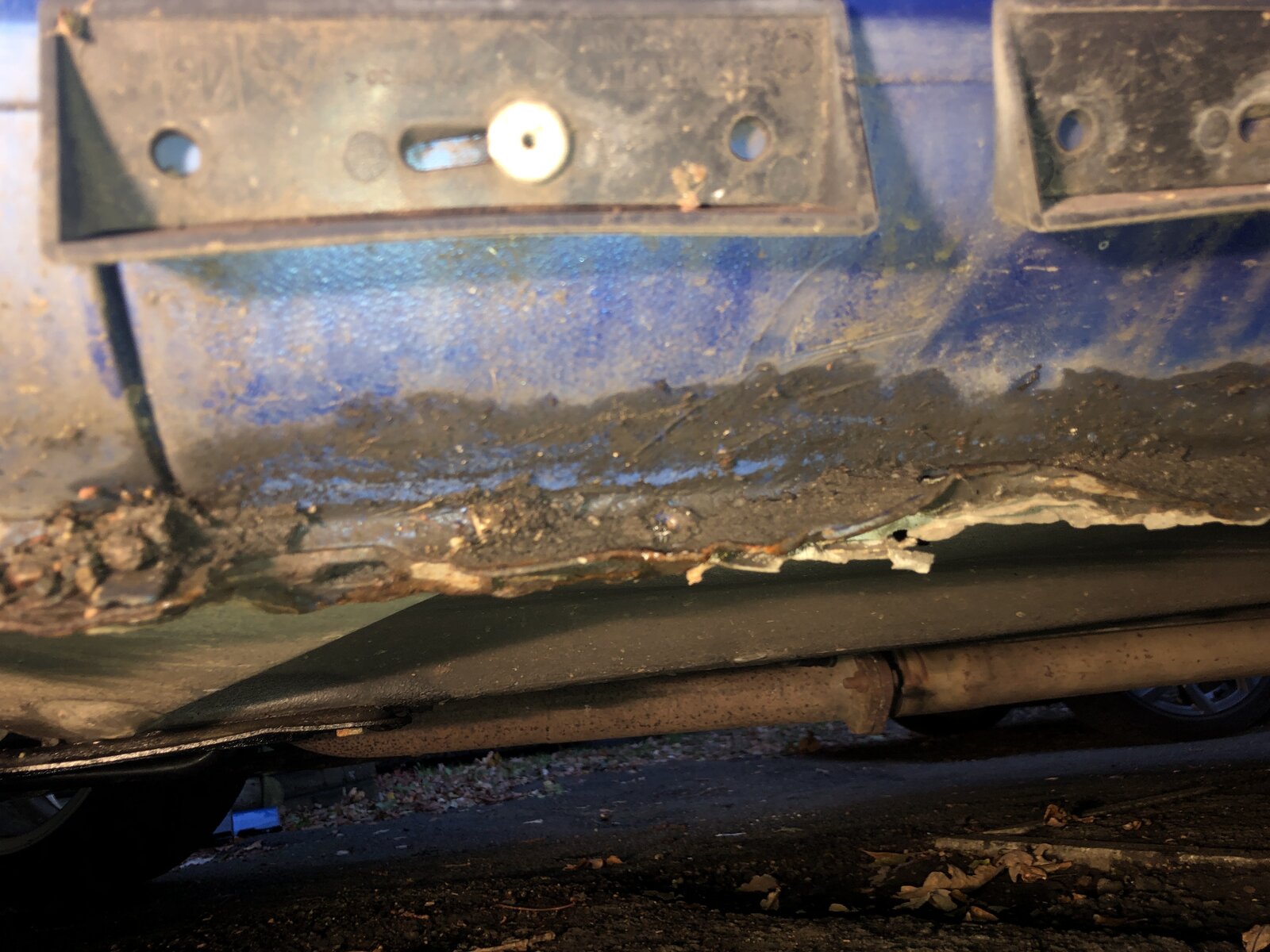

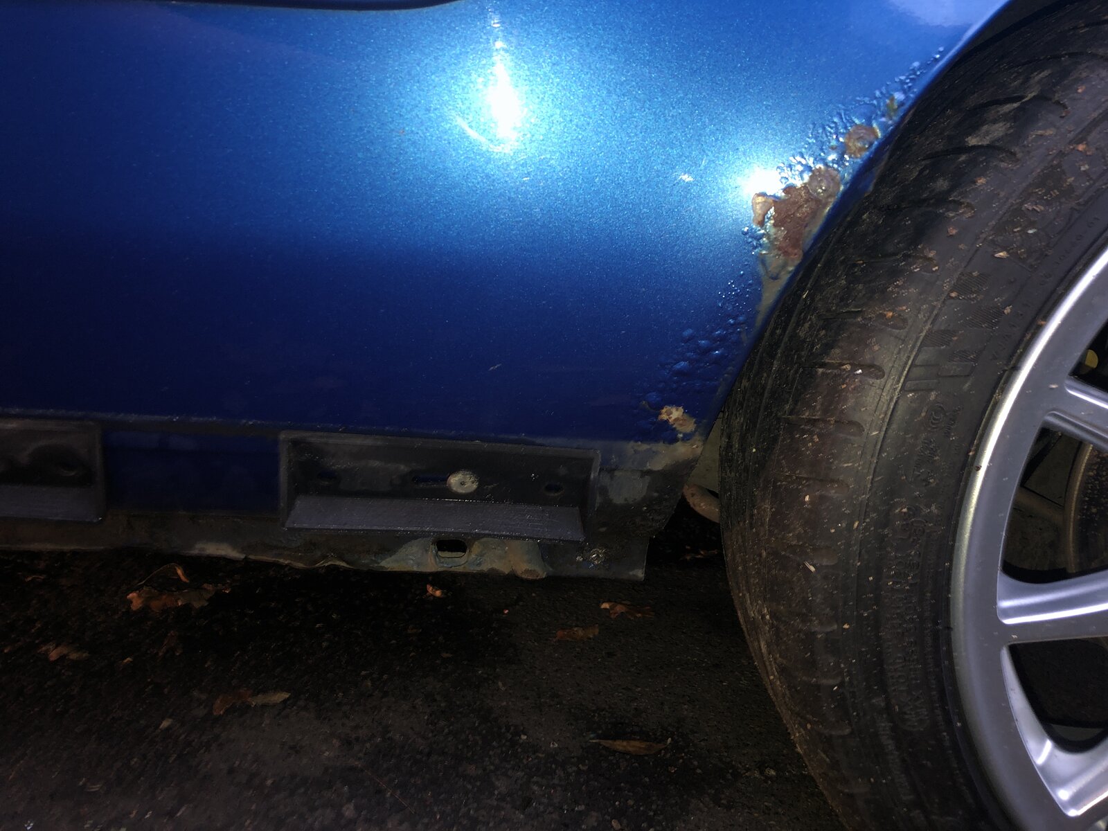

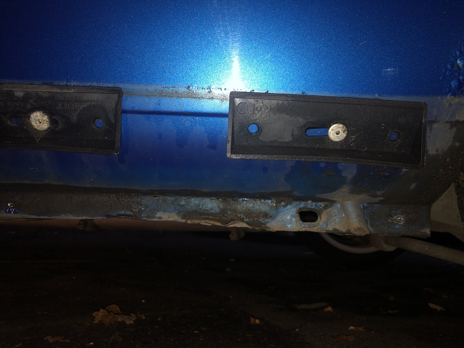

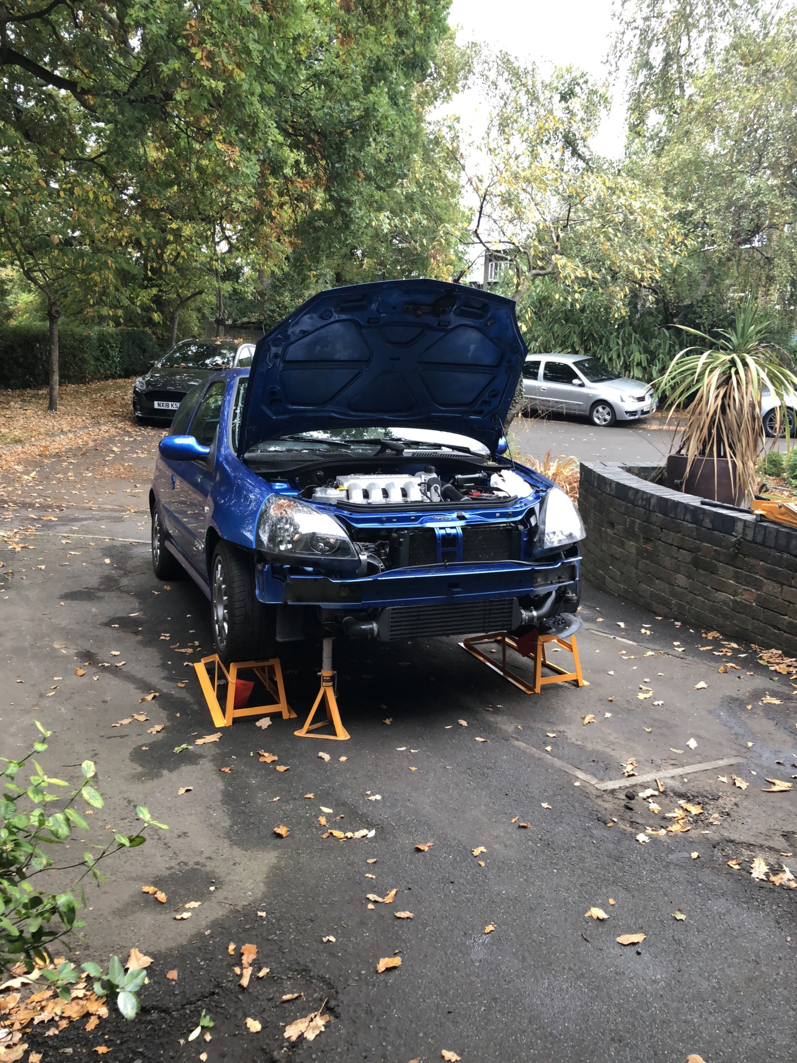

Not the most exciting of updates, but car goes in tomorrow for rust repair.
Spent the weekend getting the car ready, removing rear door cards, side skirts etc. Also fitted rear 10mm spacers - loving the way the car sits now.

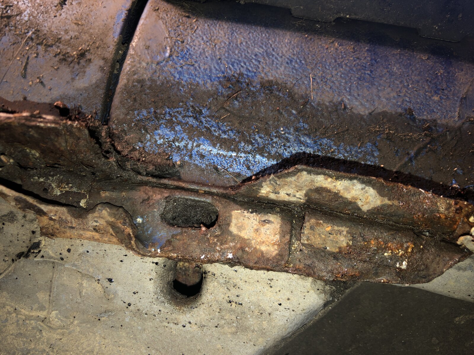

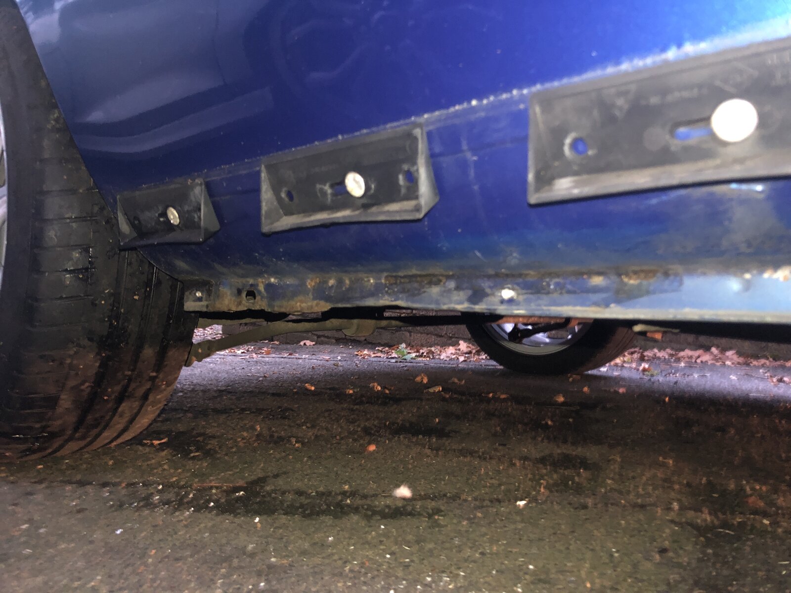

Hoping the sills haven’t gone completely but we will see. Either way it’s getting sorted which is what matters.
Shot from below looking straight up at the ‘sill’ on the passenger side.

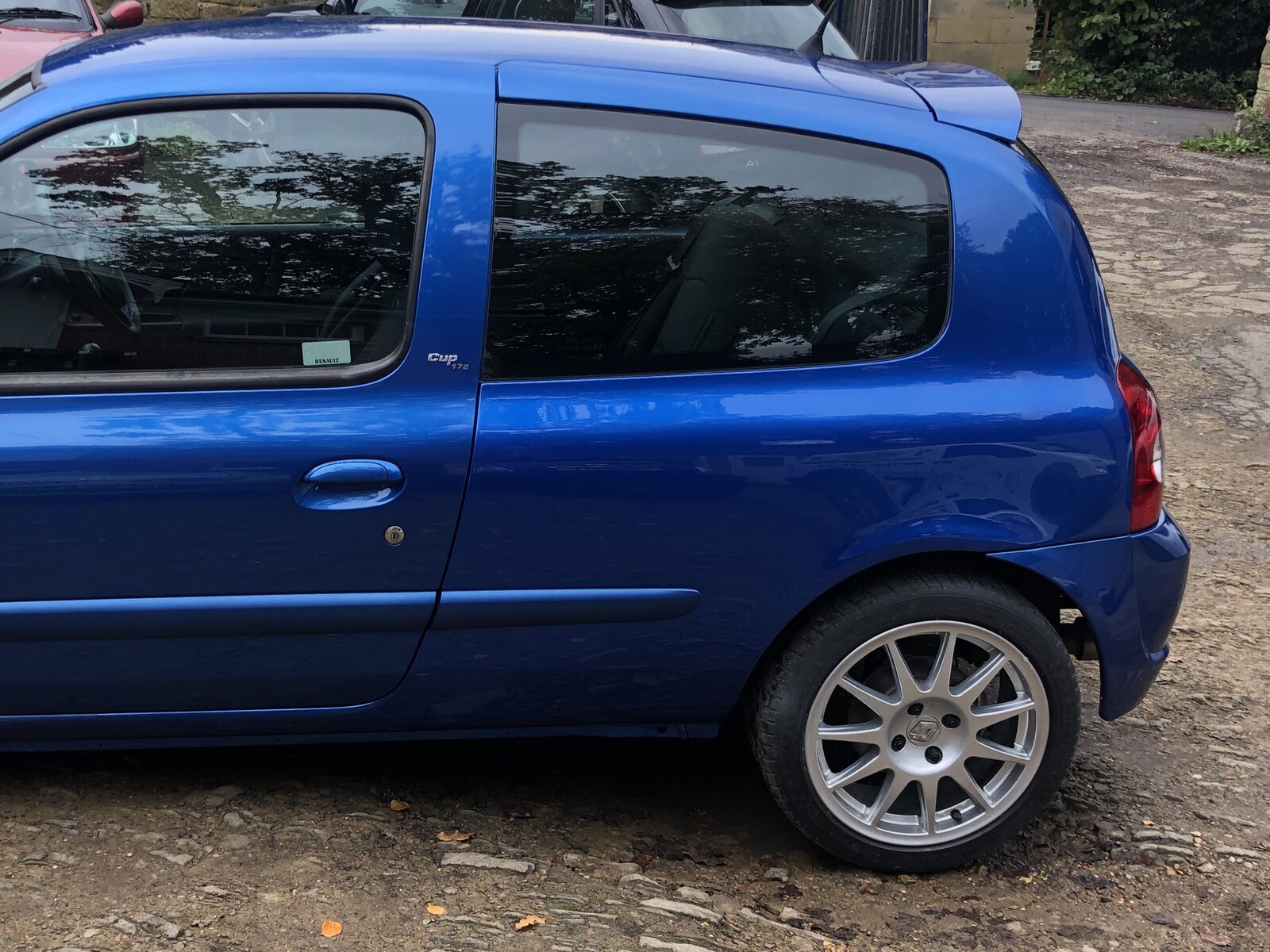

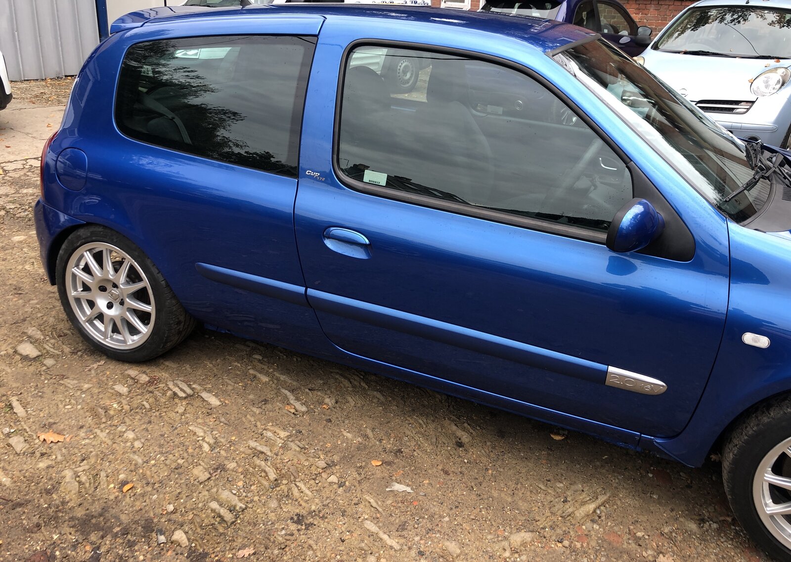

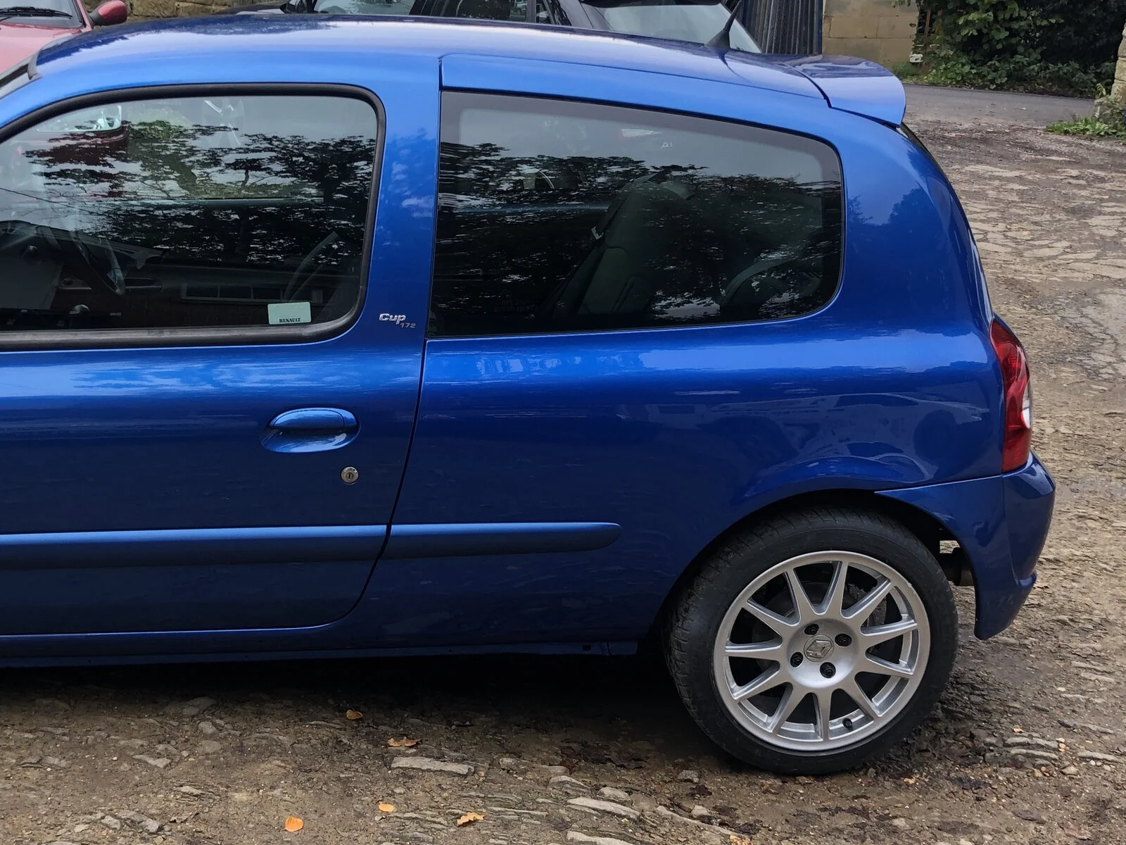

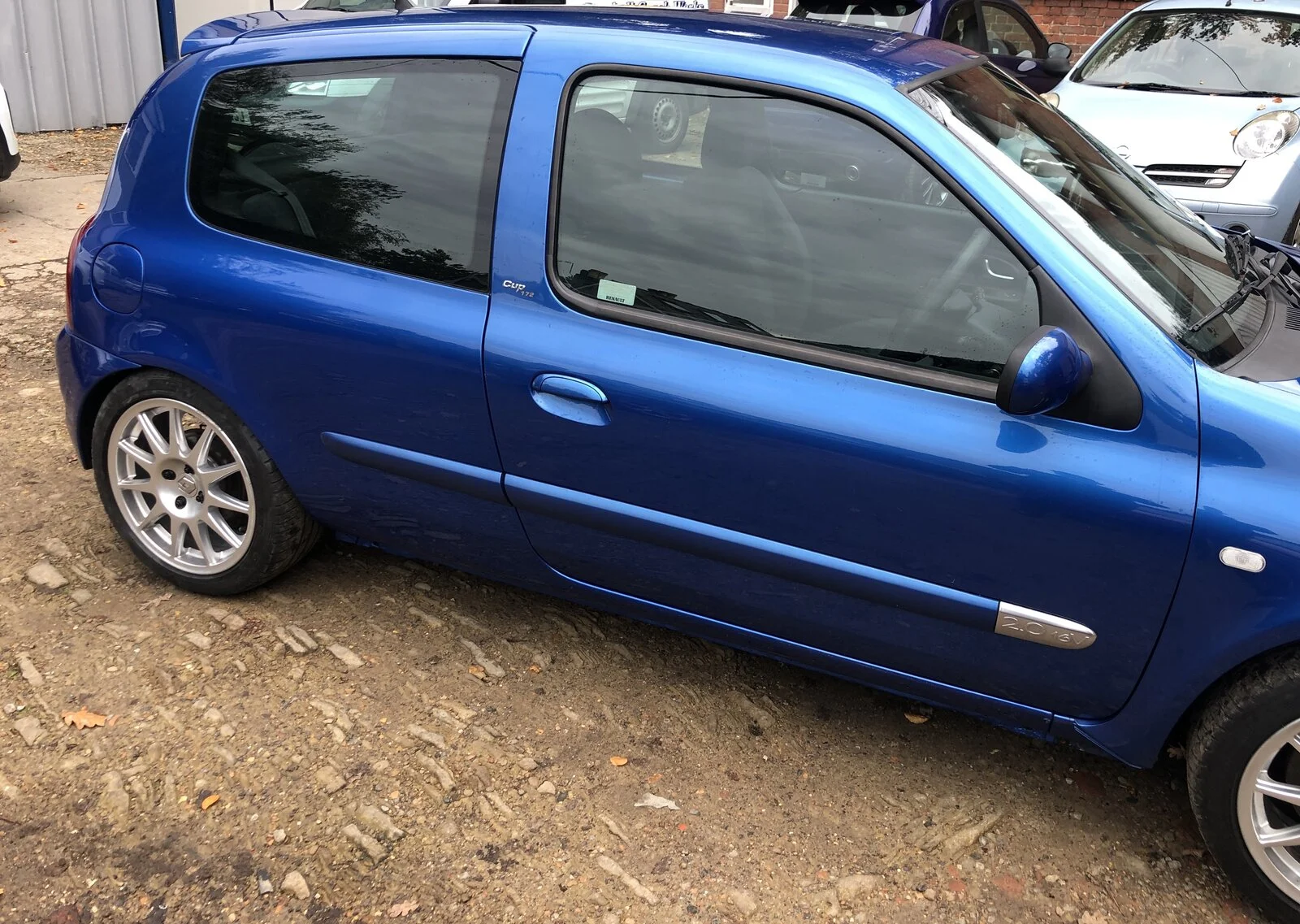

Pictures of the progress so far. Bit of a weird one, but anyone had issues with the doors and rear quarter not matching well after spraying?
Rather than being an issue with the colour, is this just 16 year old never been machine polished paint vs brand new paint?
Overall really happy with the finish and quality of the work carried out. Will update with some pretty pictures of sills etc next week. Talk of carrying on this colour through the doors as it seems to match the rest of the car, just not the doors.

They should match well if the shade is well matched, spray out cards are used and it’s blended into the next panel. Often shops don’t mix their own paint and order without checking the shade. Had it a couple of times sadly. New vs old paint is sometimes very obvious though so a machine polish on the older panel is a good idea. As both panels are metal I would expect them to have a perfect match. Plastic to metal is different and does often have slight differences.
