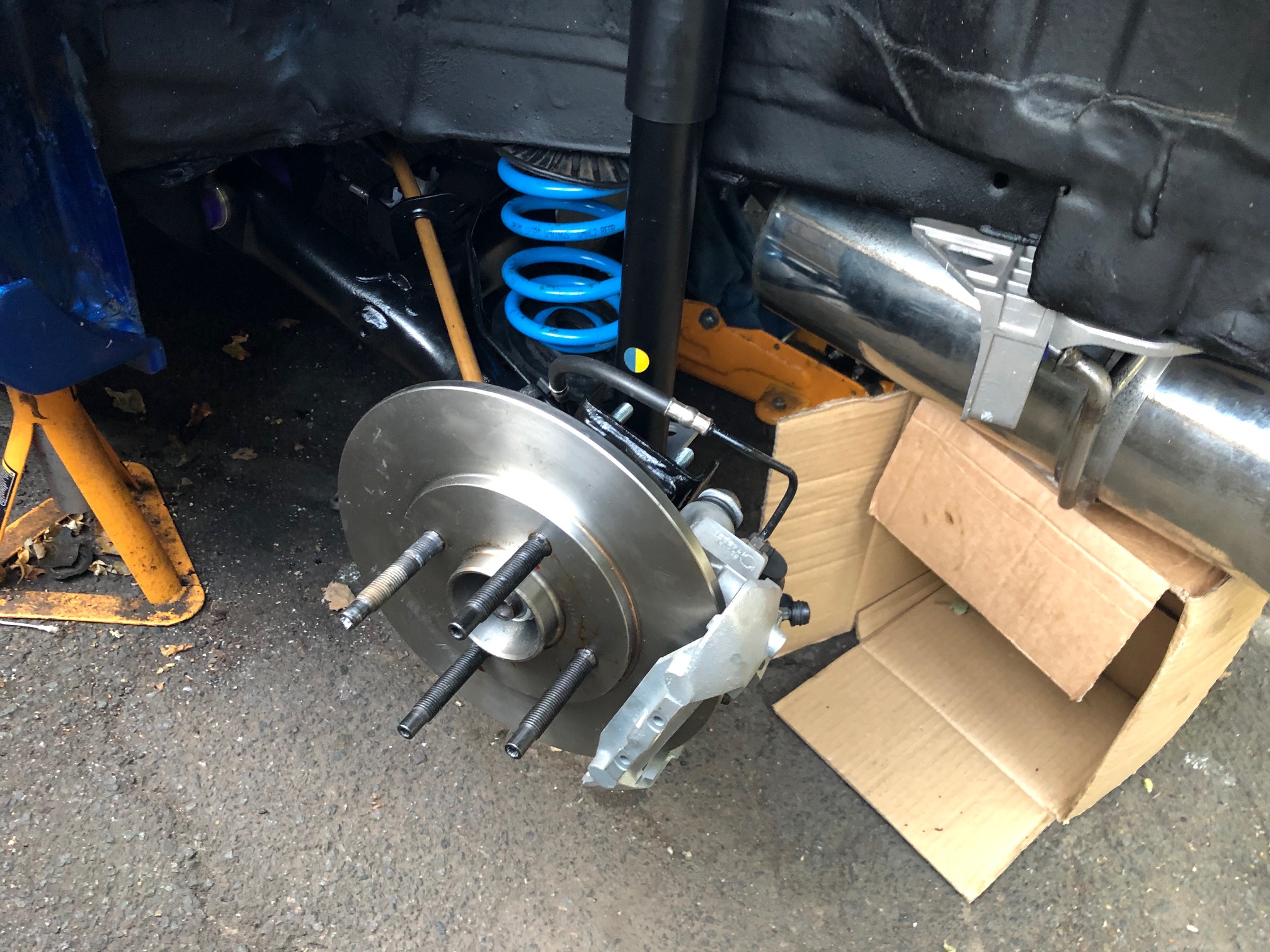

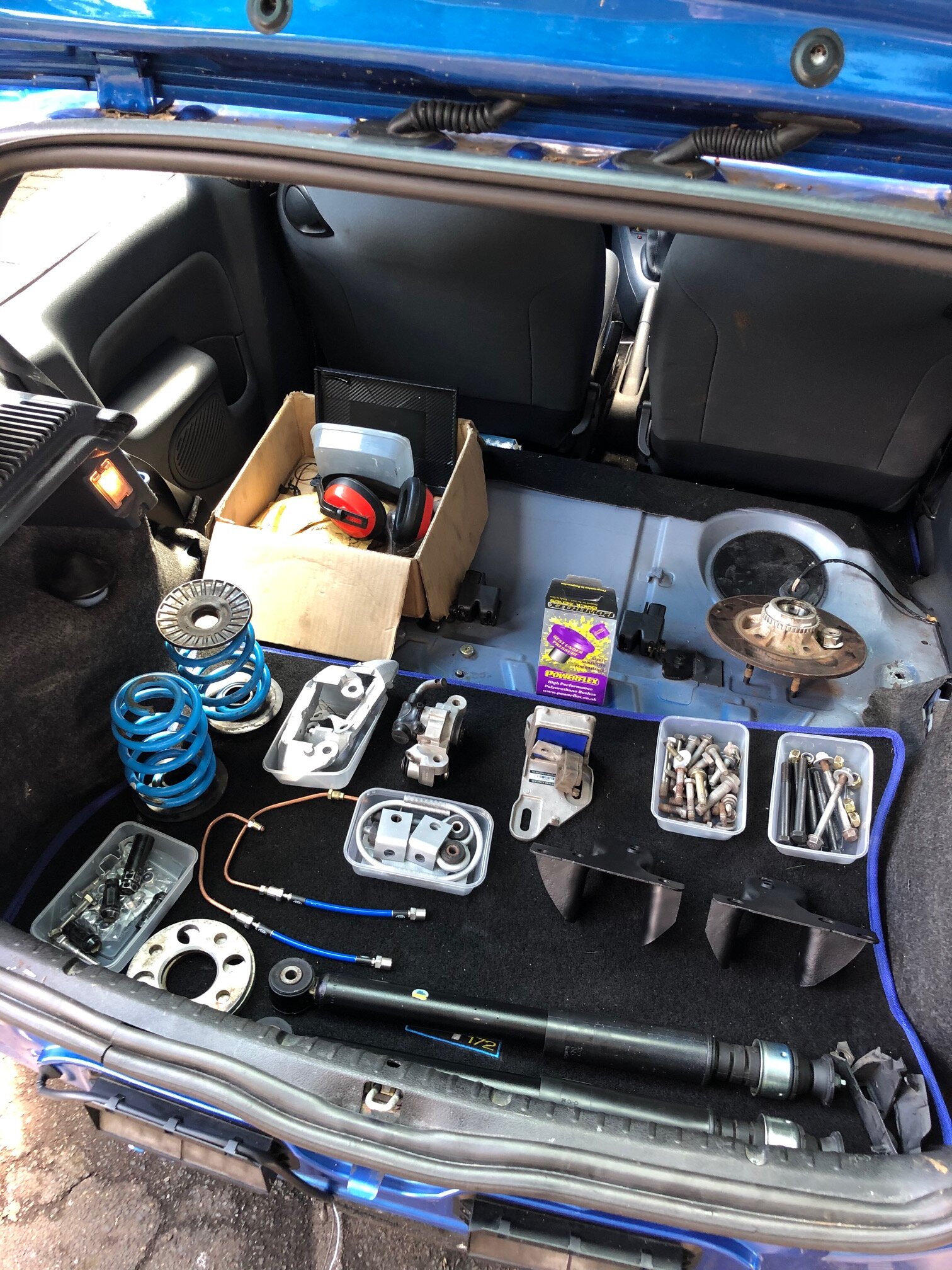

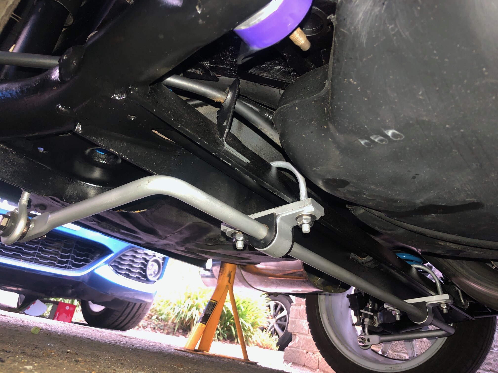

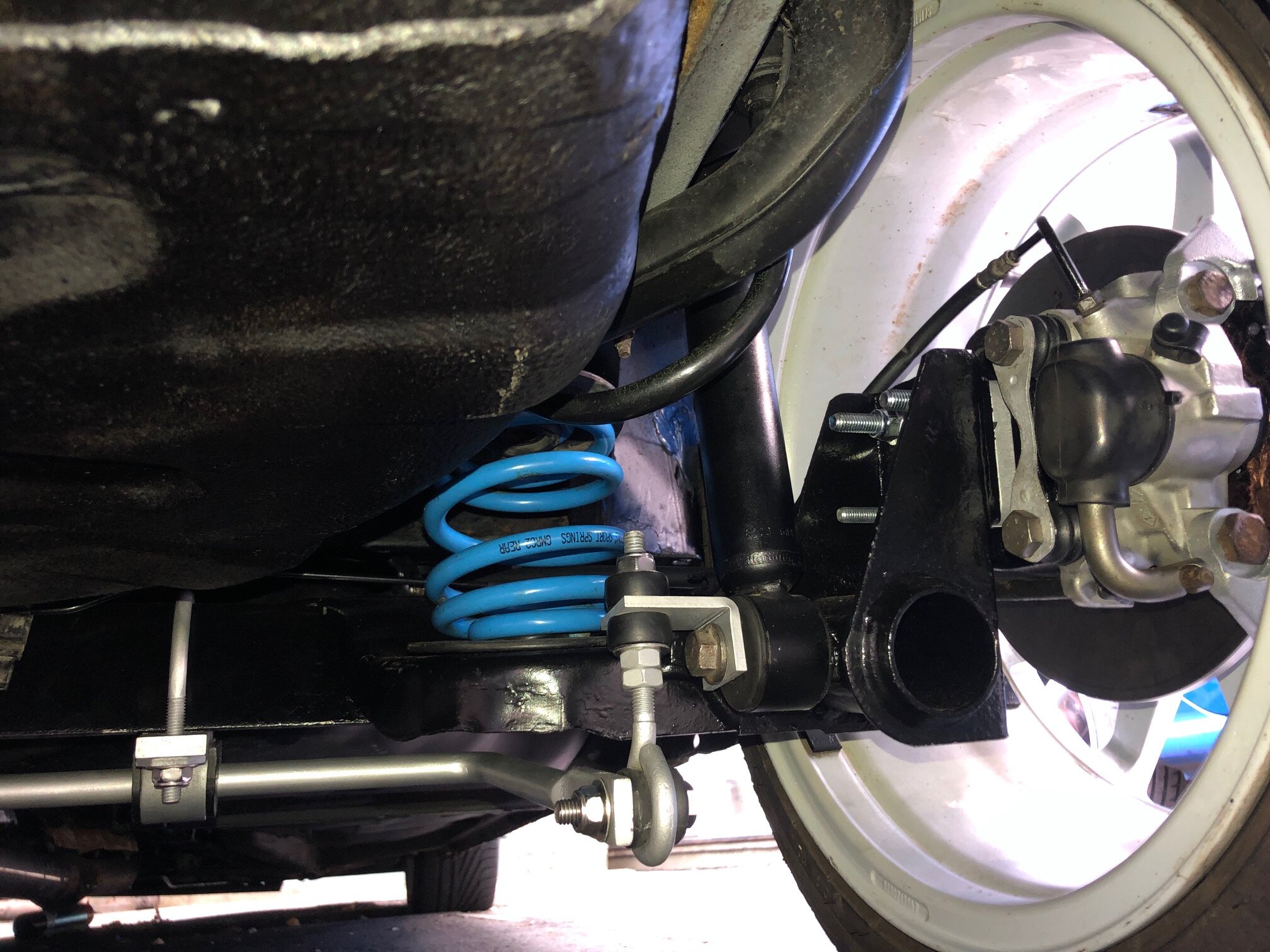

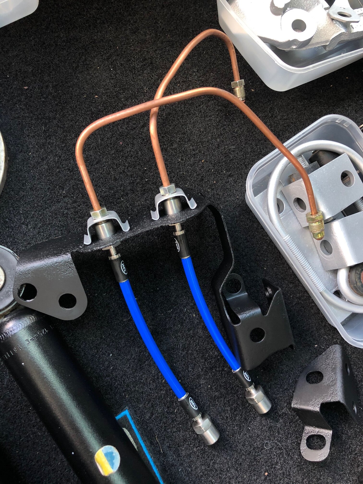

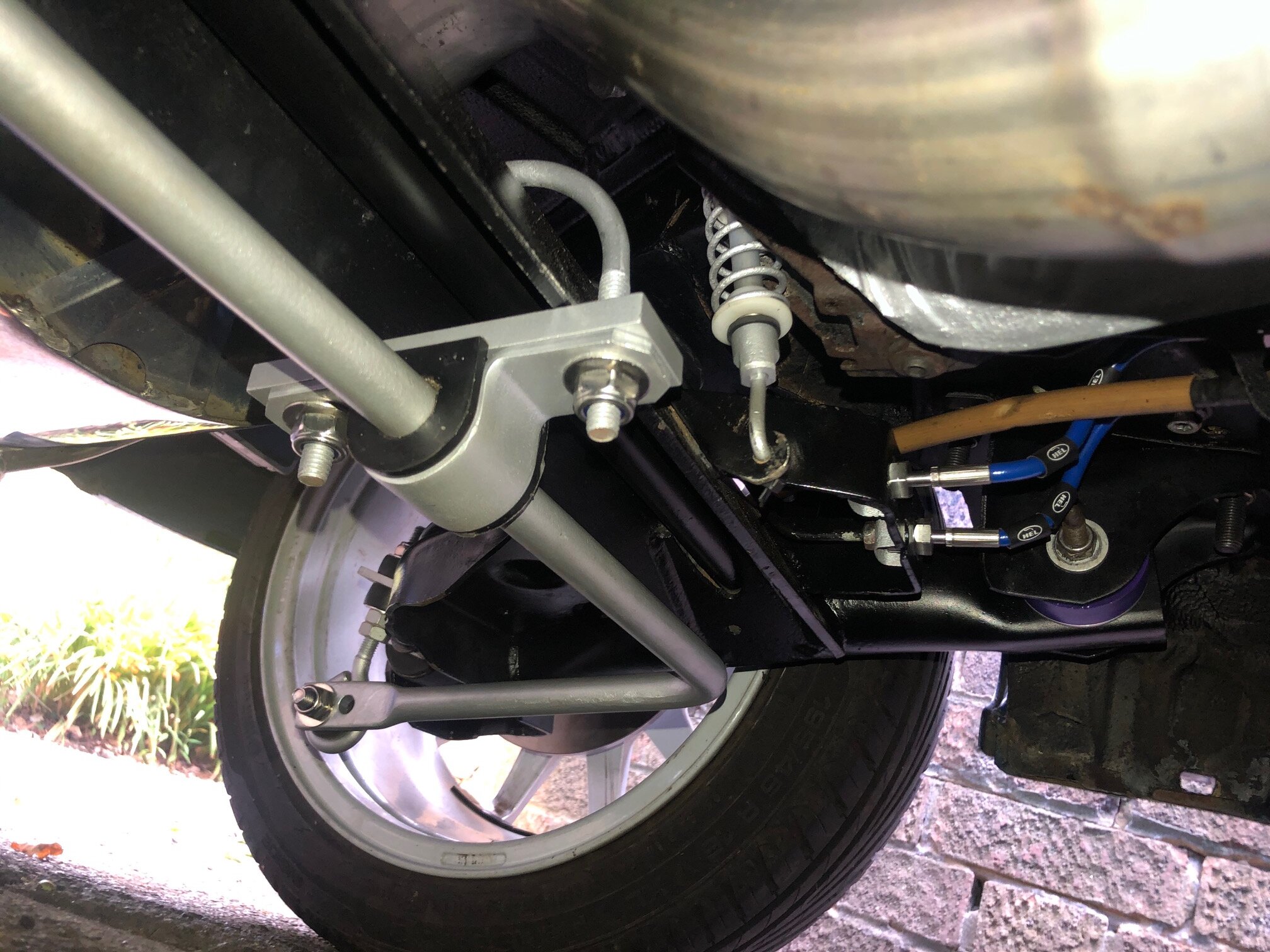

The underside of the car is now done. The second part video won't be quite what I was expecting, as it was challenging enough to do the work, let alone film it all. Below are a few photos. Would take forever to list all of the parts, but everything is pretty much new right up to the new discs and pads. Coolest part is the extra 10mm spacing at the rear from the PMS kit. The front needs an extra 10mm now too!

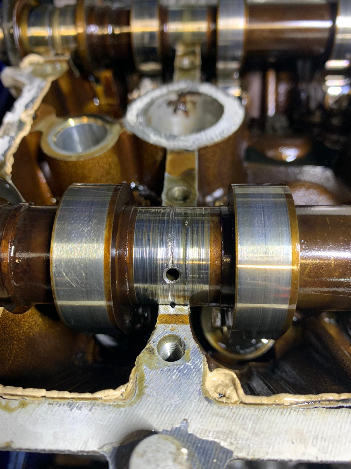

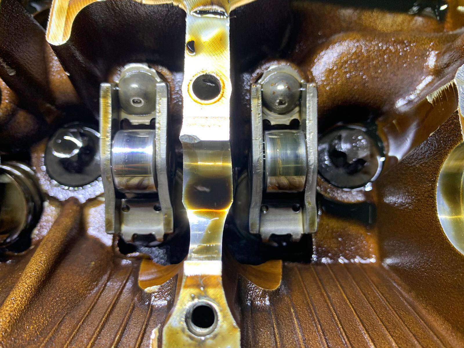

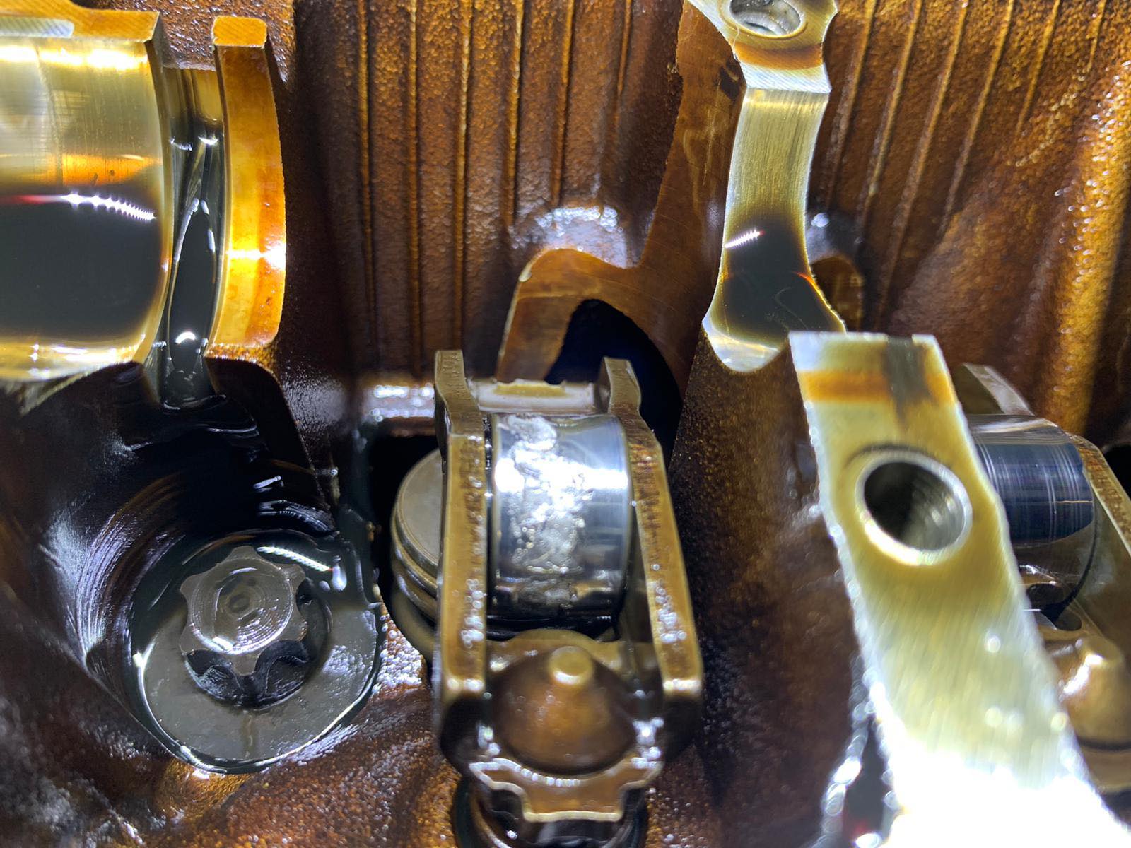

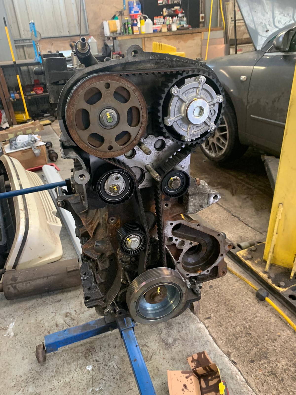

Ok, so, where to start. I have owned this engine since 2016. It's been boosted, made good power, been fairly reliable, but is now toast. You would never have known things were this bad from driving it. New engine inbound!
It started off as an oil leak and ended in cam cover coming off to reveal this :oops:. Interested to hear peoples opinions, but we reckon oil starvation to the head.
npt
  BMW 320d- 172 cup
Blocked strainer maybe, check to see if sump was layered with sealant when fitted last time, people/s**t mechanics love doing this, my mates "rebuilt" cvh engine done by what he thought was a legend failed because of this in less than 100miles 😂
What's the plan, new engine and map tweak?
cjgower
Shocking isn't it. I've owned this engine since 2015, so thought it was solid. You never truly know what you're buying.
Yes exactly that. The plan is to drop the engine in that came with this shell, as well as the turbo kit. I'll then get it booked in again with Engine Dynamics for the map to be adjusted. Fingers crossed it doesn't add up to be ridiculous money!

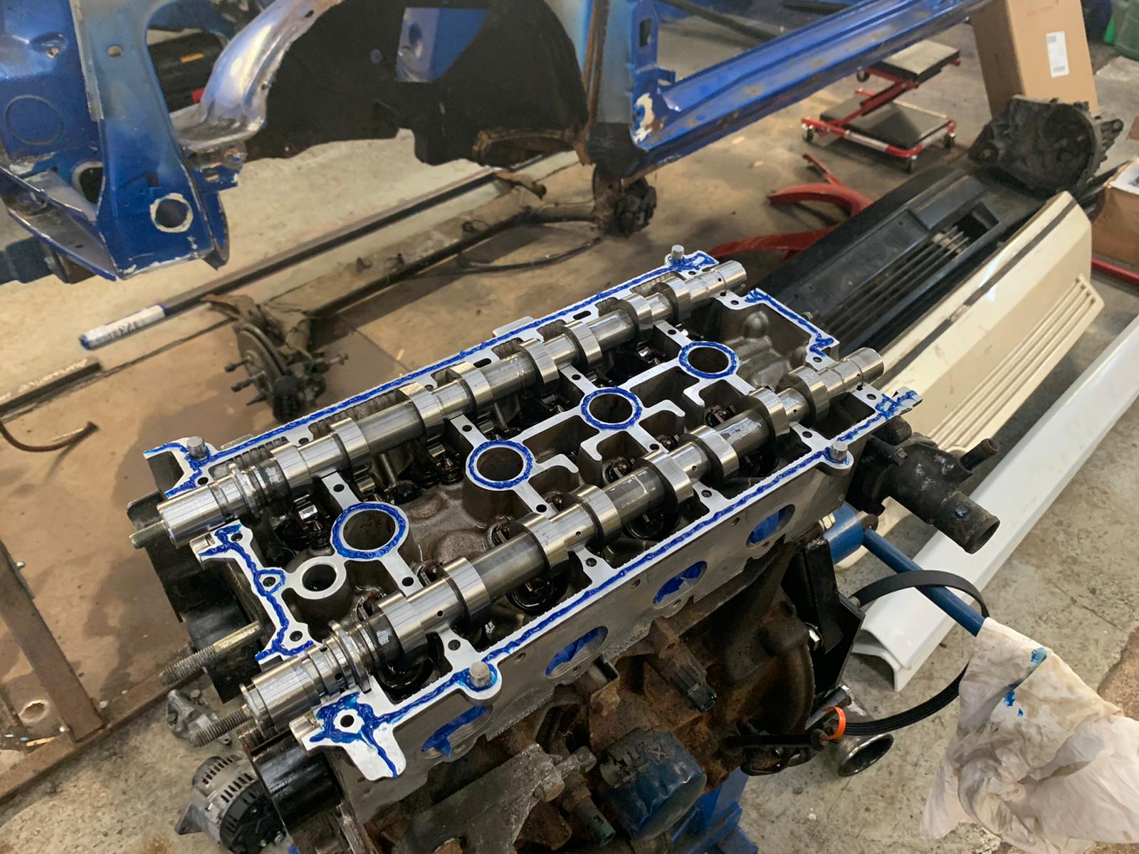

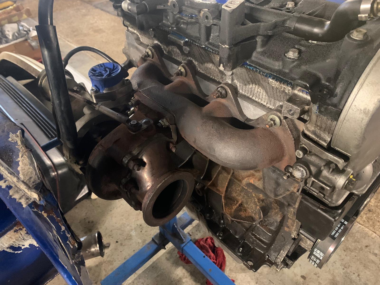

The original engine is now back in.... and the Cup is back! :love:
This time, I left the work to a pro and although the total cost was eyewatering it means I now have a car that should be a little kinder to me in the long run. Booked in for map adjustment in March with Engine Dynamics.
New parts fitted:
  • Genuine Renault breather inlet seal
  • Genuine Renault lower Inlet manifold gasket
  • Genuine Renault upper inlet manifold gasket
  • Genuine Renault cam cover tune of sealer
  • Genuine Renault lower bottom pulley
  • Genuine Renault vvt solenoid seal
  • Genuine Renault lower front cam belt end crank seal
  • Genuine Renault timing blank
  • Genuine Renault cam seal and hardware fitting kit
  • Genuine Renault exhaust manifold gasket
  • Genuine Renault cam belt kit
  • Genuine Renault type d coolant 5 litres
  • Total quartz 10w50 6 litres
  • Genuine Renault engine oil filter
  • Genuine renault sump gasket
  • Genuine Renault elf 75/80 gear oil 3 litres
  • Genuine Renault thermostat housing gasket
  • Genuine Renault water pump
  • Genuine Renault flywheel bolts x7
  • Genuine Renault sump washer
  • Genuine Renault down pipe flexi fitting kit
  • NGk Spark plugs bcr8es x4
  • X4 cosworth m8 studs with aeromotive lock nuts
  • X2 t25 manifold lock tabs
  • Aux drive belt
  • Used 172 cams supplied by KTEC
