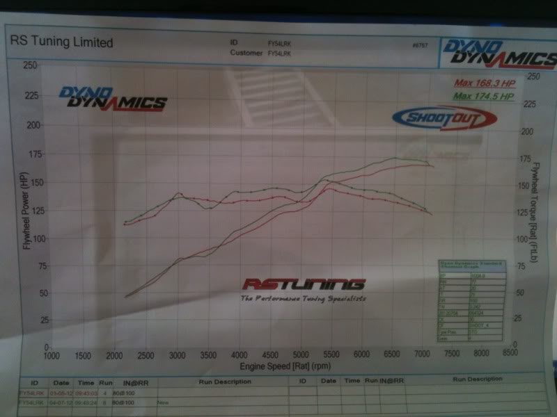

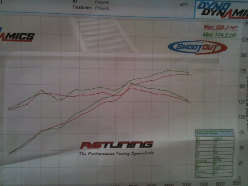

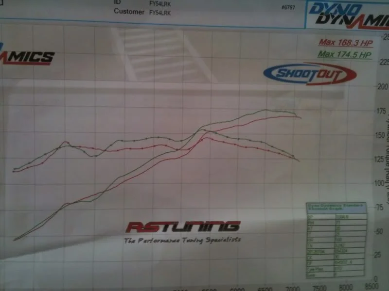

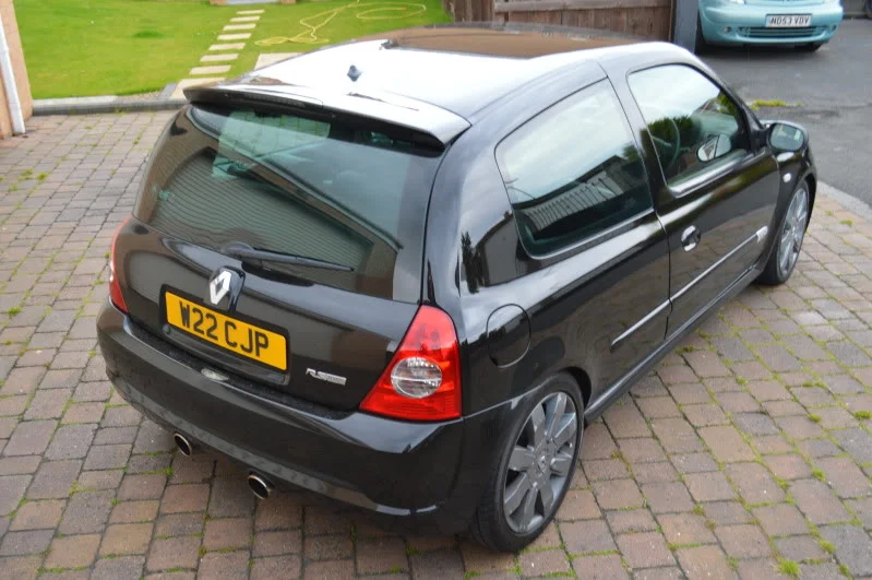

Well this thread needs updating with some propper pictures of the car last weekend.
Had a problem with the car on the same journey as the video was taken that I posted before, a random misfire was occuring, so I thought it best to get the car strapped down to a set of rollers and do some running on them whilst looking at the live data for the ECU. There was only one man I trusted for this so Wednesday saw me and my bro travel down to paul@RS tuning in Leeds. Paul also agreed he'd do some power runs of the car to see if any improvements had been made since the last time I was there.
2 fault codes appeared, one for the post cat lambda (de-cat) and the other was the TDC sensor. So I'll be ordering one of those in the next few days and get it back to full health.

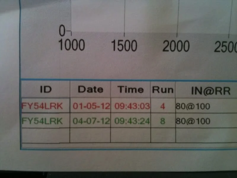

Here are the RR results:
Quite spooky the times it made its best power Red - previous occasion Green - Most Recent run
As you can see by this power run the car had been ran a few times to check for the faults so maybe heat could've been a factor in the peak figure.
Anyway, mods since the last time are:
ITG Maxogen
De-cat
Yozzasport Cat back system.
Figures were 174.5bhp at the flywheel with 153lb.ft torque. Not bad for a standard mapped car, Improving around 10bhp and 10lb.ft in the mid range with the current mods
Paul is quite confident the car will be good for 180bhp with one of his remaps however I think I'll opt for a set of Catcam 438's to really optimise the mapping work, Paul says the mid-range will be significantly improved as you can see at 3-3500 rpm it has a big dip in power and torque.
I'm still convinced the timing isnt 100% so I'll be dropping in to Fred@btm to get that checked out at some point when I'm passing.
Thanks for looking

looks like the maxogen etc paid off.. although like you said 2 me the original exhaust would of been strangling it..
  182
Looking really tidy Chris! Nice power gain since the last dyno run, I didn't think the exhaust and air filter would of made that much difference!

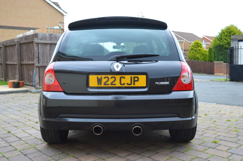

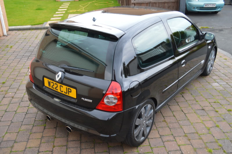

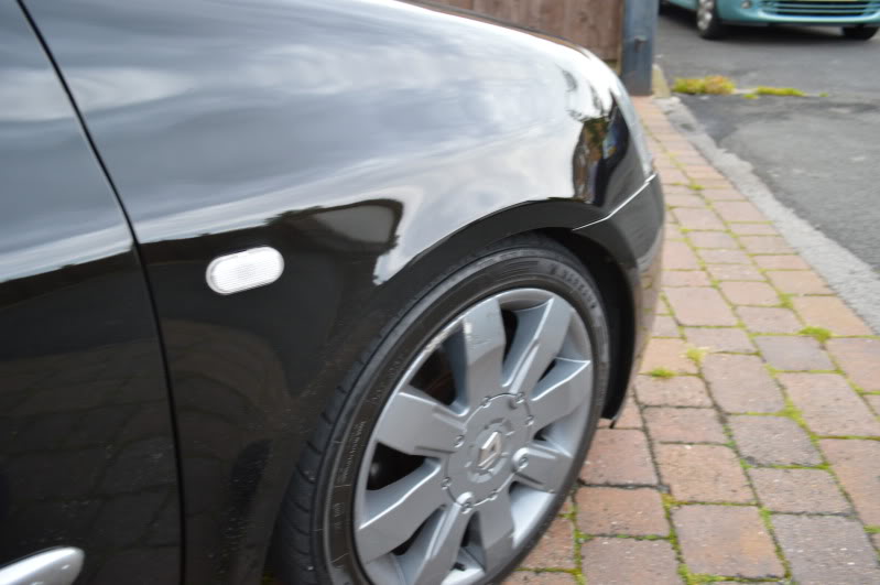

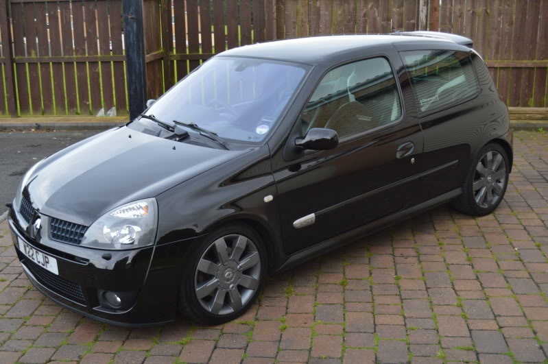

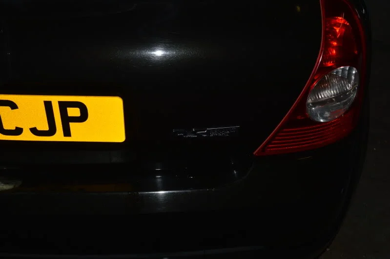

Got my private plate transferred from my silver cup so glad its tidied up now.
Just got this one from bonxy from a meet tonight, spent the weekend doing some paint correction on the car as it was disgraceful
Will do a full write up soon with some more detailed pics
Ged
  PD130 Peach
looked shiny when i saw it tonight, so much so someone i was with said, why did the door look a different colour when it went past.... It was the sparkle of gold as it went into the sunlight...
Looks at a nice height aswell.
New it was you straight off with the trophy spoiler ;)

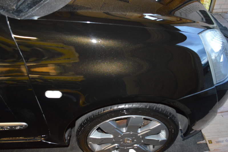

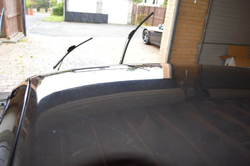

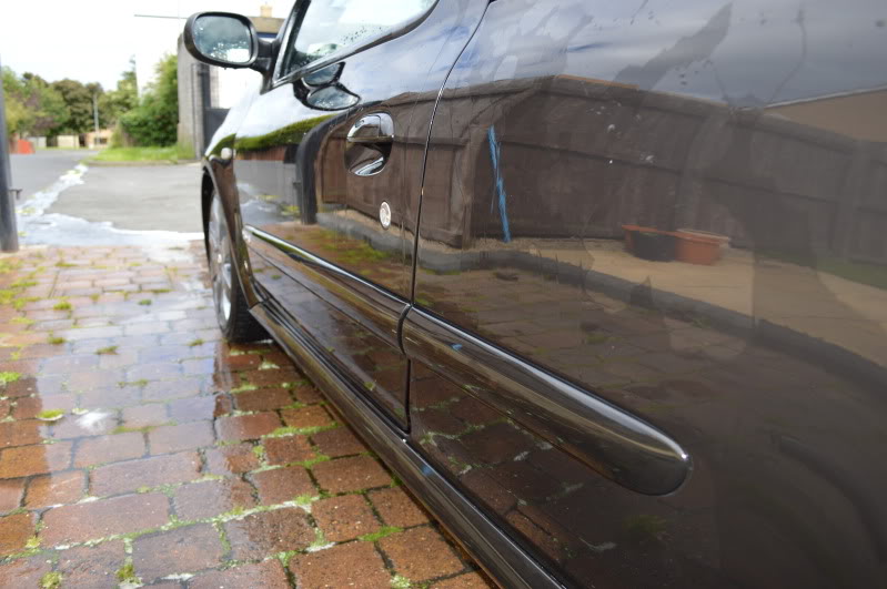

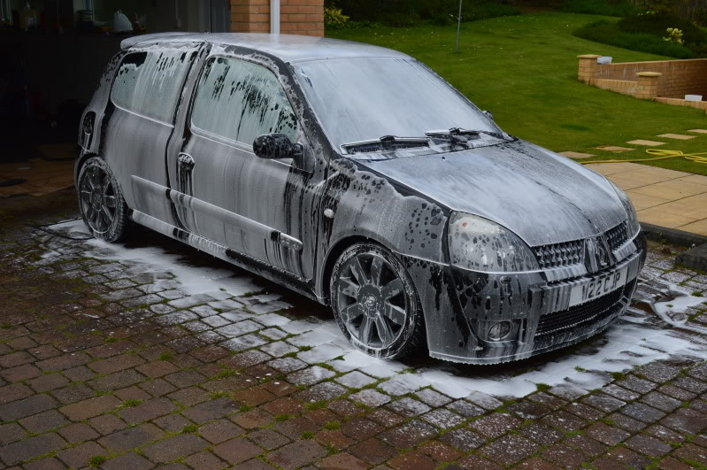

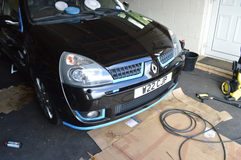

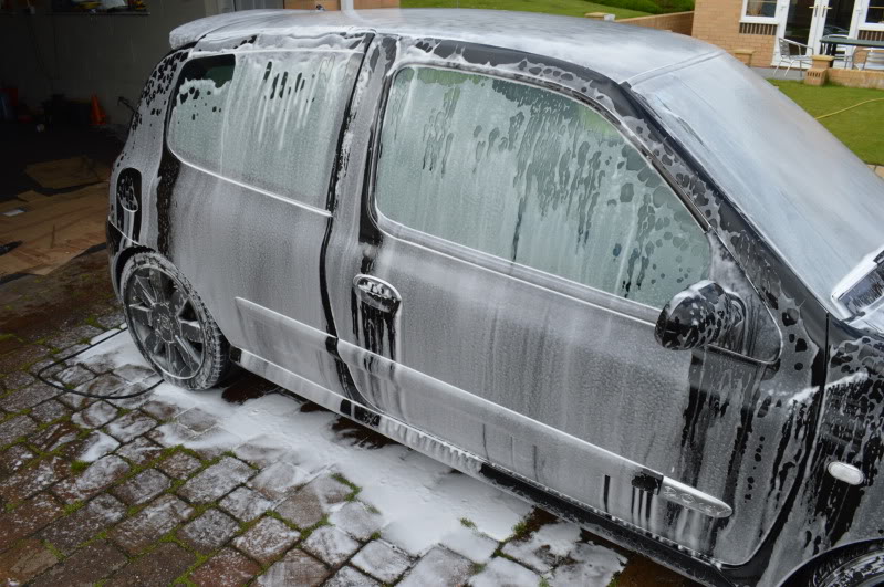

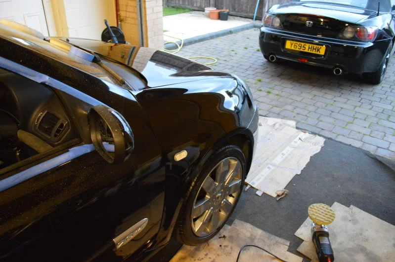

So then as mentioned above, I spent some time (15 hours) a couple of weekends back getting the paint on the BG somewhere near where i want it.
Process was:

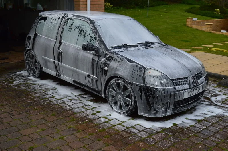

Rinse the car
Snow foam
clean shuts, window seals etc with APC whilst the foam was dwelling
Rinse Foam
Washed using zymol auto bathe
Iron X'd lower halfs, tailgate and wheels
Rinsed
Clayed
Washed again
Taken inside to get a feel for what I was in for.
I used a Yellow 3m Pad with a test session for some chemical guys & poor boys products. However they both turned out to be crap, so used some remains of menzerna I had lying around to finish the car off.
I did a final finish with menzerna via a blue 3m pad.
Once the polishing was done it was dusted down and given a coat of dodo juice blue velvet wax. I couldnt find my zymol so had to make do with that for now.

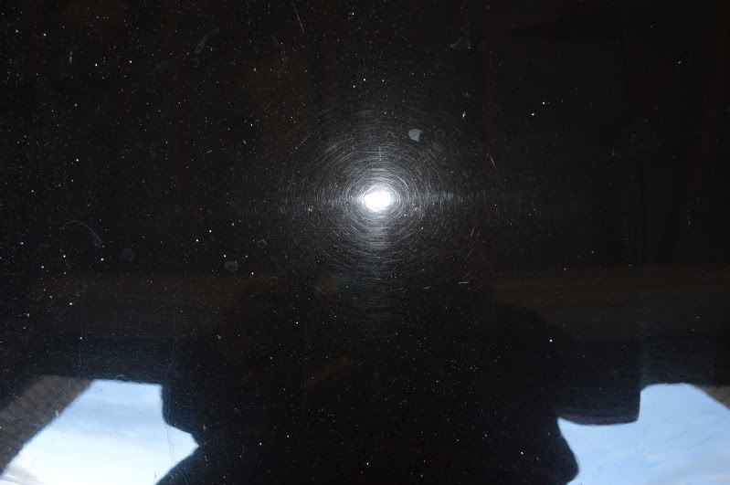

Heres some pics anyhow, check out those swirls :eek:

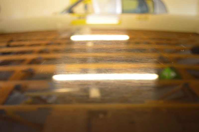

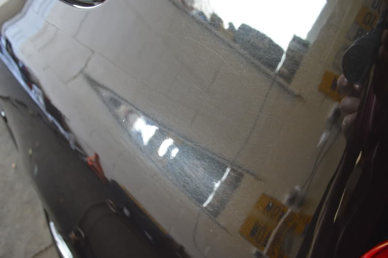

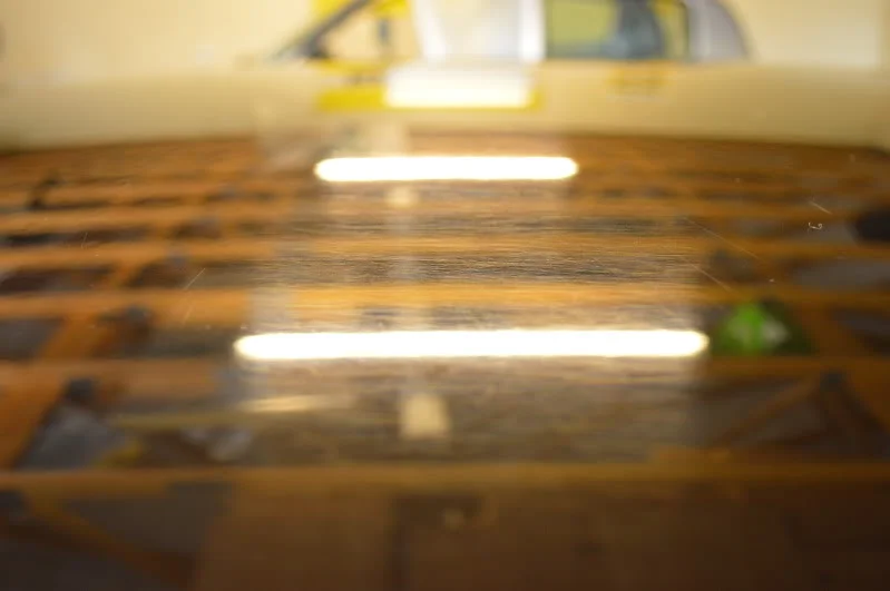

This is what I'm dealing with:
The drivers rear quarter has some rather dodgy sanding marks in, must of had some paint in the past
This is the roof, automatic car wash anyone? :banghead:
Tailgate, not too bad

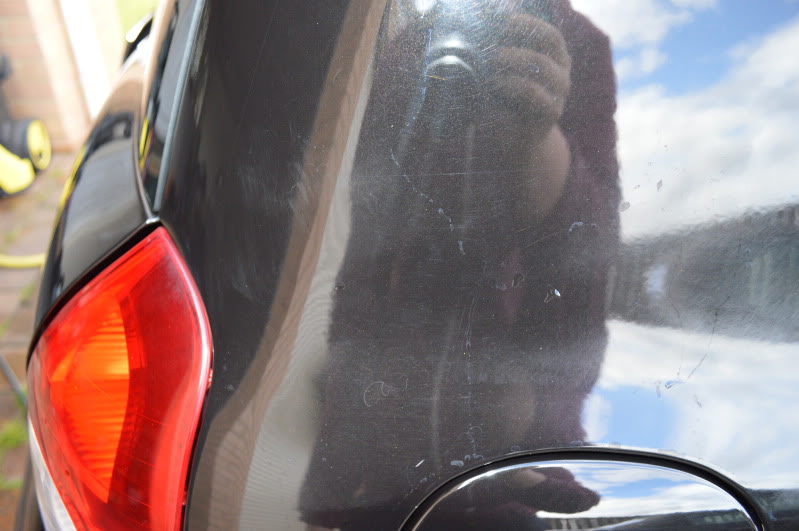

Passenger rear quarter

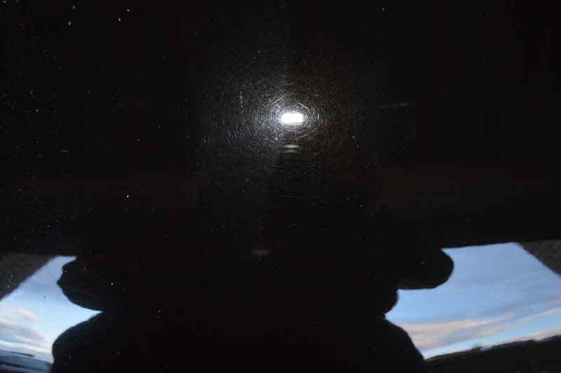

Bonnet

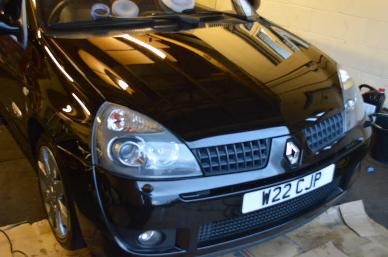

After 1 pass on the bonnet
Some other randoms showing the level of correction I got, I'd say probably around 70% Correction compared with what I started with, unfortunately I had to have the car out by 7.00pm on the sunday, so I think another full weekend on the paintwork should sort it out and I reckon I can get between 90-95% correction on the panels.

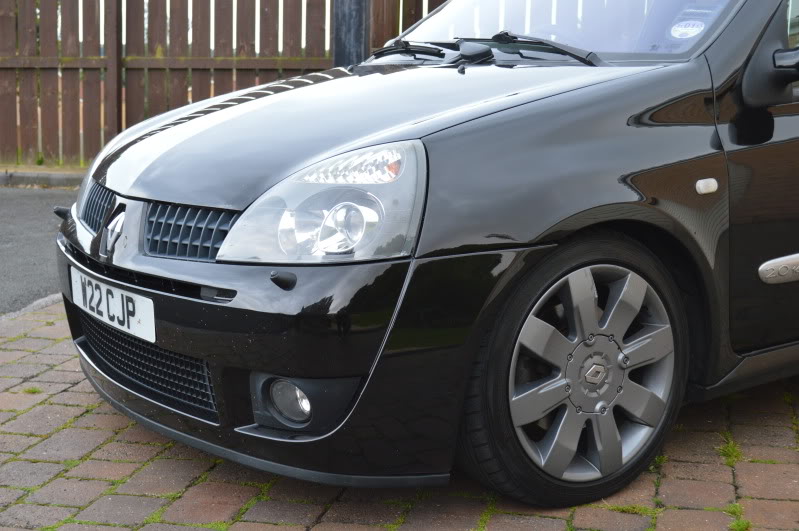

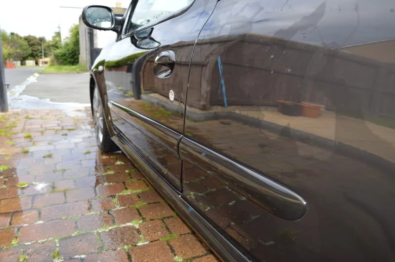

So this was a few days later, I ran out of time to get pics on the sunday, so these were around 4 days later with a bit of fly killing action on the front end

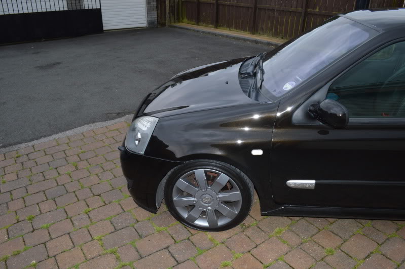

So thats it, oh forgot to mention got my private plate from the silver cup onto it now too :) looks soo much better.

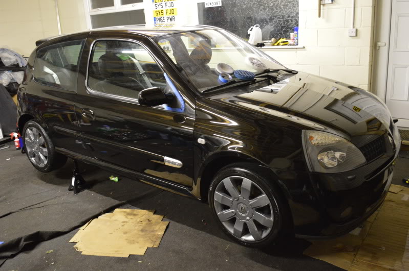

An update on the cars present state:
On axle stands as I await a refund on my suspension, whether there was a problem with the rear end of the spax I'm yet to find out but I just couldnt get them to perform as I would expect a normal coilover to perform, they were too stiff/bouncy no matter what height I had them set at :(. Hopefully Dan@519automotive can get that done swiftly enough.
I'm probably looking to go full trophy suspension set up on it, or H&R's however the set I've planned on getting aint going to be possible to get for the next 6-7 weeks which would leave me up the creak without the car.

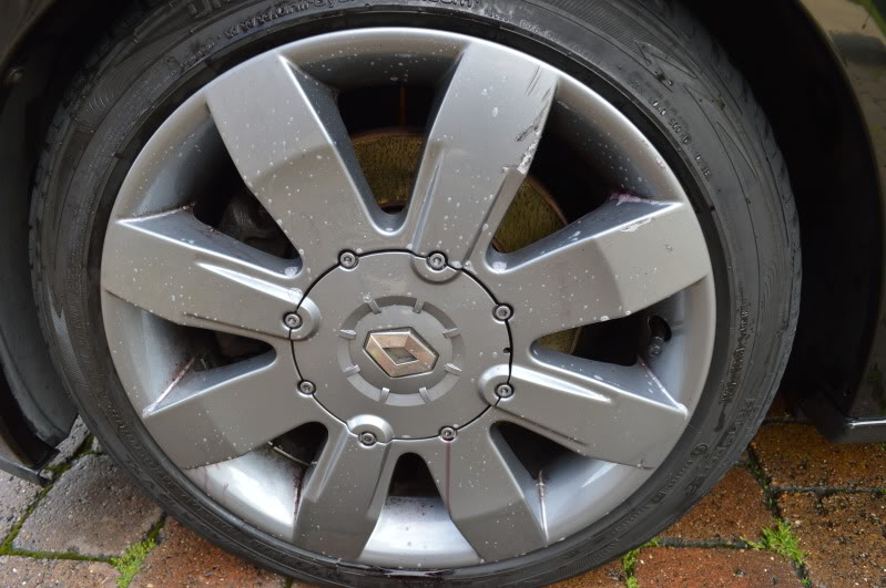

Whilst it's on axle stands I'm cleaning the arches out and going to give the insides of the wheels a good clean as they're minging after 8 years of road crap on them
Thanks for looking
