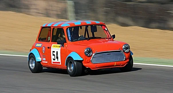

Something a bit different - this is my 1380 mini racer, out in the Classic Thunder saloons championship this year.
It started life as a minicross racer but one test session and many tales of rolled cars later we decided to go sprinting instead. A couple of seasons after that it was time to go racing.
It has a carbon kevlar front end and now weighs a whisker under 600kg, runs on Dunlop mini miglia slicks and has KAD 4 pots up front (the rear brakes are standard callipers as they don't do anything). The 1380 engine revs to well over 8k and produces ~140bhp. This is put through a Swiftune dog box and TransX LSD.
Last year I was running low 55's around Brands Hatch Indy, this year with the addition of electronic ignition it would be good to break into the 54's.
And here it is chasing Cossies at Pembrey:

That is awesome, got a real soft spot for mini racers, you not considered the KAD twin cam head??
Not seriously, it would move us up a class in most of the series we've competed in, cost a small fortune (£10k for an engine iirc) and probably overheat the front tyres over the course of a race anyway. You could switch to 13" wheels as the more powerful cars do which would allow us to run more rubber but affects the handling and it doesn't appeal to the purist in me - they should run A series and 10" wheels imho.
150bhp seems to be about the sweet spot, it's the cars lousy aerodynamics and lack of fifth gear that kill it at higher speeds (currently tops out at 115mph) so you probably wouldn't be gaining that much ultimate pace anyway.

Can't remember but they built a pair of them with the same livery so our sister car might still be out pounding round the rallycross circuit somewhere. To be honest, apart from the shell and rubbish bolt in cage, there's nothing left of the original car, the next big upgrade we could make would be a new shell with proper miglia spec cage.

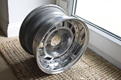

The wheels are two piece based on Mini Special wheels. You can pick them up off eBay for not a lot of money and then the rim machined off and a seperate spun rim fitted. A lot cheaper than MB's which is what a lot of the Miglia racers use.
Before:
http://allanbudge.co.uk/carpics/refurbed.JPG
After:
And the Force Racing website where you could spend a fortune on titanium bits and bobs:
http://www.force-racing.co.uk/
One tip I'd give for sprinting/hillclimbing, where you need the softest possible tyres, is get hold of some uncut Dunlop Miglia wet tyres (i.e. the tyre before they cut the tread so still slicks). The wets are the softest compound so warm up the quickest and give the best grip over short runs.
