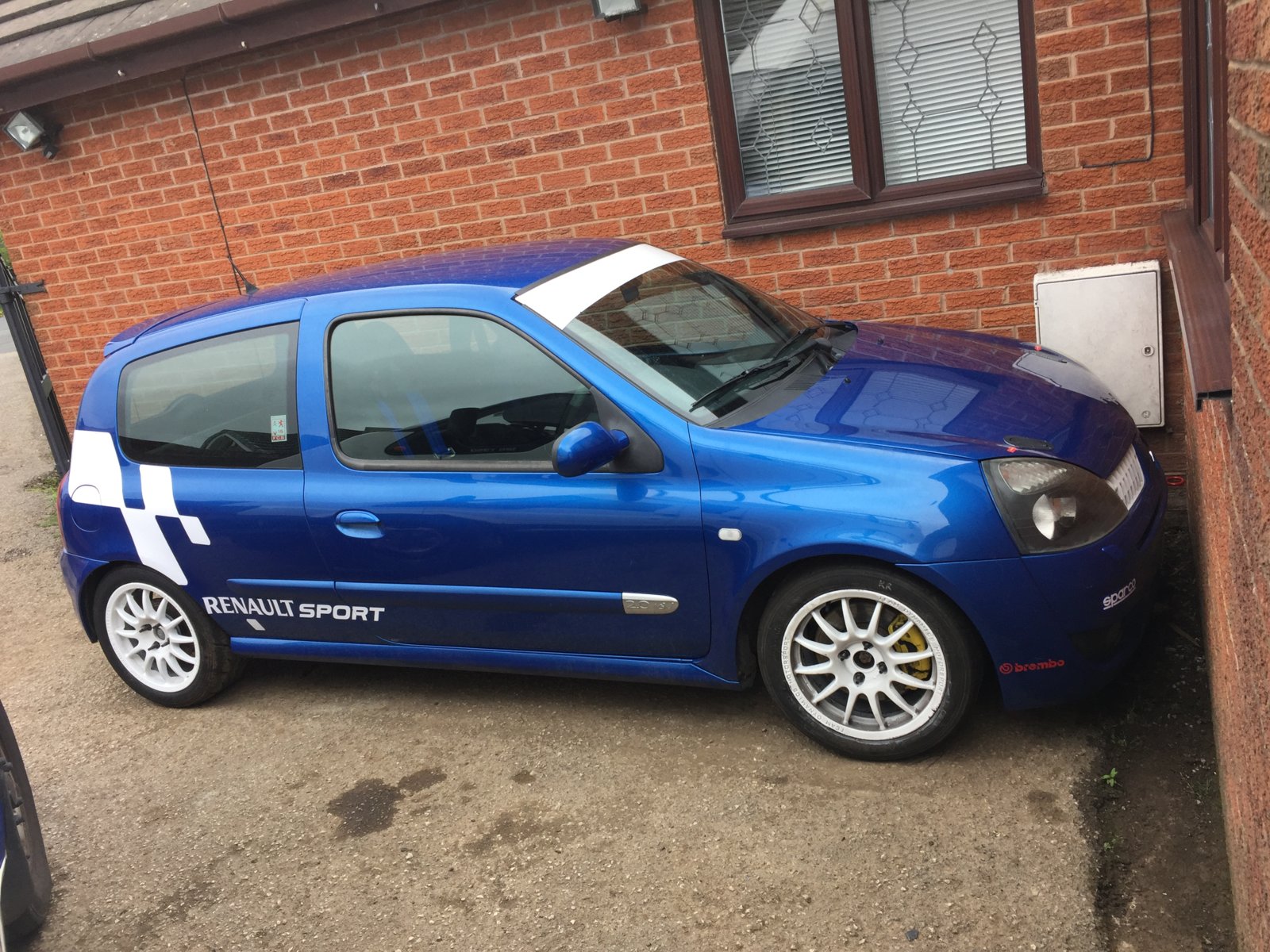

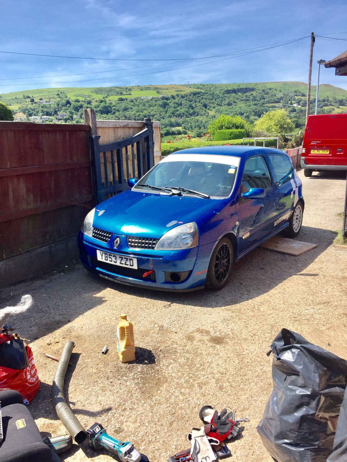

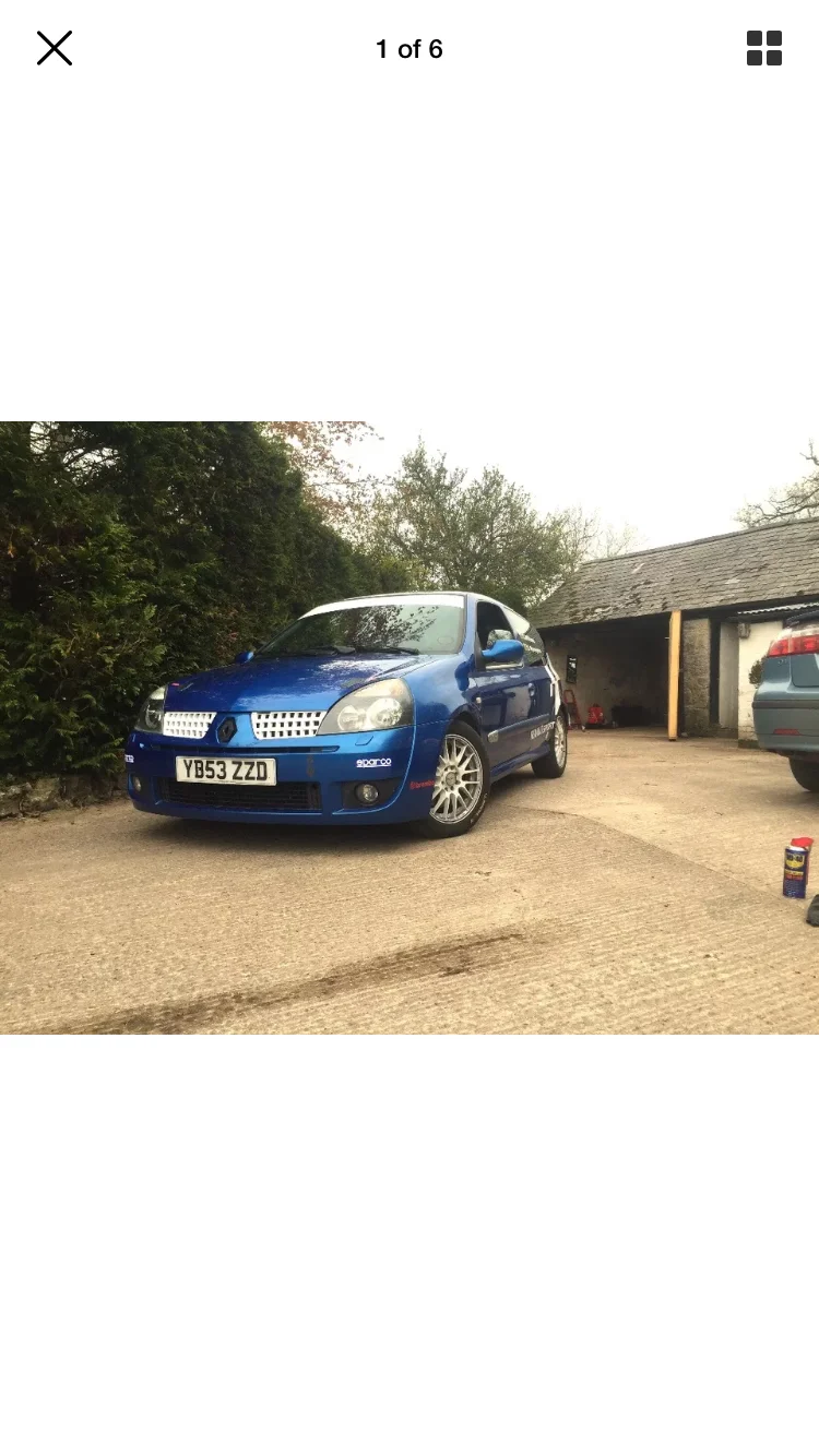

] A few months back now I bought a msa logbooked clio rolling shell.
The plan was to buy a donar car for the engine and brakes and make one car out of the two.
I ended up buying this 172 cup off eBay, it had bucket seats, coilovers and sabelt wheel.
But I got offered to much profit on the rolling shell and it was sold with in a week of owning it.

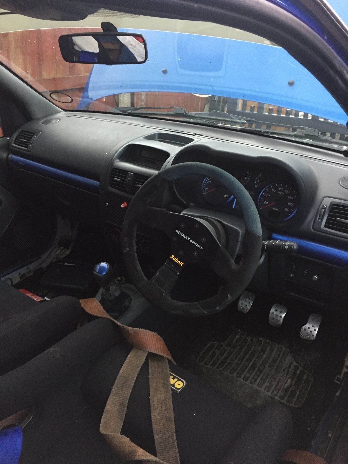

First up was to get the belts done, new battery and new alternator.

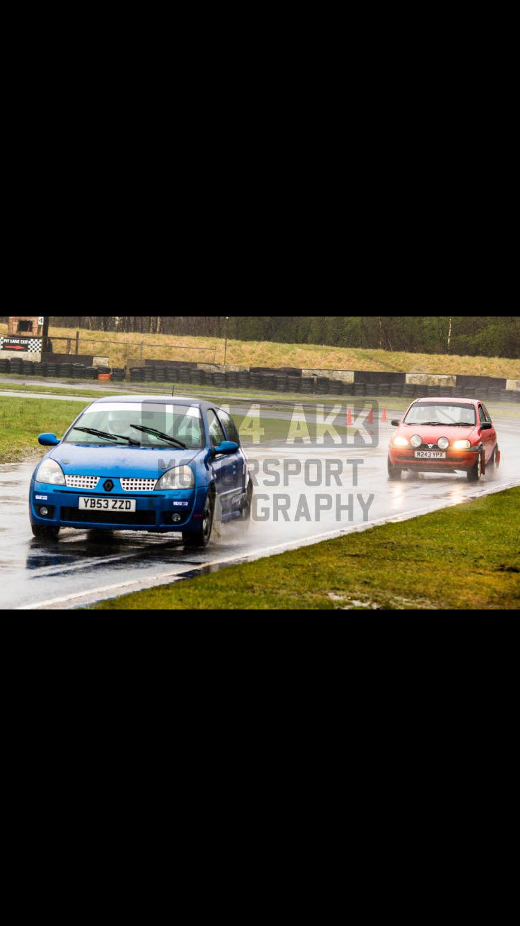

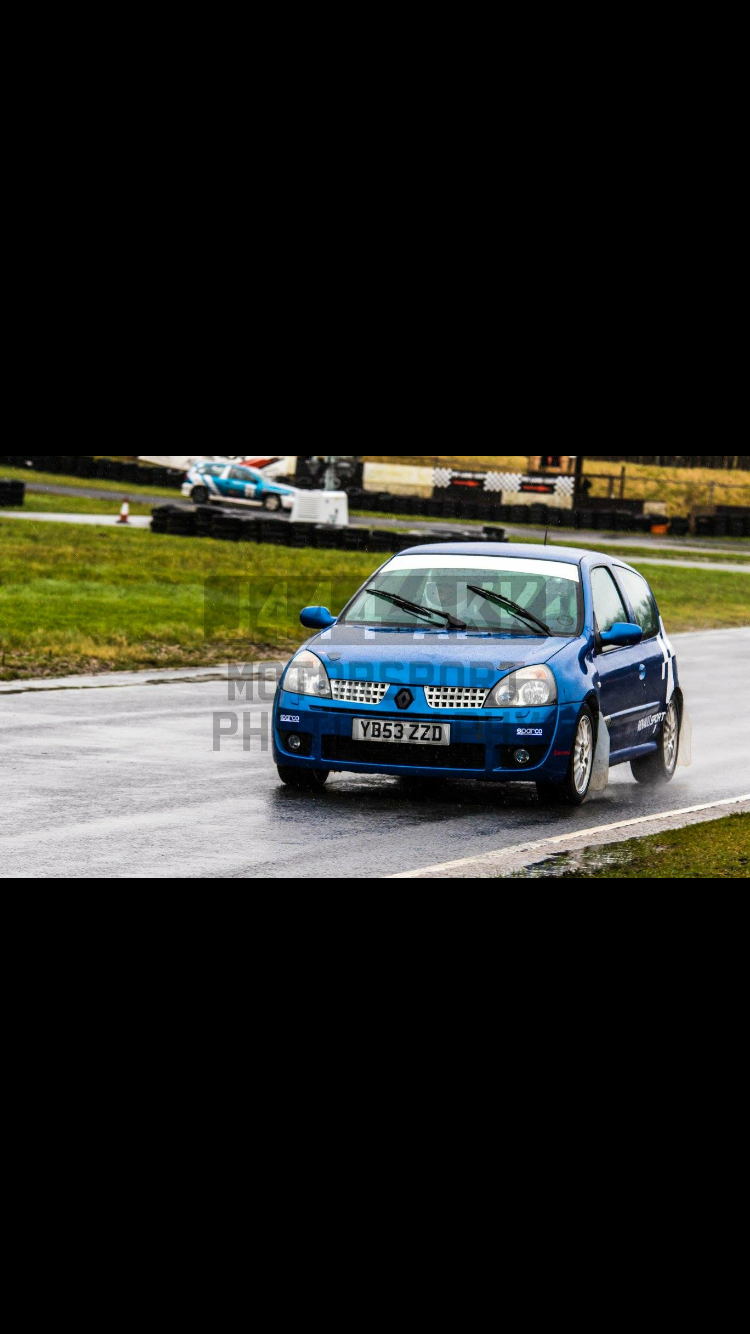

Then took it to three sisters in Wigan in the rain.
Found out a few things. One being the vmaxx coilovers are shocking

Since that first outing. The car had new gaz golds all round with ktec solid engine and gearbox mounts, 6 pro race 1.2s with a048 tyres on. The difference was amazing

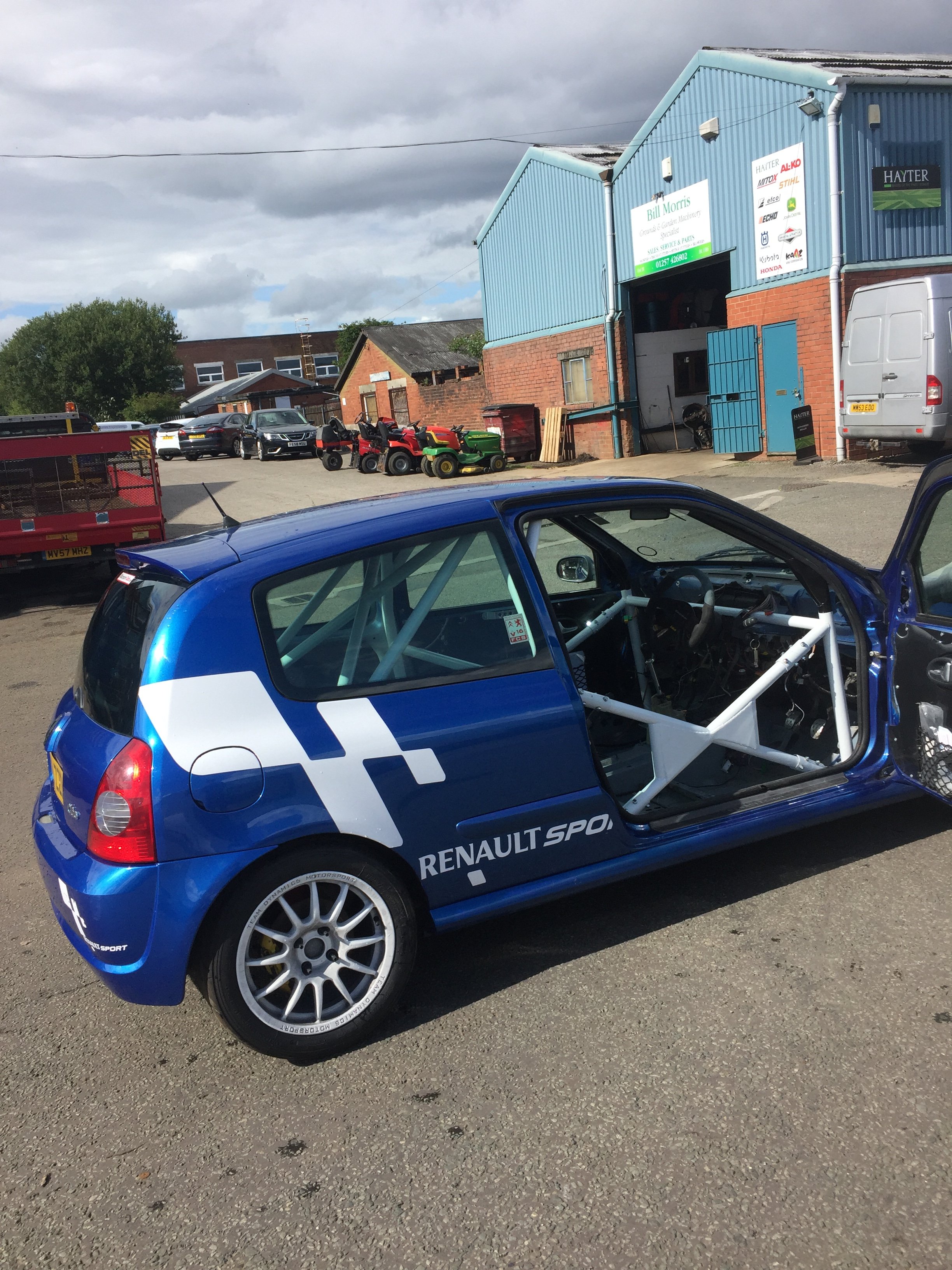

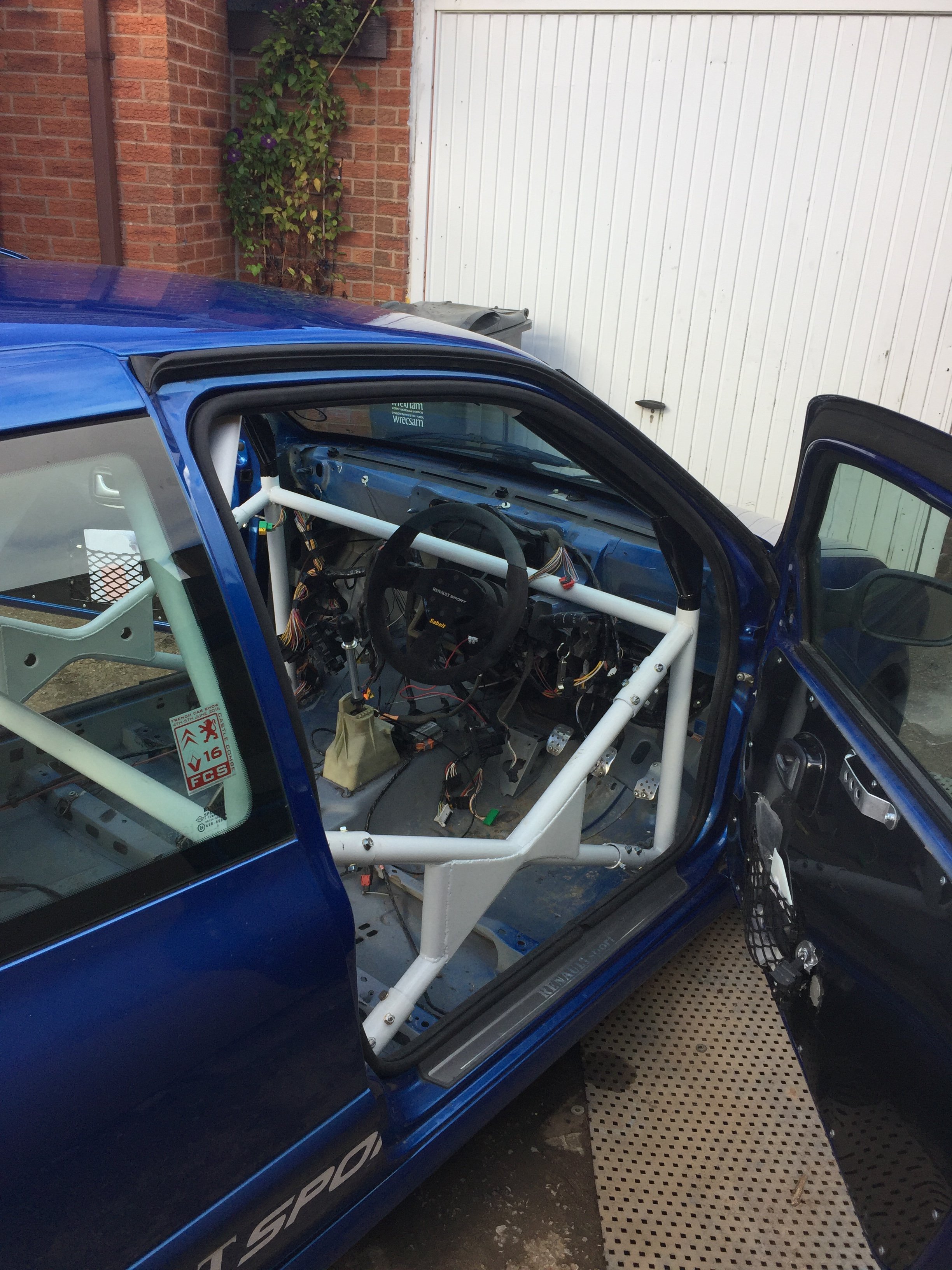

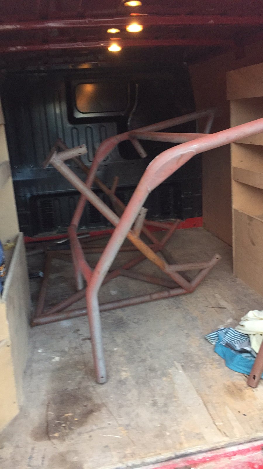

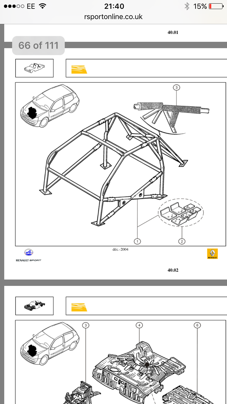

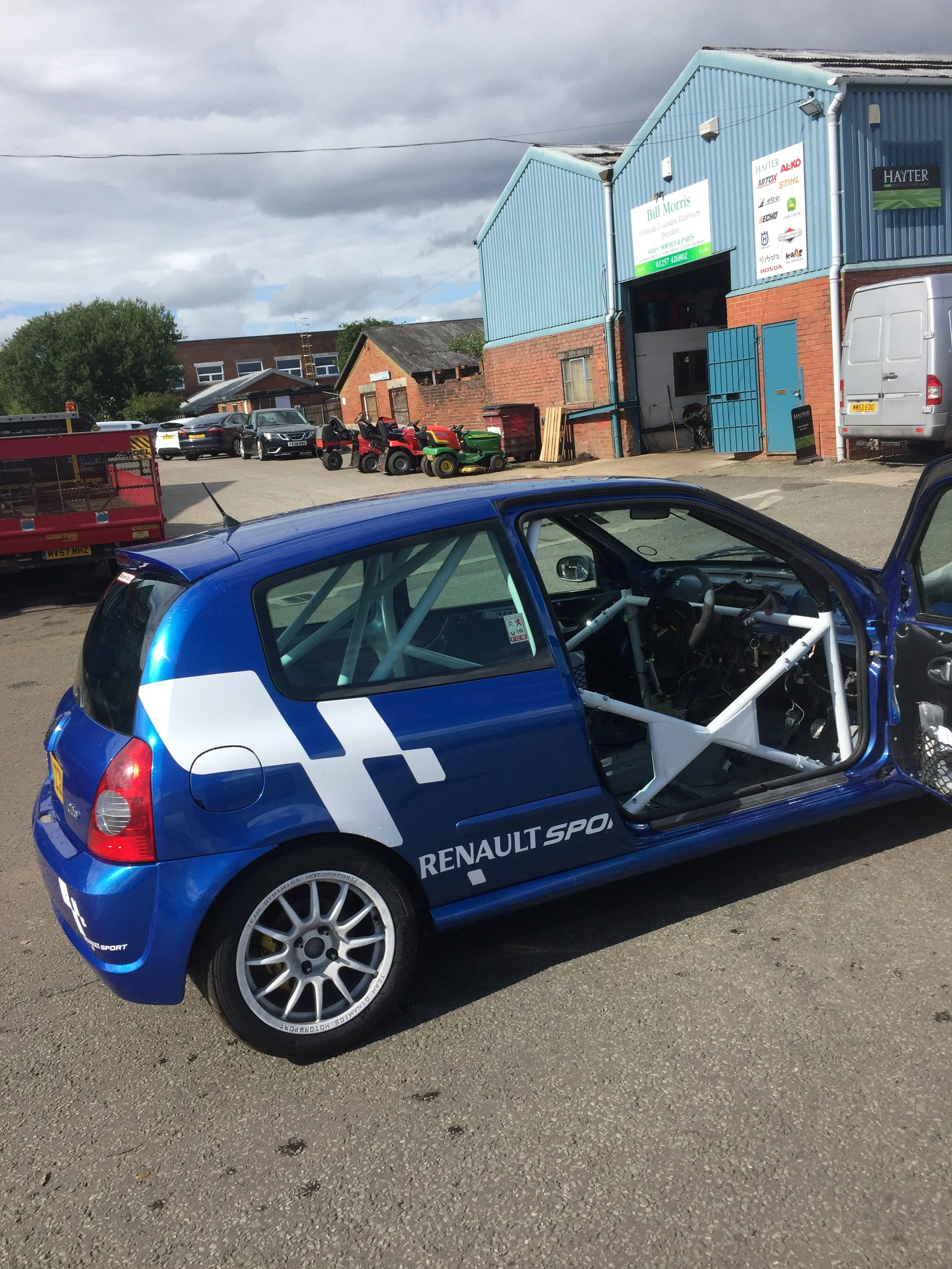

Manged to get an ex clio cup racer cage. I'm going to be adding an X door bar to the drivers side to match.

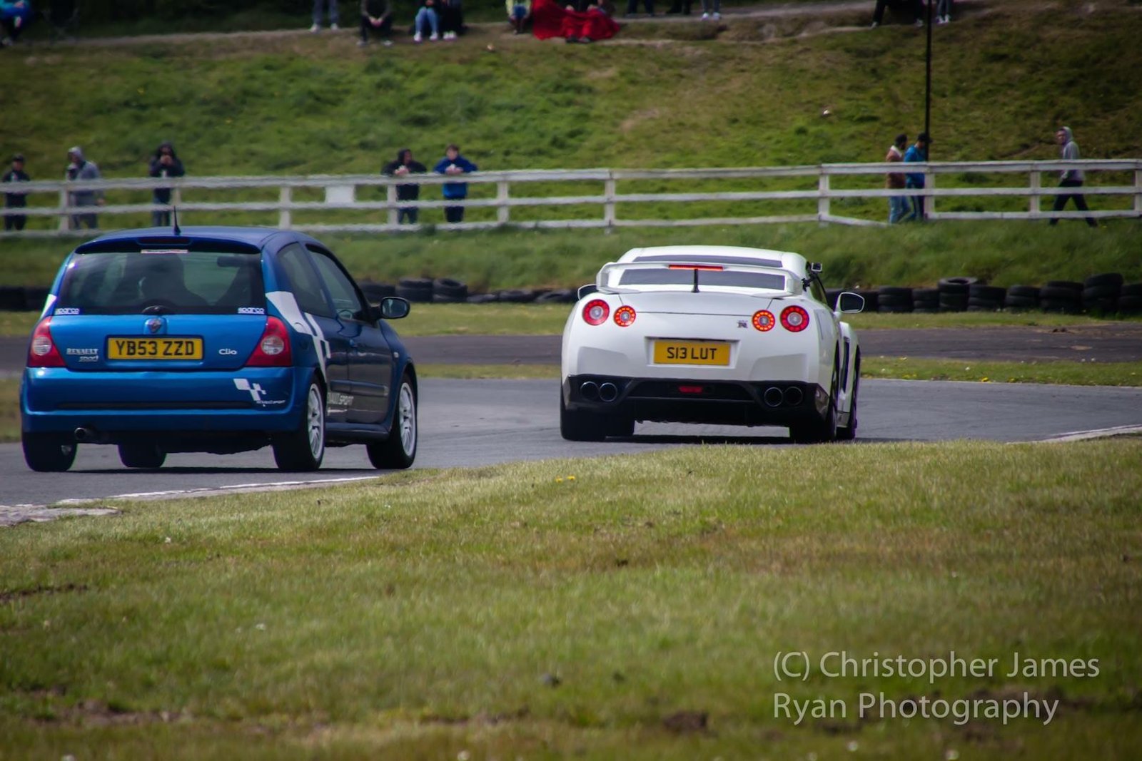

I'm new to the track, why did you spin right there? I was expecting it at a tight corner.
Car sounds great BTW.
Thank you. And it was a number of things, I let off just going over the brow, and I put the right front wheel on the grass. My mate races in the Porsche Carreras cup and he did the exact same spin.
After that spin I came in and found the power steering sensor leaking fluid. So that might of had something to do with it too

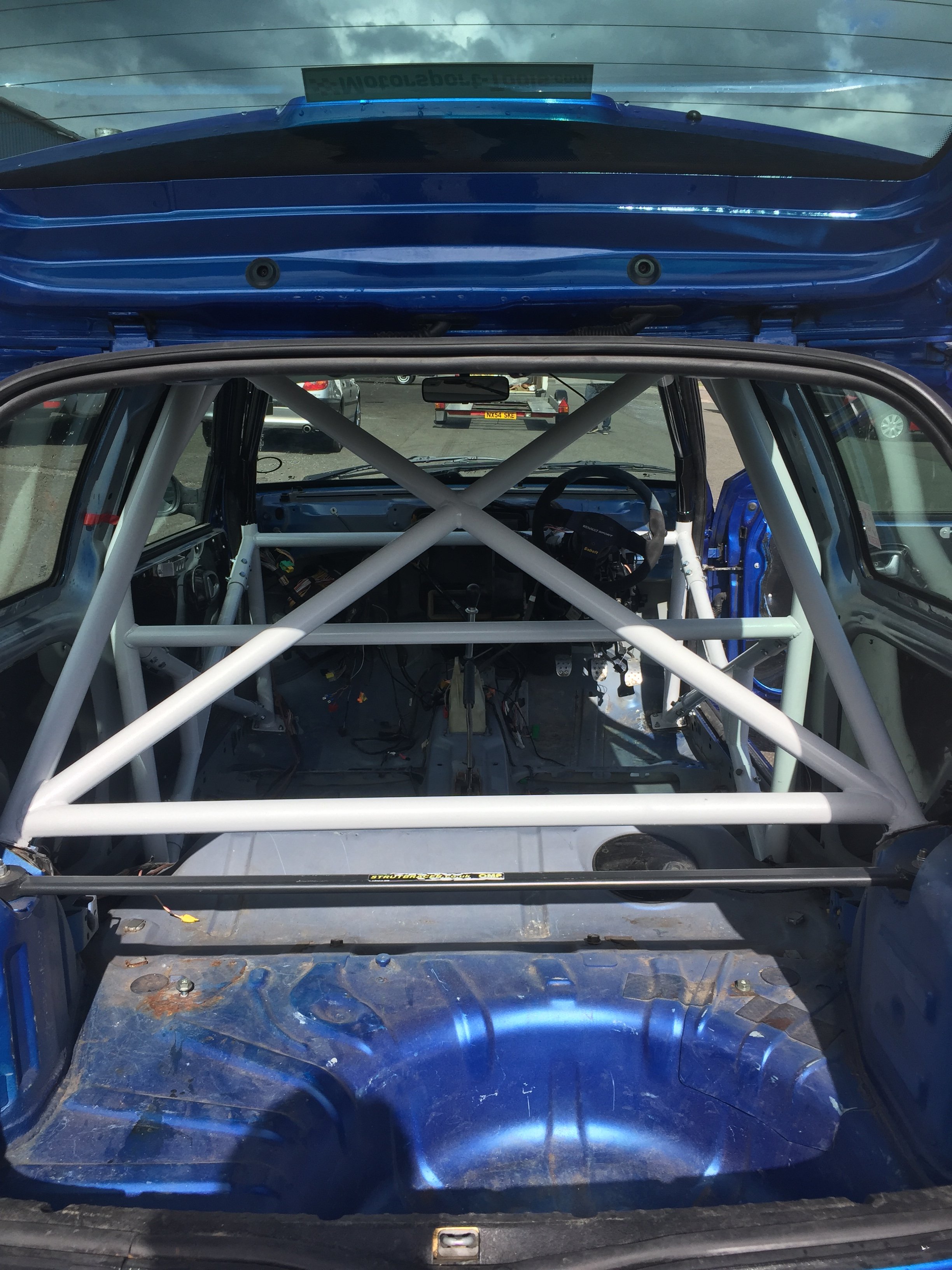

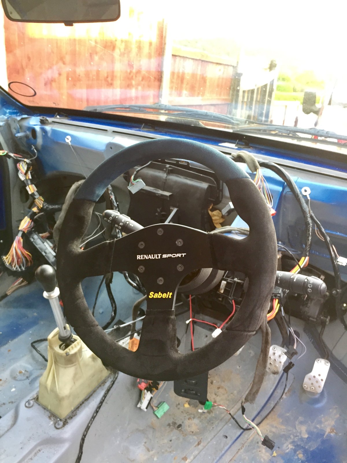

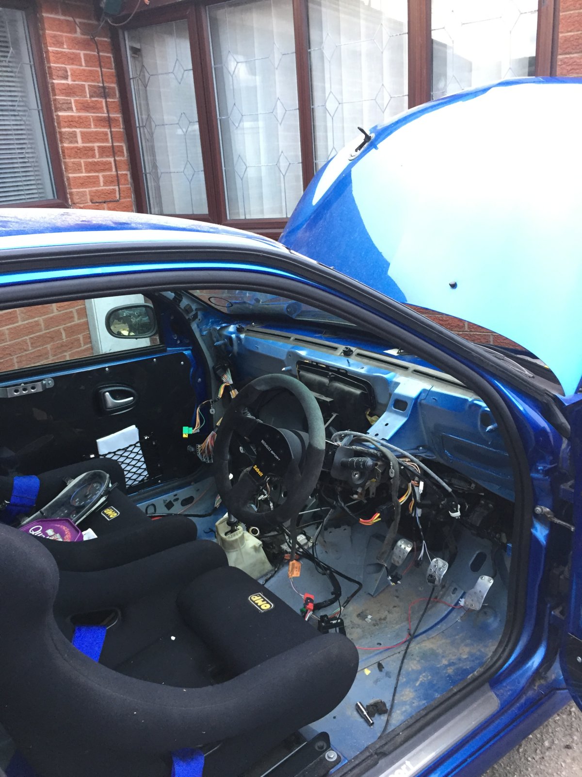

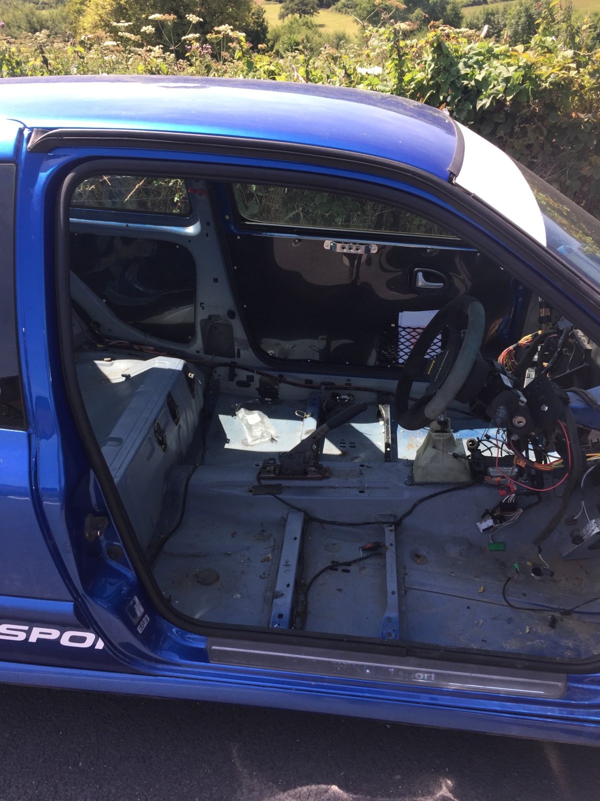

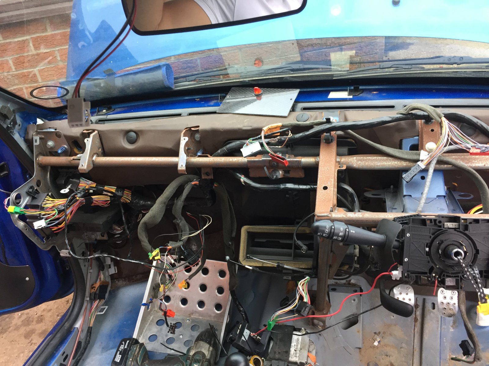

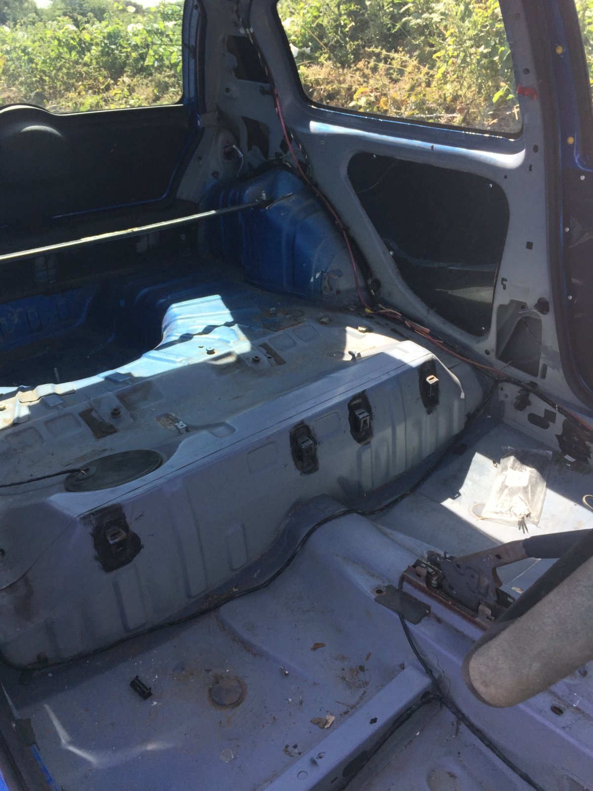

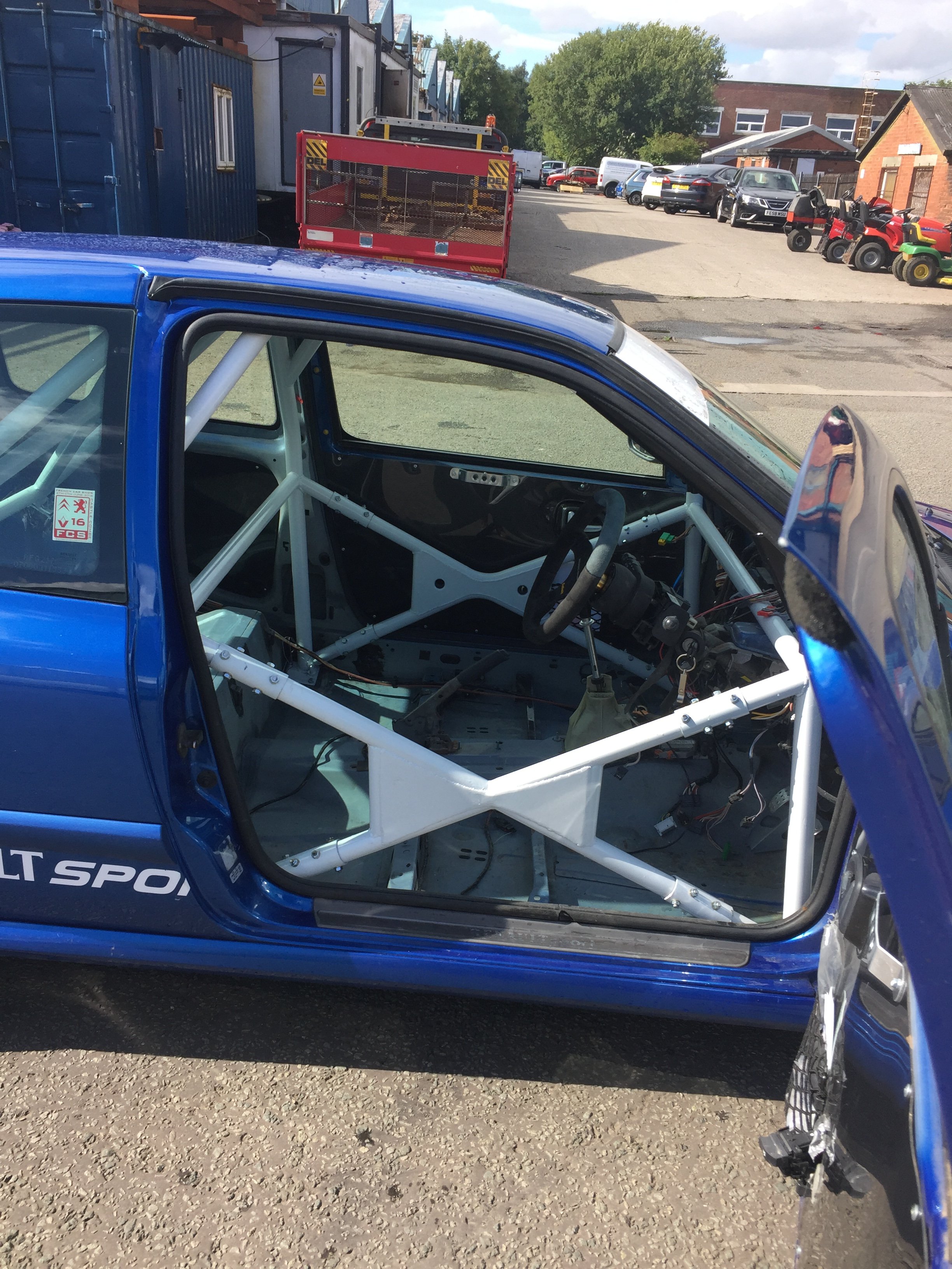

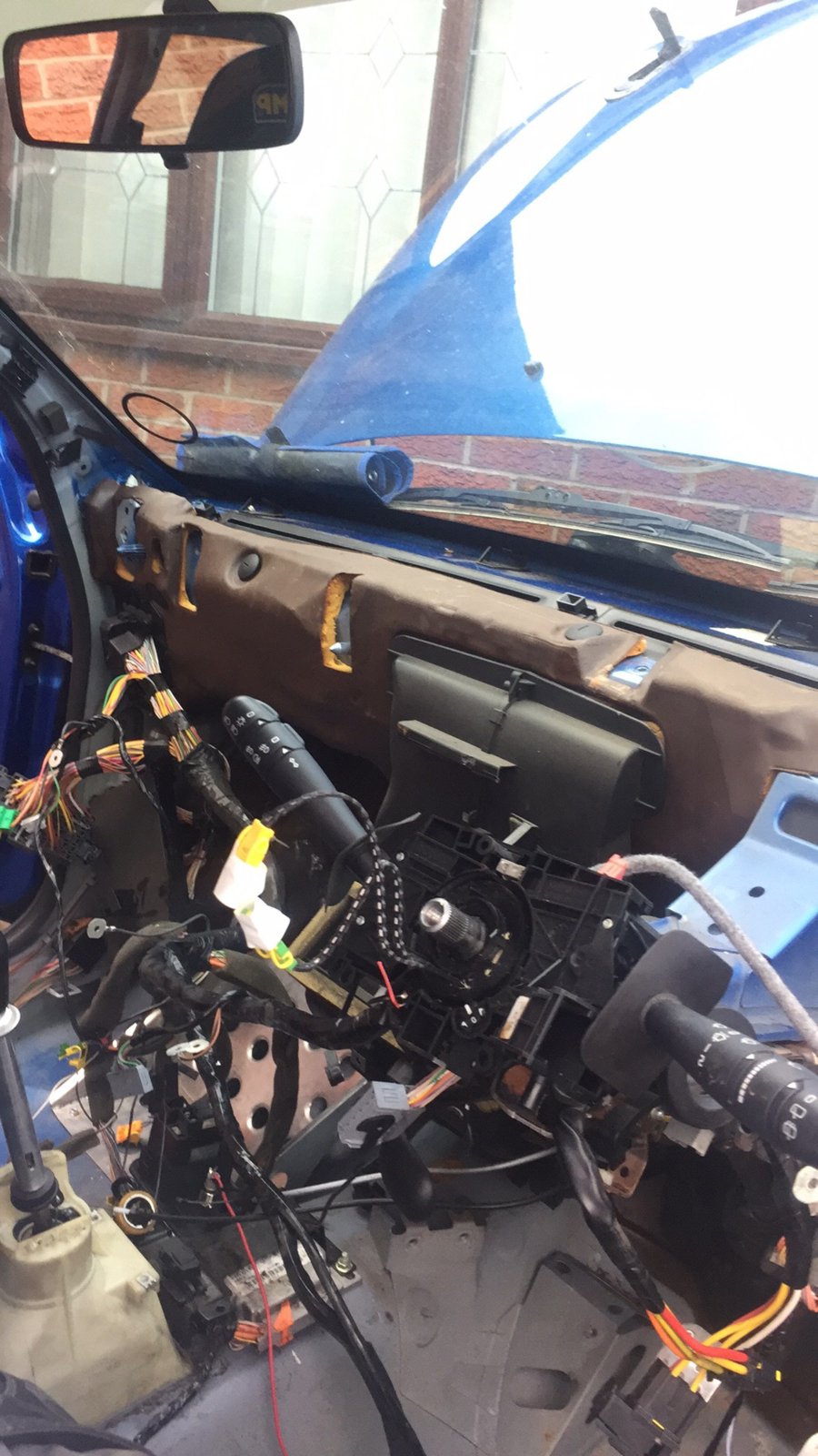

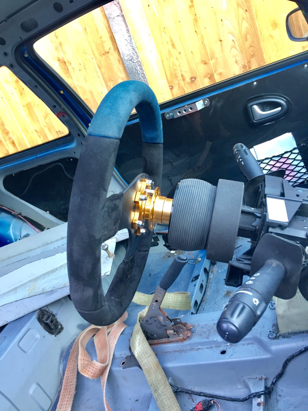

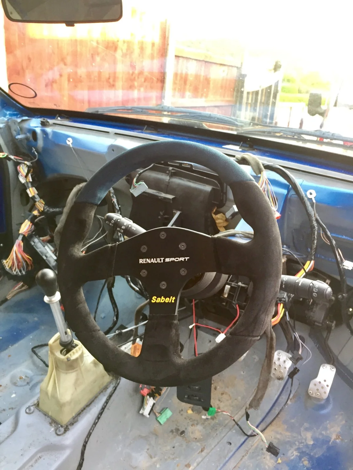

Finished stripping the rest of the interior out today. Ready for the cage fitting this week.

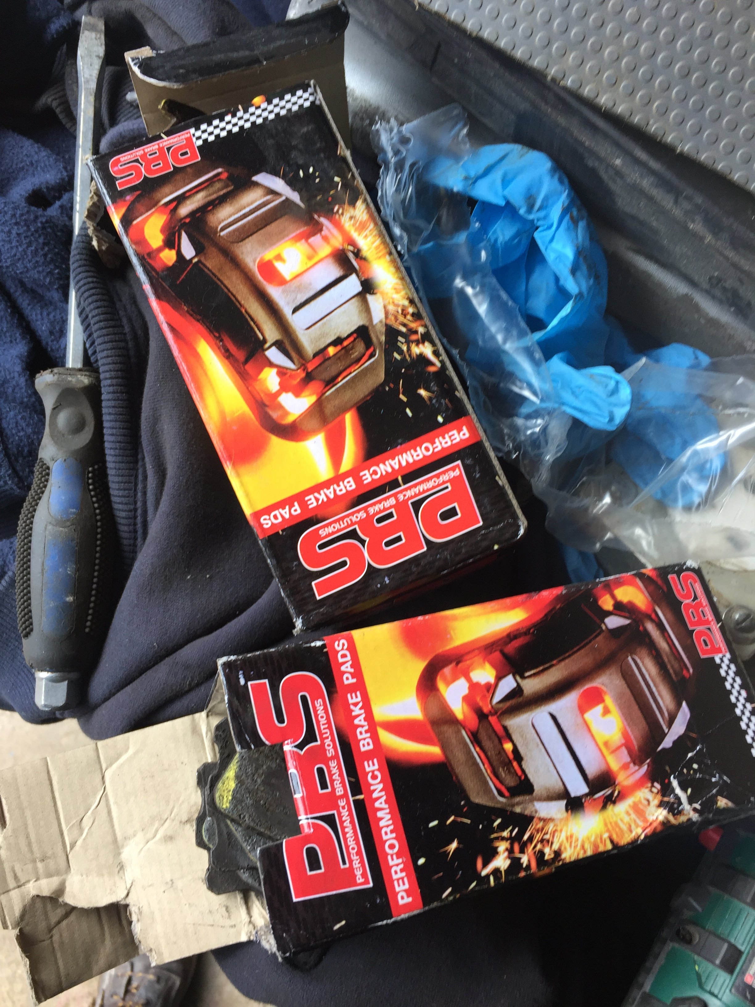

Also fitted my pop off steering wheel boss and ordered some PBS front and rear pads and some brembo HC discs
Small update.

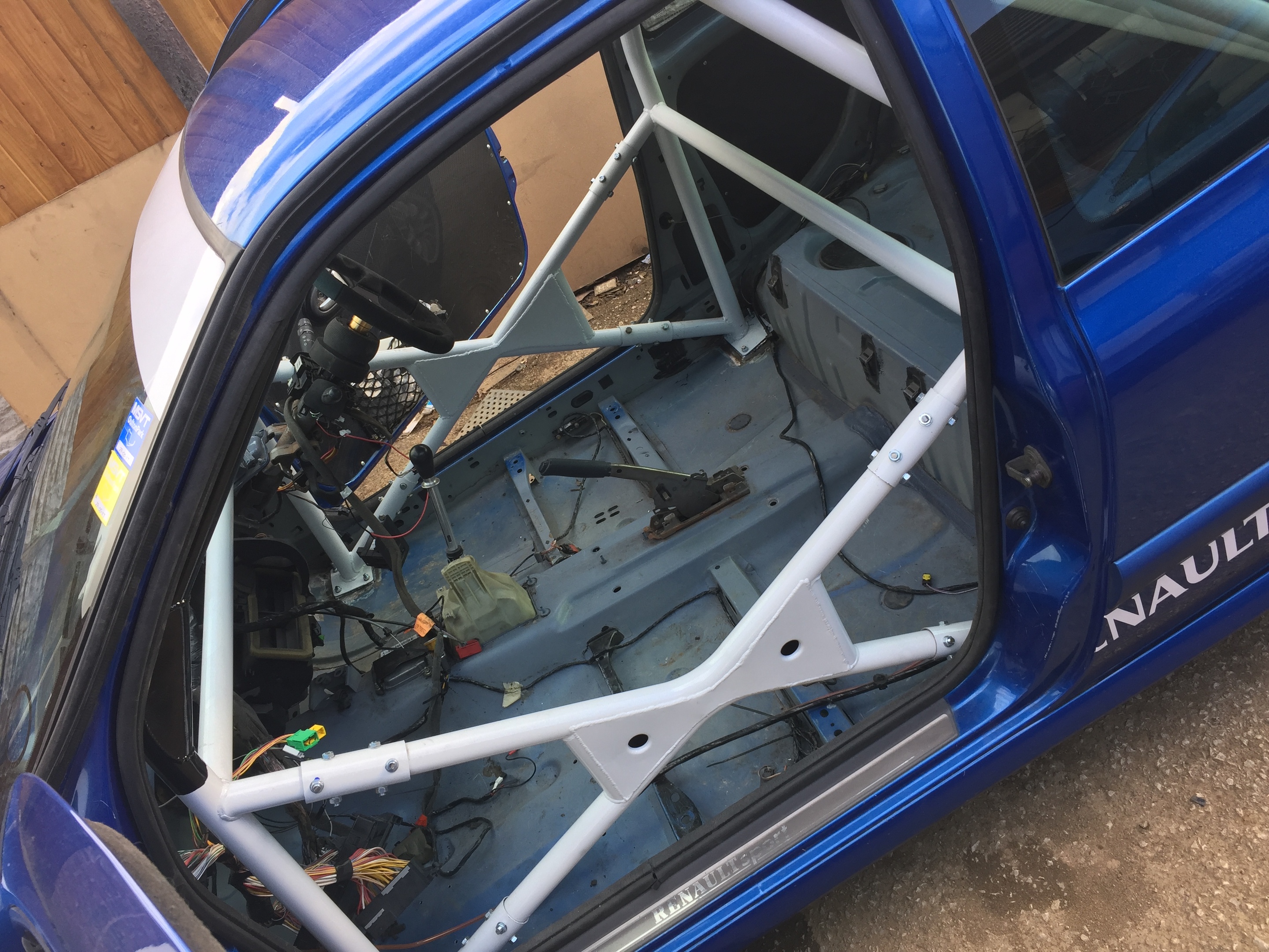

The roll cage is getting fitted and sprayed at the minute. I should get the car back early next week.
I've ordered the PBS front and rear pads, bargain at £120 for the both. Supposedly compared to RC6 but half the price.
Hopefully they've be better than the yelllow stuff I'm running at the minute.

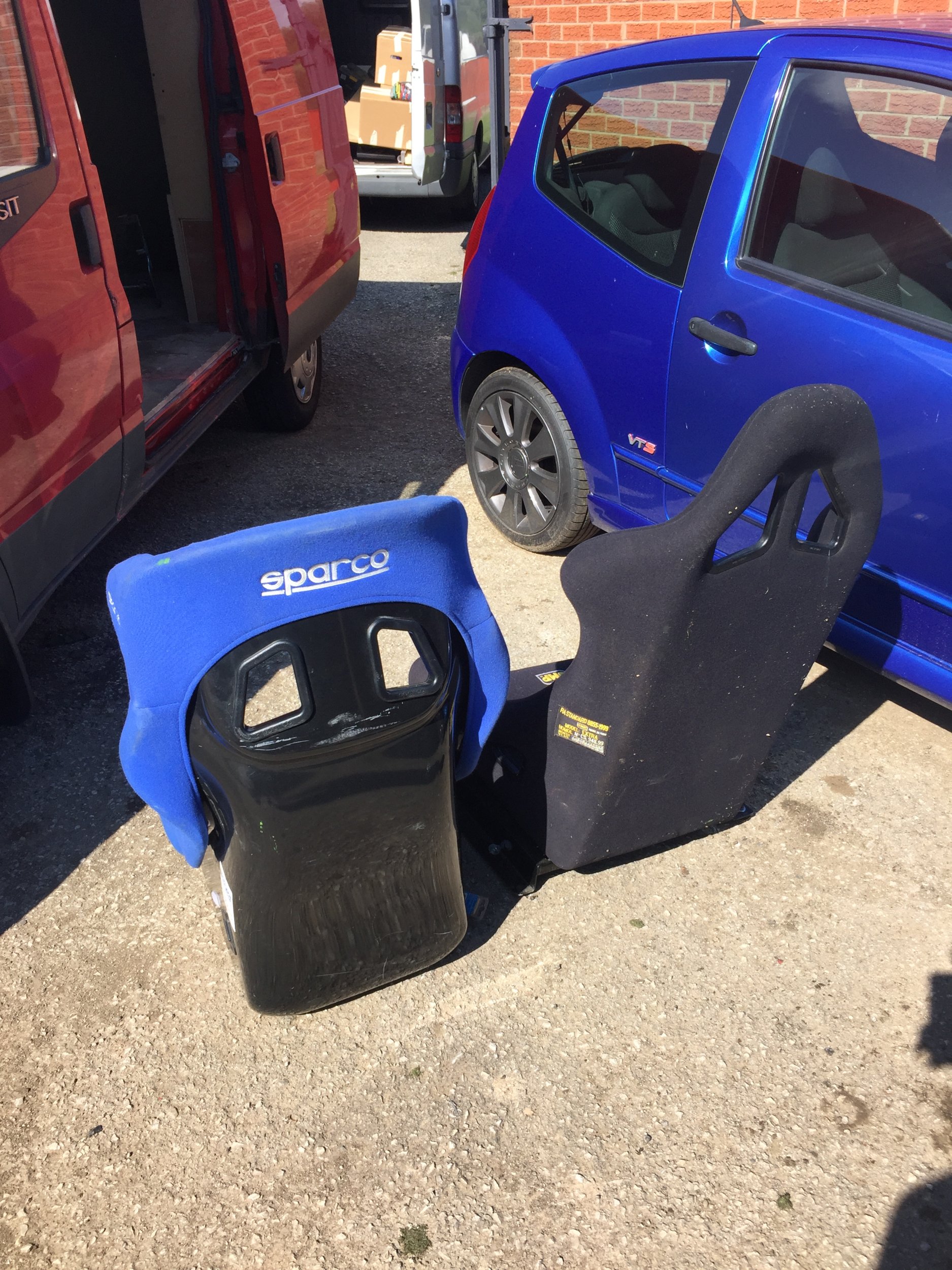

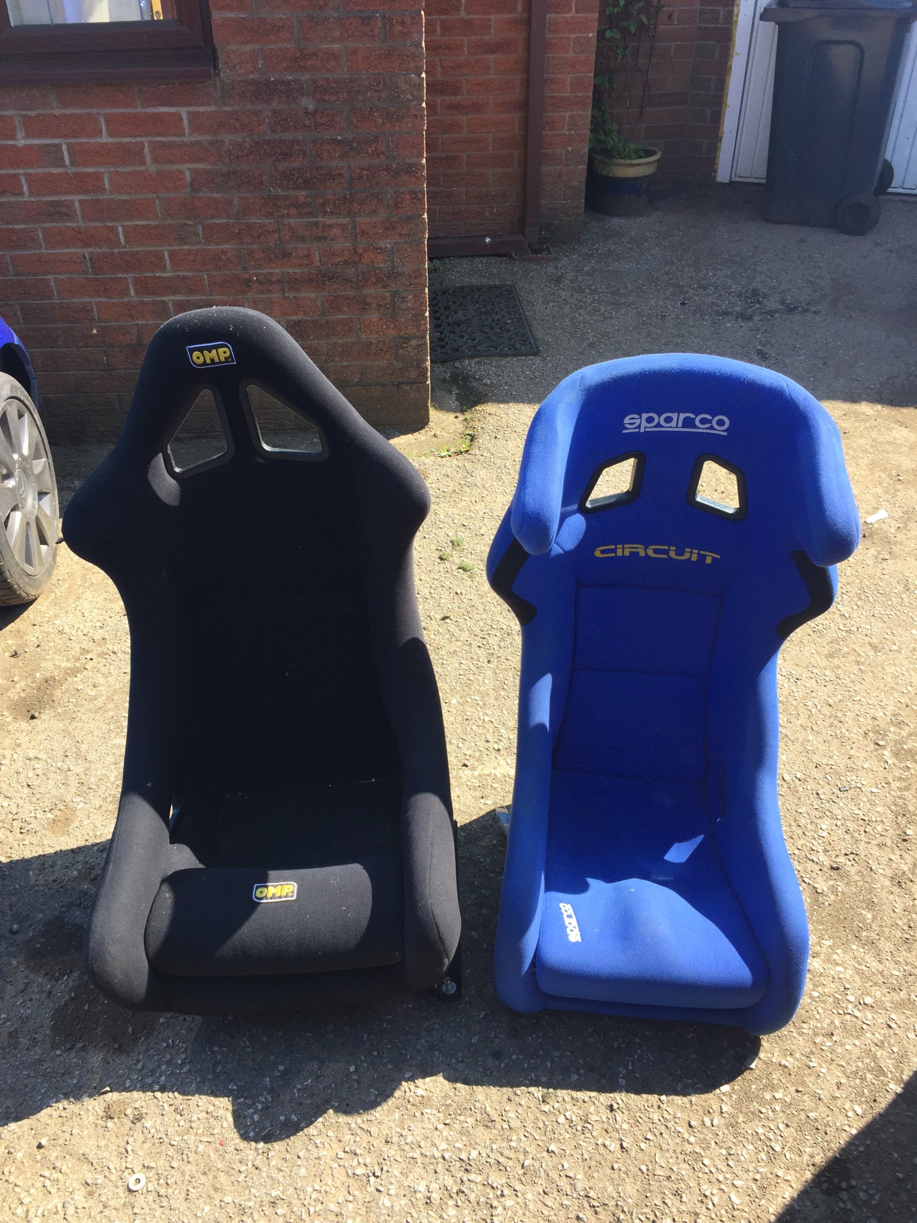

I've also bought 2 new seats.
So my omp seats will be for sale soon.
I've also booked Donington for the 9th of August.

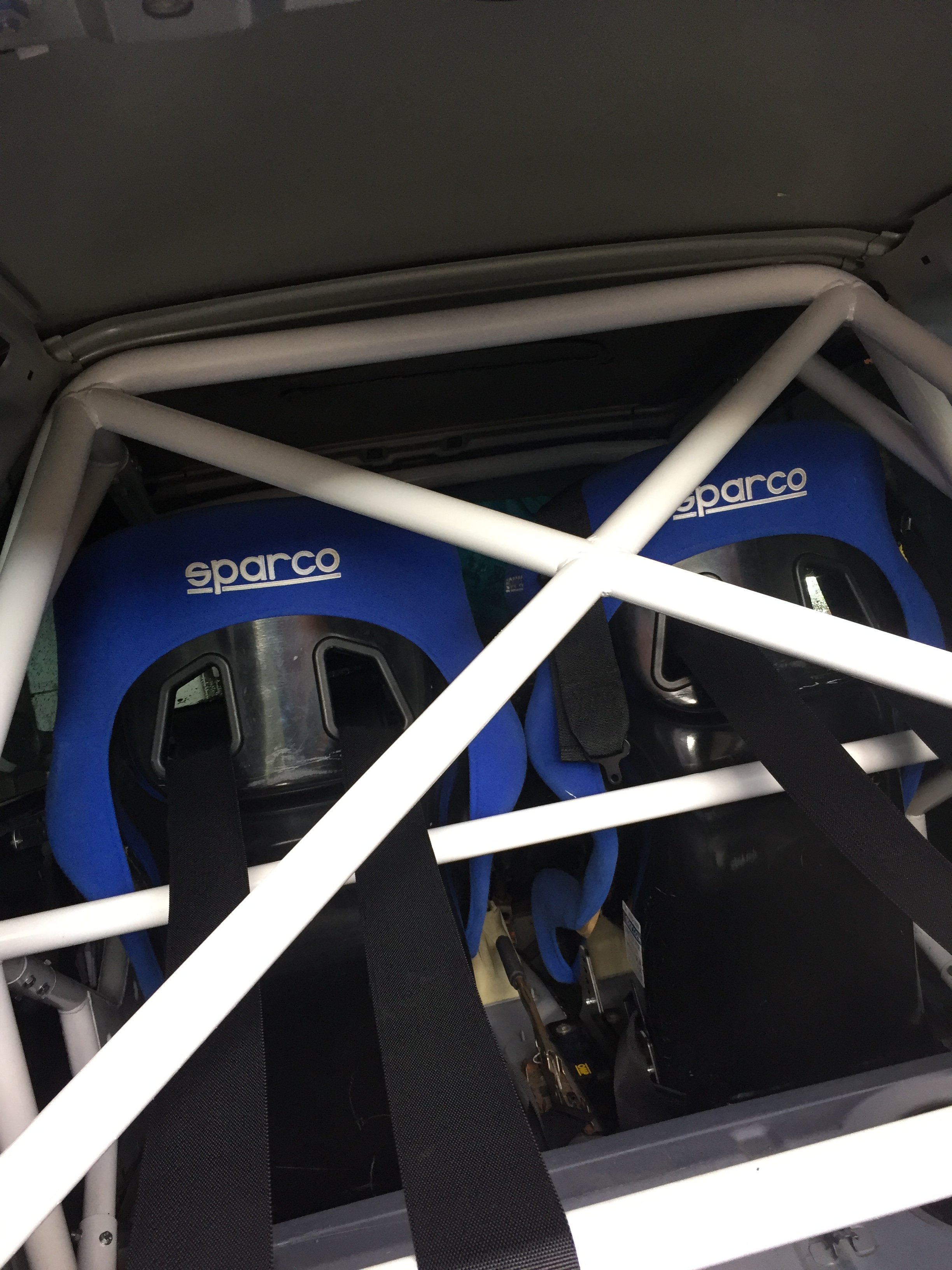

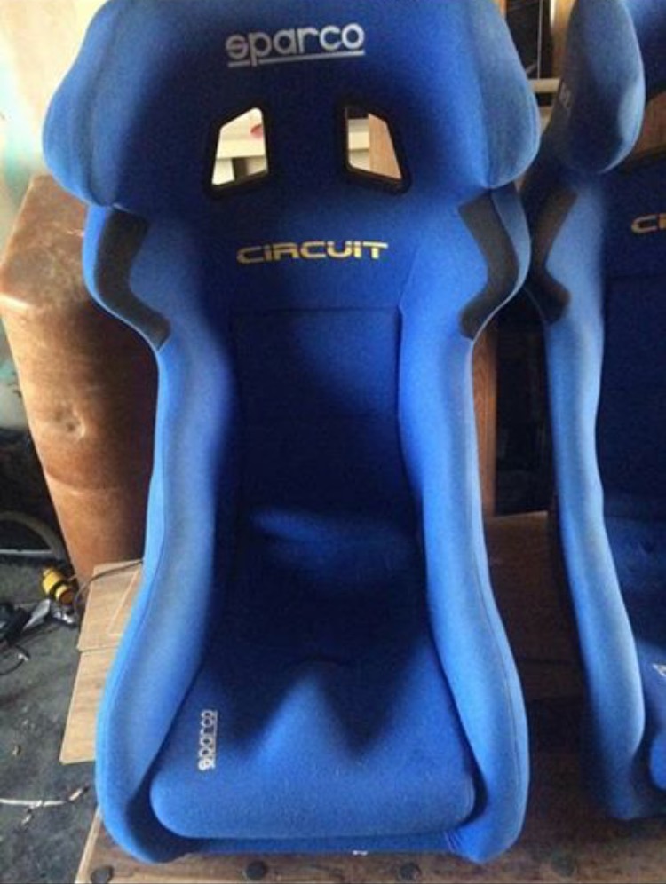

Picked up my two sparco circuit seats last night.... and are possibly up for sale. They fit a little to tight on the hips.
You can tell compared to the omp seats the difference in size.
I'm going to fit them in Wednesday when I get the car back from having the cage fitted. If they don't feel right they'll be up for sale.

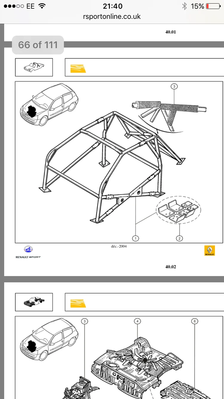

Did you source the cage through
R-Sport? If you don't mind me asking; how much was it? Weighing up my options.
This looks like it's going to be a brilliant car when complete!
Thanks mate.
And no I managed to find the cage for sale on eBay second hand at a very good price. I did contact R-Sport about the base spreader plates. But they never replied to my email.

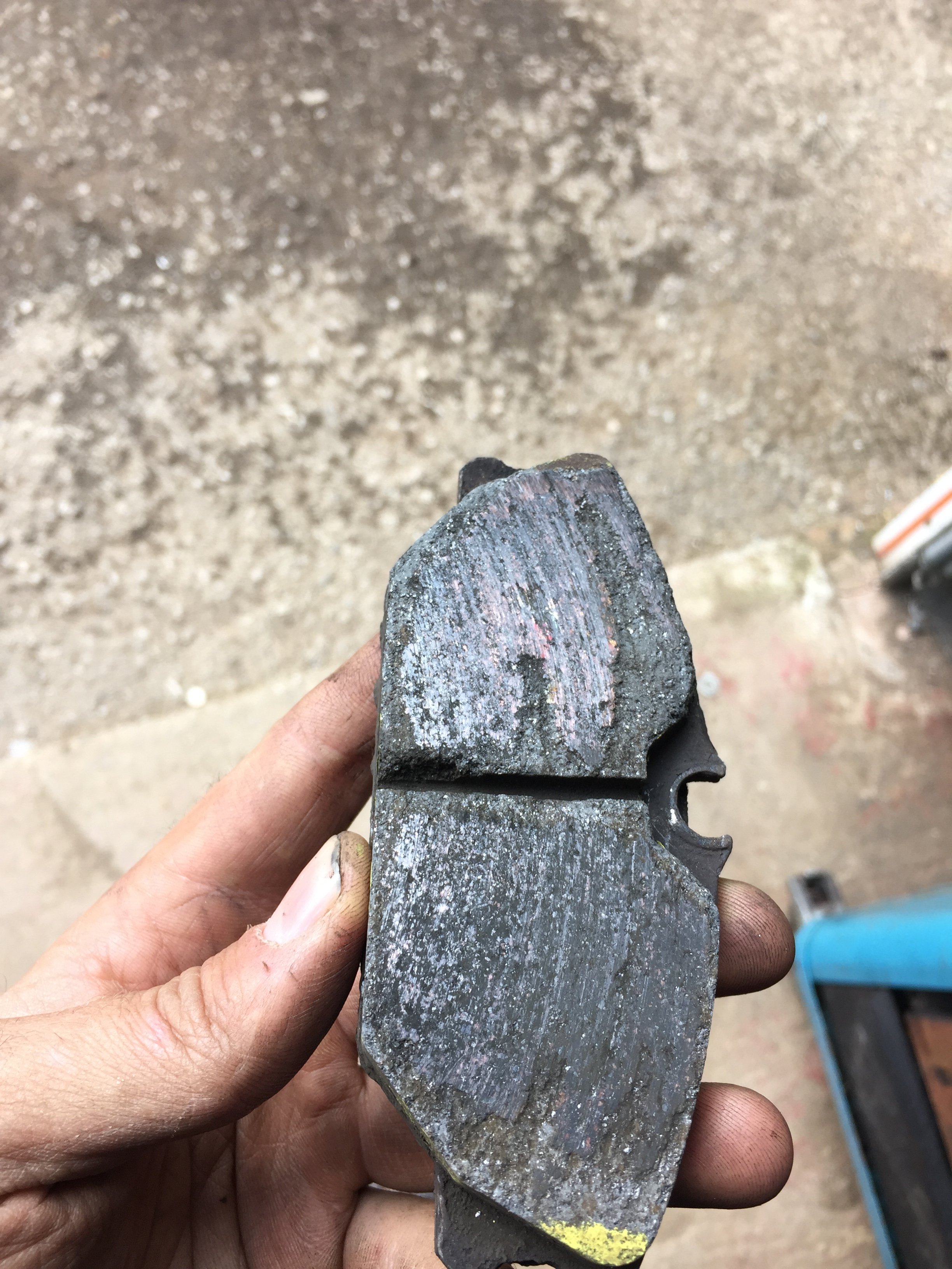

Been rushed off my feet to finish the car. Dash, seats and new 6 point harnesses in. PBS pads on front and rear as the yellow stuff were knackered after oulton.

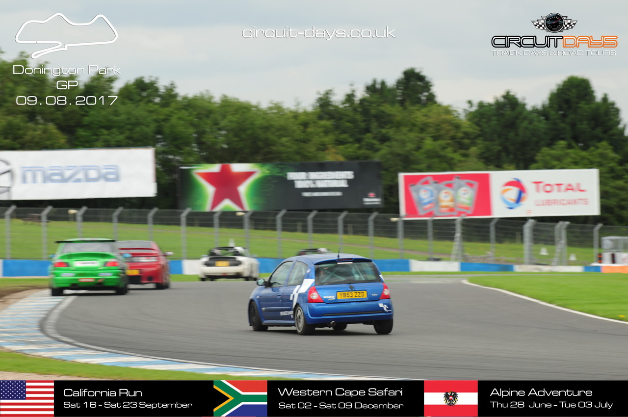

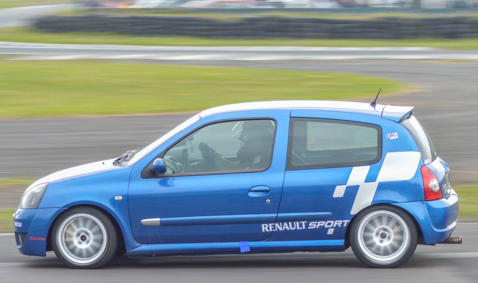

Amazing day at donington park yesterday.
The morning was really wet and slippery. Had a lot of brown pants moments. Mainly due to brand new pads and a048 in the wet. We were locking up under braking even when trying to brake lightly.
Did one lap on some toyo road tyres which were even worse. But after about 11 am the track dried up and the car was flying.
I got black flagged for being to loud on drive by. So had to spend the rest of the day lifting off going down the straight not to set the fb reader off.
I've got some videos. But they are taking forever to load to YouTube.
Fastest lap of the day was a 1:57 with a lift down the straight which I'm happy with on my first time round

How did you find the pads?
I thought they were great. Can't compare to Carbon Lorraine but I couldn't of asked for anything better.
Squeal a little when cold, didn't fade all day. Only issue is was there's quite a lot of brake dust. But the pads don't even look like they've been used

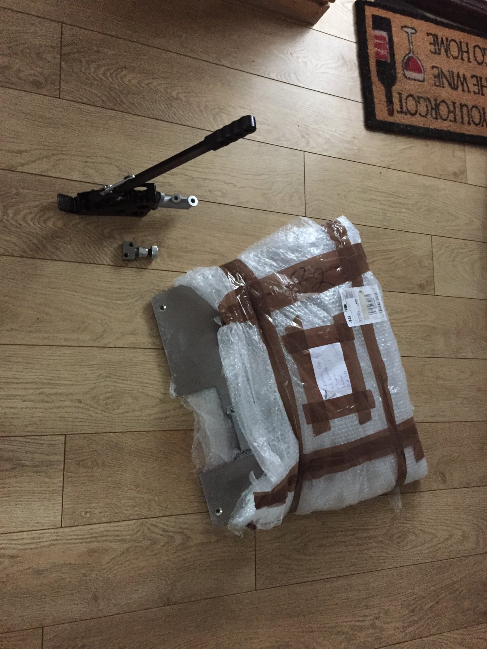

Some goodies came today
Pure motorsport sumpgaurd
Bias valve
Hydro handbrake

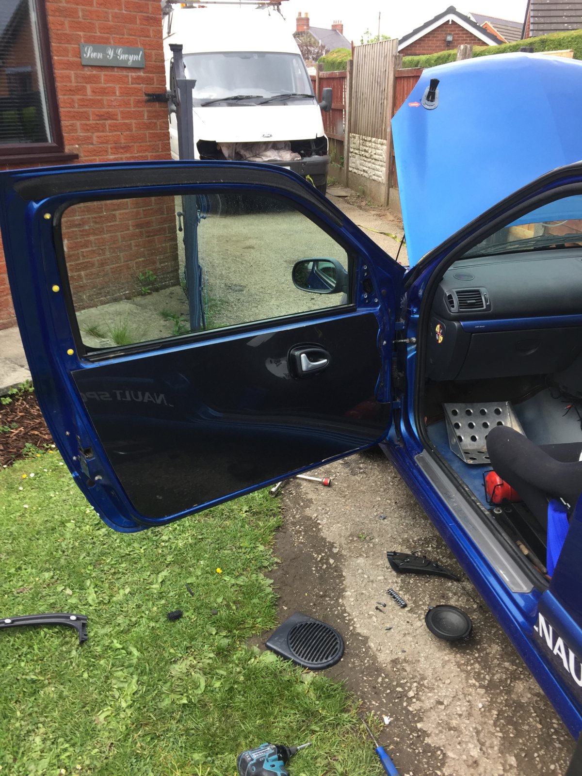

Fitted the front poly windows today and mudflaps. But got to dark for pictures
Rear poly windows tomorrow

Have you fitted yours now? And if you did, did you have the engine in? Looks likes it's going to be a right struggle
engine in and got rid of abs pump at the same time. the fitting wasn't that bad but to be honest i'd never have anything from them again. it was only down to the fact we had waited so bloody long for them and the car was booked to be logbooked that stopped them from getting sent back.
bit of a pain bringing the line into the car, ended up doing it just to the side of the column.
Agreed on that, i ordered 2 lines and it took well over 7 days for a stock item to be delivered and still needed work despite being 'plug and play'
