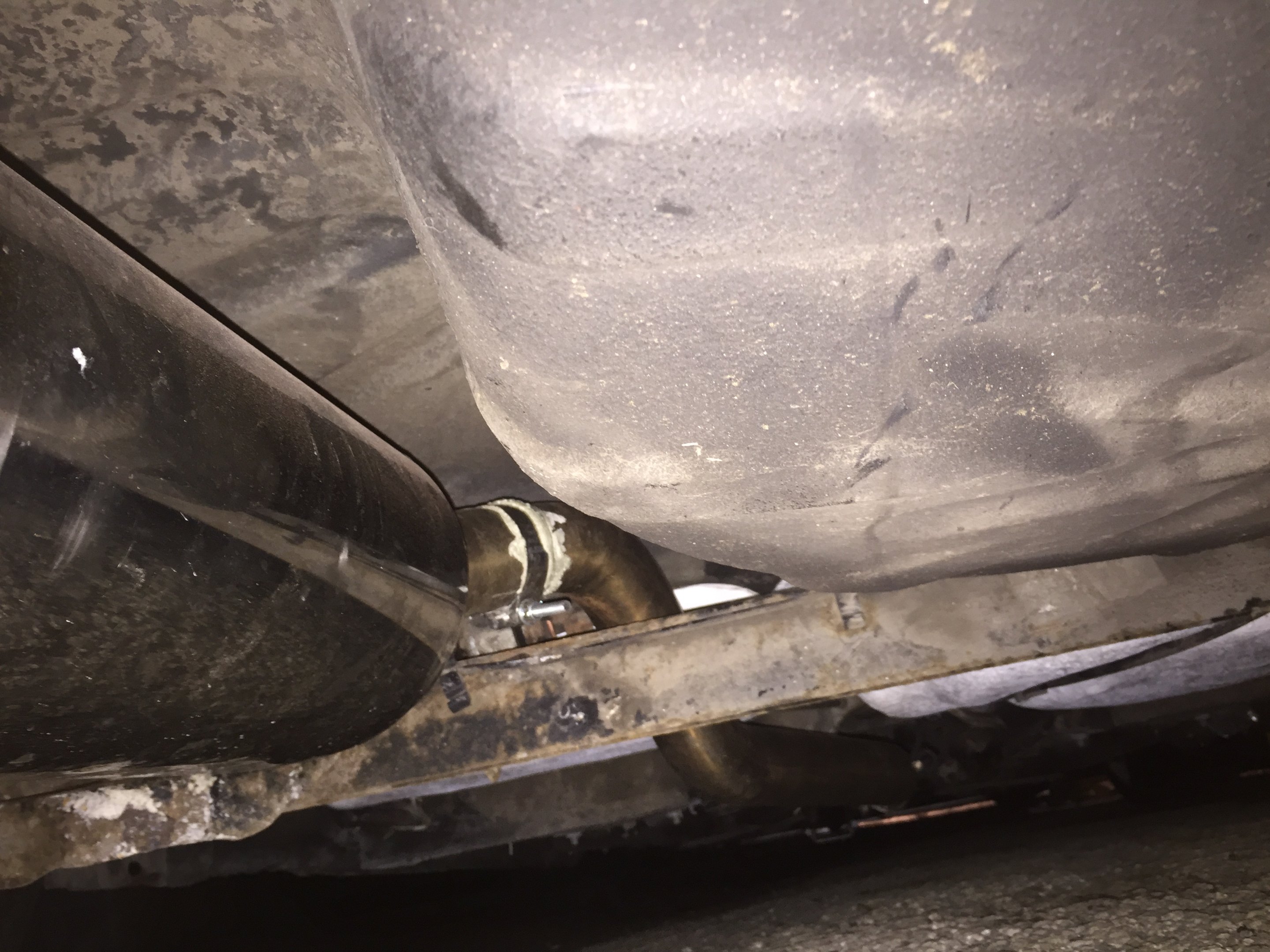

engine in and got rid of abs pump at the same time. the fitting wasn't that bad but to be honest i'd never have anything from them again. it was only down to the fact we had waited so bloody long for them and the car was booked to be logbooked that stopped them from getting sent back.
bit of a pain bringing the line into the car, ended up doing it just to the side of the column.

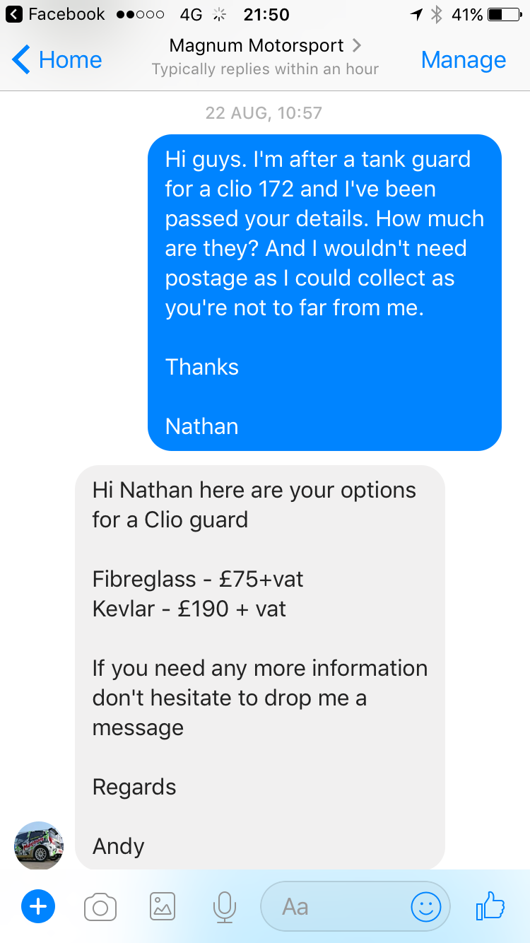

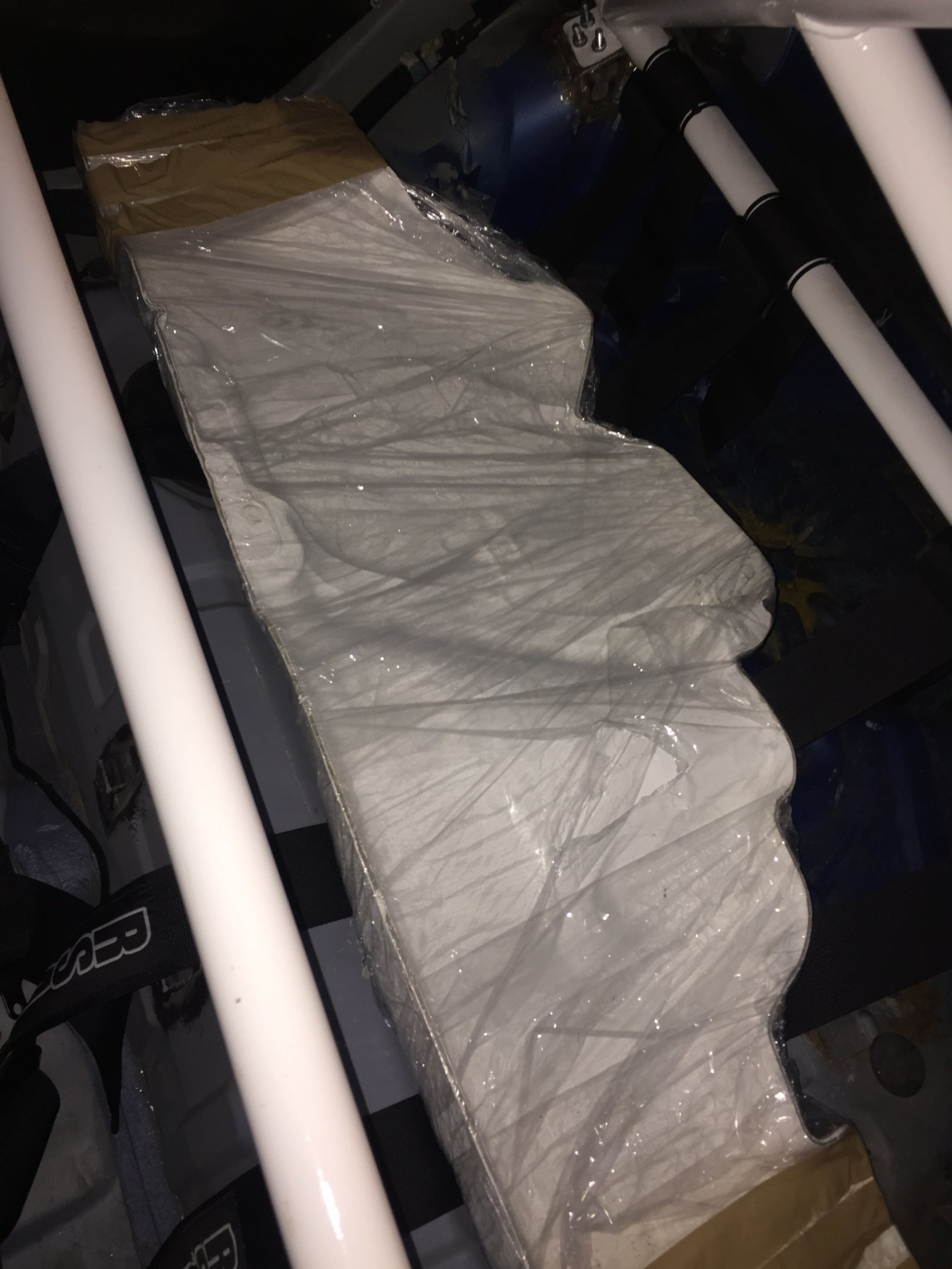

Tank guard picked up, I got fibreglass one as the car will only be doing tarmac events,
Still feels pretty strong, and it bolts in to the original mounts

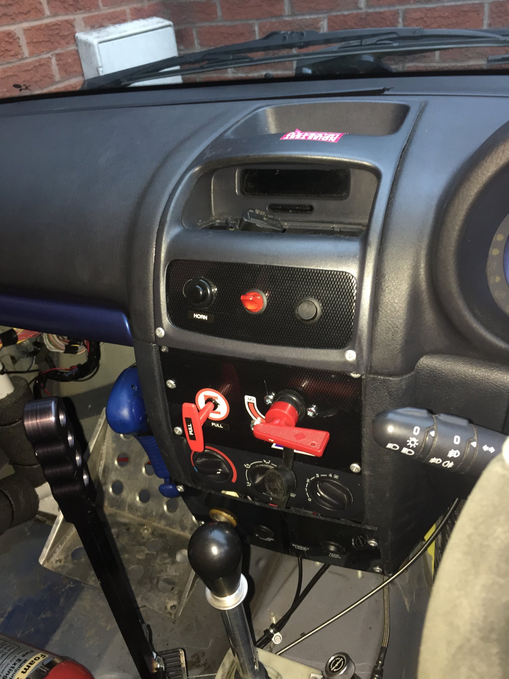

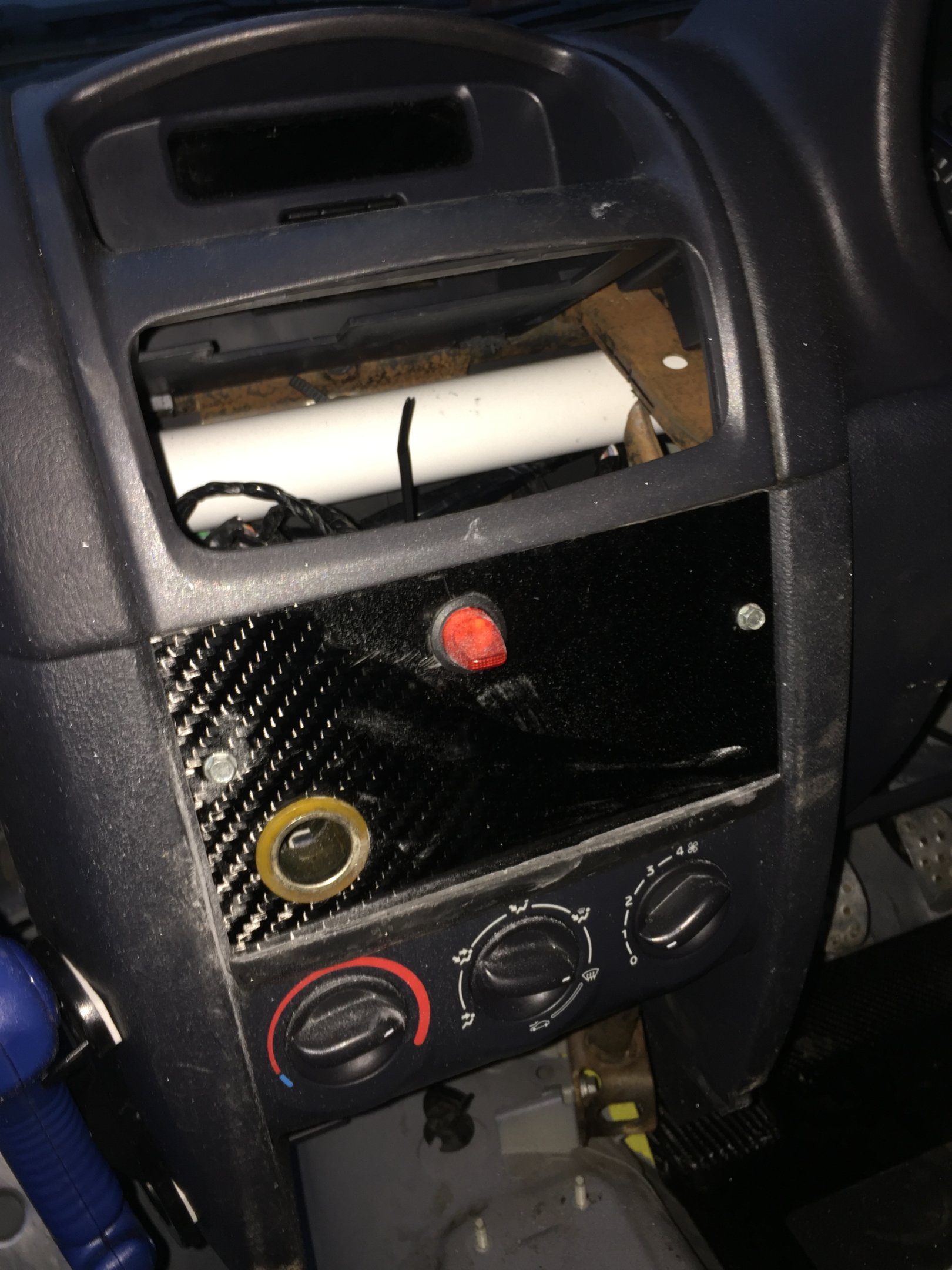

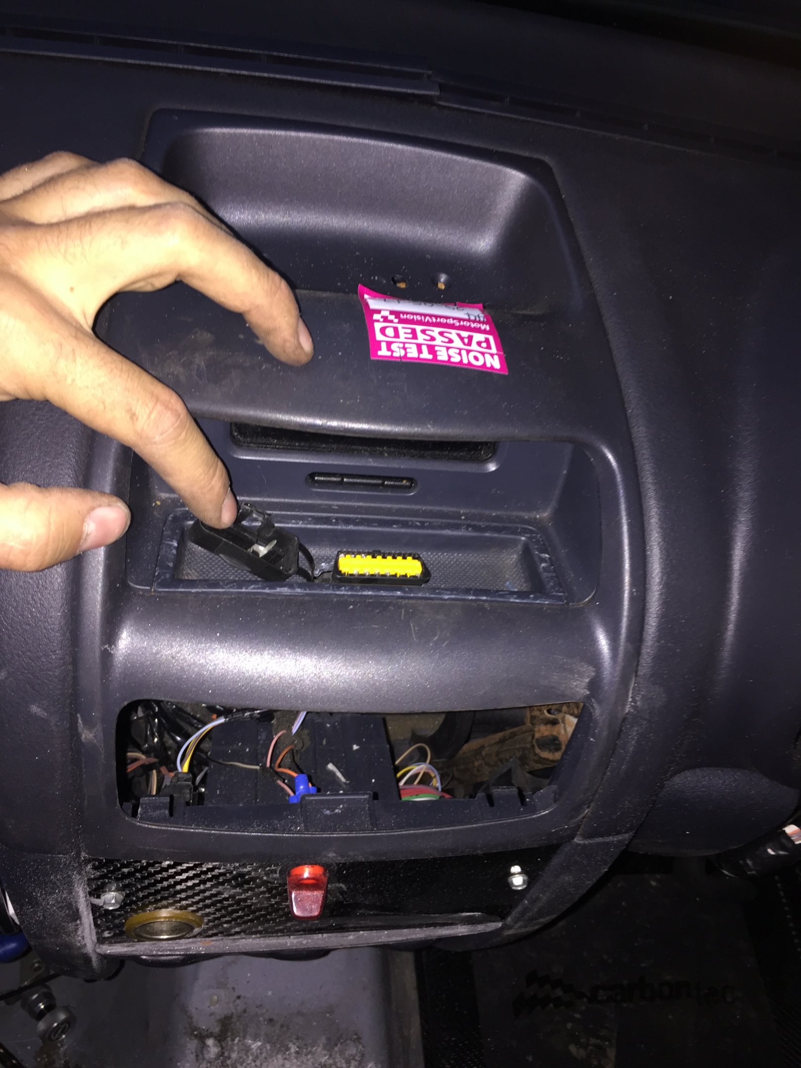

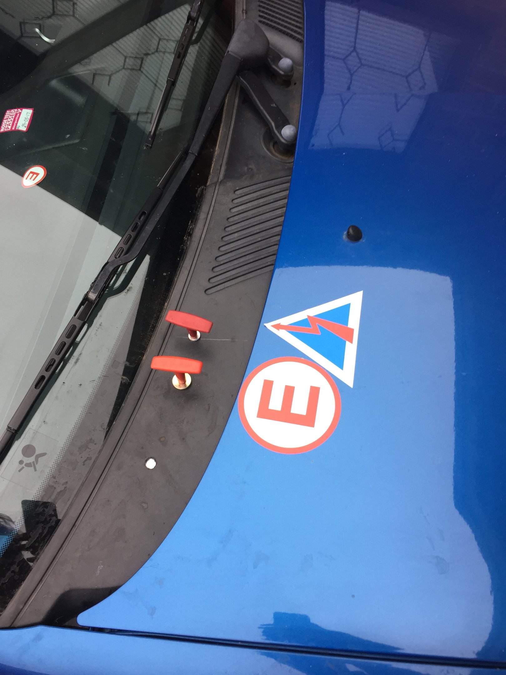

Sorted a few bits out with the dash so I can make some space to mount my kill switches and extinguisher pull cords
Fag lighter in the dash
OBD port now in the dash

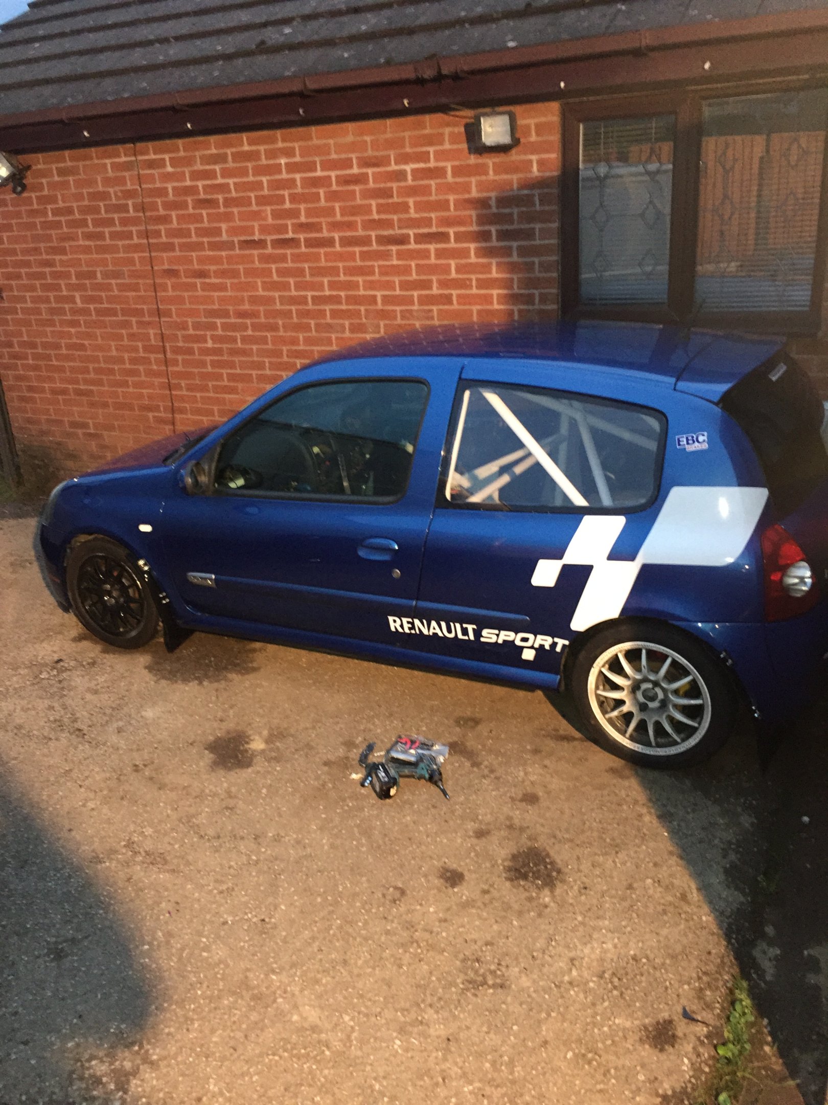

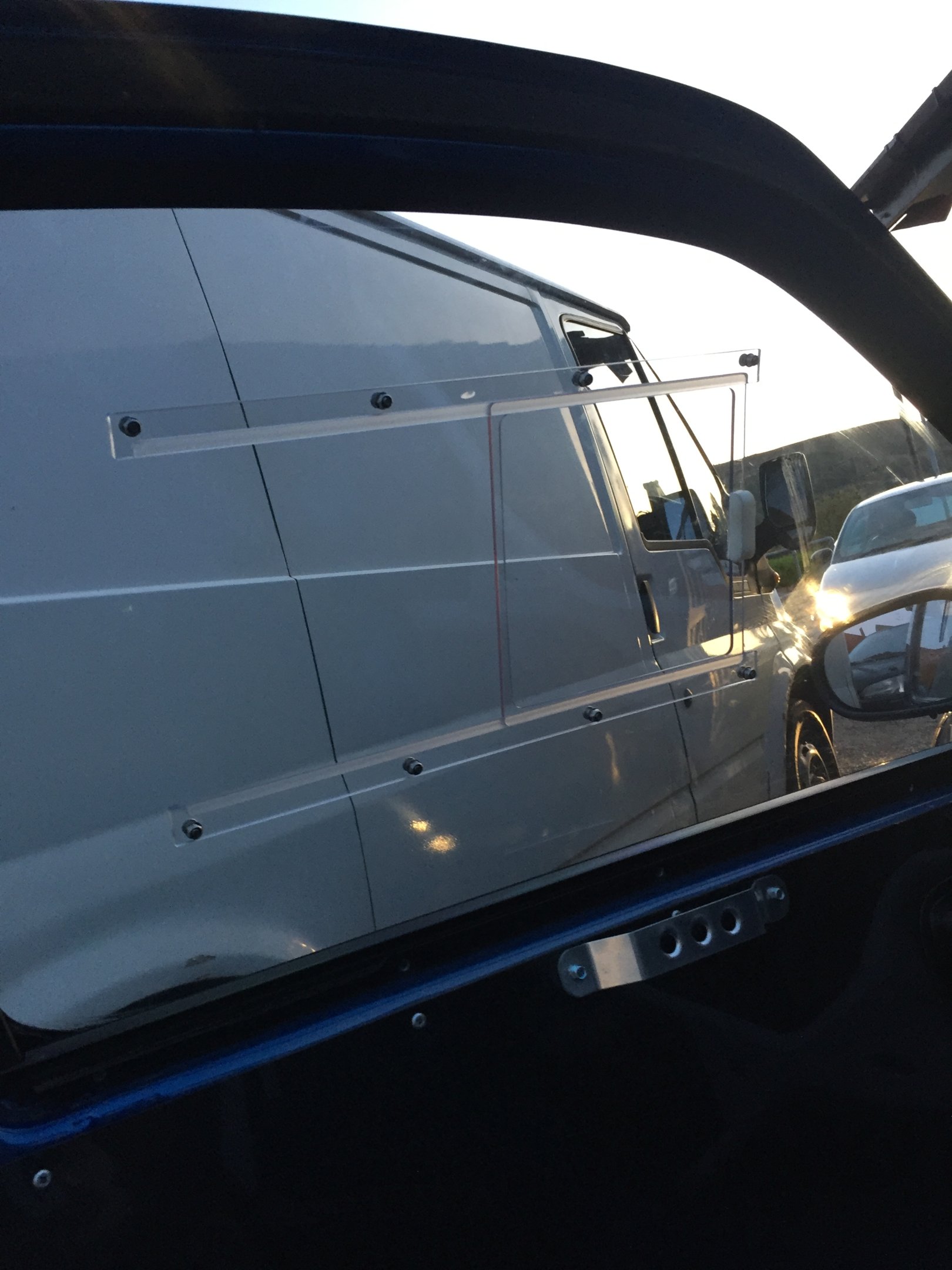

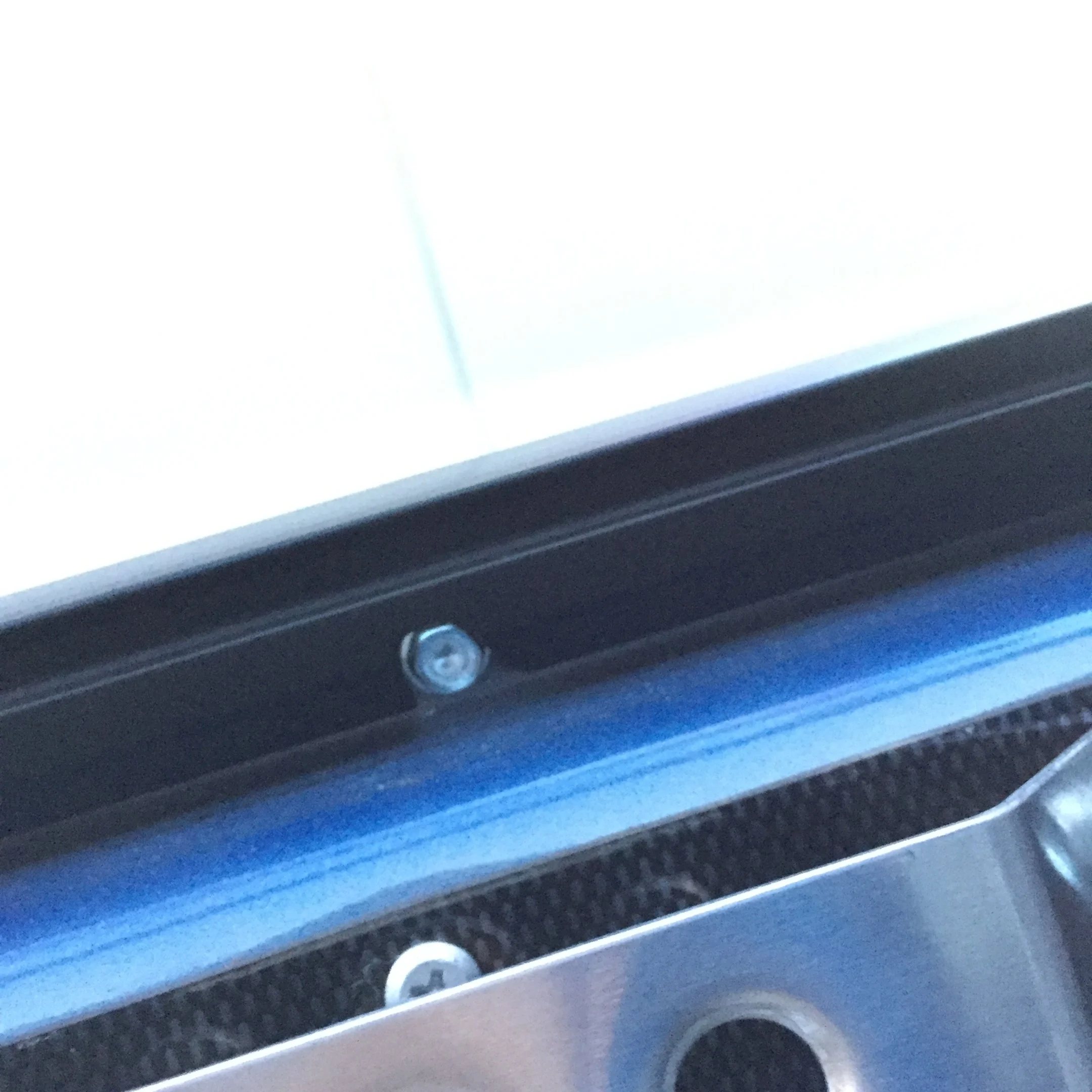

If any one is wondering how to fit front poly windows.
I've tek screwed the bottom in, from the inside, pushing the window to the outside of the body work and have used silicone on the bottom outside seal.
Very easy to do, glass window and motor out, and poly window in, with door card back on in 10 minutes

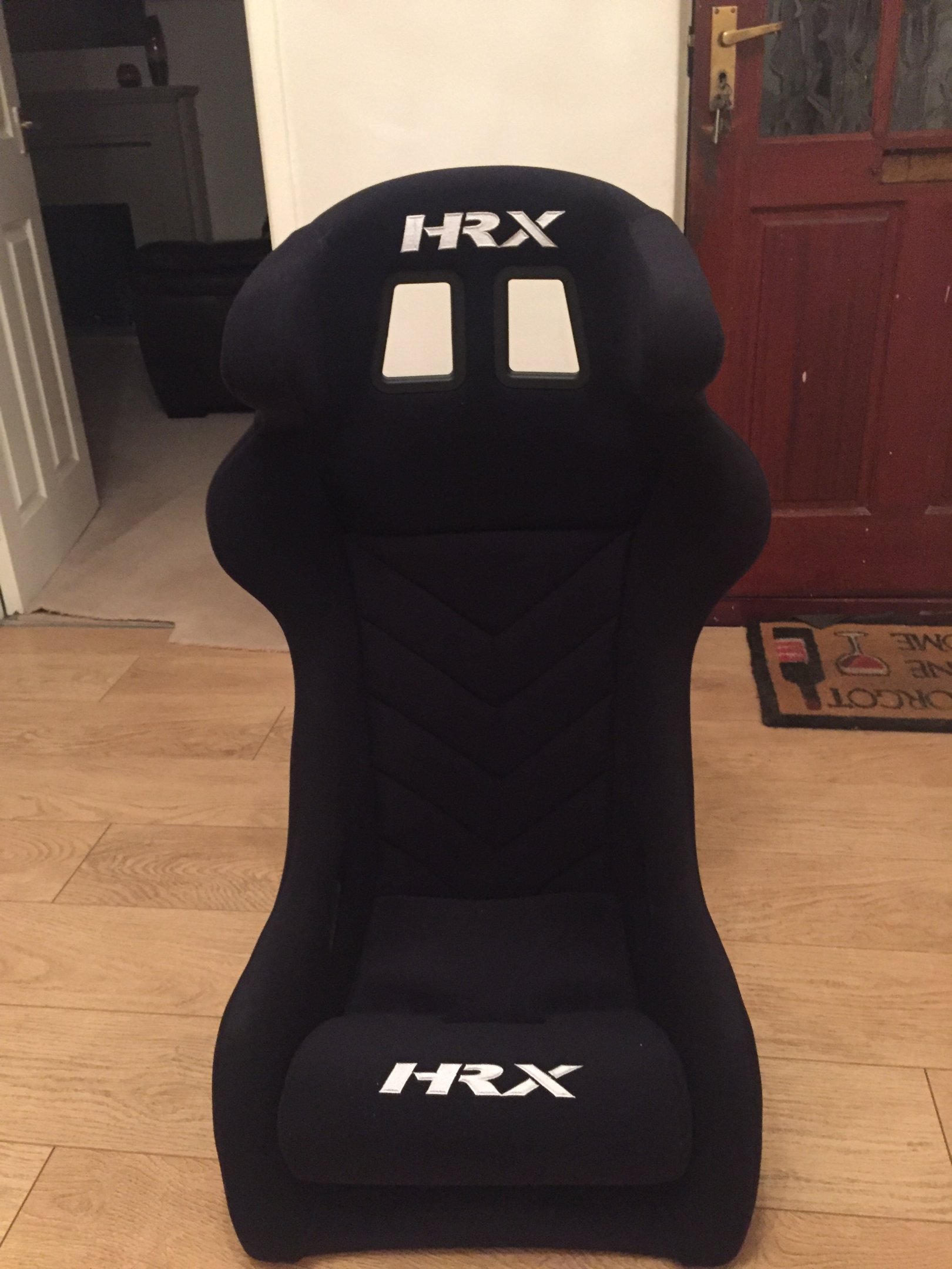

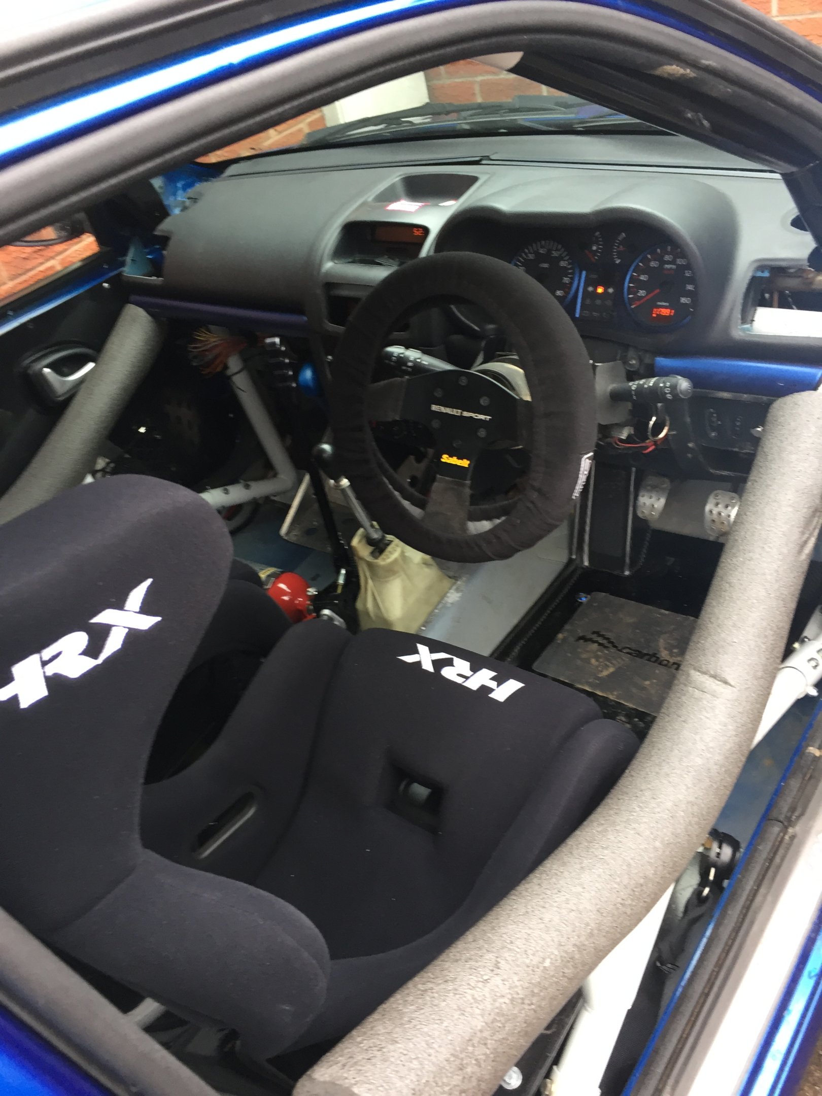

Picked up my new HRX seats tonight, almost identical to the sparco circuits, but a fraction of the price.

Comfiest seats ever. Got them in my clio.
HRX harnesses are excellent too
  Audi rs3/Clio 172cup
I tried them on Saturday morning. Then went to demon tweeks, tried every seat there and only one seat compared really, and they were almost twice the price.

No I got them direct from HRX after doing a deal for seats, harnesses and side mounts with them at last year's Autosport show. Bryn has only started dealing them this year.

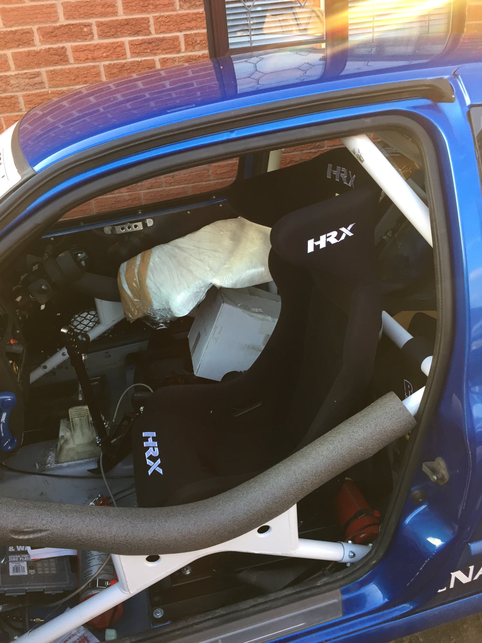

Fitted the new seats, took ages to get them where I want them and I'm still not completely happy with the seating position.

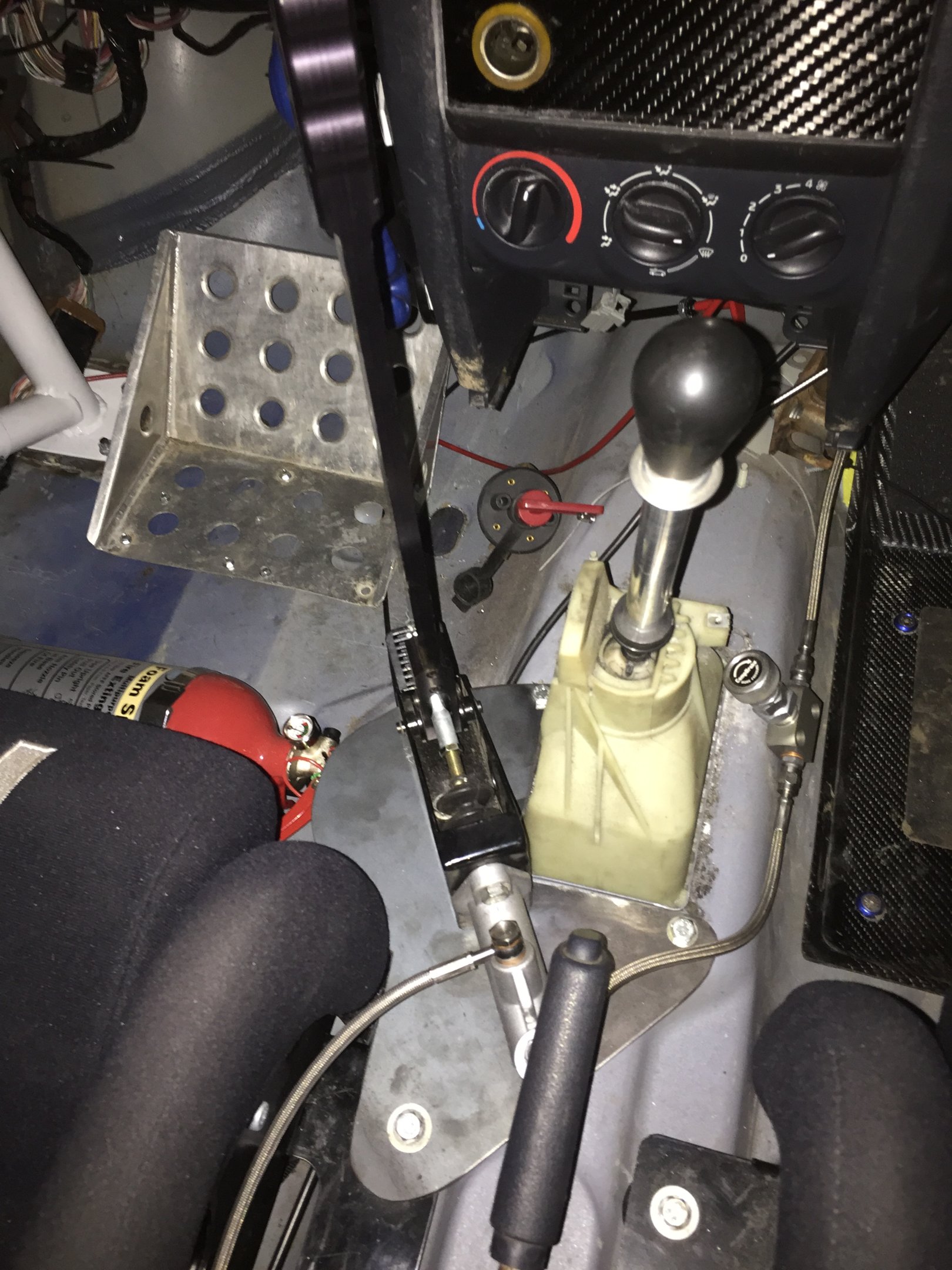

Fire extinguishers plumbed in with the new hand held fitted too.
Pull cords fitted. But I need another plastic trim.
I drilled this one wrong.
Still need to fit sump and tank guard, and need the auto elect to wire the kill switch and some horn and intercom switches.

Took the seats out again and re fitted them. Now I'm happy with how they sit.
They could go slightly lower but at the minute it's not worth the new subframes to do it.

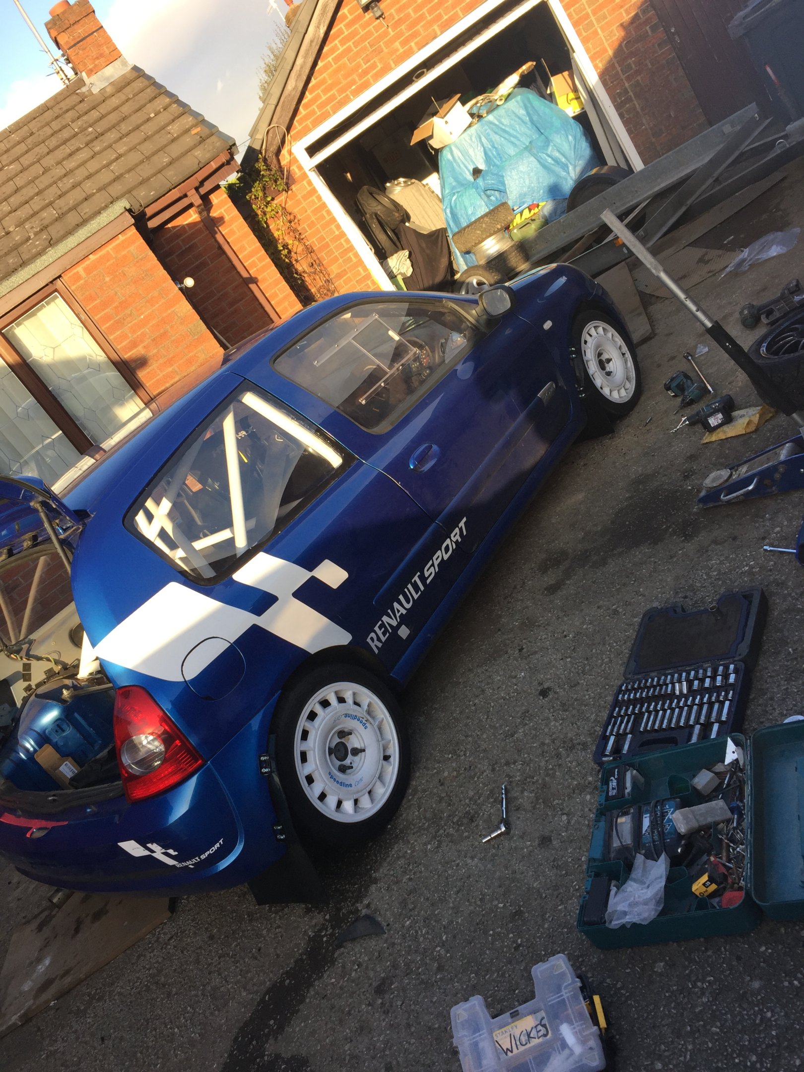

Update time.
I insured the car and drove it on the road for the first time ever......
It was horrible. The gaz suspension was either to hard or to bouncy. So I bought some bilstein b14's.

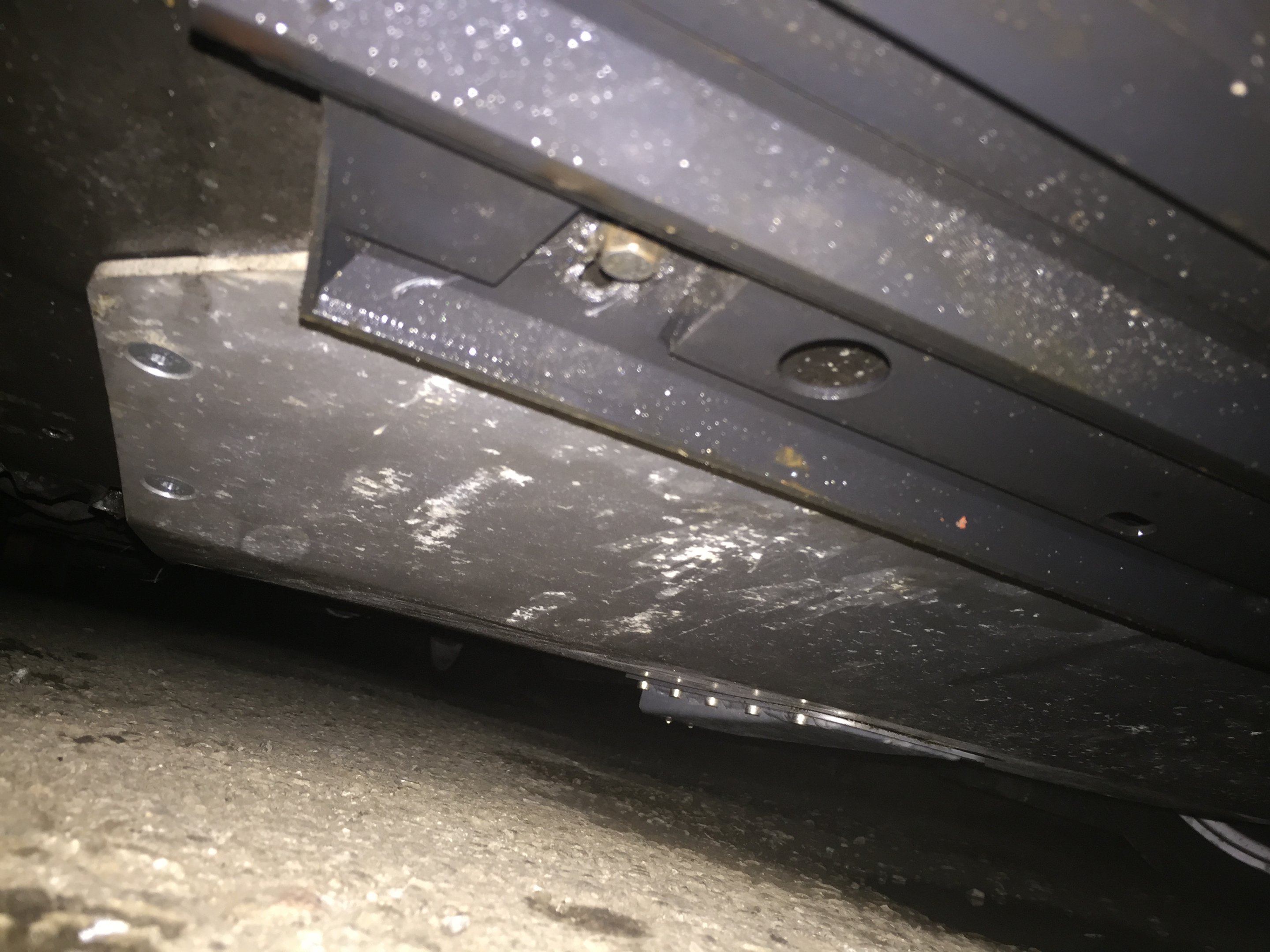

In the mean time I've fitted my pms sump guard, tank guard and hydro hand brake with a mounting plate.
I also bought amd fitted a pms exhaust. Hopefully in the next year I'll get the pms manifold to match.
The exhaust is considerably quieter than what I had before but still sounds good. Only at age thing is that the car feels like it's holding back now. There used to be a lot more power lower down in the rev range to what it feels like now.
I still need to wire up the cut offs and horn. But they're the only things stopping it from being msa log booked.

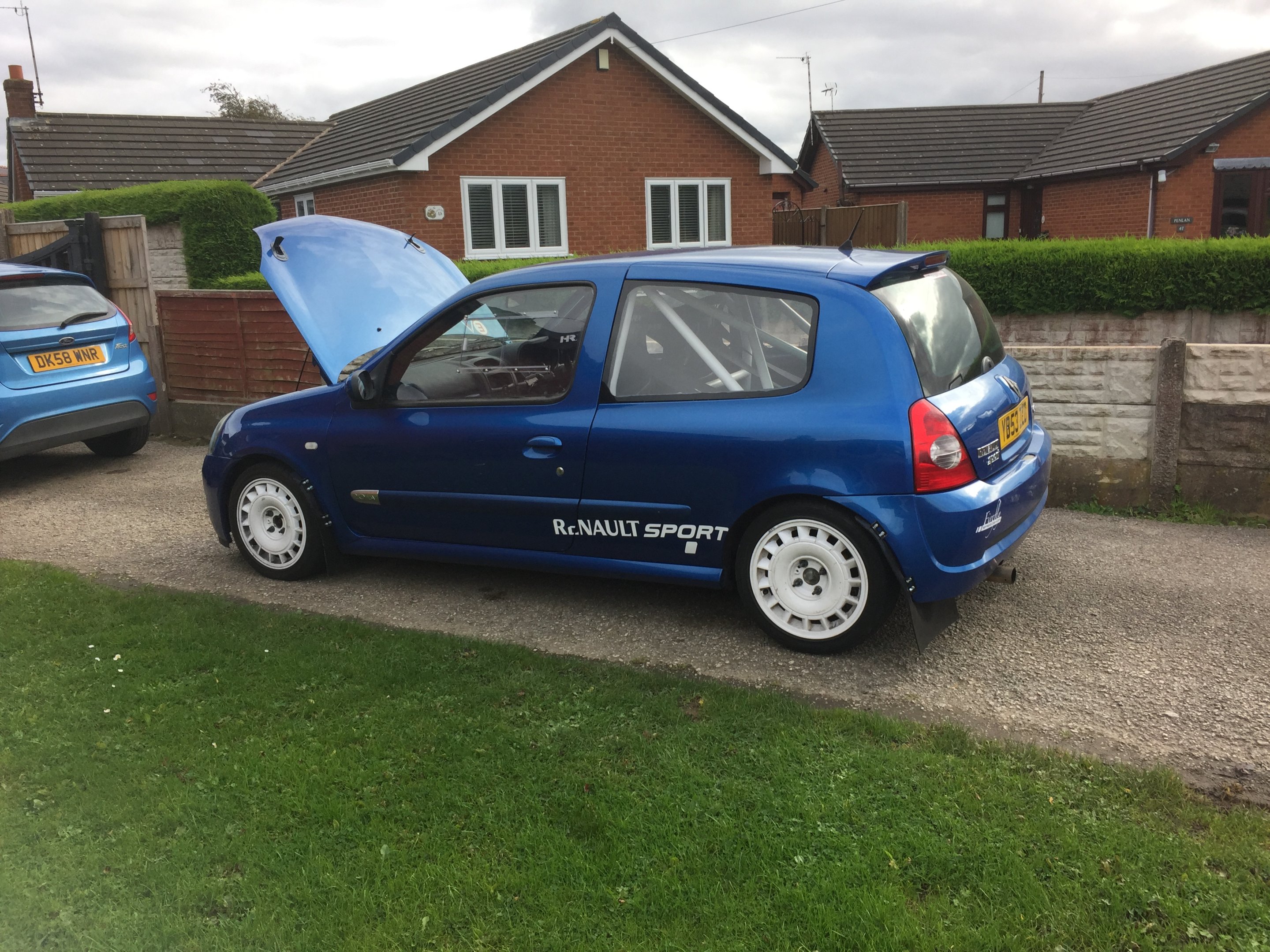

The car is finally finished to get msa log booked.
Electric cut off and switches all wired in this week
Me and my brother took the cars to three sisters in Wigan for a blast yesterday.
We both killed a set of tyres. My brother had a blow out on the fastest bend and put his into the tyre wall. Luckily all he needs is a new light and bumper.
The clio went well after we sorted the tyre pressures out. First session the tyres got to hot and I could get any grip anywhere.
I'm going to change the front springs on the bilsteins to 450 lbs as it was to soft.

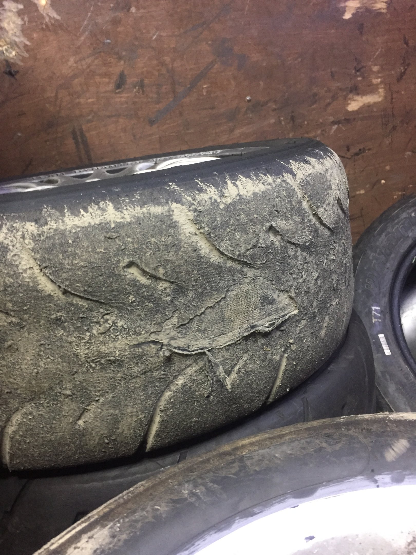

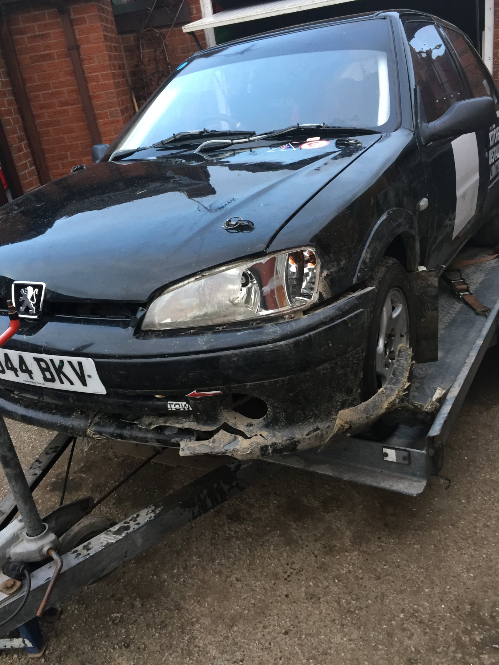

I'm going to change the front springs in the bilsteins to 450 lbs as it was to soft.

Can you remember what size/length tek screws you used for the front polys? Going to pinch that and order some!
Cars looking and going well mate!
Cheers mate.
Mine are slightly bodged. And I do want to change the screws I have.
I think I used 25mm screws. But in the middle of the window I've got the screw, screwed into a 5mm packer that's pushed against the poly.
Ideally you need a few different lengths or use rivnuts.
