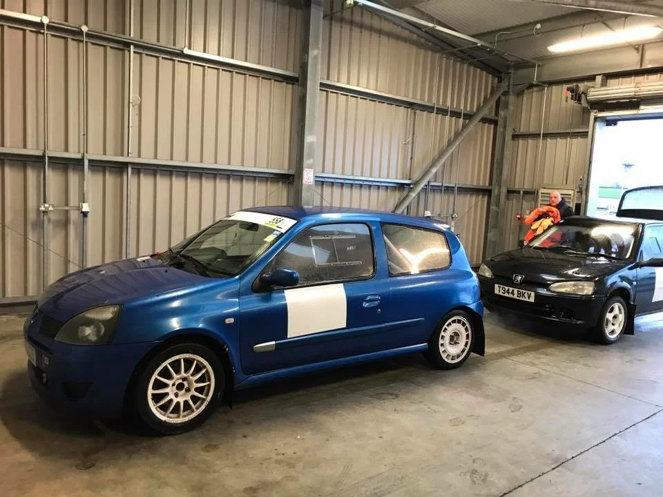

Me and my brother are taking the both cars to Anglesey rally track day in the 29th of December so I've been buying tyres and even more wheels for the car

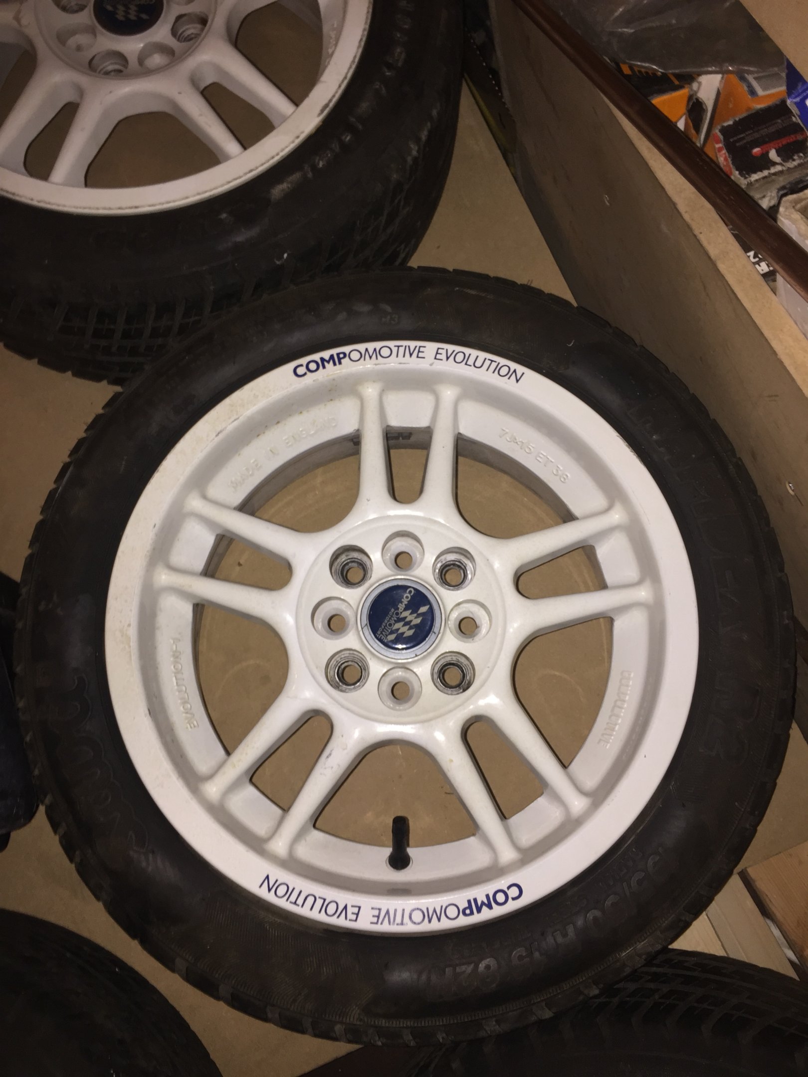

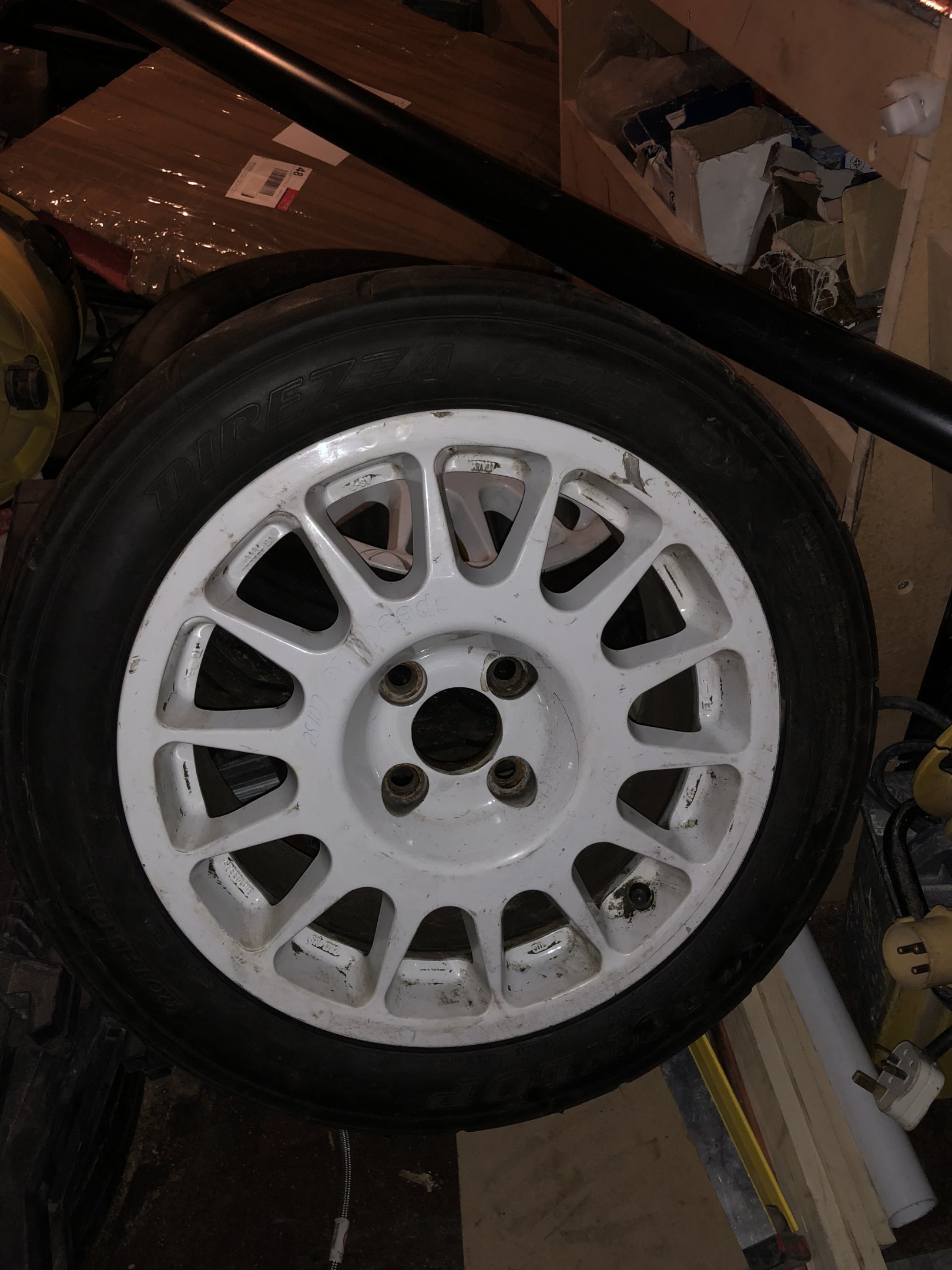

Picked these up this week as I needed more 7j wide wheels.
Now I've got 10 7j wheels, 4 6.5j speedlines and 4 15" Renault wheels and the garage is full of hankook, Dunlop and Michelin rally tyres. Just need to get them on all the rims

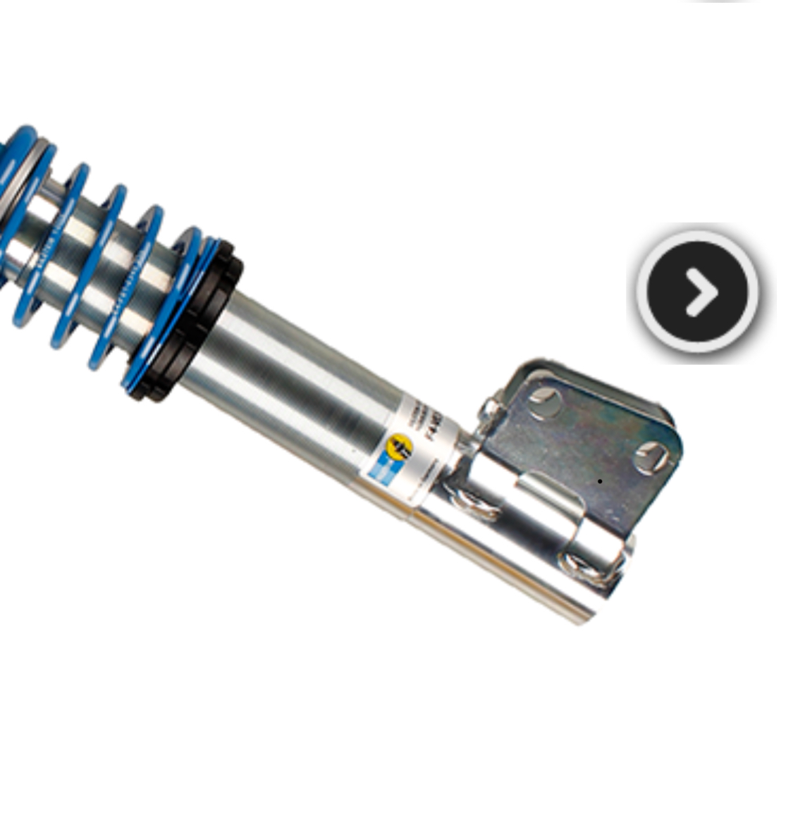

Fitted some camber bolts due to the bilsteins not having a slotted hole for camber.

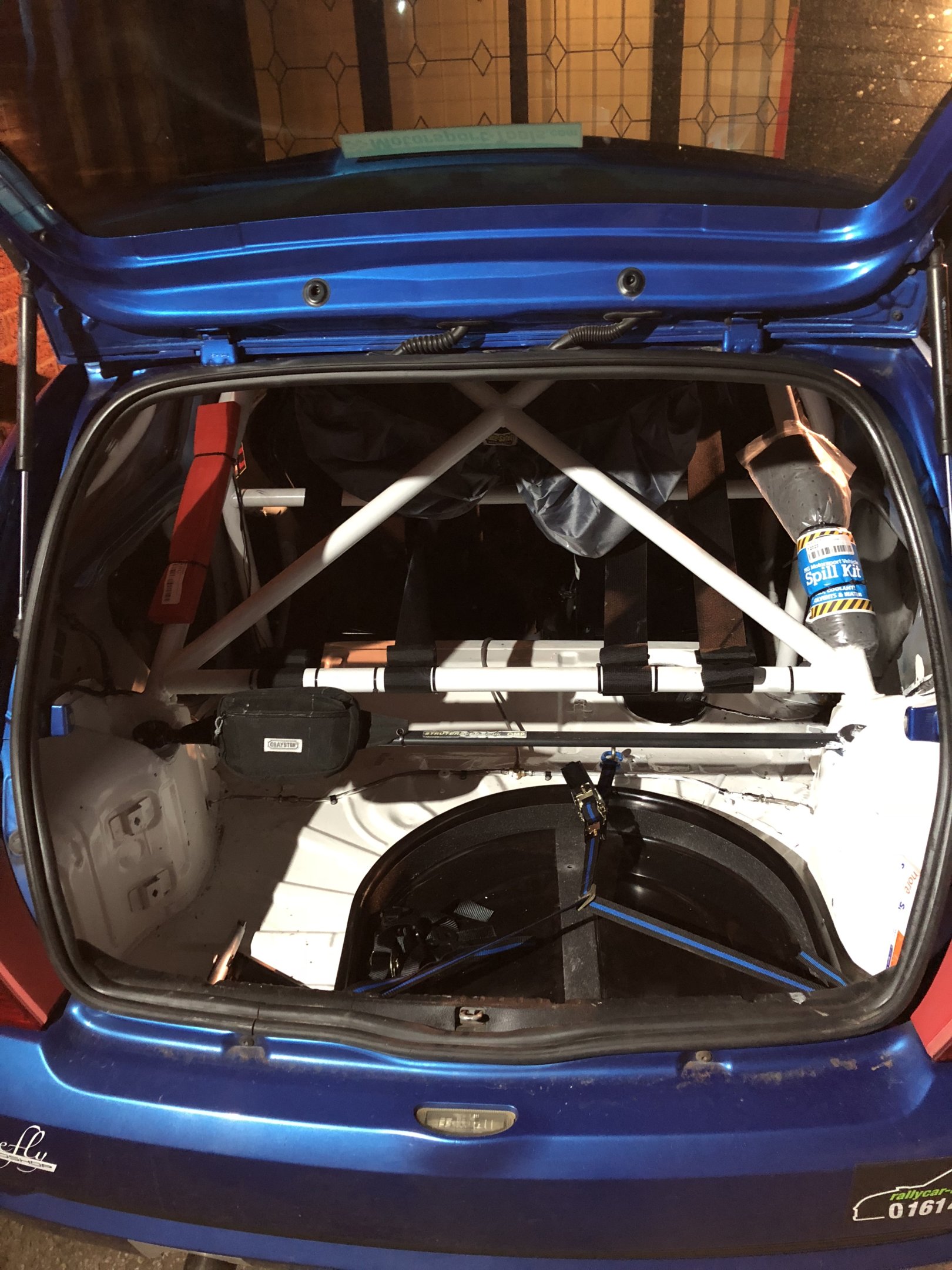

Rear part of the roll cage has been refitted with new spreader plates. I've also painted the rear of the car and spare wheel well.

thought bilstiens were slotted?
I’ve seen some that are slotted and others that aren’t. I’ve set it to max camber at the minute at Anglesey next week so I’ll have a play round with it there. When I had it on track I had a similar camber setting and it handled well.

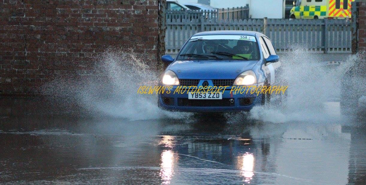

So I was at Anglesey rally track day yesterday. Car was superb all day, only issue I had was the fuel line popping off mid hairpin but nothing some cable ties couldn’t sort out.
There was a couple of clios there. A white 197 that I’ve seen there before and a blue 182 that a pass at the end on this video. It was the last run of the day so I took my cousins daughters boyfriend out.
After today though I need to diff and a lower final drive, but I did catch up and overtake my brother in his 106 cup car which he wasn’t happy about. I’ve got a few more videos that I’m uploading today.

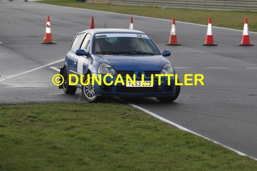

Looks like fun, but also looks like a hell of a lot more wear on components especially tyres, brakes and suspension over a track day, lol.
Looks like fun, but also looks like a hell of a lot more wear on components especially tyres, brakes and suspension.
I did go through 2 tyres yesterday but it was my own fault. I had hankooks that had been cut for wets and I didn’t bother changing them when it dried out. The front tyres were gone in this video.
Wasn’t to bad on the brakes but I wouldn’t do it on track suspension. The bilsteins were pretty good though

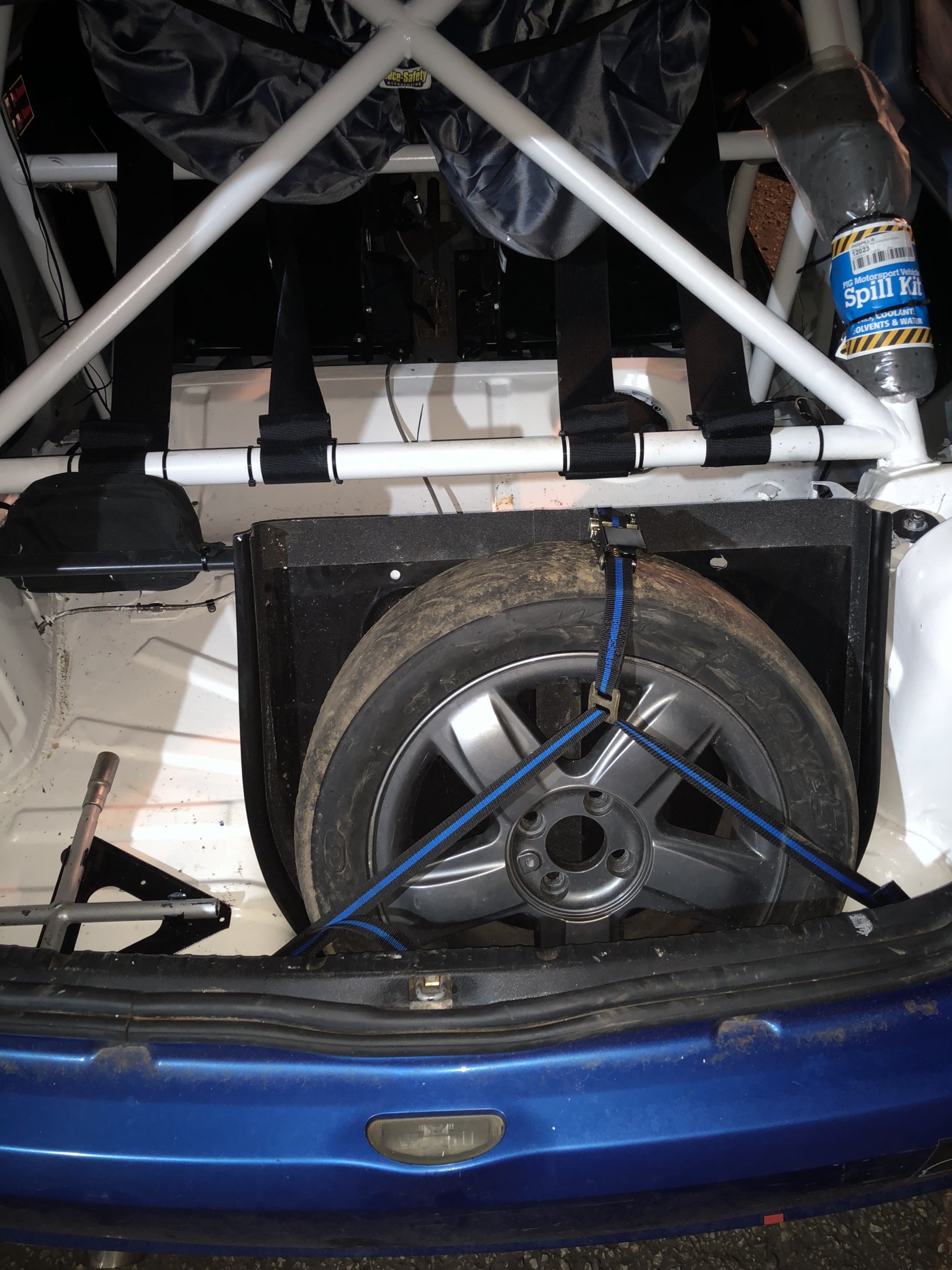

I’ve bought a composite spare wheel holder. Not sure if I’m going to use yet, but I might bolt it in over the 172 wheel well. I won it on eBay for not a lot so I’ll sell it if I don’t end up using it.

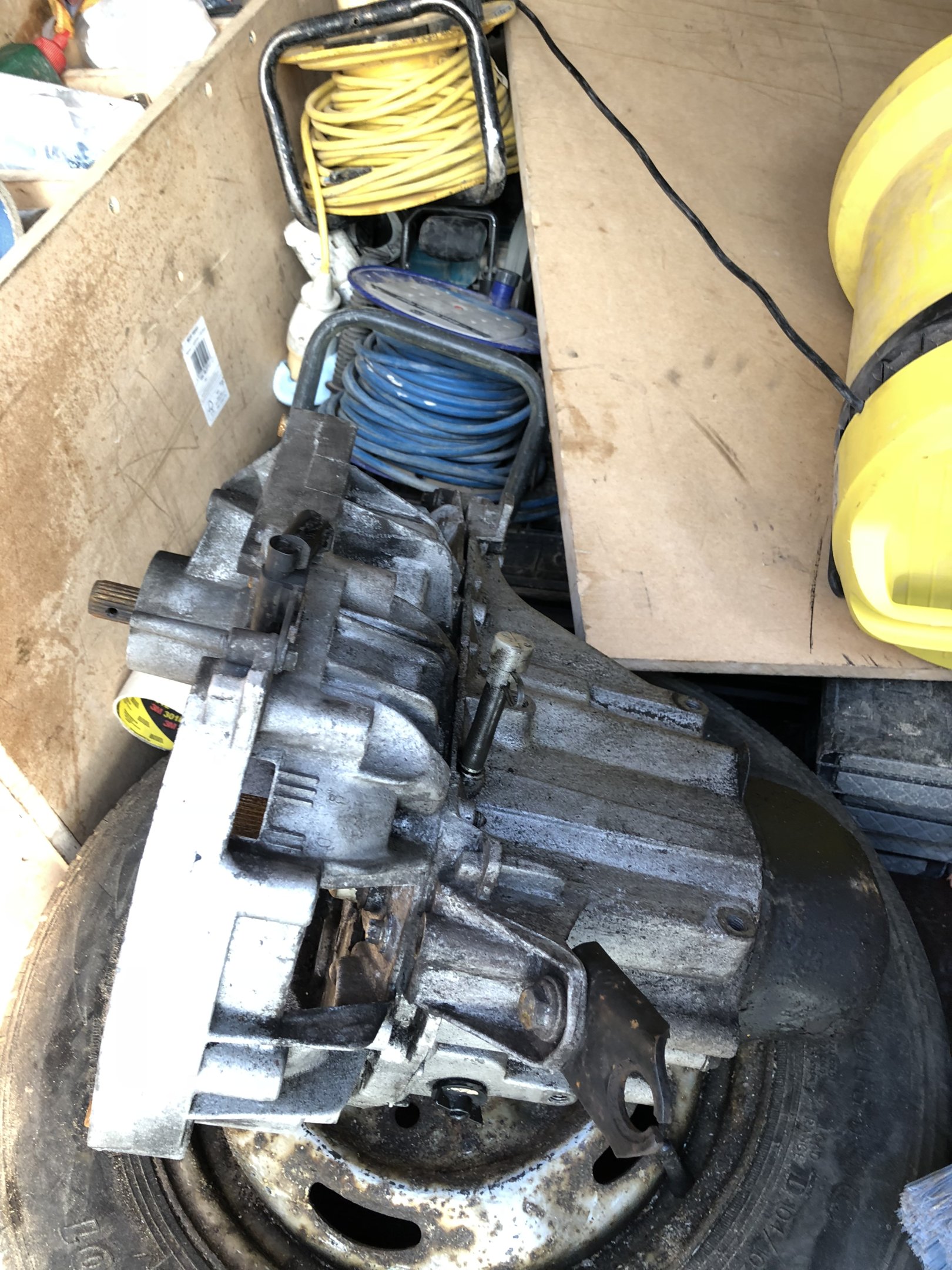

I’ve also picked up a 129 gearbox so that can be rebuilt and a gripper Diff and lower final drive fitted

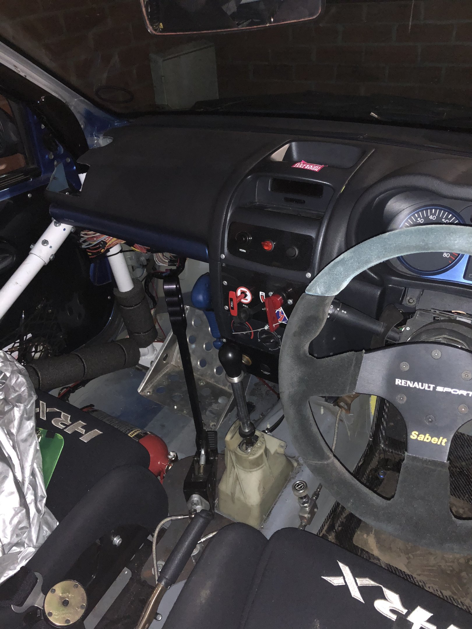

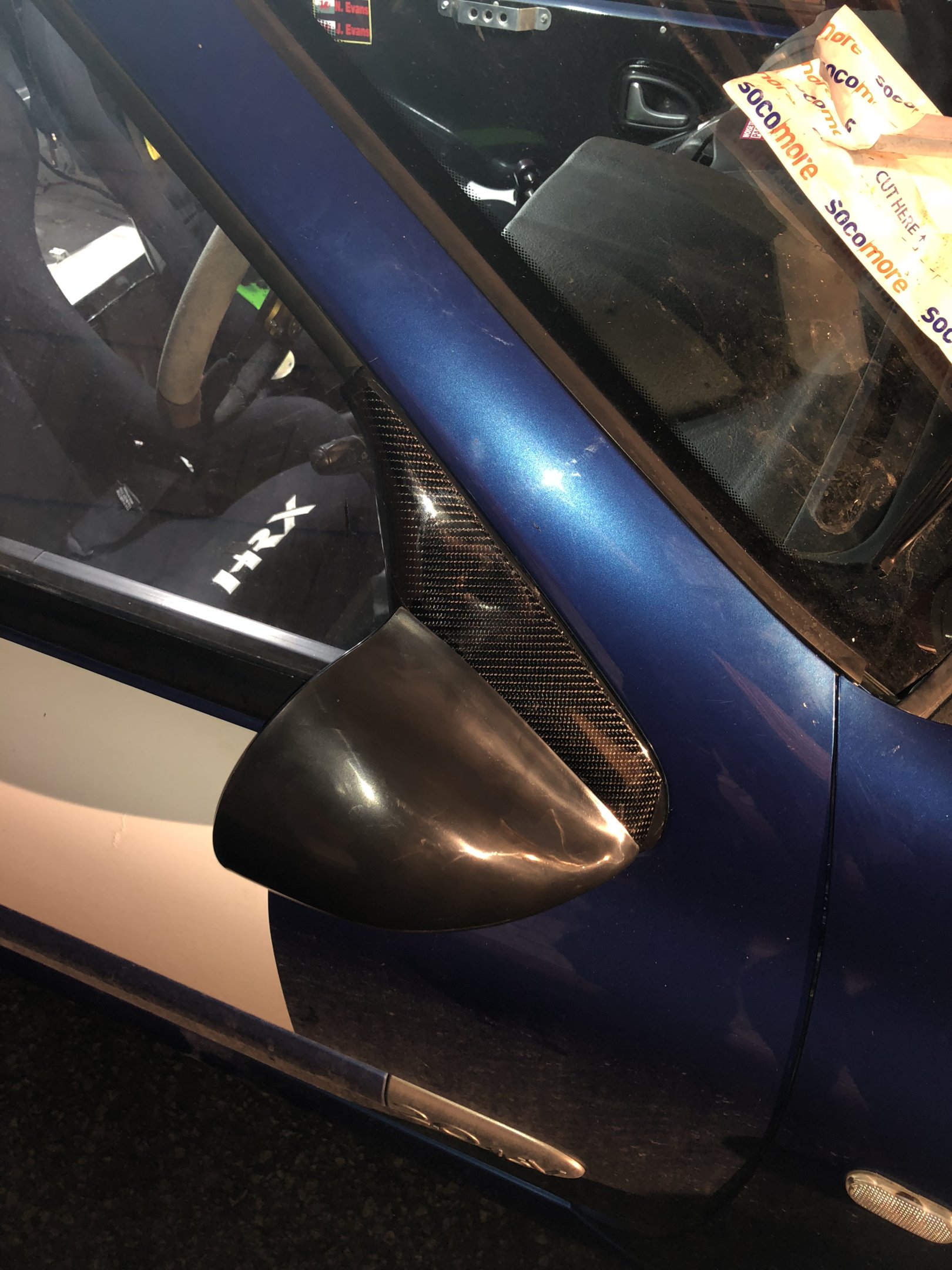

So fitted the cheap eBay wing mirrors. I ended up damaging one whilst I put it on nothing a bit of cheap carbon wrap couldn’t hide. I’m probably going to rip them off on the first chicane anyway

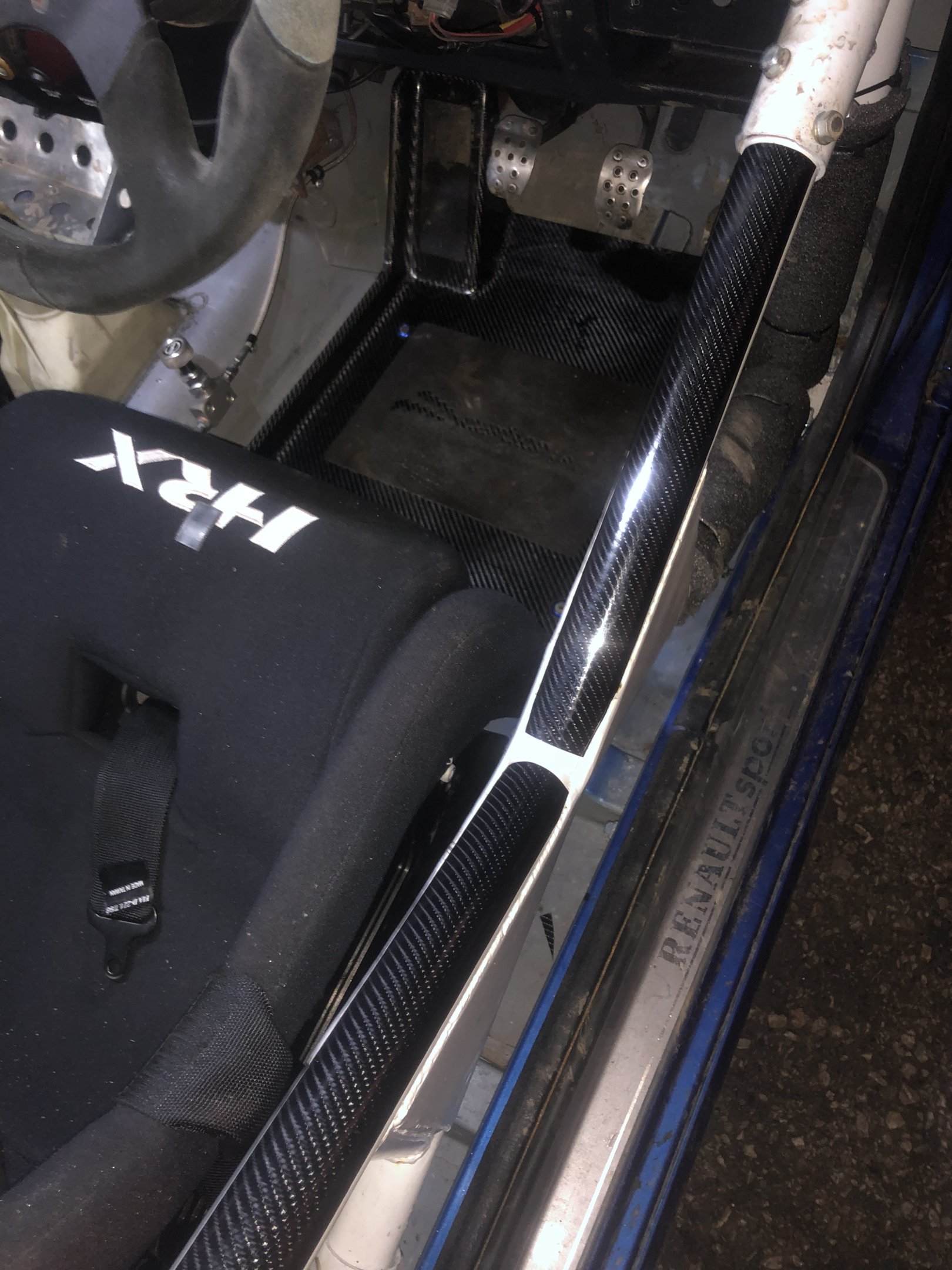

Whilst the wrap was out I decided to wrap the door bars on the cage
Bolted in the wheel brace. Then again played around with mounting the spare wheel

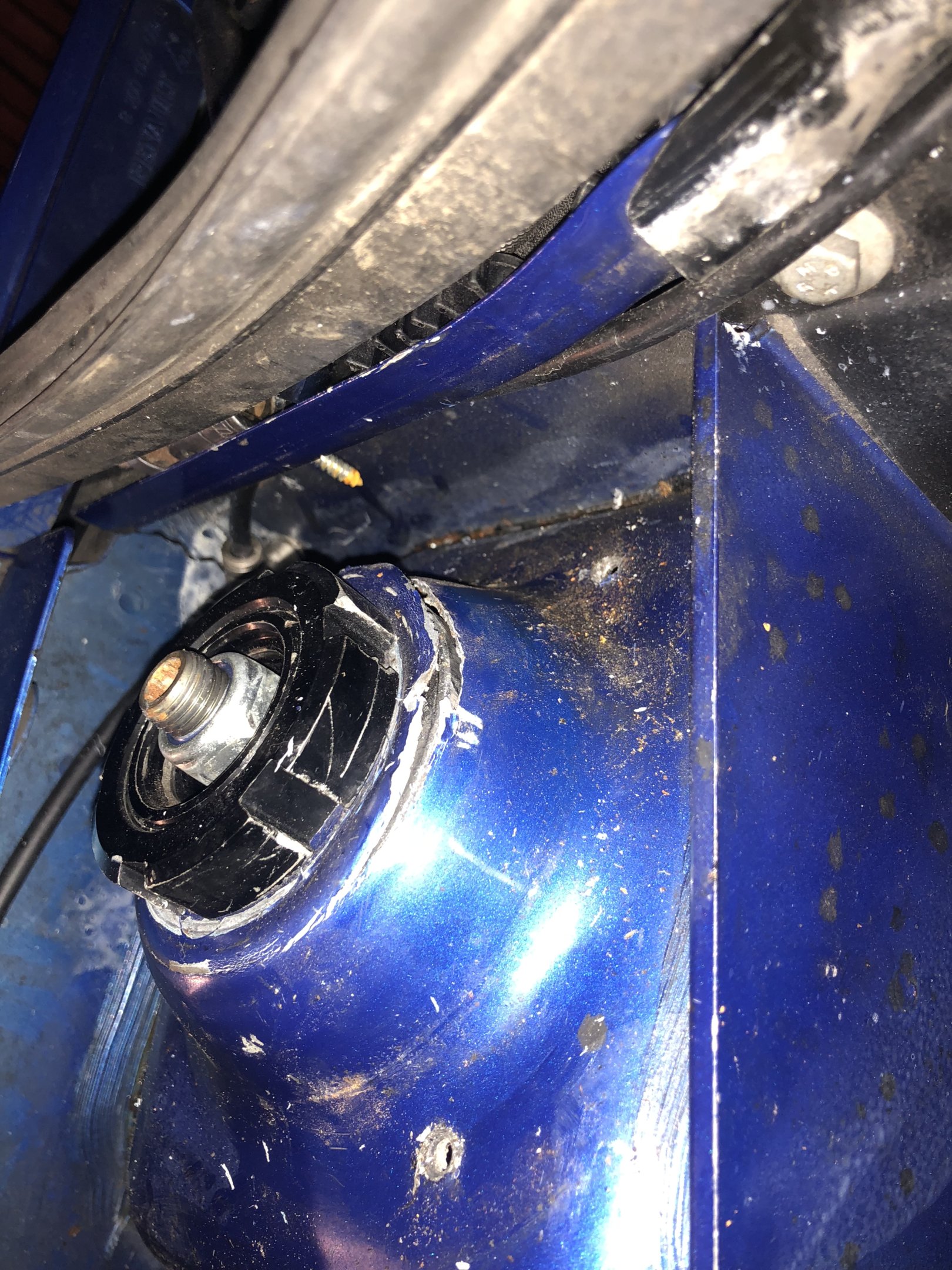

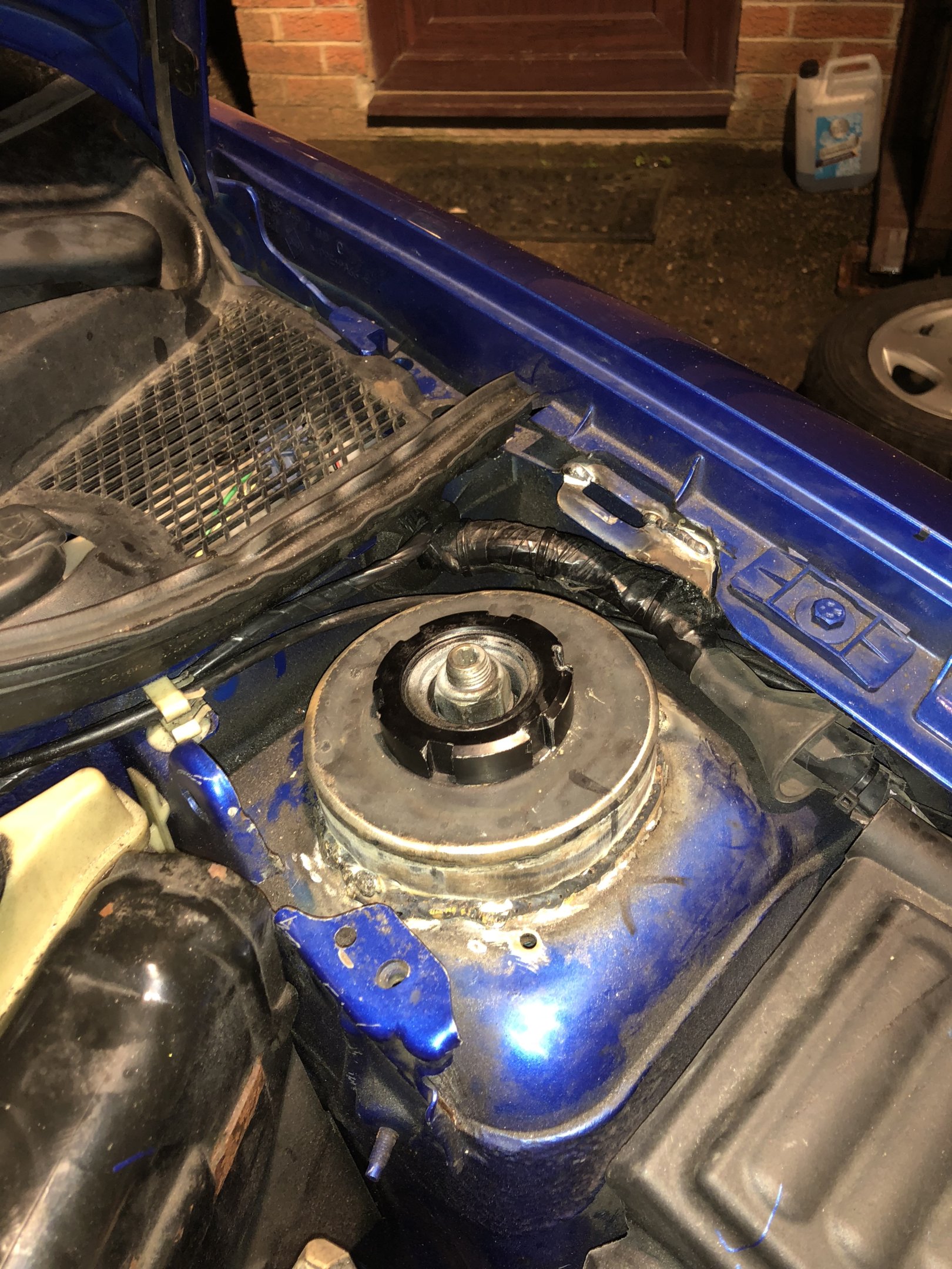

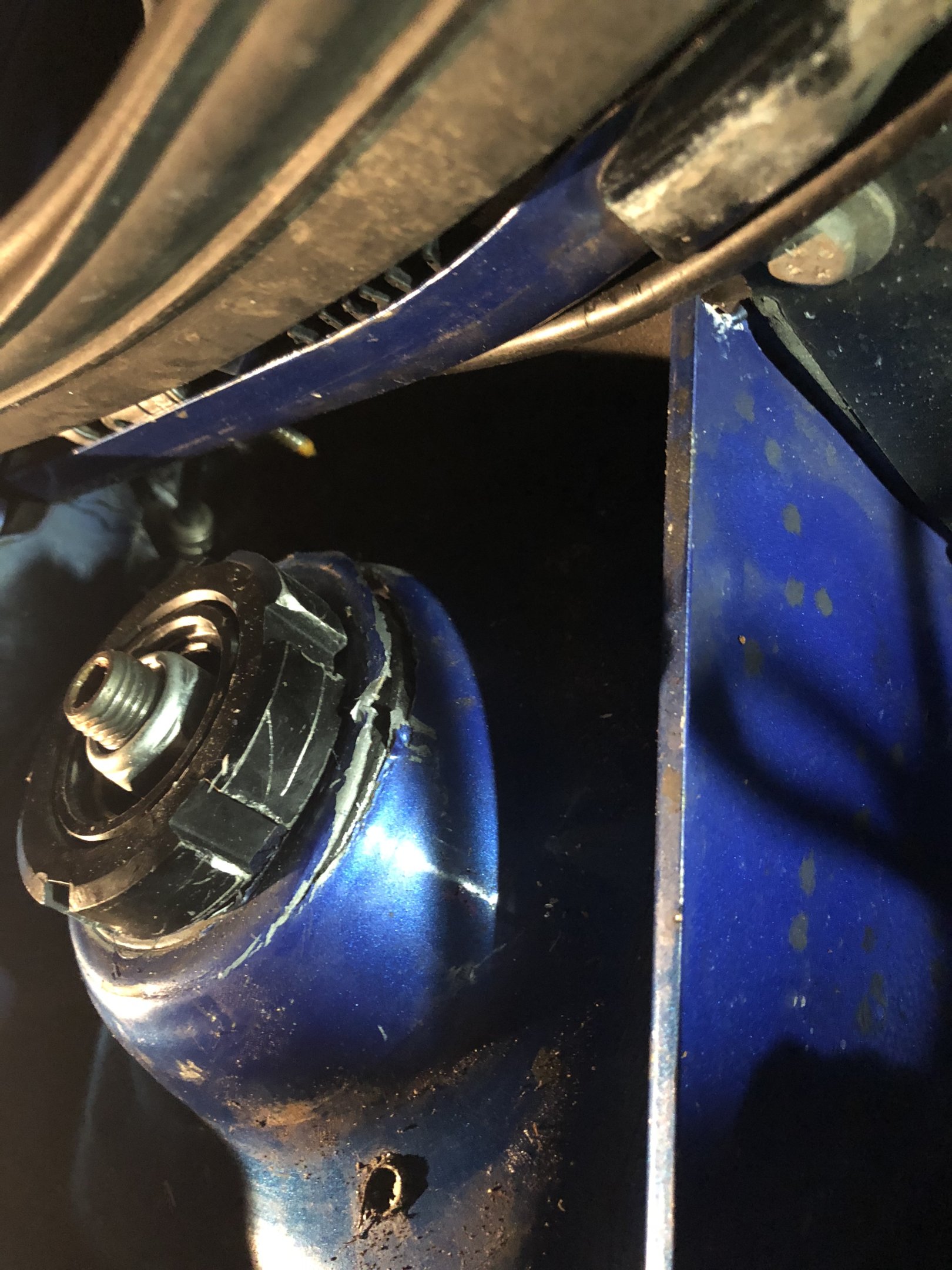

Whilst working on the car tonight I noticed this........
So this now needs welding ASAP with a strengthening plate welded over that. Was meant to be having an mot tomorrow then oil and filters next week. The Agbo stages is only 2 weeks away now
Only hardish landing is the silly jump at Anglesey , but I braked every time I went over it. I’m going to order some longer springs for the front.

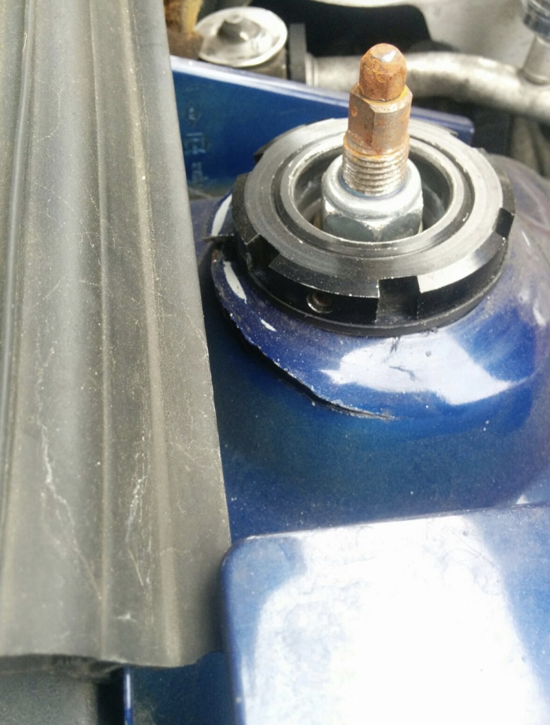

I did put a picture of it on Facebook and a guy with the same gaz mounts as mine has the same problem with the drivers side turret
Interesting. I wonder if the Gaz top mounts strain the body somehow.
Has @Pauleds strengthened his top mounts? His car has done a few events ok. If his has survived, it might suggest that the Gaz mounts are an issue.

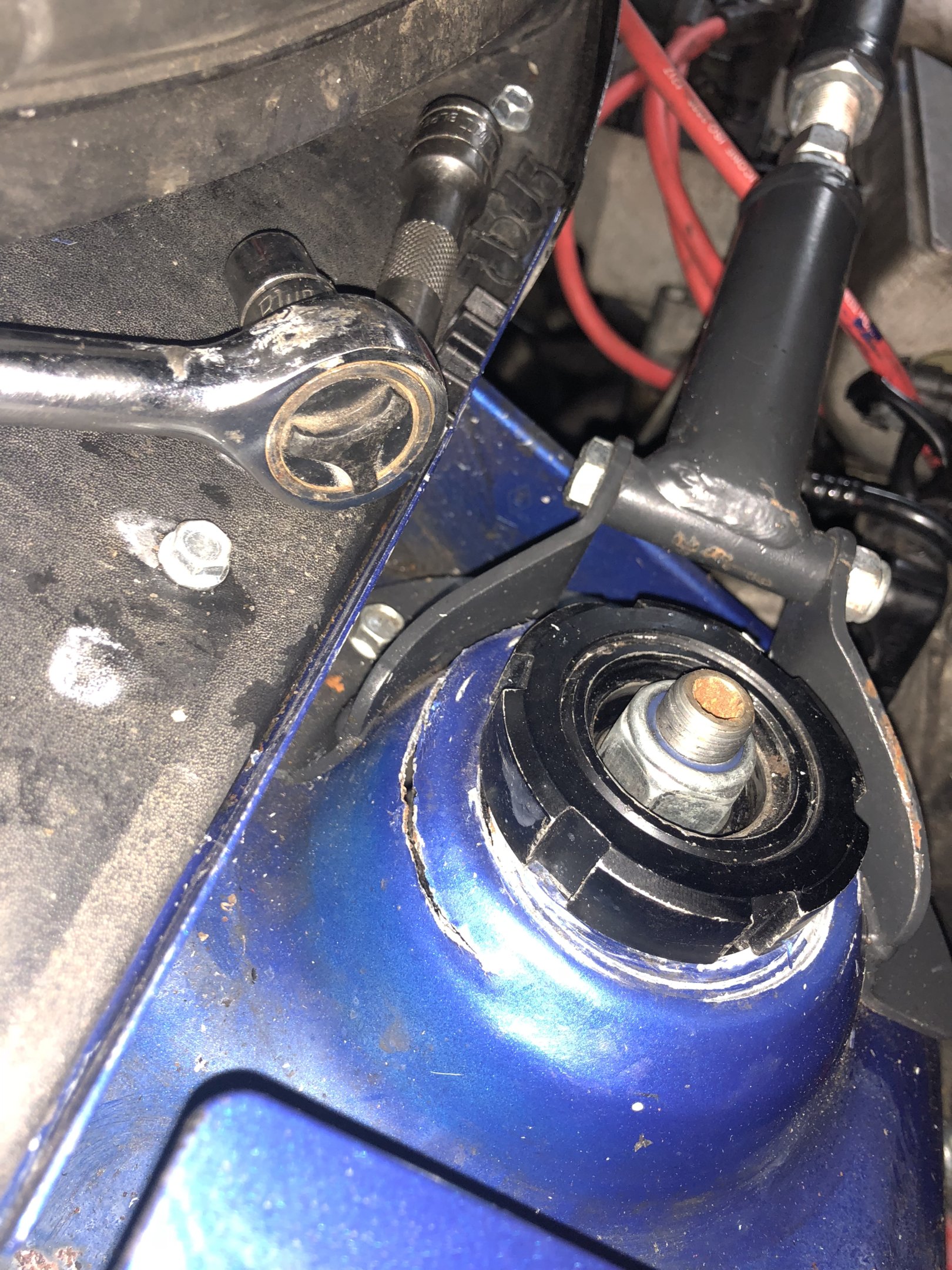

So the top mounts are sorted. They don’t look the prettiest but they’ll do until the engine bay gets sprayed.

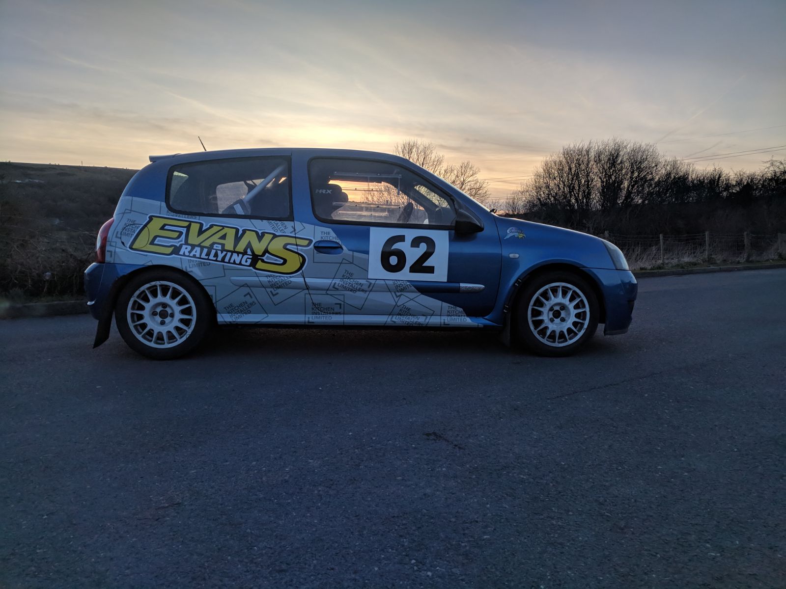

Mine and my brothers cars get some decals yesterday ready for the AGBO stages on Sunday.
