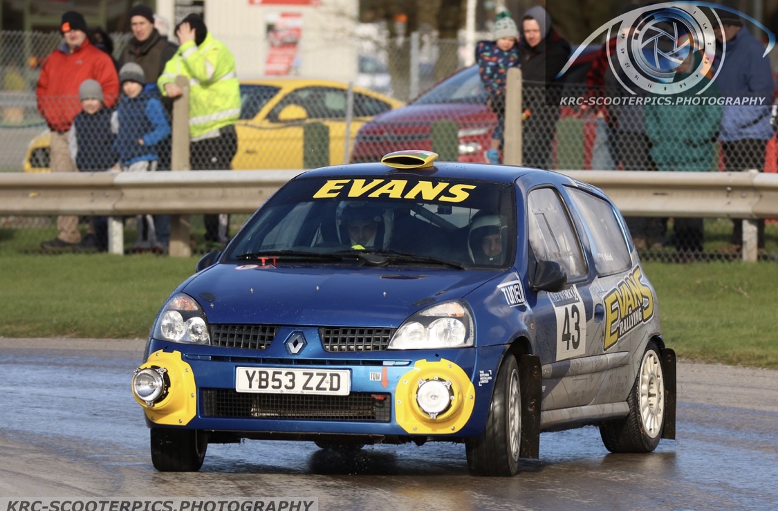

Few bits from our rally track day yesterday.
Another snapped inner CV too. Give the new shaft death and so far so good

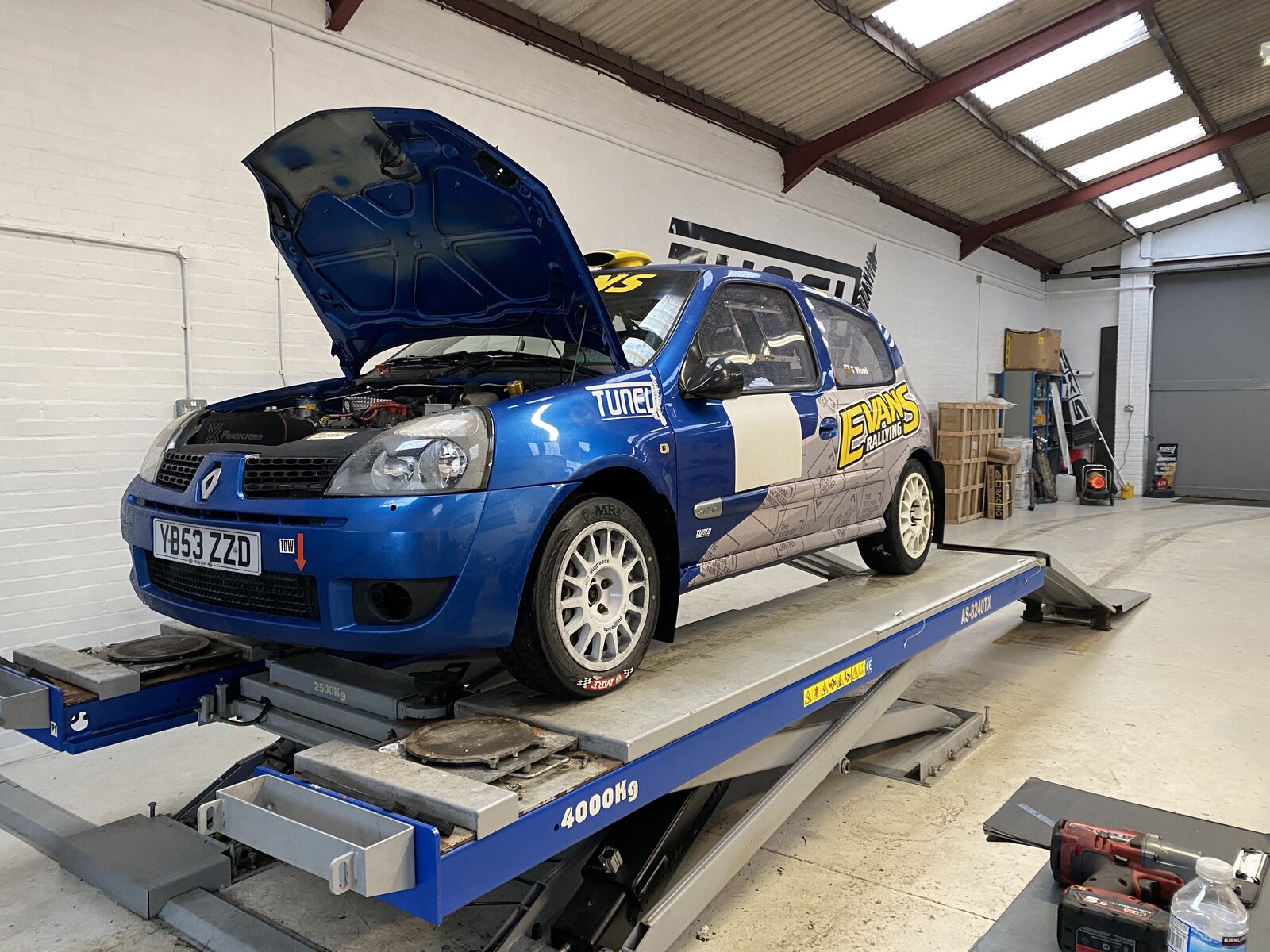

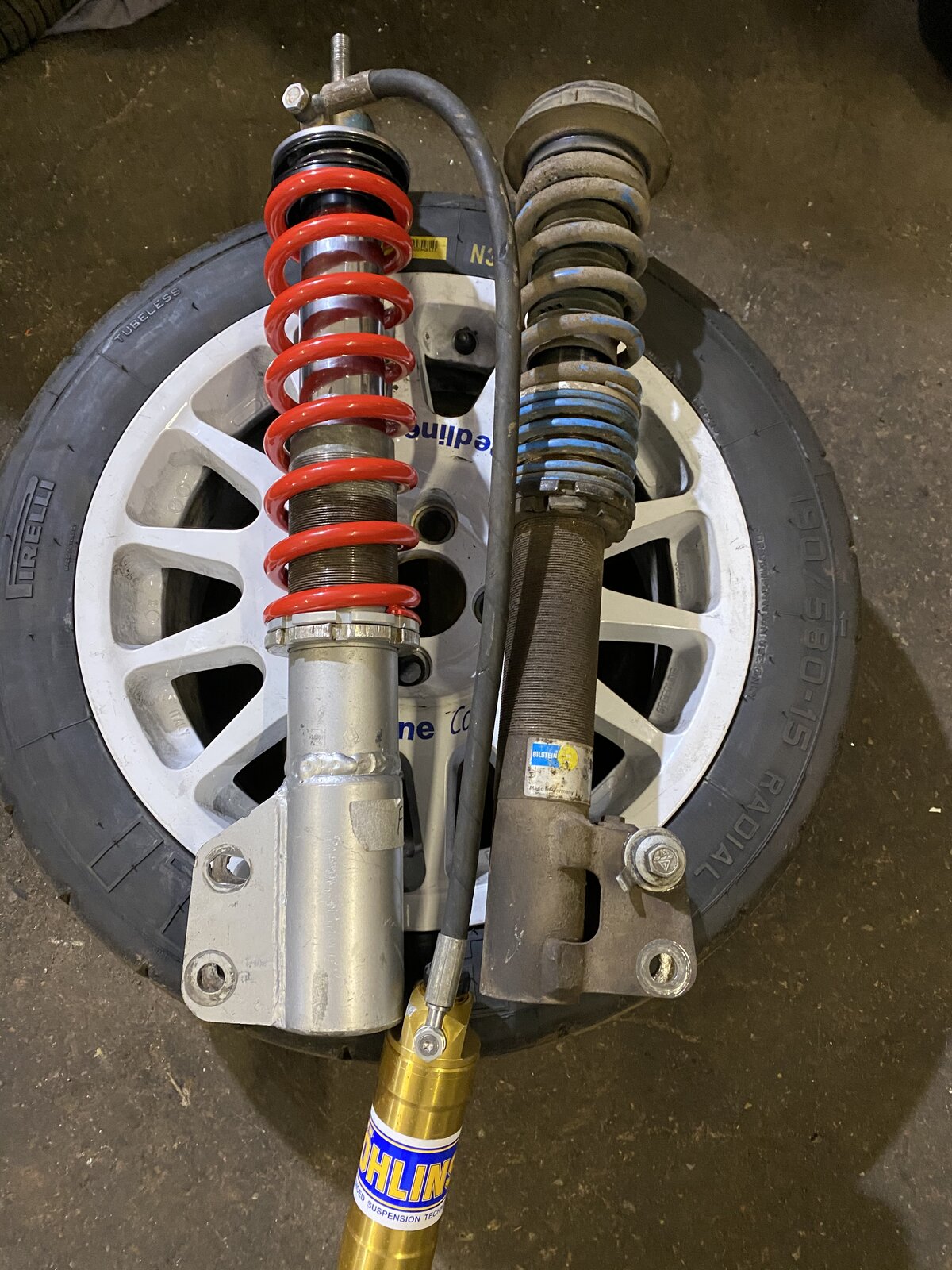

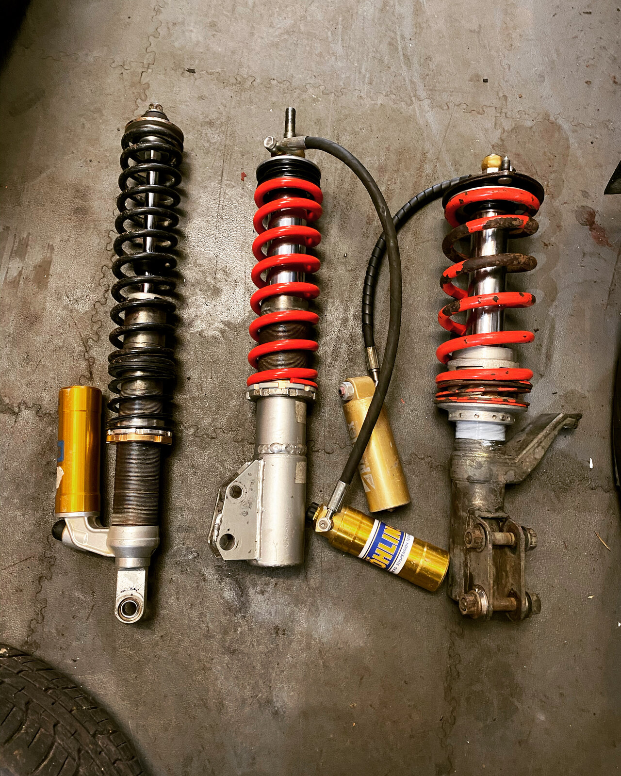

Some nice upgrades coming for this year. I’ve finally had the ohlins fully rebuilt and serviced. It cost a fortune but this is going to transform the car on the closed road rally’s as this year I’m competing in the msuk asphalt rally championship so the suspension upgrade was needed.

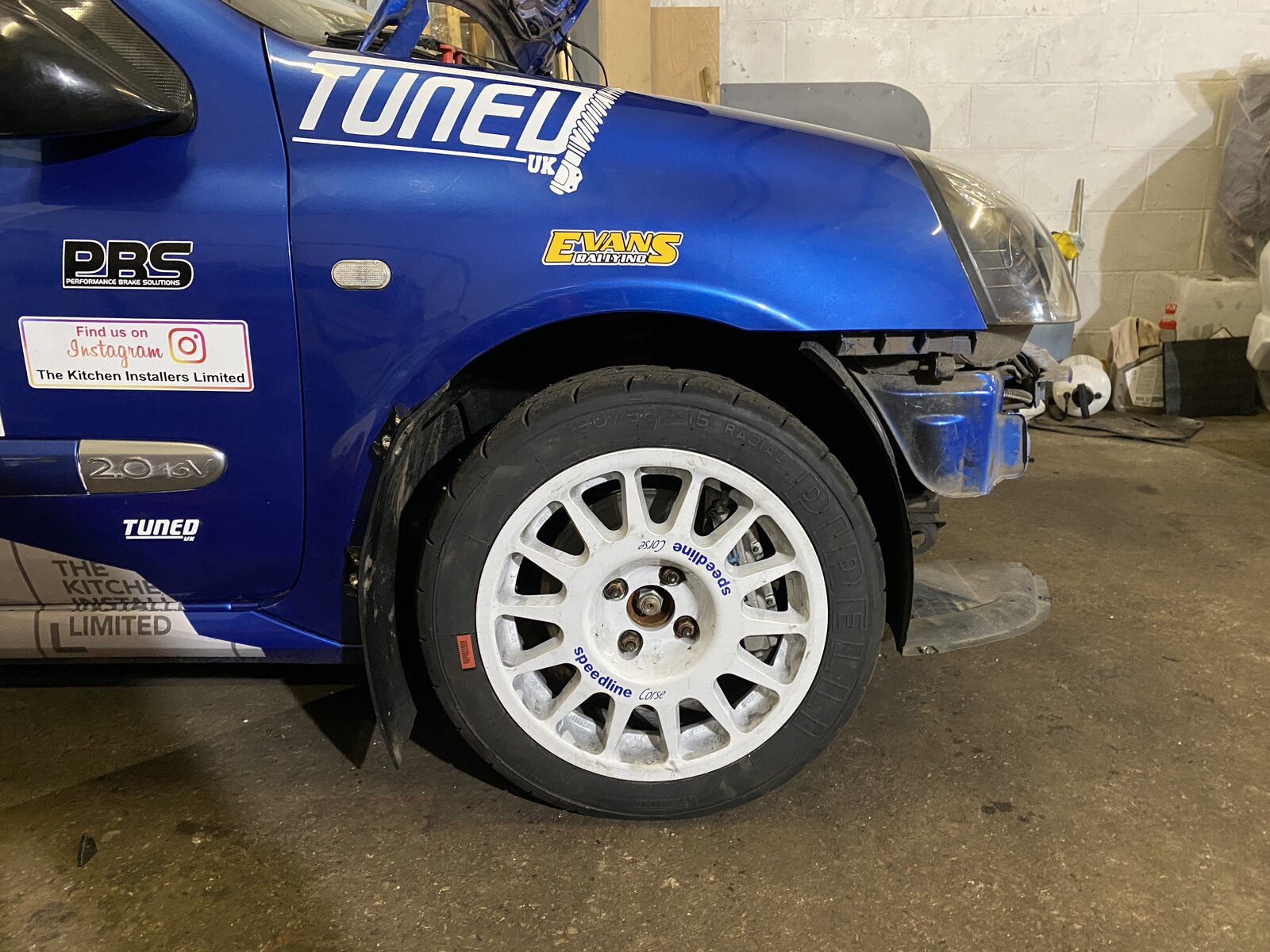

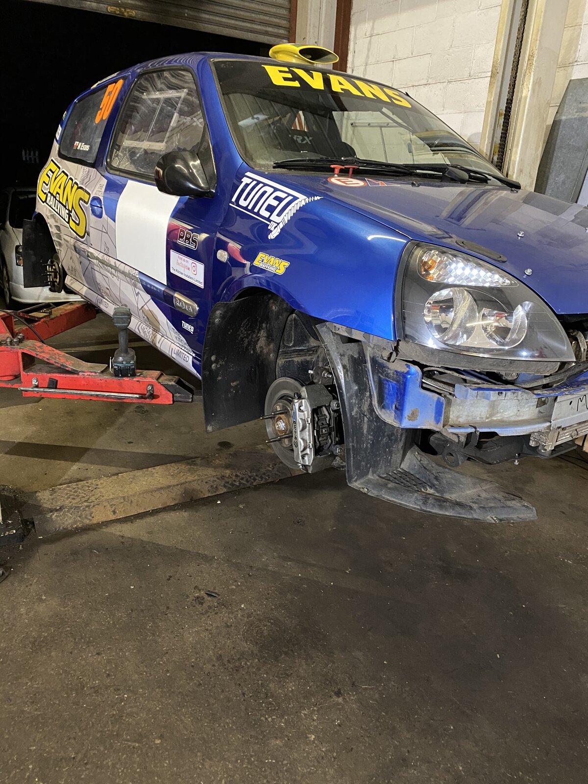

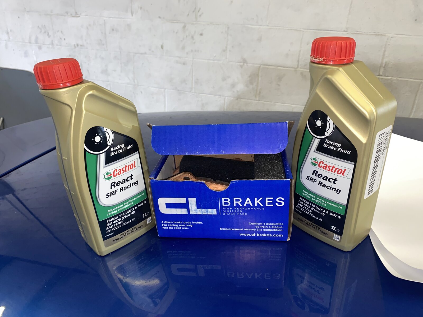

I’ve also fitted a new water pump and belt, new dust seals in the brembos, new CL6 pads, HC discs, new genuine Renault rear discs, BRT Motorsport rear brake lines due to needing to route the brake lines slightly differently with the wider coilover on the rear, 10mm stub axle spacer so that the inside of the wheel doesn’t touch the shock. I’m still running the 172 cup stub axle as the 182 stub and spacer would be way too wide.

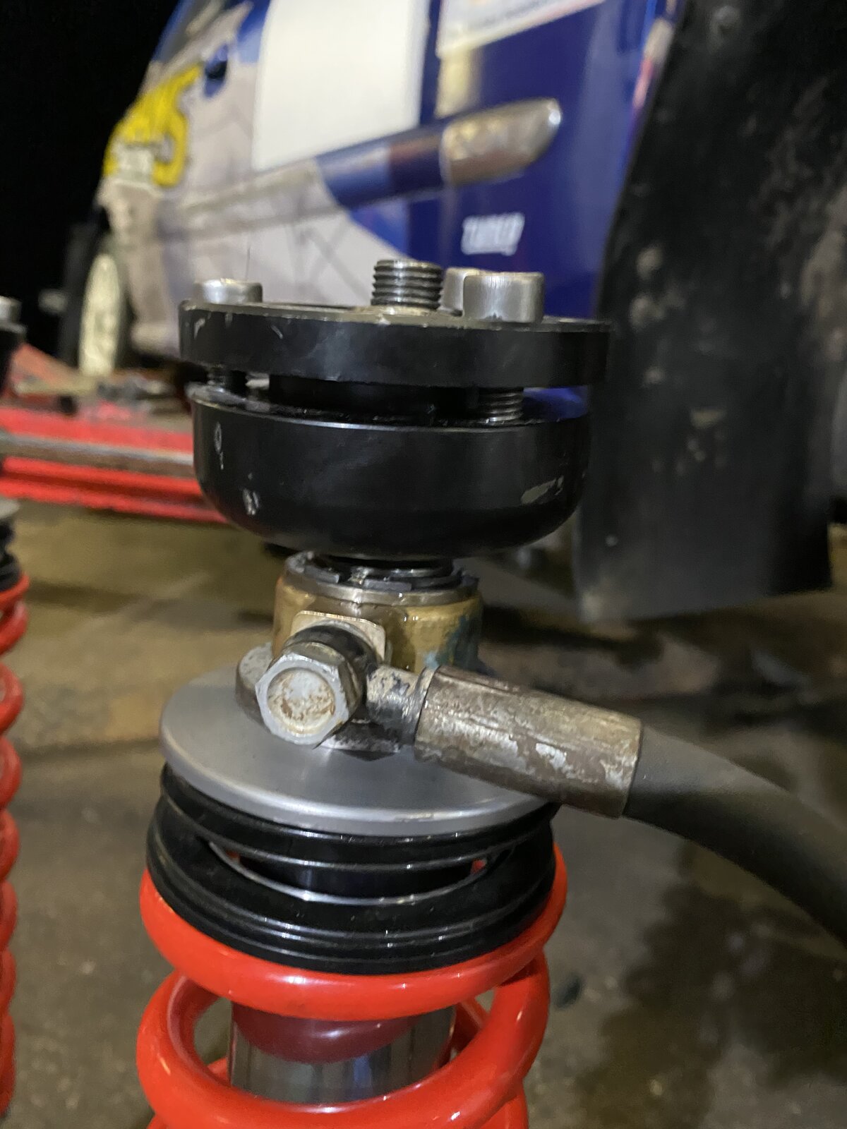

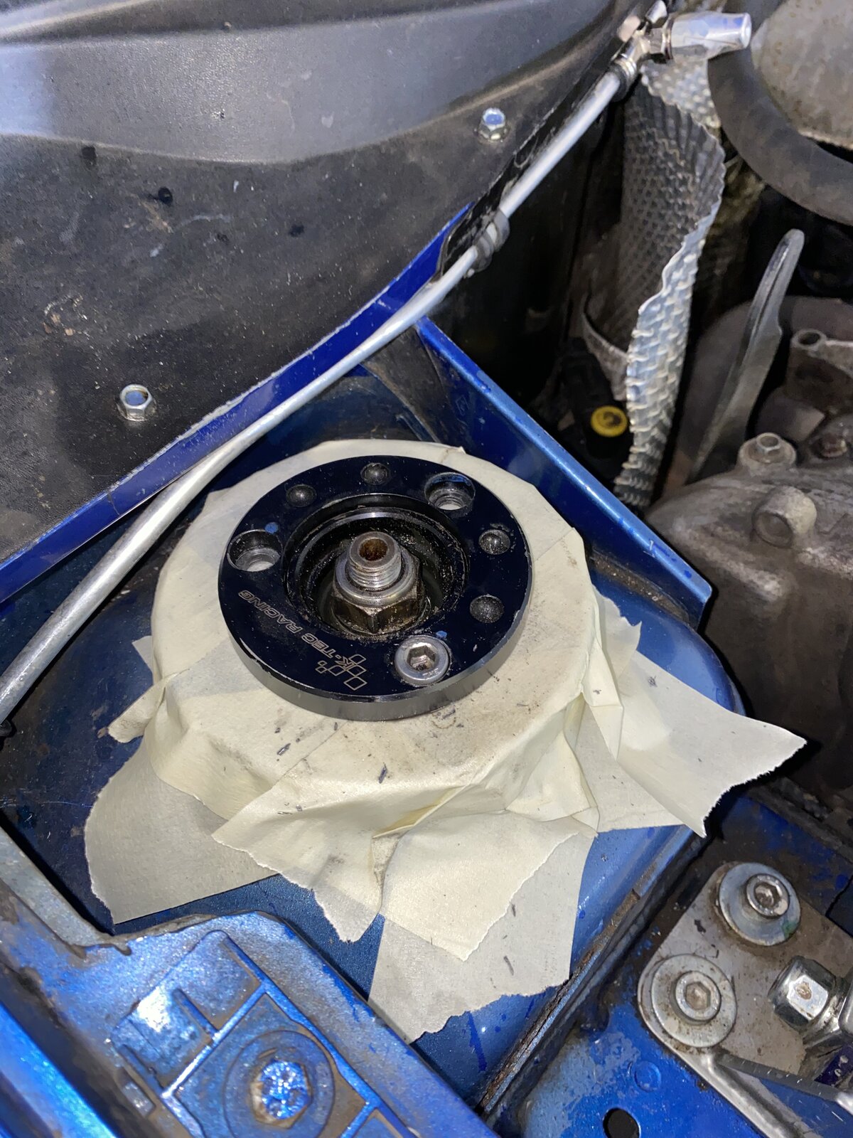

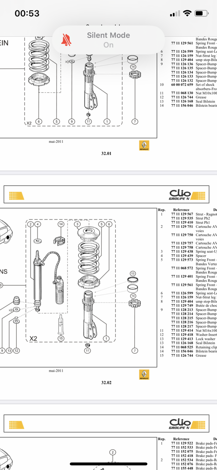

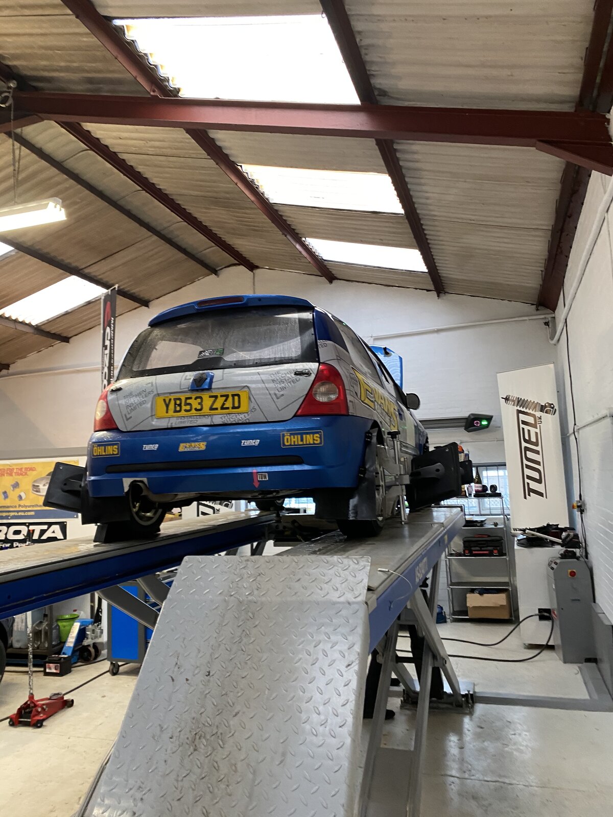

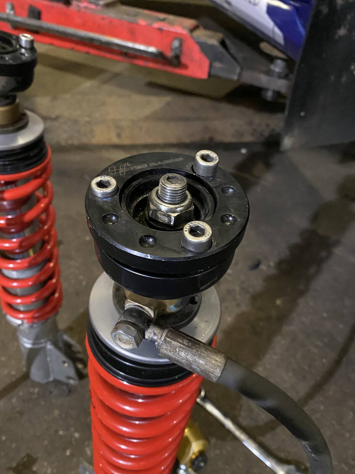

Few issues already. I was missing 2 spacers that go on top of the shock. So had to use some spare Ktec mounts as these worked without the spacer. Number 4 I’m missing
The fronts will be coming off tonight just remove the helper springs as the cars still too high at the front.

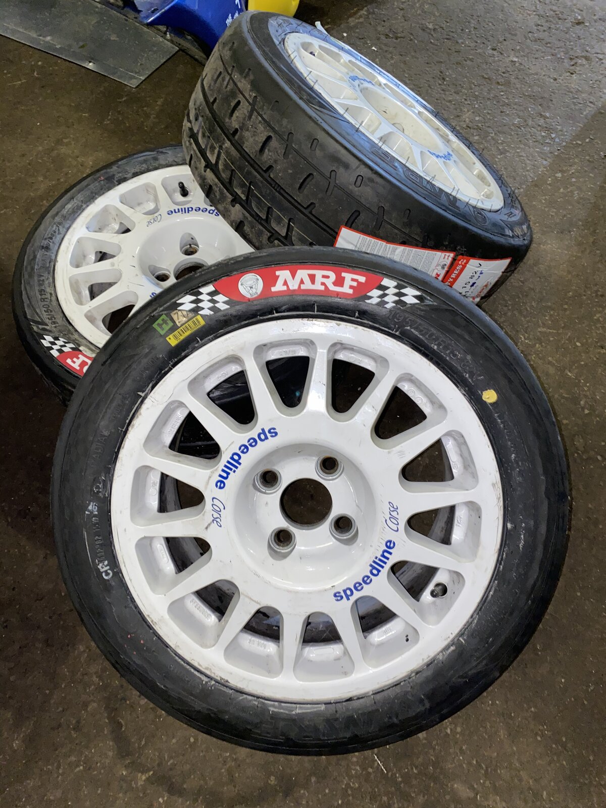

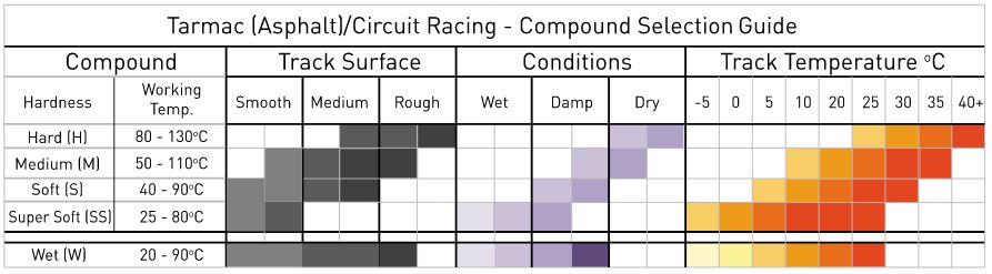

Got the tyres on ready for the weekend but I think they’ve made a mistake with the compounds, I have a wet compound and looking at the big H, a hard compound when really I needed soft. 😳

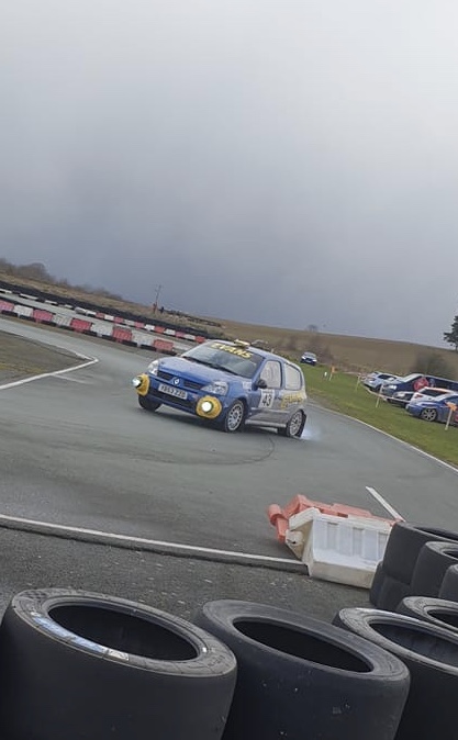

It was fun, a little different to a stage rally. It ran more like a targa, I’d of liked a few more miles on the test stages and a little better maps of the test too, some of it was like driving blind, but other than that it was full. I was on the handbrake all day 😂

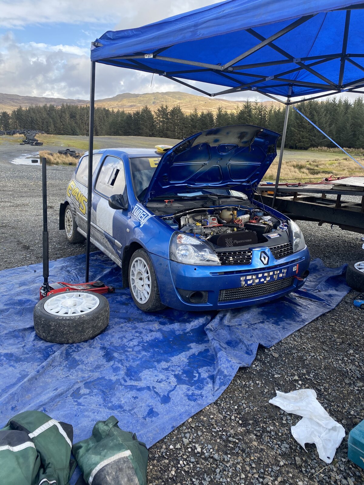

Coronavirus put a stop on the first rally of the year but we still had a test yesterday, was still good to get out in the car and tweak a few more bits with the suspension.

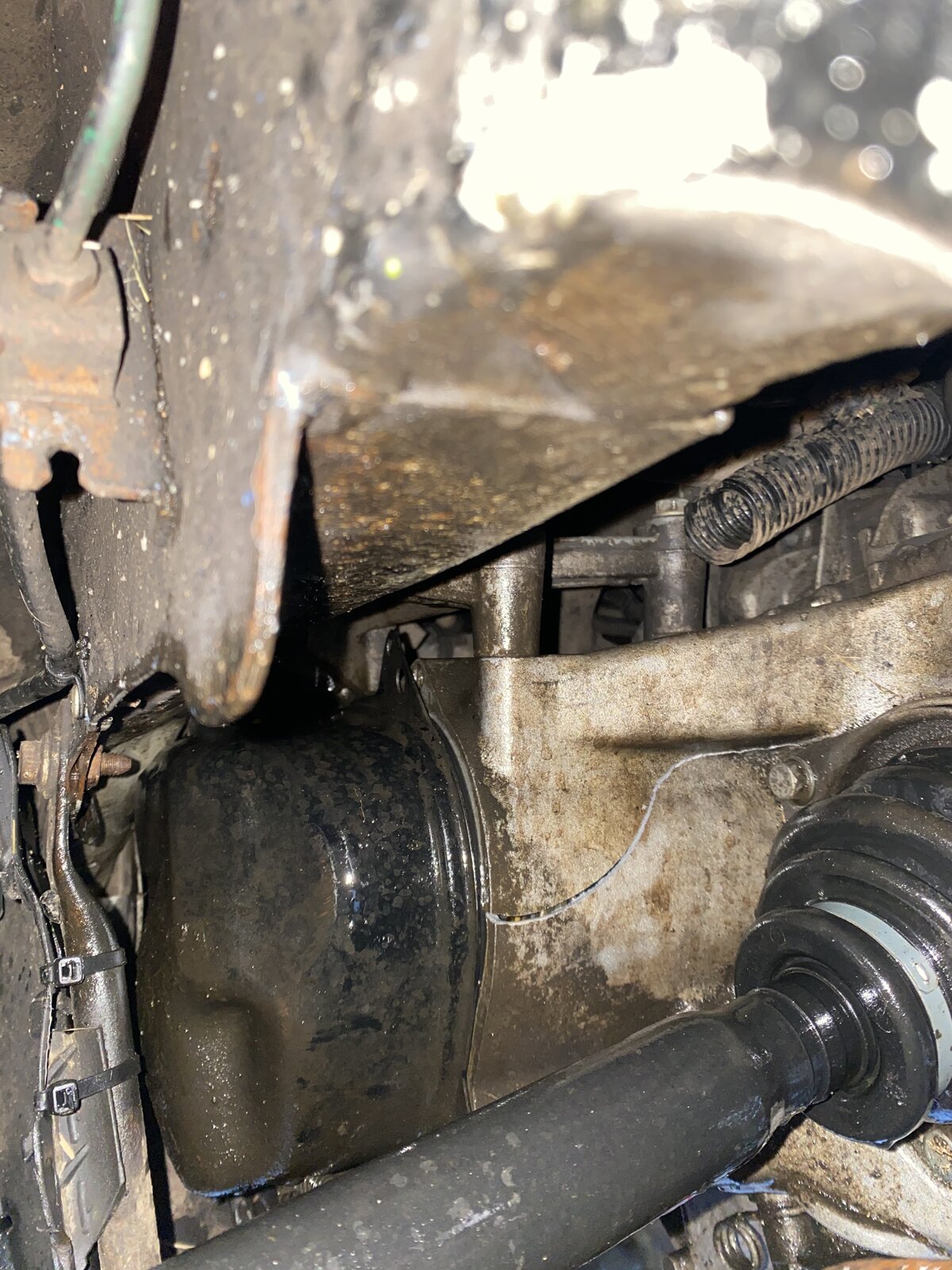

It ended a little earlier than planed. Big bang and it jumped out of gear and on further inspection I’d split the gearbox casing

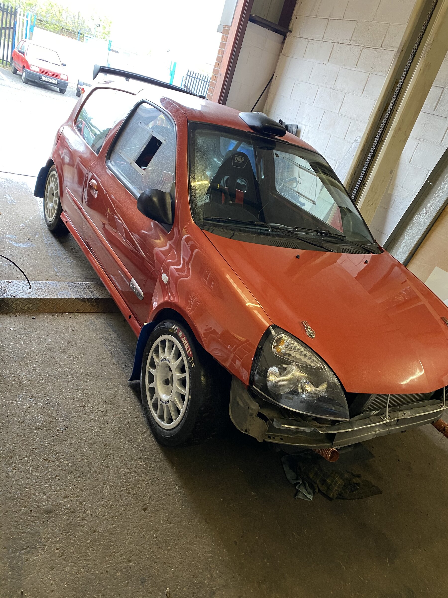

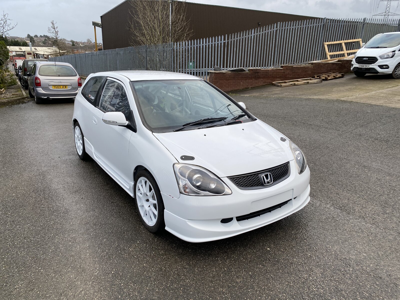

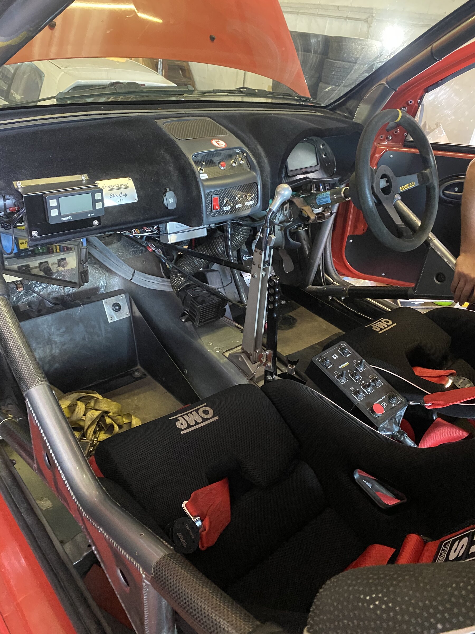

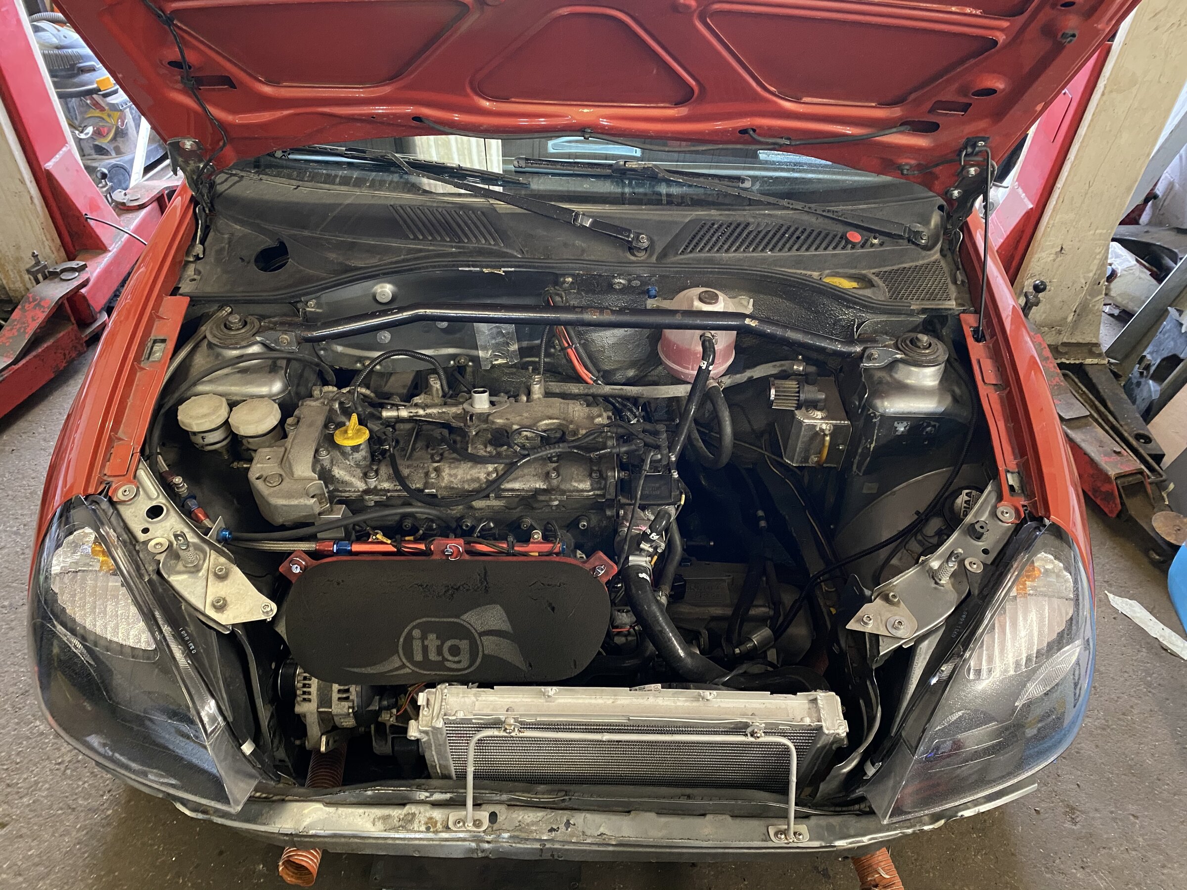

So having all this time off from rallying due to the virus I’ve ended up buying another clio.
This ones an ex cup racer that’s now a rally car. It needs work but with a few bits from my blue car I should have a fairly decent package for 2021

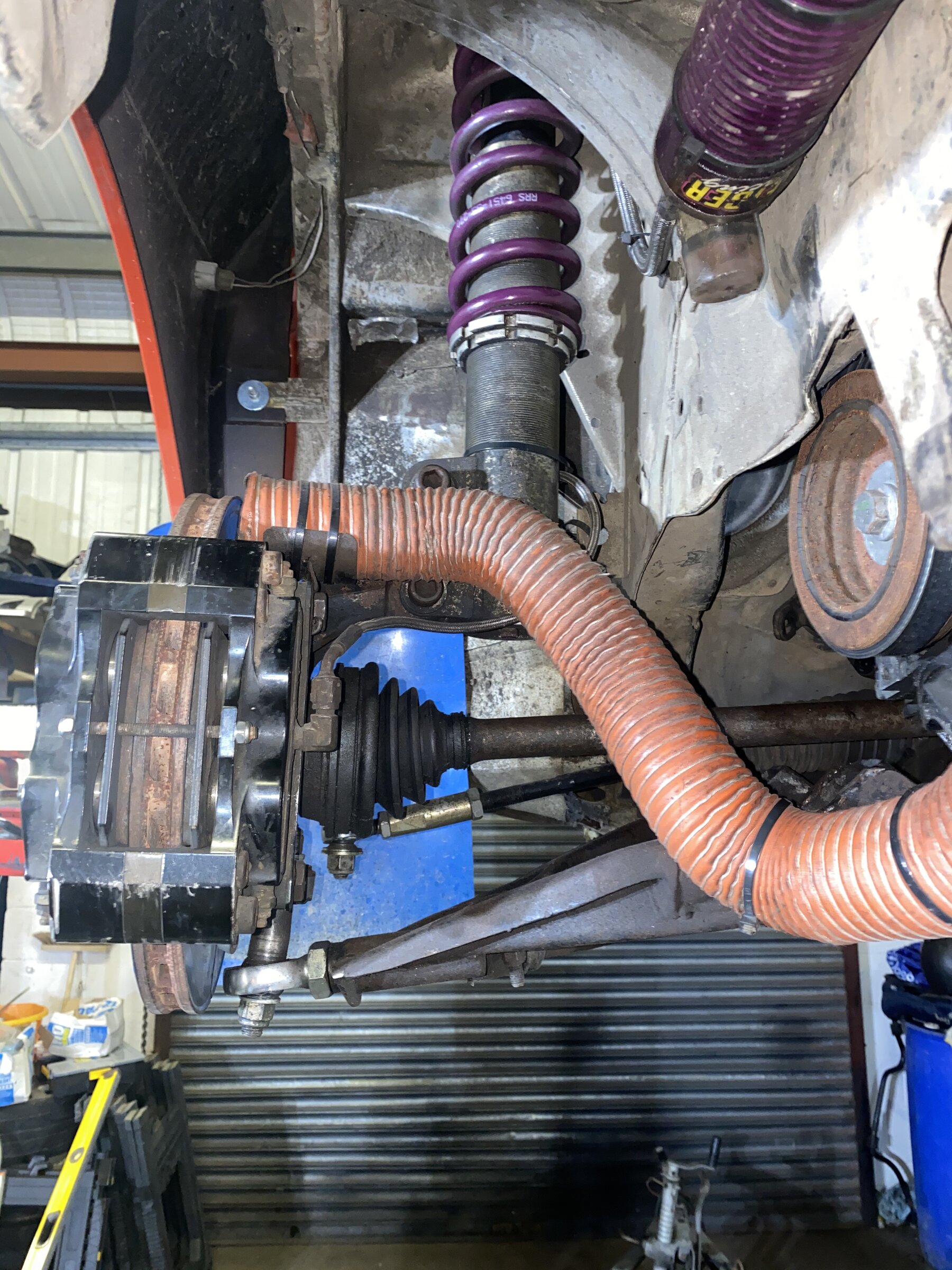

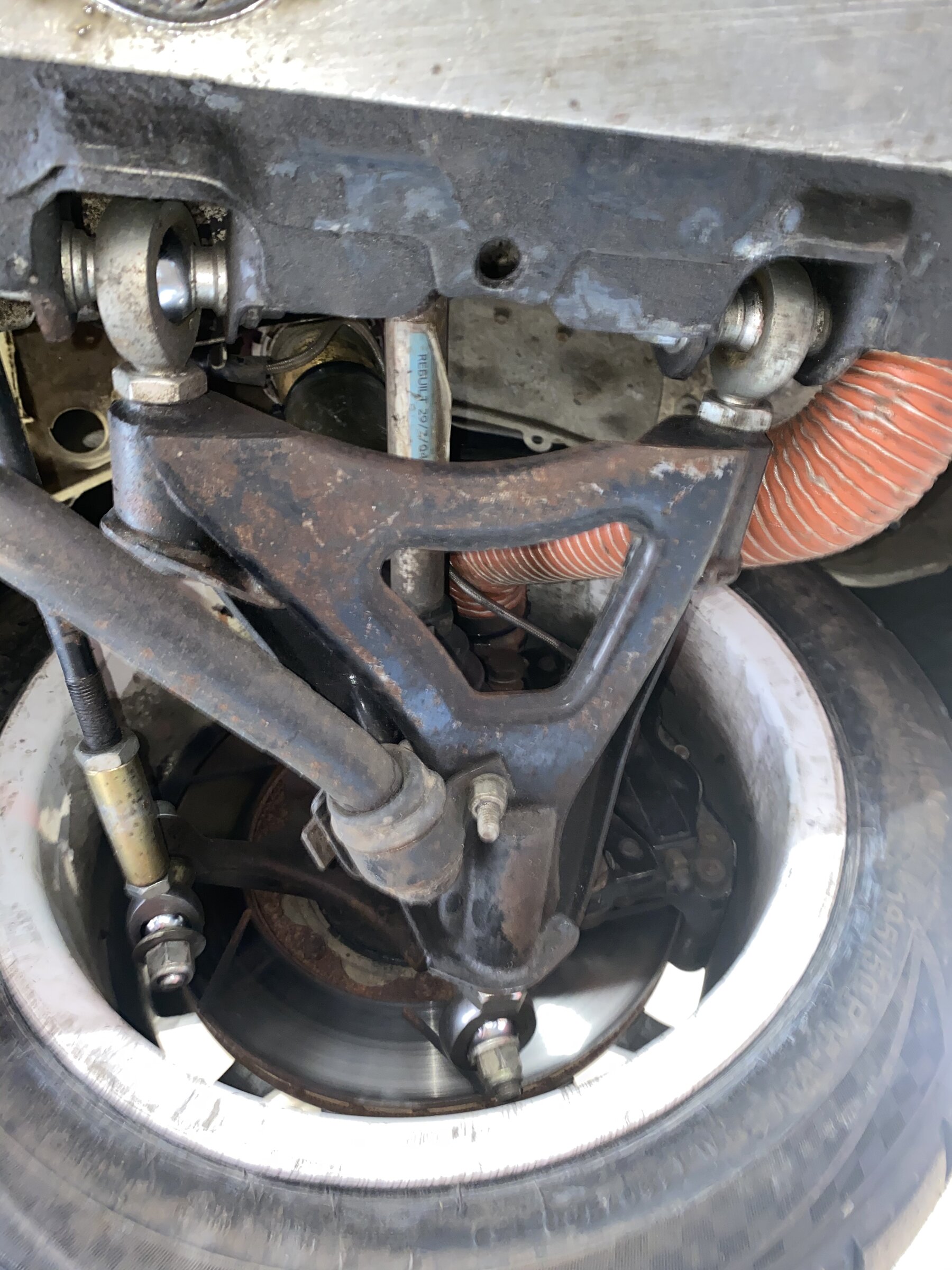

View attachment 1473126View attachment 1473127View attachment 1473128View attachment 1473129View attachment 1473130View attachment 1473131
I find the spoiler offends me. Lol
Should be a cracking upgrade this. A really good step up in performance. Lower arms are interesting. I like the rod end bearings on the inner joints, but using them on the outers would worry me a bit. Have seen them shear on heavy landings when used like that, as it puts a lot of shear stress on them.
