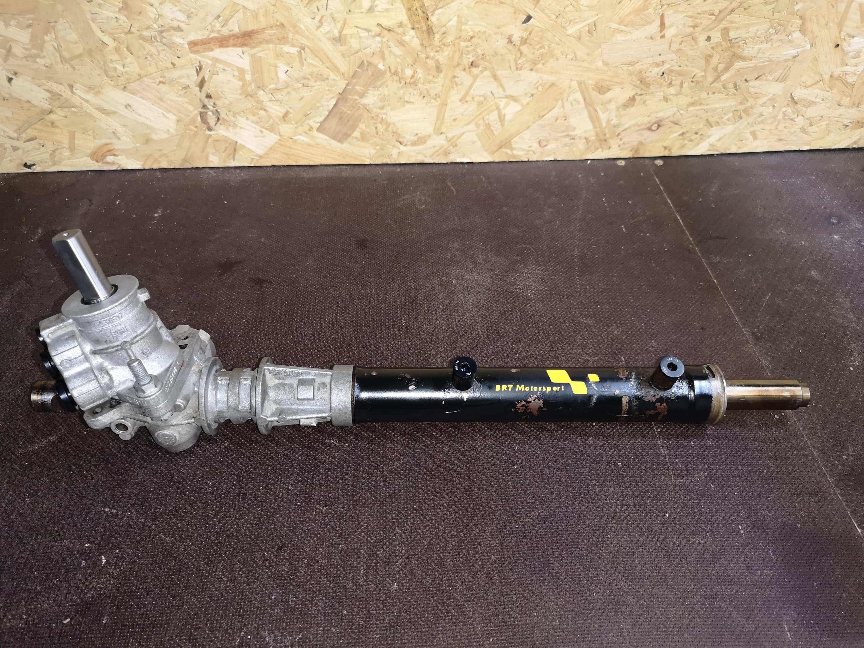

Quick rack from @BRT Motorsport
Very excited to get this on with epas.

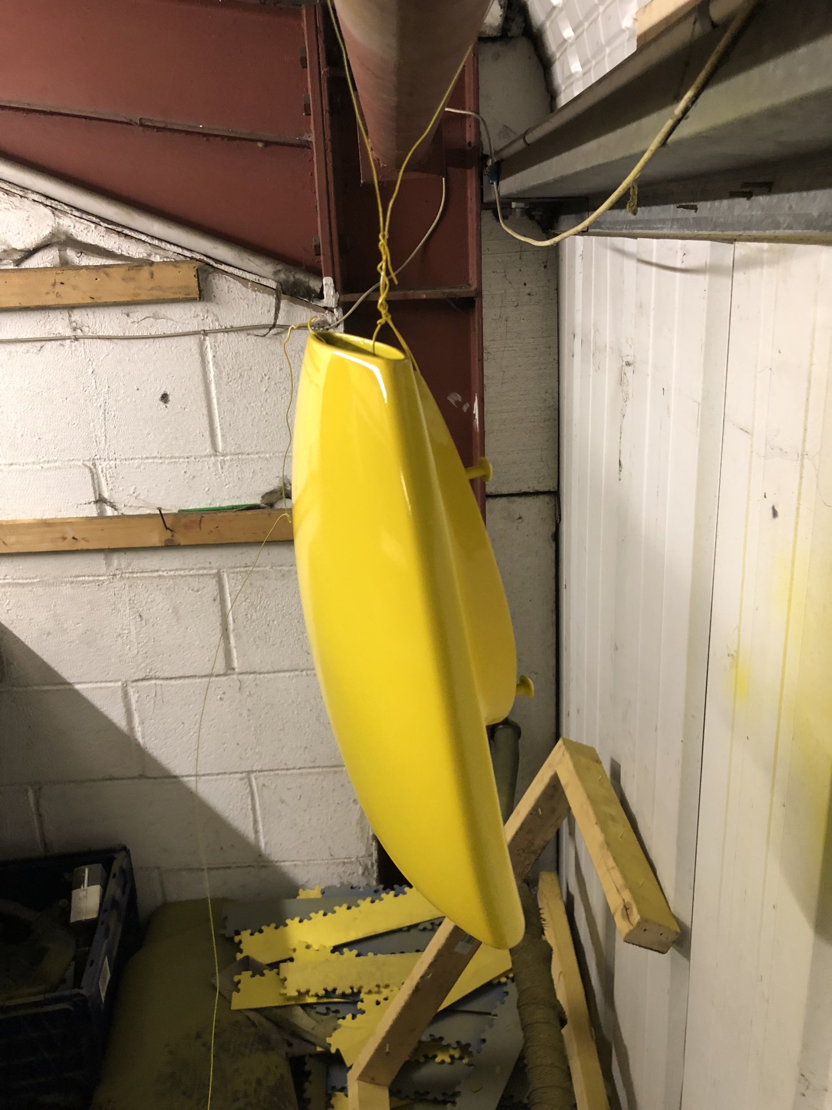

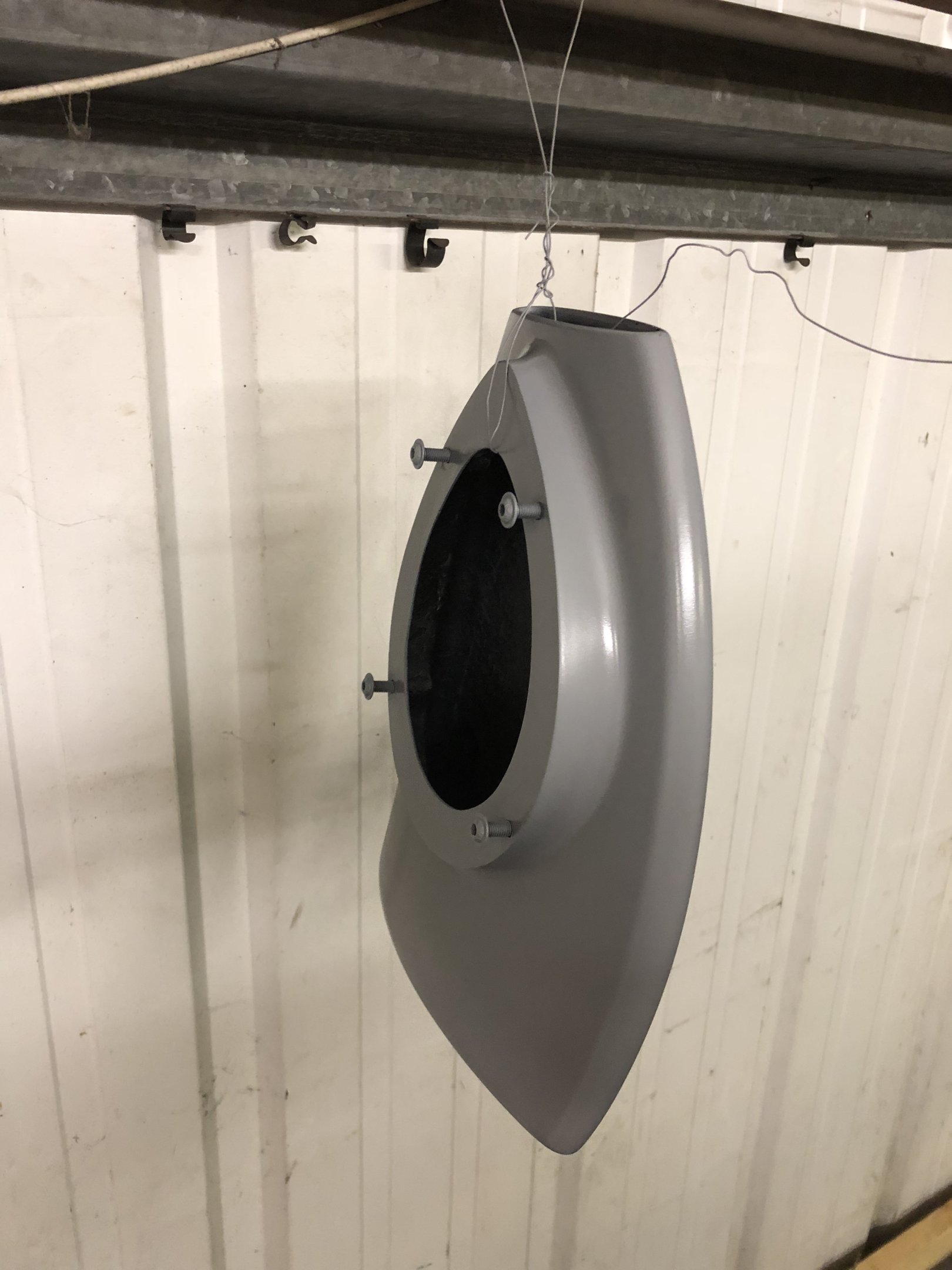

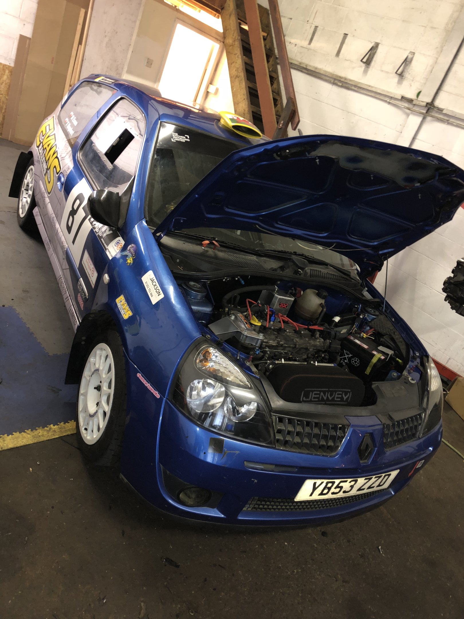

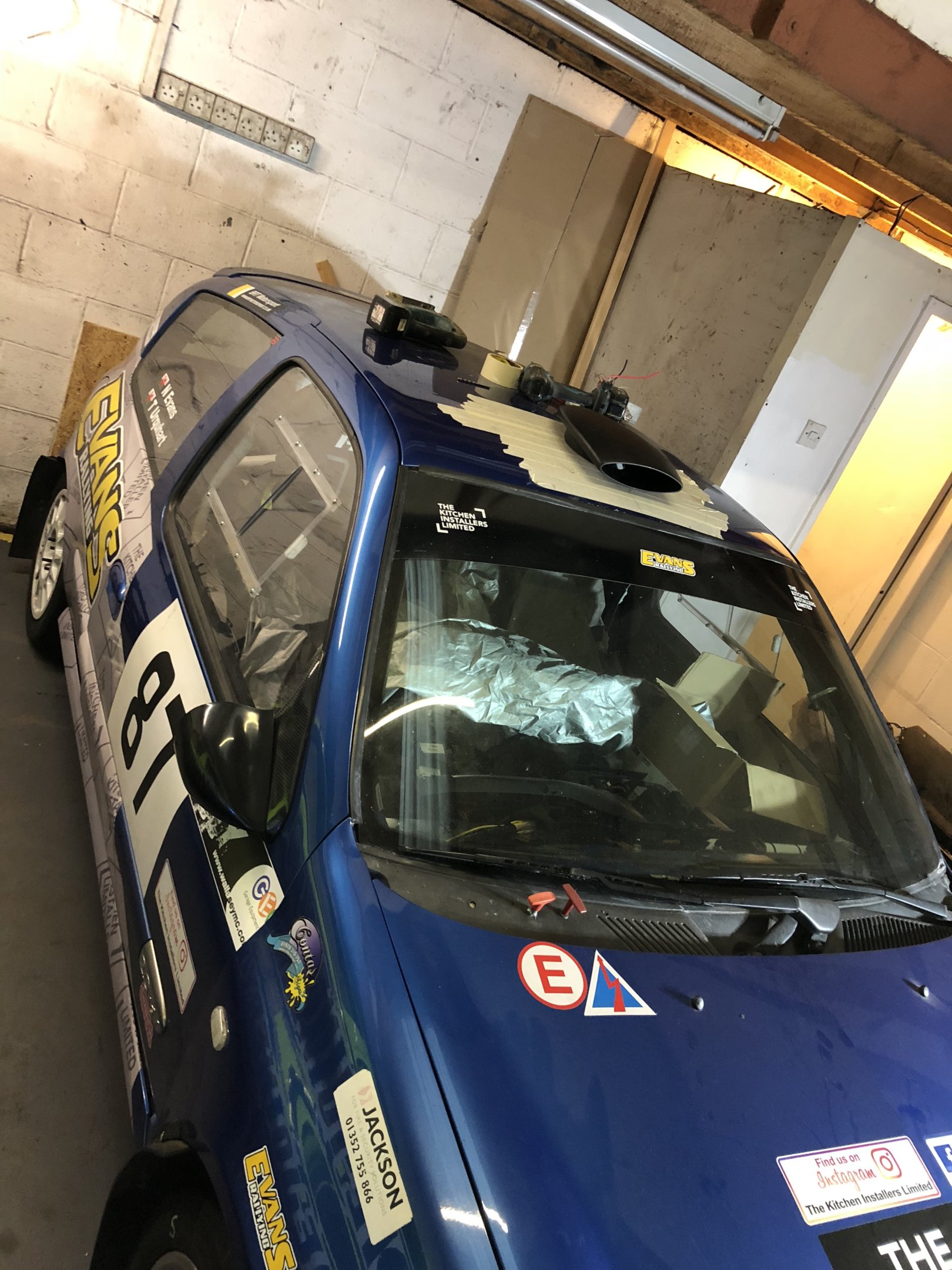

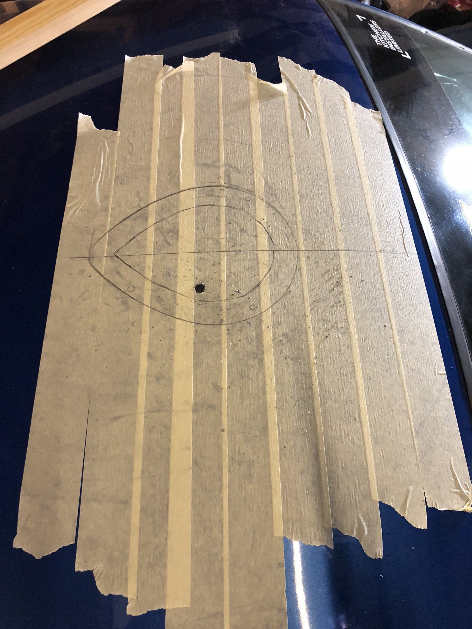

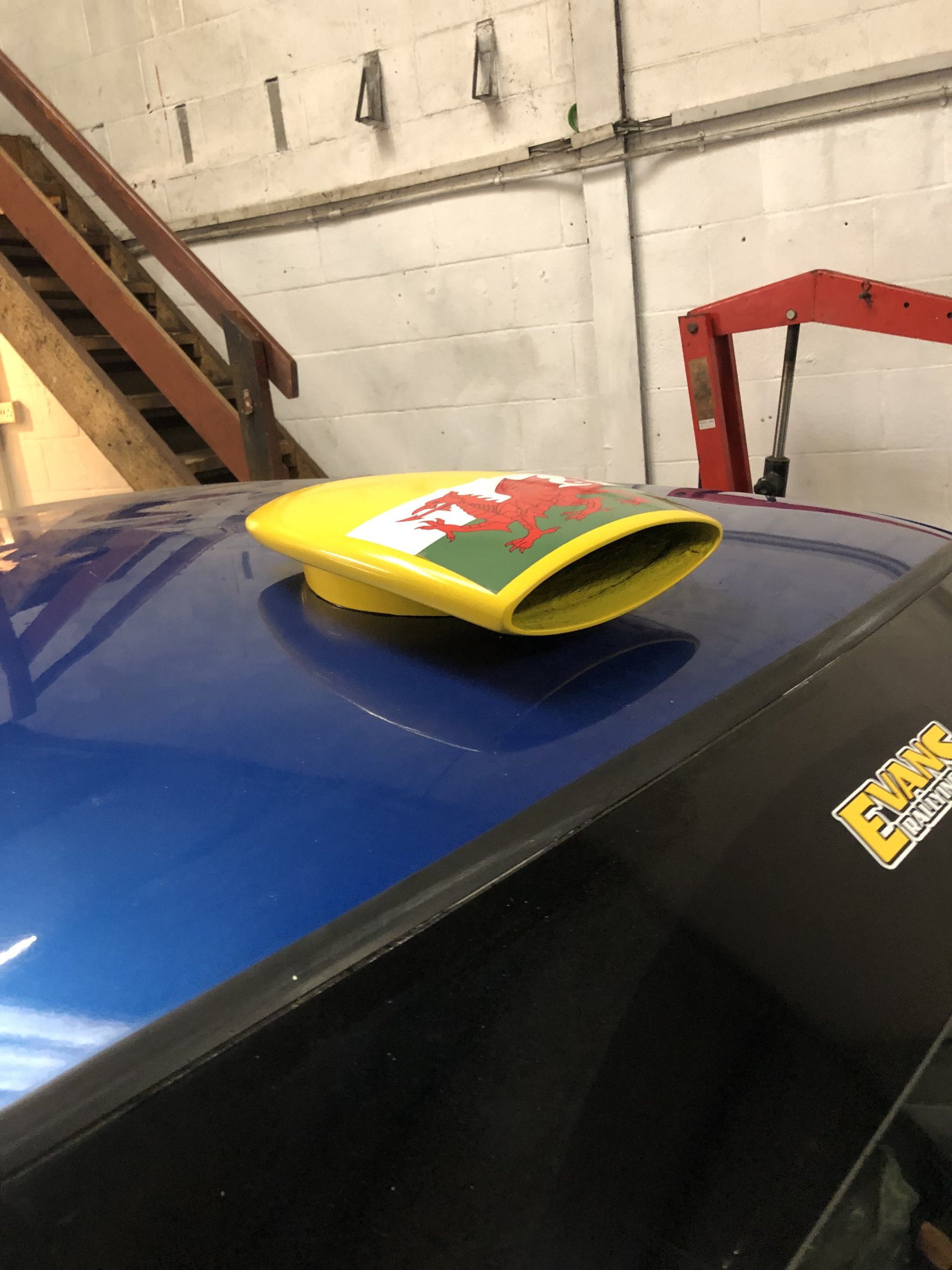

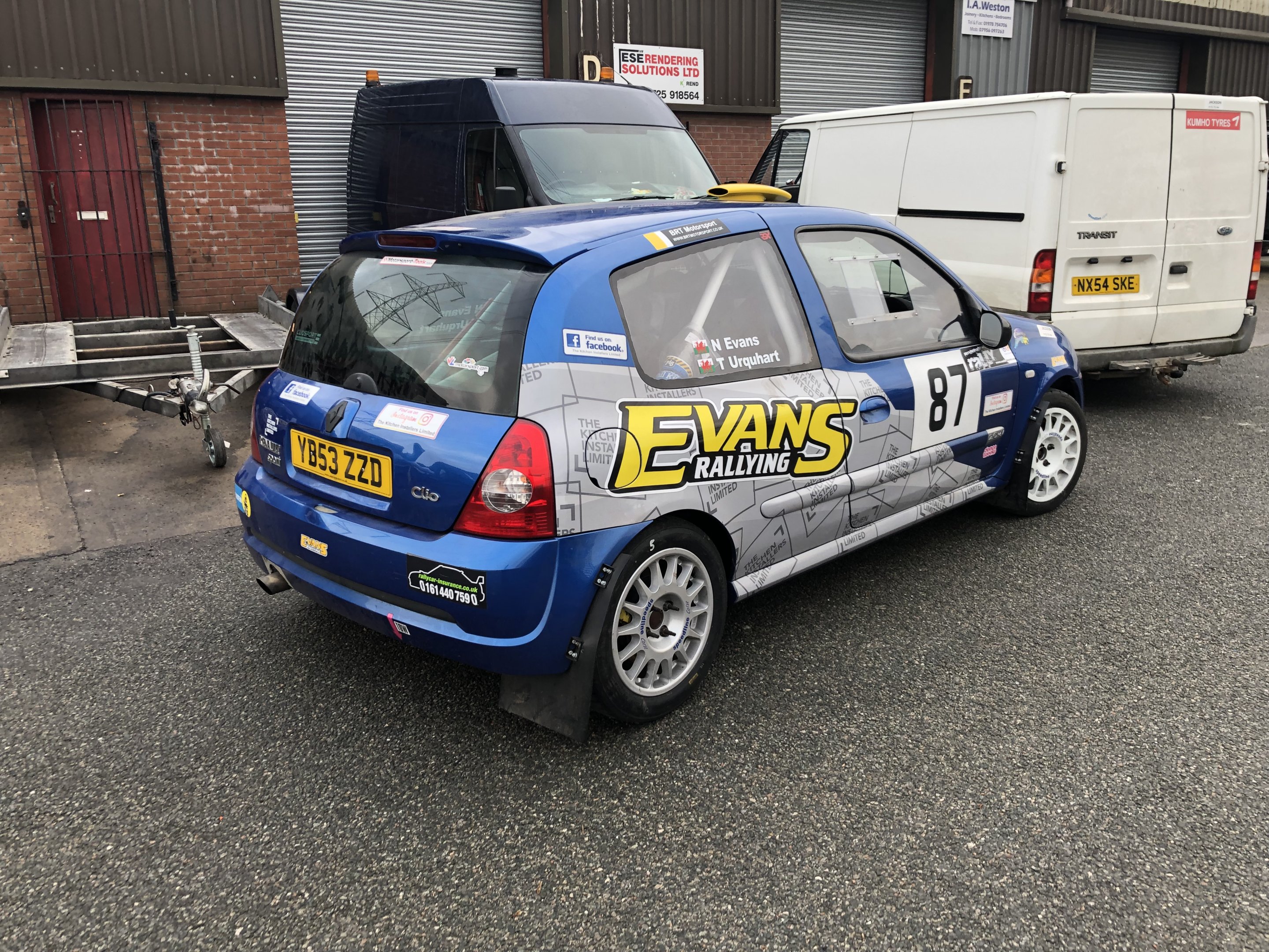

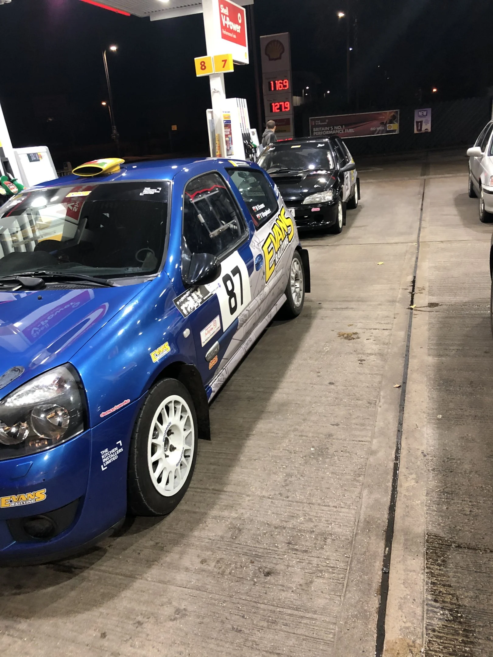

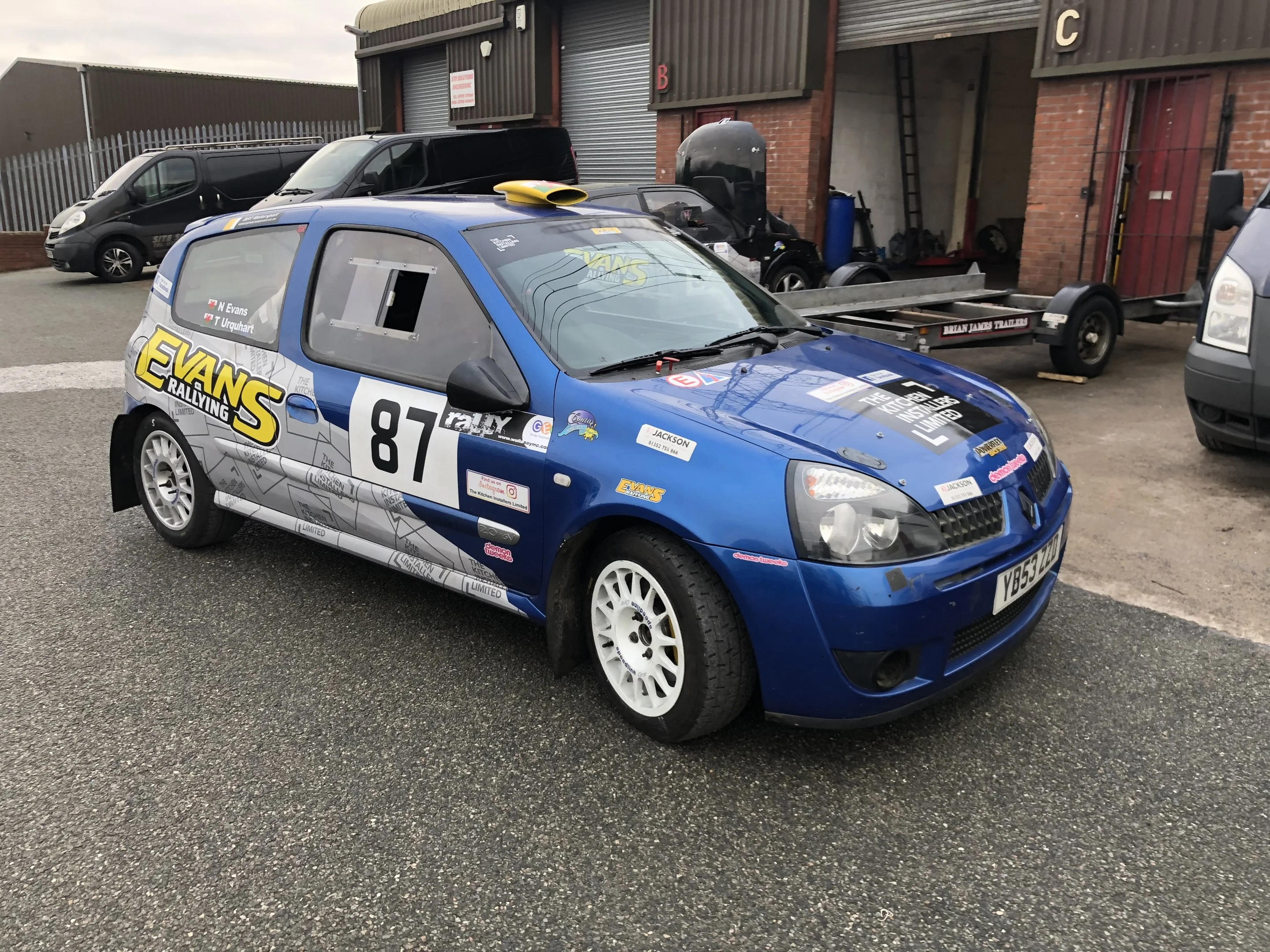

Bought myself a roof vent to go with the cup racer looks. Haven’t finished fitting it as I’ll let the paint harden over night
I’ve got Anglesey rally track day booked on the 29th of December so should have the car built back up by next weekend

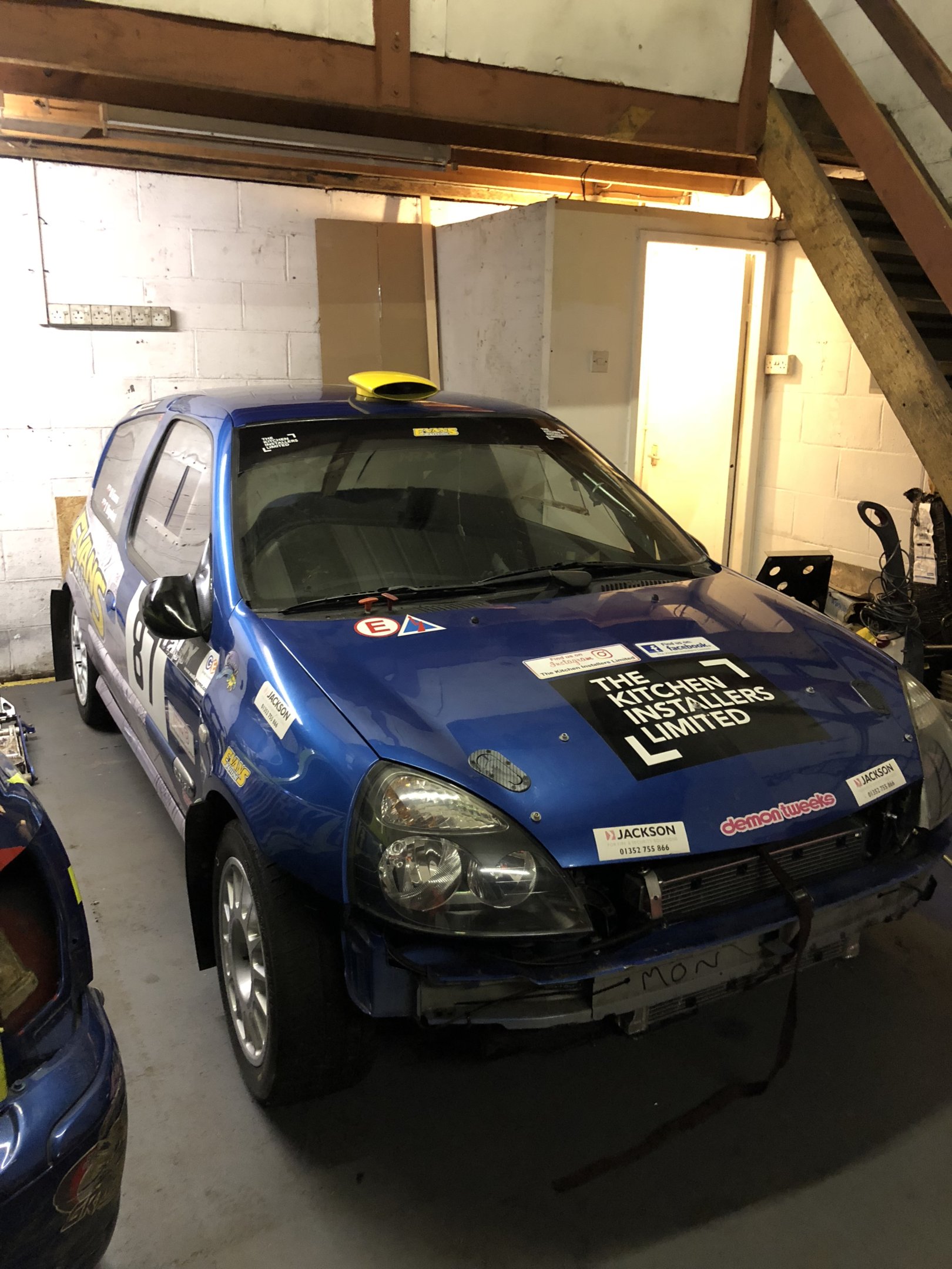

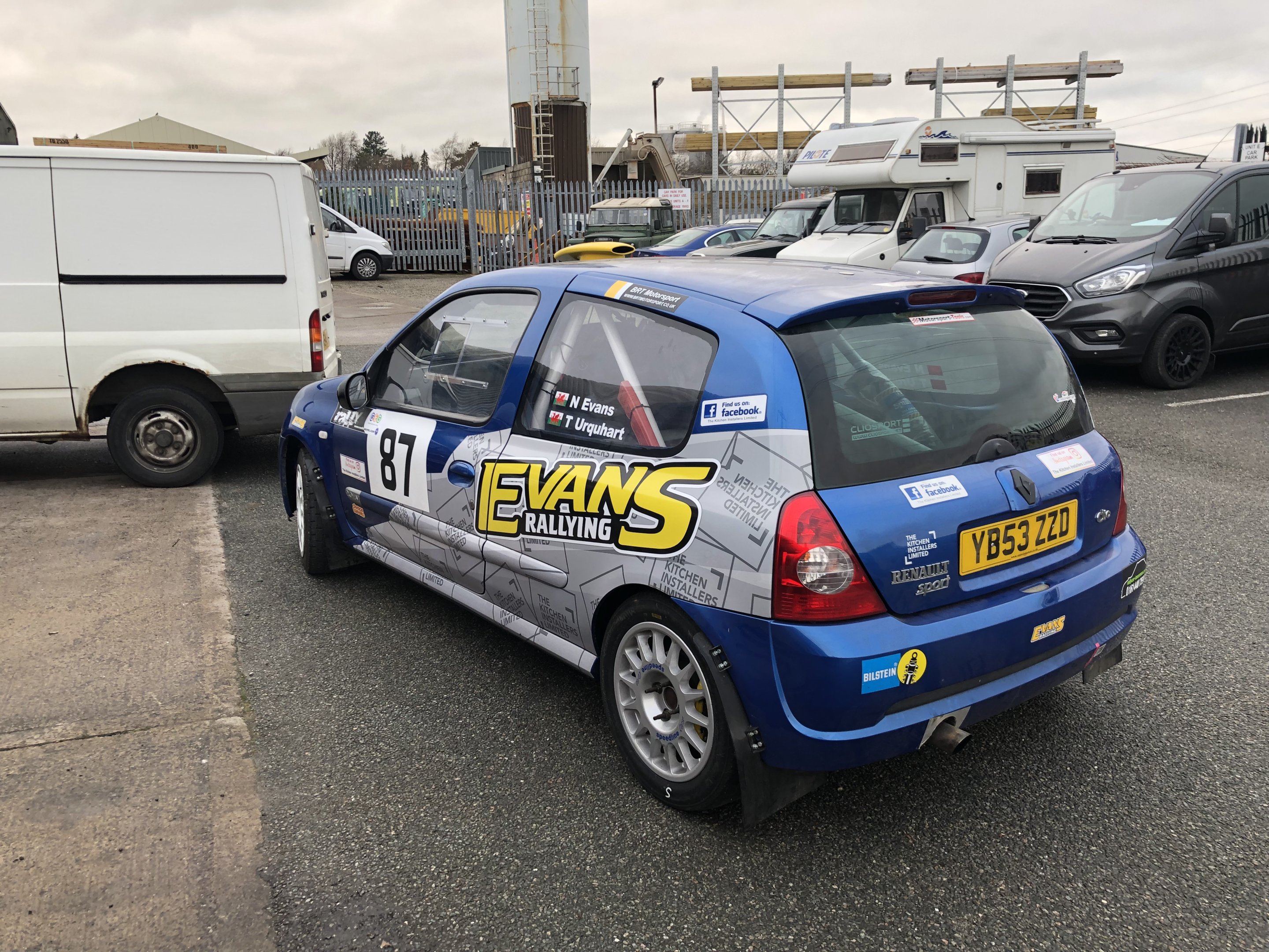

Roof vent on. Not sure if I’ve done the right thing spraying it yellow. Kind of looks out of place

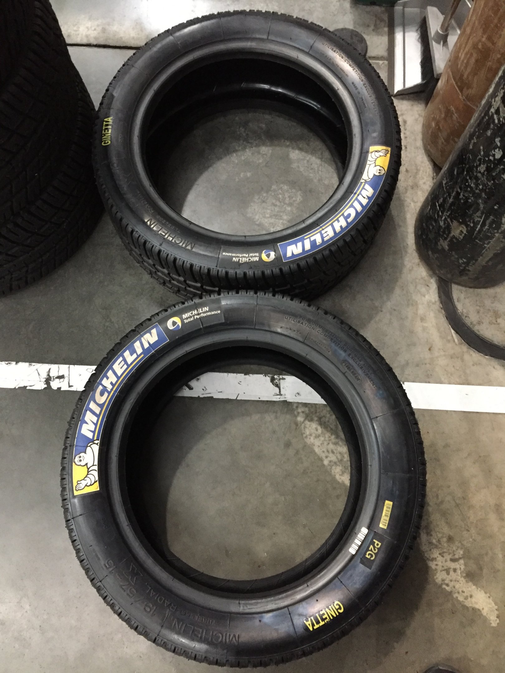

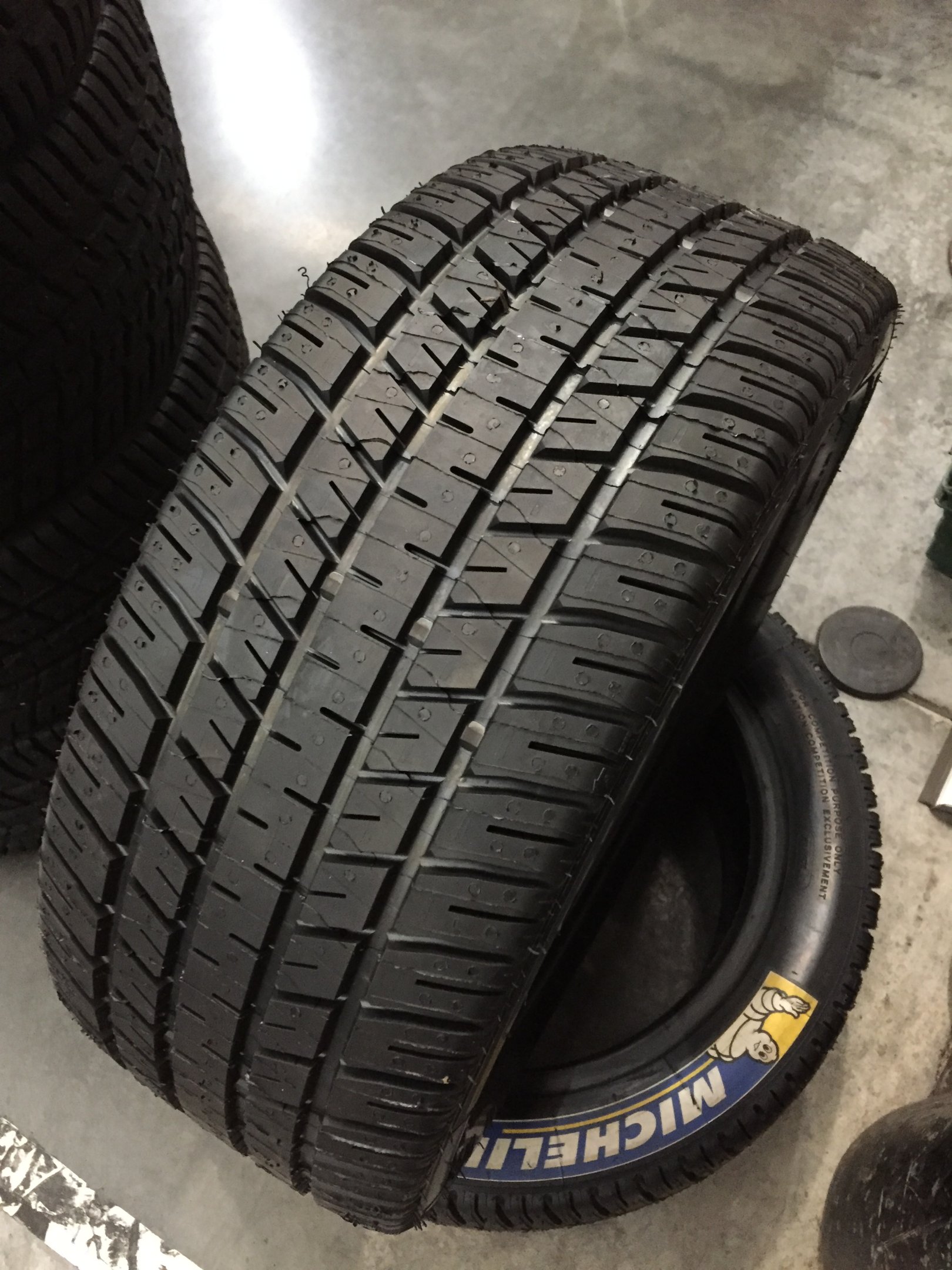

More Michelin’s purchased

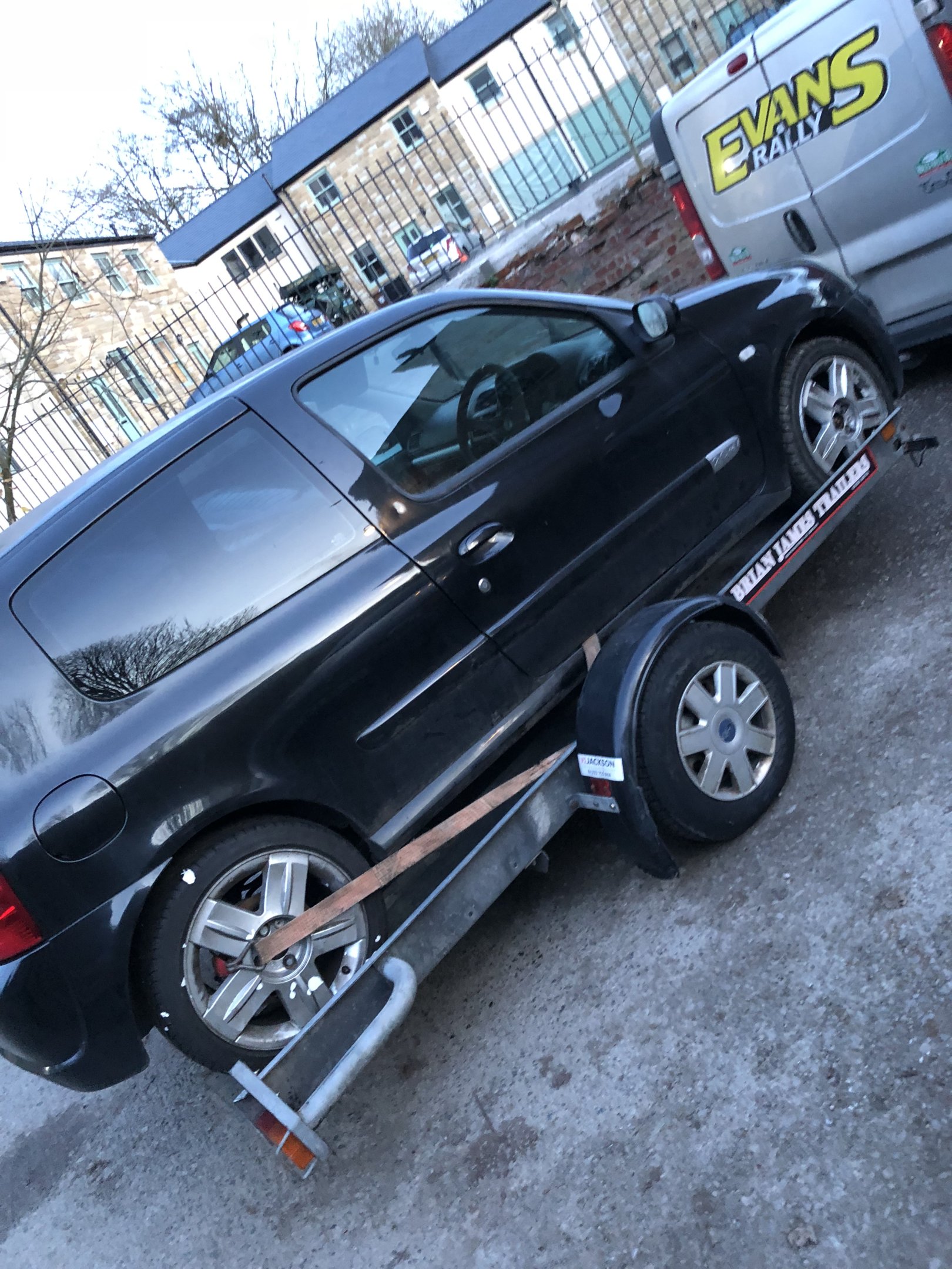

And another Clio to add to the collection. It’s either a breaker or a quick fix up and sell
Scoop doesn't look quite right in yellow I know you have yellow in your graphics. What sort of price were the tyres out of interest?
I know it looks out of place. But taking it off now it’s tiger sealed on might be more hassle than what it’s worth.
The tyres are £260 each new but I’ve managed to get a few for £150 a tyre
You could always just mask round it and re spray it. What about if you get chance, change the mudflaps to yellow then it may look more not so out of place.
If you can pick them up at 150 that's not bad at all.
I think the vent looks ok. Maybe try and add a bit more yellow somewhere else to help tie it in.
And Michelins hey...check you out lol. I need to buy some tyres. They are depressingly expensive!
Yeah I’m thinking maybe try a yellow front bumper maybe. Or just spray it blue on the car.
And the Michelin’s were a bargain. I’ve got 14 of these wets now. I should really list some for sale. Got them from Ginetta factory in Leeds

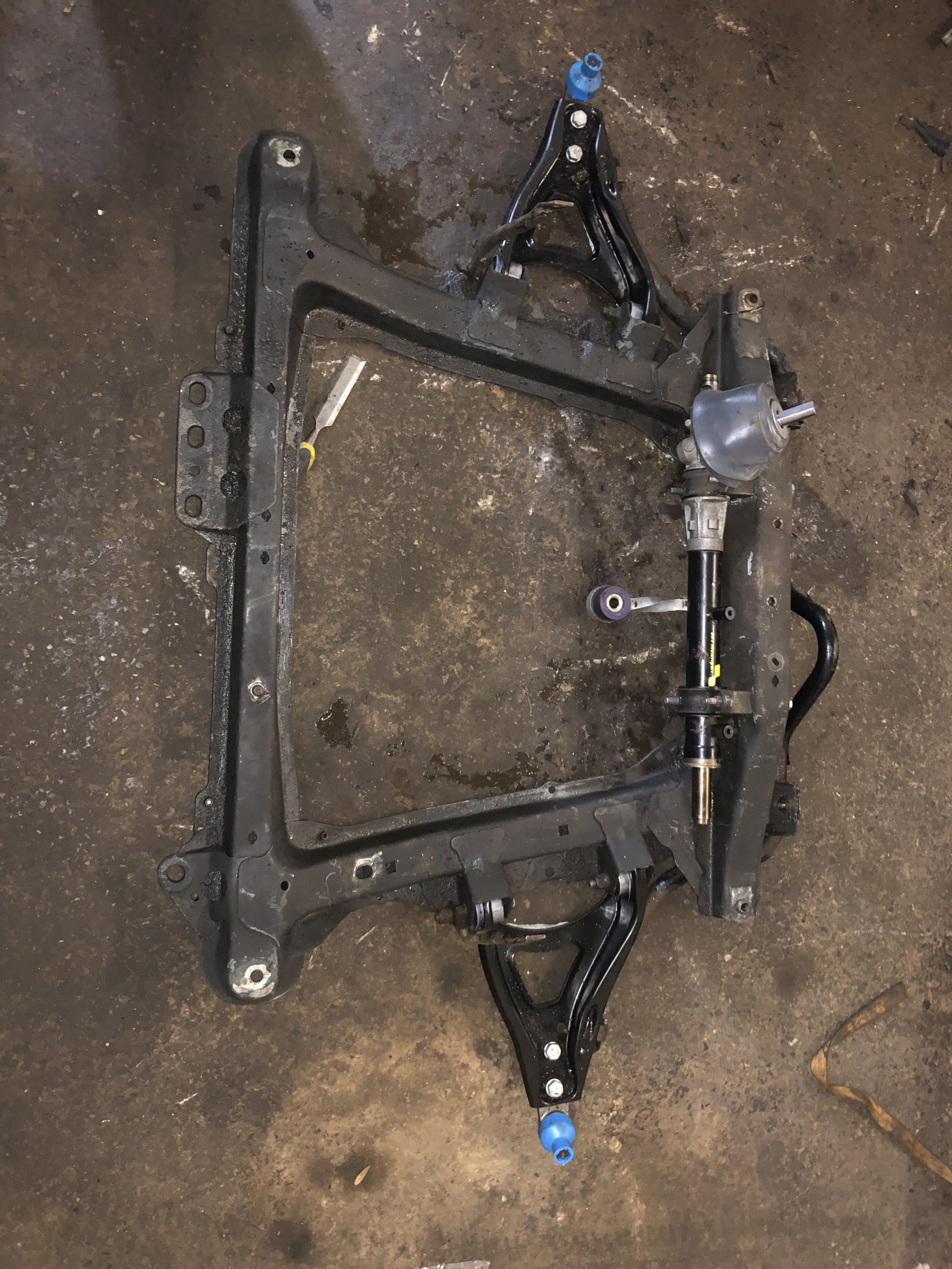

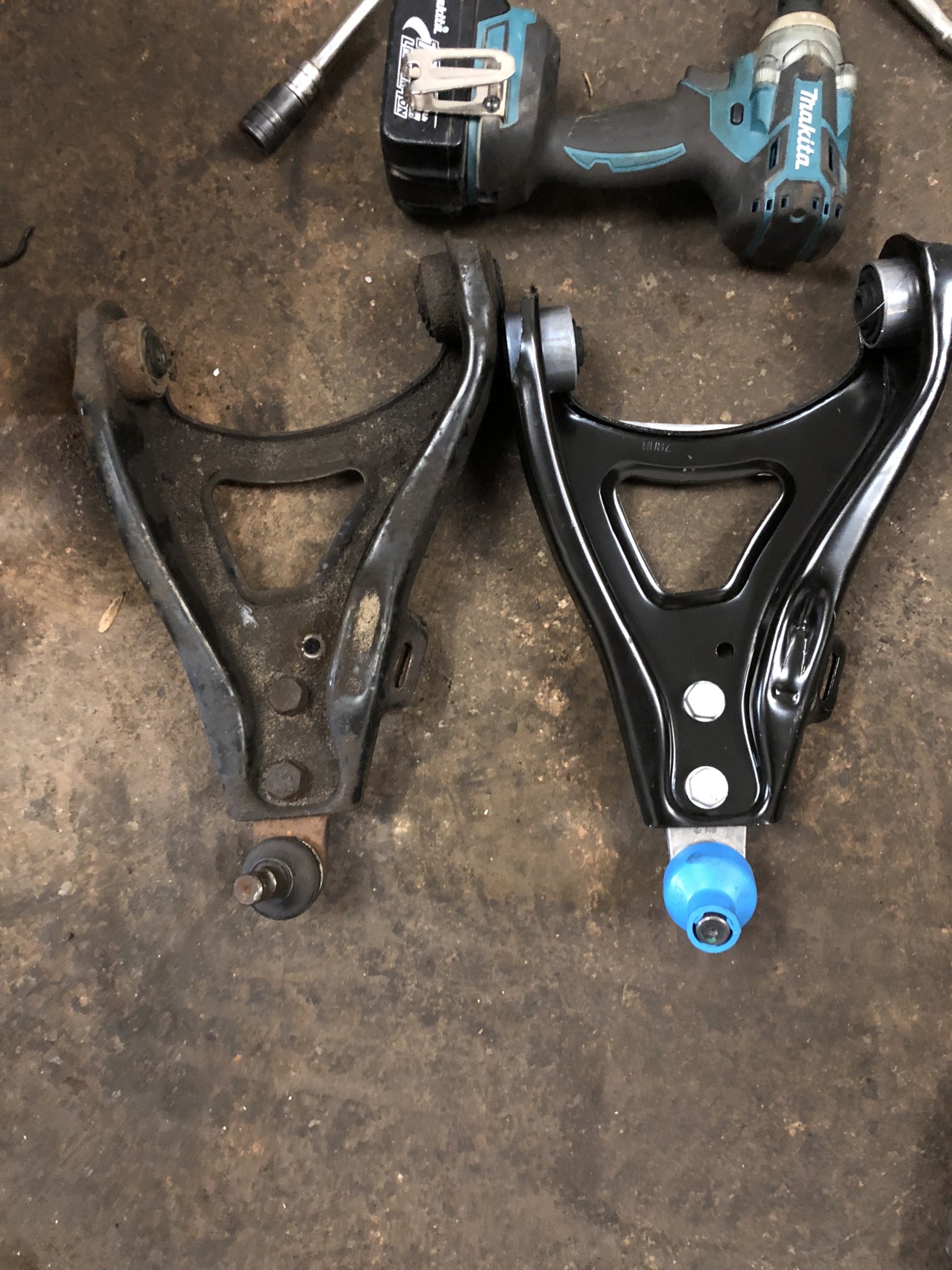

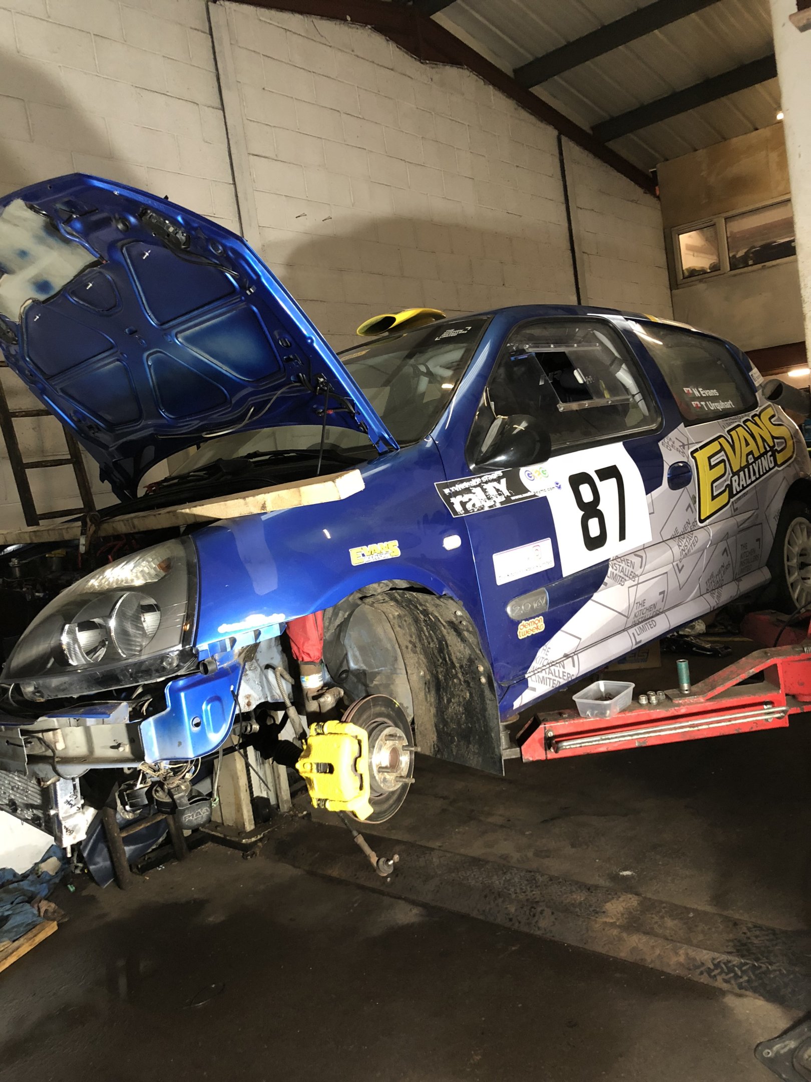

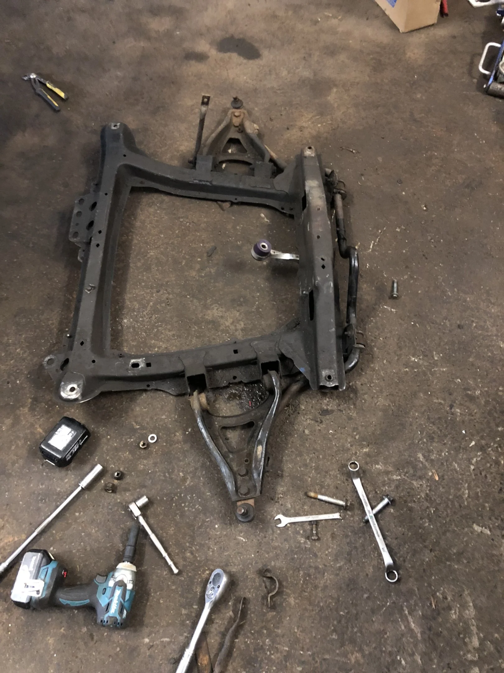

Subframe off to fit my @BRT Motorsport quick rack, new wishbones from @renaultpartsdirect, powerflex rack bushes and arb bushes.

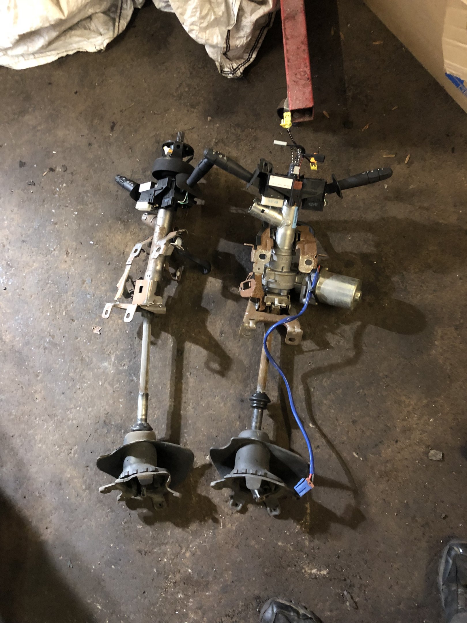

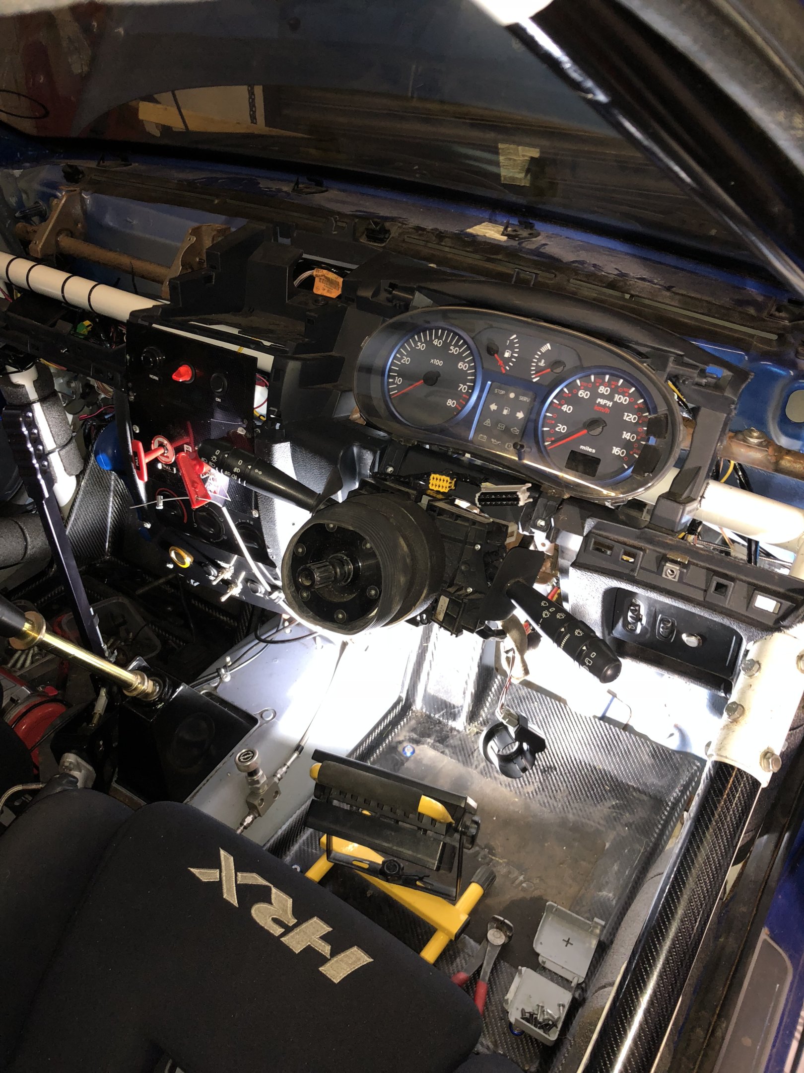

Removed the old pas system
All built up with a trip to @bloke for a rack bracket for the subframe as mine was knackered and couldn’t find my spares

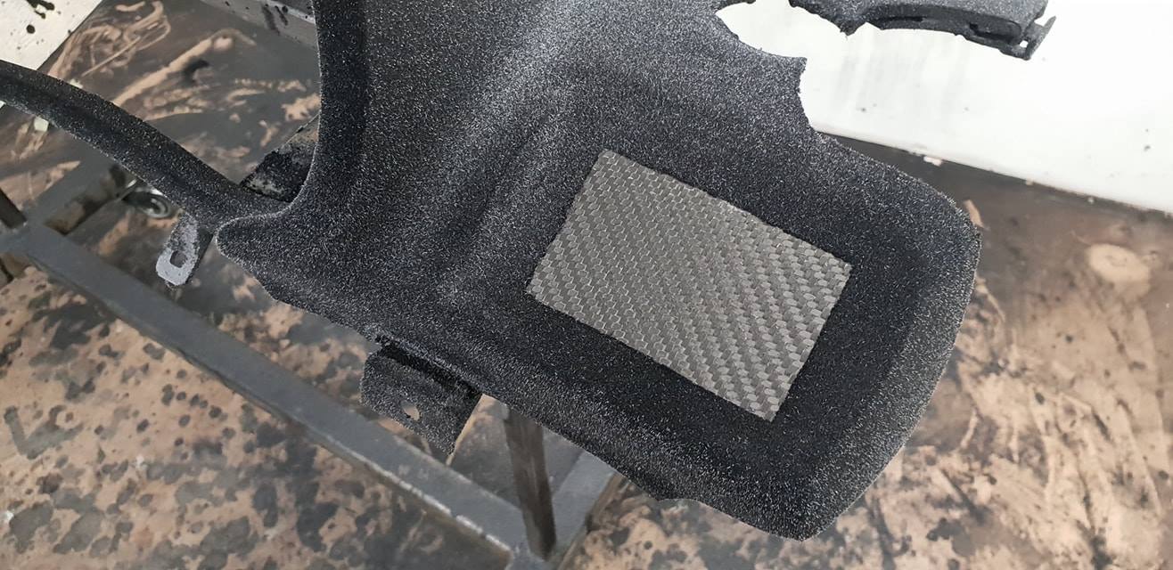

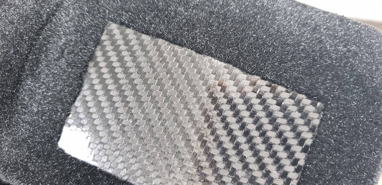

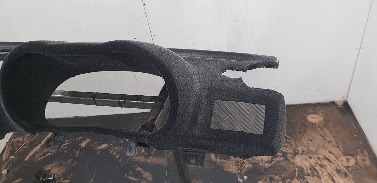

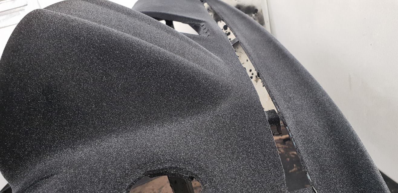

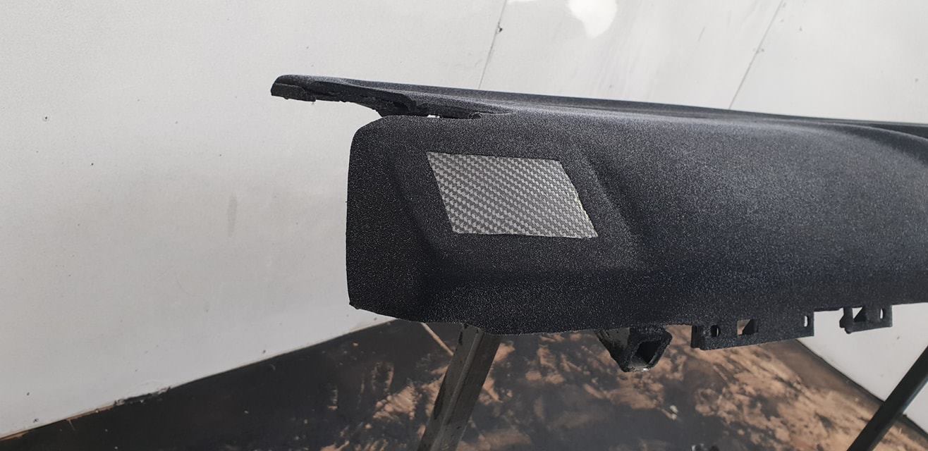

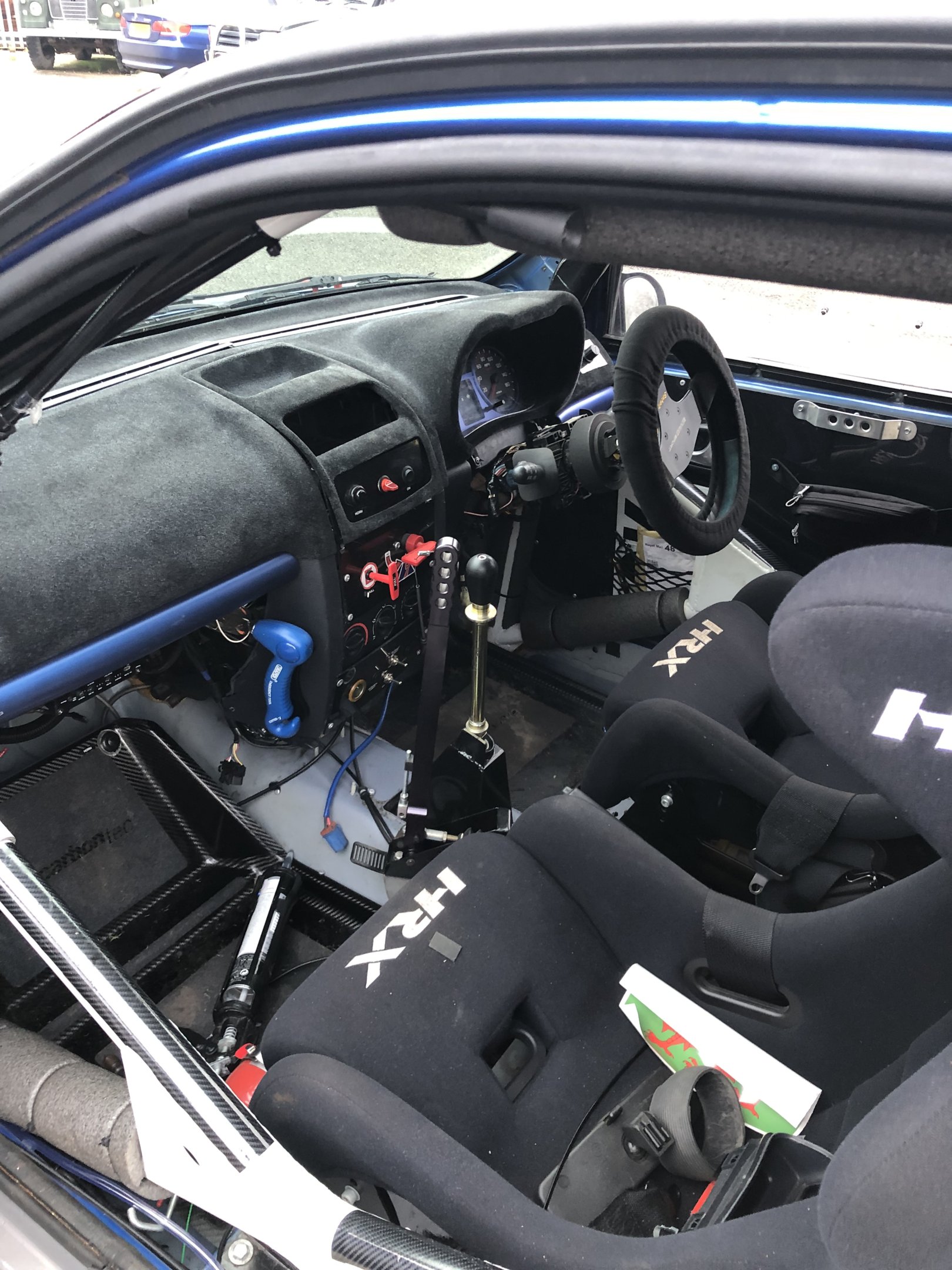

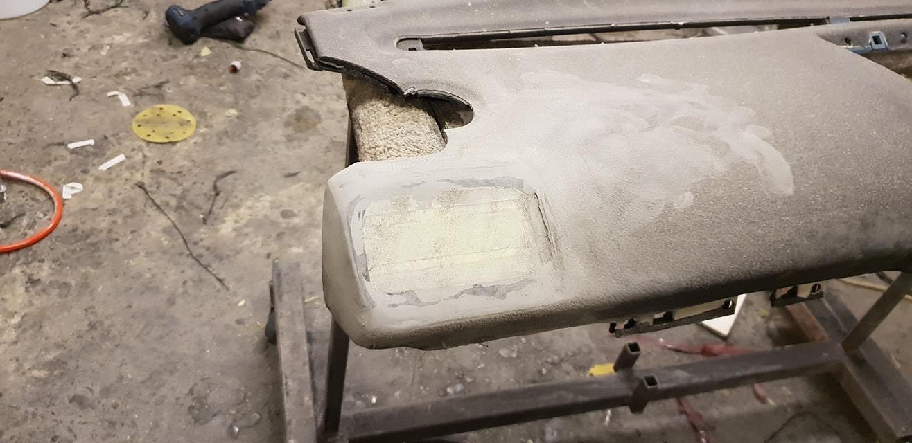

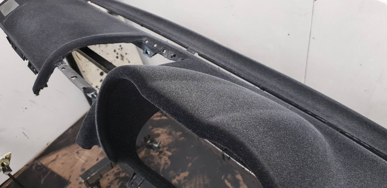

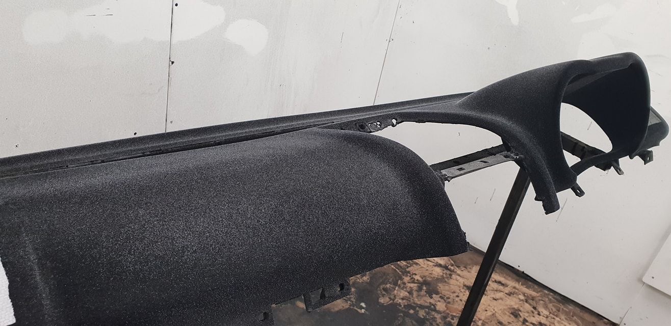

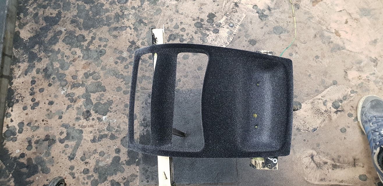

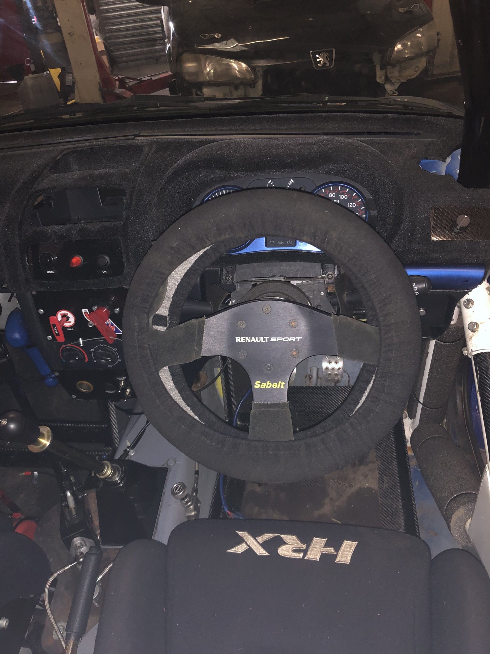

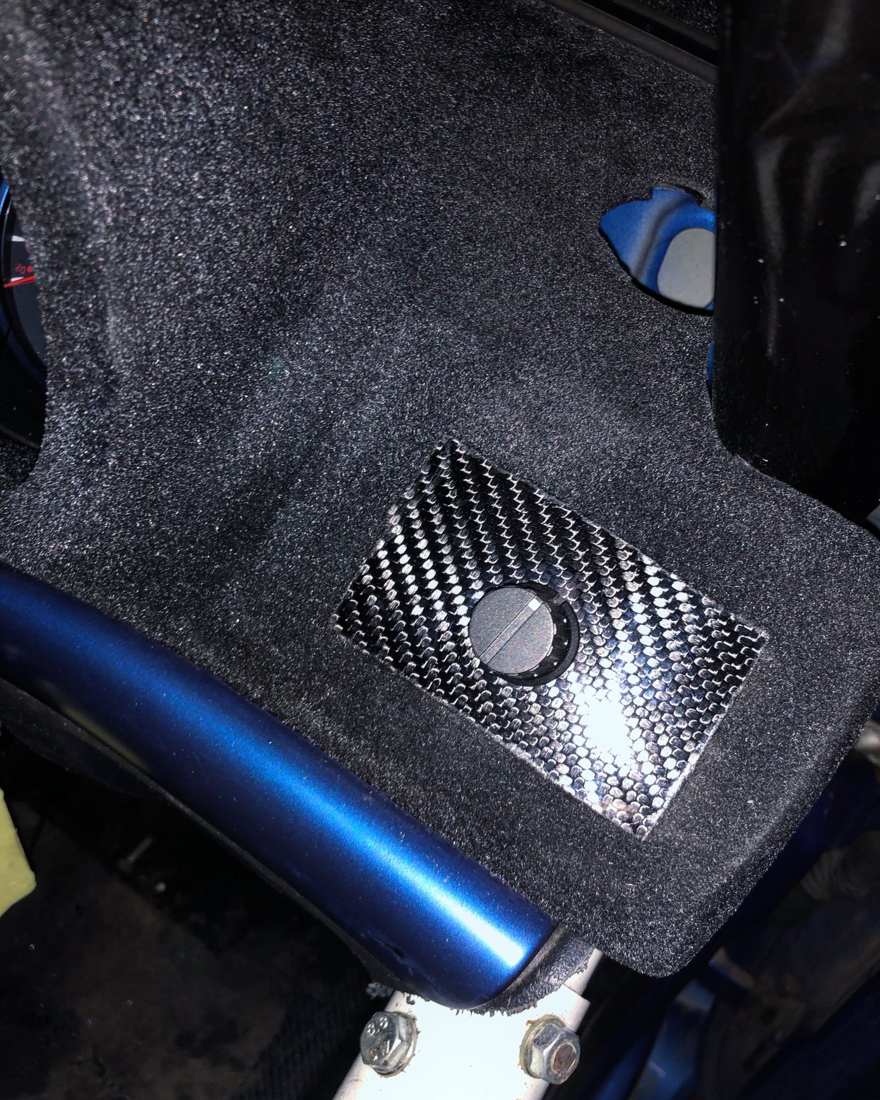

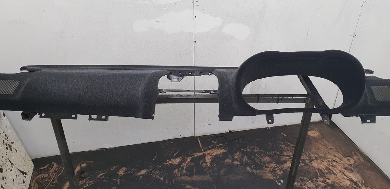

Dash top off the be flocked and some custom carbon covers over the vents to mount my epas switch.
Then on to the worst job. Getting the epas column in with the lower dash in and cup racer cage with the bar across the dash
Not the nicest of jobs but it’s in. Gearbox and subframe back on tomorrow. Then it’s wire up the epas, get it re tracked and it’s good to do a few road miles before Anglesey

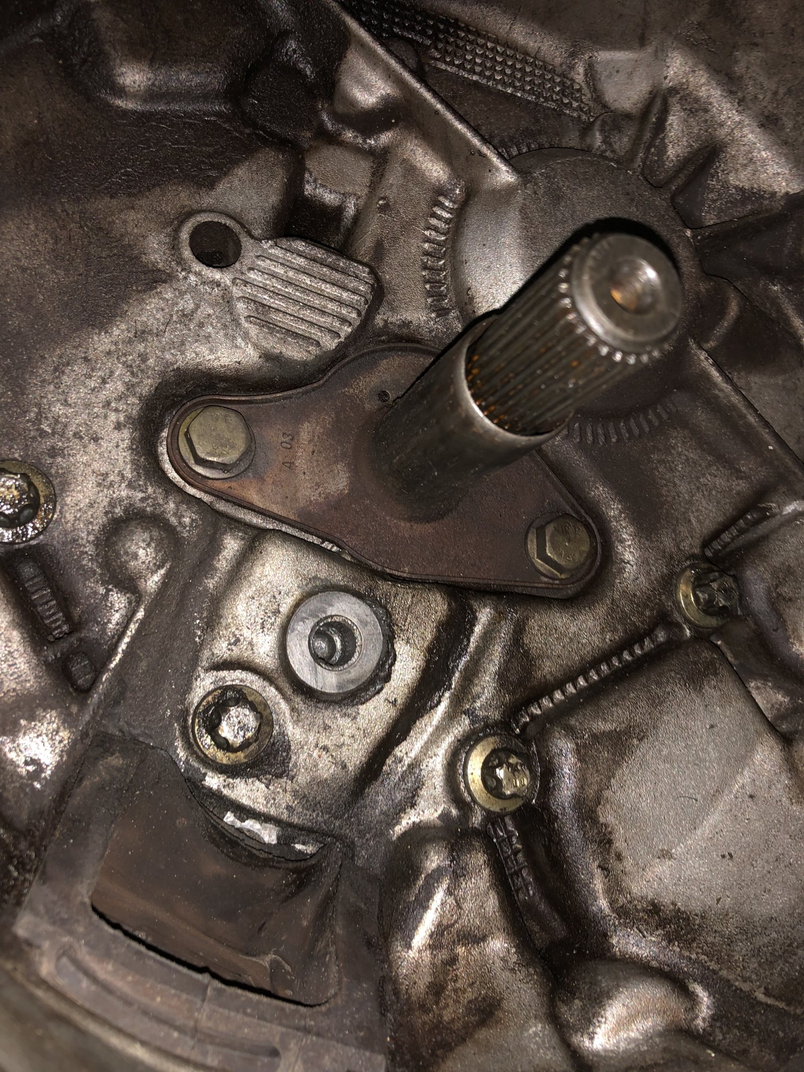

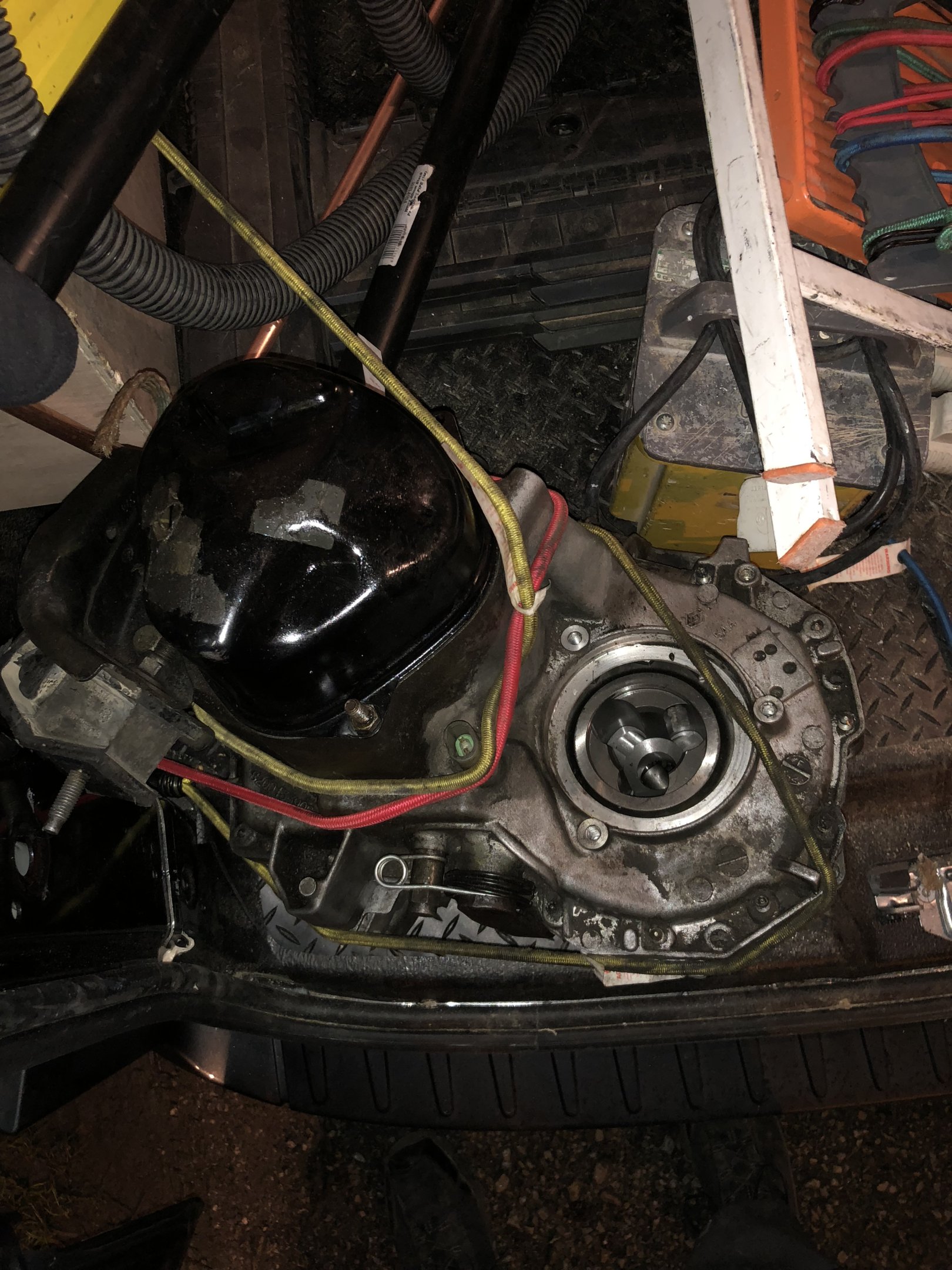

Not a good start yesterday putting the box back on.
I didn’t have the little dome insert in for the clutch fork. 20 mins later after smashing hell out of spare gearbox I managed to get it out and into this box.

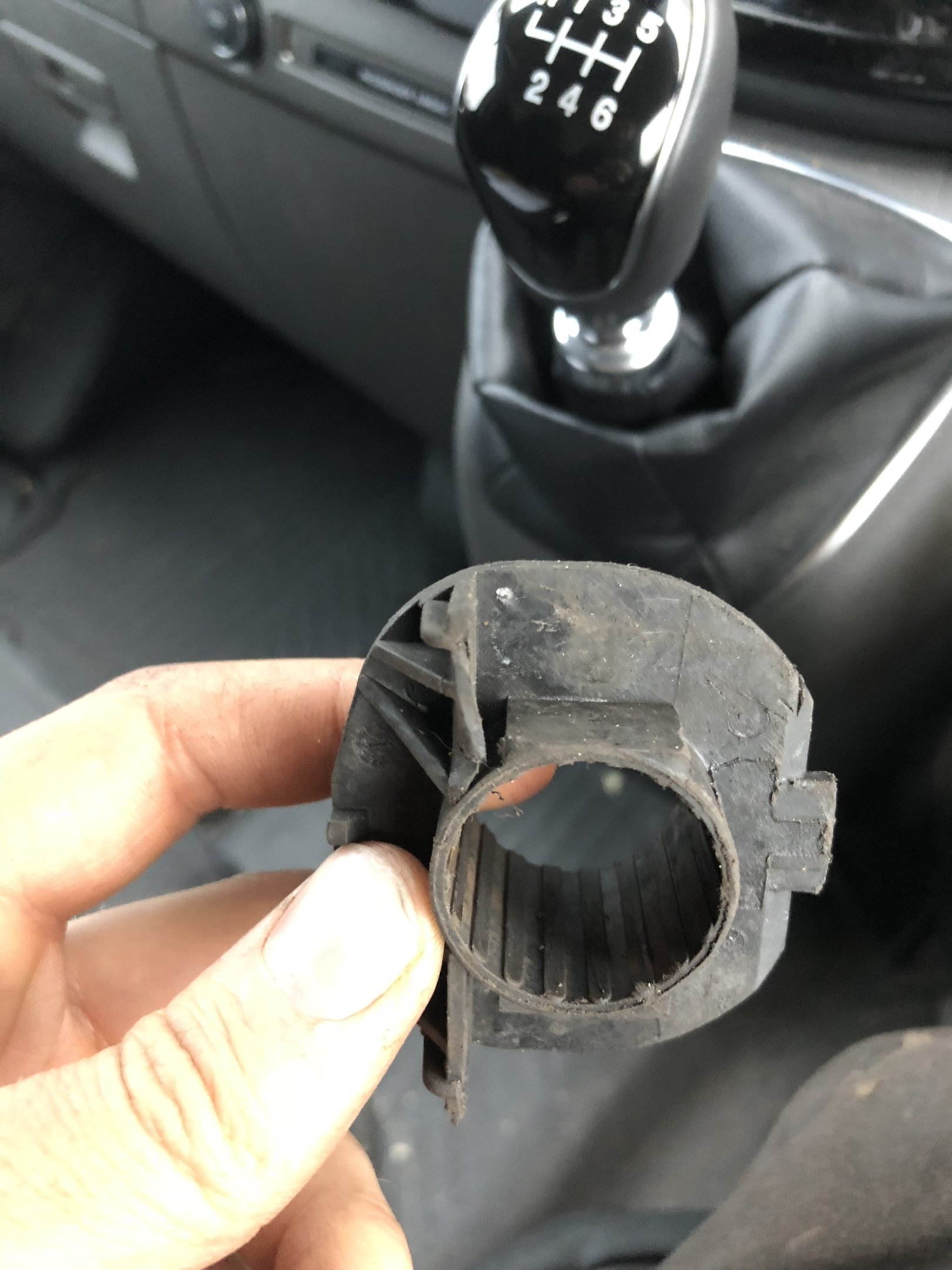

Got the clutch fork on then realised the lugs on clutch release bearing had snapped off ?
Got a new bearing this morning. Then it was time to get box, subframe, shafts and rack on.
The cars back up and running. Just need to wire the epas up and replace the nut and bolt on the pms shifter because it’s been over tightened. Then it’s road test time

But got sent these today. Epas adjuster will fit nicely to one of the carbon vent blanks

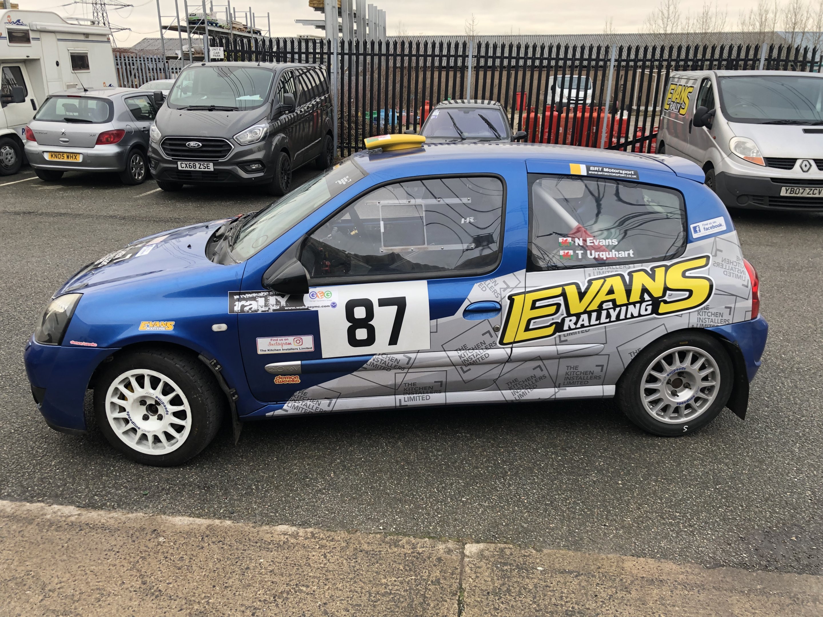

I got the car tracked today and it drives great.

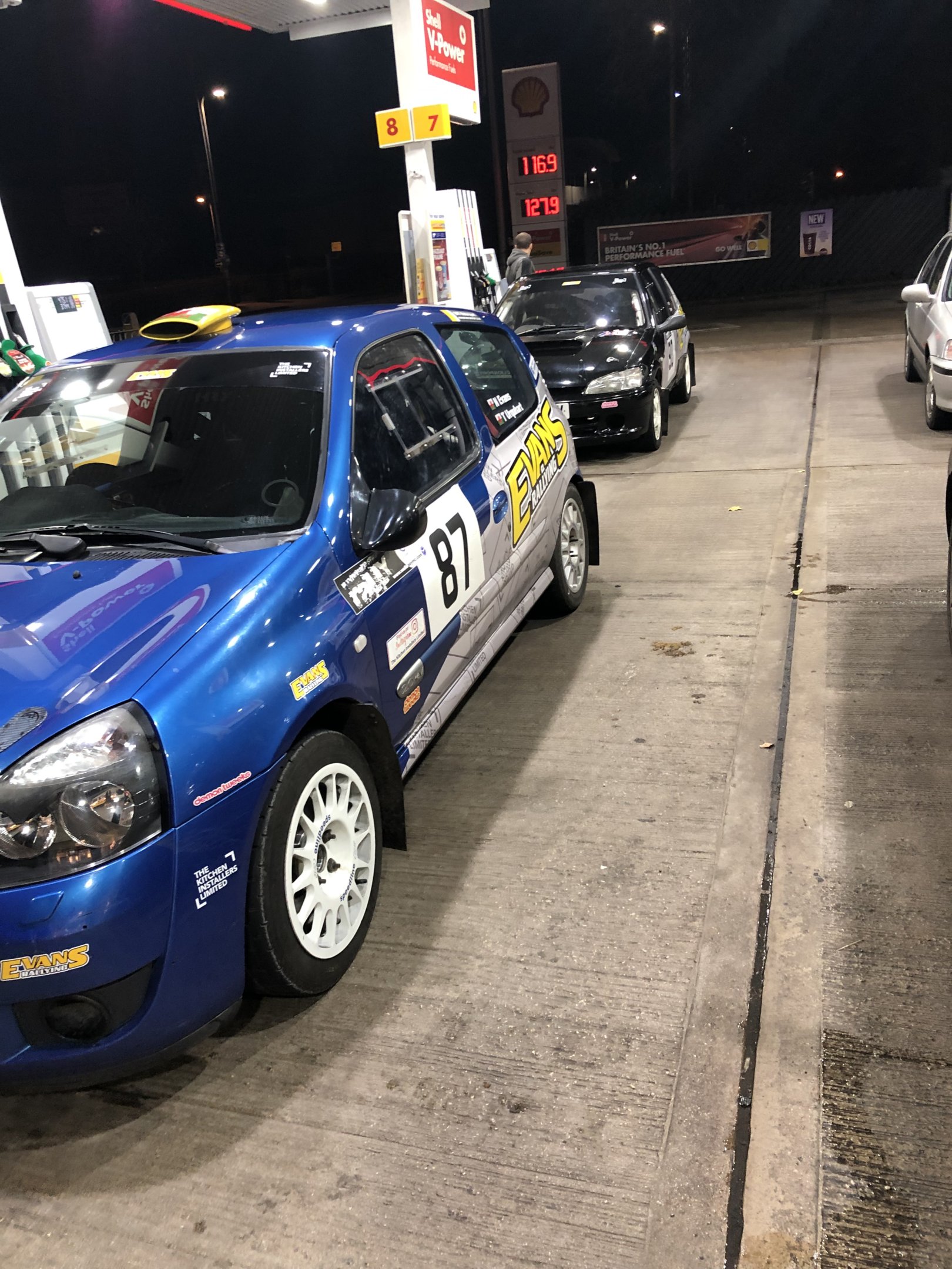

Thanks Jon. I’m out on Saturday having a play at Anglesey on one of their rally track days. Next rally might no be until the agbo stages. Nothing really stands out in Jan & Feb. When are you getting the escort out?

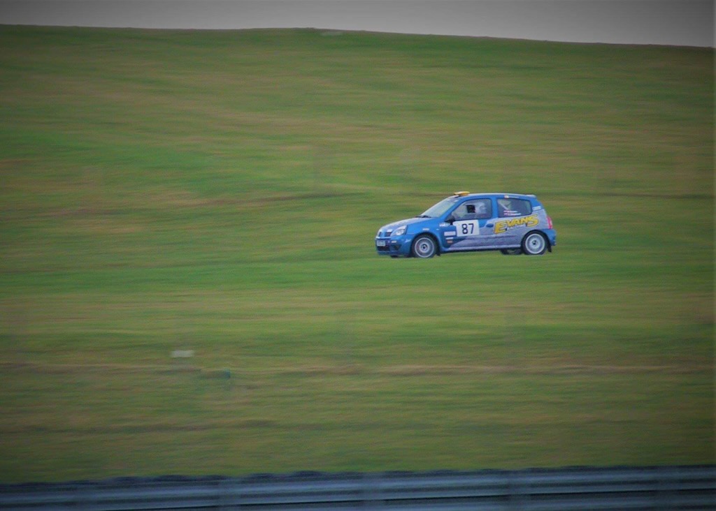

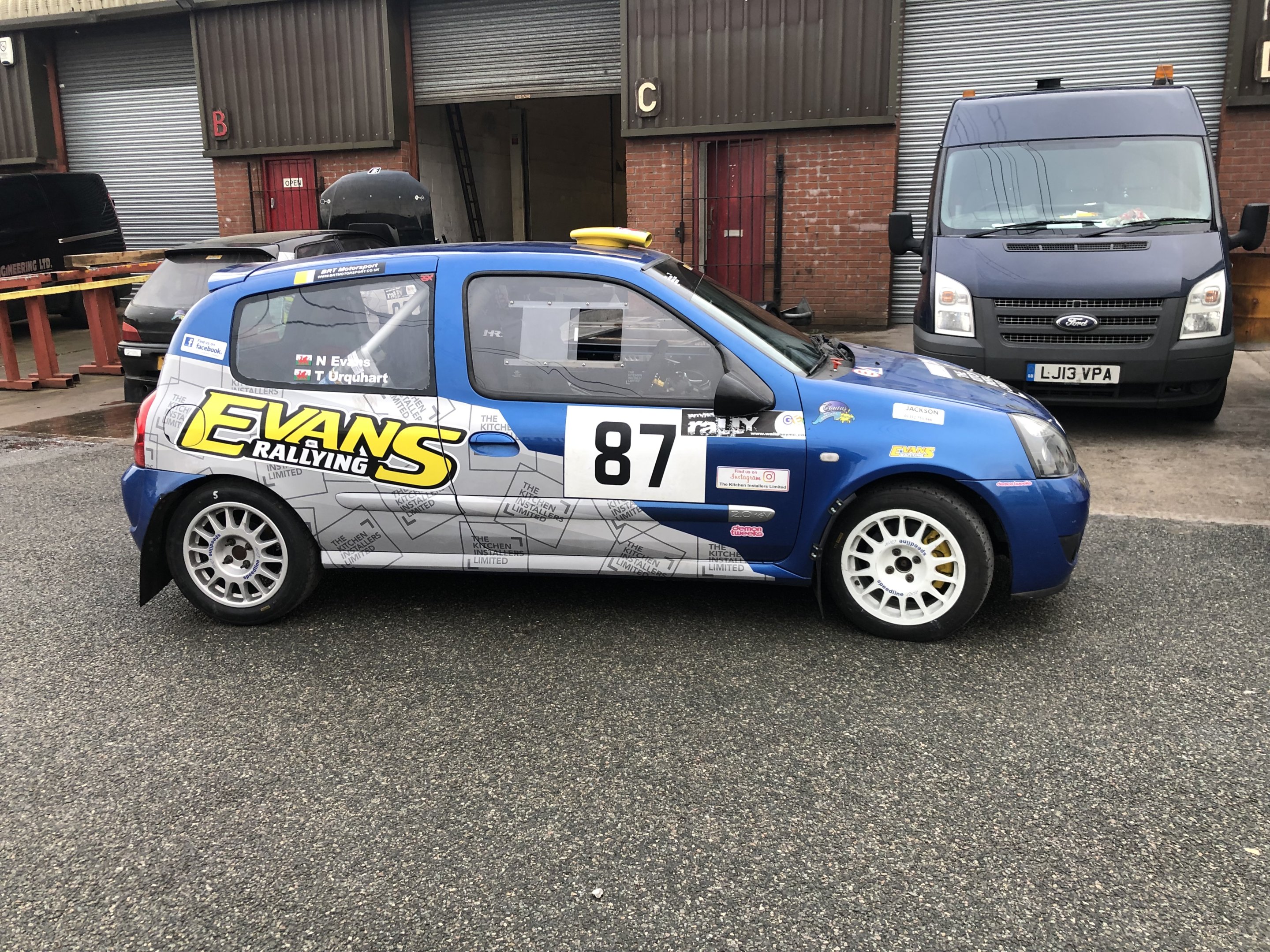

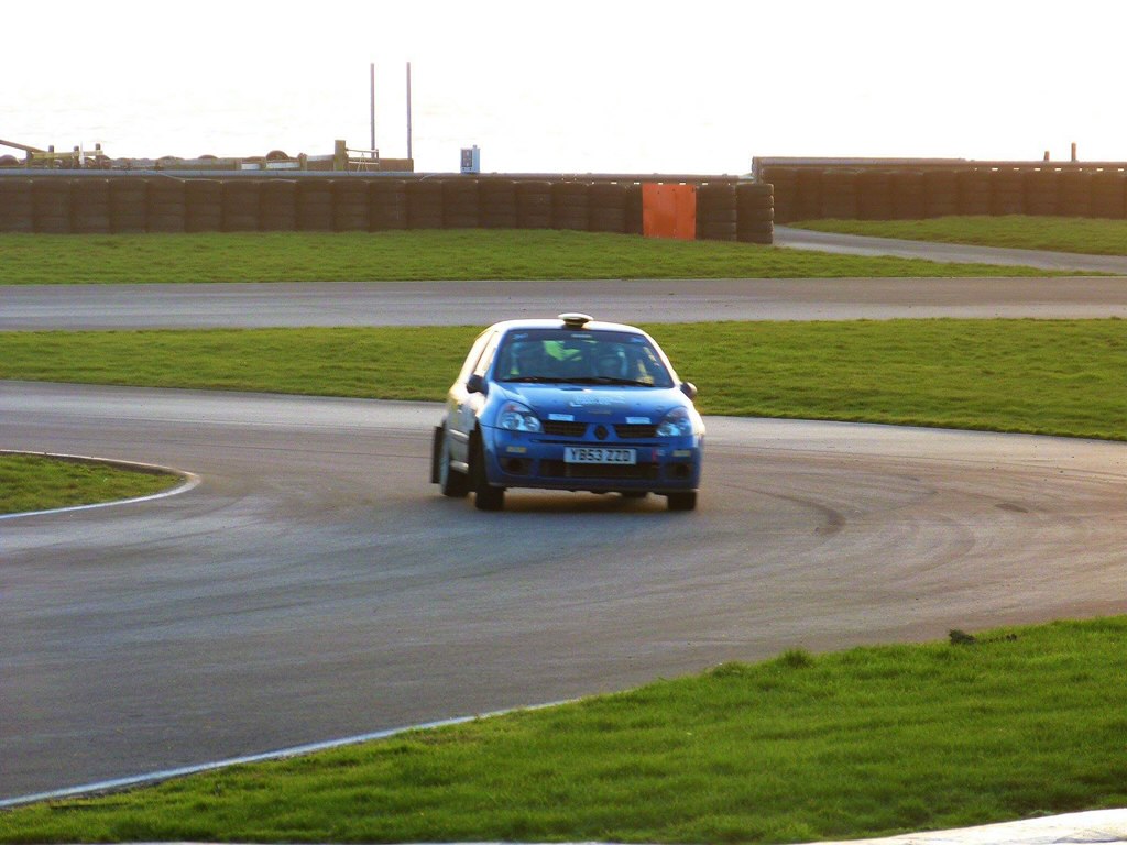

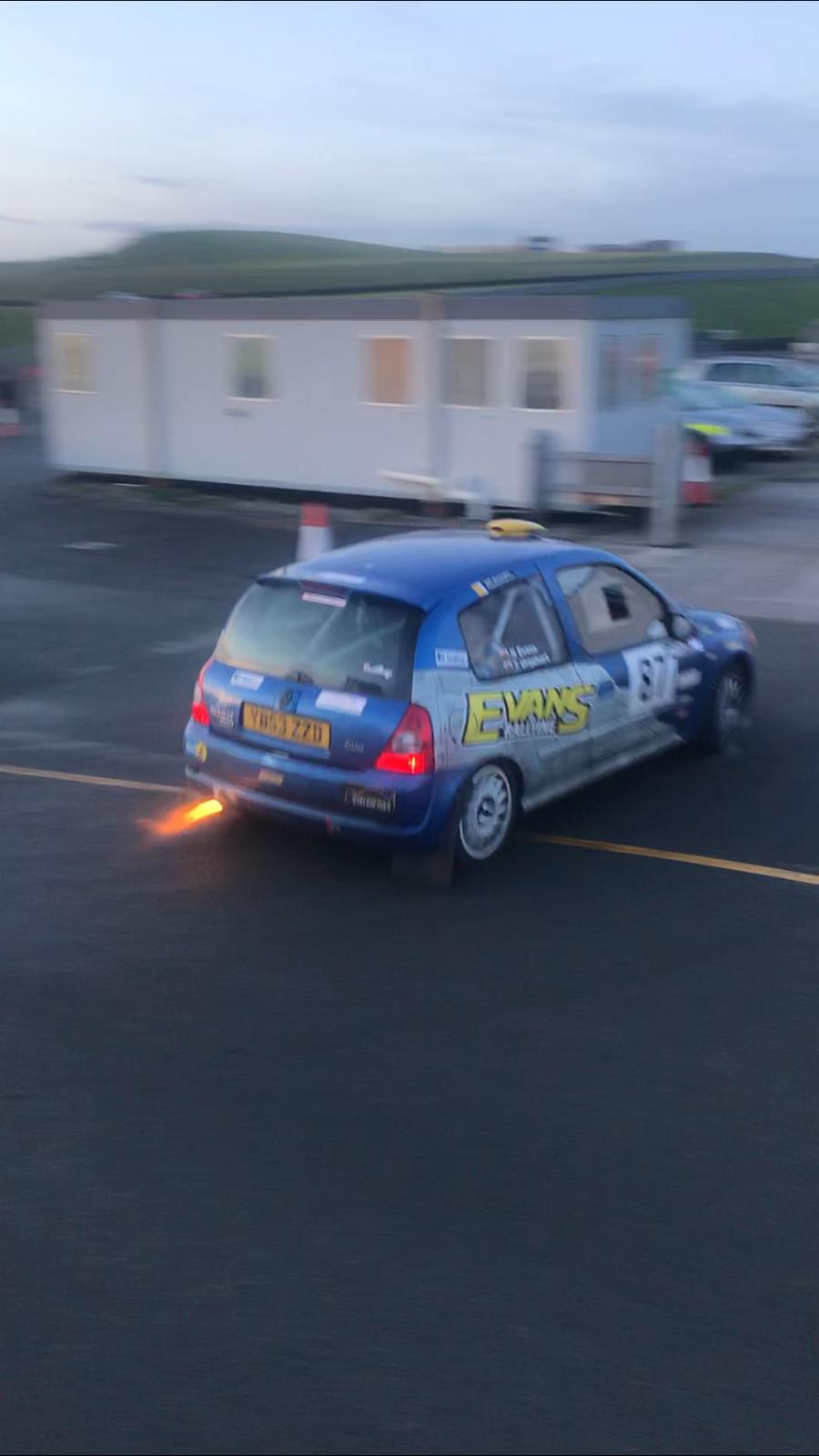

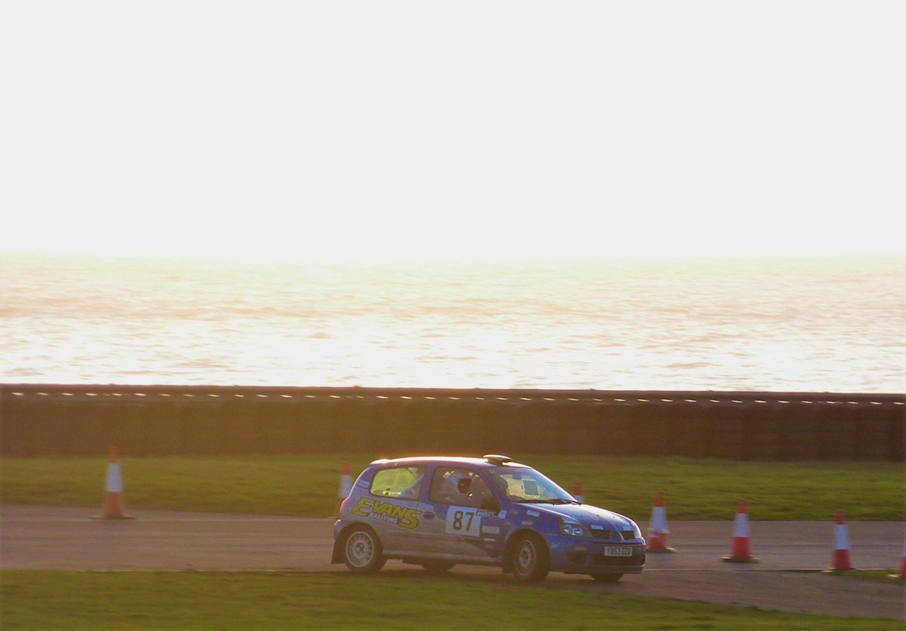

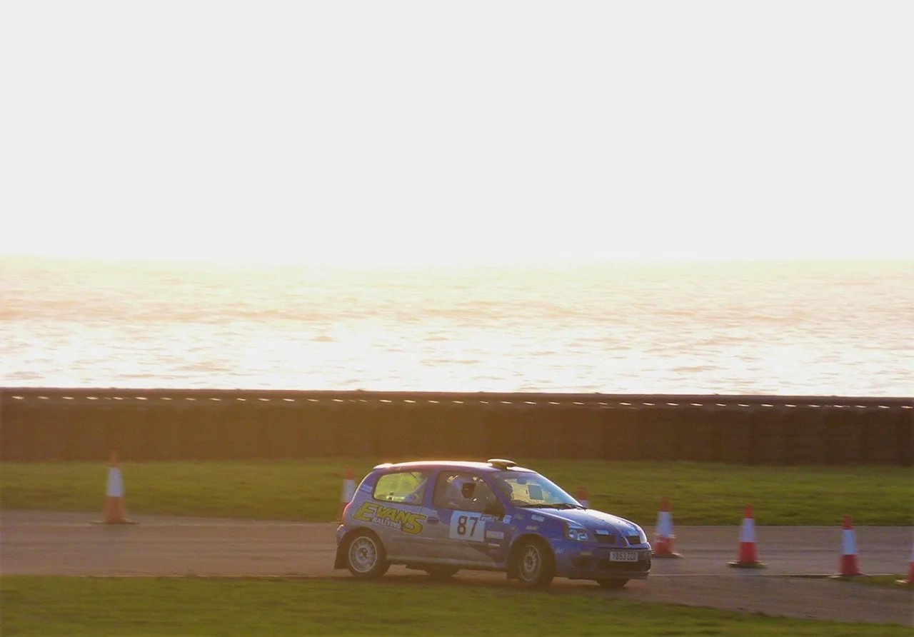

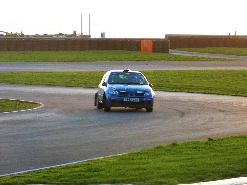

Fun day yesterday on the rally track day.
I have a strange intermittent electrical issue though. Something was drawing power. So I’d have a misfire and epas would stop working. If the car has been sitting in the queue for the stage the first 10 seconds of the stage it would misfire like hell. Like there was no fuel. After that it would run fine
@Nathan Evans how did the gripper feel in terms of lock up/harshness?
And it’s amazing, the gripper has done more miles than the ‘other’ one, yet still not broken?! Whatsallthatabout?! ?
It was hard to tell because the track was so greasy. I was spinning the wheels up quite a lot on the slower corners even on new tyres. I’ve took it down a dry industrial estate and put it round a few roundabouts and it feels perfect though. Just need to find out what’s wrong with the epas
Hahah i know, I done over a hundred miles round Anglesey yesterday and the gearbox was faultless ??
