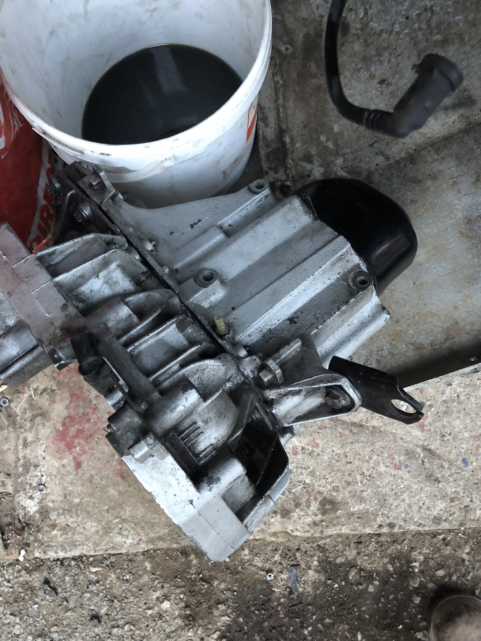

Picked up the gearbox off @NorthloopCup tonight. He’s fitted the RSX diff, cw&p and reconditioned the box.
Can’t wait to get this on now. More looking forward to this than the sound of the jenveys.

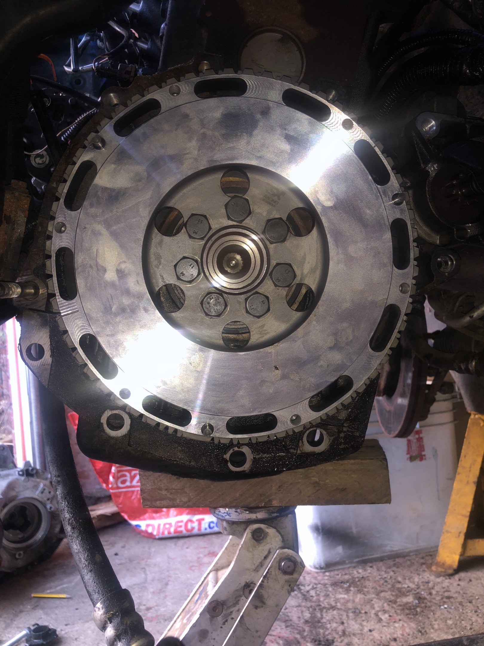

New Clutch, lightened flywheel and box all fitted tonight.
Too a few goes to get the fly wheel on though. For a minute I thought I wasn’t going to fit

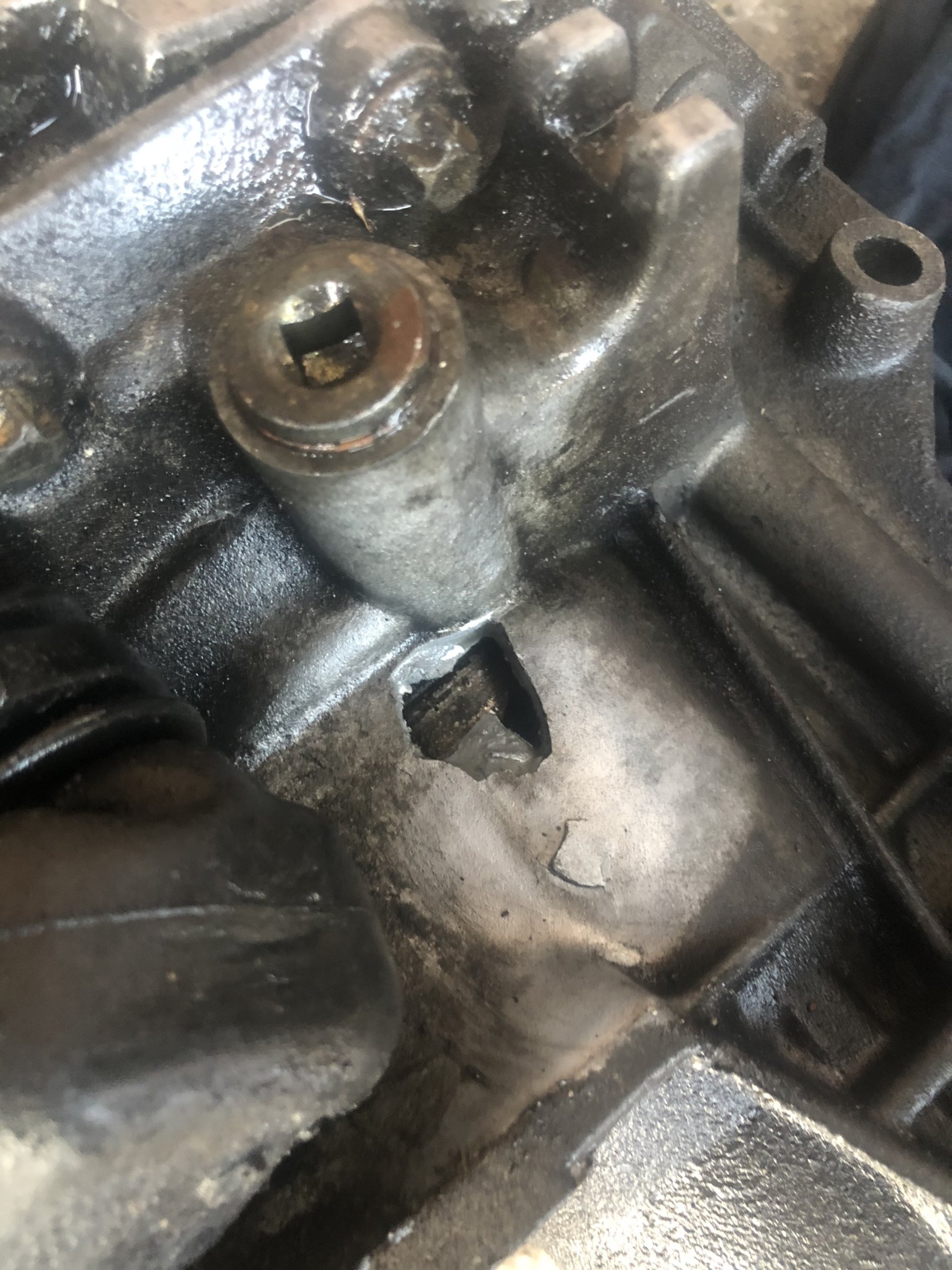

This was the hole in the old box

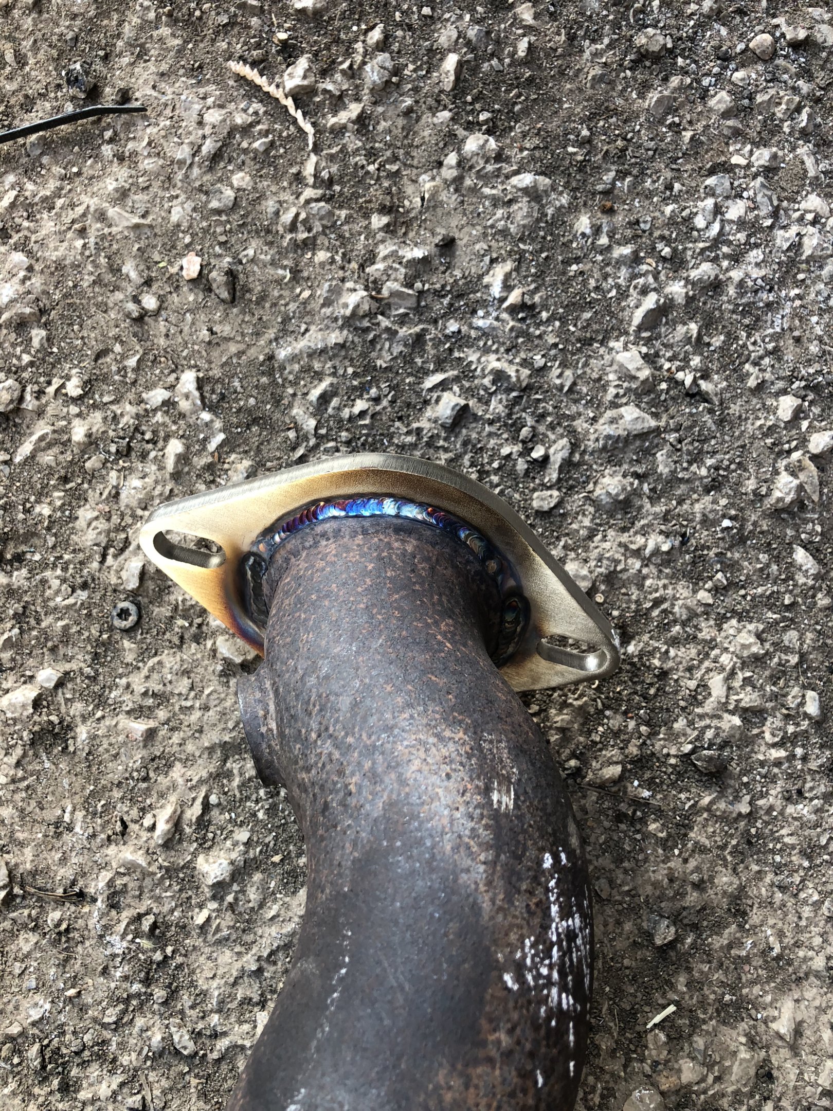

Also got a new flange on the 182 manifold. No messing about this week.

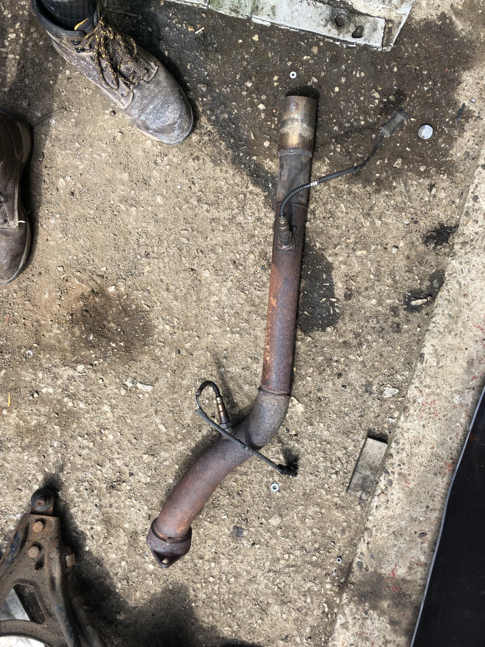

Manifold and this shitty decat is off

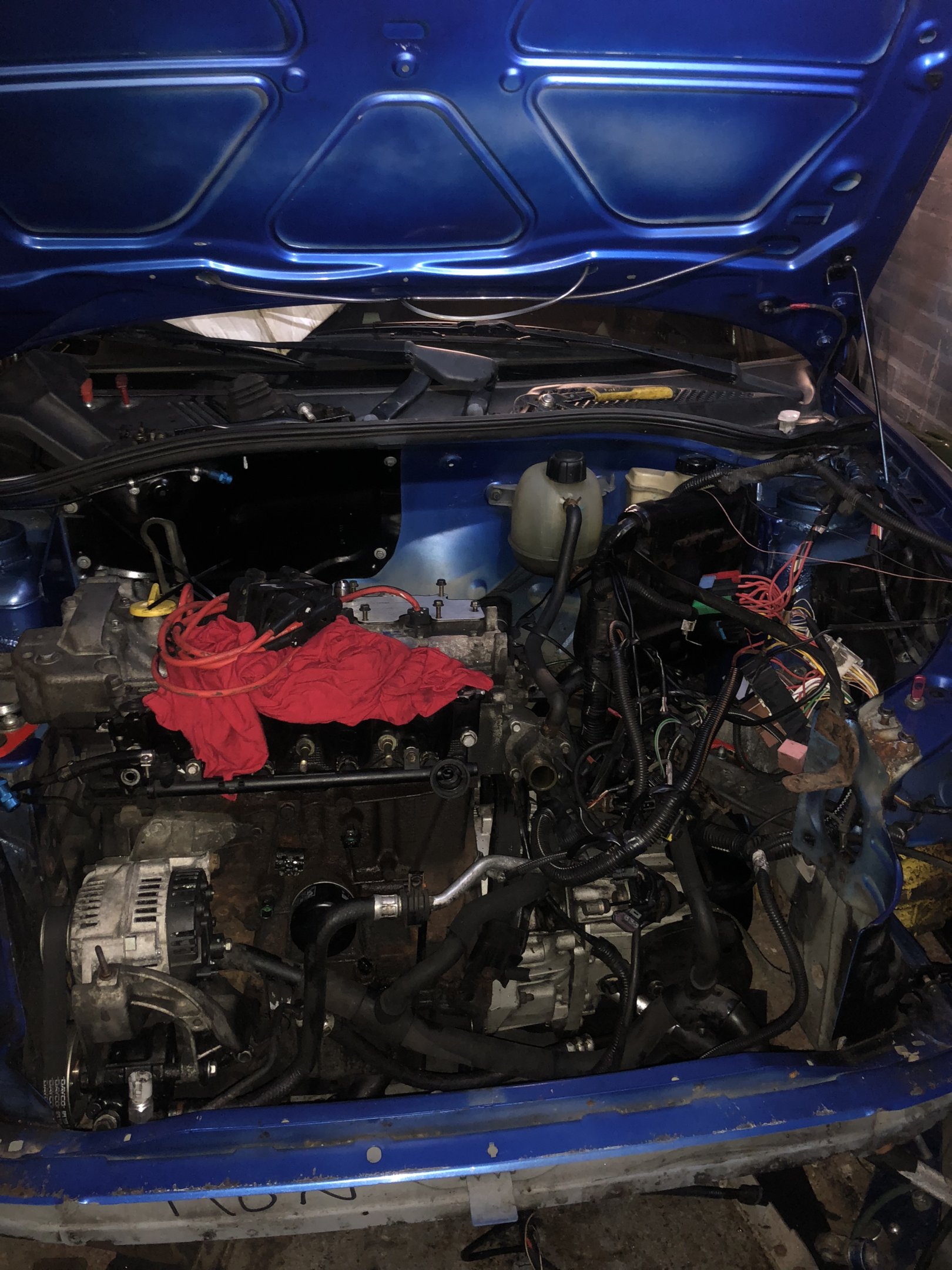

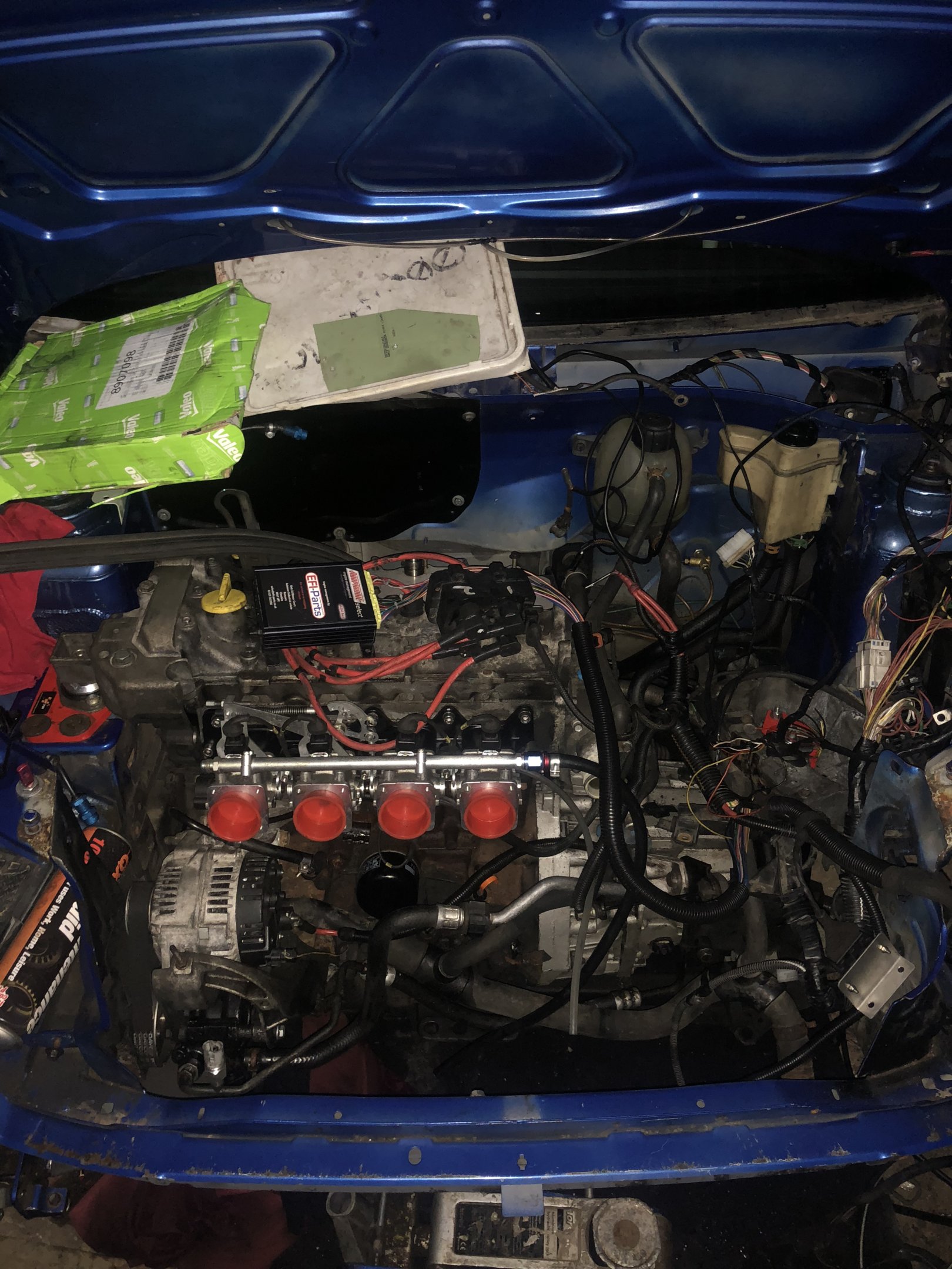

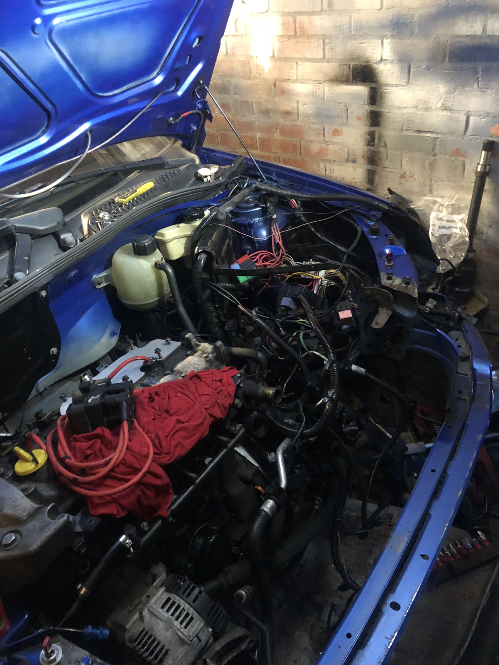

Haven’t done anything since Thursday but I’ve had a change of plan.
I was going to fit the box and subframe, have a couple of evenings driving it. Then fit the bodies before mapping.
But I thought sod it. I’m going to do it all at once.

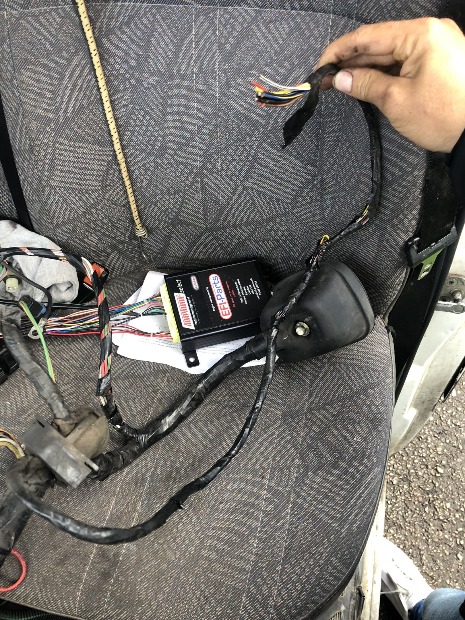

So tonight unplugged all the loom. Just got to discount the ecu and up bolt the loom to the car.
Radiators off along with upper inlet and breather plate
Leaving it looking a mess
Someone who’s had a loom off before... where do these wires go? They go through a grommet in the bulk head under the pas fluid

only ones i can think of that aren't in the main plug are alarm?
Cheers ?? I had a quick look but I can’t get the in the to look properly with all the s**t in the garage. I popped my head in but my looks got a million cable ties and tape holding out the way

You know when you start something you wish you hadn’t
The engine loom what came with the bodies has no plugs for the pas pressure switch or dephaser. The car the loom was off was running no vvt. So this loom is coming back off tonight. Old one back on and hopefully source a gen 90 ecu this week.
If I can’t the standard inlet is going back on for the time being

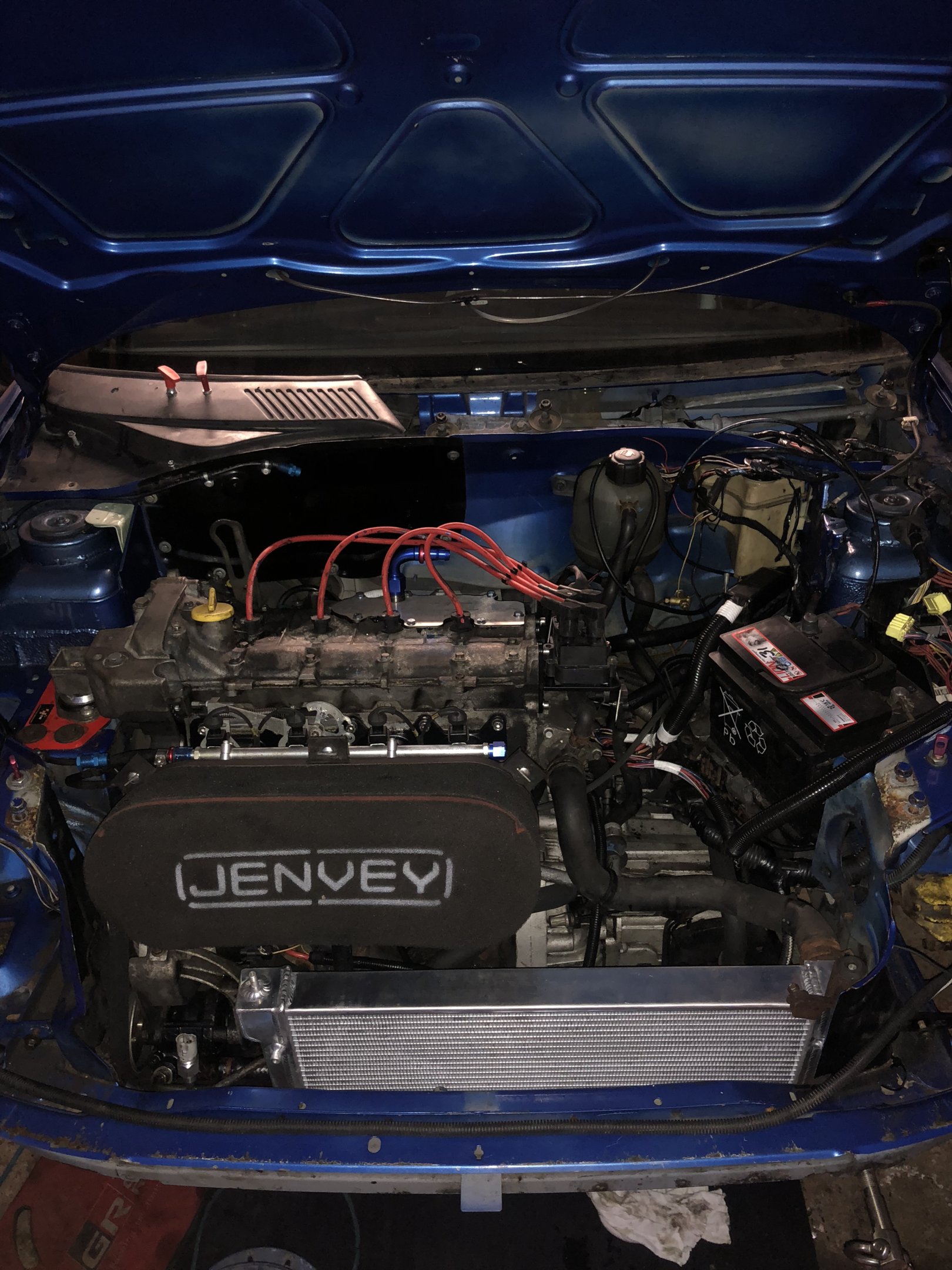

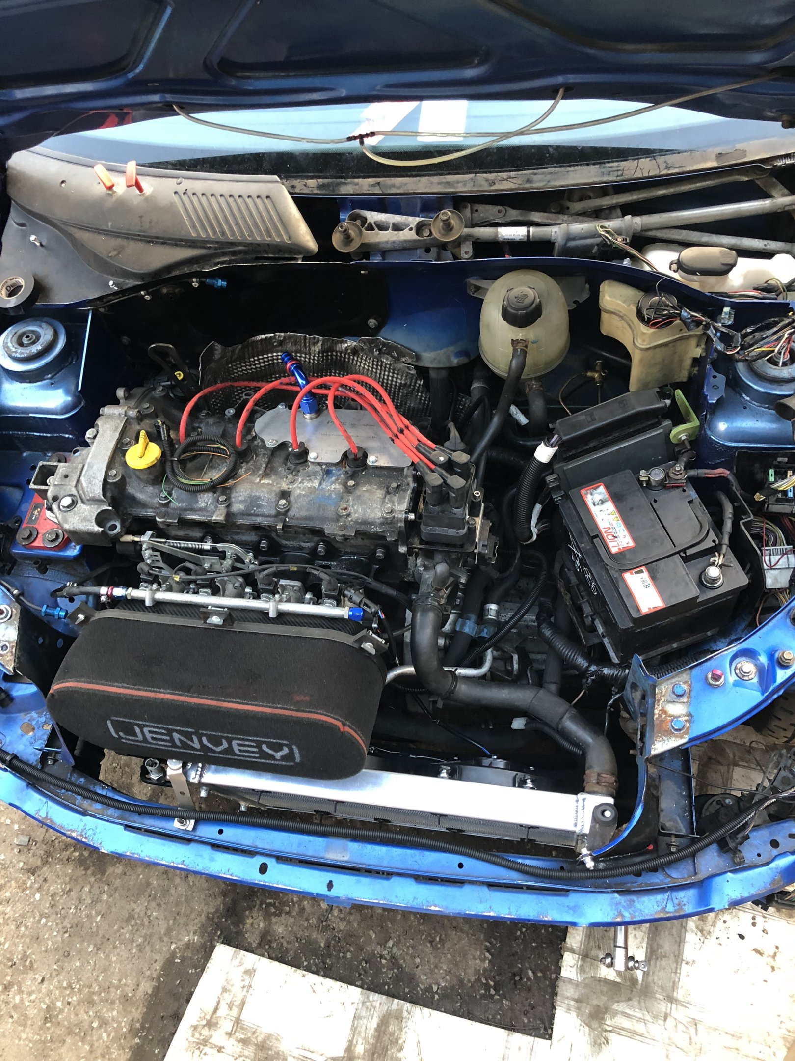

It runs.
Now ready for @bloke to finish some niggles and wire a few things up.

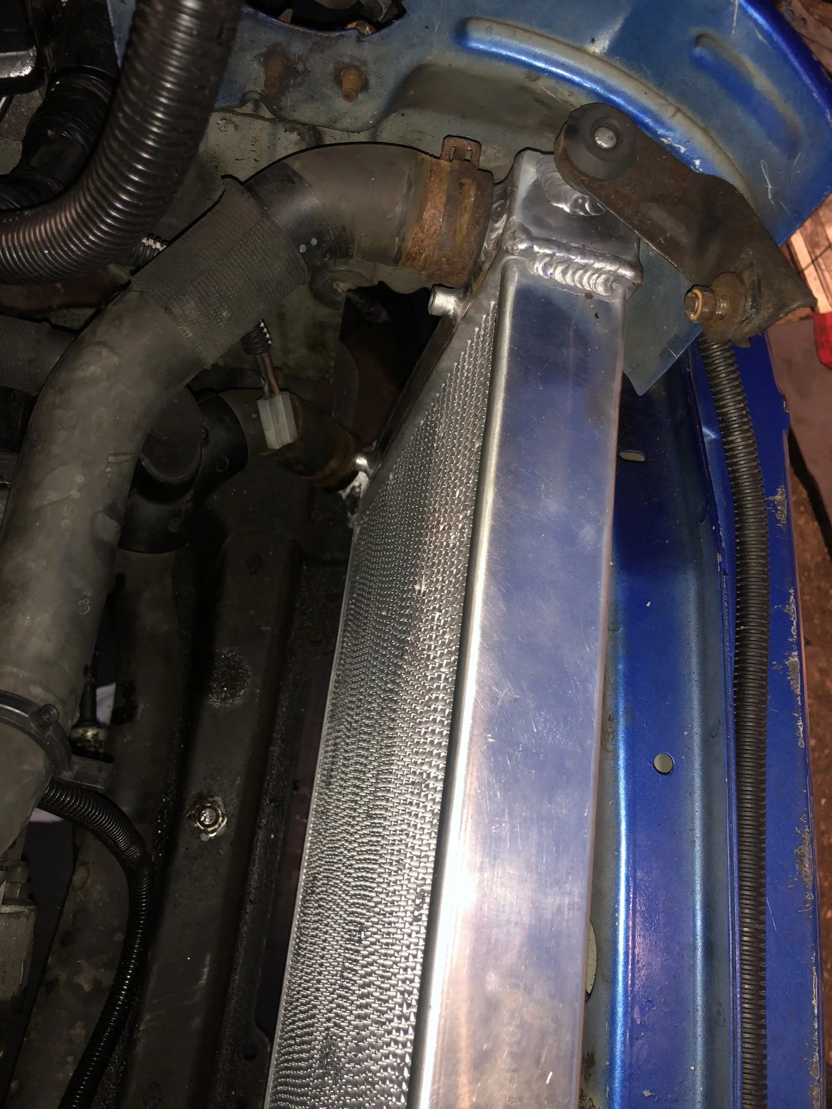

Golf rad with the bottom hose welded on an angle and pins welded for the subframe. It just needs a bracket in the top and the fans fitting
Nice! From your last update ‘you know when you’ve started something and you wished you hadnt’... I was starting to get worried it would end up like mine........taking months! ???
  Audi rs3/Clio 172cup
Probably the tattyist looking engine bay on a Clio running itbs ?
So the car ran and drove all be it up the road and back with no front end on it. Went to move it last night and the fuel pump isn’t priming.
Haven’t had time to check it properly but should be able to figure it out one evening this week.

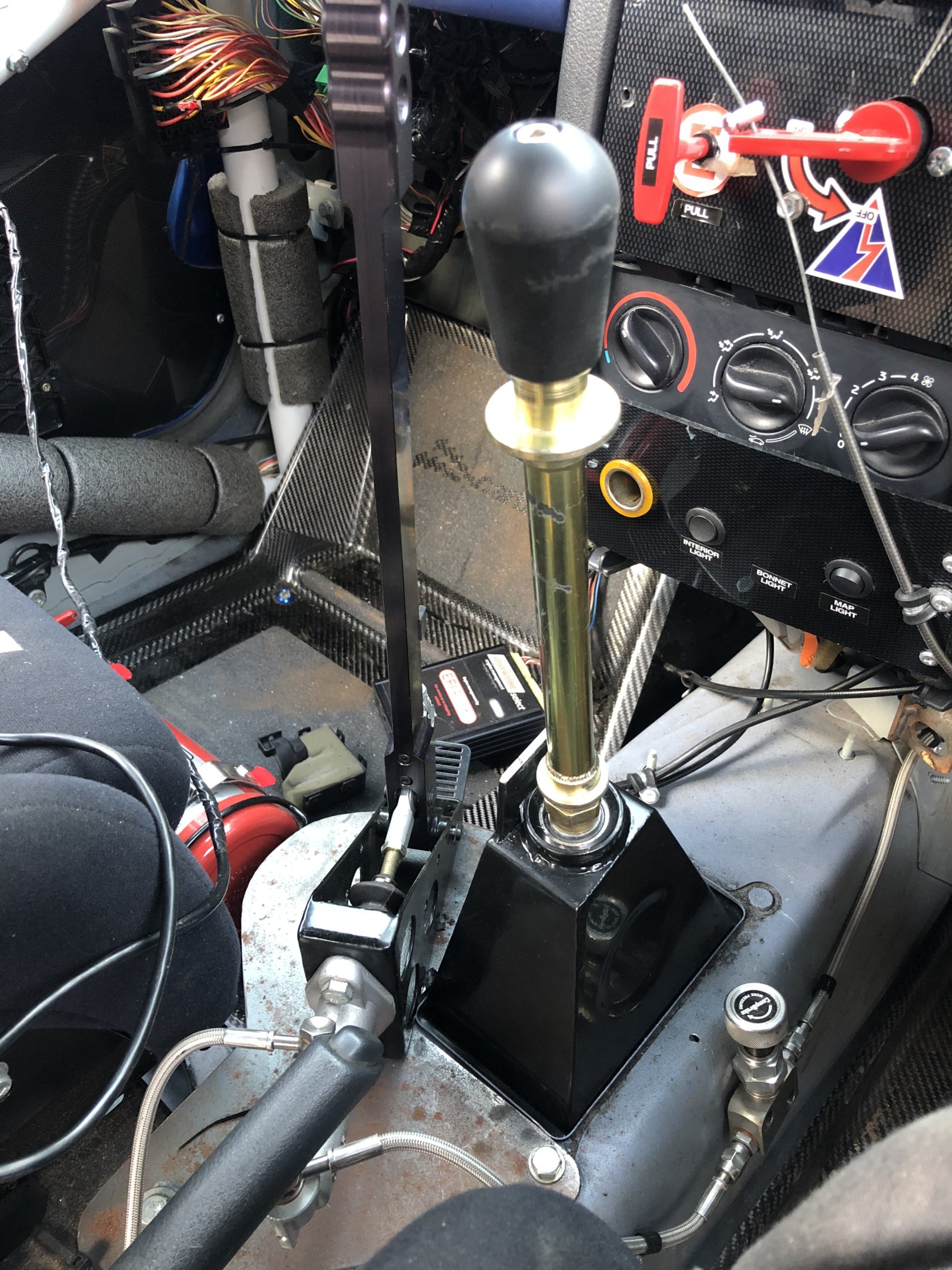

I’ve also got rid of the bms shifter and gone pms

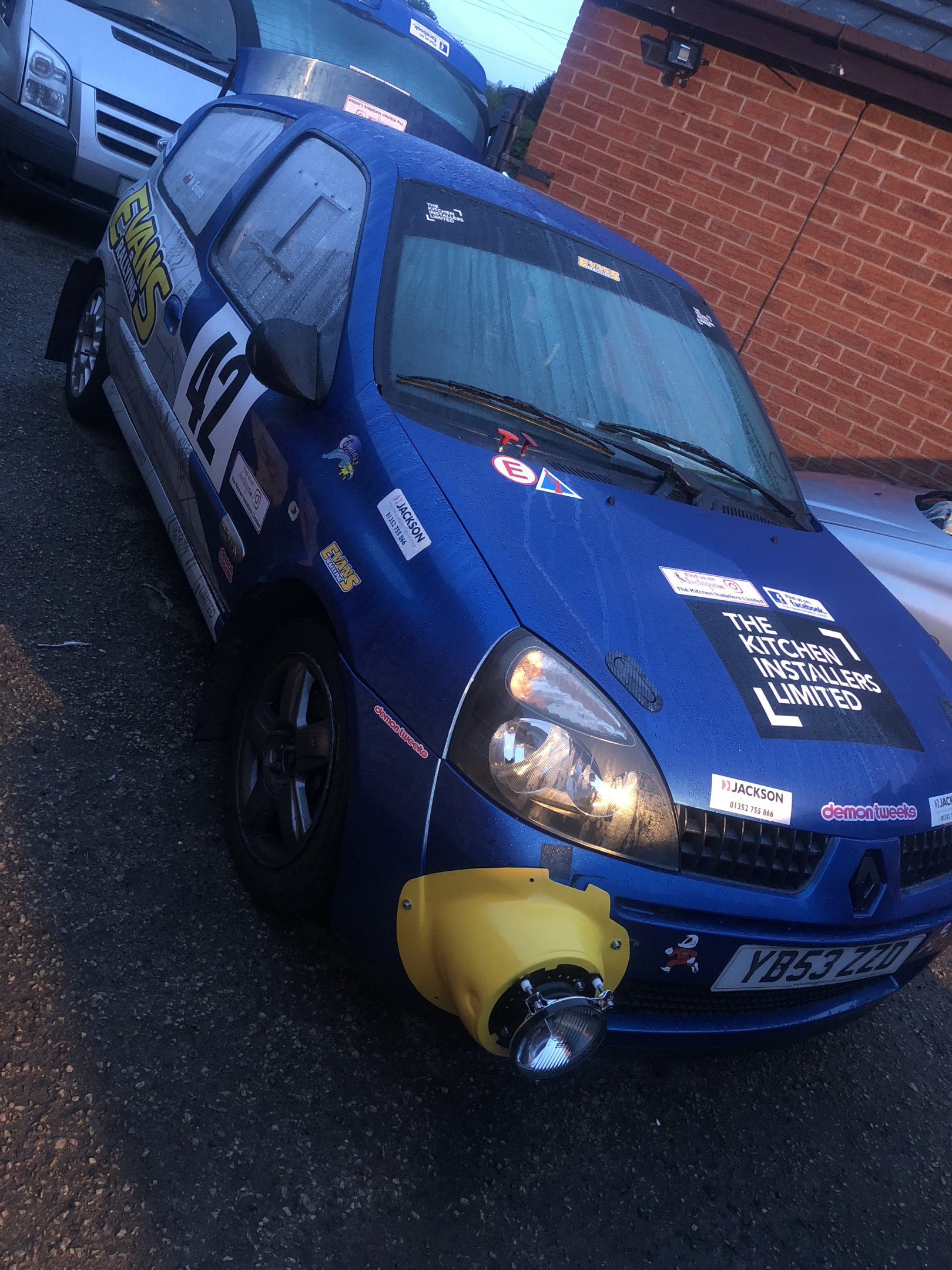

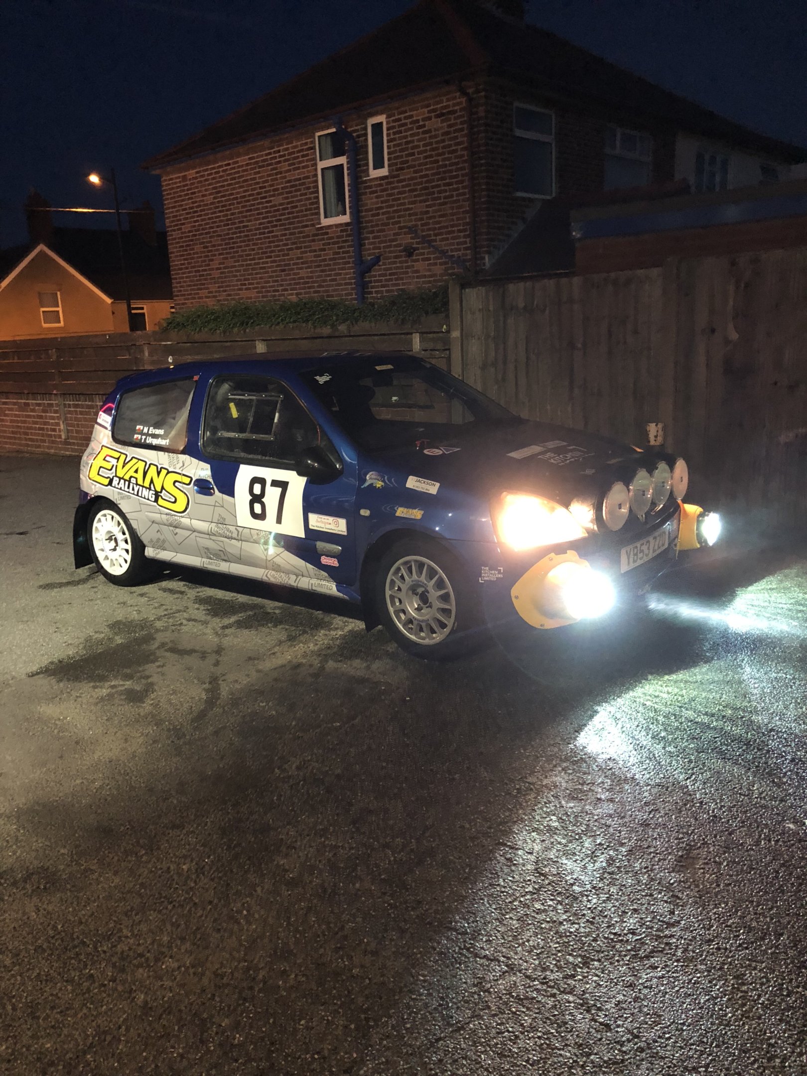

It runs and drives...

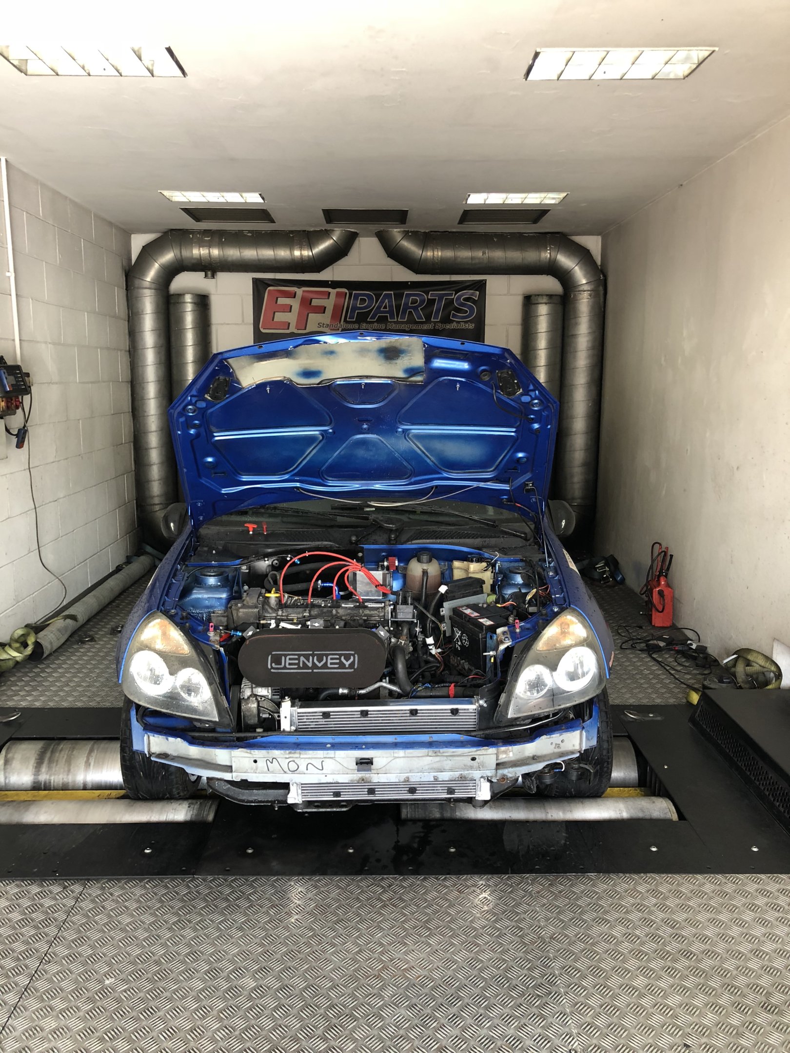

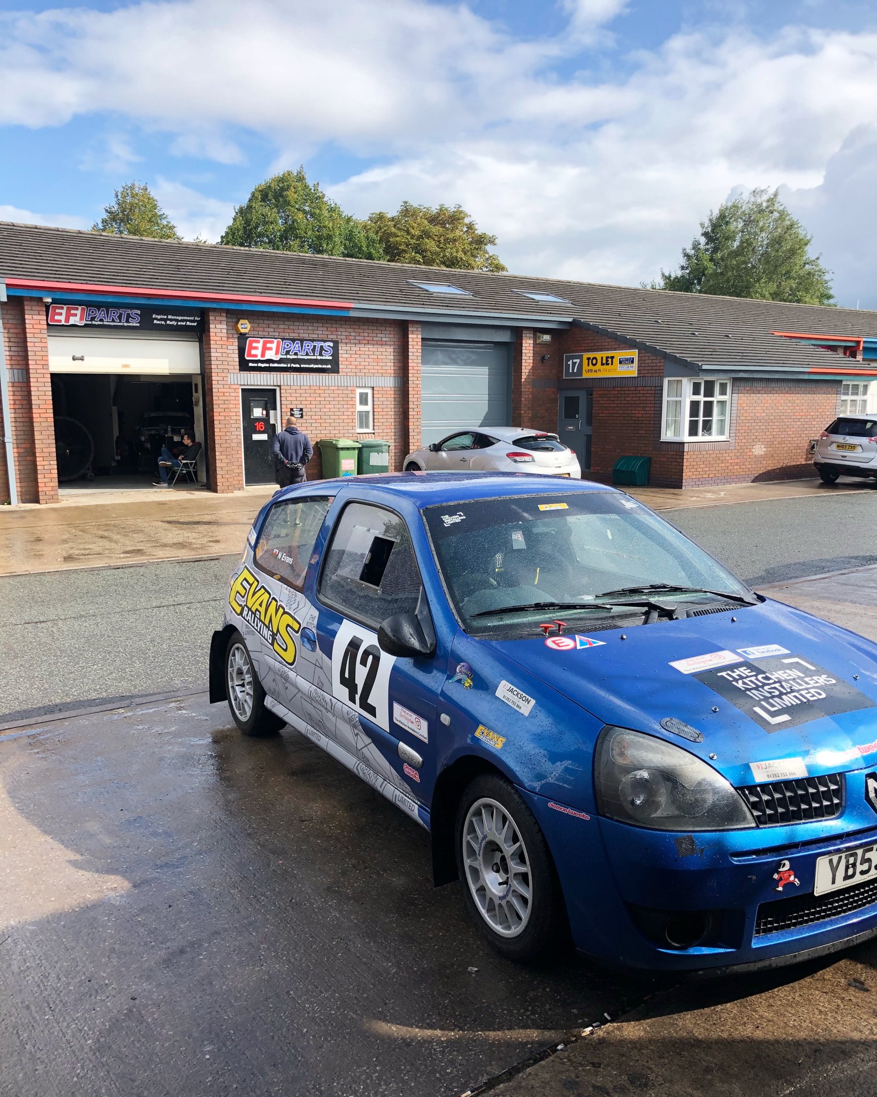

Now time for mapping at efi on Sunday.
There is a video here of the new 5.25 final drive pull. Bare in mind I didn’t want to go all the way to the redline as it still isn’t mapped and the dephaser switch is still not wired in.

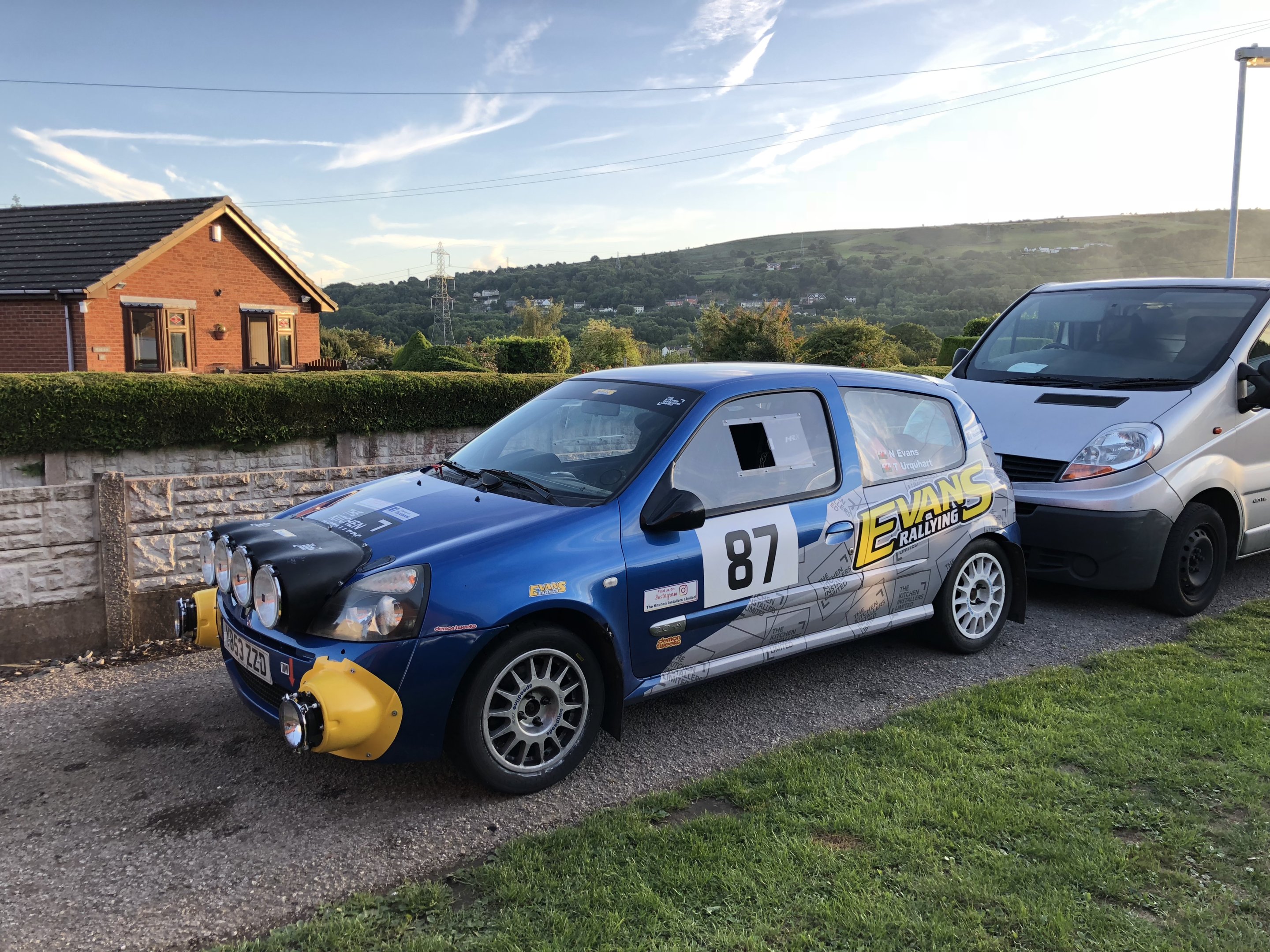

Since the last event the cars had...
Jenvey throttle bodies
Mk1 golf rad with custom mounts
Recon box
Rsx lsd
Rsx 5.25 final drive
Rsx lightened flywheel
Valeo clutch
182 manifold
Pms decat match the rest of my pms exhaust
Pms shifter
Whiteline arb
2x 9” slimline fans
Swipe for videos

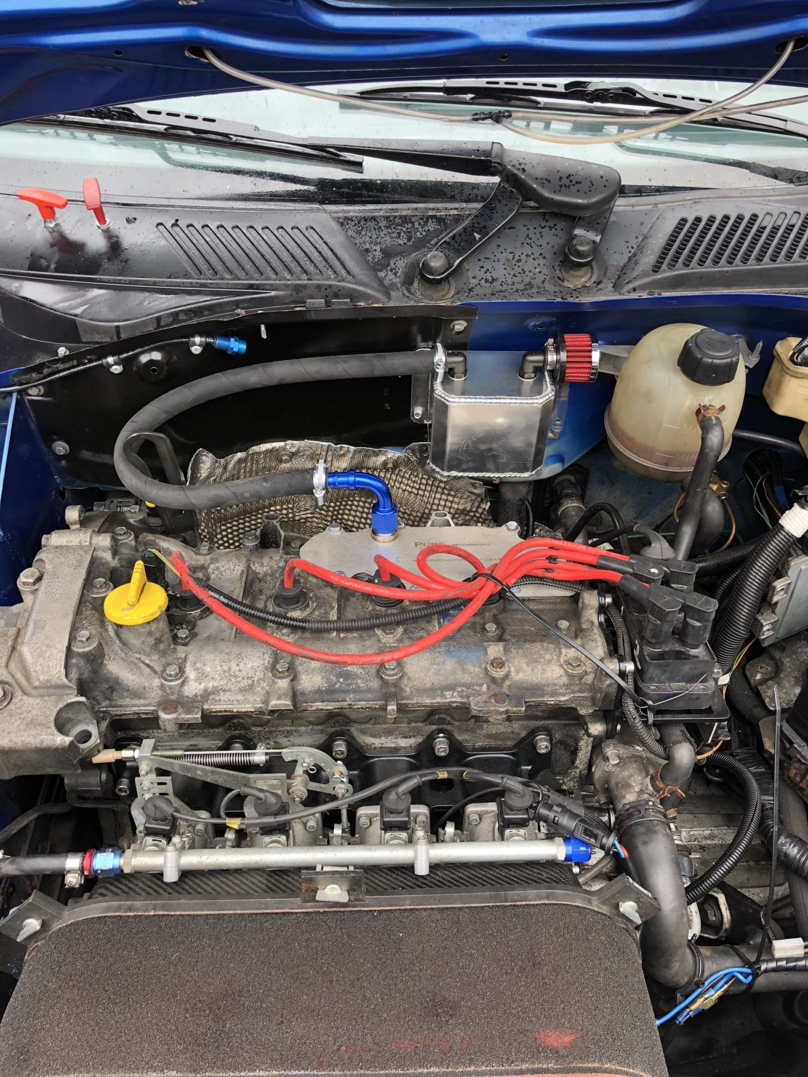

Catch tank and breather on. Just need to get the hose on a little further

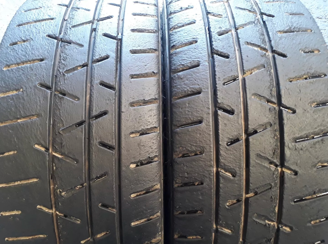

So to some new tyre pitches
2 new Kumho softs to go with another set of new super softs for the rear
Set of used new style hankooks in soft

I've been looking at tyres today. Funk me they're expensive ?
It’s a rally car not a show car ? I’ve bought another engine to be built at a decent spec, so that one will be nice and shinny.
Tyres are ridiculous. I paid £280 for them kumhos, £100 for the hankooks from us tyres and £320 for the super soft kumhos from tweeks.
Those hankooks new are £170 a tyre ?
What size wheels you running? Some good deals on 16” dmacks at the minute. I’m tempted to buy a set of turinis
And I meant JD tyres not us tyres. Stupid iPhone
Pauleds
  Merc Dueliner sport
Soft inters for the rear 220 each
Fronts i had a job lot part worns 80 each.
They work well down to the wire
massiveCoRbyn
  Several
Everyone seems to rate Michelins. I probably won't go with anything too fancy to begin with, maybe try and pick up a few cheap part worns if possible, just for shakedown purposes.
Running 17" wheels doesn't help greatly I suppose.
massiveCoRbyn
  Several
Yeah have read very mixed stuff about them online, but never really think you can put too much stock in it. Sure they're not as good as a Michelin, but would be very interested to hear an honest review. They are bloody cheap that's for sure.
Twingo 1??
  Twingo 133 Cup,
I had some maxsports on the Puma and hated them. On the front they give no confidence turning in and on the rear it felt like they were constantly moving about. They have very soft sidewalls that gave the above affects. They offered good grip though but just didn't like the way they moved about. Have some sliverstones that are much beter and some used Dunlop that are better still. They are the only things I have used so far.

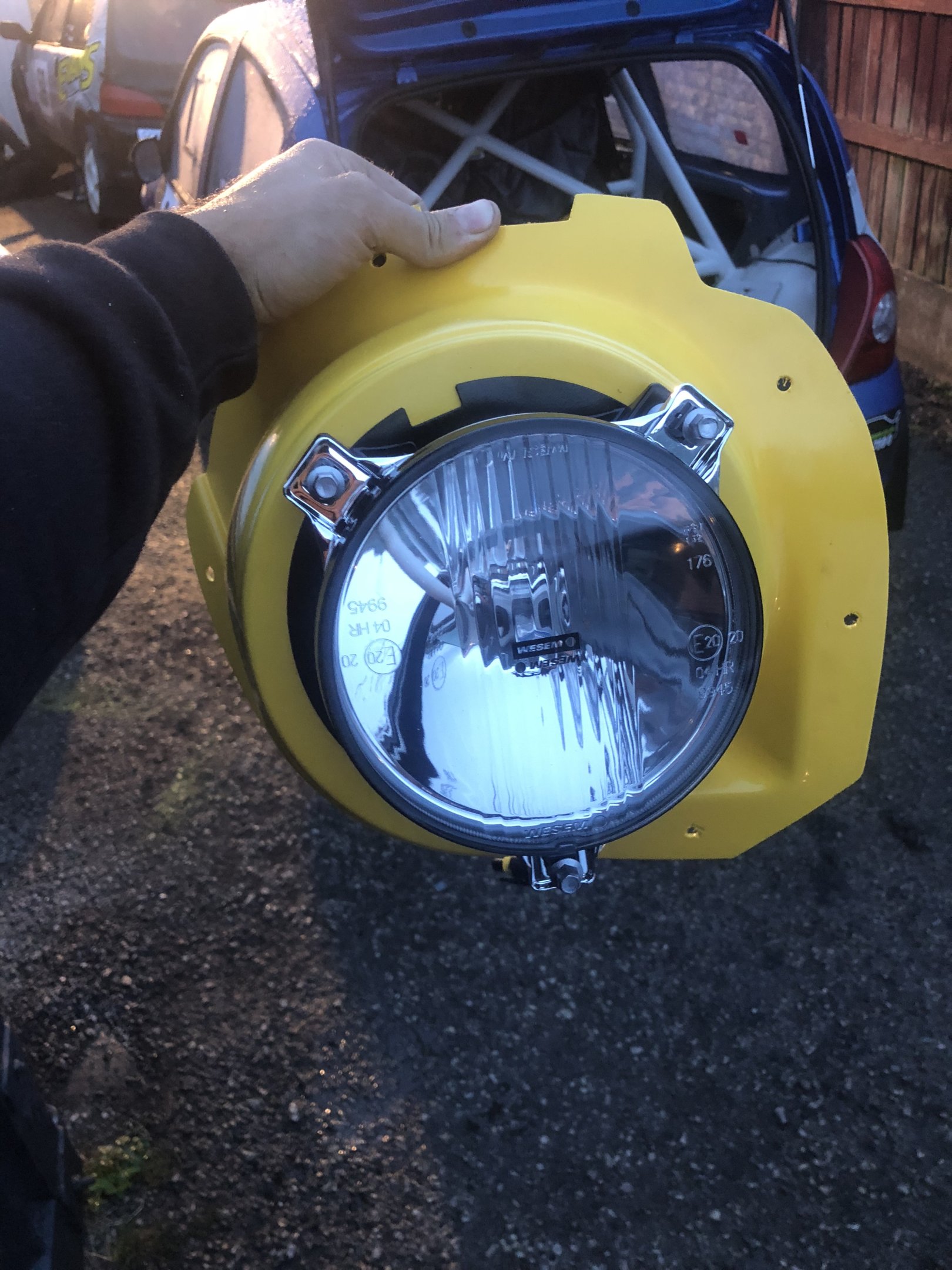

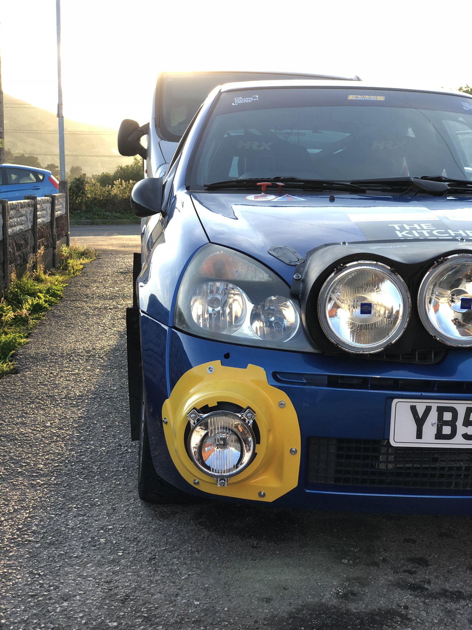

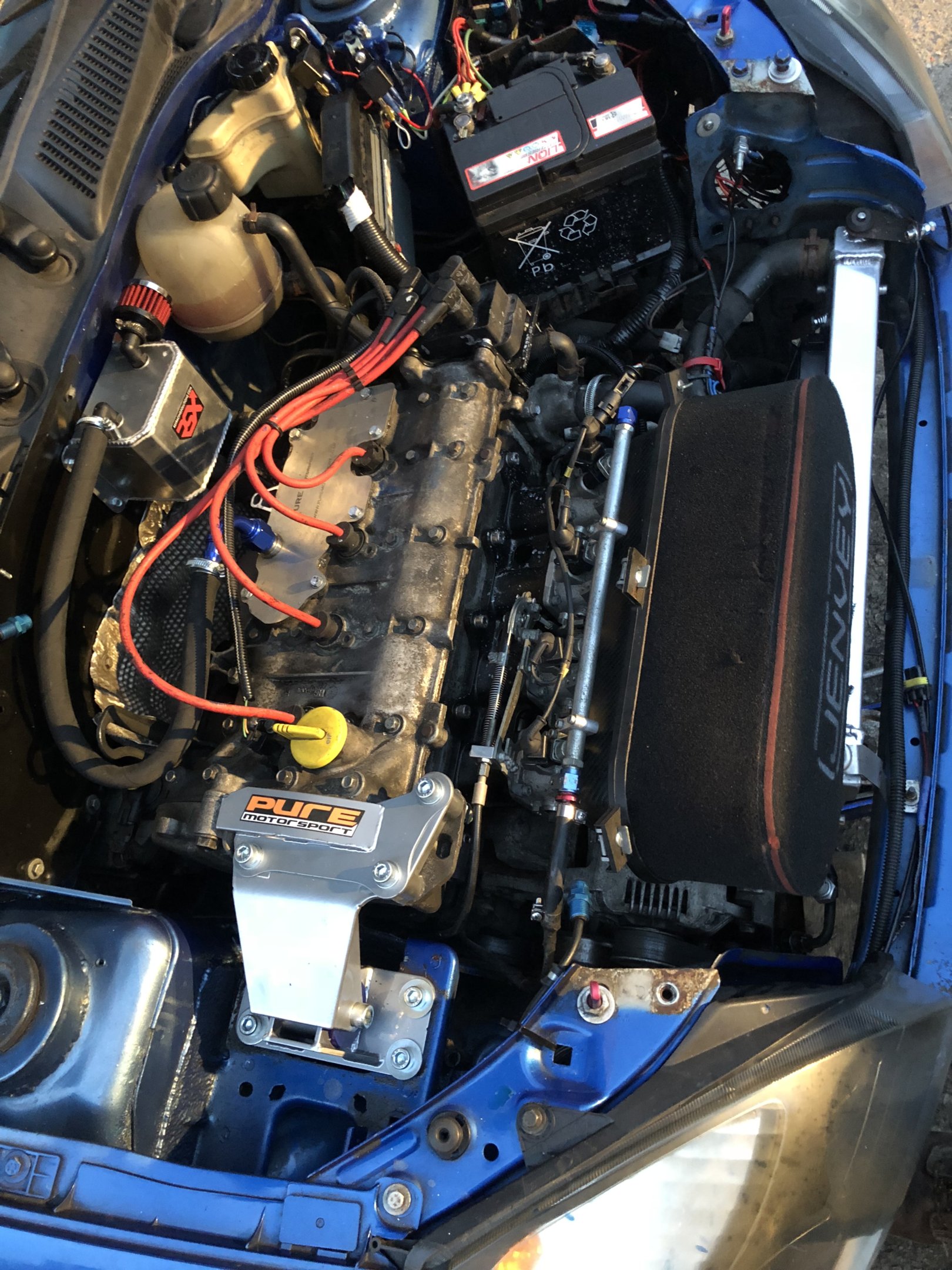

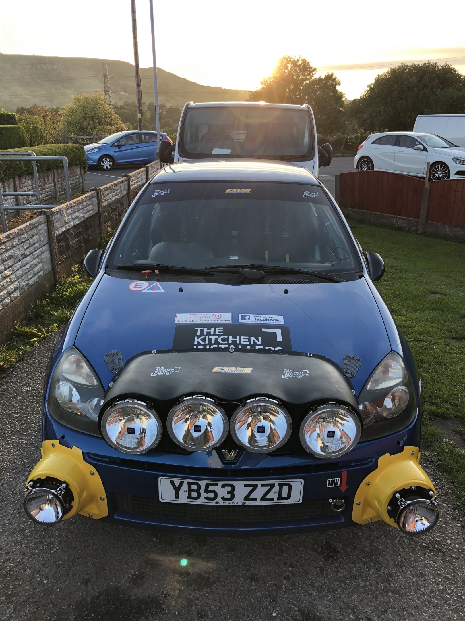

Bonnet pod fitted and wired up. Also got the bumper pod wiring finished ready for them to fix on to the bumper.
Bought an upper pms engine mount as my red Ktec one kept coming loose and wouldn’t tighten back up.
I had to bend the throttle linkage out the way of one of the bolts on the mount.
I need to fit a longer throttle cable too as there isn’t enough adjustment on this one. It’s to small.
The throttle pedal inside the car is a lot higher than the brake pedal at the minute, which is horrible to drive in anger.
So I’m going to fit a new cable and maybe bend the ph1 pedal to get it in a better position.

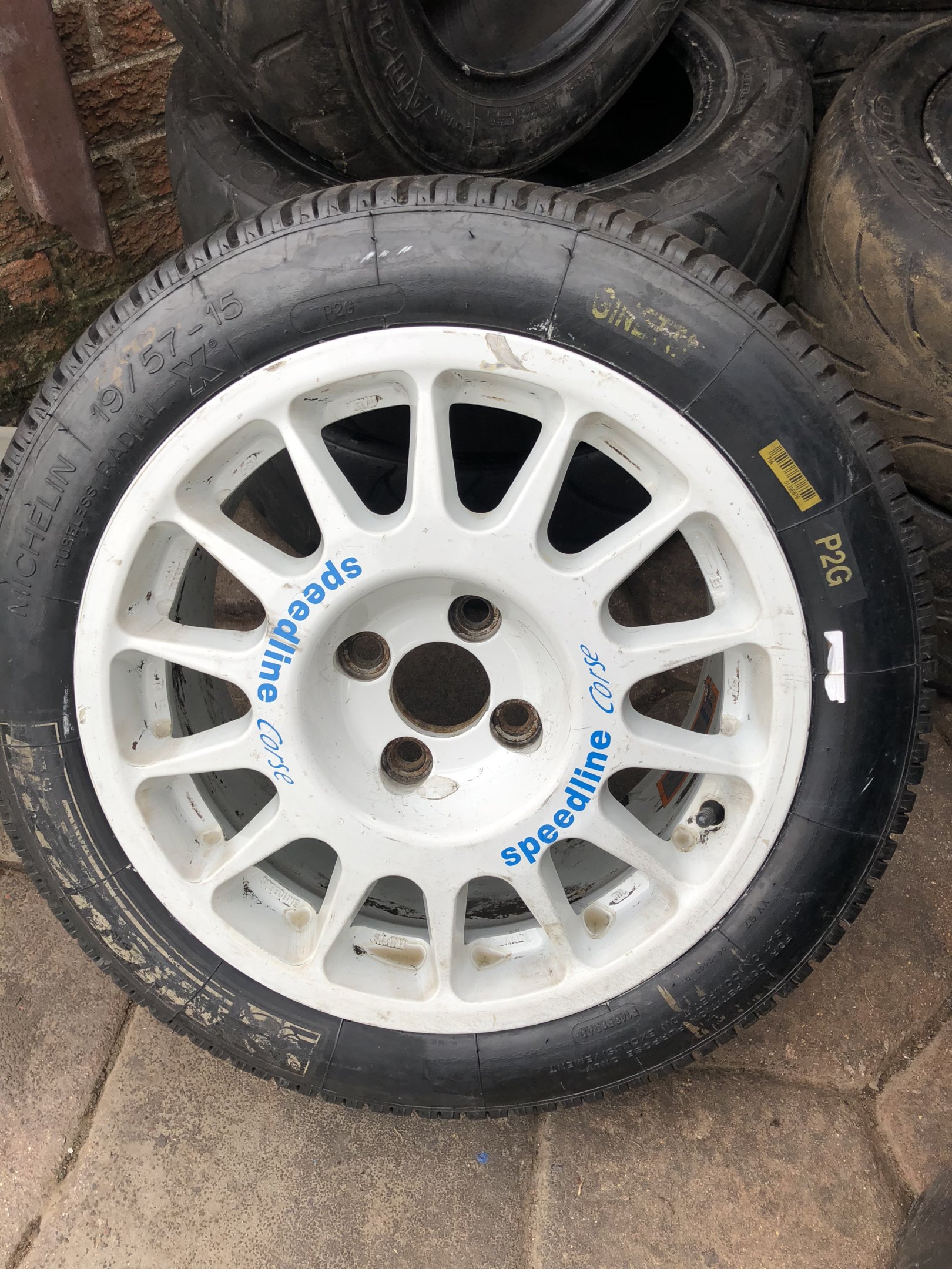

Still got some bits and bobs to finish off and get all my tyres on the right rims.
If anyone has 2 speedline 2118 let me know and I’ll buy them
