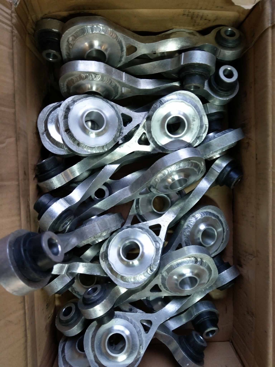

Yeah I could buy the pms one but it’s not the strongest on the dogbone piece. It’s got bits cut out the middle to reduce weight. A friend of mine snapped his.
optimiz access do a solid dog bone, but with anything holomagated rally it’s not cheap
I’ve also ordered this which I know you’d like too ?

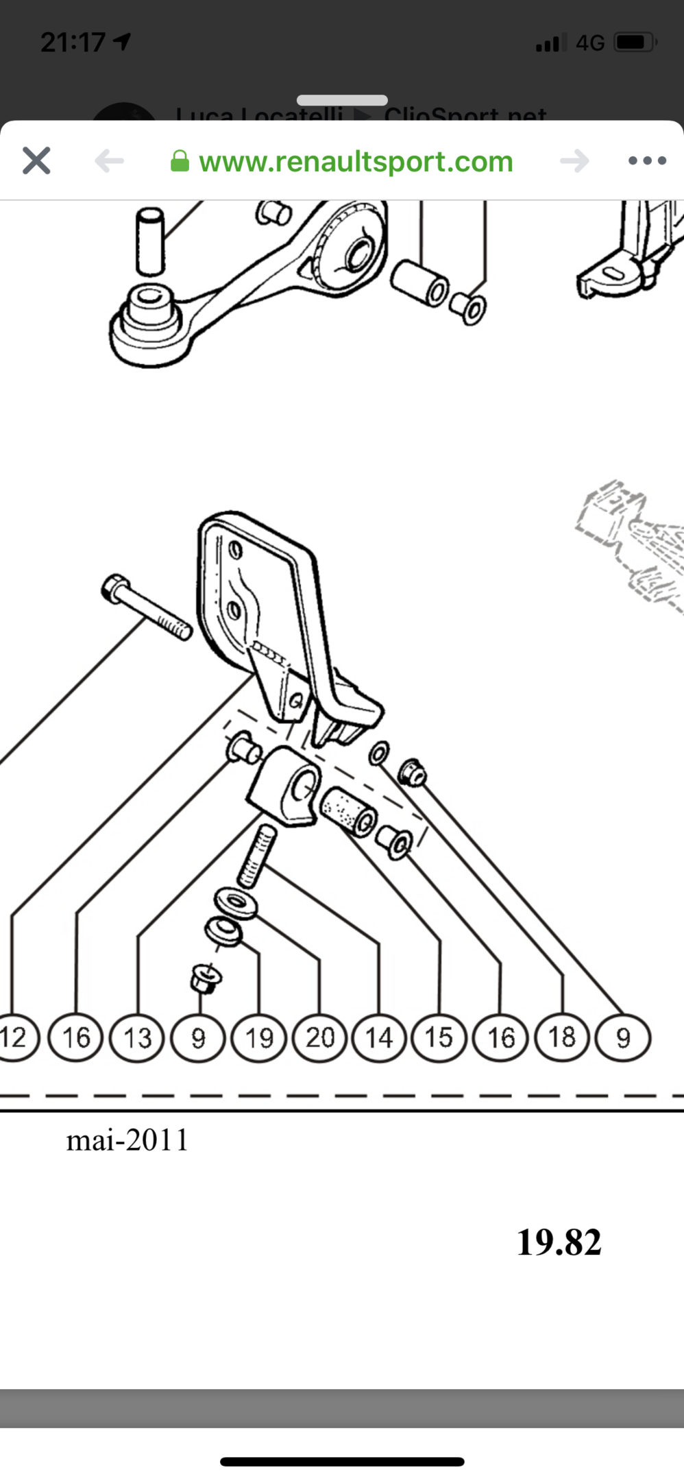

I missed this post. Where’d you get the gearbox/subframe mount from. The oe design is shocking.

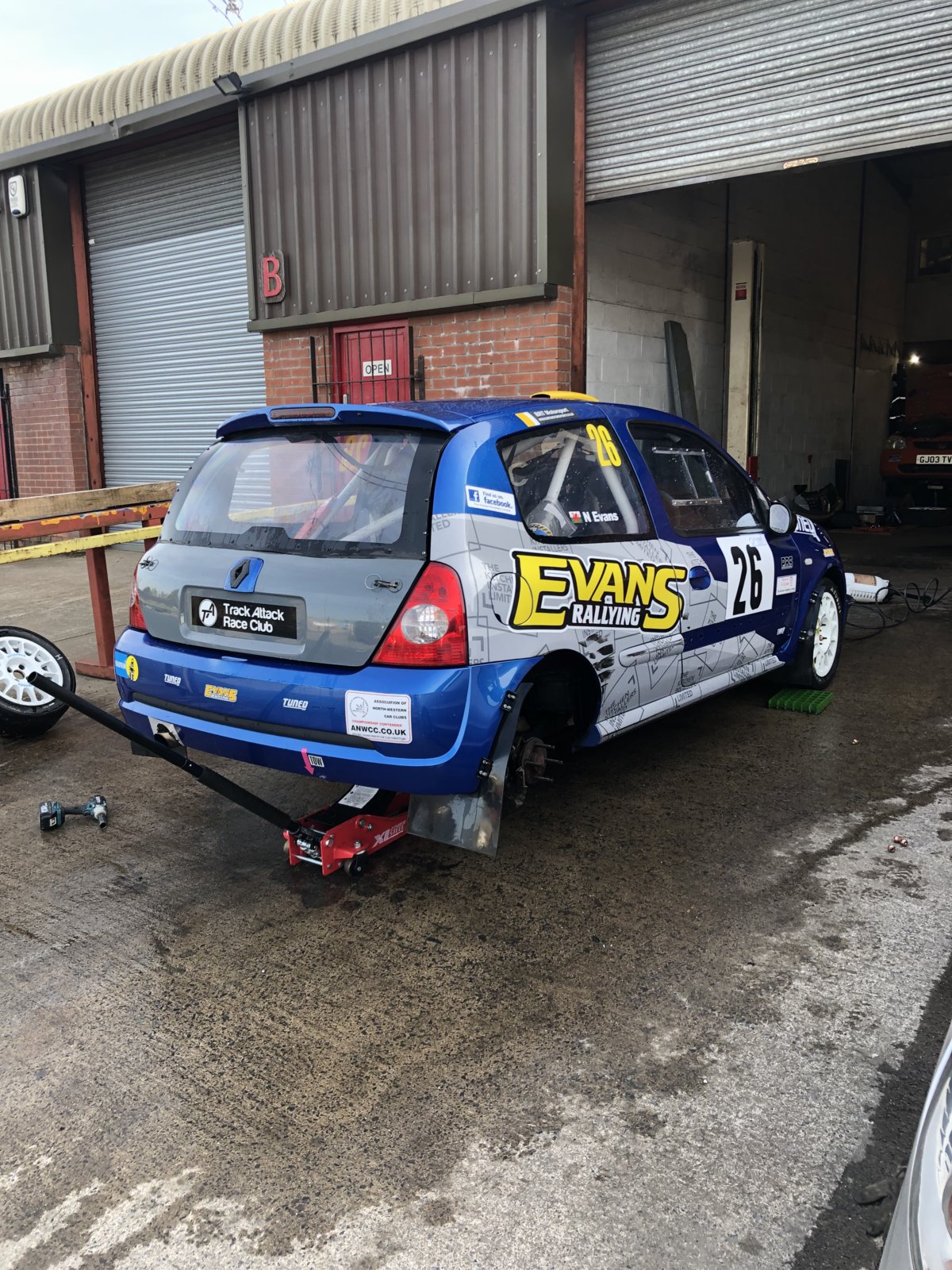

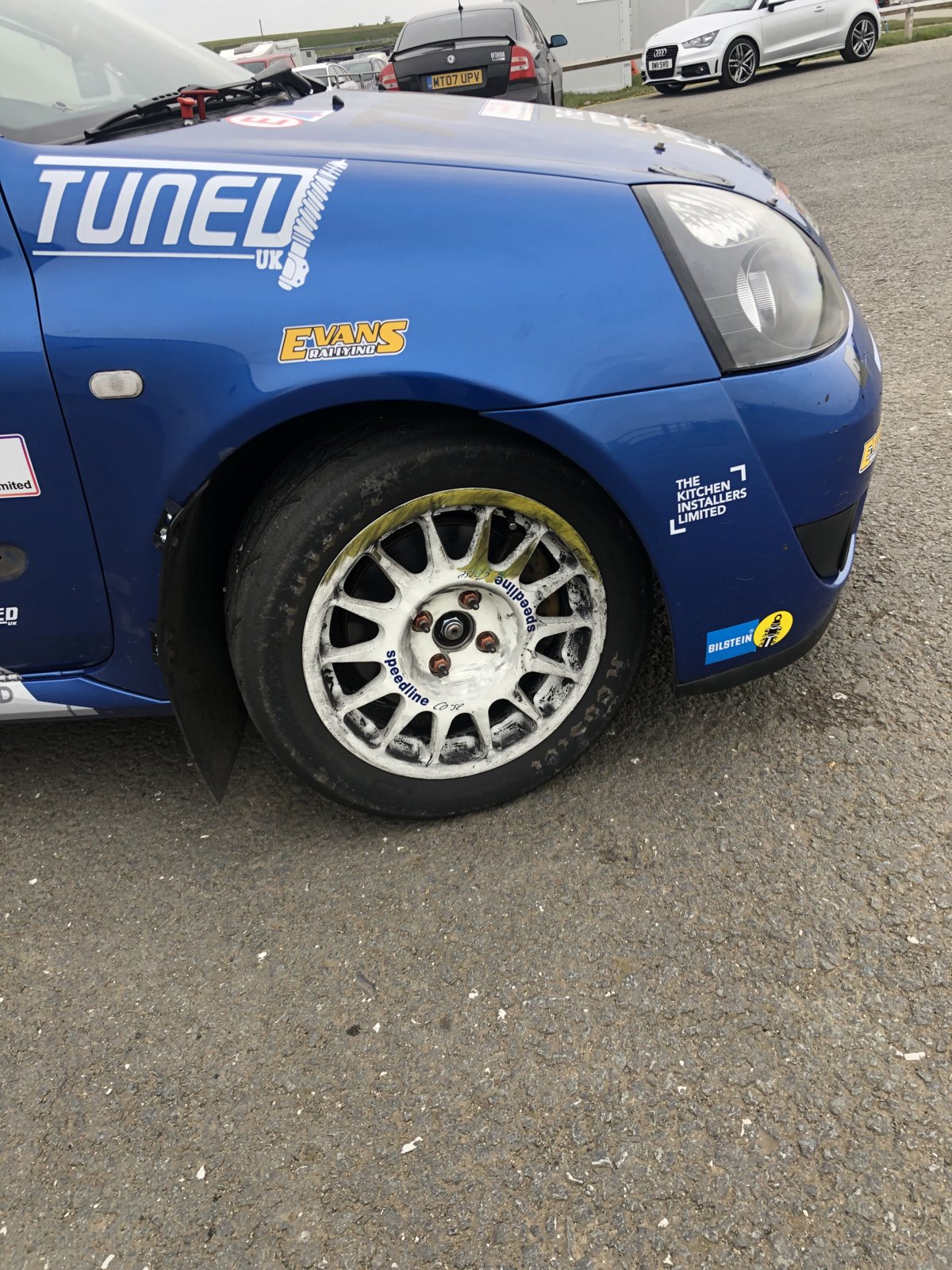

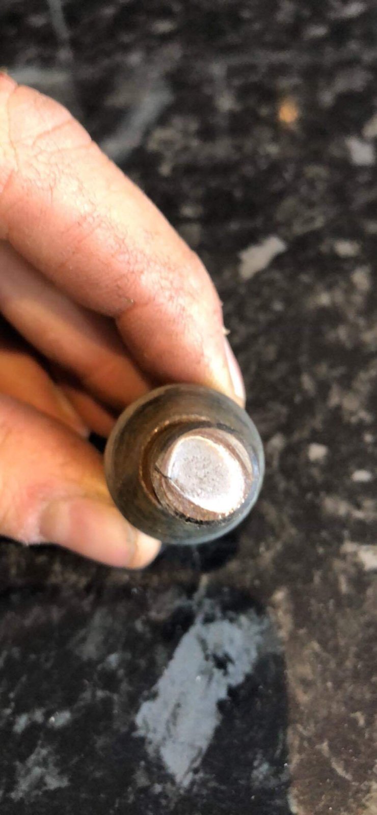

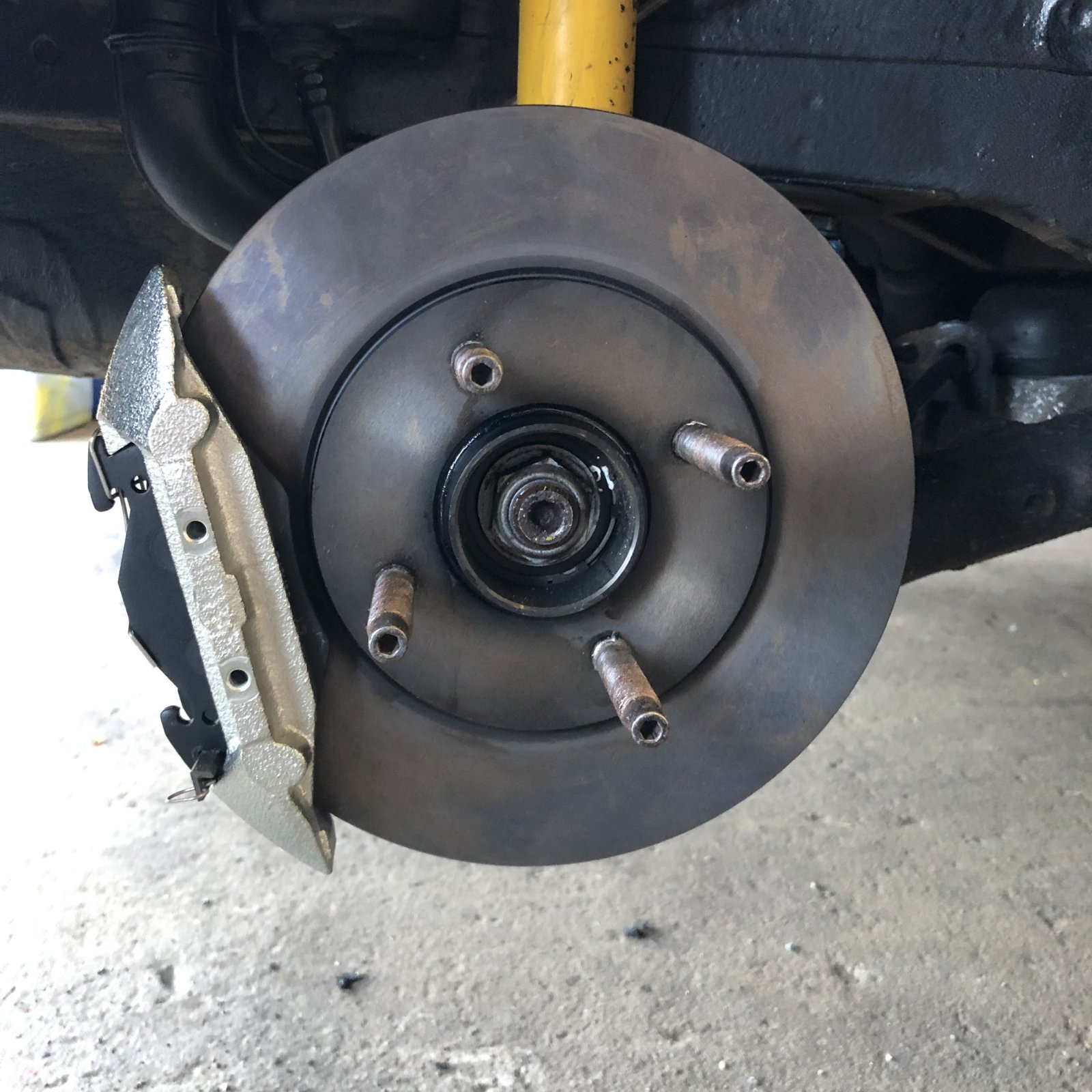

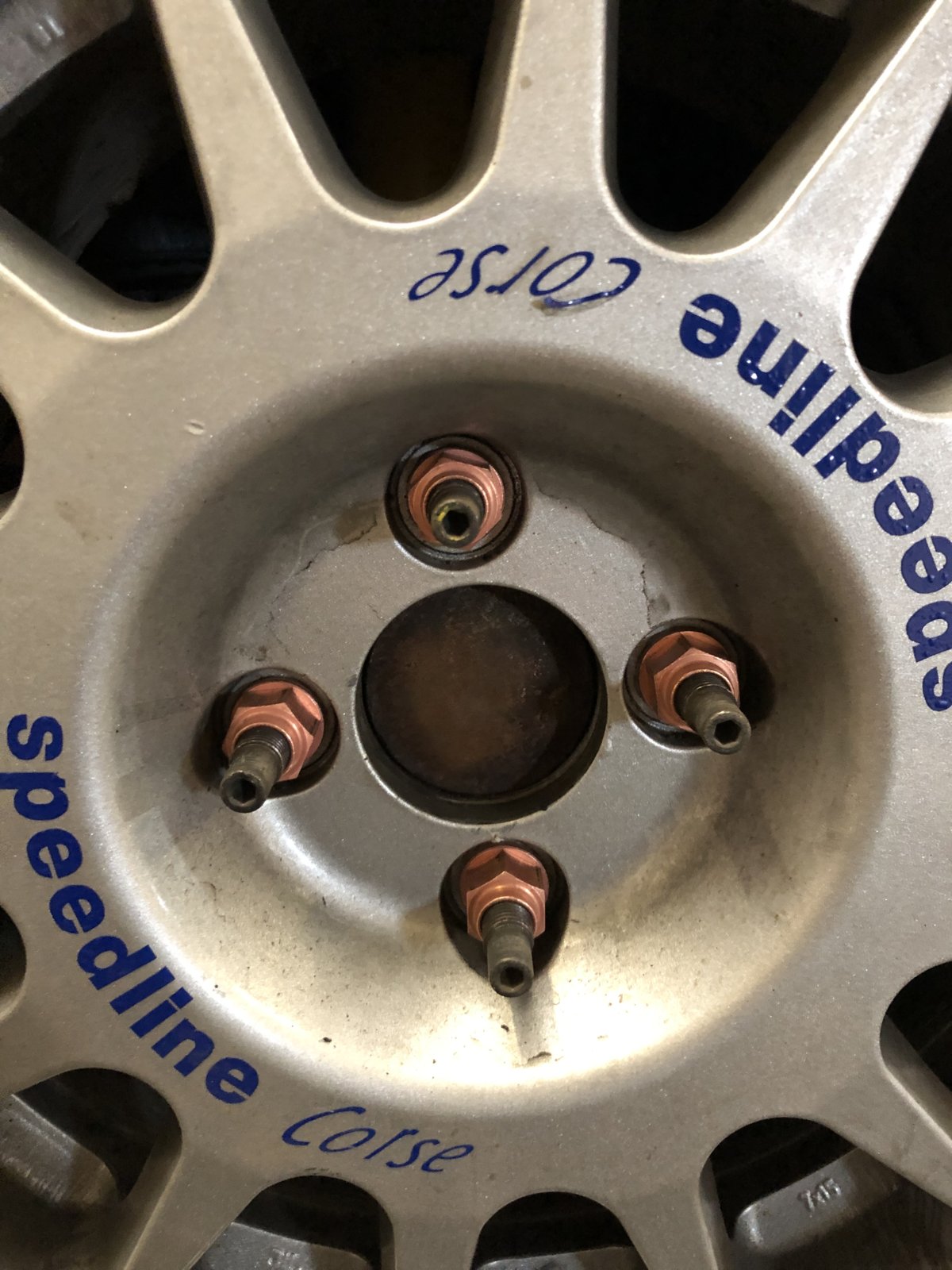

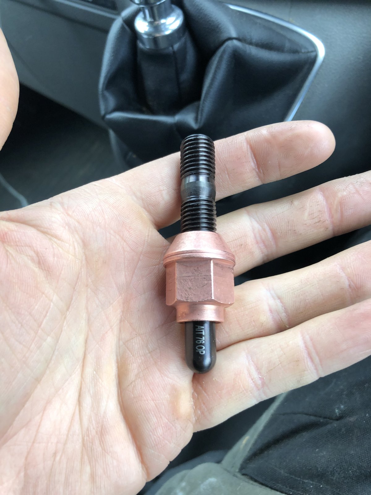

Seeing as I’ve snapped 2 of the eBay mtec studs so far. I bit the bullet and bought some AI Tech studs from demon tweeks with copper nuts. I actually paid as much for these as I did for a full running 172. ? but hopefully I’ll not have issues with these. I’m going to keep the mtec ones in the rear for now until I charge rear discs

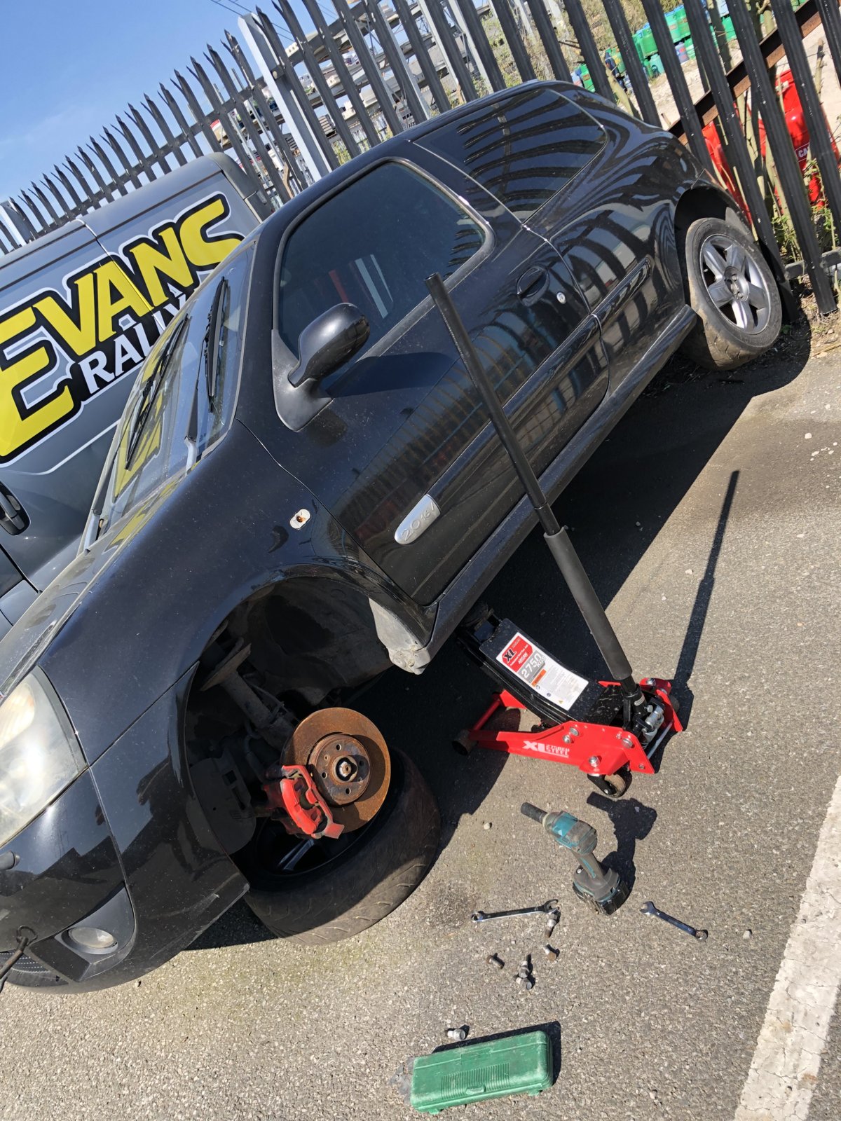

I’m also putting two brand new hubs on the front. Have a tiny bit of play in one.

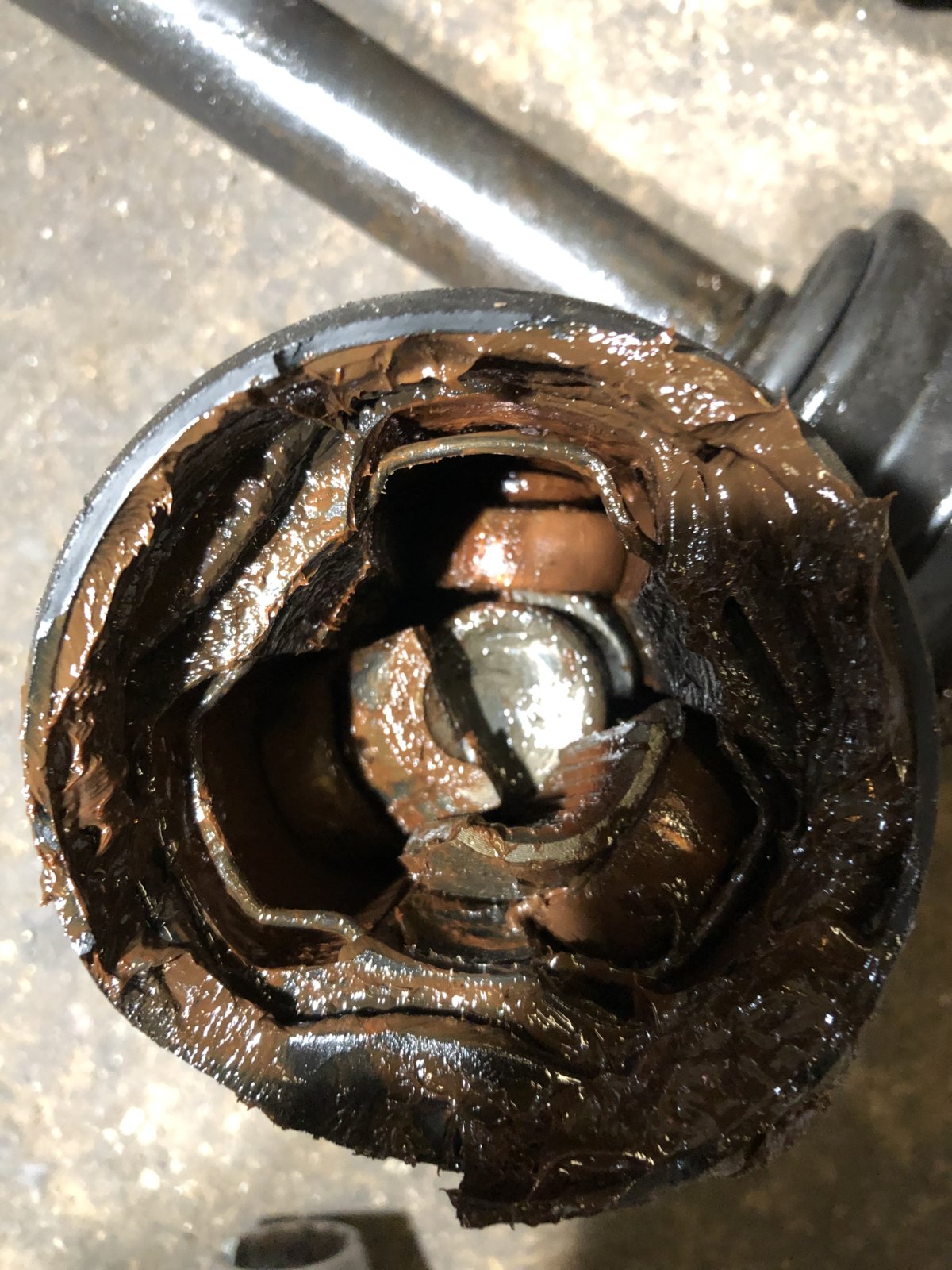

And to make things easier I took the car out on Sunday after cleaning it for a little run. And ended up snapping a shaft. It snapped it the tri lobe
Been using the PMS ones for a while no problems and my mates had them in 18 months.
Just don't swing off them when checking nuts when hot.
Rallying is a lot harsher on them compared to track unfortunately though. Last thing I want is a wheel coming off at 100mph through some trees
First one snapped just putting a set of road wheels on before rolling road. And the one last weekend snapped in my hard when I put the socket on it to torque the wheels. Those 10.9 ones on ebay don’t look great from the inside where it’s snapped. Look more like cast than anything ?
Hope my PMS ones aren't the same then ?

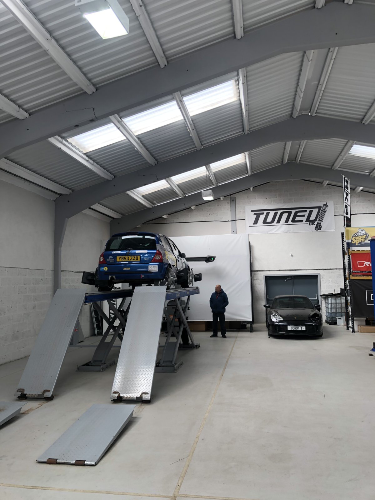

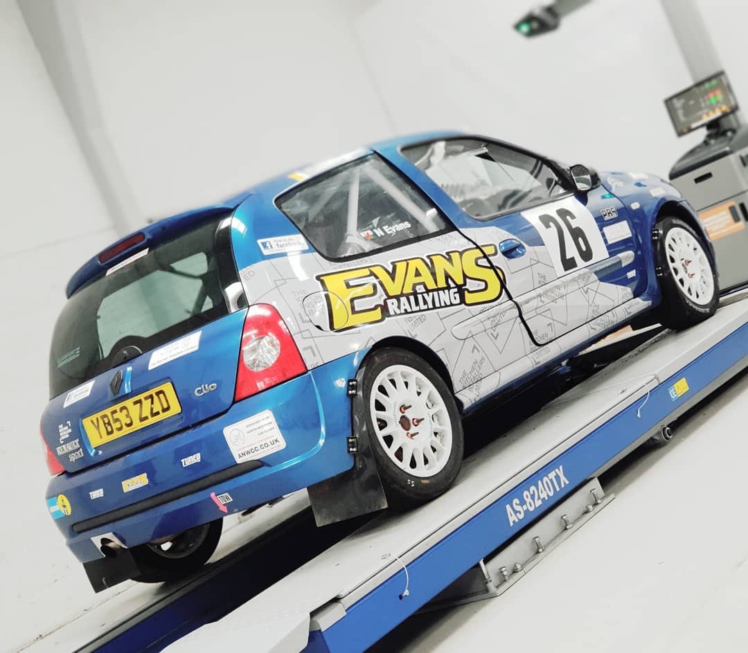

Cars had a new hub and driveshaft. And instead of doing the tracking somewhere near by eye I took it to TunedUK for a set up. Great work by Rich. Would highly recommend anyone that needs suspension or geometry work to give them a call.

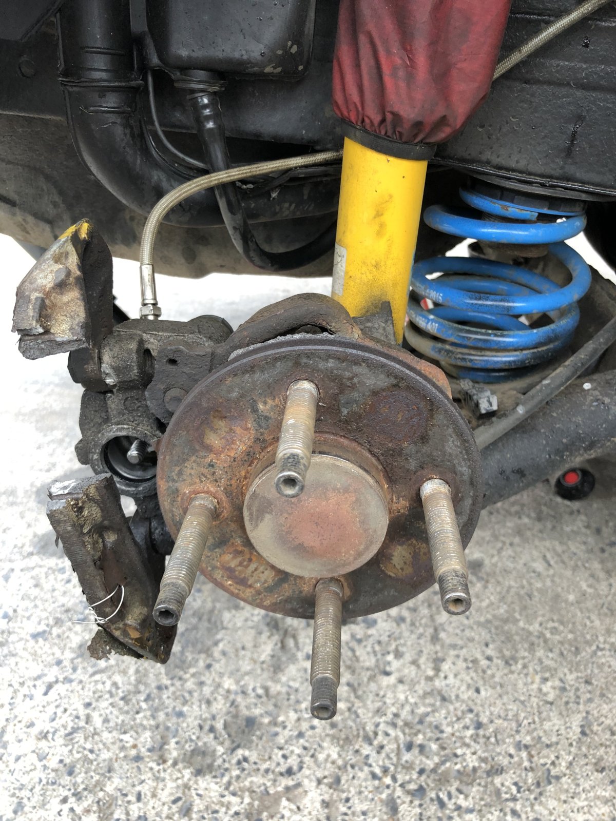

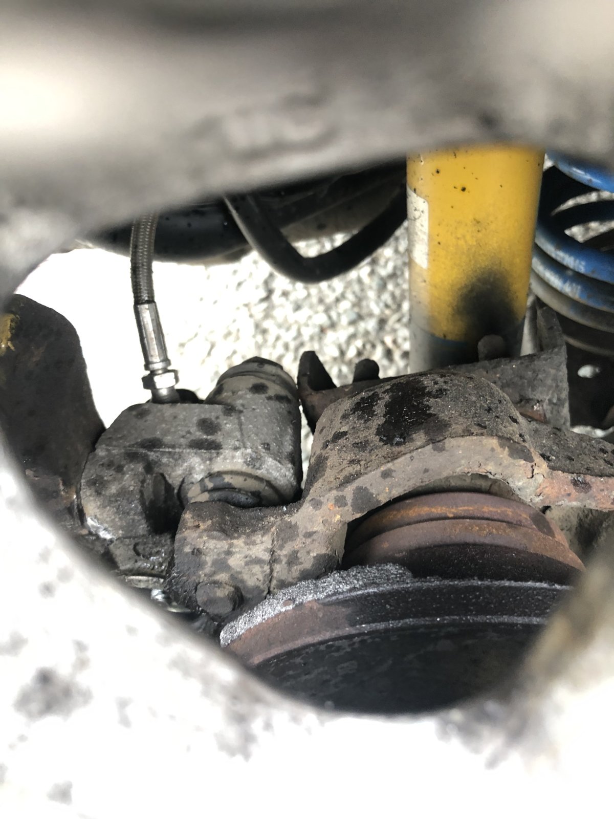

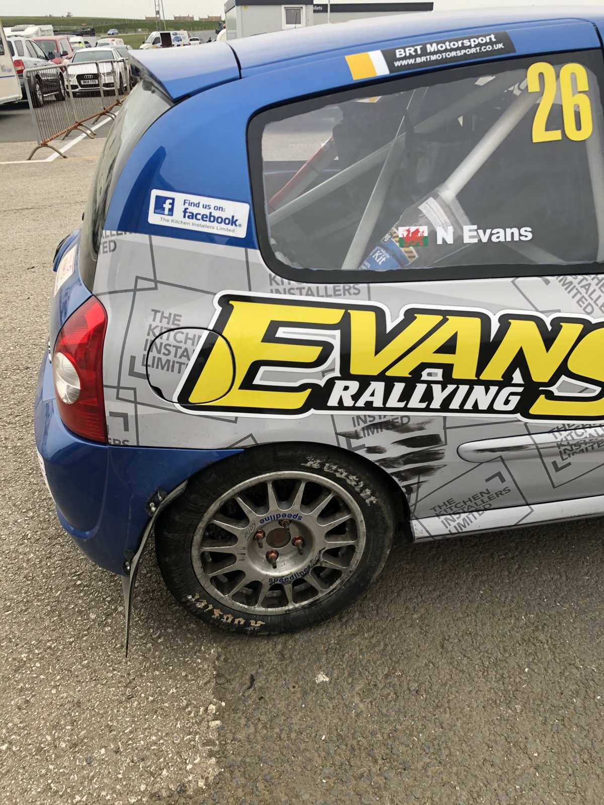

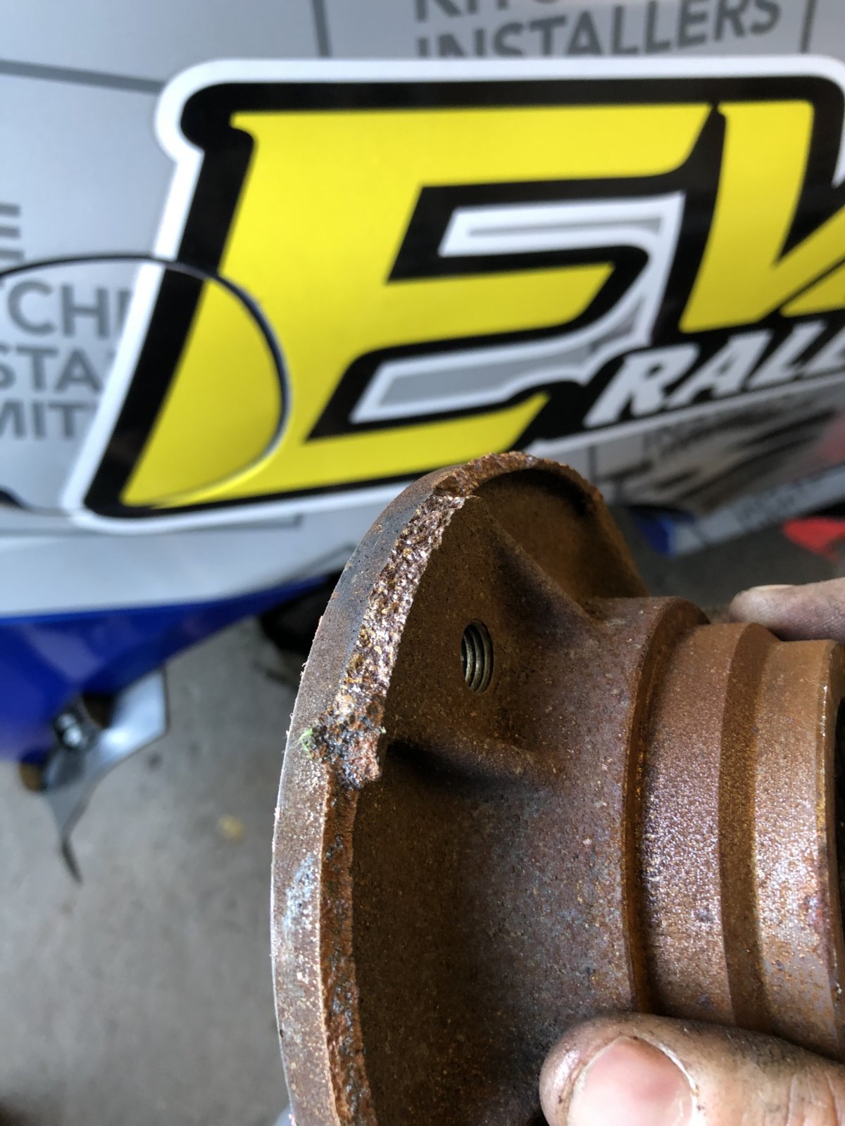

But it all fell apart on SS7. The rear disc shattered on one of the last hairpins and ripped the calliper off. I should of rolled it over the finish with no brakes, Bit of a lack of experience on my part. So I was given a 30min penalty.
We managed to bodge it for the last stage to get a finish so I can progress to be able to enter for closed road rally’s

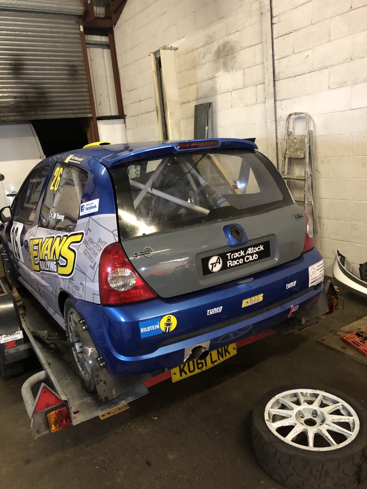

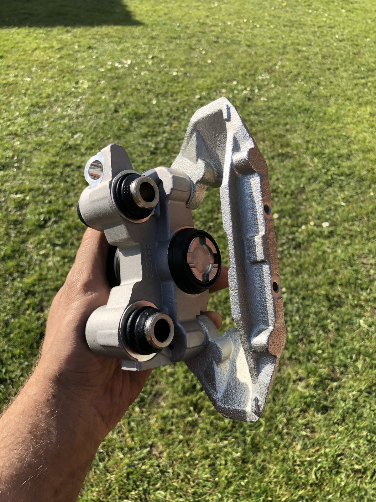

Took the car off the trailer to wash it and get it ready for the next event in a couple of weeks time.
Damaged caused on the last event
New callipers, new discs from RPD and pads from PBS
New dust covers
And the bleed nipple snapped on the front calliper after flushing the fluid out. So handy having a car you can nick bits off

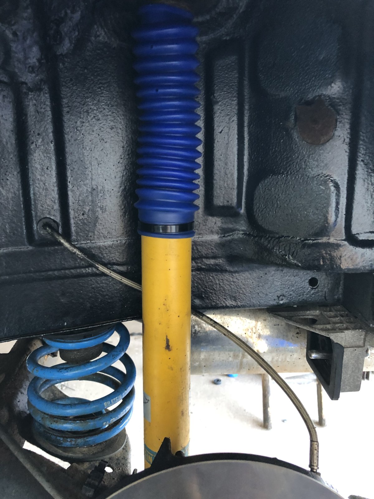

How does it take the harsh landings after taking off over the crests? I guess you run a sump guard?
The way it slides round is epic ?
Handbrake is unreal on it now with the whole new rear set up.
But yeah takes to the landings fine. Obviously track suspension would be useless. The B14’s are ok. In an ideal world I’d have Reiger or proflex like my brothers. No such thing as a harsh landing with them
