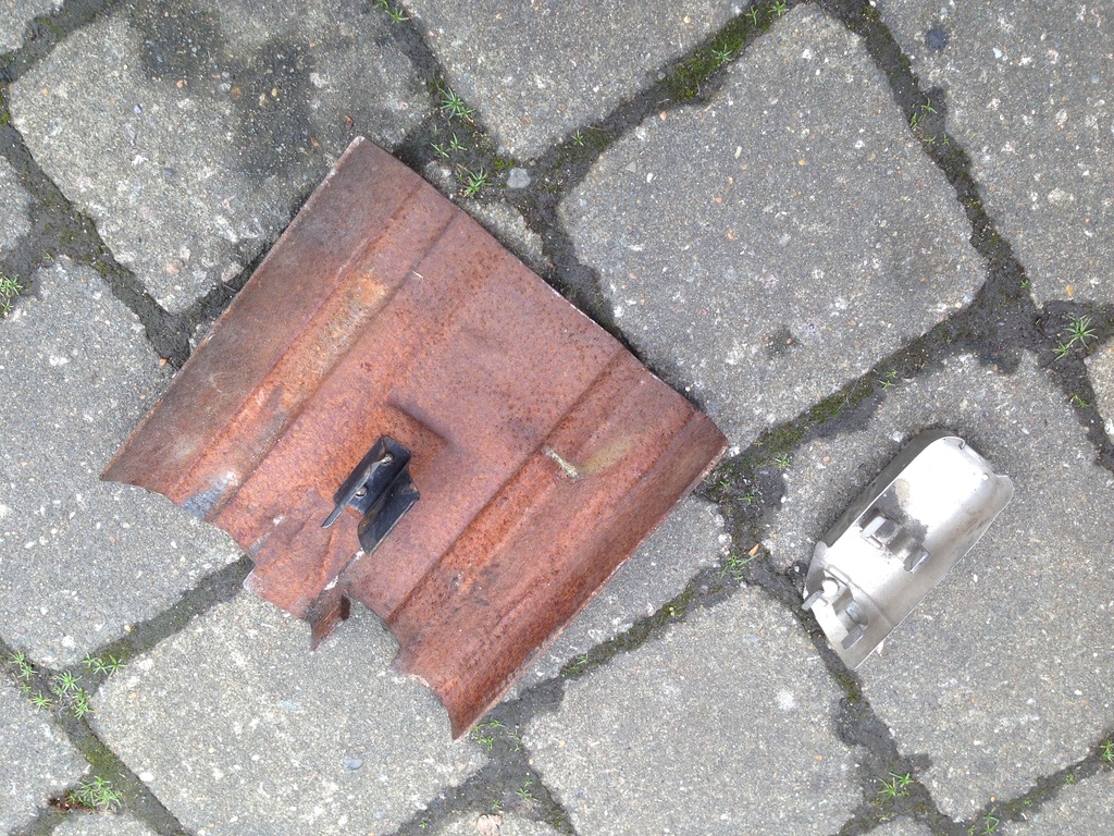

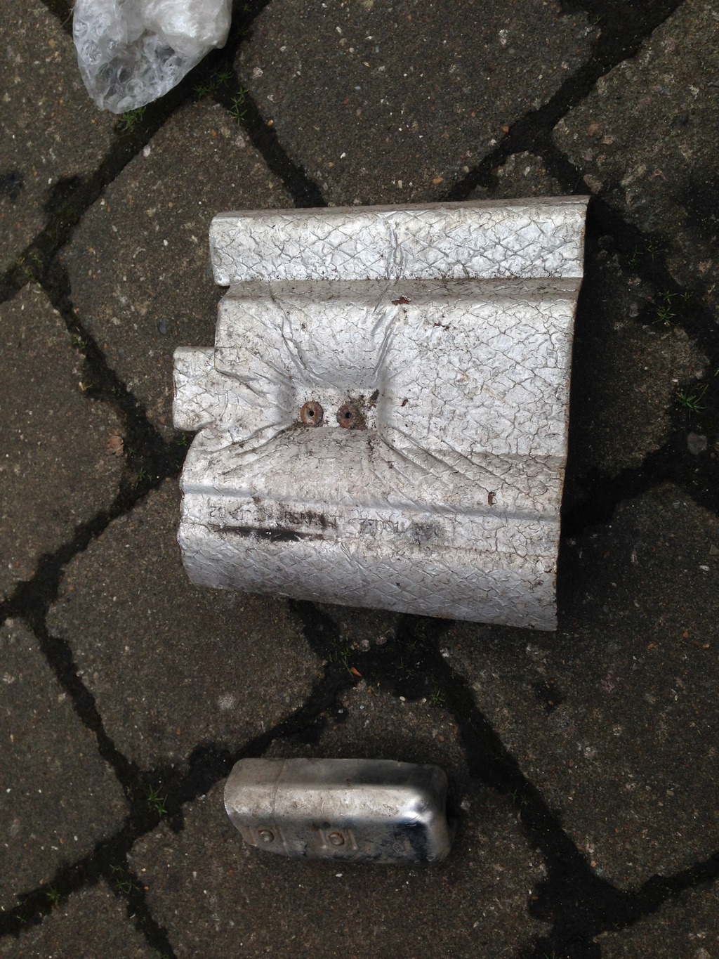

I have learnt that there should be a heat shield over the starter motor which to be honest would make sense, I am on the hunt for one, won't use car till I have one fitted.

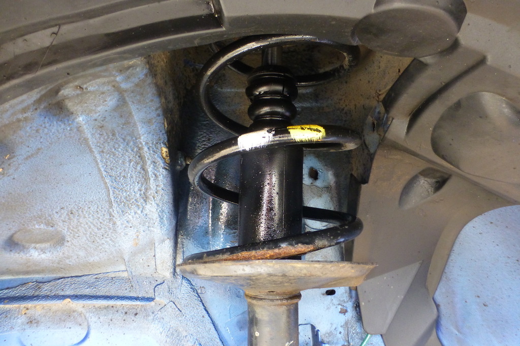

Some useful information to note on the standard RS Clio springs:
White/White is 172, White/Yellow is 172 Cup, Blue/Yellow is 182 Cup and I need to confirm what standard is.

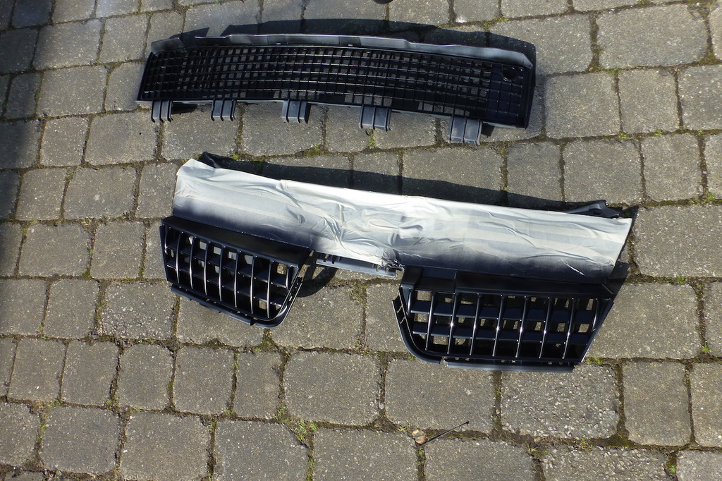

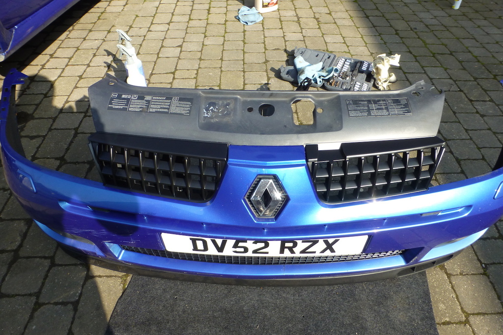

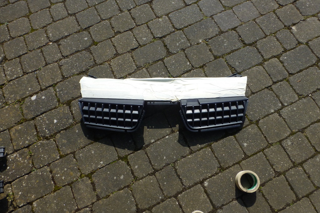

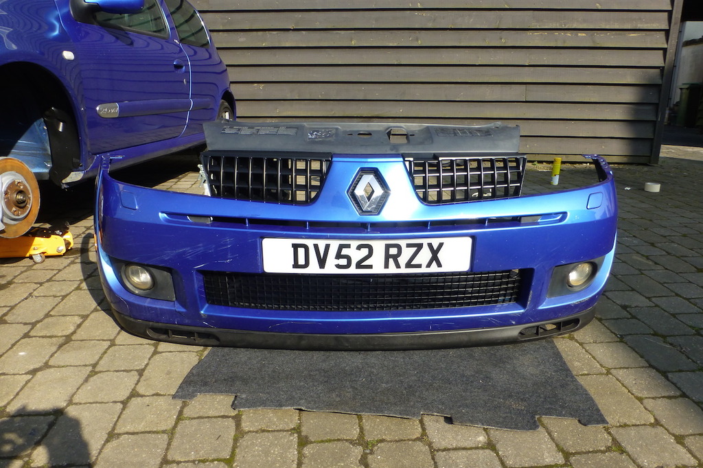

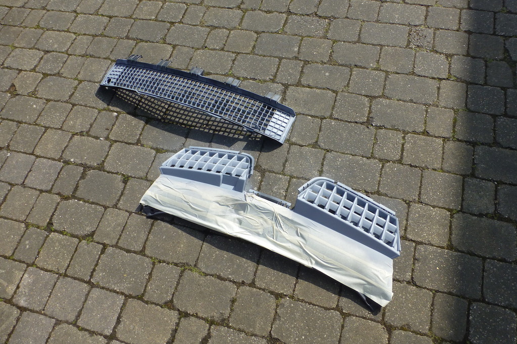

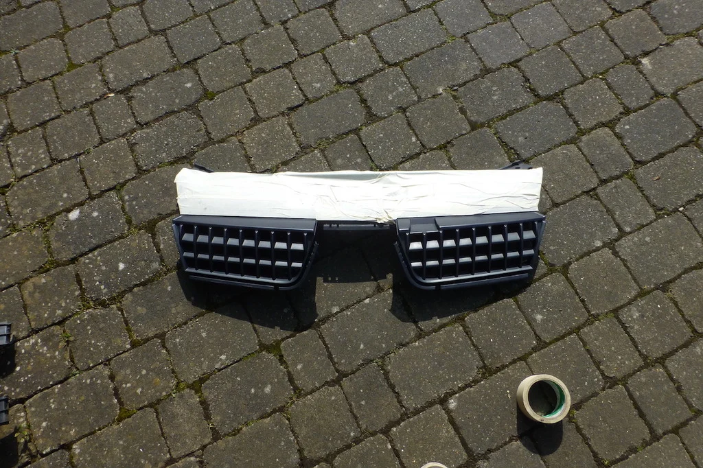

Today I managed to remove the grills from the bumper and spray them up,
Masked up:
Primed:
Sprayed up:

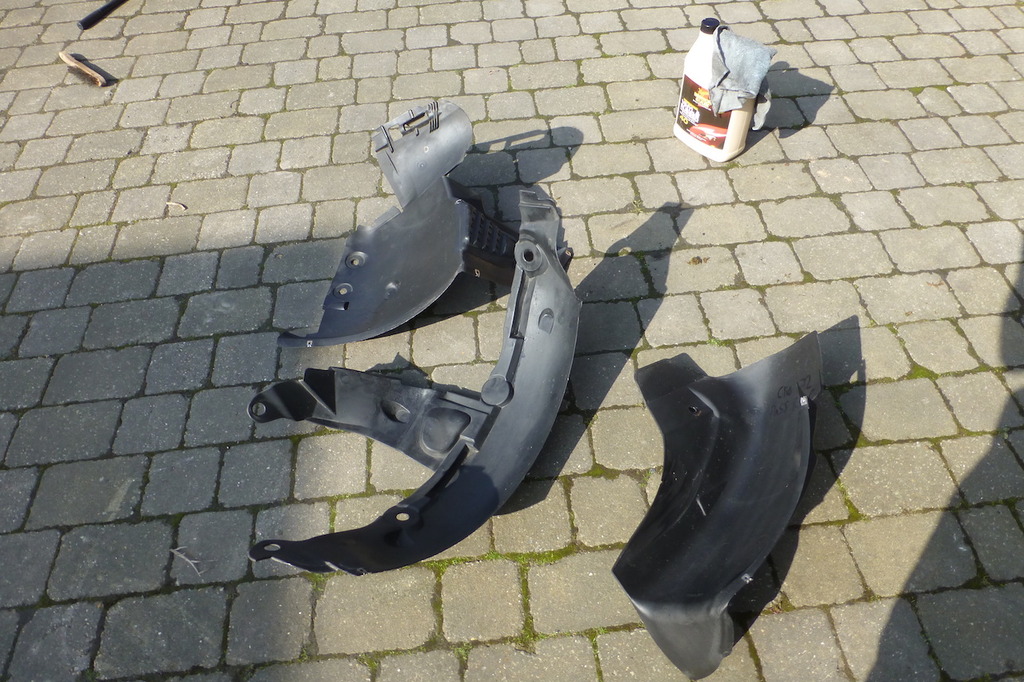

Cleaned and treated the arch liners:
A bit of a comparison:
I didn't fully remove all the tar etc, it is after all a track car, but a good improvement.

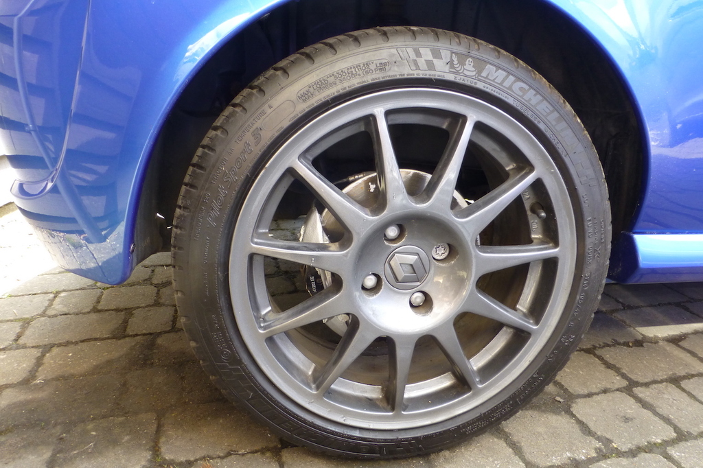

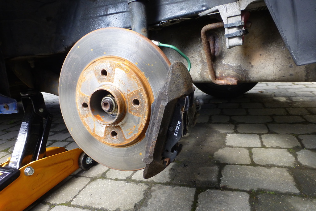

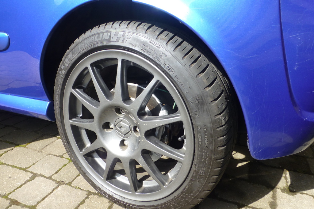

Then on to cleaning the arches and a painting up the callipers and discs, probably won't last long but looks much better:
Refitted the grills back on to the bumper, looking much better however the bumper is a mess, looking forward to getting it replaced as really letting the car down:
Cleaned up behind the grills:
Bumper refitted:

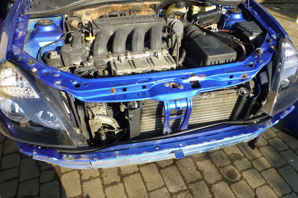

Little update, removed the front splitter as sold it to another Facebook group member, I have purchased a Skoda Fabia one which looks a lot more OEM.

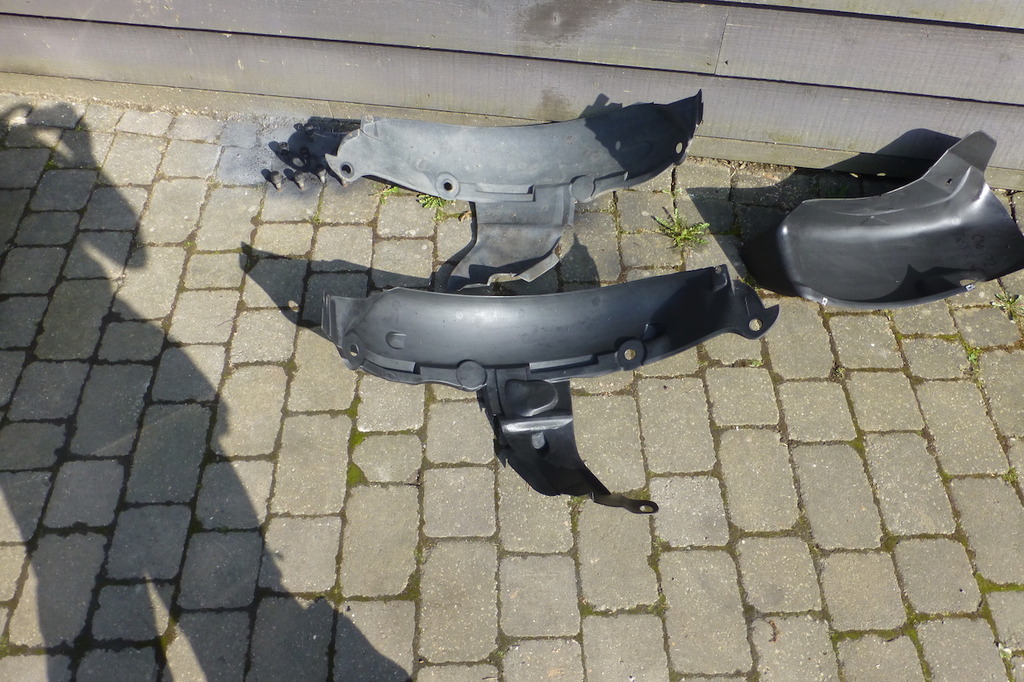

Fitted the replacement rear arch liner:

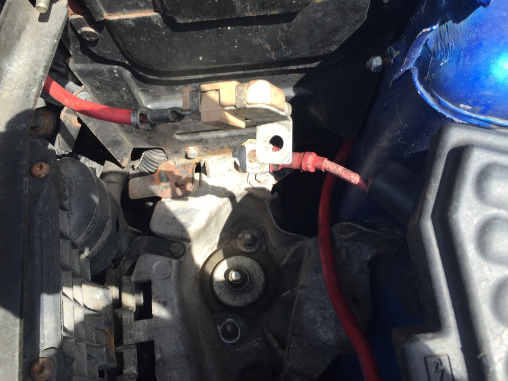

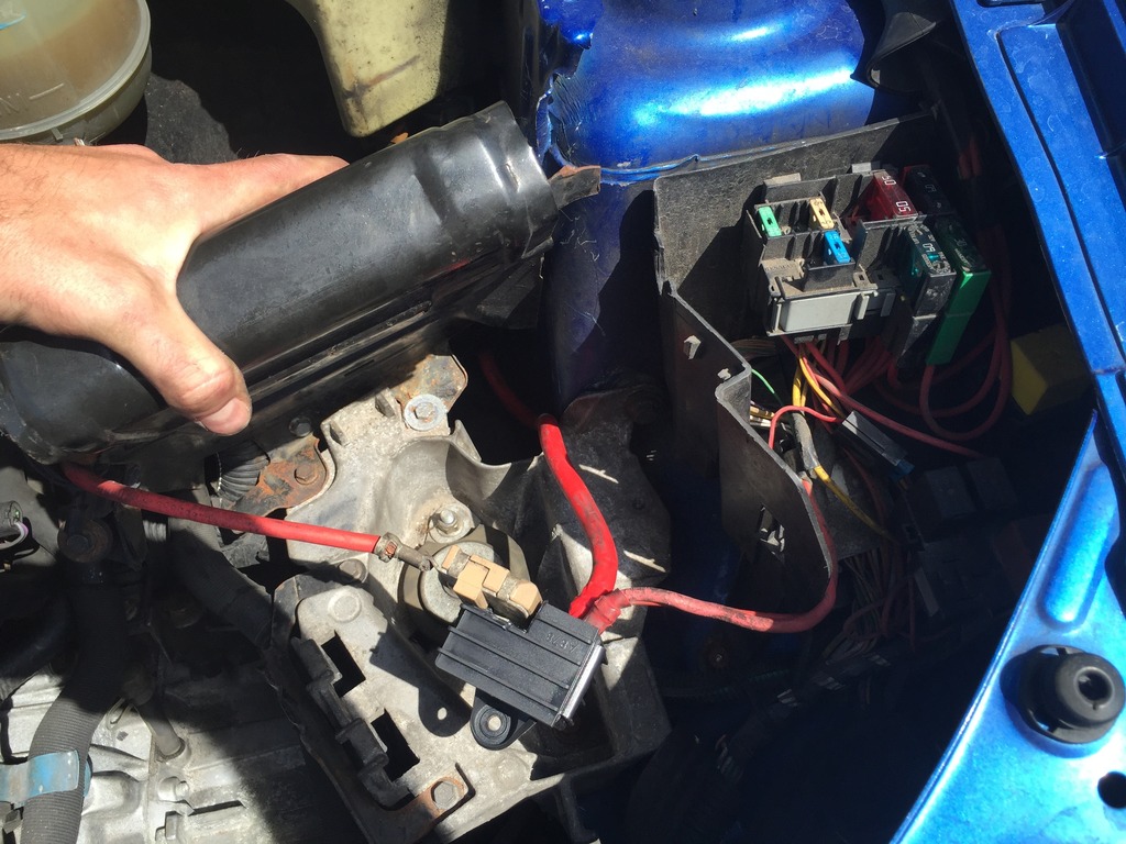

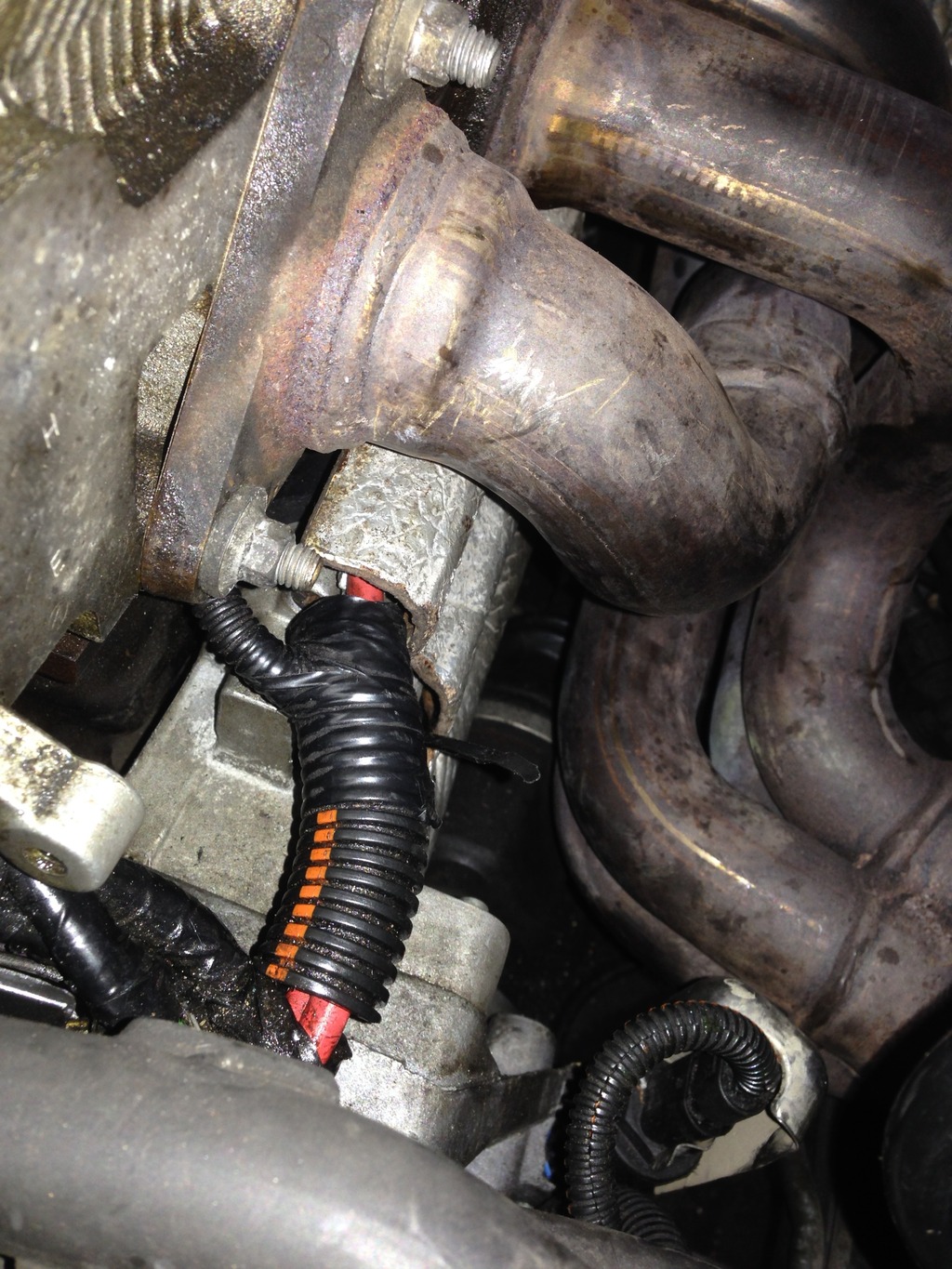

I have managed to source the heat shield which covers the starter motor and cabling from the manifold which is due to be delivered tomorrow.
I have also managed to find a replacement set of springs to replace the damaged one on the drives side which should be here early next week.

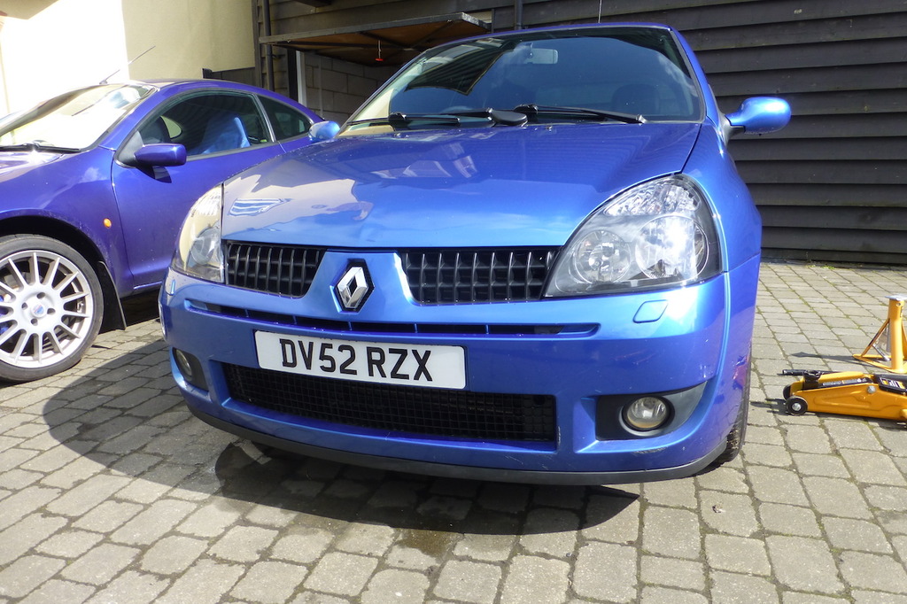

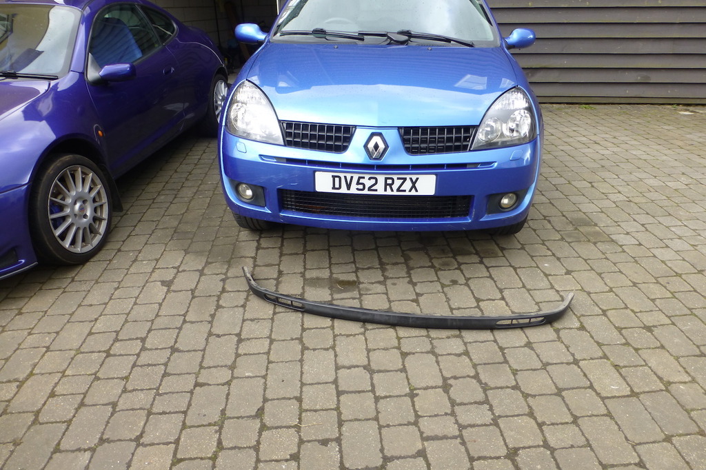

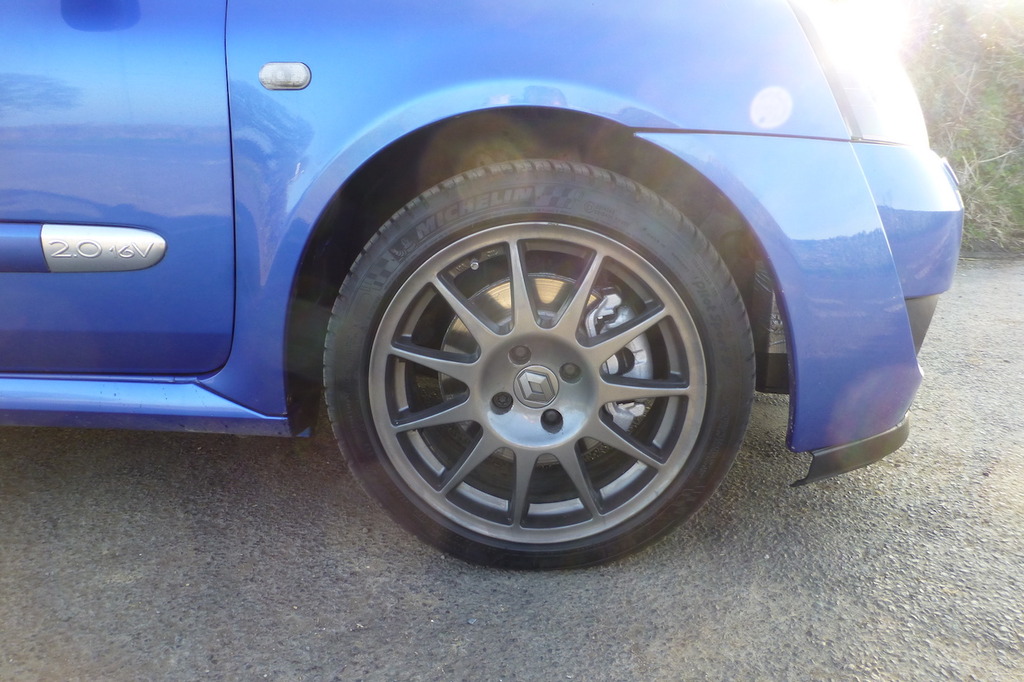

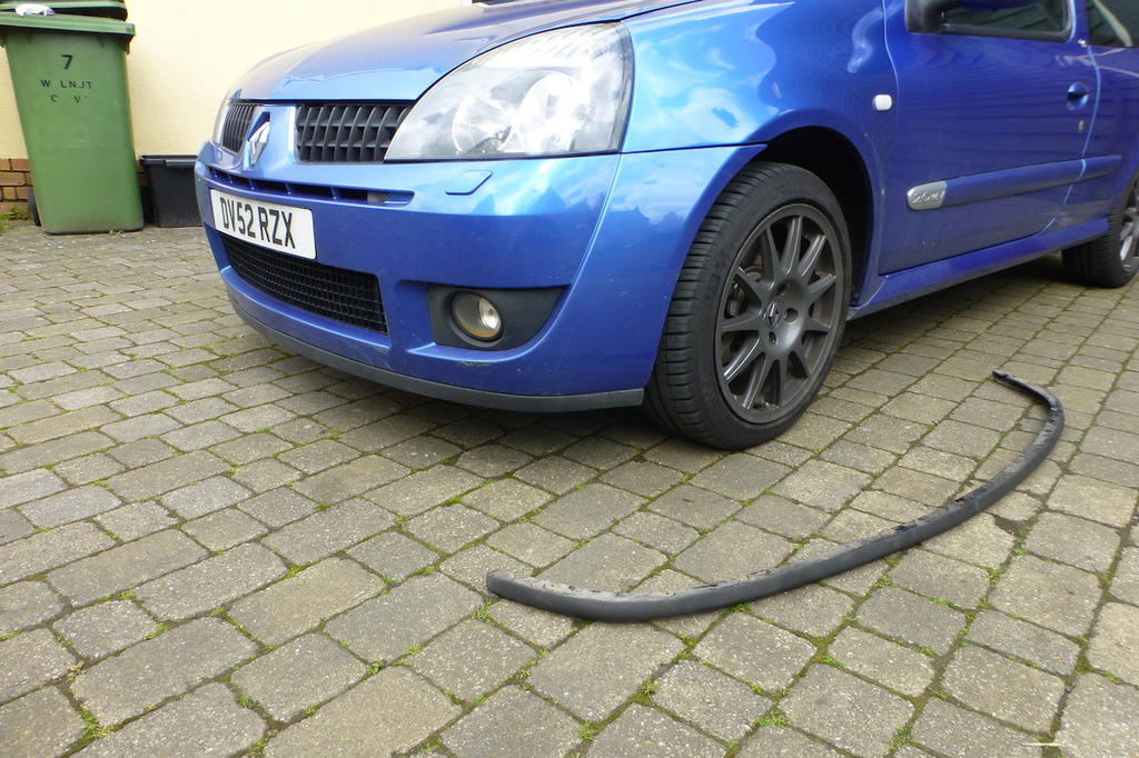

Skoda splitter arrived today so I fitted it at lunch time:
Before:
After:

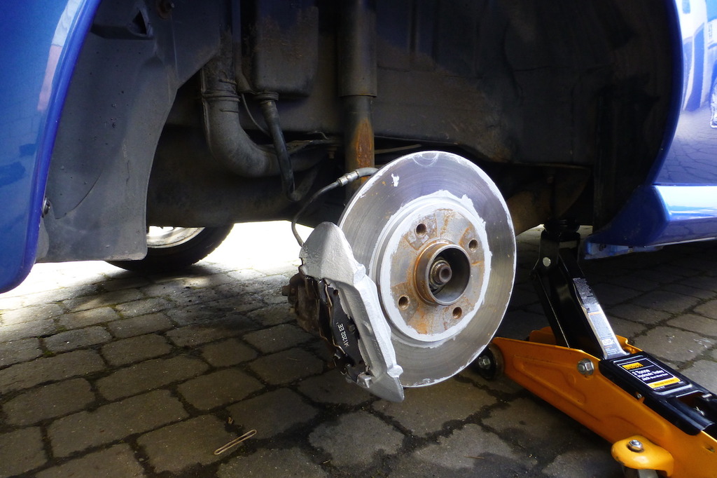

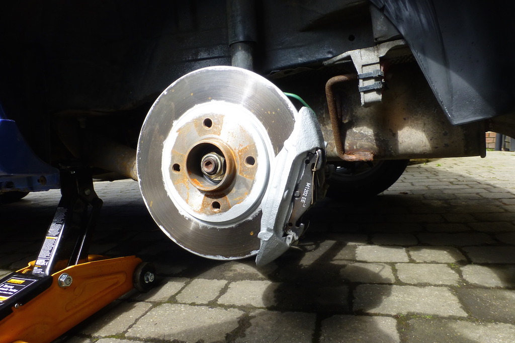

Also had time to give the rear callipers a quick lick of paint:
Before and Afters:

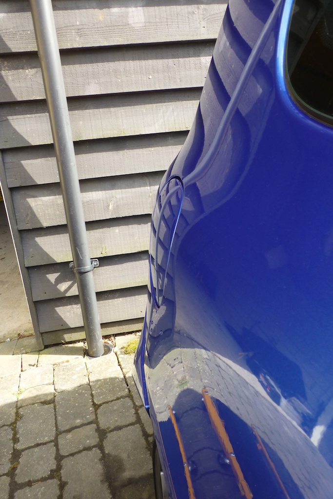

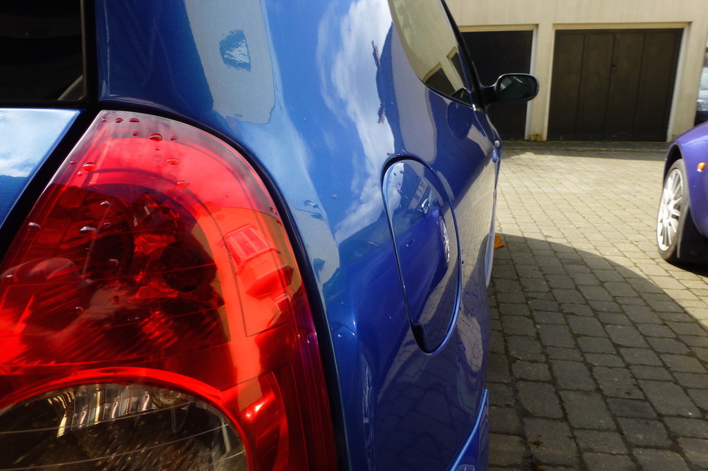

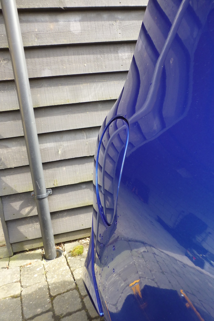

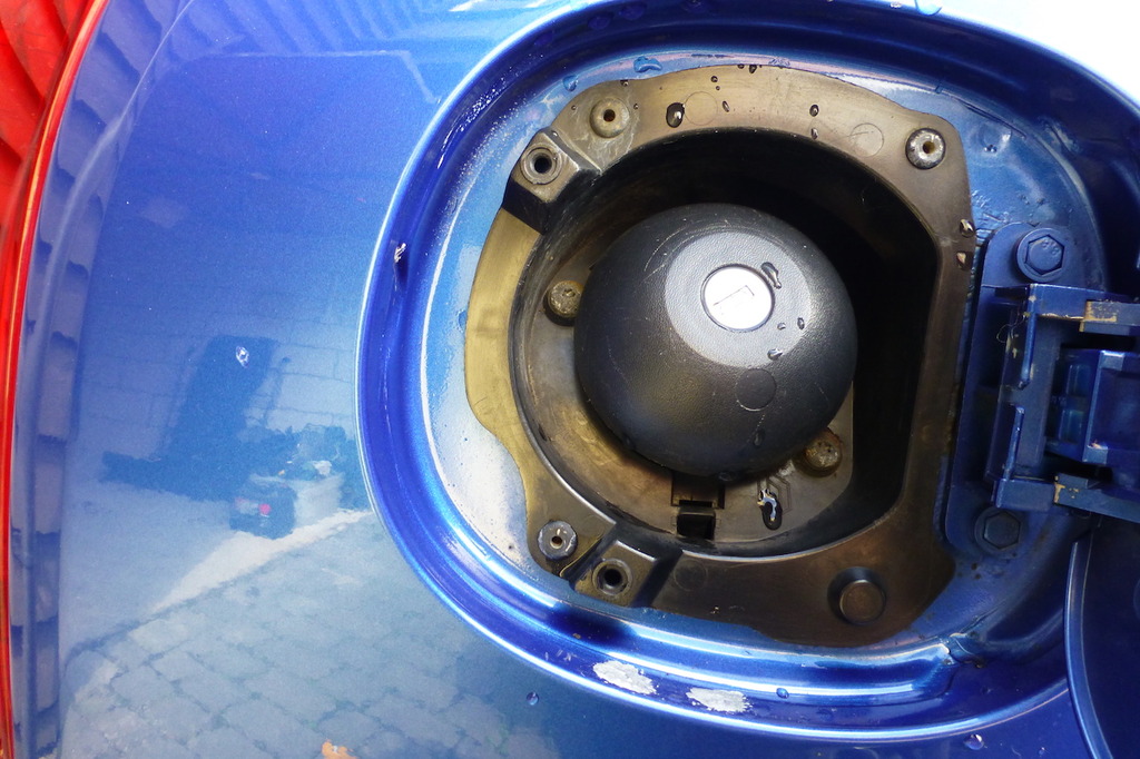

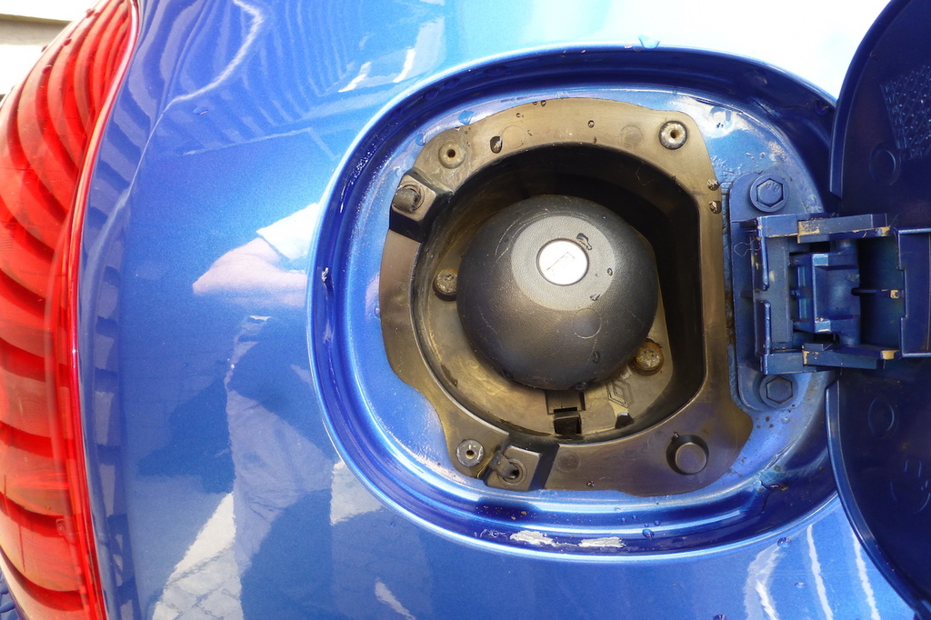

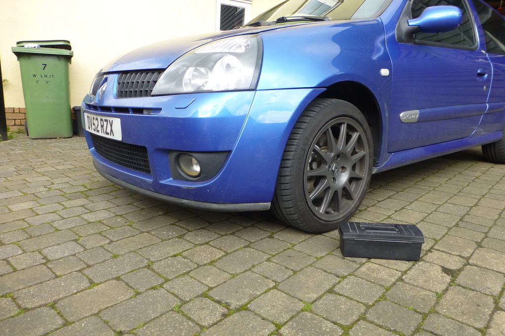

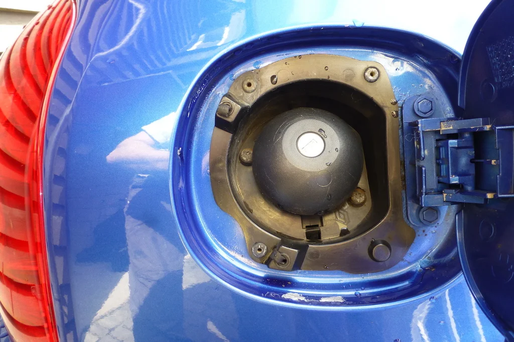

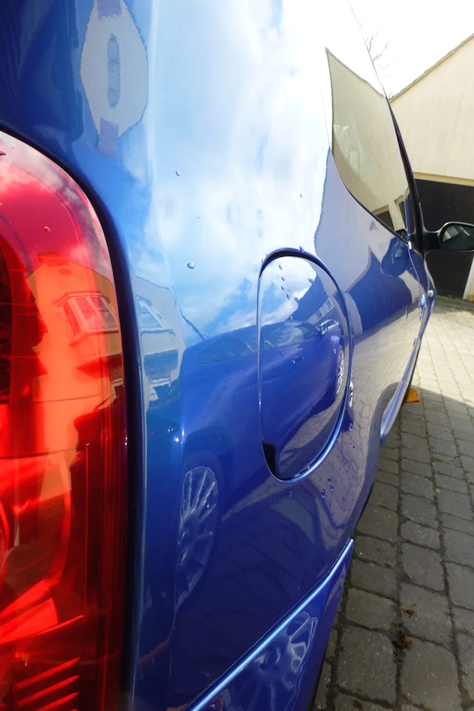

Another thing that was bugging me is the fuel cap does not sit flush with the body work, I had a look on the other Clio and I could see that on the Cup it had two rubber grommets missing, you can see where they should have been
Quick temporary fix:
Before:
After:

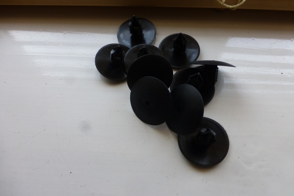

Some replacement arch liner plugs arrived, just £1.99 for ten off eBay.

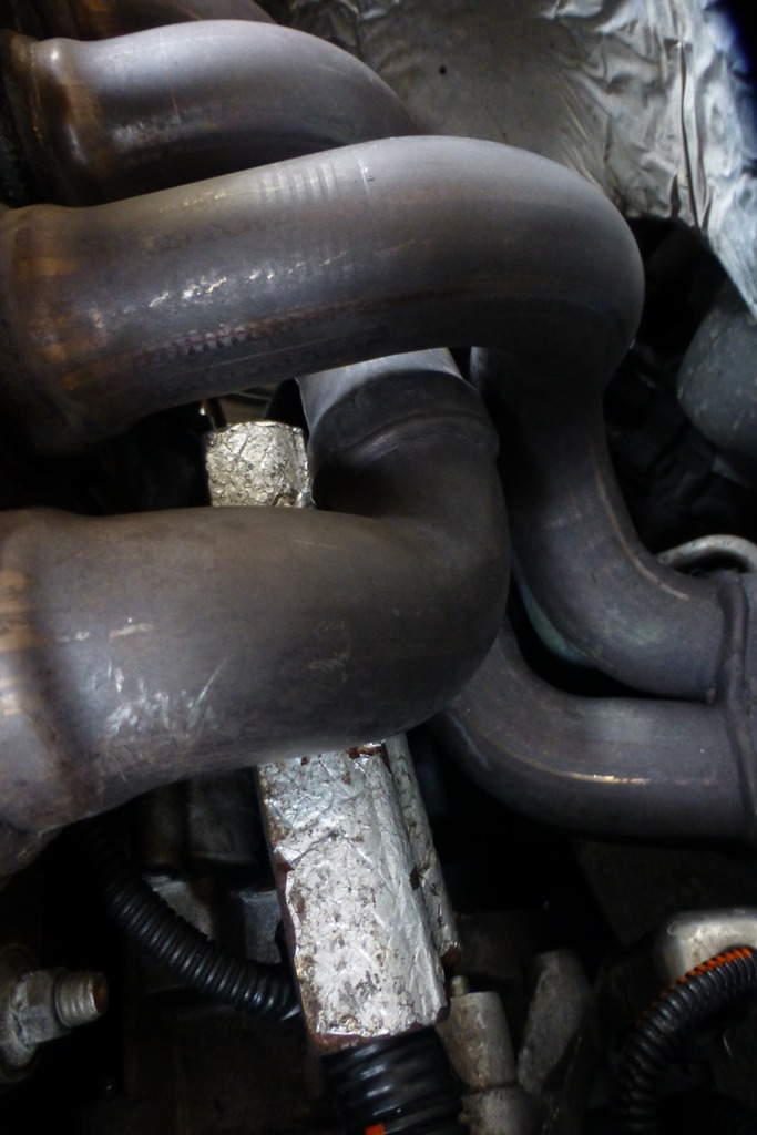

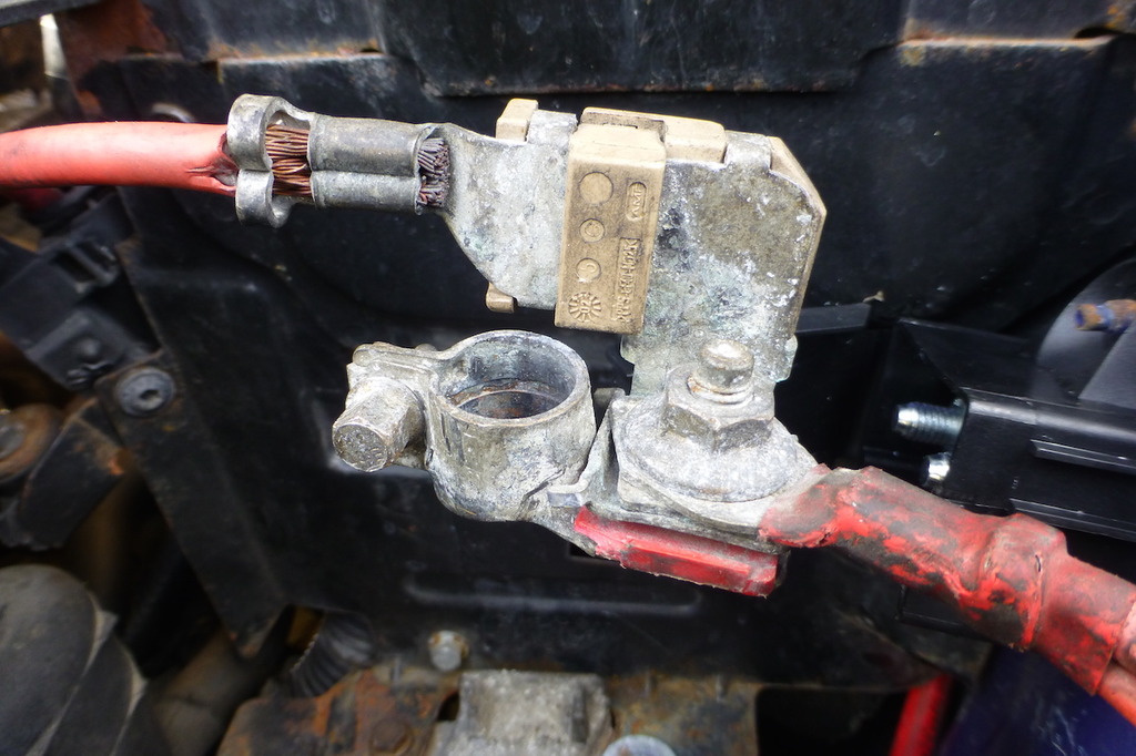

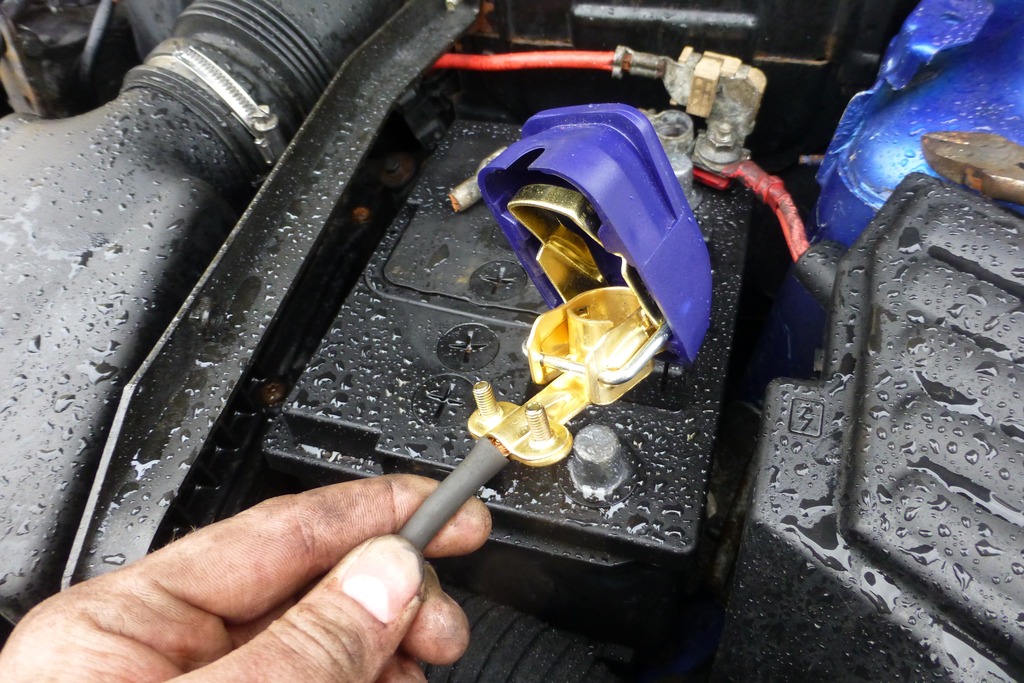

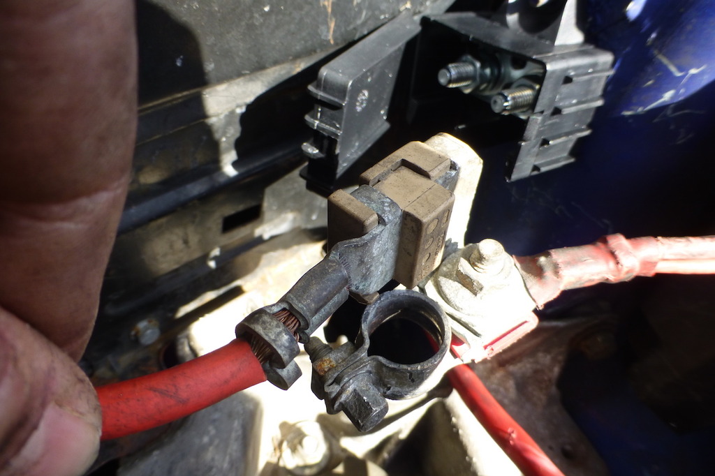

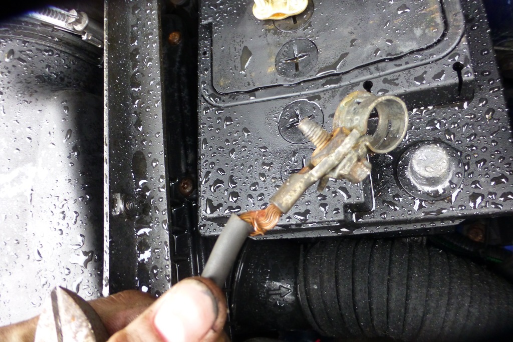

Sorted out the god awful negative battery terminal, some pretty cool fixings for just £3 for both again off eBay.

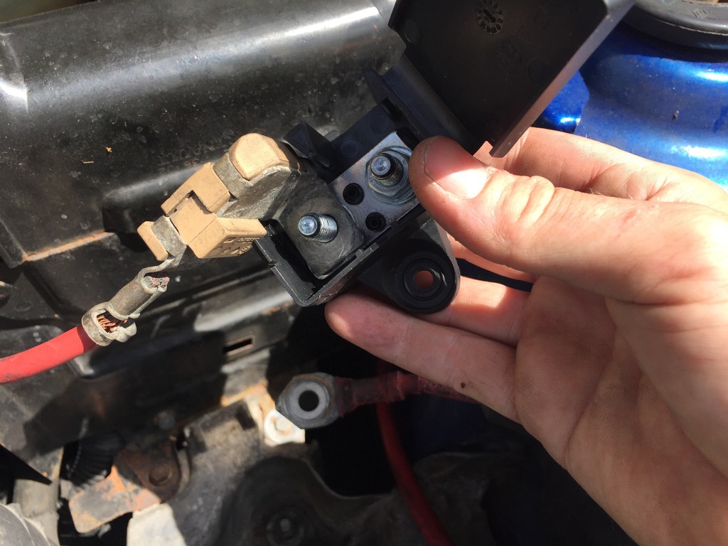

Fitted the replacement heat shield after about an hour and half, couldn't fit from the top so had to fit from underneath, was so annoying and frustrating, in addition its not in correctly as there should be a small gab where as its resting on the underside of the manifold still.

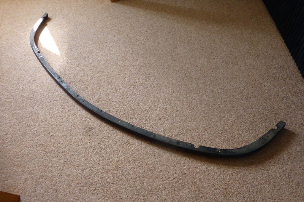

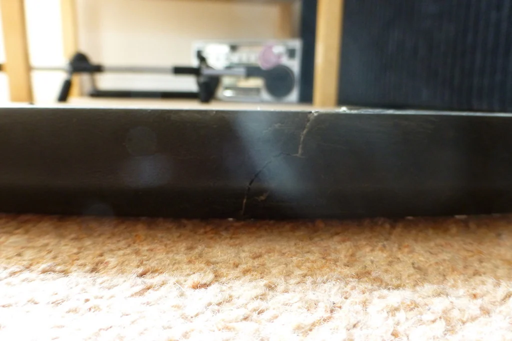

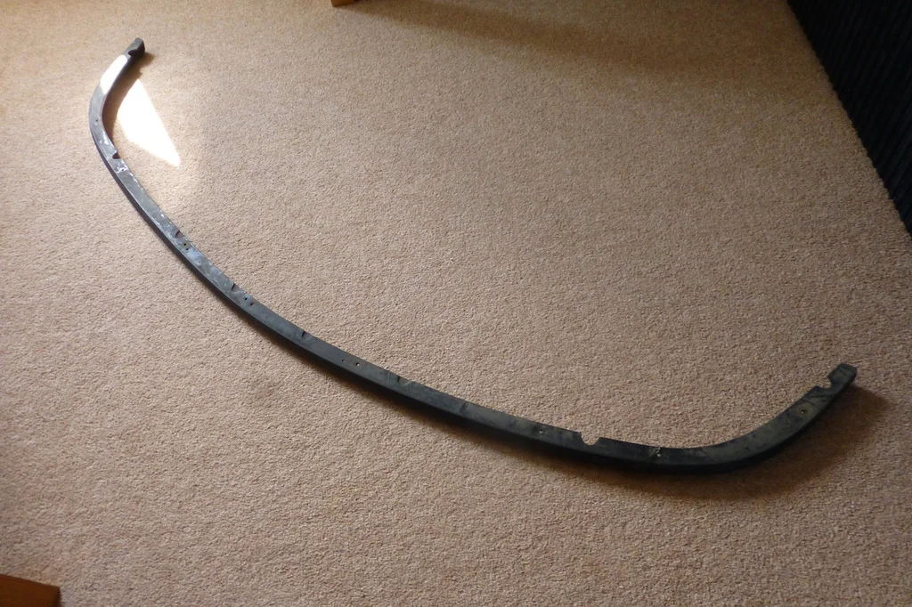

Not much done lately, I have however sourced a OEM front splitter for just £20 delivered, slight crack and can see where it has been repaired previously but once fitted I much prefer them compared to the cheap Skoda alternative:
You won't be able to see the track once fitted :)

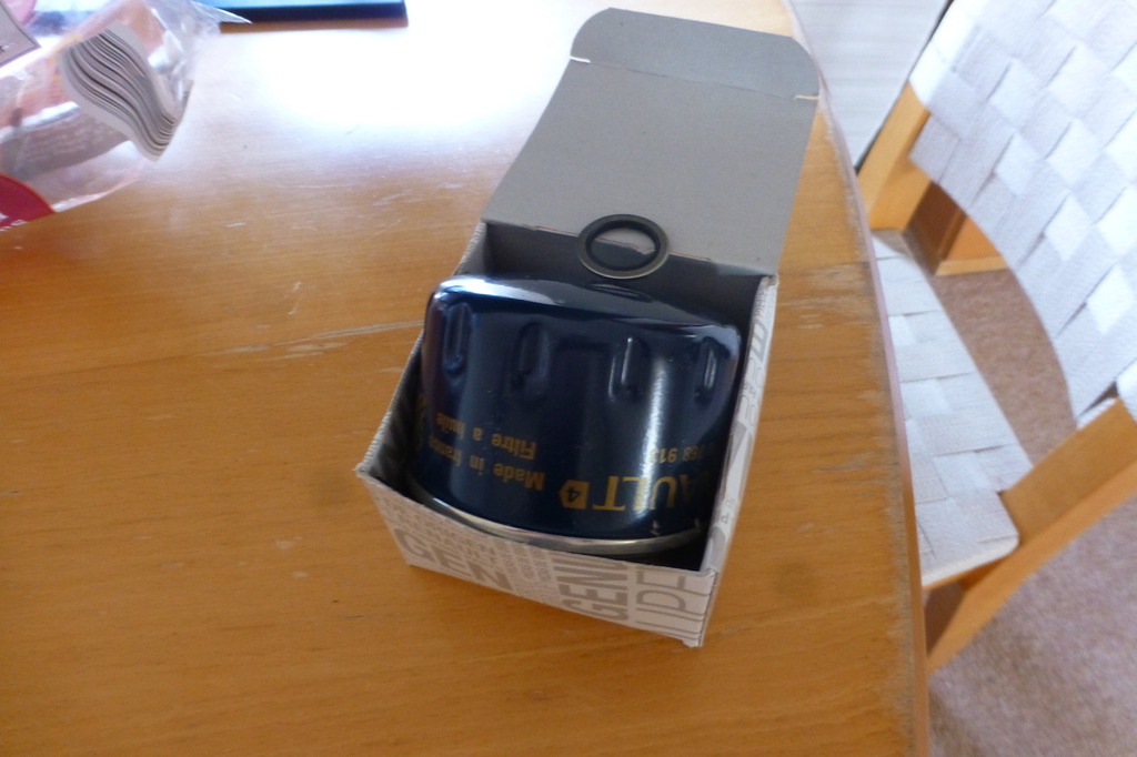

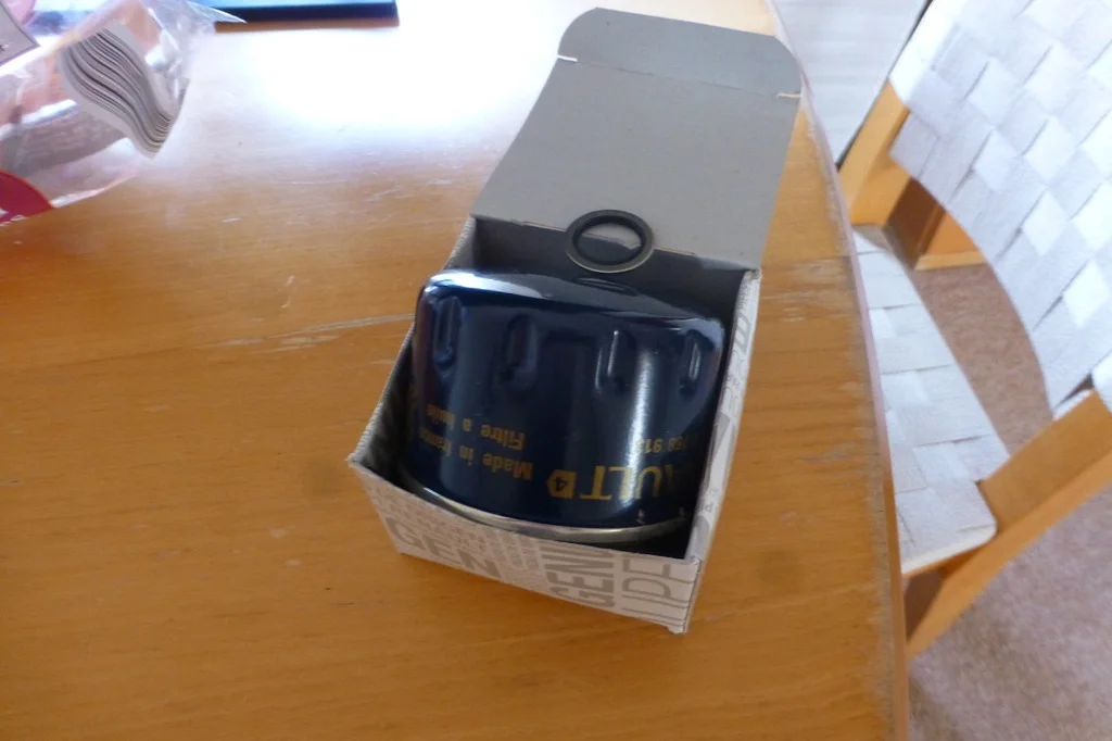

Bought a replacement oil filter as the oil is pretty low so thought I might as well drain it all out and fit replacement:

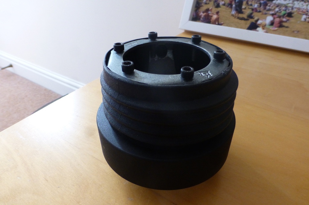

Purchased a Boss for the steering wheel, usually £60 and I got it delivered for £40 so a few pennies saved:

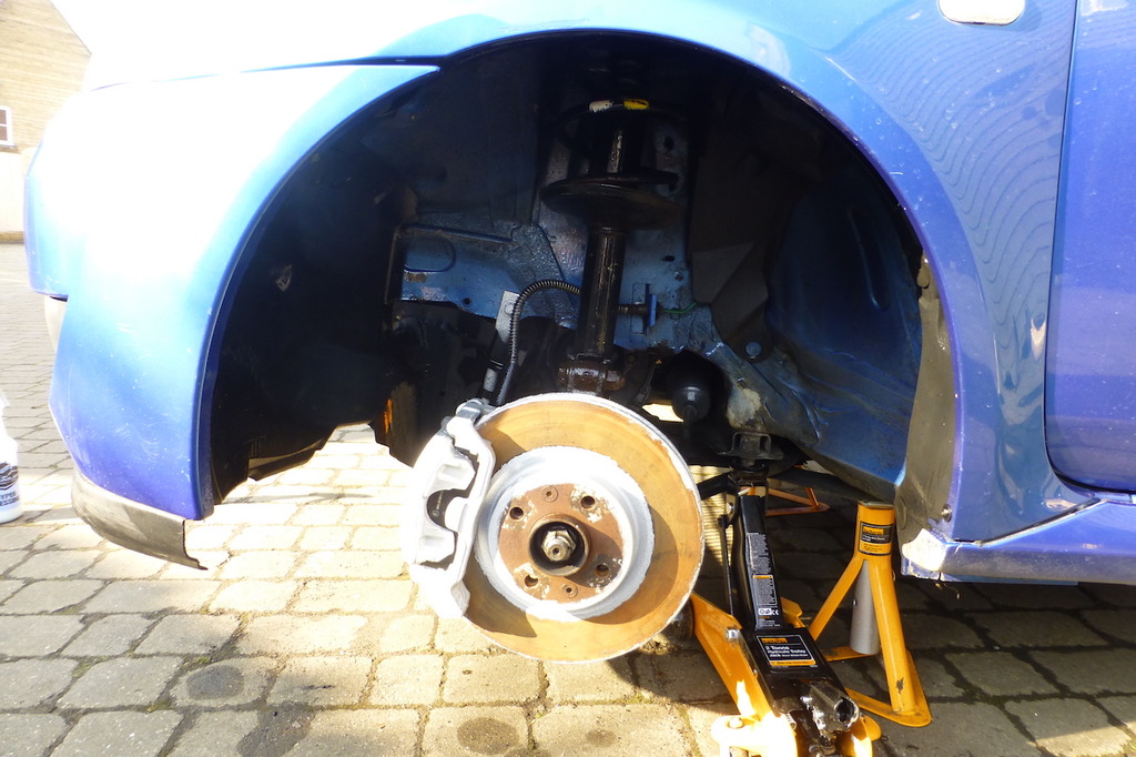

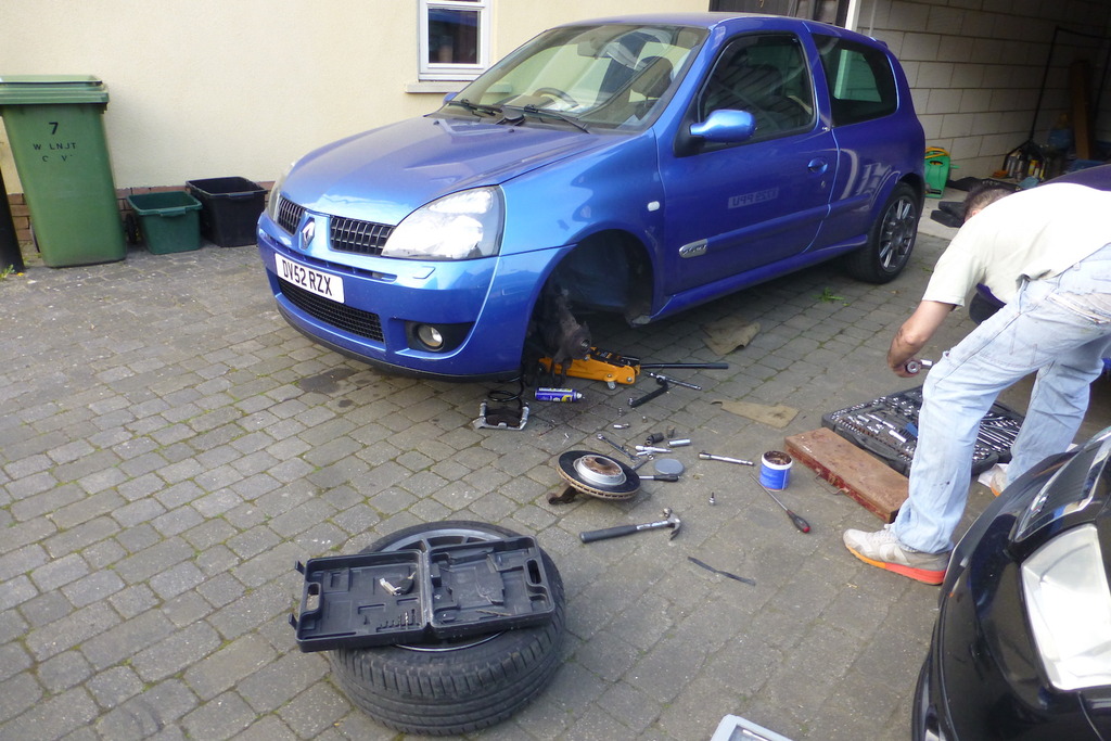

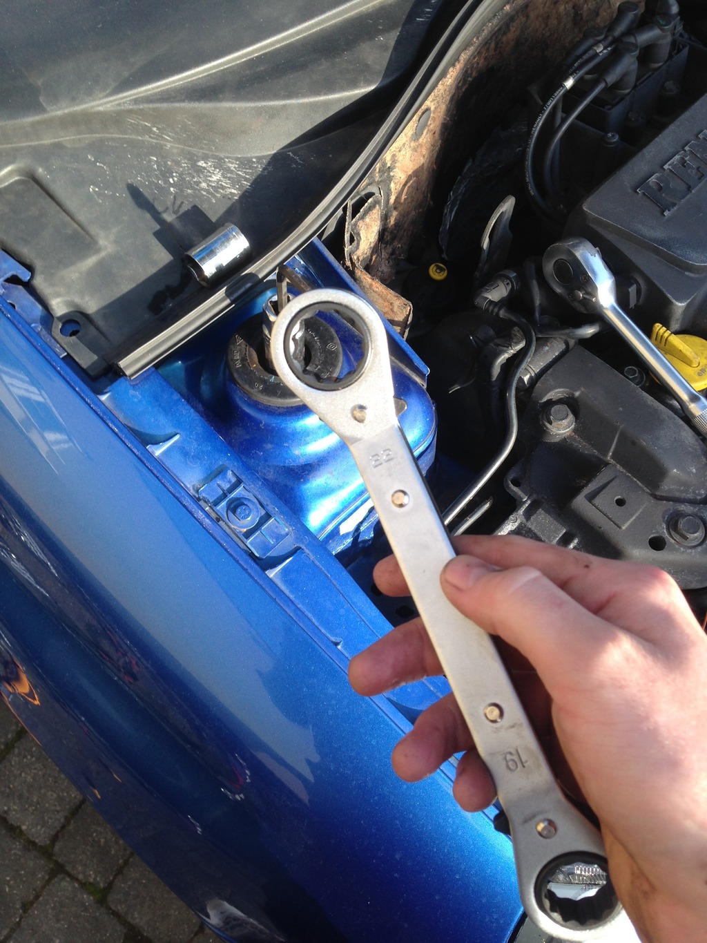

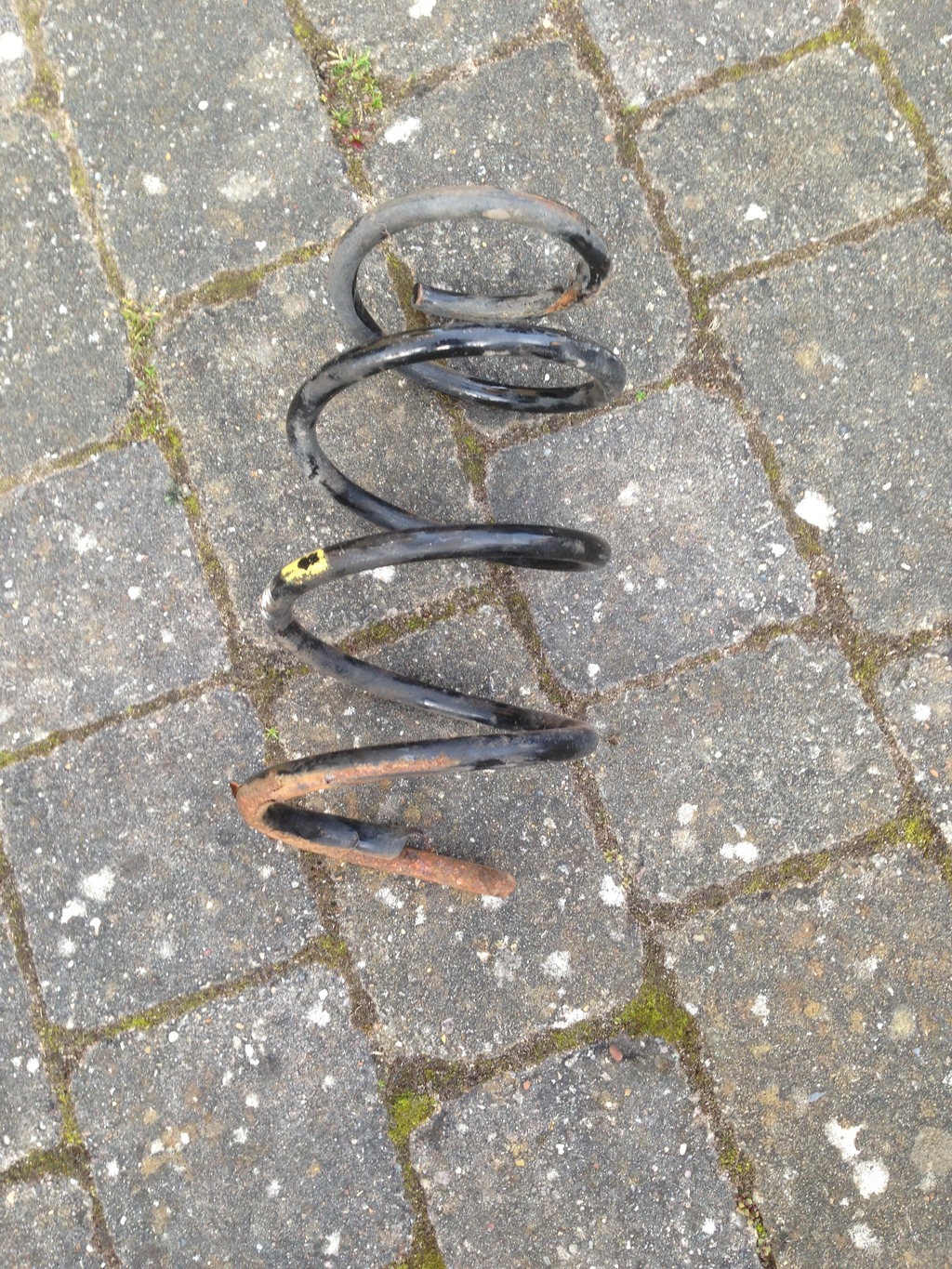

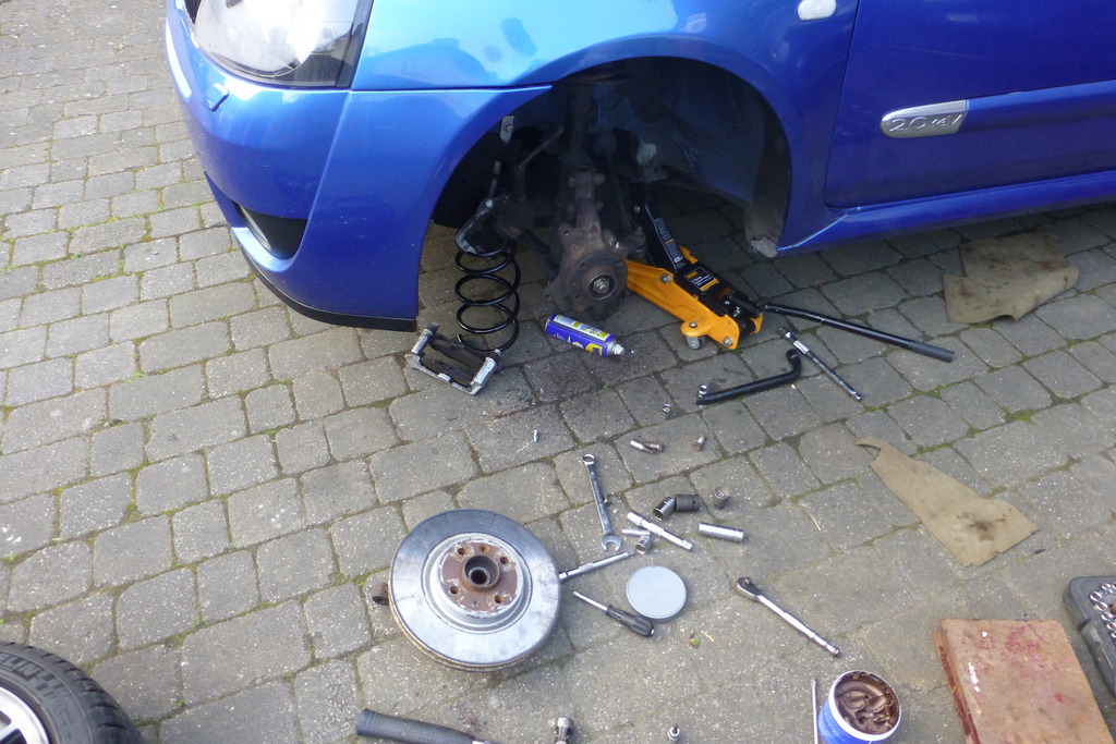

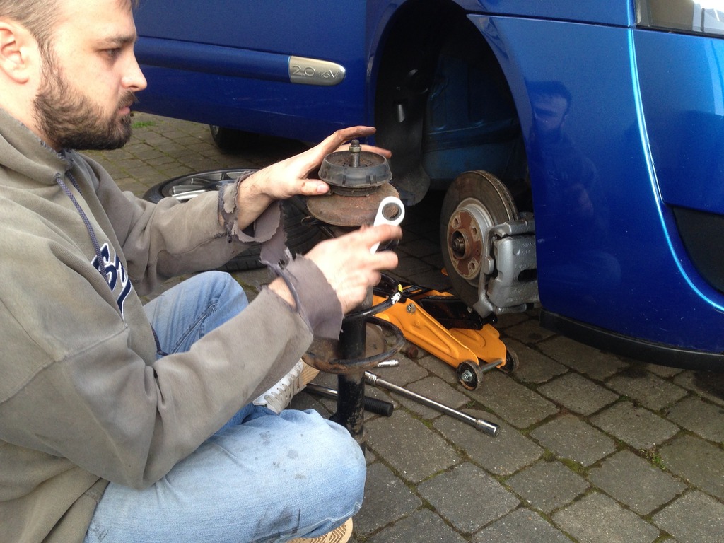

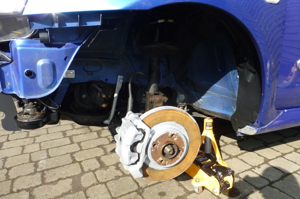

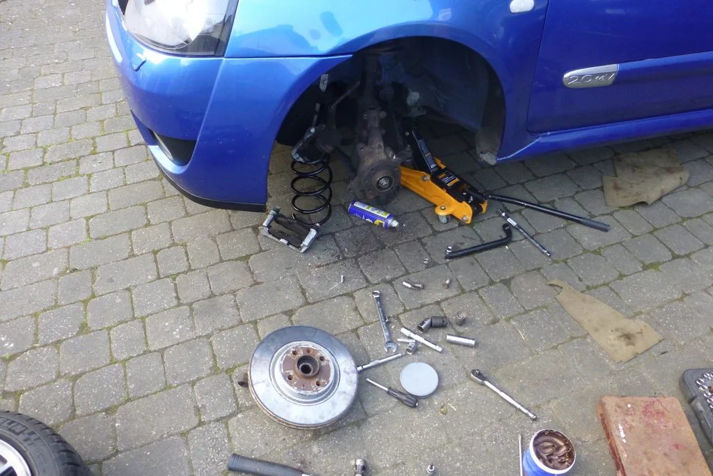

Finally got round to replacing the drivers side spring, obviously made the car feel so much better, however still facing some issues with feel through the steering wheel, off to get the tracking sorted which will hopefully resolve the issue.
Removed the broken bugger:

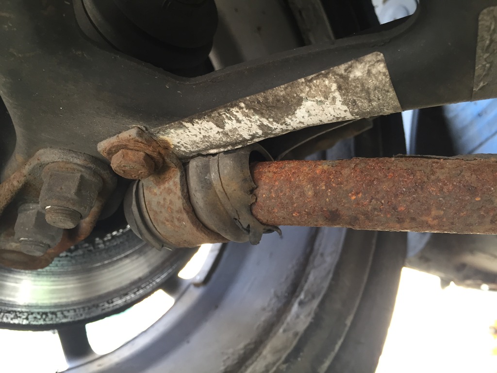

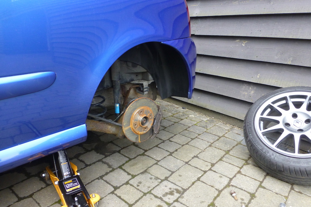

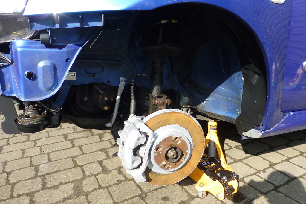

After using the car for a while now the car felt disjointed and felt as though it was waving from side to side under hard acceleration, in fact it felt pretty bad and gave me no confidence when driving it hard.
I went to get the tracking sorted by a friend who works on the Cup race cars and he suggested that I have the hub replaced, as there was movement in the lower ball joint, the wheel wobbled when wiggled side to side. He noted that the lower ball joint looked as though that it had recently been replaced so was confident that this would be the issue.

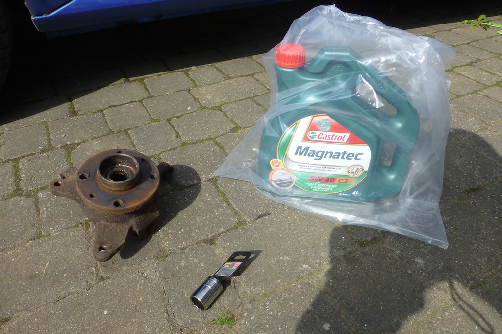

Replacement order from Tim Finch, (breaker for Renault Sports) £28 and arrived the following day.
Replaced this evening and wow the car feels fantastic transformed it. So happy with how it drives now.

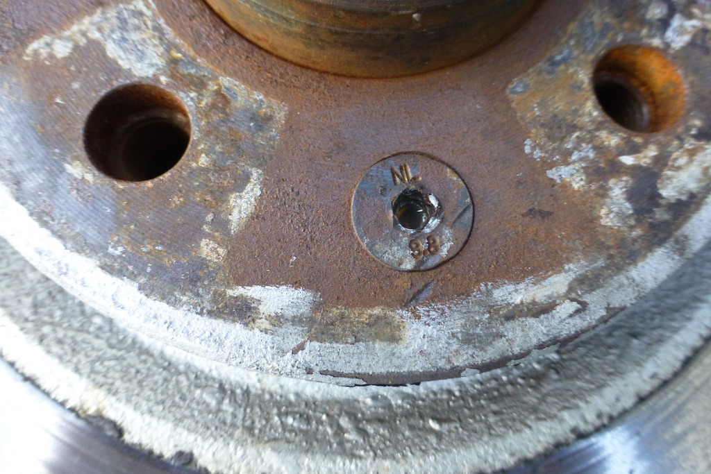

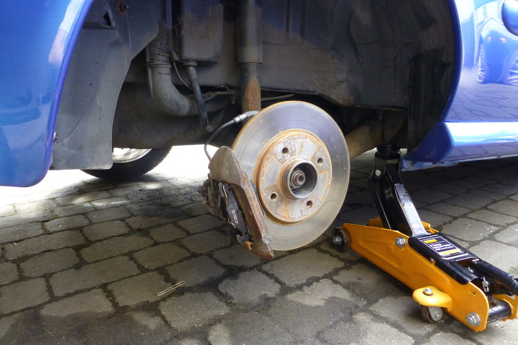

Replaced a friends Halfords 21mm socket that we snapped when replacing the front spring,
5 Litres of oil ready for the oil change and the replacement hub:
Faced one issue in that the ****ing disc locking nut rounded off so had to drill it out.

The hole in which the lower ball joint slides in to was more oval than round in the one the I removed thus allowing the movement creating the terrible driving experience.

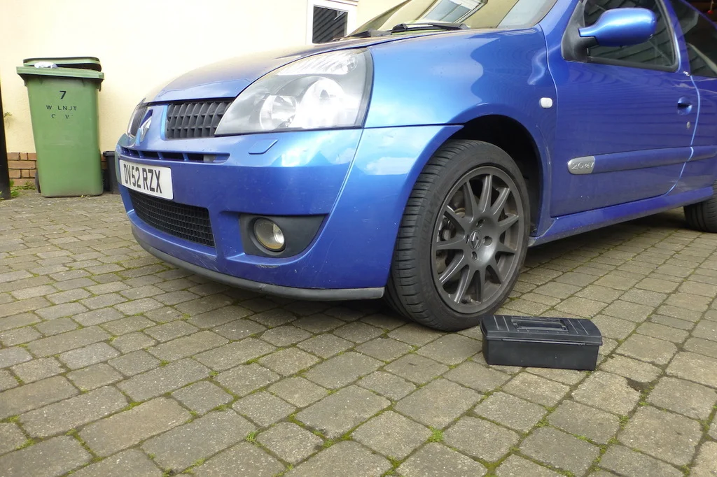

Right well with the big push to get the Puma ready for next weekends meet I haven't done much on the Cup, I have however received a few items that I purchased

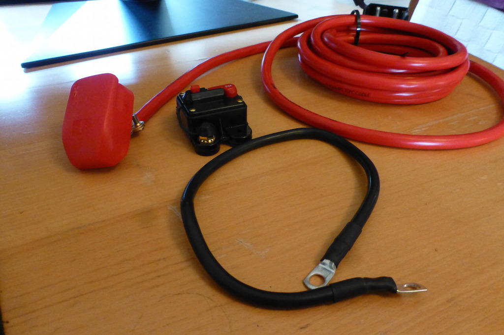

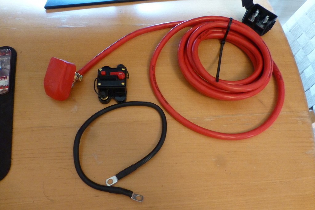

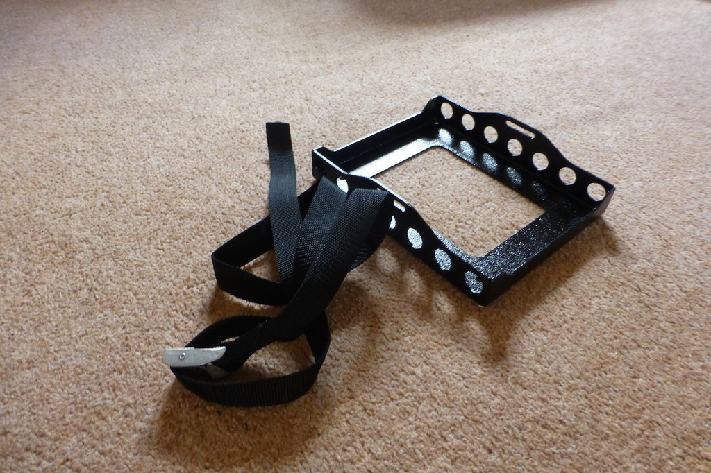

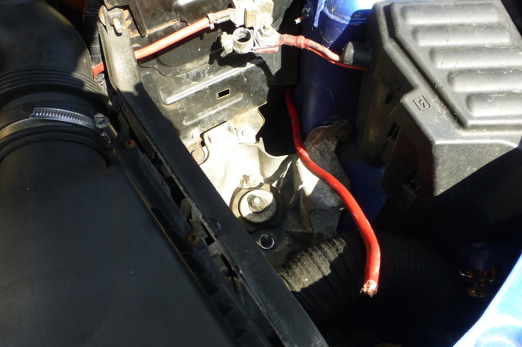

Power lead arrived also ordered the battery tray :) Almost all the parts arrived require to relocate the battery to the spare wheel well.
I have also purchased a set of bolts (4 x M8 40mm) for the OMP bucket seat frame which is also due in tomorrows post.
Next up bucket seat and harness.

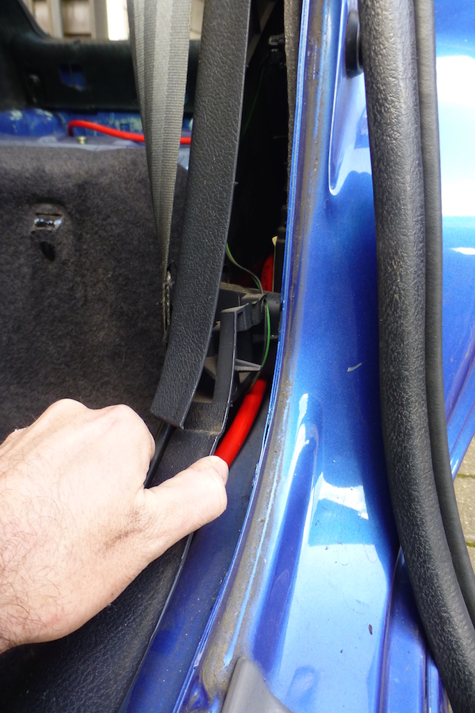

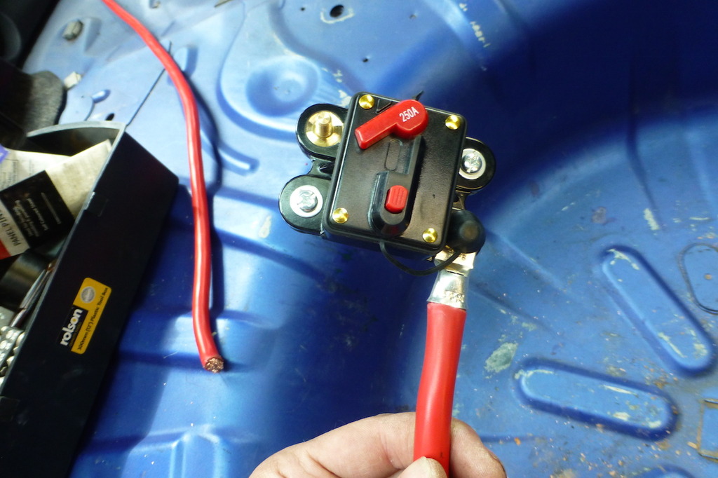

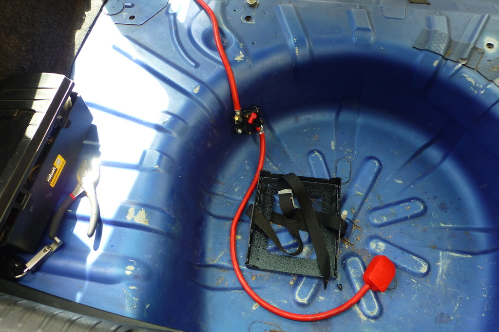

Okay so the battery tray arrived this morning,

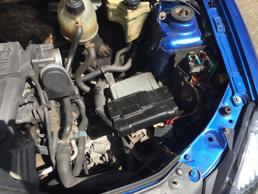

I have made a start with setting up re-locting the battery to the rear, I think it will be going in this location which is pretty much dead centre of the car.

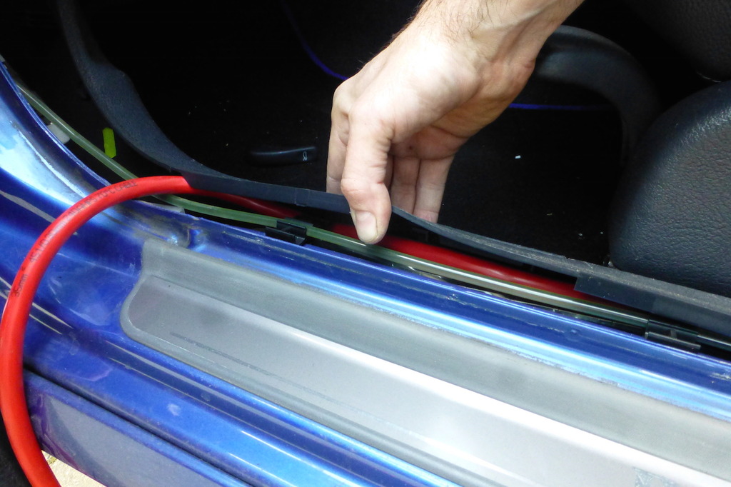

I removed the battery and fed the power lead through:
Its a bit of a squeeze in the sill but does fit nicely
Location once pushed through the grommet

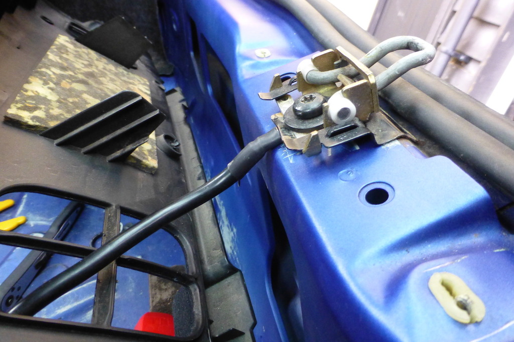

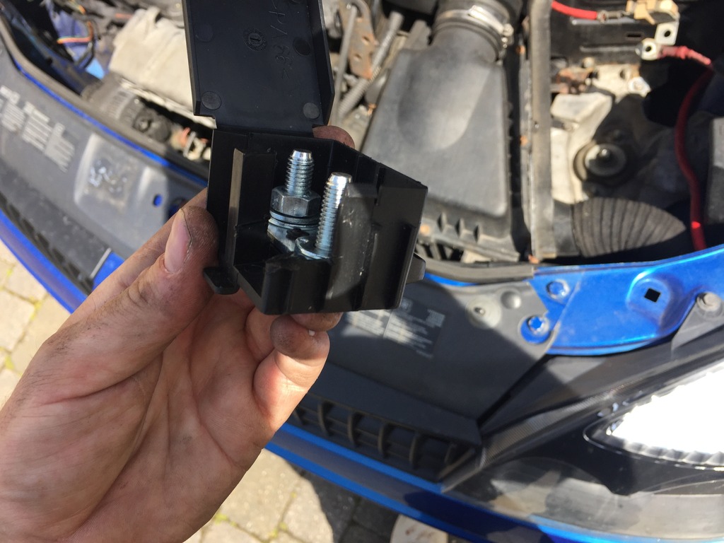

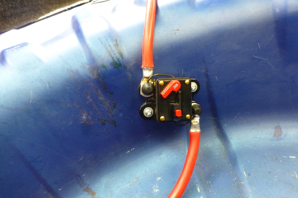

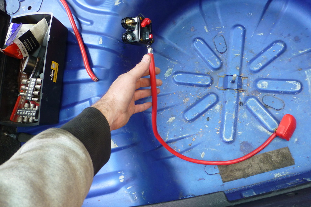

I have checked and it seems that there is a 60AMP fuse built in to the cable, so it need to remain fixed, it will however fit nicely into the new junction box.
You can see in this image where I have positioned the junction box, just happens to be a screw thread that I can utilise:

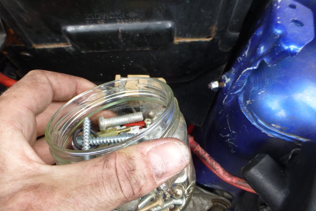

Out came the tub of odds and sods, suitable 10mm lock tight nut found to suit.

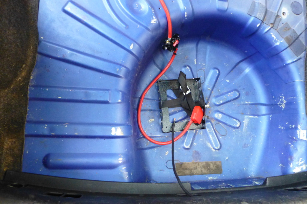

Mock up of the proposed layout, I need to get a replacement drill as mine has died, also need to source some suitable fixing bolts for both the battery tray and the fuse cut out device.
So there we are pretty much ready to fit once the bolts arrive and I borrow or replace my drill. Ay tips or suggestions welcome.

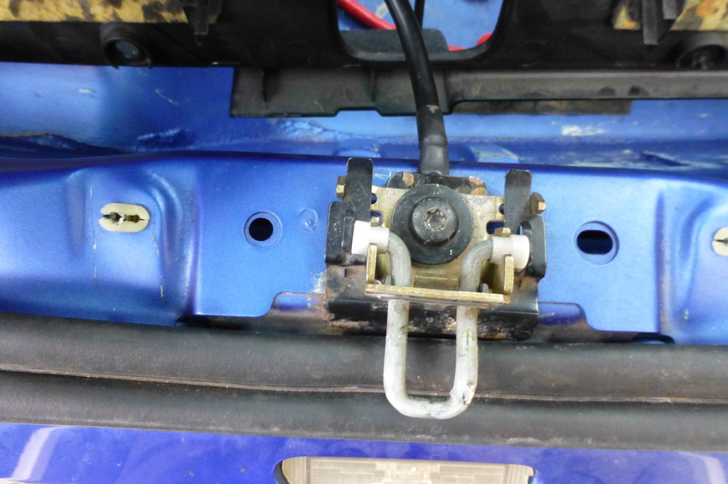

Oh the earth strap will be going to a bolt that holds the boot catch as suggested by a another Clio owner.

In all honesty not a lot, the battery weights a lot and just spreads the weight more evenly throughout the car, in all honesty just getting a smaller race battery and locating it under the seat is the better option however it worked out more expensive than this option.

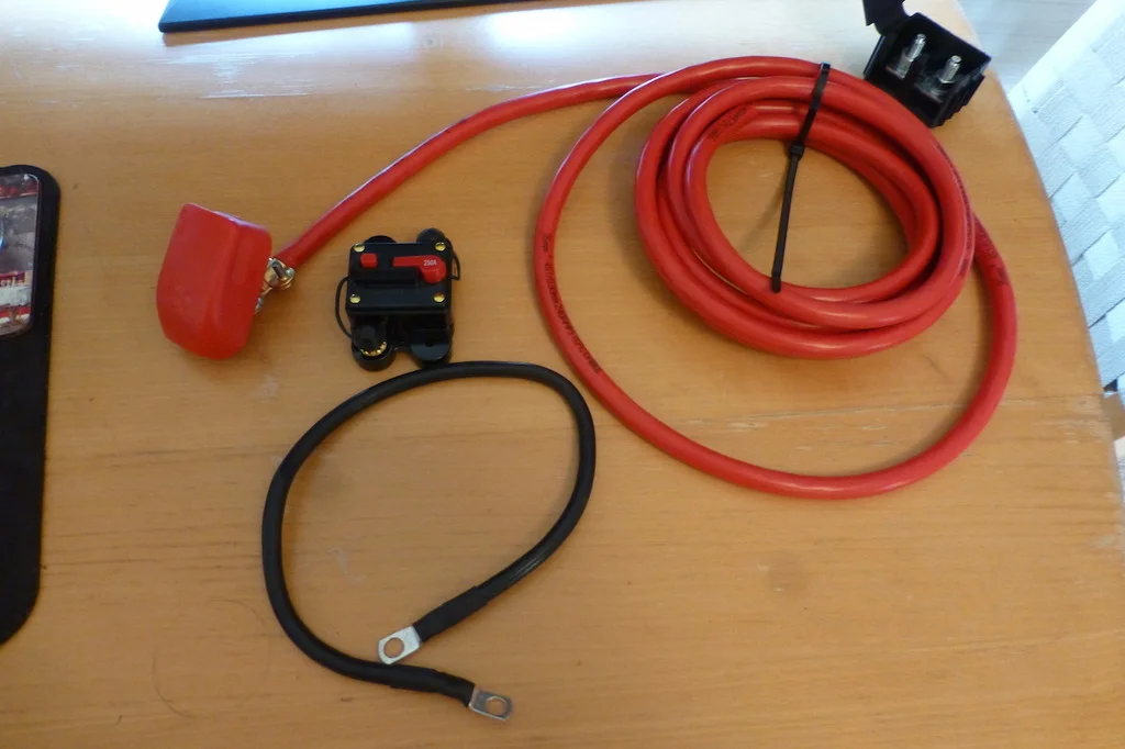

Smallest update ever, lugs for the power cable have arrived.
Just need to borrow / buy a drill so that I can mount all the parts. Next week should have it all fitted. Frustratingly the Corbeau Club Sport bucket seats are out of stock so might be a couple of weeks before I can get one delivered.

Started sorting out the cables for the battery:
Will the location of the earth cable be adequate?
Just the drill required now in order to bolt the cut out and battery tray down.

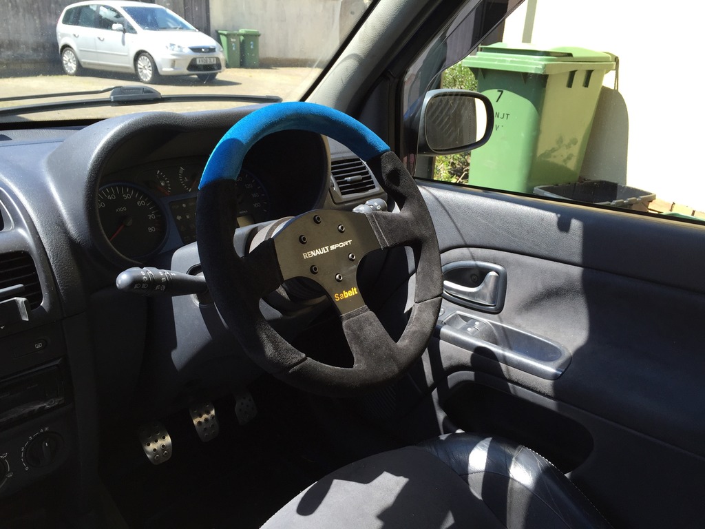

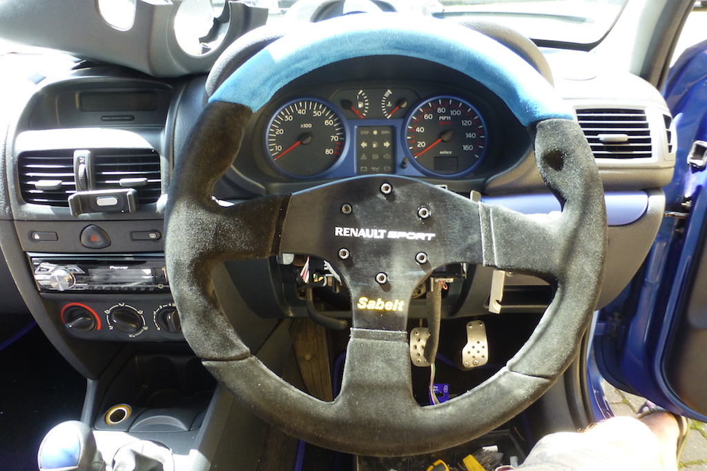

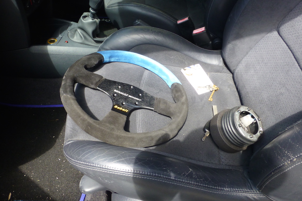

Steering wheel received and fitted this evening, got for £152 delivered as part as a group buy:
Wheel is fantastic and I would recommend to all, next stop bucket seat and harness.

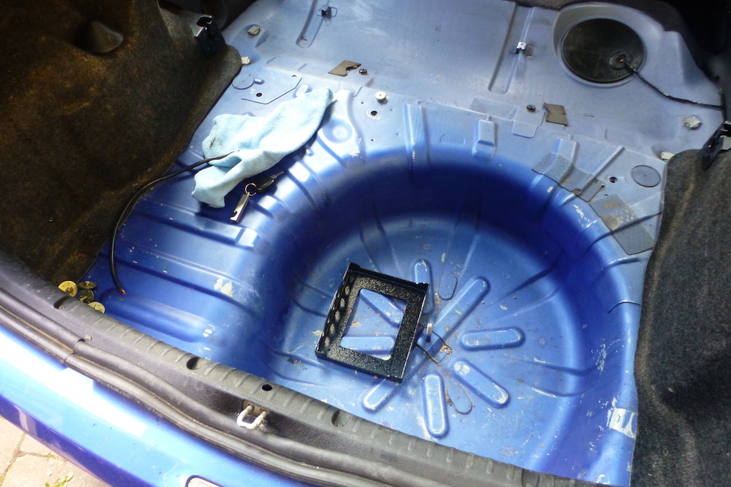

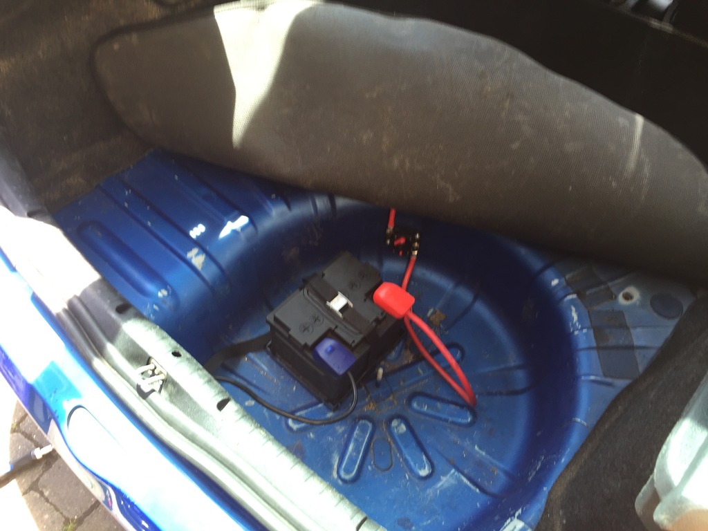

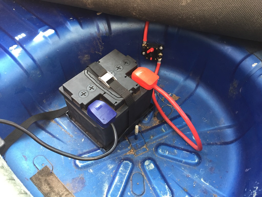

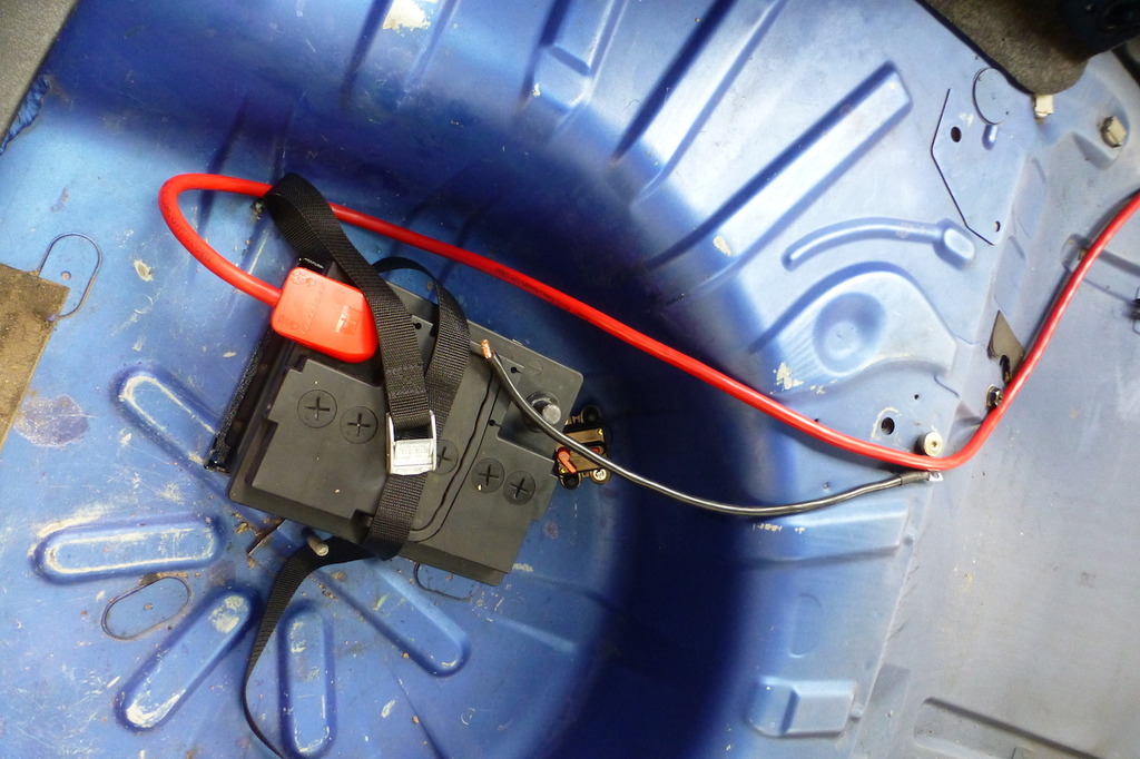

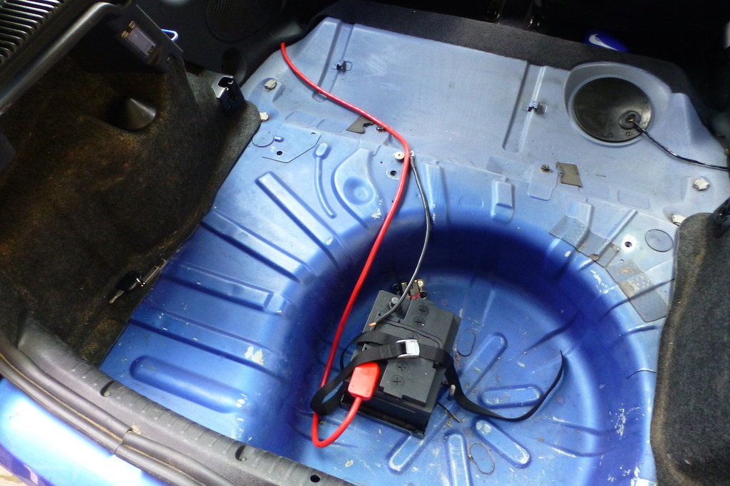

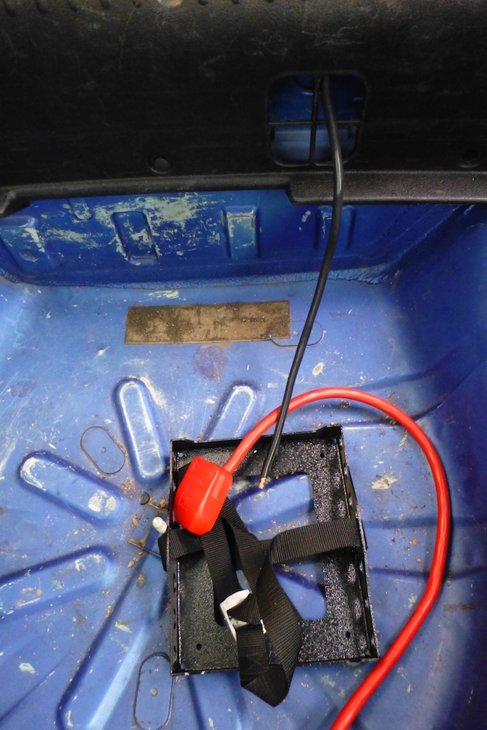

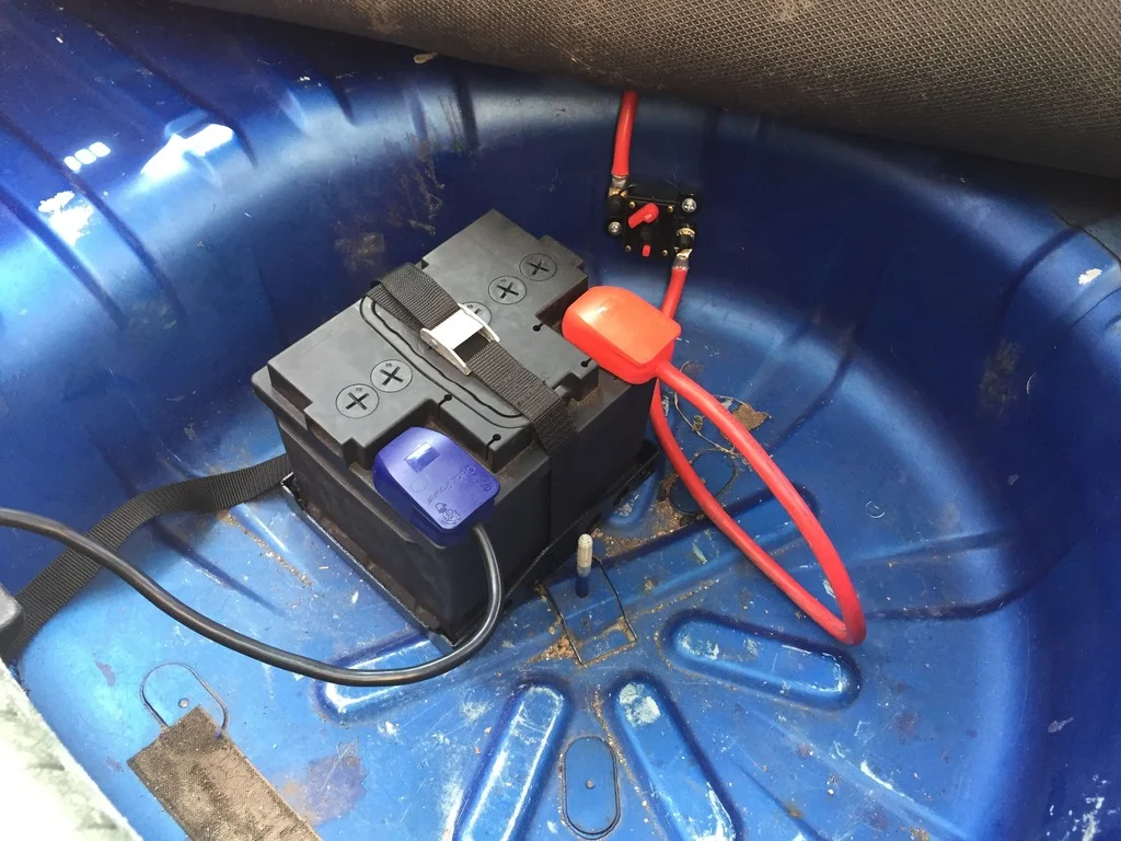

So I finally sorted a drill out and have now relocated the battery to the boot :)
Had to cut the part slightly but worked out nicely
Ready to do the oil change tomorrow, had to order a sump plug tool which is due in the morning.

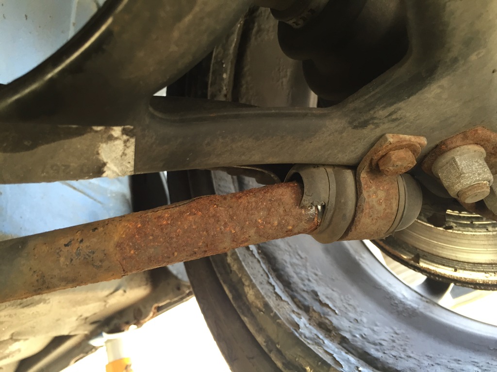

Suppose to be having the tracking doing tomorrow however i have noticed these perished rubbers so I need to get these sorted first
