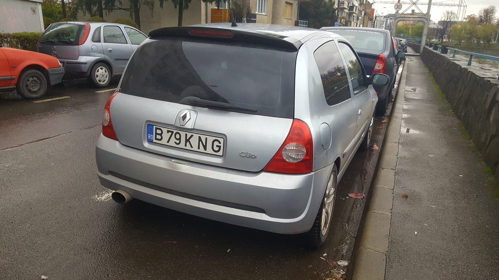

Clio 172 - slow progress project

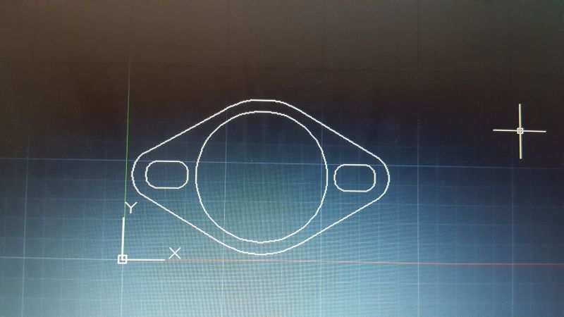

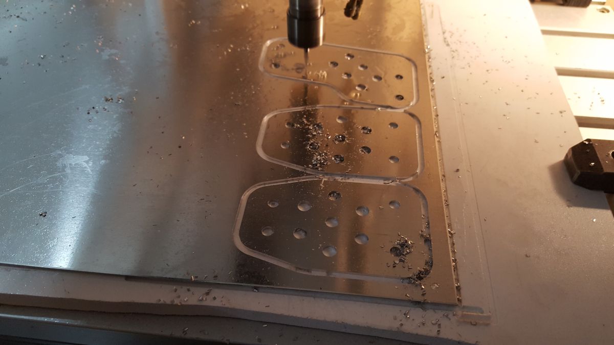

The hole should be around 1mm upper, but it is what it is:)
Hope it will seal fine without any issues.

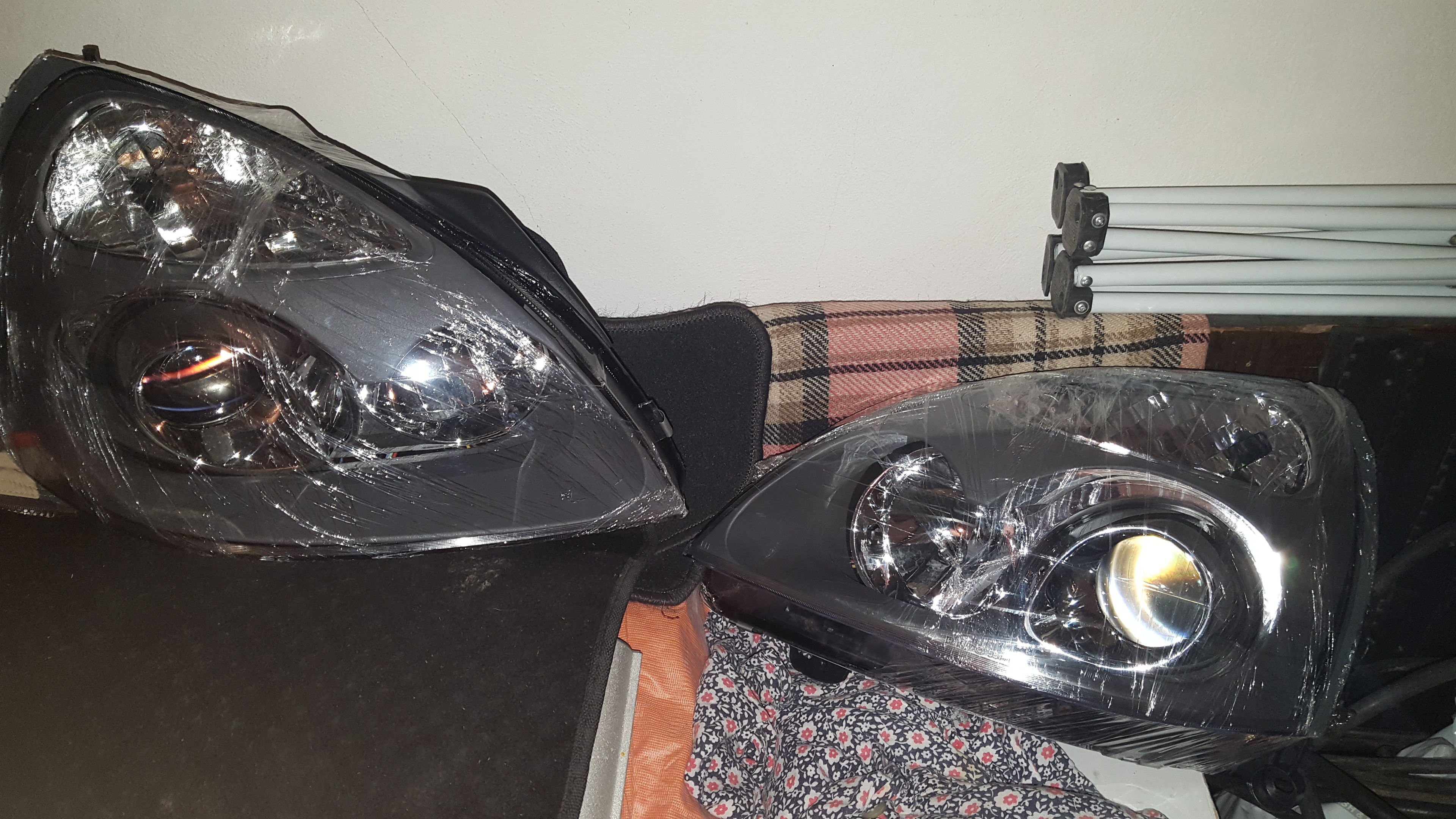

Looks great mate. Have you got a link for the new lights?
Sent from my LYA-L09 using Tapatalk

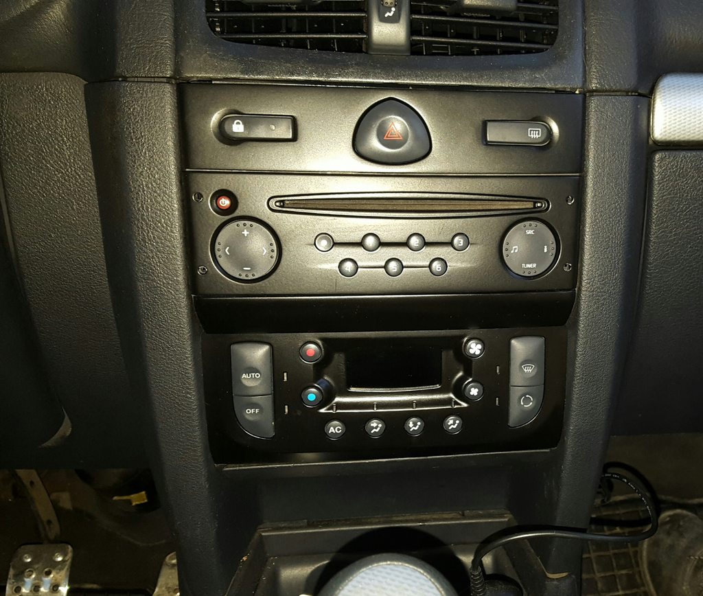

After 3 years of searching, finally get the original satnav plastics in order to add an android device.
Wireless charging, but 3.5mm jack for now, next Bluetooth connection.

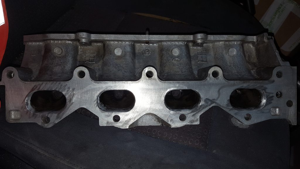

Another project...
For now, 197 ported inlet

After 3 years, this "retrofit" is done.
I am very interested. Did you modify the software to the mobile phone so that it starts automatically like carplay / android auto? Have you modified it so that it turns on and off with the car ignition?
Tell us more please.
Hi! I am using an android device (s9) that uses a car app as home application.
The phone is charged using a wireless charger. Because the phone was not so big, I have access to power on/off button on it. Otherwise you need to hack the device a bit, or use one with on off button on main screen.
