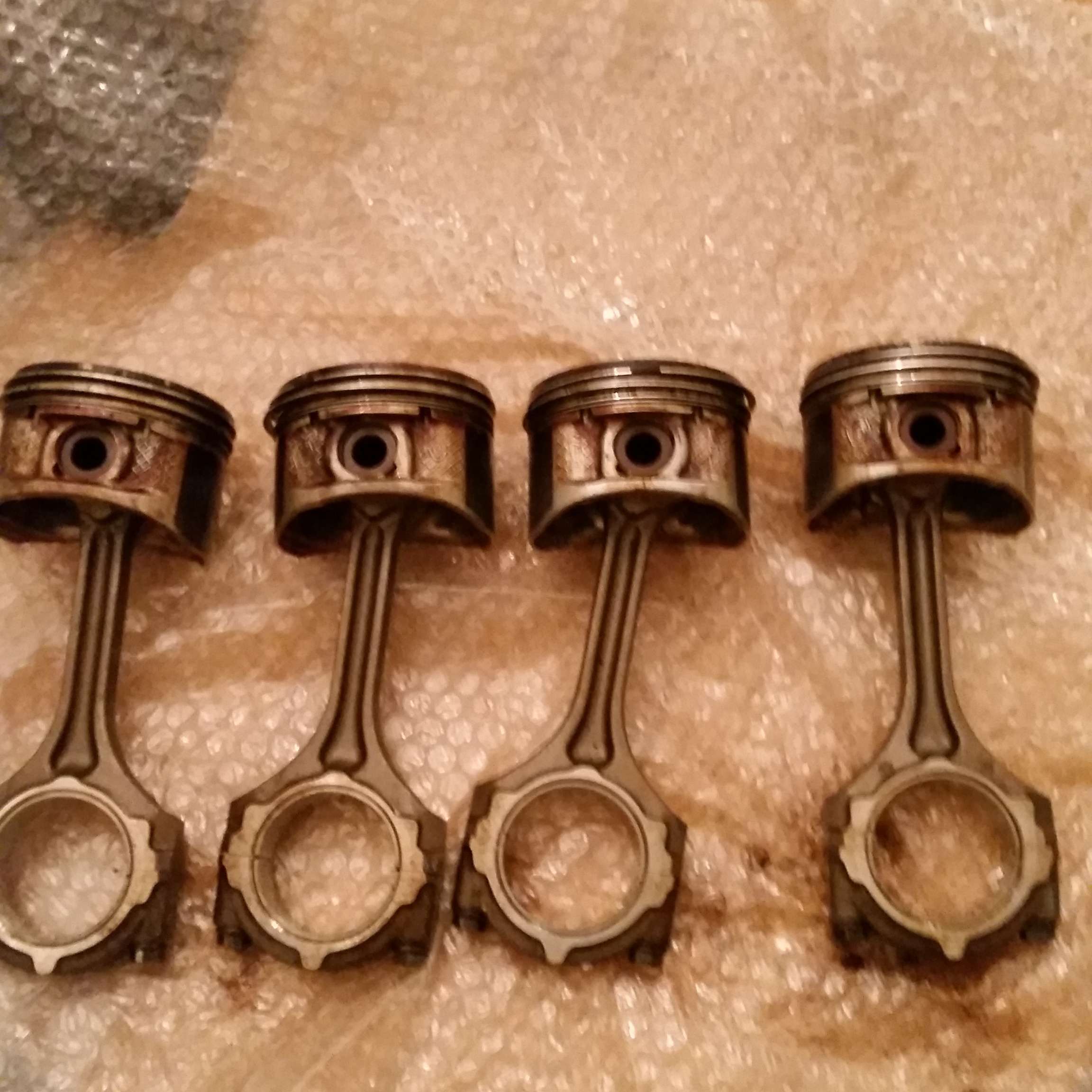

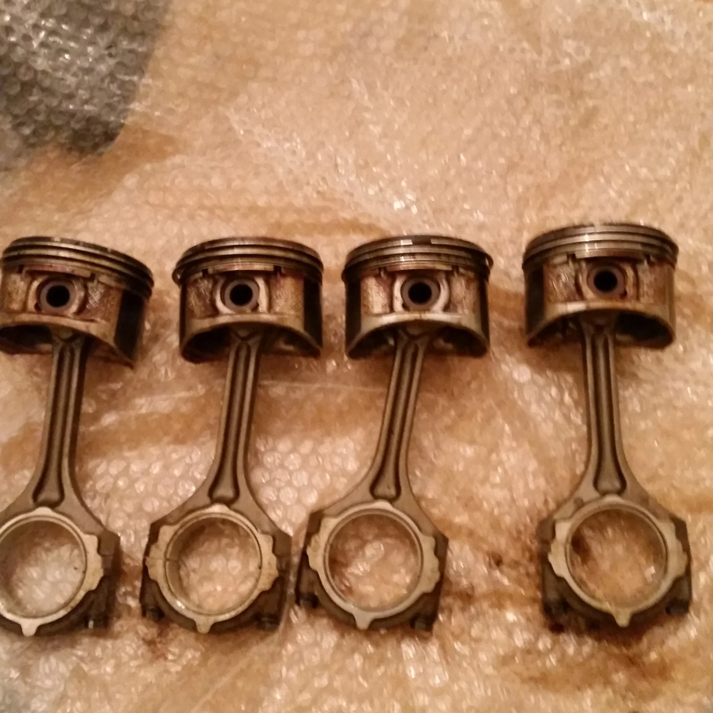

I've already got my megane pistons and rods, got the pistons with the rings worn for £40 so will replace the rings!.... bargain IMO. ... They are in great condition other than rings tbf

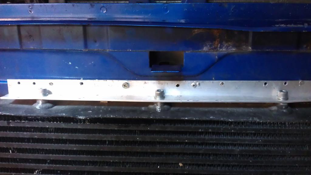

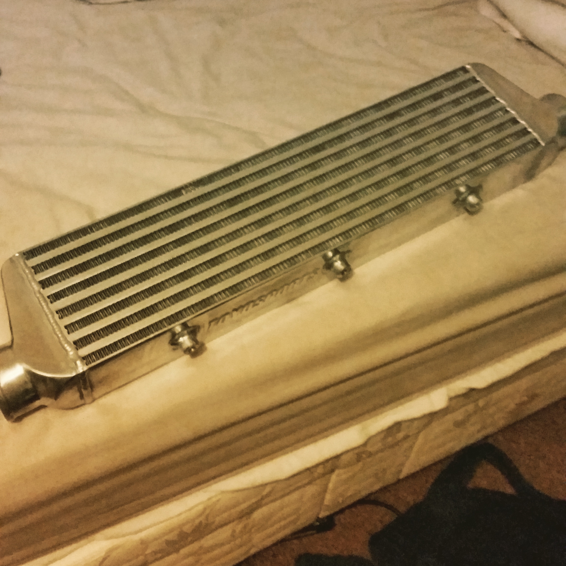

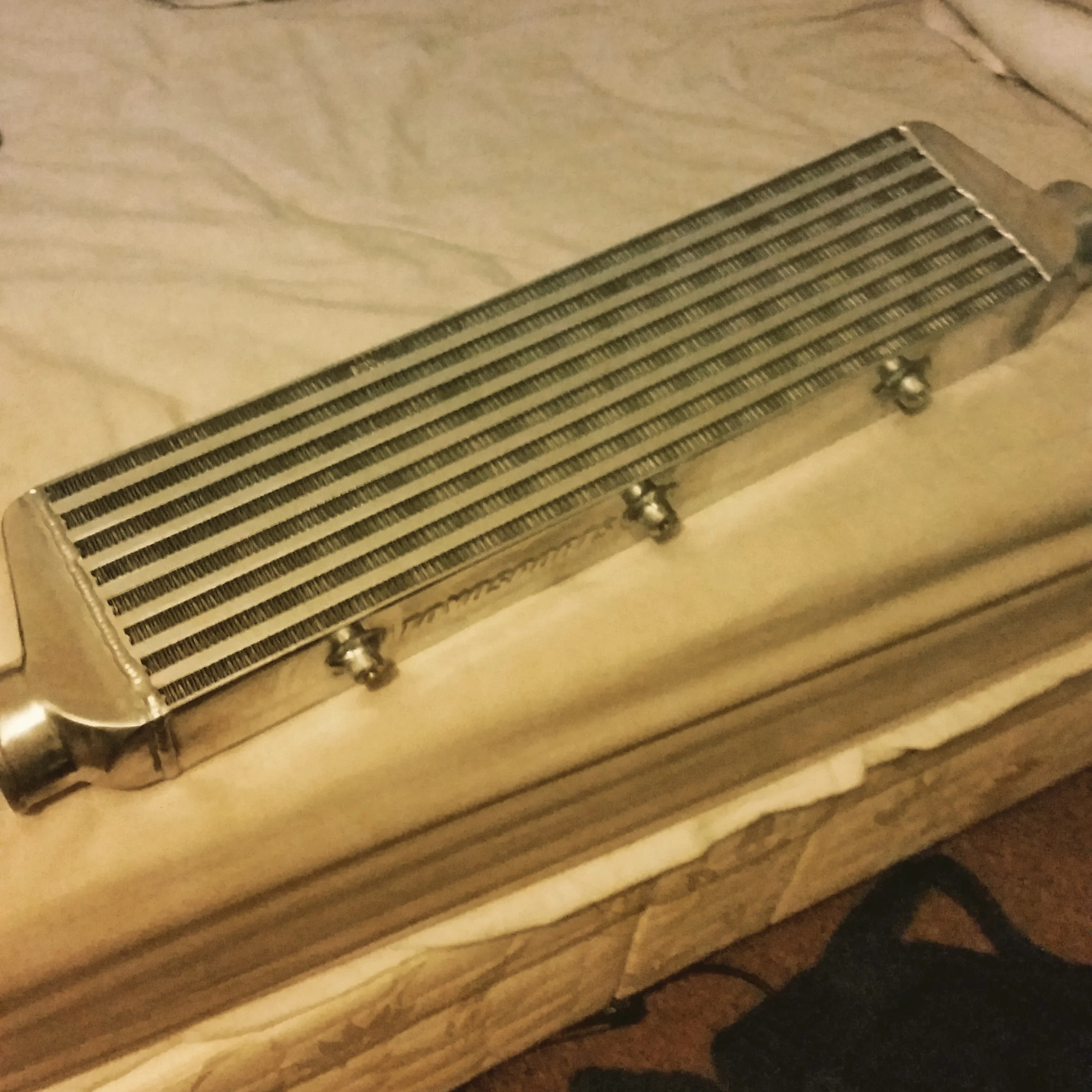

Also got an intercooler, it's a ebay special as I'm aware of? Toyosport? I have seen people using these on there builds what sort of way shall I do of fitting it and has anyone using this intercooler had any troubles? Does the ktec pipework fit it?
Will still foul iirc and that would be a bit counter productive unless timing them up with advance.
they clear, had one over to chris at efi he was saying clears but obviously needs dephaser 'taking out' on ecu.
So I can use uprated valves? I wasn't planning on machining pockets as I didn't realise they foul? Hmm.. also thinking on using the ph1 fuel sender with the walbro 255 pump... just need to find a ph1 sender first lol.... anyone got any good experience with turbos not sure what type gt28 to use!! :)

i have to admit that i'd hooked the solenoid back up as the car came in as an un finished project, few bits of loom chopped out including map sensor!! fortunately car only had standard ecu on so was only getting it ready to go to chris for new ecu and map, was when i was talking to him that he said about leaving it un plugged, lucky as i hadn't even thought about clearance issues with the meg pistons.

Guess youve got the the ktec mani on yours??, what intercooler pipework have you used for yours> i got a mate of mine in same town as me building the same build as me, he is making his own pipework he bought the ebay pipework you can get an join them all up until it fits so i dont know whether to do the same, the only thing is itll look a tiny bit tatty, something like the ktec pipework will look neat! if it dont fit my toyosport intercooler i can always fabricate the pipework to make it fit ?
Lol, no its not the ktec manifold I have. I bought it new but second hand if you know what I mean but didn't pay anyway near that.
All my pipework is custom 2.5" diameter. I use a XS Power intercooler from a 200SX.
Megane pistons work fine, Andy at ct will help you with timing specs I'm sure
Does the 200sx intercooler okay then does it?? Sounds ideal! !
Most intercoolers will work if you make them fit. I wanted 2.5" pipework with either straight or 90deg ports. The one I got had straight ports but when making the pipework just make it to suit your route.
