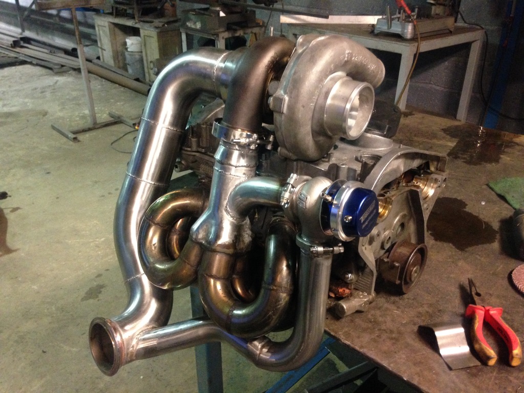

They changed the spark plugs over and put it for mapping again today - now at 1.2 bar it makes 314 bhp with 330 lbft....
But anything over 0.7 bar the turbo bleed valve boost passes and there is flat spots still.... now they're aiming this towards the actuator as from what I know th actuator spring is 0.3 bar (5 psi)spring and they have spaced it out and put a bleed valve to try and cheat it but at 0.7 bar is passes... at 0.7 bar it makes 245bhp but I'm not happy with that... so now I'm trying to order a adjustable actuator... just wondering what spring I should go for... now at 1 bar its 300bhp so I would be happy with that so I'm wonder whether to go for 1 bar spring or go for a 0.8 bar spring and adjust upto 1 bar am I correct in thinking that?
Andy explained megane pistons don't like heat but the air flow etc I'd impressive there isn't much heat even at 314 bhp.... but like I said I am happy with 300 and 270 minimum ... I really hope to solve this soon as I actually really do want it back :(
Can you not wire a Mac solenoid valve as an aux out to the ecu and control the boost with that, correctly if I'm wrong but this should allow you to achieve the boost you are hoping for?
Admittedly your actuator is a bit on the weak side, I've just had a look back through your thread to see whether your using a t2 or t3 actuator. It looks like a t3 which should be fine, I personally would put a 7psi one on there and sort your boost control setup out.
Bleed valves are pretty nasty so as Korky says get a proper electronic solenoid on there out will give you much better boost control. That way you can block the vacuum pressure from the actuator and it will be strong enough to combat the pre turbo exhaust back pressure.

Right what there saying is happening is the button valve isn't holding shut and exhaust gas is passing through it. ... I need to get a better actuator with 1 bar spring so it can keep the button valve shut.
This is what they have explained ... now I'm really struggling to find where I csn find a adu stable actuator for the gt2560r ... I've found 1!!! ... which is on ebay from kinguwa but I think that is a cheap type but I really don't know atm ... anyone used this turbo with an adjustable actuator?
You don't need an adjustable actuator. You just want a .7bar one, and then use something like a MAC valve or an N75 to control the boost level electronically. Speak to Owen developments, they'll stock the actuator you need
I buy must of my stuff from atp turbo
http://www.atpturbo.com/mm5/merchan...tp&Product_Code=ATP-WGT-028&Category_Code=WGT
I used the 0.5 bar/7 psi one, and didn't have any problems. But as mentioned your actuator sees two pressures, you have the pressure from your vacuum line which fills the actuator with boost pressure, then you have pre turbo exhaust pressure pushing against the wastegate flap which pulls against the actuator. In theory the combined effort could over whelm a weak spring.
The easiest path you can take is too fit an electronic boost controller, this will block all the vacuum pressure to the actuator until the required boost is hit. Also because of the size ratio of the penny waste gate flap to the size of the actuator you will need exhaust pressure that is considerably higher than 5psi to force it open.
The other added benefit is it will give you adjustable boost settings.
