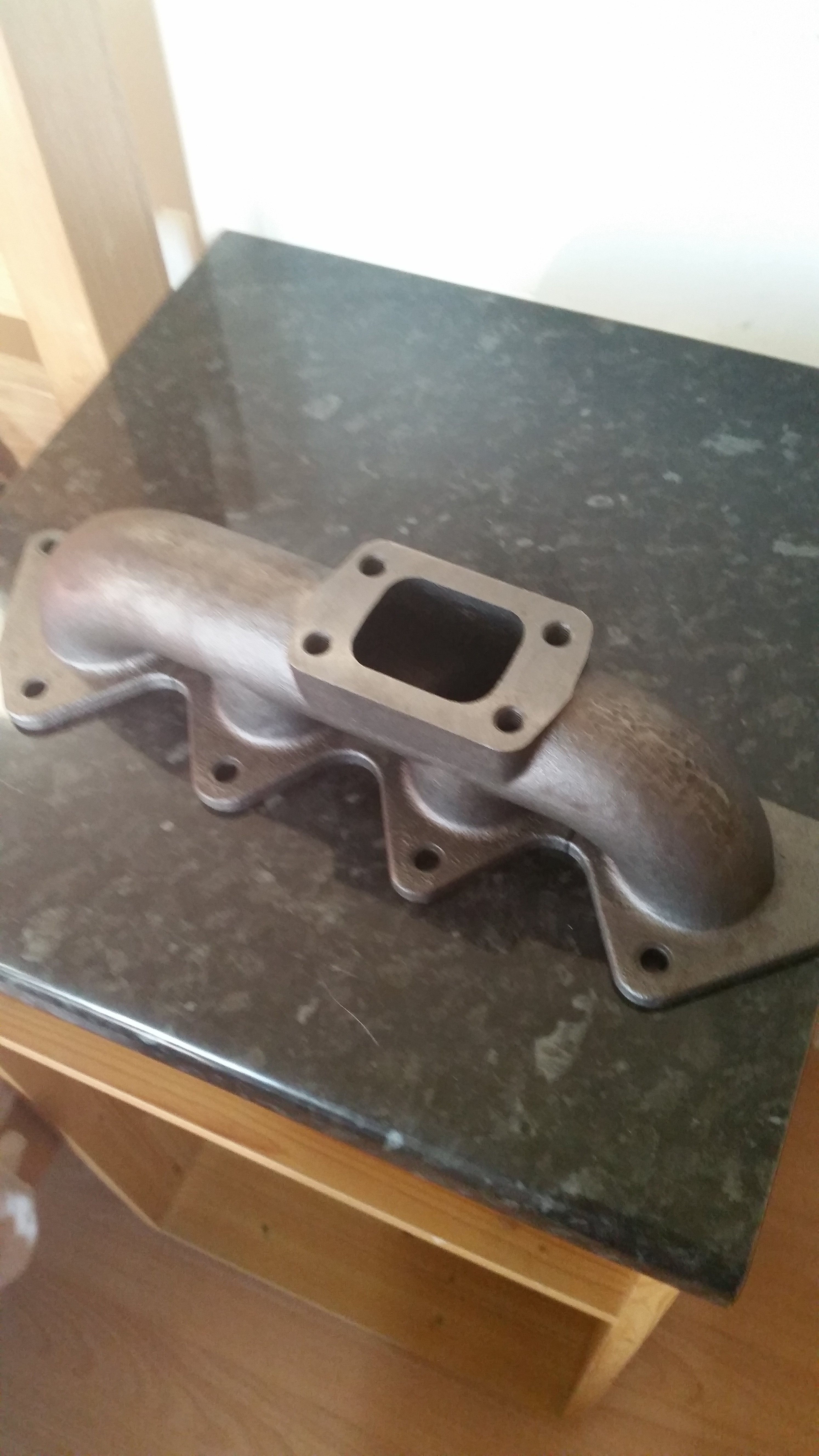

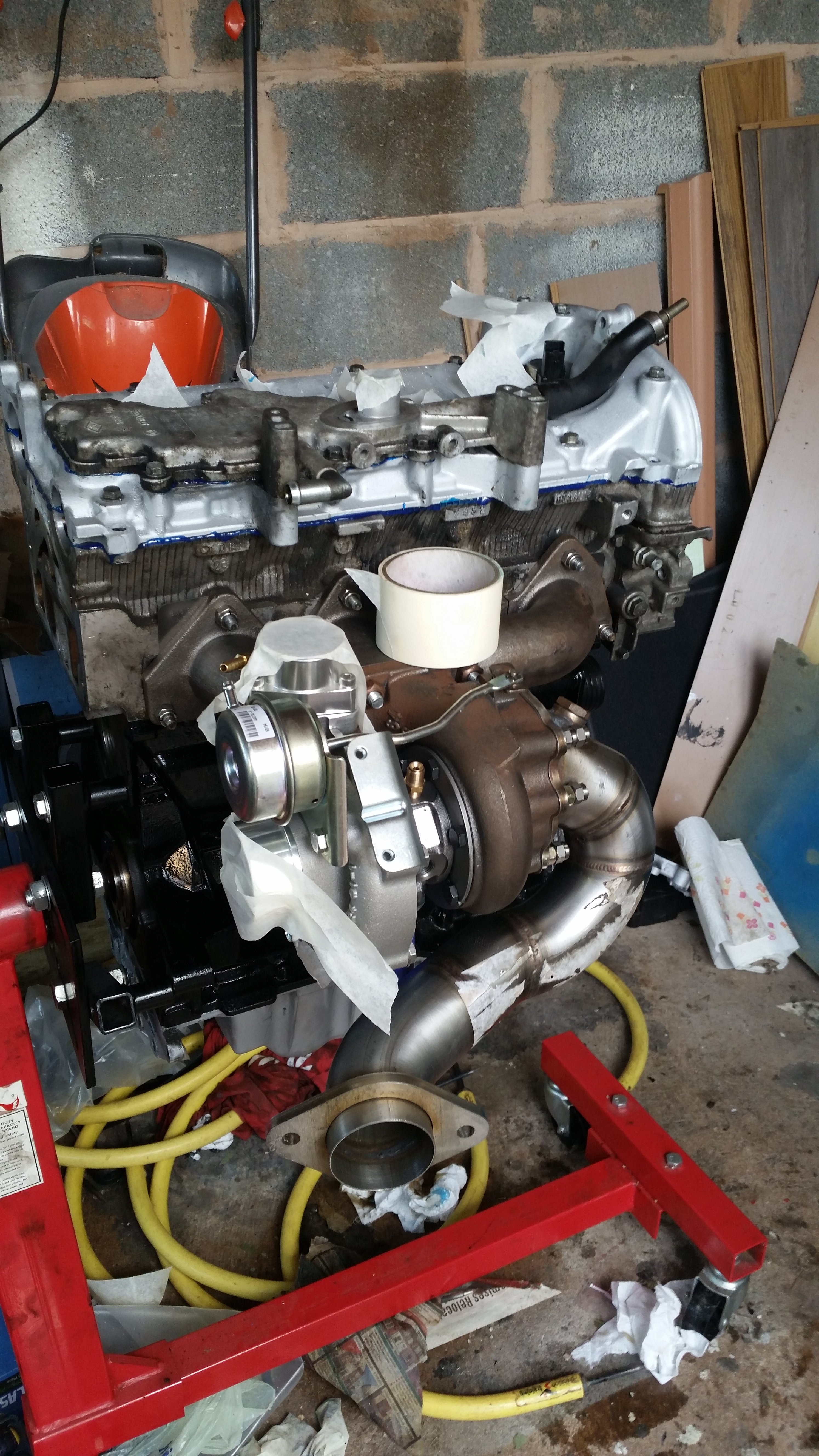

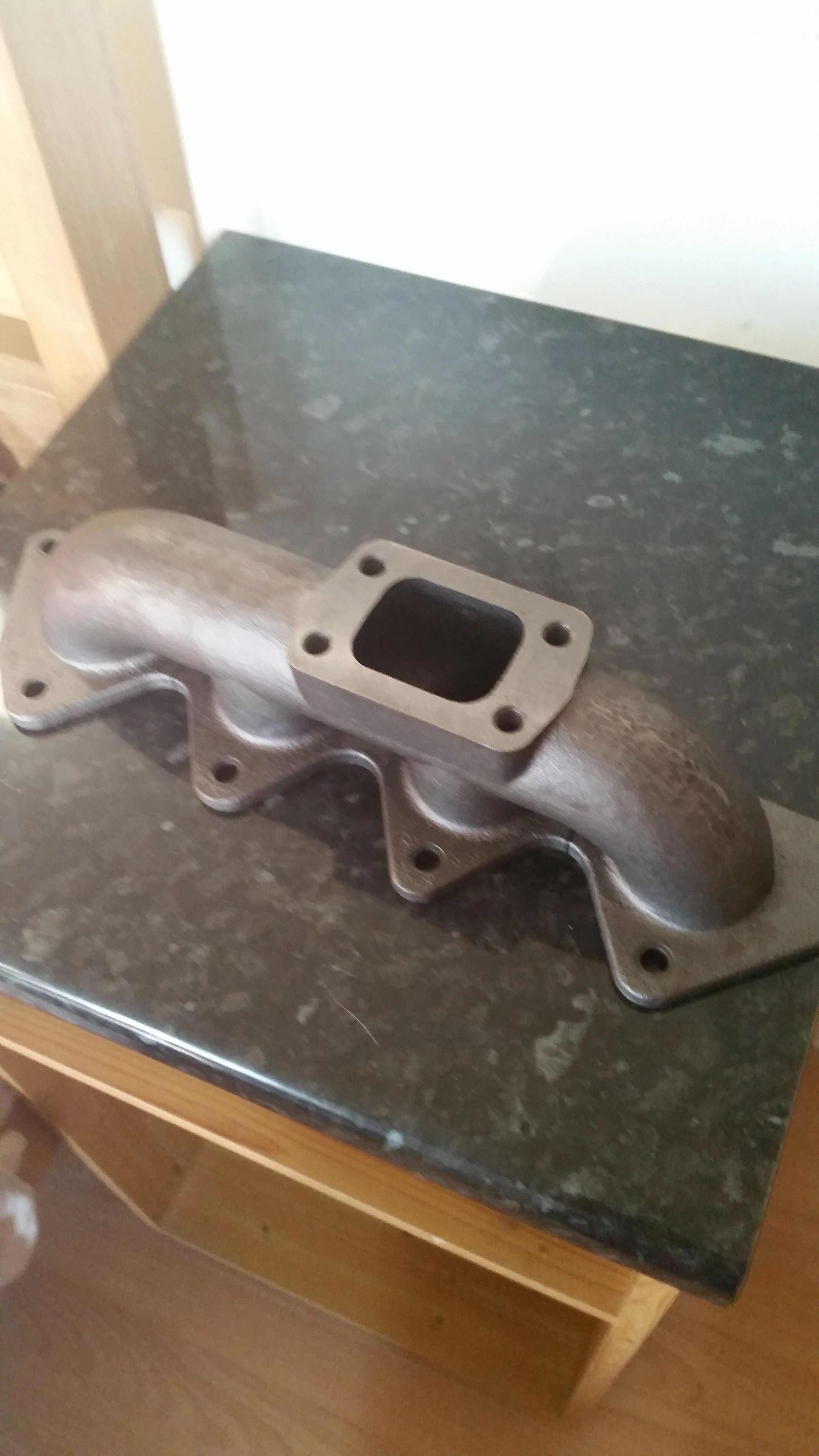

The manifold arrive ! It's actually pretty good for one cheap from America so just gotta order the pipework next !

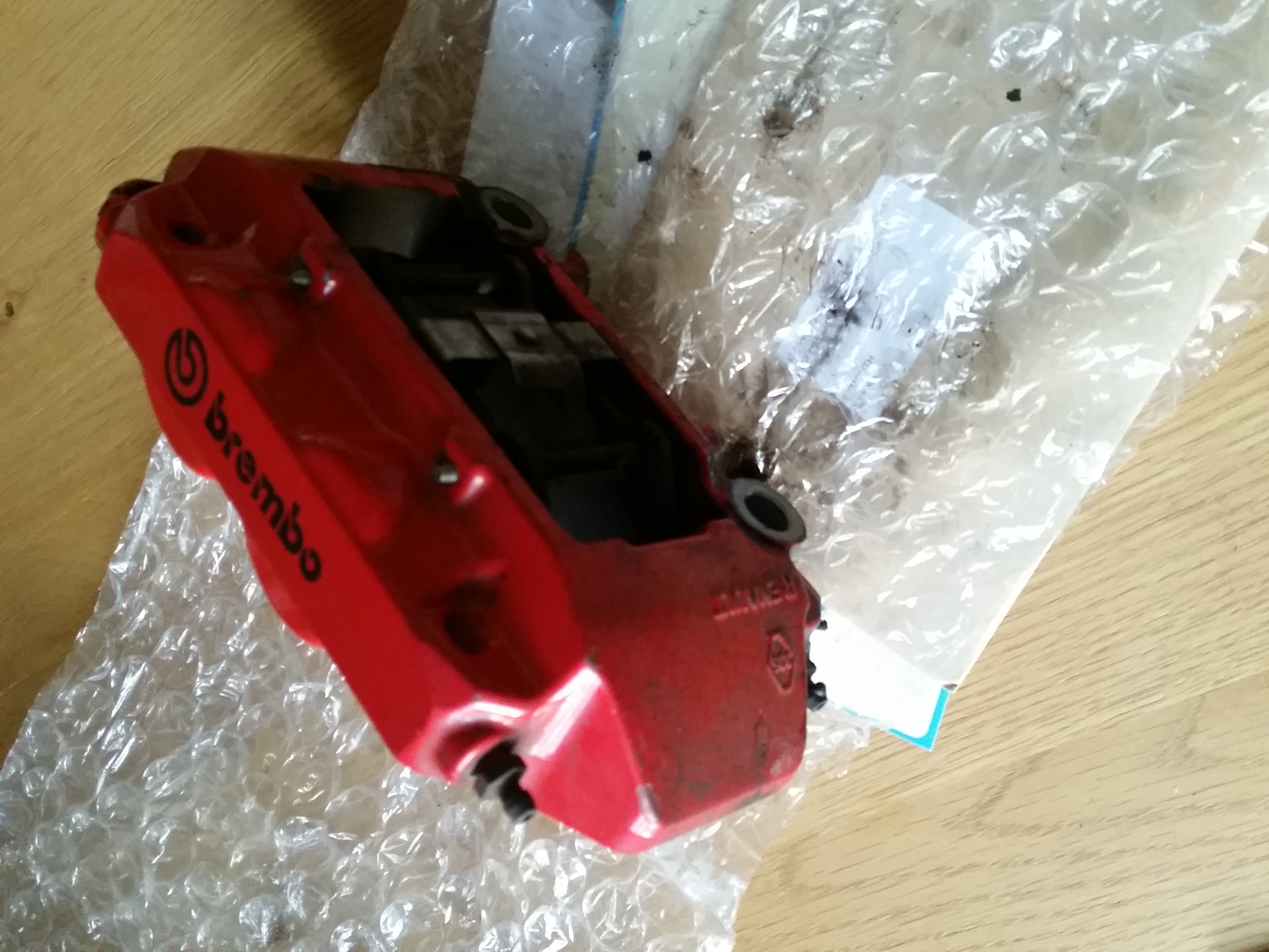

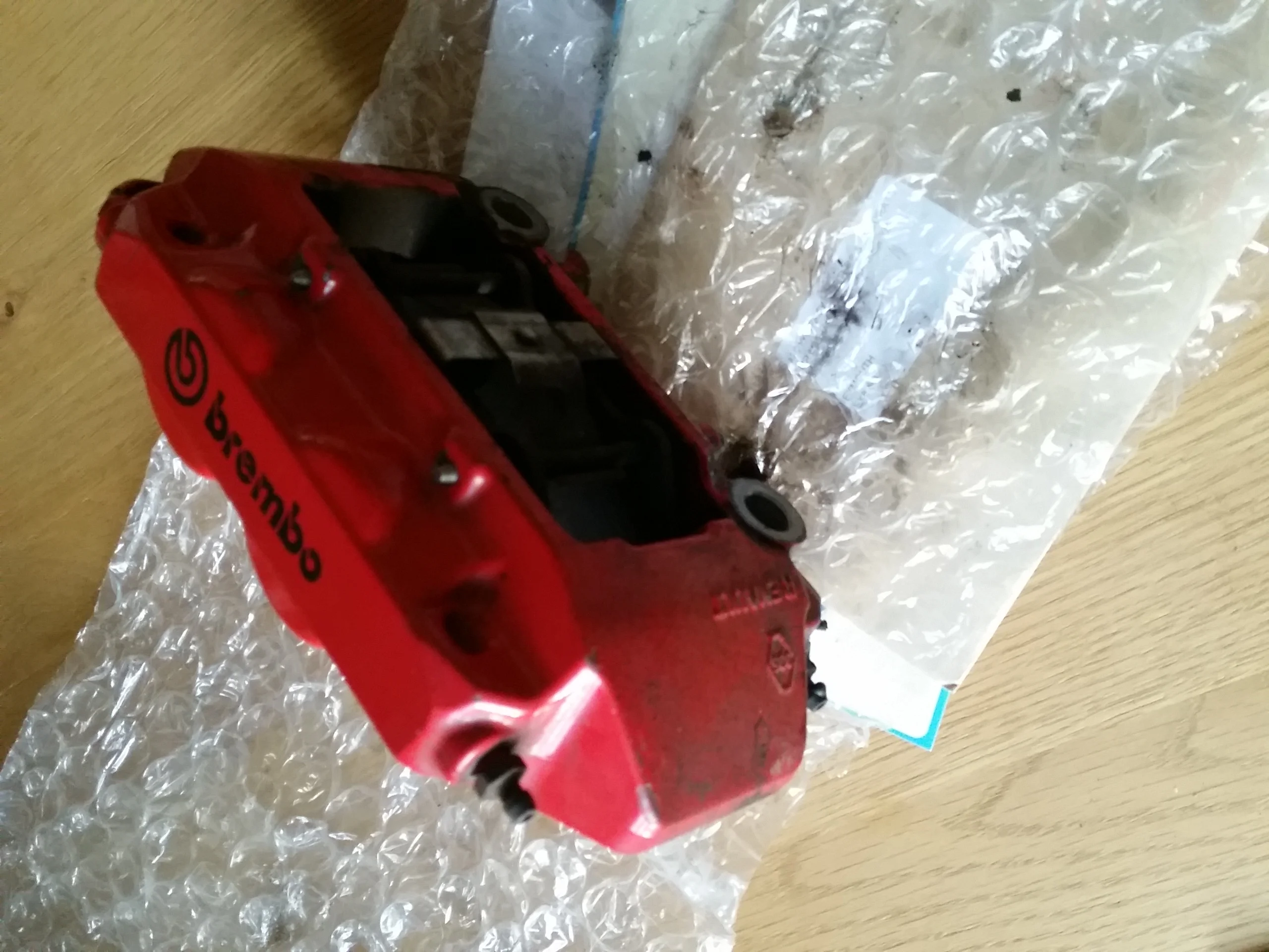

Ordered some 4 pot brembos from the megane for stopping power which arrived just gotta paint them recondition them and buy the brackets for them to fit ! Also will need braided lines so anyone selling megane front braided lines would be sweet! !

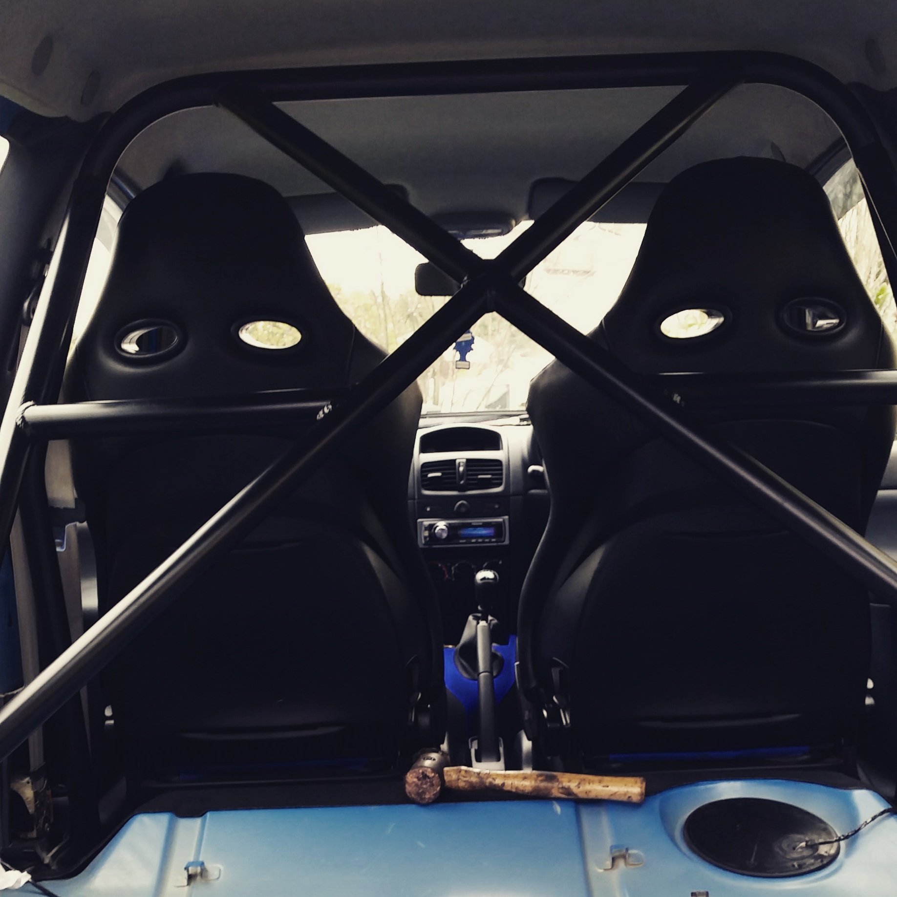

Bought some lovely blue and black alacantra recaro trendlines, all fitted, ordered the clio cage for sale on ebay, so that's on its way, just gotta order the harnesses next to go with it!!
ive seen this clio turbo custom manifold! looks great , wouldn't mind buying one myself for the turbo build!!

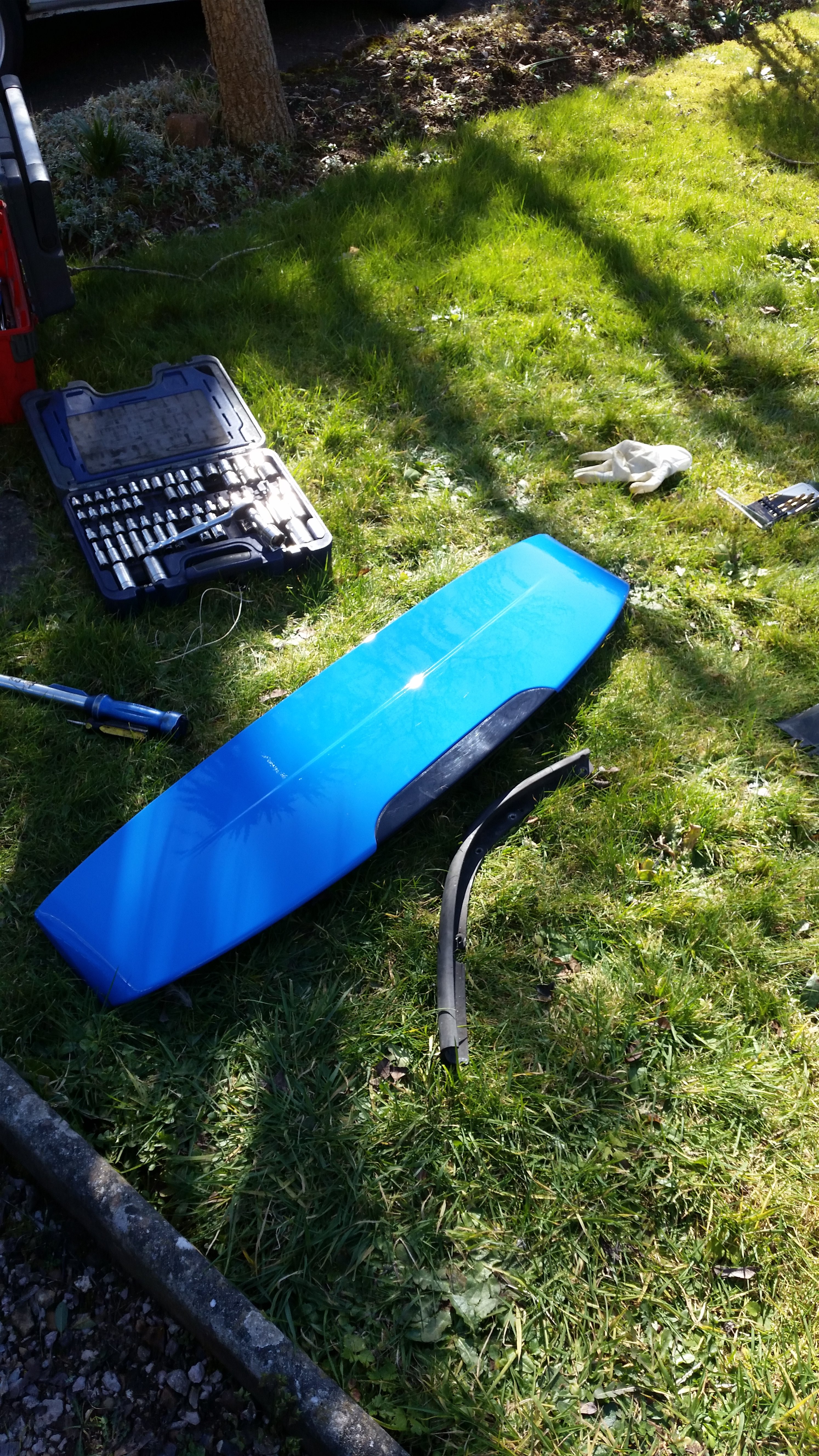

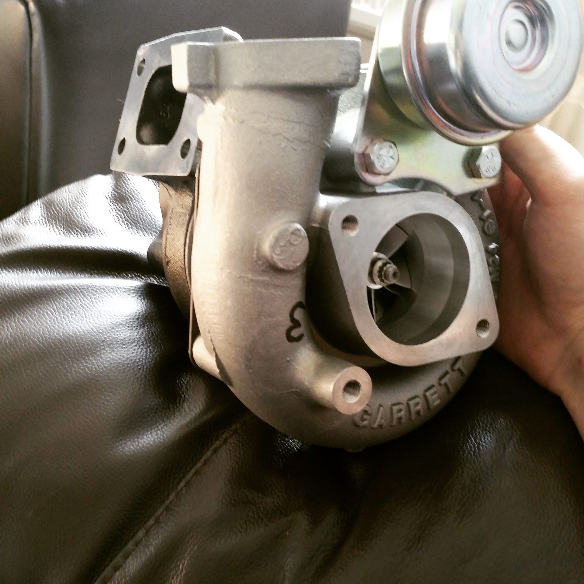

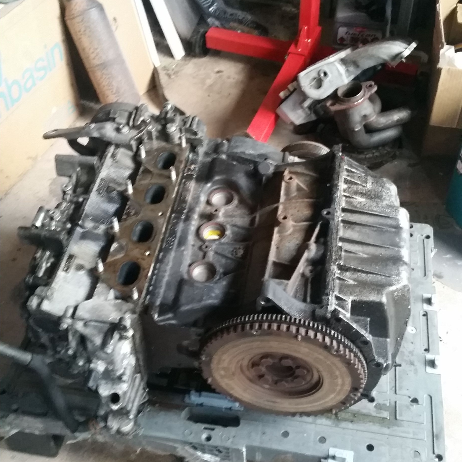

Right so I have ordered the walbro pump, helix paddle clutch, ordering the gt2560r tomorrow, gen 90 ecu next week fingers crossed, pipework should arrive tomorrow! Bought an engine so I can start building! I mounted my cage today so looks great with the trendlines :D v6 spoiler and turinis on just gotta add the brembos next :D

Having abit of trouble with finding the correct bolt for turbo to manifold, I bought some m10 escort cosworth nut and studs, the studs fit in manifold perfect but the turbo flange holes don't fit around the m10 nuts ? What shall I do or do I have order specific bolts? It seem as if the turbo has m8 fittings but the manifold has 10mm thread....@Andyrg@ ClioTurbo
Don't drill the turbine housing as its quite tight and you won'tbe able to tighten the M10 nuts.
You need step down studs, M10 one side 8 the other.

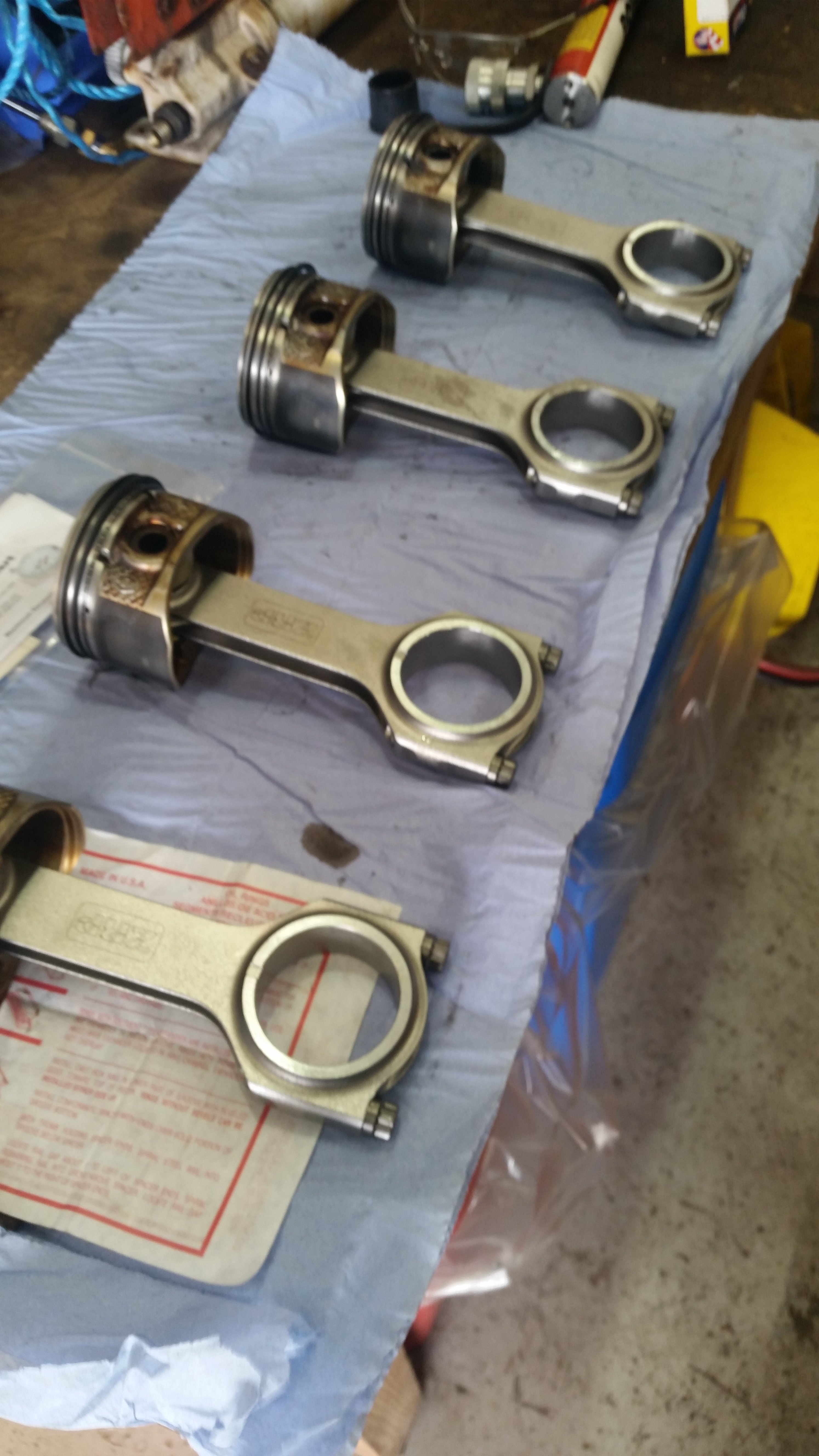

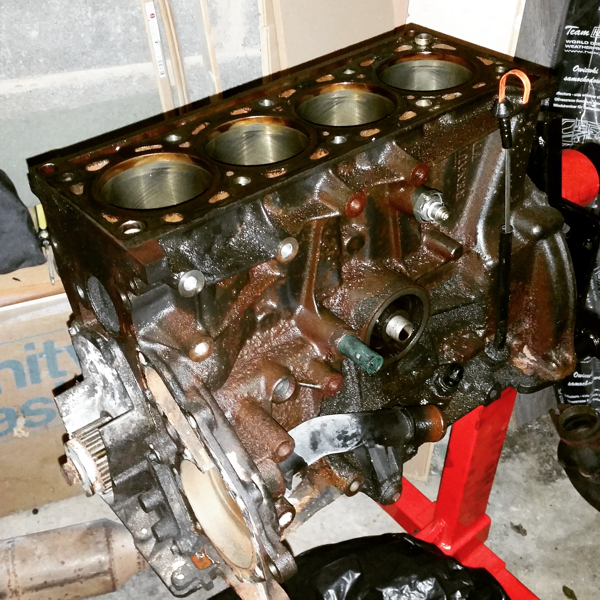

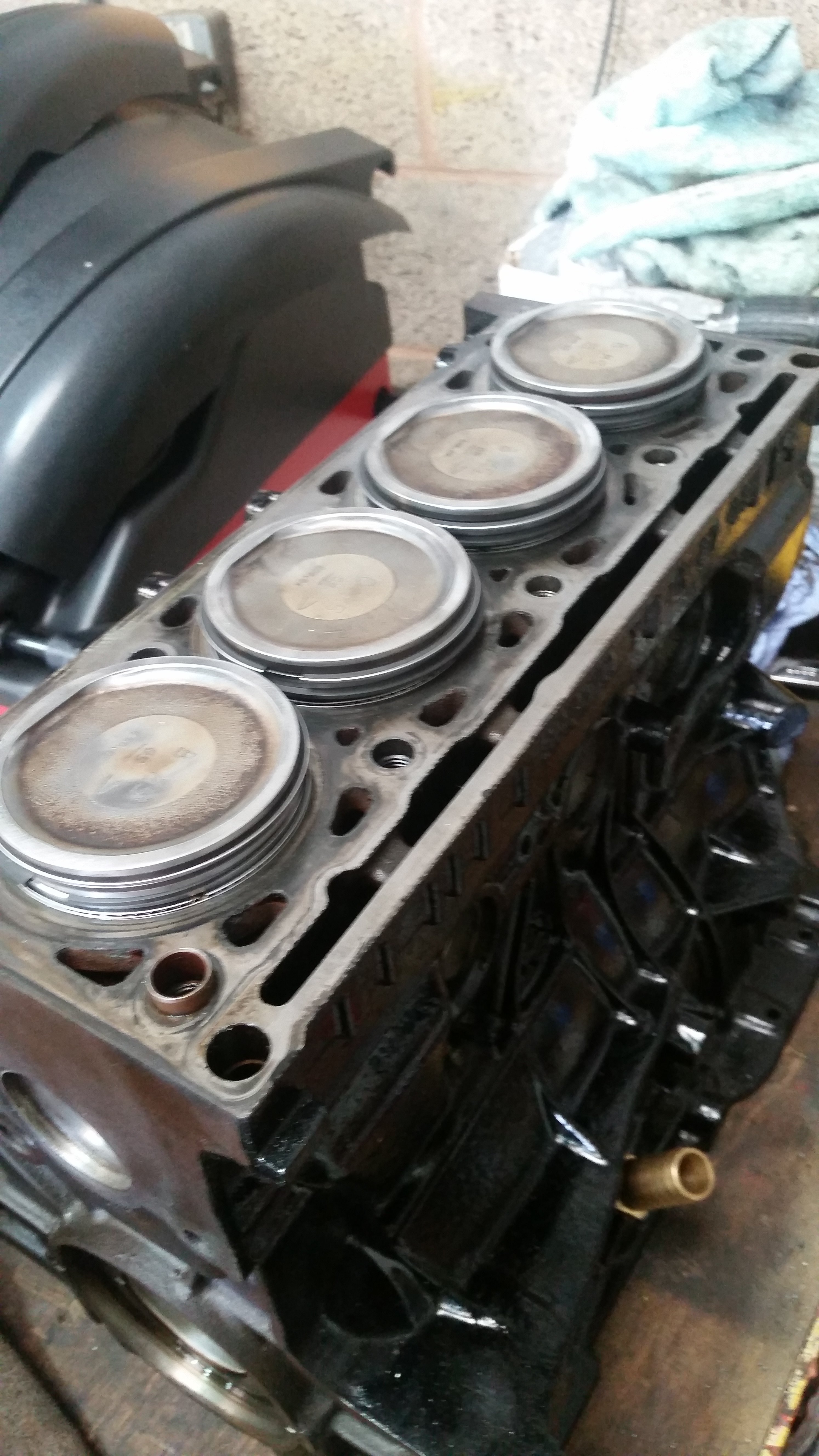

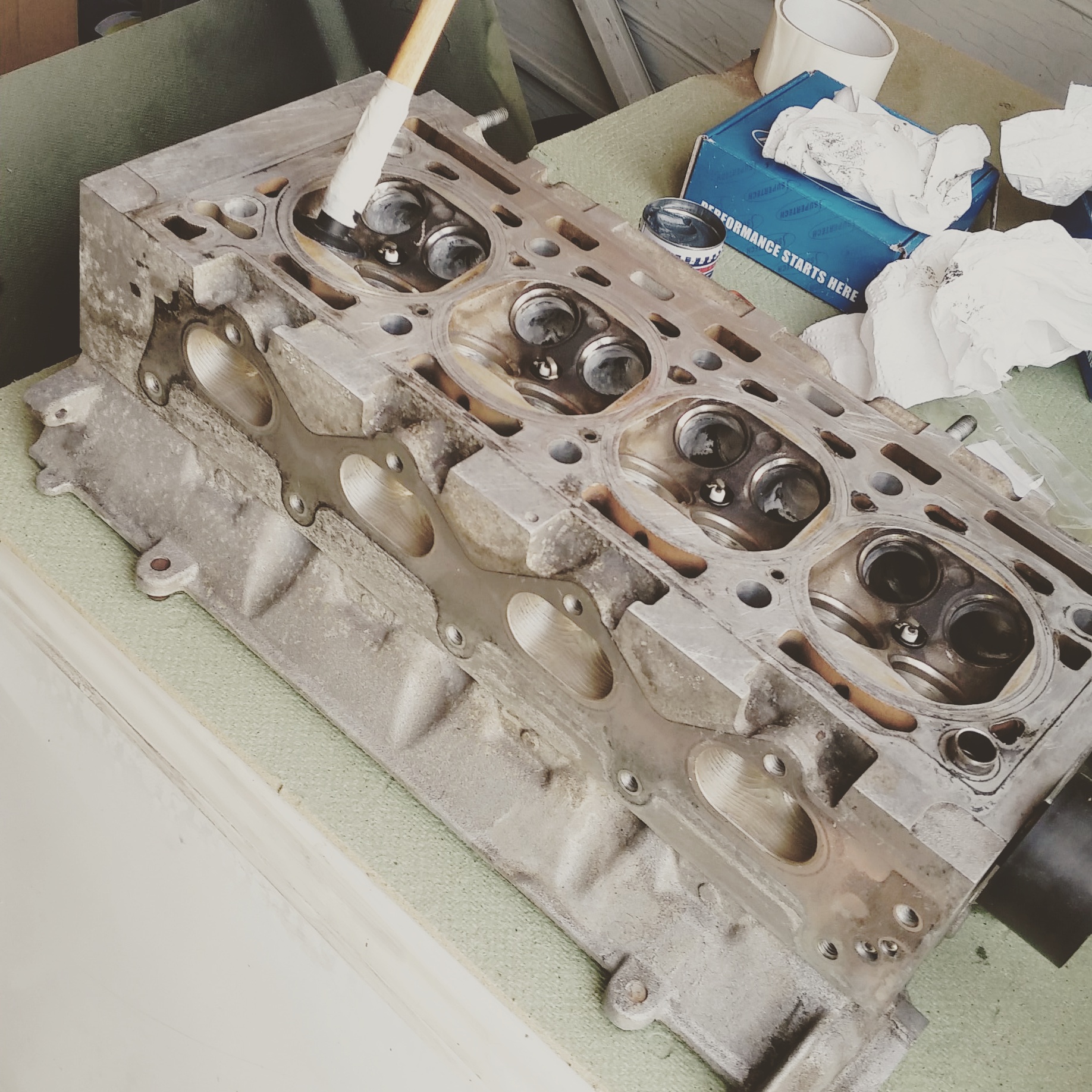

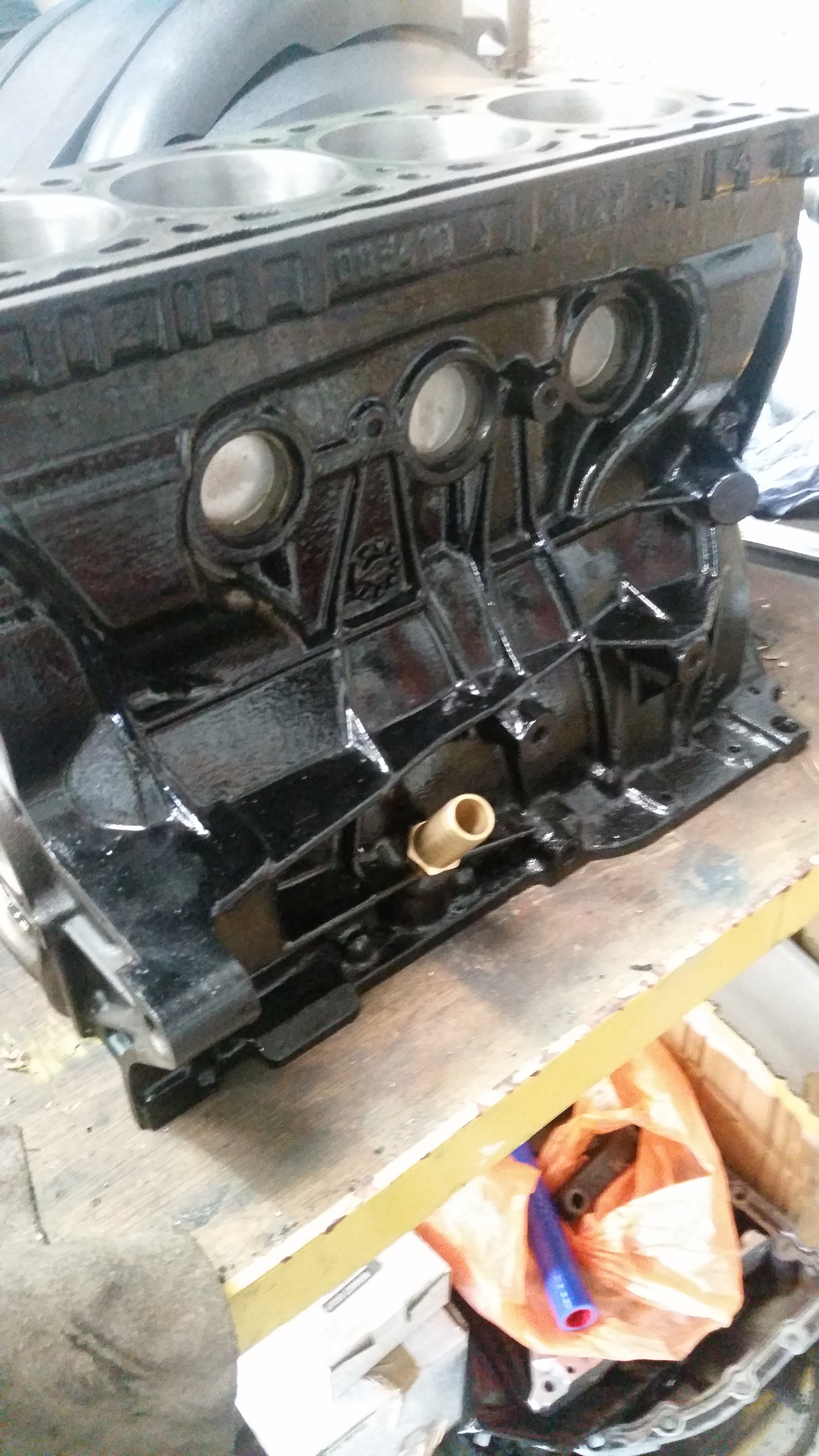

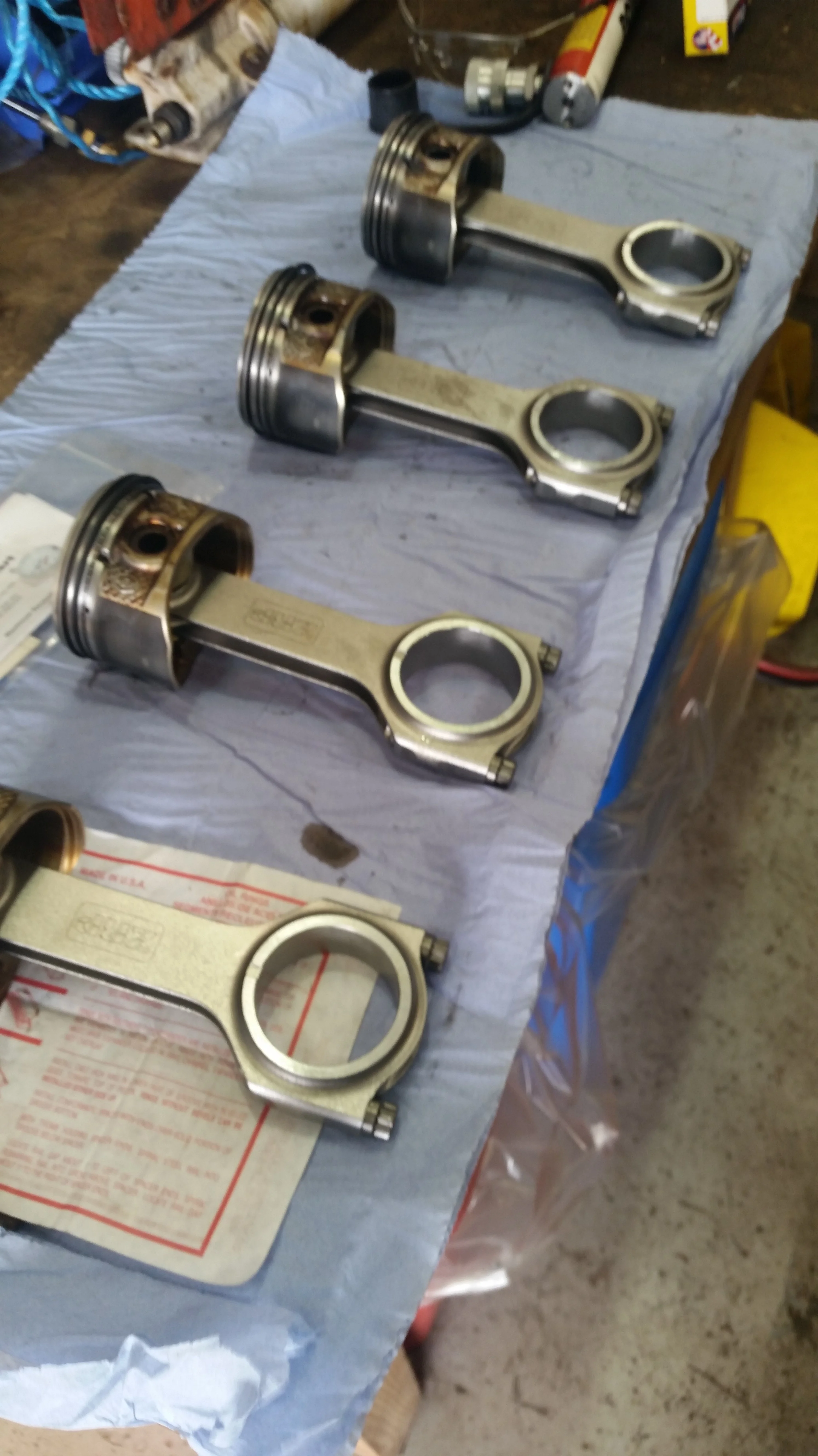

Started rebuilding the block new piston rings and put on forged conrods on my megane pistons so will be able to safely hit 300bhp without worrying about my rods bending.
All that I need to do is order vacuum pipe for the bov and gauges etc... and find a yard to use for engine replacement etc...

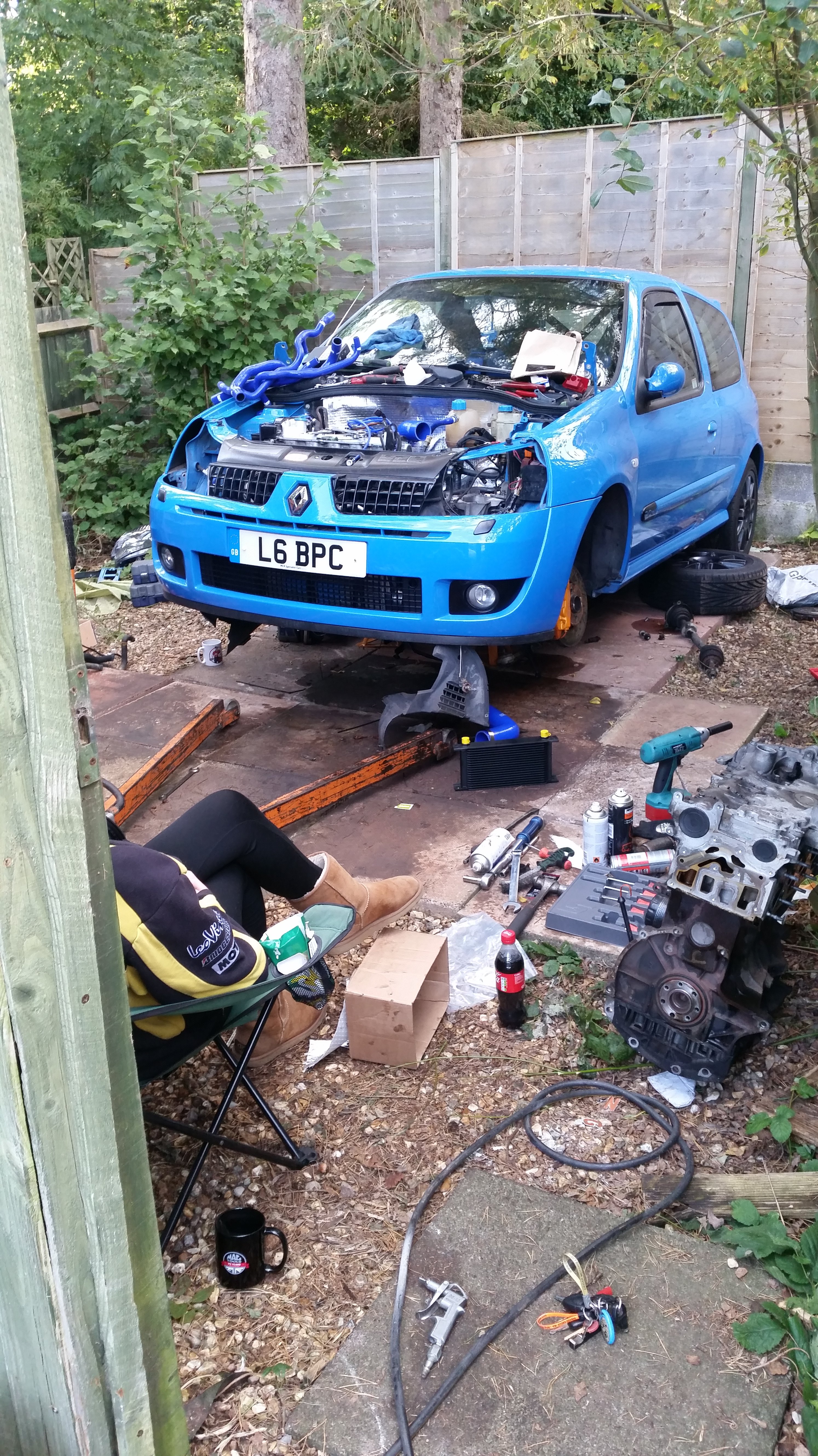

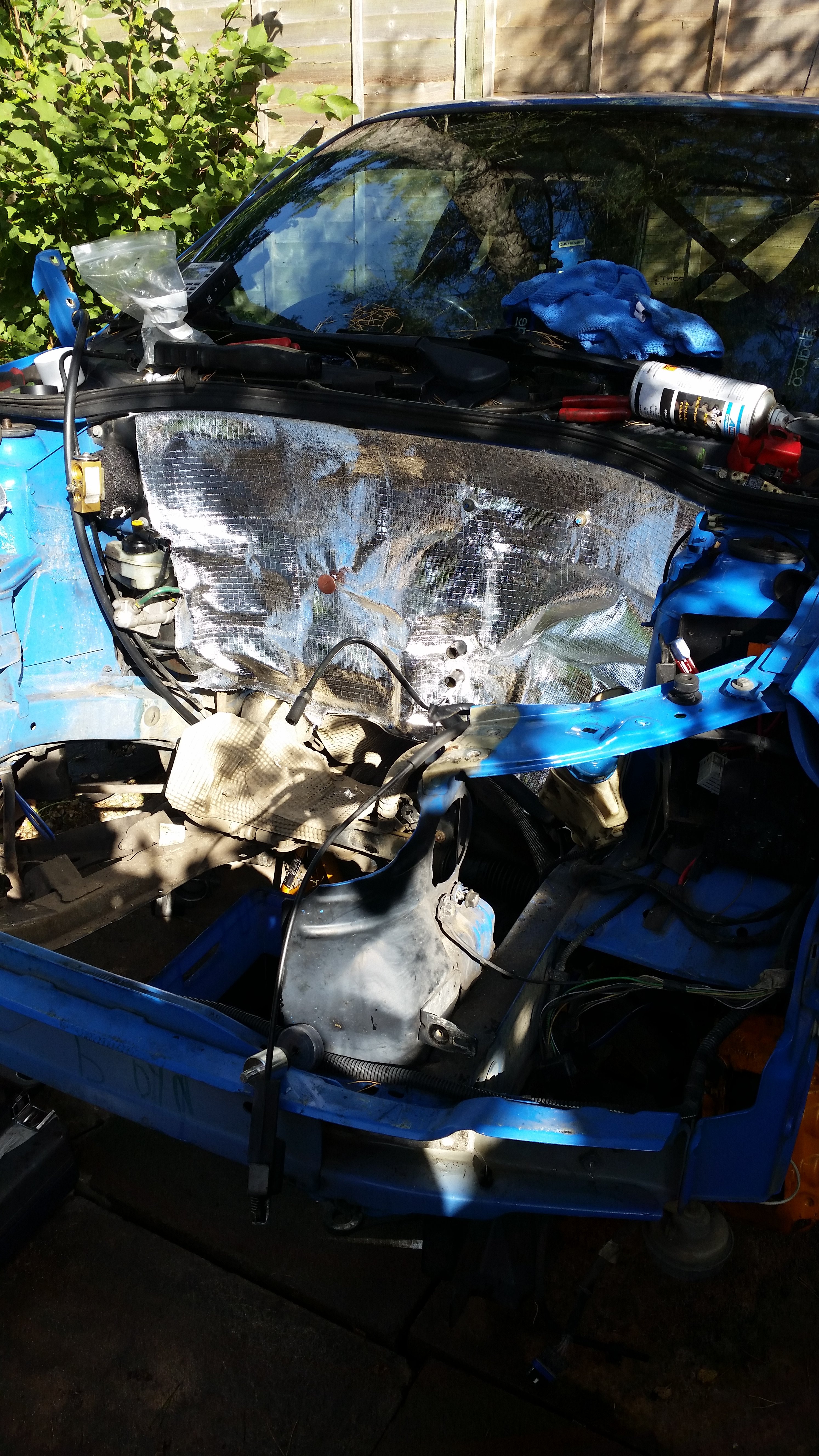

SO i am starting stripping the car down tonight ready for engine to be taken out and replace it with the new turbo lump!
im so excited but on the other hand nervous aswell!!!

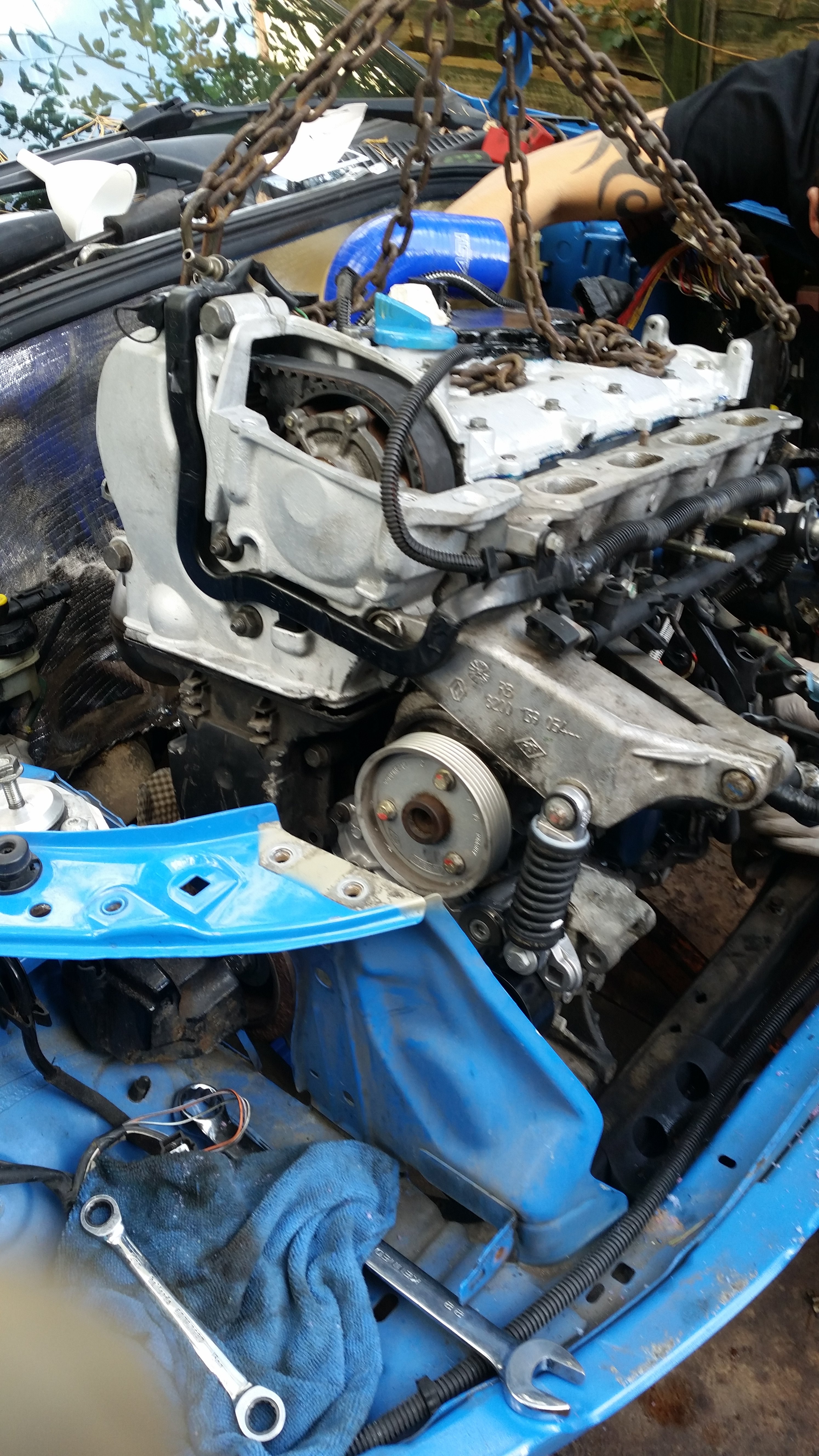

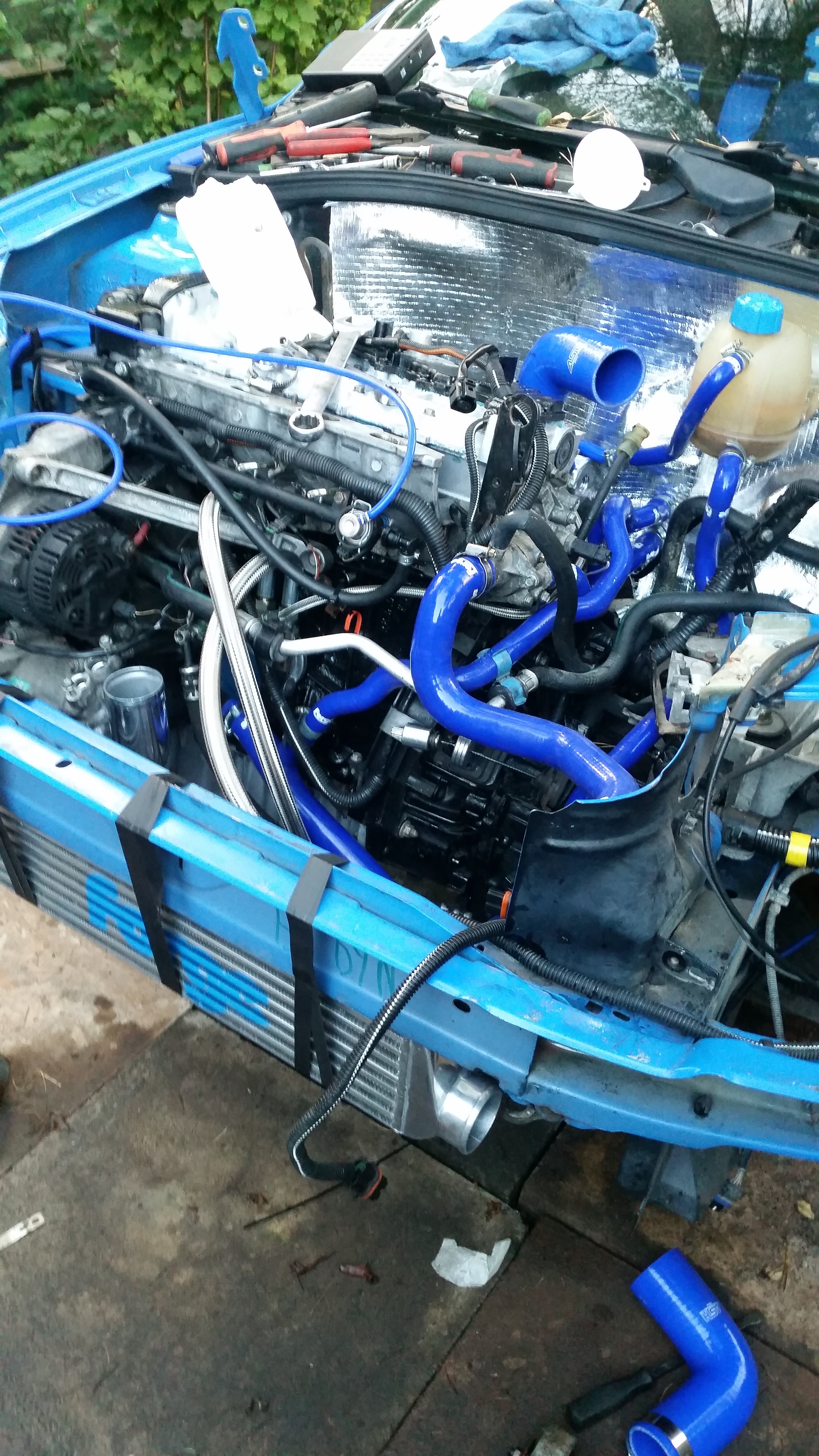

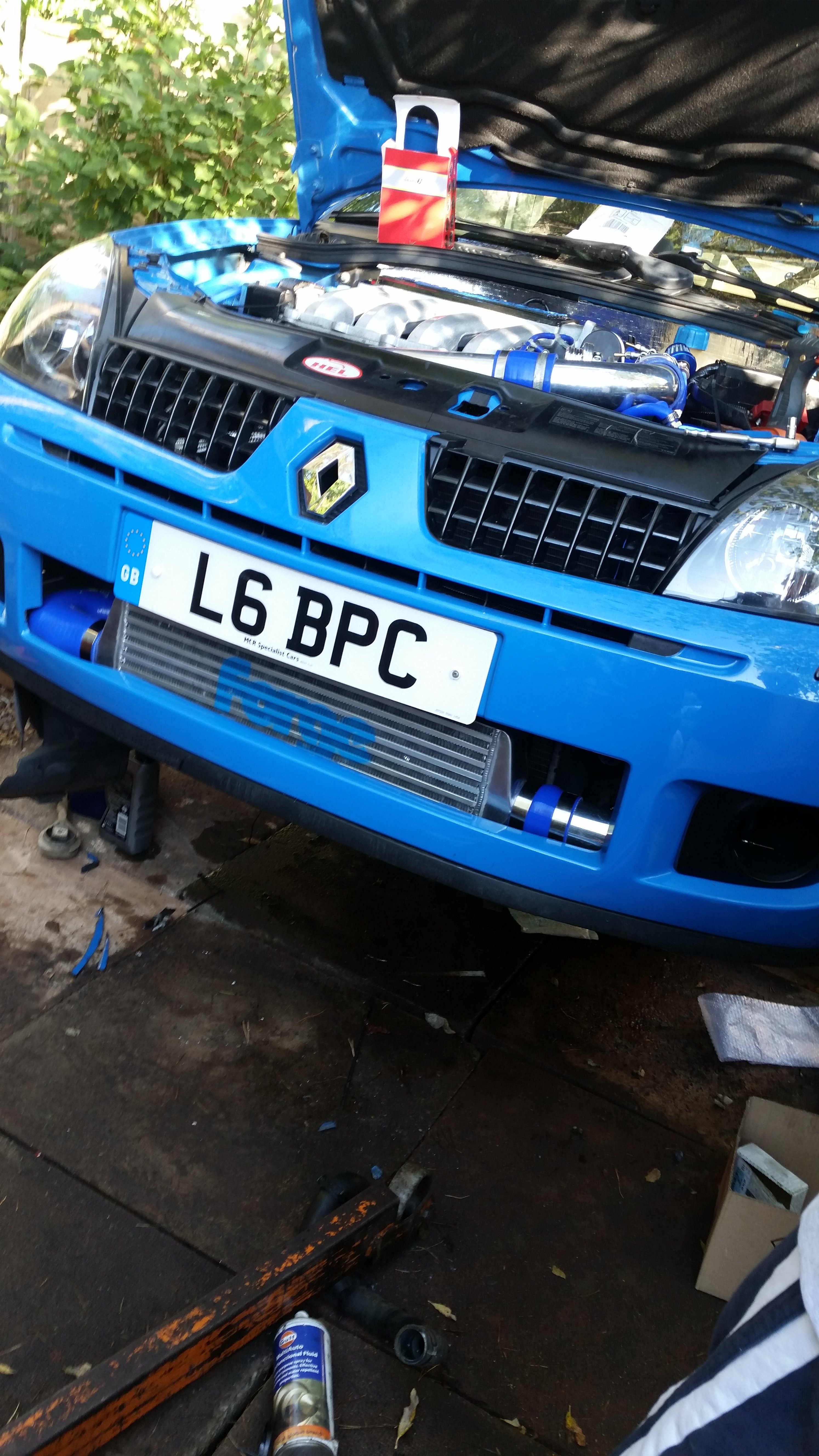

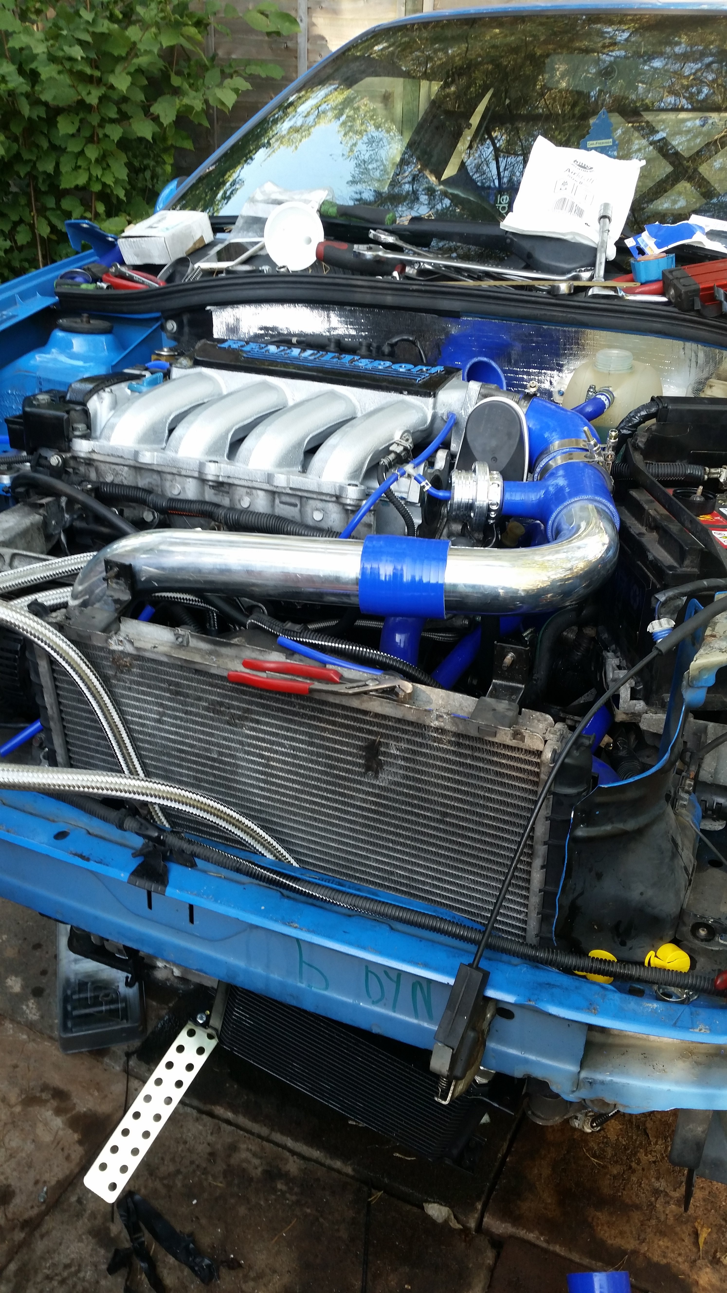

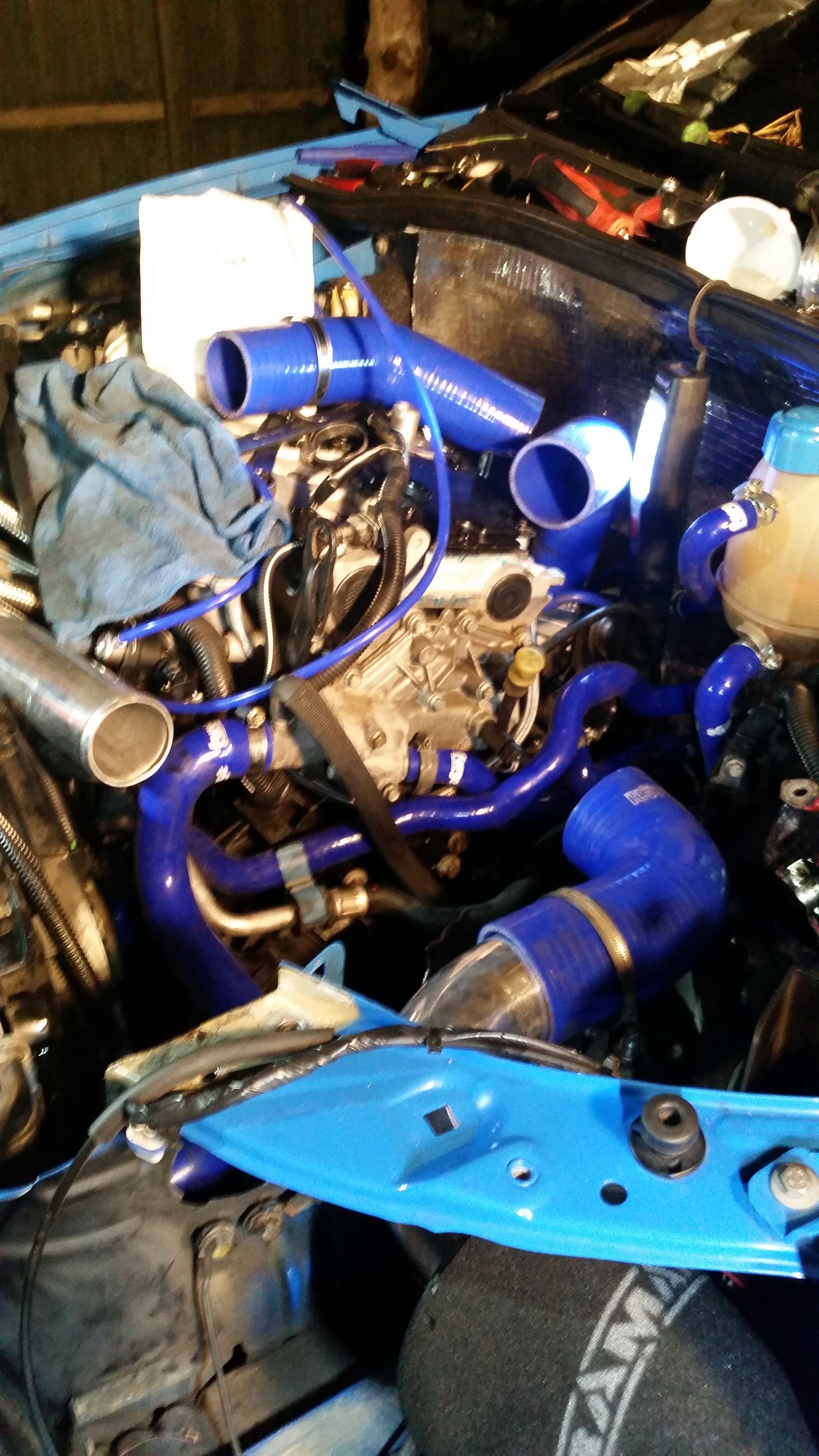

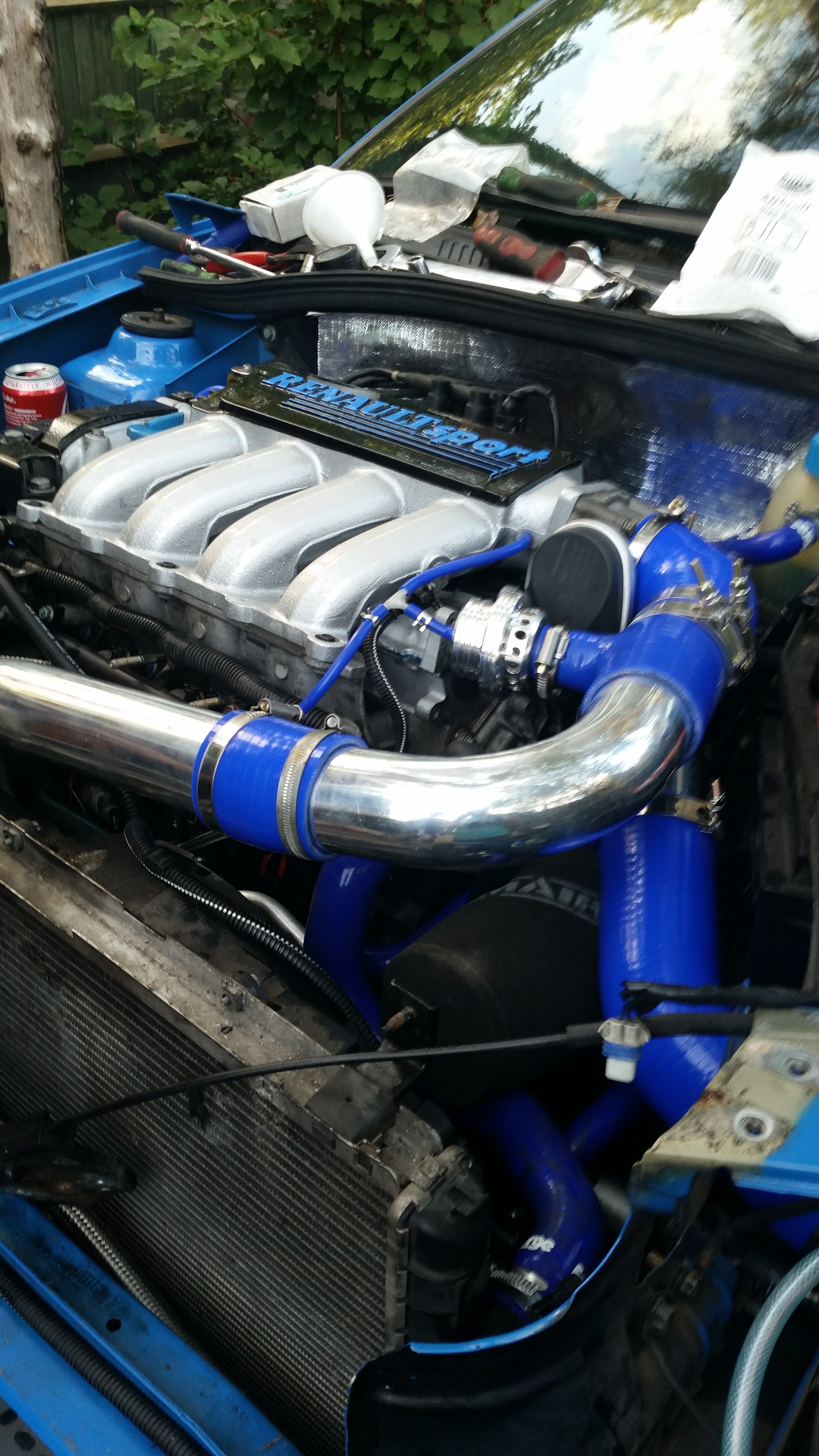

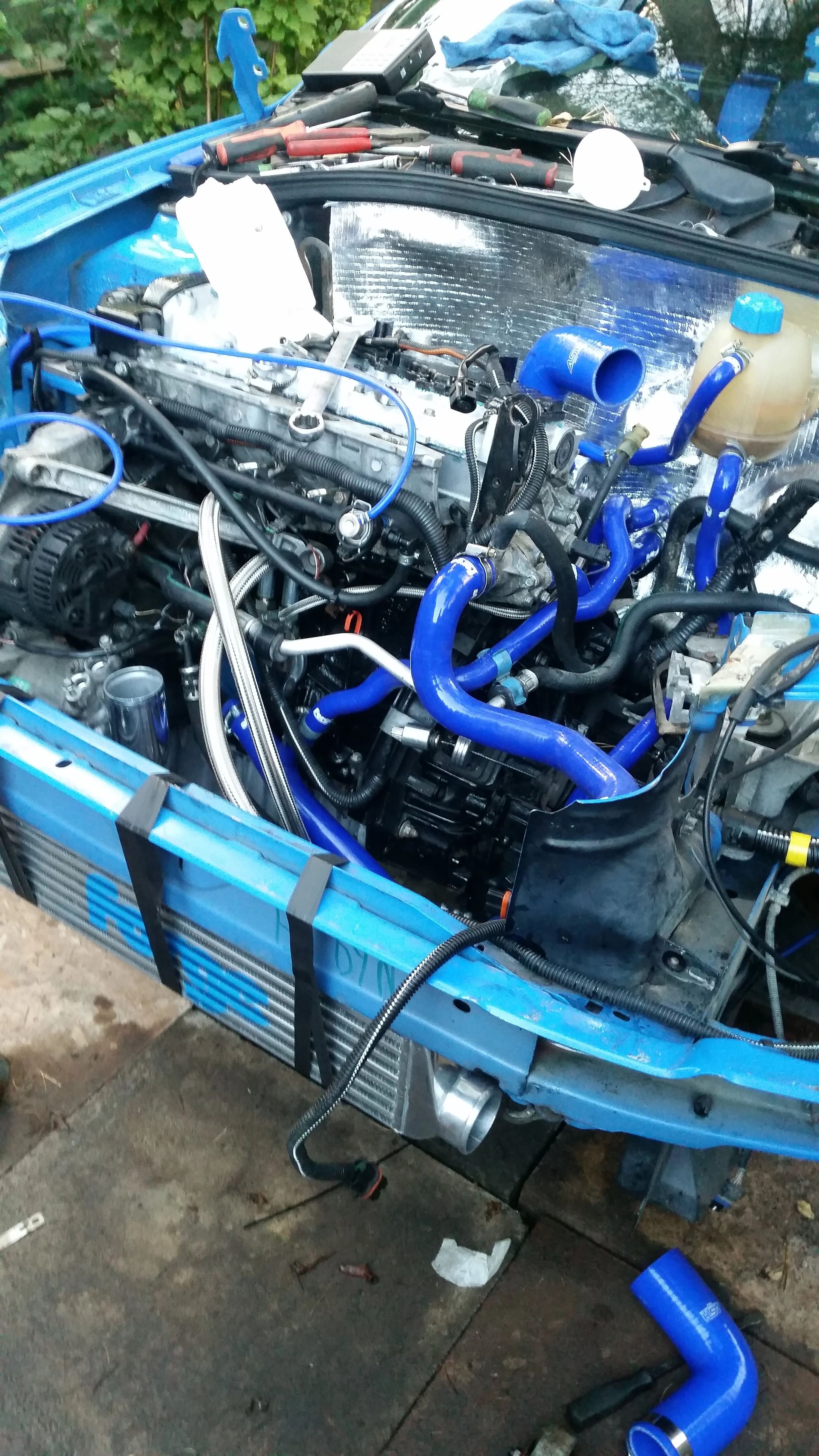

So this weekend. The engine is in and it is alive - few issues tho.
Forge silicone hoses the heater matrix pipe leaks at the joiner - the diameter of the pipe is way to big so I guess this is popular? But I have contsct forge for this....
The link pipe supplied by ktec doesn't fit properly it has pushed mu exhaust against the floor and it was near enough impossible to fit it -
Had to remove the wheel arch liner as there boost pipes were in the way... which was a strange one
The last one of all ktec had said to me I could run 630cc injectors on the base map but the car is over fuelling massively - it kept cutting out as soon as I went to change into 2nd after throttle - checked the spark plugs and they are covered in black - the black smoke was unbelievable when first drove it so I have sent a complaint to ktec - I feel ktec havent been helpful at all at stages but I hope they sort this - I don't fancy chucking my yozza to make an exhaust fit as it fitted before and I love it and I feel if that has to be the option ktec should supply this as it is their product that has caused this.
Other than all this I'm really happy it's running hopefully I can sort the little things out.

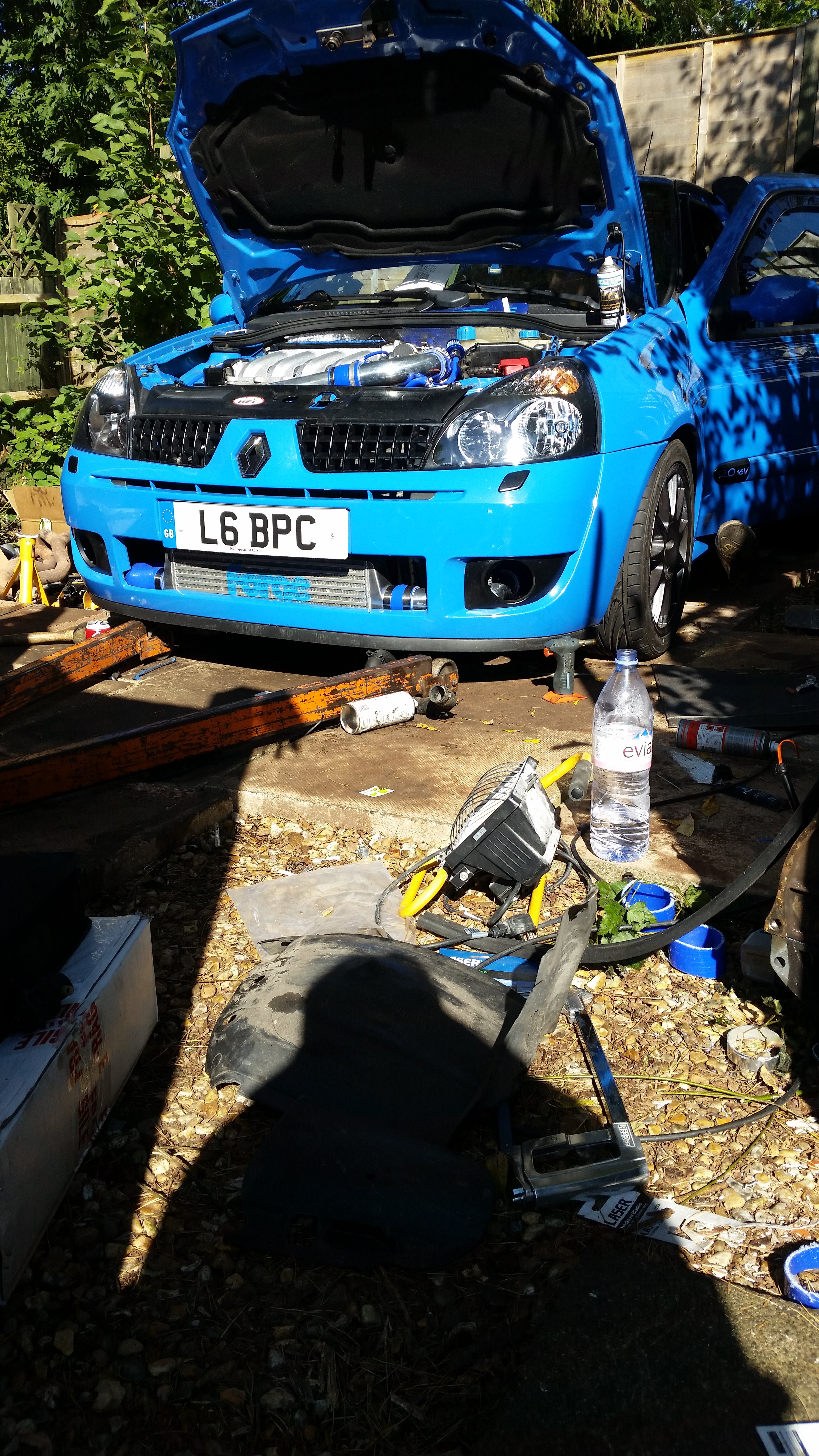

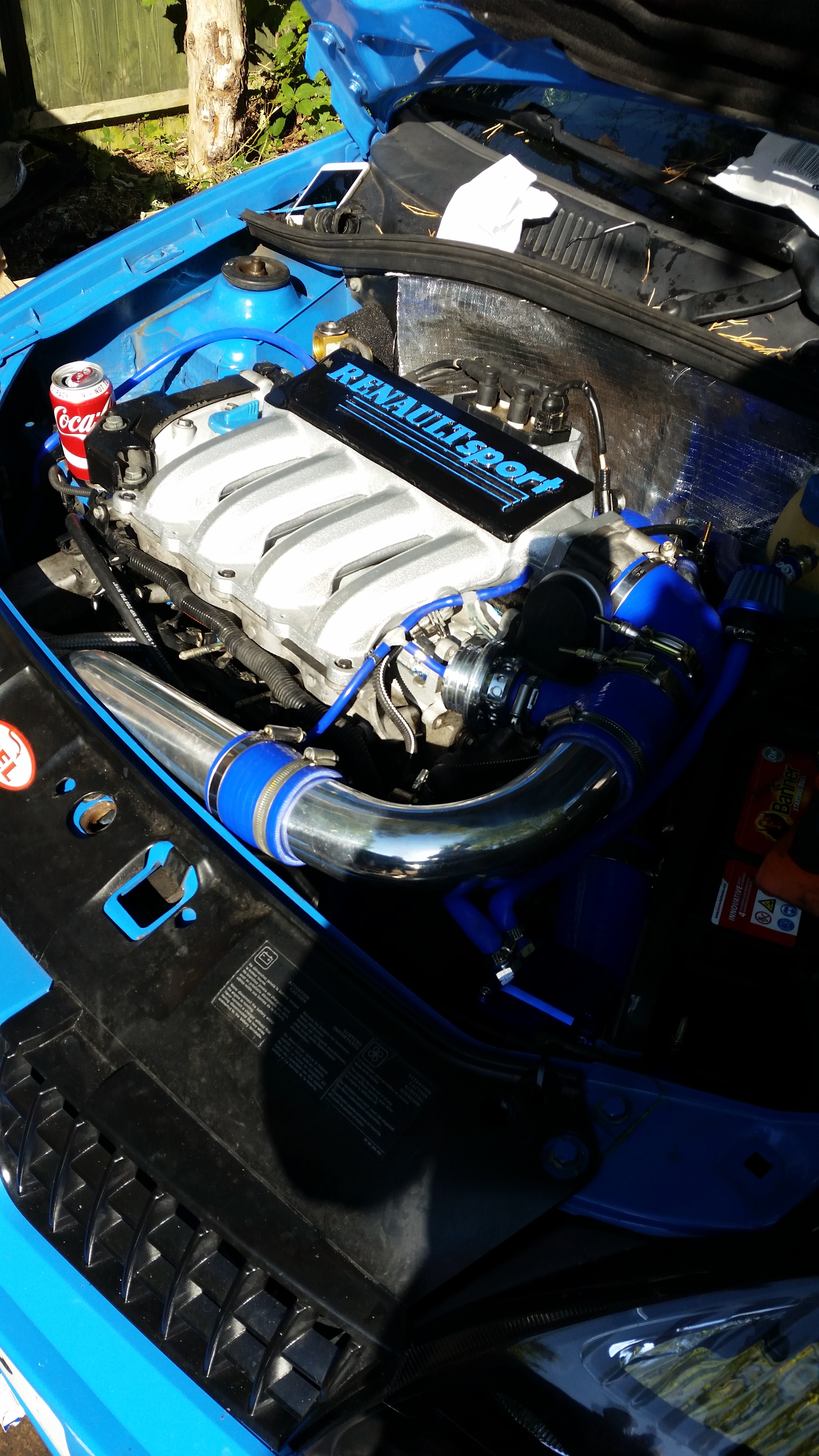

update - been a month now since the engine went in - standard injectors are in and have done about 500 miles now running the engine in on base map -
Exhaust blow is sorted but still vibrating against floor so abit annoying !
Oil pressure gauge now working and boost gauge but seems to be temperamental on what boost it reads - sometimes when started it will read -10 then turn it off and back on it'll read 0 and will work when driving.... thinking it maybe a dodgy vacuum hose so I've ordered new hosing.
Niggles to sort:
Oil leak from temporary oil return pipe (ordered new pipe)
Oil leak from either sandwich plate for cooler or the sump but need to see where it's coming from - (hope it's not sump as need to lower sub frame to get sump off.)
Mapping is booked for 4th November so only a week or so till I can really give it its first burst!!!
