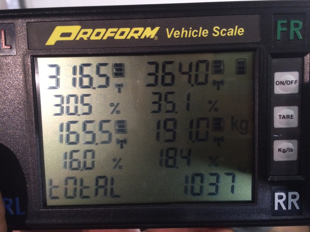

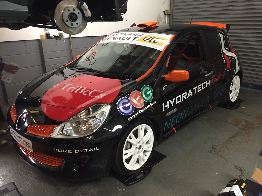

Took the plunge and purchased our own Laser tracking gauges and wireless corner weight scales.
Setup the clio suspension on our own for the first time before oulton for a test.
weighed the clio at 1037KG with half a tank of fuel so not bad with the turbo engine in there. corner weighted it best we could for now
Finally time for a dry trackday did oulton park on the 11th of November to try and test handling brakes and new power. car certainly goes very well now and is fast enough with the power to weight! It really needs a diff putting in now so will decide on that over winter.

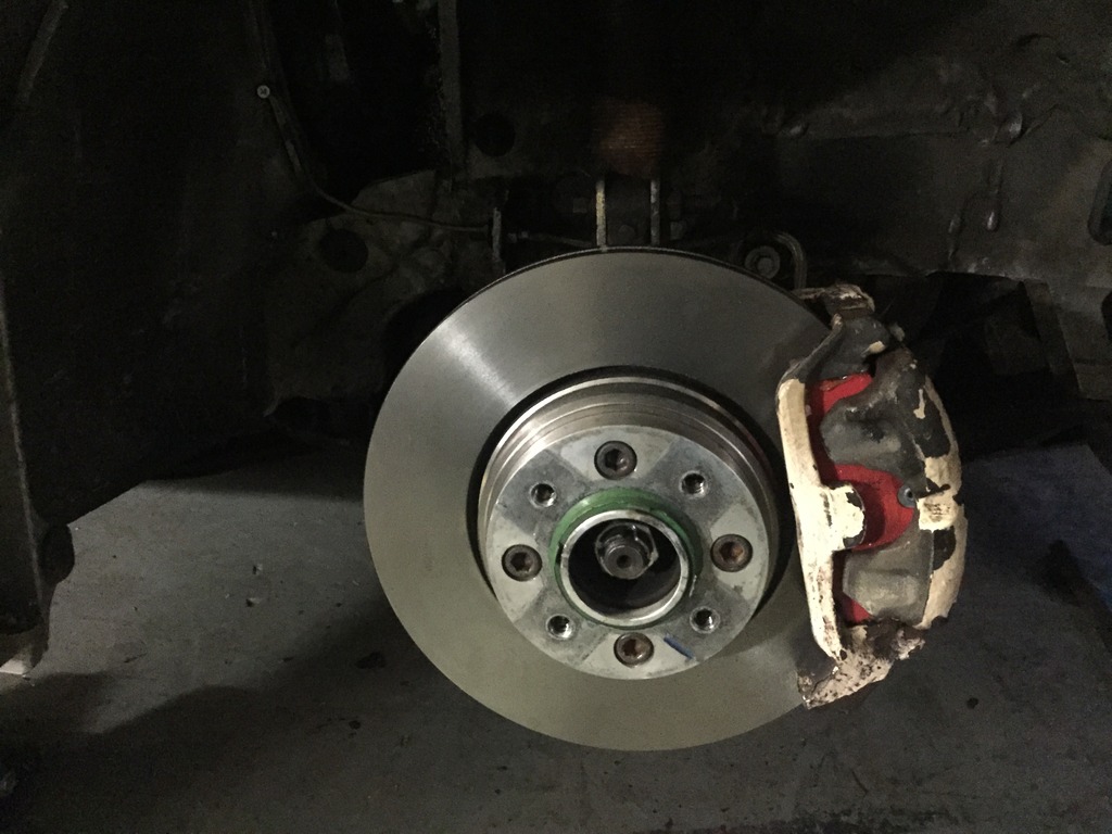

Brakes again weren't on the ball. after speaking to my brake man we are going to try a set of new calipers mine are 10 years old now. More importantly he's help me diagnose we don't have a one way valve in the servo so could be pressureing the brake servo! hopefully this is why the brakes aren't up to much with any luck!

going to change the calipers tonight and fit the one way valve before Friday hopefully sort it out, will let you know

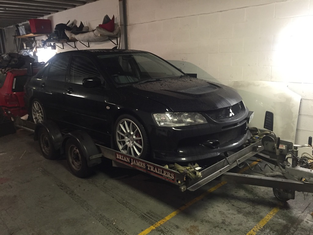

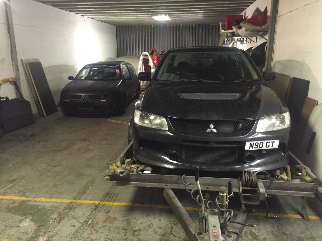

That's it for this year, car is now in the unit and has been swapped off the trailer with the other reason I don't have a big budget for this car, Low mile Evo 9 GT

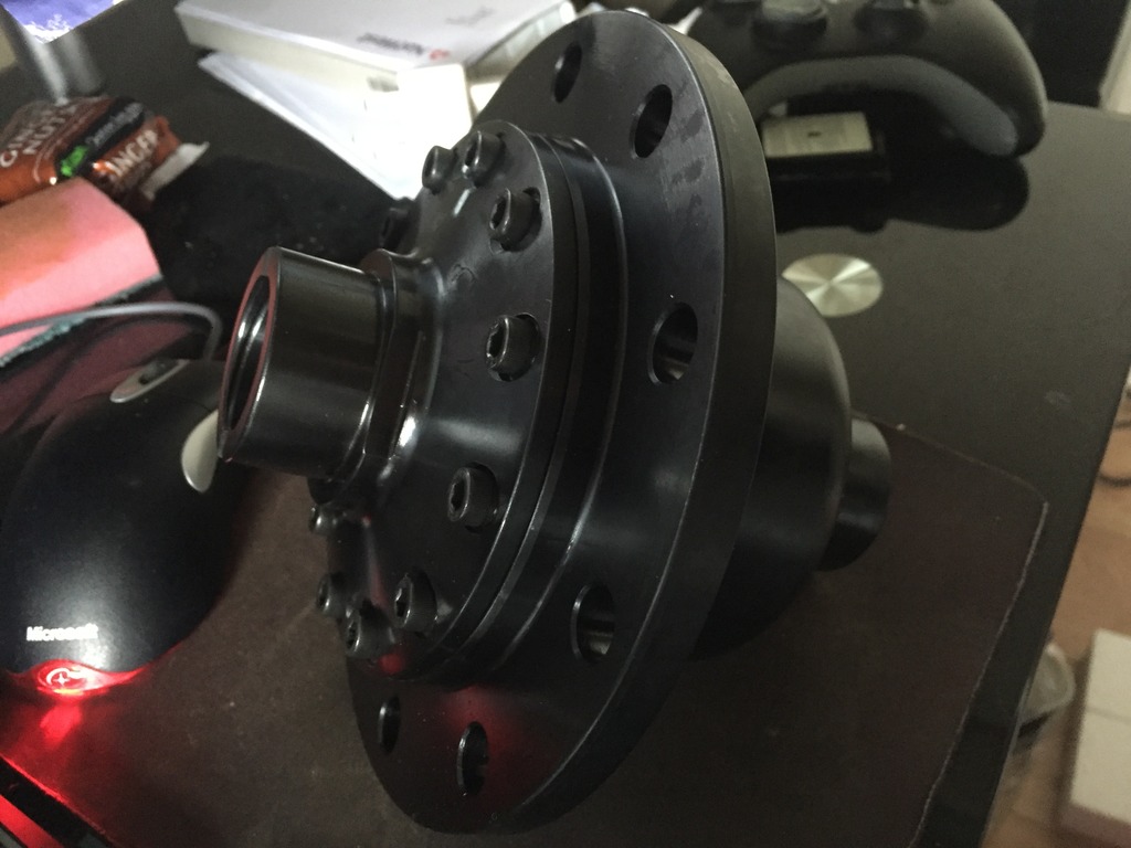

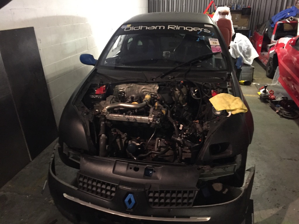

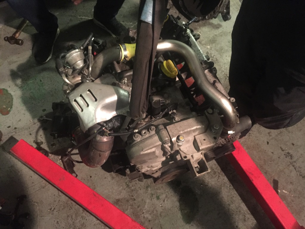

Engine box coming out of the clio to have a gripper diff fitted and a full weld in roll cage is being fitted and a good general check from the past year, apart from some handling/braking issues the car has done better than expected!

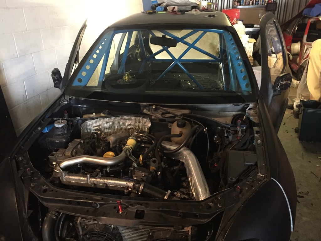

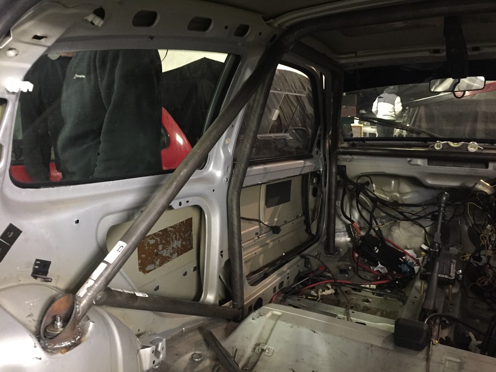

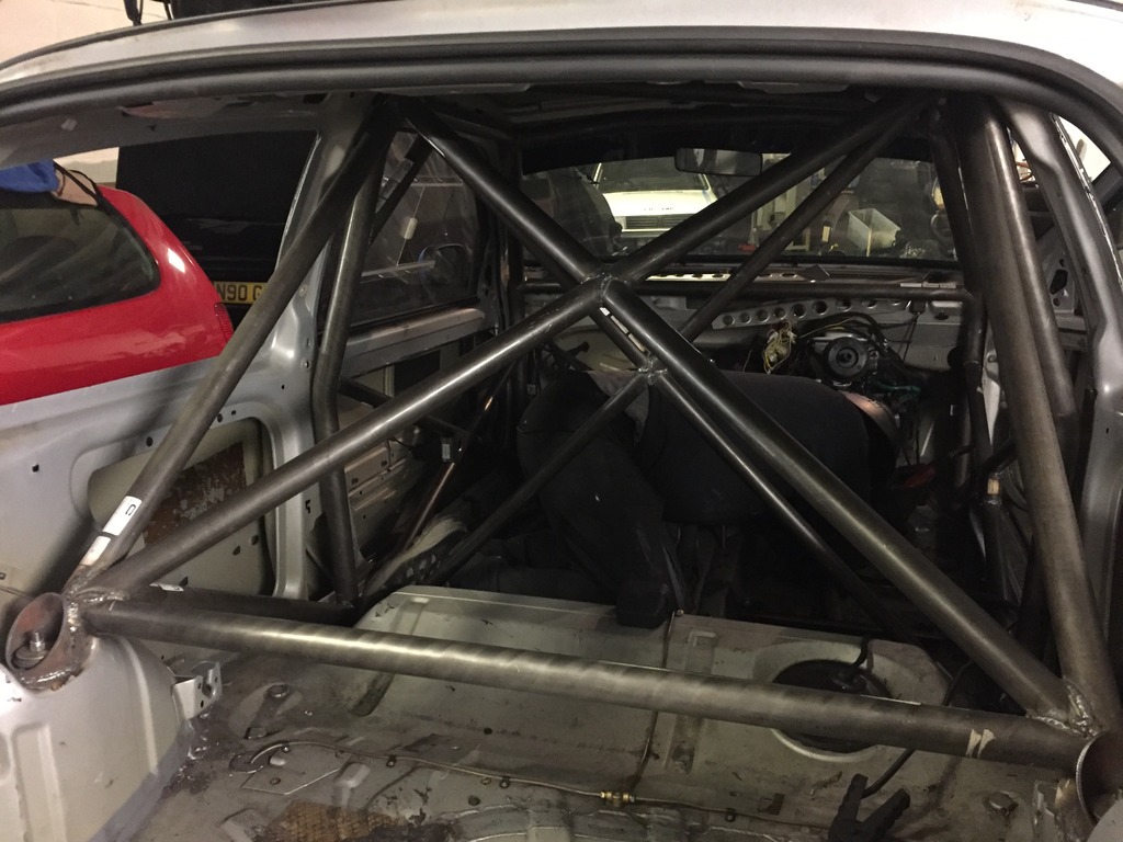

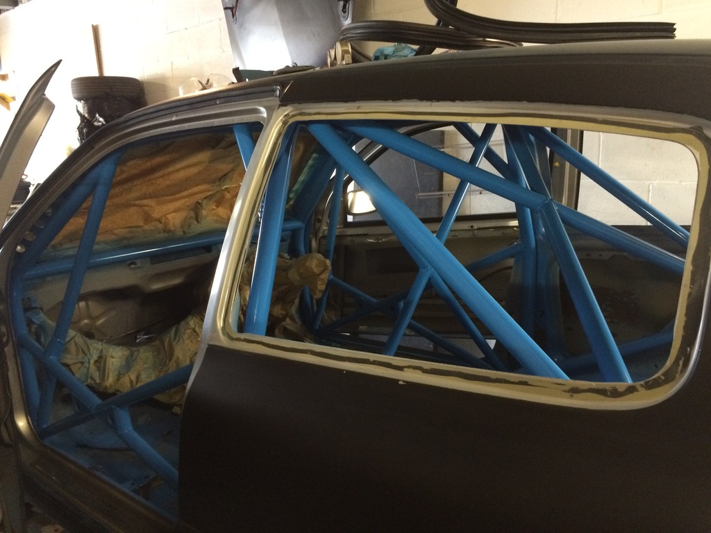

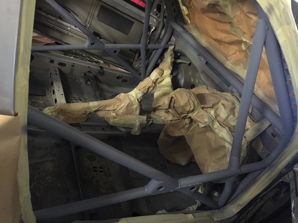

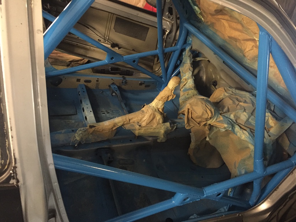

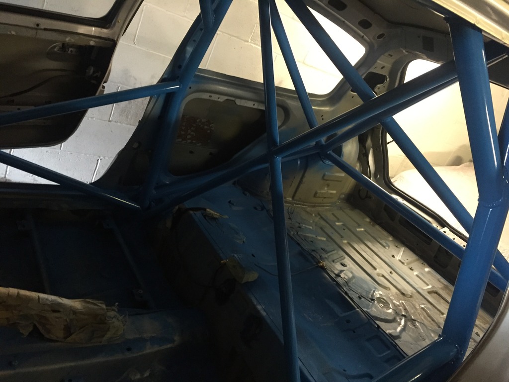

winter update:

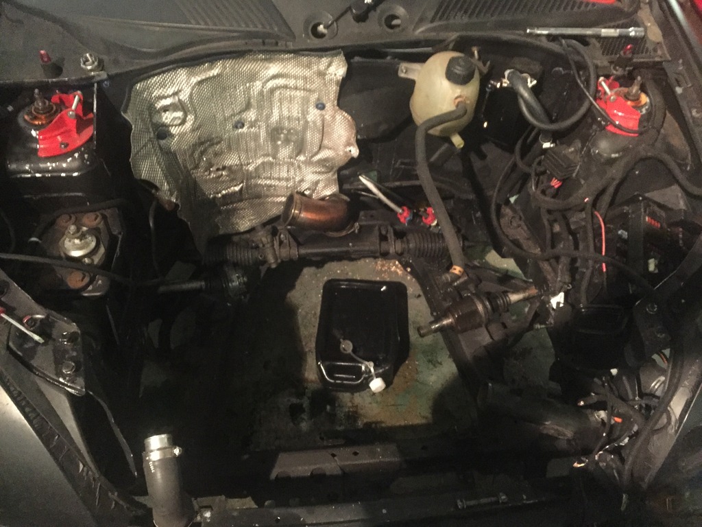

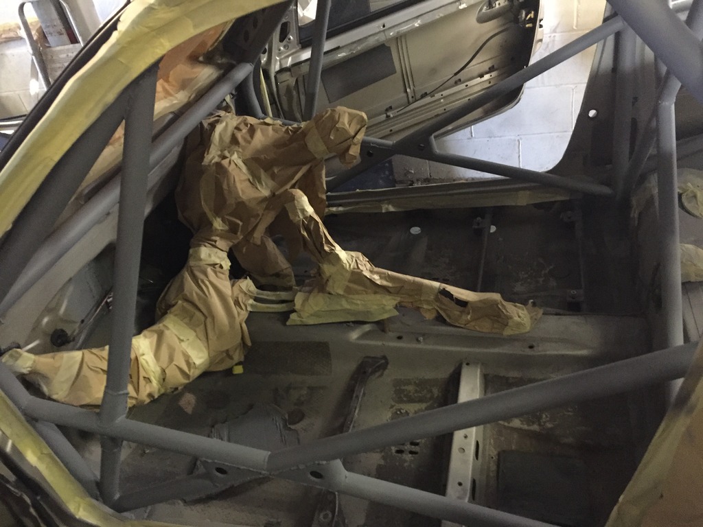

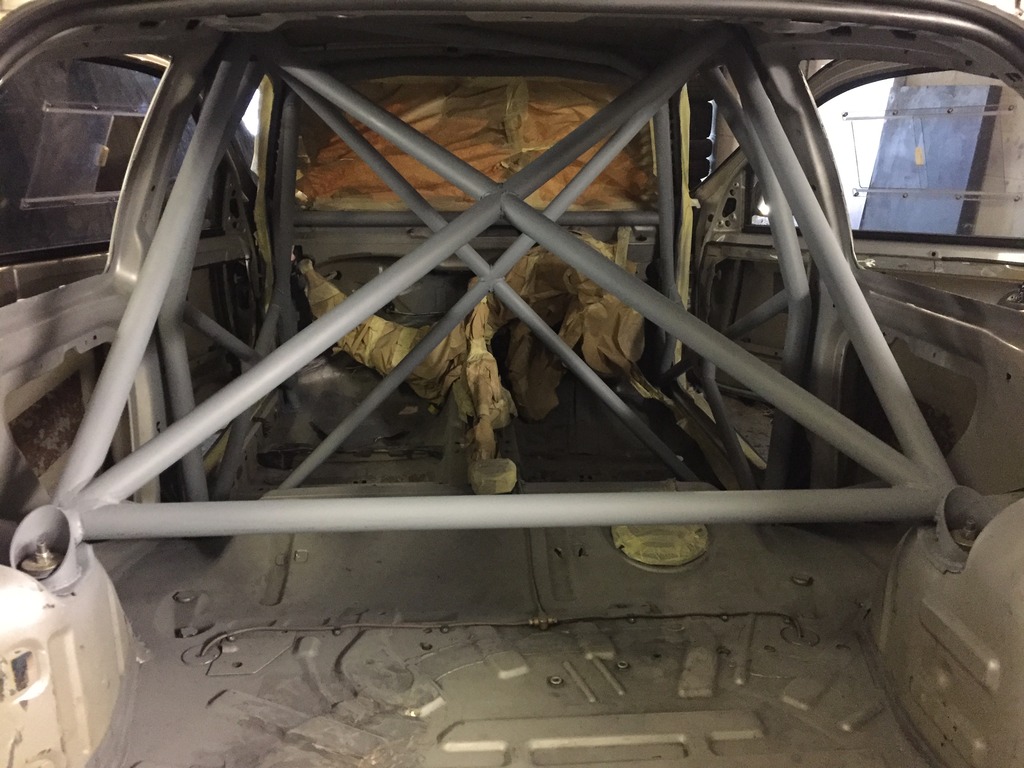

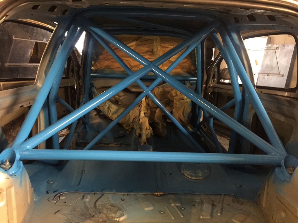

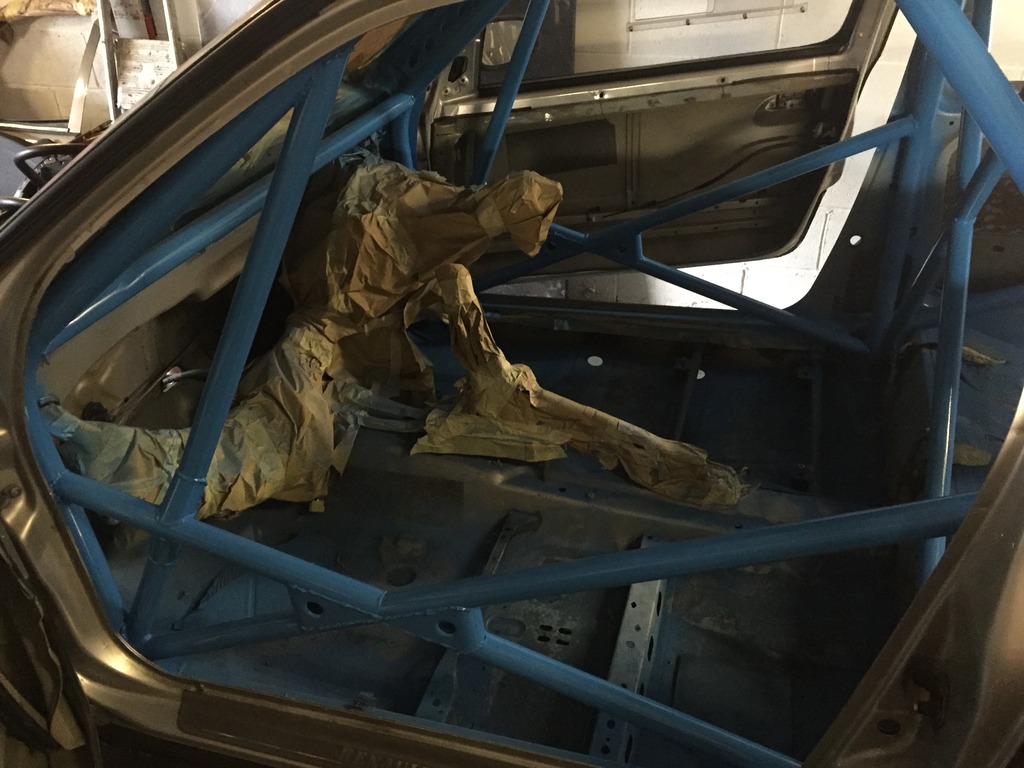

over the winter we have removed engine and box to fit a gripper diff and give it all a check over after a year of track use. one of the rear engine mounts we have used has started to give in a bit so will be uprating that a bit and a CV boot has given in. but apart from that Gripper diff is in place in the gearbox and about to be all put back together next week

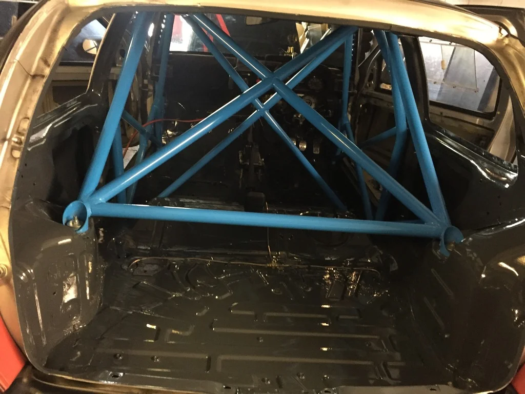

We have also stripped the full car and fitted the roll cage, mammoth job and big thanks to Mr H for spending every Tuesday in the clio welding! a few more bits to finish off but 95%in and welded in!
going to give it a quick freshen up inside and start bolting it all back together. hopefully back out in march some time

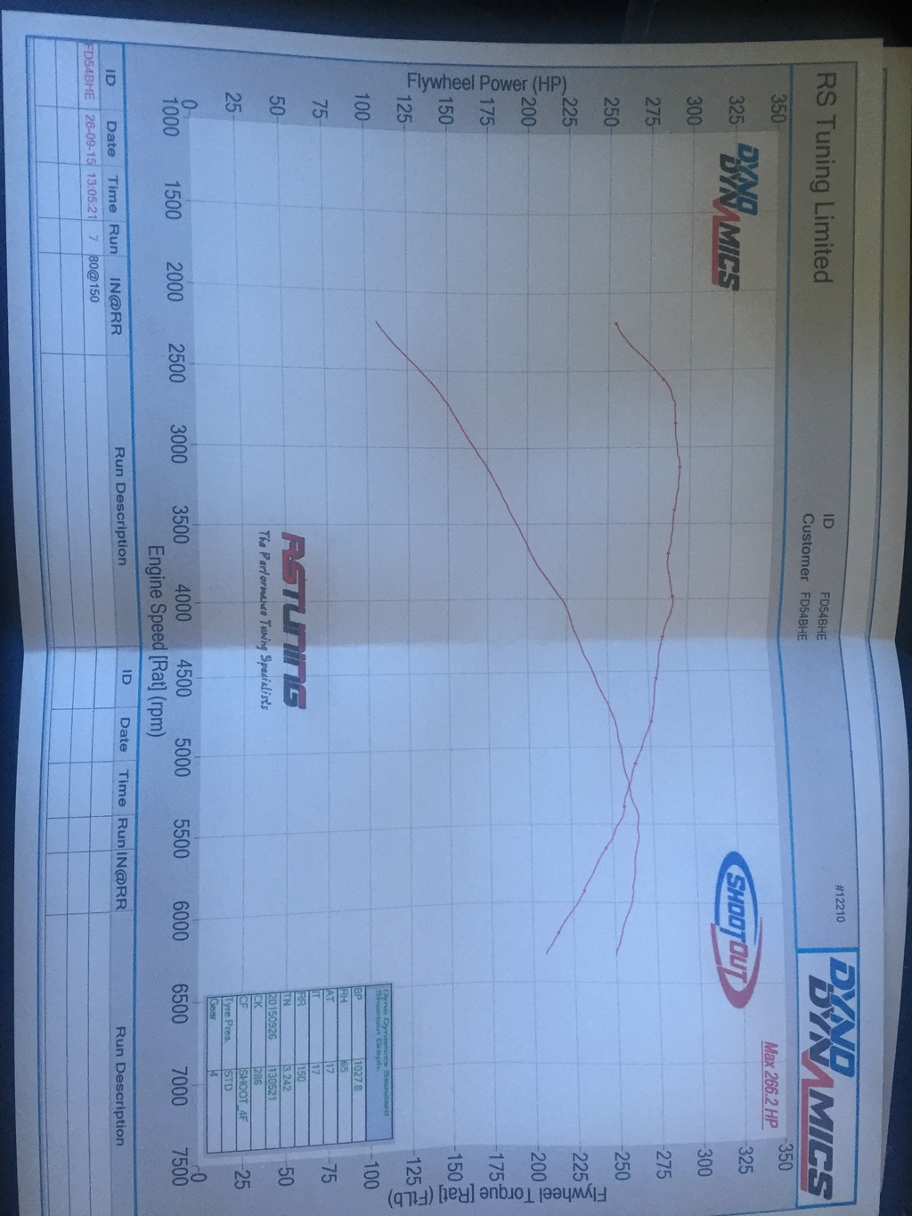

Car is also booked in to have a remap at RS Tuning on the 26th of September, not sure what sort of power levels it will rise too but we shall see!

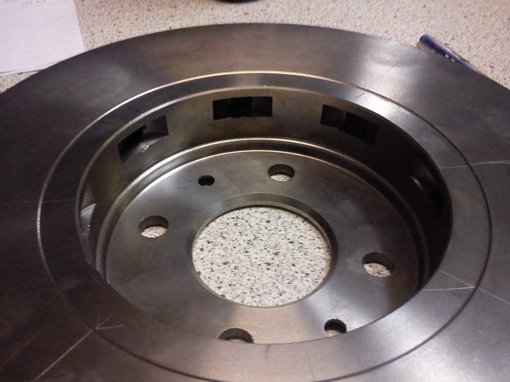

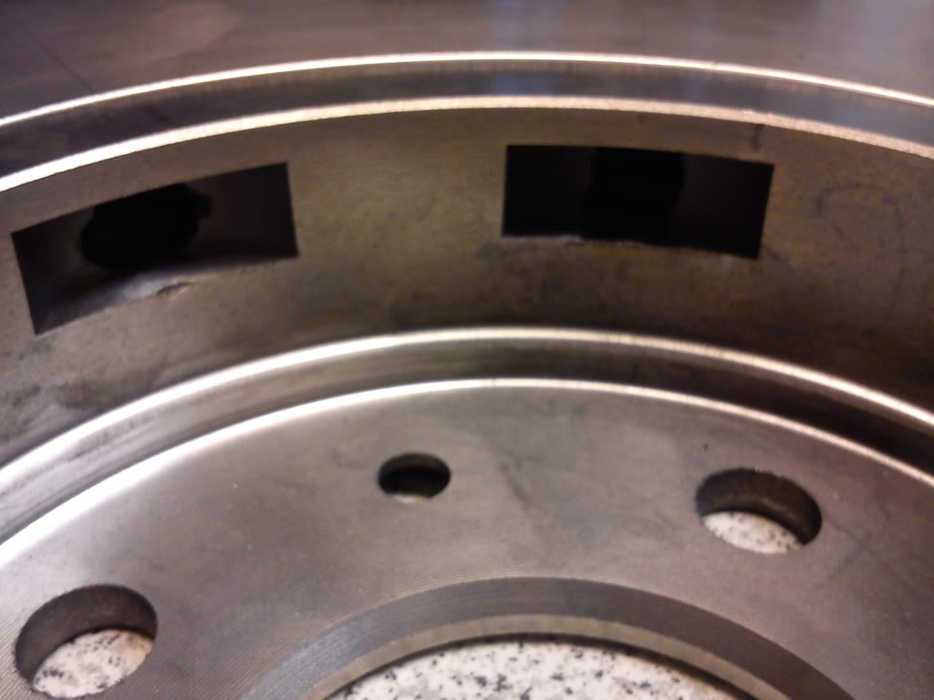

the 280 disks has cooling from the outside and thats no good, so we did this.. never faded the brakes but pads has been so warm that the springs on the pads lost tension

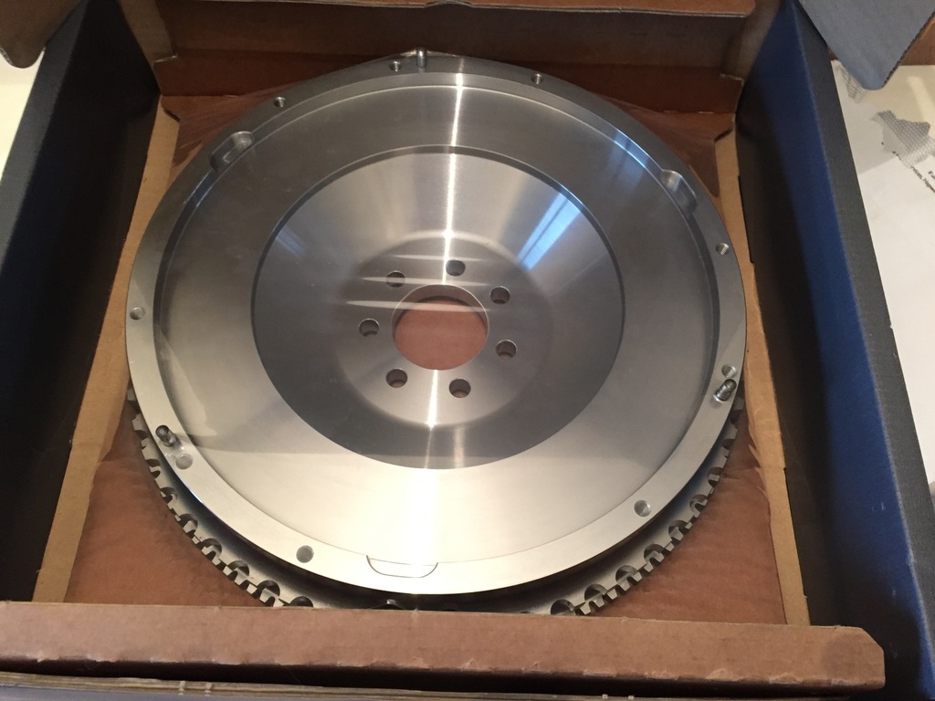

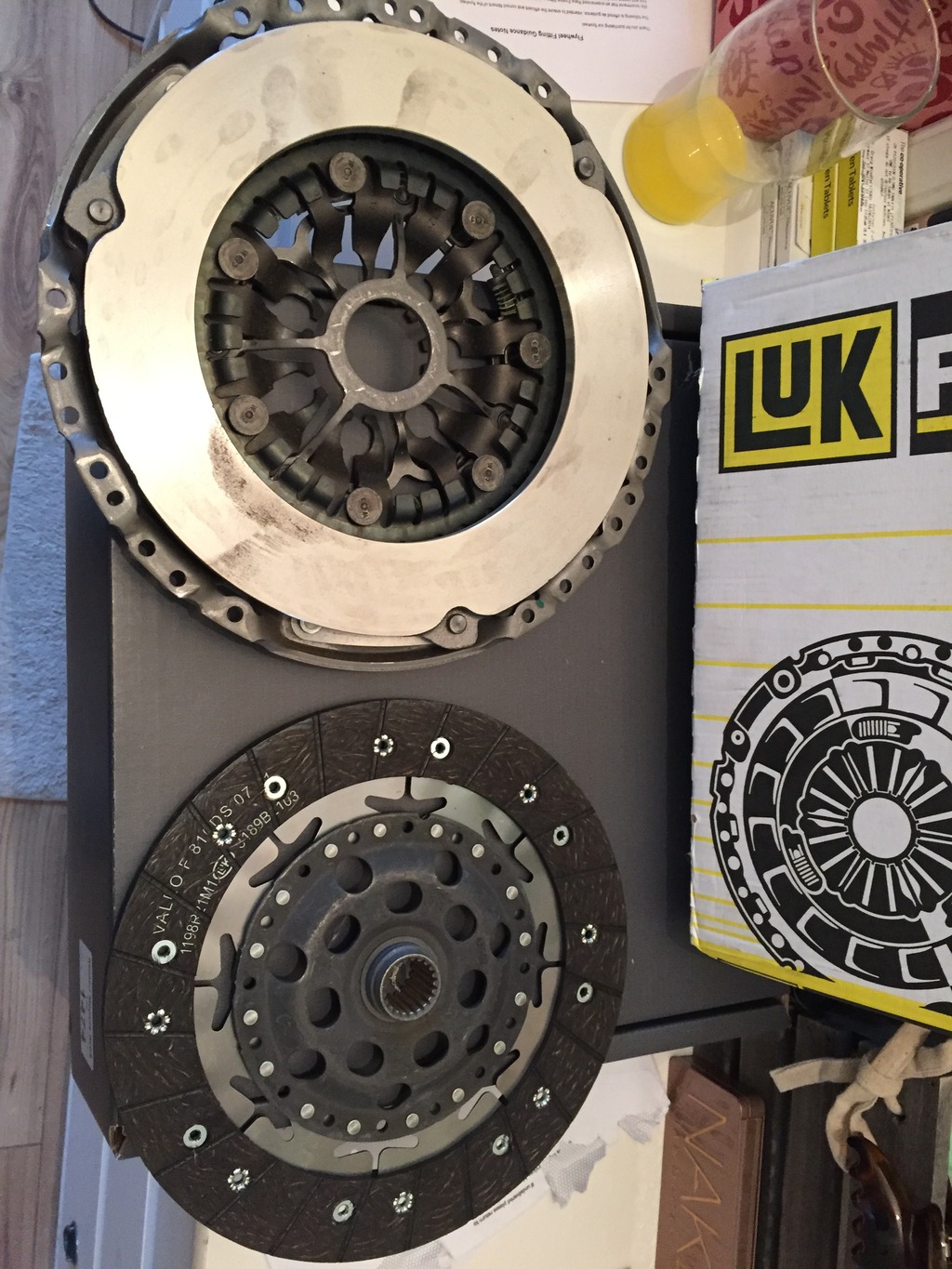

hope to get it back together next week, cage is finished just needs a good painting inside. awaiting a single mass flywheel clutch then engines back in.

clutch has just arrived I think, shall unpack and check. That will be fitted probably next Tuesday now

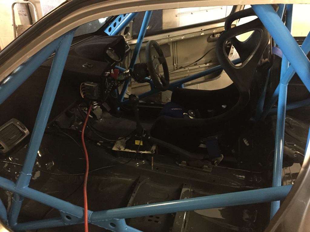

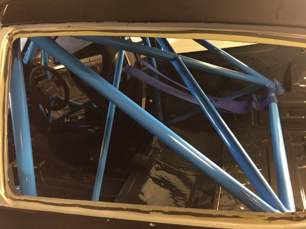

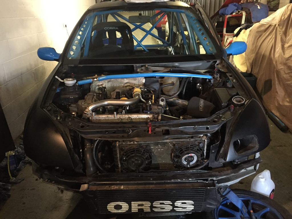

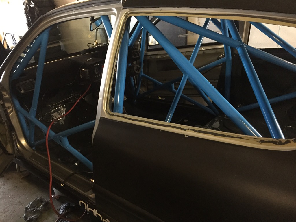

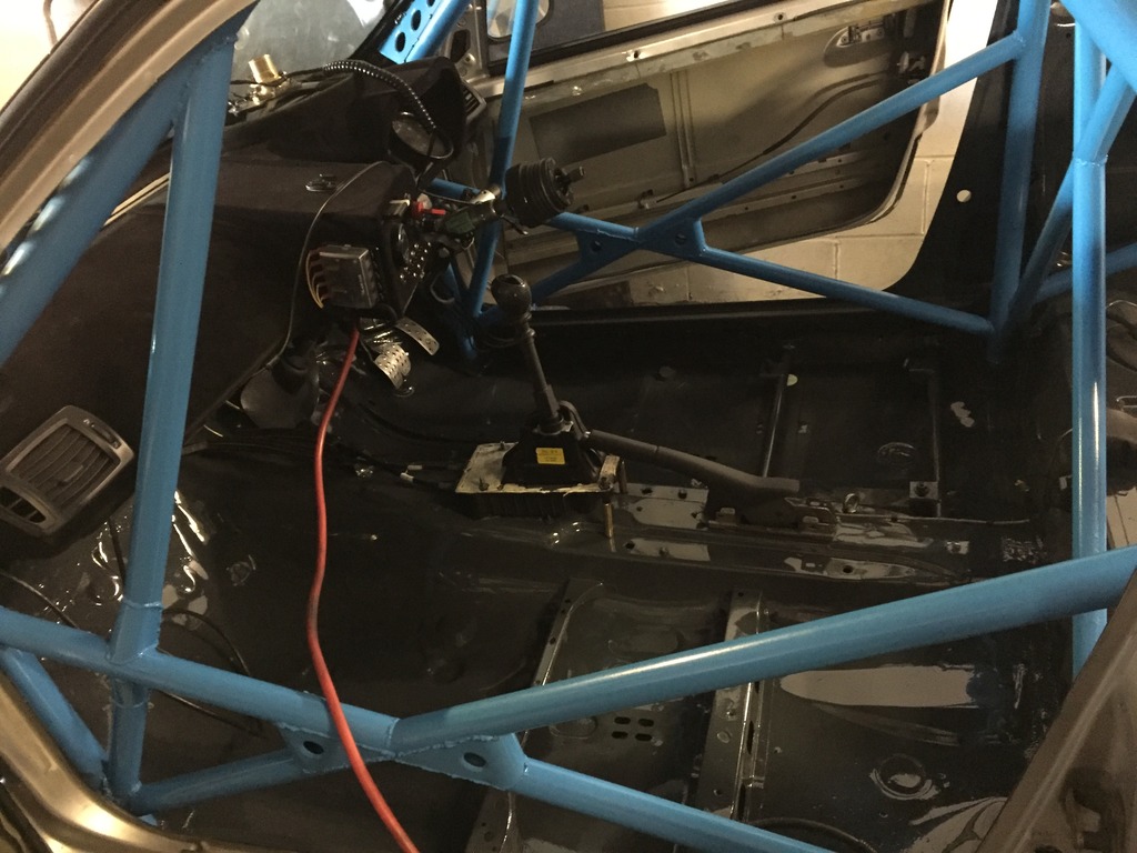

Engine is fitted again and running once again, now has single mass R26R flywheel/clutch setup and a Gripper diff so looking forward to testing that.
Cage is done all in and painted up seat/harness fitted just a few more bits to finish off and she's ready. Car is painted a non metallic Anthracite and the cage is our oldham ringer blue t o match the rest of the car.
think some brembos will be going on too.
some pics
This looks awesome, something I will be attempting in mine this year I think but not 100% thats the direction I'm gonna go for yet.
What pedal box are you using?
And is the interior loom completely custom now? so just the Megane ecu running the engine?
As these are the bits I'm unsure of currently
windle
  Evo 9 Gt, 182 Toy
pedal box is a mix of clio/megane welded together
loom the full clio one has gone, we now run full megane ECU UCH and a custom separate loom for the likes of indicators lights wipers etc
