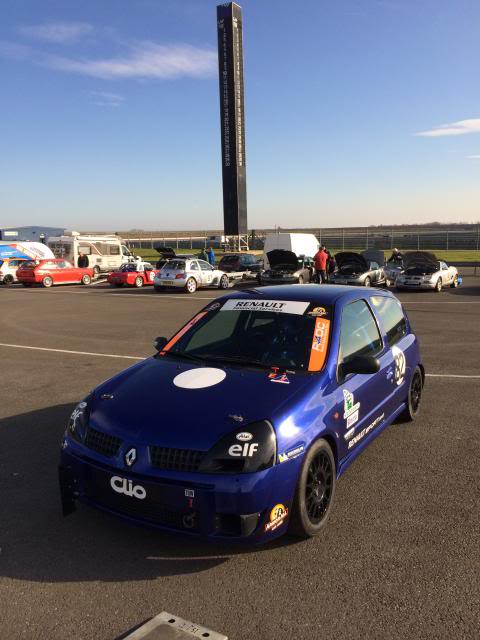

Had the car sent over to Mark Fish for a check over and a few minor details seen to such as cambelt etc. I stripped and cleaned the suspension - a learning exercise for me having become used to the crazy set up on the Spider and not have much experience with FWD- and fitted in date belts and FIA fire extinguisher, try to fathom out the AIM data logger, searched for the transponder and eventually found it in the rh wheel arch. and, finally, got some track time at a Lydden track day in February. Another learning exercise then, how to drive FWD! Was out on my own for much of the early experienced sessions so did not realise how fast I was going until they let some other intermediate drivers cars out, M3's etc were being dispatched without even trying and was the quickest car out there until Liam Doran turned up in his Monster energy DS3. Was amazed at the brakes as the Spider has no brake servo so braking was a big effort but in the Clio the brakes were astounding but also noted high front tyre wear, infact killed a Michelin race tyre after just a couple of sessions, Whoops.
First race would be in April.

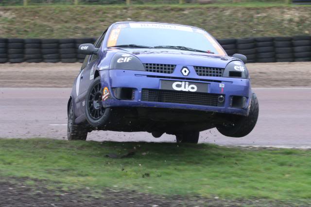

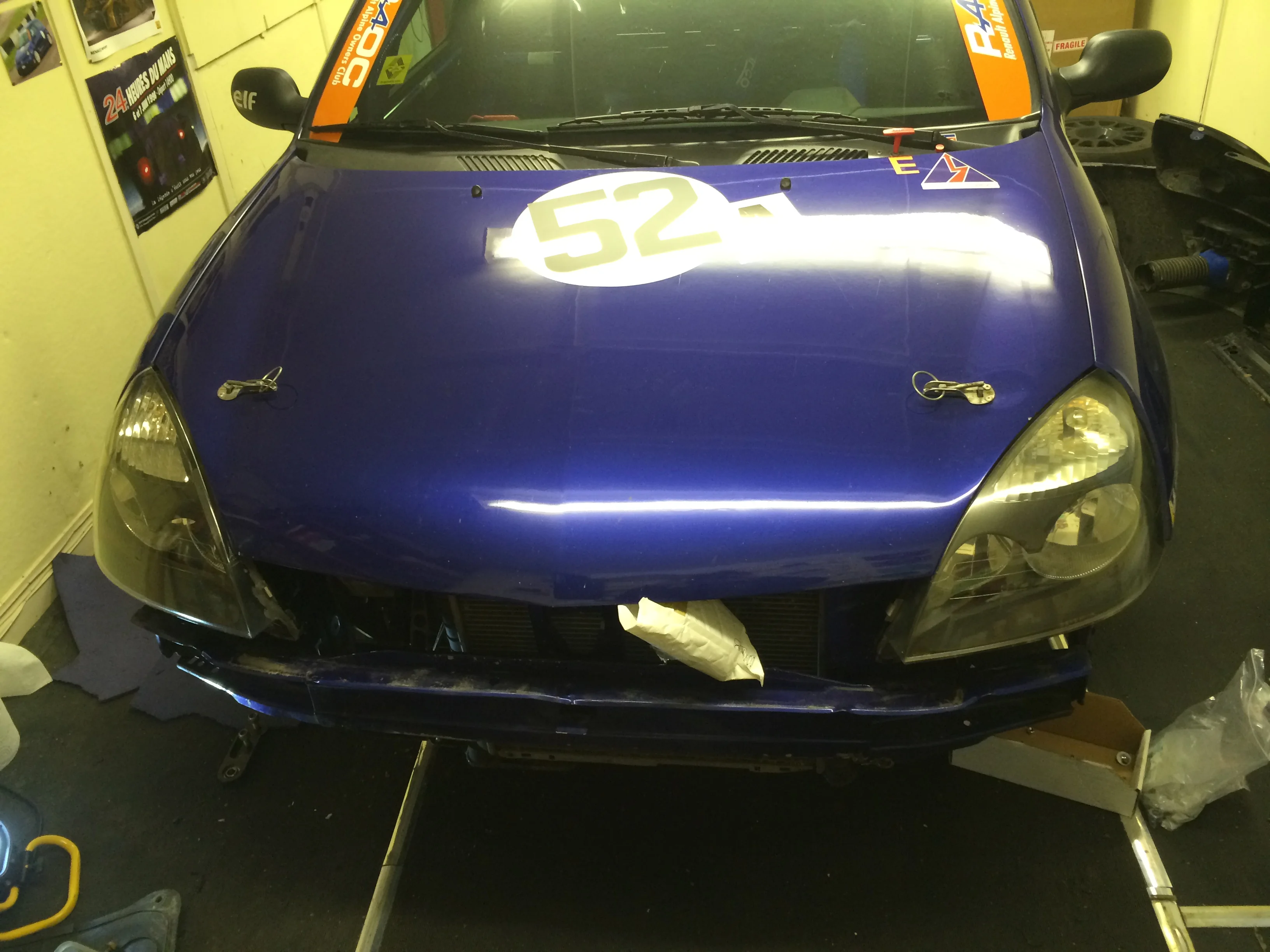

Surprisingly no damage done other than the deflector under the radiator, after a good strip down and checking of suspension he was out at Rockingham yesterday in the sprint:

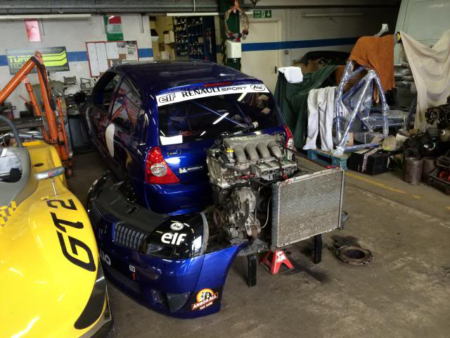

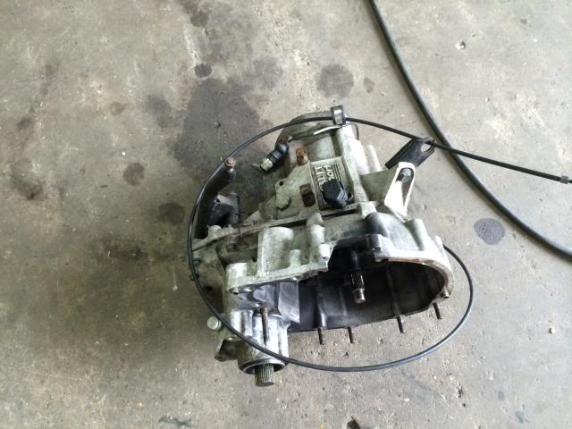

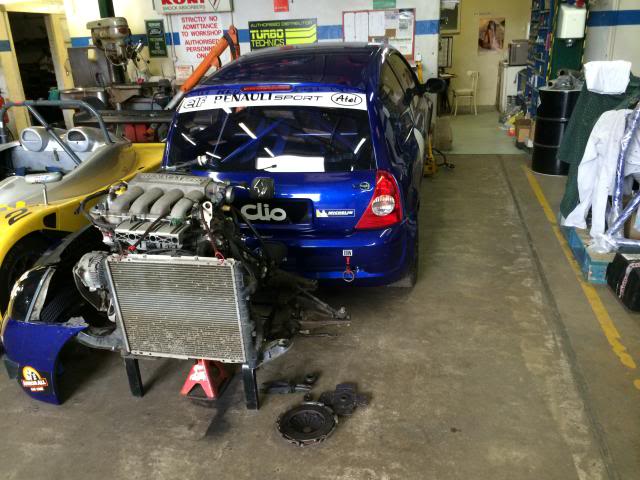

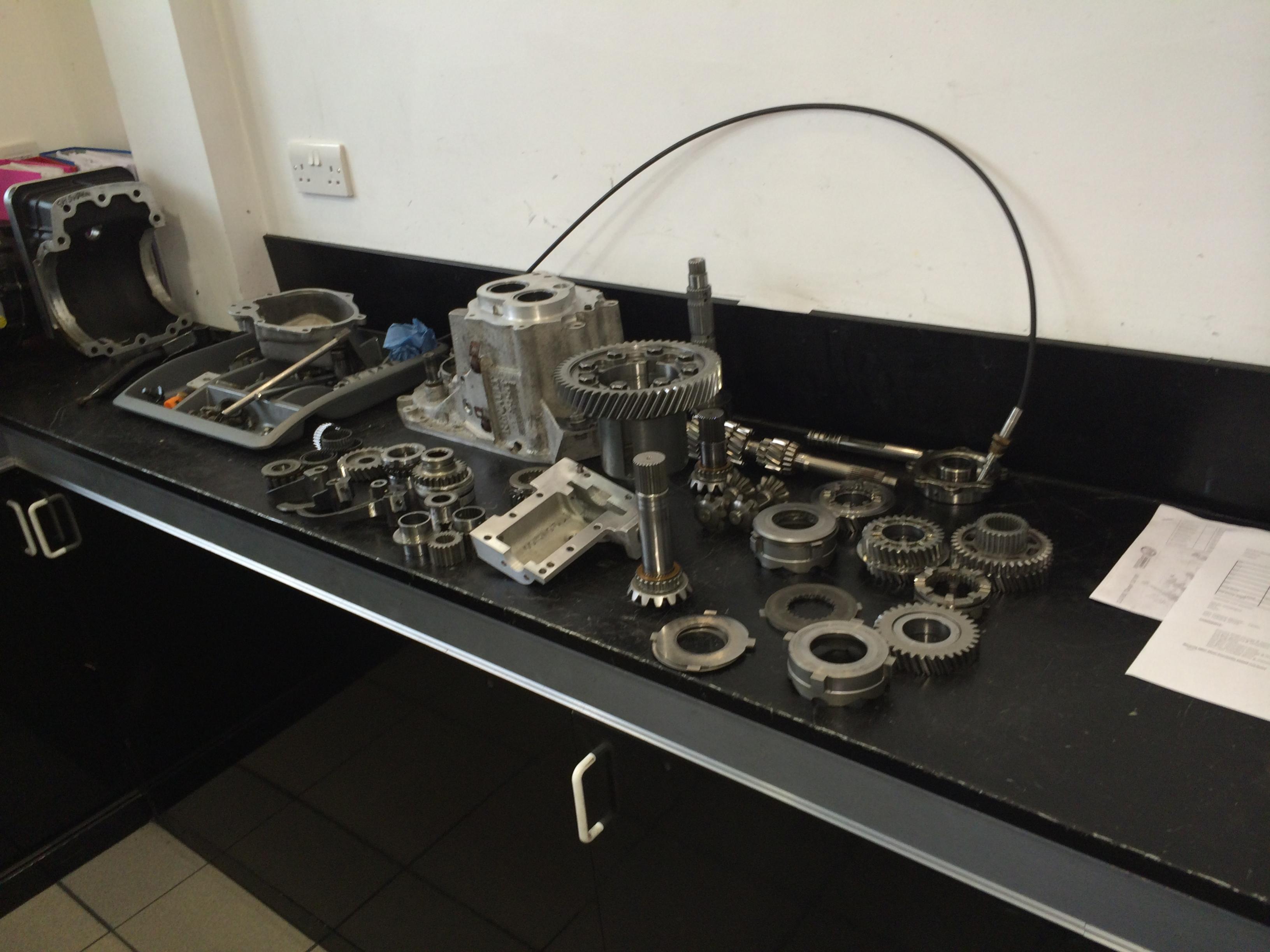

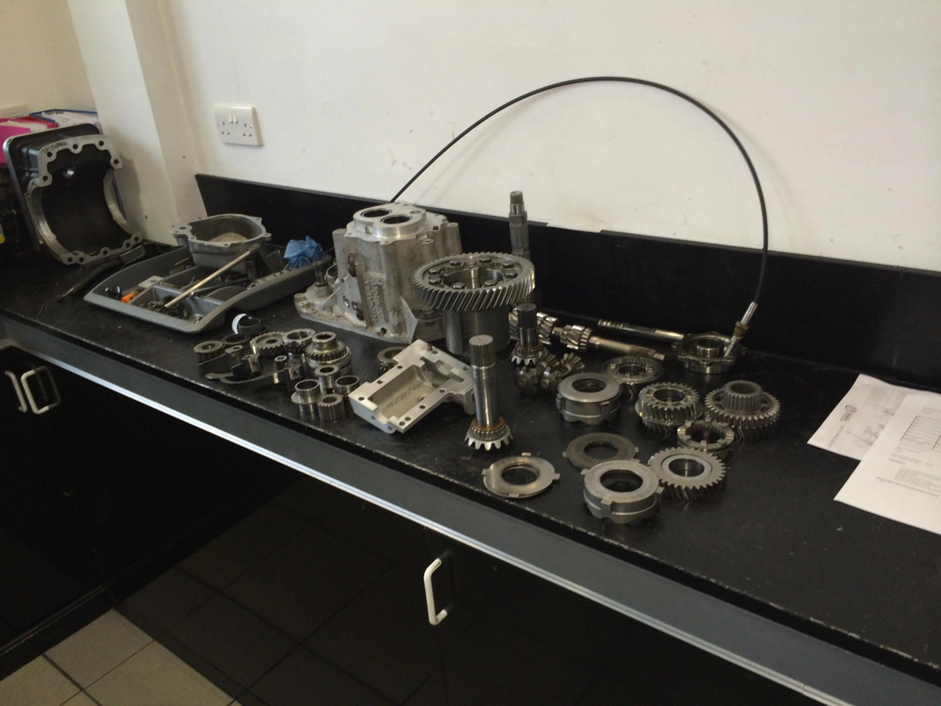

Been having a few gearbox oil leaks and reckoned the gearbox has not been re built for 10 years or so, so have taken the plunge to get it re built.
out comes the Engine and box:
Box ready to go down to SWR:

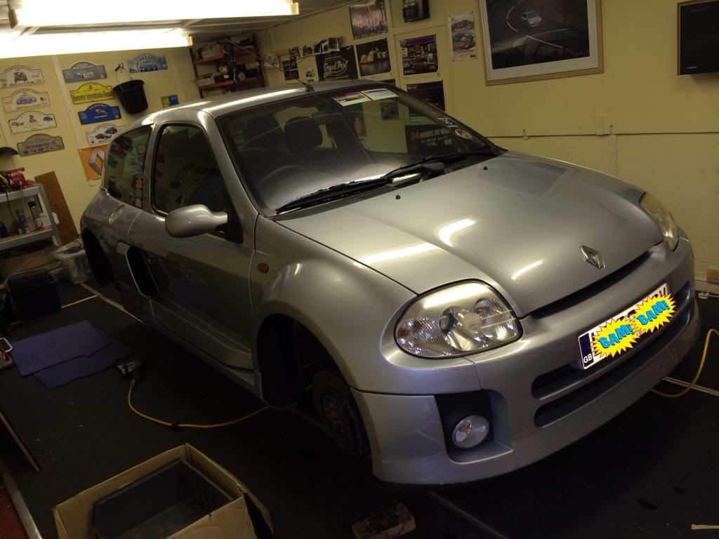

in the meantime... to keep myself amused....
not been on the road for 3 years, a bit tatty now and needs some caring for.
  Clio V6, cup racer
ok all stripped now:

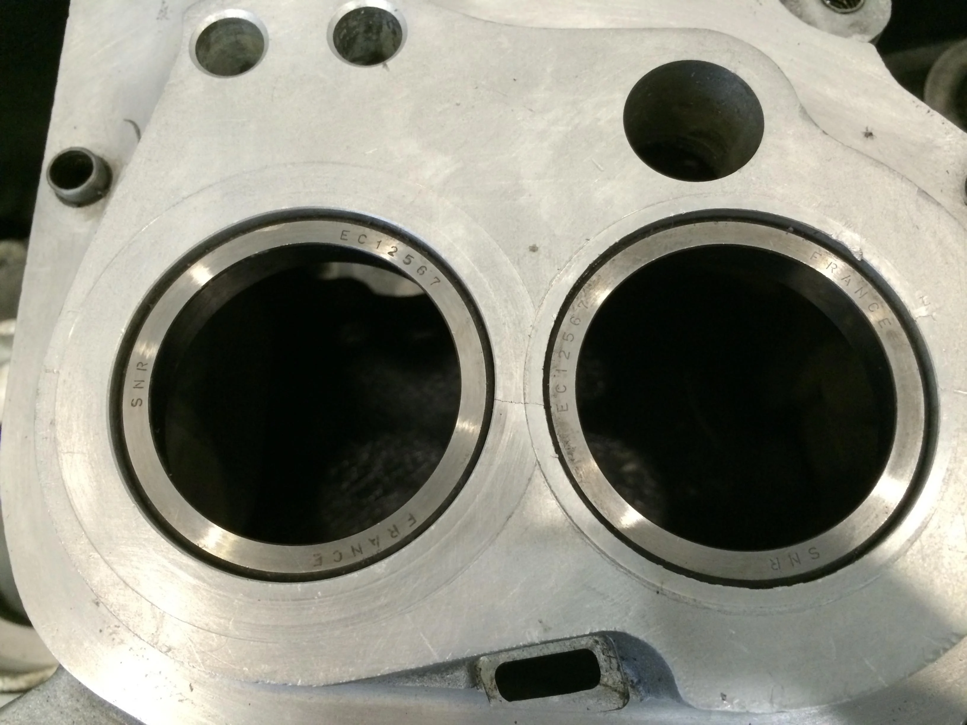

no major issues with gears and dog rings but

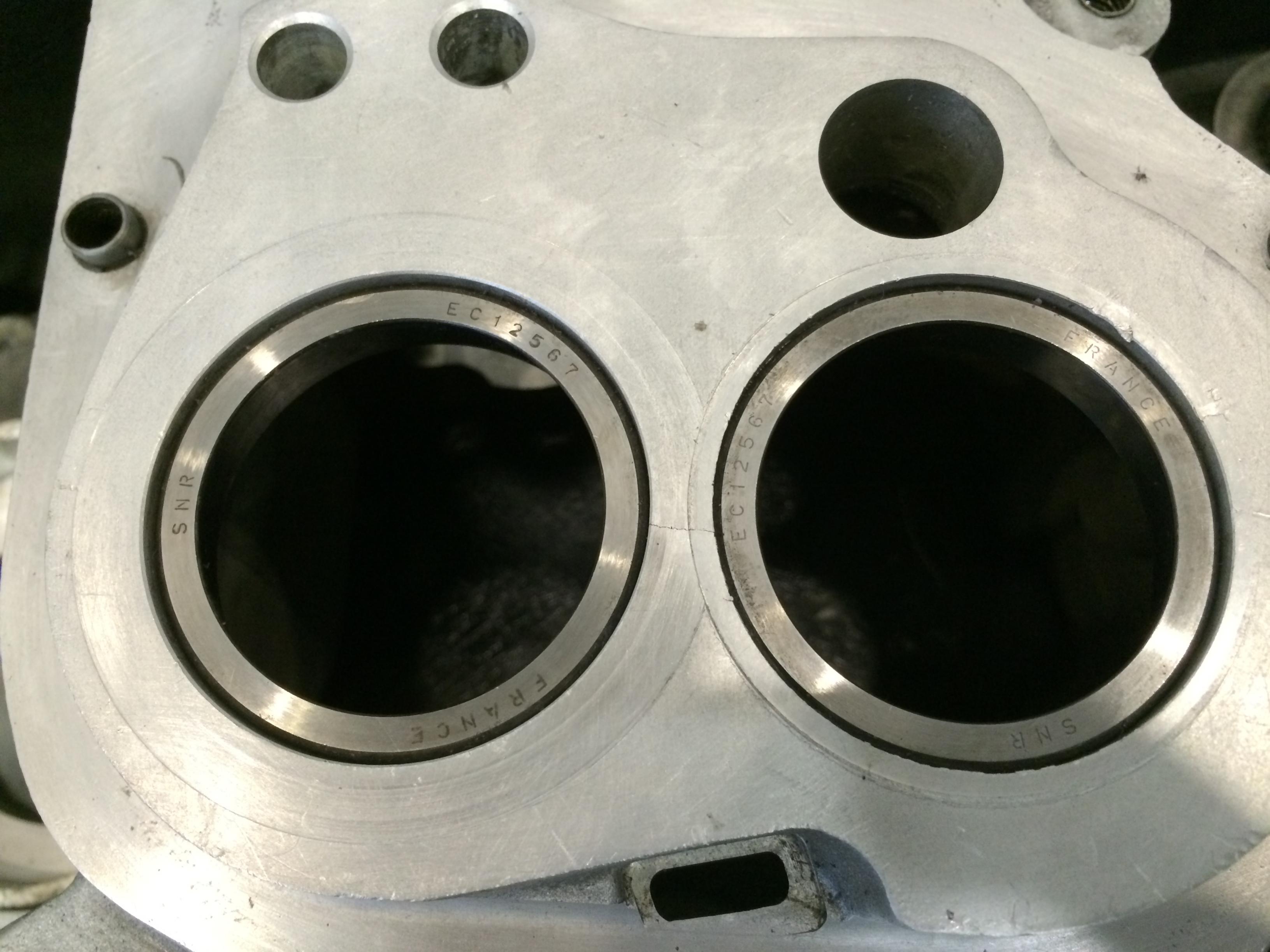

crack here will need welding and machining (or £900 for a new casing!) Not actually a major issue and tempted to leave it but now I know its there I wont be happy.
  Clio172cup rally car
^^^^Assuming that's the same as a jc5 casing, you could potentially use one of the steel reinforcement plates that are available on eBay. It certainly looks like it to me.
I was thinking that but these boxes are 6 speed, would there be enough space for the reinforcement plate to fit as well as the extra gear compared to a standard jc5?

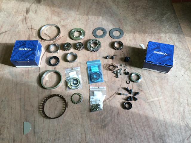

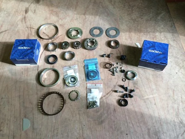

At last, Gearbox now collected from SWR, with this lot replaced:
total inc vat was £1600 or there abouts + the £70 spent welding and machining the cracked casing. (Which SWR would not get involved in)
Think SWR give a top service really, £375 flat labour charge on a SDTSA, its the cost of parts from SADEV that bumps the cost up. Have no doubt that in cup race series days the teams would replace all the gears and rings and that would soon top £4k easily, Primary shaft itself (which includes 1st gear) being e900 in itself.

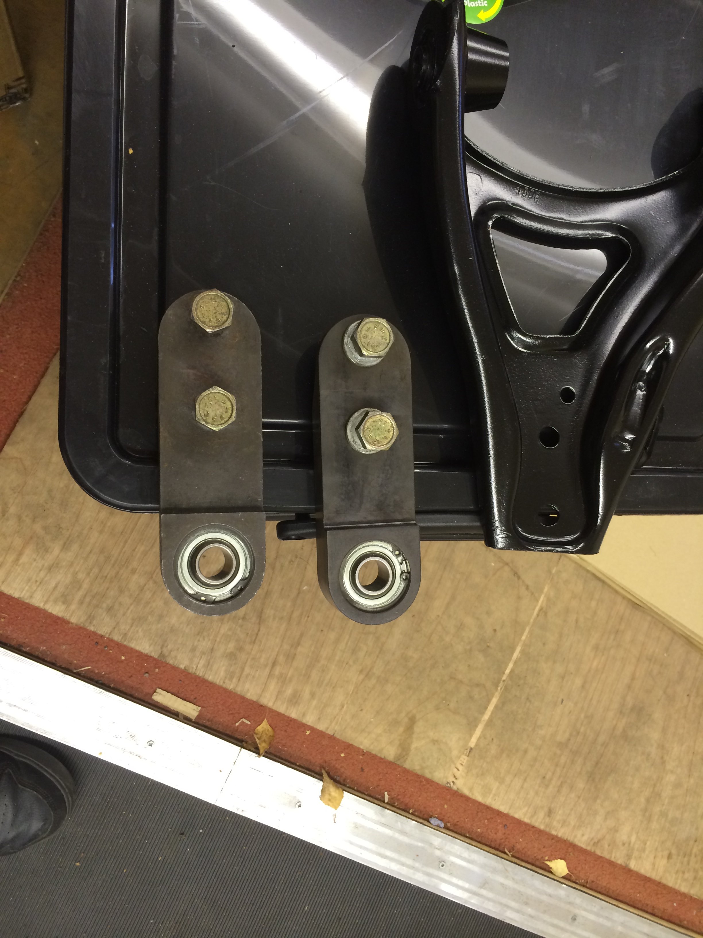

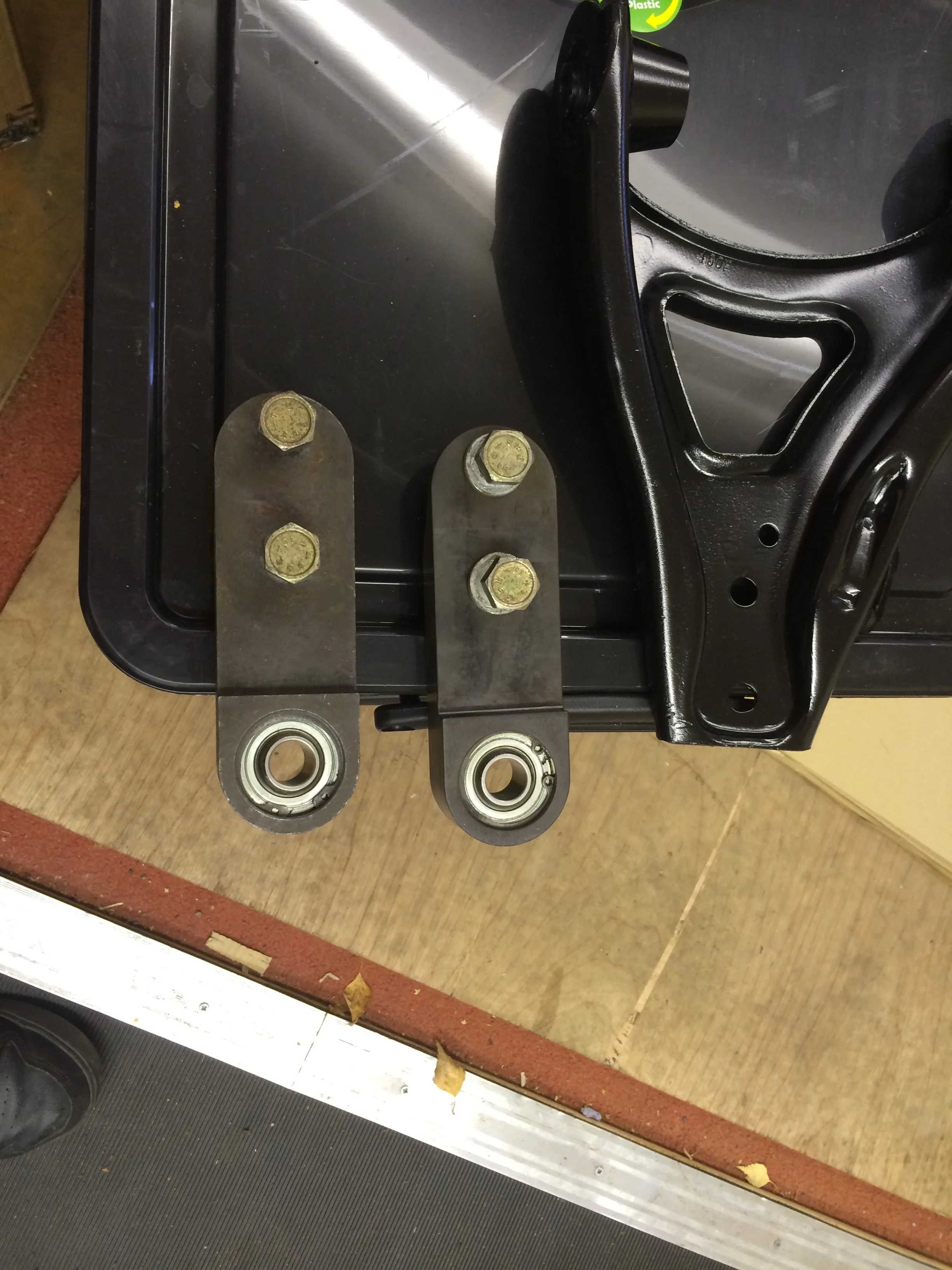

New uniball bearings in the lower wishbone extenders as these have no weather protection on them and were pretty much siezed, found one of the old bearings was loose in its housing having worn an oversize hole and pretty sure the whole bearing was revolving on steering inputs rather than the bearing itself. Luckily these (the extender plates) are still available from R sport, pretty much the only part of the front suspension that is. Although the new bearing fitted much tighter, and I think some locktite would have done the job, I didn't want to chance it so will keep that one as an emergency spare.
Wishbone bushes were in good nick so hung on to those, have all new bolts and nuts to screw it all back together with.
Dampers are now also off and having a good inspection and clean up.

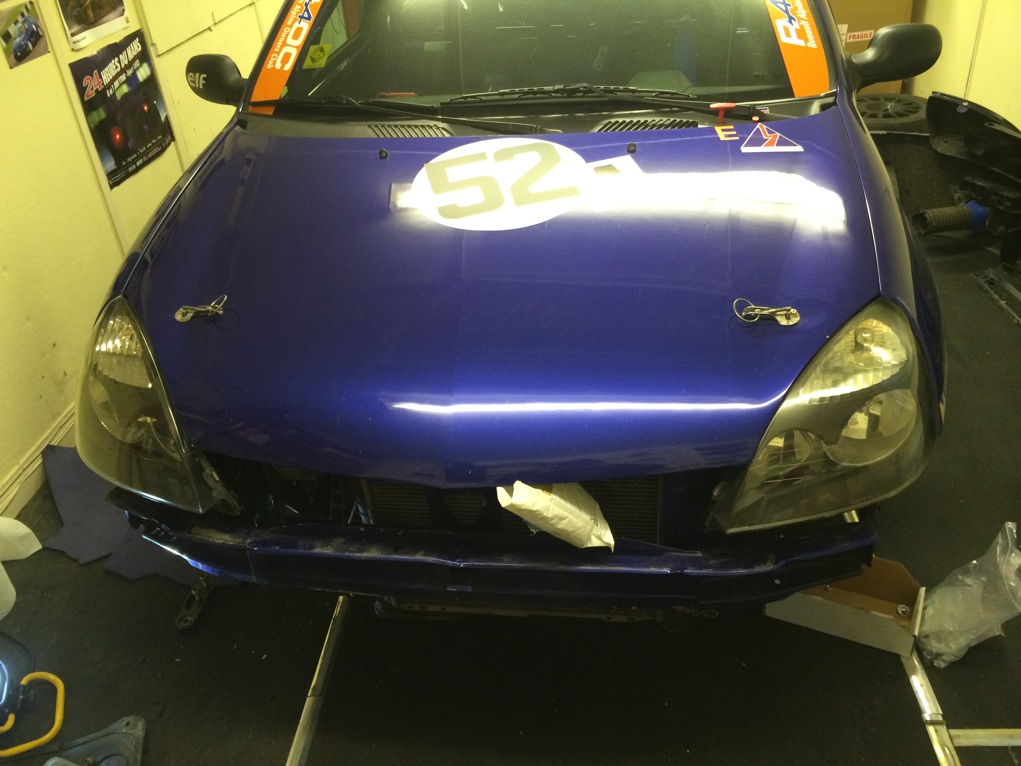

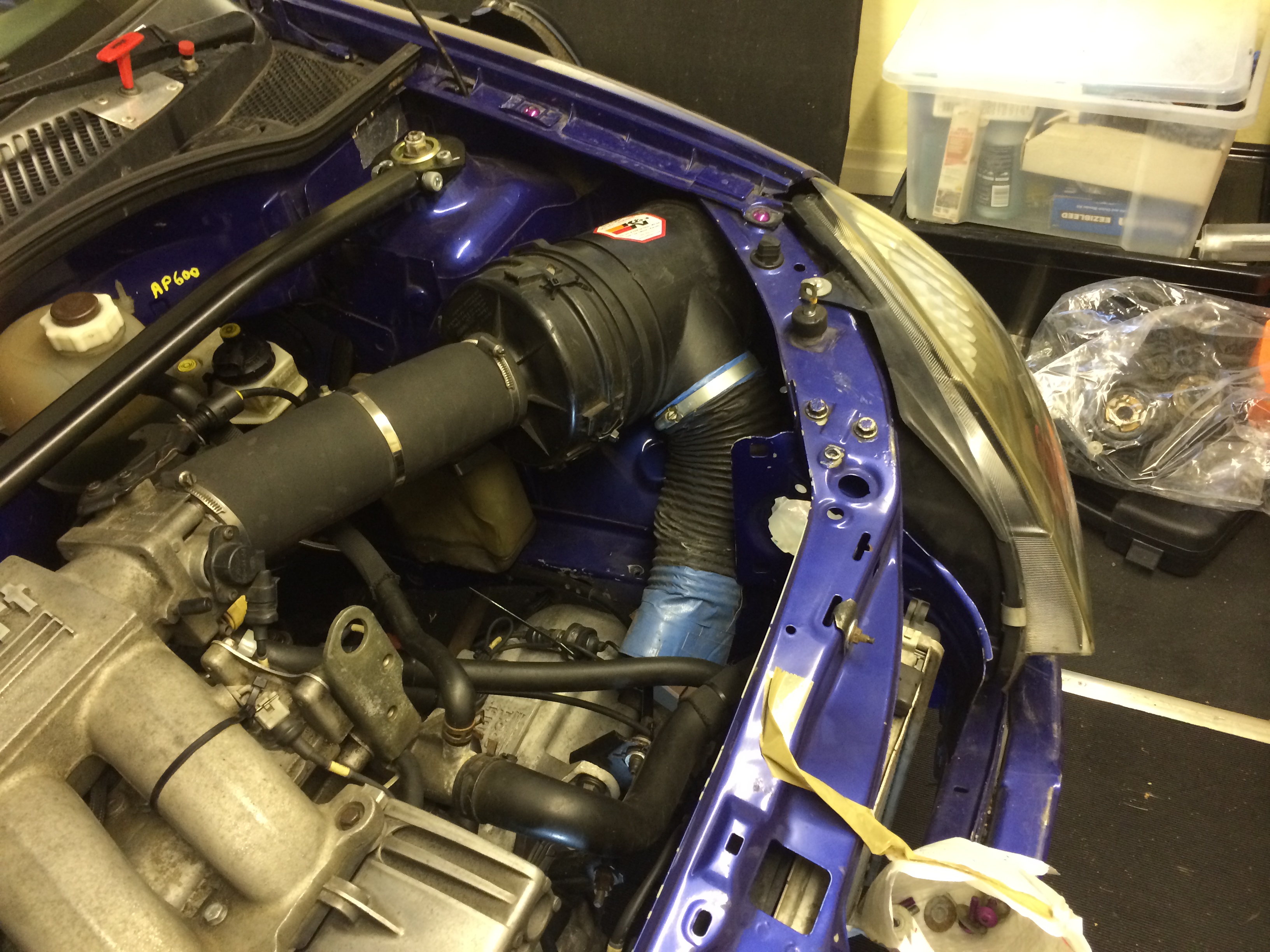

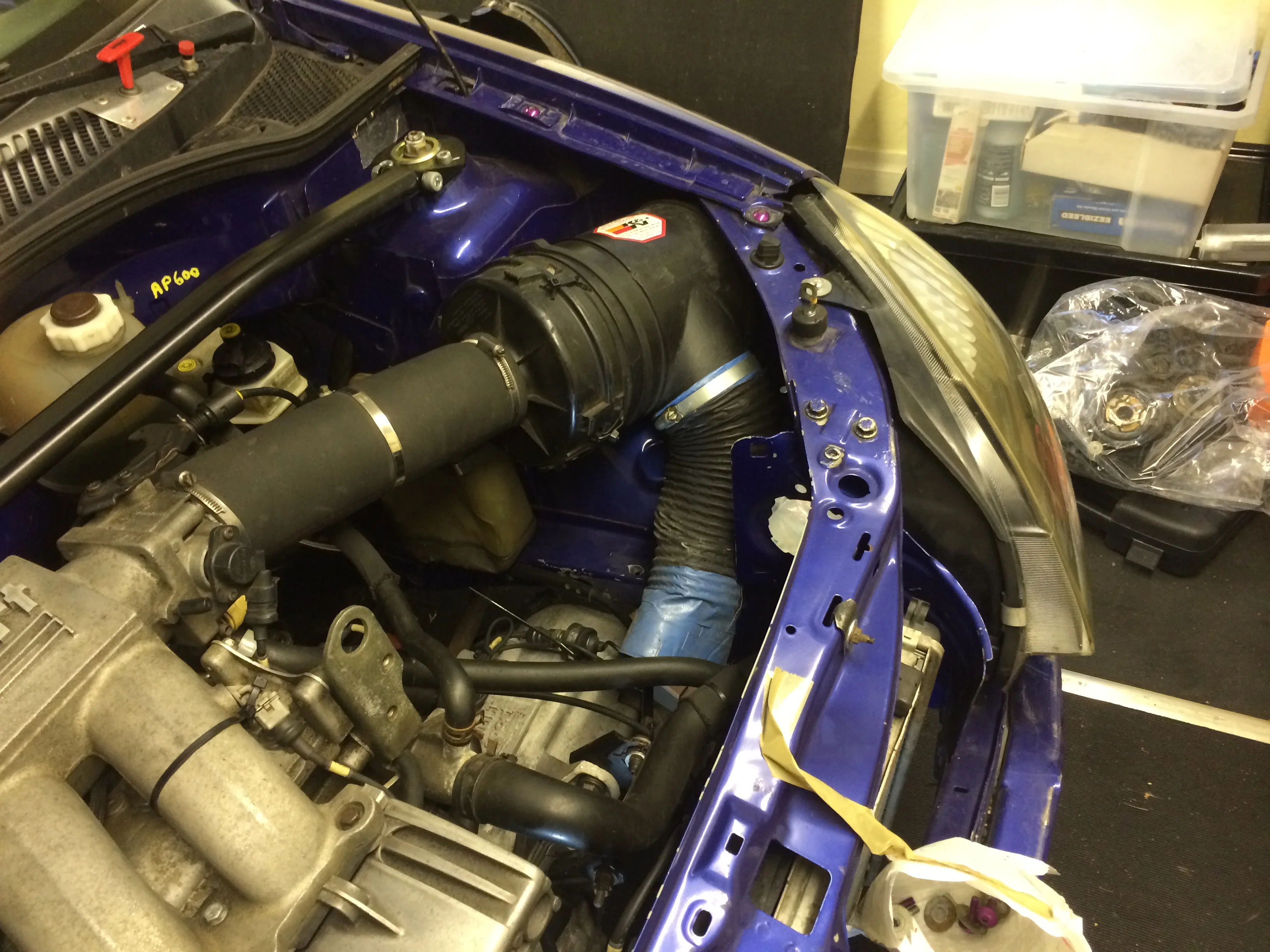

Sadly, it seems all race series now required headlights so:
just trial fitted some scrap depo lights for now for now, not happy about it either.....
plus, now have the induction issue to solve as the original airbox was fed through the headlamp cover.
so, what are my options? would a cone inlet filter in the same place get enough cool air to work effectively? Anyone done similar without resorting to ITB'S?
