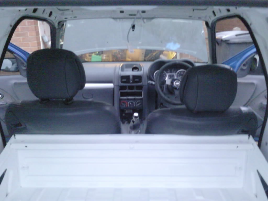

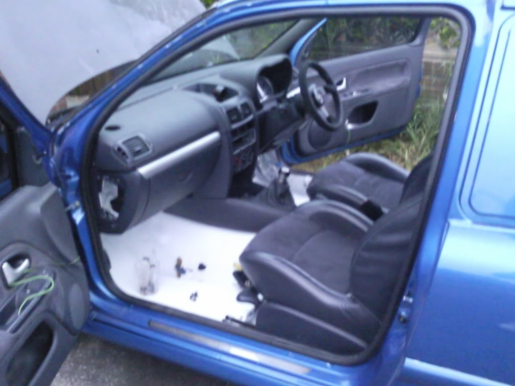

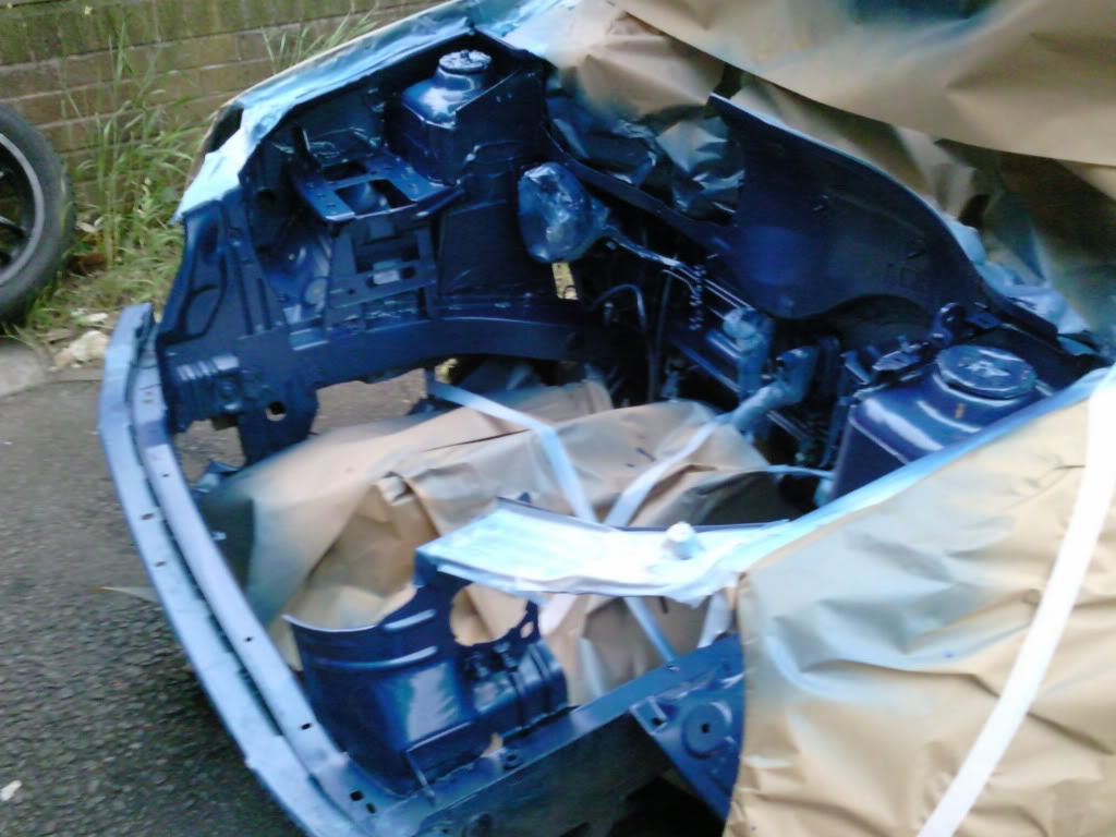

havnt had alot of time recently to do much on this but here are a few more pics of were the car stands now .
also out of work again so hope this project doesnt come to a stop.

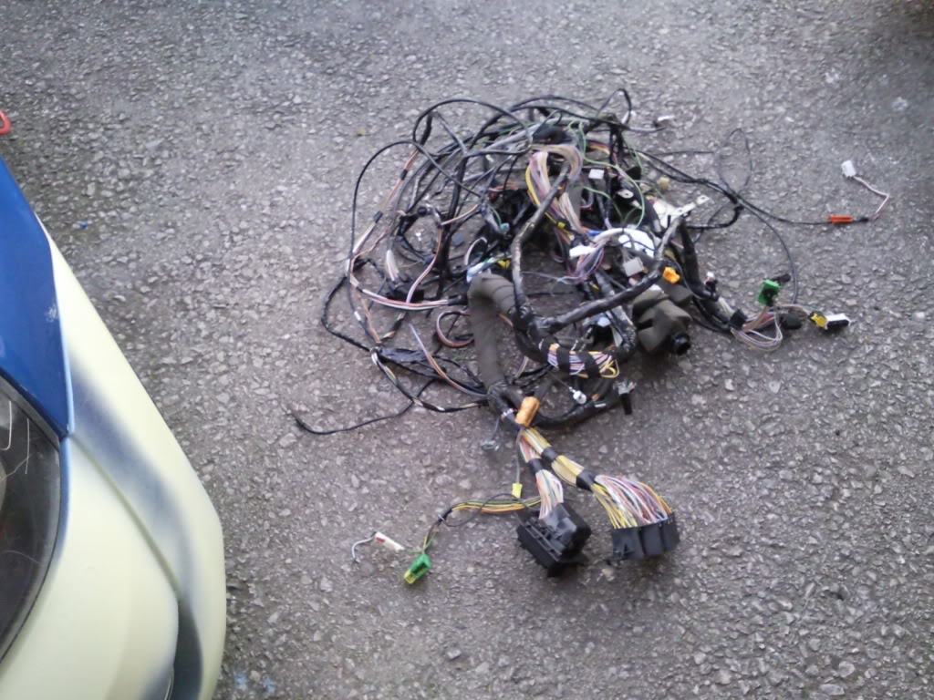

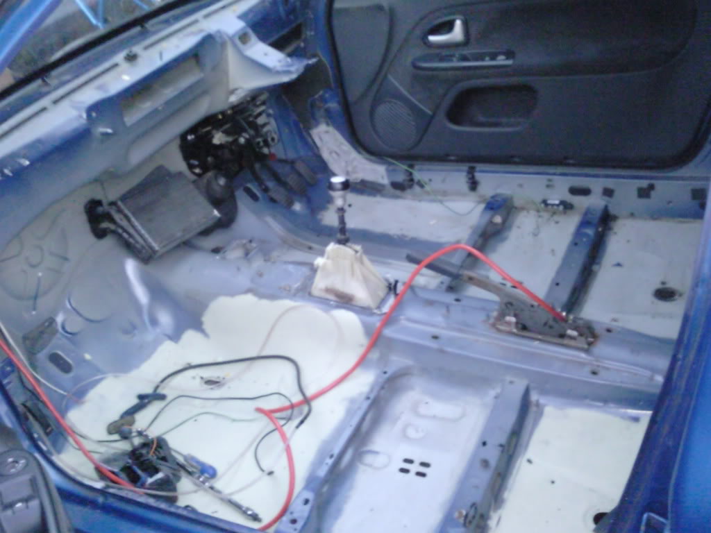

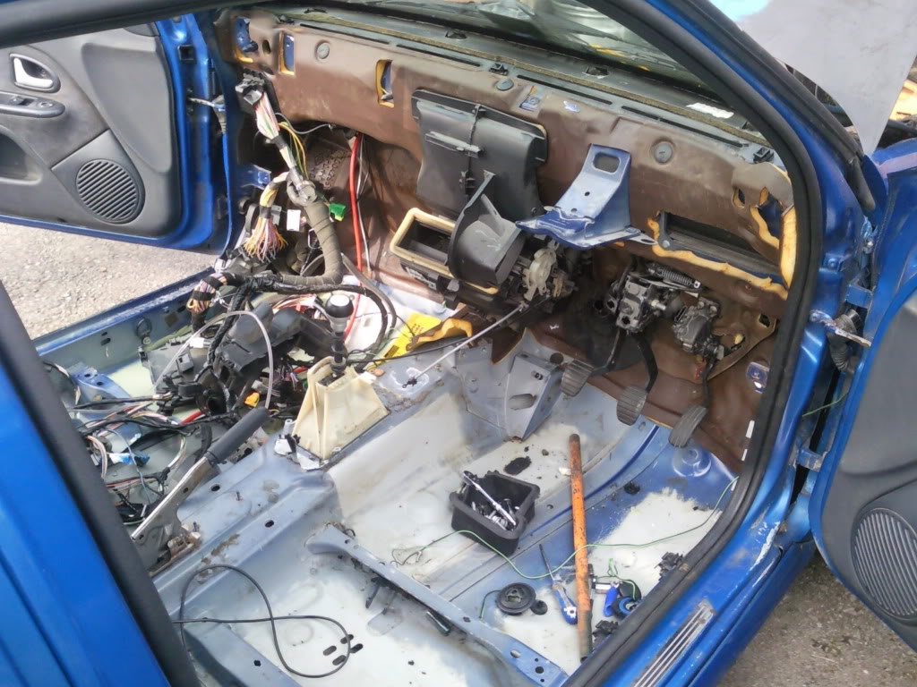

finally got all the dash and loom out then gave it a quick clean , now will be hoovered out then panel wiped ready for painting. going to give white a blast and see what it comes out like.
the loom which was right ball ache to remove ! lol

nice mate :). hope you dont have to stop the project as looks good.
i see why u put off doing the dash, looking at the pics that is a major job! lol

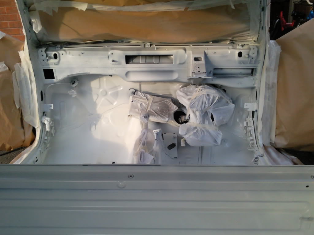

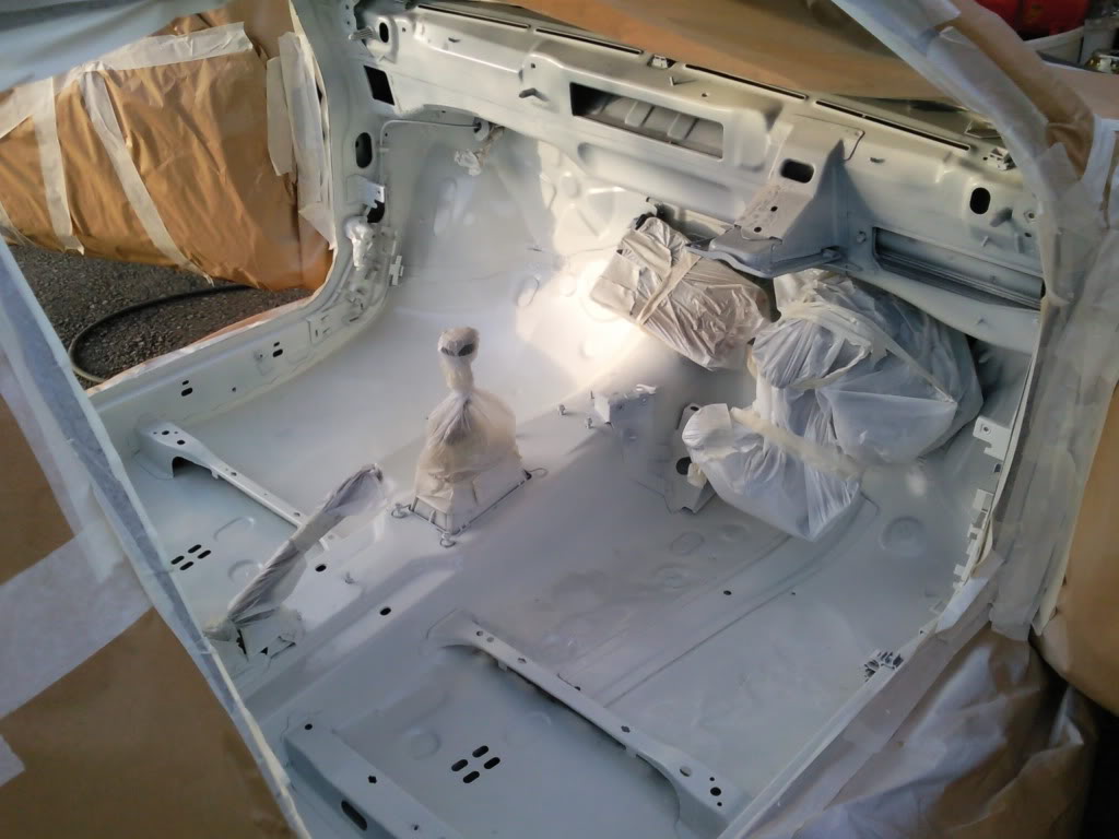

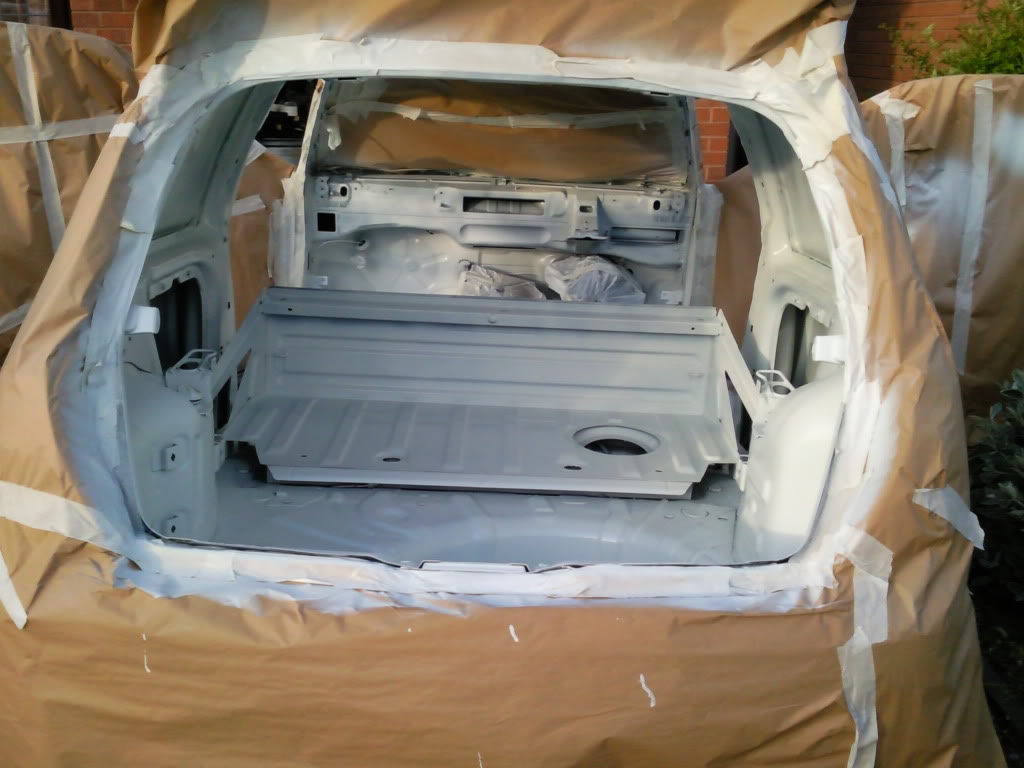

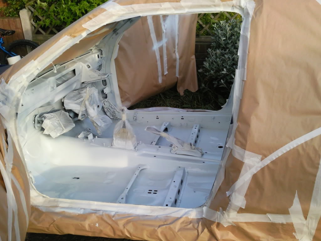

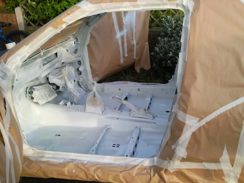

takin alot of time but its all done now , just got the last of the tar s**t of the roof and gonna mask it up later on ready for paint.
how hard is it to remove the tar on the roof? and then put the headliner back on? how much does it weigh?
cars looking good, fair play to you for doing a van conversion lol :approve:
ahh man its a right b**ch, the head lining takes about 5 mins better to do it with 2 people tho .
as for the sound deadening its a bit of a pain i used a heat gun and scraper. then s**t loads of thinners and raggs.

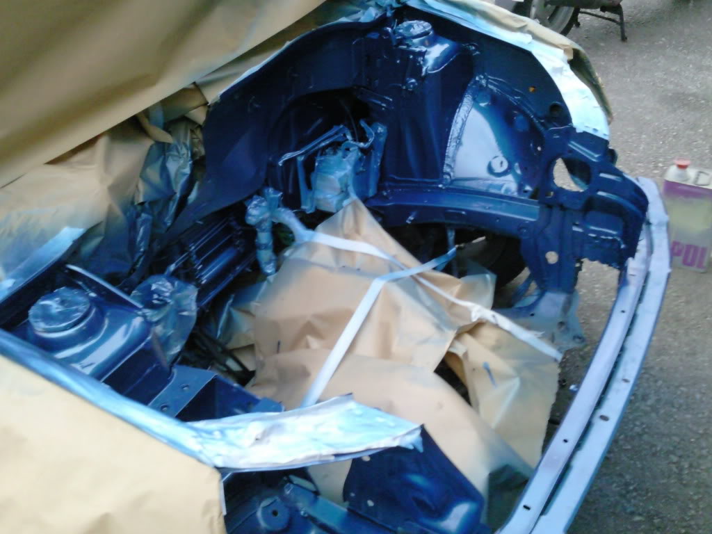

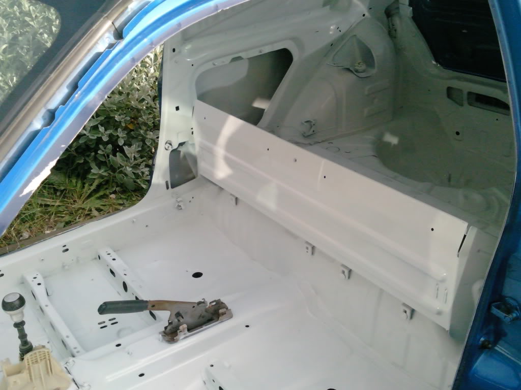

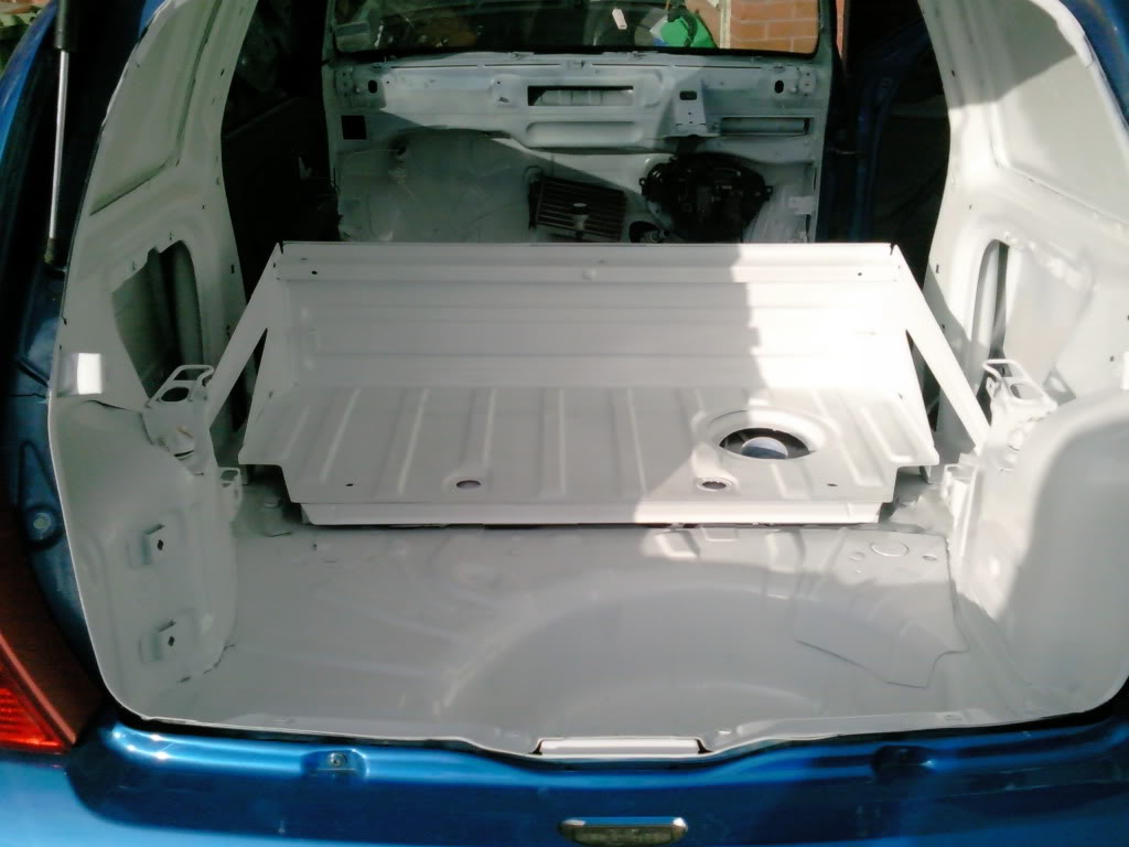

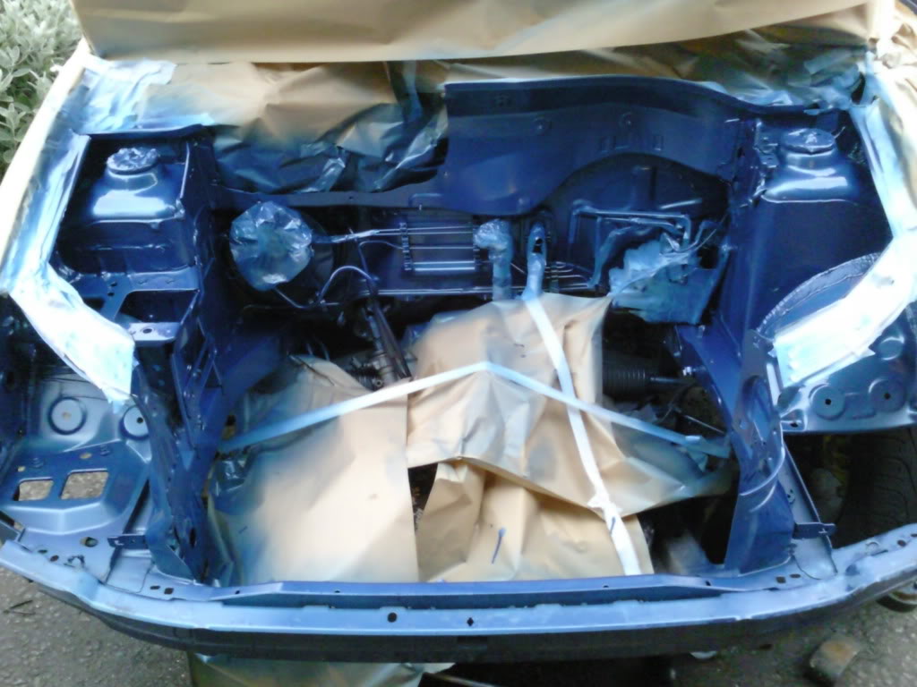

a little update, finally got most of it finished and a s**t load of silicons in the paint . god knows were they all came from as it was panel wiped 4 times .. could of been the diesel tank but its mostly sorted now . just got roof to finish as i ran out of paint and panel windows to re do but thats a easy job.
  Astra GSI, 172, Golf

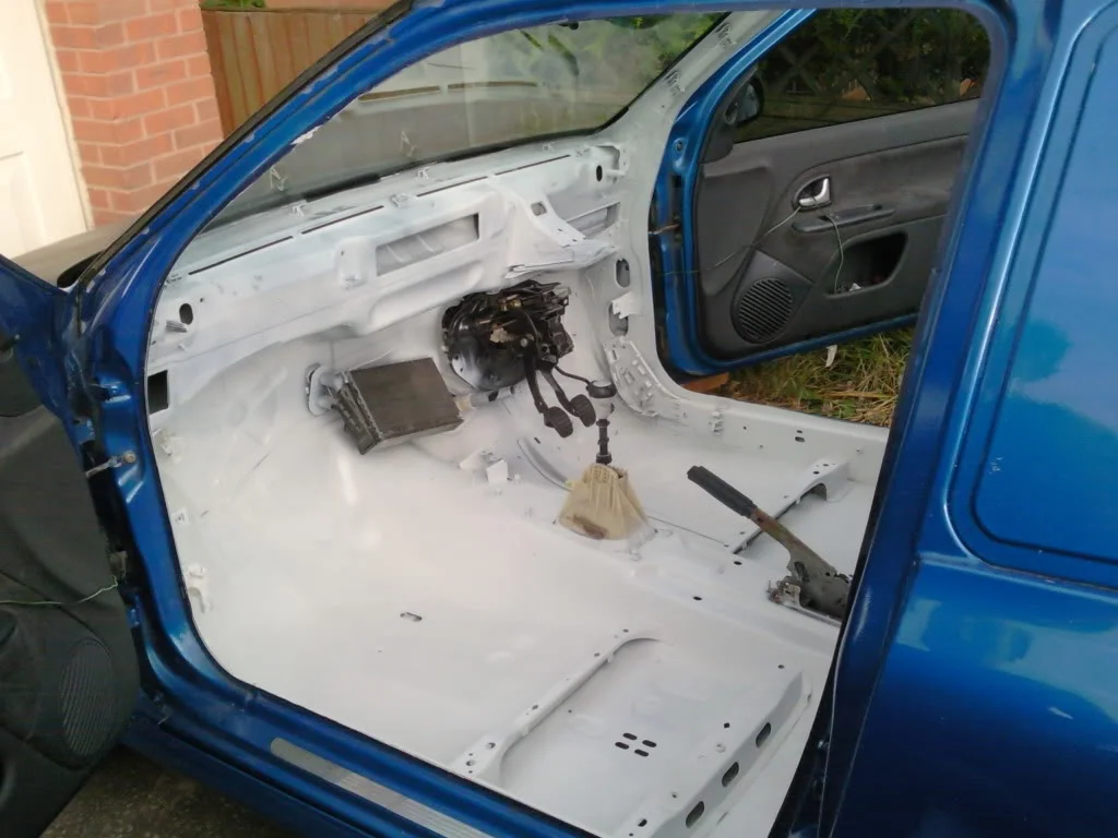

just some pics of it unmasked , looks loads better and i think the white against the blue really goes well. i just need to find a full loom cheap then i can get some of the interior back in and built up.

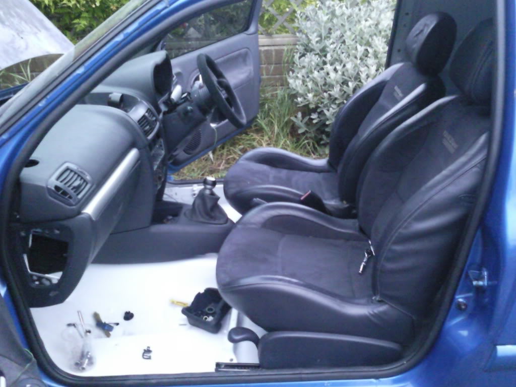

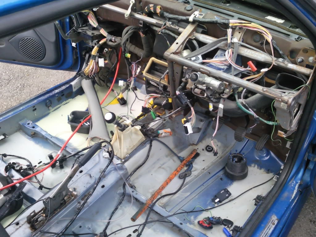

still waiting to find a wiring loom for the right price so in the meantime i stuck the dash and a few other bits in to see what it would look like built up. gotta say i love it !
bought a RMD steering wheel , and 172 mani think i can pair the mani and rear section up fairly easy just need to work out exact size and weld up a decat.
just a quick update finally got a full loom sorted out and some clocks so the interior can be built up properly now. just need to start get an engine sorted and some mounts..

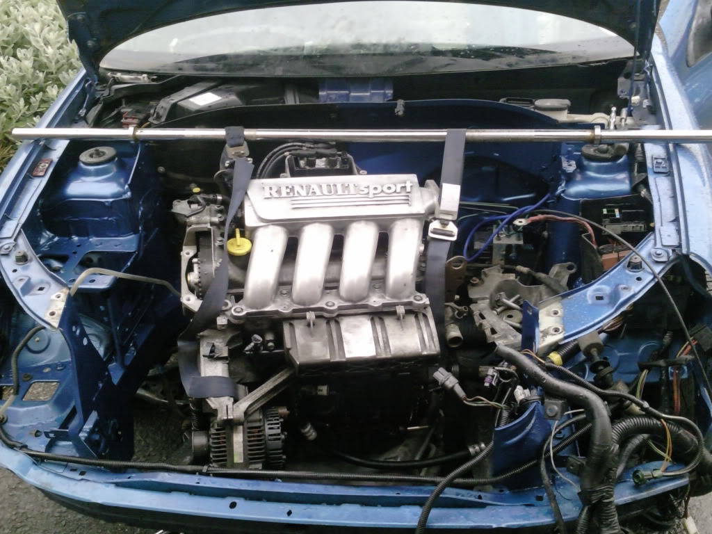

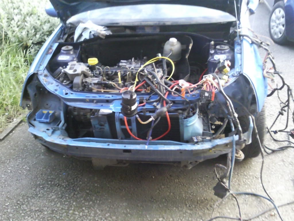

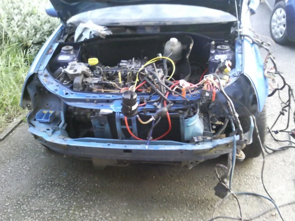

well i have bought an engine that will be with me 2moz im going to test fit it to see what it runs like and to see if there is any niggles etc then it will be removed and stripped down cleaned up and painted few new bits here and there then rebuilt wit arp's were needed etc .
gonna try getting the rest of the dci loom out tonite and make a start on taking the engine out. then got the bay to prep and paint the same blue as the exterior as its a darker ( like monaco ) blue from its original colour

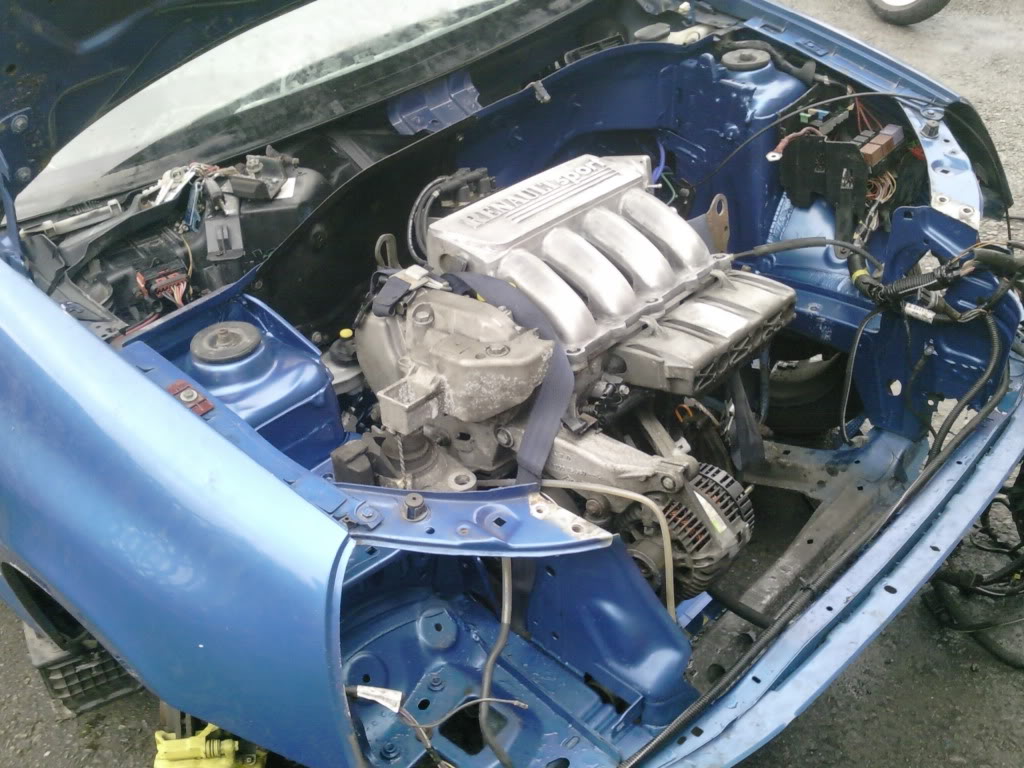

just a few pics to update
after disconnecting most of the wiring got one wire left to chase under the car and unplug then that can totally come out

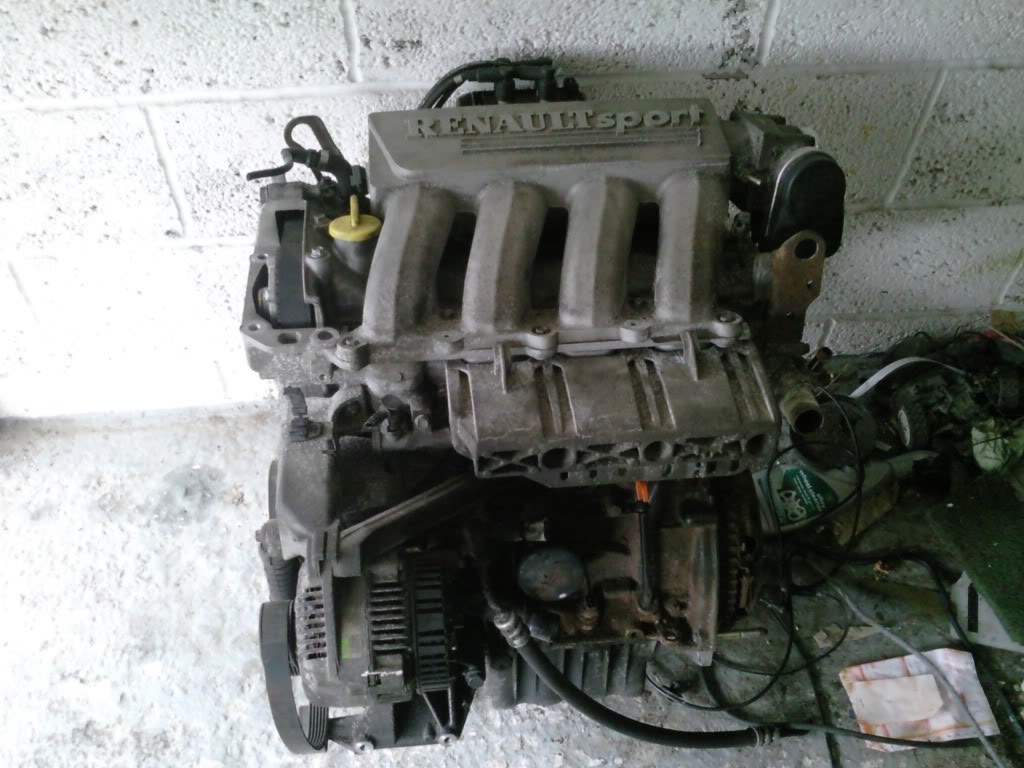

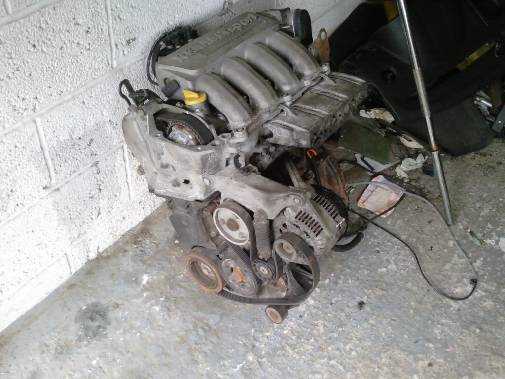

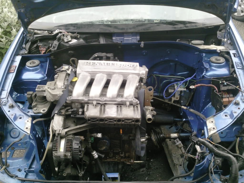

and heres my new engine,
going to give it a good clean up today whip the inlets and a few other bits of . then set at them with sanding paper, dremel and a machine polisher to get em nice and shiny

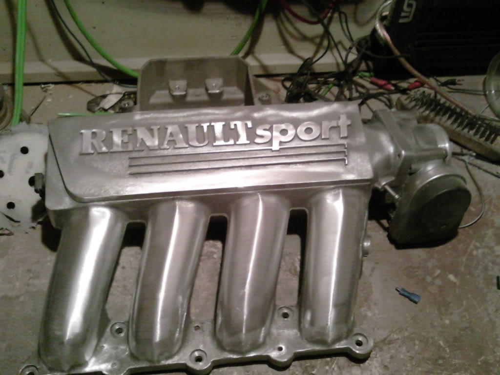

made a start on the inlets.... this is gonna be a loooong drawn out process :(

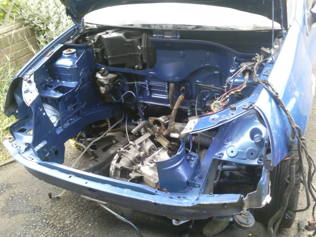

little update
Did think about gettin an engine crane but me and my mate lifted the engine in to save a few quid . gotta lift it back out now tho to attach gbox :( then relift it back in
also sein as when i requested al the engine mounts i only got the one that goes over the cambelt and teh twisted leg one, im now going to have to source the one that attach's to the chassis .
also the fpr is missing from the engine but cant grumle at the cost of it i suppose.
