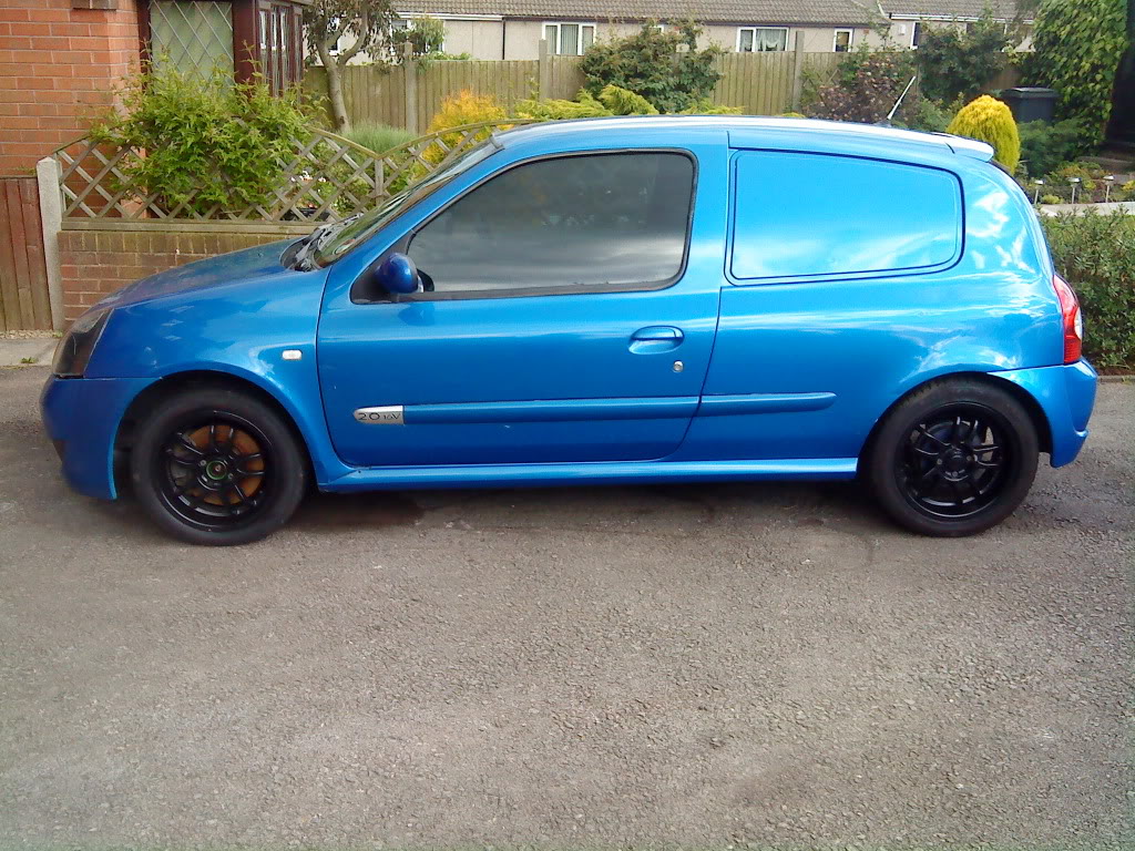

hi this is my van it started out as standard van in a dark blue (similar to monaco blue )
dont have any before pics :(
then it had a full 172 bodykit fitted and painted in think its artic blue ?? some one may recognise the colour .
then it went to derv doctor for a while to be mapped and have a few things sorted. came back at 106bhp
then a mate bought it and didnt look after it very well which lead to the turbo blowing and few other engine problems which is when i bought it for £1000 :D .

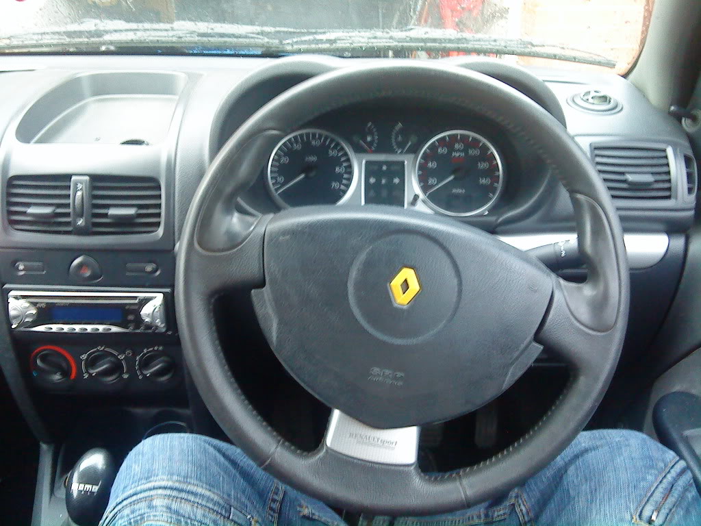

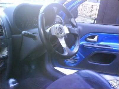

the first thing i did was to replace the blue smoothed door cards and momo jet steering wheel .
for 172 alcantara door cards and 172 steering wheel :D

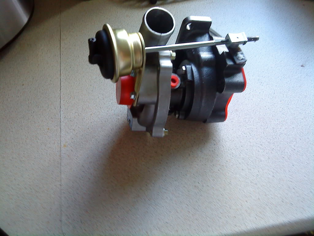

then the turbo was removed and a newer one that was in ''mint '' condition was bought from ebay and fitted but the car still smoked very heavily ! so i removed the turbo again and stripped the top end
Then the engine had a full rebuild anything that was worn was replaced , did have pics but lost them due to having a s**t phone ! but the inlet went from being 1'' in diameter to barley even able to put my finger in due to all the sludge from the turbo and other s**t . so that was all chemically cleaned , then rebuilt with new head gasket , bolts , seals , cambelt + tensioners etc .
but the car still smoked its cvnt of so after all that work it turned out that i had bought another blown turbo :mad:
but by the time i had saved up enough to rebuild the engine and realise the turbo i had bought was useless the sellers warranty had ran out and he didnt want to know about it !

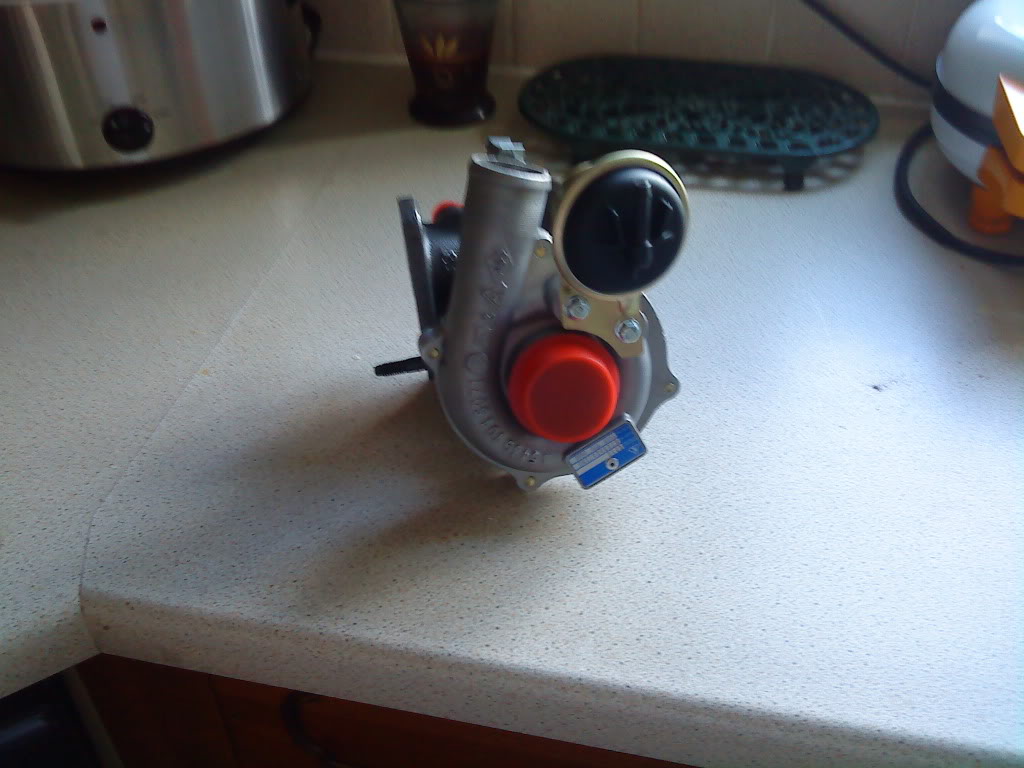

so i had to save up yet again and buy this a new dci 80 turbo :D

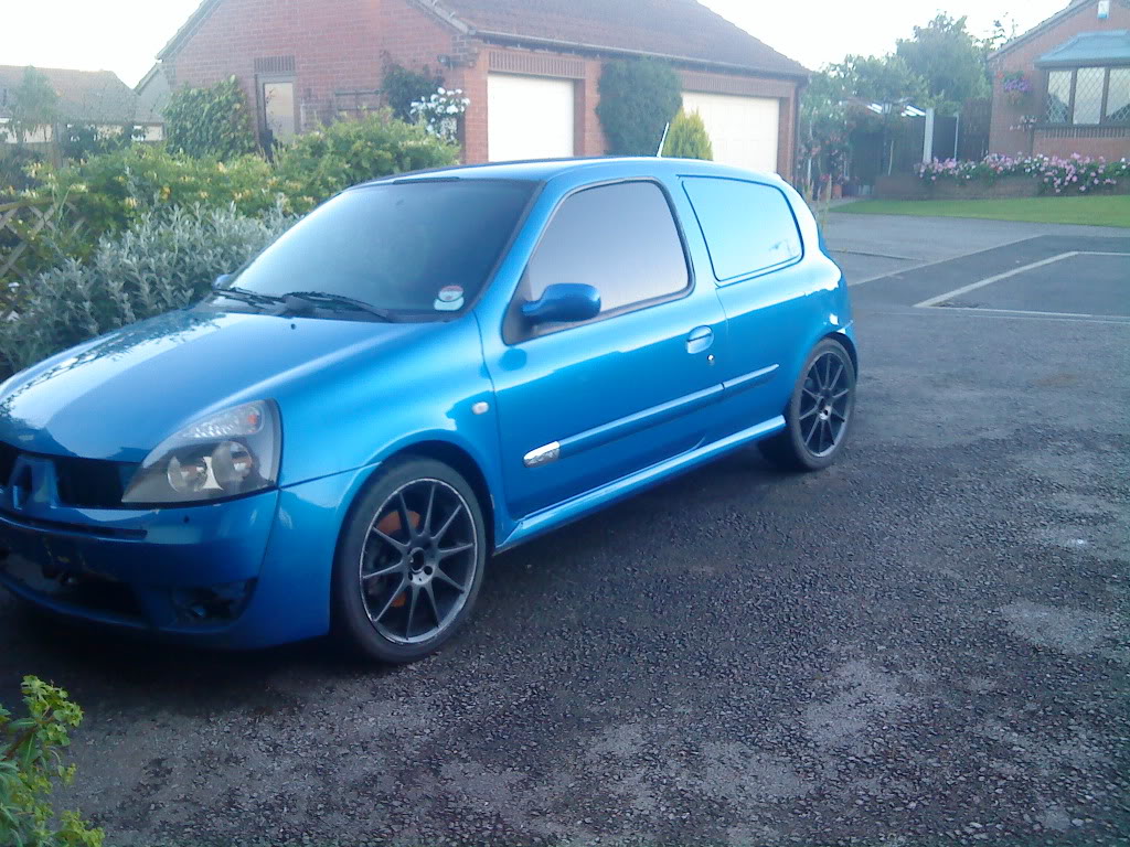

then i decided i wanted a bit more stopping power and making it look that bit closer to a real 172 so i bought full 172 suspension setup wishbones hubs shafts brakes etc and got them all fitted up , dont have any pics of fitting didnt think about making a project thread lol .
heres a pic of them before
then with bigger brakes fitted , i also changed the wheels to 15's as they should liven up the handling and acceleration a bit more .
i think it looks alot better with the 15's on personally , any opinions ???

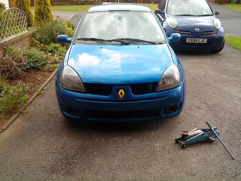

then painted diamonds yellow ( front bumper is in process on being painted )
painted dials silver same as 172 and steering wheel badge yellow , and painted dash strips matt silver ( were blue before )
then painted renault logo yellow and the surround blue ( was grey before )

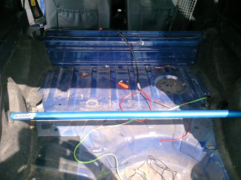

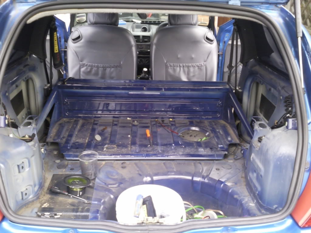

bit of an update but not much . got all the rear end stripped out including wiring loom etc . already got the seats and carpet out of the front just got the dash to do this weekend and start removing all the sound deadening :dapprove:.. how fun whats the best way for this ? heat gun and scraper ? thinners ?
all the back end is almost totally prepped for paint just need to prime a few areas etc . and have wired the battery into the boot just need a cage to secure it
i have decided im going to paint the all the inside white as it will go well against the blue . maby do the wheels white to ? but open to ideas's

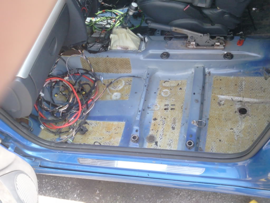

got most of the sound deadening out now came out quite easy with a heat gun and scraper . i do have some pics but i cant load them at the min . should be on tommorow hopefully .
just got the dash left to remove and get some more bits primed up
  Astra GSI, 172, Golf
nothing amazing to look at but just a few pics of were the car is at the min.
also bought a sport ecu of a member on here , on the lookout for a full loom pref from a cup .

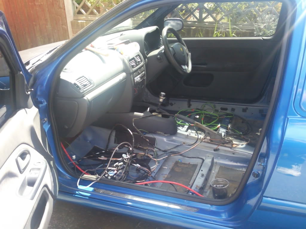

got the subs and all that lot removed
them removed the rear cards

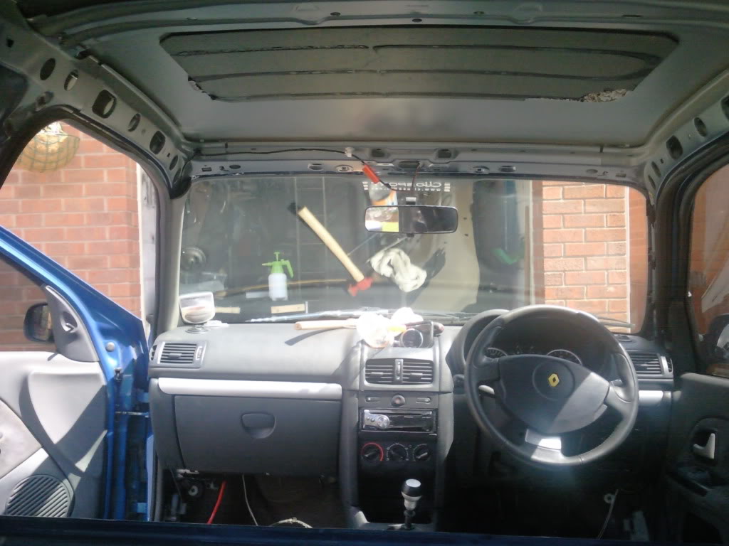

roof lining of... not looking forward to removing the sticky sound deadening from the roof
then removed the seats and front carpets.. found a few quid to bonus !!
made a start on the sound deadening on the front all the rear has been removed already .
ans thats were it stands so far going to get some more done this weekend and hopefully get all the dash out to as i have been putting it of due to the heat .
also not sure what colour to paint the inside either blue ( to match oputside ) or white any thoughts ?
