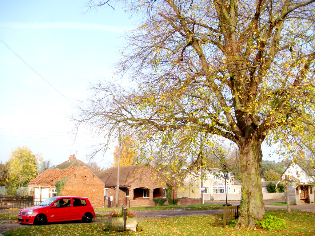

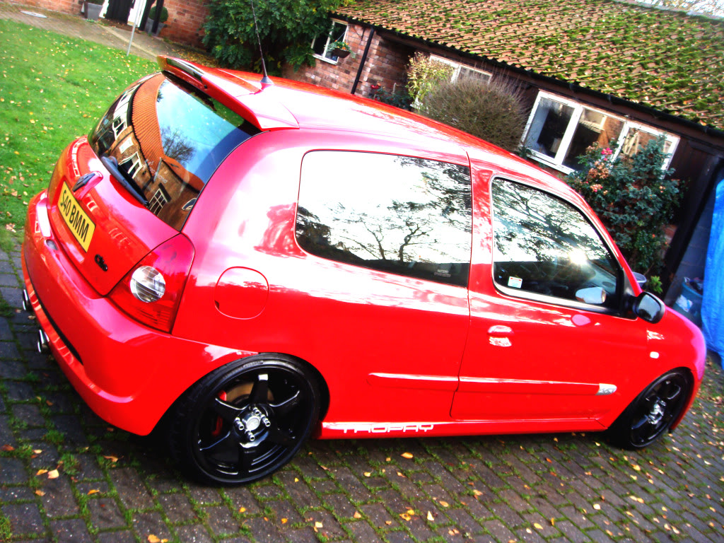

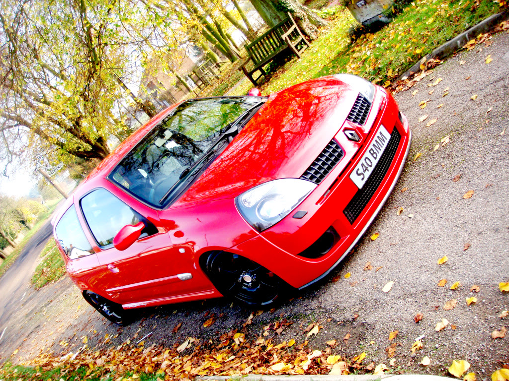

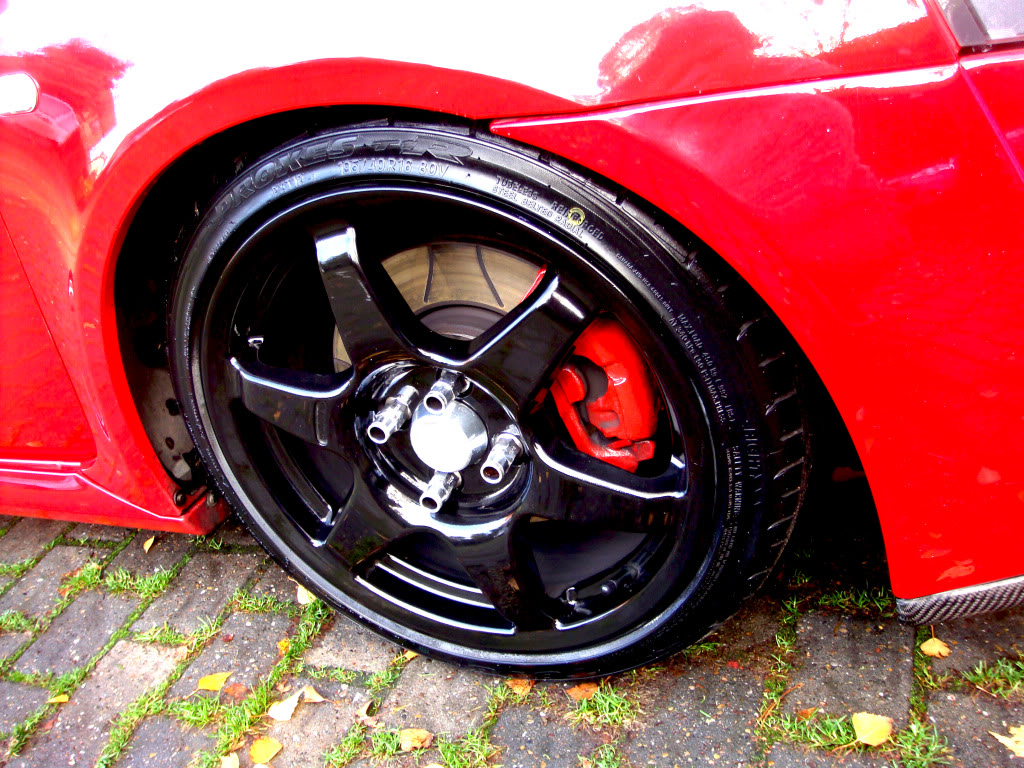

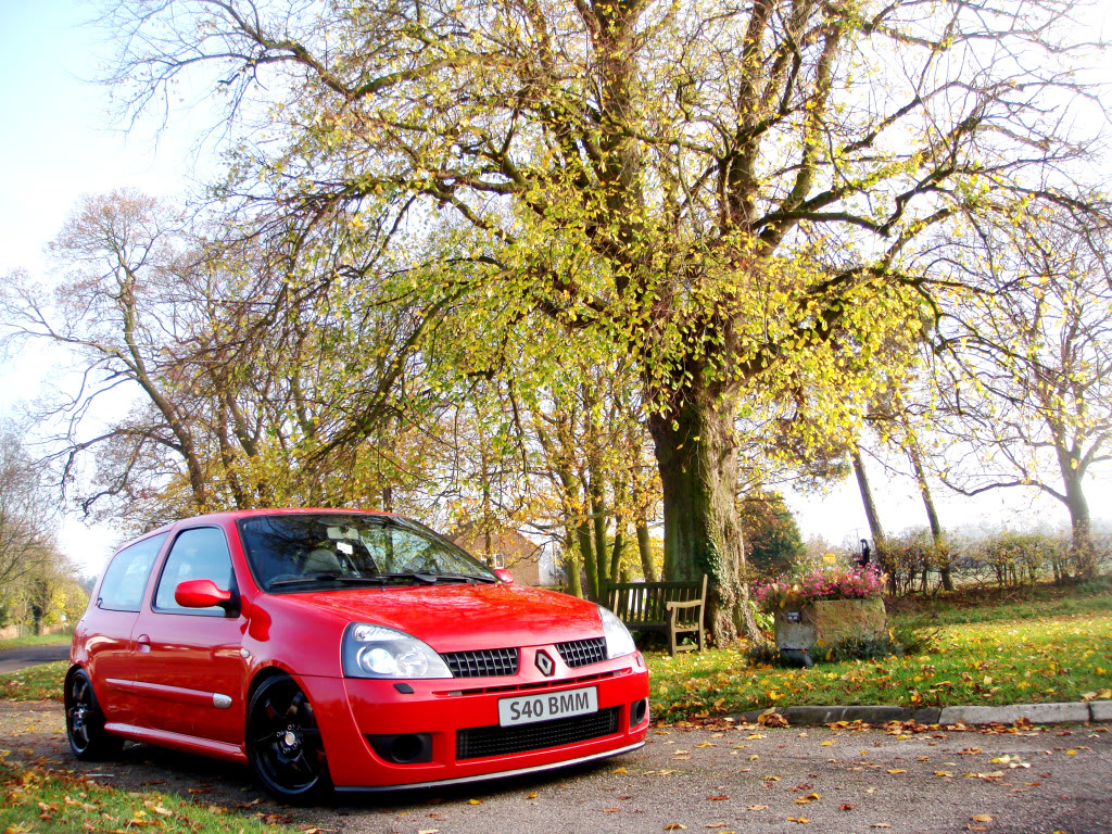

As some of you know I have fitted my new wheels, SD Cage and adjusted the H+R's Height. The wheels are Compomotive MO6's in 16x7.
I think I have got it looking about bang on bar a few small things like painting the RS grilles and Mirror baseplates gloss black and covering everything in real carbon.
I am cracking on with tidying up the bay next week painting a few things up as I have the dreaded oil leak from the rocker cover bolt and I'd like to sort that ASAP!
Comments Please :D

Oh!! Didnt realise you could get MO6's in Clio fitment?
Would have had some years ago if that were the case lol ...
Looks great, although seriously, put normal wheel bolts back on, those stud things look horrific :(

They arent clio fitment ;) there vauxhall fitment with the centrebore expanded.
I am waiting on a set of rays red nuts coming, should be here wednesday hopefully.

I think im in love! The ONLY wheel i have ever seen that looks good bar the usual, turinis, cup wheel, ozs etc, Looks sooo good!

Mate I've just made a mess that is the best trophy I've ever seen, absolutely love it!!!

Looks good, but christ what have you done to the pics? I need some sunglasses after looking at them!
  Abarth 500 Esseesse
That looks stunning! How many times have you been arrested by the Trophy Police though for doing away with the original suspension? :rasp:

You have :D although I have altered a few things. They now have 500ft/lb faulkner springs, and different rear shocks.
I agree the road ride slow + fast bump is far superior with the sachs, but these are a brilliant compromise if you want the looks and with the different spring and rear damper setup the setup I feel is greatly improved over the standard H+R setup! I run these with AST top mounts set to max caster and camber bolts at -2'.
The main thing over the sachs for me is the initial roll. I really feel unconfident when turning in and cornering hard when there is lots of body roll. With this setup the roll is far less without making it awkward to drive fast! It still brings a smile to my face on a good B road as did the Sachs (I still have some pretty much newly rebuilt ones here just in case ;)!
Granted the trophy sachs maybe quicker but I prefer a suspension setup that is suited to my style of driving and if im honest im not the next Sebastian Loeb so they tick all my boxes, brilliant build, ride and handing.
Thankyou for all the kind comments everyone. I am really happy with it now and looking forward to going to some meets in the new year!

I disagree, & iirc ive driven on this particular set of H&Rs lol ... Sachs is a better road setup, in fact theyre simply superb, hence why i still have mine :)
Driving > looks

I have to say even though your car is different it doesn't do it for me ! :dapprove:
each to their own though buddy ! :)
Gally
I like it I just don't love it. I don't like the idea of removing the Sach dampers they are what the Trophy is imo.
  RB One Eight Two
I really can't make my mind up with this one, it just doesn't look like a Trophy...
Fair play for being different though.
