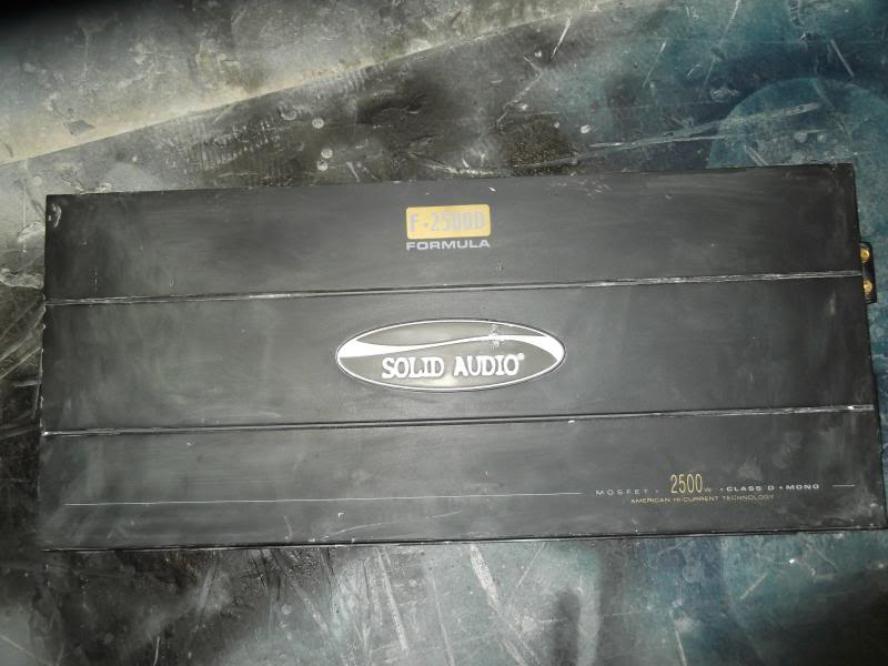

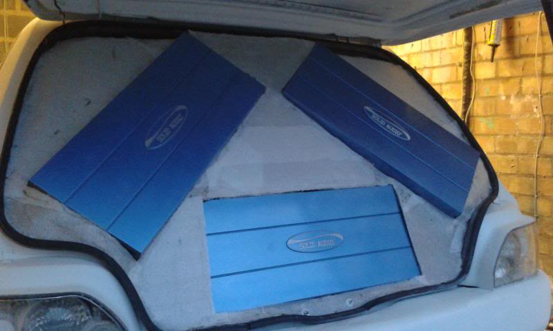

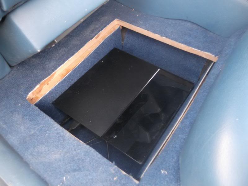

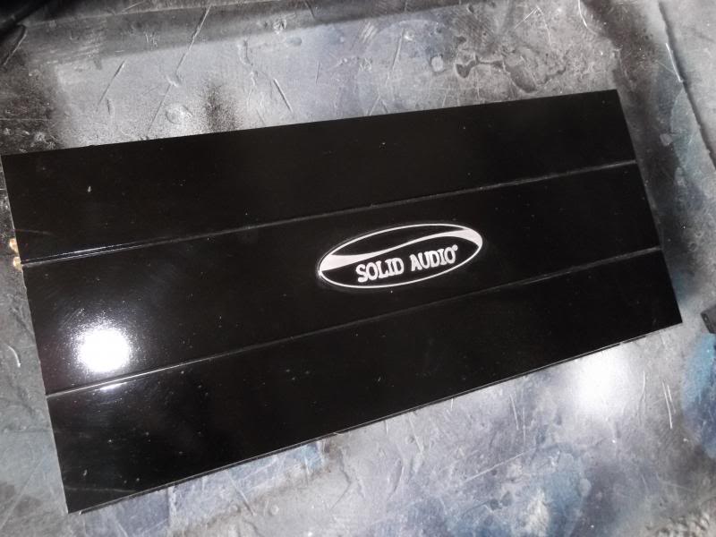

Decided to paint my amp casings as they were looking very scruffy. I painted the whole thing and then remade the diamond cut style finish on the badge
Before
After

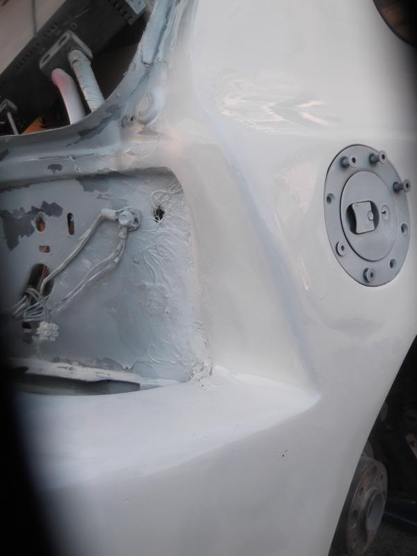

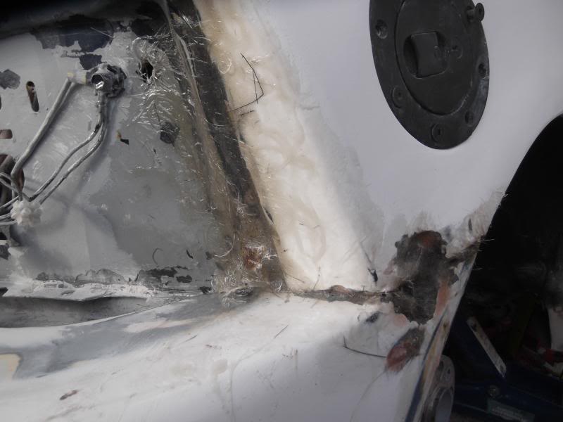

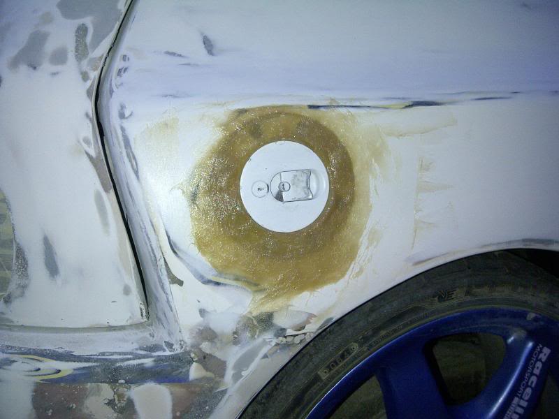

I also found some cracks where the rear bumper joins the rear arches and it hasn't even been near a road yet. I figured i had better get to the bottom of whats caused it. Turns out the comedian who fitted the kit decided to only attach the top half of the arch to the car. The bottom half was moving about and causing cracks. I have now fibreglassed everything together both behind and on the front face so should be ok (when the other sides done). We shall see. The middle of the bumper has also been fibreglassed to the car to give extra support and will also help the boot shut line...more to be done on this tomorrow
During Prep - now fibreglassed to panel
Filled and primed

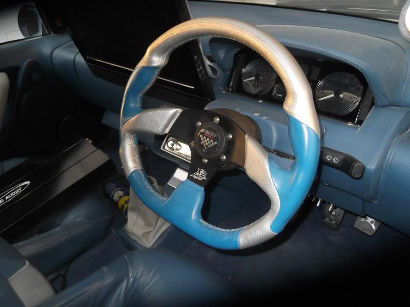

I've also just won a brand new Sinfoni steering wheel on Ebay for £30 so will be replacing the other one

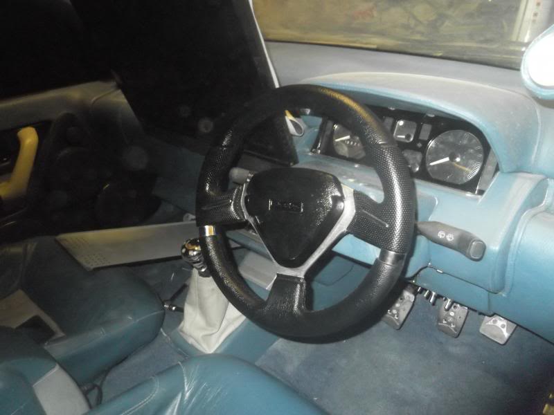

Old one

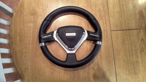

New one
I'm undecided on whether to paint the fuel filler cap black or have it white like the car. Any opinions appreciated
