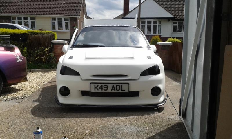

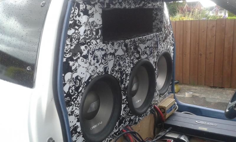

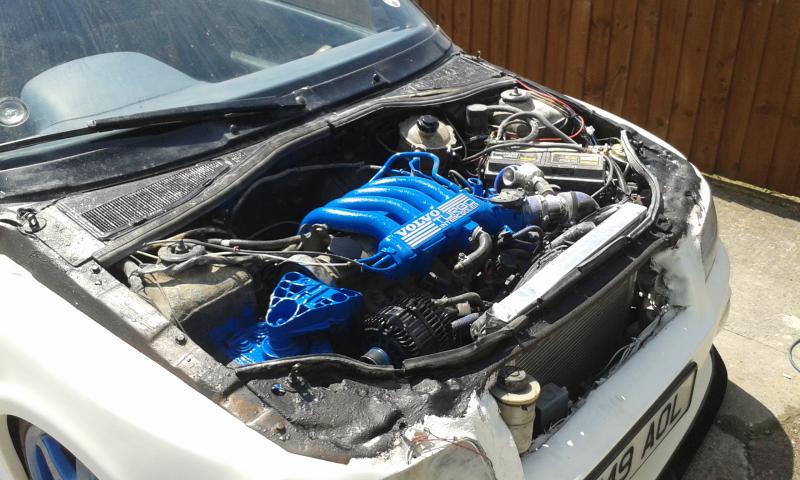

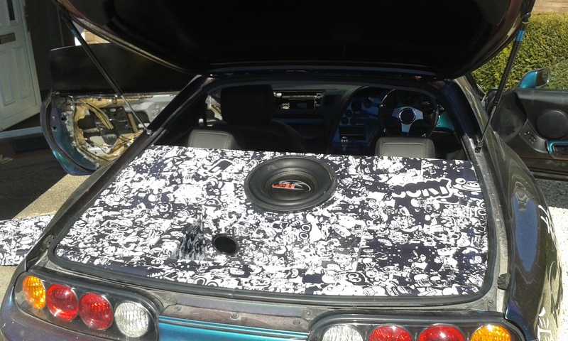

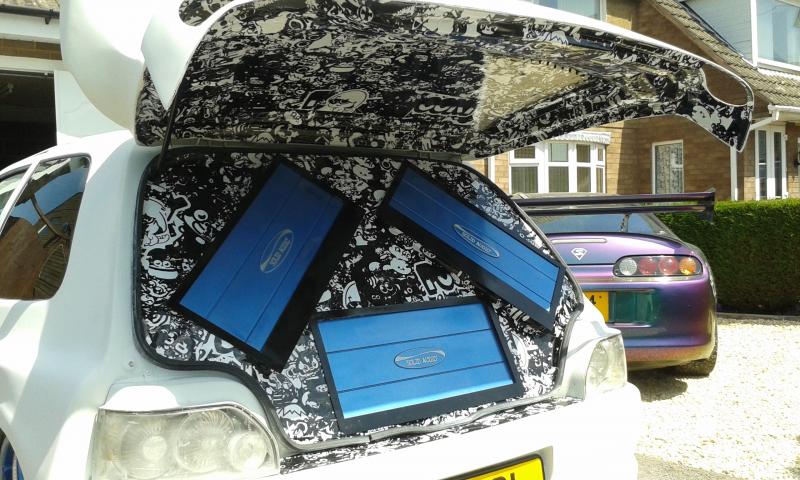

Things are coming along now. The wheels have now been painted in the final colour (Ford Vision Blue). The amp build is complete and has been stickerbombed in the same Moshi Monster vinyl as the roof which I think works well. The inlet has been painted blue with the alternator and a few bits going black
Next will be the window wrapping, sunstrip and fitting the door protectors, repainting the front splitter and bonnet pins, then it's pretty much ready for plasti dipping :)Is anyone liking how its coming along still? lol

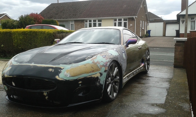

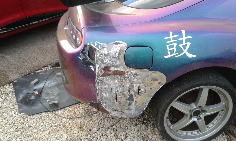

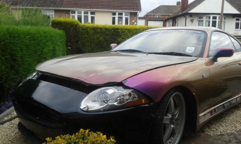

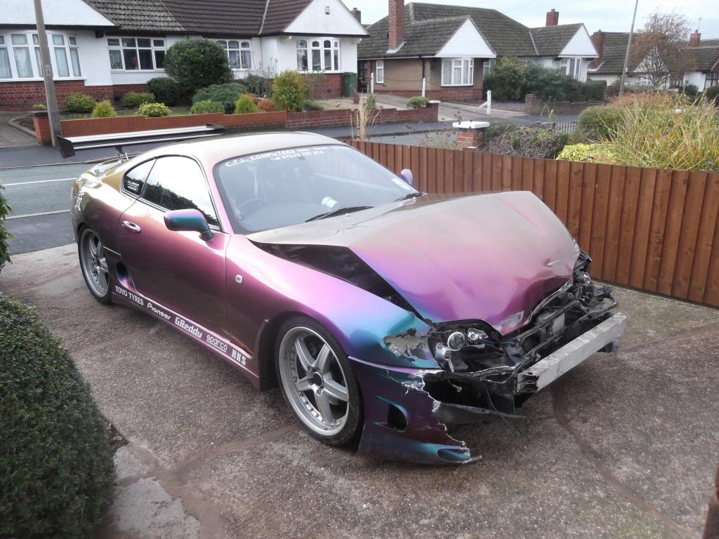

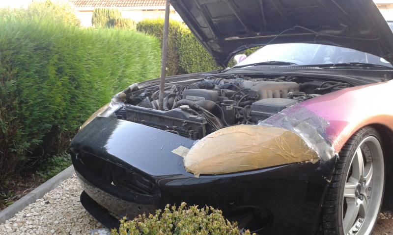

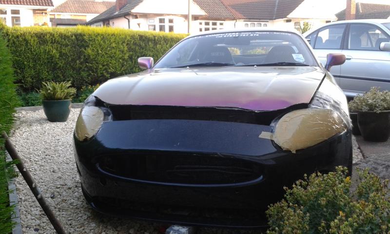

I can't remember if i ever put any pics of my other ongoing project up but here she is as i'm doing bits on this at the moment also. My Supra had a front ender so decided to go for a Jag XK conversion.
Original state after crash
And the new front end (only really just started)
  Clio Widearch
Its weird.My mate was more bothered than i was..lol. I'd had it for 5 years at the time and knew it was repairable. I've never really liked the front end anyway so it made me bring my plans to the table a bit earlier than expected

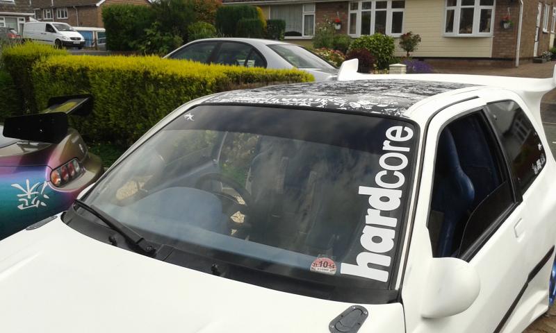

The Clio's coming along well now. The lights are now all tinted and some stickers have been added (more will be added when they're done) I have been sorting the 19" screen mounting as it was never done right (pics tomorrow) and fixed some niggly problems with the charging system and cosmetic finishing. Here's how she looks tonight:

no its only in primer at the moment. I'm having it plasti dipped gloss white so everything can be fitted and bonded to it first and then final coat done after

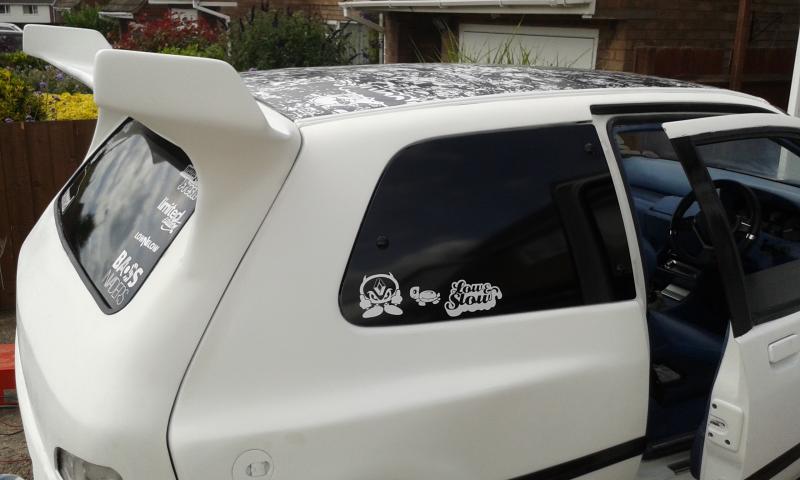

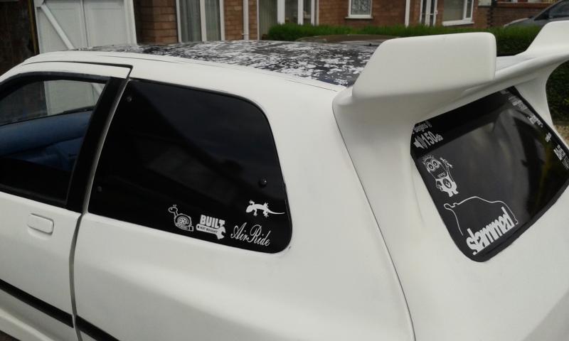

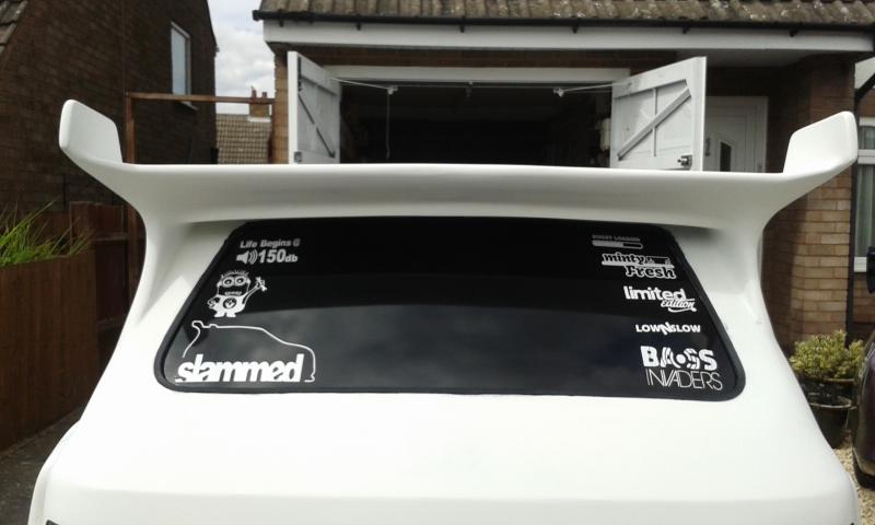

Bit more work done today. the rear vinyl looked crap so i've changed it to blend in with the rest of the build.
Old
New

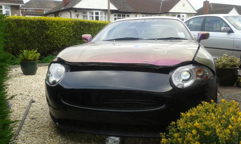

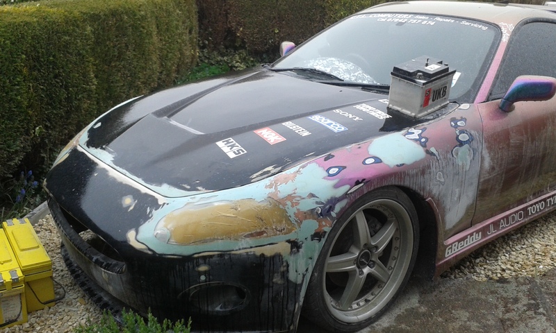

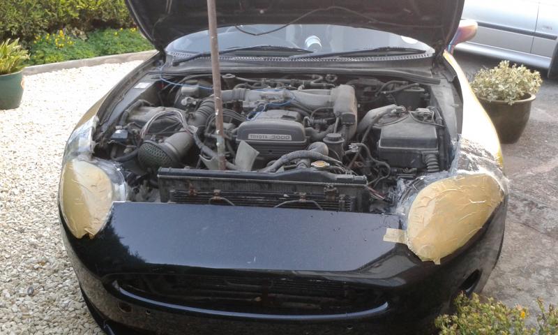

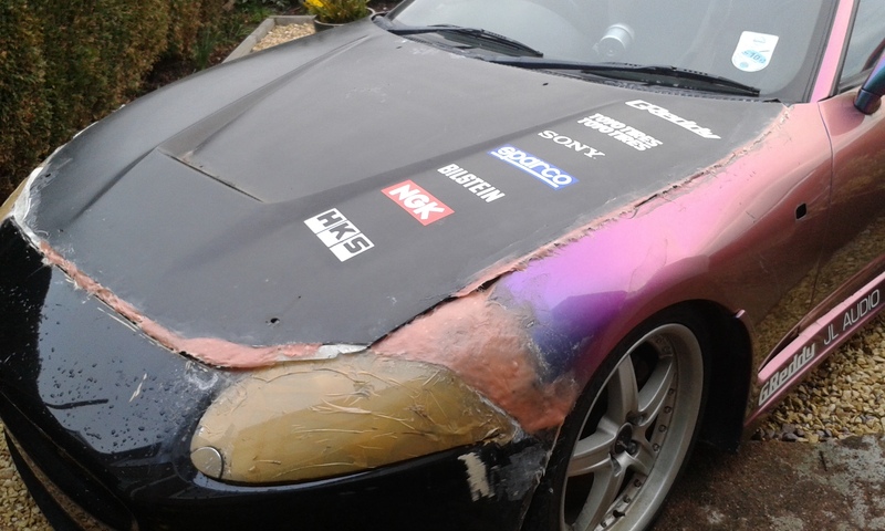

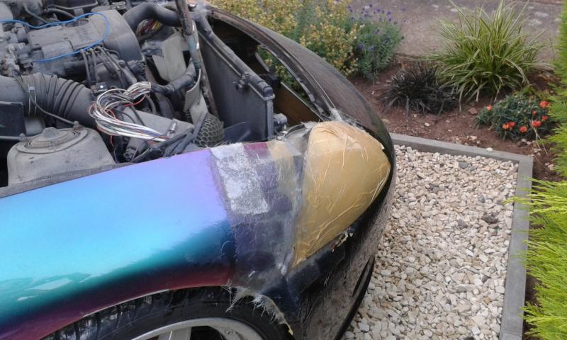

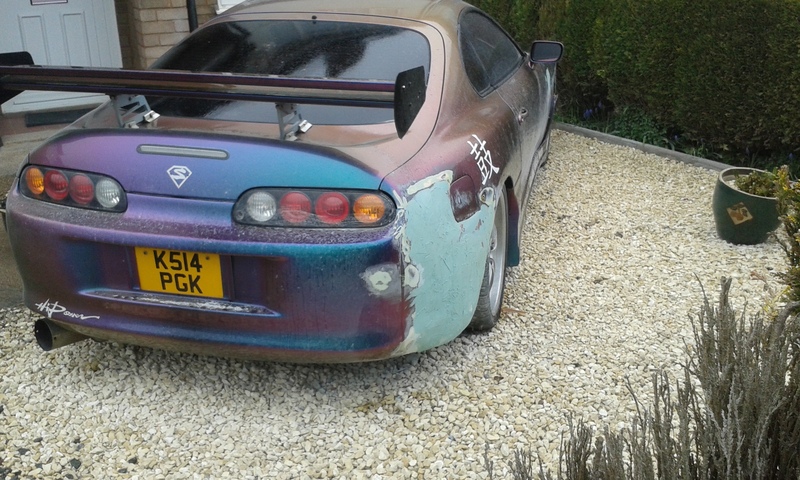

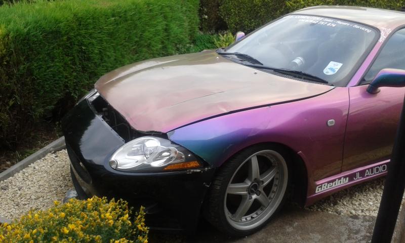

bit more work done on the supra. fibreglassing the lights in and building up the wings to meet the lights. The bonnet line is pretty much there. The bonnet will be extended next to meet the bumper and go round the lights.

You must have shares in a Glass Fibre company ;)
What's that bumper on the Supra? Why have you gone over the lights or have I read it wrong?
  Clio Widearch
saner is correct. Its having a jag XK front end conversion.
Unfortunately i dont have shares in a glass fibre company but i do get it cheap. Luckily there wont be too much fibreglass on this build. :)
Oh and on the lights...thats parcel tape. Fibreglass doesn't stick to it or go through it so its ideal for masking off when fibreglassing around them.

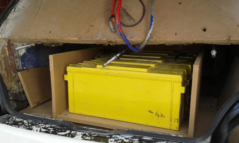

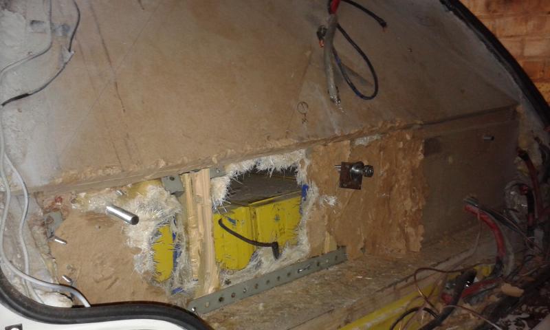

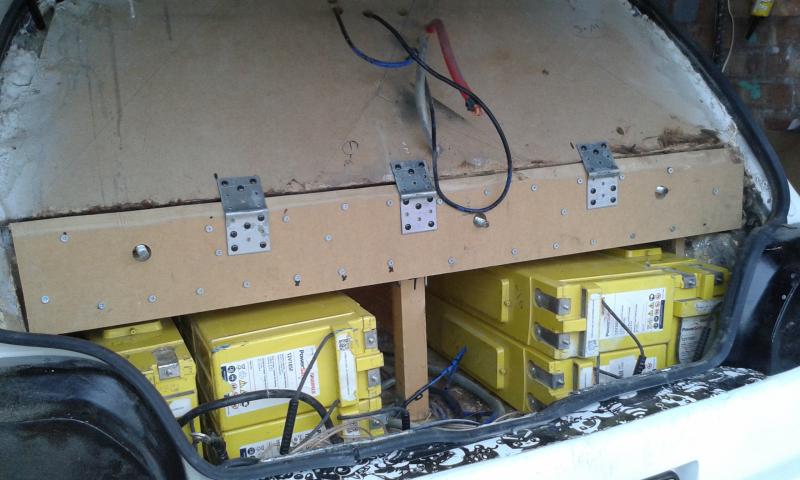

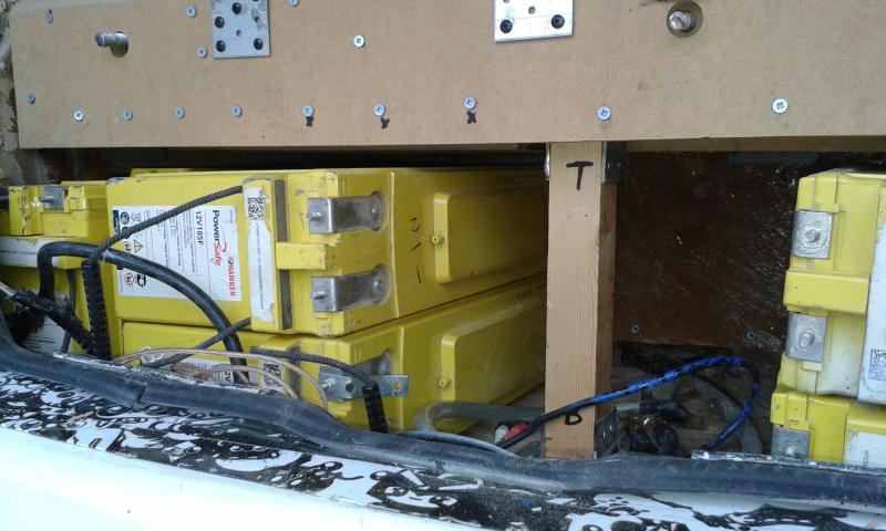

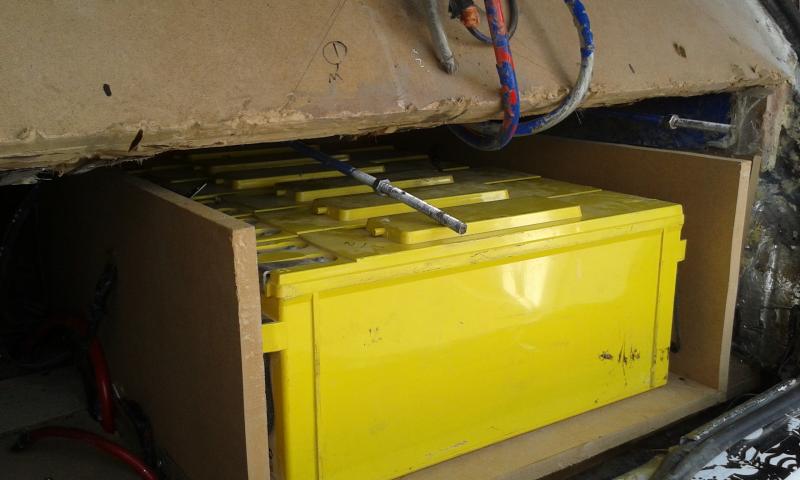

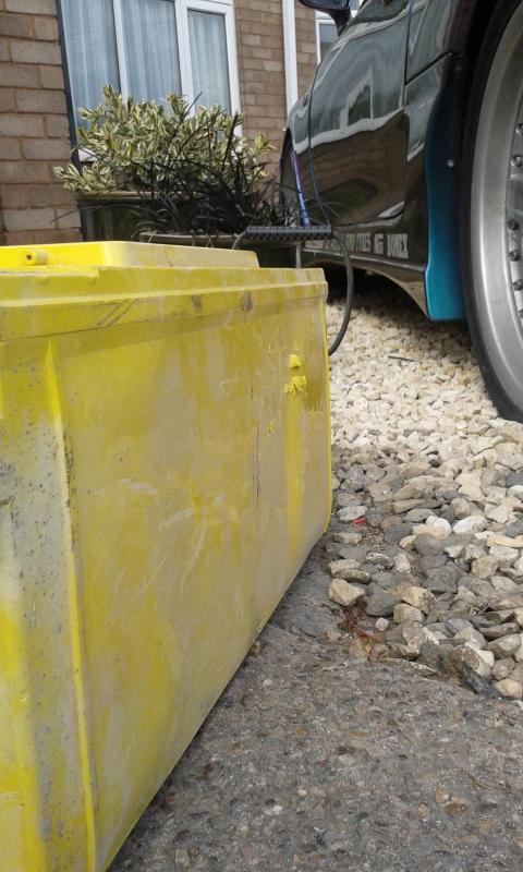

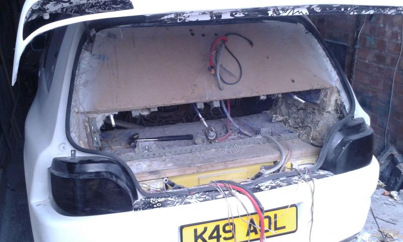

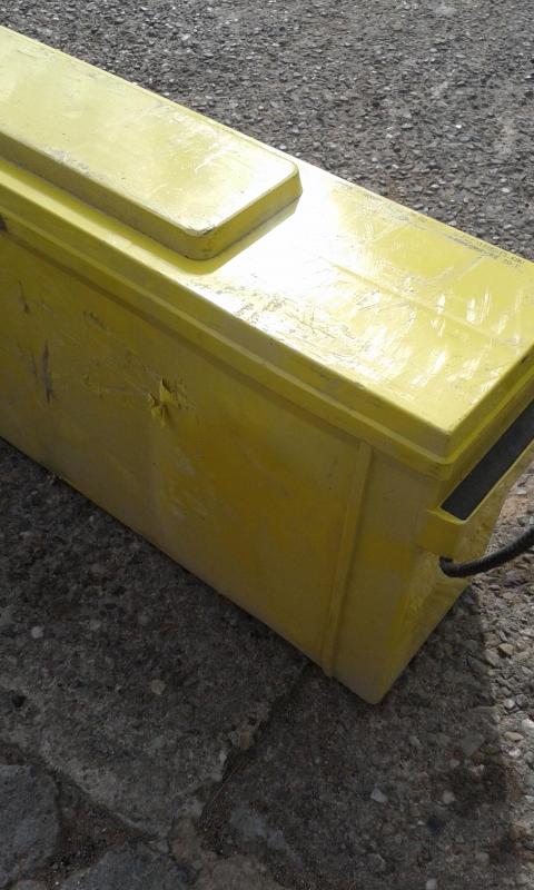

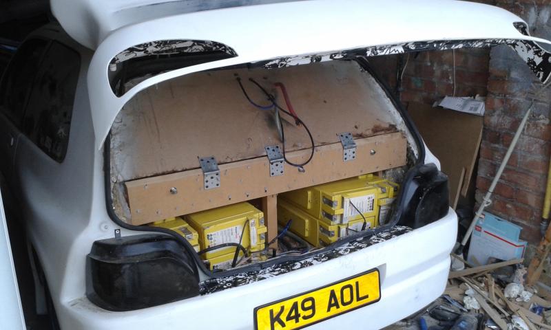

Just when you think things are going well..another problem. I had an issue with some severely fried batteries. Due to the "ingenious" way i put the system together, there is no access to them to change them so there's only one thing for it.....the rear end of the system has to come out and be redesigned...could be a long job.
  Clio Widearch
well it looks like i've found the problem. 6 of the batteries were fine but very flat but now seem to be charging ok on the charger.
The 7th one is down to 1.9volts and is that knackered the cells inside have started to swell....not good i'm thinking.
More work to come tomorrow starting on rebuilding the box and making an access tunnel for the batteries and cables.

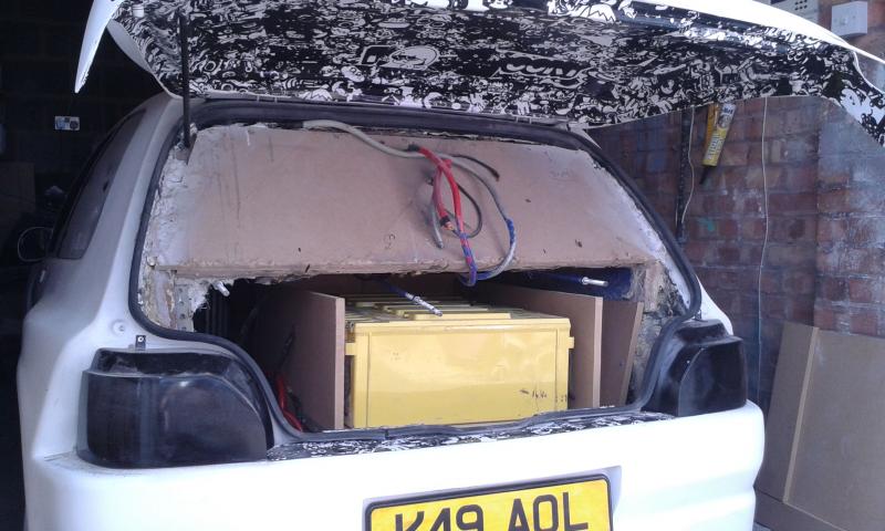

  Clio Widearch

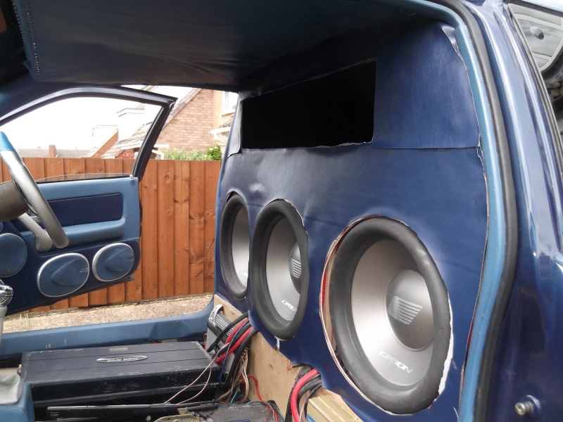

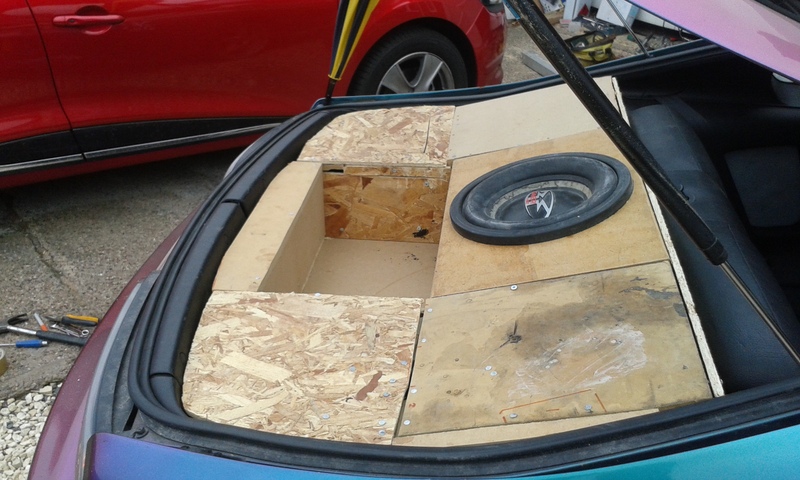

I decided to change the design as the battery tunnel would have taken up too much box space. I've done a compartment at the rear instead

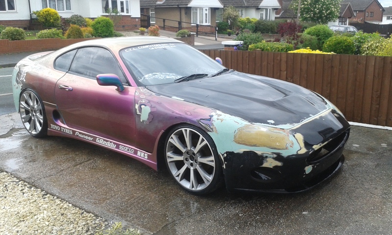

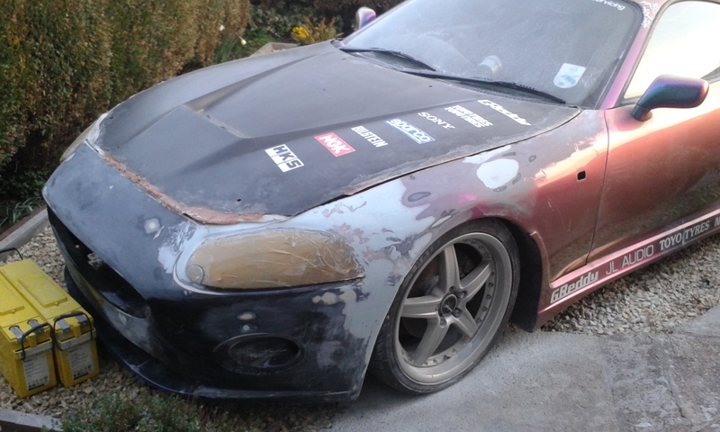

Here's the latest pics from the last few weeks....still plenty to do:
Boot build being done

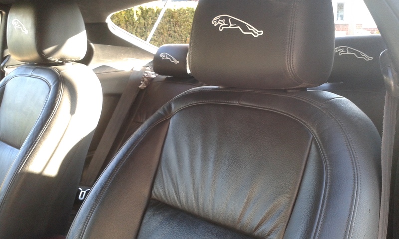

2008 Jaguar XF full leather interior with all motors working (10 way adjustable and heated)

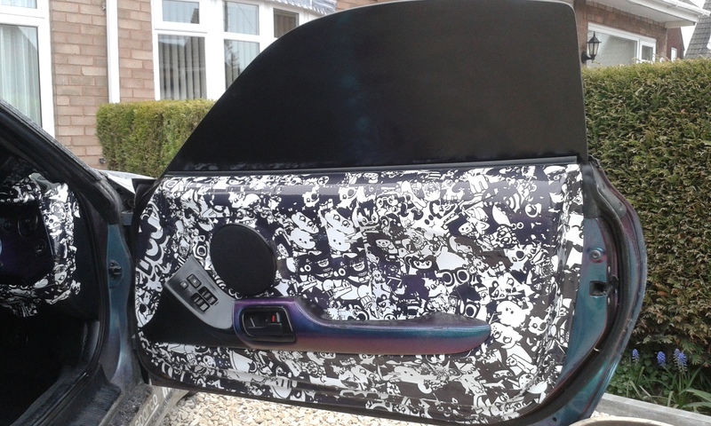

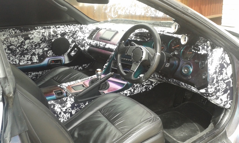

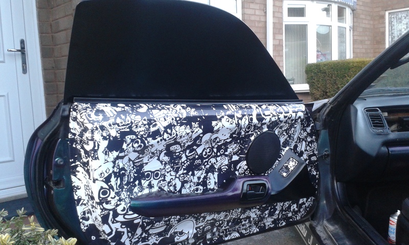

Door panels and some of the iterior done in Moshi graphics and flip paint (not to everyone's tastes I know) Work in progress

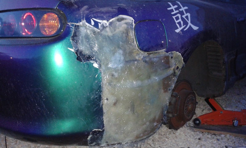

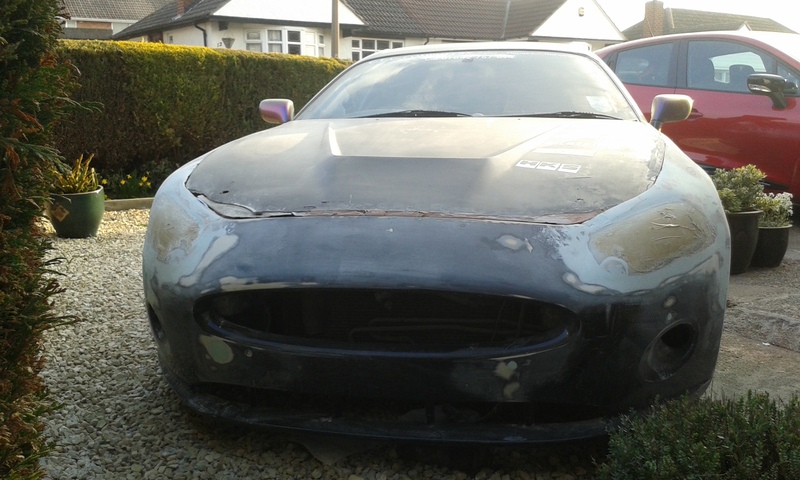

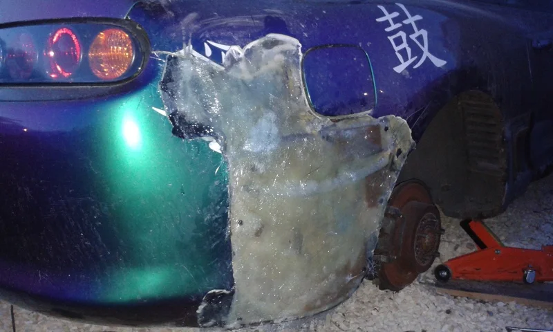

The rear end on the off side was full of filler and sat in too far from a poor previous repair but is now being done properly

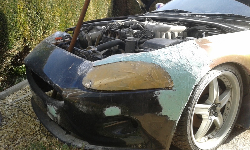

The front end is coming along well. new vented bonnet and the panel lines are coming along nicely too

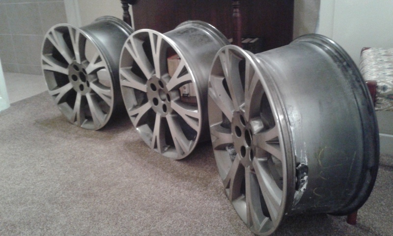

2014 Jaguar XK 20" Orona wheels ready to go on (I have 4 now) with a small stretch on the tyres and PCD adapters spaced 20mm each side front and rear

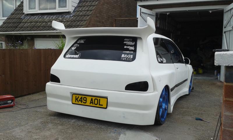

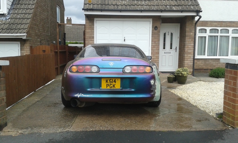

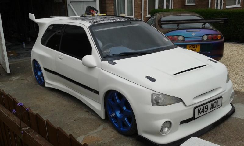

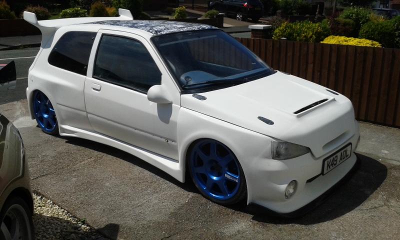

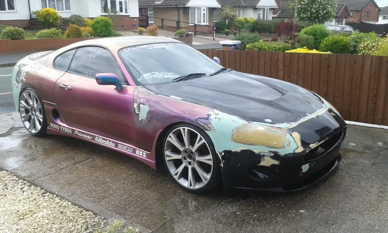

A little weekend update. Jag rims now on and interior almost finished
The spoiler is being changed to a shortened standard one
