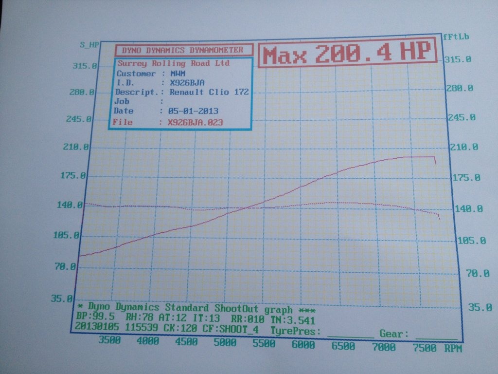

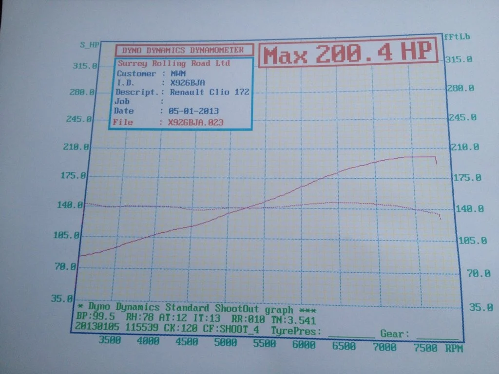

Congrats to DanPl6 on cracking 200bhp (rs2 + 197 cams)

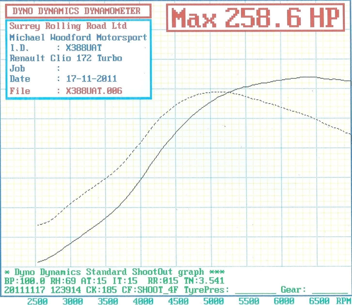

I fail to see why its been mentioned about 10 times now on this thread that turbo cars are easier to force air into, its so obvious it just doesnt need mentioning letting alone repeating again and again.
YES turbo cars are massively easier to tune, its been said lots of times, no one has disagreed with it at any point so there is no point having a totally one sided discussing saying the same thing over and over when there is no one disagreeing with it anyway.
We all know that giraffes are taller than mice, and that turbos are easier to get extra air into than N/A engines, neither of these things needs continually mentioning as if its news TBH unless someone comes along and says the opposite to need correcting.
Youre right no need to mention turbo'd cars. Just sometimes you feel you need to remind people that there are 100x better cars to tune when they are spending thousands of pounds trying to hunt figures and gains of 30bhp.
anyway, can you actually explain Laine's graph, comparing the two you actually get much better torque gains throughout the rev range with cams so its hard to justify spending the extra thousand on this manifold for inferior gains.

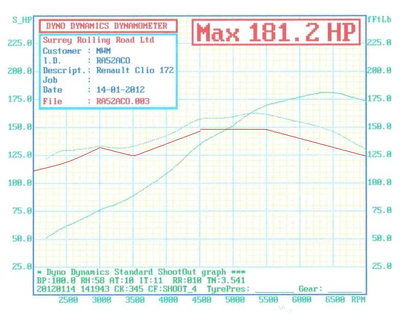

That's exactly why I use Surrey Rolling Road.
They have no interest whatsoever in fudging the figures as they are no way linked to me. I just show up, pay my money and they dyno the car! Charlie literally couldn't give 2 hoots what the figure is.
They also have a Dyno Dynamics rolling road which are also very respected.

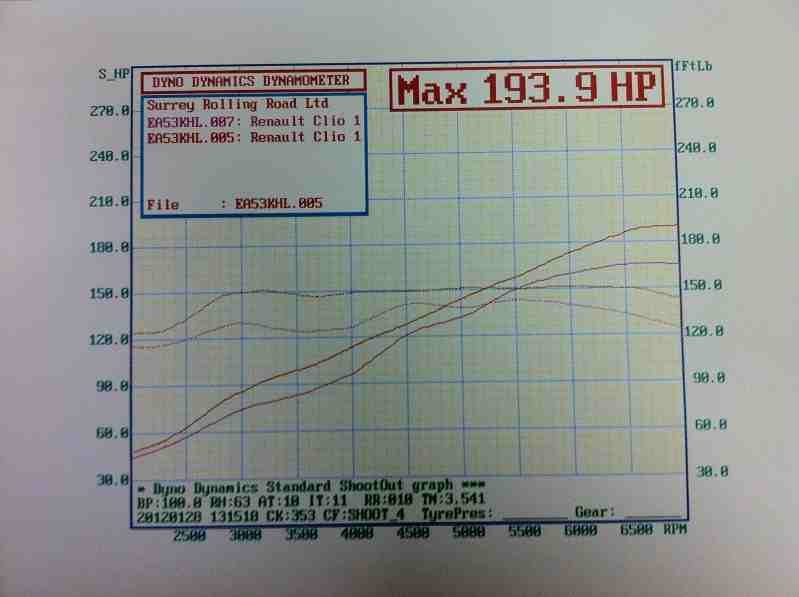

I have a standard inlet laying round and a set of 438's. I'm temped to get an overlay graph with my engine on the same Dyno to end this for good.

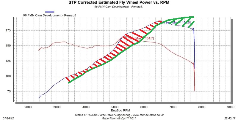

OK, MWM thread is closed, so ill post here, direct comparison GT Cams package vs MWM's graph. (£1000 fitted + £300 map) vs RS2 + 197 cams £1000 RS2 + £300 map + £150 cams
Whats better value? (green = RS2 gains, red = RS2 loses). No ive not cheated the green line either.
I think thats a really good comparison laine and it shows clearly that each has their own point where they are better.
I think its probably slightly unfair comparison to compare a car from the dyno of the people who mapped it, against another car on a totally indepedant dyno, so Im sure you are sensible enough to realise that (especially given that Mikes wasnt even properly mapped he just put it on out of interest half finished to get a figure before taking it off) if you were to use a more level test (ie both fully mapped and on the same dyno) the two areas would be a lot nearer to being the same size (although I think the cams would still slightly win as it happens)
As mentioned before though, if you want to rev a car hard on track as you are coming out of a bend and dont want to upset the balance of the car by dipping the clutch its very obvious that the RS2 gaining where the standard engine suffers so poorly at the top end is going to give a nicer drive than a set of cams that instead improve it at the point its already good to drive anyway.
Two very different ways to skin a cat, and IMHO no clear winner between the two, each are suited to different driving styles and uses, I have driven cammed with standard inlet and RS2 with 197 cams both a lot, and to my personal preference the RS2 wins, especially on track, but I am sure others will have the opposite preference.

Laine, as you are good with photoshop, can you do me a favour please?
Will you take your car before and after 438 cams and do the same "here is where it gained" comparison, and then do the same with Mikes car before and after the RS2 and the cams?
I think that might make for very interesting reading?
I can try tommorow, id be happy to. I know where this is going though, i remember seeing the direct comparison screenshot on their dyno computer between my stock car dynod about 2 months previous vs 438's and map. the gains were pretty much... not there, i was dissapointed, literally talking 1-2ft lb's tops (peak gain of 3ft lb). I'll be the first to admit that was a big waste of my cash.
Dont think Mikes posted his graph before his cams were fitted?
Laine, the reason I want you to do it, is partly to balance out what I feel is an unfair comparison you have done one way with an unfair comparison the other way, so that when the RS2 and 197 cams on those two particular examples makes about five times the gains in area that the 438s have done, I can point out to you that you shouldnt be comparing such different cars to start with, as that time you will agree with me, and yet when it suits the argument you are trying to put forward you will happily compare two totally different cars on different dynos one of which is independent of the not fully mapped car that went on and one of which is owned by the person mapping it!

Hey laine, excuse the slight crudeness of the graph, but what do you think of the gains here, excuse the crudeness of the line Ive added but it is a reasonable copy from a standard car graph:

Wow! This thread has exploded!
i didn't follow the whole discussion, all i can say is wow at the graph of Dan!
can't even call it a torgue curve, it's more a torgue flat :p

Just for comparison for those who are interested, standard 172cup run over laid with same car with RS2 on same rollers.
