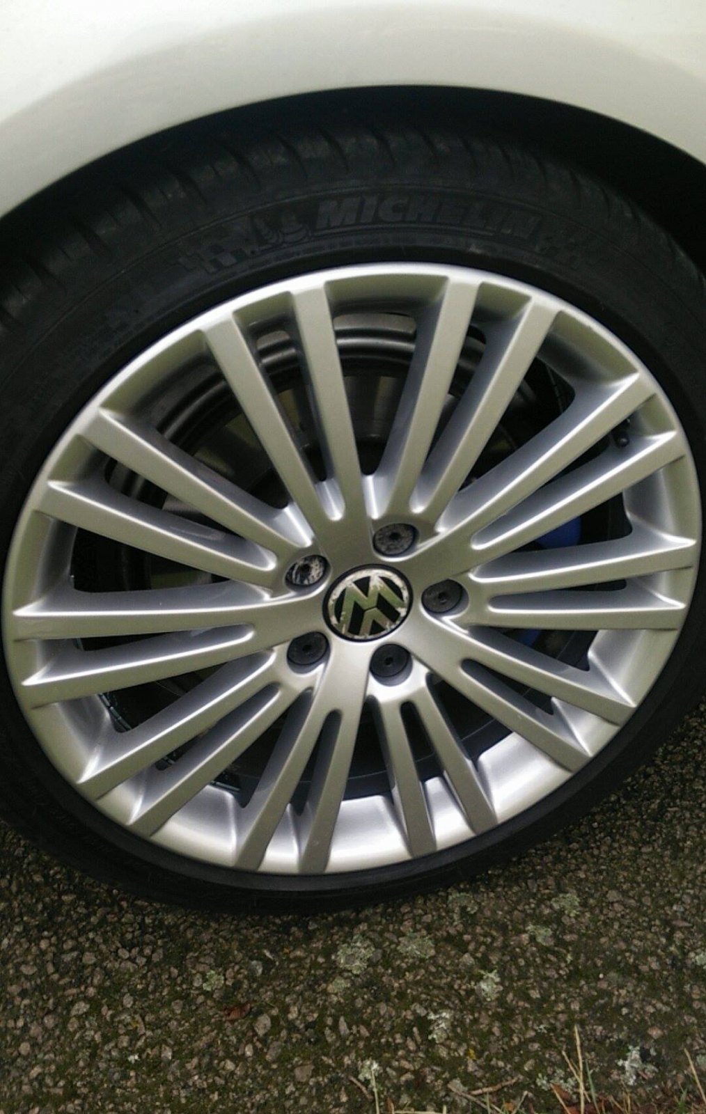

Still own this piece of s**t, somehow.
Wheels were refurbed today at Paint It in Billericay, finish looks pretty good.
We'll see if it solves the issue with the constant tyre deflation.
Haven't taken a proper picture yet because the car is utterly filthy (outside hasn't been cleaned in 6 weeks at least)
Here's one of them:

Those aren't the wheelnuts Ginge, those are wheel bolt covers made of plastic. The bolts are probably worse.

Wheel refurb was 285 all in
