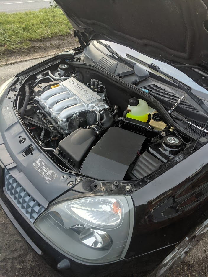

I've just caught up with this, it's done two things-
1. Made me really unhappy with my engine bay.
2. Given me a bit of motivation to get stuck into it again.
Im actually not that happy with the bay yet, there are some other on here which just look so mint! But glad its offered some motivation.... its demotivated me to ever do this again haha. But tbh once you get going they are so simple to do
Not so easy on my sloping drive! I cringe putting mine on axle stands, I always check wheels/leave in gear etc for added security.
I'd be happy with that bay, mines not awful but the engine has stayed in meaning some bits just aren't accessible. I should have put the effort into a clean shelled example really but a respray would always be nice if I can get it done at a semi sensible price, I consider it 'pre-dented' to save the disappointment 😆

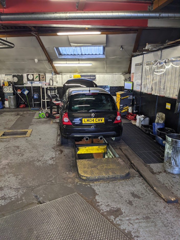

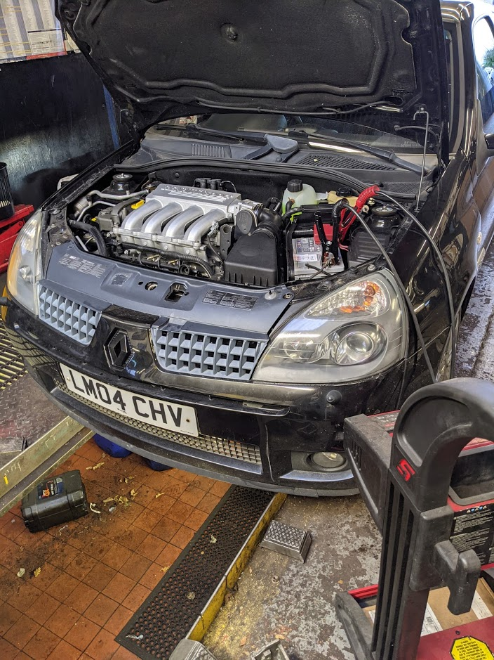

Couple of bad shots mid fail. Got there and they had the charger on which was good, meant I could drive home at least. And luckily passed emissions so new injectors and old cat are doing find.
Drive home was good, car feels super tight now and seems to pull quite a bit harder than before so guessing dephaser was well past its best (it was very noisy). Need to get tracking done as soon as it has a legit MOT then I'll get the TH's on. Was impressed by the lack of horrid NVH, assumed with poly bushes in engine mounts and slightly stiffer springs it would be horrid but feels absolutely fine to me.

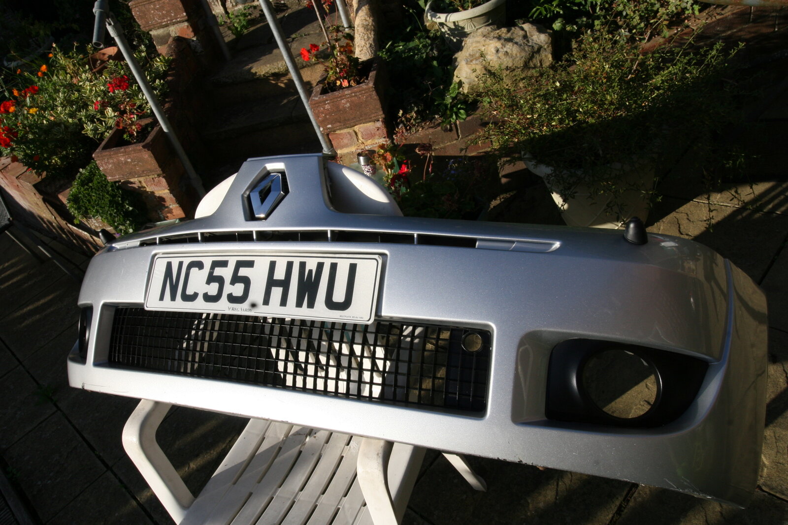

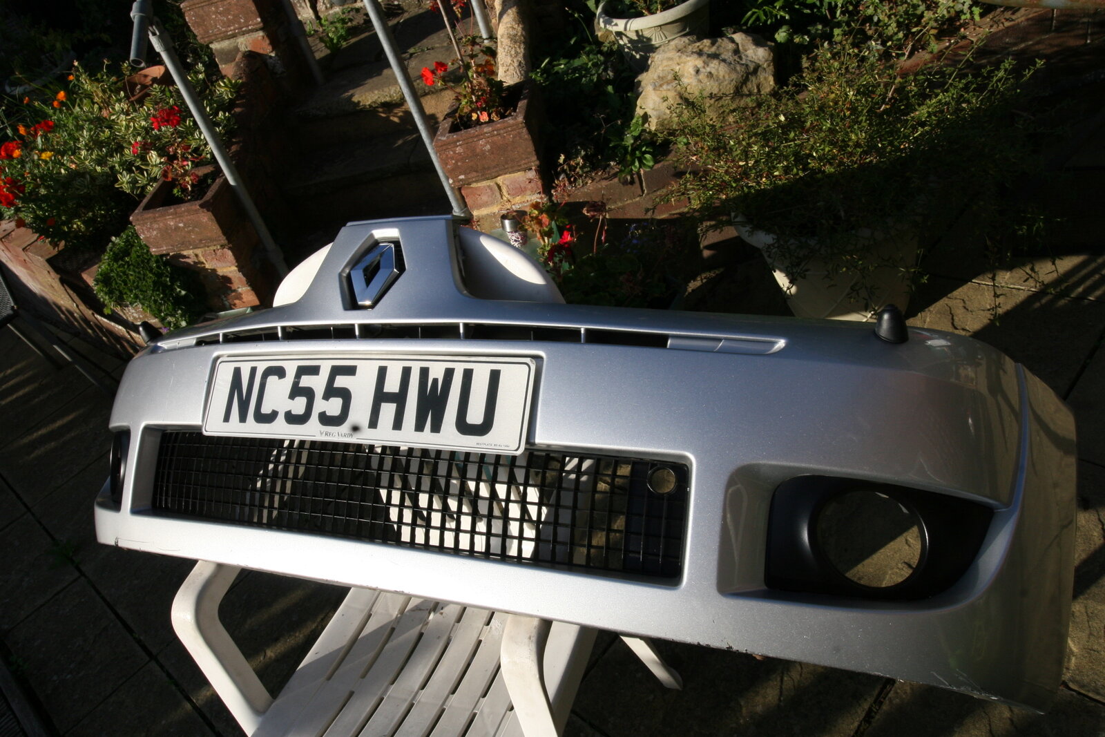

Trying to decide if I should paint the grille black on not....
MLB
Seems to me that the grille is the exact same colour as mine, even after treating it with Gyeon Trim.
Altough satin black would probably look nicer I think they should be grey.

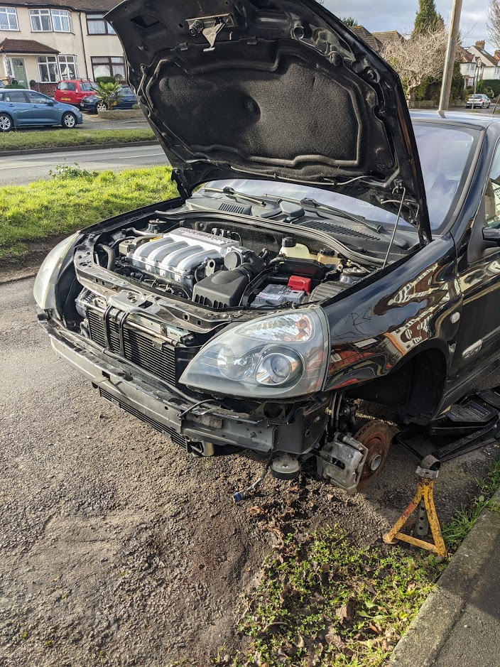

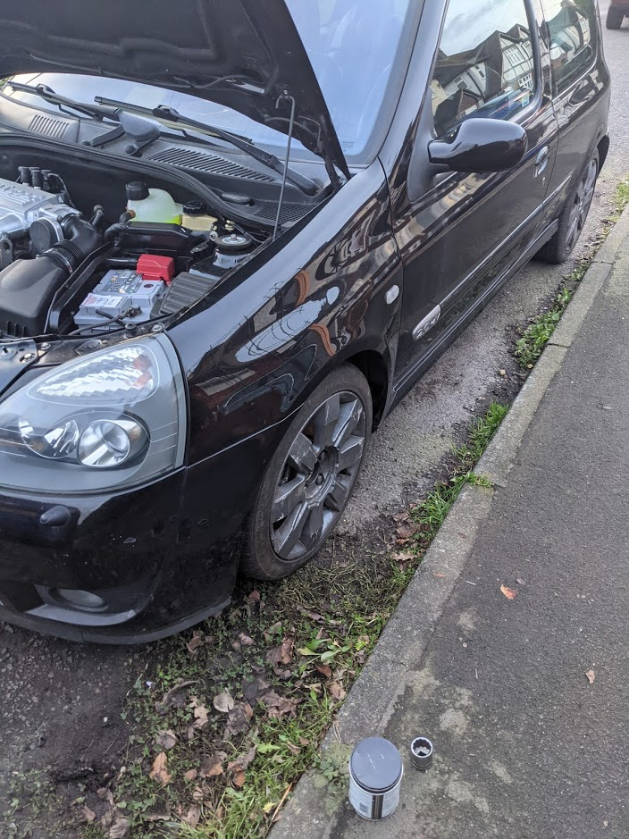

Shocking day. Set out to change CV joint boot so I could get to the retest tomorrow. After swimming in CV grease for a while I managed to just about get the Universal boot on (was slightly too small).
All done, hub a bit hard to get back on as the CV didn't want to seat properly, figured it would just pop back in of its own accord on its first drive etc.
Reversed off the blocks, went to drive forwards and nothing but grinding - f**k nuggets. So I (because I was too lazy to take the boot back off to seat the CV joint properly) have stripped the end of the driveshaft and filled the brand new CV joint with swarf. Brilliant.
Had a paddy, removed the joint and slung it back together, ordered a new genuine shaft from Ktec because the J&R site didn't say anything about cup packs blah. Car blocking neighbors drive, on a hill and I couldn't push it back up alone had to wait for him to get home. So now, car is siting on the floor, undrivable with an unpreloaded new bearing (great).
The hour long job turned into an all day s**t fest, and I didn't even get round to fitting the new alternator. LIFE.
Klumpy Dumpy
Not all gingers stink of piss. But I do.
When you roll it jack it up and take the weight off that wheel. If not you'll f**king kick yourself mate
Oh and for anyone else doing a CV boot, take the shaft off the car and you can take the spider off the splines of the shaft and get a proper boot on there. Do it nice or do it twice

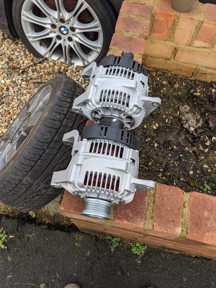

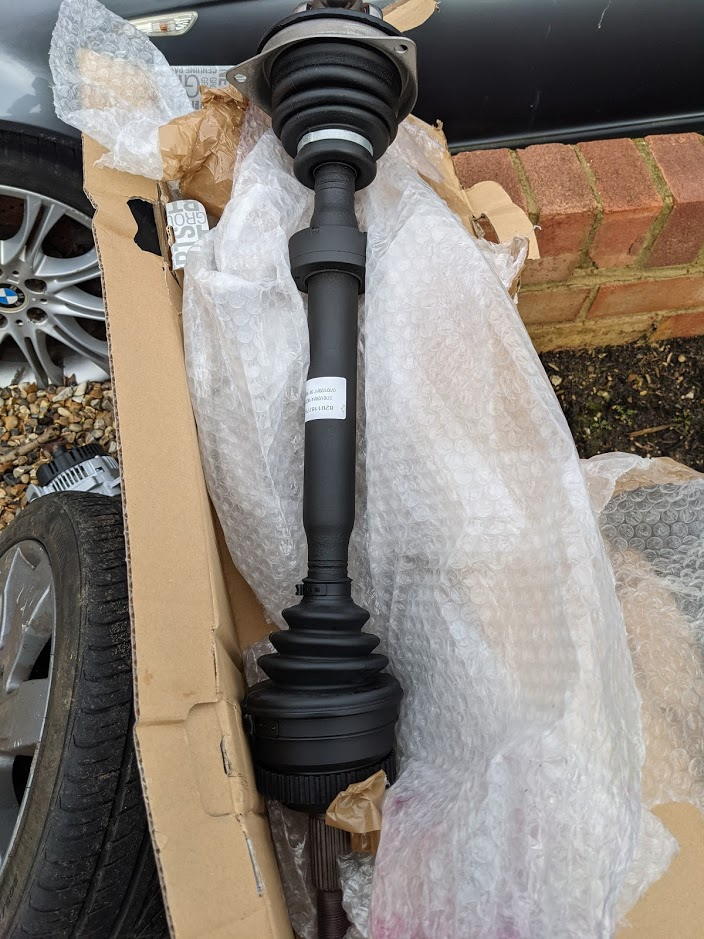

So its been a long wait for parts.
Ordered a new Renault driveshaft from Ktec before xmas and it arrived a week or so ago. So Sunday was the day to just get on with it.

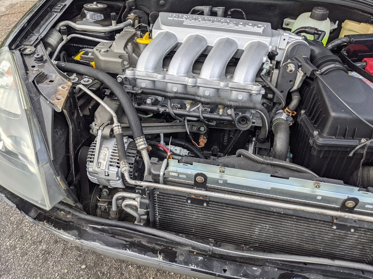

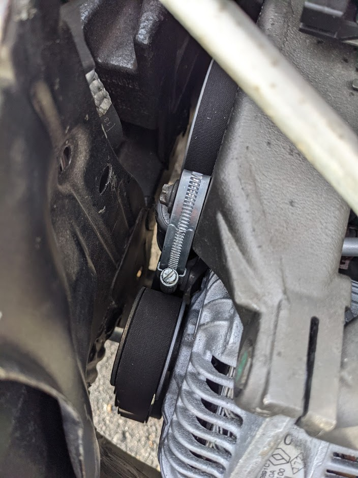

Managed to get new Renault alternator fitted in about an hour while box oil was draining
Jubilee clip around the tensioner worked a treat
Cleaned all the connection points well together with the main earth strap, these ground through the block so intermittent or poor connection (due to some pleb painting everything) will do the alternator no good at all.
With the box drained it was time to bash on the new shaft
I gave it a good coat with dinitrol clear so we shall see how well it lasts

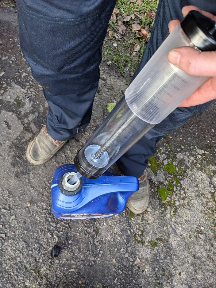

Originally I bought a large syringe as I was going to reuse the nearly new fluid, so suck out of washing up bowl and squirt back in. On closer inspection the new fluid had a few brass sparkles, not too surprised as the box was freshly built so instead just refilled with fresh. Syringe worked well, will be using it in the future!

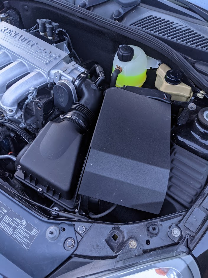

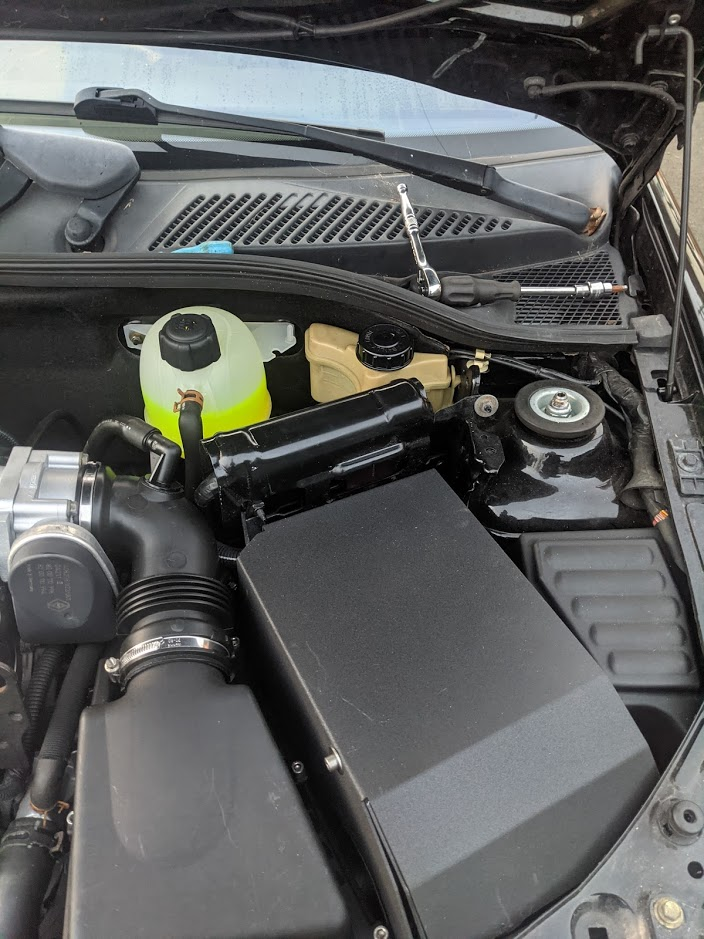

With the car rolling again, and the battery charging there was just enough light left to attach one of the nice battery covers. I've had it for a few months but didn't (obviously) want to install it before fitting new battery and alternator.
I think it really tidies the bay up well
ECU cover back on
Need to give the bay a wash when the weather warms up but its looking alright.

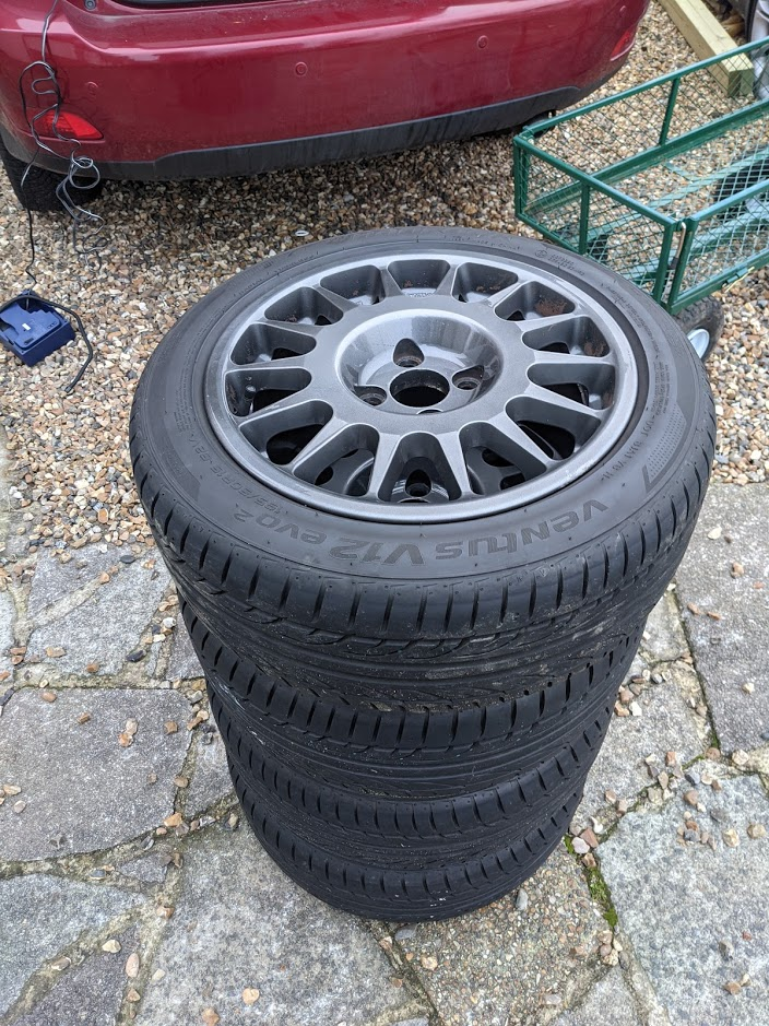

Next jobs are to clean under the arches and refit the liners so I don't ruin all the work. Then its all getting aligned. Spacers on order, so once alignment is done the new wheels are going on.
Once it warms up a bit I'll be sorting body and interior but for now I've got a legal Clio once again :cool:
