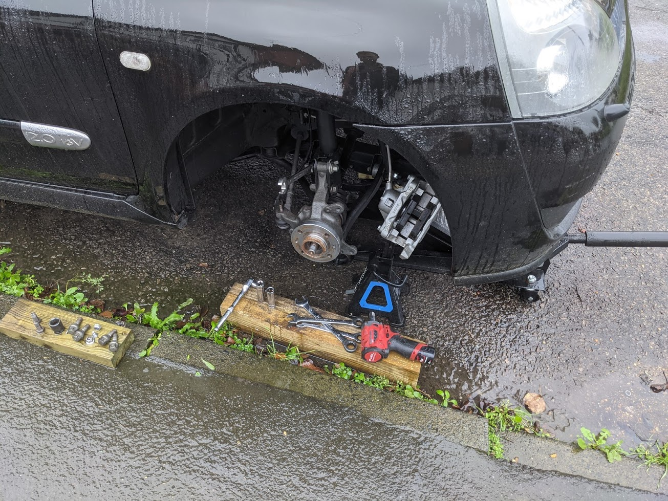

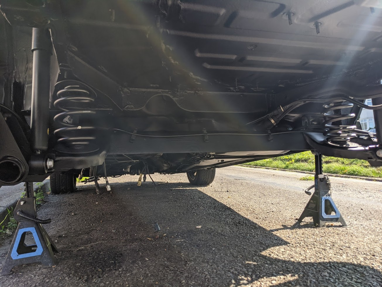

Jesus - where did we get to.... I've done a fair bit more to the car since the last update. Had to take a break to sort out a few house bits.

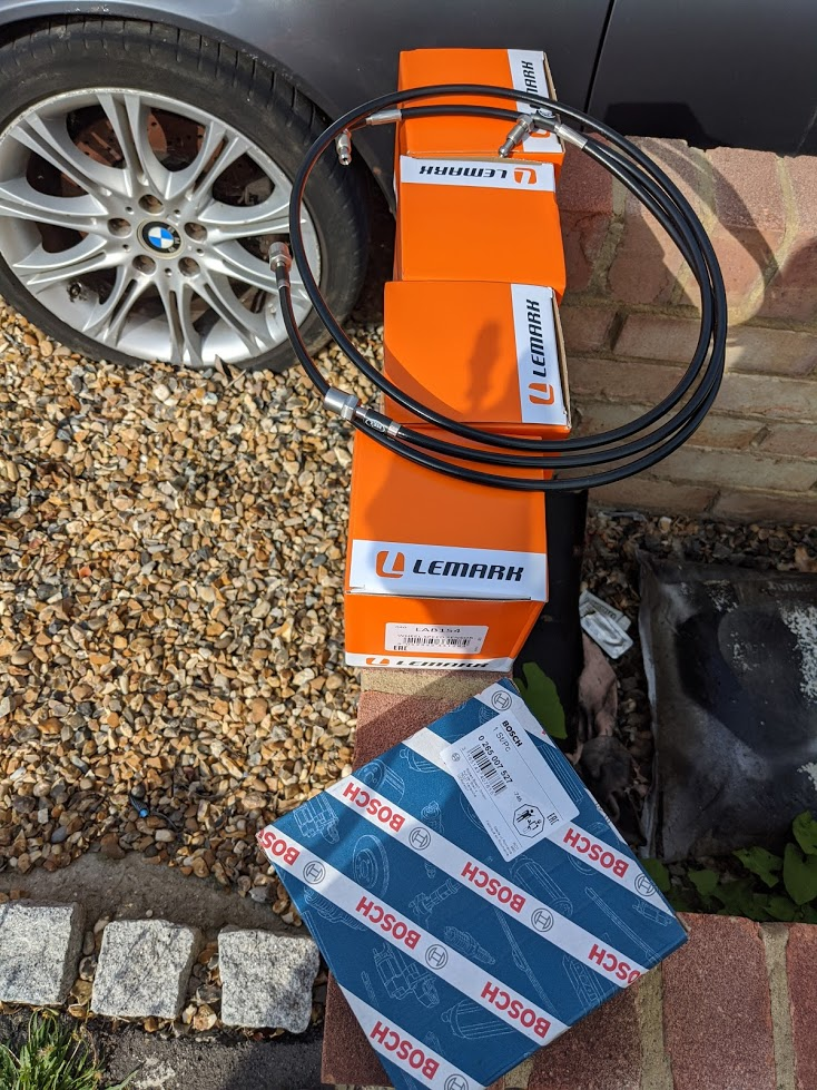

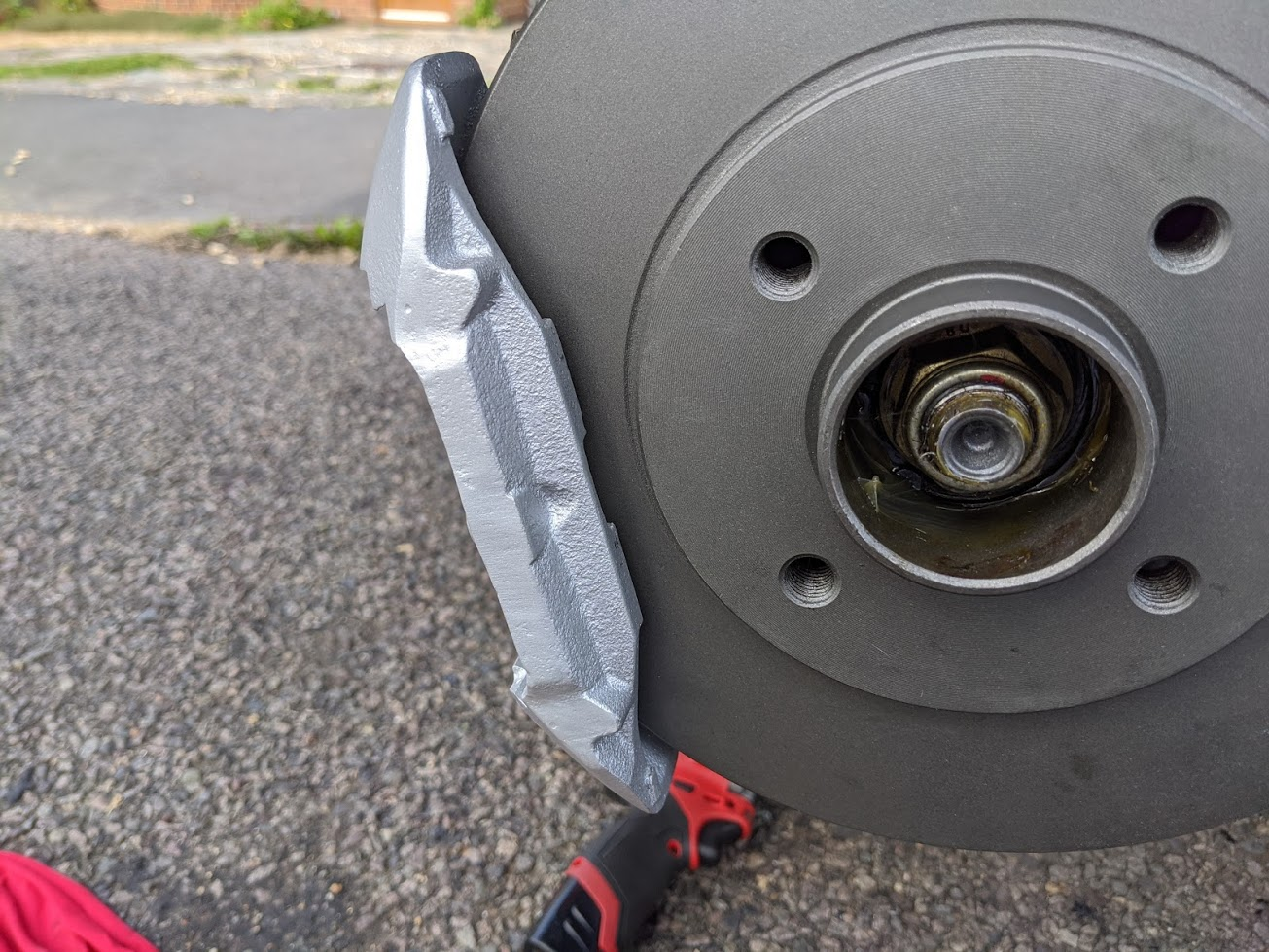

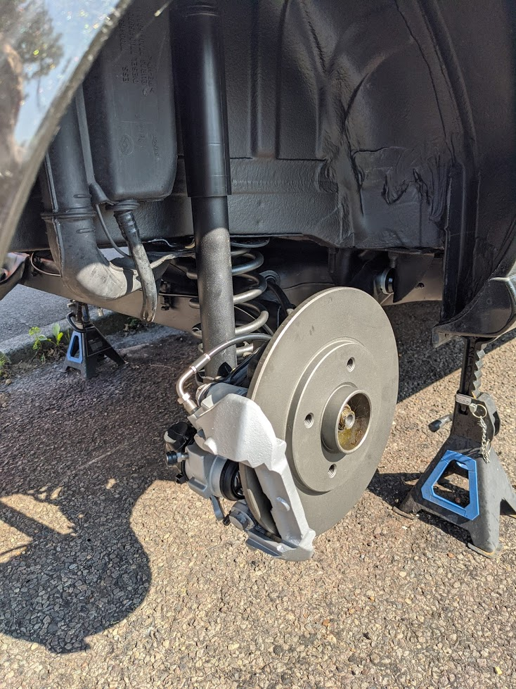

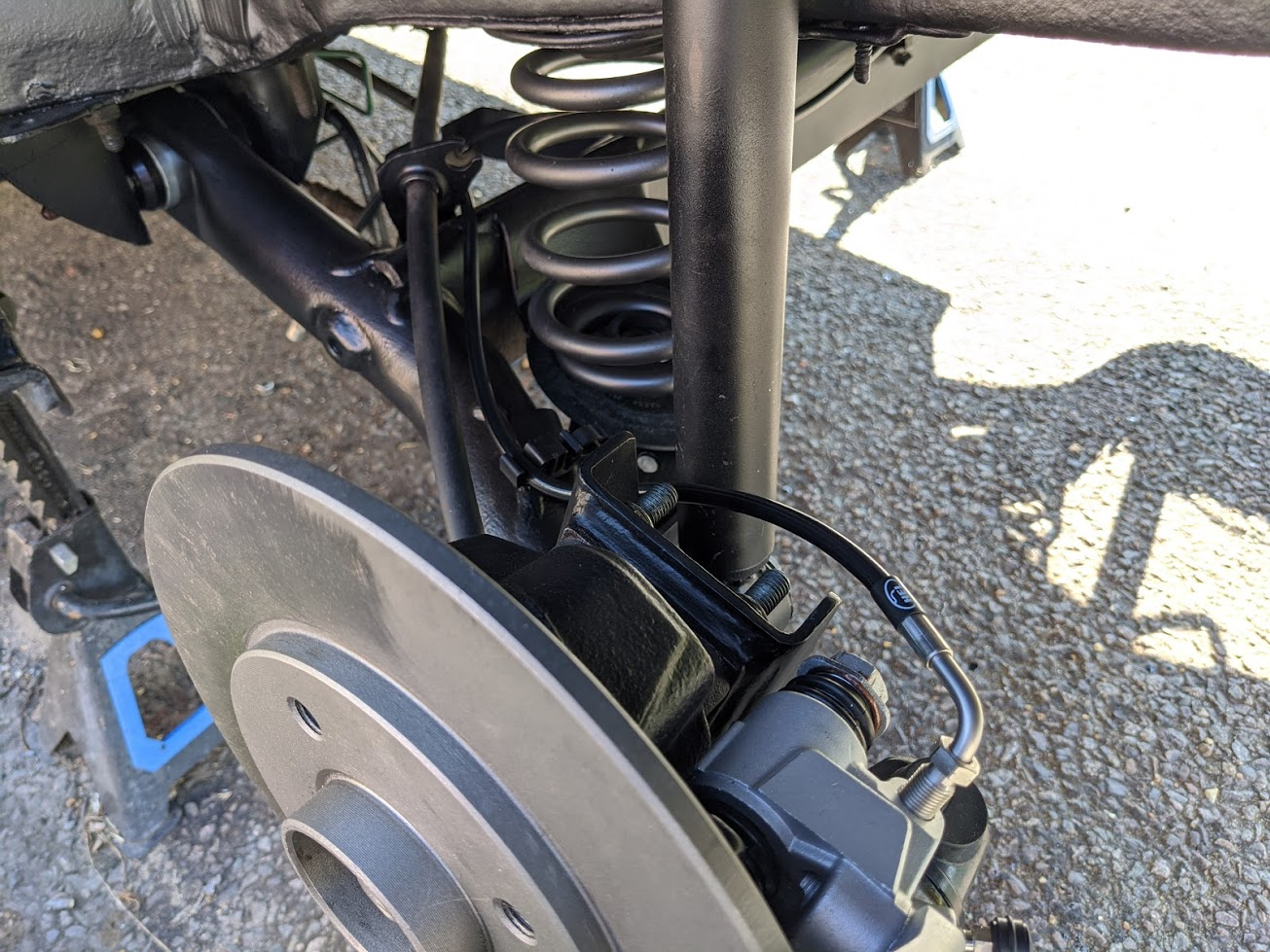

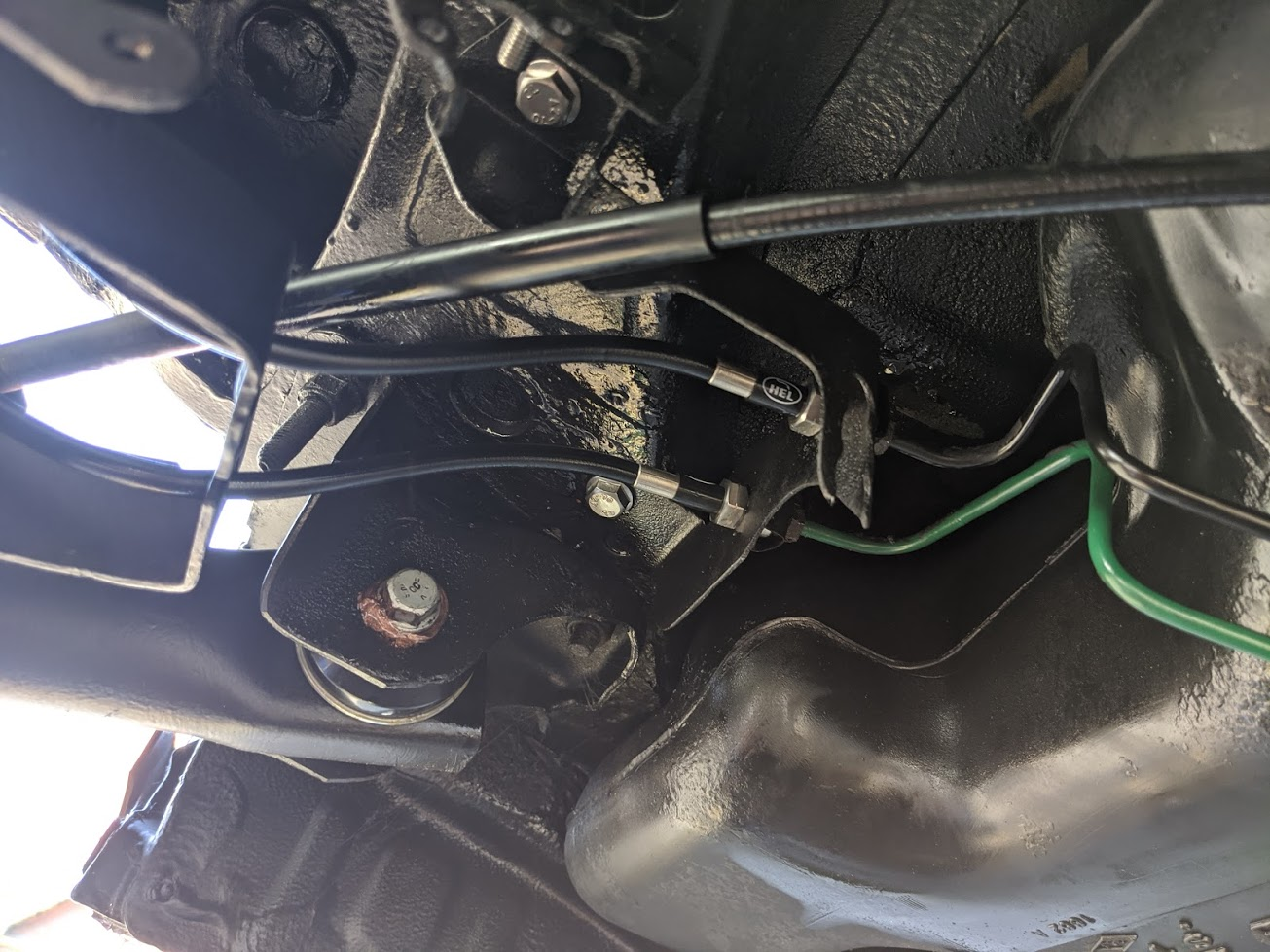

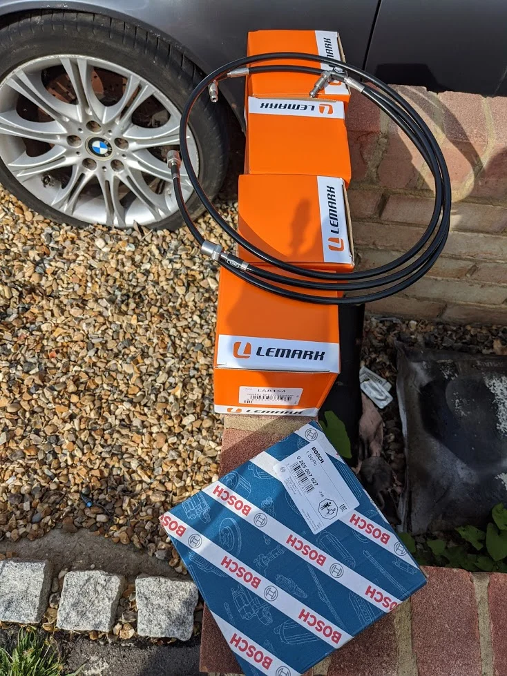

Got the rear brakes and new braided lines on the car
Took an eternity to find the right type and length of ABS sensors but after buying 6 finally got it right

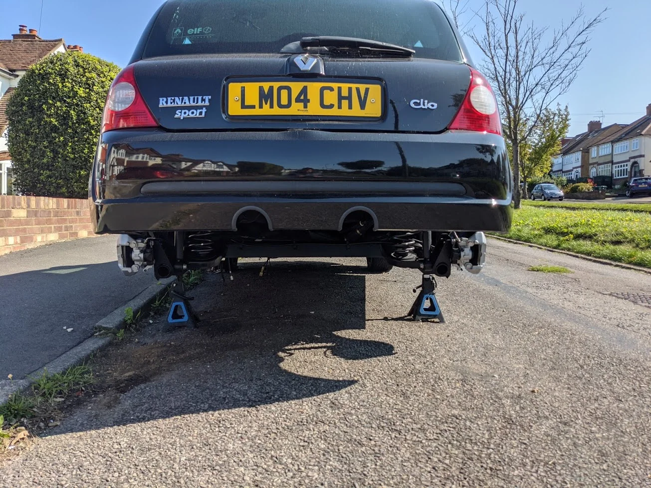

By this point the rear end was really starting to come alone

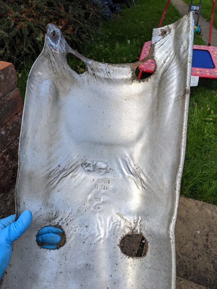

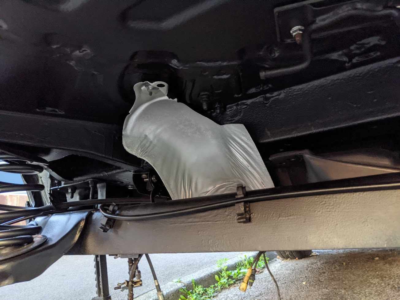

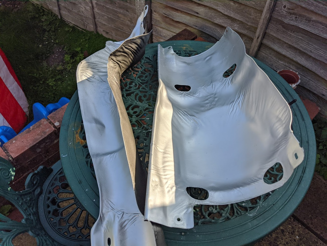

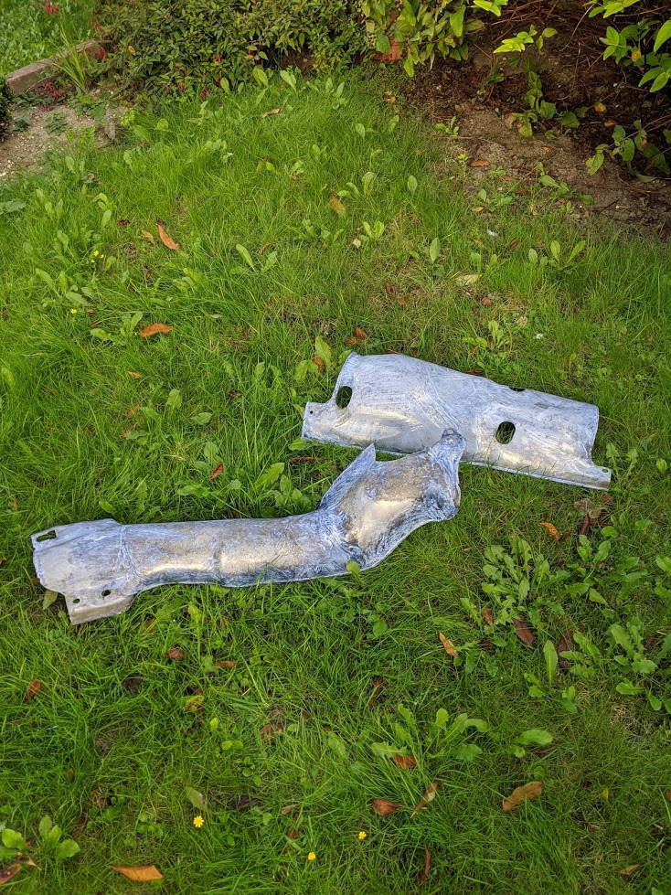

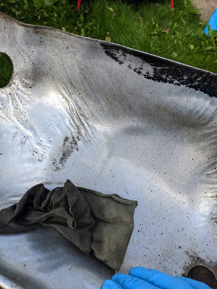

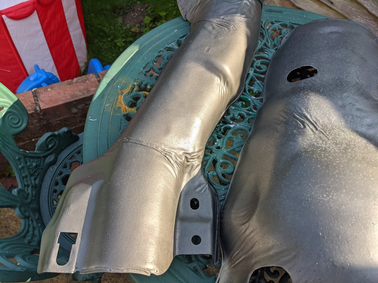

Next up wash the manky heat shields
Decent scrub with degreaser
Treat any corroded bits - seemed to do F all.
Starting to run low on fancy Eastwood paint, so backside is one colour, t'other side is another... hope the mot bloke doesn't complain haha

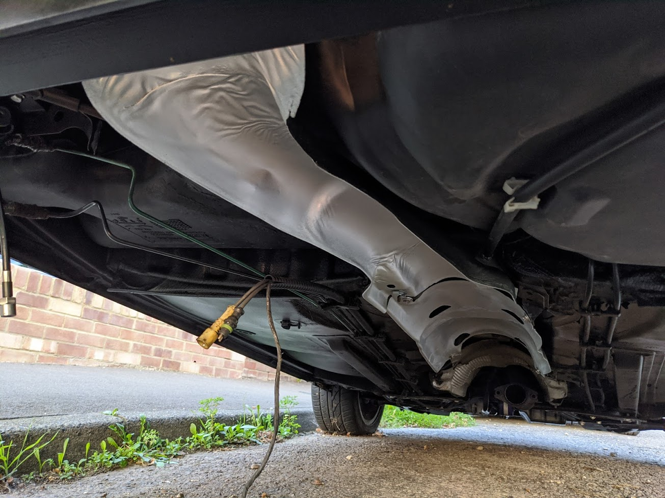

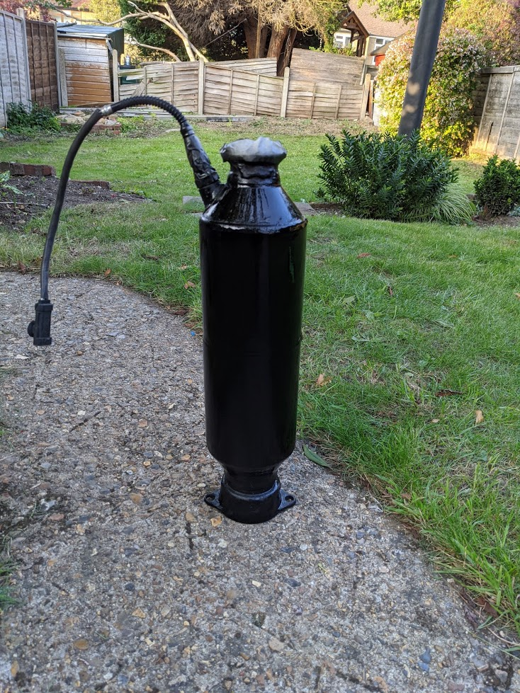

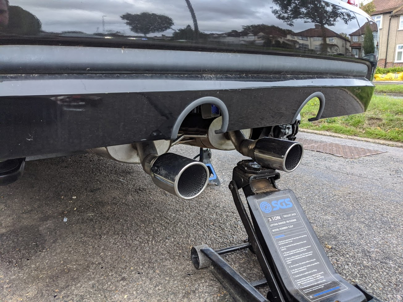

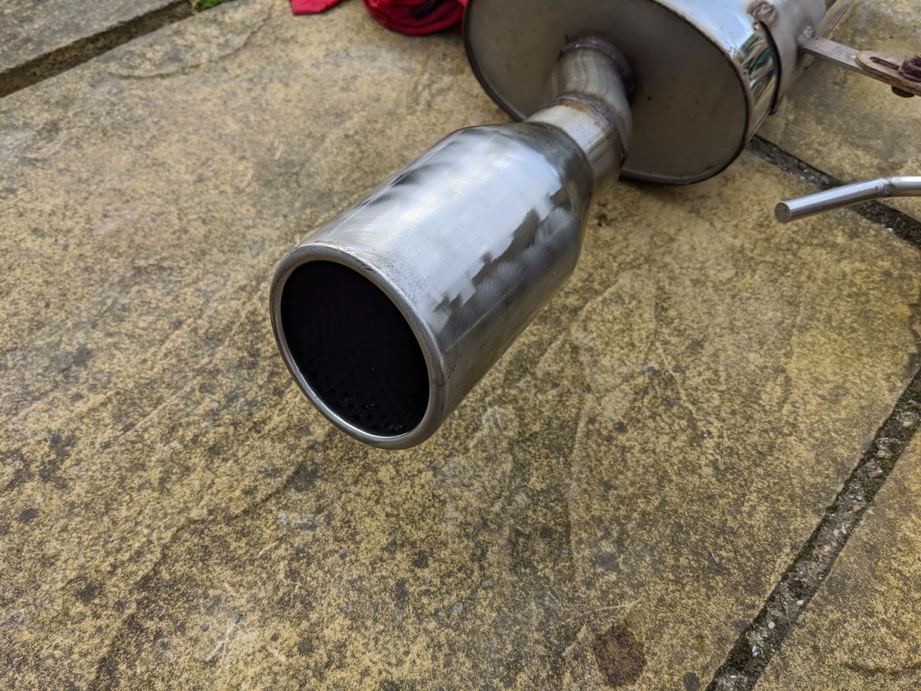

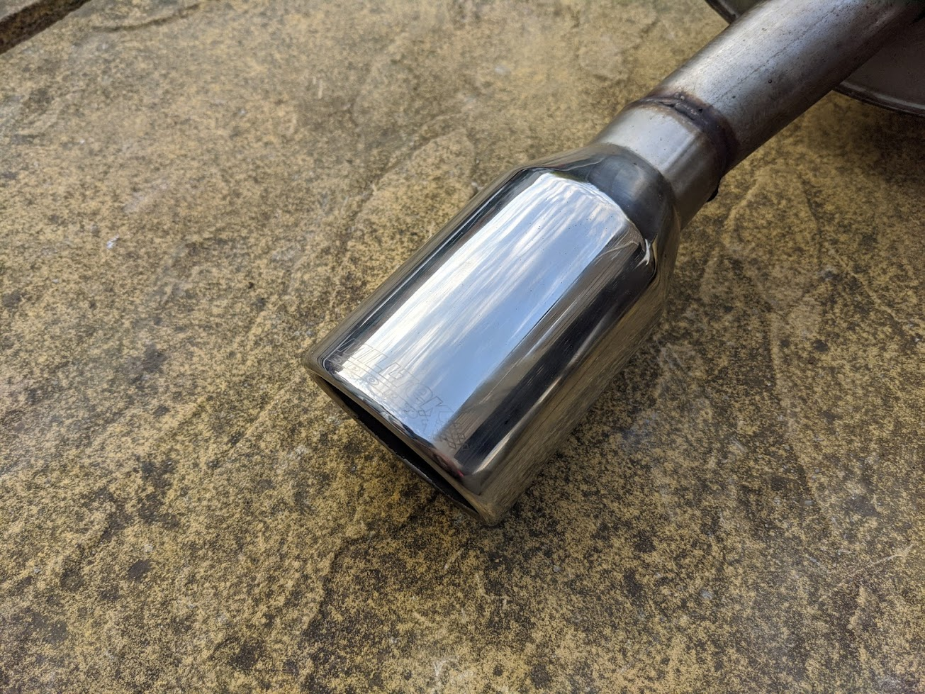

Bought a used Miltek system after trying to buy a new RS192 which was out of stock etc. Happy it was to be honest, after 3 weeks of waiting cancelled the order and next day this popped up, half the price and in good shape!

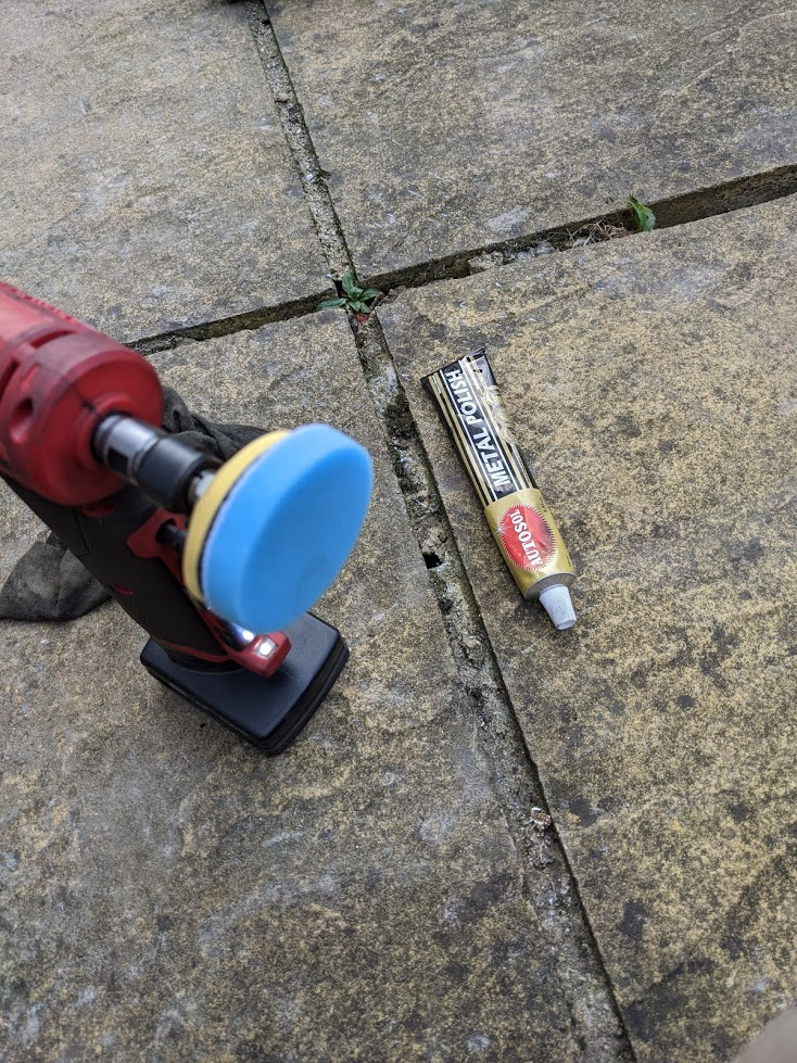

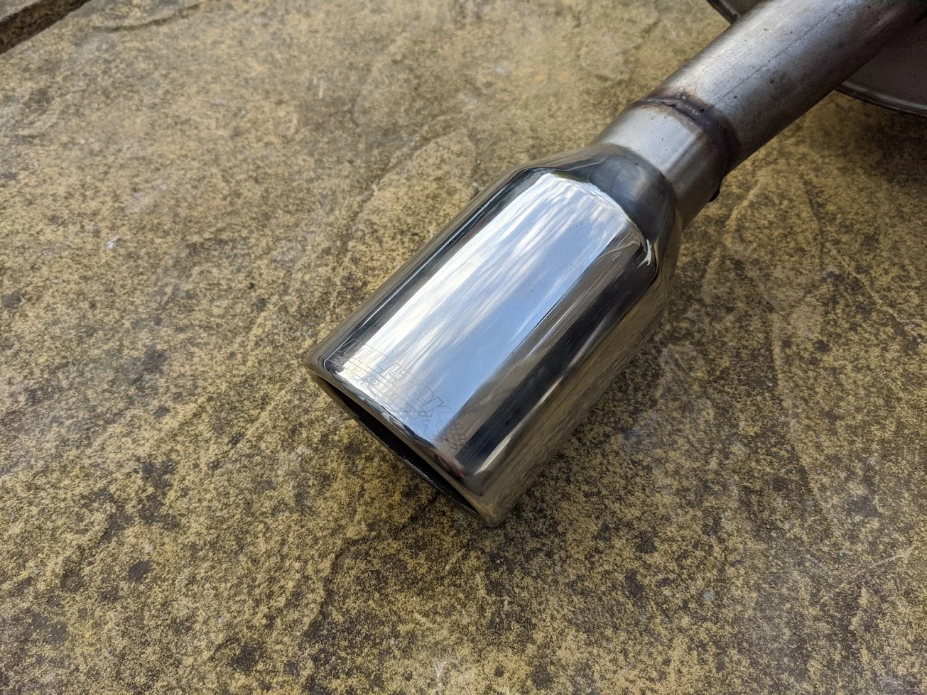

Gave my tips a good rubbing

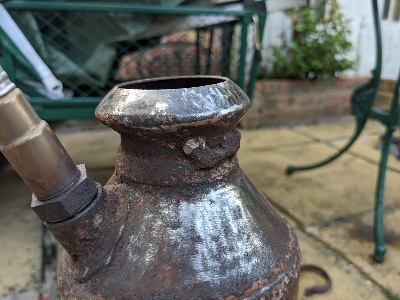

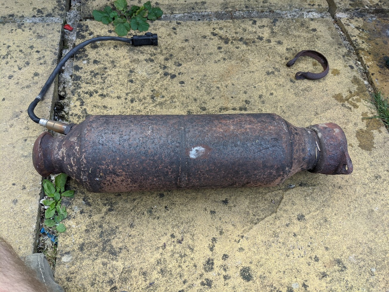

Cat was starting to look very sorry for its self - is the original one and looks fine inside
Someones been here before!
Sanded and quickly painted

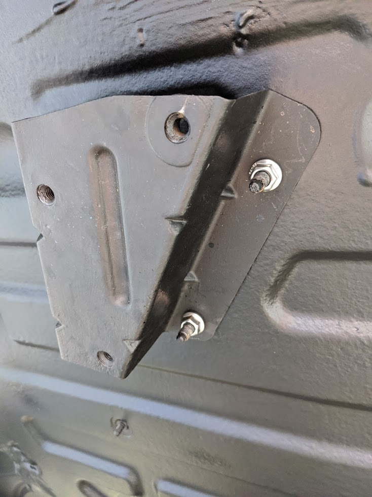

Mounting brackets back on the car

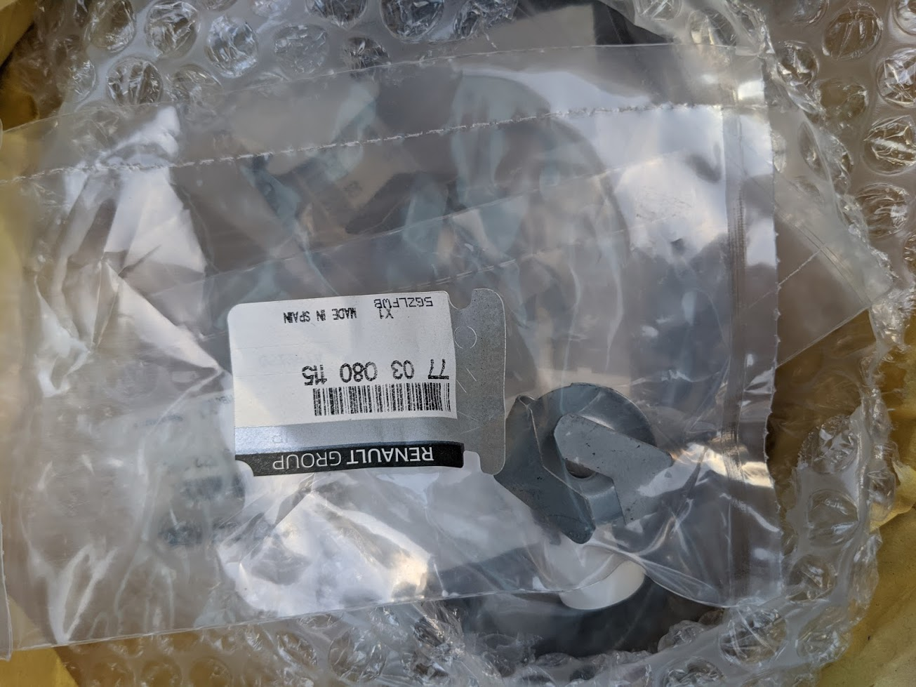

New heatshield clips from RPD
Some time later

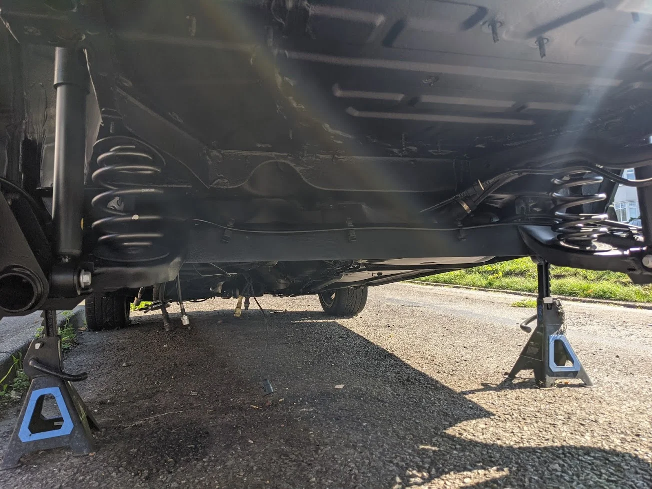

Added some clear wax after finally bolting up rear lines

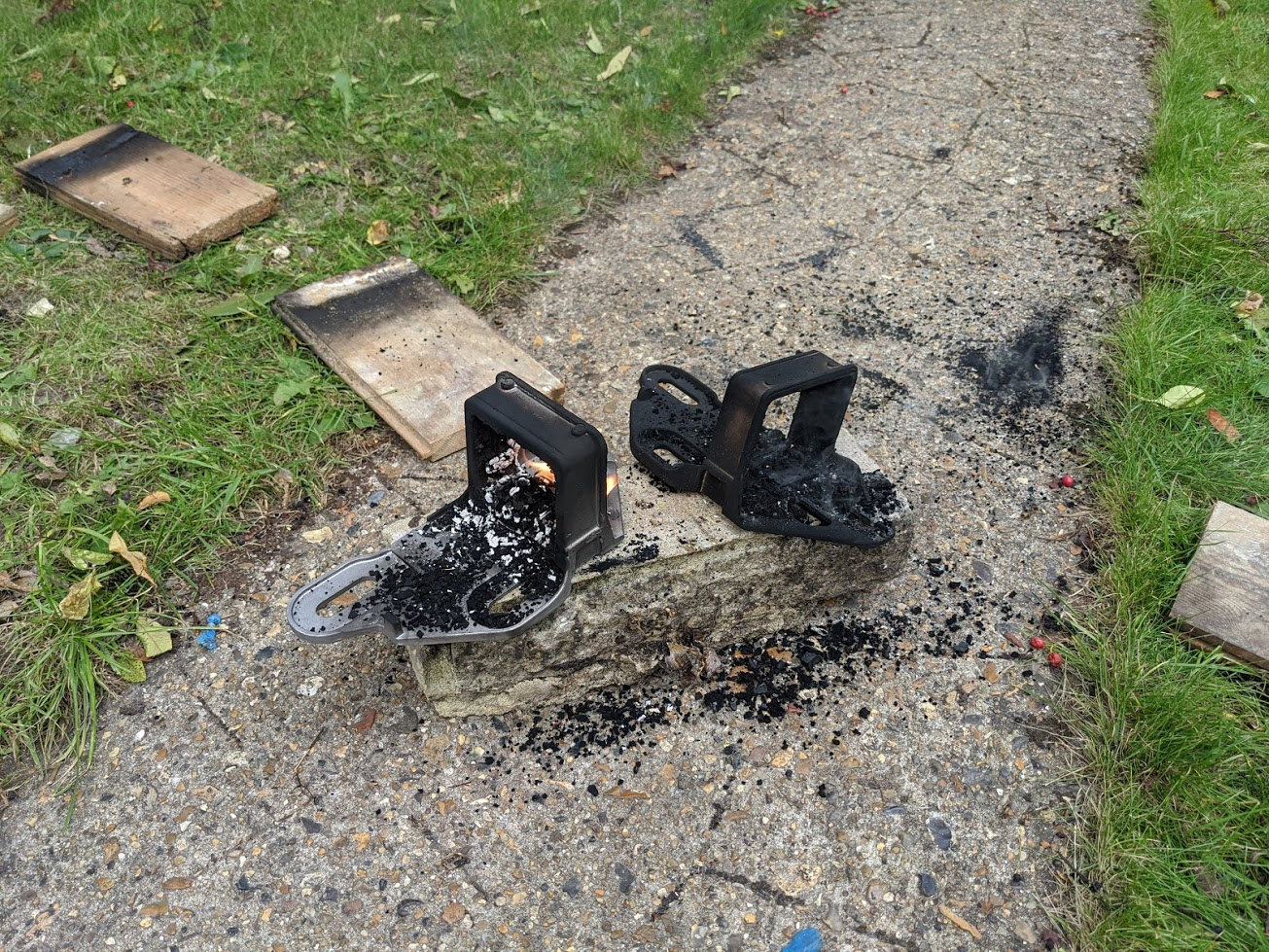

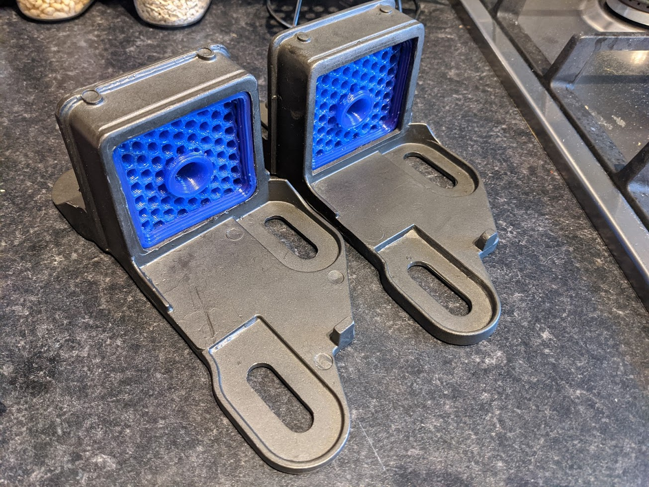

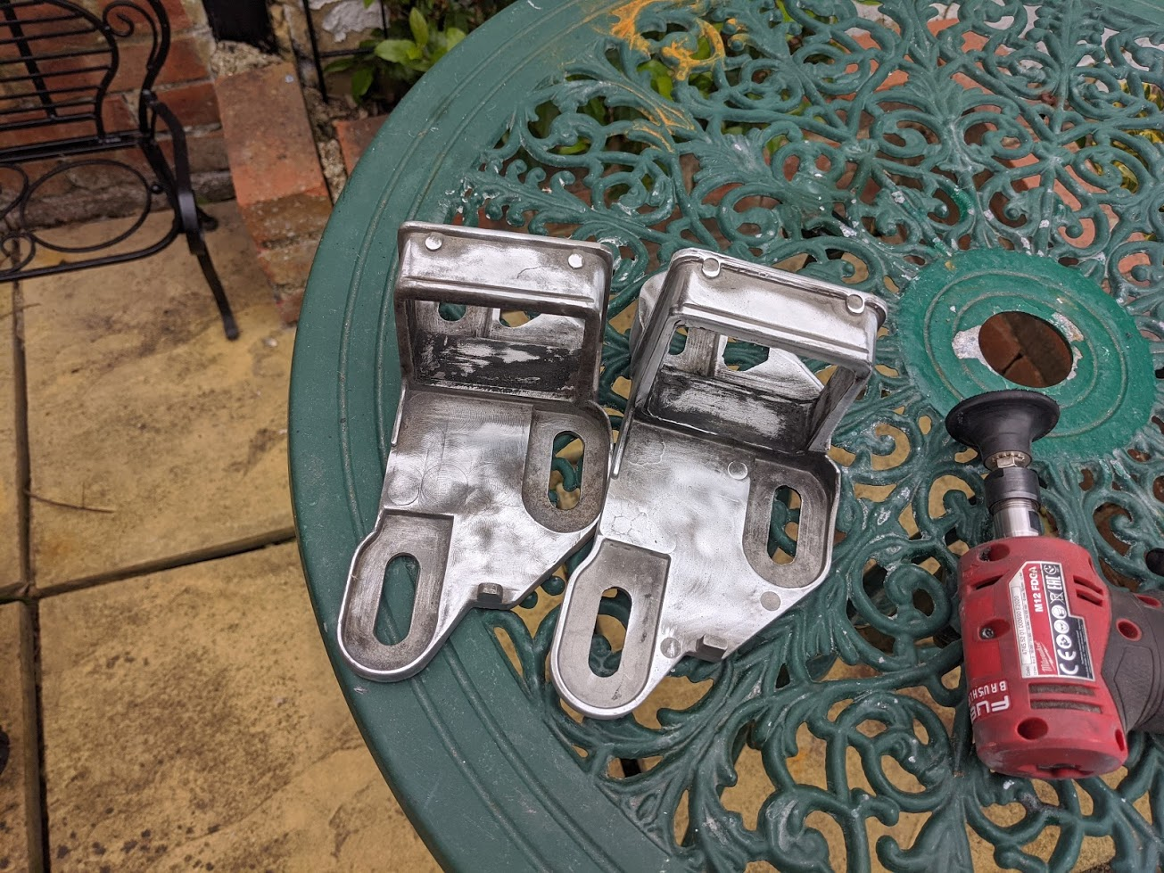

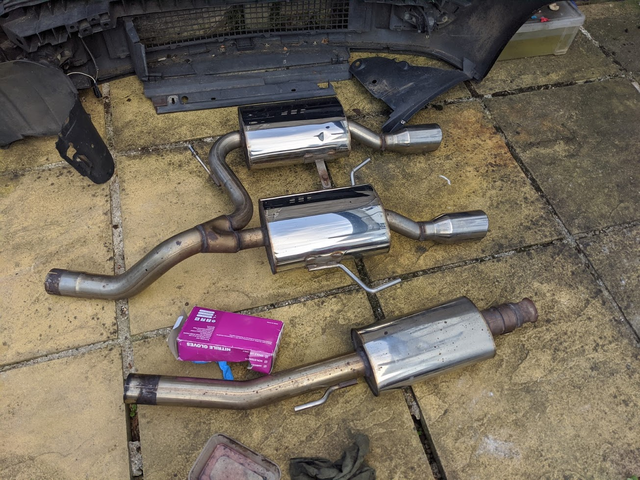

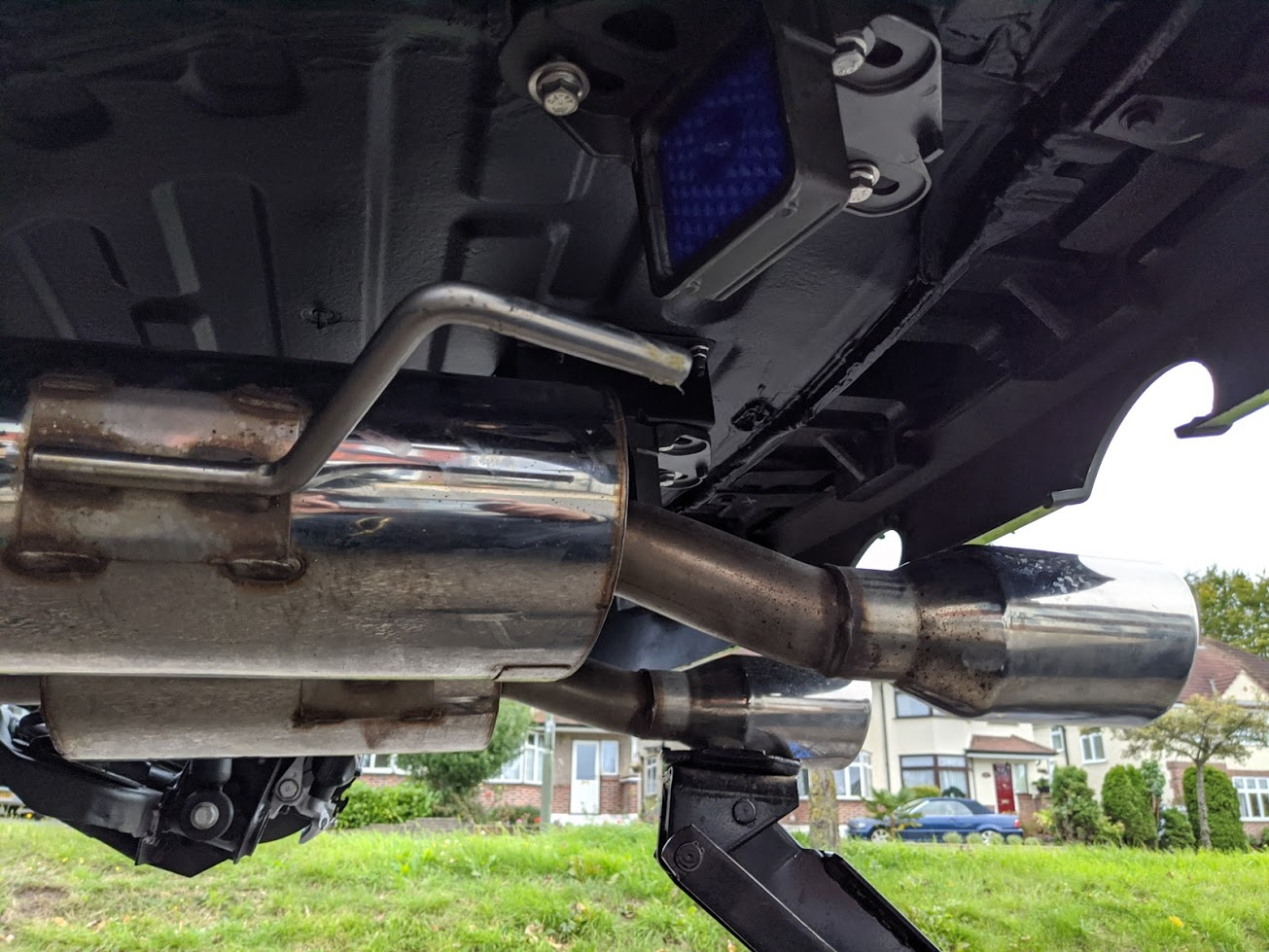

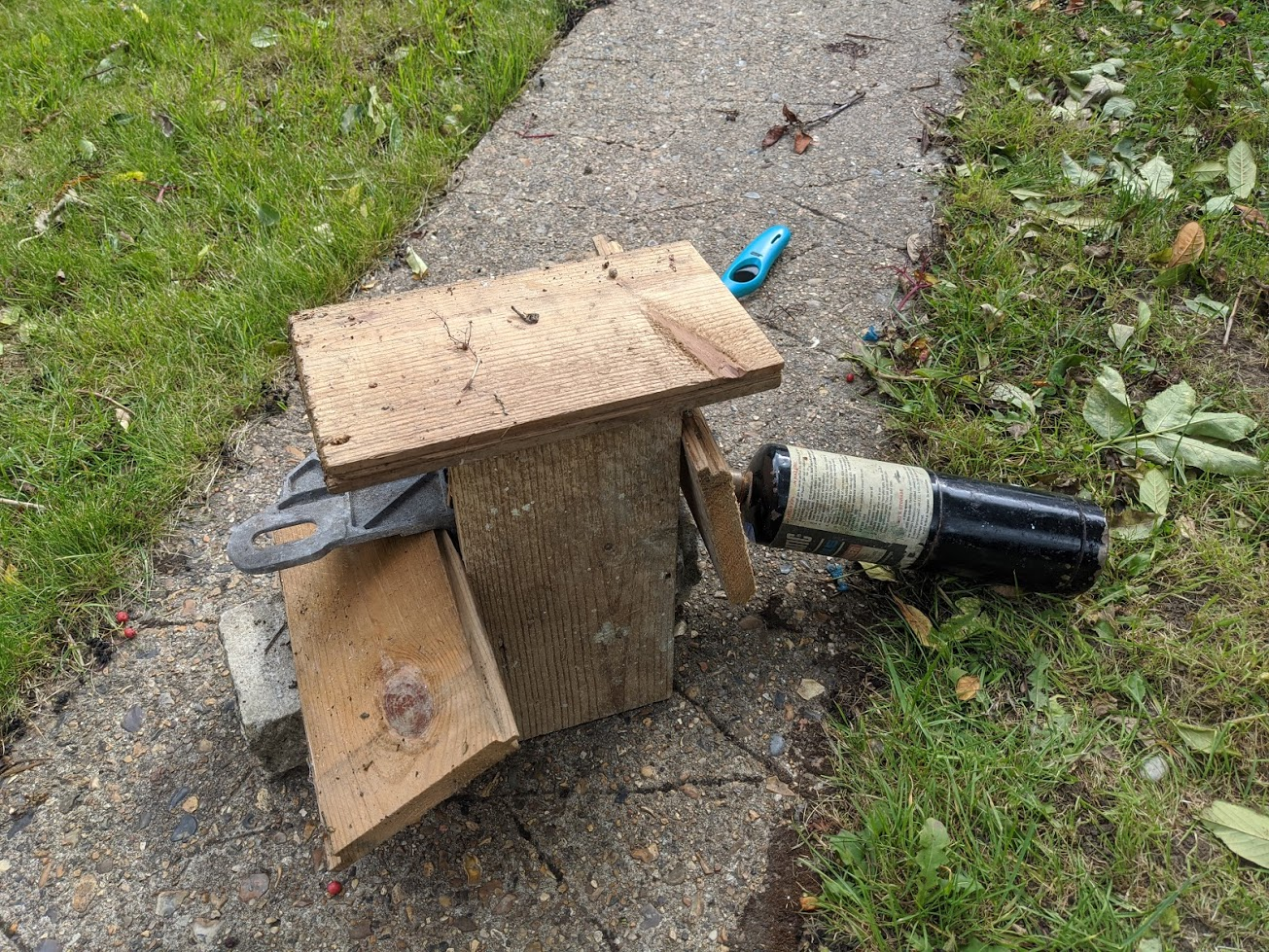

Time to begin the exhaust saga. I f**king knew I had a couple of spare mounts somewhere but buggered if I could find them... obviously found them in the boot of another car since... fool
Anyway. Two new mounts, surprisingly difficult to set on fire, had to build a little stove and soak everything in lighter fluid before it would get going properly, neighbors loved it... not. Weirdly building a stove out of wood worked.... great! f**k you science.
More grinding later.... bored of grinding things now
Bit of paint and some 3D printed mounts in place.... interested to see how long they last. Printed by a chap on here marked up by 50M% by KAM and bought by yours truly. But generally more than happy to support a member on here who is giving it a go.
Trying to get this all together was a c**t. Not many pictures because it was actually struggle street

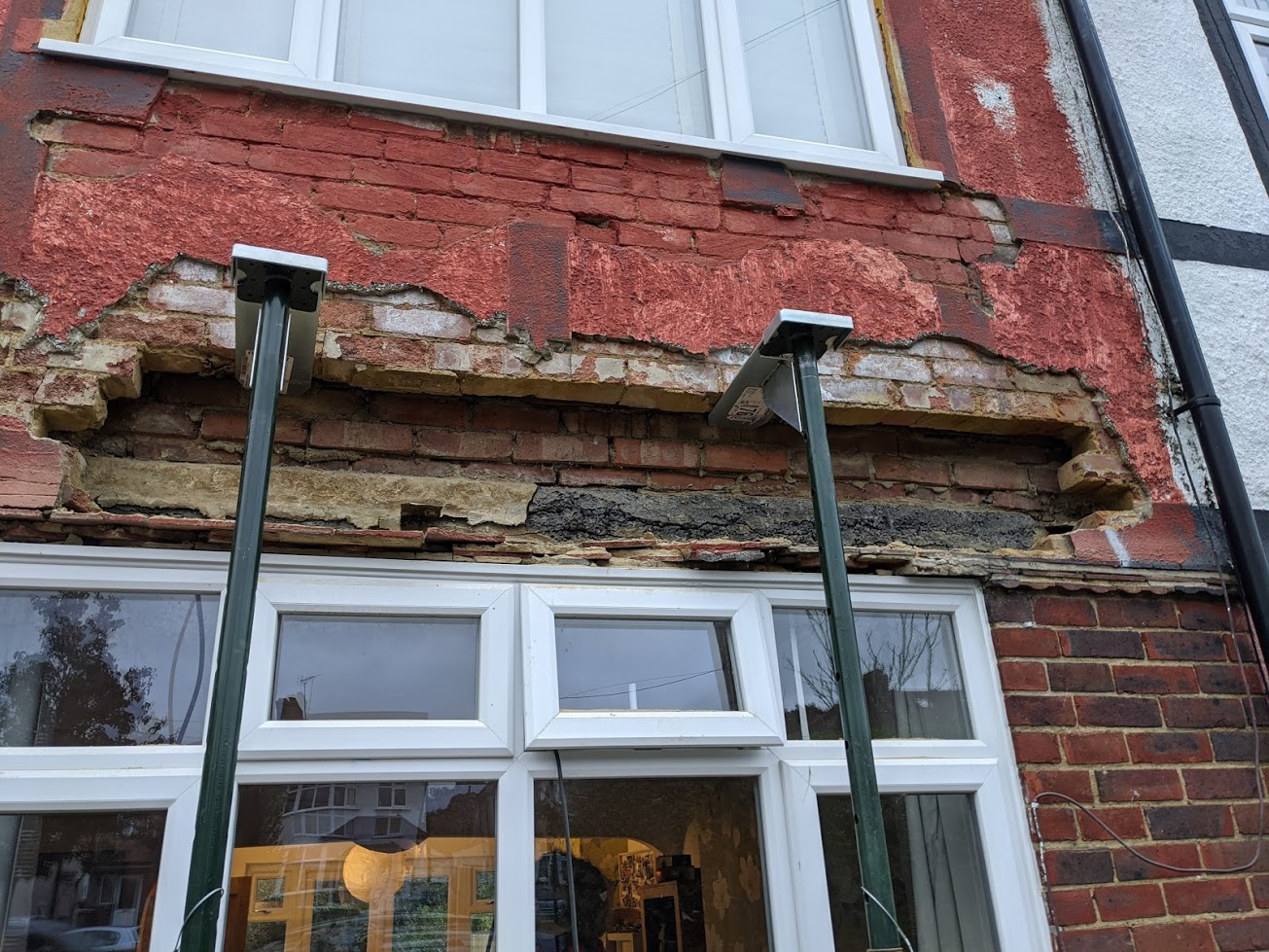

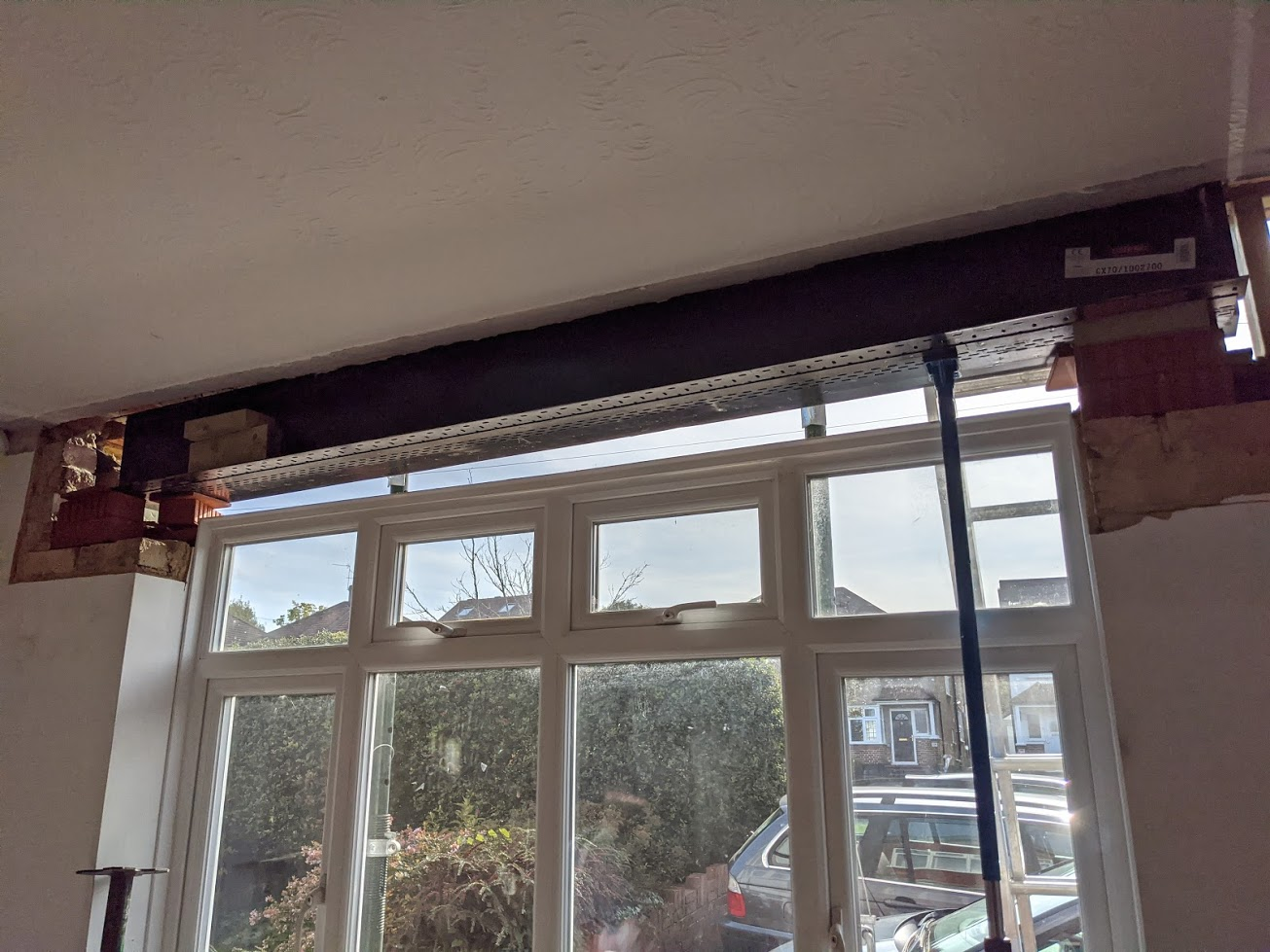

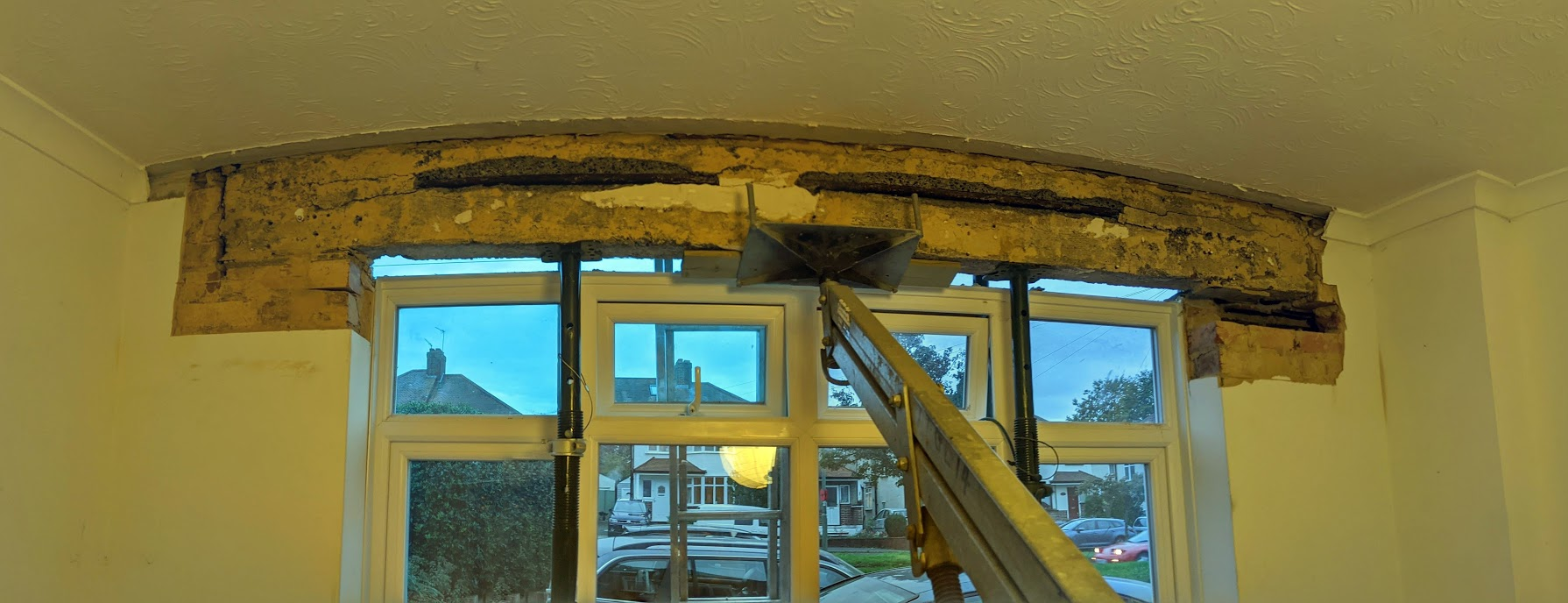

At this point playtime was over for a while. Needed to rip out a b*****d massive concrete lintel from the yard, had failed when some cowboys fitted double glazing the year before, but was likely going to fail anyway... they just hurried it up. House isn't supposed to be red either but thats another fascinating tale of cowboy misery.
f*****s 300KG!

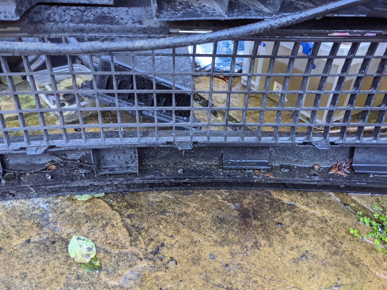

Its bumper day... yay *getting quite bored of forgetting to order stuff for the weekend by this point

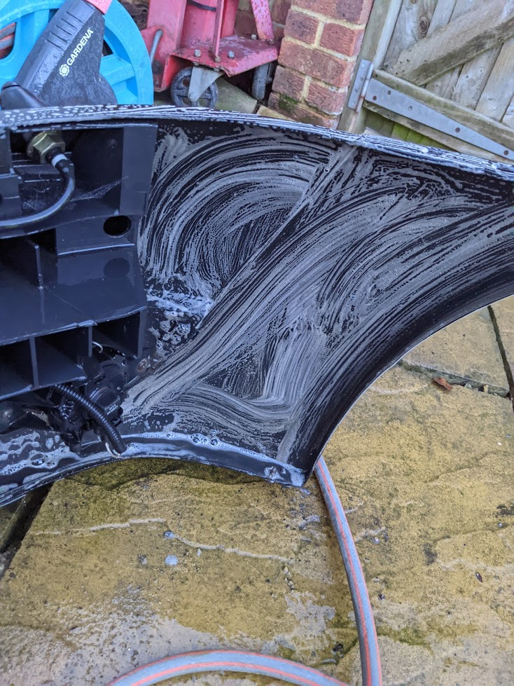

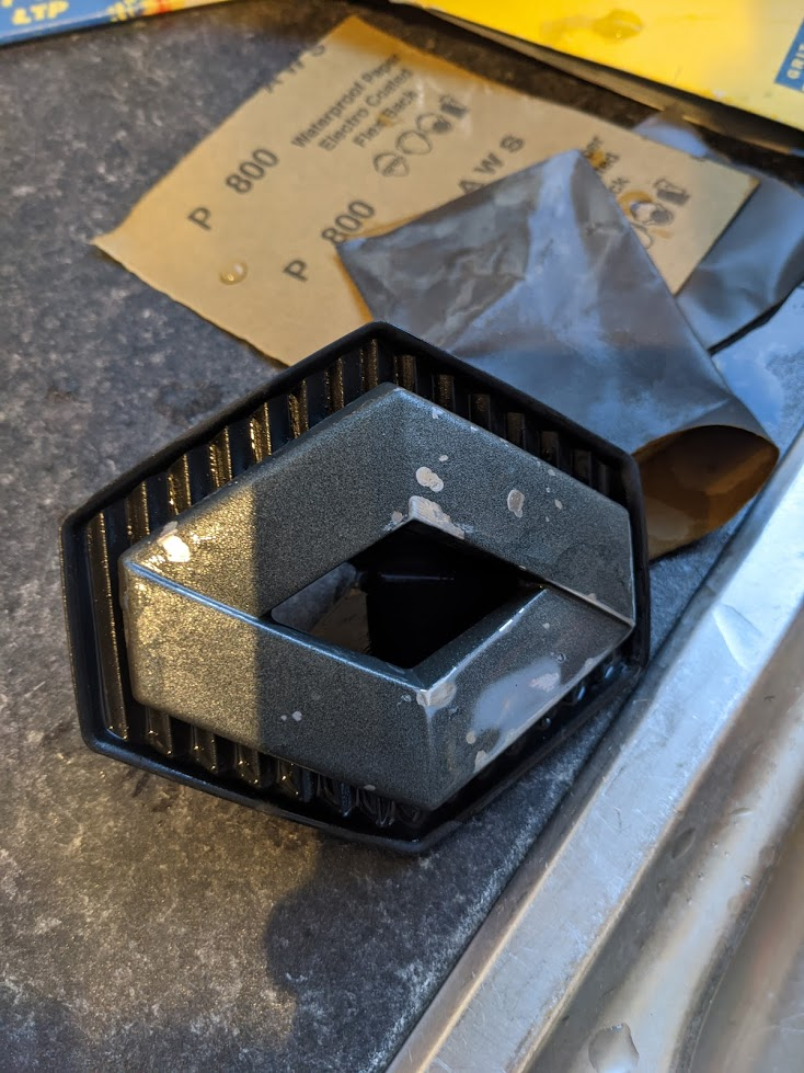

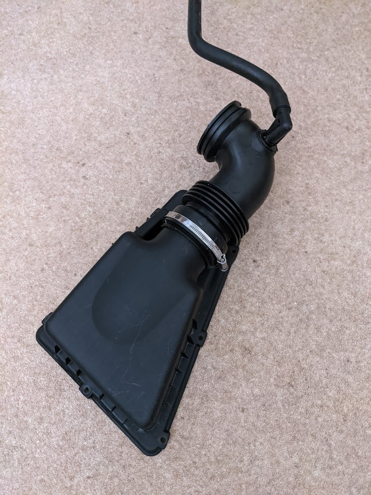

Bumper had been in the garden for some time by this point. The undertray was done for so will be replaced by future Rob. Time to clean the nature off
Gave the airbox a good scrubbing too and some aerospace 303

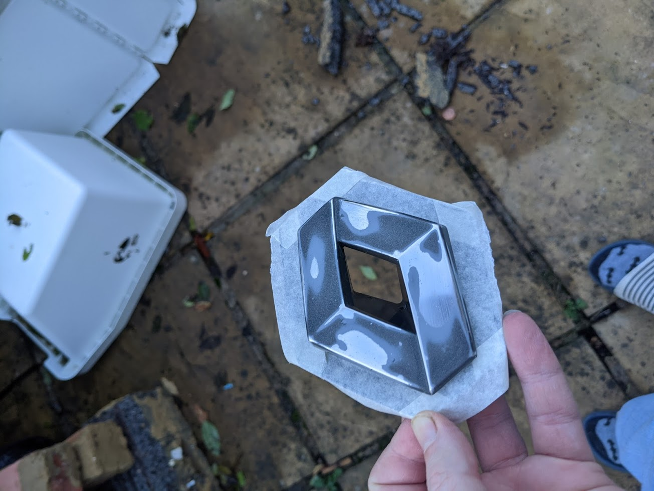

Front badge had been caved in by a mong previous to my ownership, only one I could find on short notice was a badly sprayed one
Few tickles later
Wham bam, forgot to take a few pics mam

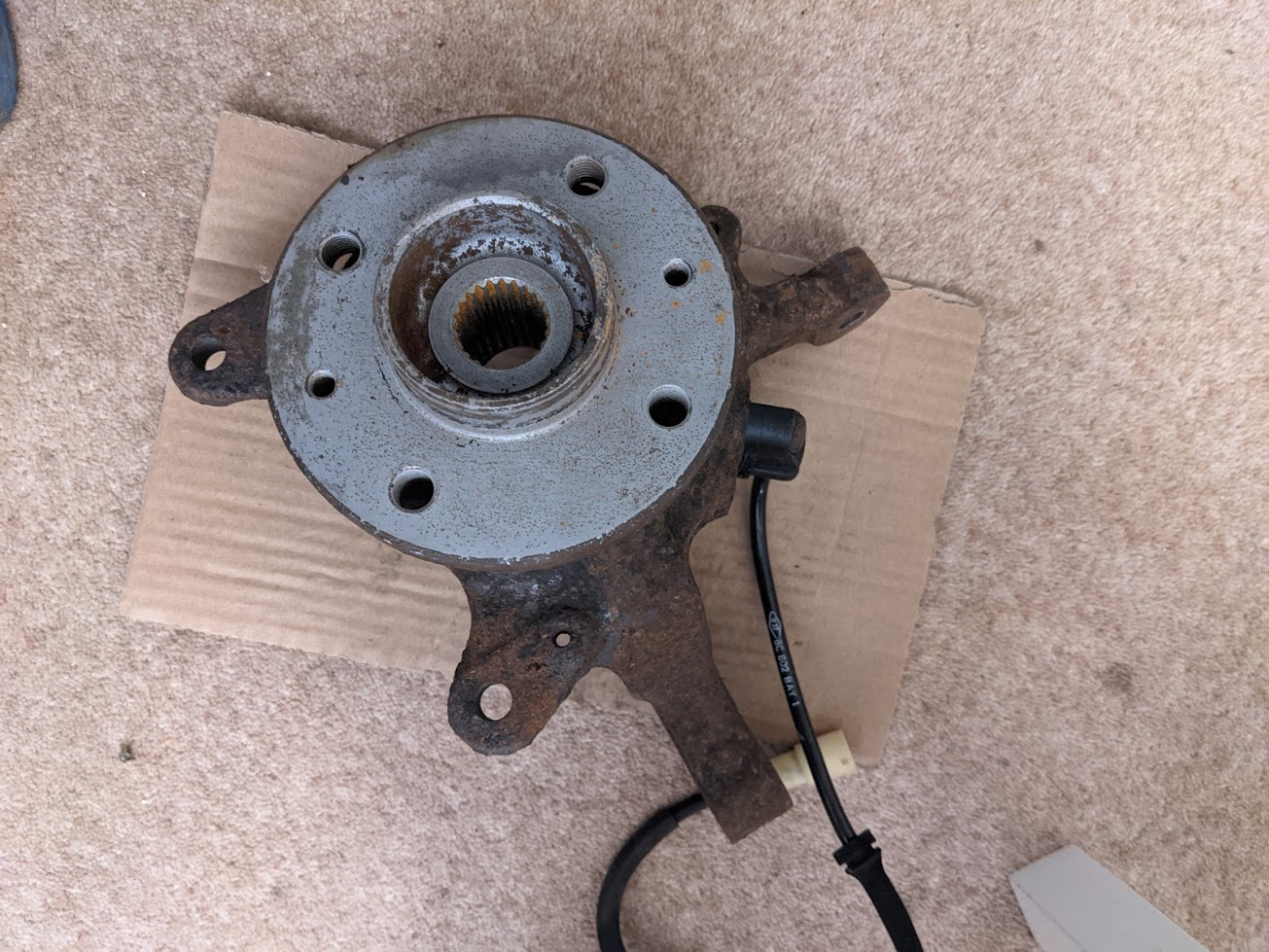

It was at this point that I knew... I had fucked up

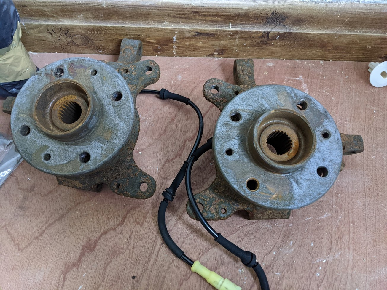

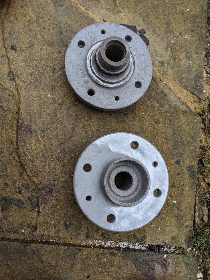

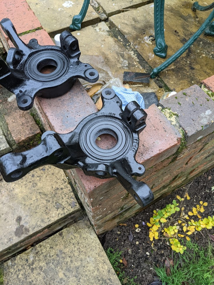

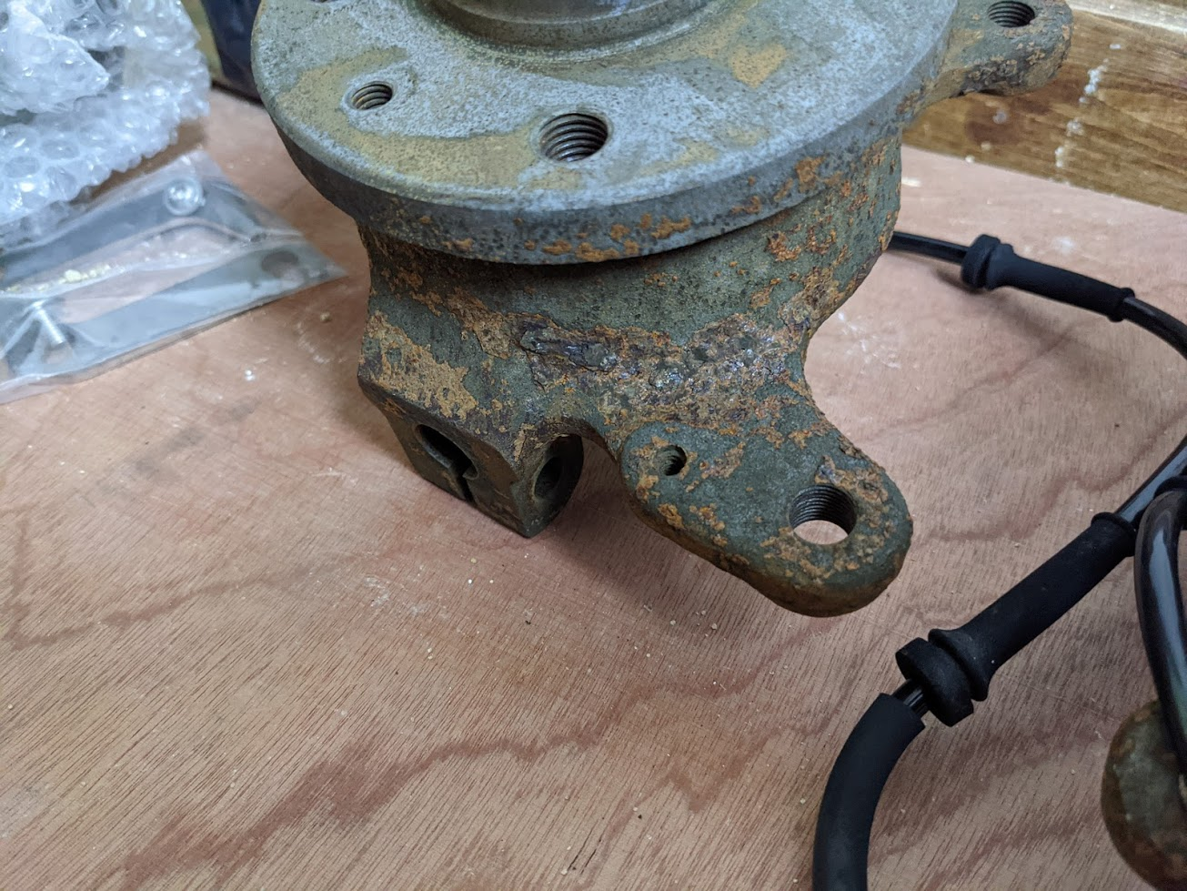

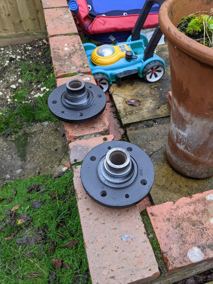

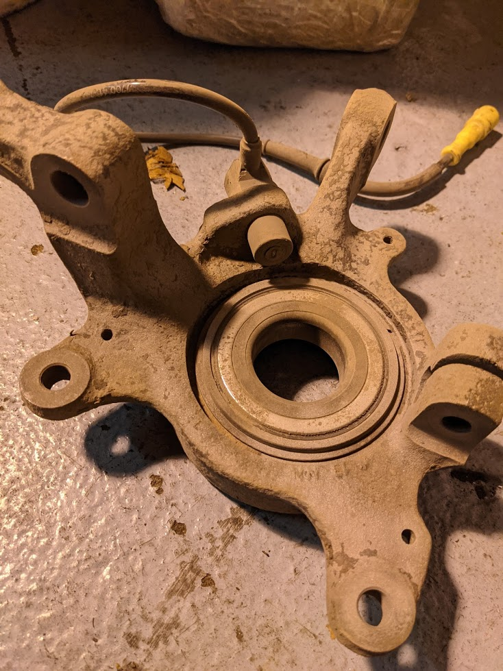

No matter what I did, I just couldn't get rid of play in the front bearings... after a few back and fourths it turns out that the SKF bearings I bought (believing them to be the dogs bits) were from a faulty batch, so in a fit of desperation I bought another paid of 60mm hubs from @Inferno182 (well recommended!). New hubs were in much better shape than the last scabby ones I cleaned up. But still a bit 15 year old mank
A 4 hour dip in citric acid later with bearings etc still in place
Then pressed the drive flanges out and went to my lock up to use THE - WORST - SANDBLASTER - EVER.
Over that pile of s**t, any remaining scabs were.... you guessed it ground off (with a good dose of wire brush in drill n eye). Dishwashered while she was out no doubt not socially distancing from her mother or something daft and painted. Not as pretty as the last ones but these actually work.
At some point I pressed the bearings out and round off the inner's from the drive flanges (such a dick of a job). New FAG bearings installed.
The fitted them up on the absolute pissing rain. End result was NO PLAY thank f**k for that

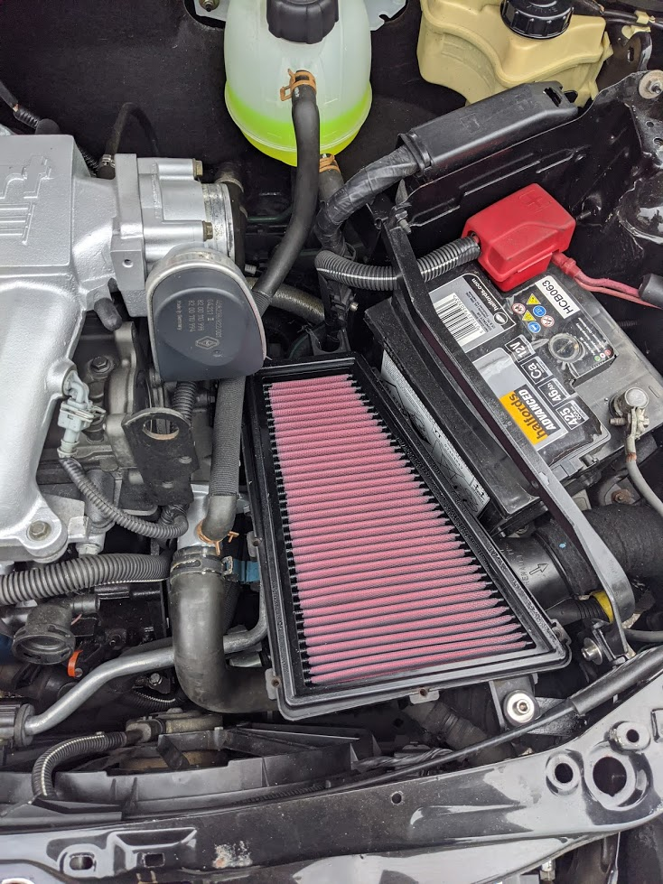

After having a word with my self about spending getting a bit out of hand decided I wouldn't buy a new induction kit as originally planned but obvisouly couldn't fit a standard (and probably better in every way) standard filter back in.

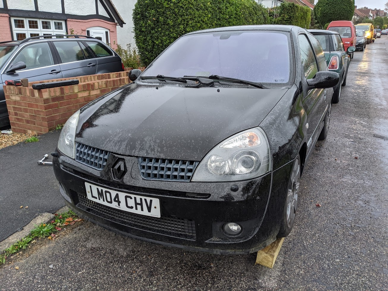

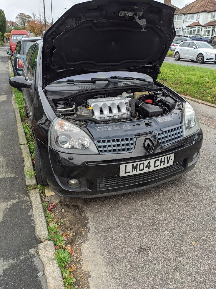

Then, this morning I took the old dear for an MOT!!!! yay!

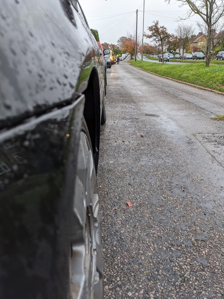

On route the alternator started trying to combust.... f**k ducks. After saying (to my self) that the pikey van in front was smoking a bit much for the trees and such slowly figured out all the smoke was coming from me.
Pulled over:
Was much worse in person. Smoke was more and I was standing in the road swearing a lot. Engine off didn't stop the smoke, all tools at home. f**k sticks. Drove slowly/quickly (f**k knows) home, to the safety of tools and ripped the battery lead off. Measured 0.7 ohms across the battery leads which is basically a hard short across the alternator because my leads are 0.5 ohms on their own.
Ordered a new genuine Alternator from eBay and a 100mm Jubilee clip (if you know, you know). Won't arrive until next week. Tomorrows plan is to charge the battery and take it for the MOT with alternator disconnected. Apparently will pass with alternator light on (we shall see) but I haven't had an MOT for a couple of weeks now and need to park it on the road. Its been there for so long I'm sure it will get reported by some do-gooding-arsehole-bored neighbor at some point.

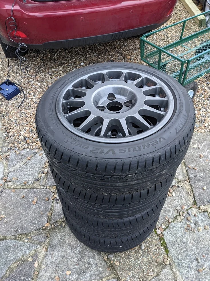

Lol I wouldn't follow my lead in regards to wheels. I have 8 sets for the clio at the minute 😂

Wow. Those braided lines are just perfect. From where did you get them?
