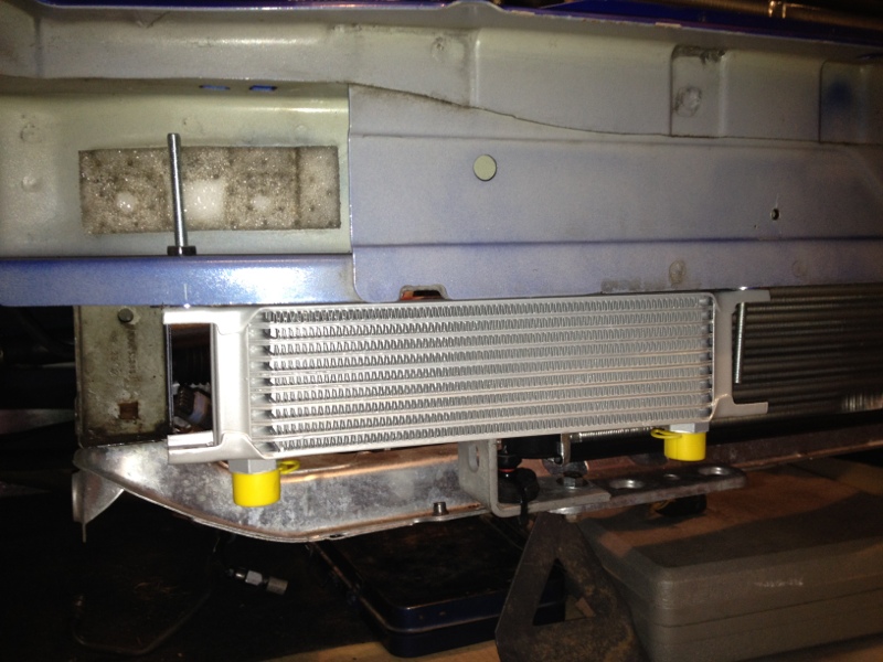

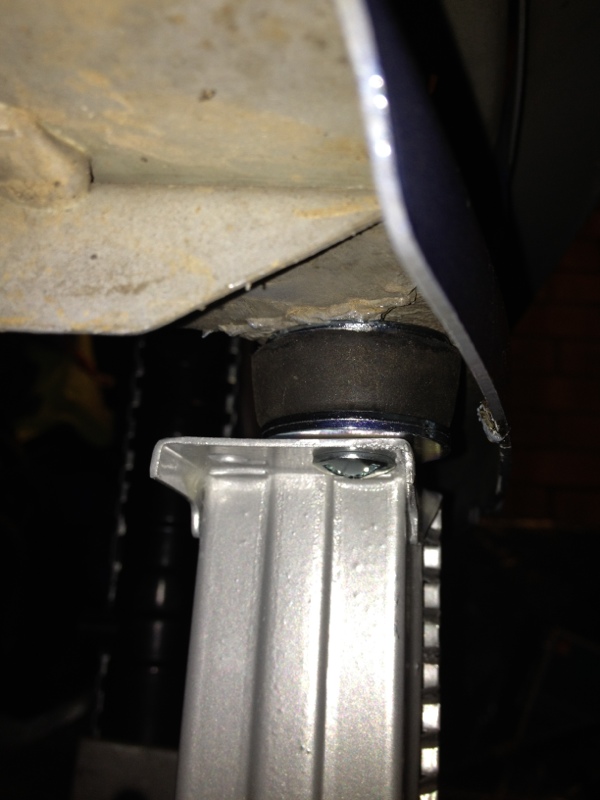

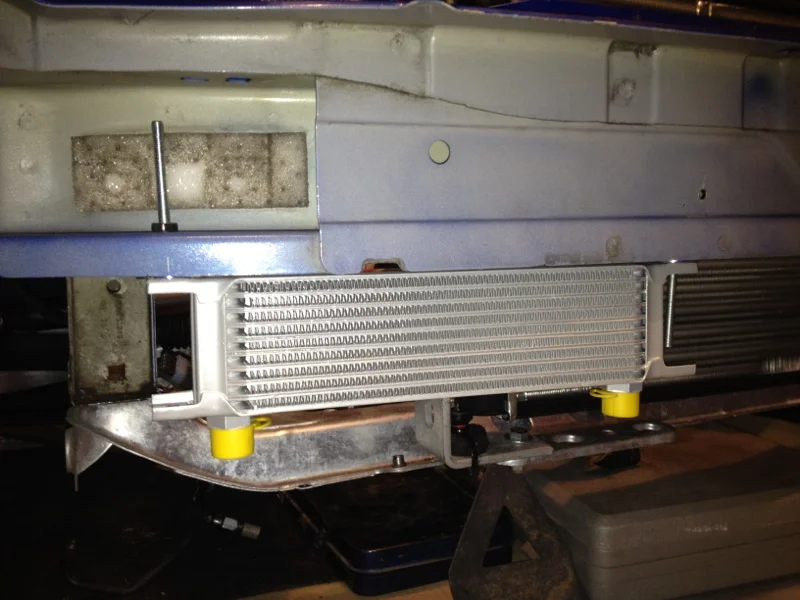

don't solidly mount the oil cooler and don't use self tappers, i hate those polo rads, no good for a road car IMO, find on a hero car, don't go hammering M8 bolts through it eh![]()
Ok- cheers, I think I can knock up some rubber mounts for the cooler.
Regarding the polo rad - suppose its a good job ours is a HERO car![]()

Also waiting on an oil cooler and some bushes amongst other bits and bobs. Interested to see how you have mounted your cooler. Also like the looks of the Polo rad.
Keep up the good work, might see you on track soon.
Nice job with the oil cooler, I'm thinking to move mine atm. I thought the inlets/outlets had to be upright otherwise it just empties all the oil from the rad into the sump and then you can never read the oil level? I am probably totally wrong![]()
That makes perfect sense I knew I'd be wrong lolYou got me thinking about the orientation of the cooler for a minute! I think its alright with the inlet/outlet being underneath as the oil filter is well above the height of the cooler and this is acting as the "head height" of the pumped system. Hope so anyway![]()

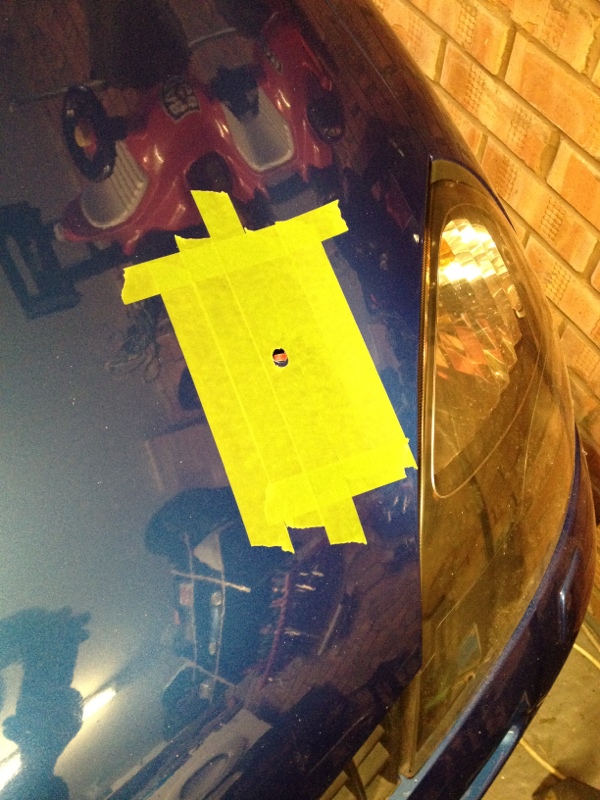

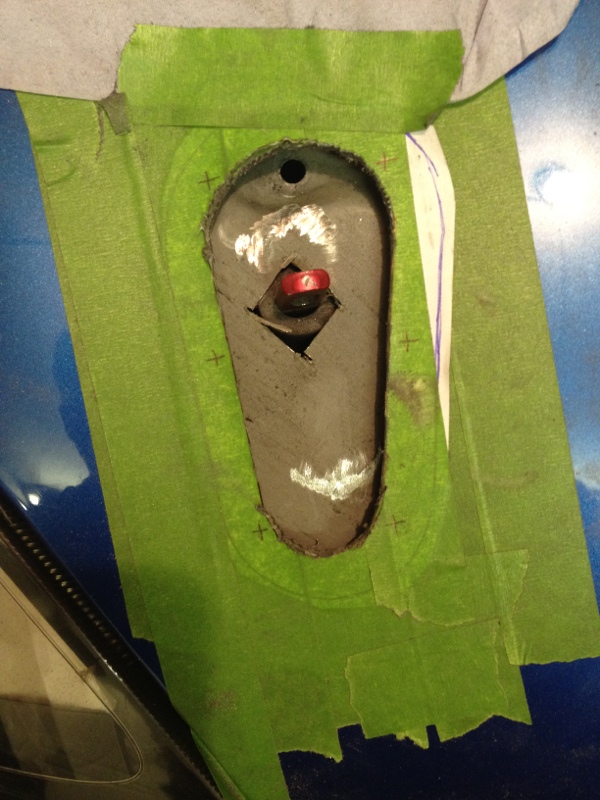

I've got my bonnet held on with 4 of these after I cut the entire skin out. Saved a good amount of weight from chopping it all out as well.
Measure twice cut once is the key! Lol!
How strong is the bonnet without any ribbing? It must flex quite a bit surely?
Definately a case of measure twice, cut once!![]()

Spent yesterday afternoon copying your idea for mounting the oil cooler and have just ordered an SE310 from adrad as future plans are for throttle bodies and my original rad is rusty. You will find the car on here from when AdamR owned it. Might do a rebuild thread over winter, but for now its just build, build, build before the season runs out.
